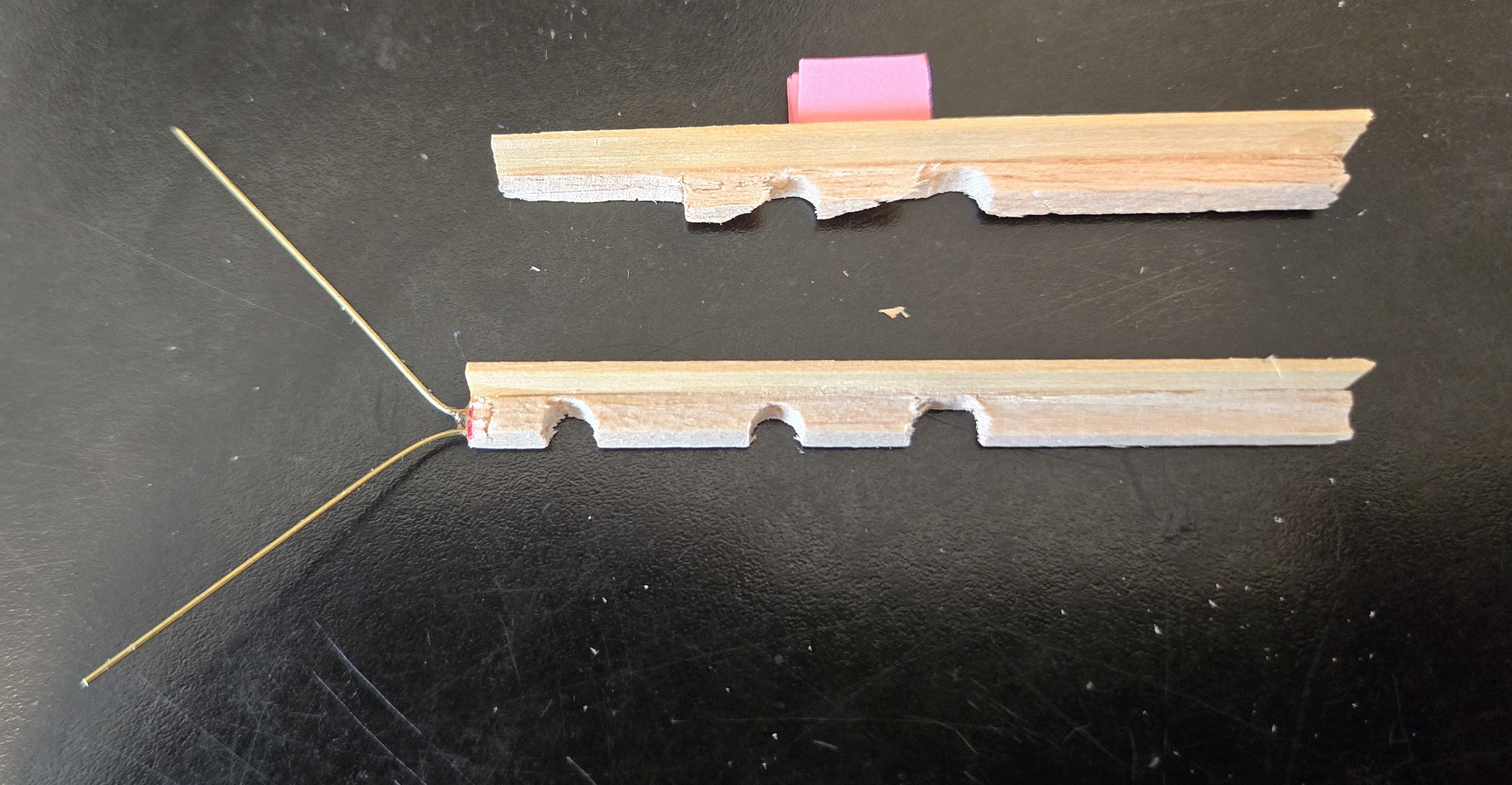

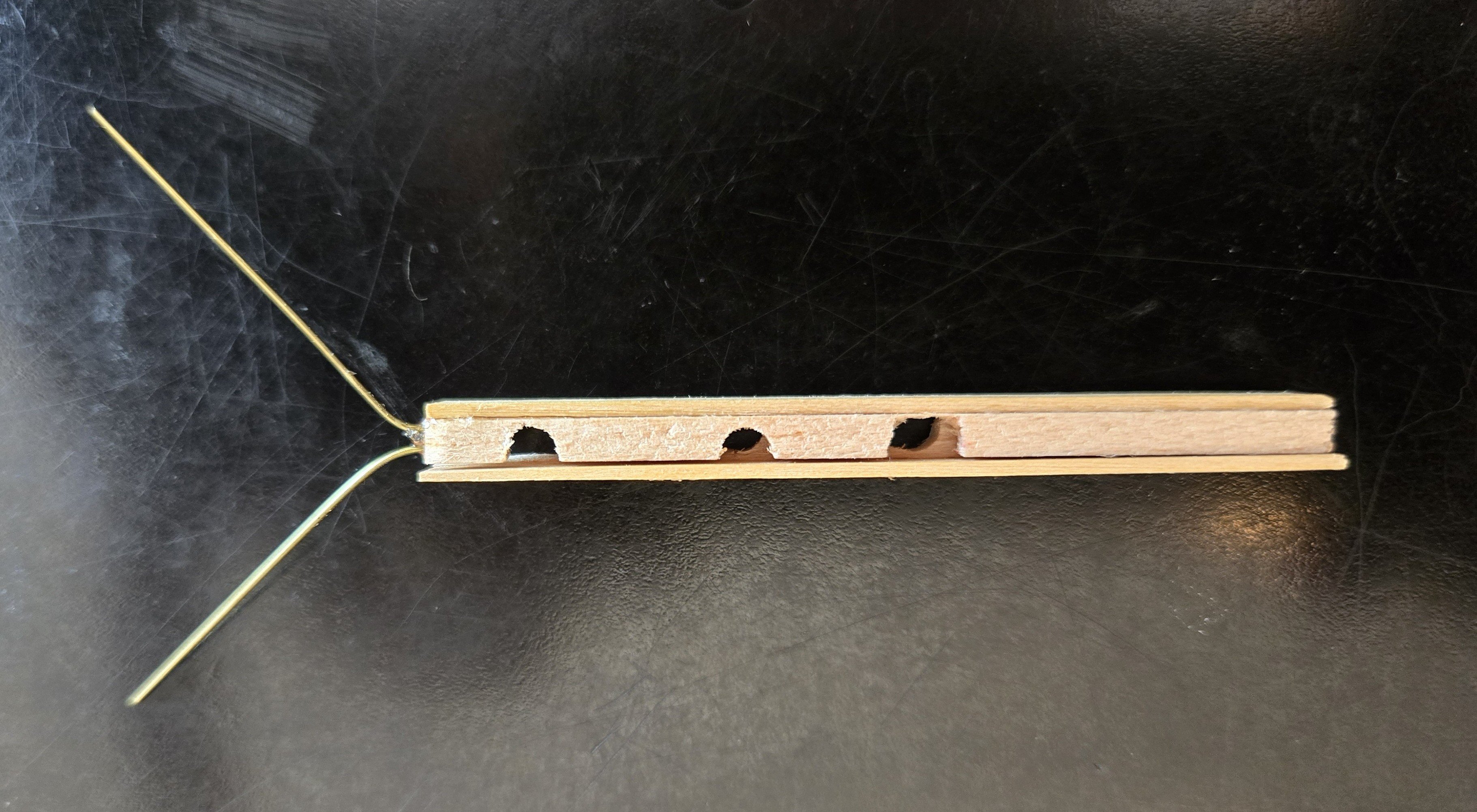

The tool that I came up with piggybacks on the fortuitus use of a metal rod for the jibboom documented earlier.  This provides a firm anchor for the tool which has two parts, one clamped on the left side of the jibboom and the other on the rightside.  Pic 2 shows the two parts together (without the jibboom and Pic 3 shows the two parts separated.
tooltogether.thumb.jpg.2c9a353f7df81b54783c299ca09a16d0.jpgT
The slots that have been filed permit the stays that pass through the jibboom to be adjusted when the clamp is on.  The two rods project under the catheads to provide more firmness.toolseparate.thumb.jpg.51db4c3d69e66f3faa8b3f79d707e974.jpg Pic 4 shows several things.  First, it shows the 'tool' clamped around the bowsprit/jibboom.  Second, it shows the stick that organises  the 4 main stays and the 5 fore stays.  This stick pivots around the tool to facilite getting the boat into the bottle. Third, it show the the ship hanging upside down to make mending the lower foremast easier. (I don't remember if I mentioned that the lower foremast broke just below the mast band supporting the forecourse truss during these machinations.)  Hanging it upside down greatly facilitates ensuring the right alignment as the glue cures.  The pink clamp pulls down on the upper masts also to facilitate the alignment.  Having the stays all organized also helps this mending by keeping all of the rigging away from the mend point.  The only remaining problem that I am aware of now is that mending the mast will most likely also glue the fore yard to the mast which is not OK.  I'm thinking of cutting the fore yard truss (wire) and replacing it with thread after the mend is complete.  The upper yards mostly use thread also.
 upsidedown.thumb.jpg.9a605362ff3d811d369ddff17ab67902.jpgo

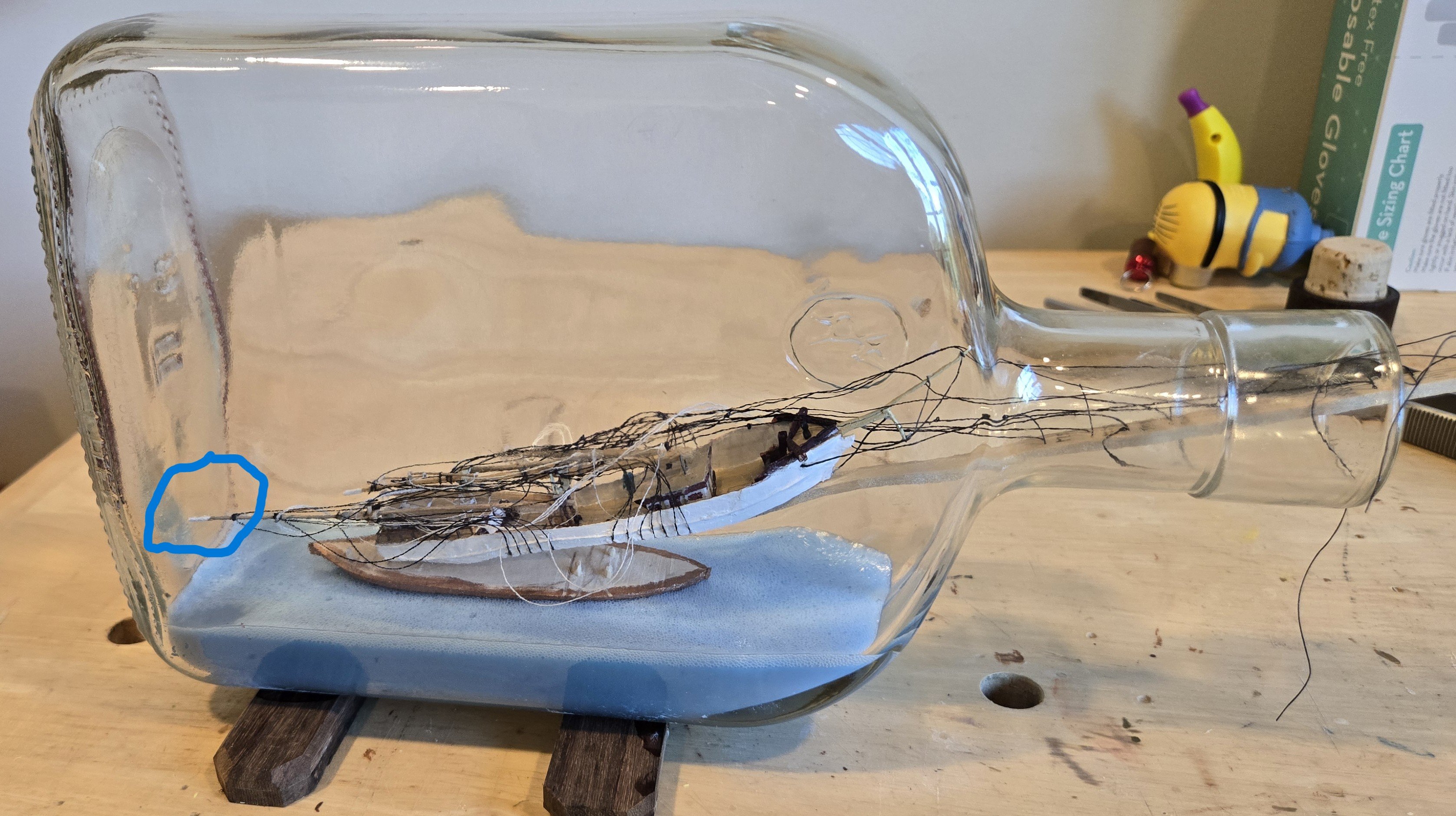

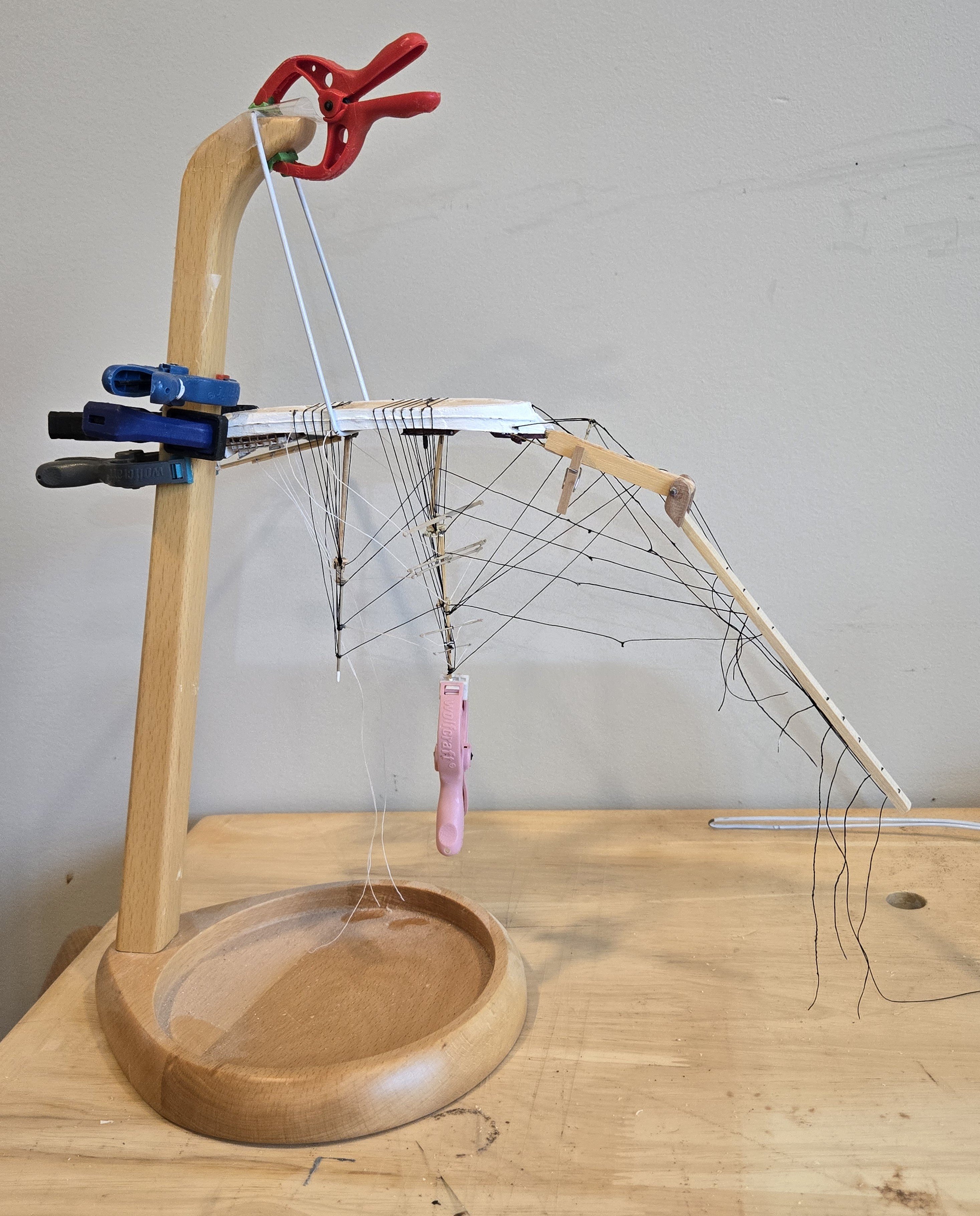

After about a 3 month hiatus due to flagging confidence that I could successfully do the the delicate work coming up properly, we are ready to continue.  Pic 1 shows Leon glued in the bottle with all the extensions of the stays coming out the neck.  The work of gluing the hull down was clumsy and not well done but at least it's finished.  Now we are ready for the final adjustments of the stays and braces.  I usually reduce the size of these pictures but I think the larger size is useful to see the rigging more clearly. 1-15togo.thumb.jpg.8edcd16aeee59022c0b3e0cefbe1a8cf.jpg
I had a plan for how to proceed but that plan changed at every step.  The first step was to tighten the forestay, put a drop of glue where it entered the anchor deck and then cut it off where it left the stemhead.  This worked beautifully.  I had planned to continue with the fore topmast stay but realized that structurally it made more sense to do both the mainstay and the main cap-stay because they end at the lower foremast which was now stabilized by the forestay.  There was a problem, however, because the 4th main port shroud had apparently been compromised when the upper hull was glued to the lower hull so the mainmast could not rise to its proper position.  The only remedy I could think of was to cut that shroud at the waterline and hope I could glue it back in place when the rest of the rigging was done.  Having cut this shroud, I fitted the mainstay.  I unskillfully cut that stay where it left the lower foremast leaving a tuft of thread about 1/16" long which hopefully I'll figure out a way of removing later.  Then I fitted the main cap-stay and cut that off pretty cleanly.  Now I figured to fit the main topmast stay since it ends at the lower foremast cap and thus is also stabilized by the forestay.  Unfortunately, the lower topsail yard is also attached to the lower foremast cap and I was afraid that a drop of glue for the main topmast stay might immobilize the lower topsail yard.  So I decided to fit the upper topsail yard (which is rigidly attached to the lower topsail yard but is a little above the lower foremast cap) before working on the main topmast stay.  I also figured to fix the lower yard. Since I was fixing all 3 lower yards it seemed reasonable to fit their braces also.  At this point, I figured another photo, Pic 2, might be interesting. The easily seen differences between these two photos ae 1--  The missing 2 extensions of the 2 lower mainstays leading out of the neck and 2--  The correct orientation of the foreyard.  The braces for the lower 2 yards can also be seen but being white they are not very obvious.
Before putting the ship in the bottle, the braces for the foresail and the lower topsail were taken from one yardarm, down to a hole in the bulwark, across the deck in a loose bight to a hole in the opposite bulwark and up to the opposite yardarm.  Now in the bottle, after the yard was glued to the mast, a hook was introduced through the neck of the bottle, back to the bight which was then gently pulled taut.  The brace threads were glued to the holes on the outside of the bulwark and then cutoff on the inside of the bulwark.   Also visible is a ring of copper wire around the martingale - this is a remnant from the clamp that allowed the ship to be inserted in the bottle.  This will be removed later after all the threads are out of the neck of the bottle.   I'll talk about the tools used for these operations later.

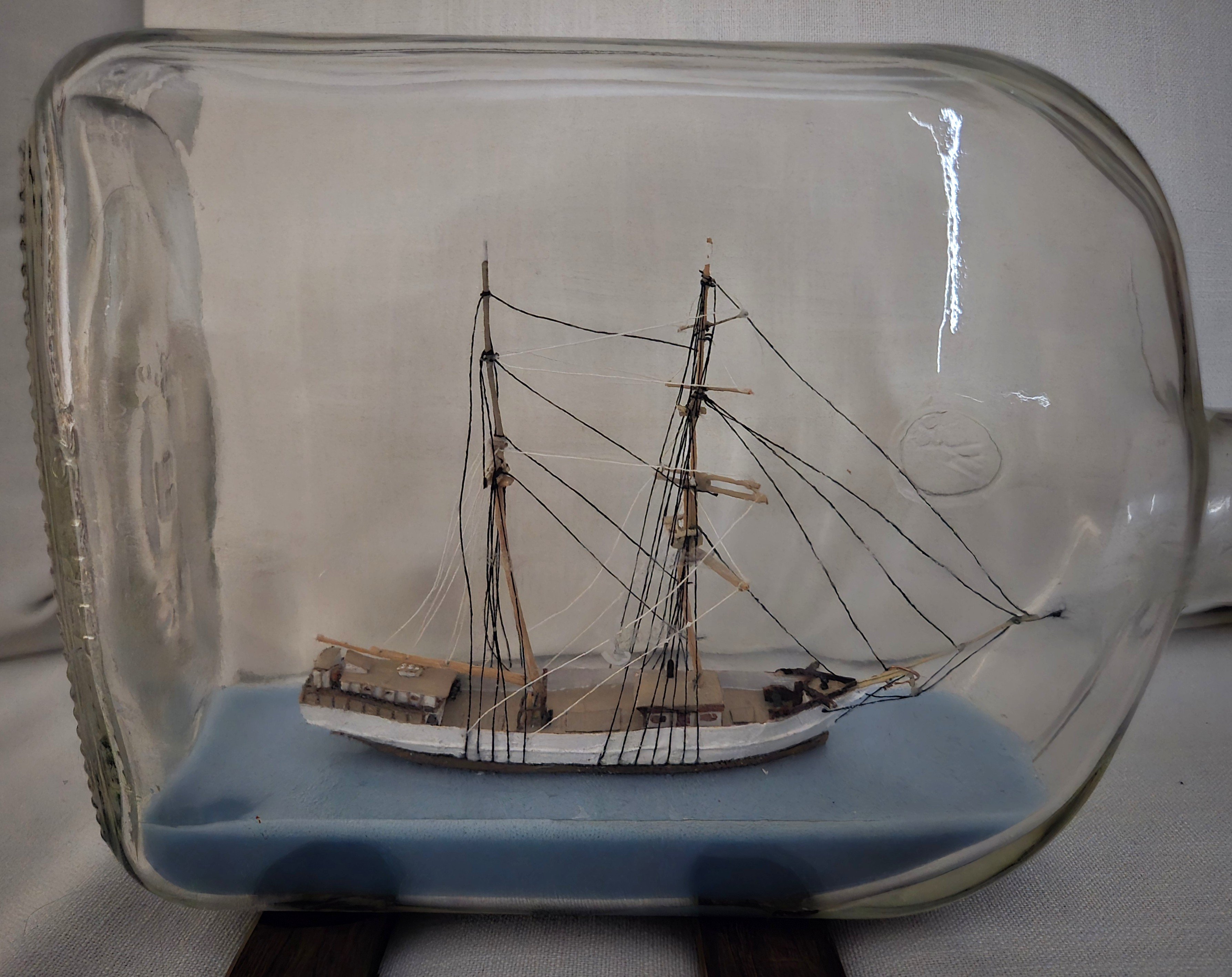

Just a few items left.  All 4 remaining forestays have been glued and clipped,  The main cap-stay and the main topgallant stay have been glued and clipped,  The upper topsail, the topgallant and the royal braces have been fitted.  A number of repairs are needed to finish the job, however.  Before tackling the repairs, we'll mention that the braces for the 3 upper yards lead back to the mainmast, unlike the lower two yards that went to the bulwarks.  To make them work when putting the ship into the bottle they were rigged differently than for the lower 2 yards.  Thread was tied to the port yardarms, led back to a thwartship hole in the mainmast and then left hanging.  Fitting these braces involved gently bringing the port brace taut and gluing the starboard brace to the starboard yardarm and then trimming the leftovers off.  Keeping the braces taut was marginally successful.

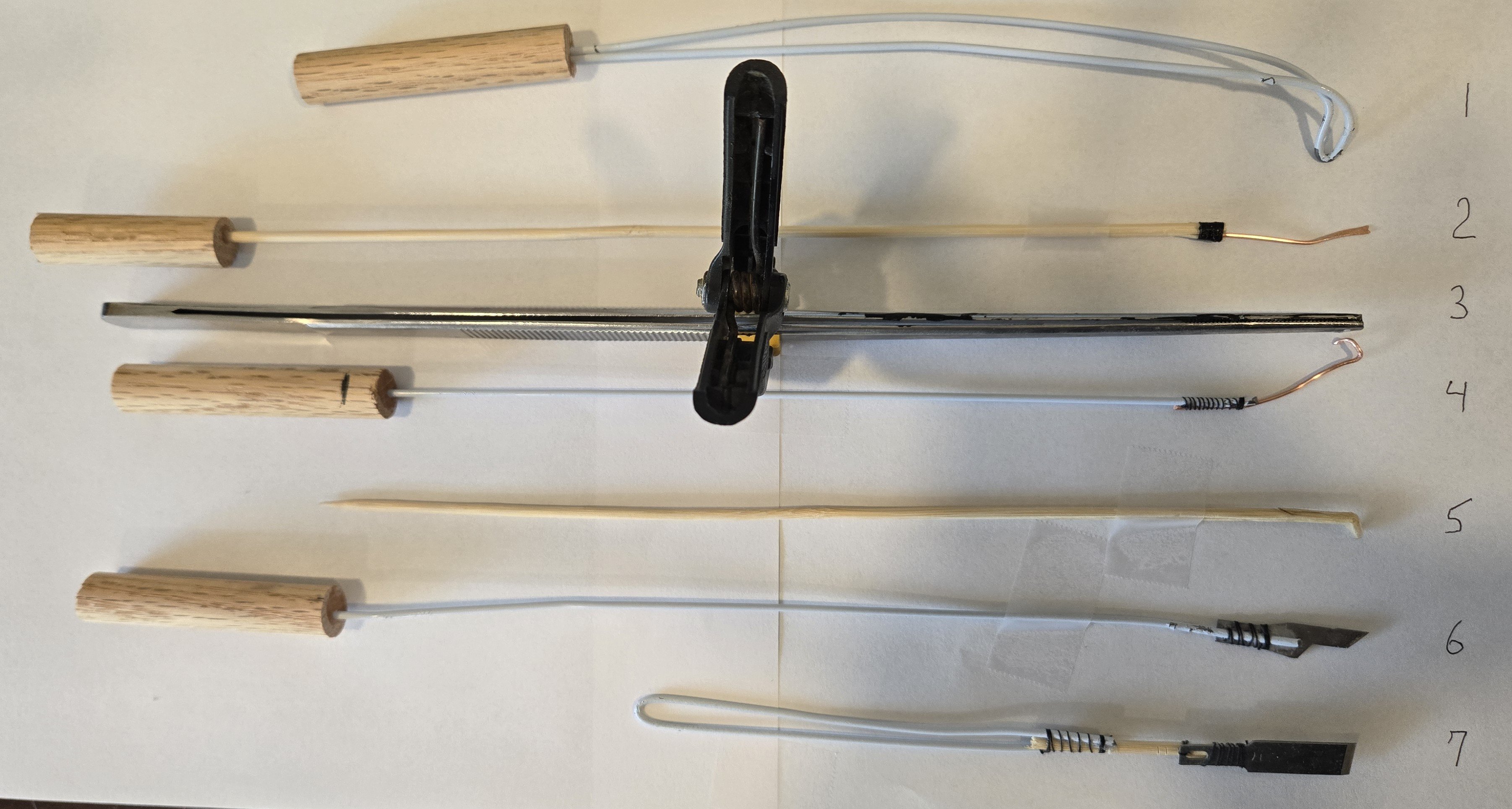

After identifying the repairs need, we'll talk about the tools used on this project.  Starting from the tip of the jibboom the needed repairs are:  1-- Tufts from the fore royal stay & the jib stay.  2-- Remove the copper wire ring.  3-- A tuft from the mainstay. 4-- A small tuft from the main cap-stay. 5--  The foot of the main topgallant stay needs to be reattached.  There are a number of problems with the mainmast because it did not come to the proper rake that would have tightened up the shrouds and backstay. 6--  Tighten up starboard shrouds #2 and #3.  7-- Tighten up the starboard backstay. 8--  Reattach the port backstay.  9--  Tighten up the peak halyards.  10--  Remove a few drops of glue on the inner surface of the bottle.  There are no guarantees that I will be able to effect these repairs but I'm going to try.
#1 helped press the lower hull onto the ocean when it was glued in place.  Then again used to press the upper hull down onto the lower hull when it was glued.  I couldn't apply enough pressure to make that joint close though. #2 helped to push spars and rigging into place.  There is a small groove filed out of the square tip.  #3 long tweezers with a clamp that allowed hands free gripping of rigging. #4 for pulling spars and rigging into place.  #5 for applying glue.  I only used maximum viscosity CA glue with this tool so it would not drip.  That did not stop me, however, from leaving a few glue drops on the inside of the bottle.  #6 a smallish cutter.  #7 a larger cutter - both used to cut threads.
I should also point out that the bottle introduces more distortion than I expected.  In my final picture of the ship I will try to find an angle that minimizes the distortion.   In any event, I was planning to tackle the repairs before posting but I seem to have another attack of lack-of-confidence and as a result I seem reluctant to actually tackle the repairs.  I do not know how long this reluctance will last so I'm going to post now.  BTW the lack-of-confidence has to do with a fear of making a mistake that can't be fixed.
