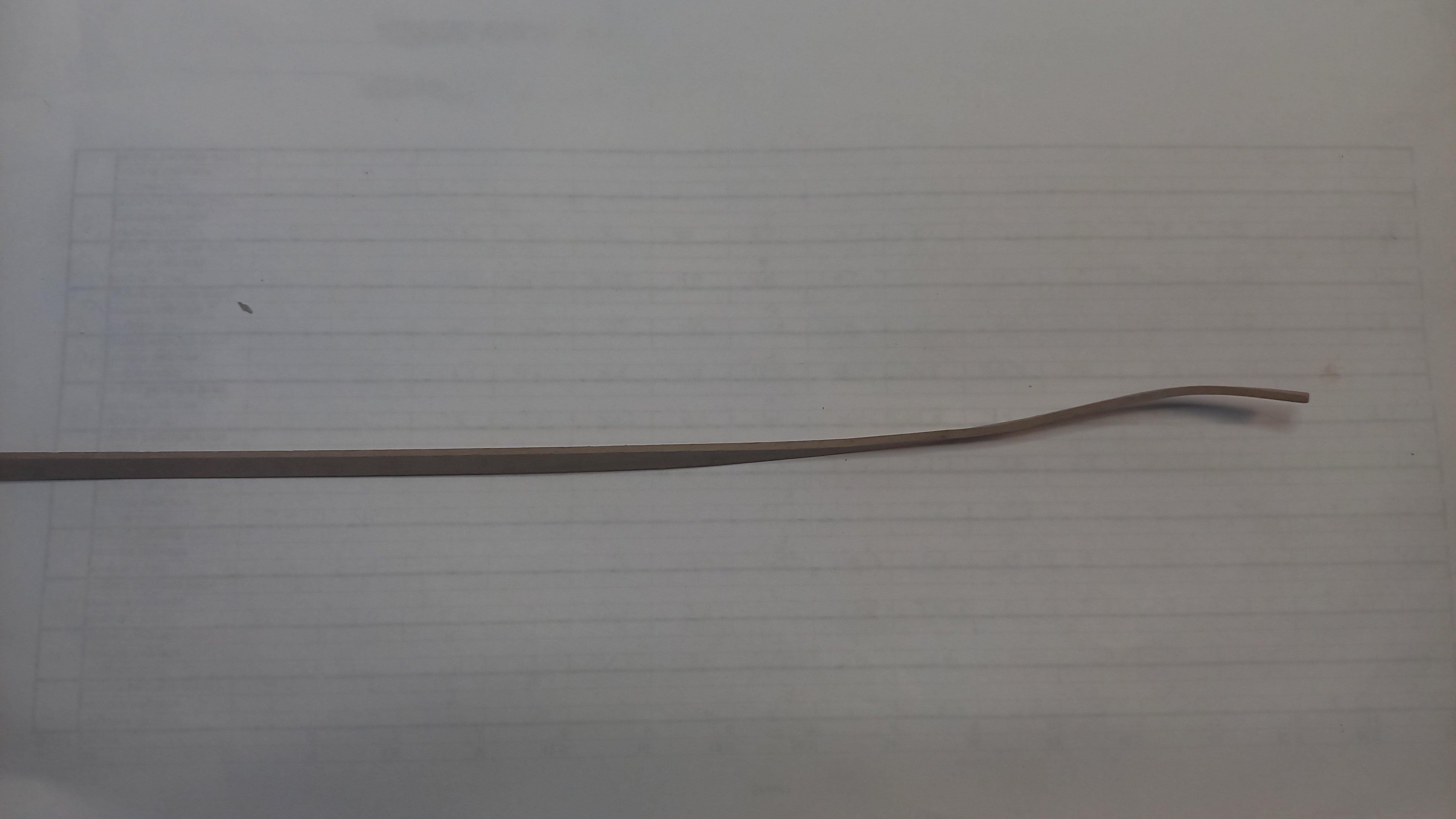

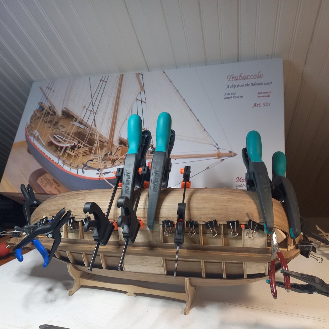

Hello,
The hull planking is in progress. There are still 14 strakes to go on each side, so the work could be finished in approximately one month. The garboard strake has been fitted.
I taper and bevel all the strakes

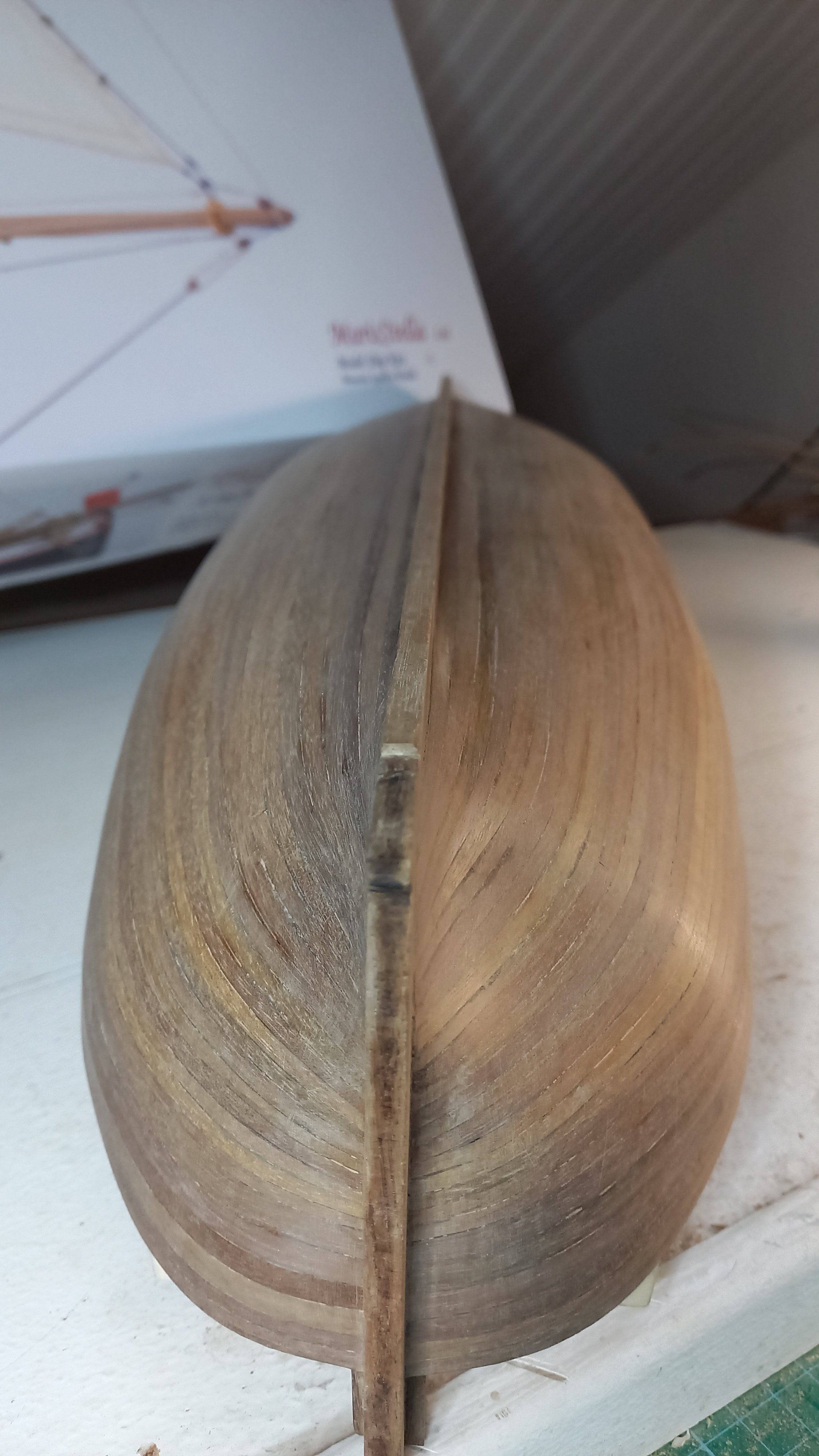

The planking of the hull is progressing day after day, timber by timber. The stern and stem are really difficult. I used all my clamps!
I try to stay quiet and be patiente...😮‍💨

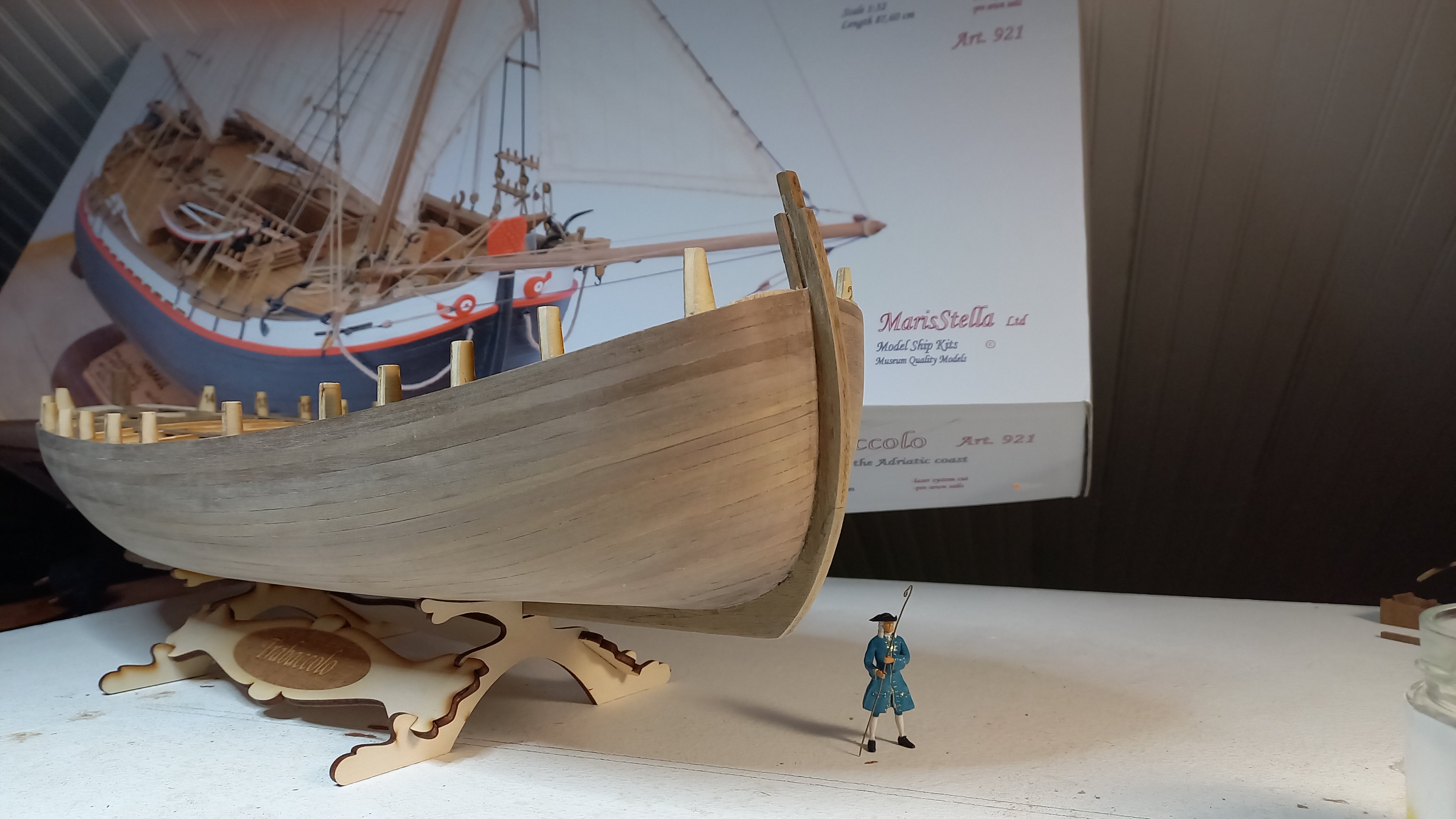

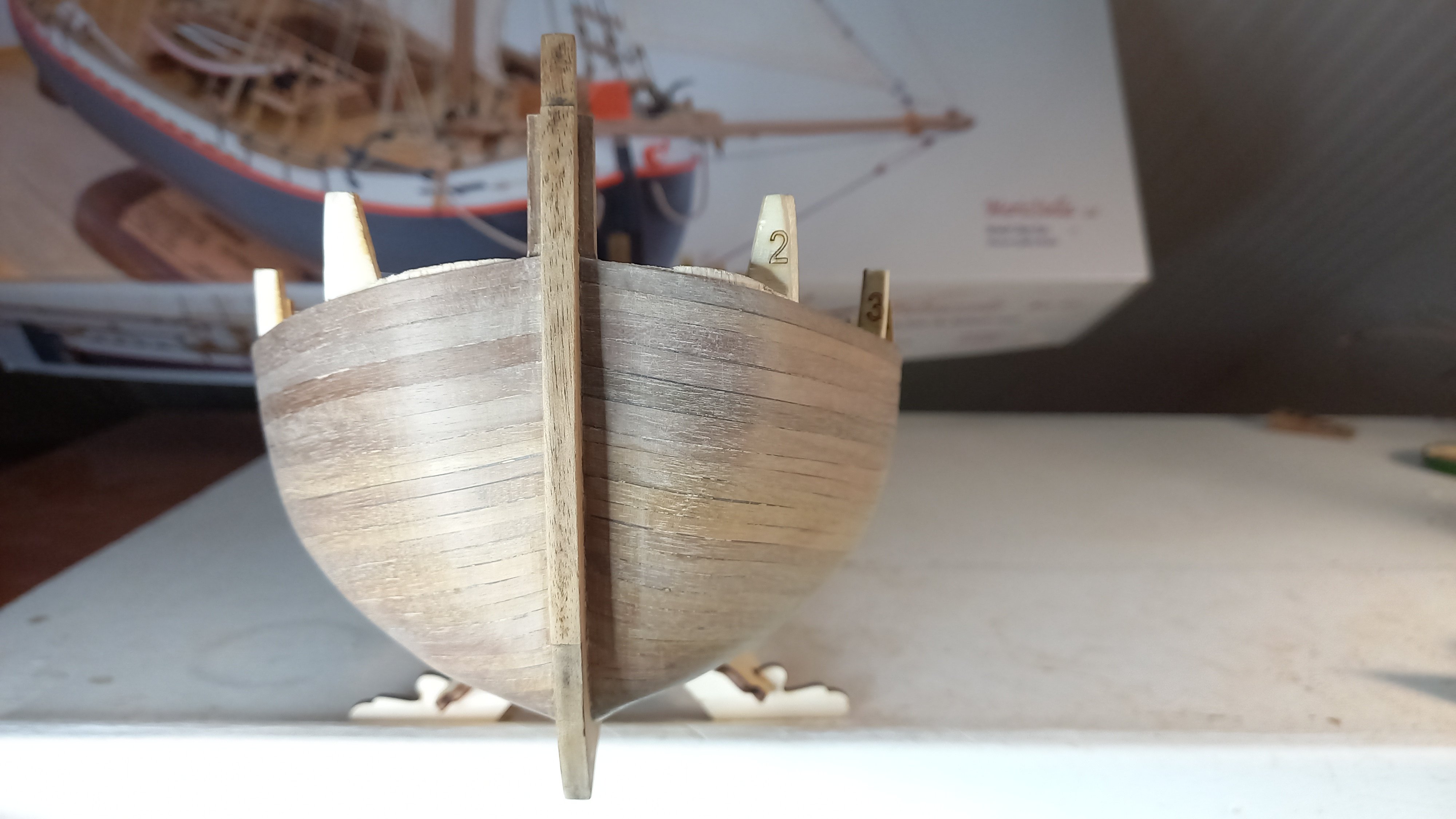

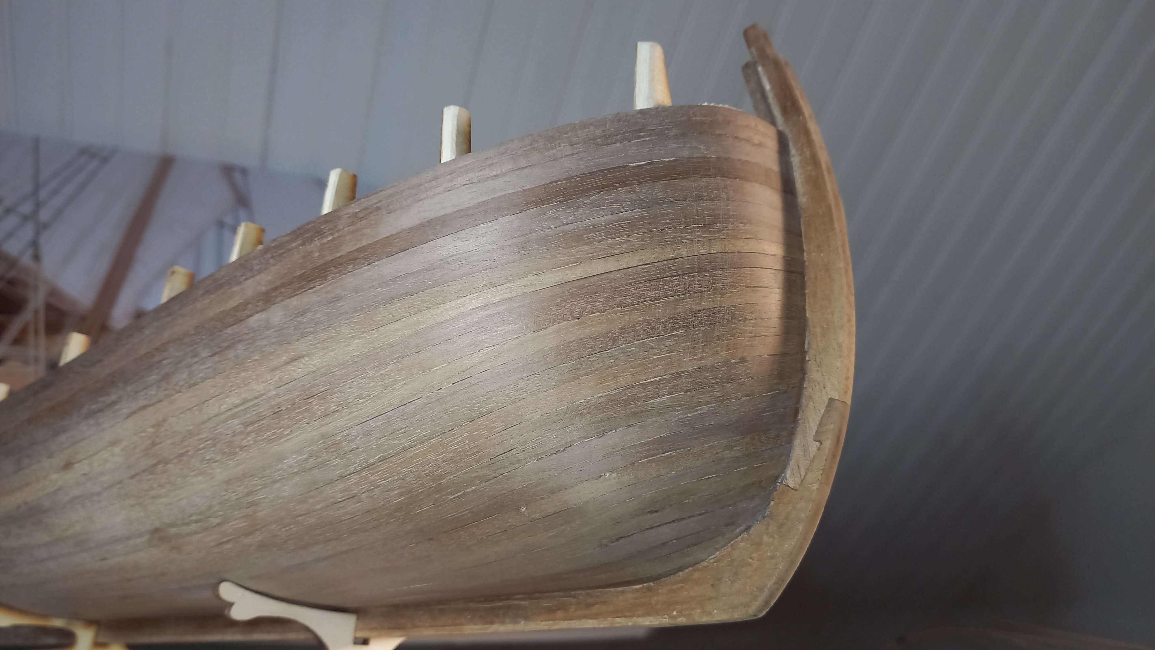

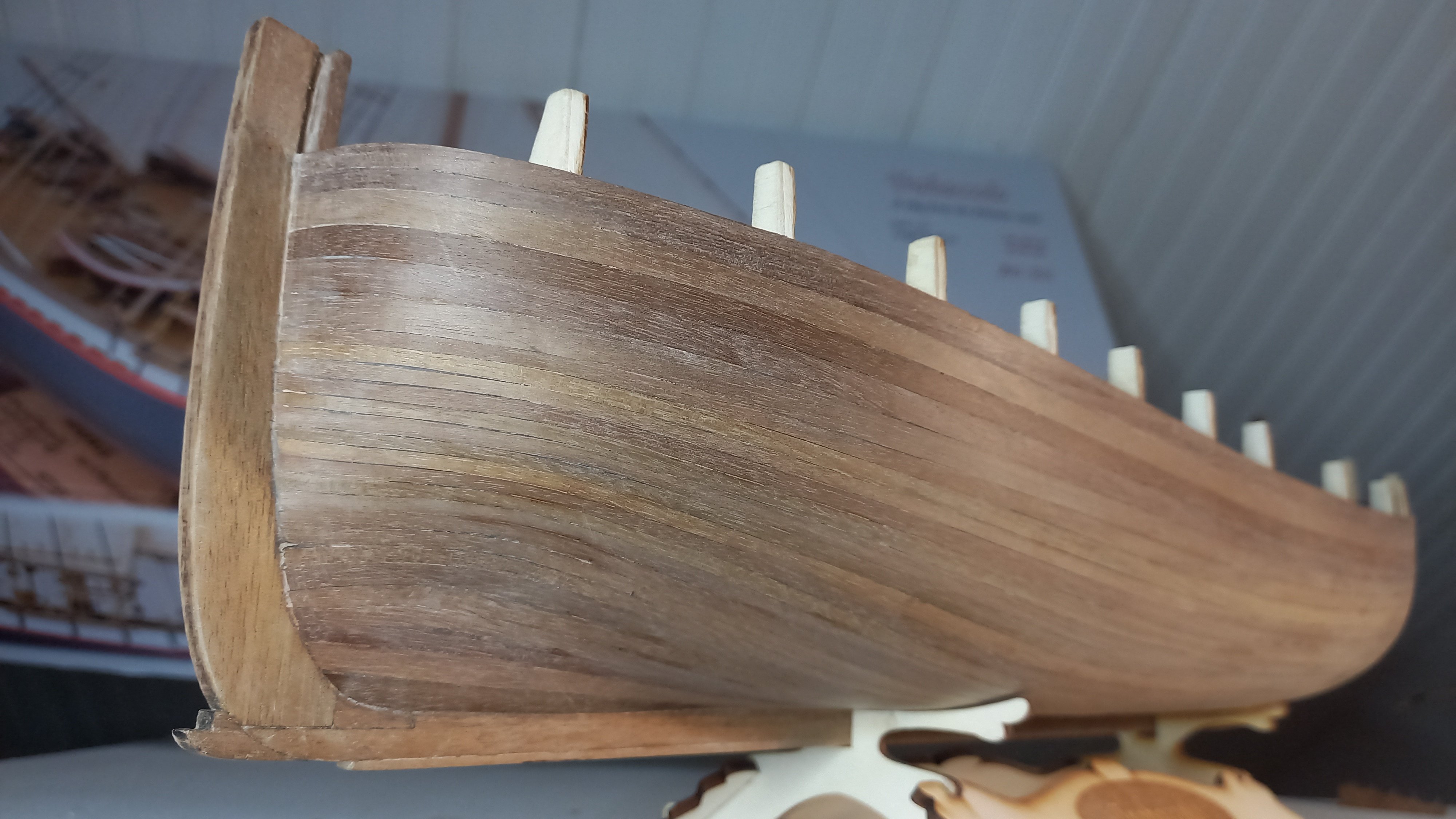

Hello,

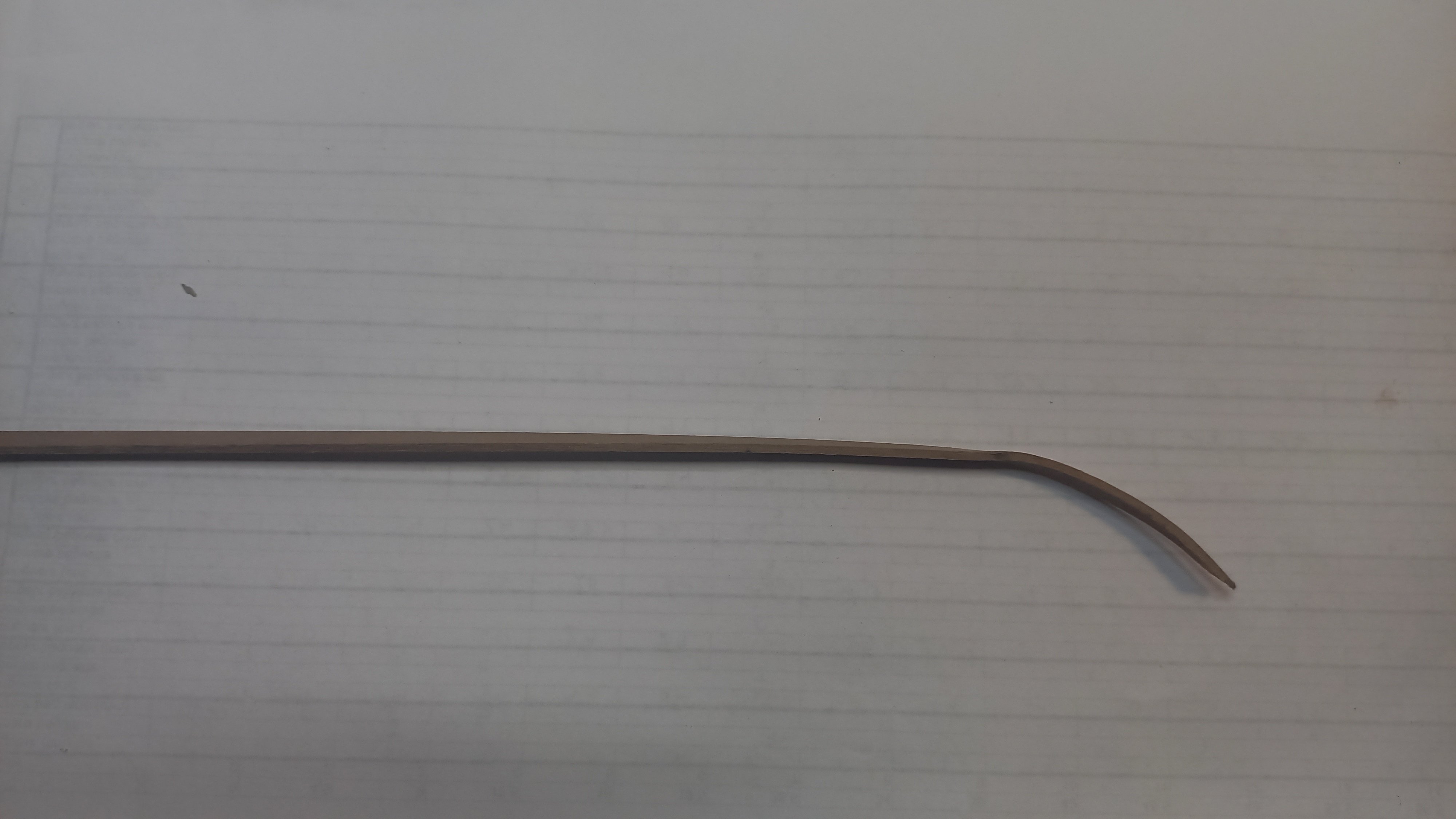

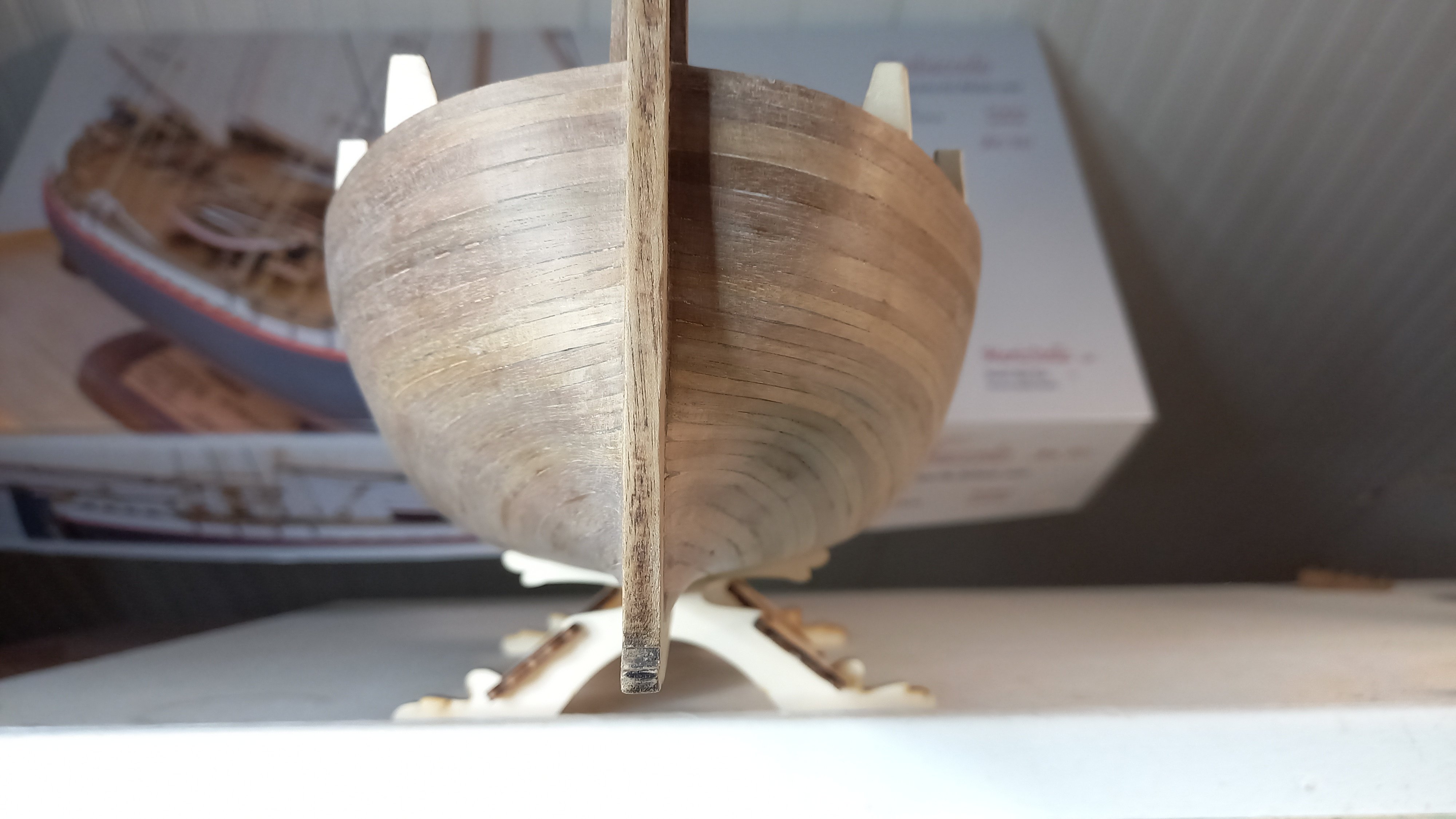

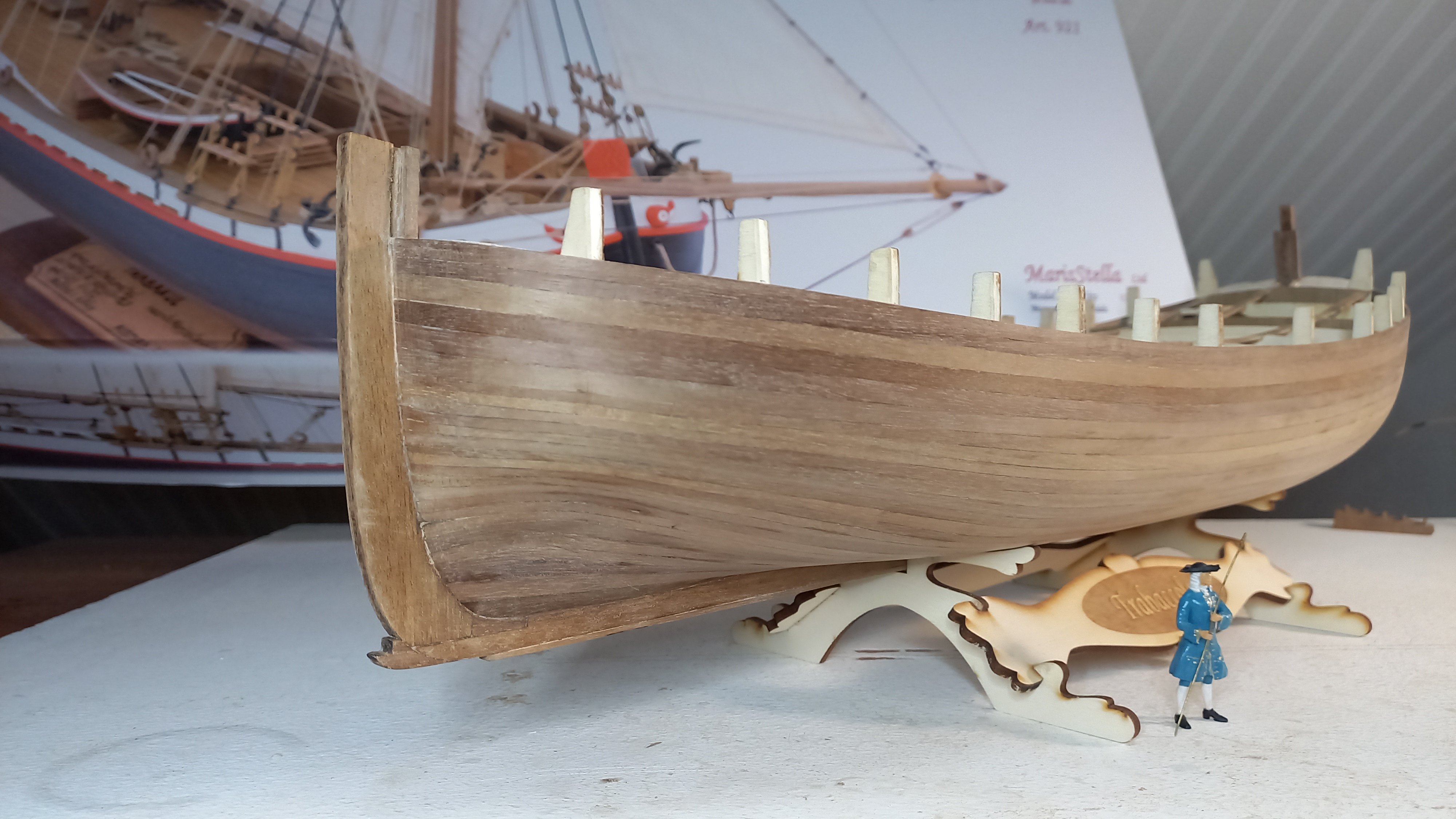

I just finished the planking below the deck. The main challenge was to bend the strake from stem to stern to avoid a mix of color, even though it wouldn't have been a problem because the hull will be black. next step will be to sand and clean (remove glue) the hull.
There is not a second chance, just one planking !
stern

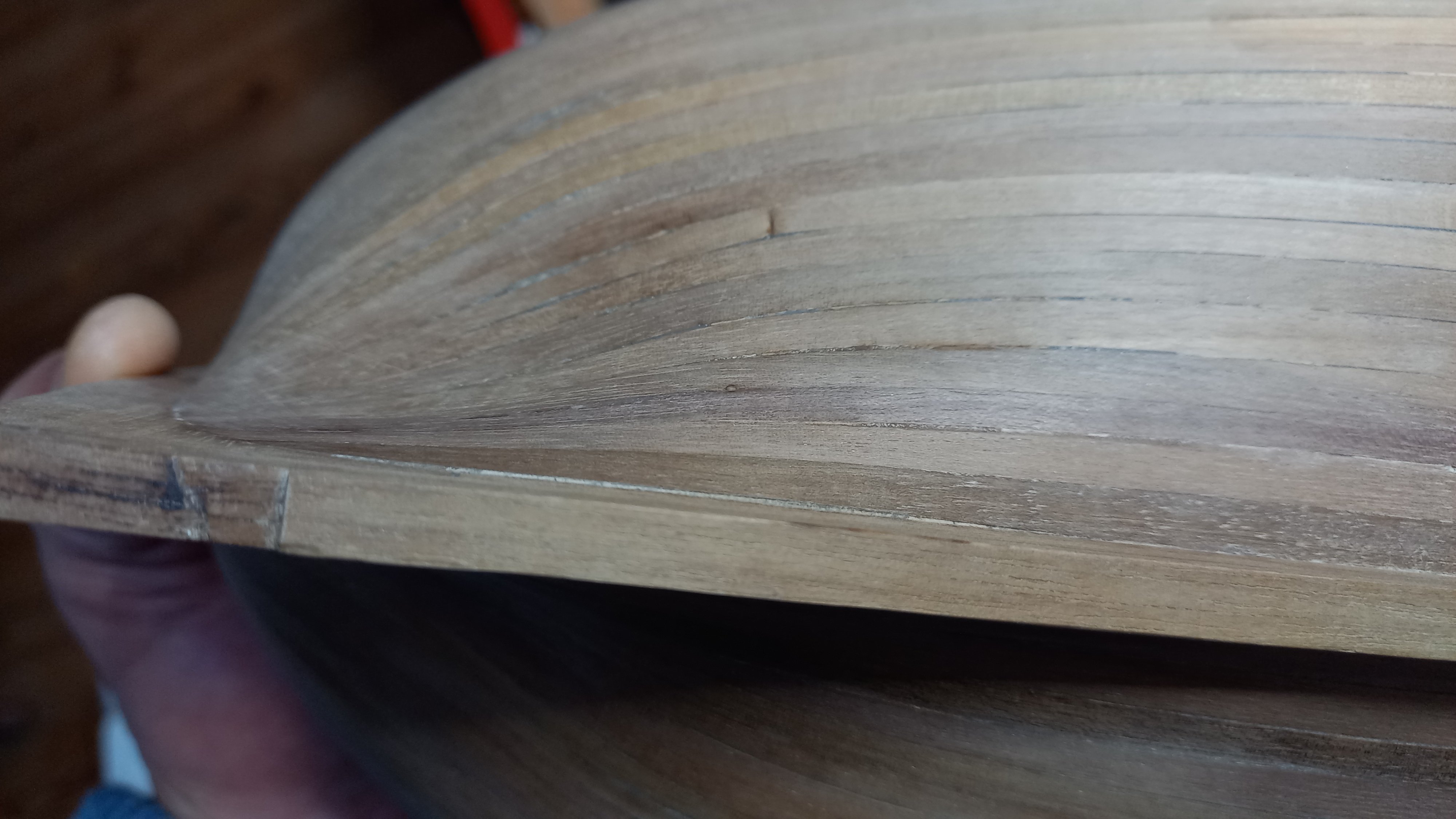

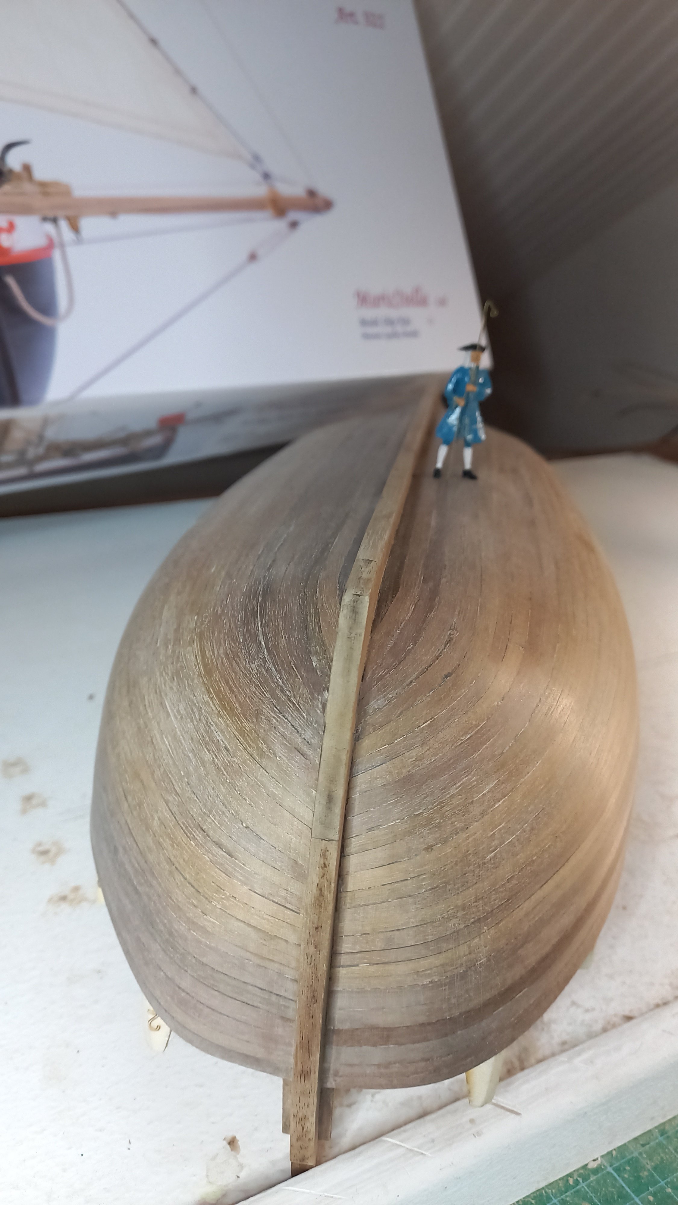

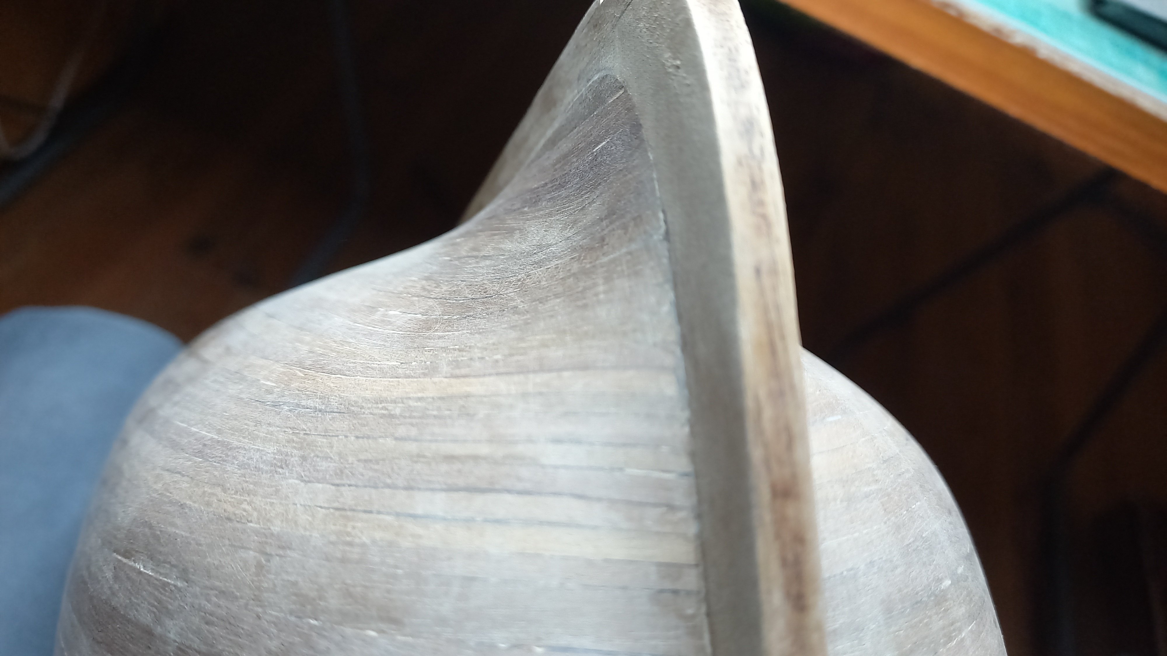

Dear Gary,
I fully agree with you that the shape of the stern is not satisfactory. The main reason may be insufficient sanding of frame 12 before planking. 😔

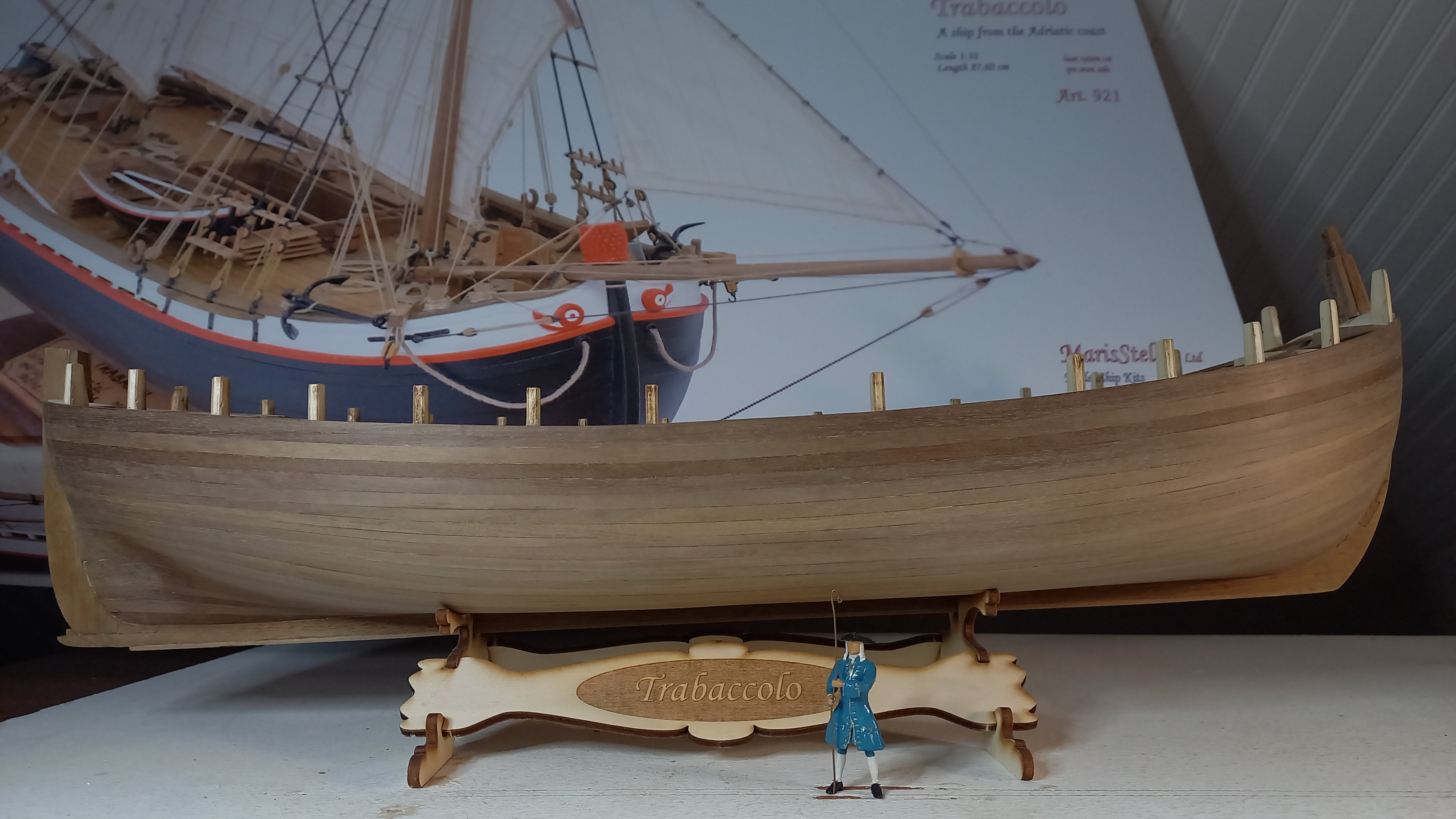

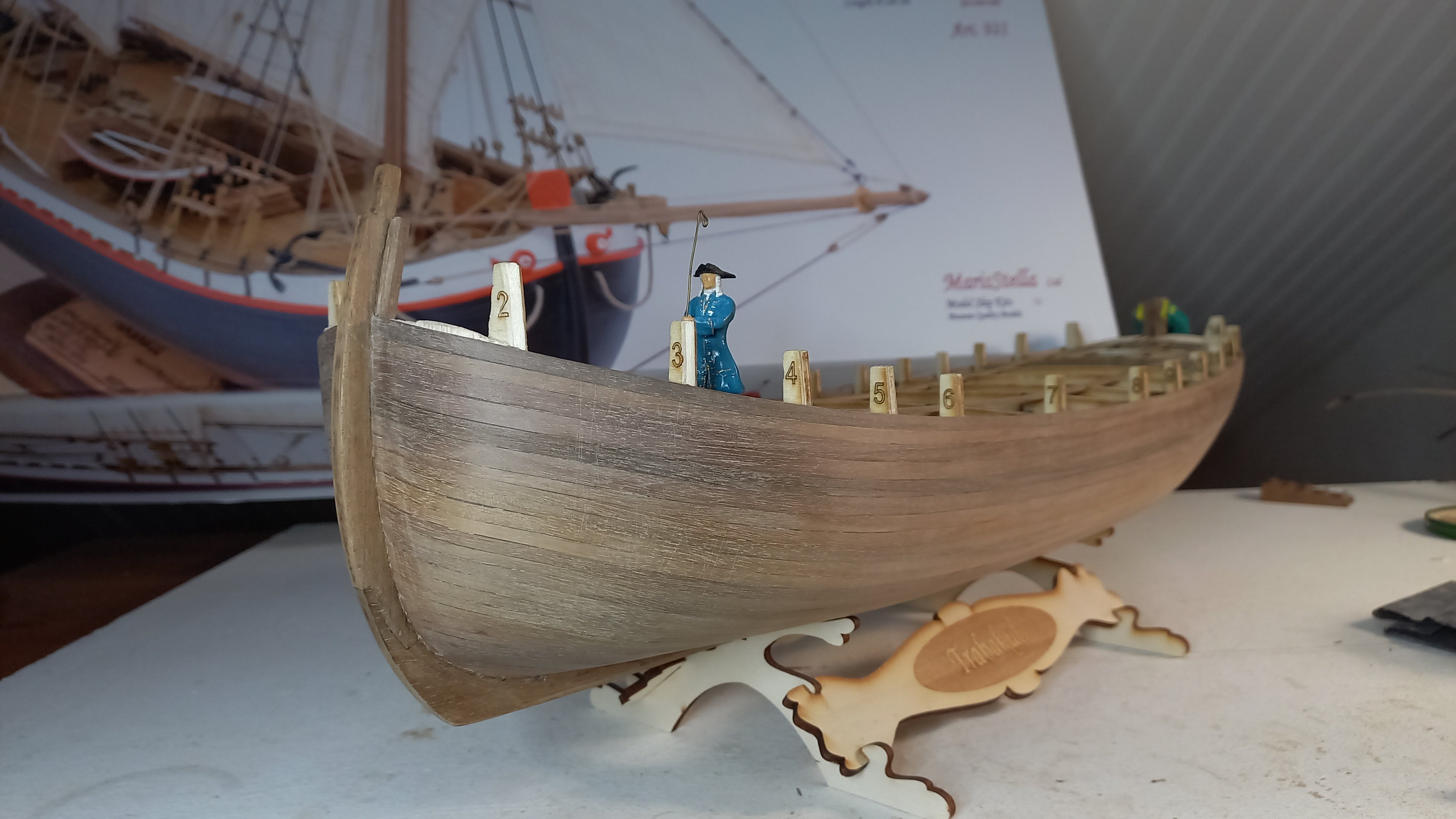

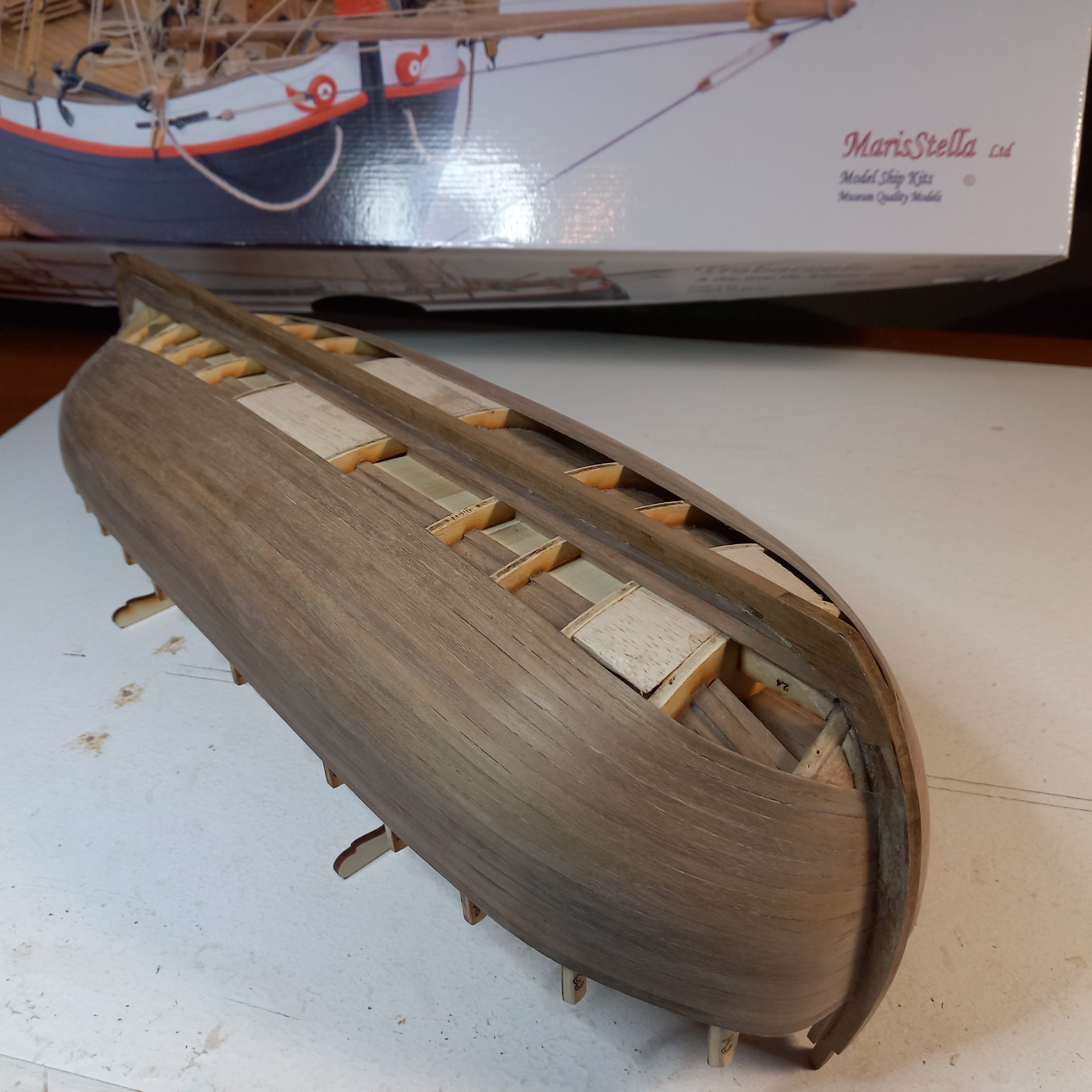

Hello,
The wale and rubbing strake are in place. I took some freedom with the colors suggested by the instructions.😉

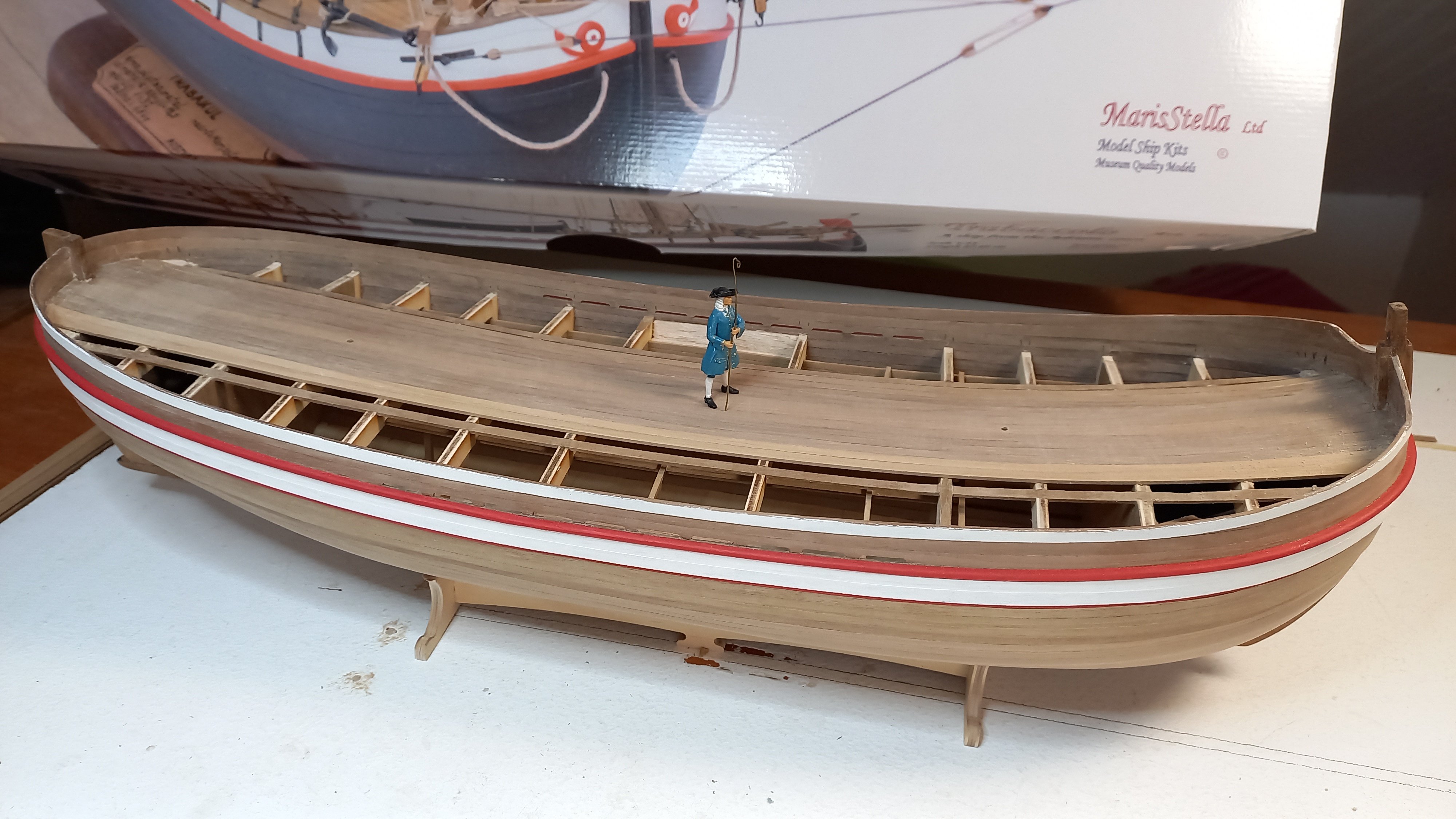

Hello,
I start the first planking of the deck.
The deck surface is made of two layers of strips, the first one is 1, 5 x 5mm strips and the second is 0.5 x 5 mm strips.
Fhe first central deck plank is 1.5x7mm, while all other planks are 1.5x5mm.
