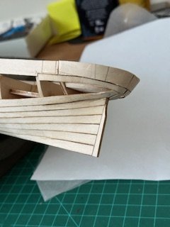

But, I had one massive fail. While adding plank 7 to the stern area, one of my clamps and rubber band slipped off, and snapped the stern bulwark extension off, taking half the stern counter material with it! I decided to make a stronger counter from scratch material, by using horizontally grained (rather than the vertical grained provided in the kit) 1/32 left over wood. I used a plank bender to shape the new pieces, removed the shattered counter wood from the broken extension (white glue can be dissolved in 95% rubbing alcohol), and reattached with 5 minute epoxy. Then, having formed the new counter pieces with the plank bender to the exact curve required, it was a simple process to reattach. The new stern counter, with fresh backing, is much sturdier, and I recommend doing it this way.

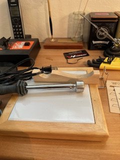

A plank bender is a very useful device (just a cheap soldering iron with a bulbous head) available from Model Expo and other sources for about $20 or so. See photo below.
plankbender.jpg.c70eb9e481429508e915f7bf60648273.jpgIt comes with a cradle and a shaped wooden block for curving. Just soak the wood for a while, then press it into the wooden block with the heated unit until the desired curve is obtained. I got a perfect fit for both pieces.
Sternrepair.jpg.14a08704435625de5eaed90a43f0f3e4.jpgrepaired stern
Overall, the planking went quickly, but the fit of some pieces was poor. I resorted to patching with scrap wood where gaps were left and sanding in other spots. Each builder will have to deal with this as needed. The final step is filling small gaps with Elmer's wood putty, Minwax wood filler,  or equivalent, and then sanding to a seamless finish.
