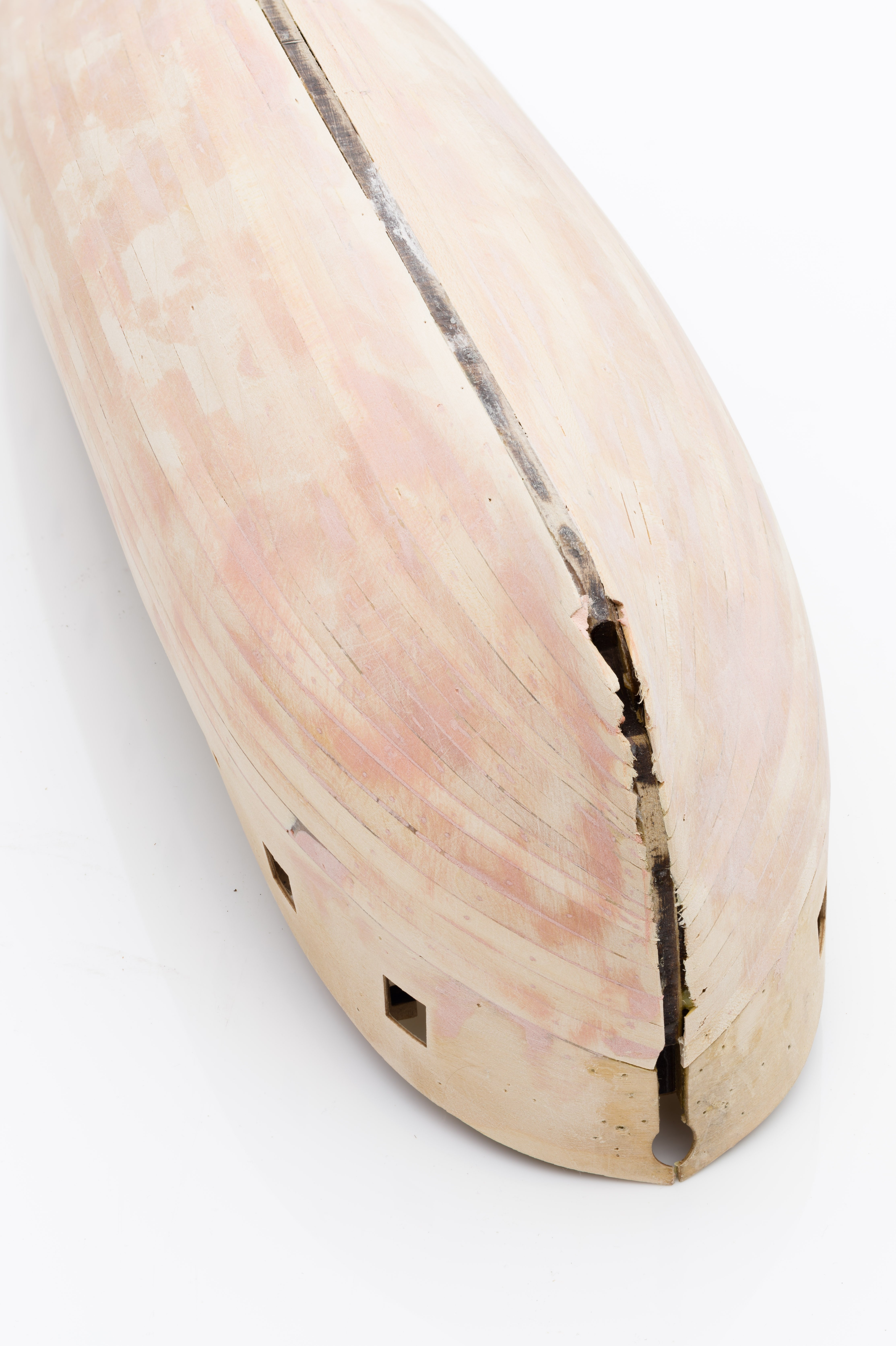

The last few days have been spent filling in the last 2 rows of planks. That was time consuming but satisfying work. There were small gaps in the rows that I could live with. The more planking I did, the more I refined my techniques so the planking got better as I got more experience.
The next step was to sand the hull done to give a relatively smooth finish. A few hours was spent on this yesterday hand sanding as well as using my small detail sander to get most lumps out of the planking.
This morning I filled the bumps, gaps and problem areas with an epoxy resin to enable me to do finish sanding and to bring the hull to a uniform level ready for the 2nd layer of planking.
The next step I have to do though is to fit the beakhead, keel, and stem to the boat. That will then be ready for the final planking to go on.
I need to study the correct method to plank the hull. Even though it will be coppered and thus hidden, I still need to do the best I can on this layer so I can gain experience before I do a non coppered hull.

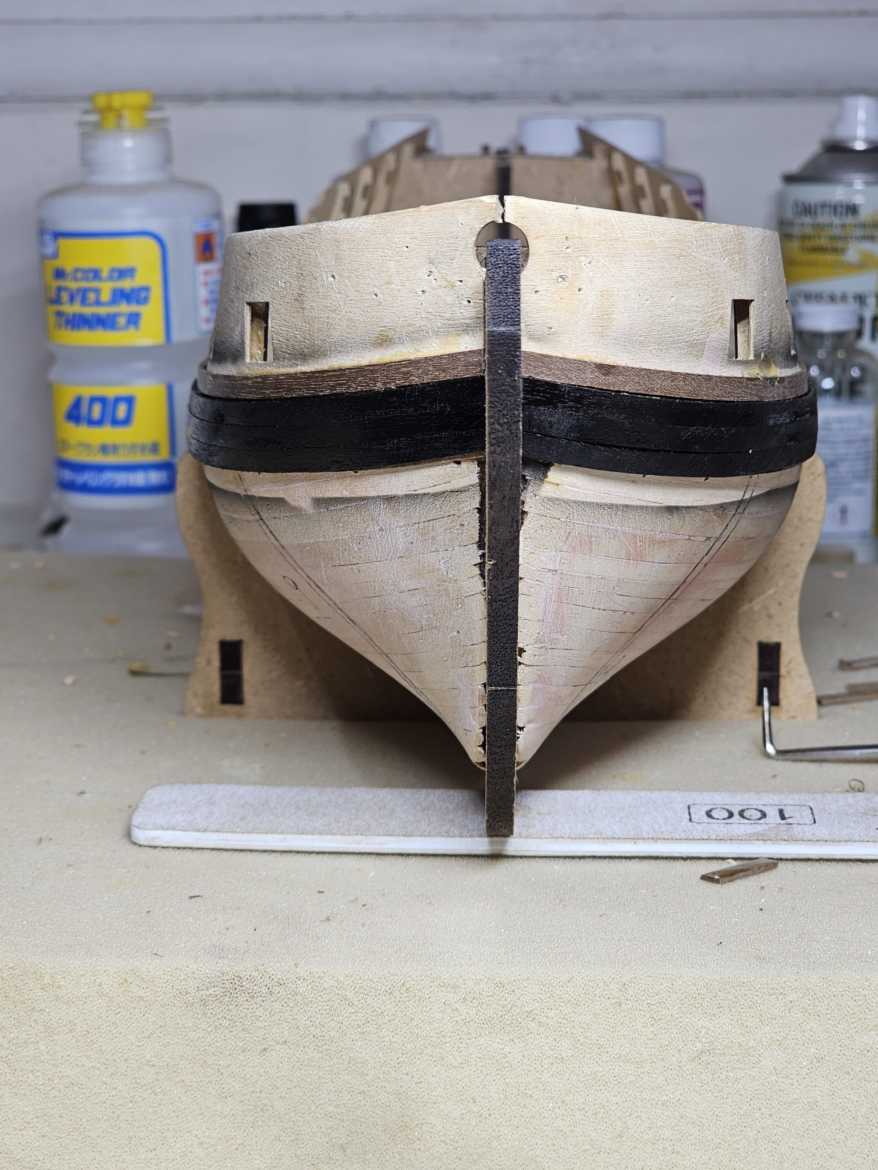

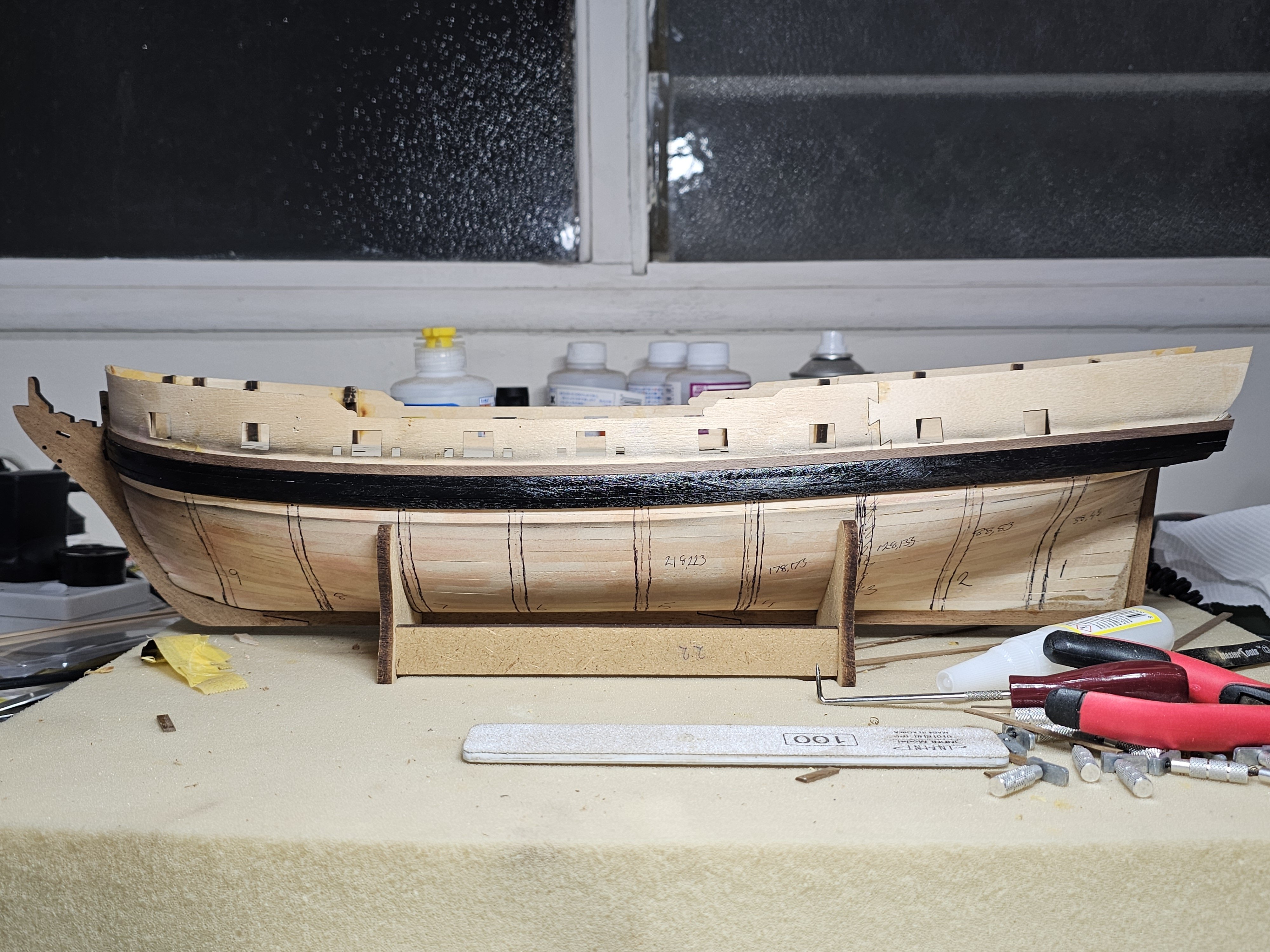

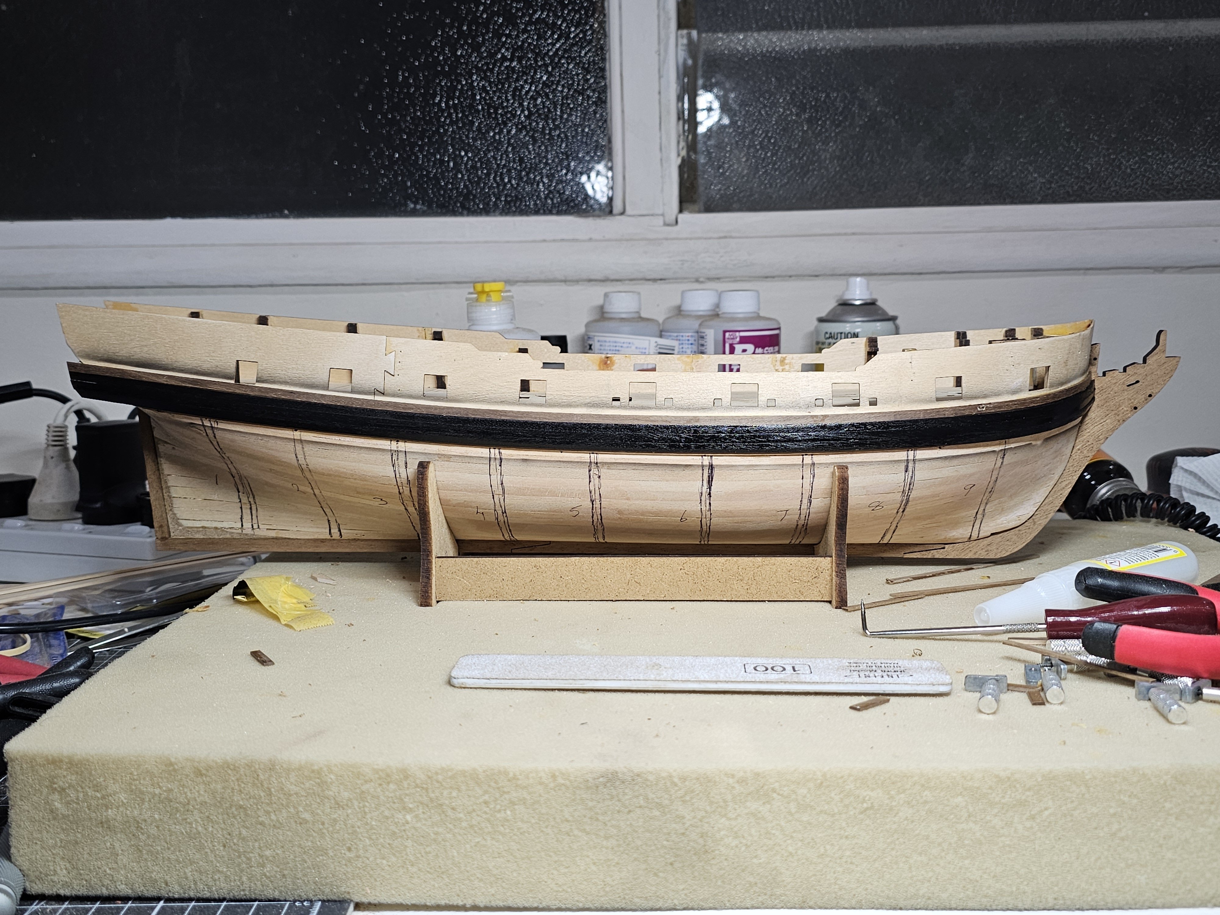

Work has continued on the Pegasus.
The last few days has seen the 3 strips on each side placed. The stern of these strips needs to be placed securely. So far they are not fixed correctly. These 3 strips each side will have another layer of strip on top. This will then be the wales completed.
The 2nd layer of planking will then be tackled.
The Keel, Beakhead, and Stem were also located and glued into position. The rear counter at the stern was also planked.

A little bit of progress on Pegasus.
The wales were sanded flush to each other, masked and then tamiya flat black with mlt to thin was sprayed on the wales.
There is also one row of the 2nd planking above the wales on both sides. I have yet to decide how to trim the rear of the wales as I don't yet understand the run where they should finish and what shape they should be.
