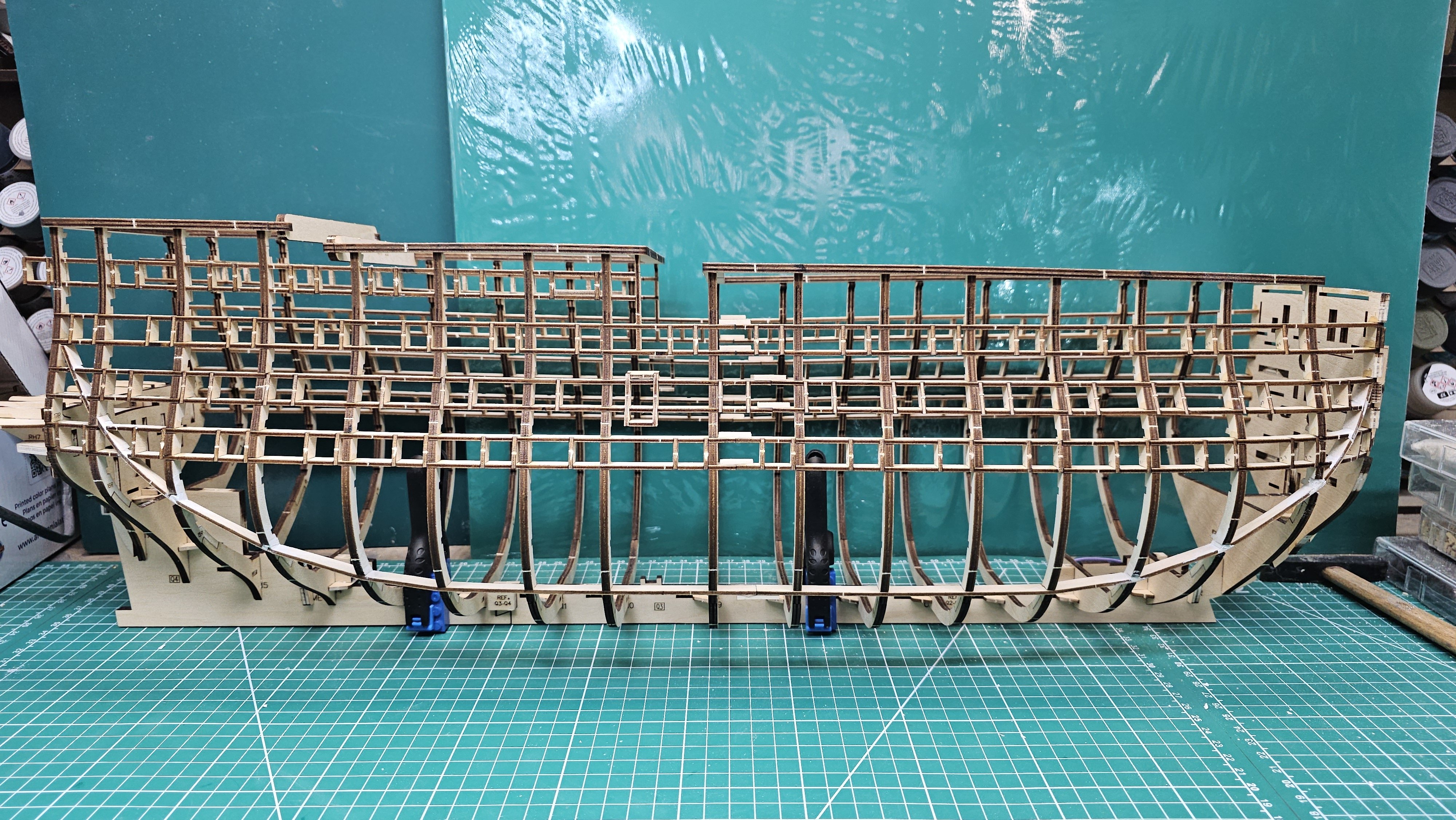

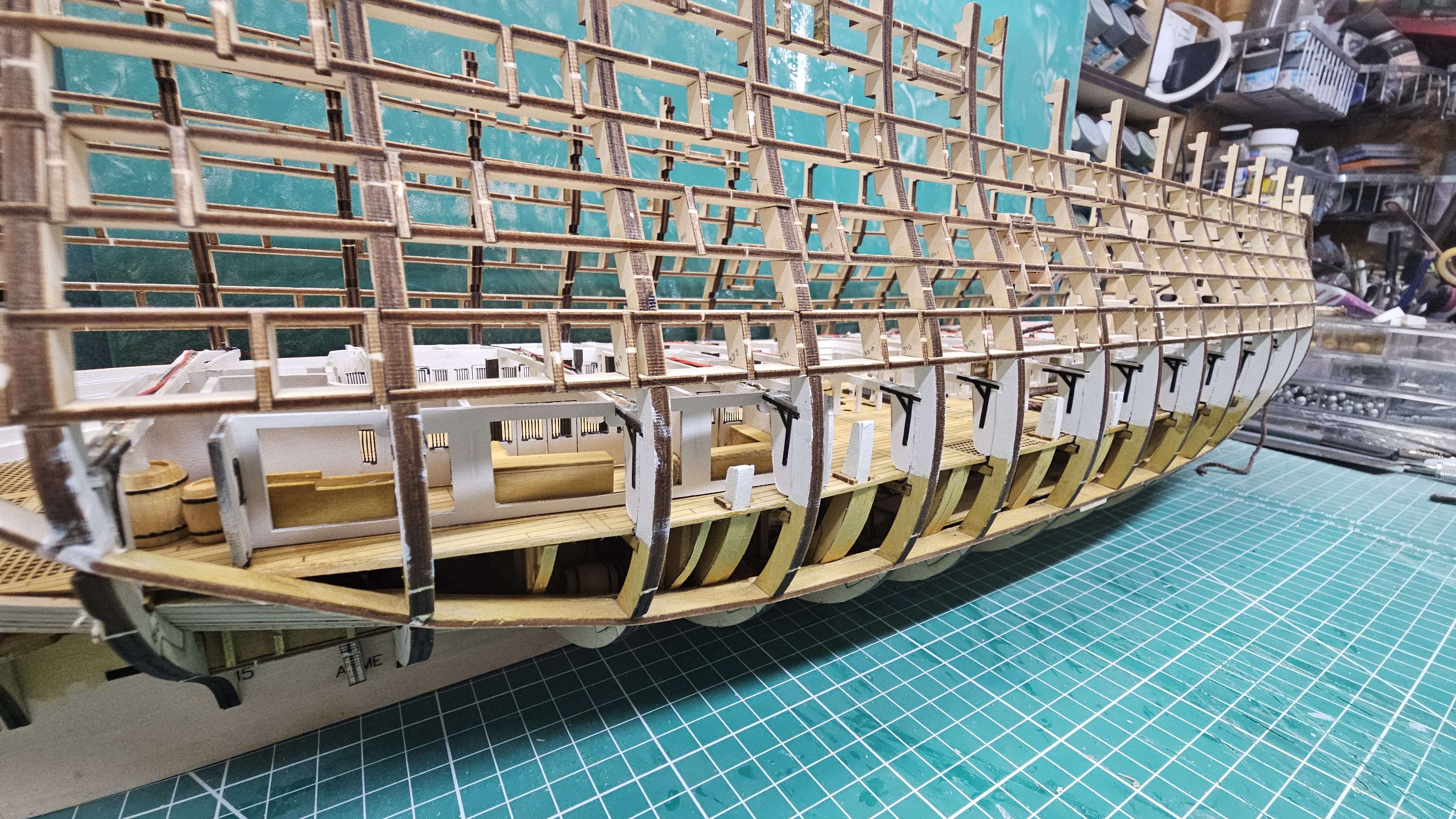

Video #16 Complete
Hull frames are now faired ready for planking. Was probably the easiest one I've done to date. I used an orbital mouse sander to do the bulk of the work, and switched to a Dremel with the EZ-Clic sanding disc for the stern area and anywhere close to the keel.
Then the first 4 layers of hull planking on each side. The wood supplied is amazingly pliable. I've not had to use a single plank bending method anywhere on this build yet.

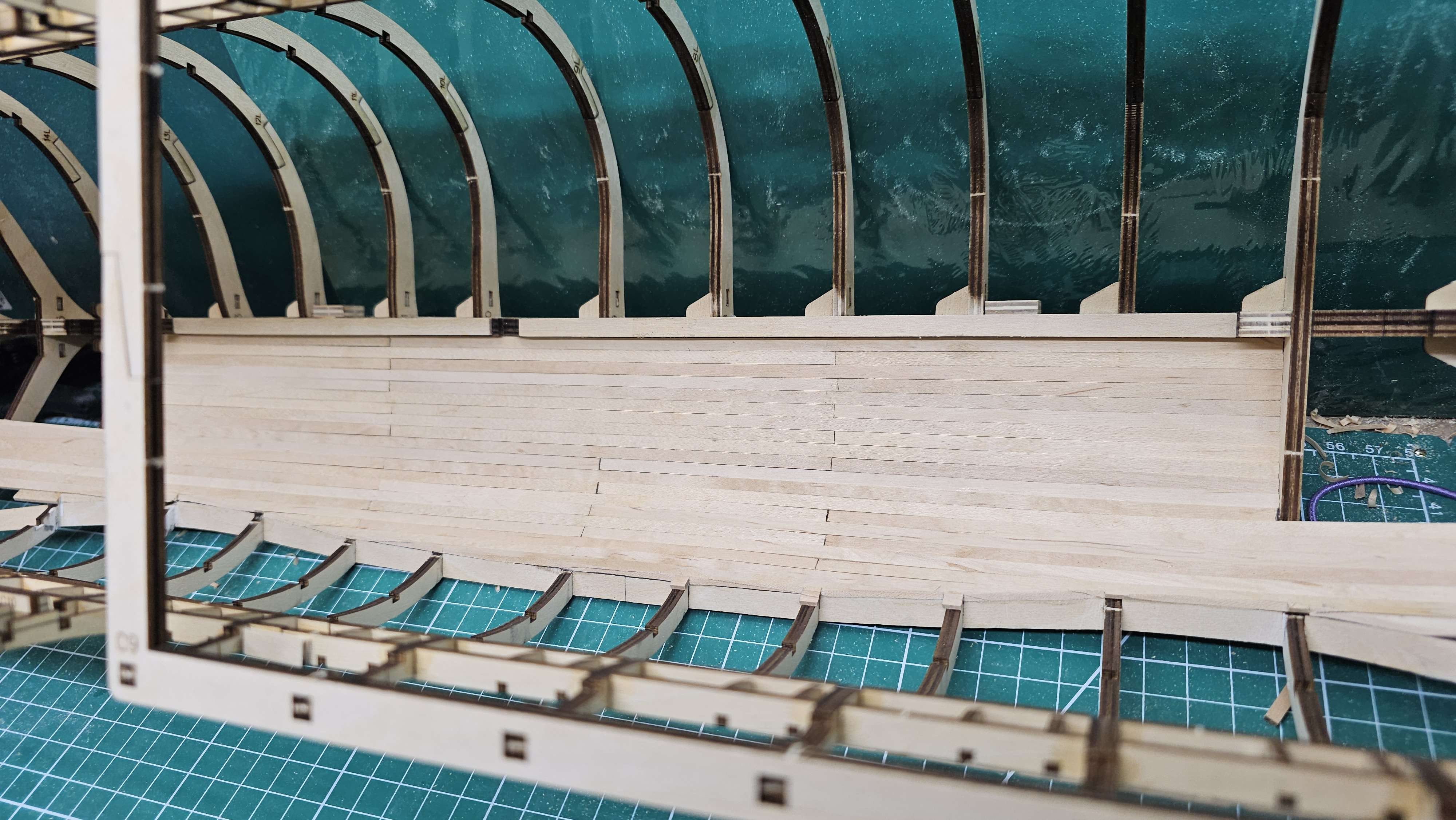

On 4/7/2025 at 2:14 PM, FifeModels said:
Evening all.
Well, What a flaming nightmare this was! The "boards" they have you make is probably the most convoluted way of doing this. Why not just use ply formers and plank with veneer?
The boards keep breaking whilst cutting, are very hard to cut, and just generally a pain in the *** to do.
So following another build of this, I've ordered some 1.5 Birch ply boards, and will cut the remainder of the hold structures from that, and either scribe the planks or just use 0.1mm veneer on them.
026.thumb.jpg.6b831db1ea34251983a9684192e922e3.jpg027.thumb.jpg.bf8555f74549d663dc2a9fce233461f8.jpg
Anyway, onwards!
Thanks
If you look at the video 3 they provide for a manual you will notice they actually laser cut the boards which of course most of us don’t have access to.  You can see the burn on the sides.
