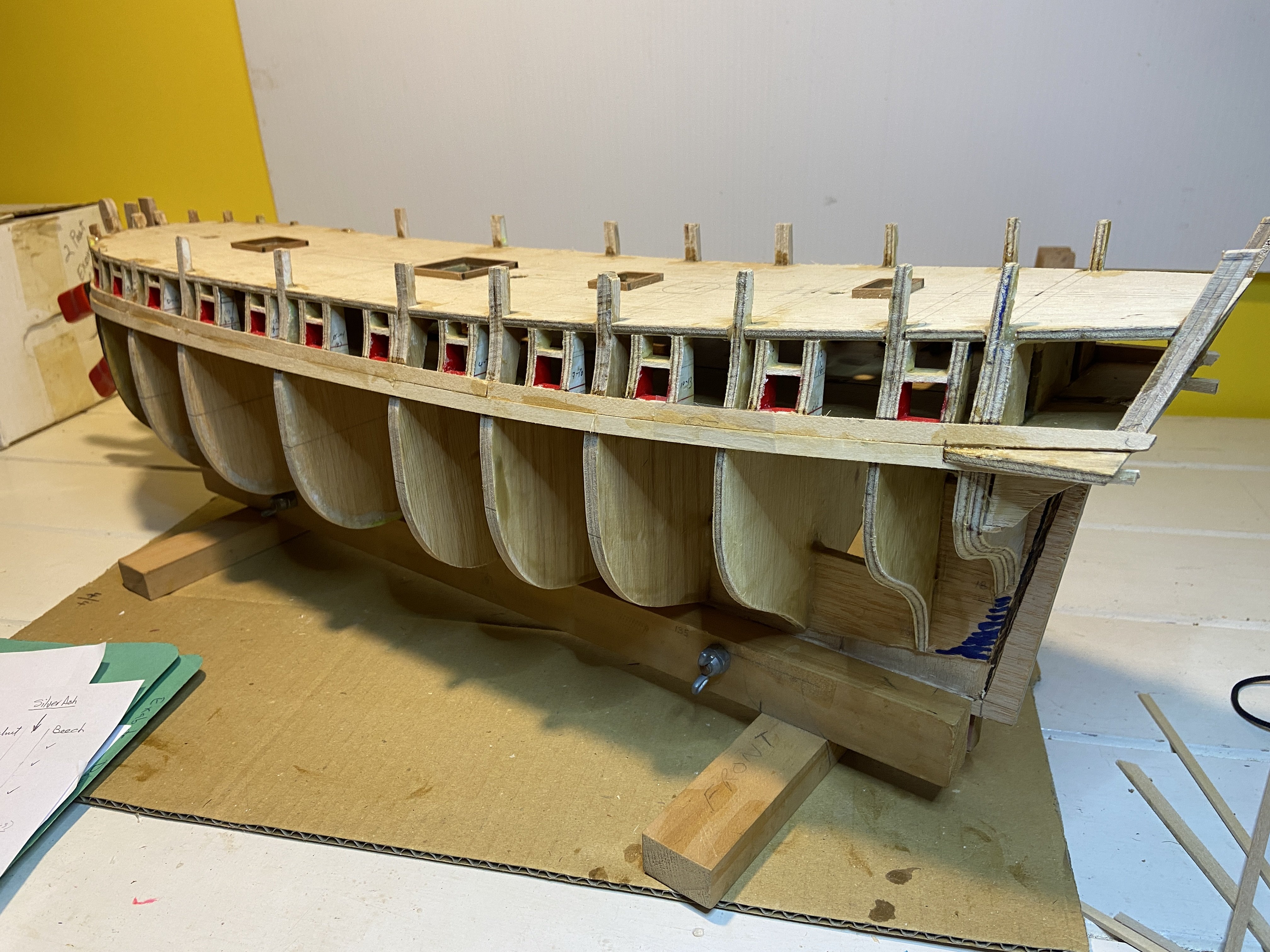

Another update to the Shipyard.
I decided to add the Mid Deck in as planned from the cut-out in each of the frames.
This will all me the option to possibly mount a couple of Caronades on this deck !
The ply frames all look a little untidy atm.
I'll sand them up, and apply a sealer to all inner surfaces.
Next to make sure I've got all the work/cuts and surfaces done before the Top Deck goes on.

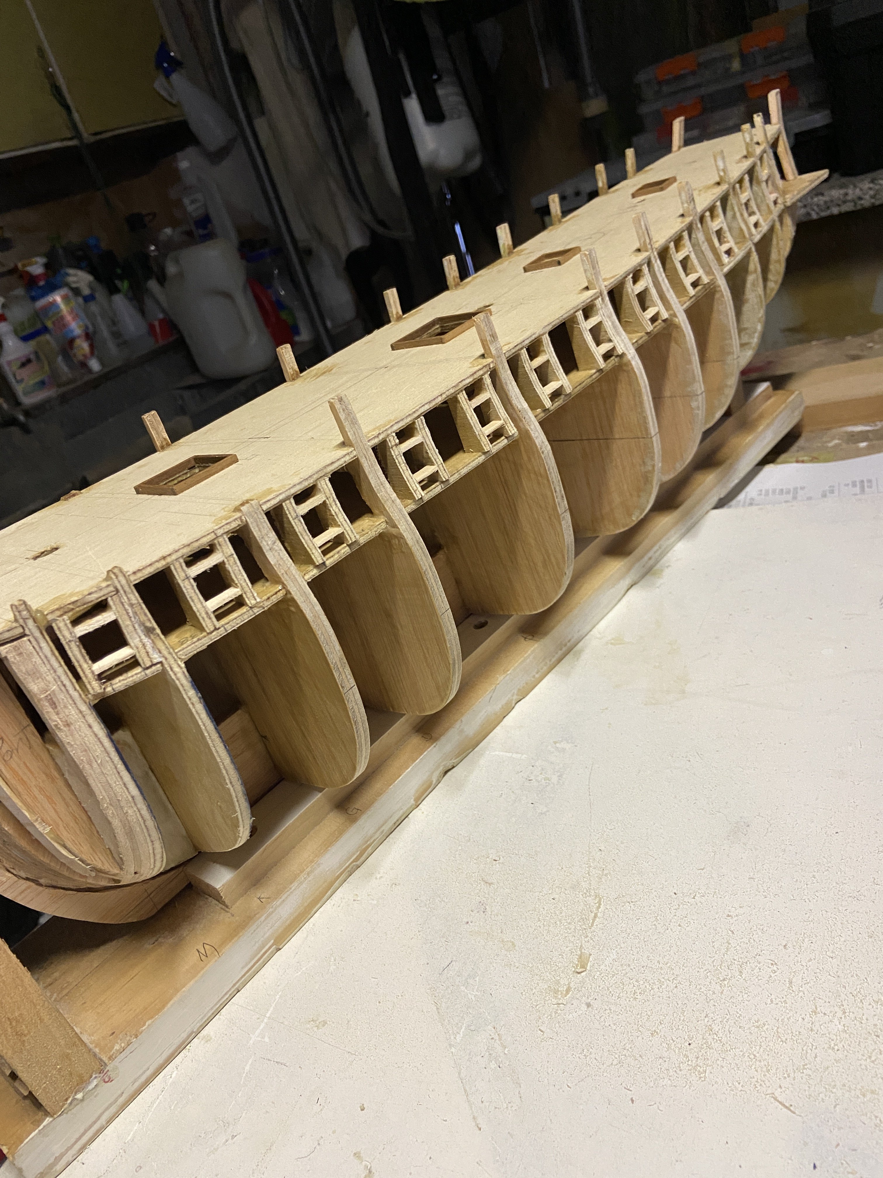

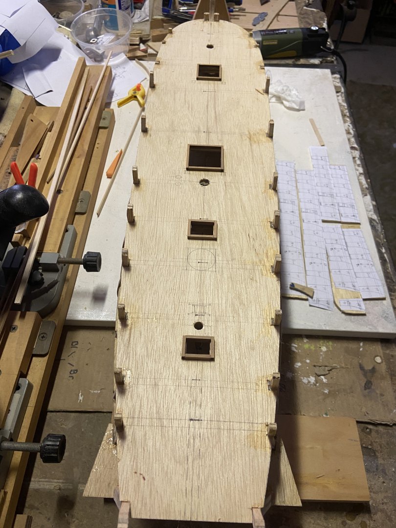

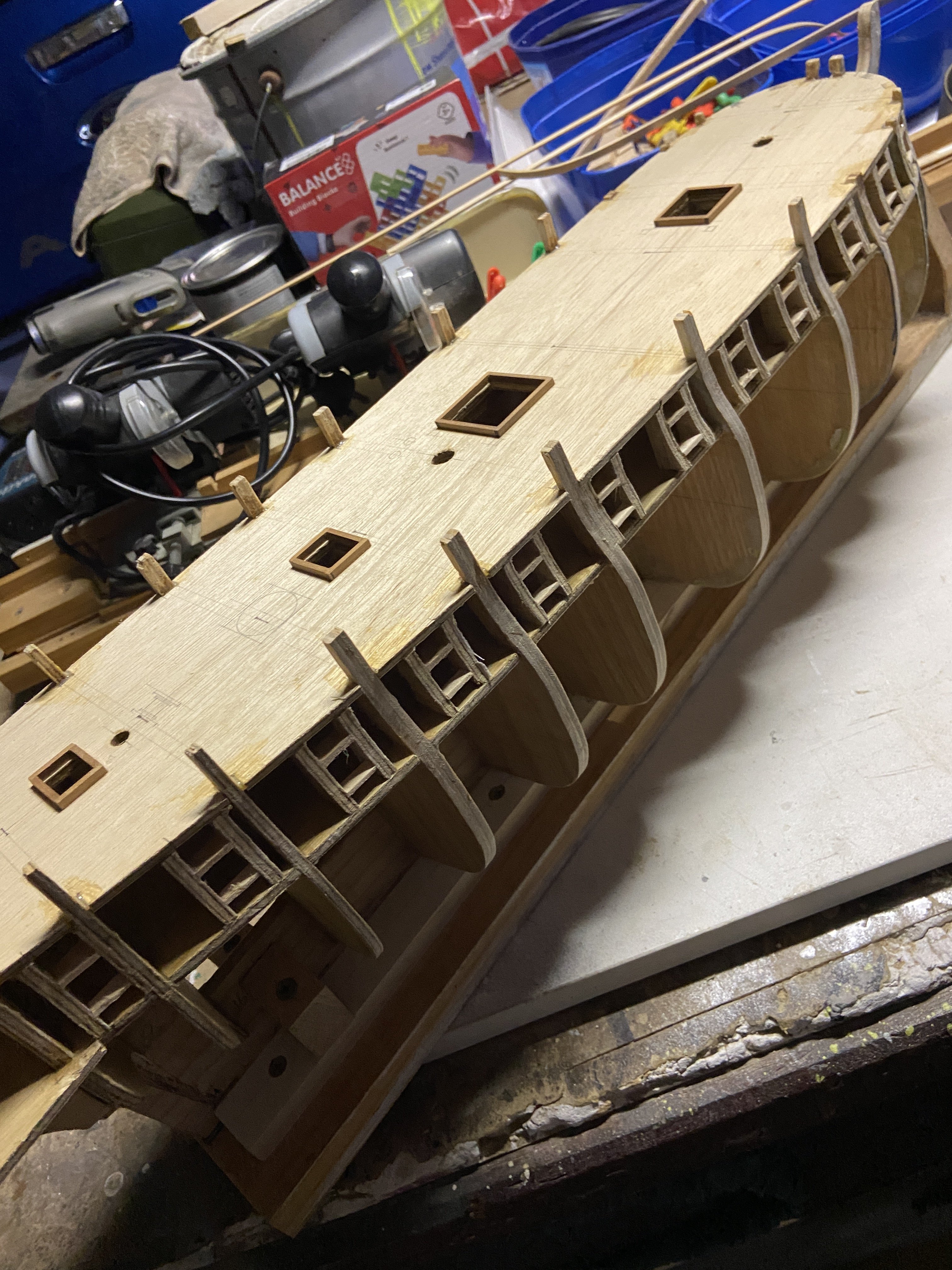

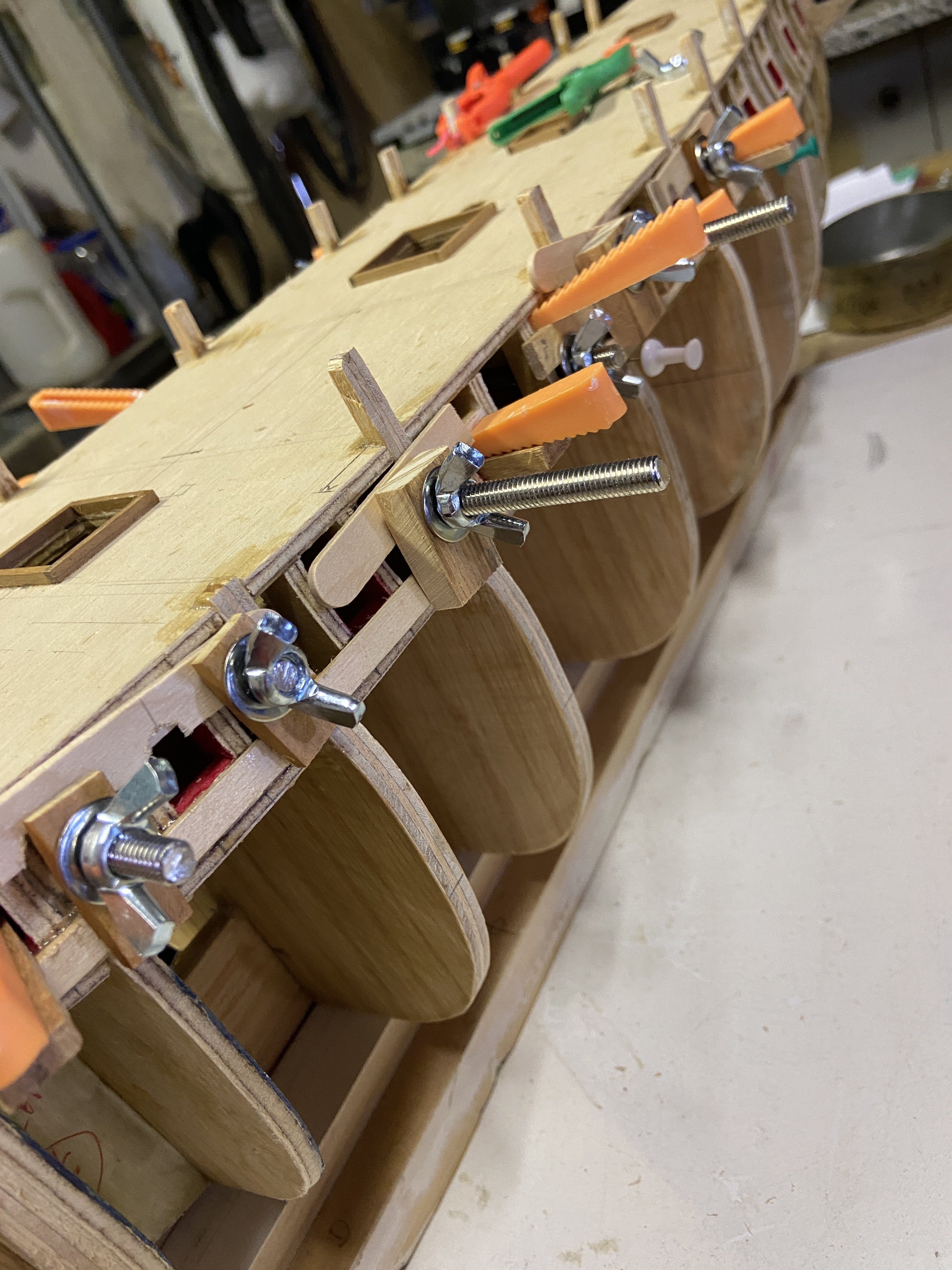

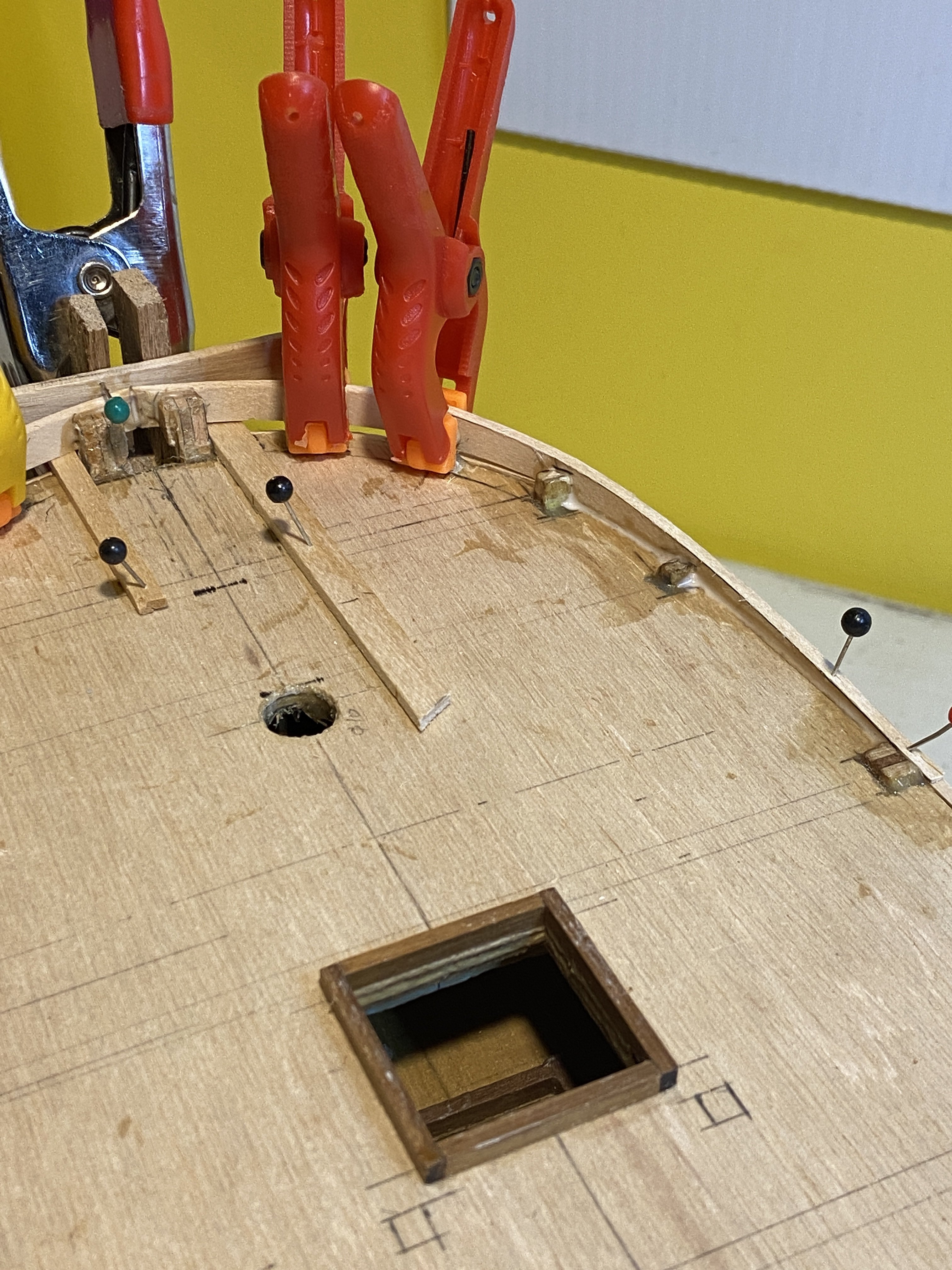

An update from the Shipyard.
Some more progress on the hull framing, upper deck supports & deck layout.
I've been checking along the way to keep the frames straight, square without any twist.
The top deck: I have added the mast locations, hatches, capstan and a few other notable items/features from the "Berwick" plan.
Where the masts and hatches clashed with frames, I added in beams under the top deck. Bit of an over kill ?, extra strength 🙂

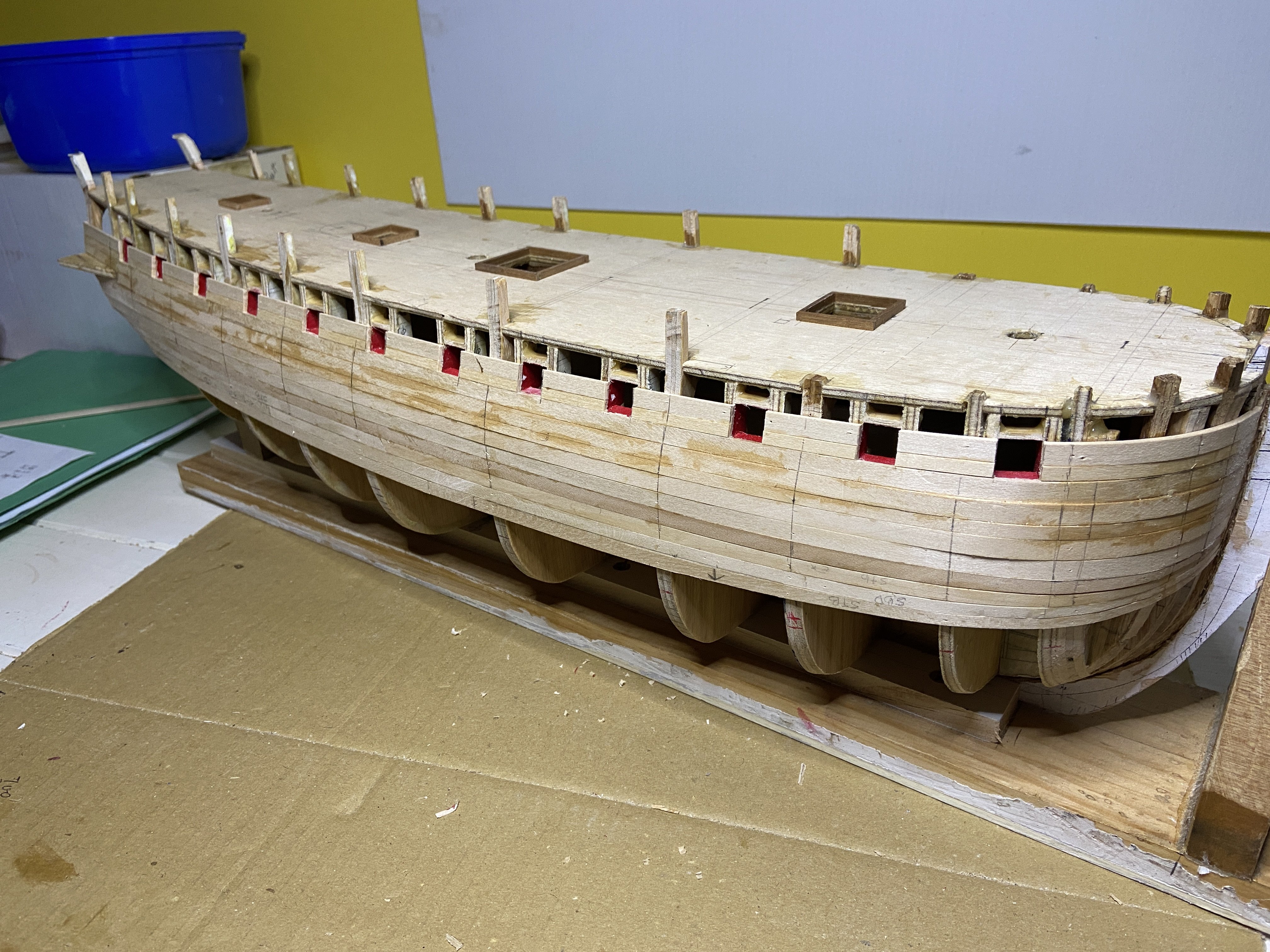

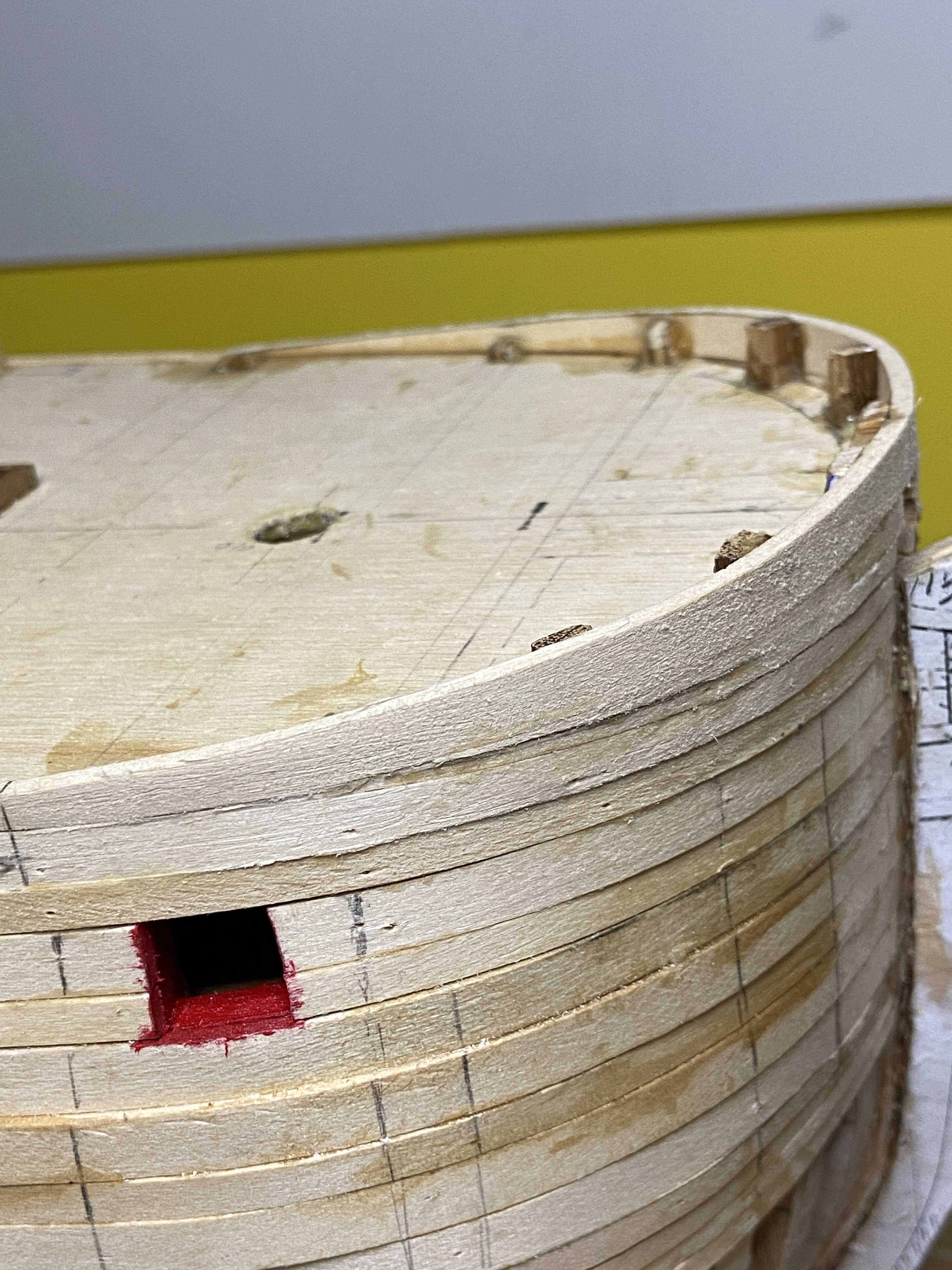

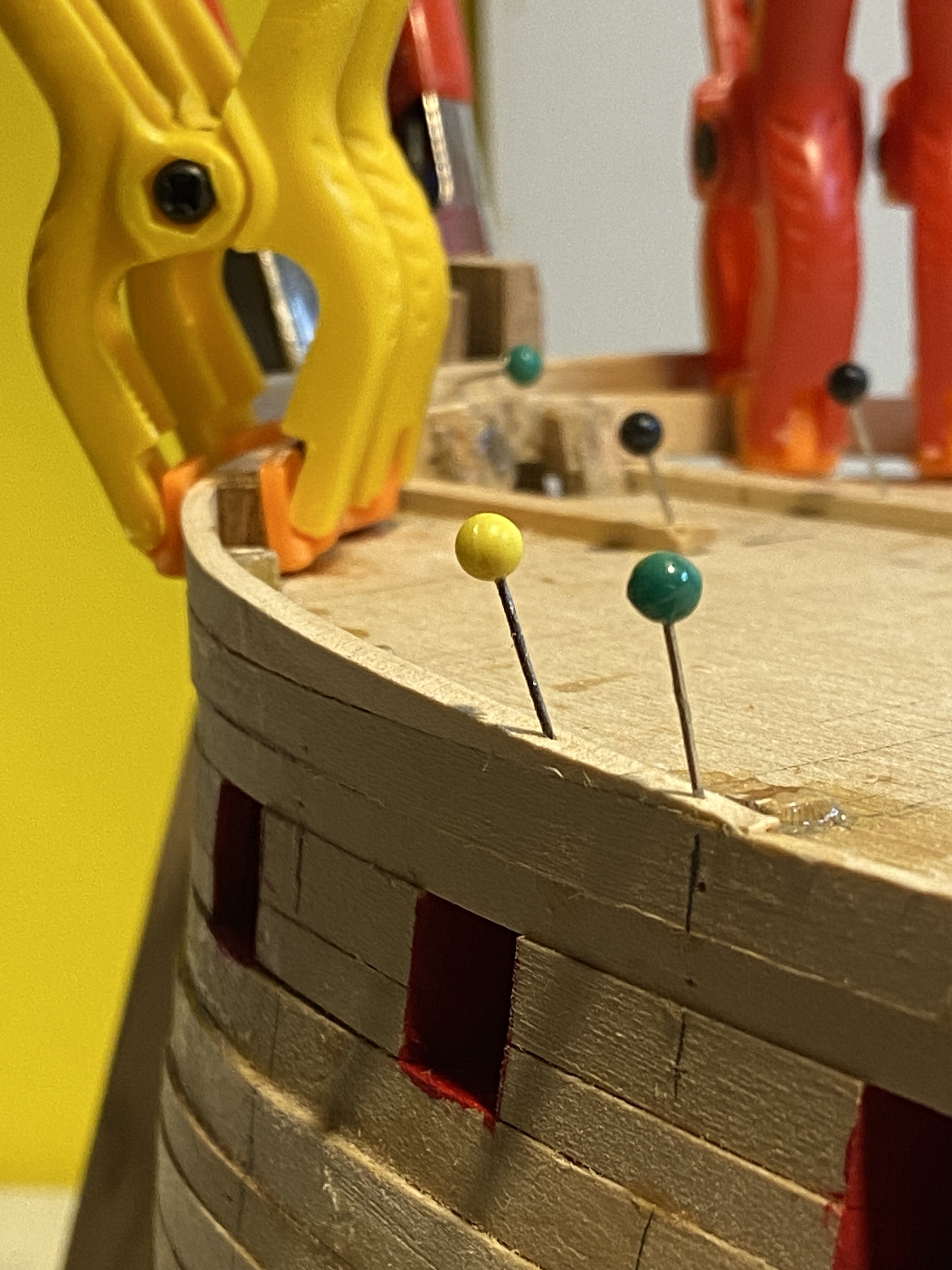

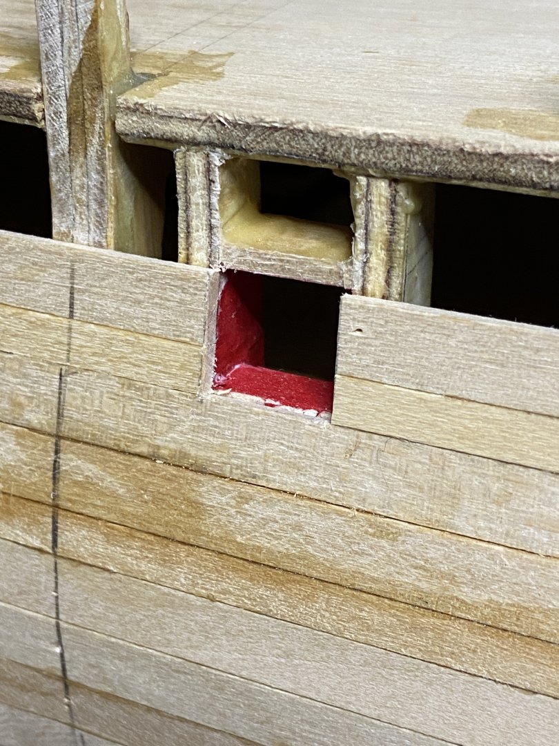

Back in the Shipyard.
Whilst waiting for the 2 Pack Resin to dry on the hull construction(many times).

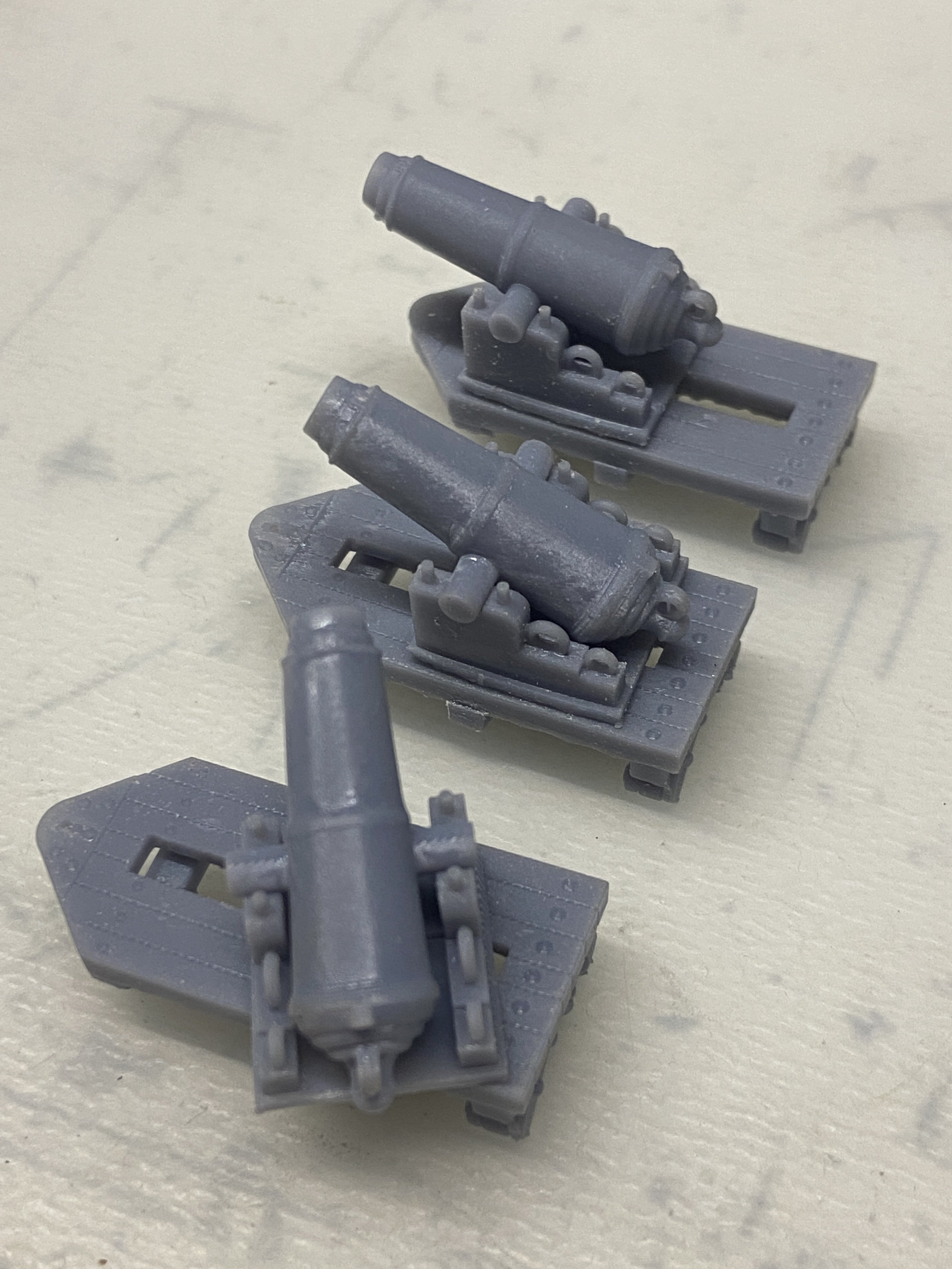

That brings me to what can I do to enhance the detail for this build.
I have been trying my hand in 3D Printing for some months now. mainly small figures for my sons to paint.
Being a design draftsman in my first trade(paid employment), I still like to "design things".
Below are the 2 types of armament mentioned above I have created/printed (still somewhat work in progress)
Will see how they paint up for use on the ship's fit-out.

Nice work on those guns Dave, they look nicely detailed without the banding created in filament printing.  Not surprising she carried additional guns in the hold; they were probably intended for defence of the new colony once landed.  Endeavour carried extra (in the hold) also for protection of the observation camp (Venus Transit) in Hawaii.
