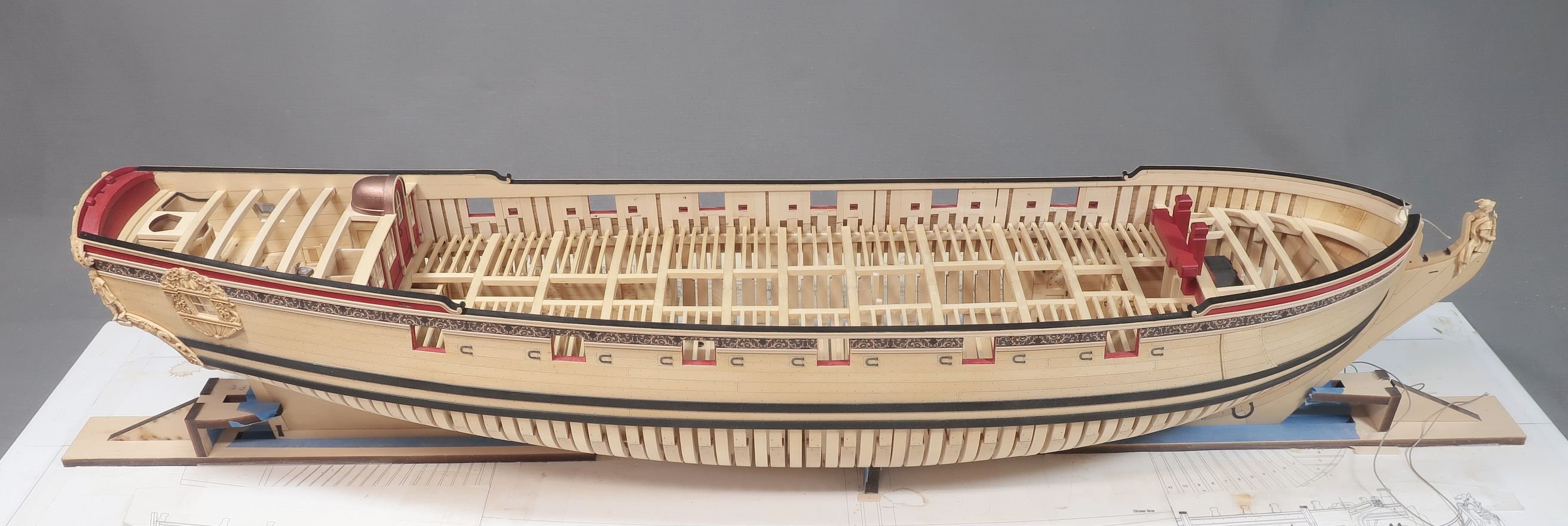

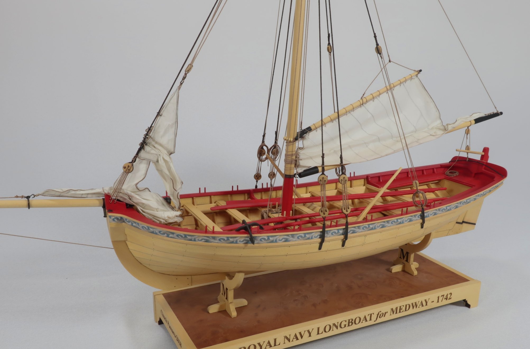

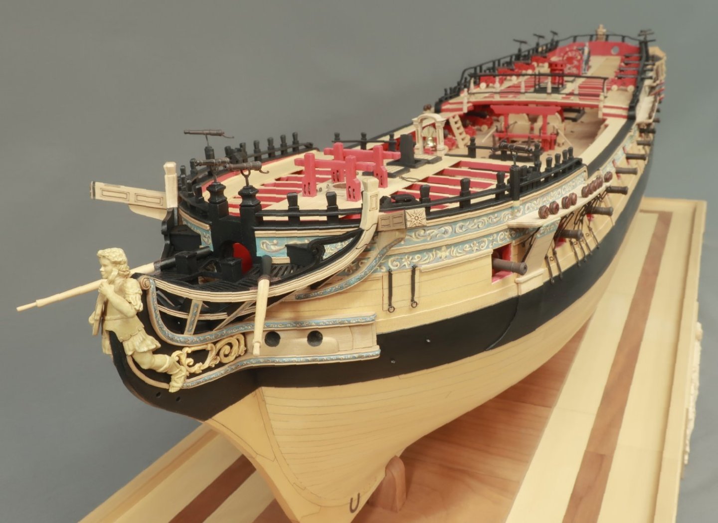

10 hours ago, glbarlow said:
Just look at build logs for Cheerful, Medway Longboat, and Winchelsea. Almost all built with AYC.
I see what you mean. Thanks!
