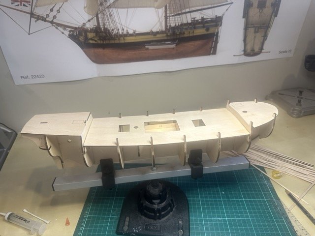

I have now had two days work on the model and the photo below shows how it is going - very early days, and I work slowly. So far, the video instructions are fine. We will see how it goes. There is no printed rigging plan, which makes me nervous, but we shall see how it pans out.

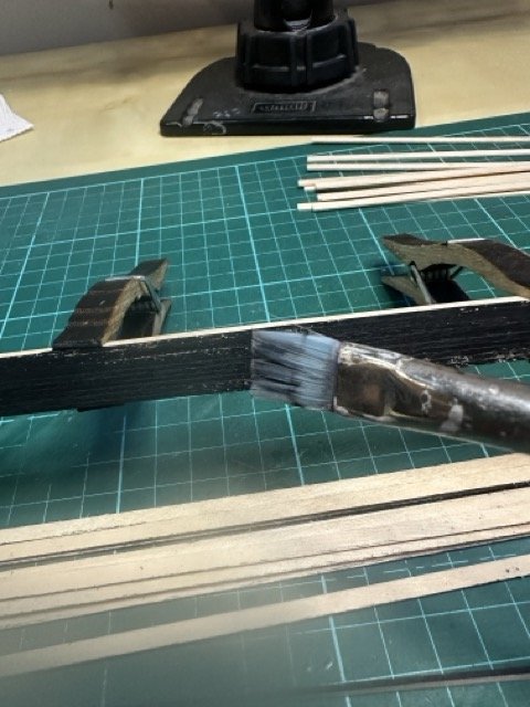

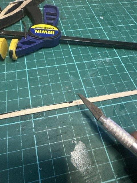

The false framework is complete. Time to start the deck planking. Before this, how to do the caulking? I have seen a number of methods used to simulate caulking. The AL suggestion is painting the edges black (having clamped the strips together first) and then cleaning away any bleeding on the face of the strips with a hobby blade. It will be interesting to see how this looks. The instructions suggest the use of a jig (see the comment in my first entry), but I haven't heard anything back from the company yet, so just used clamps. Fiddly, but seemed to work ok.

Nice work! There are lots of ways to simulate caulking, including by rubbing a pencil along one or both edges. I'd recommend using a bit of scrap wood to test some different options and see which you like best.
