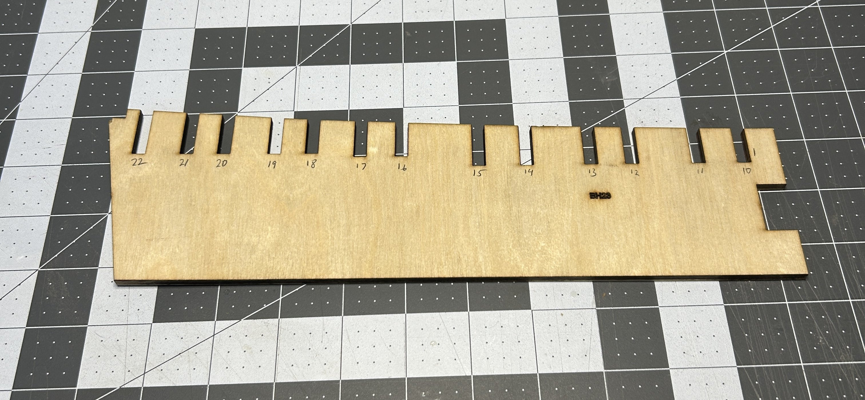

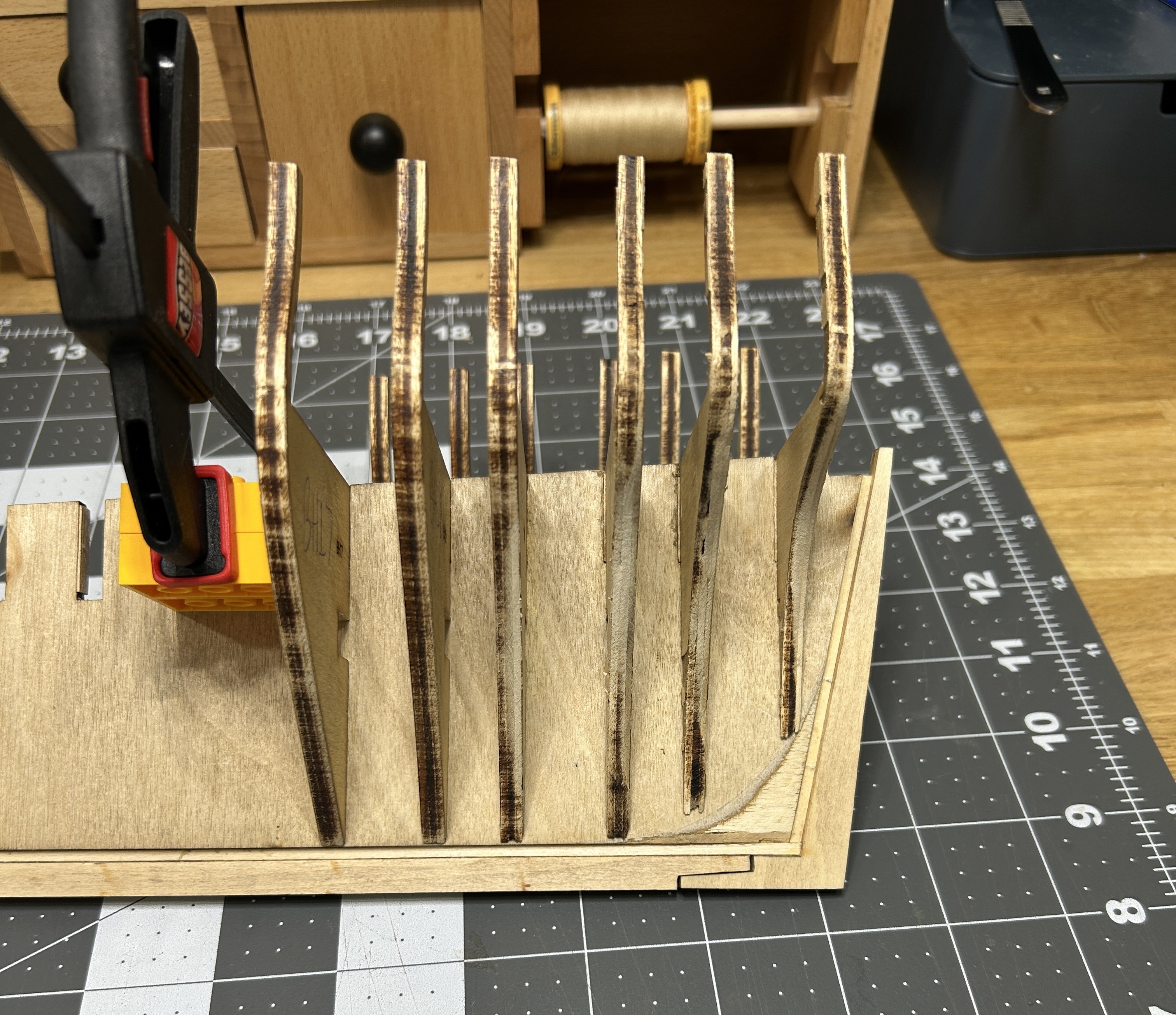

The bulkhead former comes in two pieces.  The aft section on mine had a slight warp in it so I soaked it in some hot water and used an iron for heat to attempt to flatten it.
I put some weights on it to be sure it stayed flat.
Those are 1.75 liter bottles of scotch.  Part of my tariff protection stockpile.

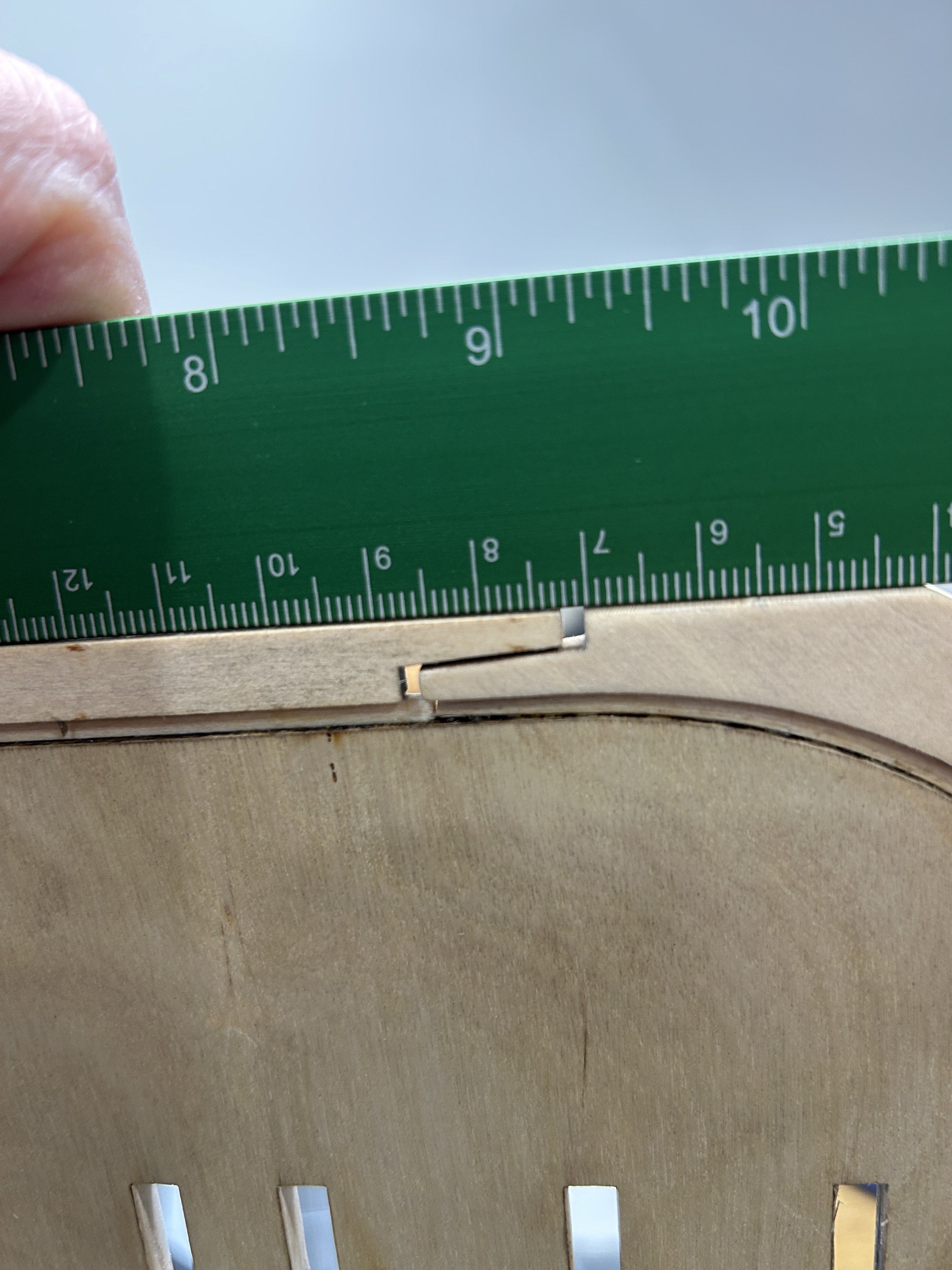

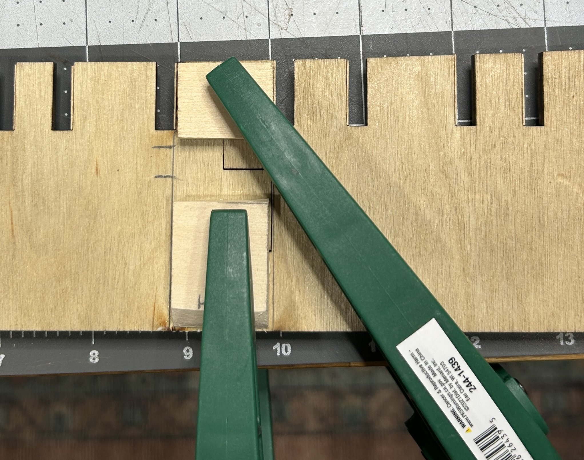

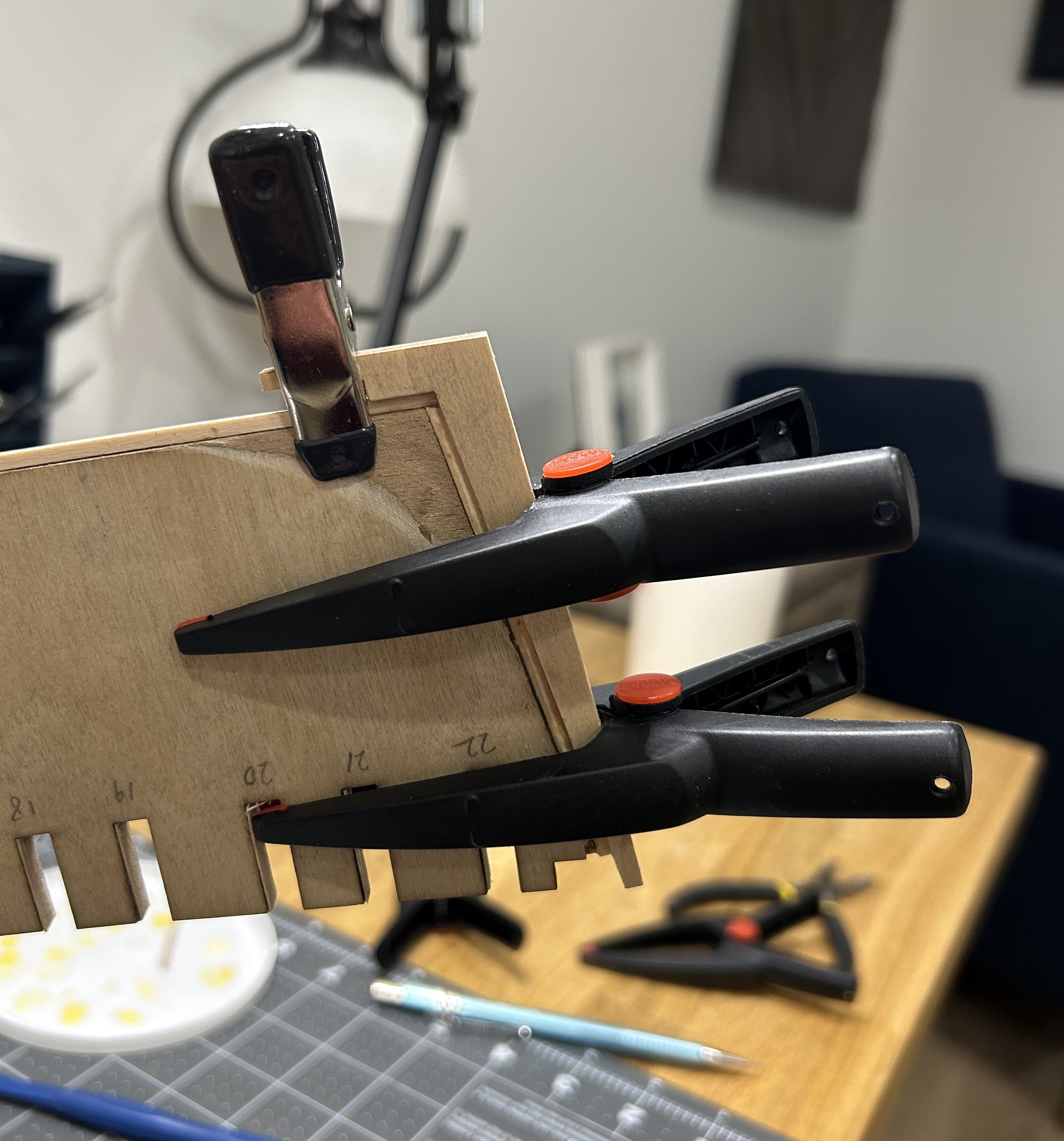

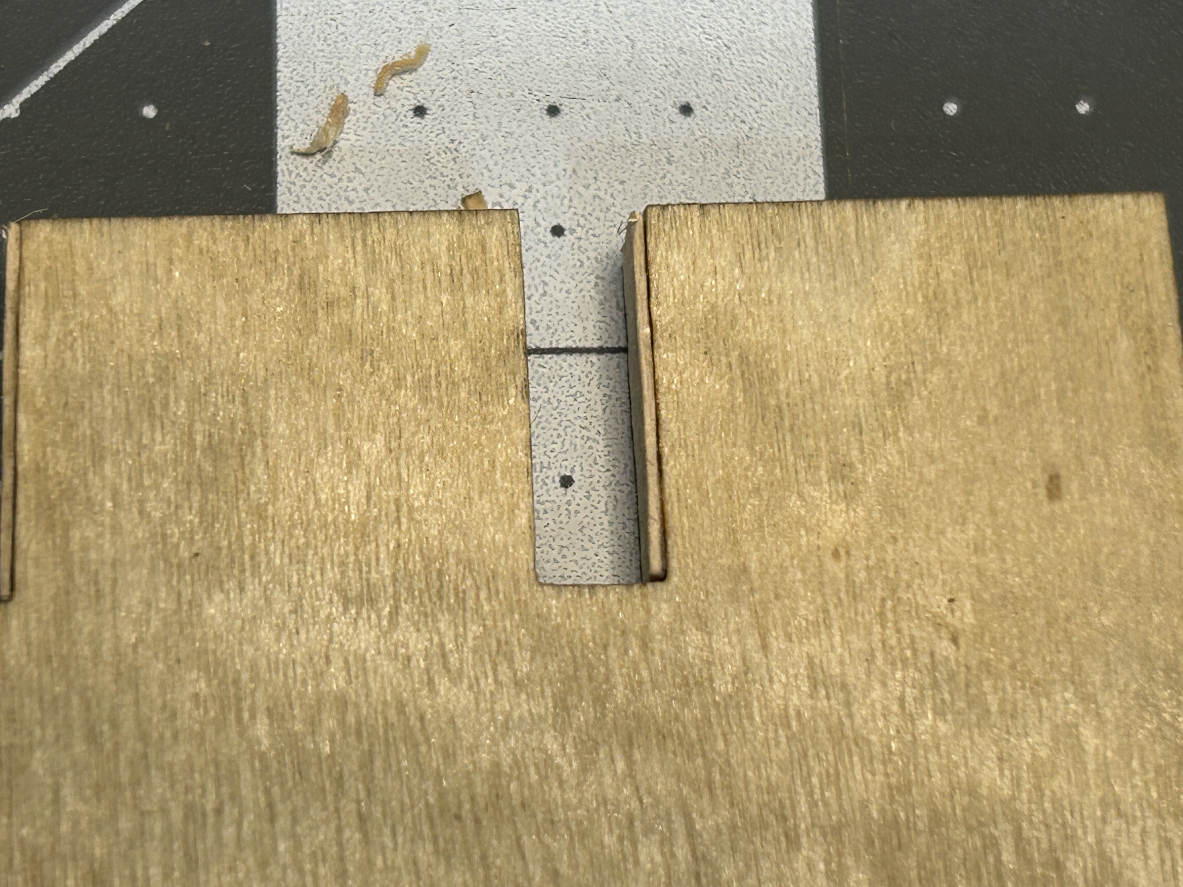

I found that the slots in the bulkhead former are all a little bit oversized, so I have added shims to the slots.  I will need to sand a little bit to get a good snug fit.
With 22 bulkheads, I will be spending a lot of time removing laser char so it might be awhile until my next post.

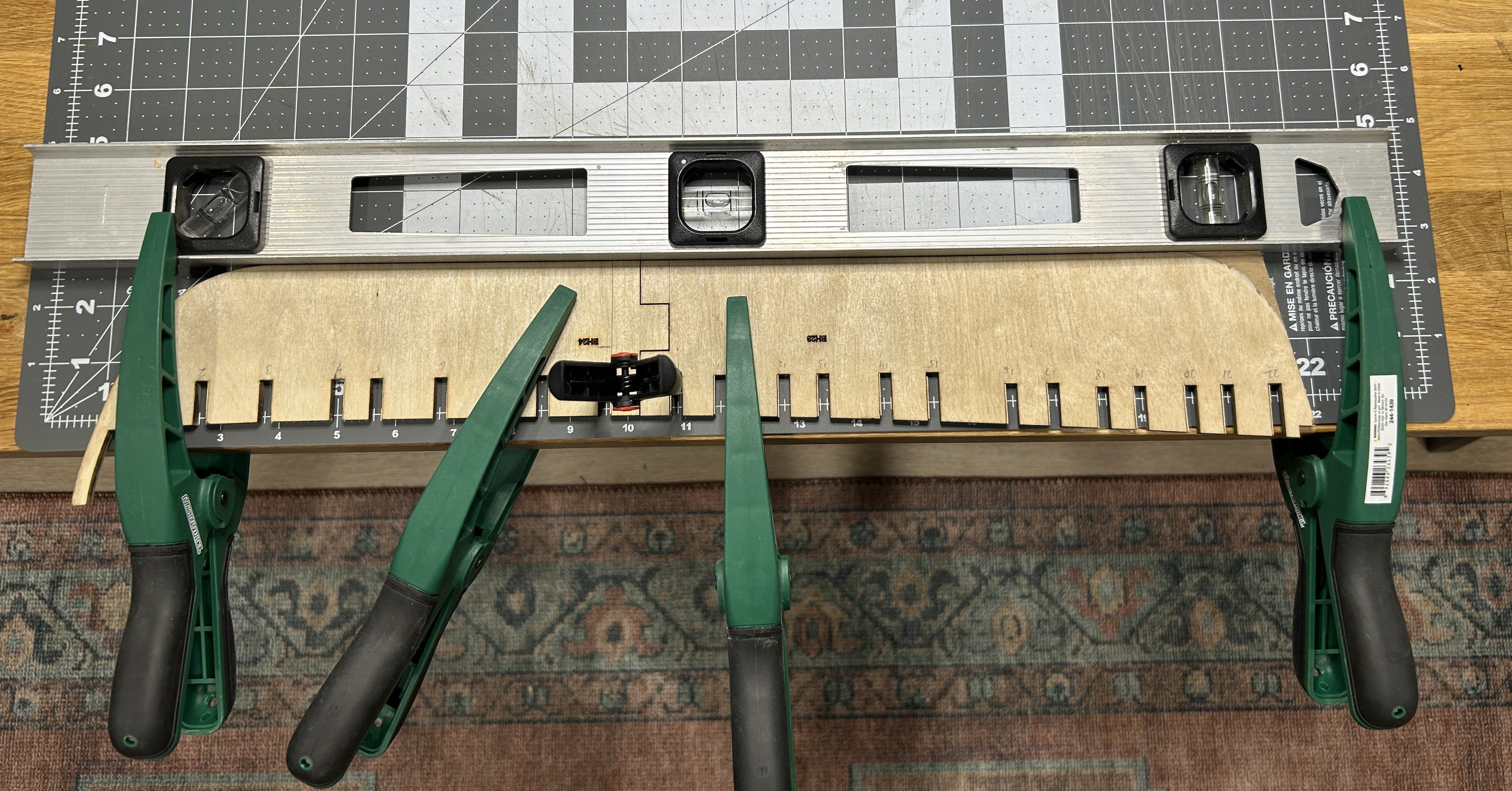

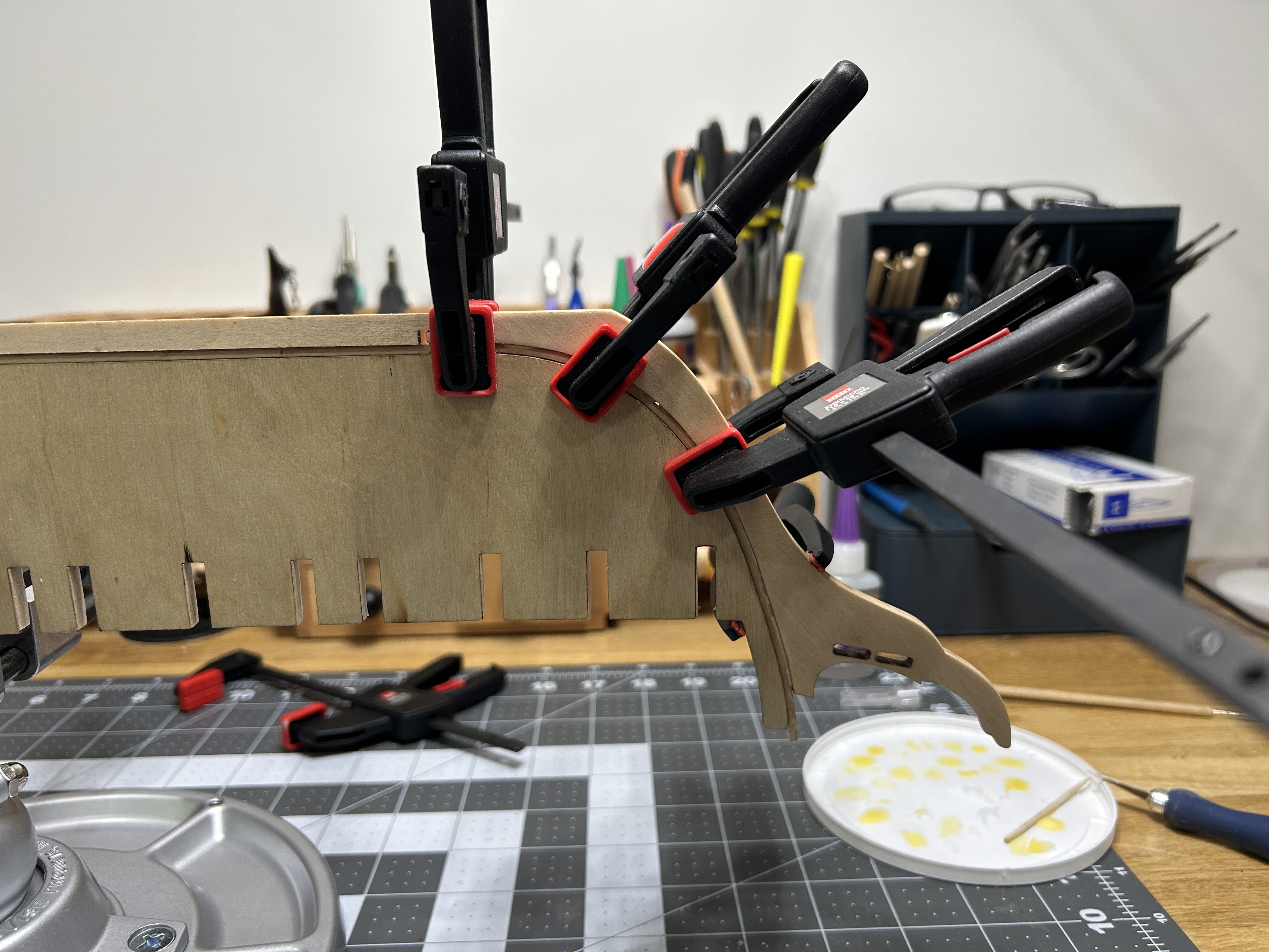

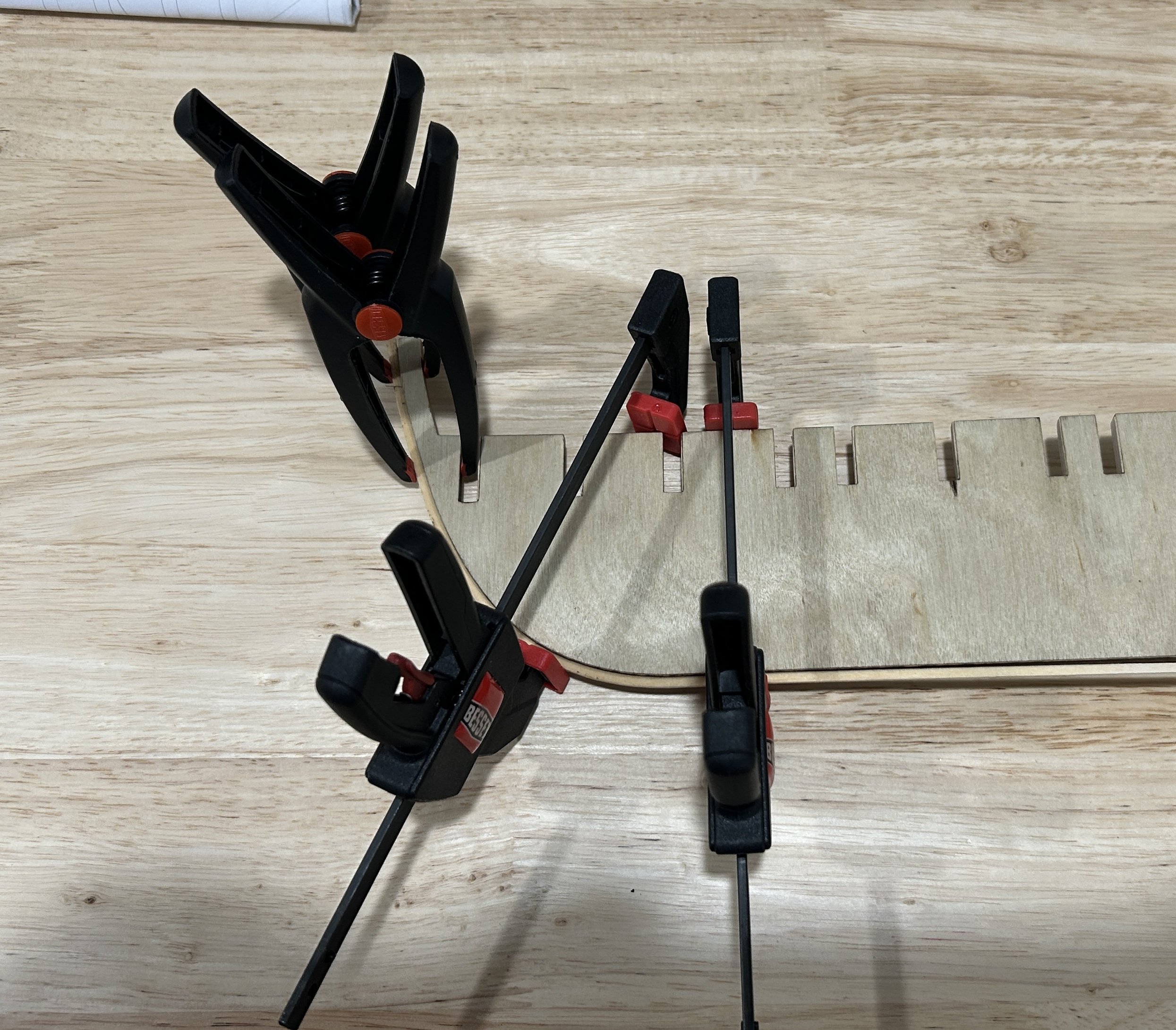

I have glued the two pieces of the bulkhead former together and added some support pieces on both sides of the joint.    I left a gap in the support pieces to accommodate the strong back on each side of the bulkhead former.

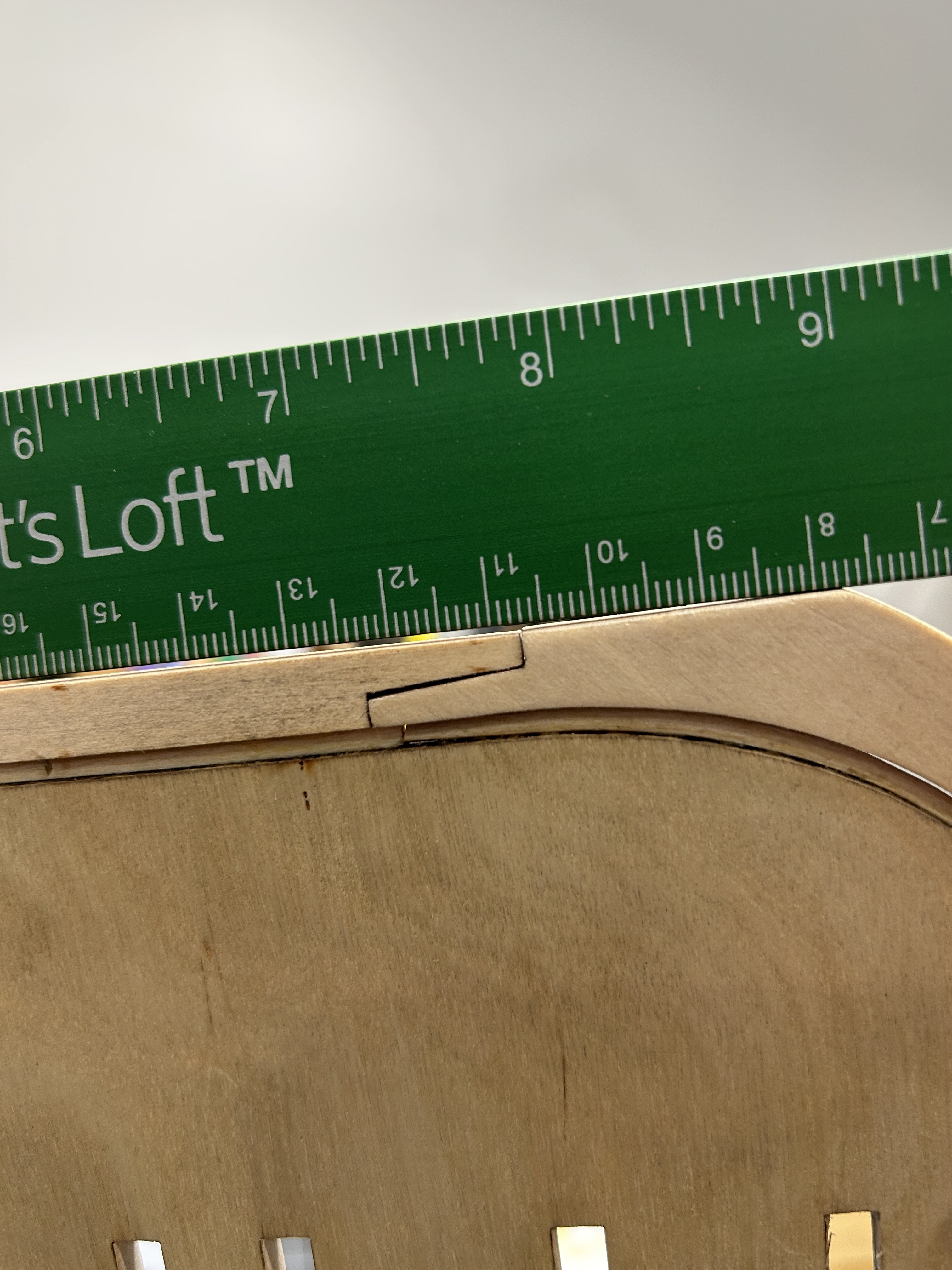

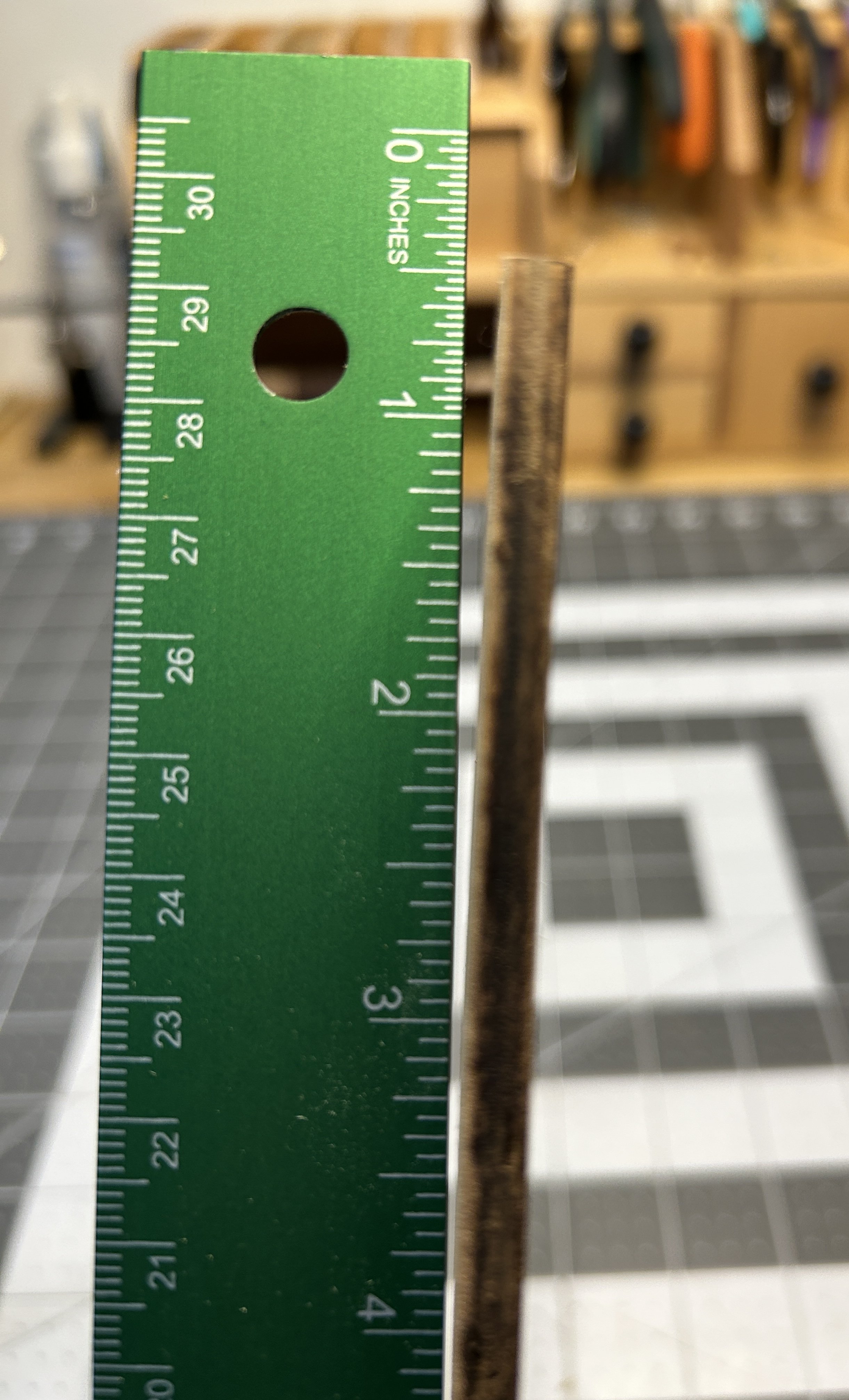

The rabbet strip is 1/16 x 3/32 basswood.  I preshaped the rabbet strip after soaking it in hot water for about 15 minutes.
Getting it centered was a little challenging.  I used a small drop of CA at the bow to get it started in the center and then used Titebond to secure the rest of the strip.    At the stern I was successful with just Titebond.
Adding the stern post, keel and stem is also a little tricky.   I used only Titebond because I needed a little working time to ensure it was lined up even with the bulkhead former.   The stern post and keel went on fine, but when I placed the stem against the keel, the bottom didn't create a straight line with the keel.  To get the bottom of the stem and the keel to create a straight line I needed to leave a small gap between the keel and the stem.  I will fill this in with some putty and it will be covered with cooper eventually.
I also pinned the stern post, keel and stem to the bulkheads former to make it more secure.

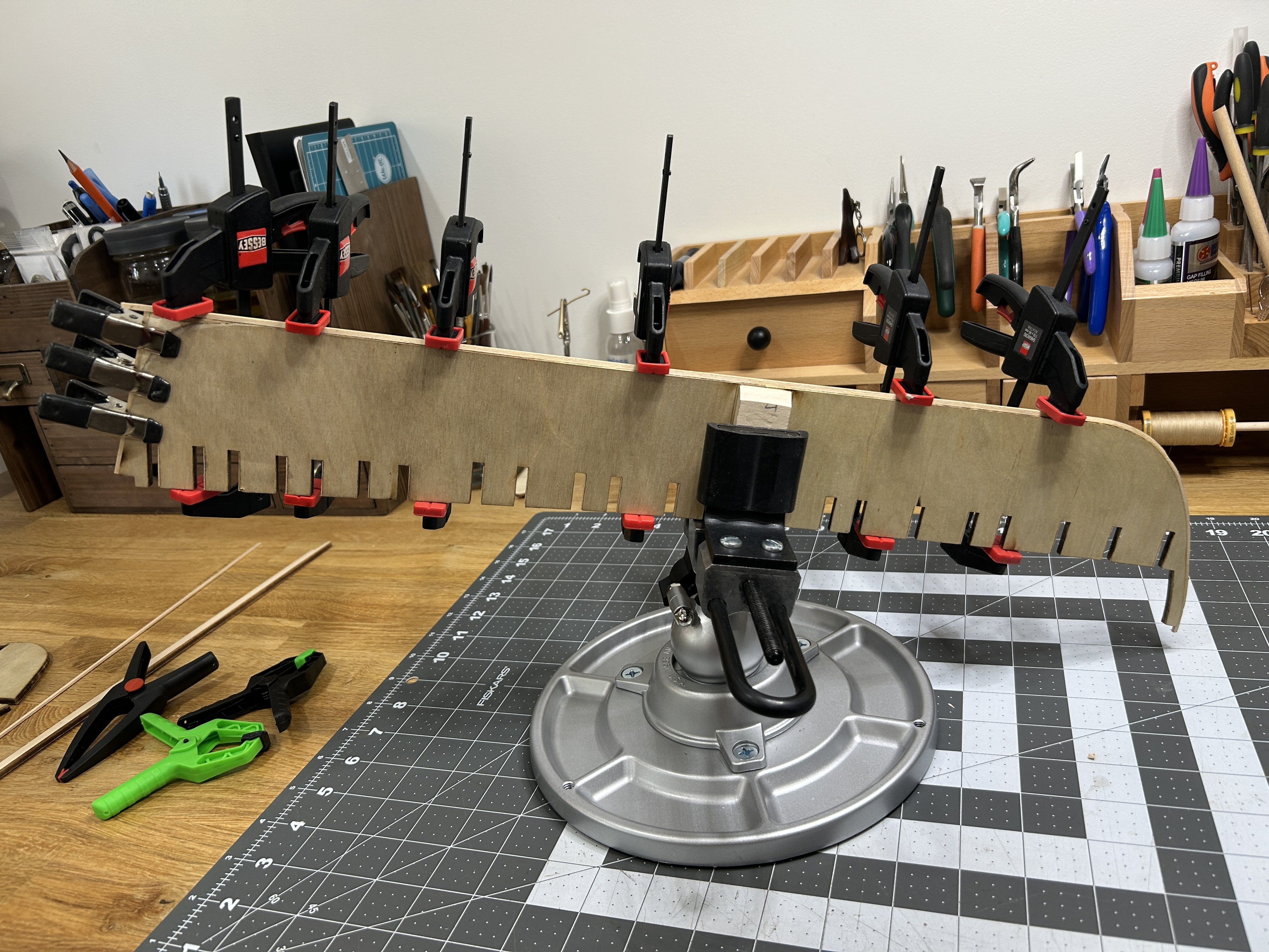

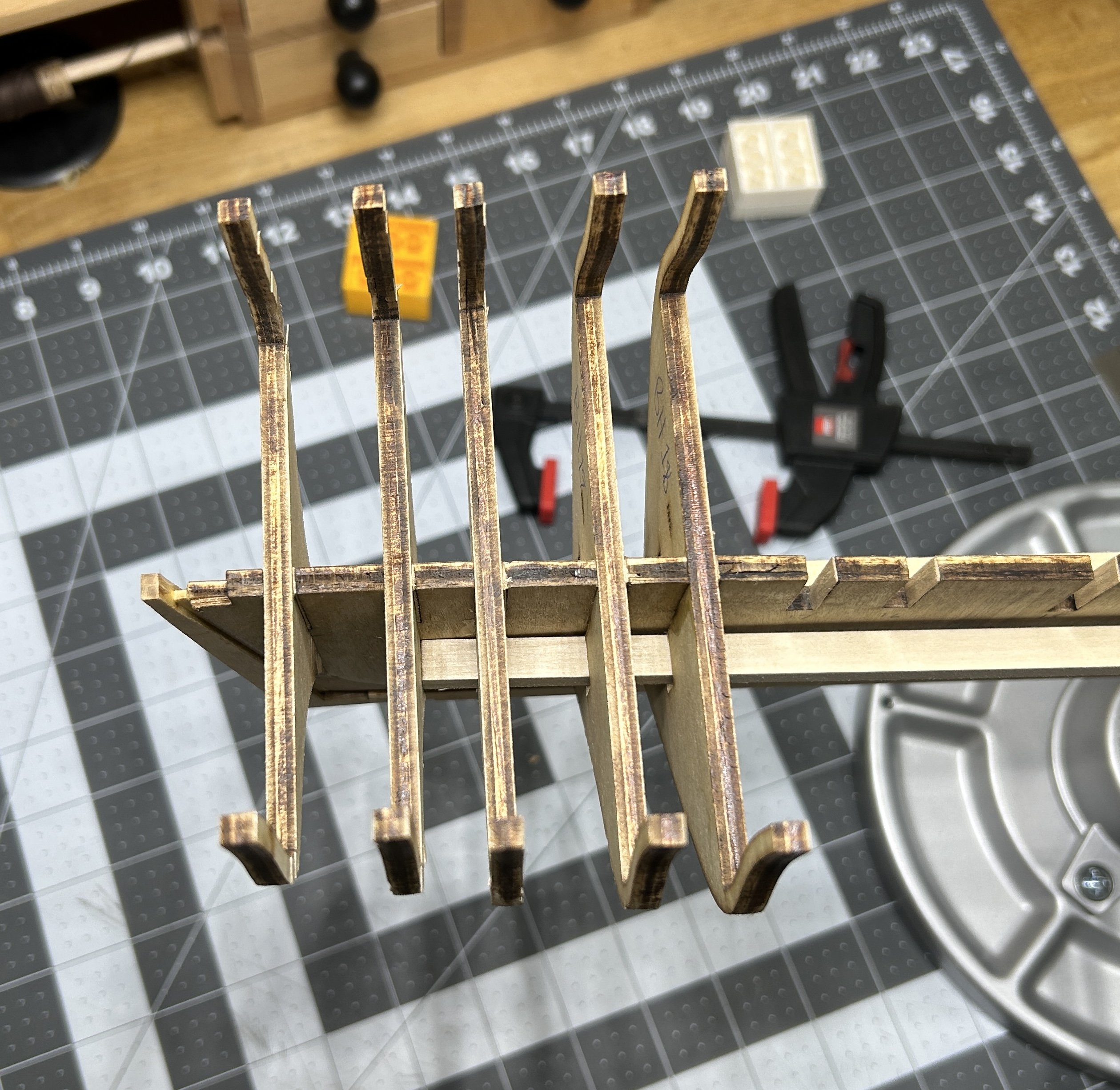

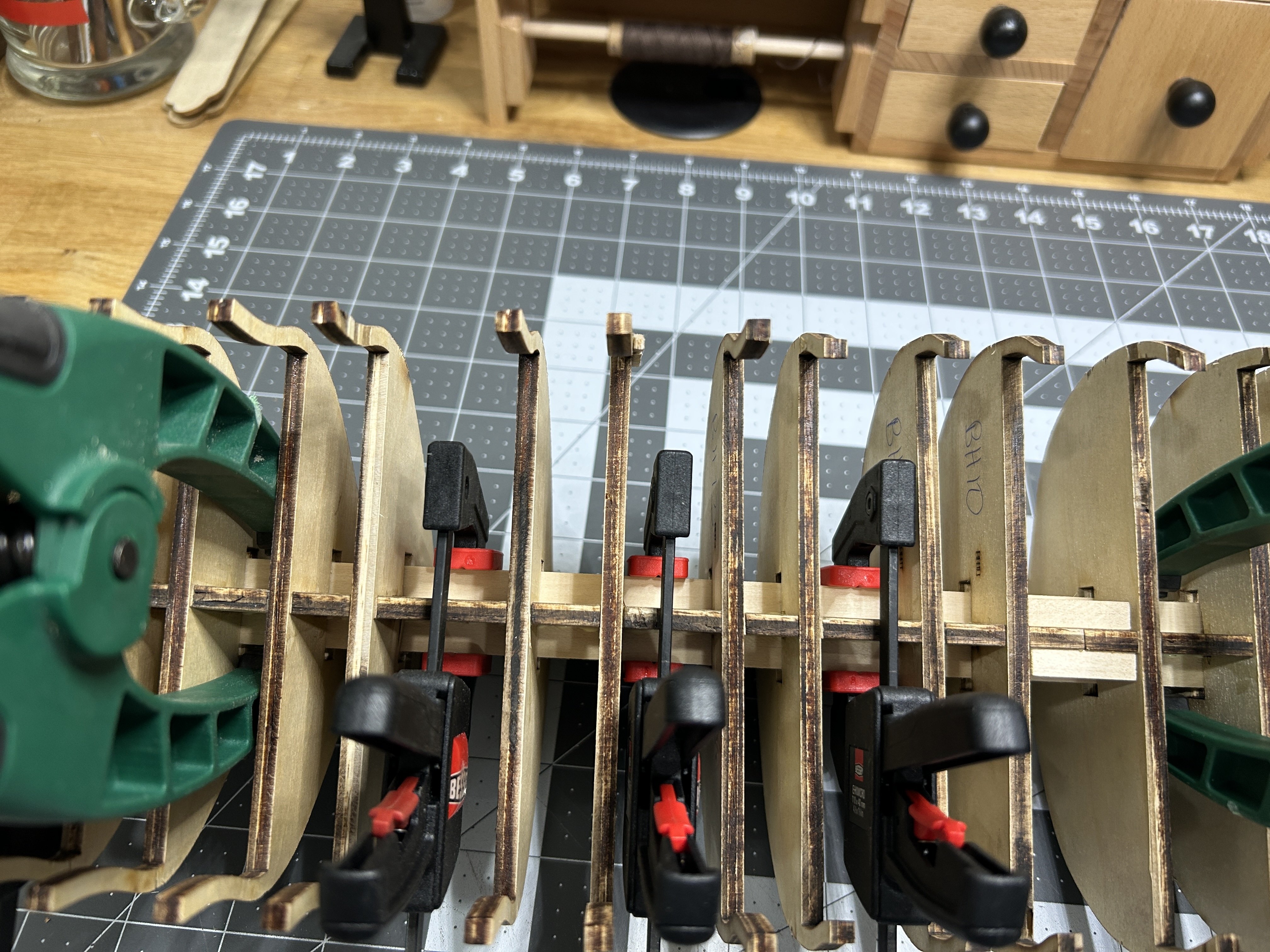

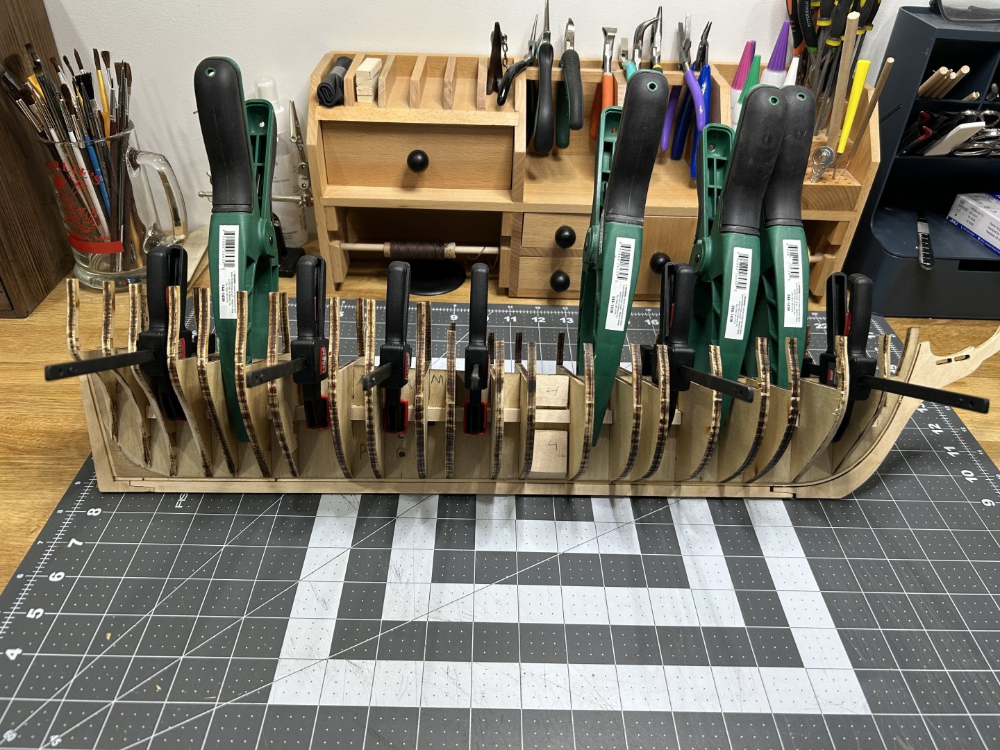

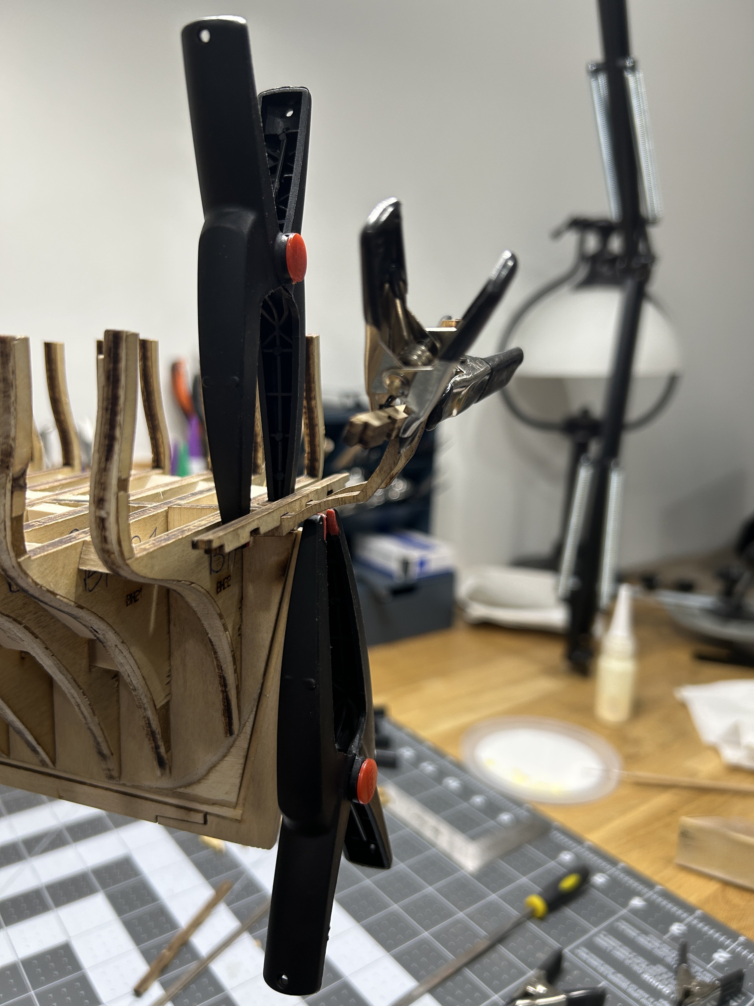

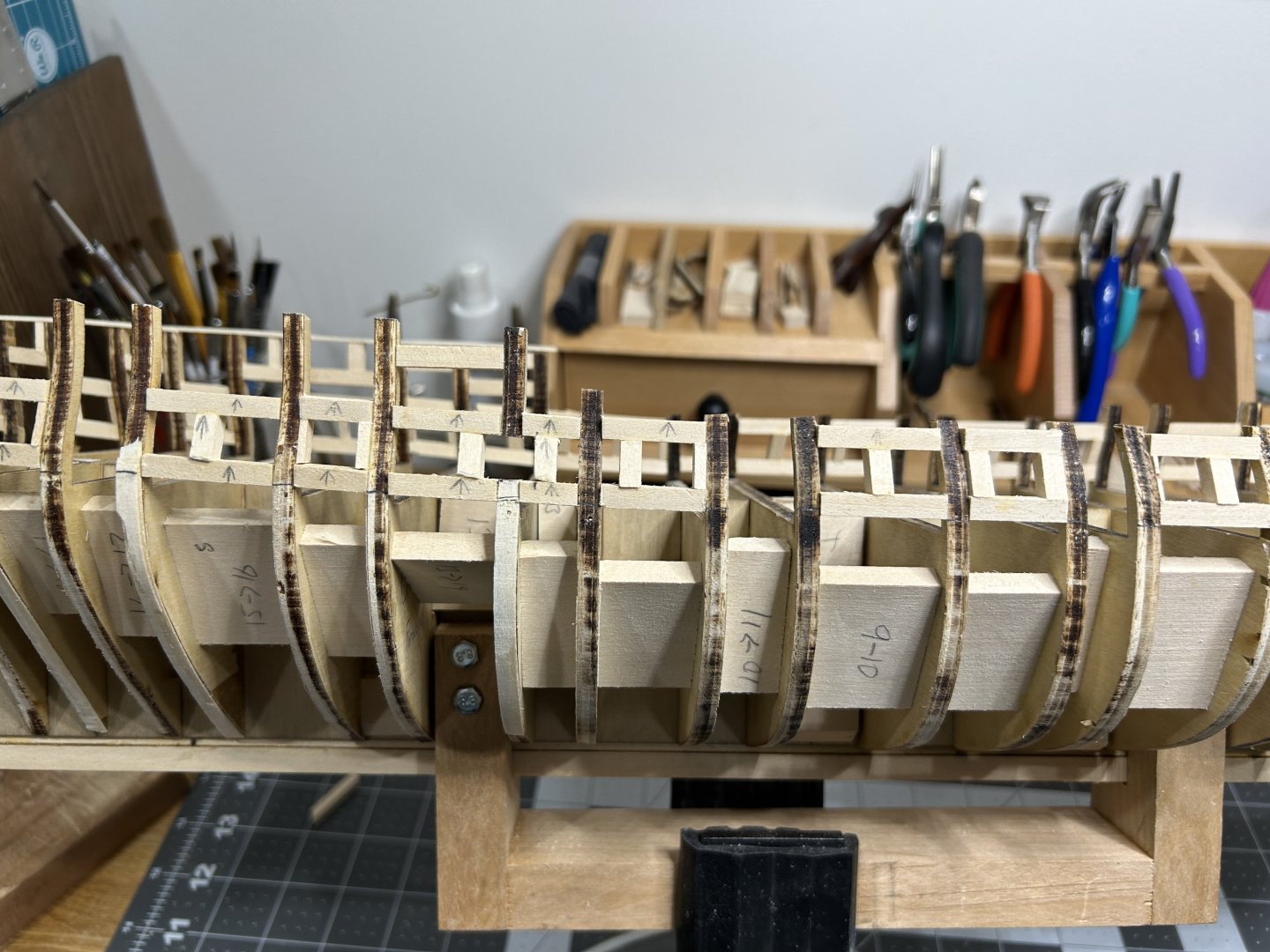

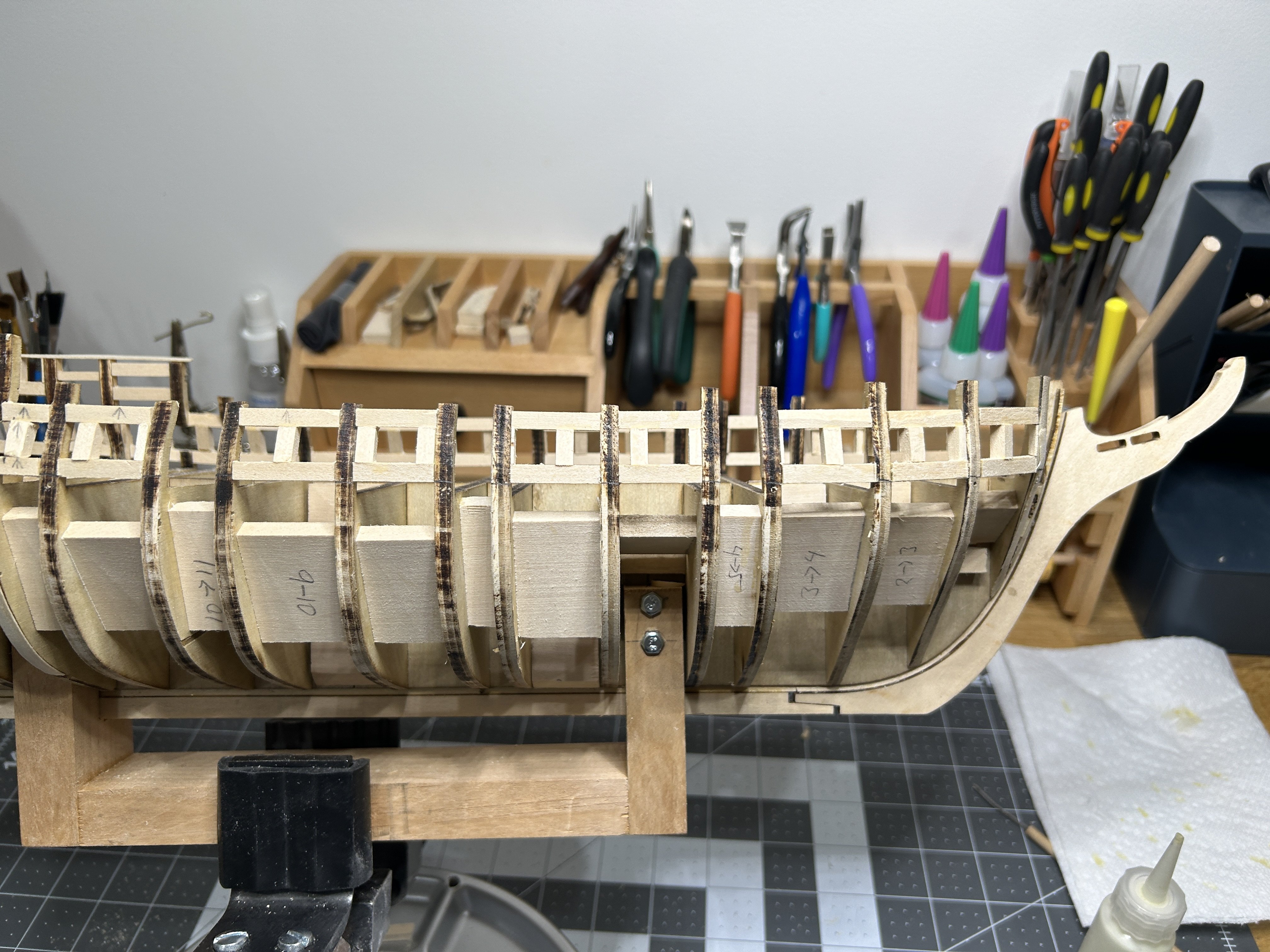

I made some progress on the bulkheads today.  I started by dry fitting all of the bulkheads that have the cut out for the strong backs to make sure that the strong backs would go through all of the cut outs easily after they were installed.  I need to do a little extra sanding on a couple of the bulkheads to widen the cut outs.

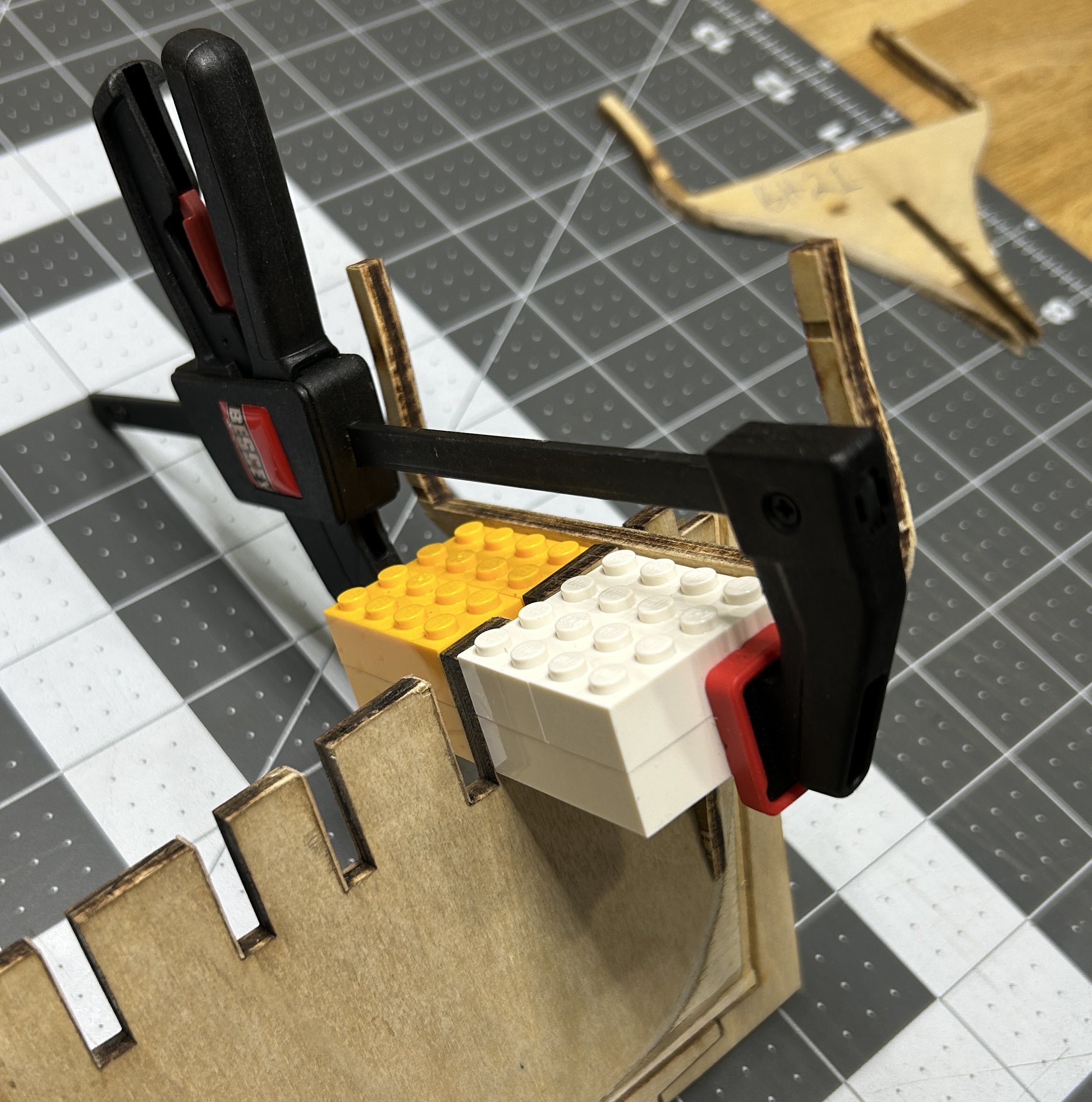

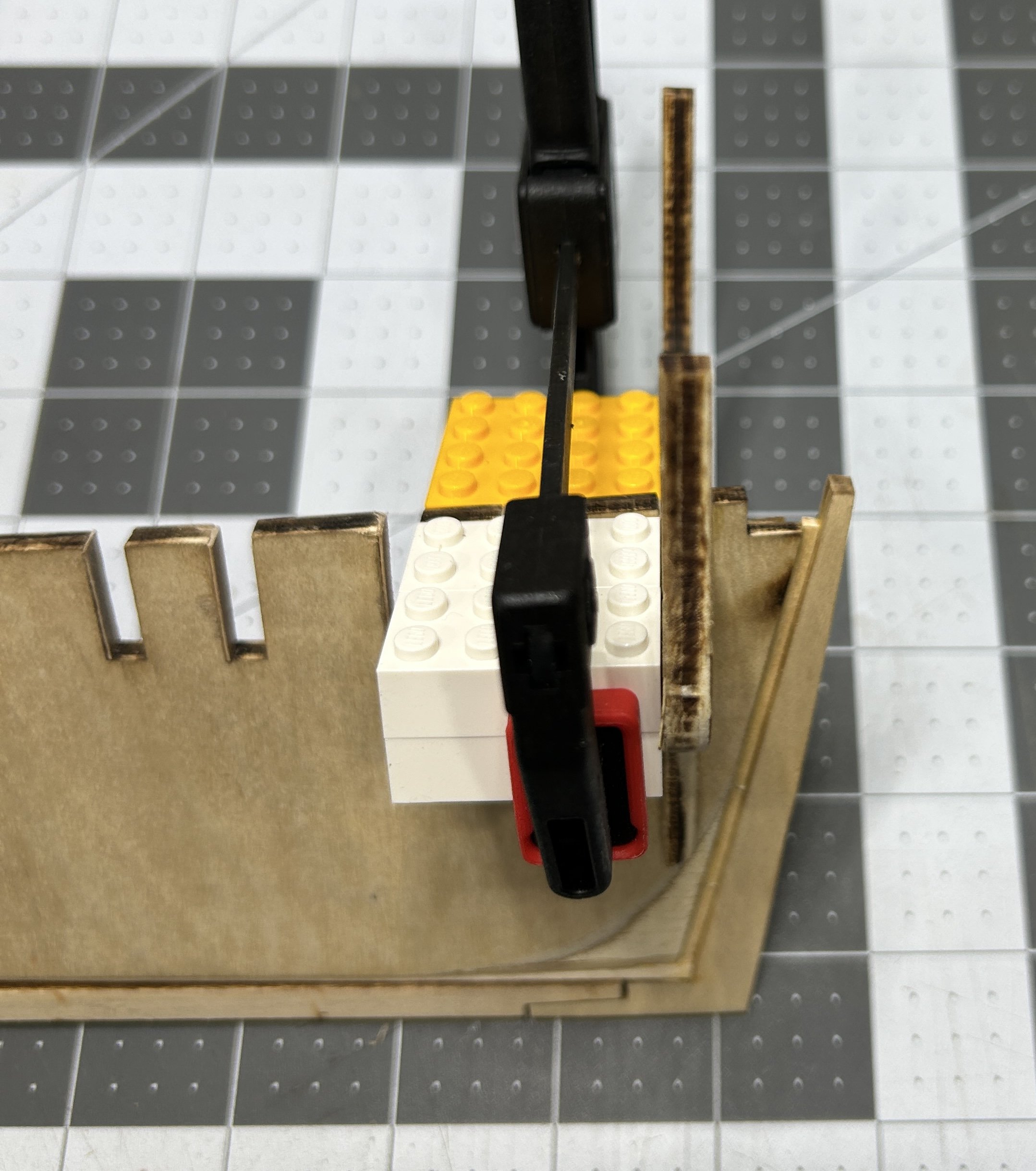

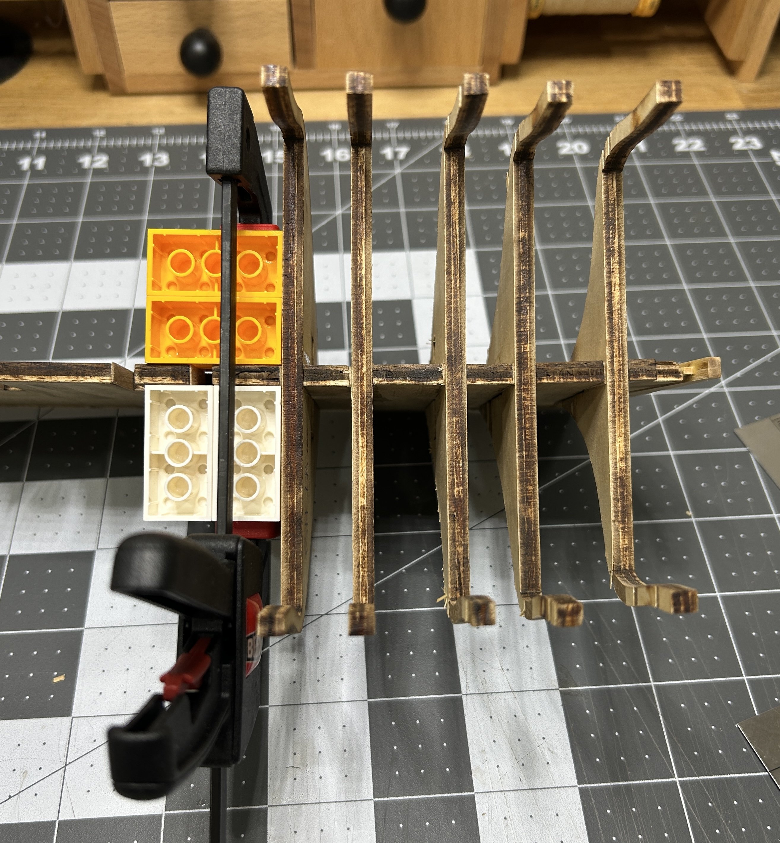

I then started adding the bulkheads starting at the rear.  I used Legos to keep the bulkheads square as the glue was a setting up.

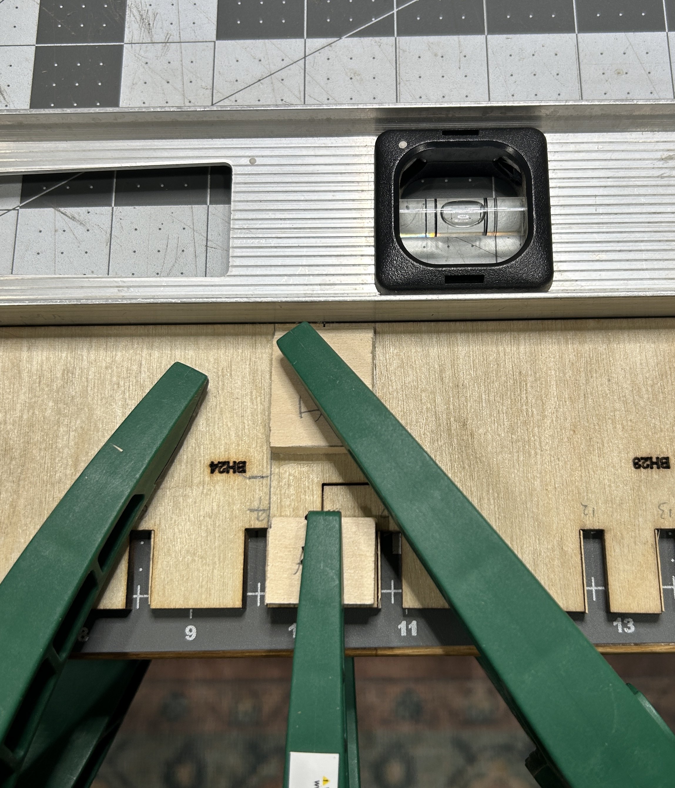

I checked the alignment of the strong back cut outs after every two or three bulkheads.  I dry fitted the first bulkhead that the strong backs goes through to confirm that the cut outs all line up.
I am about a third of the way through adding the bulkheads.

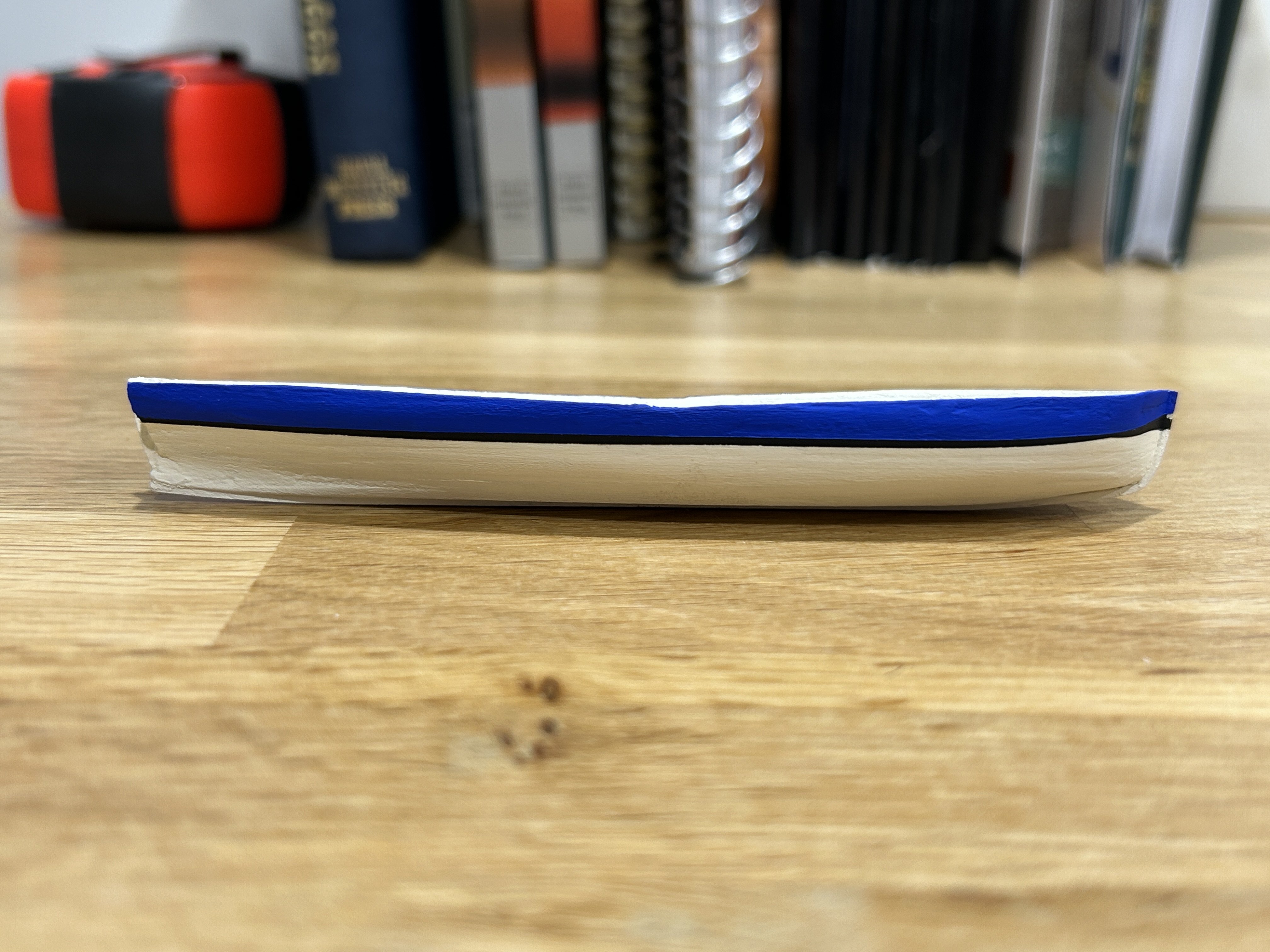

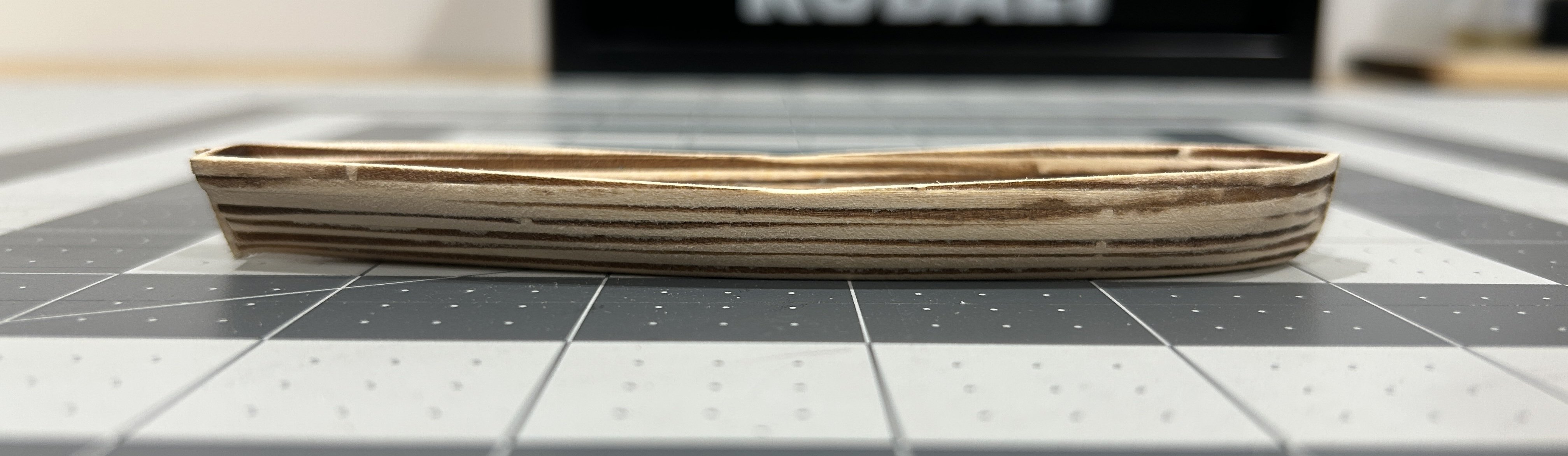

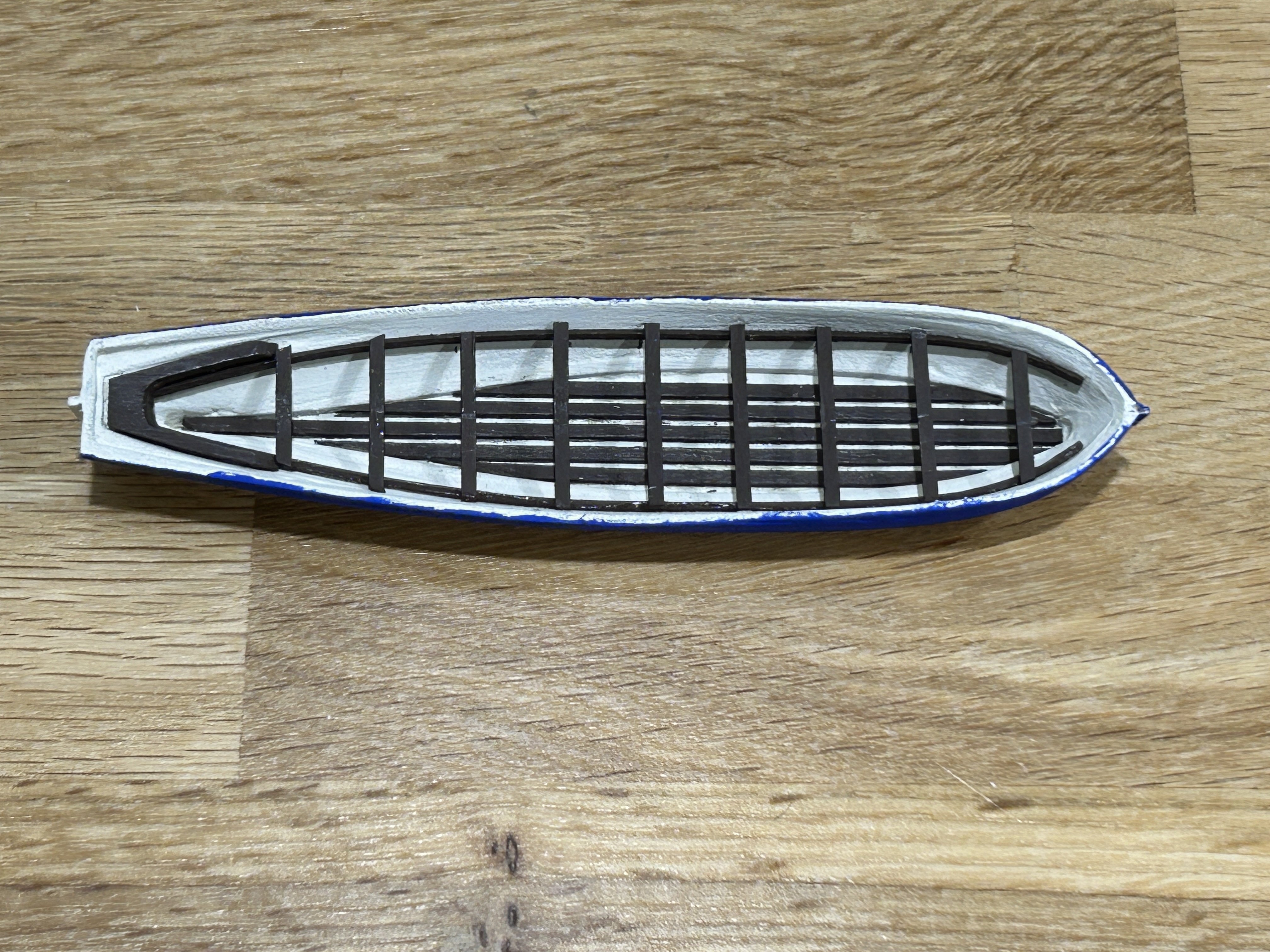

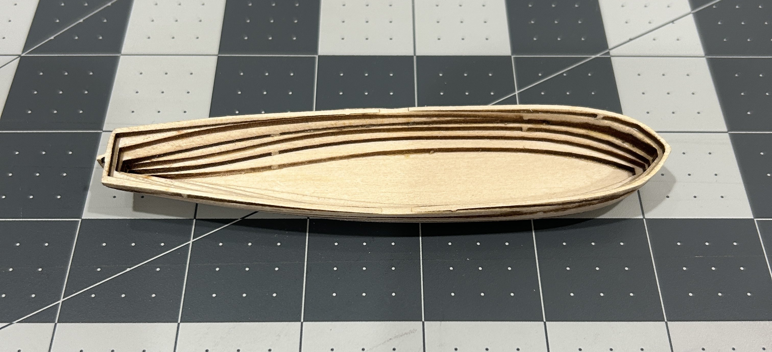

While I was waiting for the glue to dry on the bulkheads I started to assemble the ship's boat.  This uses the method of assembling layers of material to create a hull that is sanded smooth on the inside and outside of the hull.
This was my first time building a boat using this technique.  I am not sure I sanded enough on the interior, but I am pleased with the exterior of the hull.  There is a lot of detail to add, and I will probably wait until I can focus 100% on the boat to finish it.

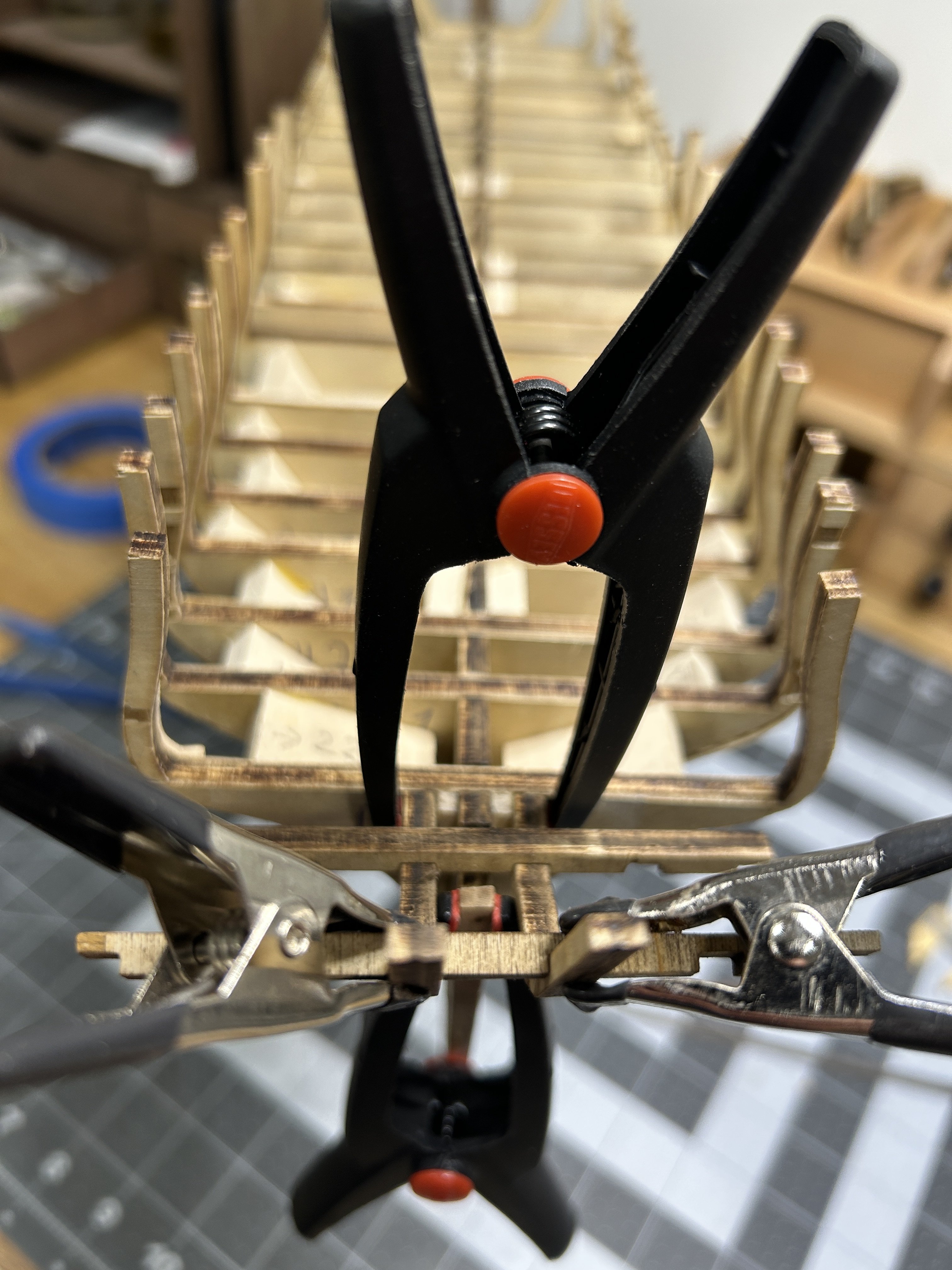

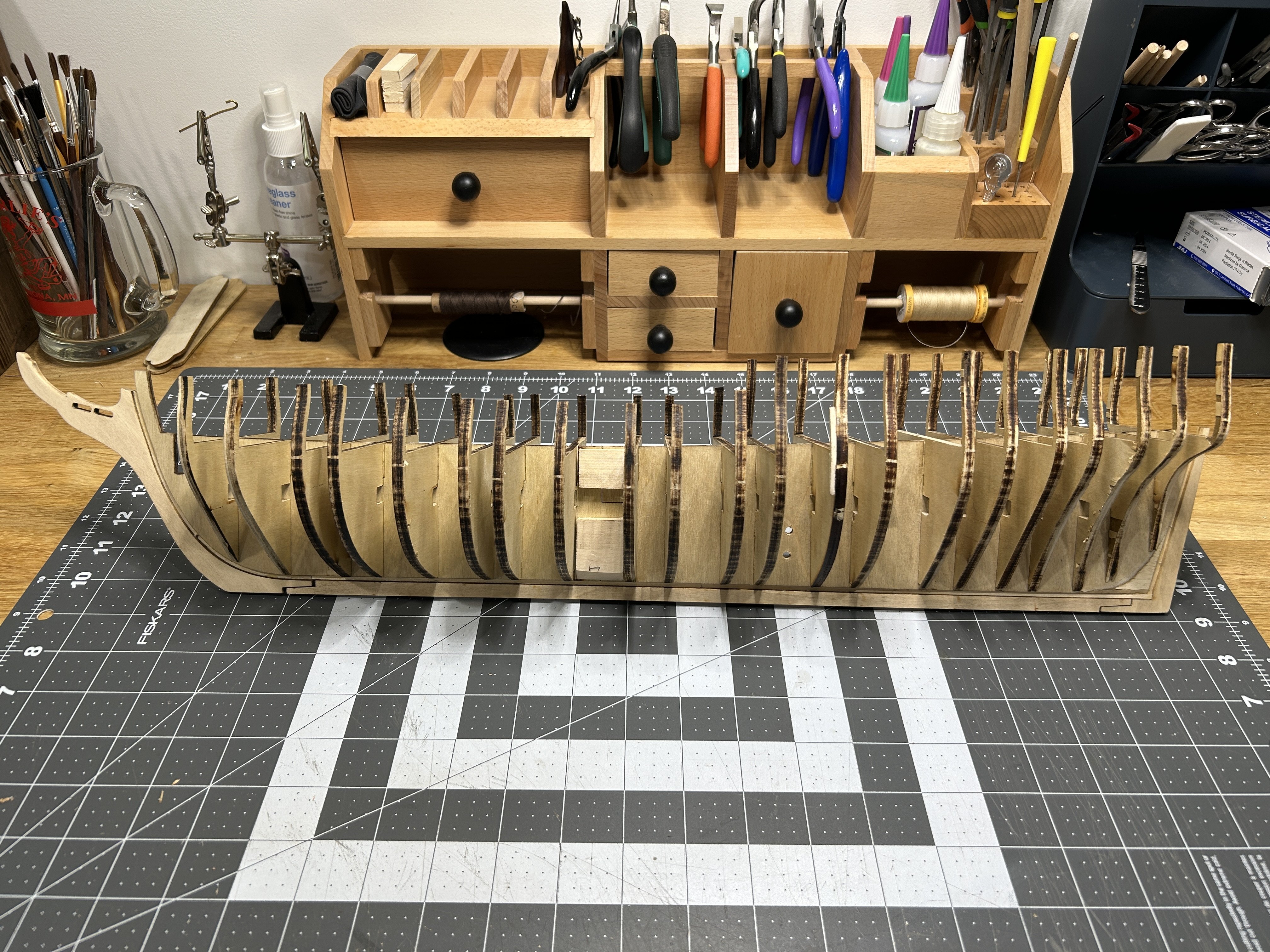

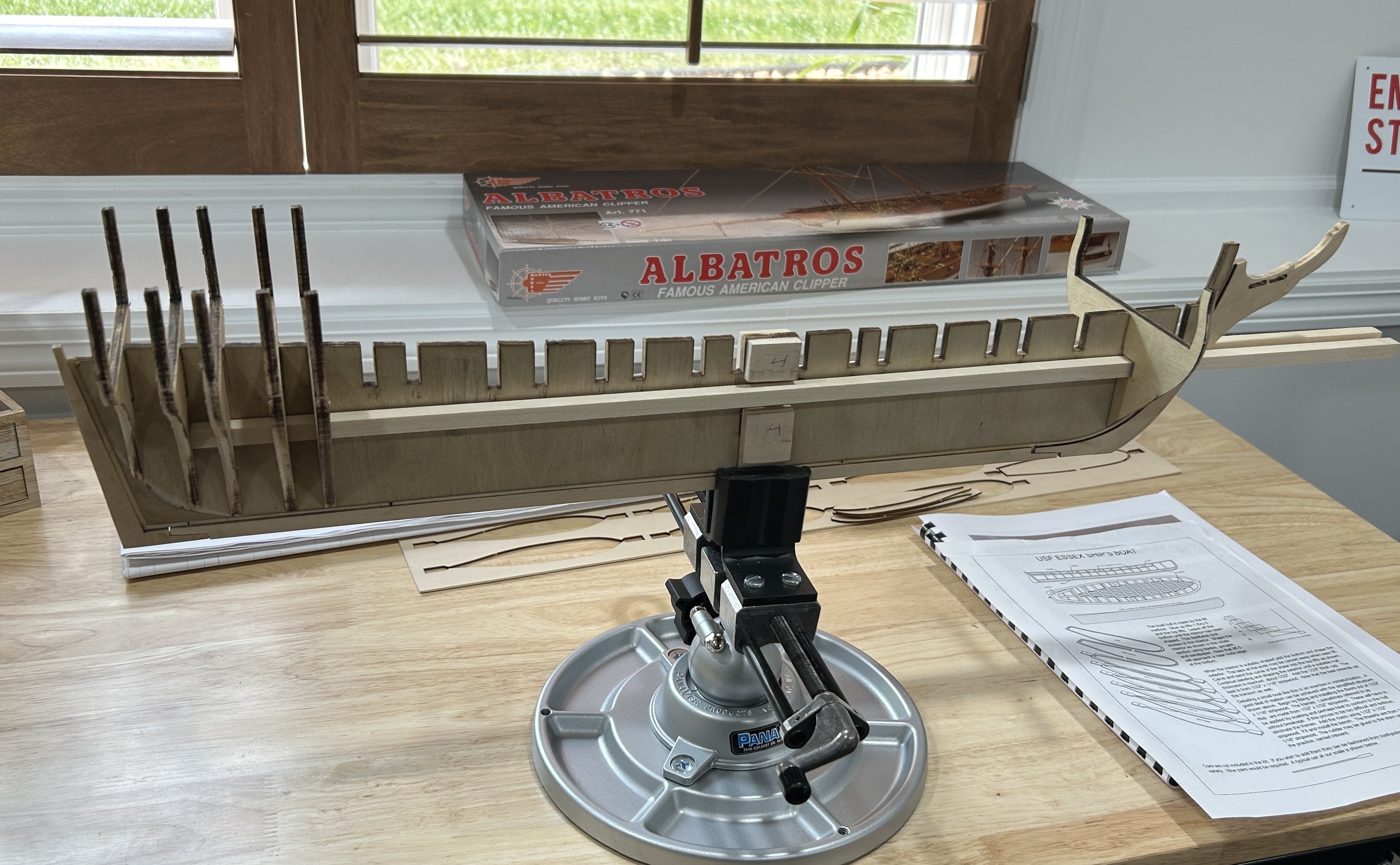

I have made some progress with the Bulkheads.  I started by adding all but the most forward bulkheads.

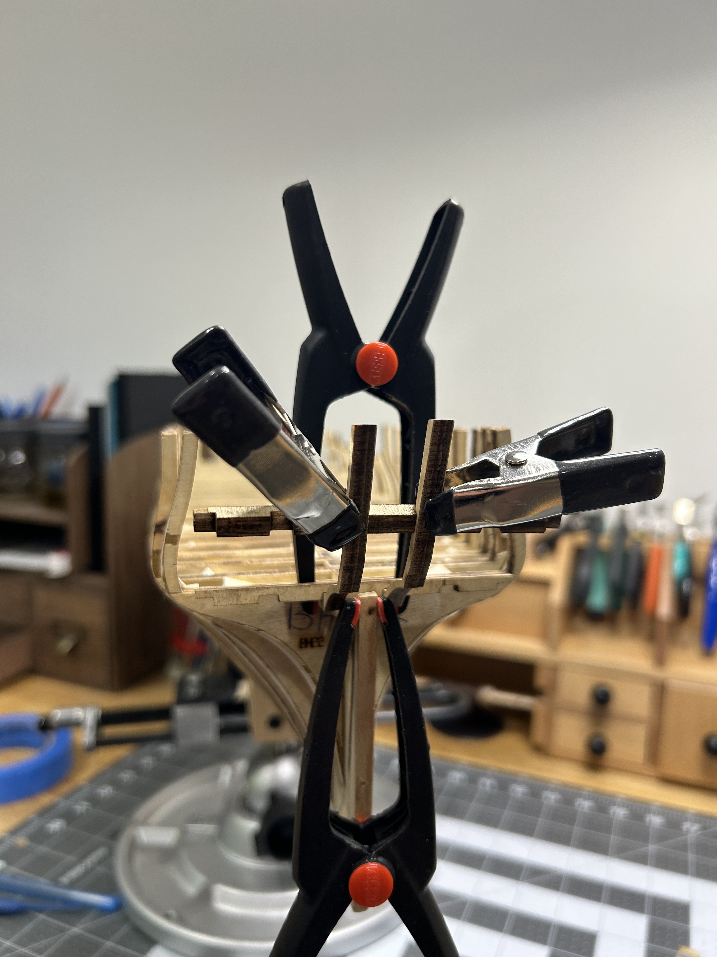

I then added the two strong backs.  These pass through the second forward bulkheads through the third bulk head aft.  They are 5/16 x 5/16 inch basswood.
I didn't take a picture but I have added the forward bulkheads also, so all of the bulkheads are on.   I will start adding the braces between all of the bulkheads next.  I think with the strong backs and the braces I will have a very solid framework to plank.

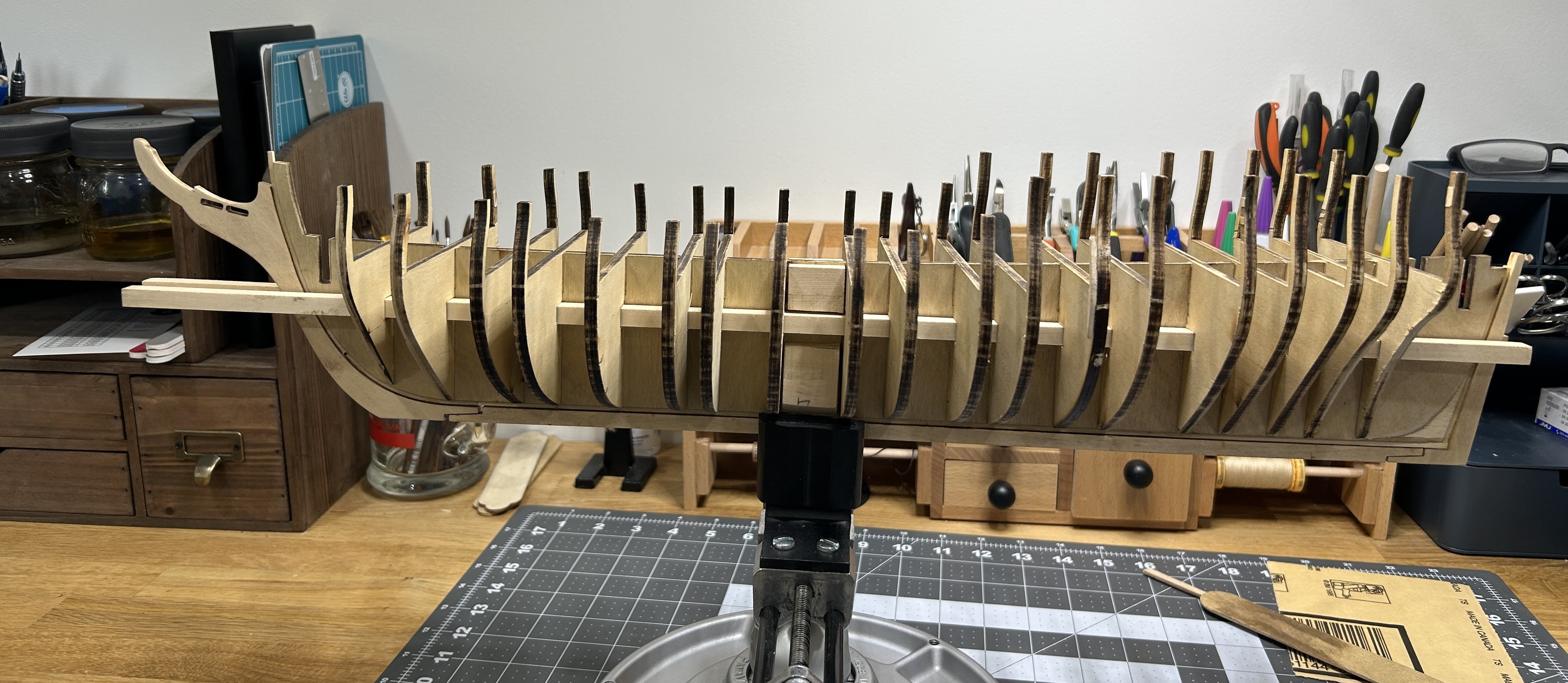

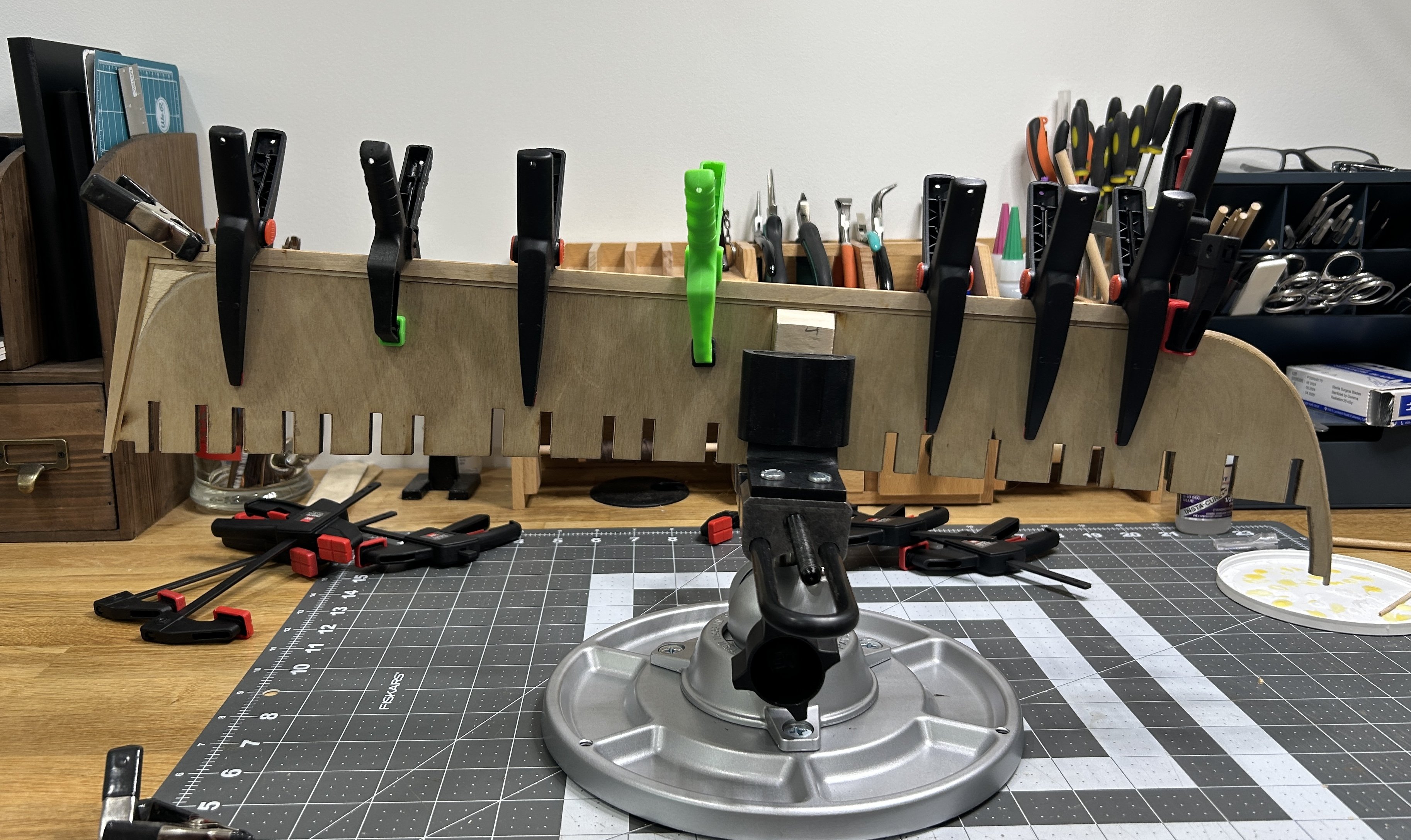

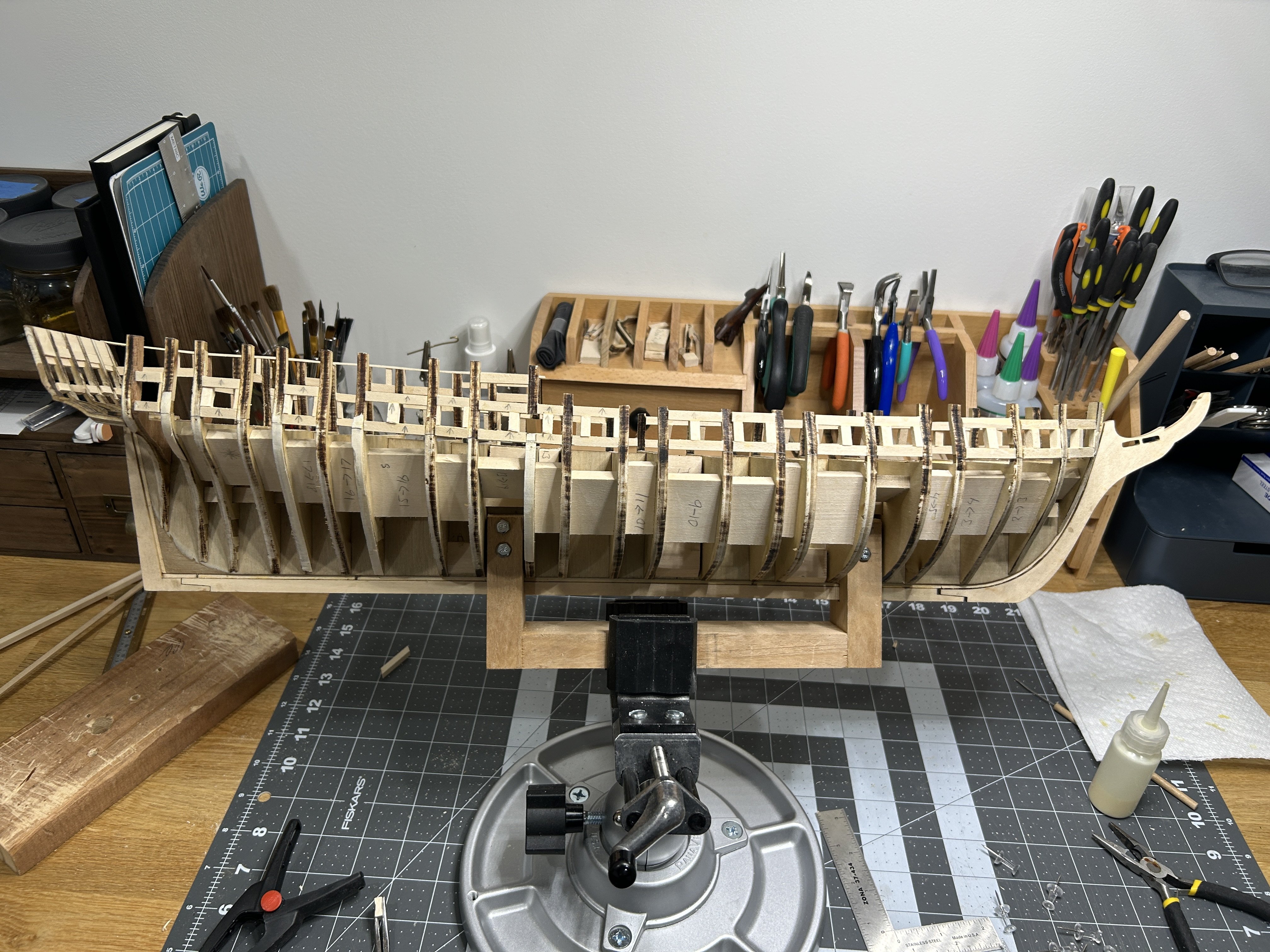

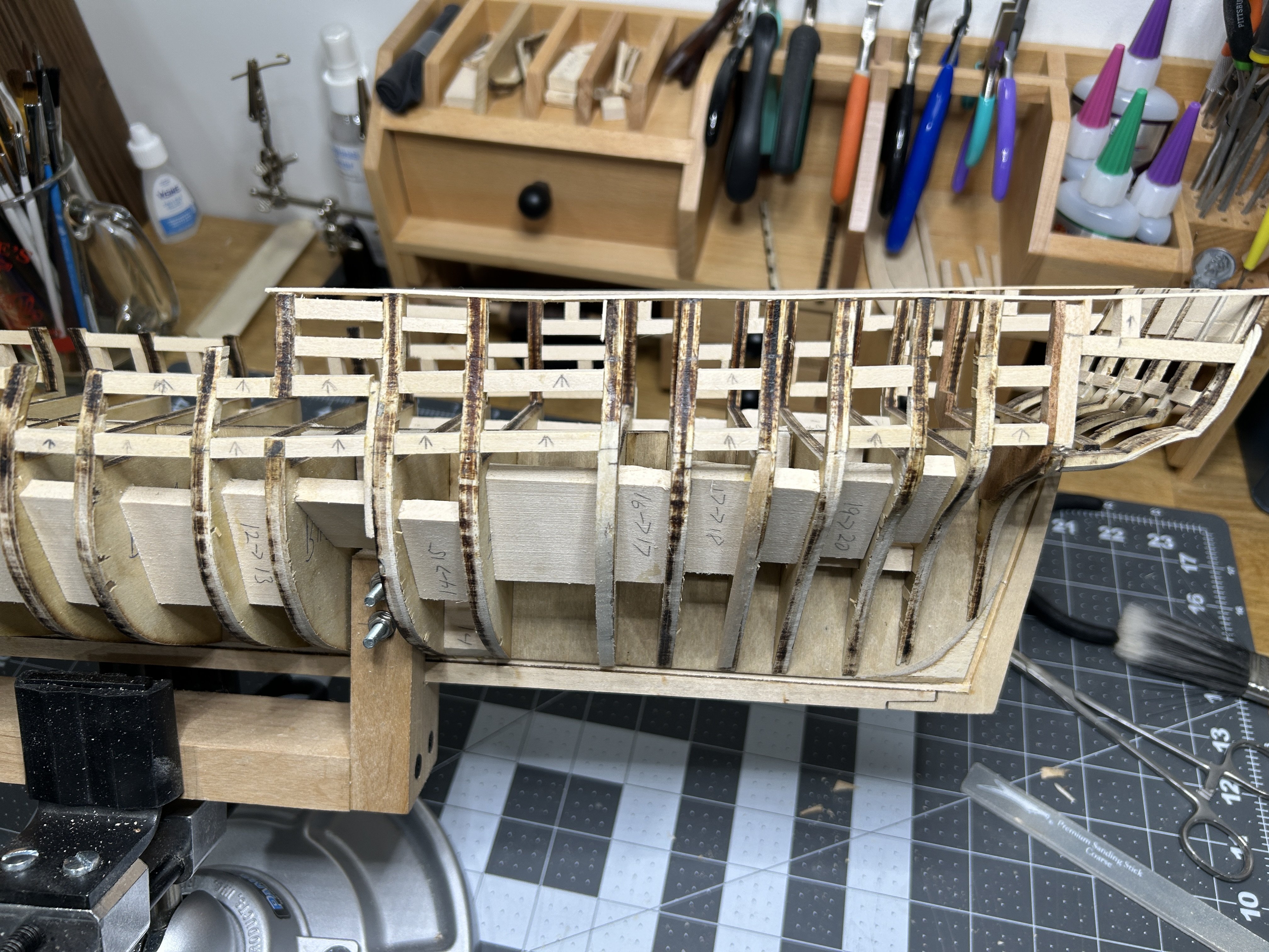

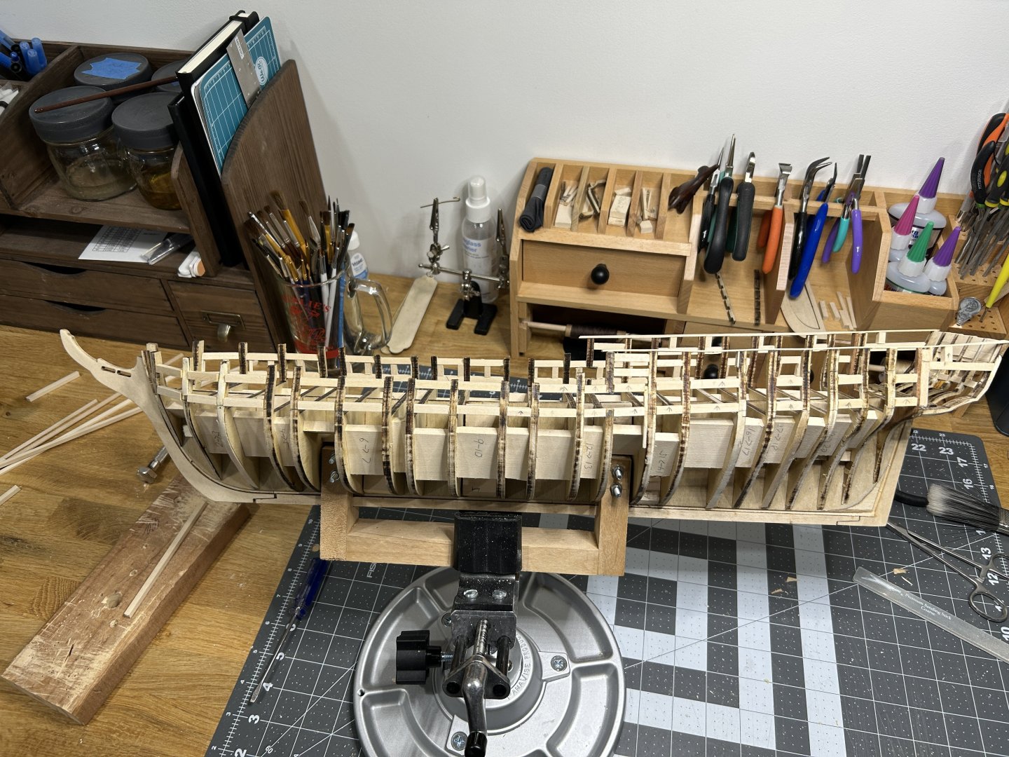

I have all of the braces between the bulkheads added as well as filler blocks for the masts and to accommodate pins if I decide to do a pedestal mount.  The braces and fillers are from a sheet of 1/4 basswood I picked up at Joann Fabrics at their going out of business sale.   With the braces and the large number of bulkheads on this model, I feel I will have a very sturdy framework for the ship.

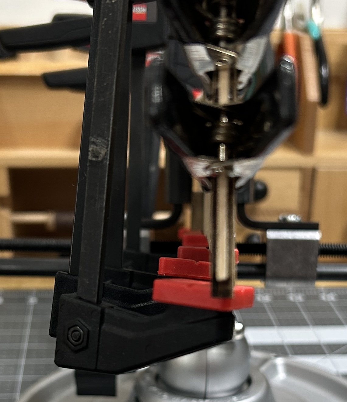

You will notice I purchased a swivel vise to hold the ship during this phase of construction.  I purchased the vise at Menards for about $85.  Menards had a few swivel vices to choose from.  I bought one that used a suction device to secure it to the work bench, but the suction didn't hold.  The rubber feet on this one grips the cutting mat very well and the base is heavy enough that even when I have the ship tilted it doesn't tip over.  The base has holes that can be used to attach to your bench if desired.  Being able to manipulate the ship as I added the braces made the work quite enjoyable.  This will come in handy as I frame the stern, frame the gun ports and add the upper planking.
I was quite nervous about clamping on the keel.  Even though I pinned it to the bulkhead former, I felt there would have been too much stress on the bulkheads former to rabbet strip to keel joints.  My solution was the build a wooden bracket out of the 1 x 2 wood that would attach directly to the front and back section of the bulkheads former and then clamp into the vise.  I cut a slot into the vertical sections of the bracket and used 4mm bolt to attach it to the bulkhead former.  This keeps any of the stress off the joints between the bulkhead former, rabbet strip and the keel.  It also allows me to avoid clamping on the joint between the two pieces of the bulkheads former.
Next up is the fairing the bulkheads.  I expect to go slow.  If I get a little done every day for 2-3 weeks that will fine.  If I get bored or frustrated with fairing the hull, I will take a break and work on the ship's boat that I have started.

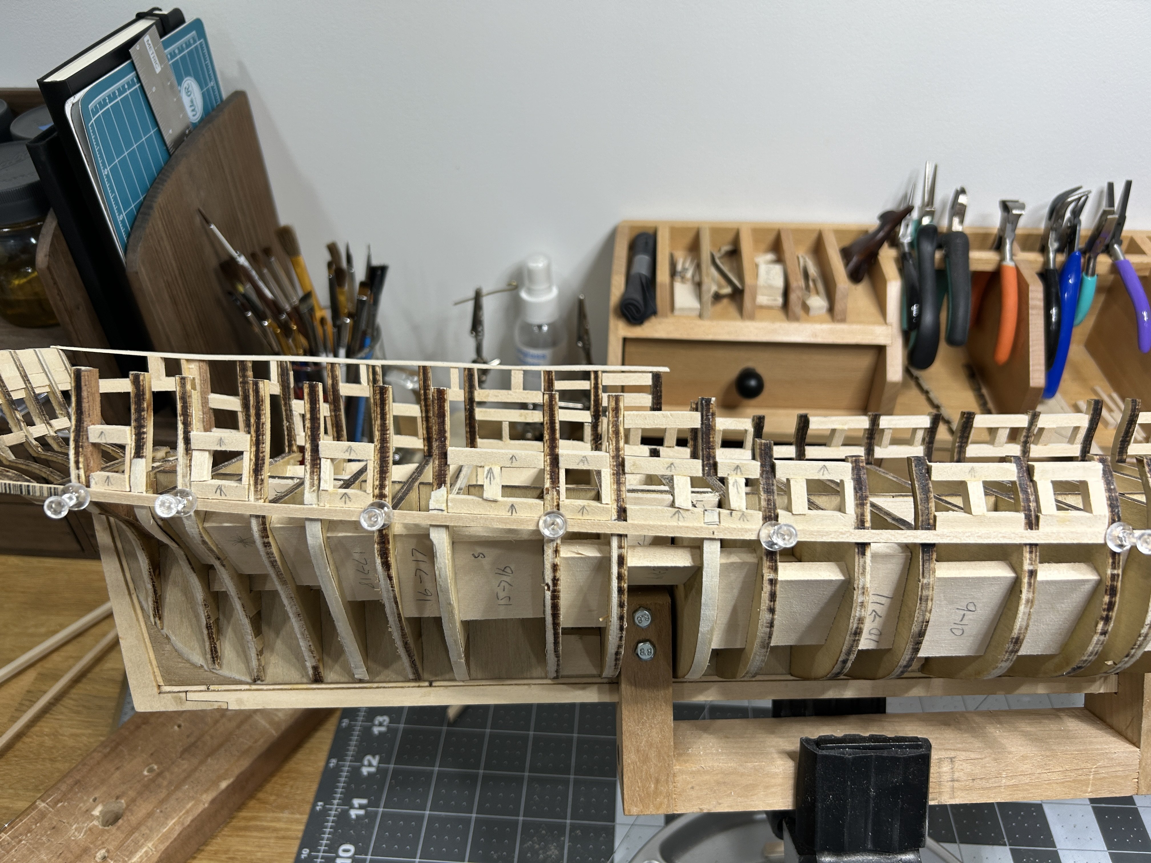

I have the bulkheads faired and have started to add the stern framing.  I am very nervous about how fragile the stern framing will be until the the upper planking is complete.  I have added the two innermost stern frames.
While I was fairing the bulkheads I also did some more work on the boat.  I added the floor, the  bench and the thwarts.  I still need to add the caprail and the rudder

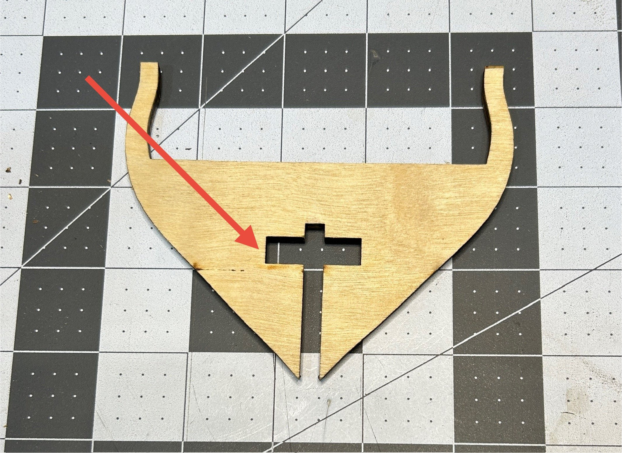

I have been working on the stern and as I was afraid of, the fragile nature of the stern framing are causing some difficulties.  The frame pieces are cut from the same plywood as the bulkheads and the bulkhead former.  I am not sure if it the quality of the plywood or the damage caused by the laser cutting process, but on some of the frames it seams as if the middle layer of wood is damaged, or maybe the heat from the laser damaged the glue.   Either way it is really hard not to break these parts as they are being sanded and shaped.  I have a similar issue with the the two aftmost bulkheads.
I followed the instructions and used the provided template for shaping the stern after the window openings were framed.  After re-gluing some of the stern frames that were de-laminating and fixing one that broke, I eventually shaped the stern to match the template
My first issue is the last bulkhead is quite a bit narrower that the stern, so the planking will need to curve inward then back out.  This seams odd, and the images in the instructions do not show that bulkhead that narrow.
I am considering shiming it to make it wider, but is is so fragile I am worried I will break them when I shape them.  Hopefully the gun port framing will add some strength.

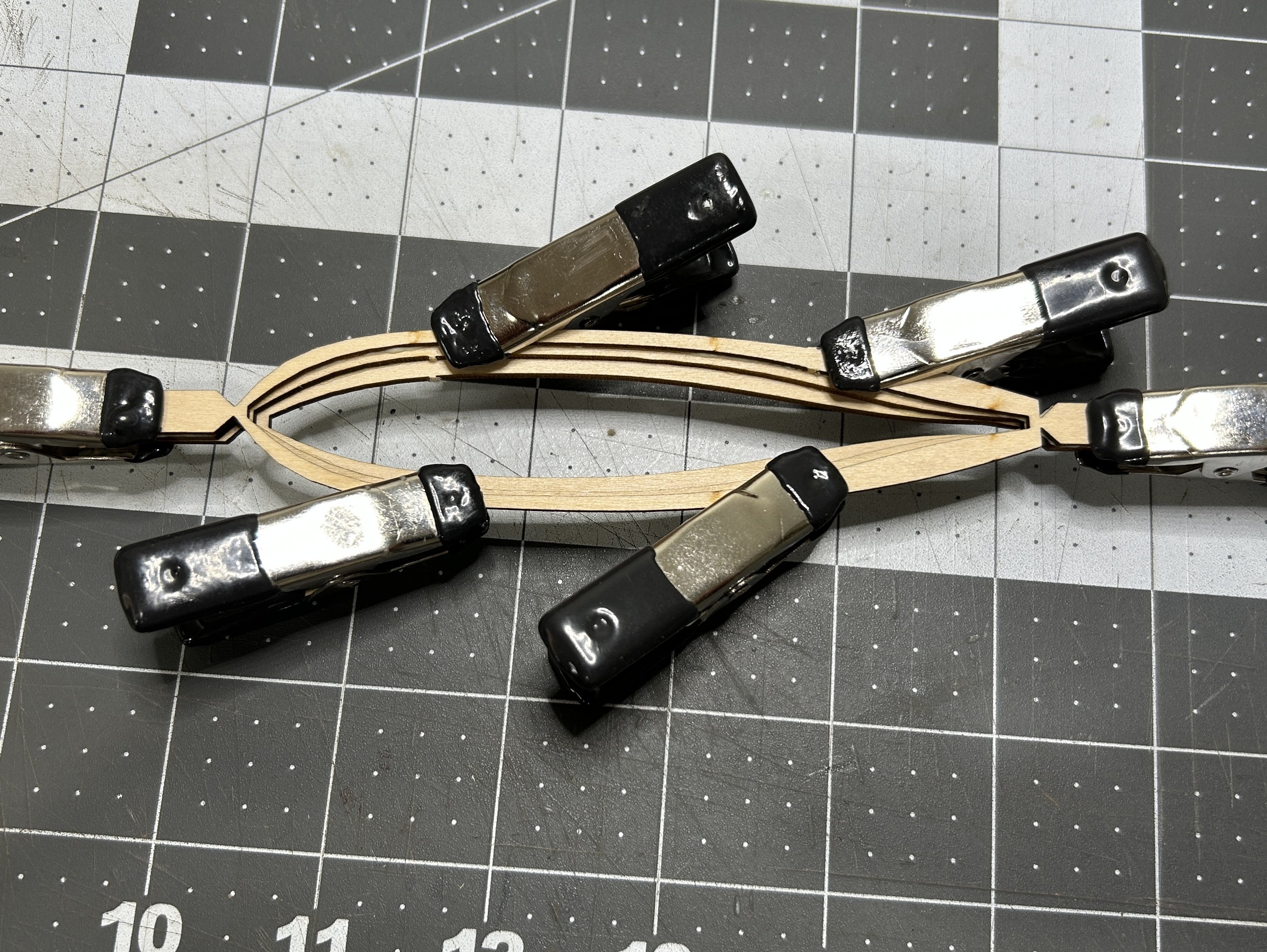

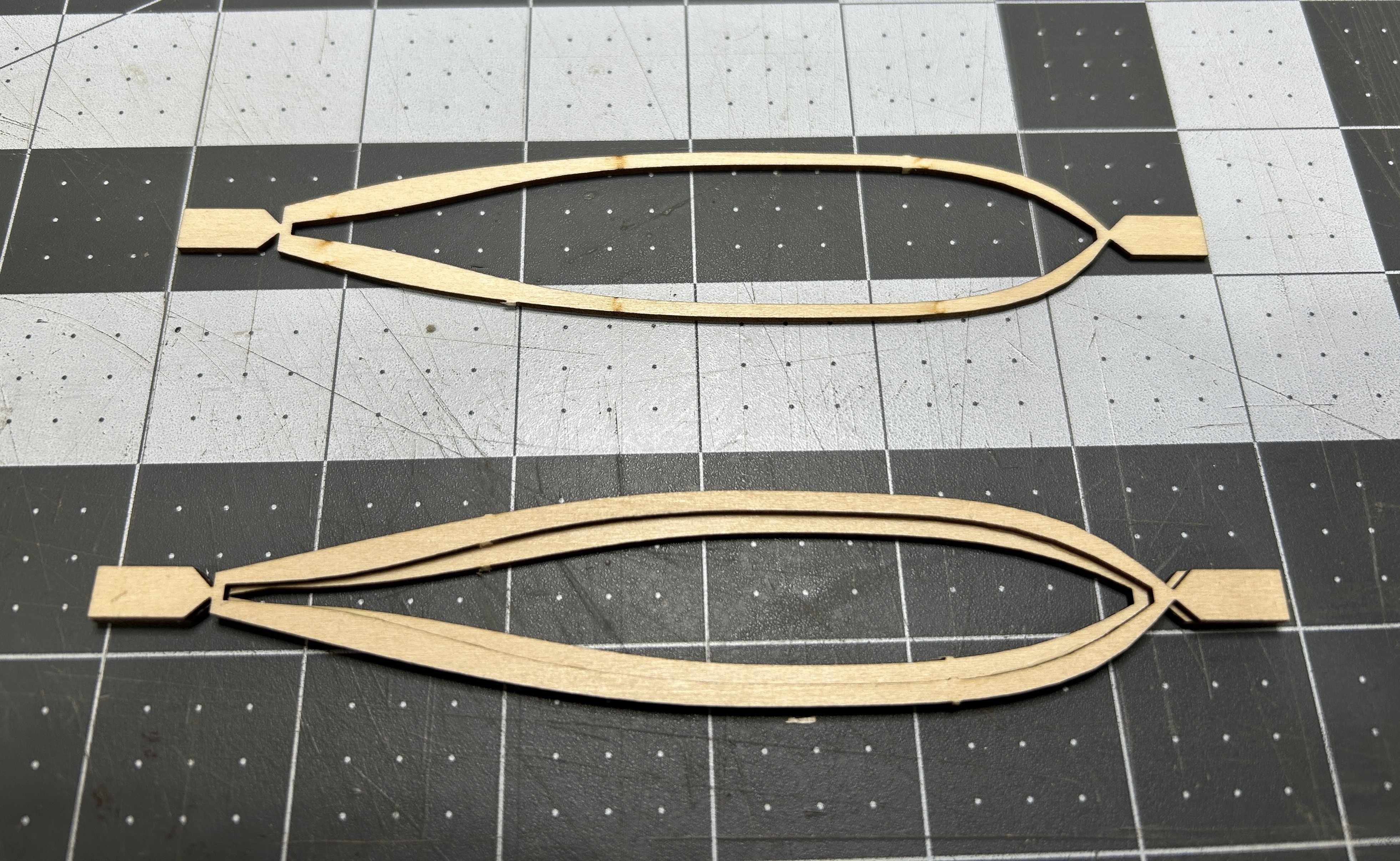

The second issue I have with the stern is this piece that frames the windows.
There is not a lot said about how this piece fits in the instructions.  However, the images clearly show the top of this part below the top of the stern framing, however the stern framing doesn't seem to be high enough.  I will be adding some additional material to make the stern taller to accommodate the window frame piece.
I have made some progress on the stern.  I have managed to repair and reattach the frame pieces that broke. I also figured out that the problem I was anticipating with the arched frame for the windows on the stern.  As I described in a previous post it appeared that the top of the arch would end up above the cap rail which would not be correct.  It turns out that I misunderstood where the the sills were to be placed on the stern.  I used alcohol to free the sills and then place them correctly.

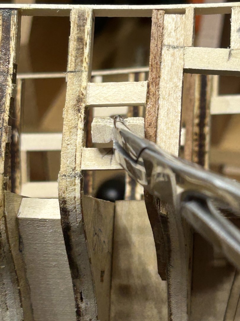

As I have mentioned, one of the challenges in framing these is that the are all rectangles.  The sills follow the upward curve of the deck and the sides are straight up and down leading a non-rectangular shape to most of the gun ports.  In order to get the size of the ports currect I did make a plug that represented the shape of any gun ports that happens to be a rectangle.
I them used a hemostat to hold the plug and used it to determine the proper height and width of the ports.

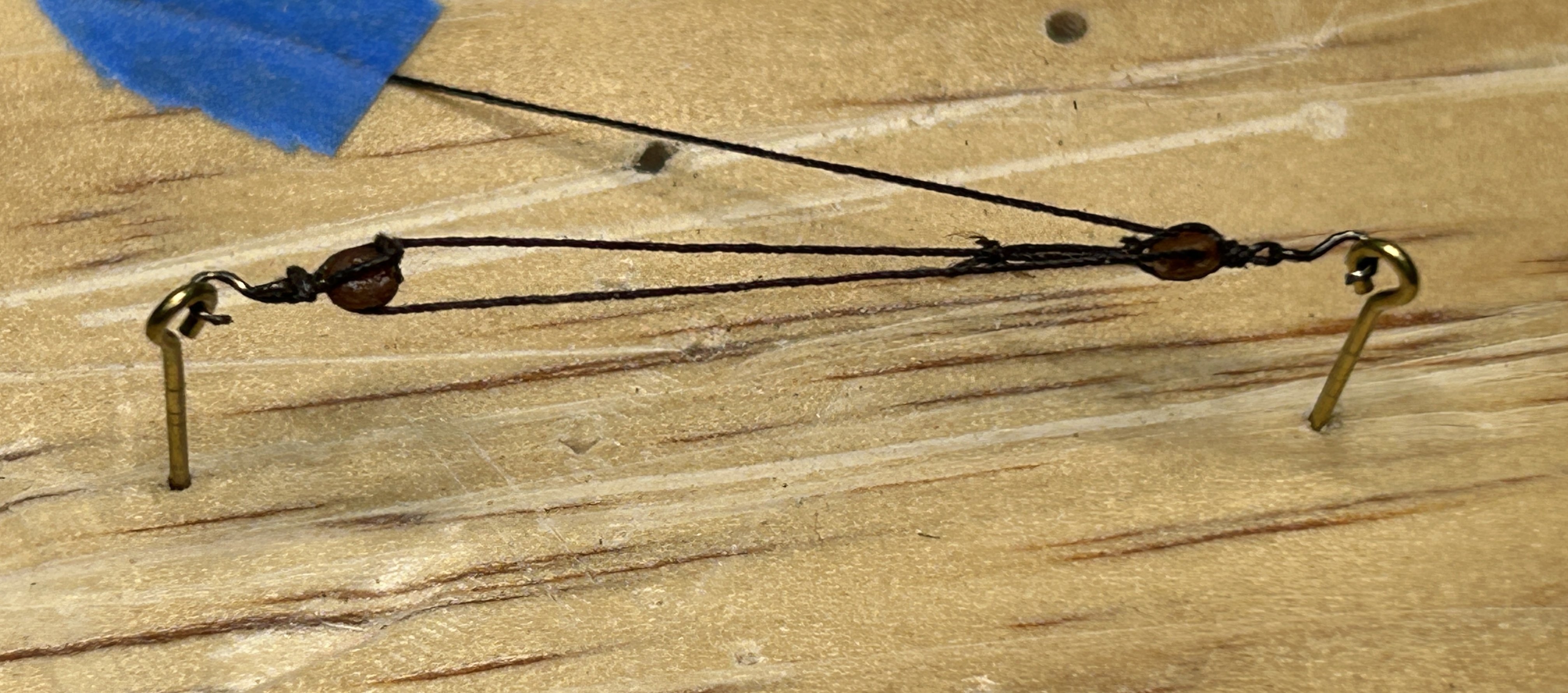

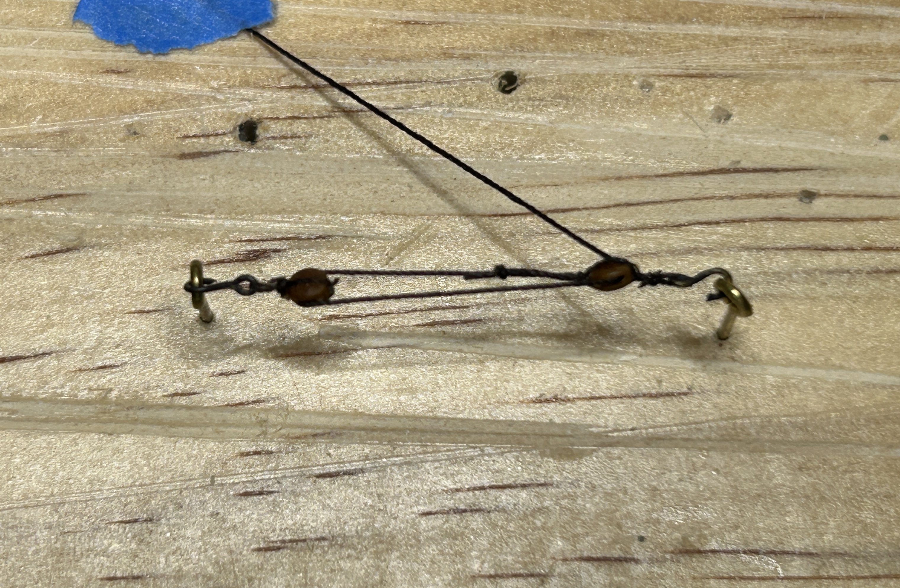

This is one of the first almost passable attempts I made.  The rope is .008 inch diameter.   I am struggling to get the rope through the holes on the blocks, so I have been drilling the holes out.  I am trying to use the techniques Chuck has shared using CA to help secure the block.  This attempt is a little shinier than I would like from the CA used.
I am using 150 weight Gutterman Mara thread for the sizing.  I was hoping to use some that was even thinner, but I am struggling to find any in the US.  Chuck shared a reseller in the UK that sells it, but I am a little nervous about navigating the tariff mess we  now all have to live with right now.
This is another attempt that I am a little happier with.
I made the hooks from small Brass eyepins.  They measure about 1/8 inch long.  I would like them to be a little smaller, but I don't think I can make them any smaller.
I have ordered some 1/8 inch blocks from Syren.  If the .008 inch rope with fit through the holes on those without being drilled out, and they don't look too big I might use them instead of the 3/32 to avoid having to do all the drilling.  I suspect in the end I will drill out the 3/32 inch blocks to keep things in the proper scale.
This is a bit of a coincidence, I just bought a couple of packs of those same 3/32 blocks from Syren this week for my carronades.
I'm glad to see they are workable, if not easy to work with at that size.
I'm impressed with the 1/8" hooks you made. I was planning on using the plastic rigging hooks available from Syren, the smallest of which is also 1/8" but now I might take a shot at making my own. Regardless of the hooks the whole tiny block adventure will undoubtedly lead to some pretty bad language. Can't wait.
