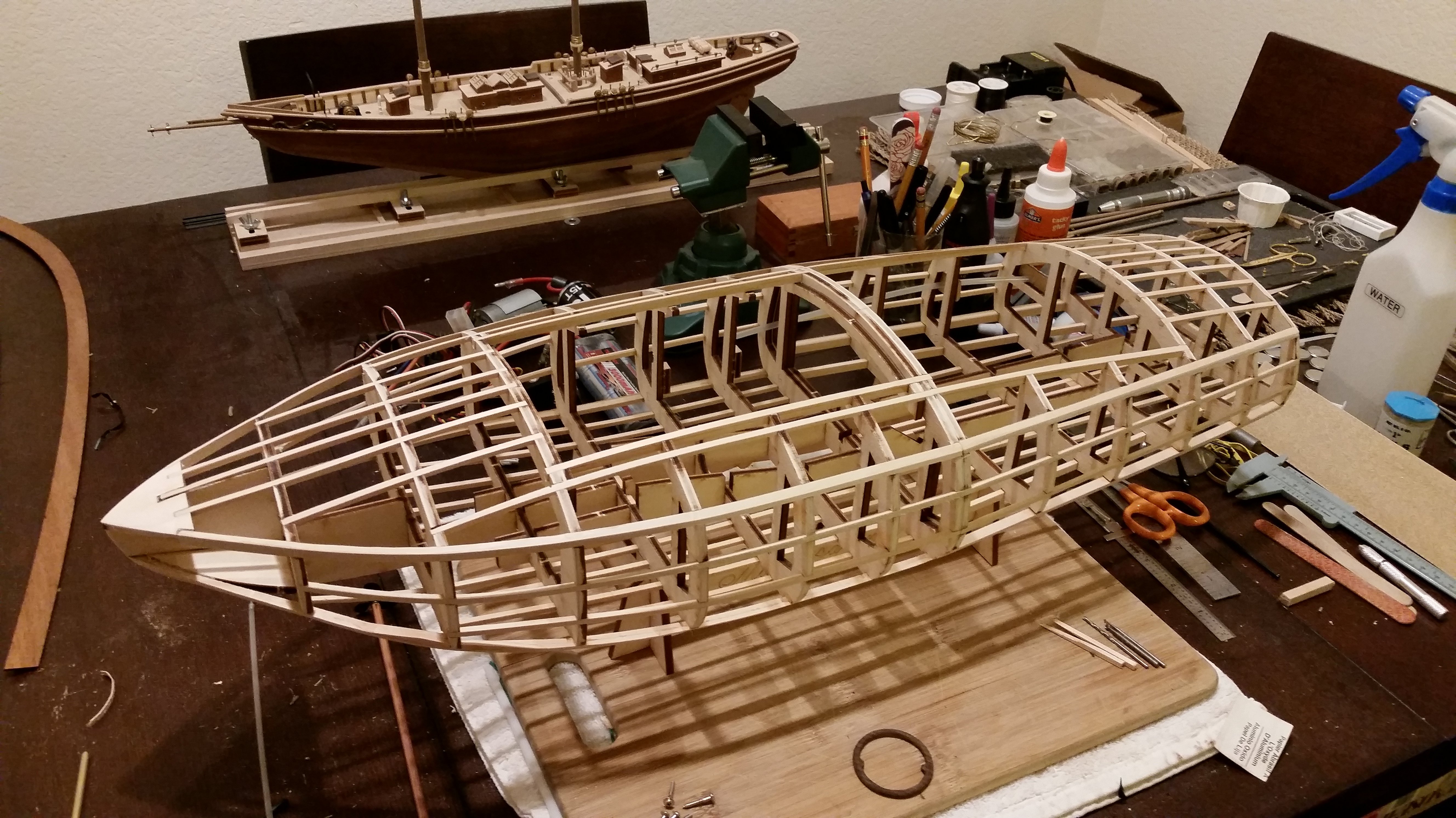

5-9-2016

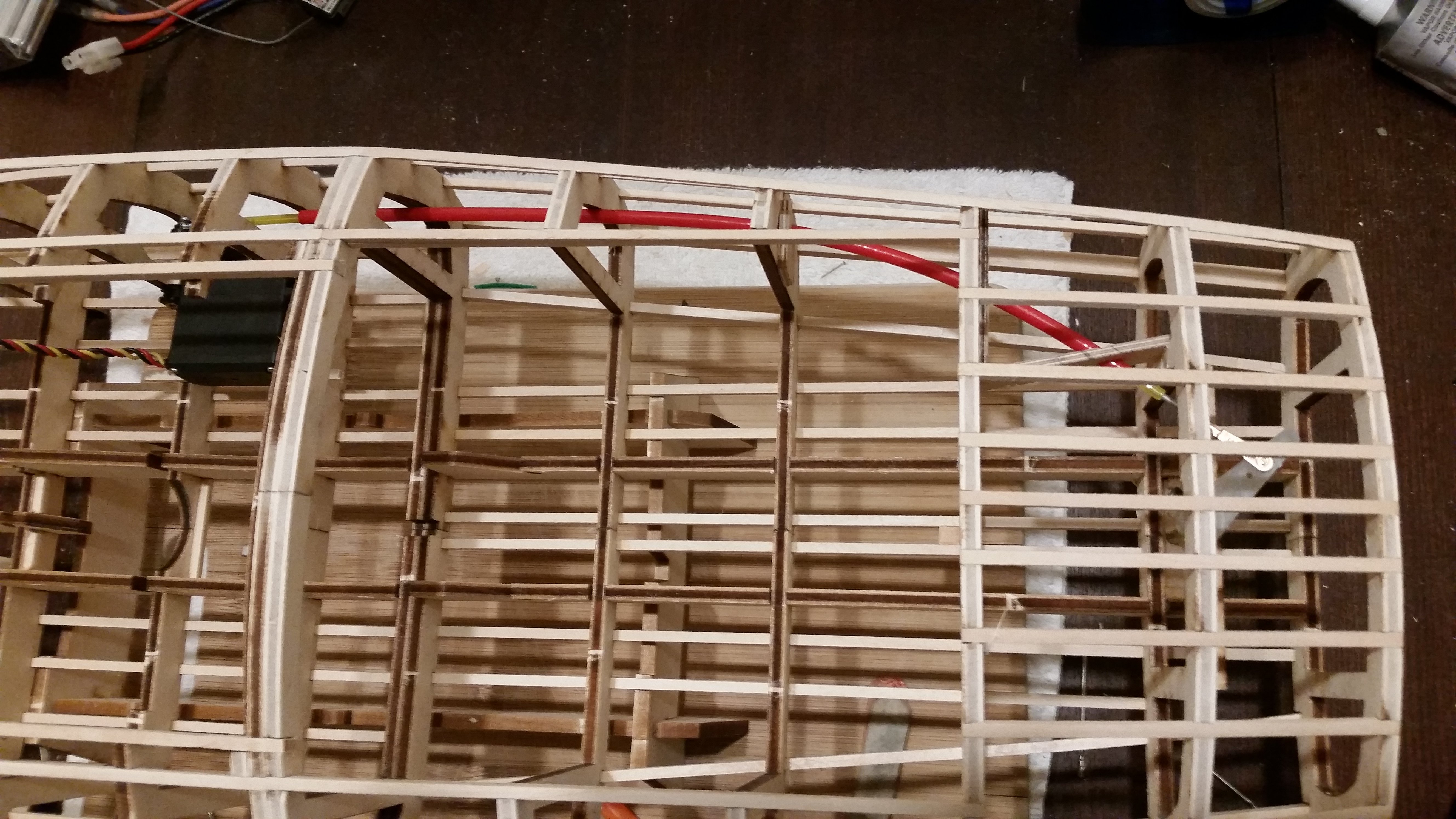

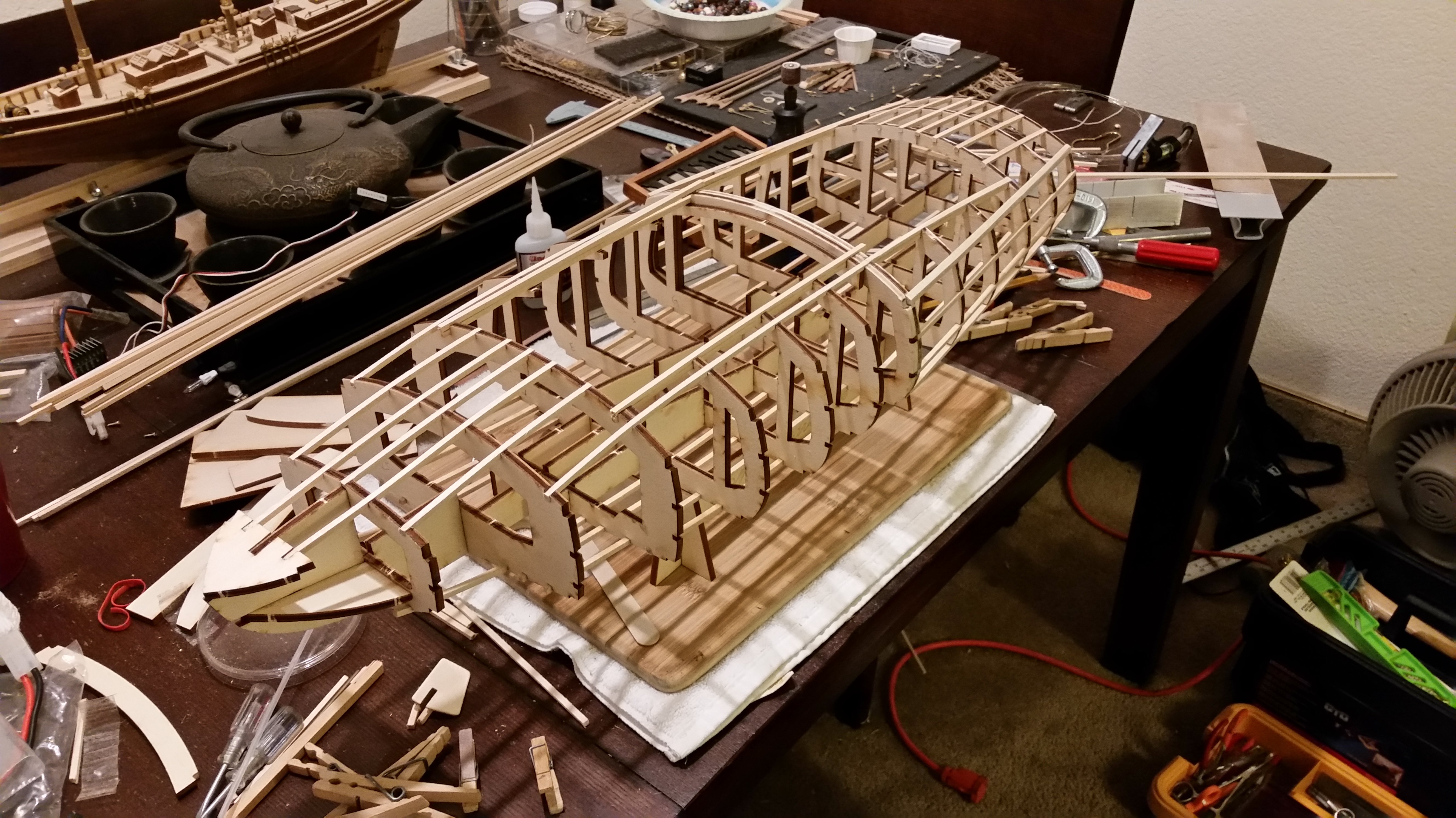

Frame-up mostly done. It's a good idea to bend the stringers before you glue them on as not to create tension that can warp the frame

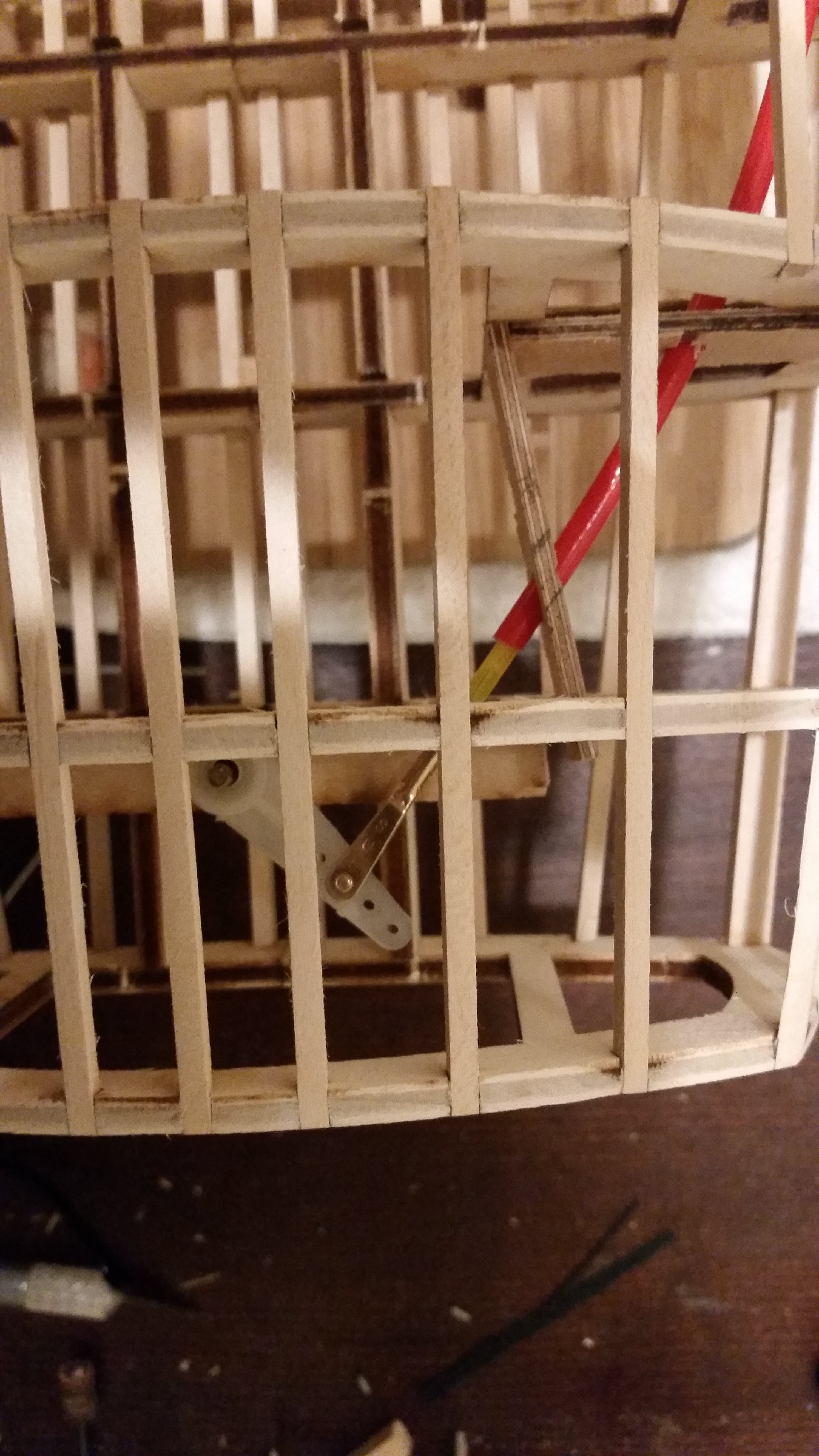

I figure now is the time to install the pushrod for the rudder since I wont be able to do it easily later. I decided to upgrade to a slop-free Sullivan Gold-n-Rod. I used a nylon armature from my box of old parts.

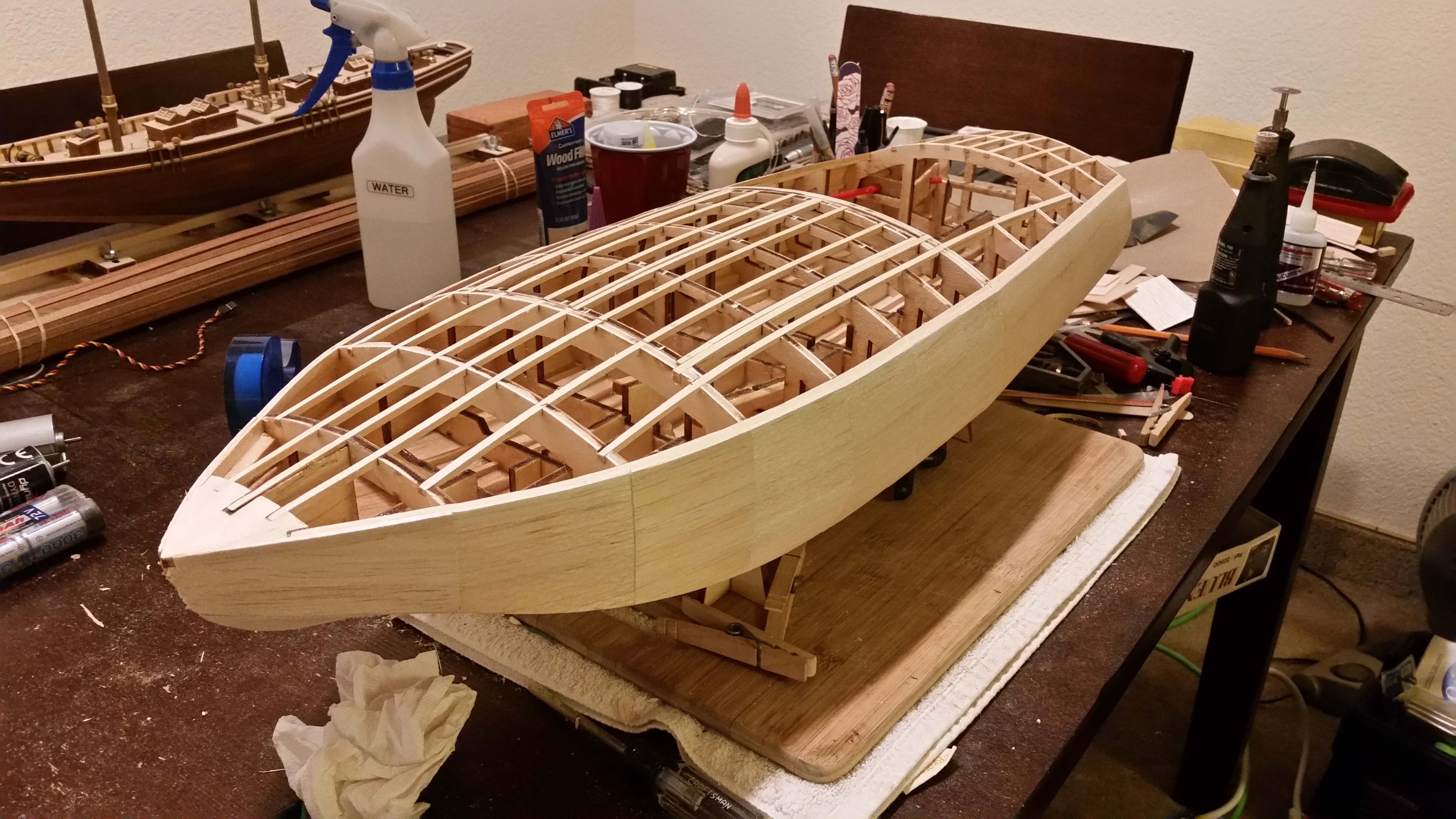

5-2016

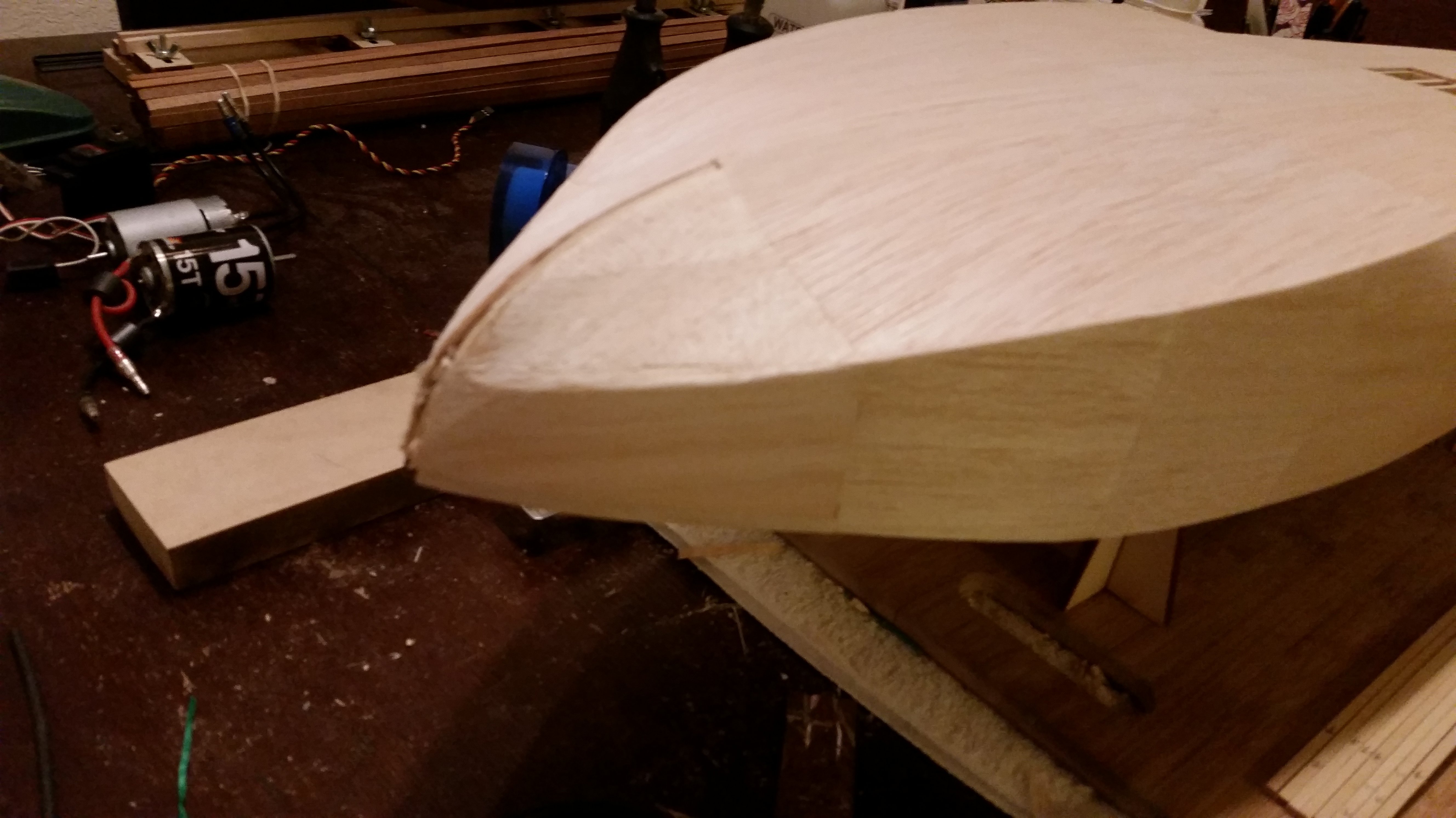

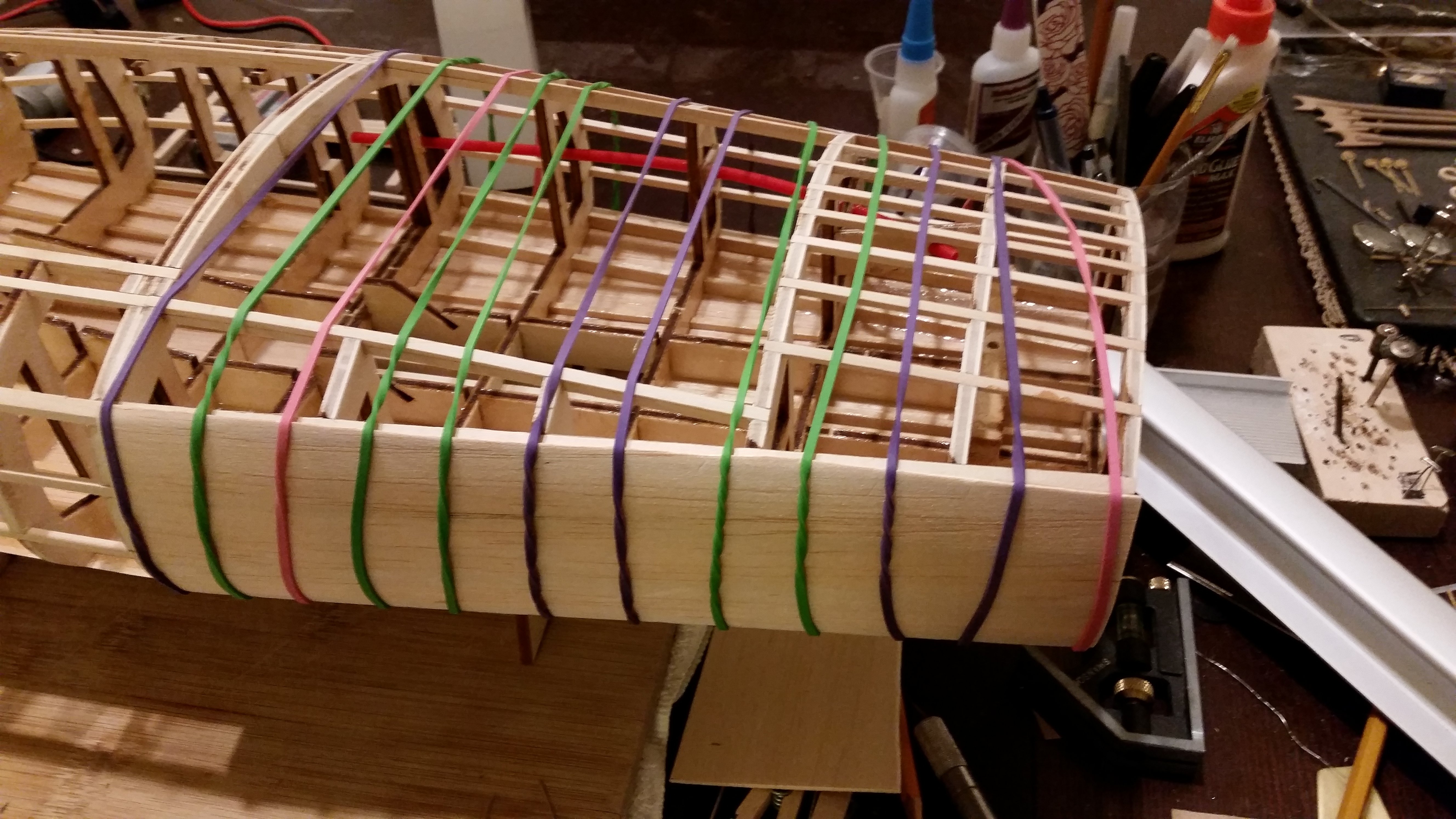

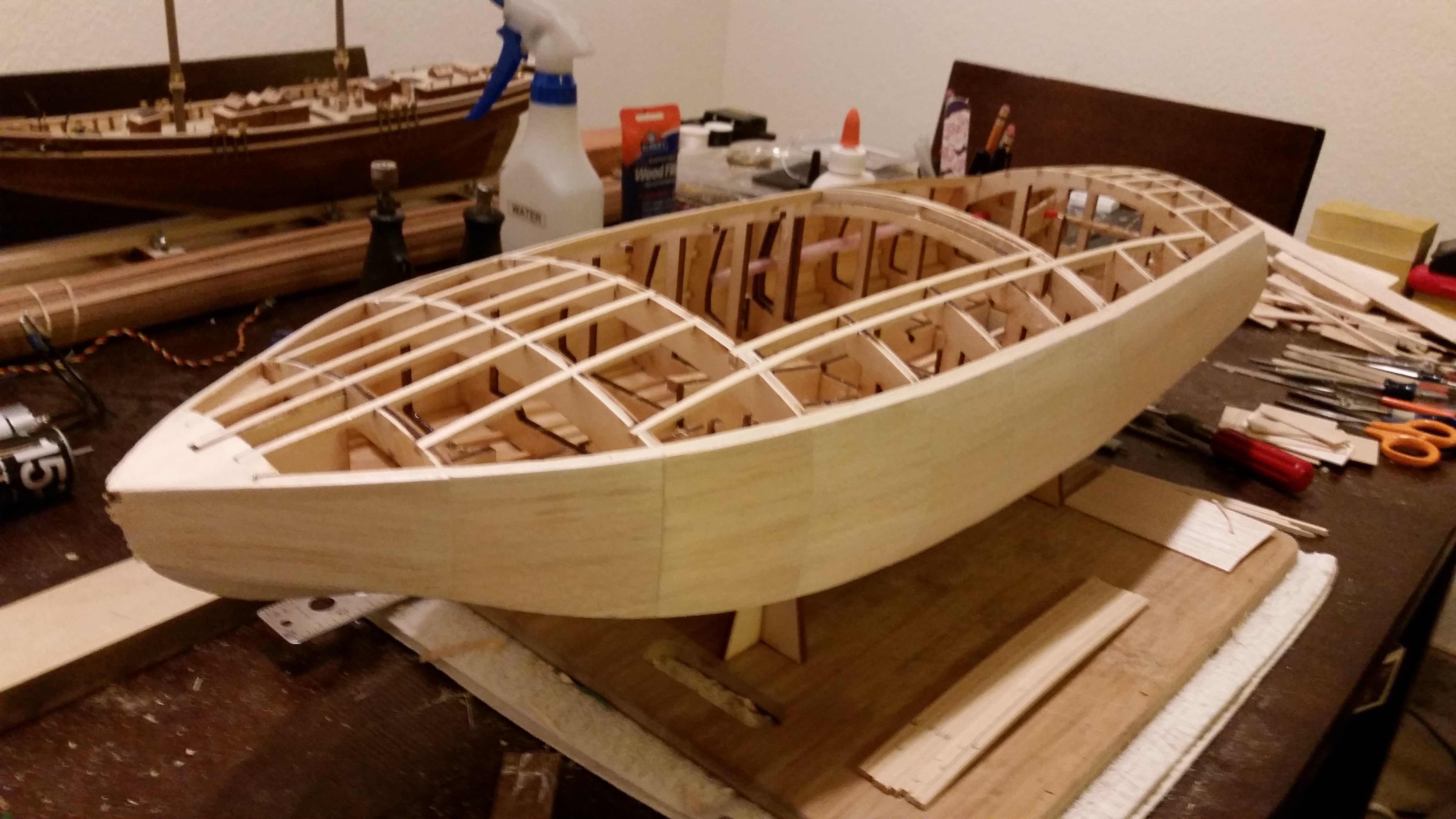

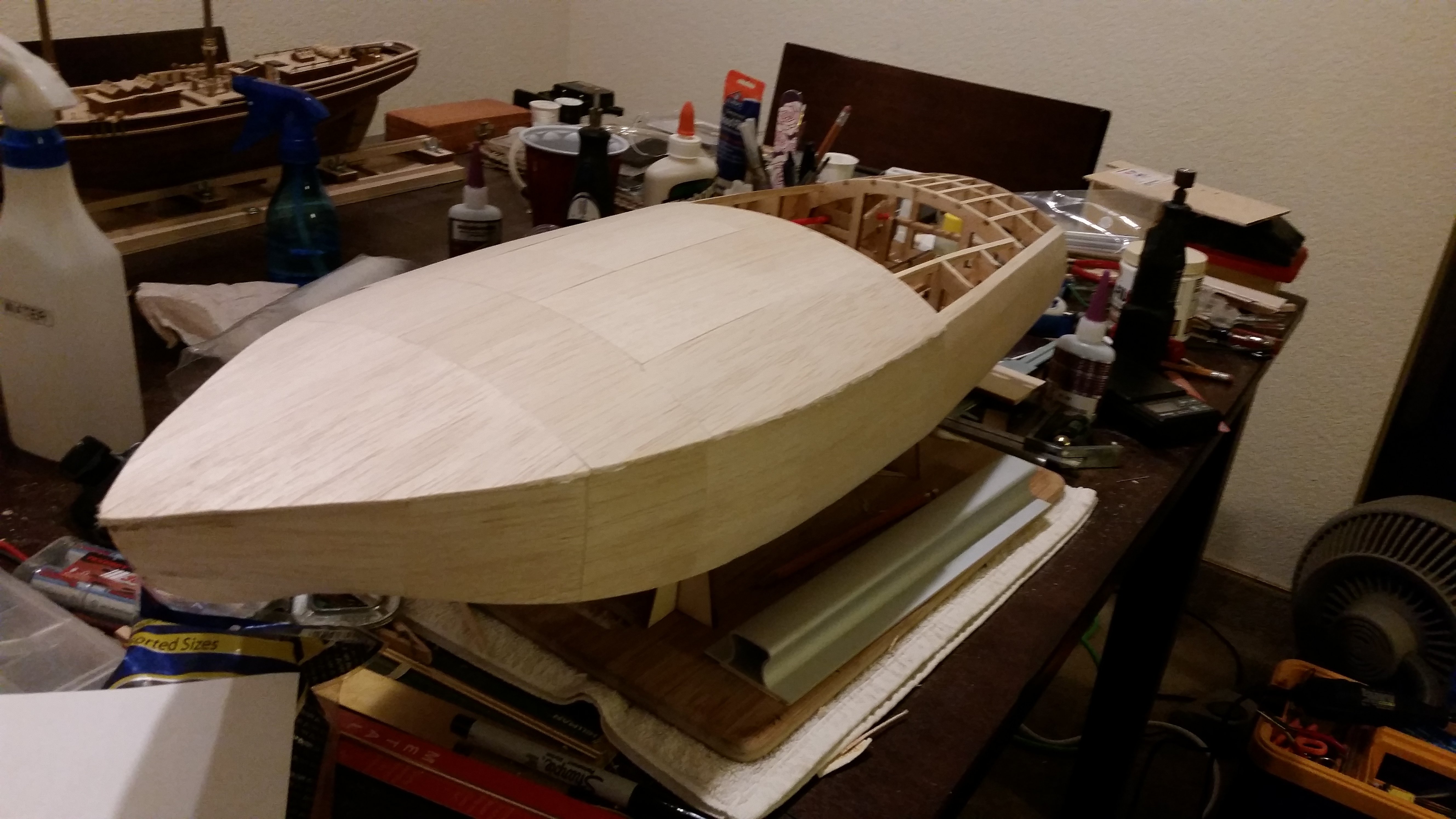

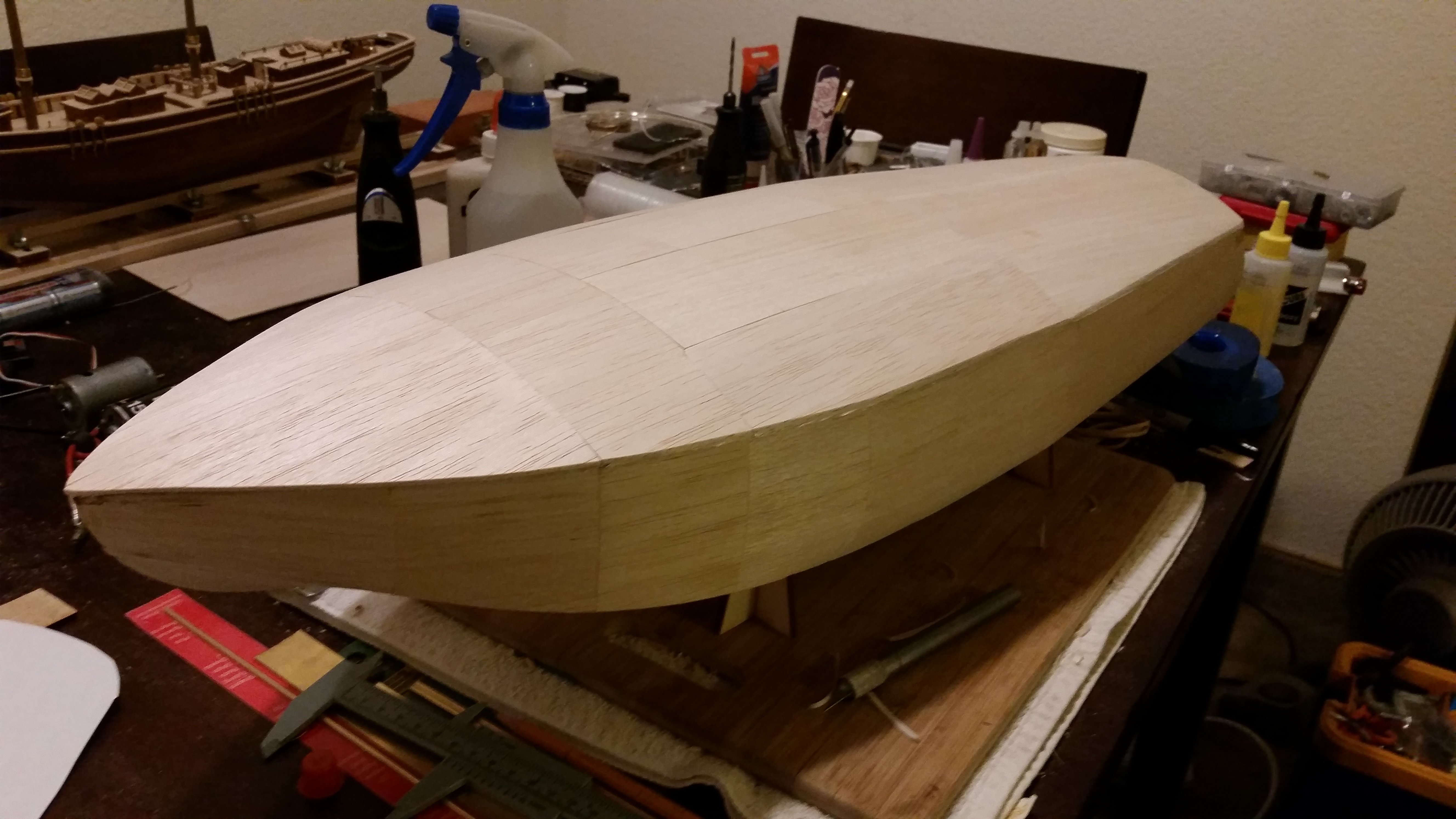

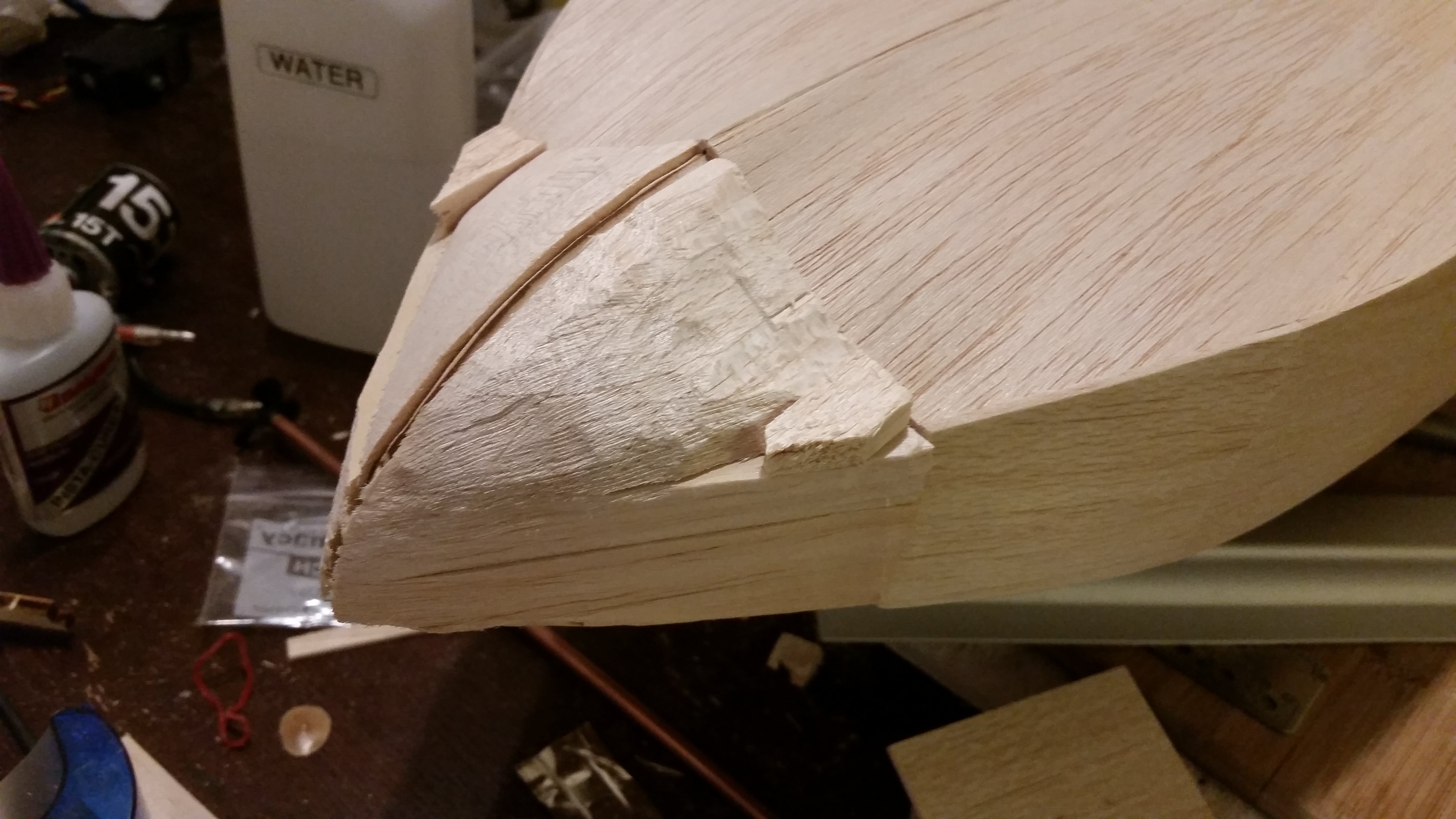

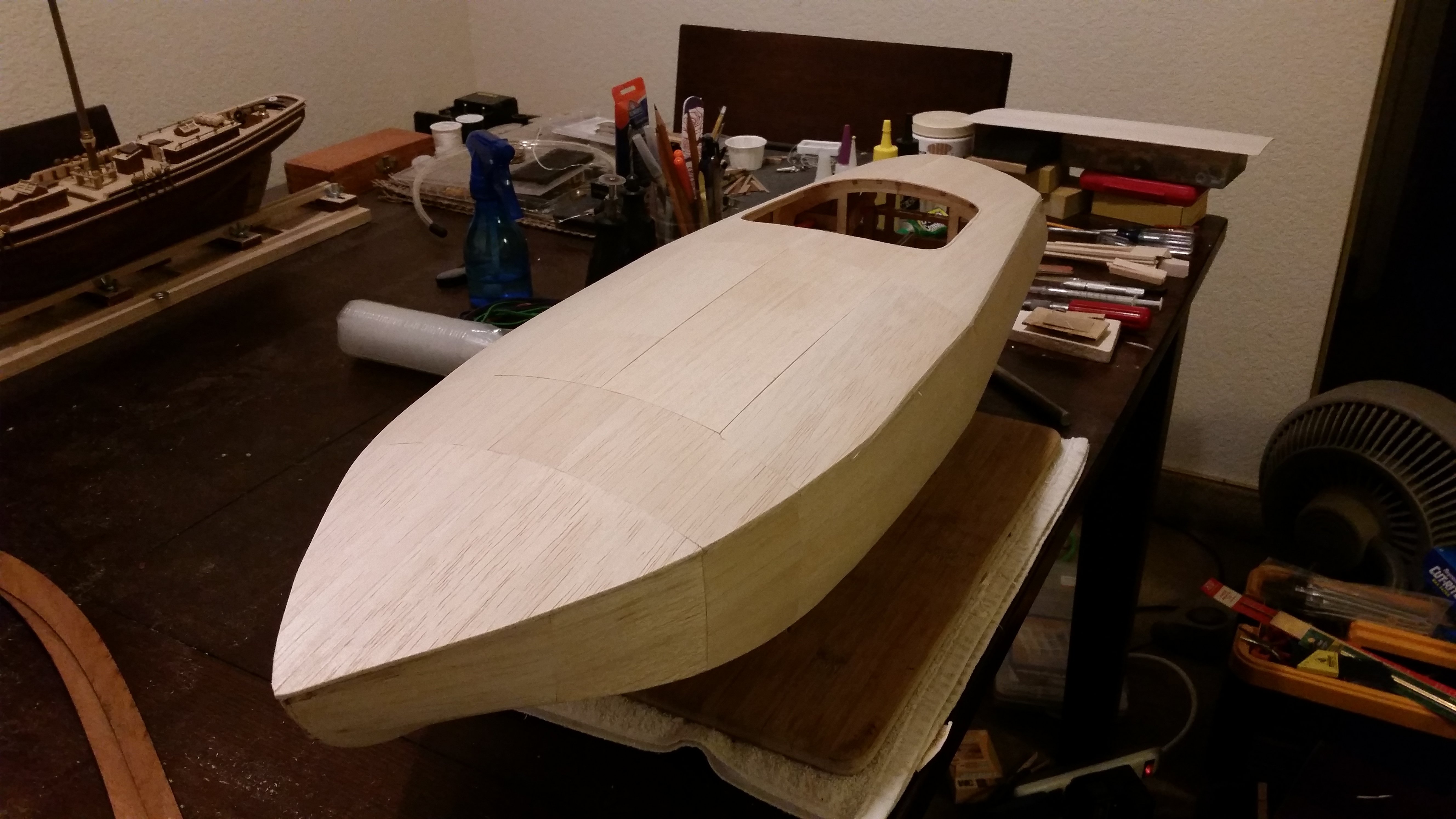

The thought of trying to make a decent planking job by just gluing to stringers and frames gave me a lot of anxiety so I decided, like many others who have built this kit, to sheet the whole thing in balsa so I have an even surface to plank to. Since the bow is such a compound surface I ended up using balsa blocks carved to shape. I sheeted the bottom and sides first because I plan on epoxying the inside of the boat.
5-28-2016

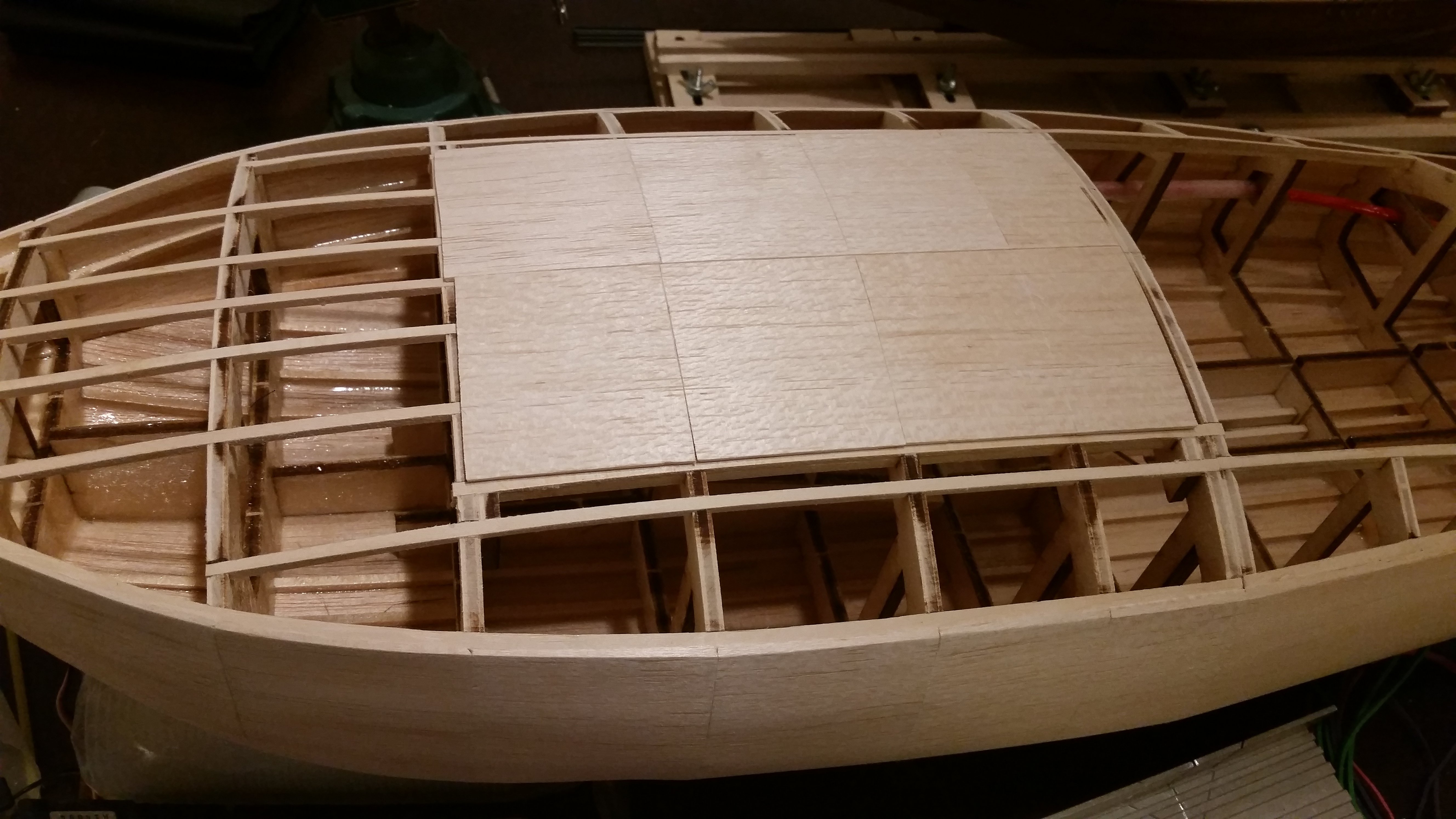

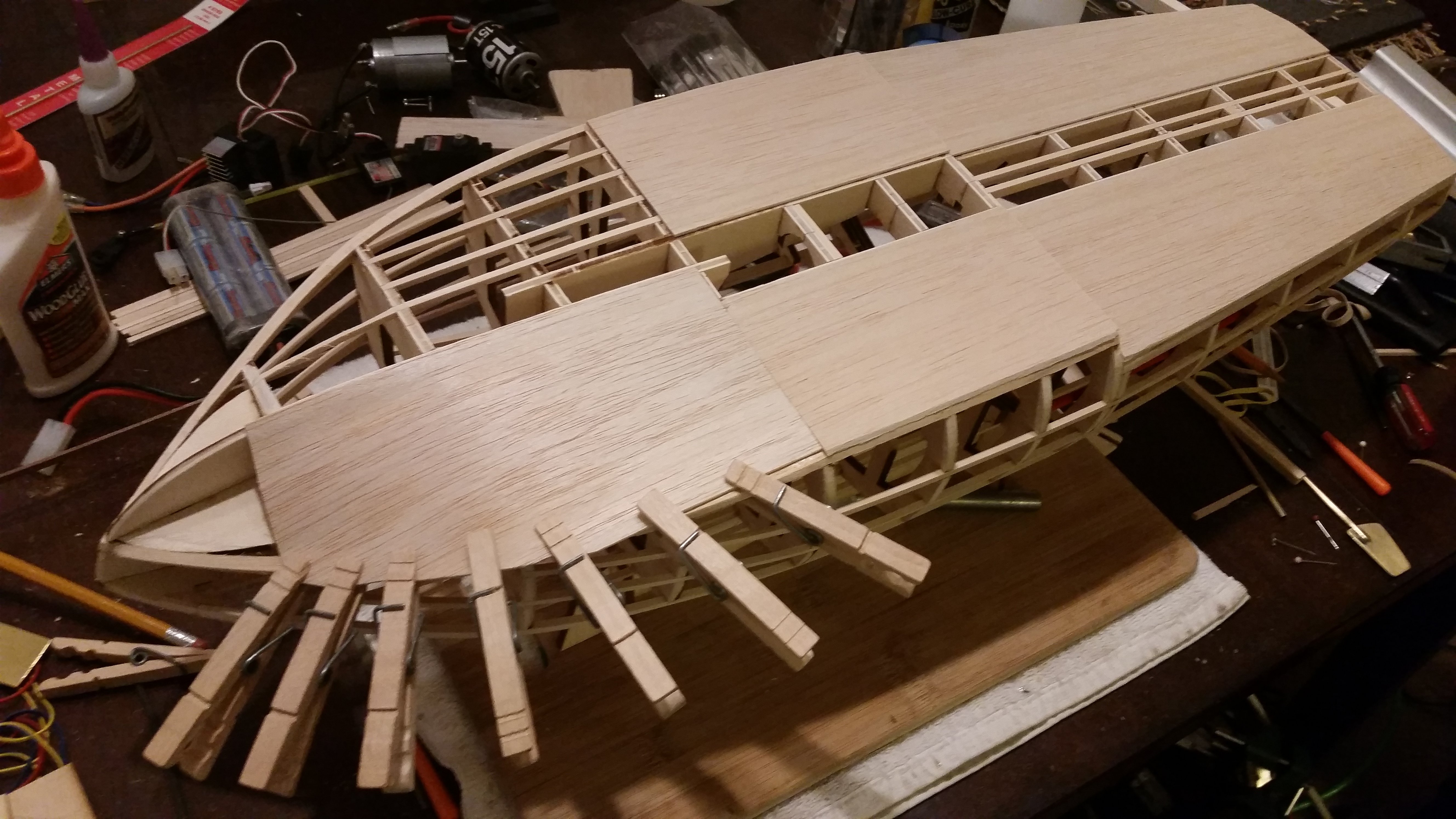

I used a great amount of care in building the hatch covers. There is compound bends in them both and I made sure to have them done right. I sheeted each one in four pieces of balsa so the profile wouldn't be affected. The back part of the deck was sheeted all at once, then the cockpit was cut out of it.
After epoxying the interior, it sat in this state for a few years. I just kinda lost interest for a while. Planking seemed like such a daunting task.

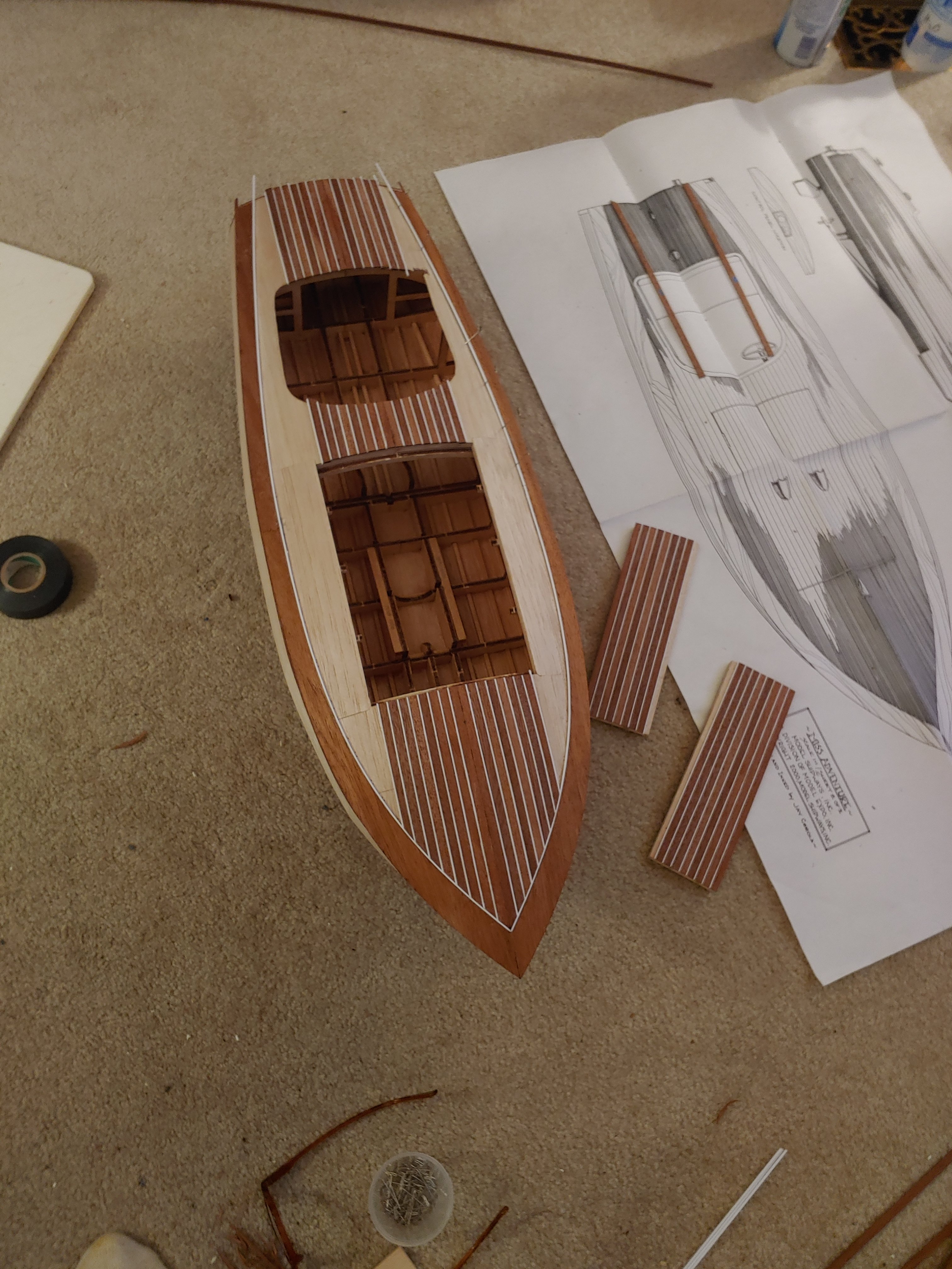

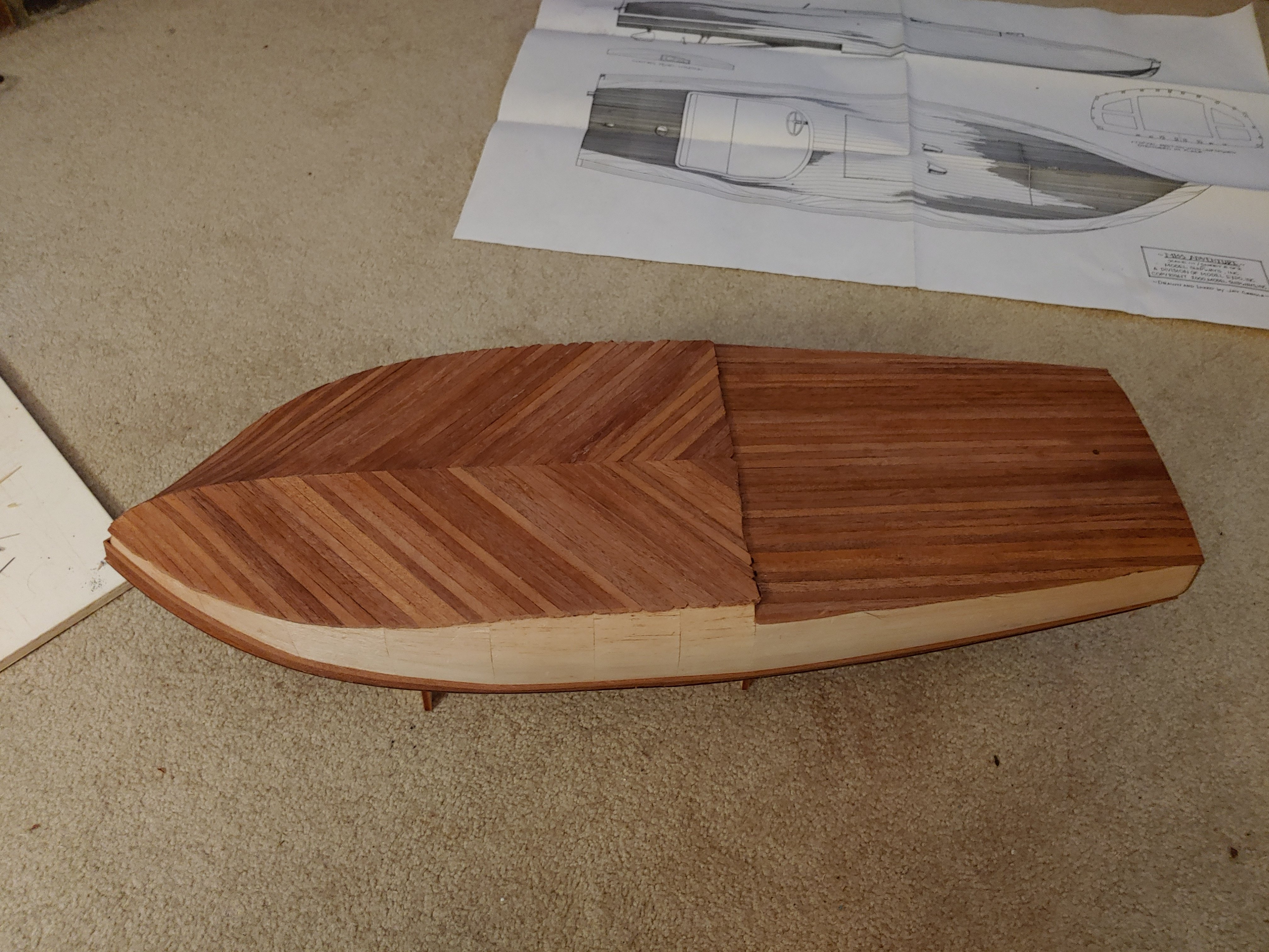

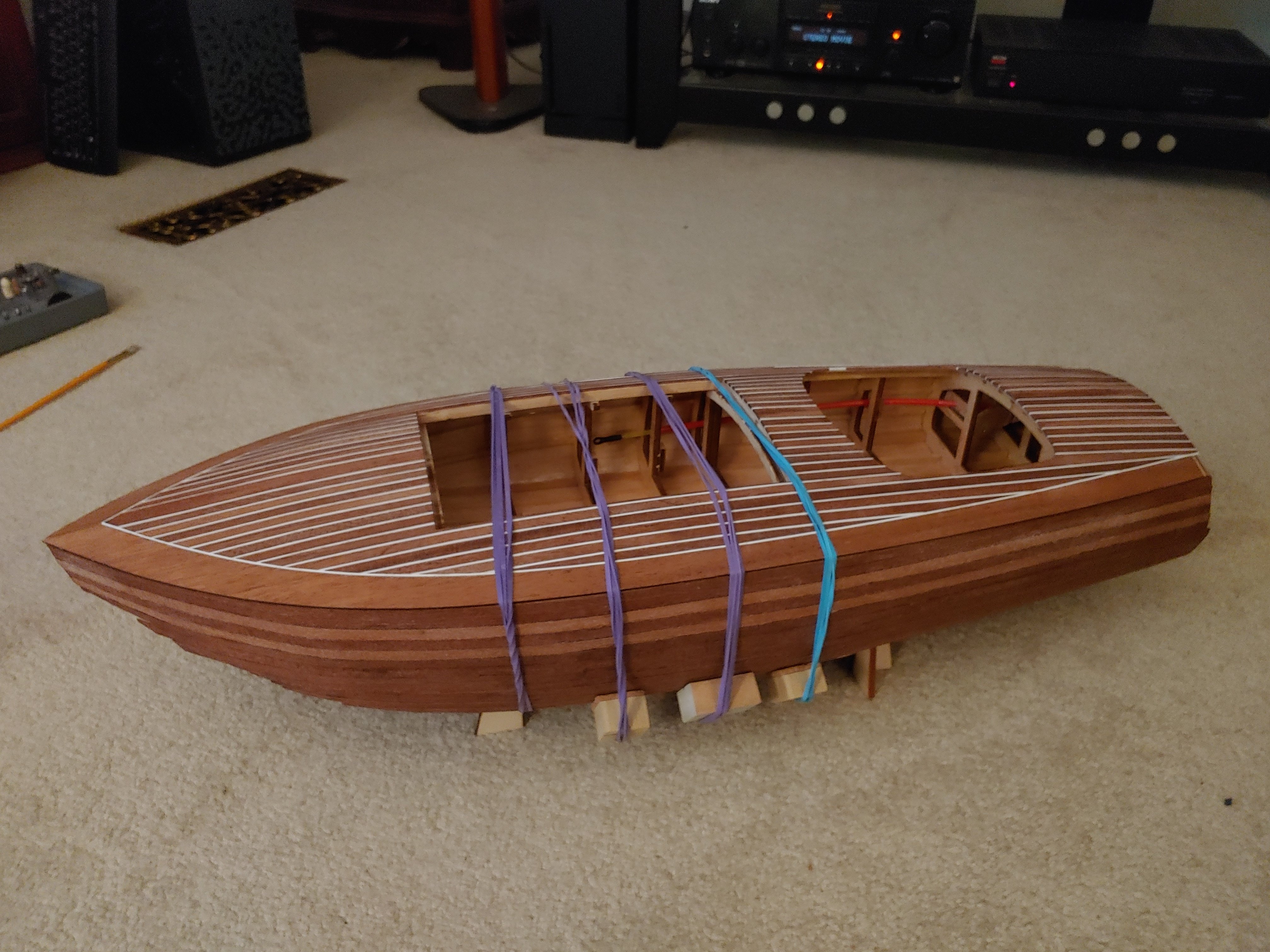

Back at it! One thing that bothered me about this kit is that earlier versions of it came with mahogany planks long enough to plank the sides with one contiuous piece, where as later versions (like the one I am building) had shorter planks requiring you to butt some together to make the length. I ended up ordering the proper length planks from MACK products as well as some cockpit coming that was more true to scale than the one that came with the kit. Another departure from the kit is that used styrene strips to simulate caulk lines on the top deck. I felt like the finished model looked too much like a mahogany torpedo so I use the caulk lines to add some character. A word about the margin planks that came with the kit...they suck. They are not solid mahogany but very thin mahogany plywood which is very easy to sand through. I decided not to even touch them and left a little overhang from the deck to the sides. I also was careful to use the same plank all the way down the deck for consistancy.

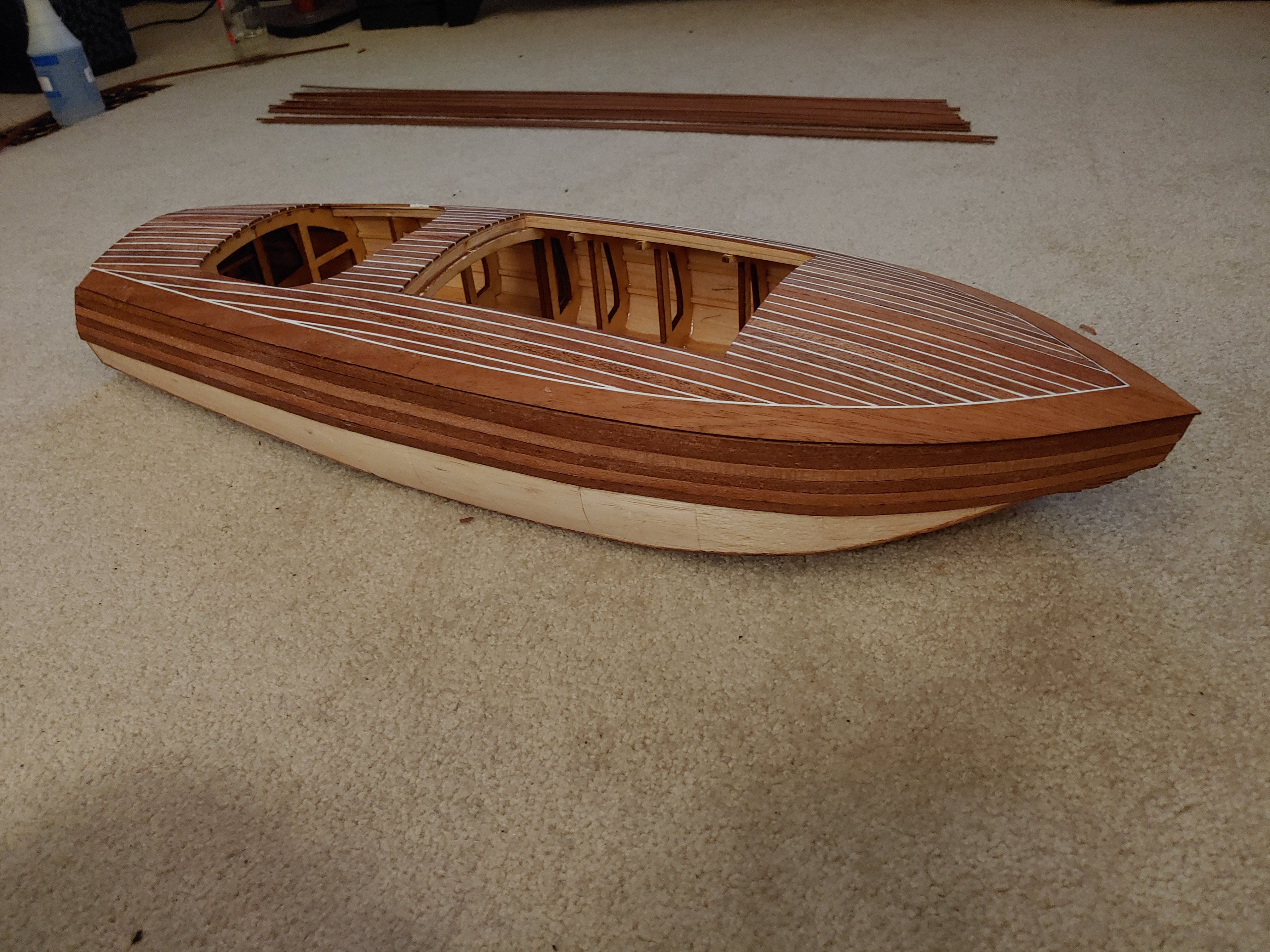

2-19-2022

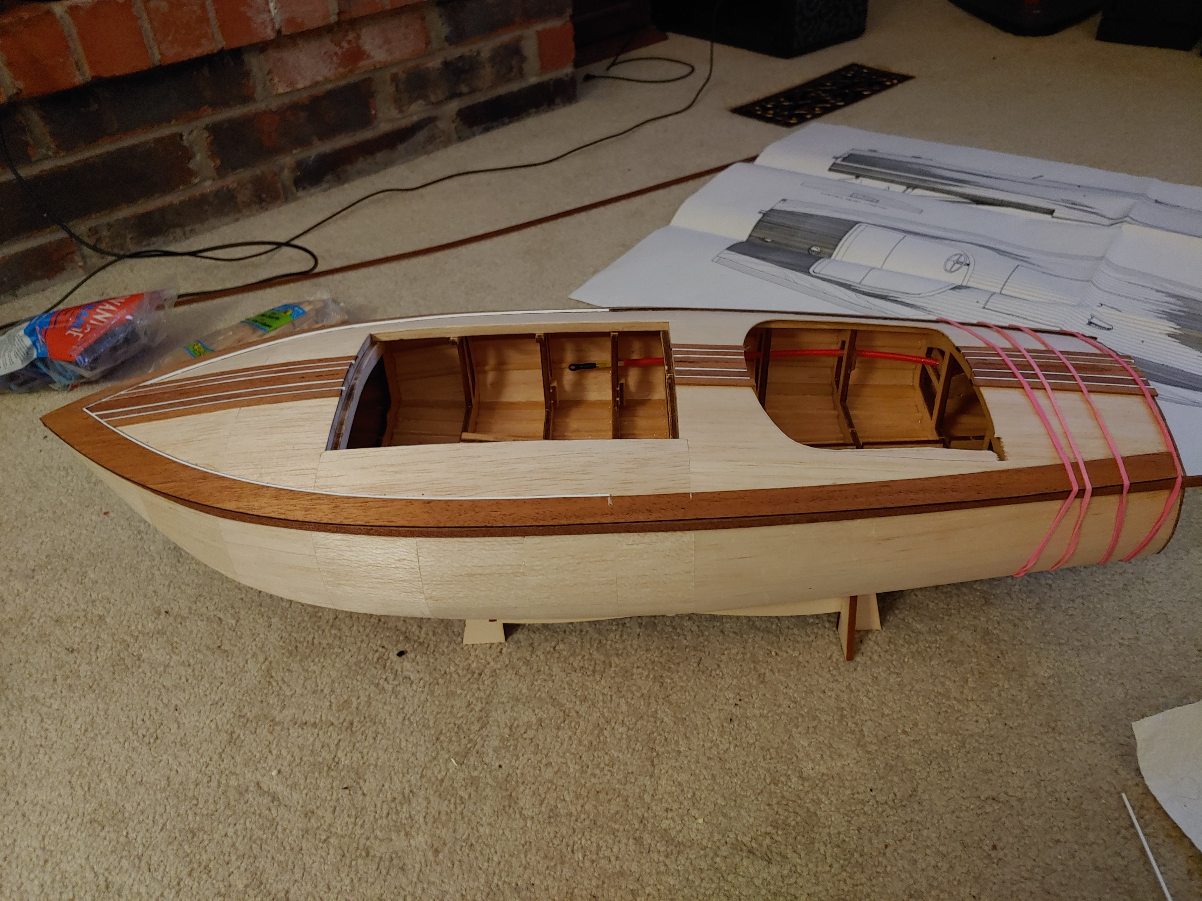

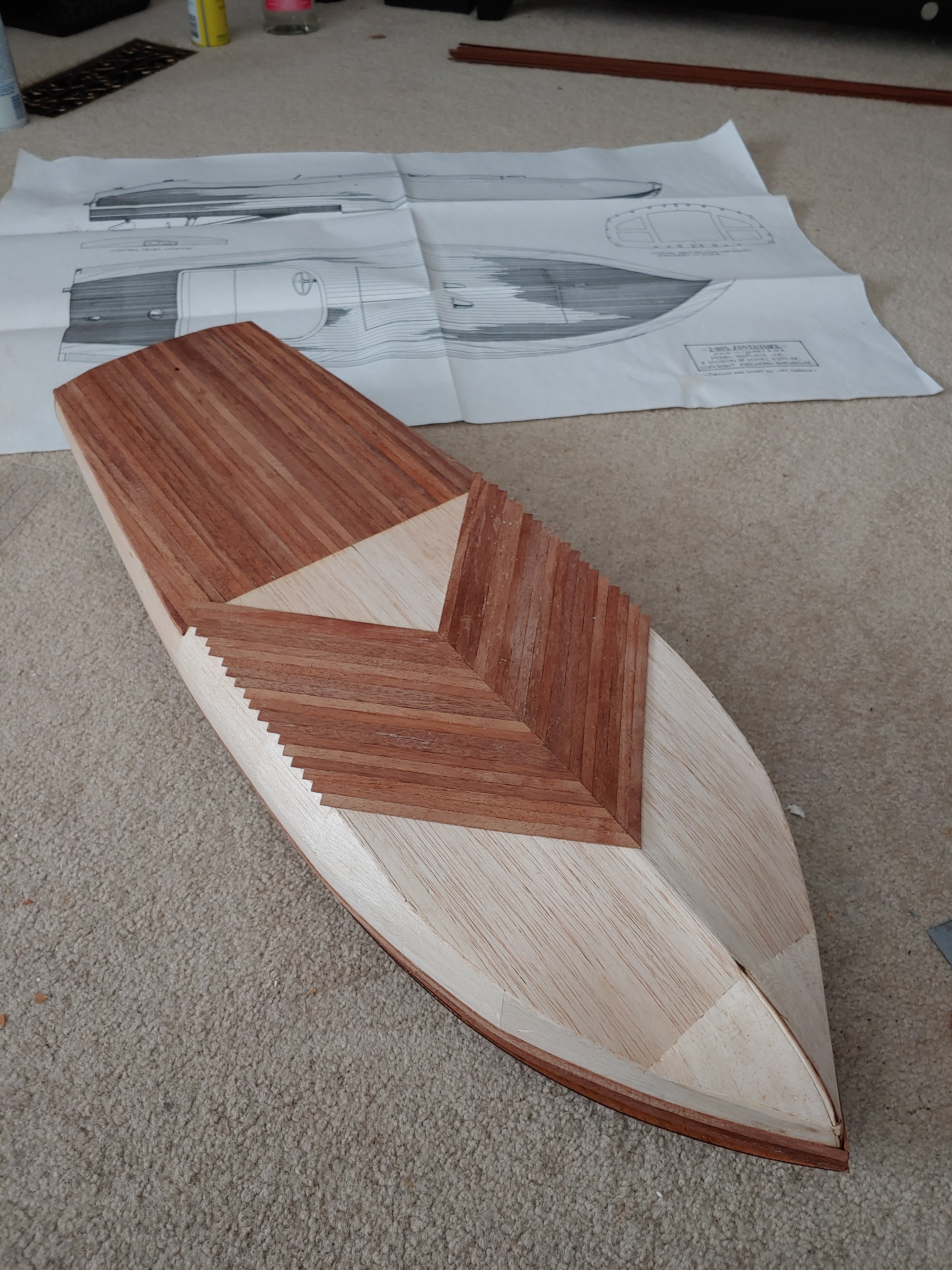

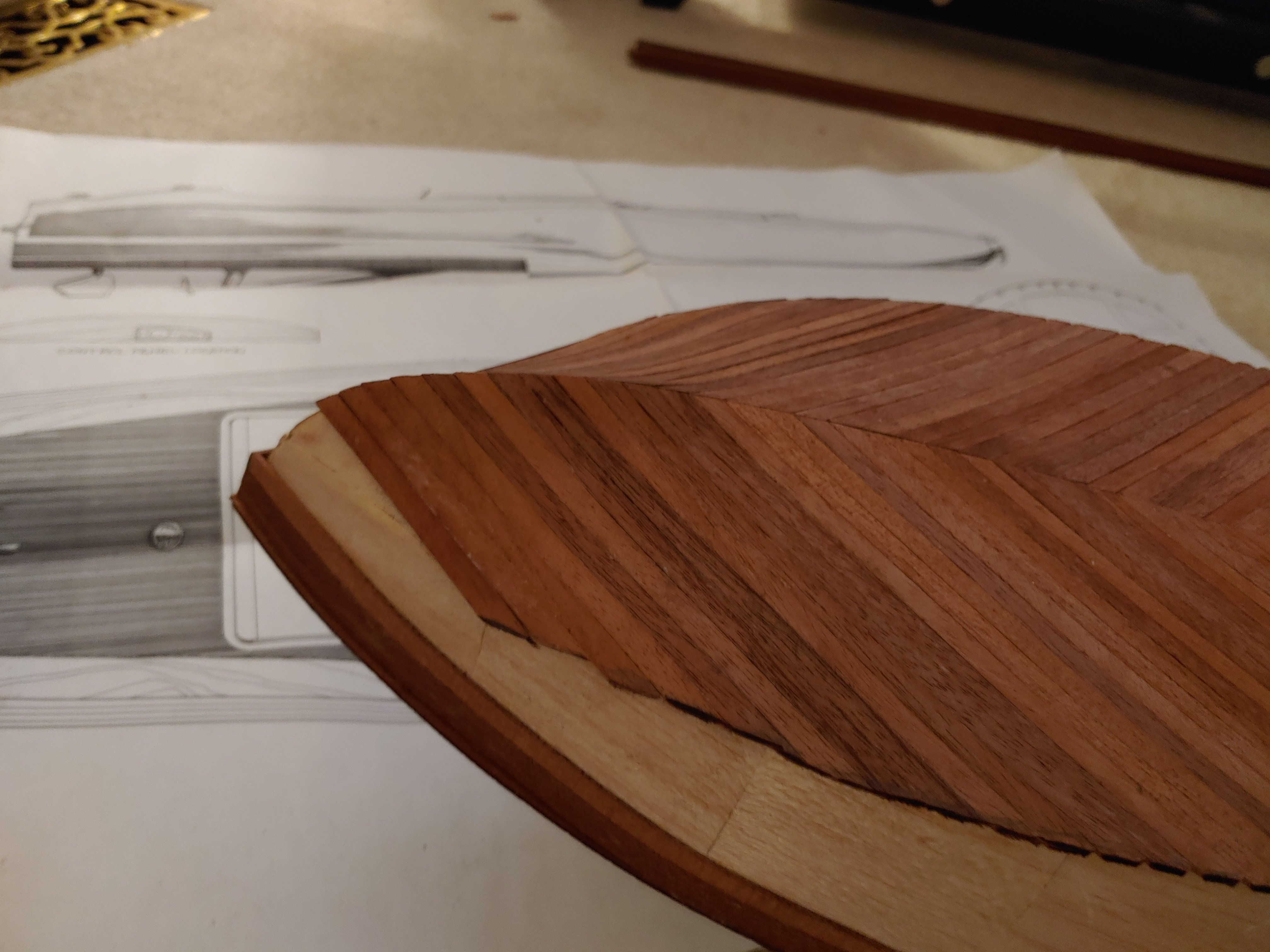

I was apprehensive about planking the compound curves on the bottom of the boat until I saw some old plans for flyer class racers using a dihedral type planking for the bottoms of the boats. I decided to go this route and I am very happy with the results. It did require a bit of bending and mitering.

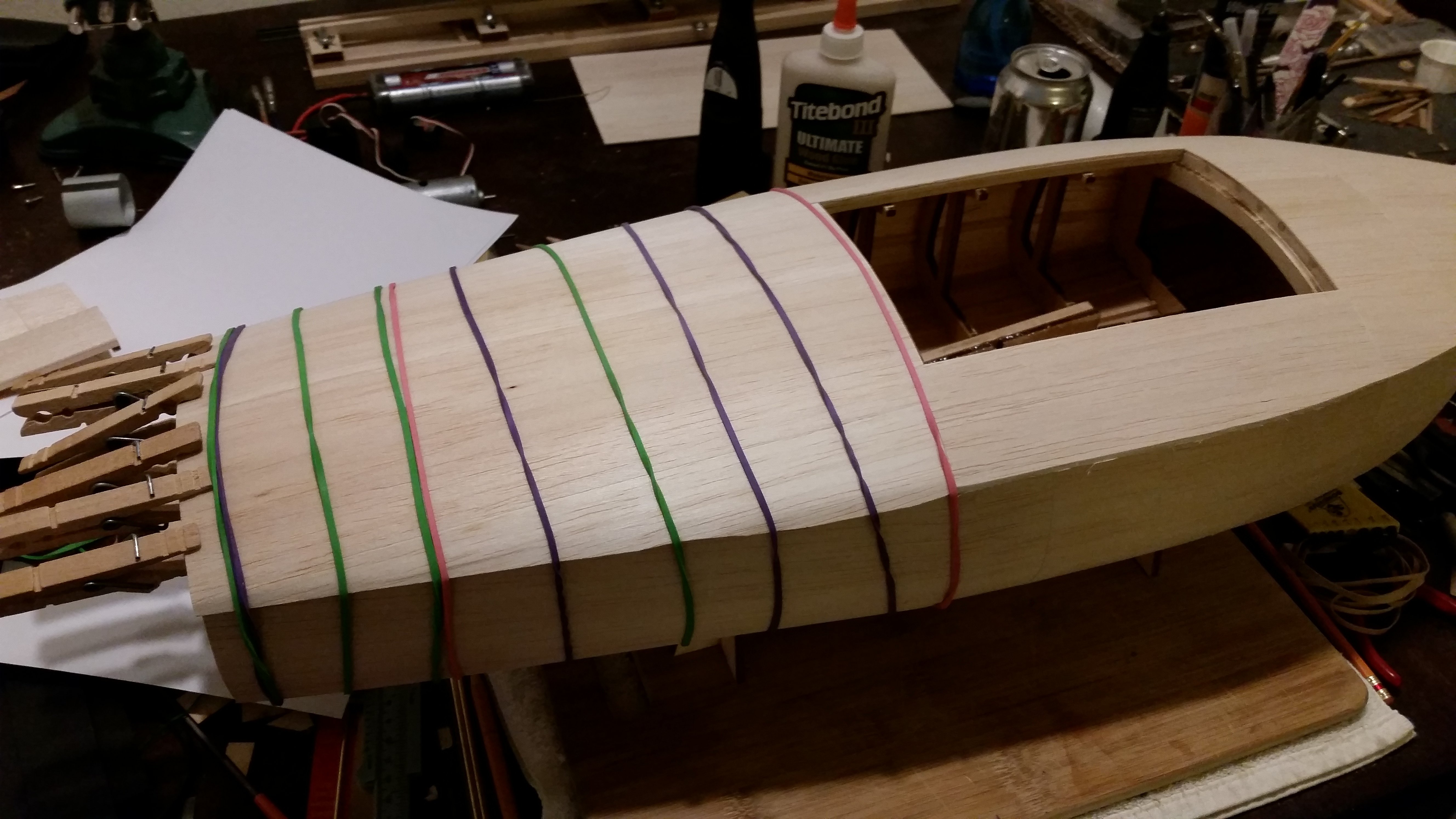

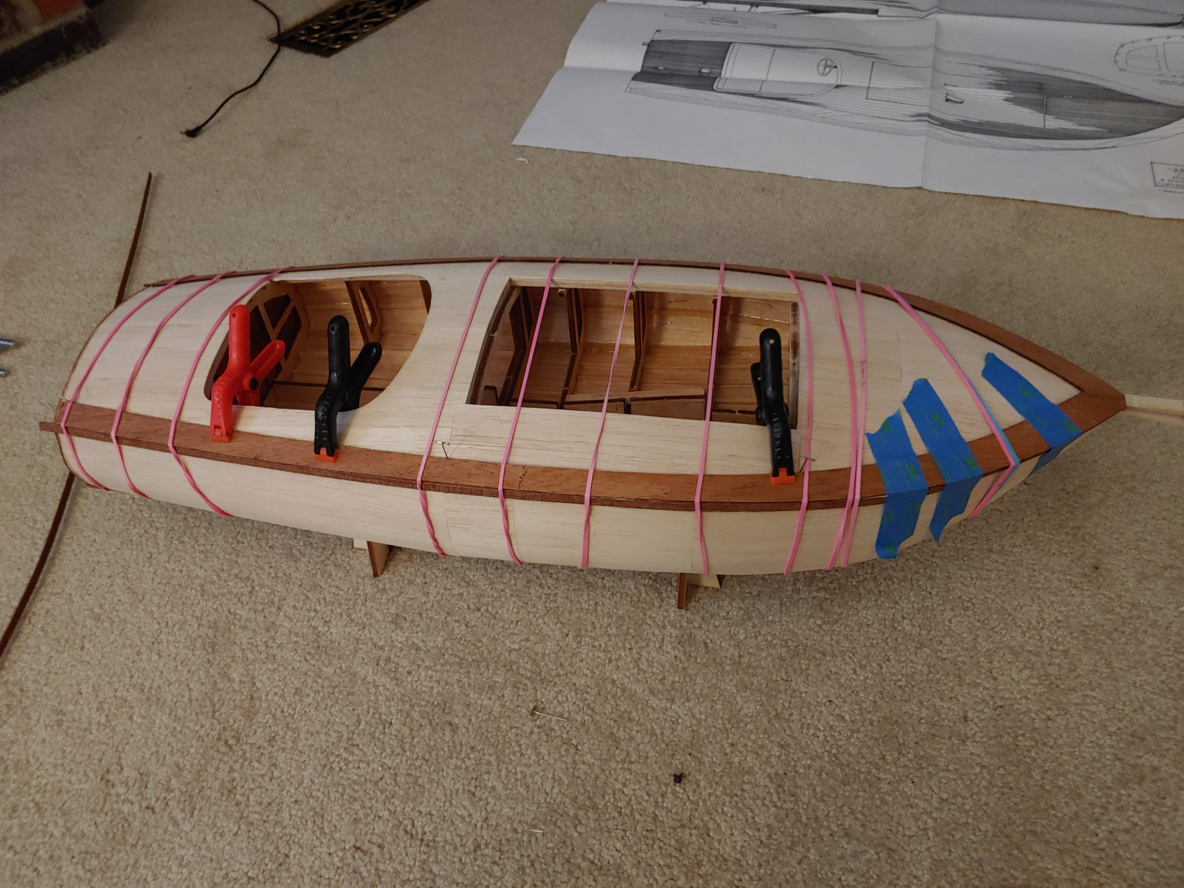

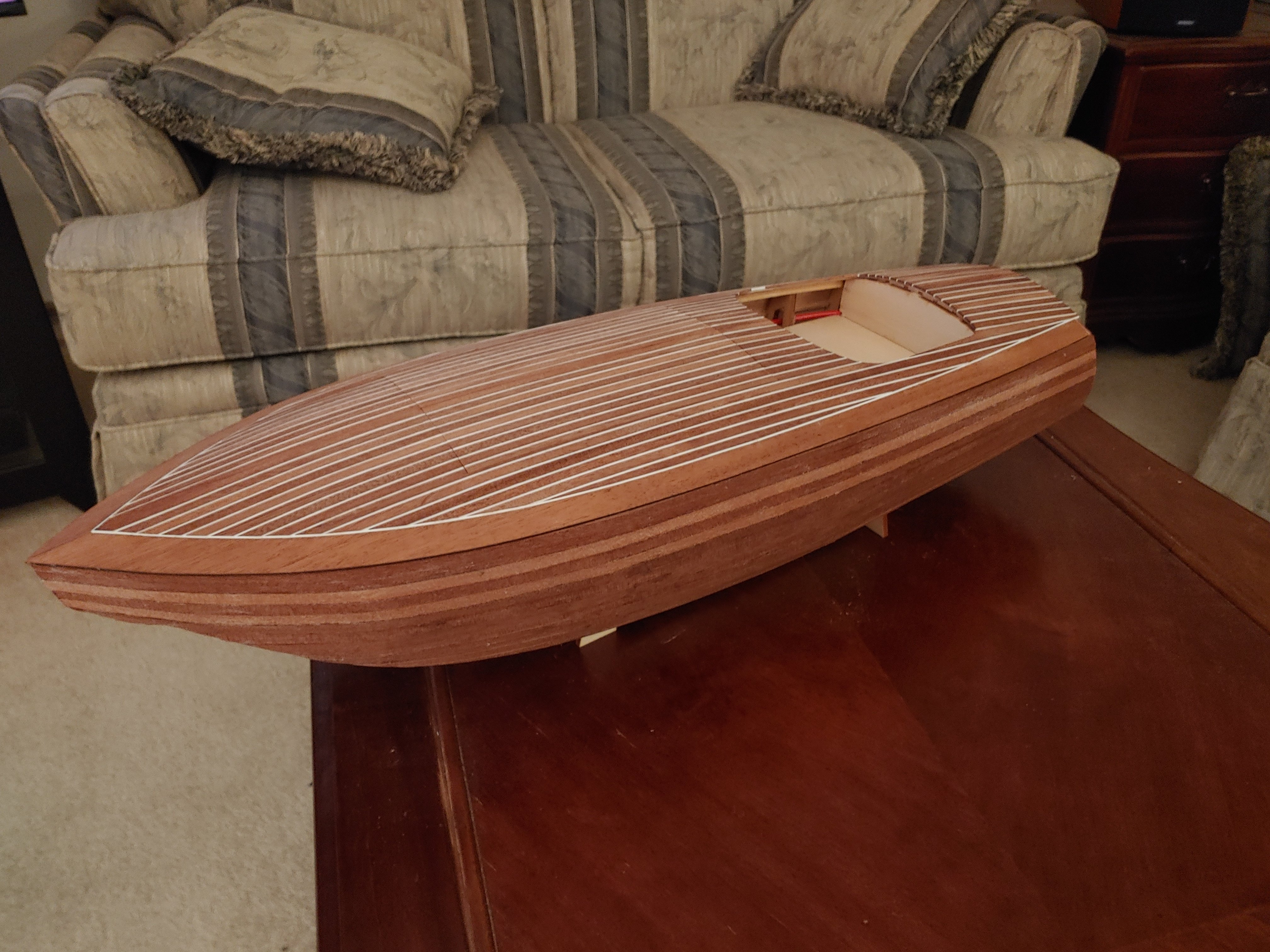

2-26-2022

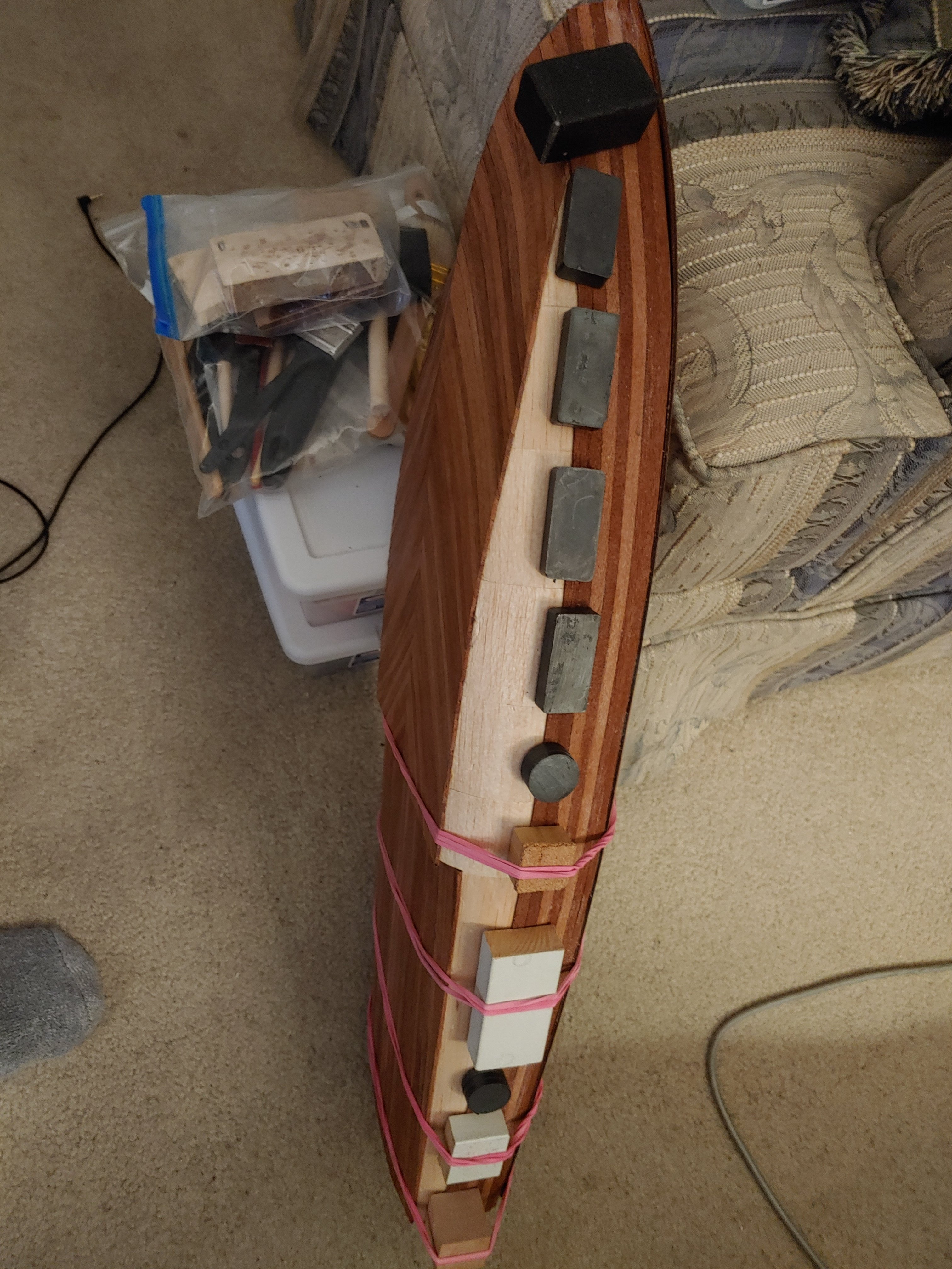

On to planking the sides. I noticed in the pack of extra long planks that I ordered that there were four planks that were lighter colored than the rest. I ended up using them as kinda racing stripes down the sides of the boat. I like the effect.  I had to come up with some creative means of clamping the planks to the model (I used Tightbond III throughout) so I used magnets and rubber bands.

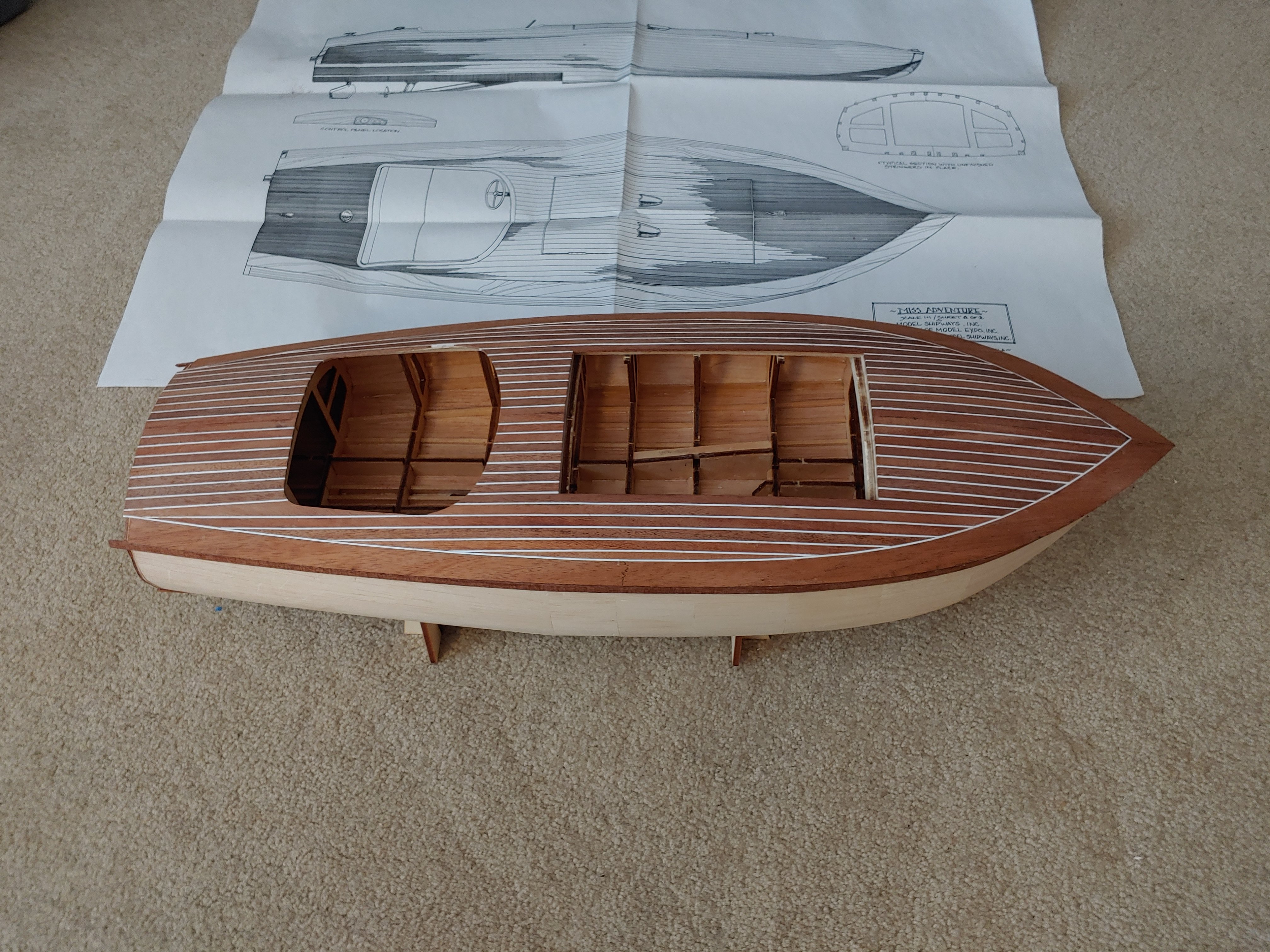

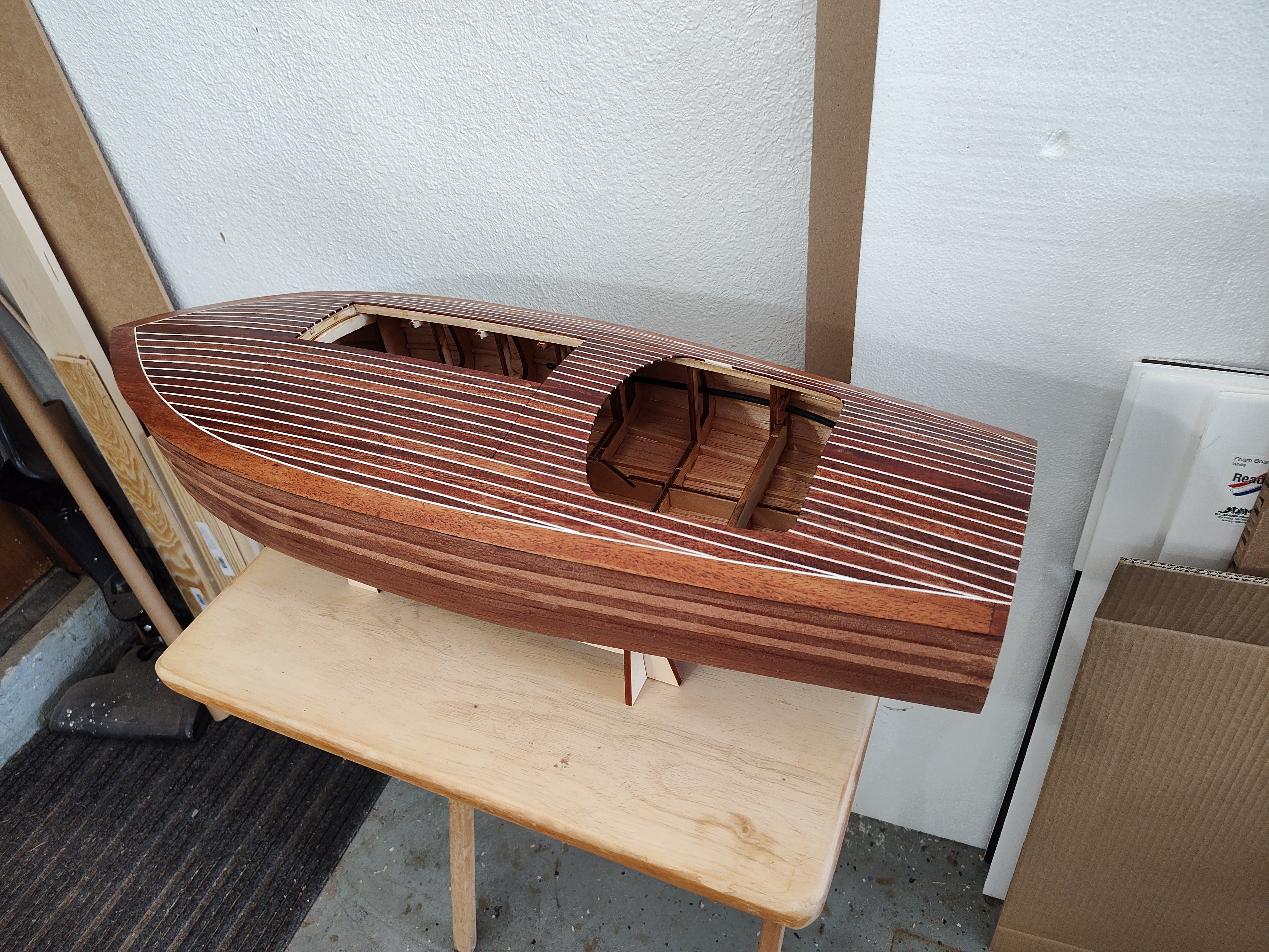

5-10-2025
Now we are getting more up-to-date. I decided on using Minwax Helmsman Spar Urethane in a satin finish. It has good moisture resistance and durability. I prefer satin finish since gloss is pretty unforgiving of any imperfections. I plan on two coats of brush on and a final coat of spray. Here is the deck after the first coat of Urethane. I hate that the margin planks were not long enough the reach the back of the boat. I had to add a piece of mahogany planking to finish it out and it looks kinda janky. I may put some kind of fitting or hardware there to mask it.

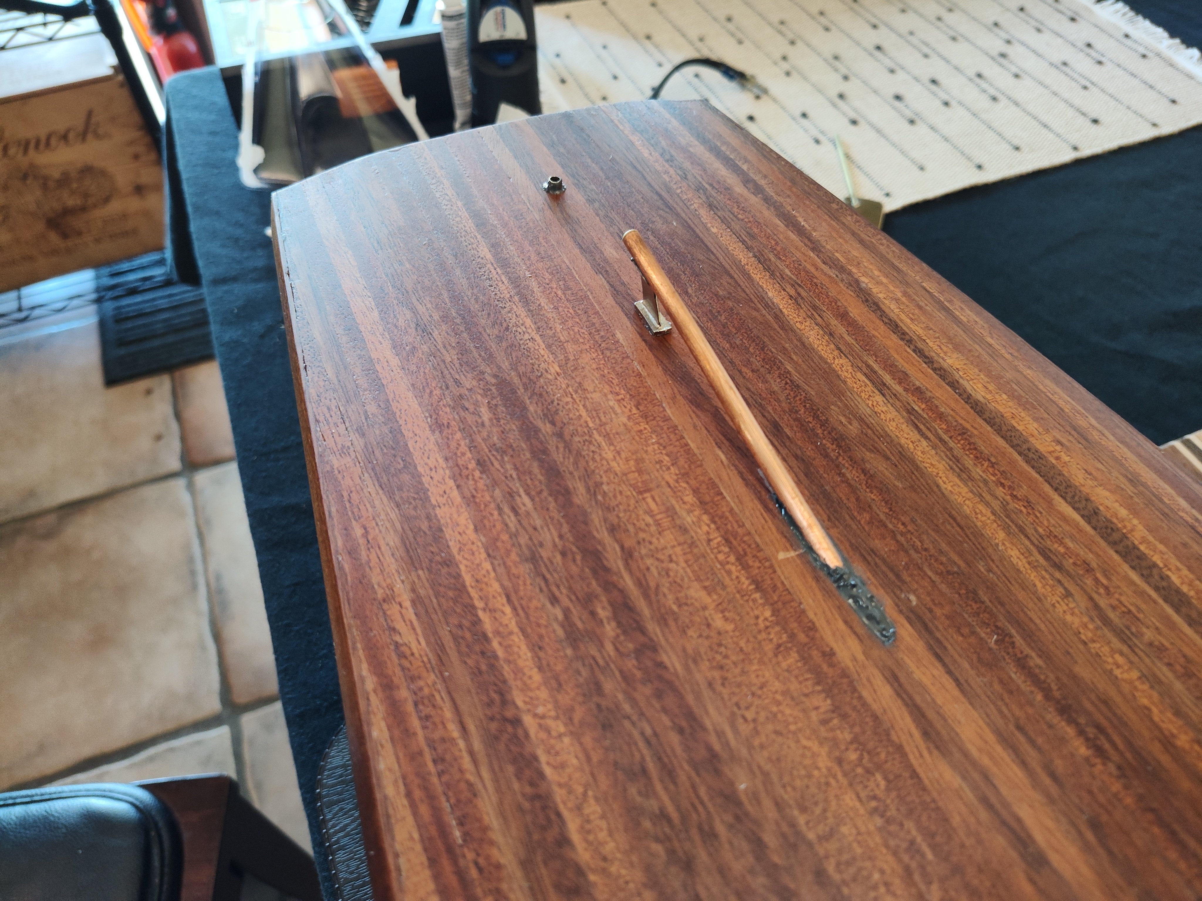

I started to get to work on some other stuff..

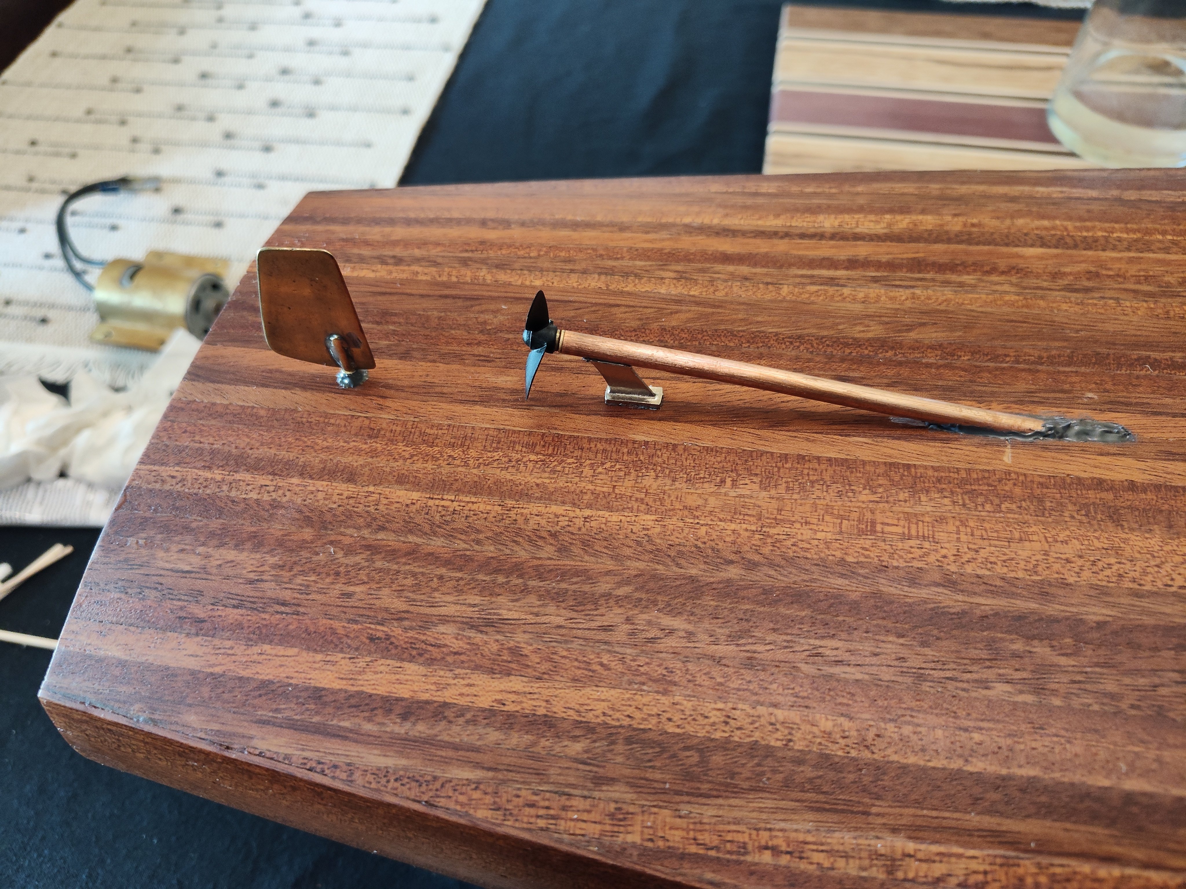

I didn't like how the kit used thick plywood for the rudder so I got some scrap brass, cut it to shape, then braised it to the rod. I still need to clean it up more.

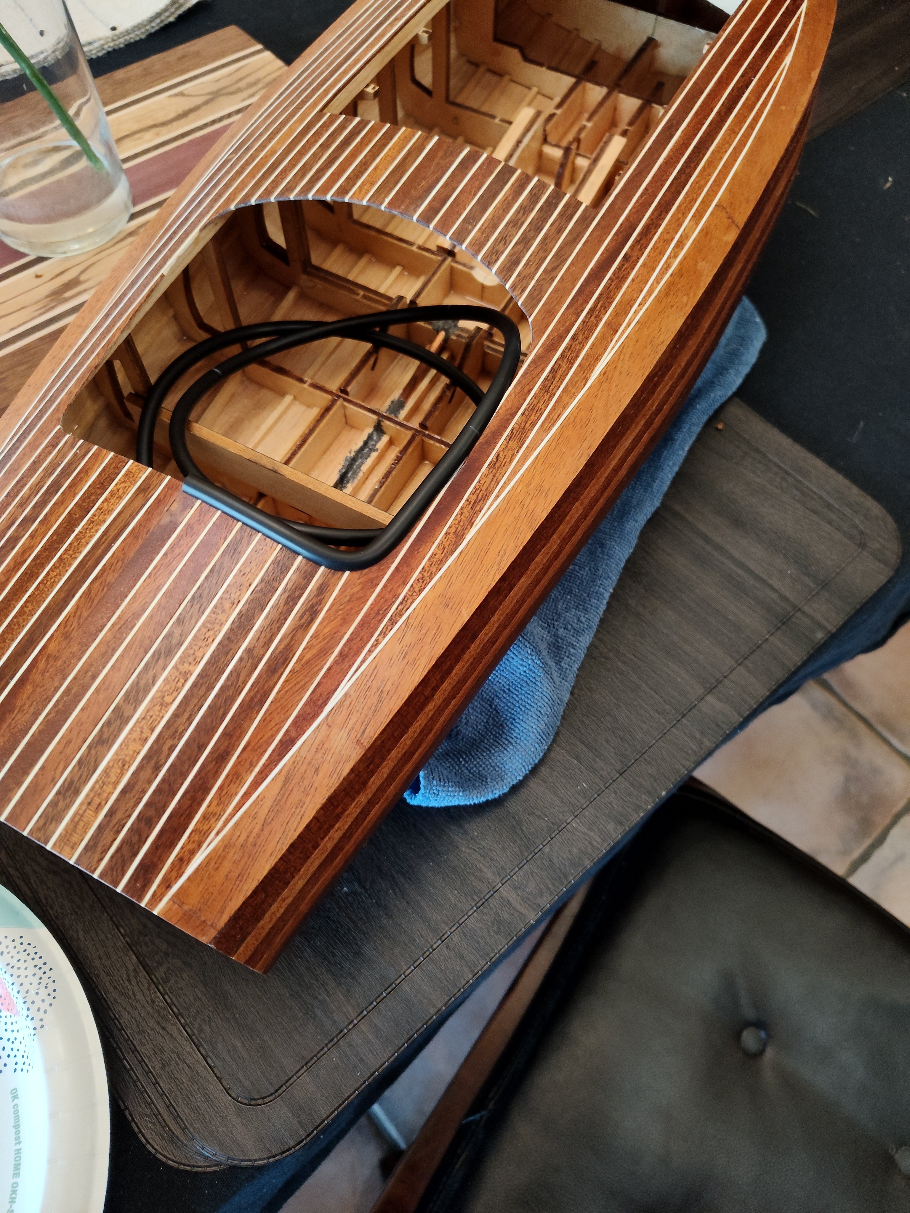

Cockpit coaming

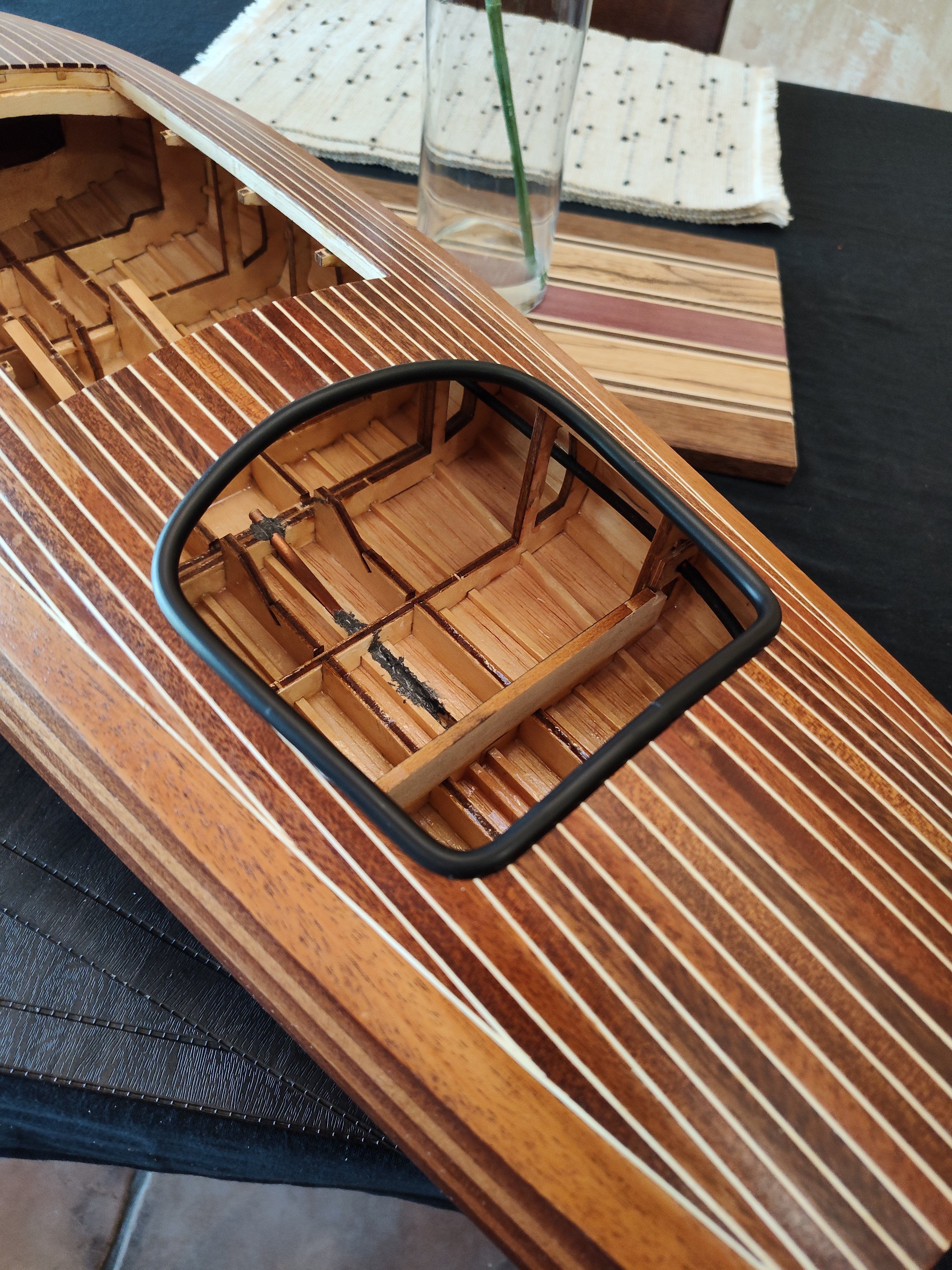

I used a larger coaming than what came in the kit. I used super glue gel since it would have been too difficult getting epoxy in that little groove in the coaming. I was wondering if I wanted to do partial coaming or do the whole thing. I went with the whole thing. I'm happy with how it turned out.

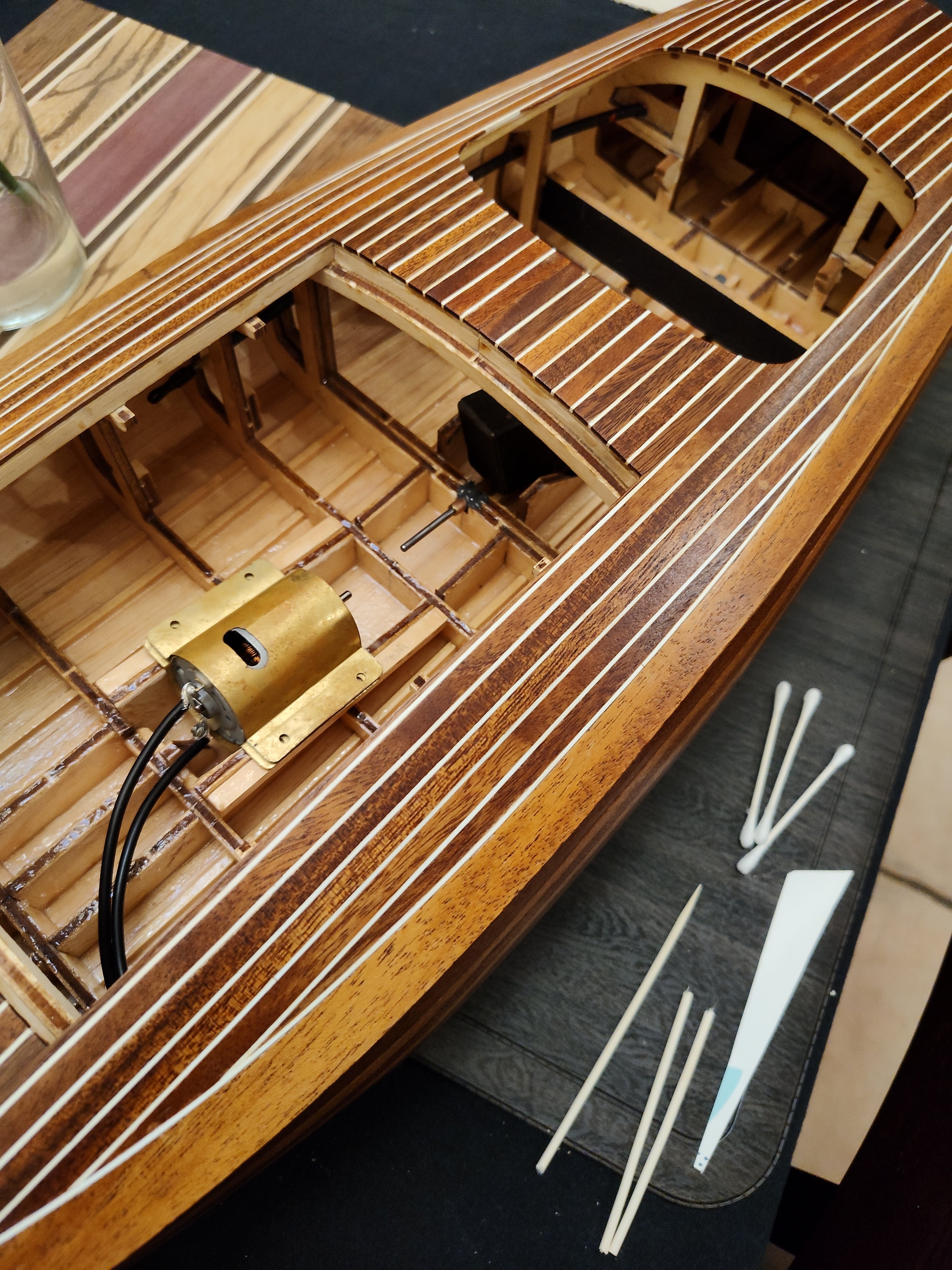

Deck hardware and exhaust going in. Once again, the exhaust included with the kit was just too small so I fabricated a better one using a brass washer and a bit of brass tubing. The intake ports needed very little fitting so those went on quickly.
