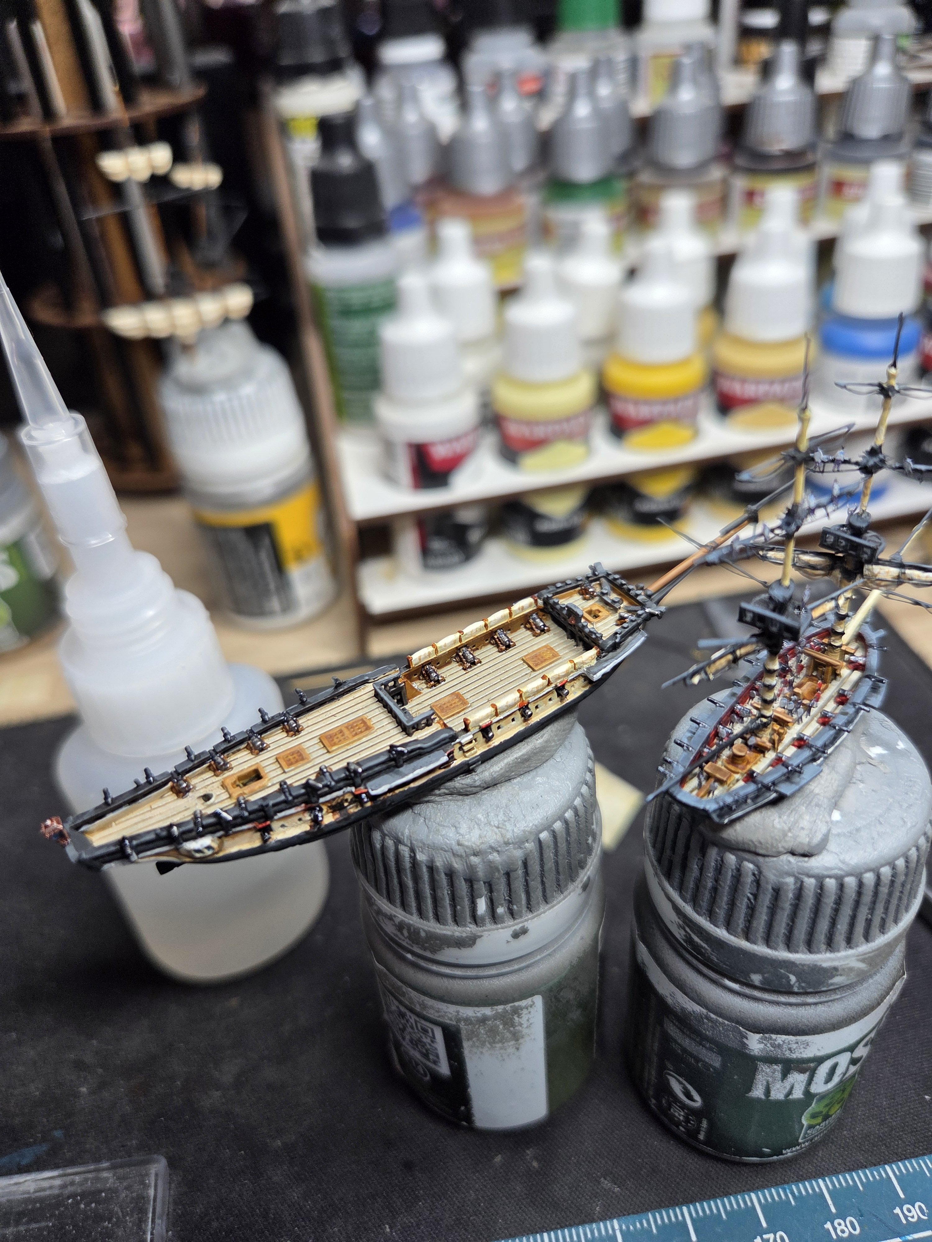

Begun fitting photo-etch deck details
Started work on brass masts and spars

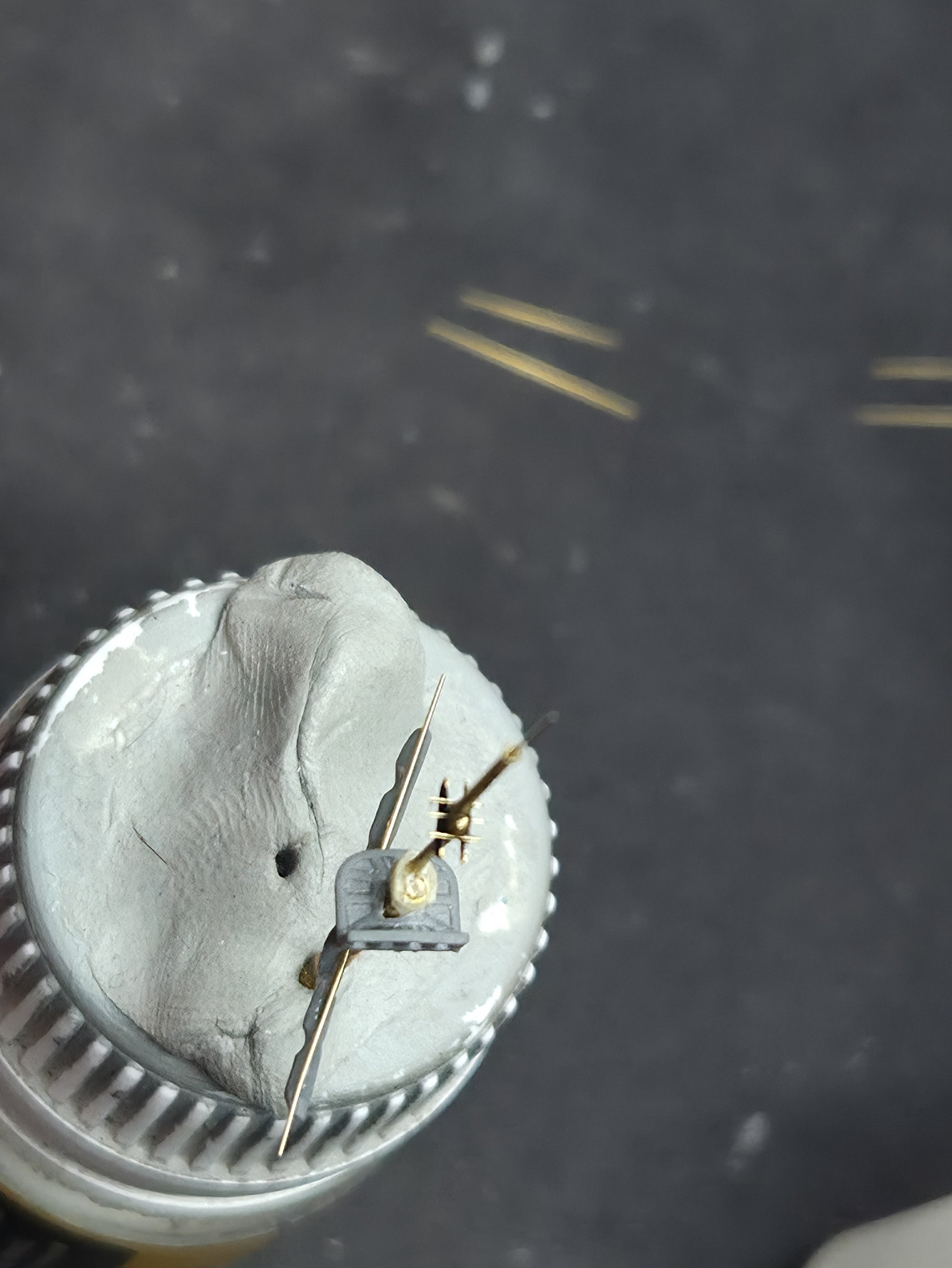

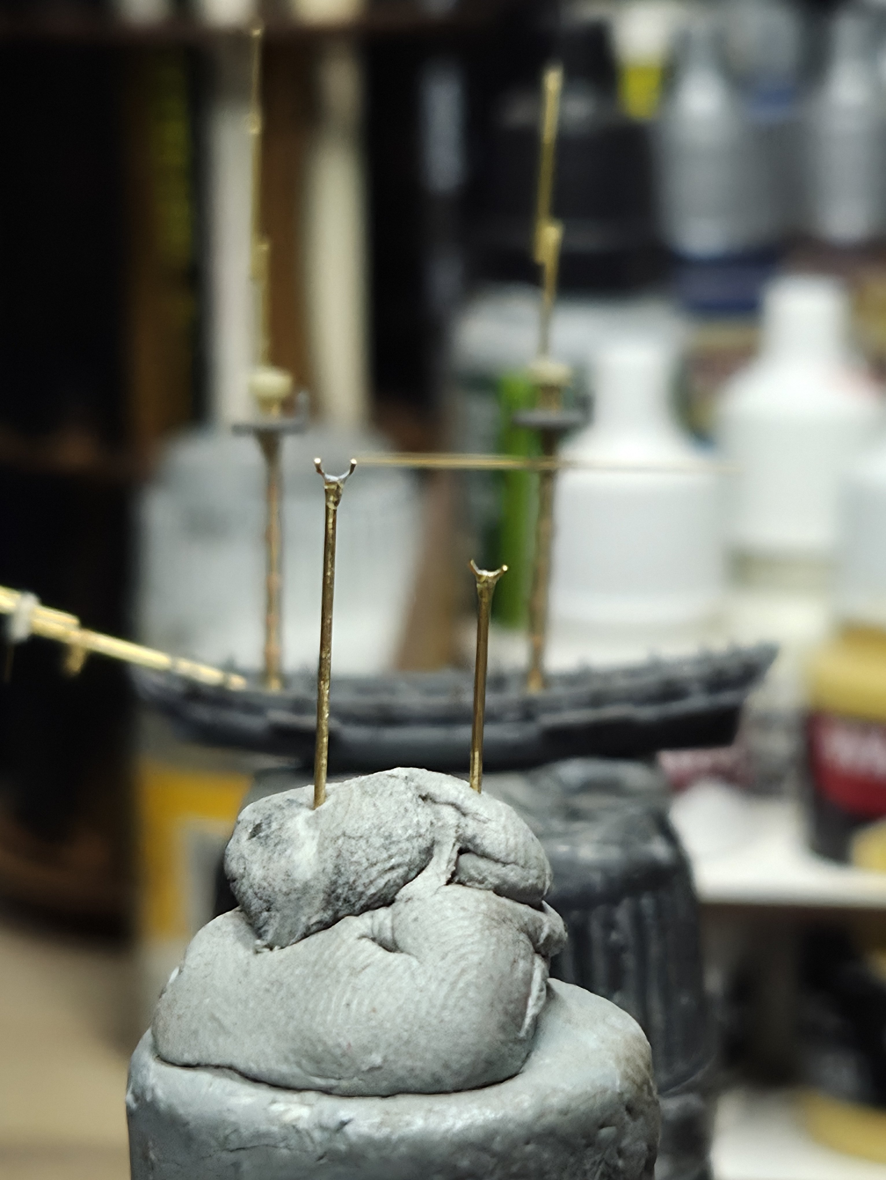

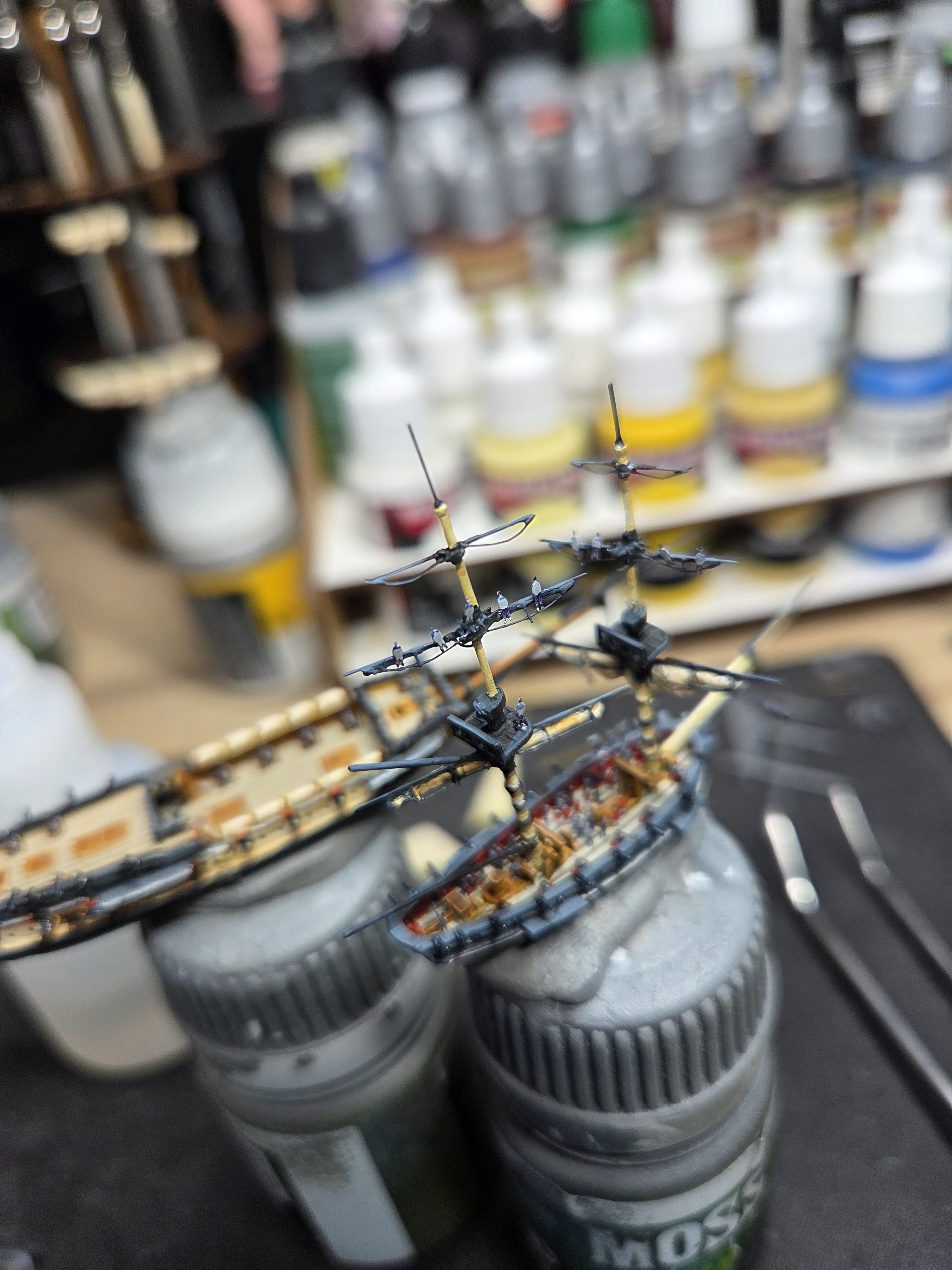

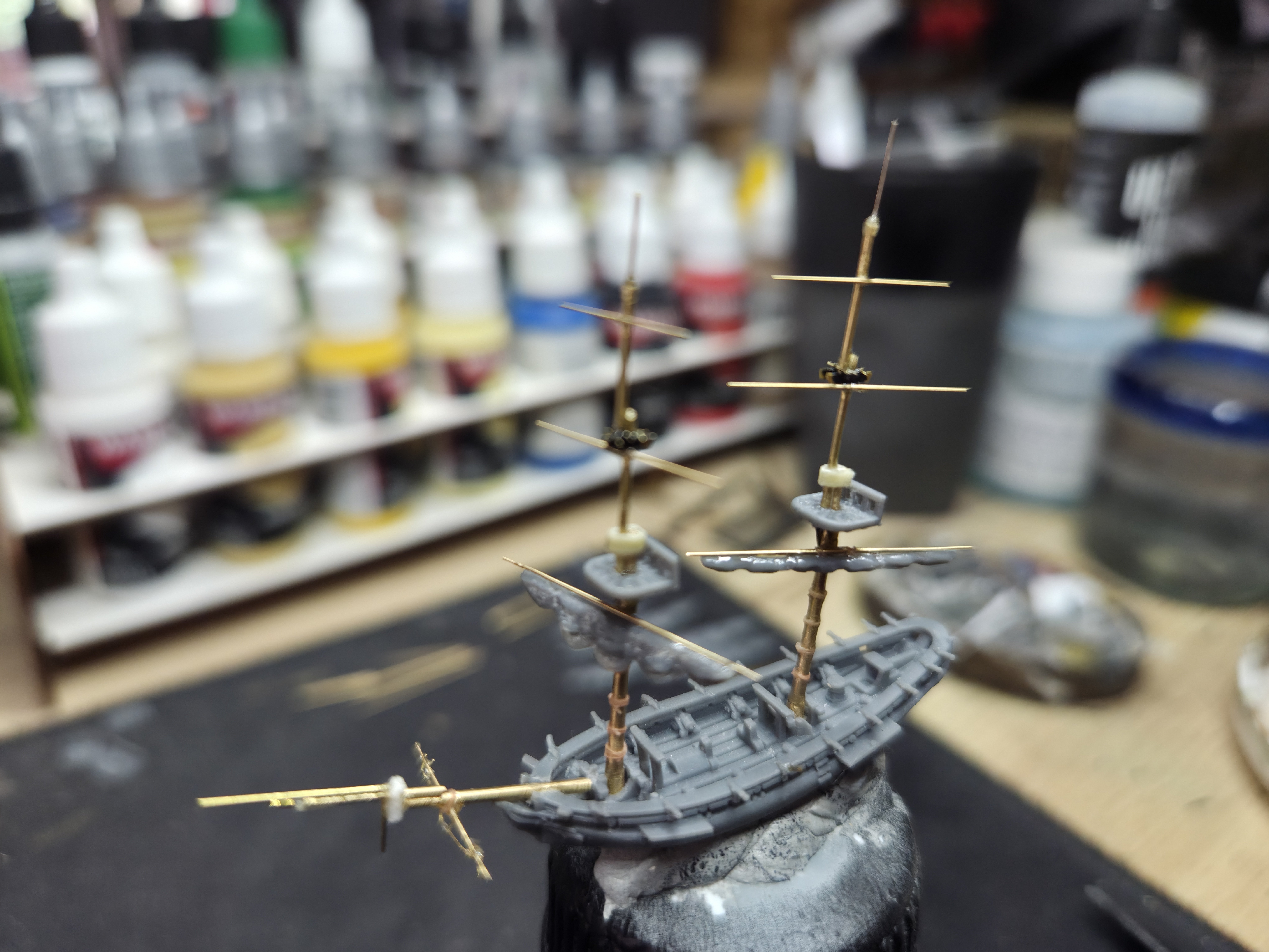

I am still working on HMS Speedys's masts. Added half rings to the the gaff and boom, my eyesight is bad enough that I can see this without magnification. Still I want this one to have as much detail as I can.

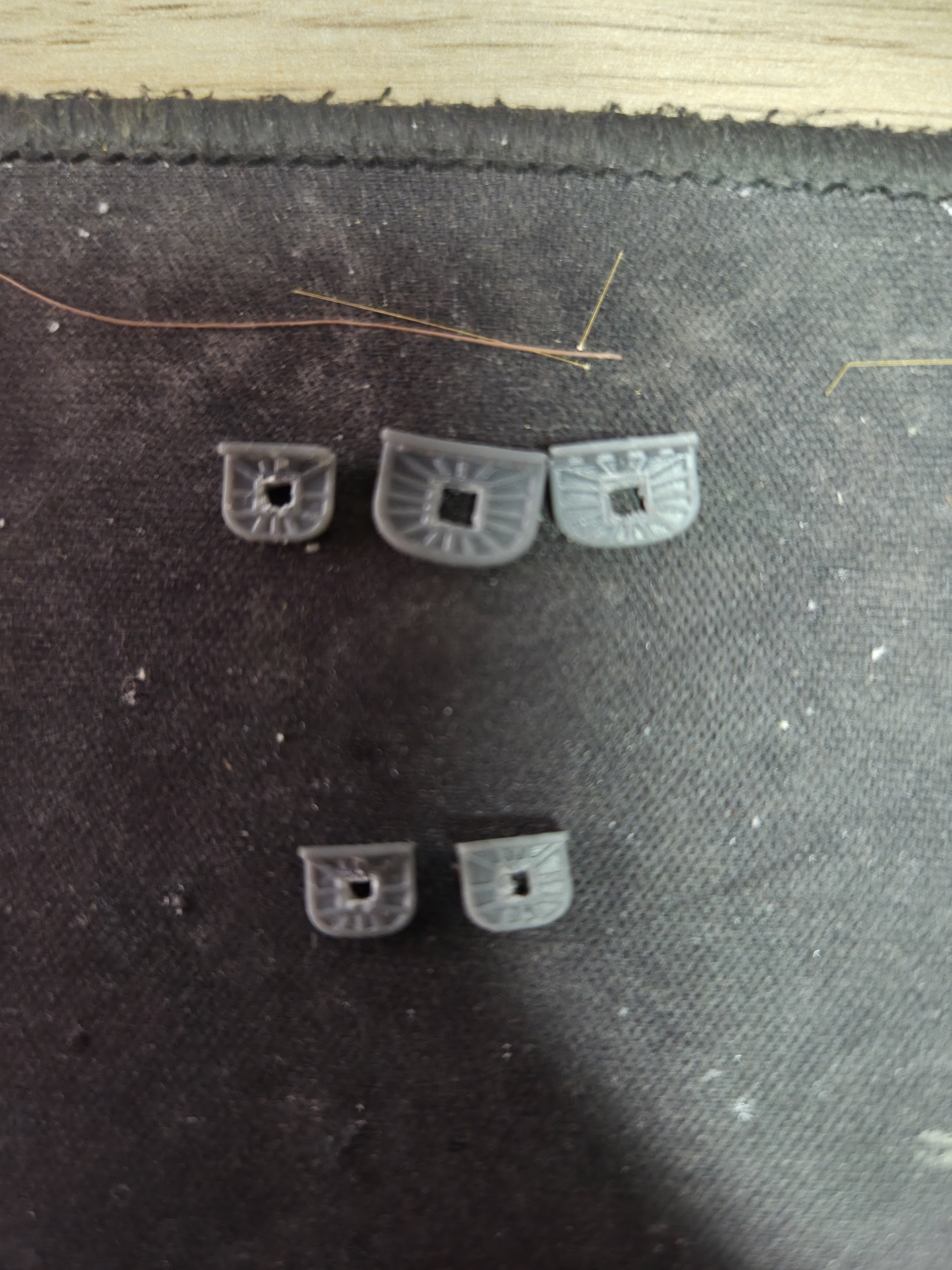

I also made some cross trees. The smallest brass is just 0.1 mm here.
And added the yards to. Next will be the foot ropes.
I have tried working on some furled sails using UV reactive putty to sculpt  details .
I worked on details for the masts of both ships also adding foot ropes.

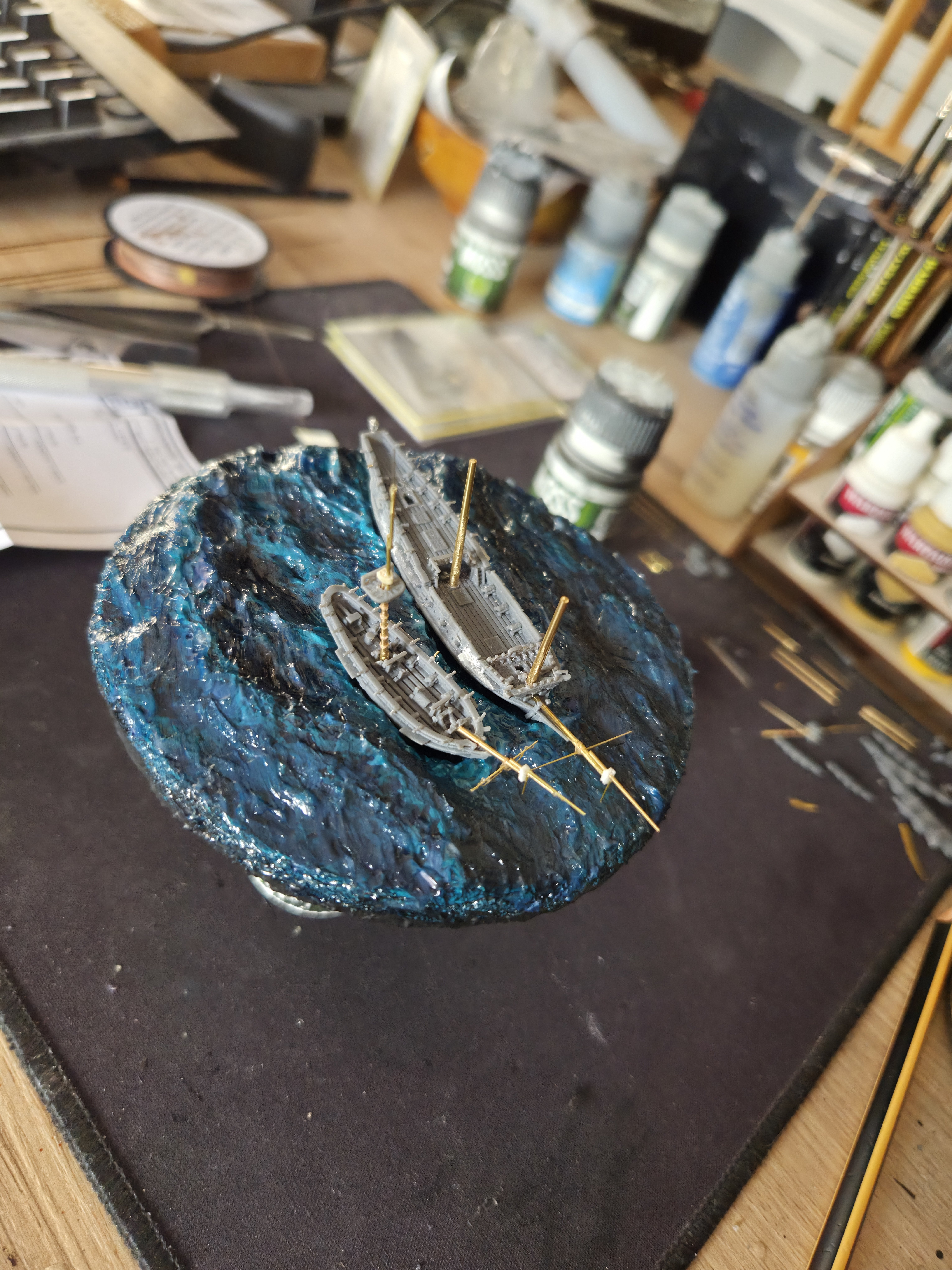

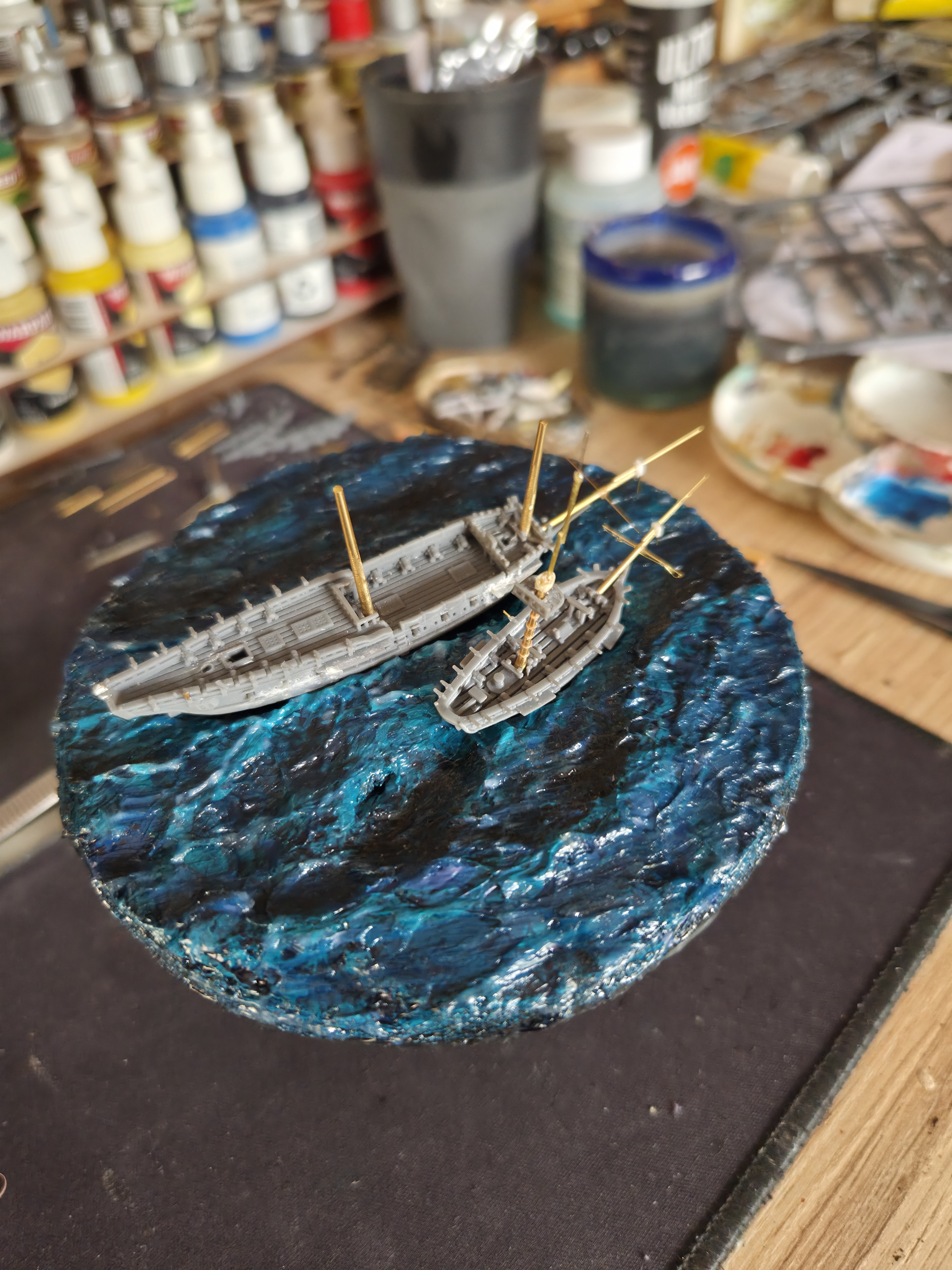

I was also unhappy with the water sp redid that. It's now better but needs more work. First picture is before, second updated colors and third as it stands now.
20250628_082429.thumb.jpg.8647684ad6675cbbb094289671ee0506.jpg20250628_232911.thumb.jpg.b31c45e64e1be0374c869b1559b2d737.jpg20250629_171745.thumb.jpg.6323921bc058b1d559cfedde678be2c9.jpg

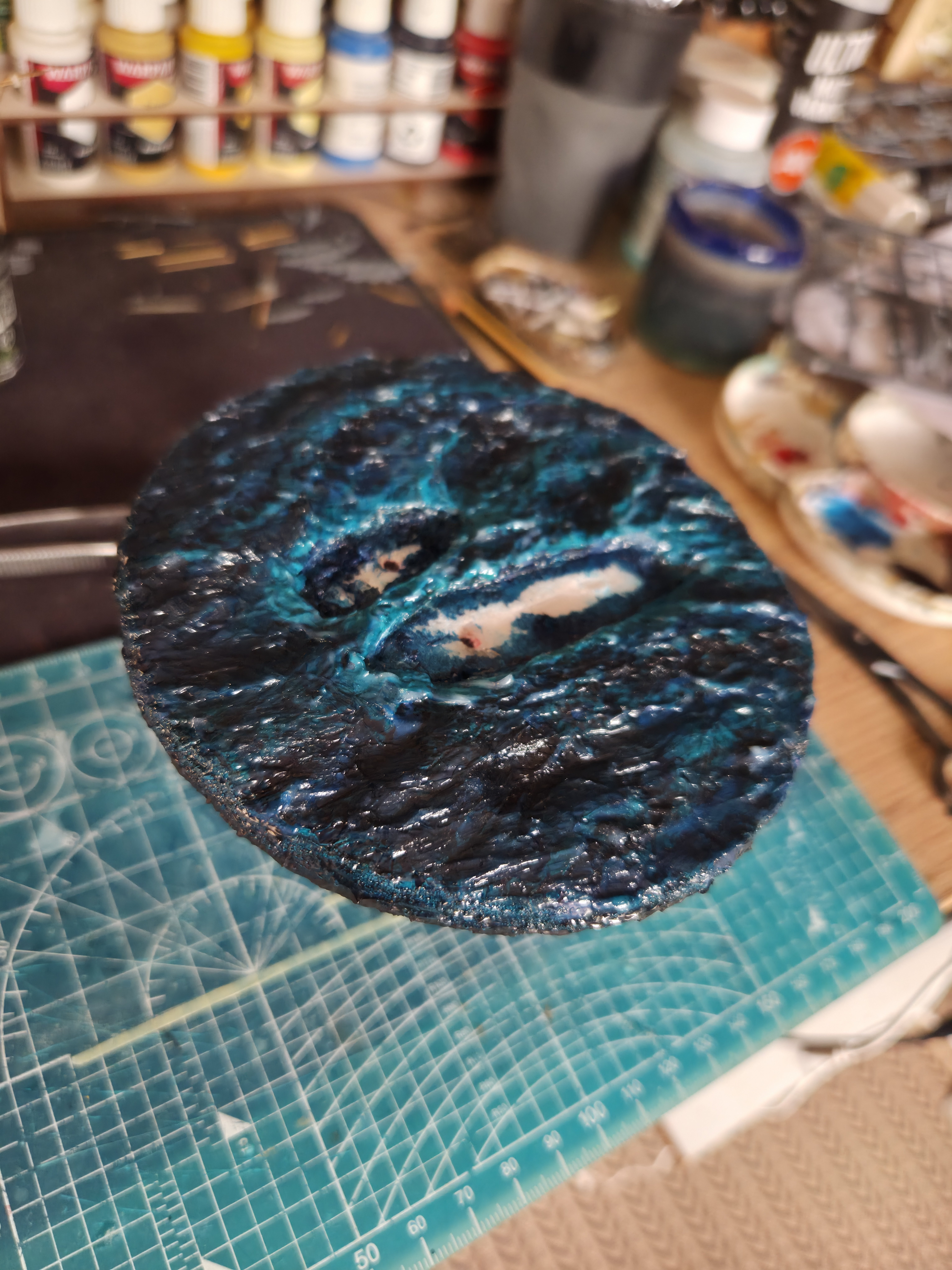

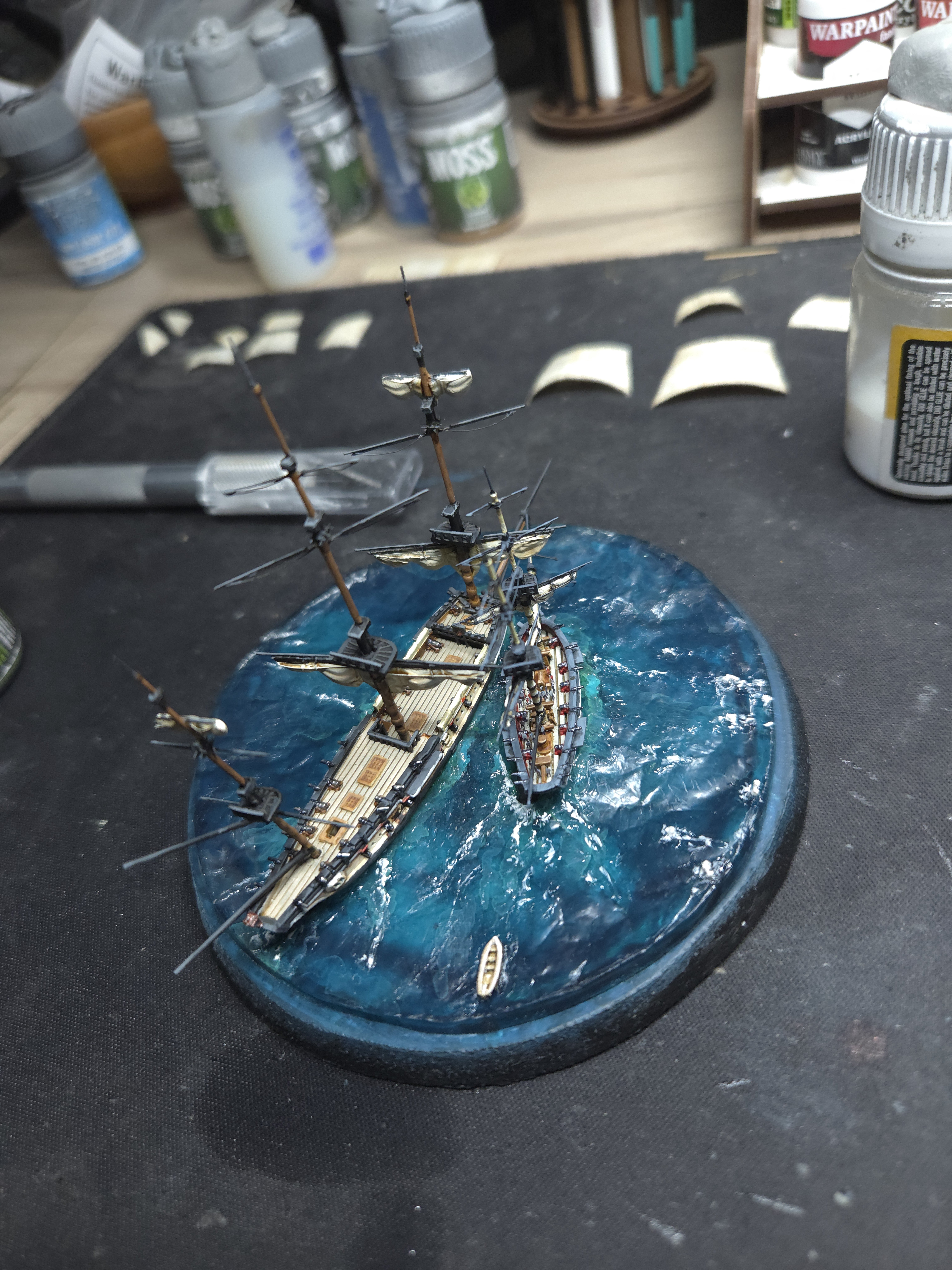

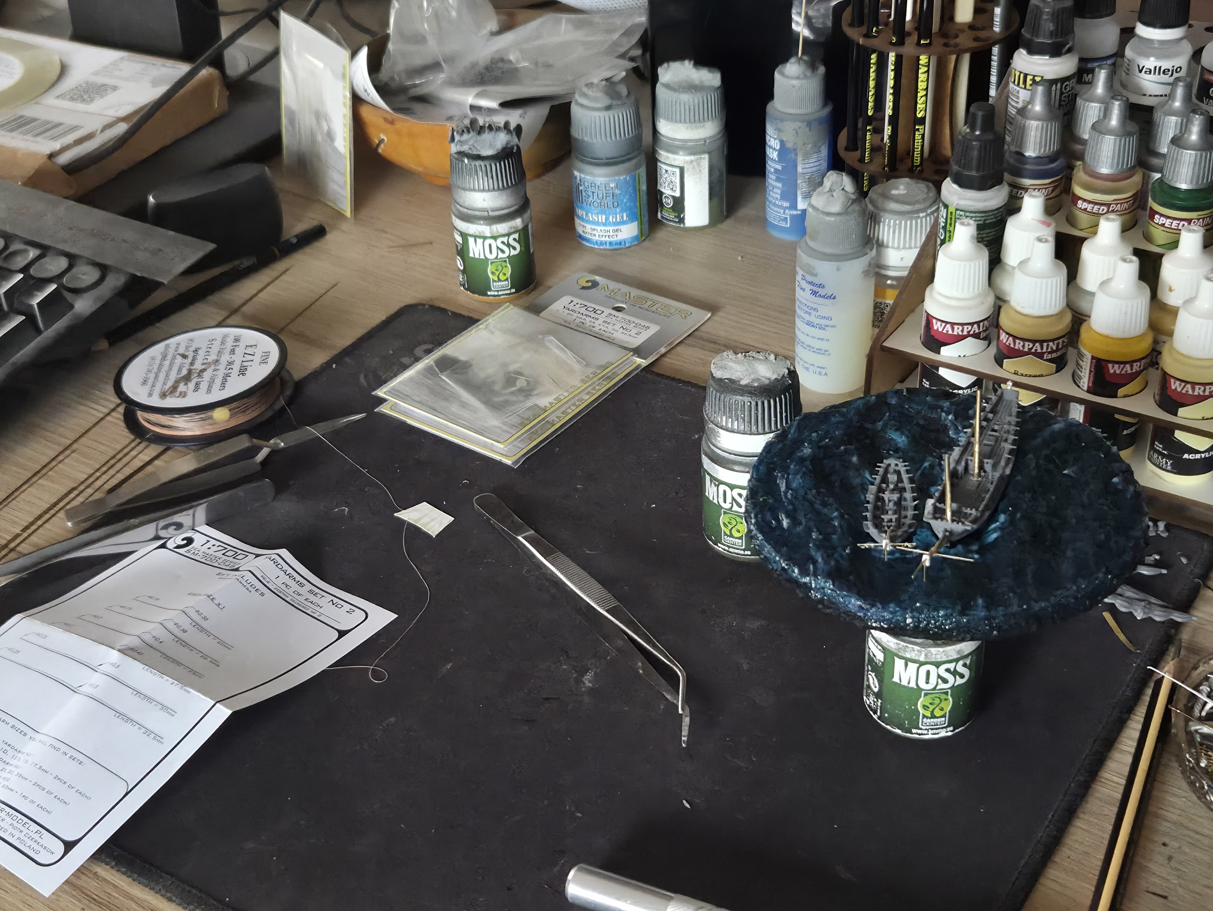

I was not happy with the water, so I decided to redo the whole base plate. New version is a resin mold I made. Much happier with this look. I hope you agree, if you check previous post with my old baseplate.

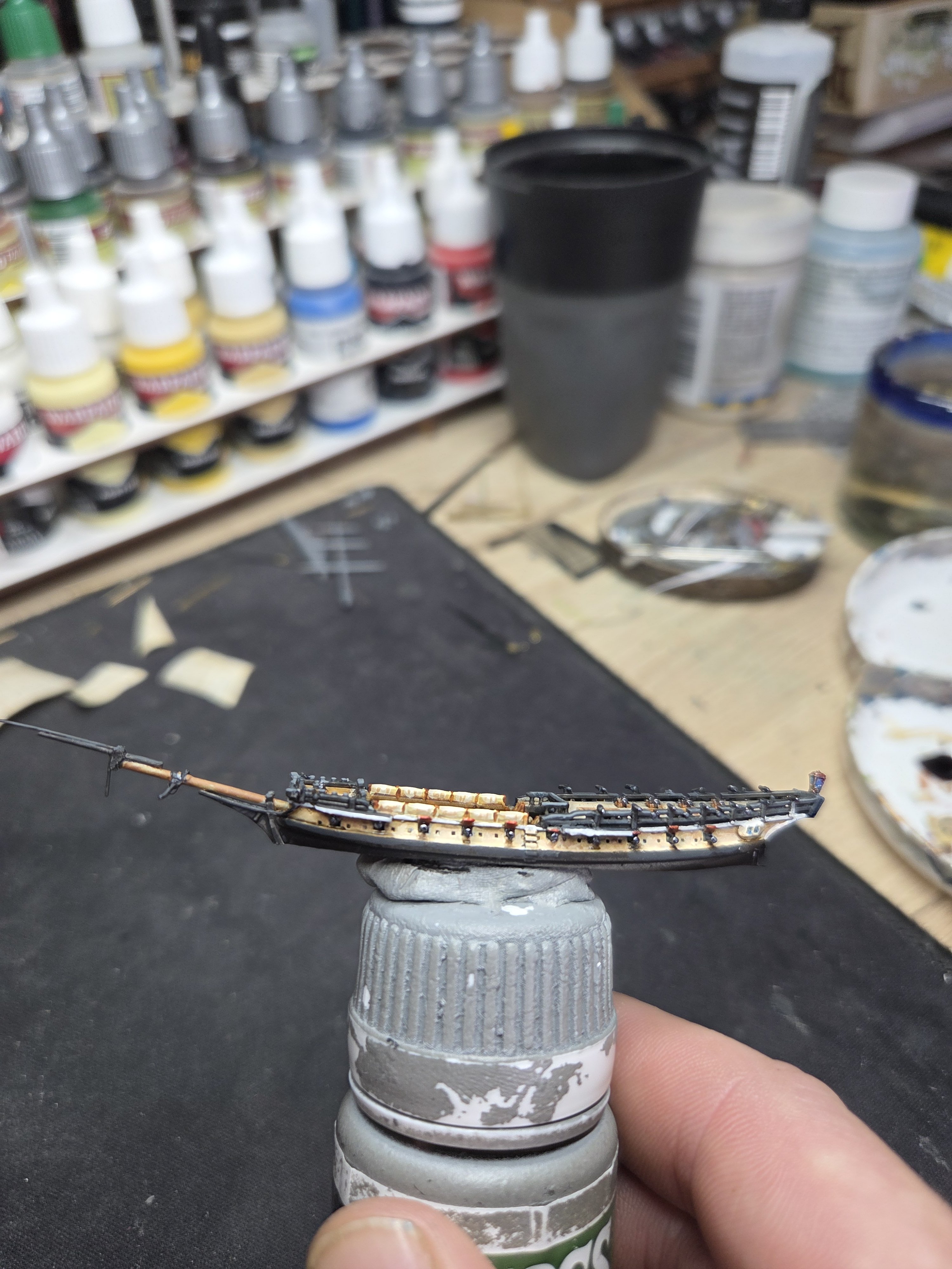

Finally I began painting HMS Speedy as she might have appeared in her disguise as a Danish ship. I also did some more work on the base with cannon fire missing speedy and splashing in the water.

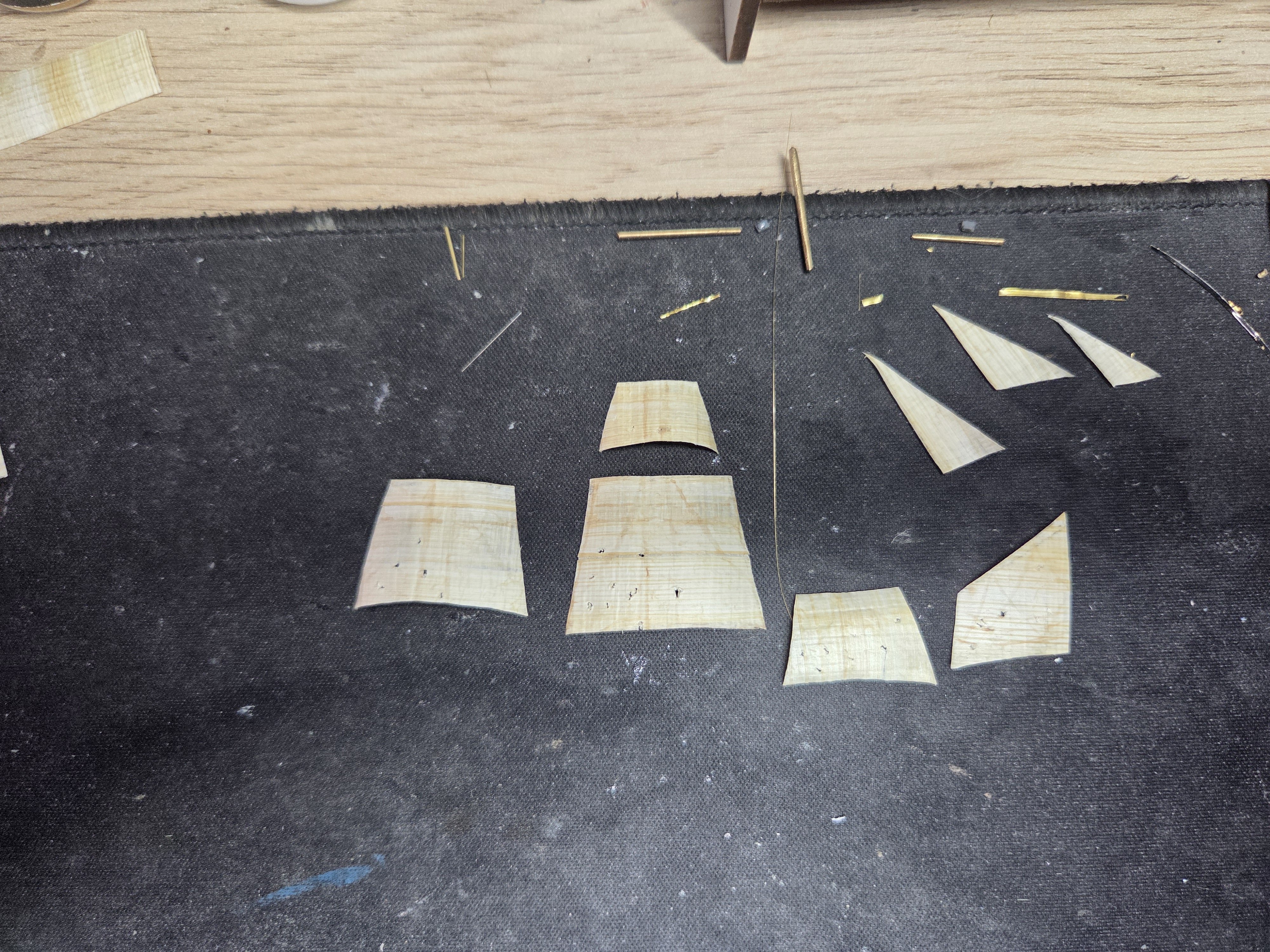

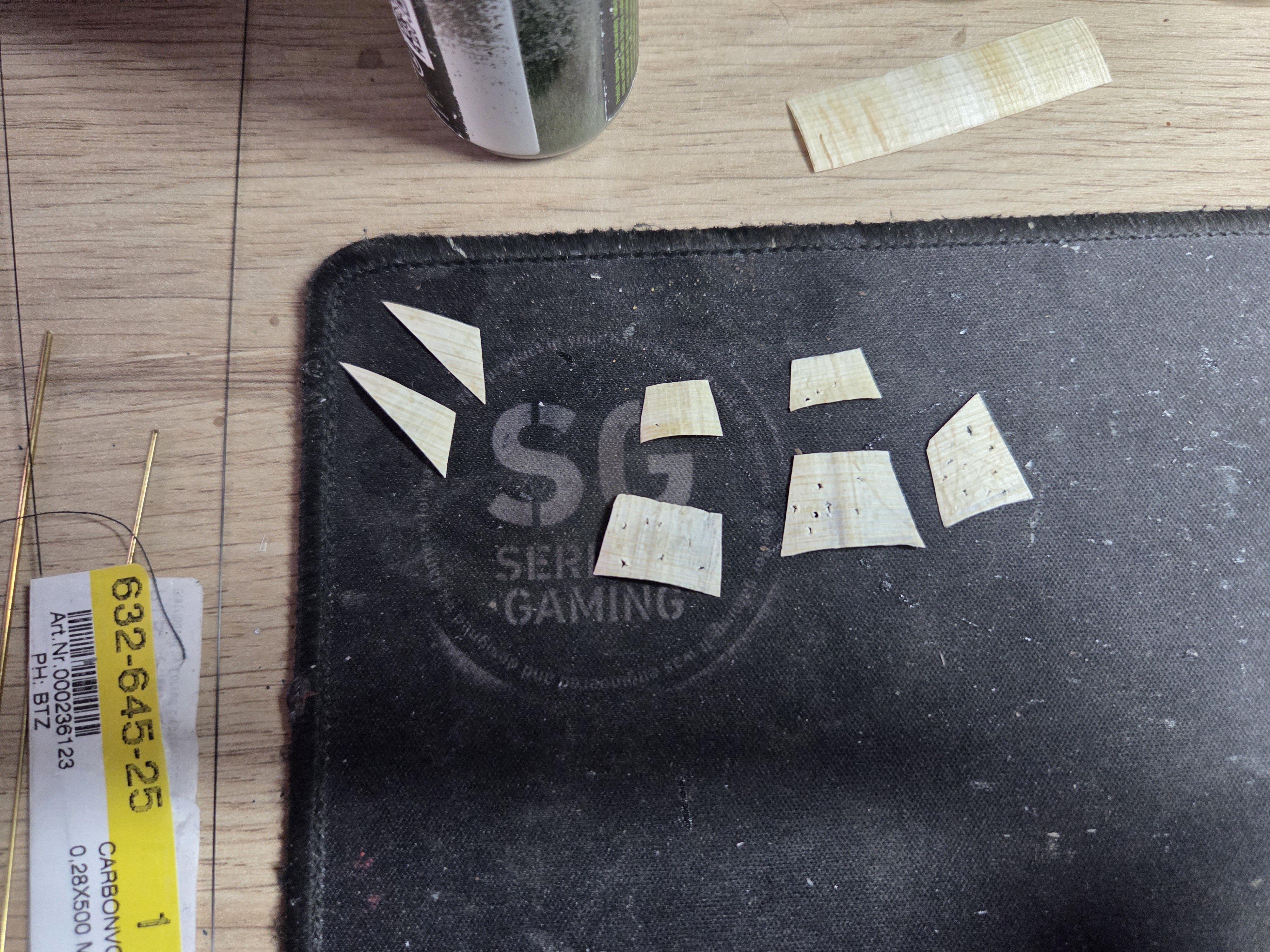

Started working on sails, I was first using normal copying paper... I have used that to good effect on wargaming minis. But this is a diorama so I needed to get something better. Got a tip about Silkspan. Did that and looked ok. Might go back to it, but then by chance I found some papyrus on a second hand shop. Decided to give it a try and I really like the result so far. Decision has not been made fully yet though. Took inspiration from HMS Victory surviving topsail, for the battle damage.  20250706_111724.thumb.jpg.392726863ee016d5d094e6a0bf48d084.jpg20250706_111716.thumb.jpg.d6f3e8766695b6233fdda7a0e355a0ba.jpgfore-topsail-of-hms-victory-after-the-battle-of-trafalgar-v0-wkufhunfn3e91.jpg.fa857b0e14eafaa4126acf088411dc42.jpg

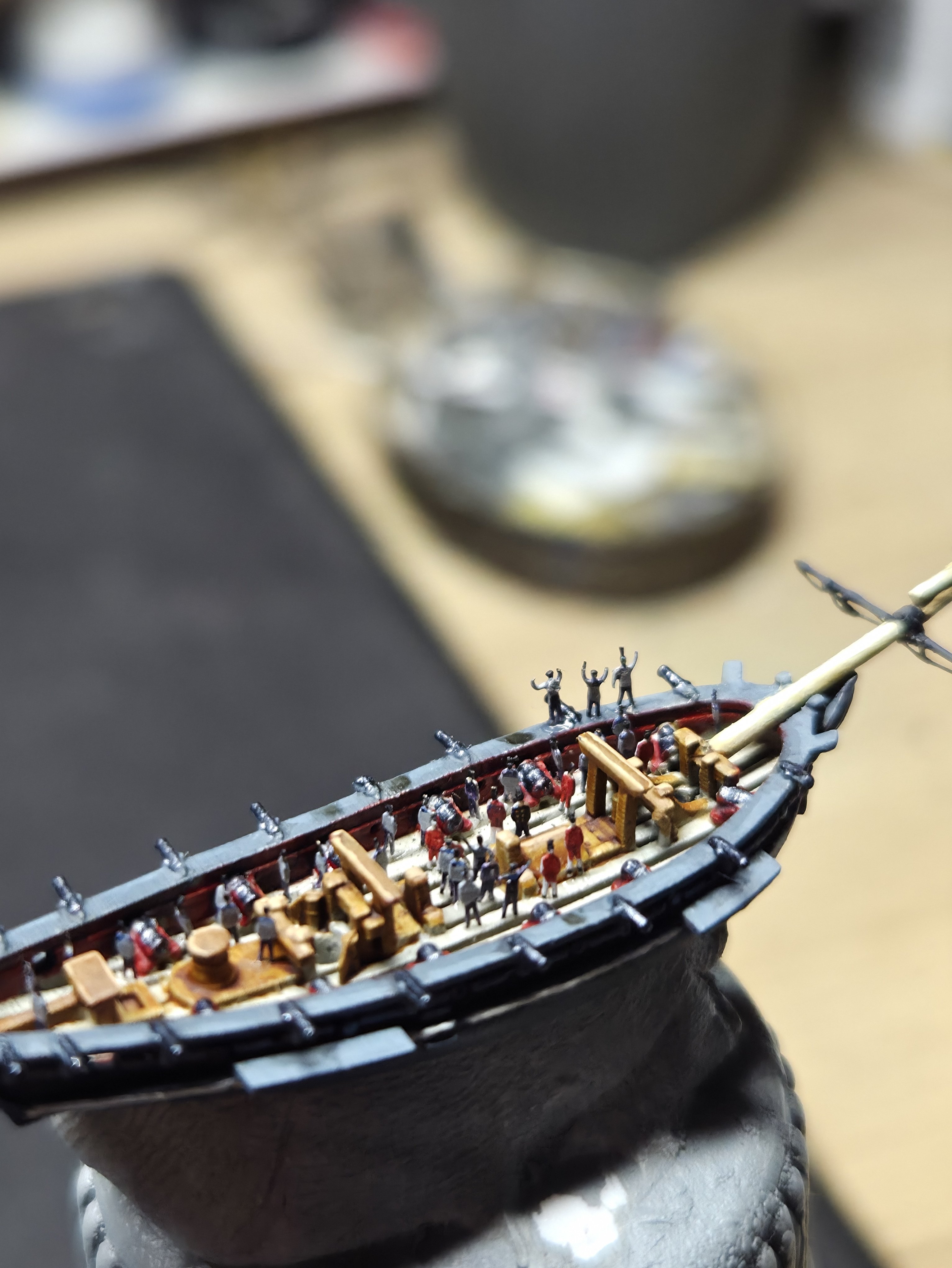

I also started crewing the HMS Speedy. The situation in my diorama does not follow history exactly as HMS Speedy boarded El Gamo on her starboard stern quarter. But for the dynamics of my diorama I have her more on El Gamos starboard fore quarter, I am thinking maybe after her first repelled attempt. I need to fit this entire diorama in a small glass so I decided to do it this way. there will be a few glimmer led with El Gamos guns firing over HMS Speedys deck, offcourse also smoke effects, made from wadding.
20250705_203351.thumb.jpg.29b4d42d6f4217fe01d437b94e218106.jpg20250707_003331.thumb.jpg.d16e0cfbcd5b7b9b8f969ea602b7da0e.jpg
This is the situation right now, HMS Speedy ready for rigging and sails, I think. El Gamo has received some small damage to her starboard side using mainly paints. She is now ready to receive some 200 tiny little photoetch crew. I will not give her her full complement of crew in this form as I suspect it might look to busy.

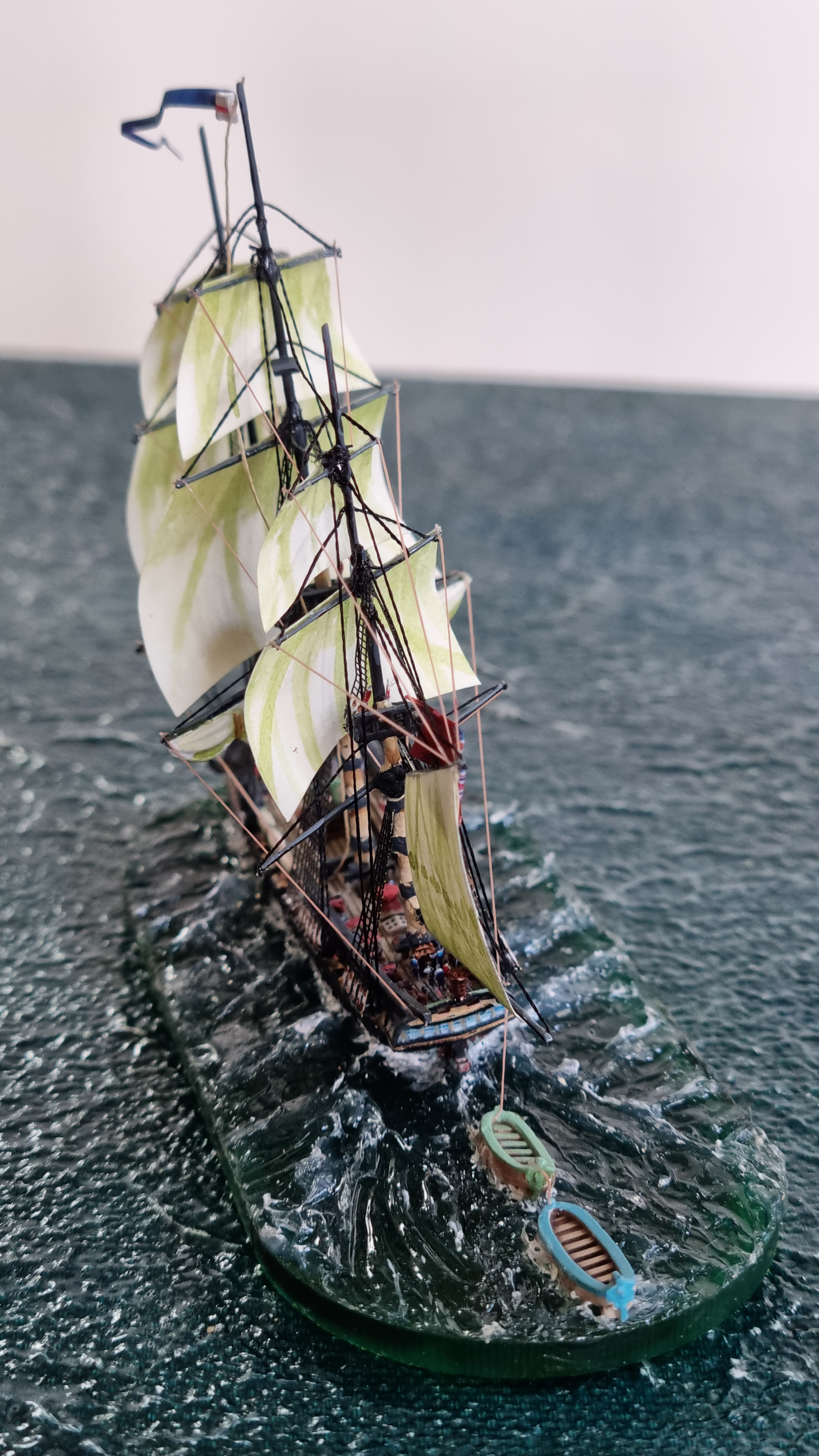

So these first are form the rigging of the models.

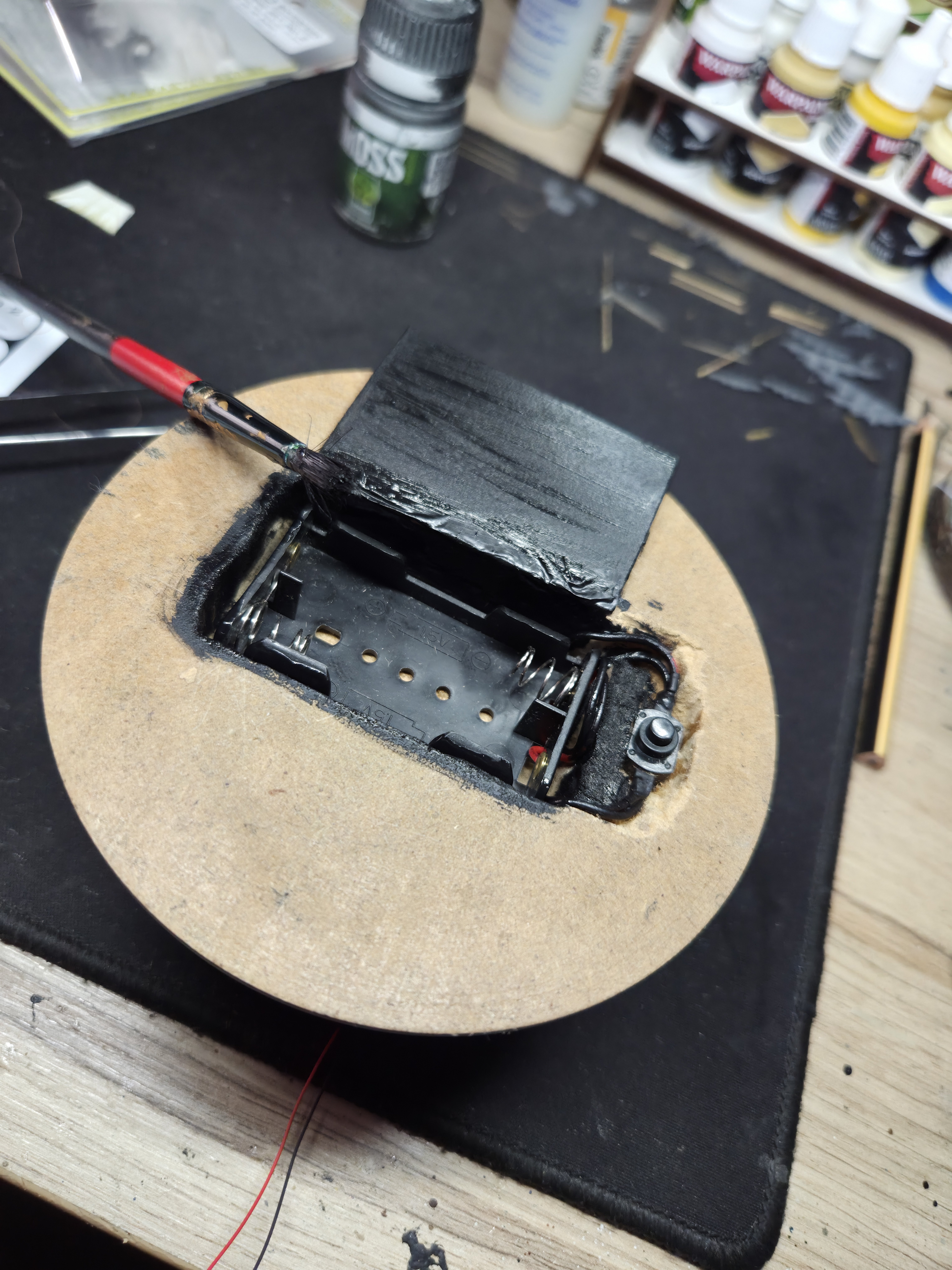

Then I fished up the base, first testing that my wiring worked.

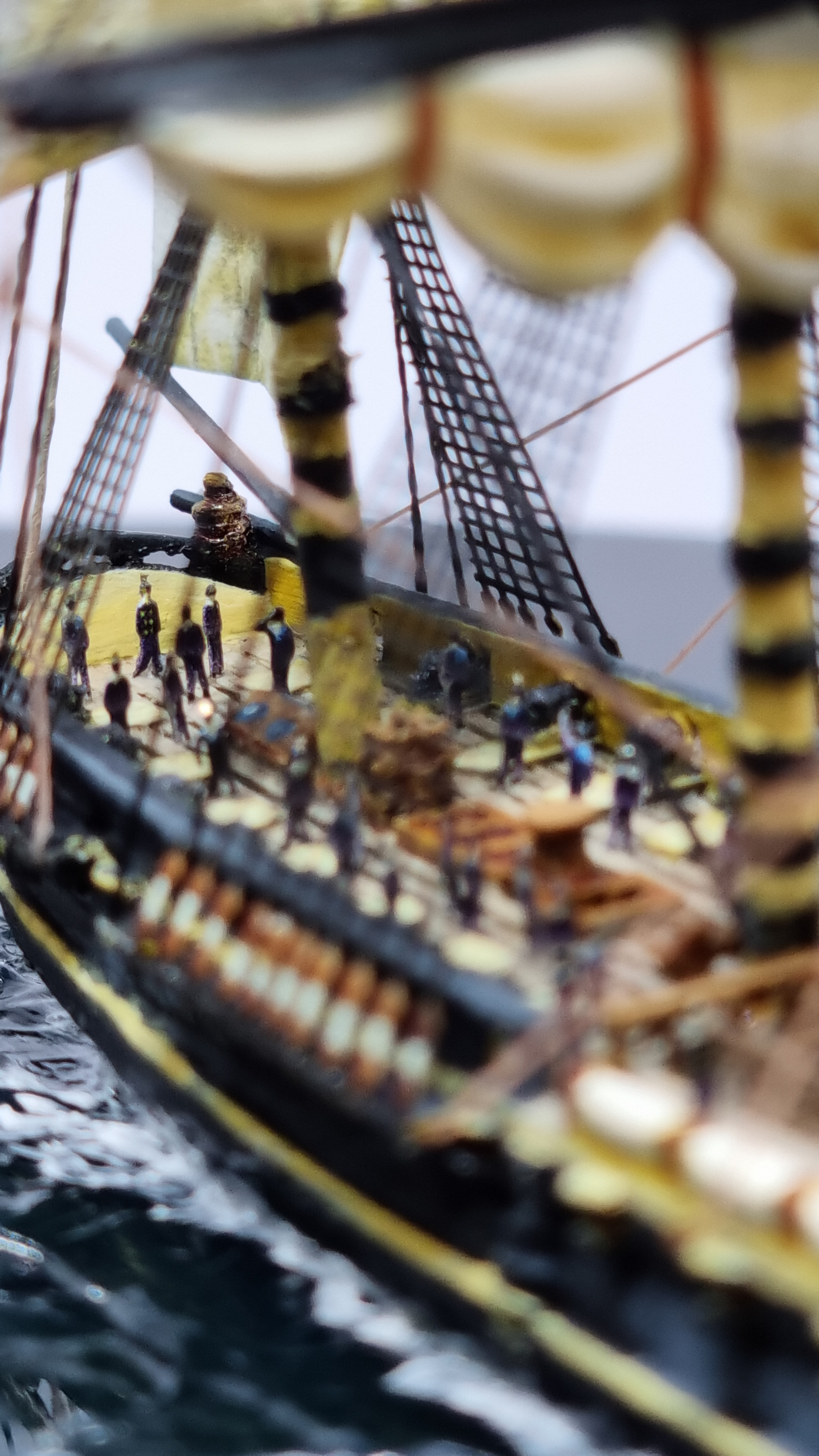

Then it was time to test mount and finally finish it up. I also did a photo shoot for another project, I used my tv screen as a backdrop.
20250718_092616.thumb.jpg.fbdd54f3d0cdc44eaac4281a3d235db8.jpg20250722_145508.thumb.jpg.945b34200d81946a129a0c0f405b2448.jpg20250722_145145.thumb.jpg.70a24e0cff353b91c33079299a4dce1a.jpg20250722_144714.thumb.jpg.1f4fa867beb544994172be0b4fe4fcab.jpg20250722_143619.thumb.jpg.8e760cdb41231268df93e903824e5f10.jpg20250722_142457.thumb.jpg.70c90a227b6feaa131e0b16d93aba366.jpg20250722_145618.thumb.jpg.54af878de0d68b05e32e2dec18526b52.jpg20250722_141122.thumb.jpg.50d898ae00296ede1977b4c4758a27ed.jpg
It was really a lot of work, not like one of the large wood models for sure, but I did spend basically my whole summer on this, hours and hours, the running rigging from the 0.01 mm brass was madness. But I hope you all will agree that it turned out ok in the end.
