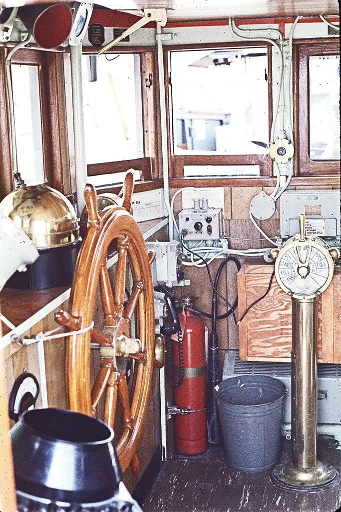

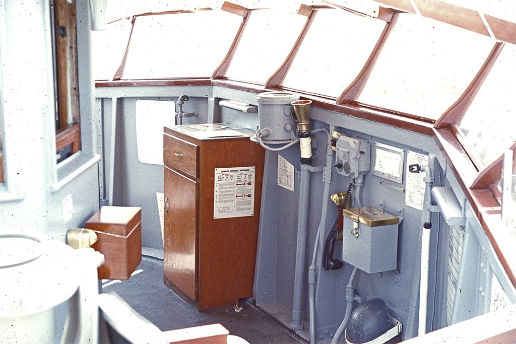

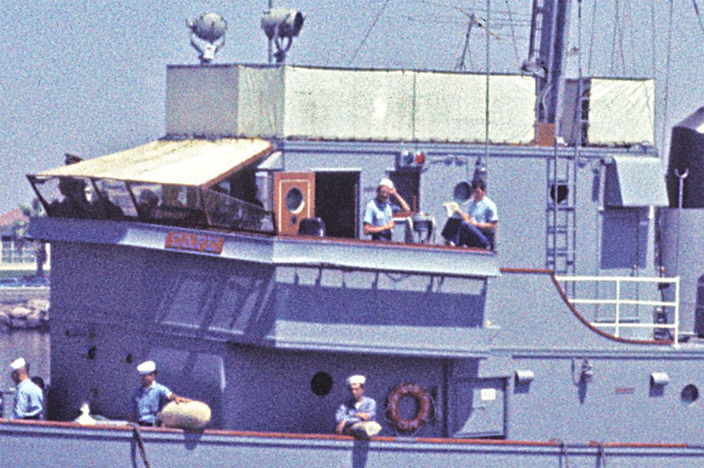

I am modeling a wooden minesweeper. Most of the ship was made of Douglas fir - timbers, planking, plywood, etc. However, it had a lot of mahogany trim.
mahoganytrim.jpg.fbf75a50da6fb860930c78137877fb56.jpgBridge.jpg.a94db3bf56d39d1737de6aae7779677e.jpg
Pilothouse.jpg.74b8055f290548029c06c3c016e0c7c9.jpgThe doors, windows, door frames, window frames and quite a bit of other parts were made of mahogany.
I only need a small amount of wood for the trim, and I can't cut my own scale lumber. So my question is what other more common woods would make a good substitute?
