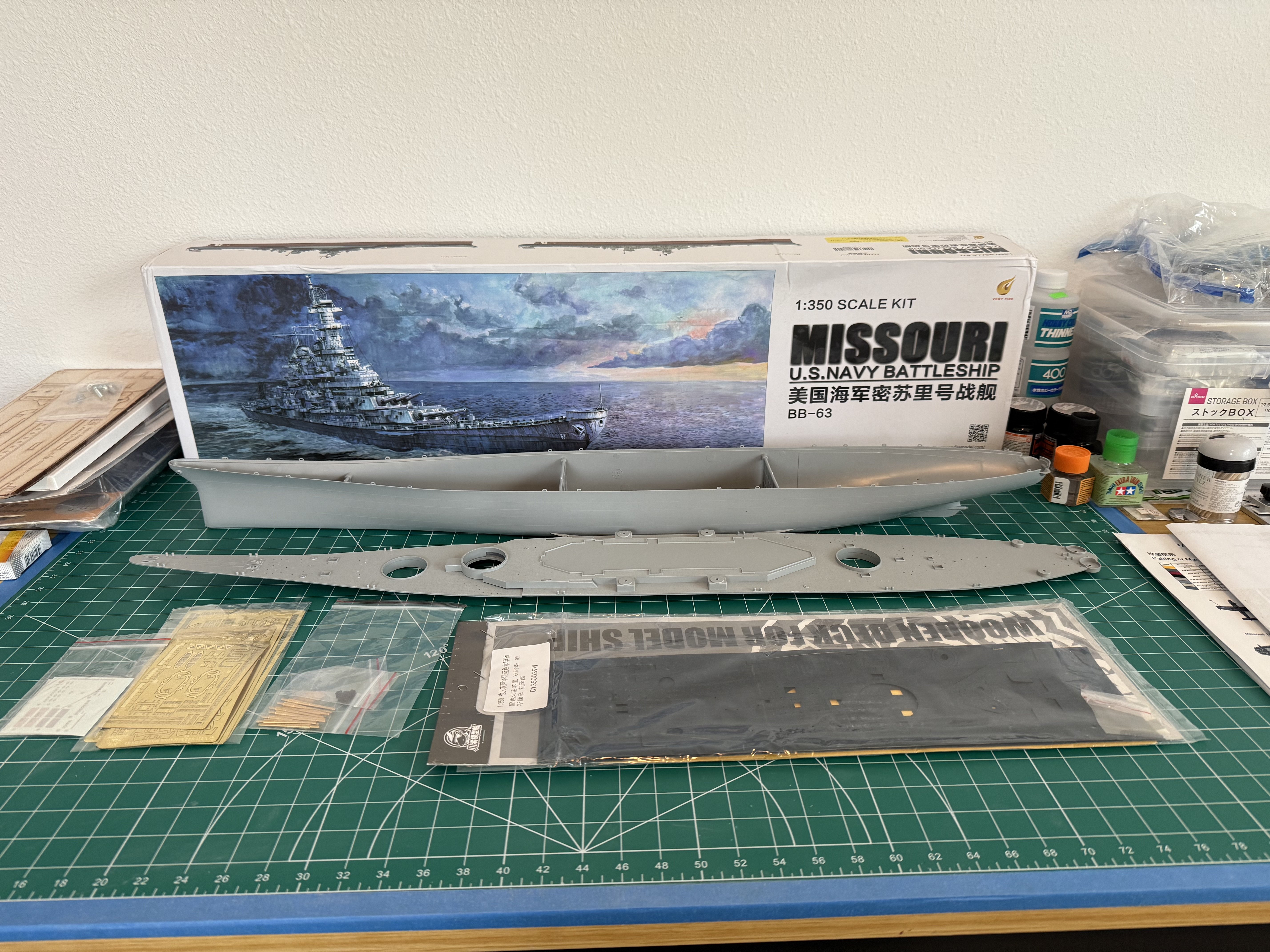

Hello everybody. I’ve been building models off and on for 10 years or so and after a 4 year break I’m back with my first ship in 1/350 scale. I’ll be doing the typical new guy thing and going way above my knowledge and skill level incorporating resin, wood and photo etch parts in this build.

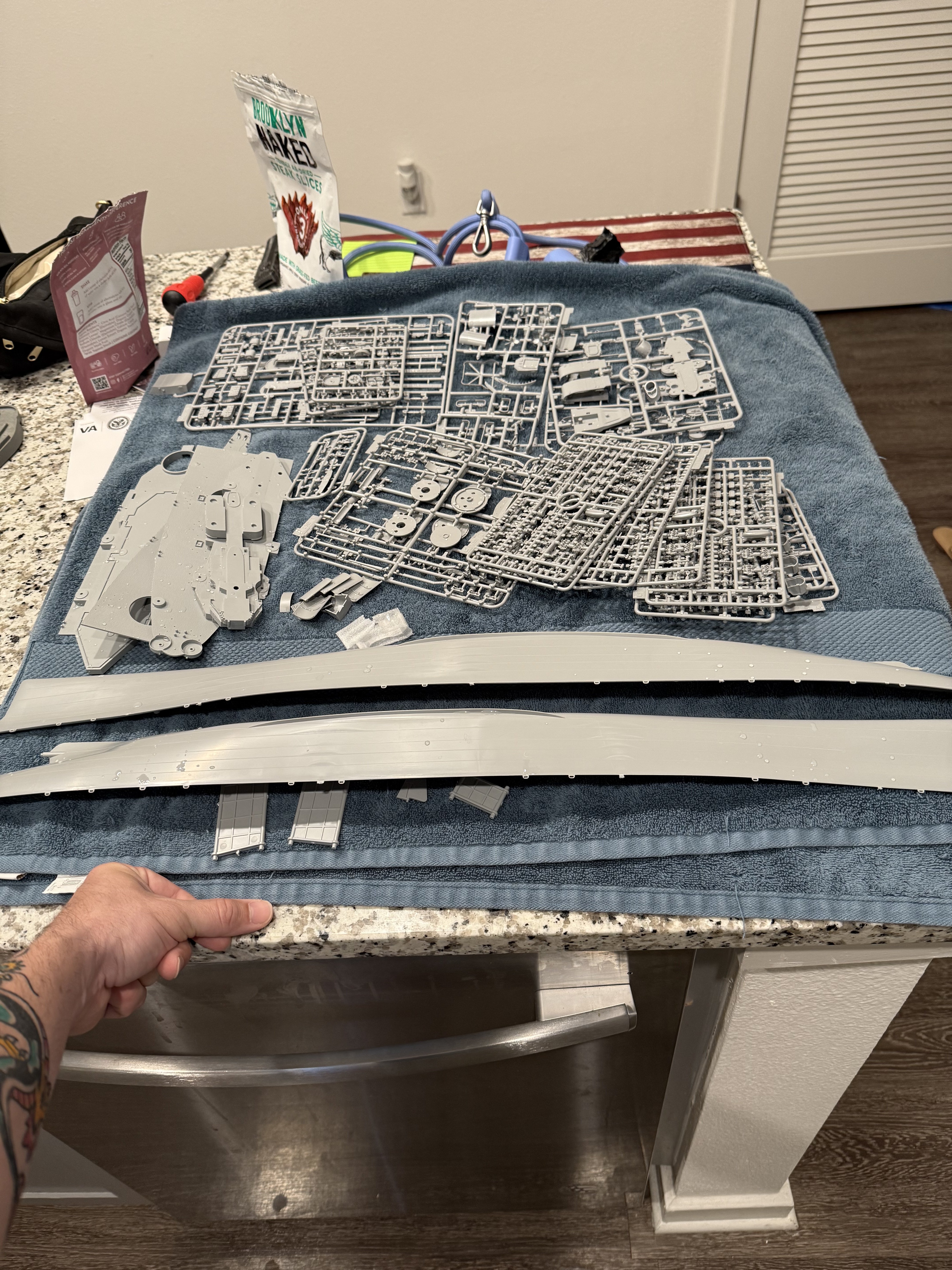

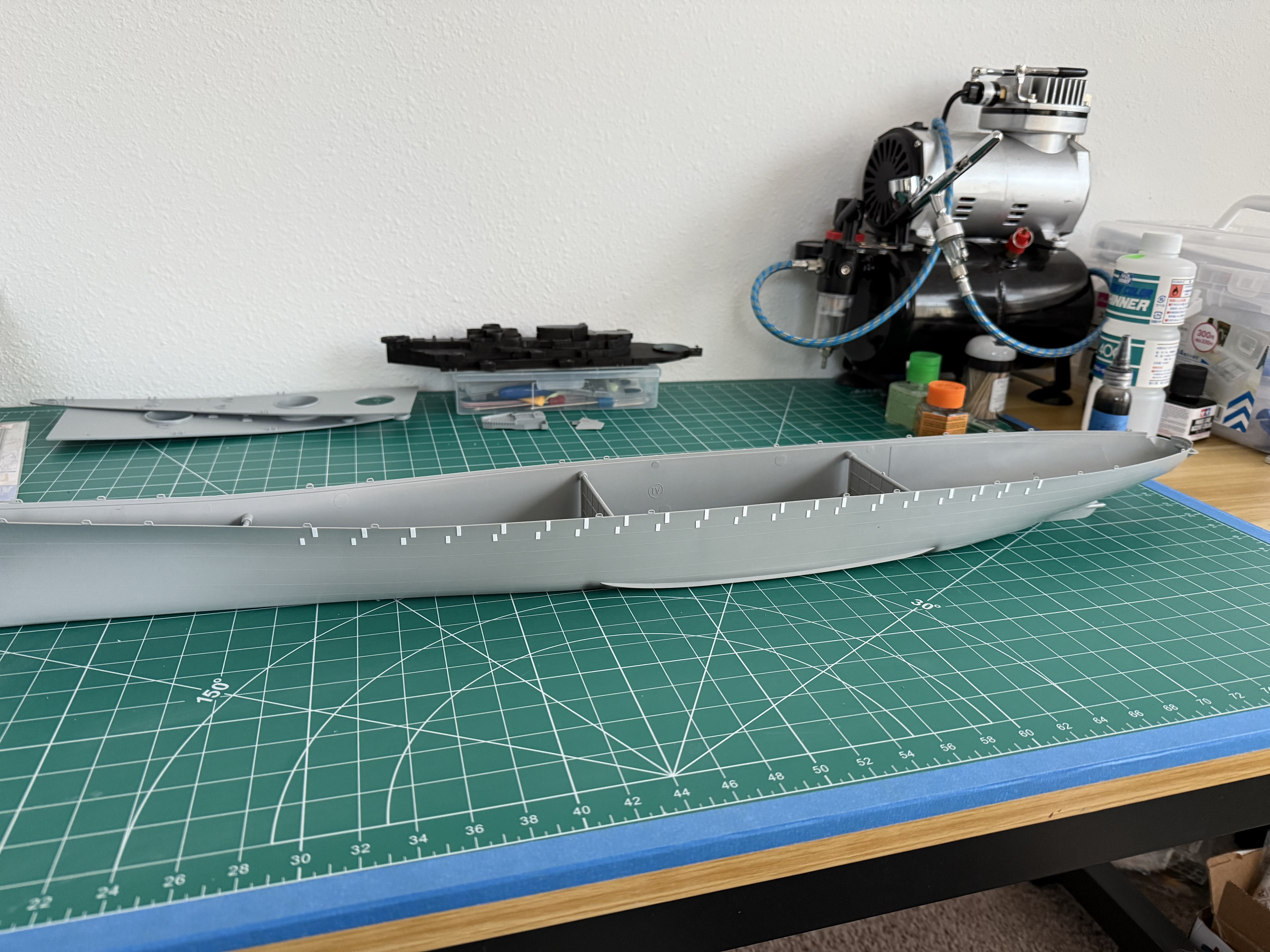

starting first off with a nice bath to clean all the parts of injection molding left over and my finger prints.

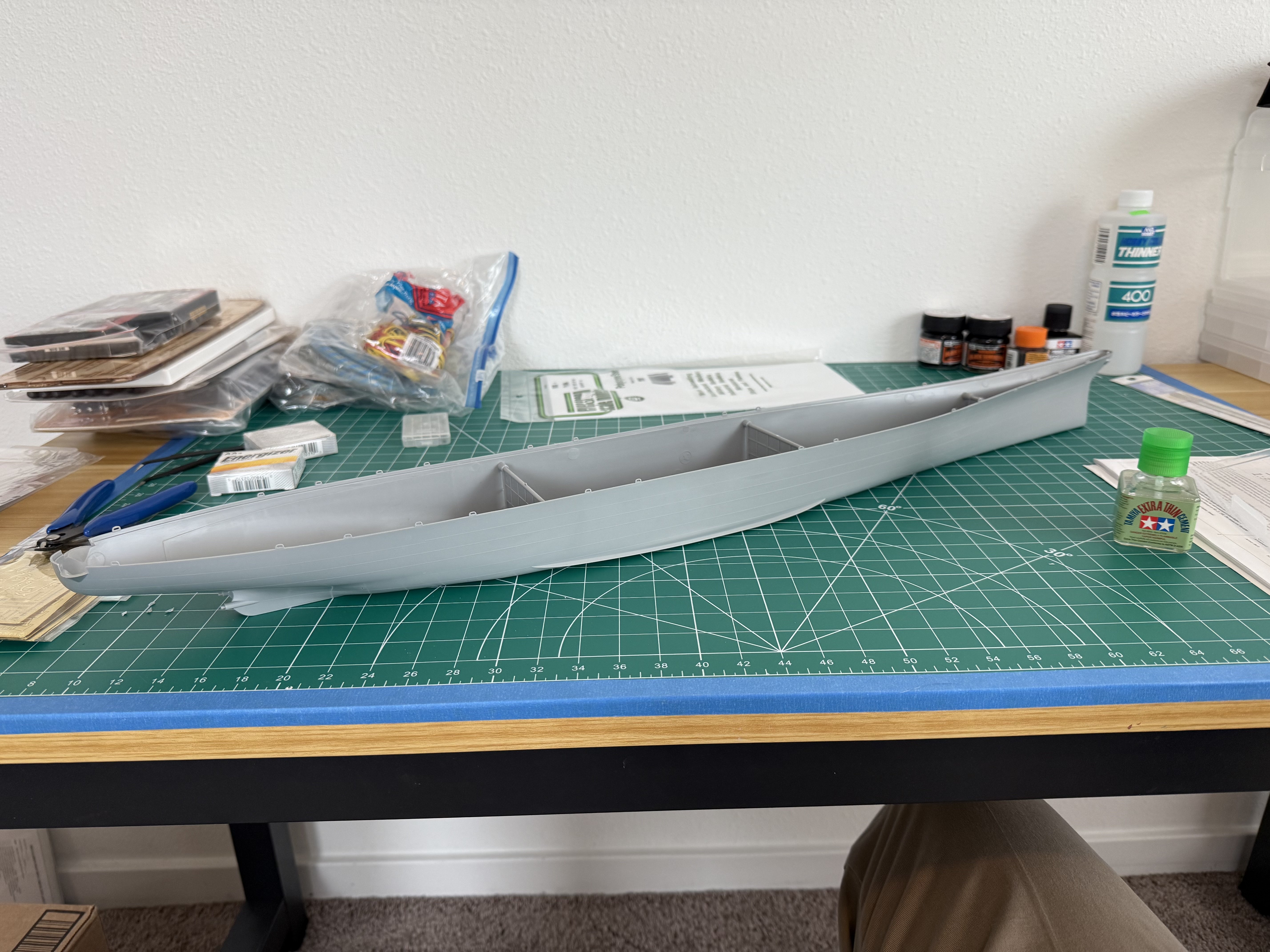

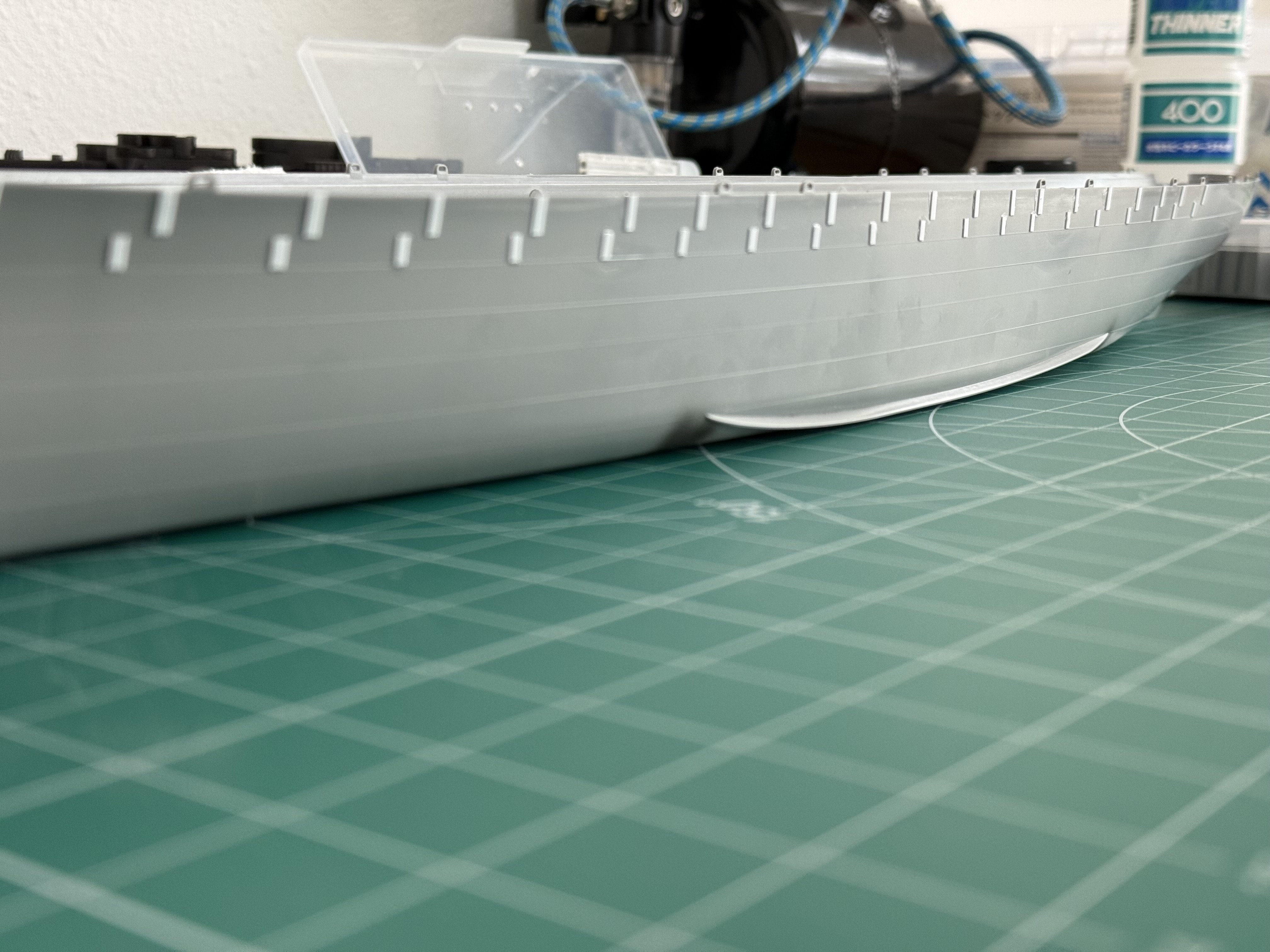

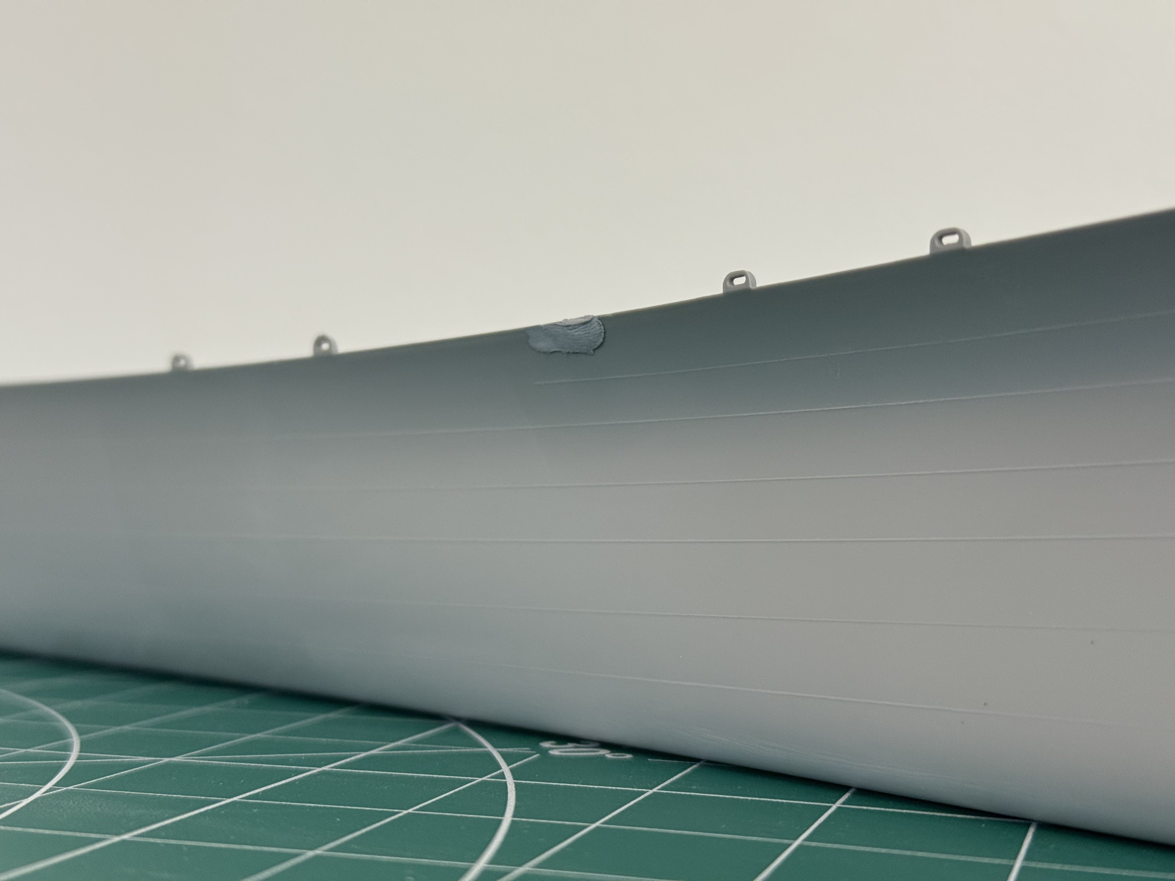

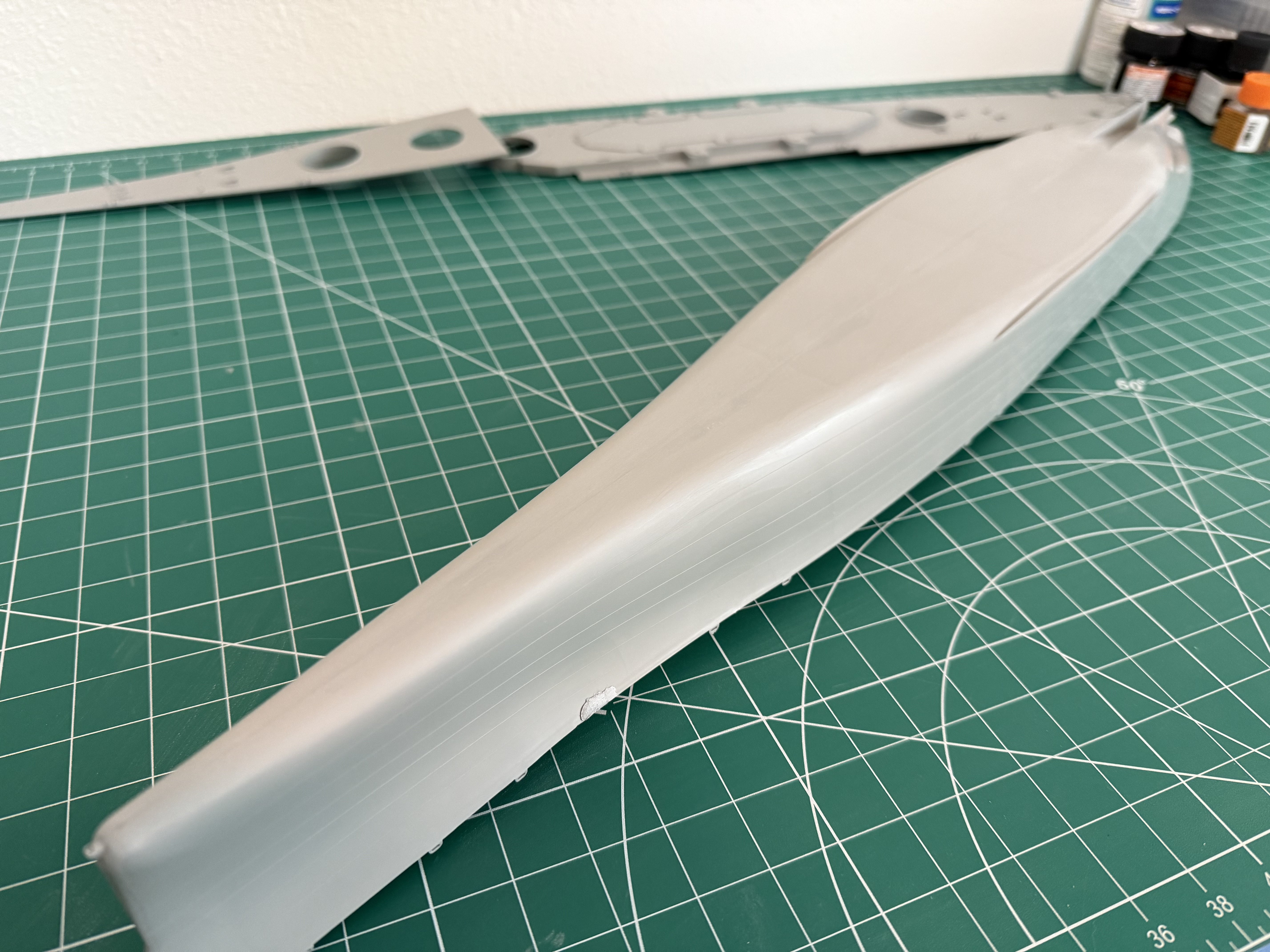

i started off with the hull. Filling and sanding the seems and a small l spot where the sprue broke the hull, which appears to be common on this kit.

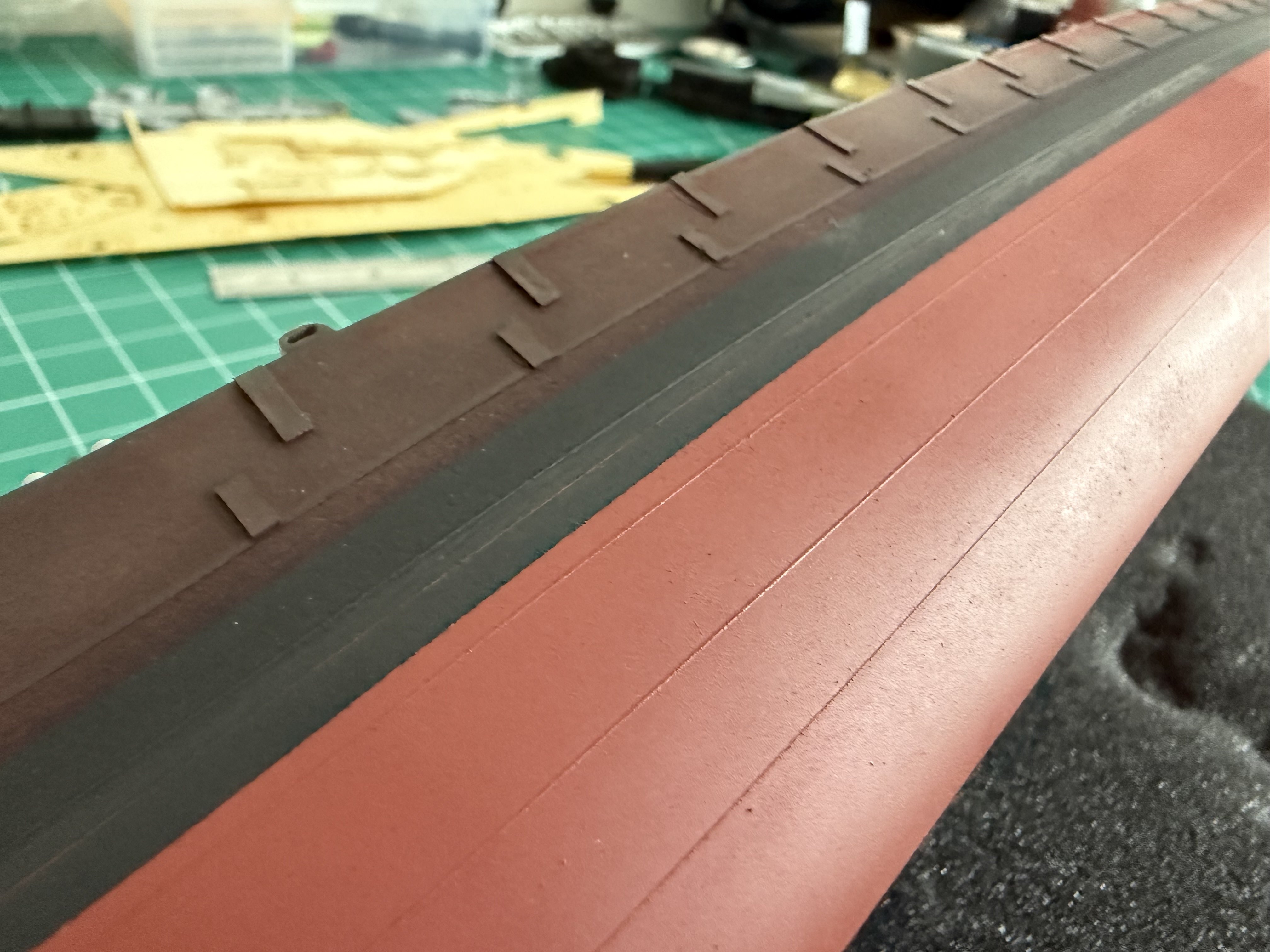

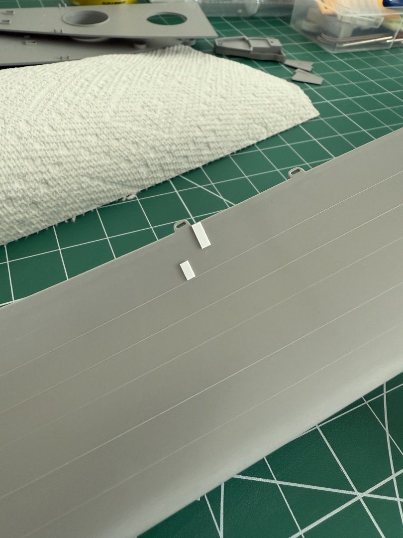

I attempted to add the armor plates along the hull. At the time I thought .10 would be about right, but after the fact I realized they were too thick and not to scale. Live and learn. note: I made a booboo and got some stitches here. IMG_6801.thumb.jpeg.41f8f1f70a1616a971aafc69f9d129ea.jpegIMG_6802.thumb.jpeg.c1afa0f3aace4b86ebff93441bb1454b.jpegIMG_6806.thumb.jpeg.00909c68e8bf07b23a045cf8f807ef75.jpegIMG_6804.thumb.jpeg.9a7410a7a1a1669e91c3a63eb0c14684.jpeg

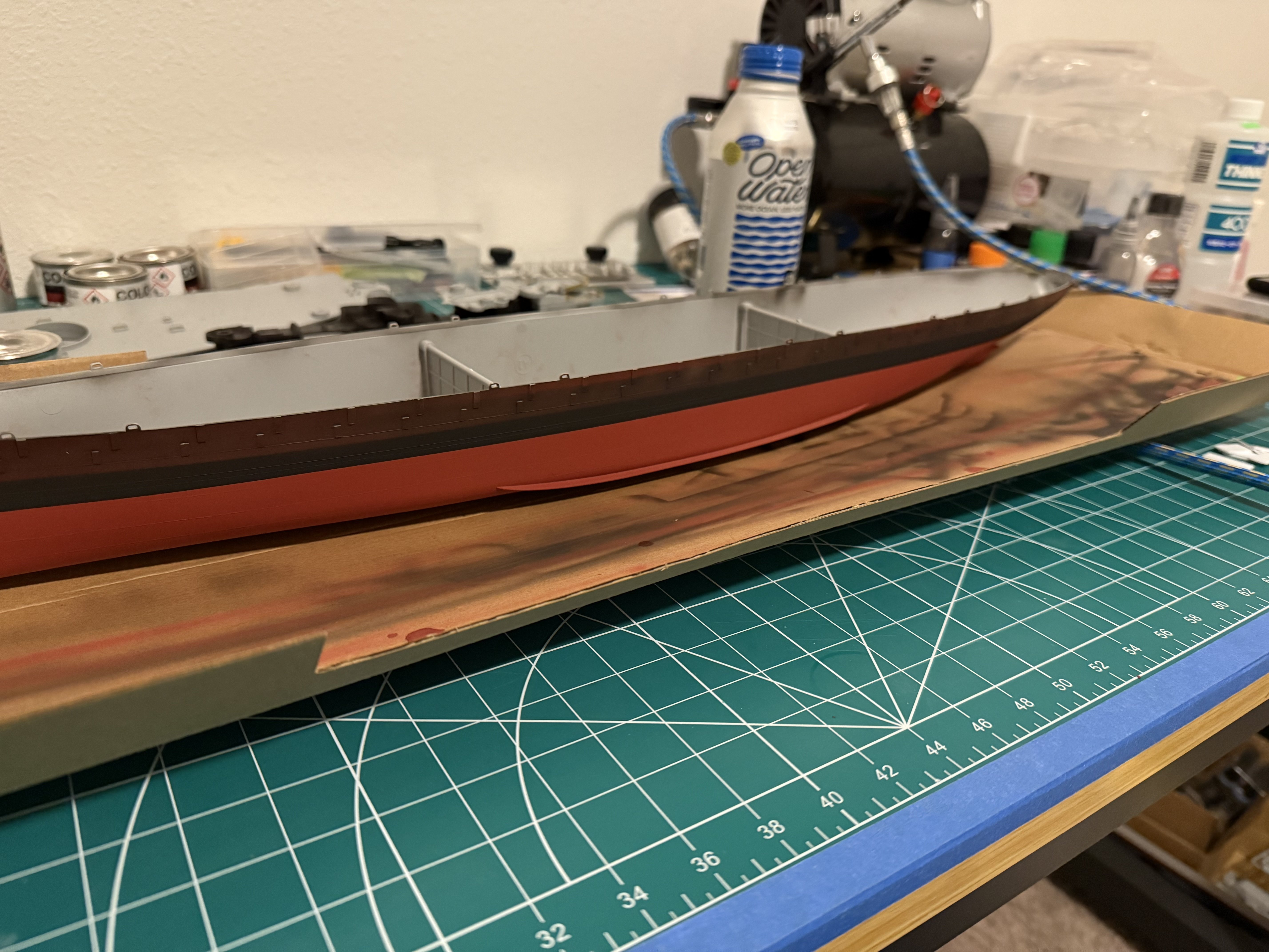

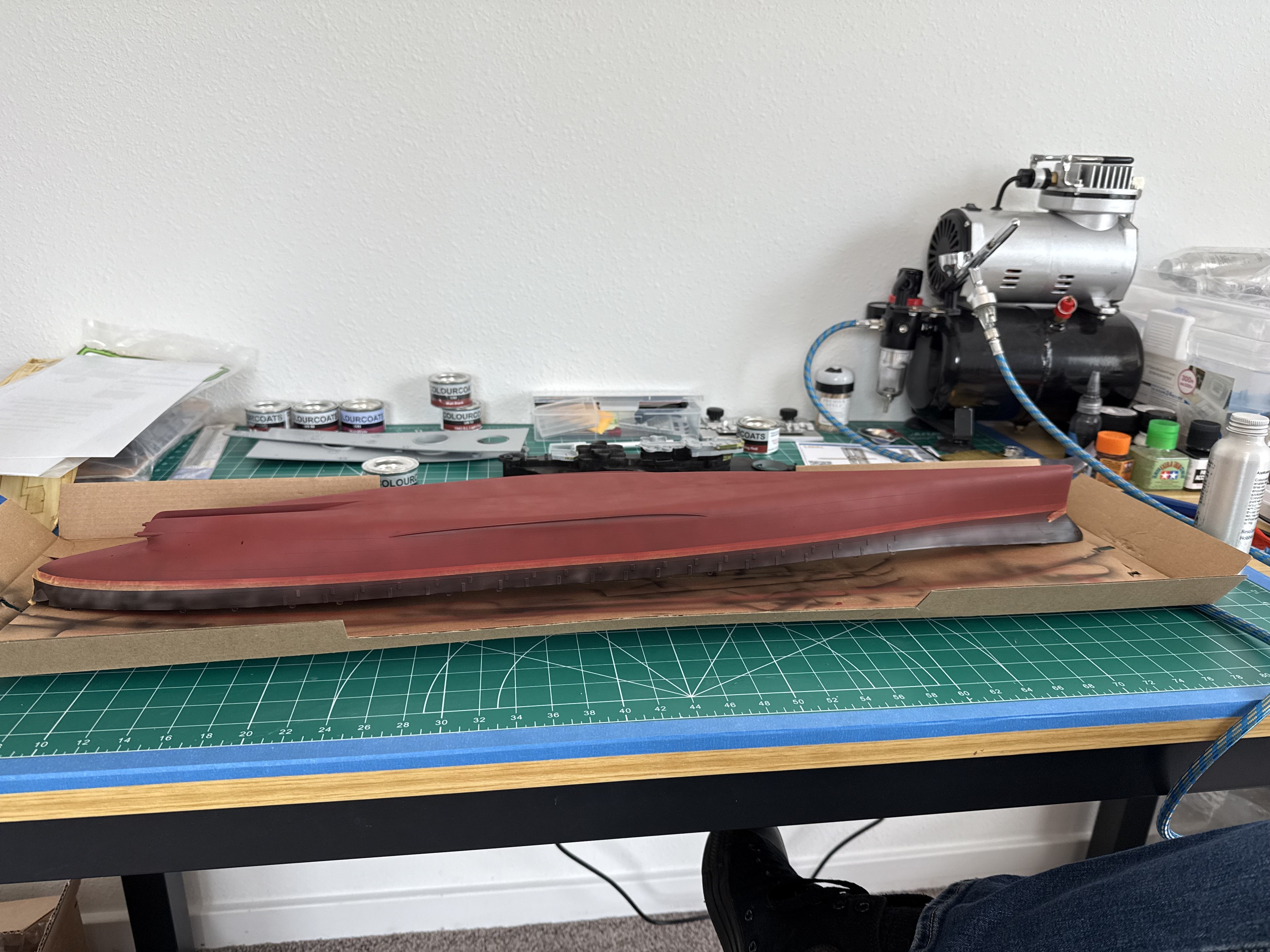

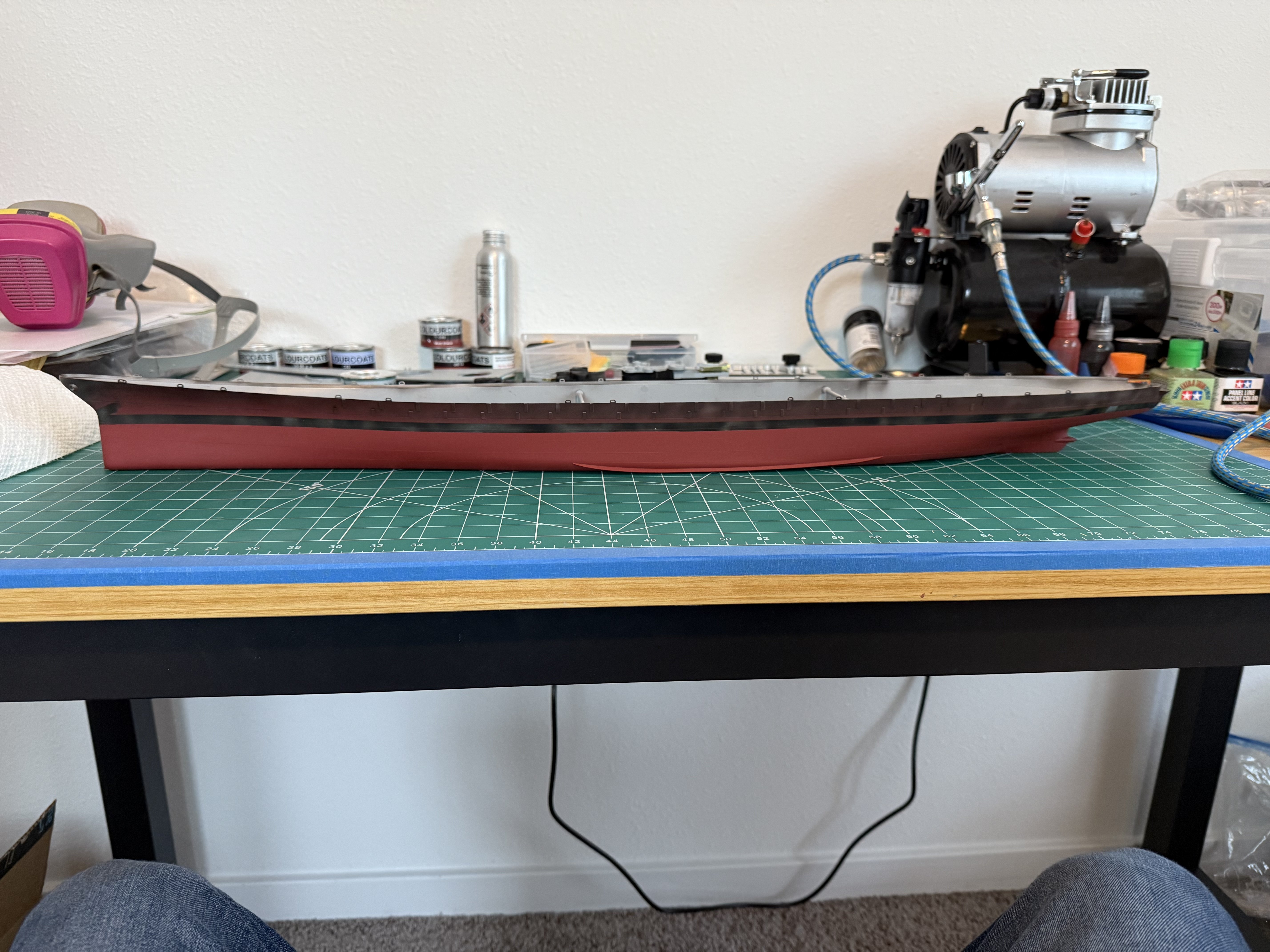

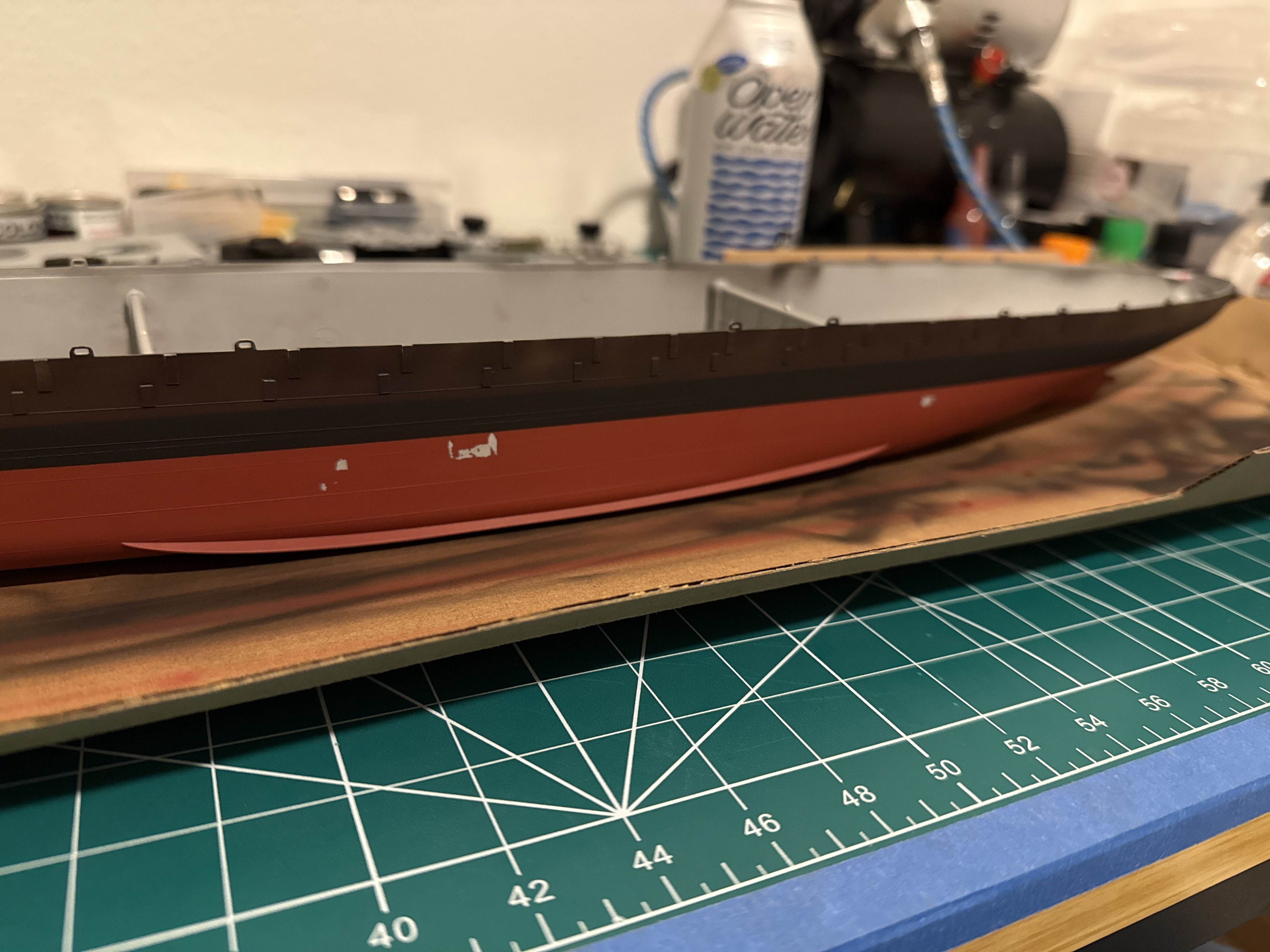

next I primed the hull and started working on the hull red using white ensign models Norfolk 65 hull red. IMG_6827.thumb.jpeg.c5cbc002d4fcb8fda8fb352edecf1720.jpegIMG_6829.thumb.jpeg.dbc2f4e755da6f1c0800867d558c075d.jpegIMG_6830.thumb.jpeg.d0fb7e928e0532da37d8424fa24f688a.jpeg
I thought 14 hours would be enough time to dry or maybe it was just a bad primer spot, but I had some paint pull while doing the boot stripe.

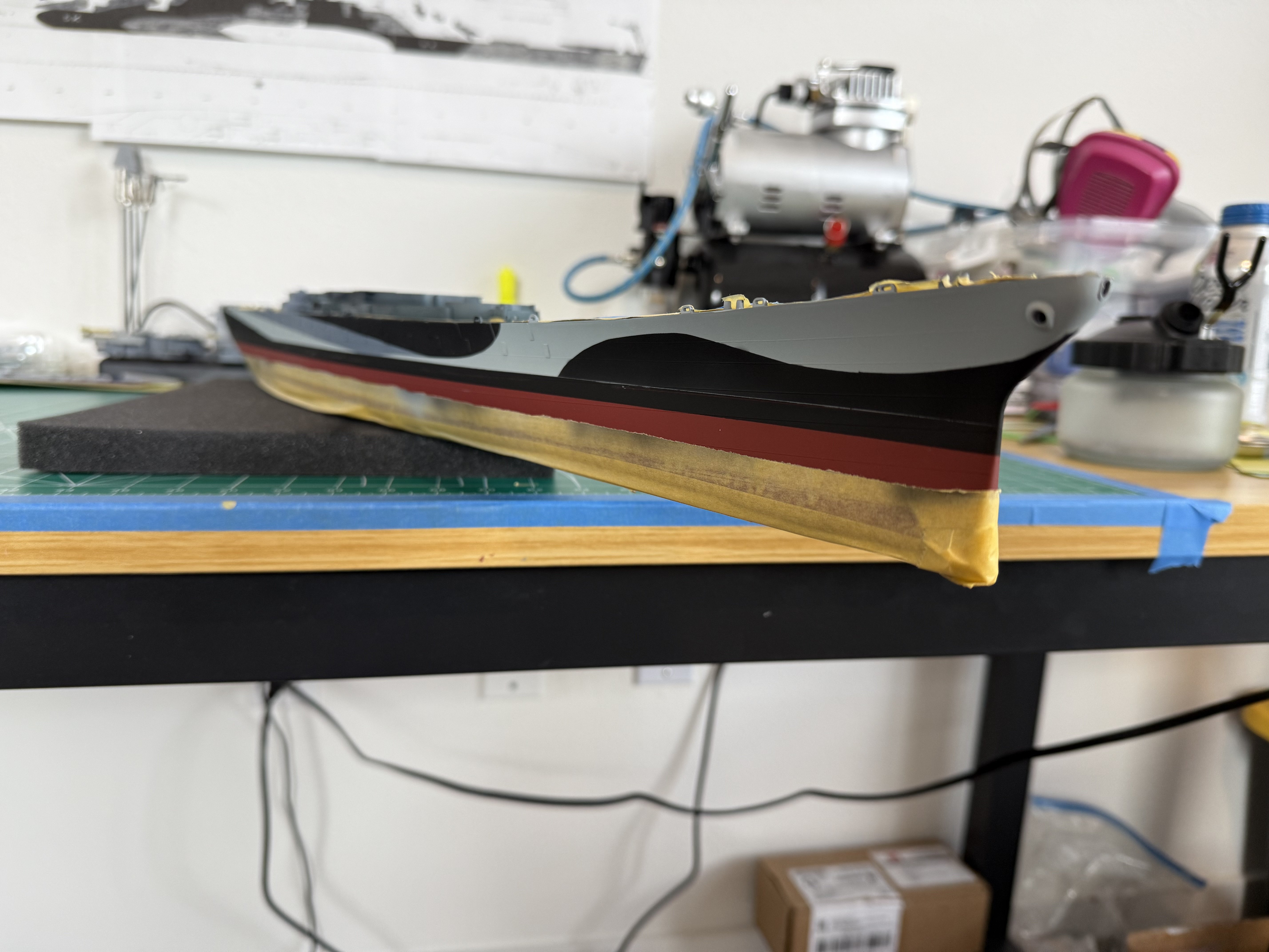

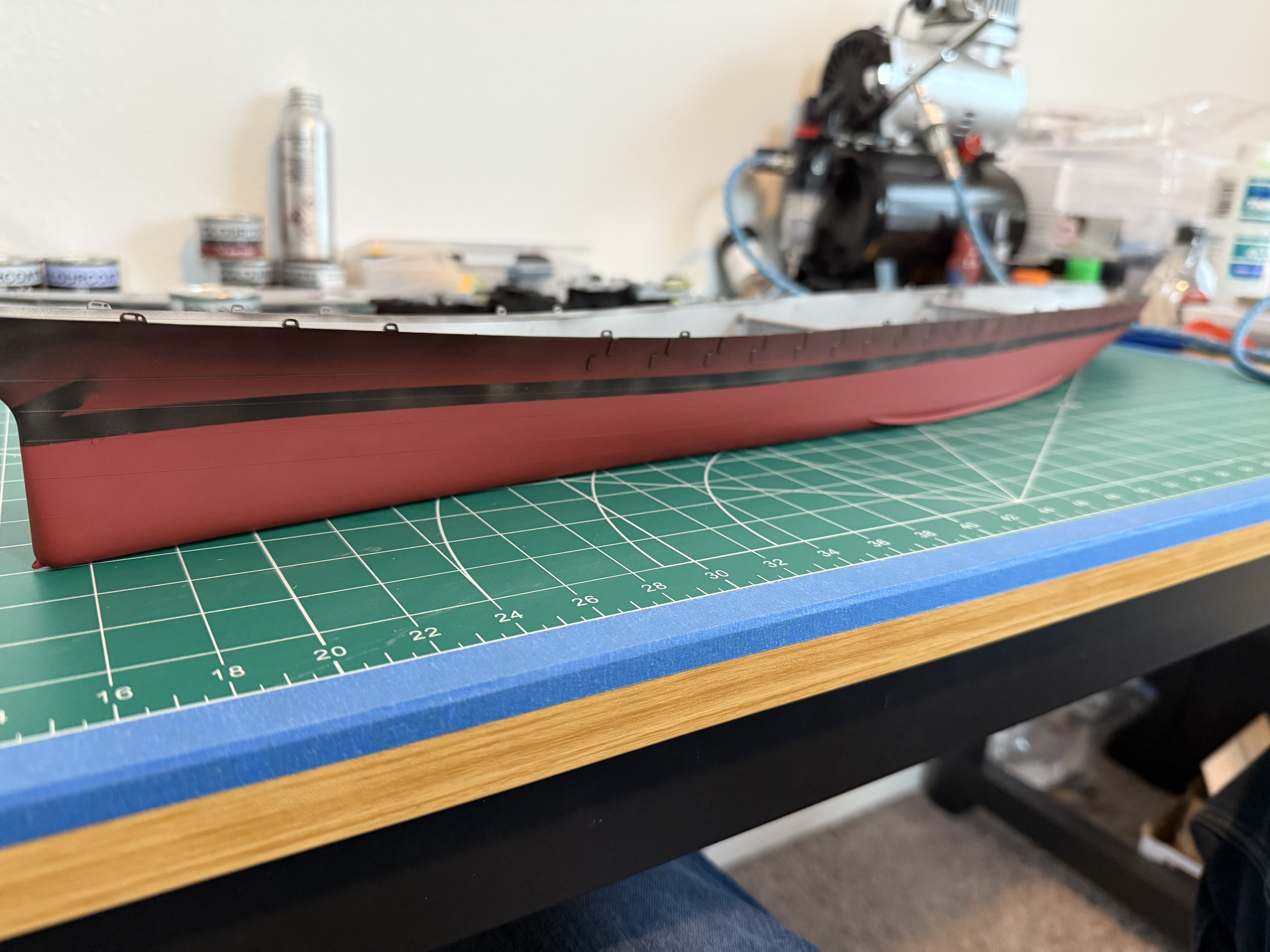

i took a moment to look things over and wasn’t super happy that there was paint lines from the hull red under the boot stripe so i used an #11 blade to scrape it down. I’ll touch this back up after the camo pattern is on. I also added some nuts for brass display stands. att.2gw3i5sMhW4aOcMQwMoo1fGhEwTotLxDvFIbzGksYic.thumb.jpeg.540e414ff3aa5ac32d85b1049a1dc967.jpeg
IMG_6862.thumb.jpeg.6fa682a4a8c7476b2ff8a55b86dd573a.jpegIMG_6863.thumb.jpeg.5aa30b9e981bb5dd209b6155fe37476d.jpegIMG_6904.thumb.jpeg.e06e4e41c6a677b8eba7d9dcd7ead267.jpeg

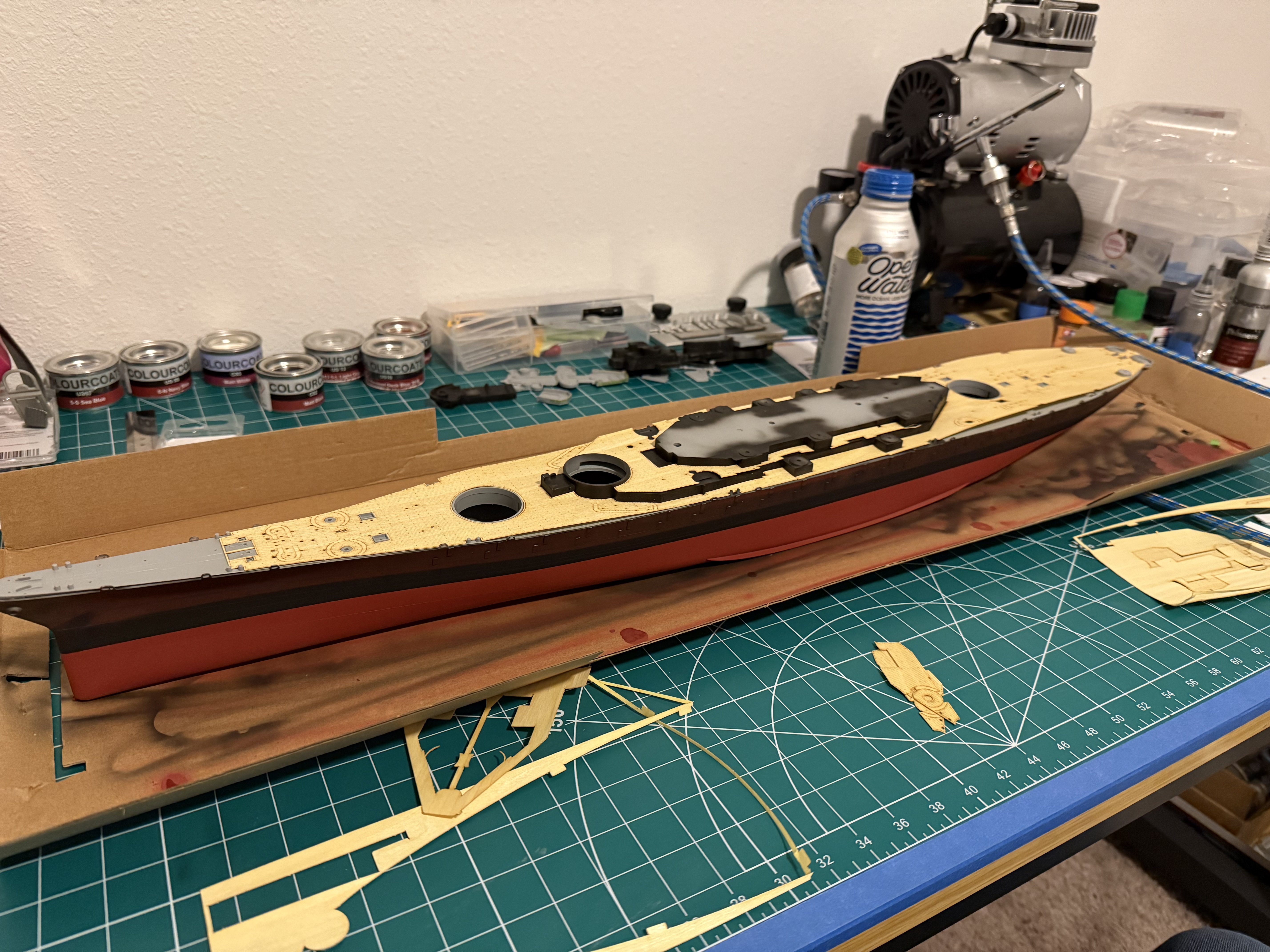

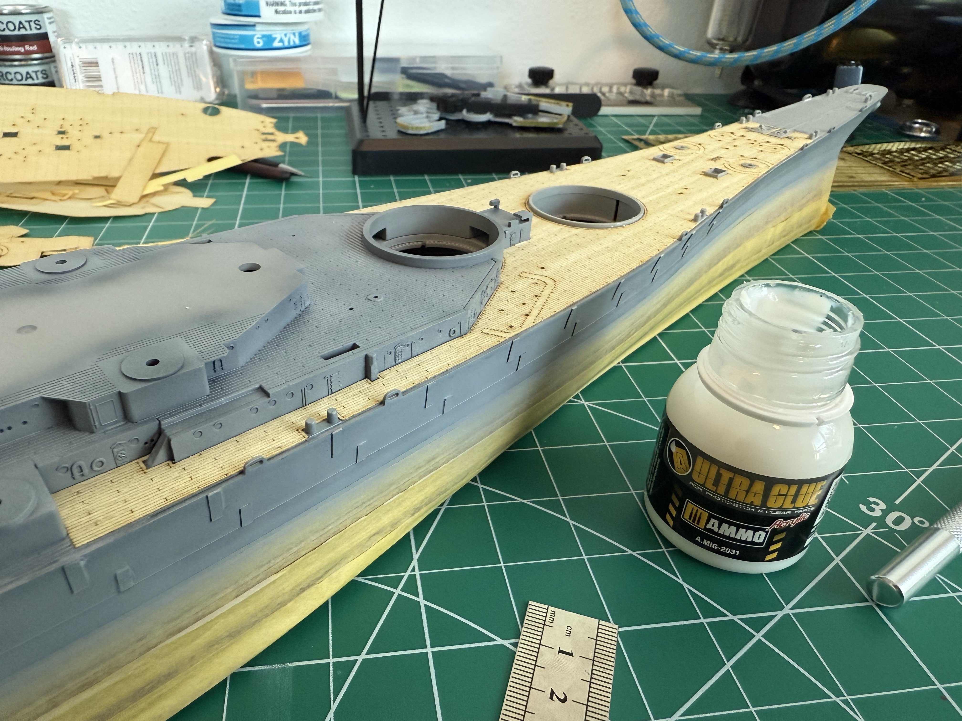

I got the deck mounted, primed, and started gluing down the wood deck.
IMG_6906.thumb.jpeg.2c987986b9b7ee15eb8c56f74cfcd6eb.jpegIMG_6911.thumb.jpeg.7f71847eba34f77216f05fc1b5c1b311.jpeg

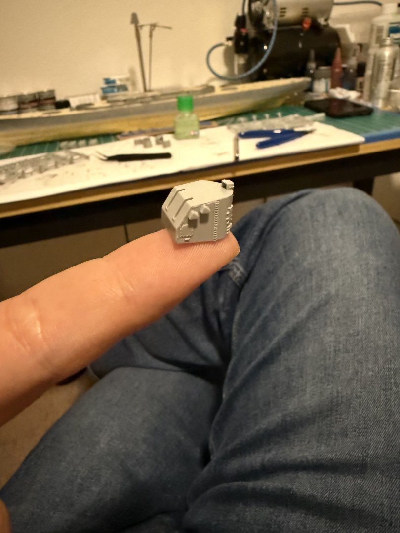

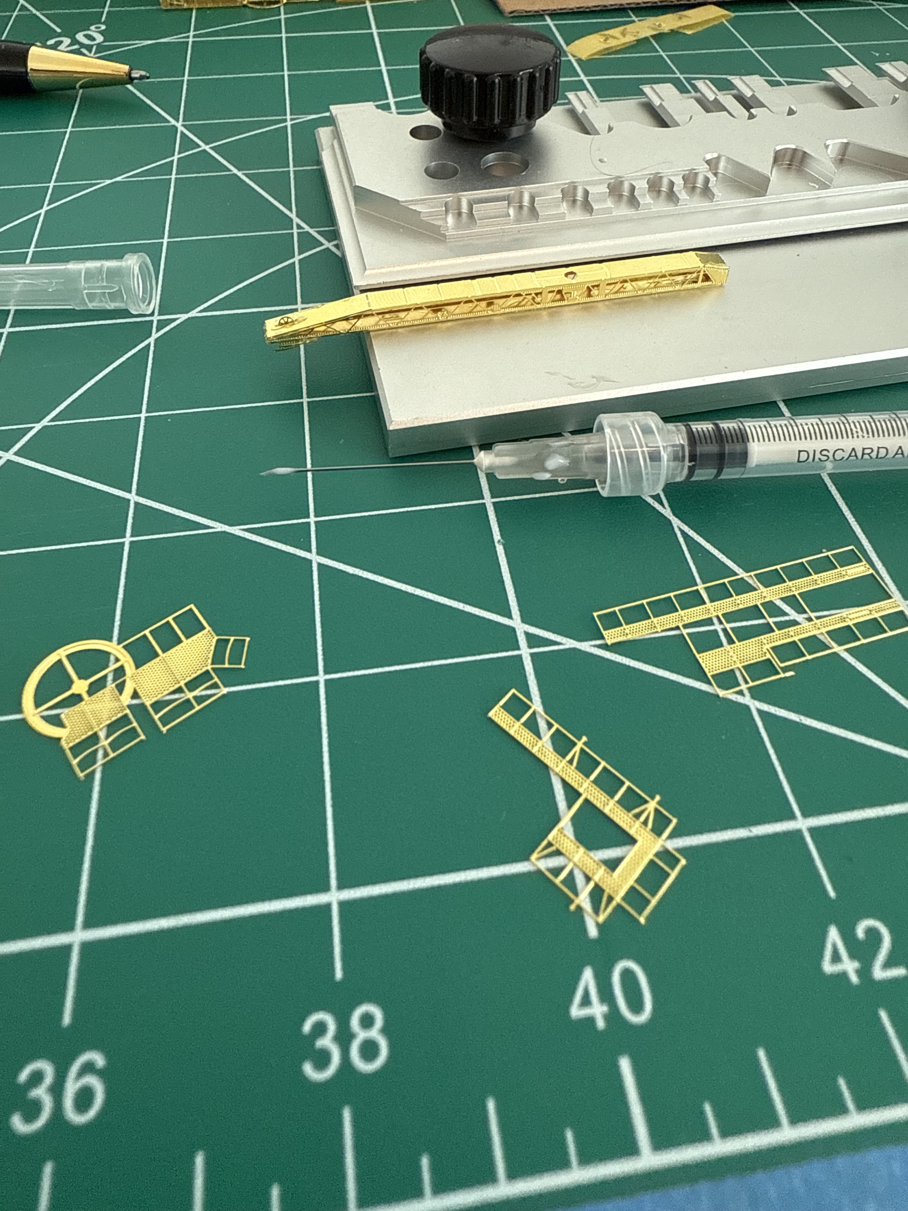

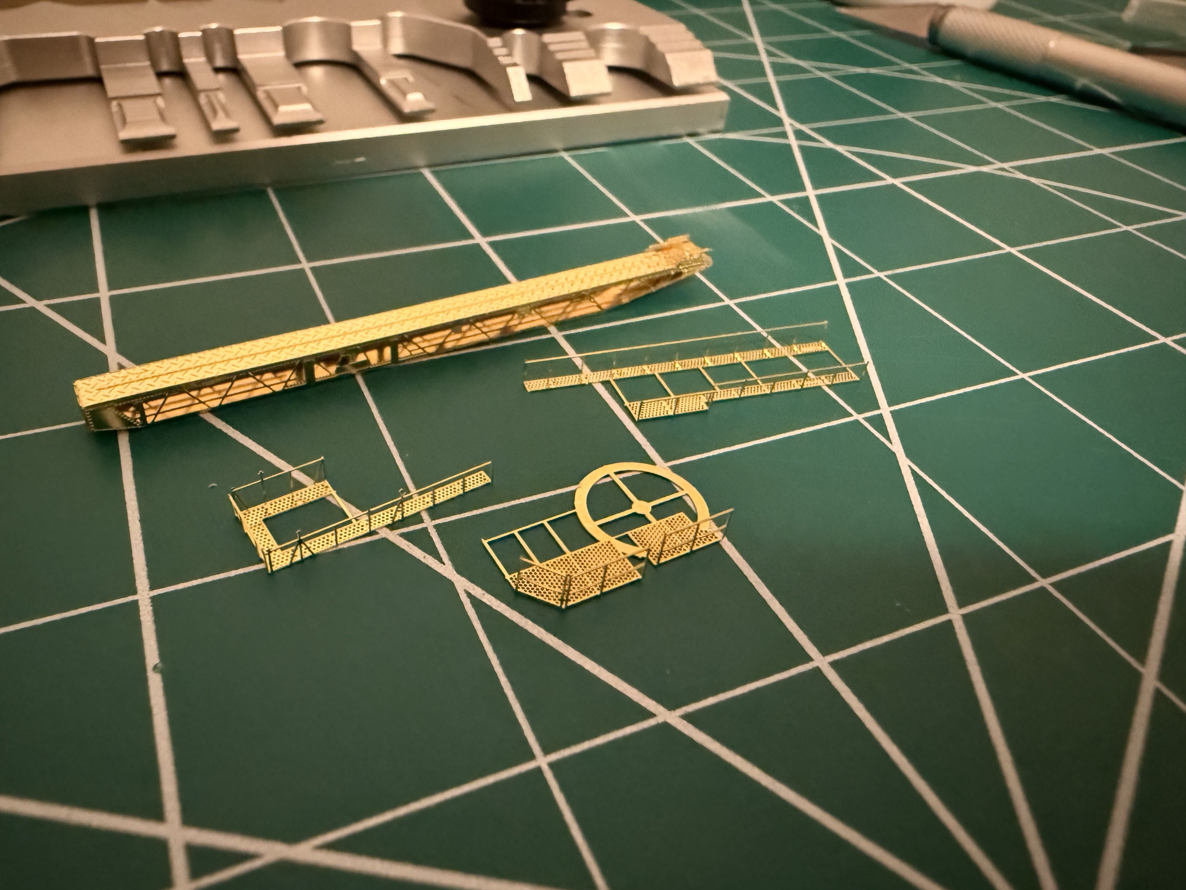

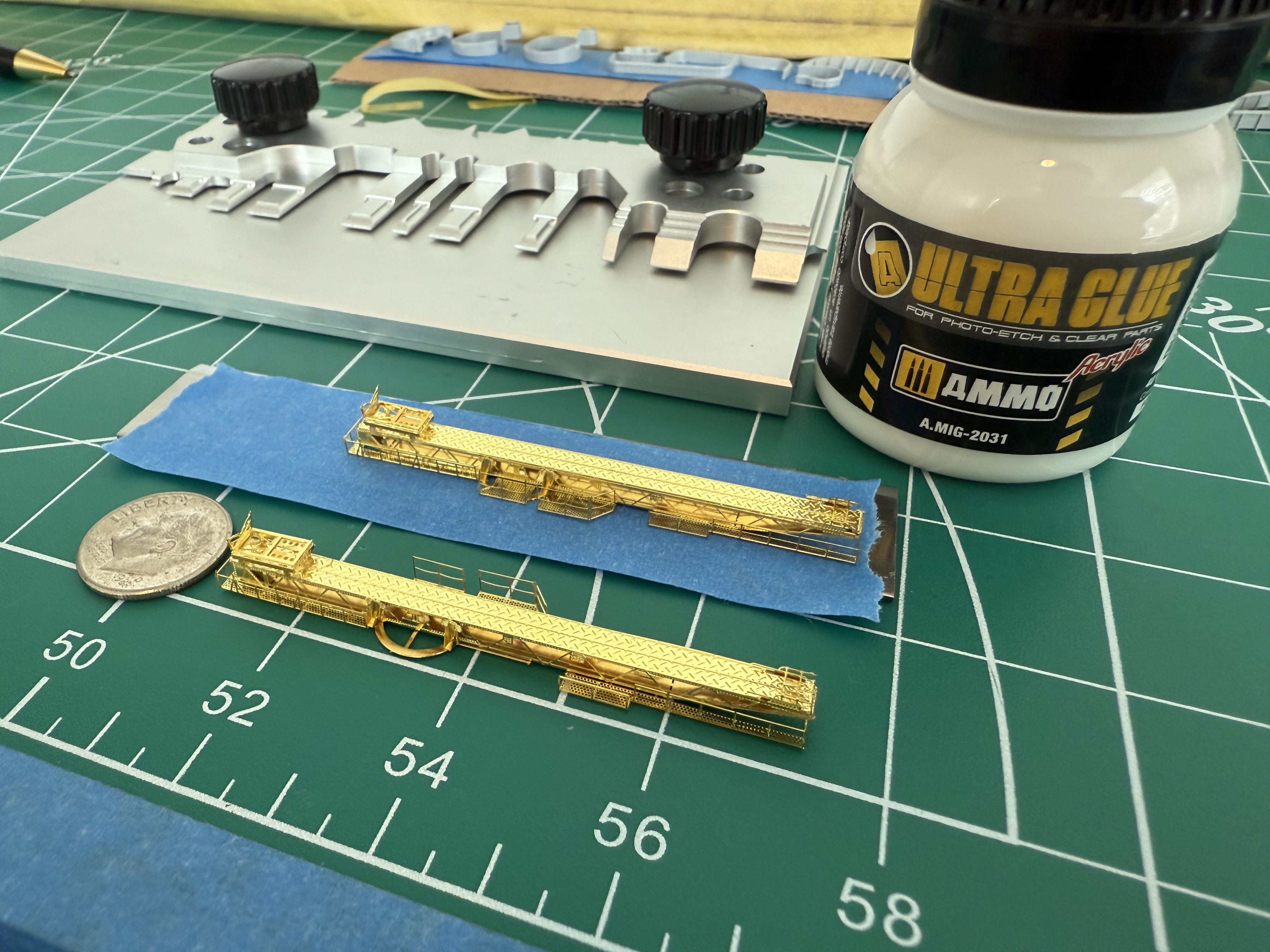

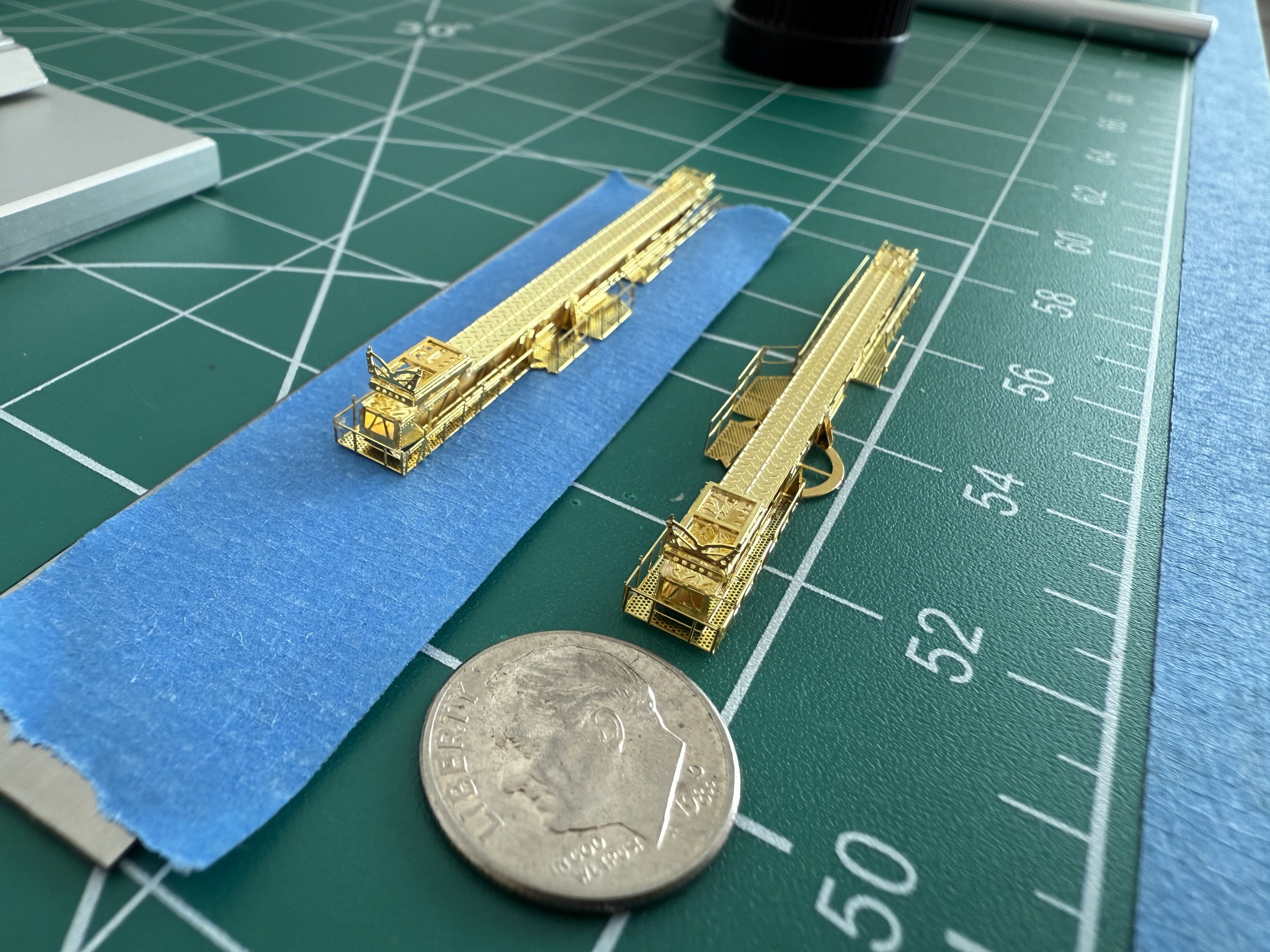

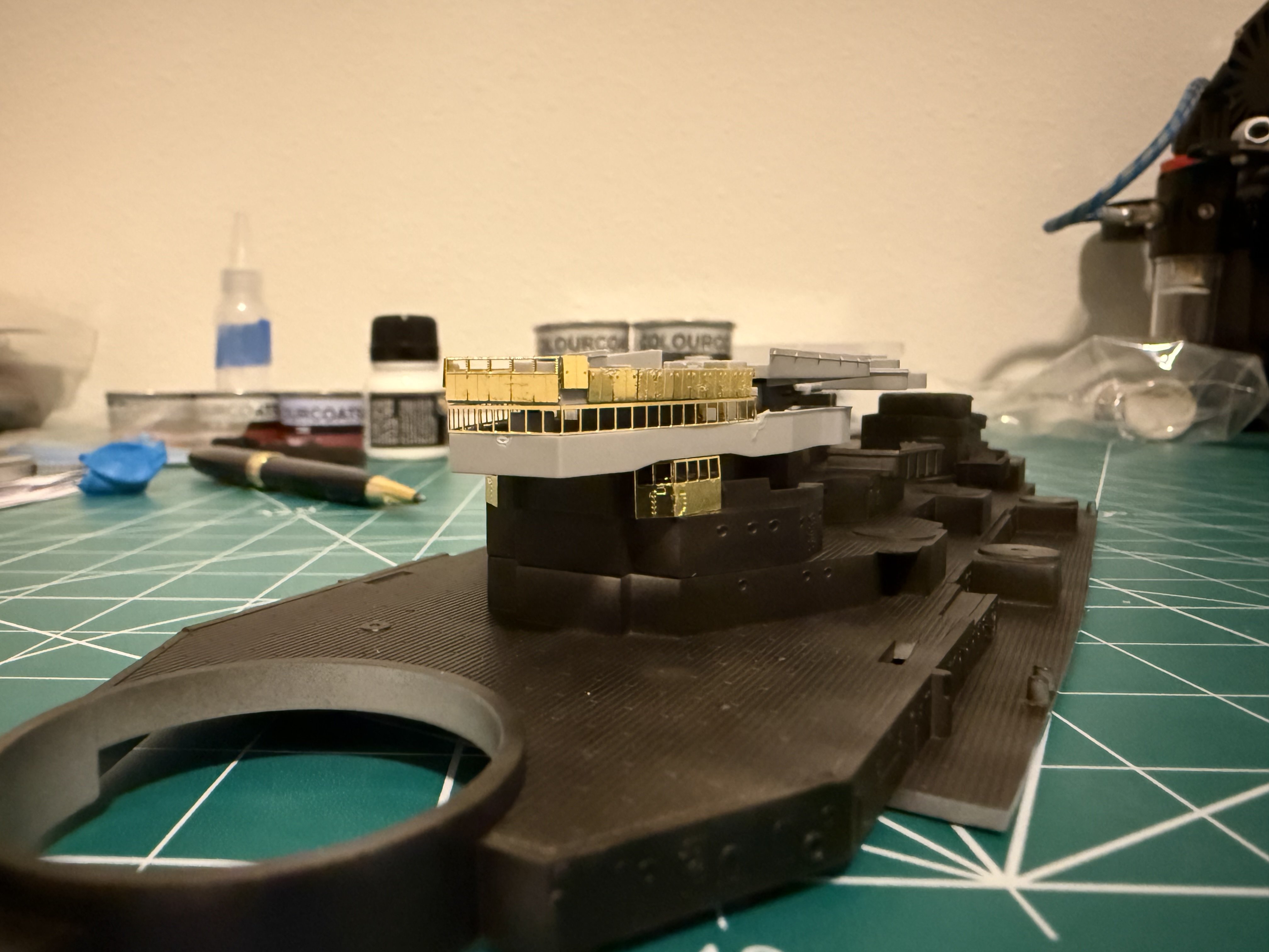

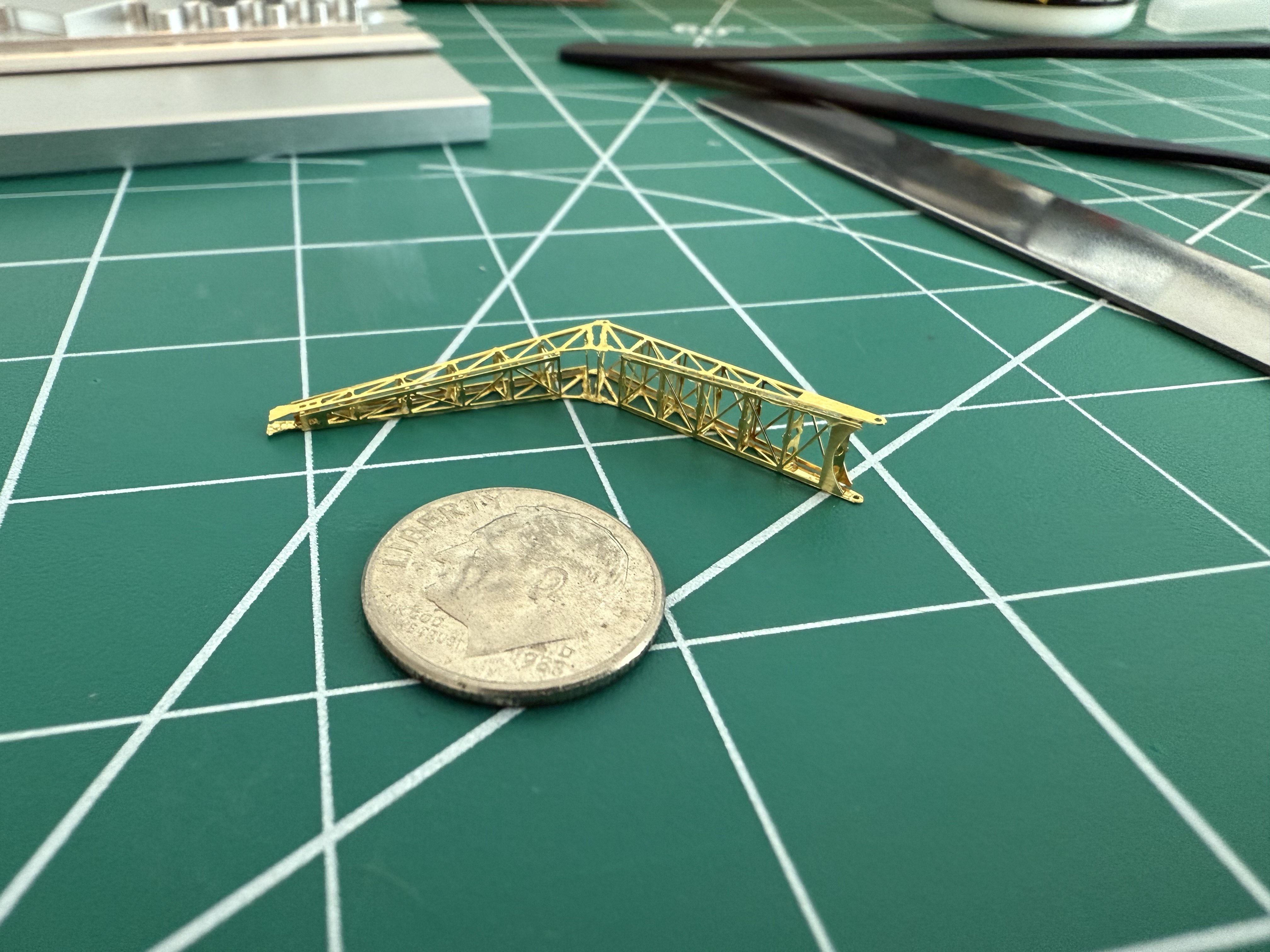

Taking my first stab at photo etching. I tackled some easy parts first to get a general idea on how to remove it from the sprue, sand it, bending and attaching it. It seemed to come out pretty well..
with my confidence at an all time high I decided to tackle something that 1: looked pretty intricate, and 2: could be easily replaced with resin if I royally screwed it up. I want to say these three parts took me roughly 8 hours to put together. I did accidentally put one of the catwalks on the catapult backwards though. I won’t tell if you won’t tell.
IMG_6925.thumb.jpeg.4569f7455f234e1d1df61de0e0511734.jpegIMG_6920.thumb.jpeg.cff5cd277cccc3d097fe9c4e5bfbc831.jpegIMG_6932.thumb.jpeg.a2668ba50d95a114b127f84fe5b2cc13.jpegIMG_6933.thumb.jpeg.426e994f442ce5a3fc17a9c4ddaea6f5.jpegIMG_6943.thumb.jpeg.4b8edf9bc44938d98d3f9e7fe0b955ff.jpeg

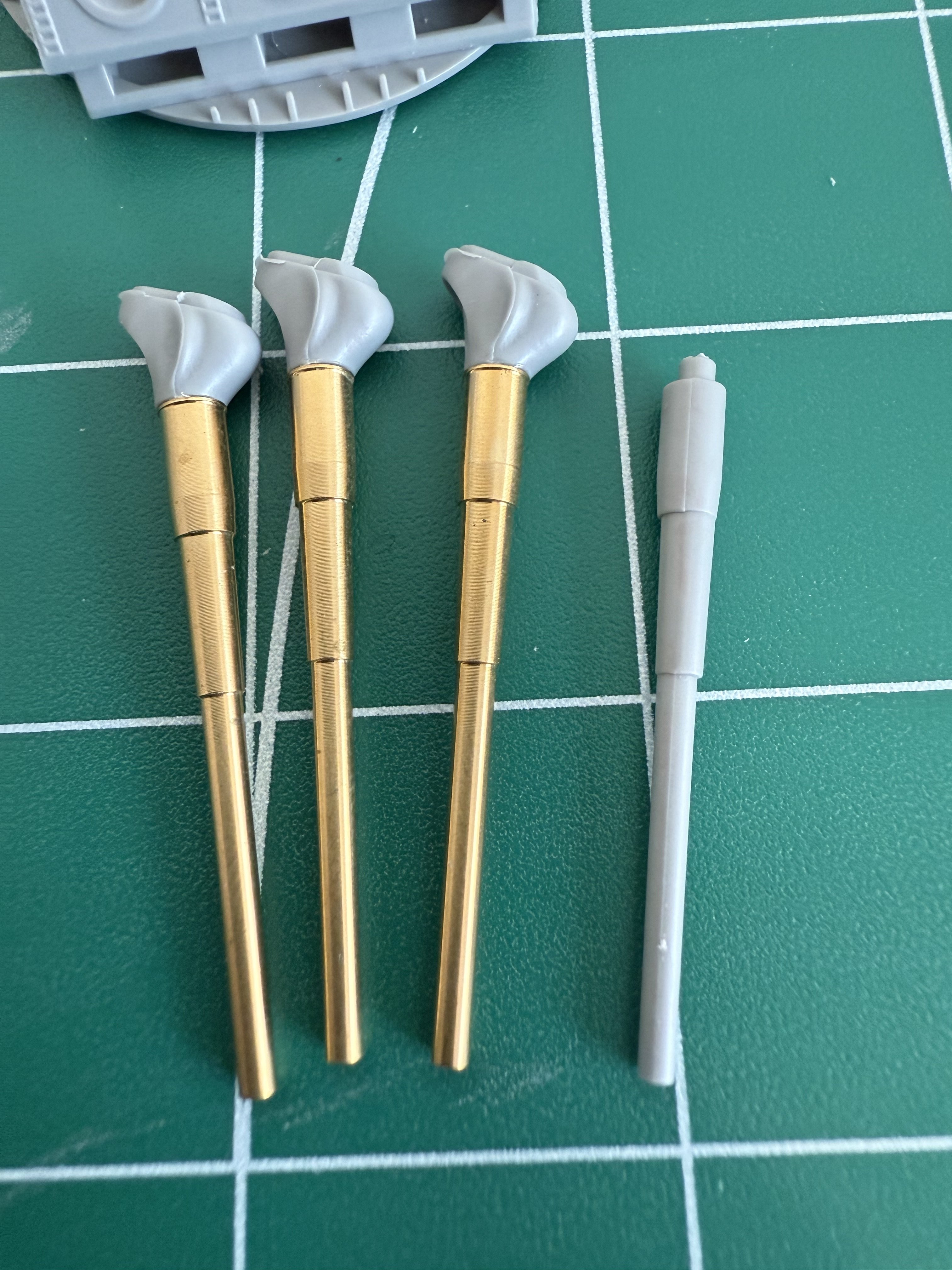

next I decided to tackle something pretty easy just to feel like I was making progress while waiting for some stuff to come in the mail. I decided to go after the turrets. They’re not completely done, most of the turrets are just dry fit as I’ll be adding PE ladders after scratching off the molded ones and didn’t want to risk breaking off the gun tube or director shields. IMG_6908.thumb.jpeg.ec061e908e4abeca2d8e316b87a11e9e.jpegIMG_6910.thumb.jpeg.78b696e28fb6f5a2c0326265ff7ad1ec.jpegIMG_6919.thumb.jpeg.0301c3e2d8343a22d7b1c14af3fd61db.jpegIMG_6917.thumb.jpeg.74351498838449b1b441da9b91888c26.jpeg

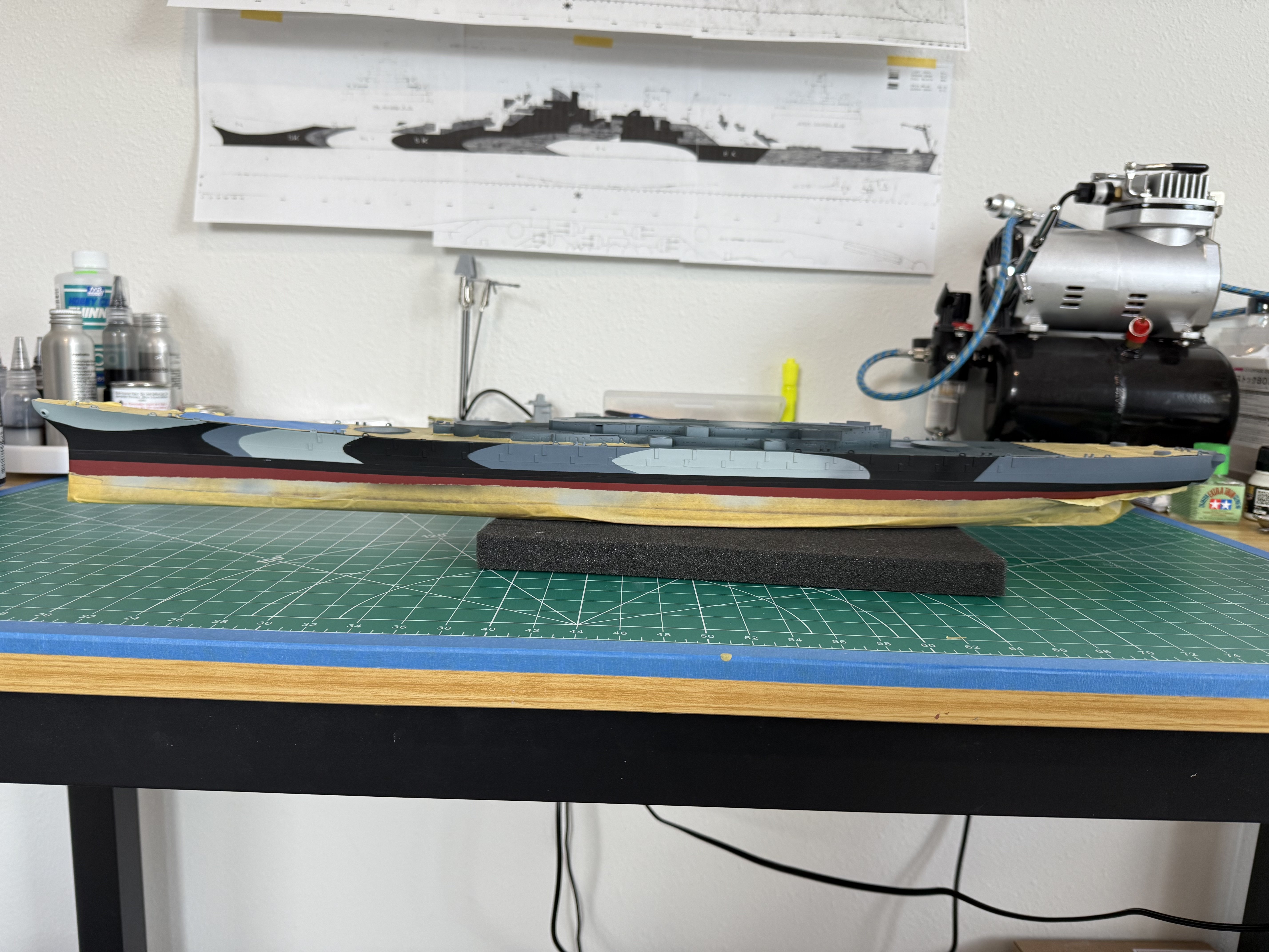

painting has never been my strong suit, and I’ve decided to paint this, probably the most difficult pattern she ever wore. I used pre-cut deck stencils to scale the original naval paint drawings to proper size so that I could create my own masks. After one pissed off girlfriend, 1 trip to target to get more ink, and 33 test prints. I got what I believe is the drawings to a 1:1 scale. IMG_6946.thumb.jpeg.b4c0b3762e625df93cee921b421c30db.jpeg

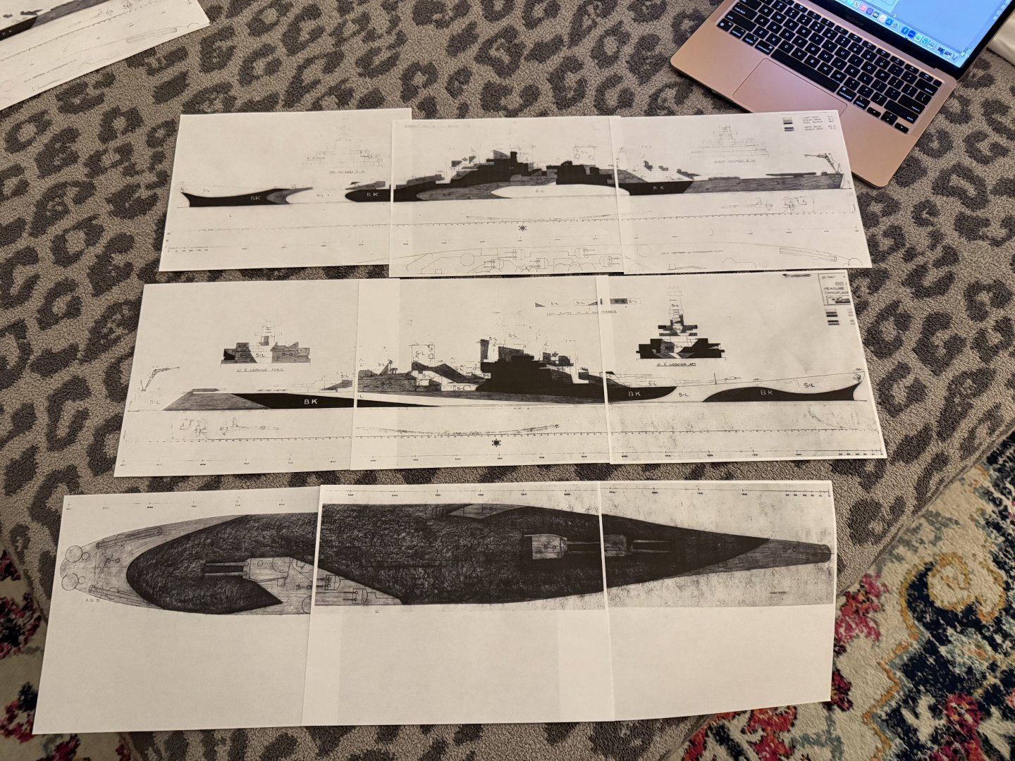

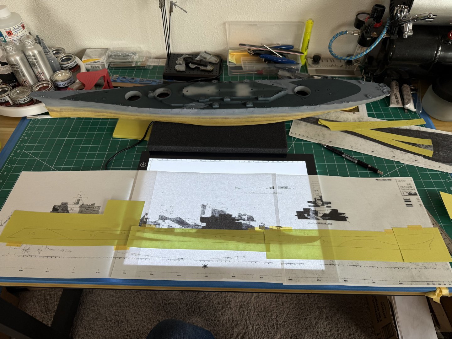

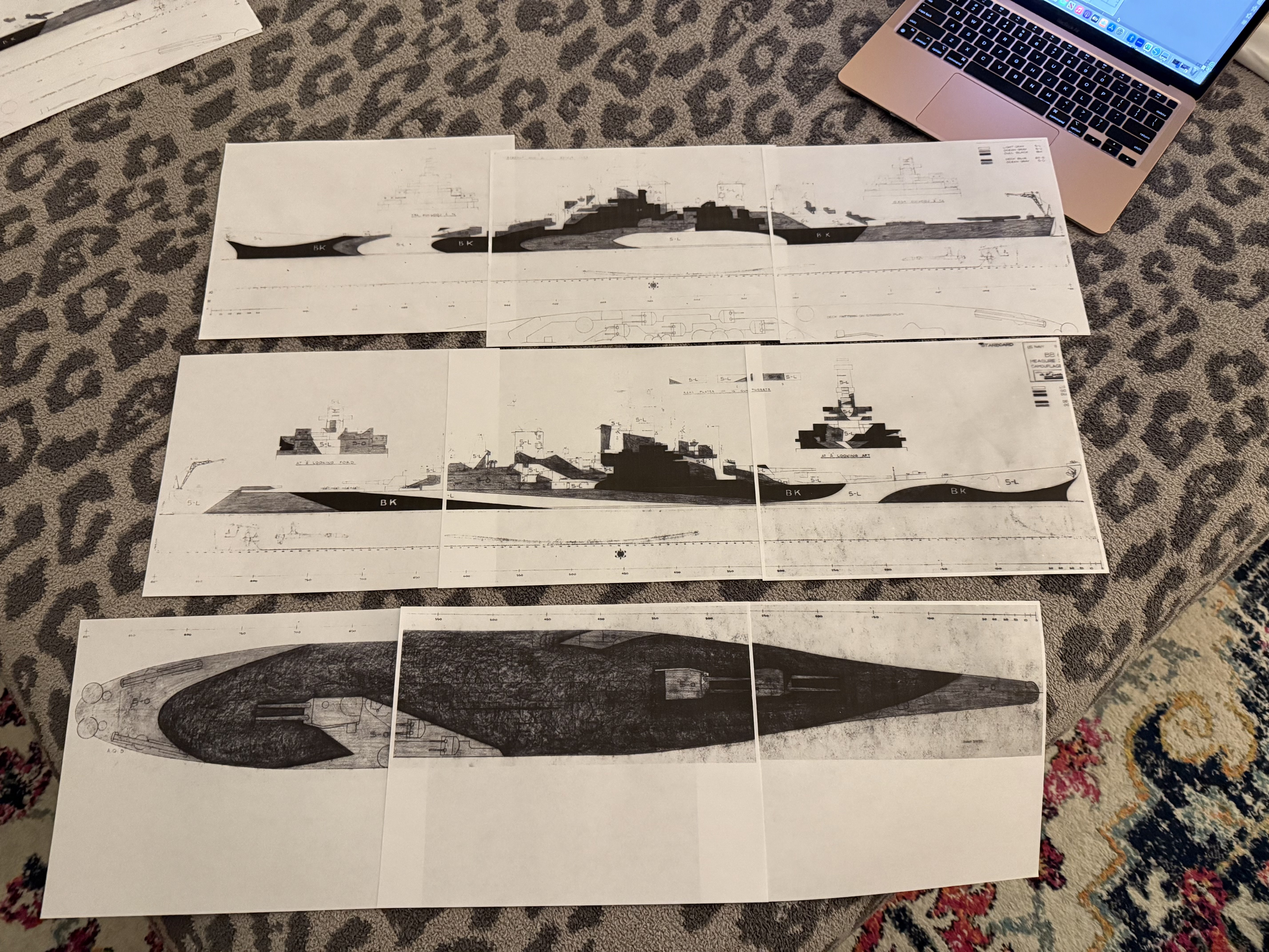

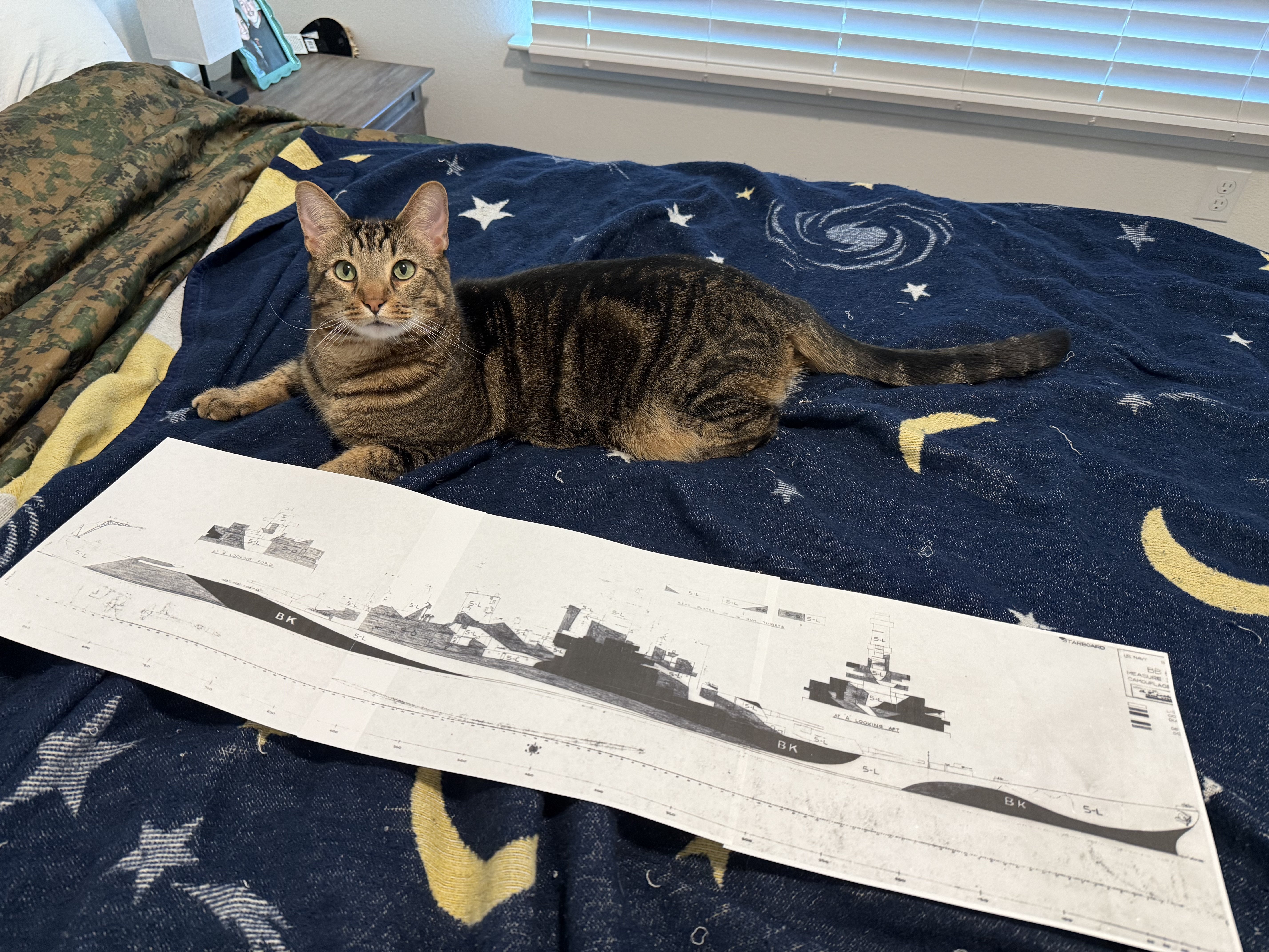

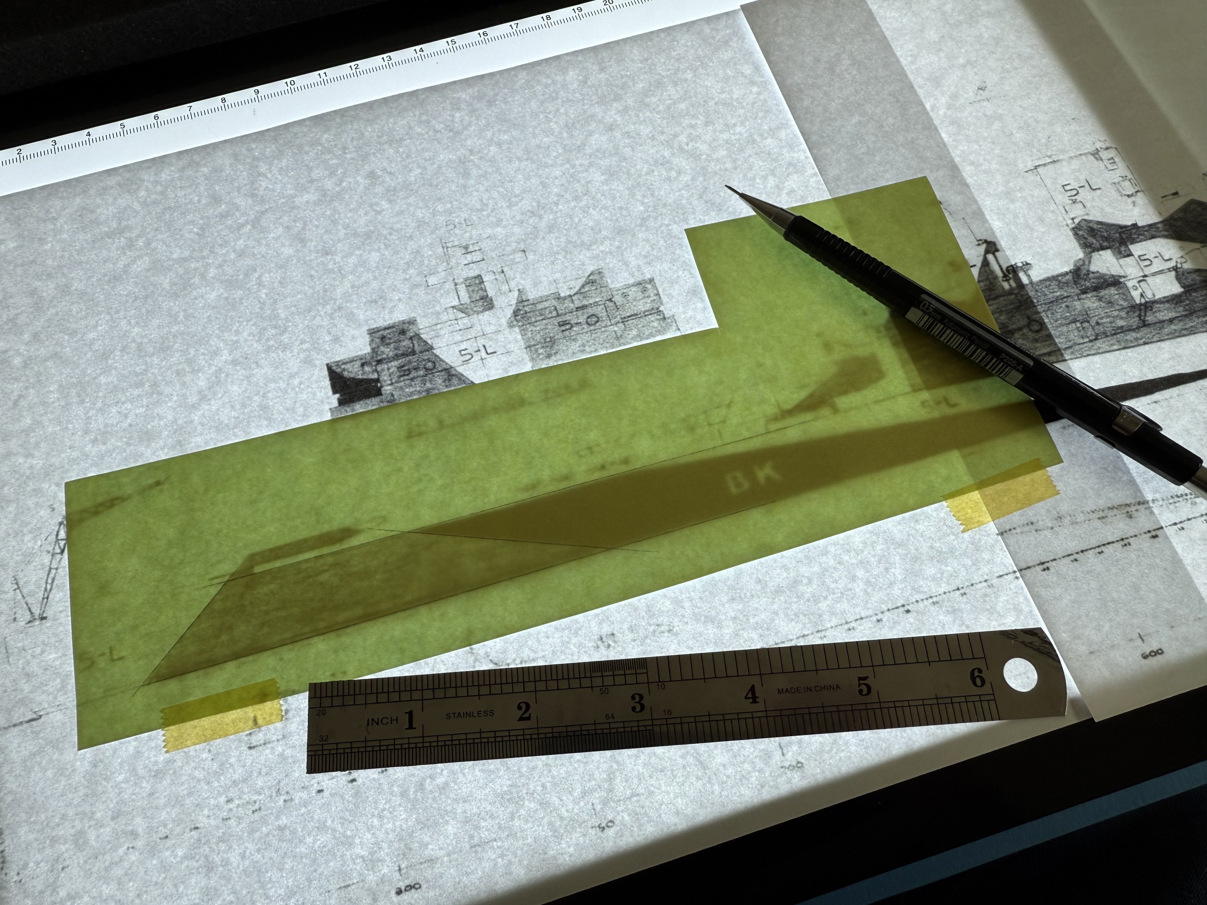

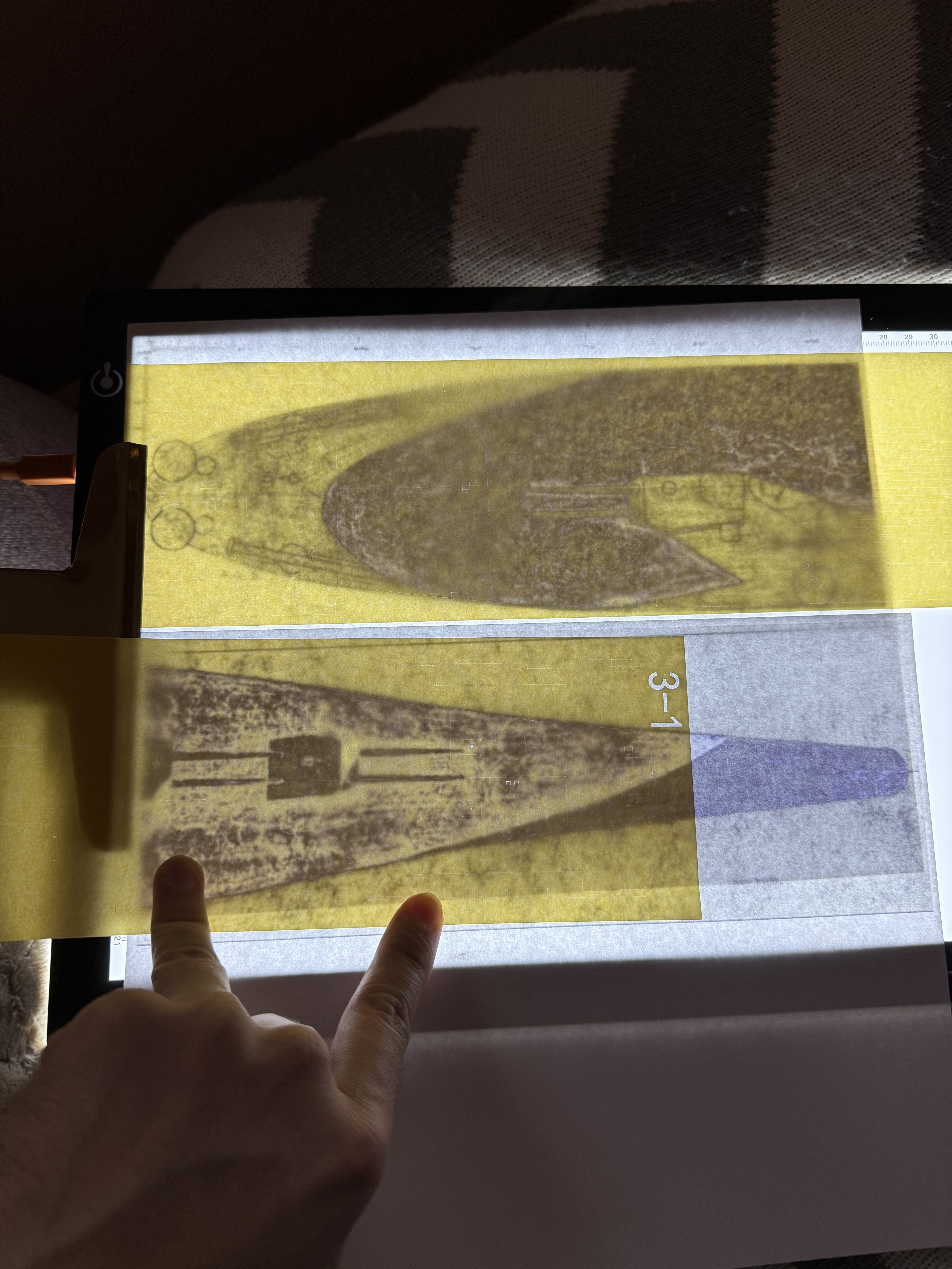

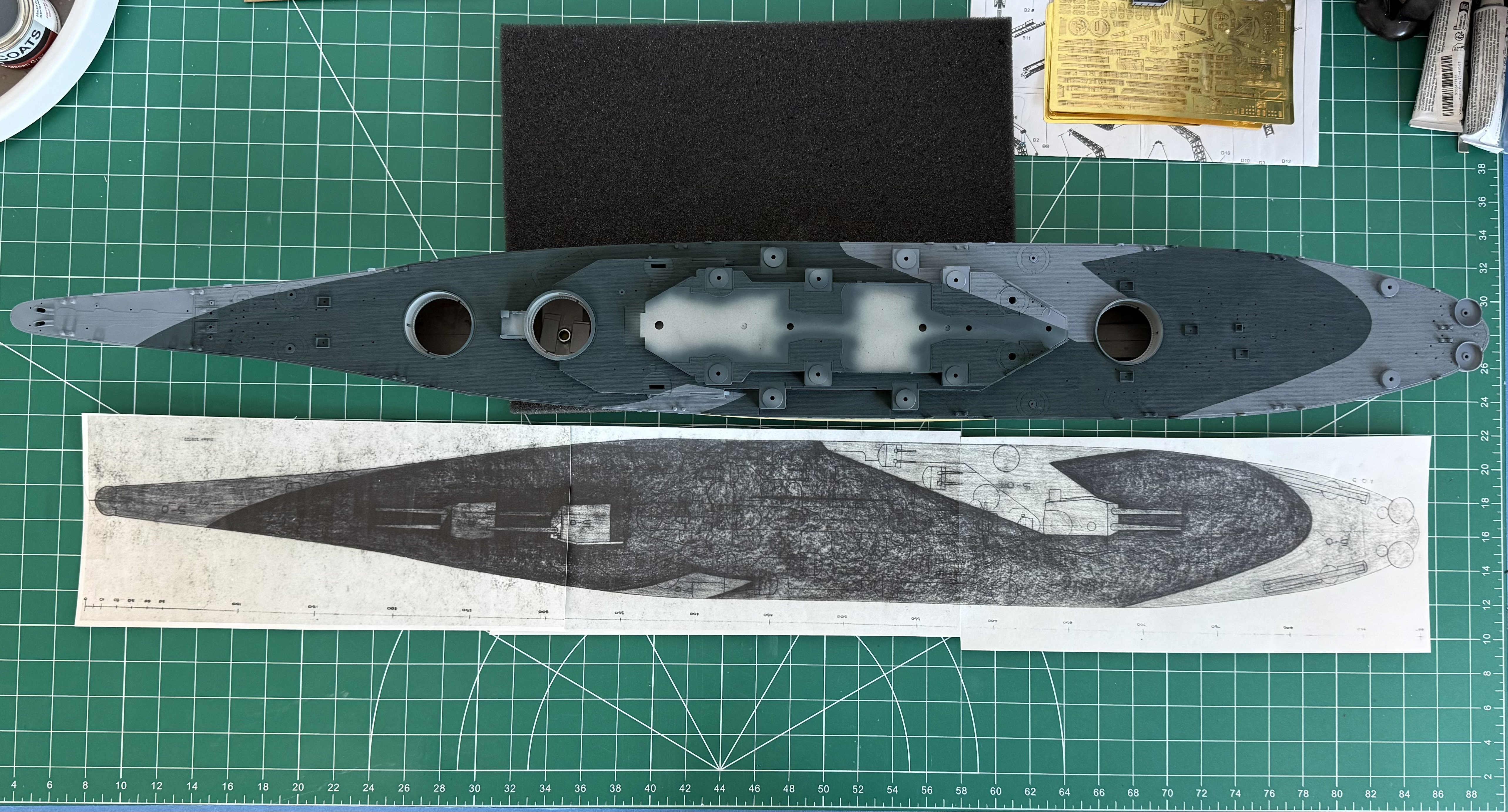

I then at this point printed all of the drawings from the naval archive, trimmed them down and tape them together.IMG_6948.thumb.jpeg.662a0151c9cdf50da7ecc64d98e1bb8d.jpeg
Once again asked the quality control man for his approval.

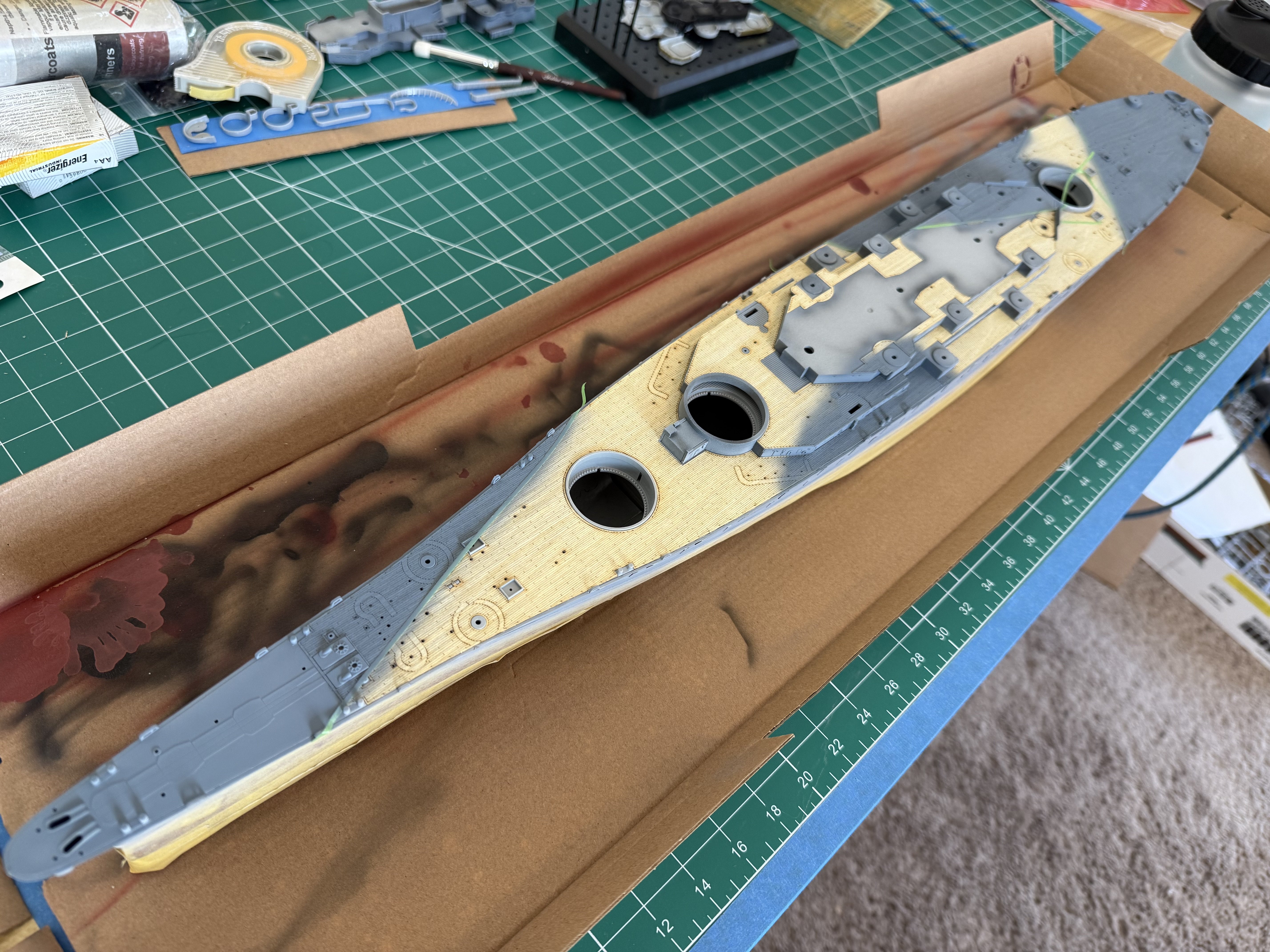

I decided to start with the deck, in my head, it seemed like the logical place to start as I’ll be able to double check the pattern on the side to its corresponding location with the pattern on the deck to make sure that I’m roughly in the right area. I started by laying down the wood deck using MiG ultra glue.
After what felt like an eternity masking…
IMG_6970.thumb.jpeg.2777c864f7188b87afef2f0840b5700d.jpegIMG_6968.thumb.jpeg.a207e82b1417fdccfec9b0b6ab2bfd06.jpegIMG_6967.thumb.jpeg.6e321ab7a3fdc9ed5eefc15b4dd54a86.jpeg

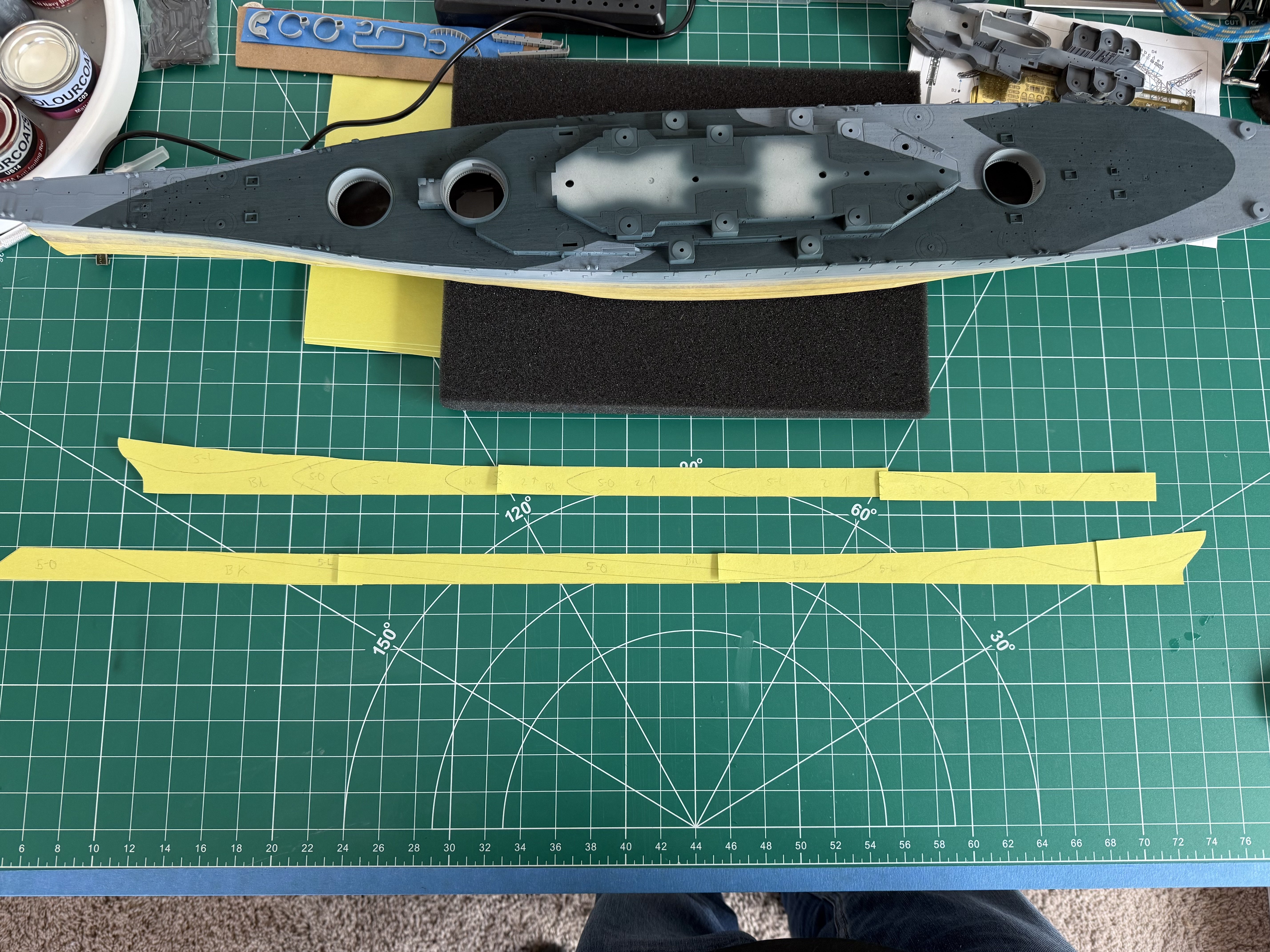

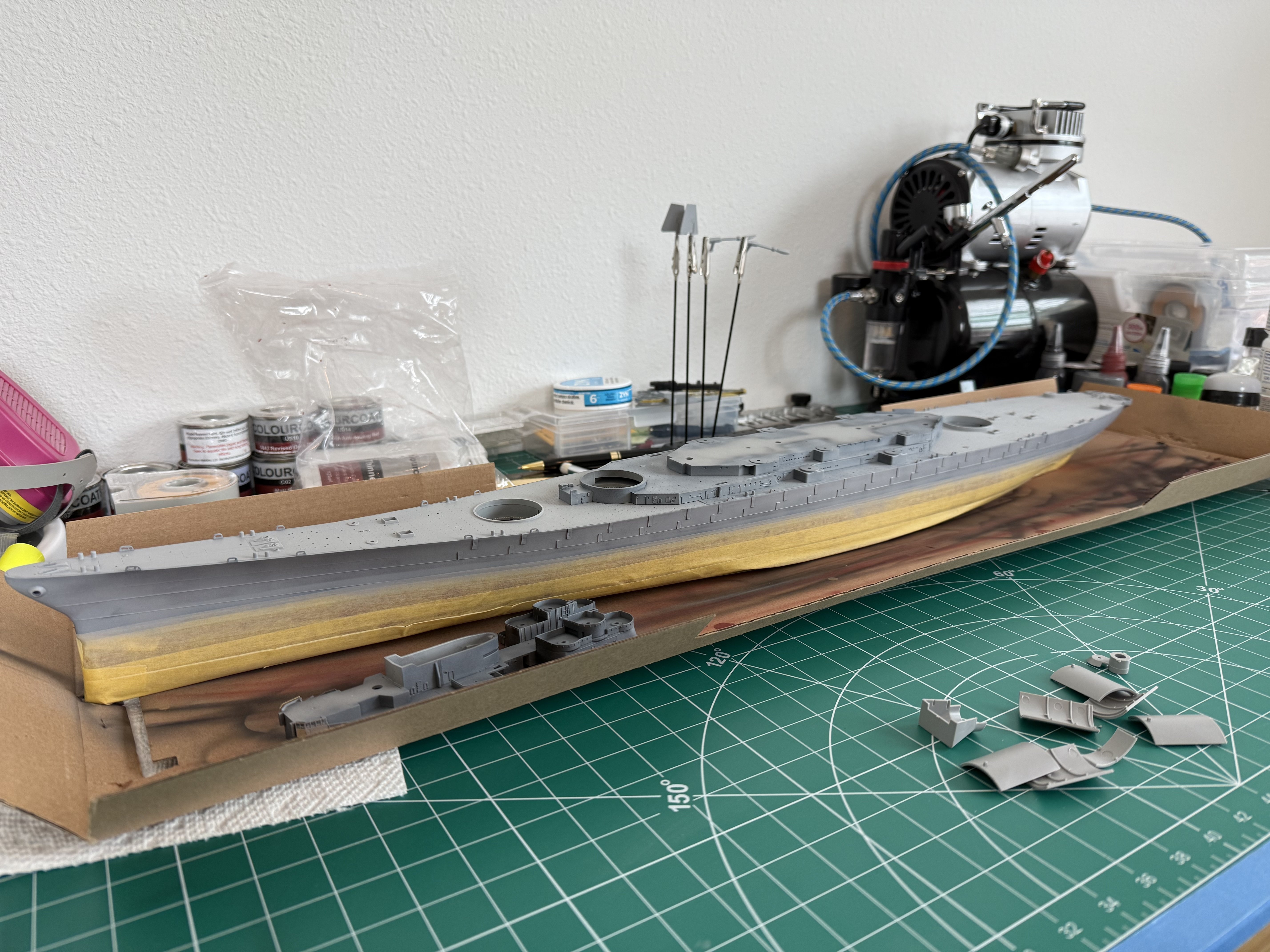

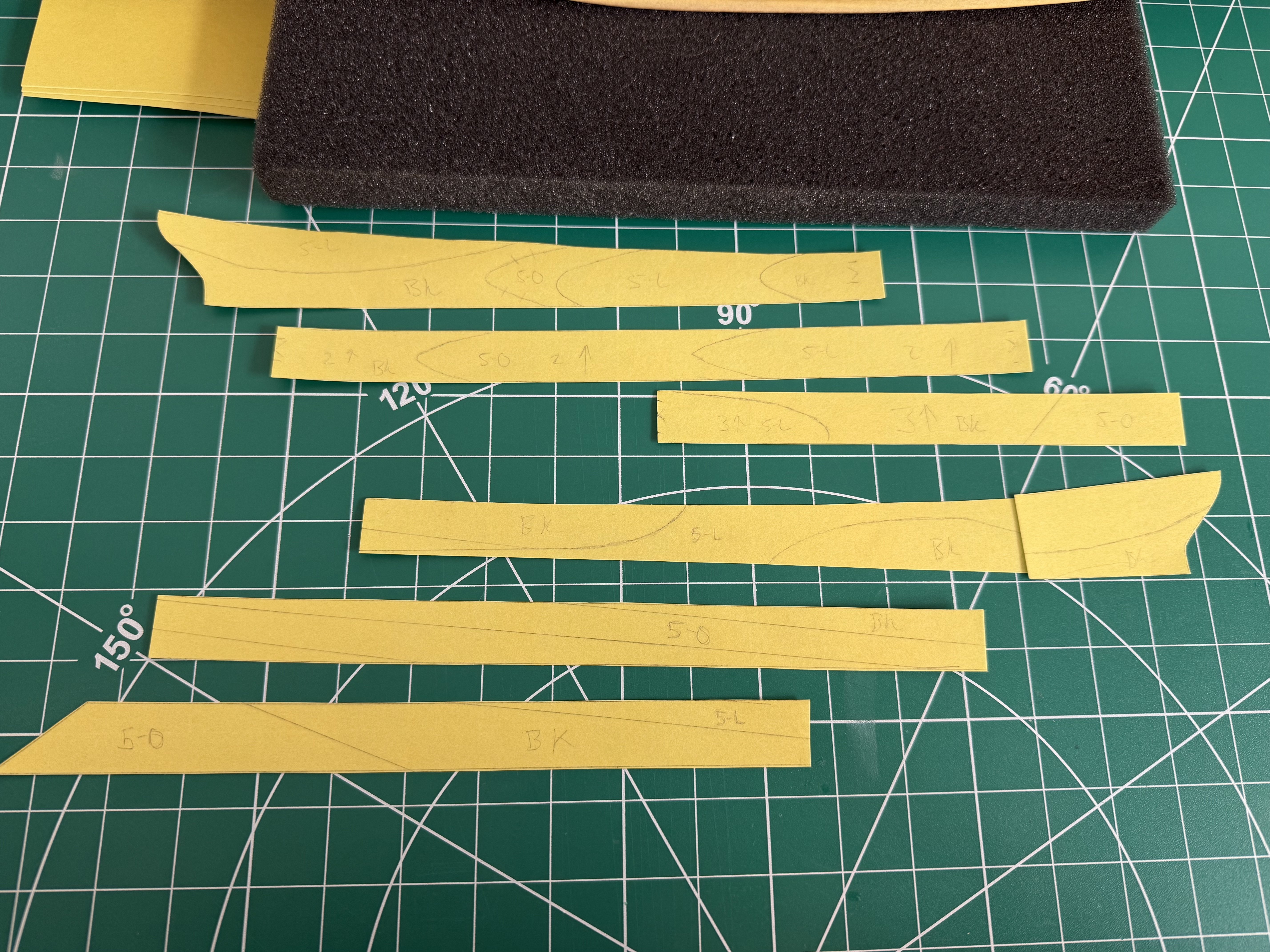

While waiting for the wood to dry, I went ahead and started tackling, making the masks so that I can begin painting the pattern on the side.
This is where it currently sits. It’s been about 26 hours since the deck was finished being painted.

It's easier to clean up ultra glue than CA if you do it while it's setting. Dip a tamiya micro cotton bud in water and wipe away. but it may be easier to use medium CA glue. That is the part I find most annoying on model ships.... Gluing the parts without making it messy.

I shall give that a go. It was great while doing the semi larger parts but these ladders man….

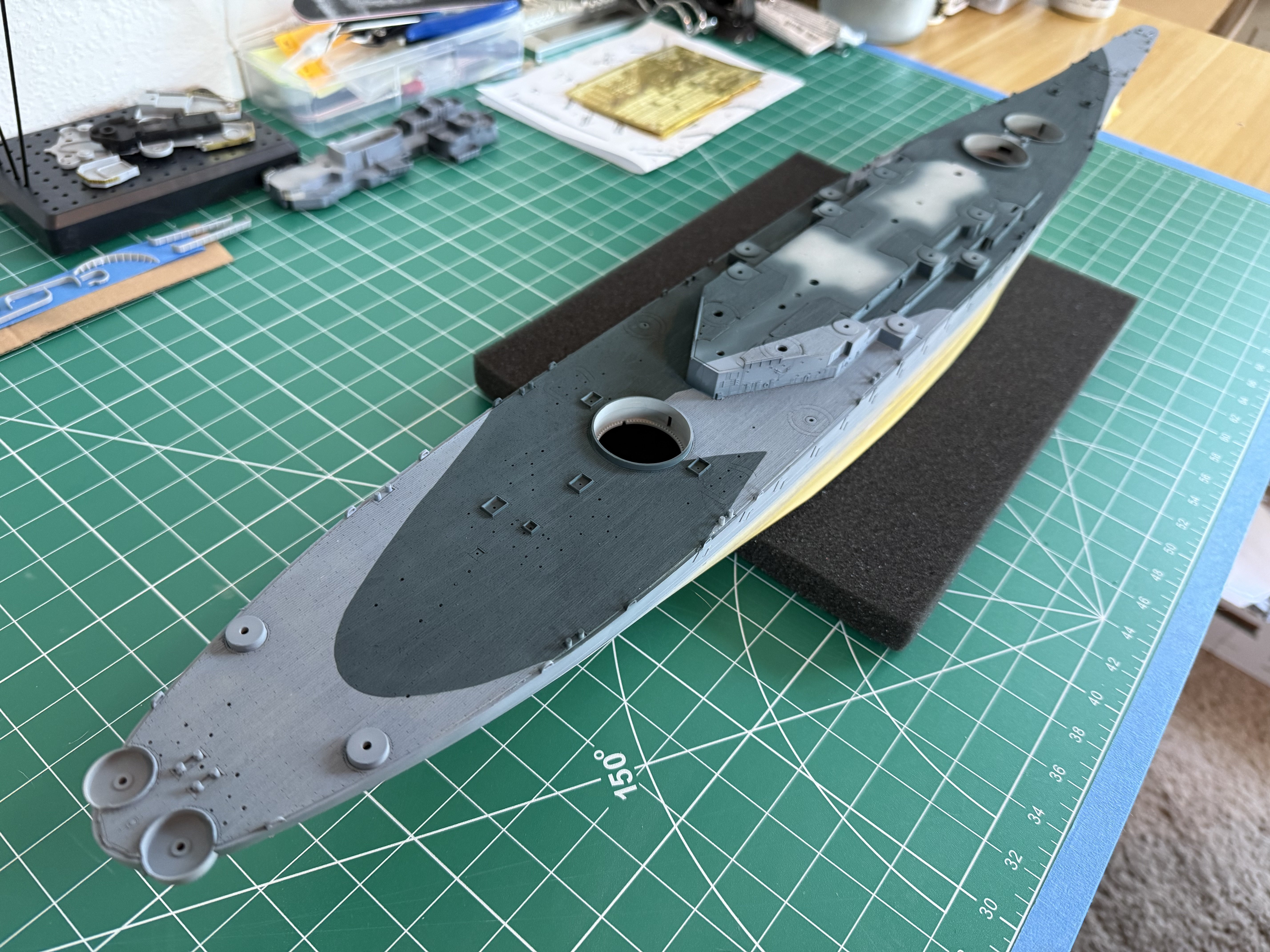

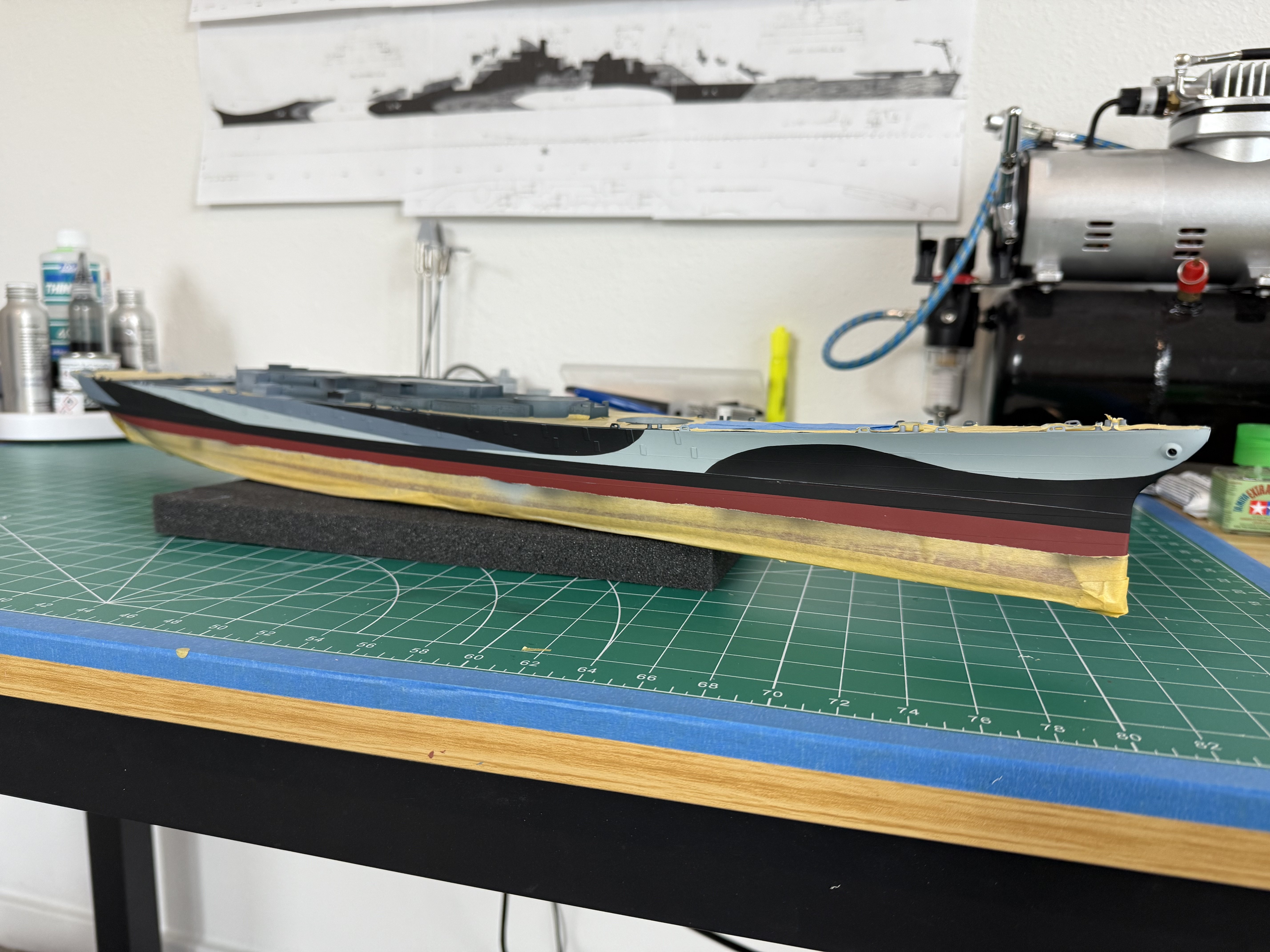

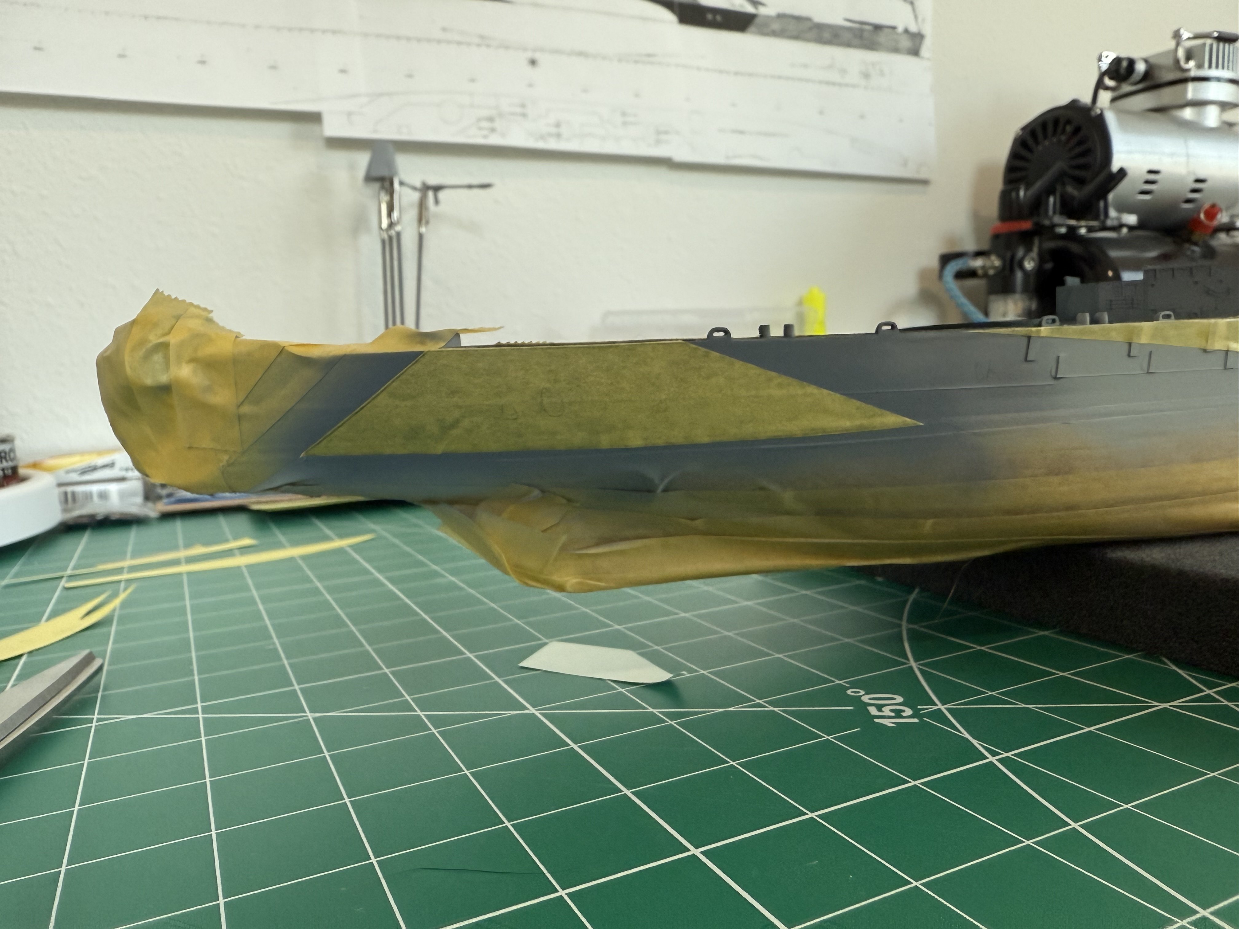

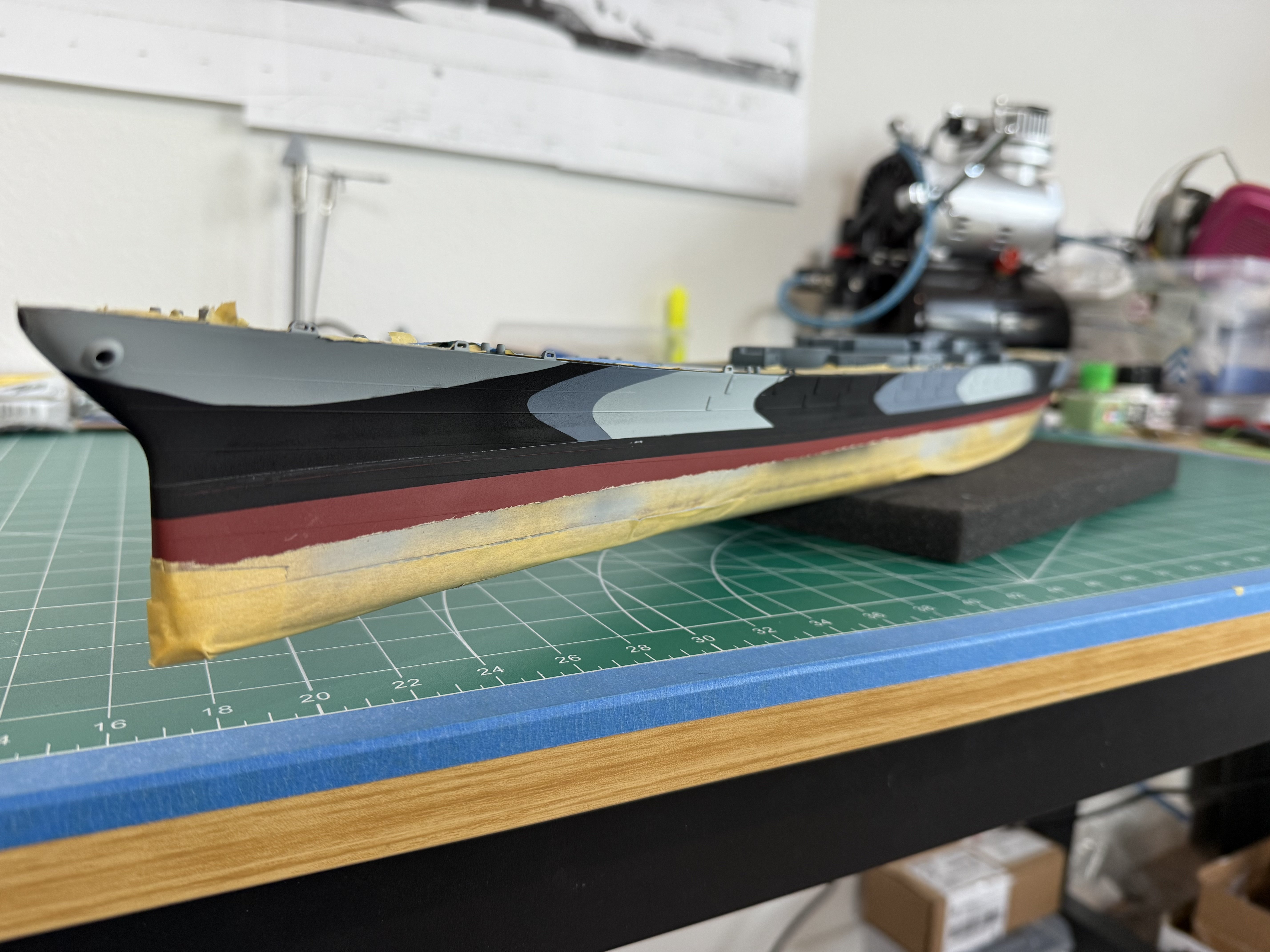

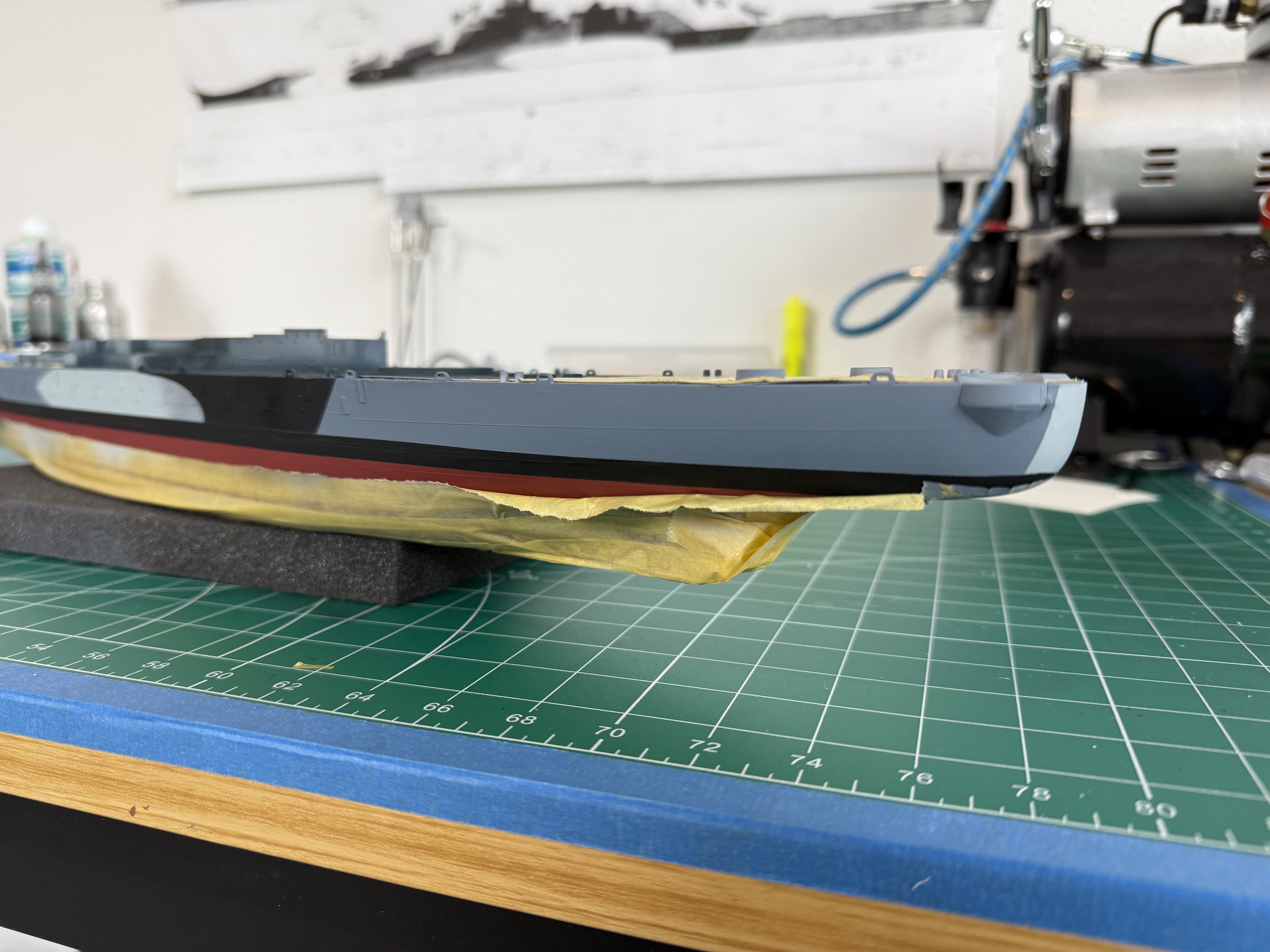

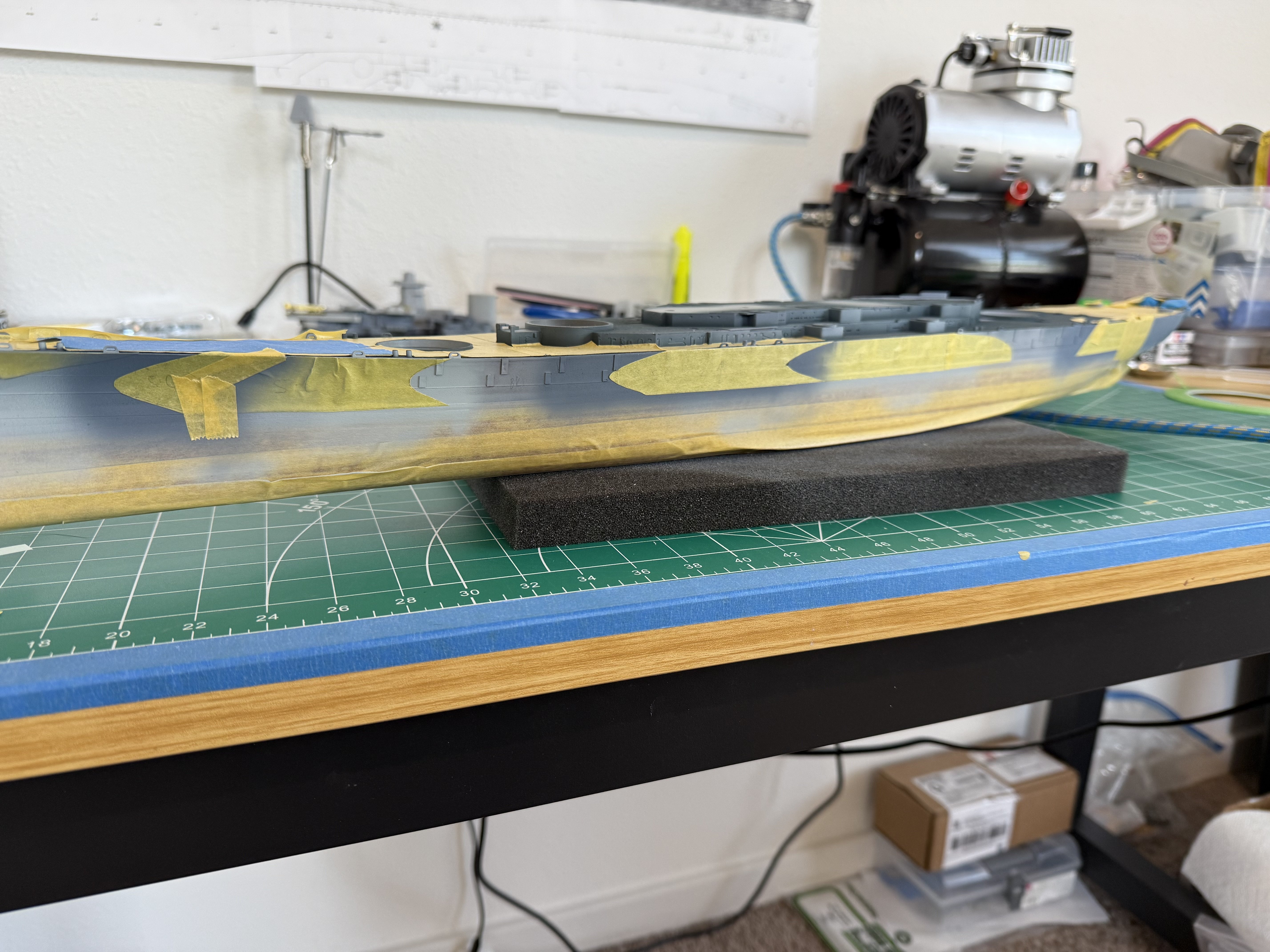

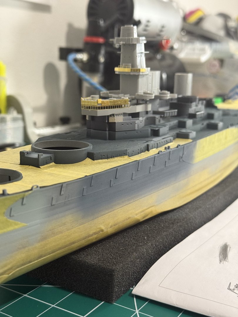

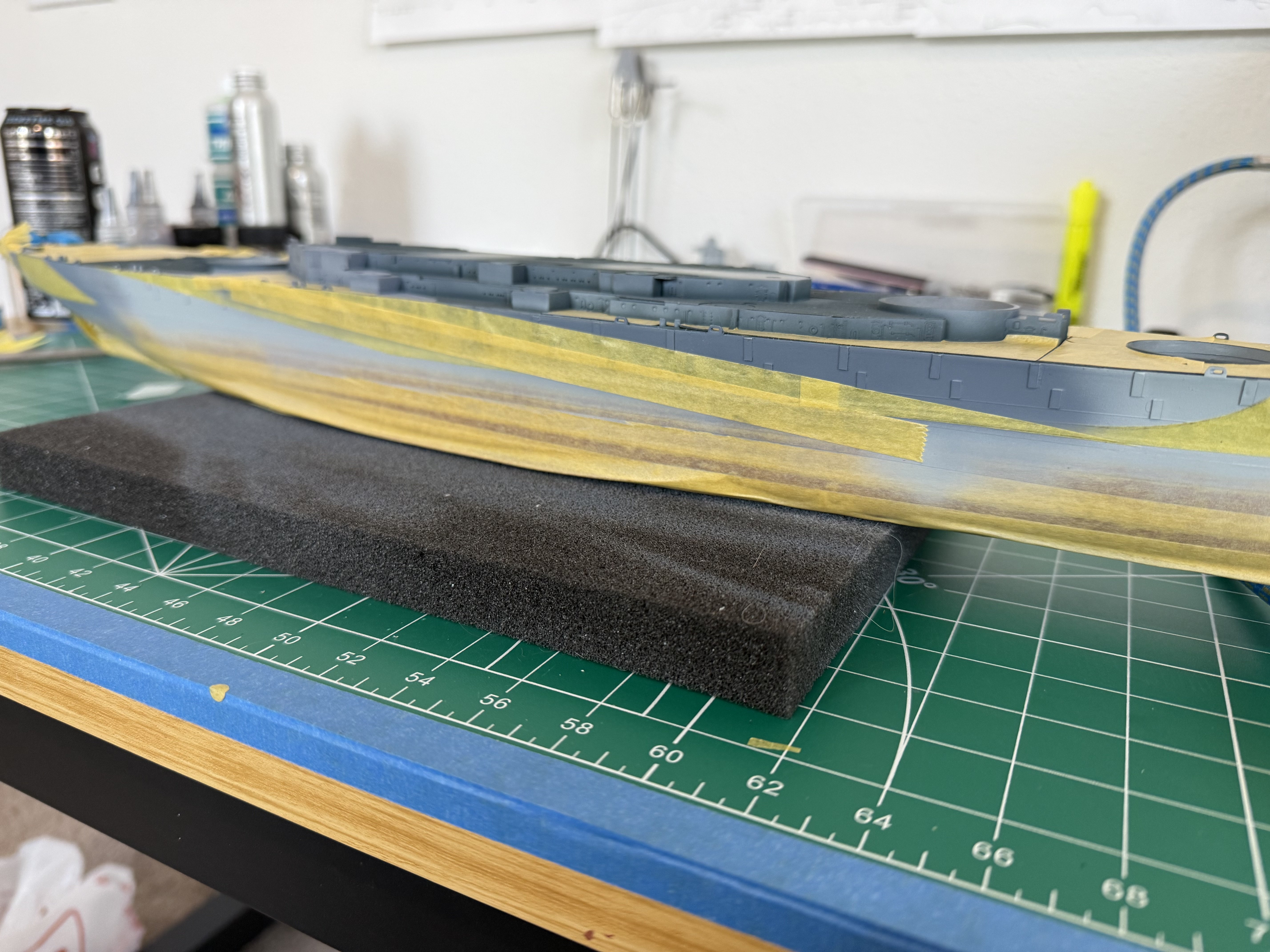

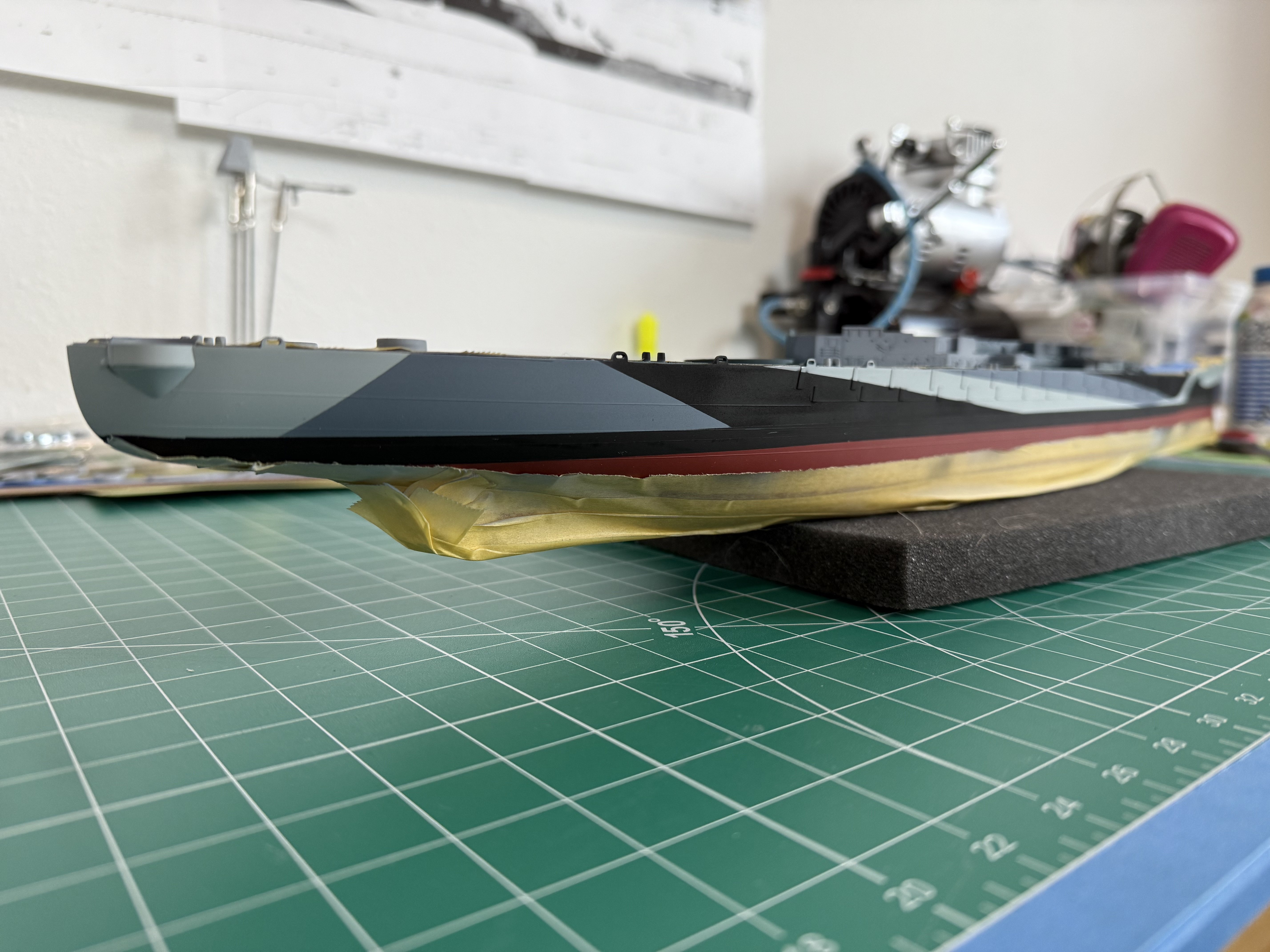

with that said….. I just finished painting the camo on the hull. Some smalls spots I’ll need to touch up from not burnishing the mask as well as I should have left some smalls spots with a smidge of over spray. I know the boot stripe area looks pretty bad, but I was planning to back and redo that anyways to correct the previous paint line issue.
for the most part almost everything lined up where it was supposed to and I think I’m pretty happy about the way it came out. IMG_7059.thumb.jpeg.82ca3c92549b274650caa94e9e097c2d.jpegIMG_7060.thumb.jpeg.ca365d5d5a7c54f529fe029e8495dea7.jpegIMG_7061.thumb.jpeg.b349f687558e8c0a49d364413447b06f.jpegIMG_7062.thumb.jpeg.83f6c40f7f9e14160885c519eb5d6b1d.jpegIMG_7063.thumb.jpeg.b8da2ece85bdd6b667d72f782ff36d37.jpegIMG_7064.thumb.jpeg.c8ed2838f8ac44ac568c856c3d366f7e.jpegIMG_7065.thumb.jpeg.9e7f1560646da5a2481fc9546091f79d.jpegIMG_7066.thumb.jpeg.0ebd6365a0a13493ff14b97da2776605.jpegIMG_7067.thumb.jpeg.f0db59df5a106f57e7fc9102fd15d91c.jpegIMG_7068.thumb.jpeg.885cf2255e455f4f33c67b9d2fb592b9.jpeg

I bet you a filter wash will help "hide" some of the over/under spray. Looks fantastic.
Will you share what colors you used for the ship?
I am using white ensign models enamels for all the painting. I believe in America they’re “color coats”. The old owner has commented on Facebook about all the official naming/ownership.
I have their Norfolk hull red, 5-0, 5-L, 20B, matte black and matte white for this project, and some of their other colors for another project.

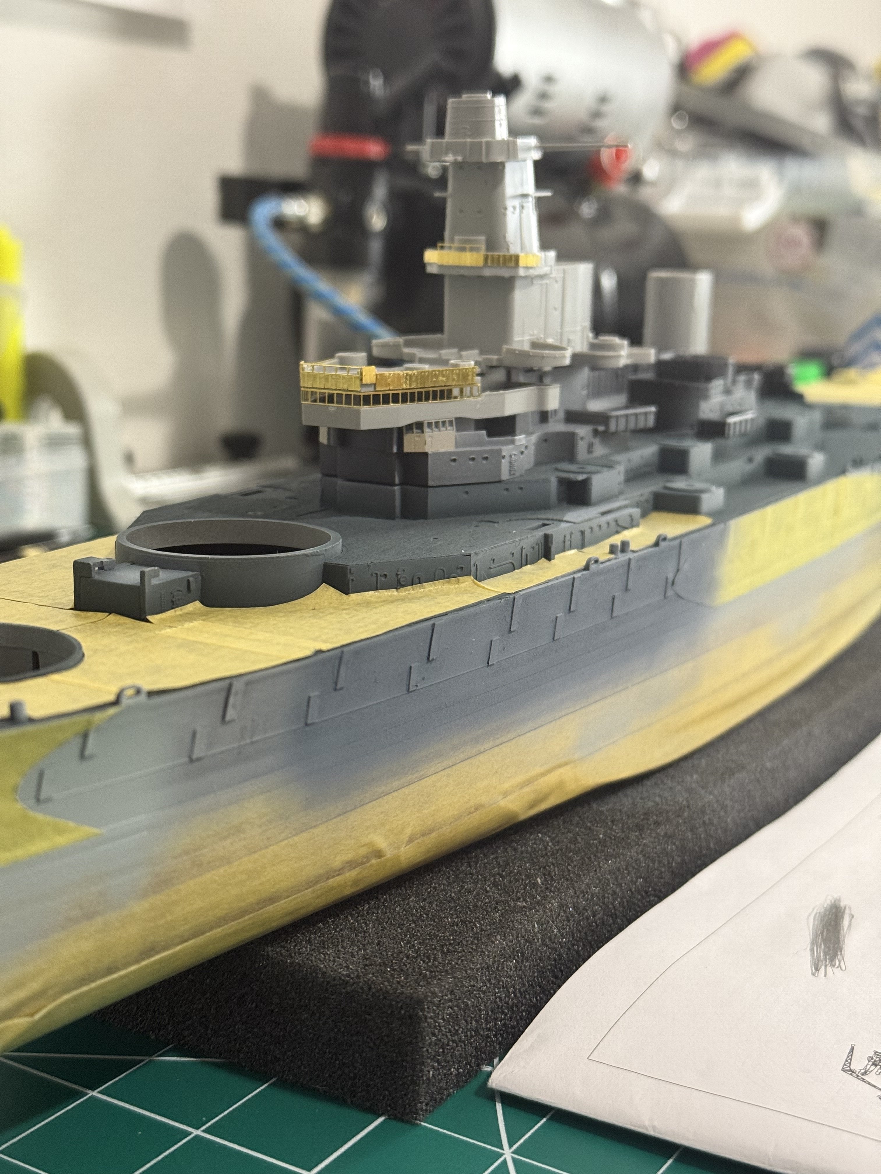

I touched up the small errors in the camo on the hull. I also layed down the 20B deck blue on all the parts of the super structure so that I can start working on painting its camo. It’s all dry fit and sitting in place to make it easier to work with.
i also started working on some of the smaller deck pieces as I am planning to start assembling the objects on the deck and working my way up.

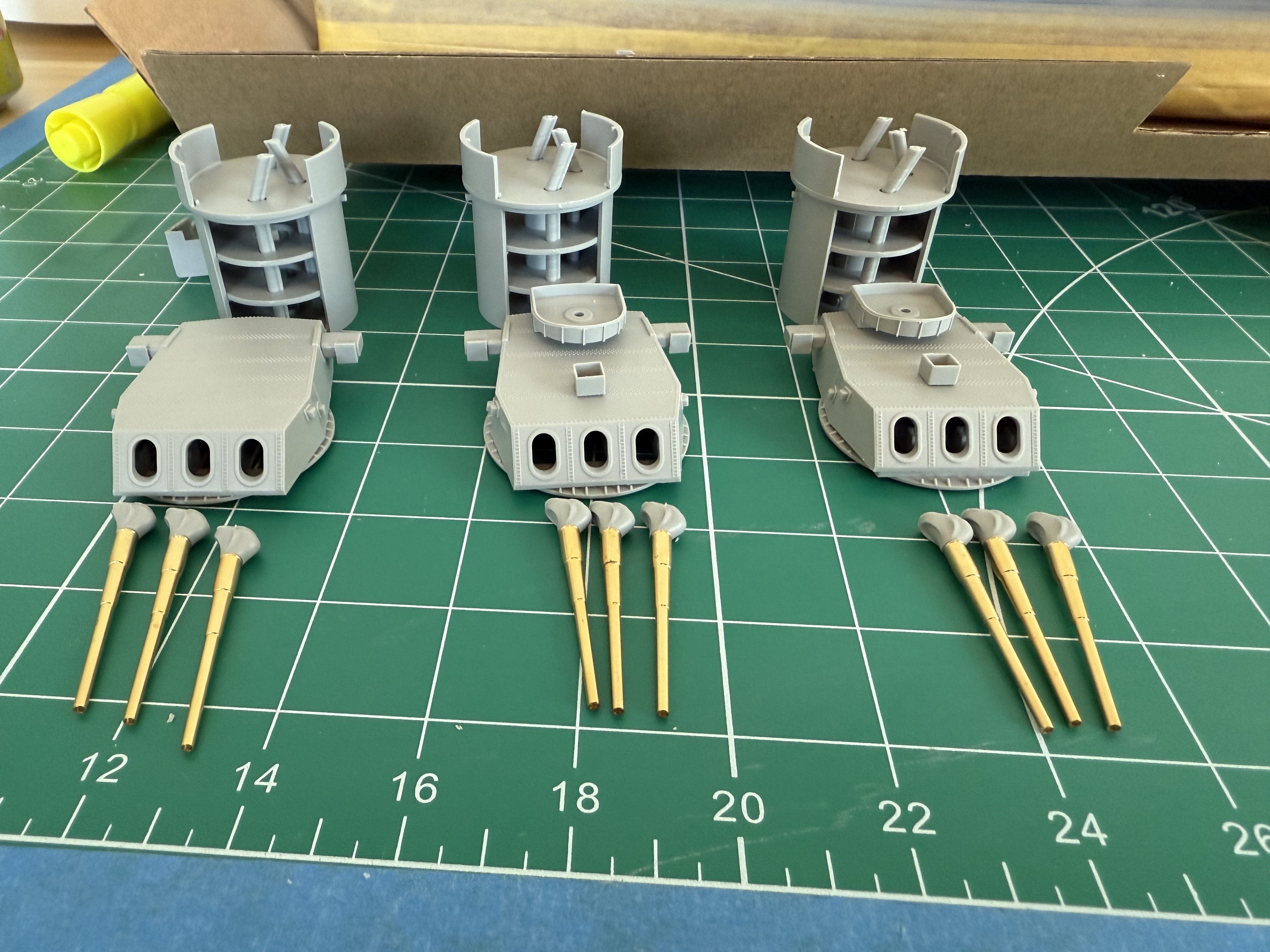

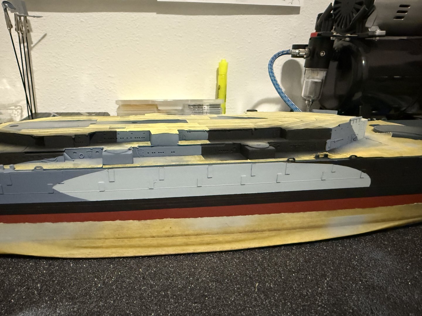

Slowly starting to work on the first two levels camo scheme. About 90% complete with these levels. I was hoping to finish them today but I threw my back out yesterday and I just can’t get comfortable in my office chair long enough to make any progress.

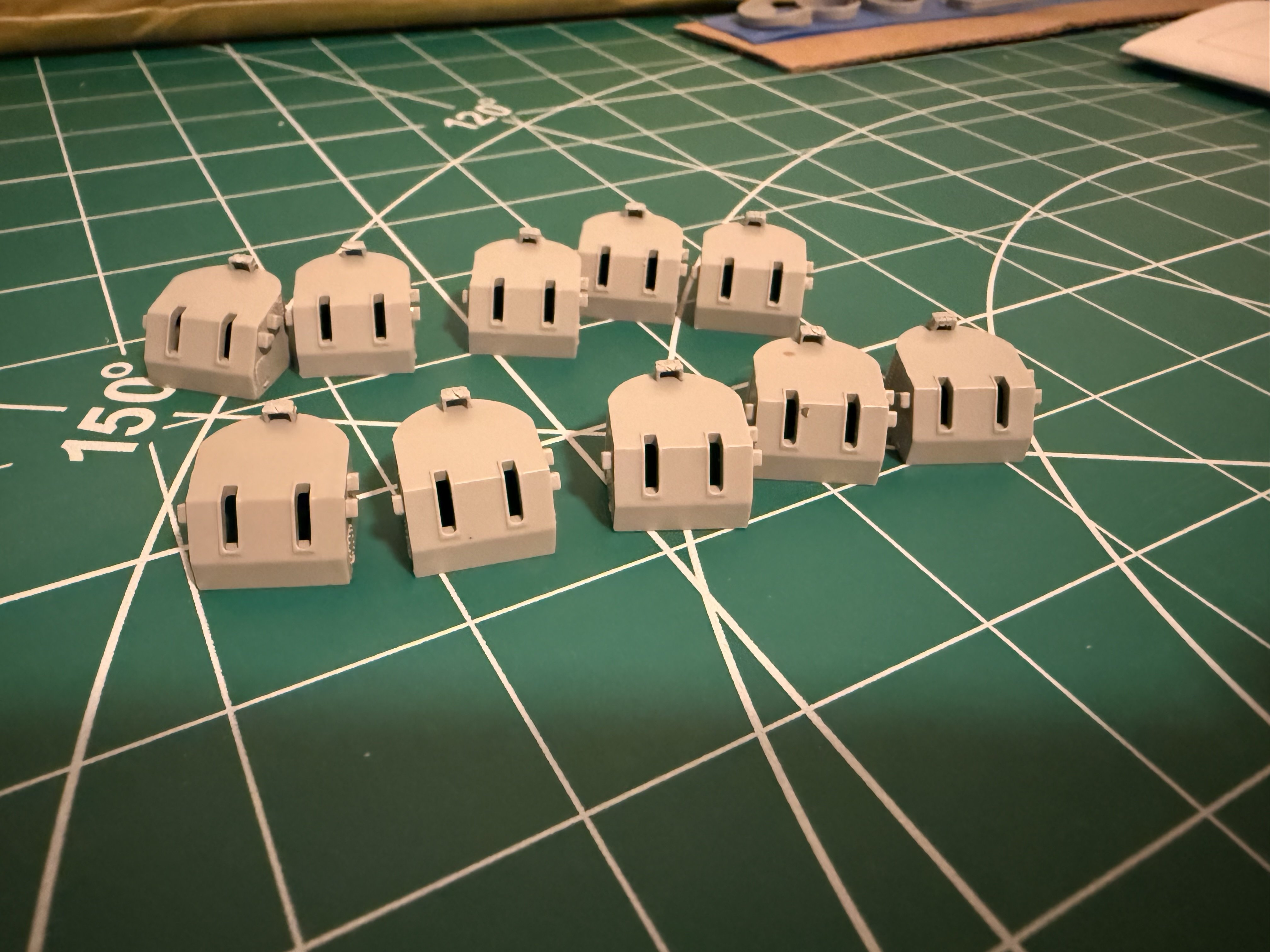

on the bright side the resin bofors, 20mm, and gun directors shipped today.

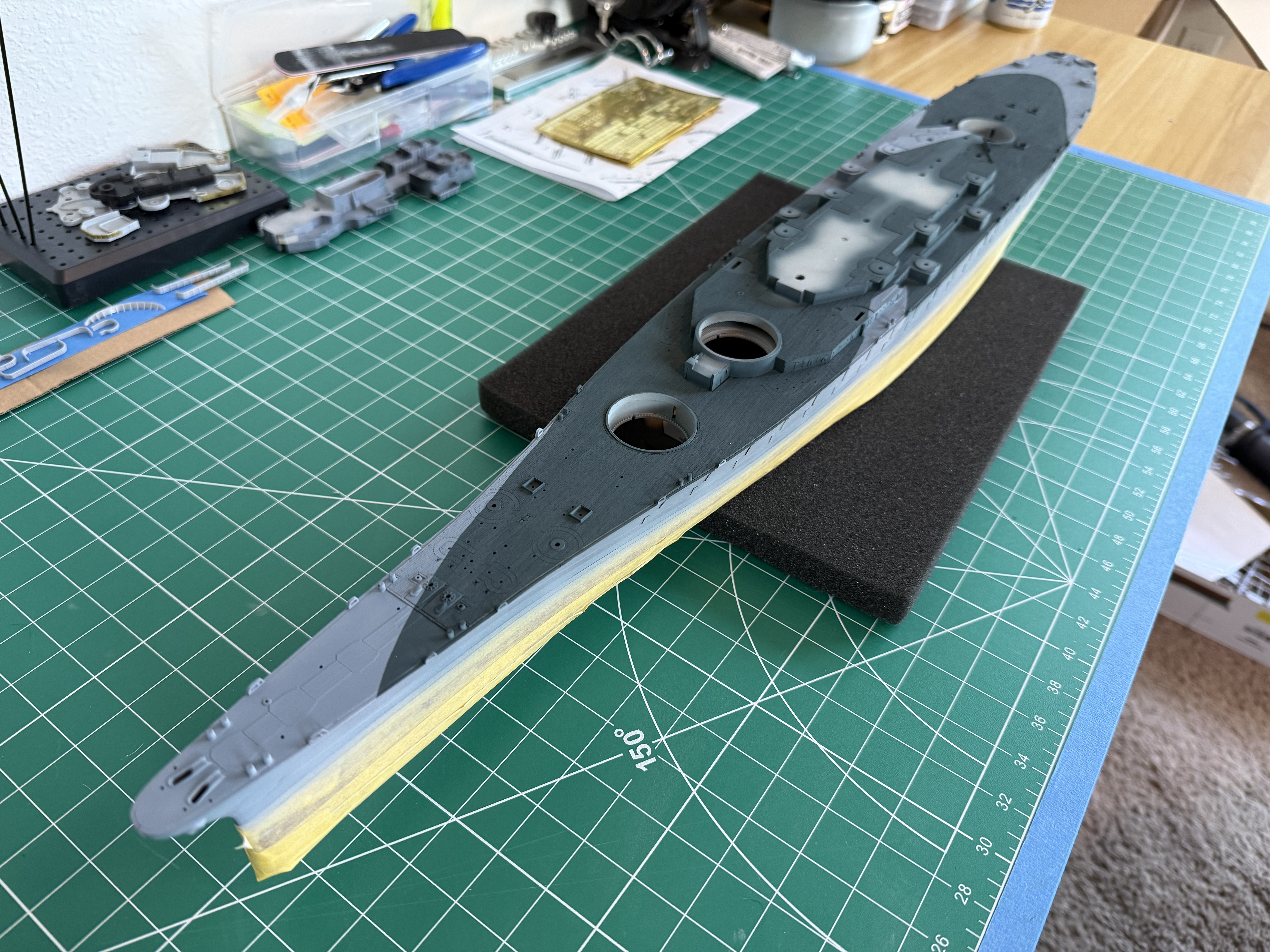

IMG_7120.thumb.jpeg.a1436fbd8dd2c72ced8eb894017894d8.jpegIMG_7121.thumb.jpeg.d96a91da57b6bc0658b7d96426eaa03d.jpeg

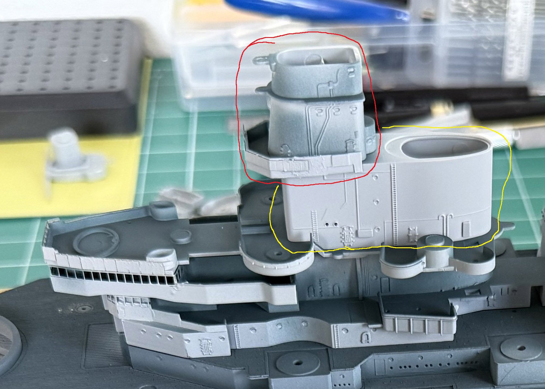

is the section of the forward superstructure circled in red glued to the section circled in yellow because if yes then there are some problems.
1: the red section is to far forward causing it to overhang the yellow section as both sections' faces should be vertically flush.
2: the red section minus it's base platform is in reverse in that the flat front should be towards the bow & the rounded angled back should be facing the stern.
The base is glued, but the tower isn’t. If it’s meant to be flush, that isn’t how the kit is set up as there was a receded section for the base to click into.

53 minutes ago, ddp said:
what i am calling the base which the tower is sitting on is actually the "secondary conning station".
look at these plans as there is a problem to your model in in that area & maybe more.
BB-63 USS Missouri Booklet of General Plans (1944) https://archive.org/details/bb63bogp1944
https://archive.org/details/ship-design-drawings?tab=collection&query=uss+missouri
http://www.navsource.net/archives/01/63a.htm
Follow you pictorial evidence for the tower. May be doing some kitbashing to correct this.

I am so confused about what you guys are talking about. My model looks exactly the same as the actual Missouri in that area. I’m not following what’s “wrong” here. I also have no idea what kit bashing means.
Two items. First the kitbash/corrective surgery. I think we're both pointing you in the same direction.
Sometimes manufacturers generate a kit that doesn't follow published plans. They're close, but sometimes parts are cast to ensure ease of removal from molds, in a plastic kit, or structures are simplified for ease of construction in a wood kit. What's the modeler to do? He does corrective surgery or kit bashing to make it look more like the photos he's using to build with. Sometimes you add extra parts, sometimes you may have to modify or adjust parts. It's all part of being a model builder versus an assembler.
Second item, orientation of the conning tower:
The halfmoon projection on the lower part, facing the stack area,  should be on the forward side of the tower. At least that's what the picture in post 20 shows.

to me kitbashing is when modifying a model's appearance to look totally different from the original appearance like these. kitbashing Revell's 1/429 scale USS Arizona into the OBBs(old battleships) of ww2 from the Wyoming class to the Colorado class.
on the 2nd item, look at this link which is of the real ship as it shows that halfmoon projection that Canute says were it should be.
http://www.navsource.net/archives/01/016384a.jpg
in this cropped view of the forward superstructure from Missouri's Booklet of General Plans 1944 that i linked above, you can see that except for the different platforms, the vertical front face of the tower is vertically aligned flush unlike yours which is sticking out past the lower part of the tower.

I understand the tower is backwards in my
Picture. It’s just sitting there and not installed.
while I see what you’re saying about the plans, all of the photos I can find of the Missouri in ‘44 show that the kit is correct in having the platform overhang.
i know that the platform is to overhang but the upper half of the tower is not to overhang but be vertical flush with the lower half of the tower.
It’s just sitting there….none of the superstructure other than being painted has been assembled… it was just put in place to all fit in frame of the picture.
My apologies for the confusion. I thought you were referencing the platform overhang this whole time and was very confused. I’ll be making extra sure when things start getting glued that I pay attention to the direction that tower faces!
