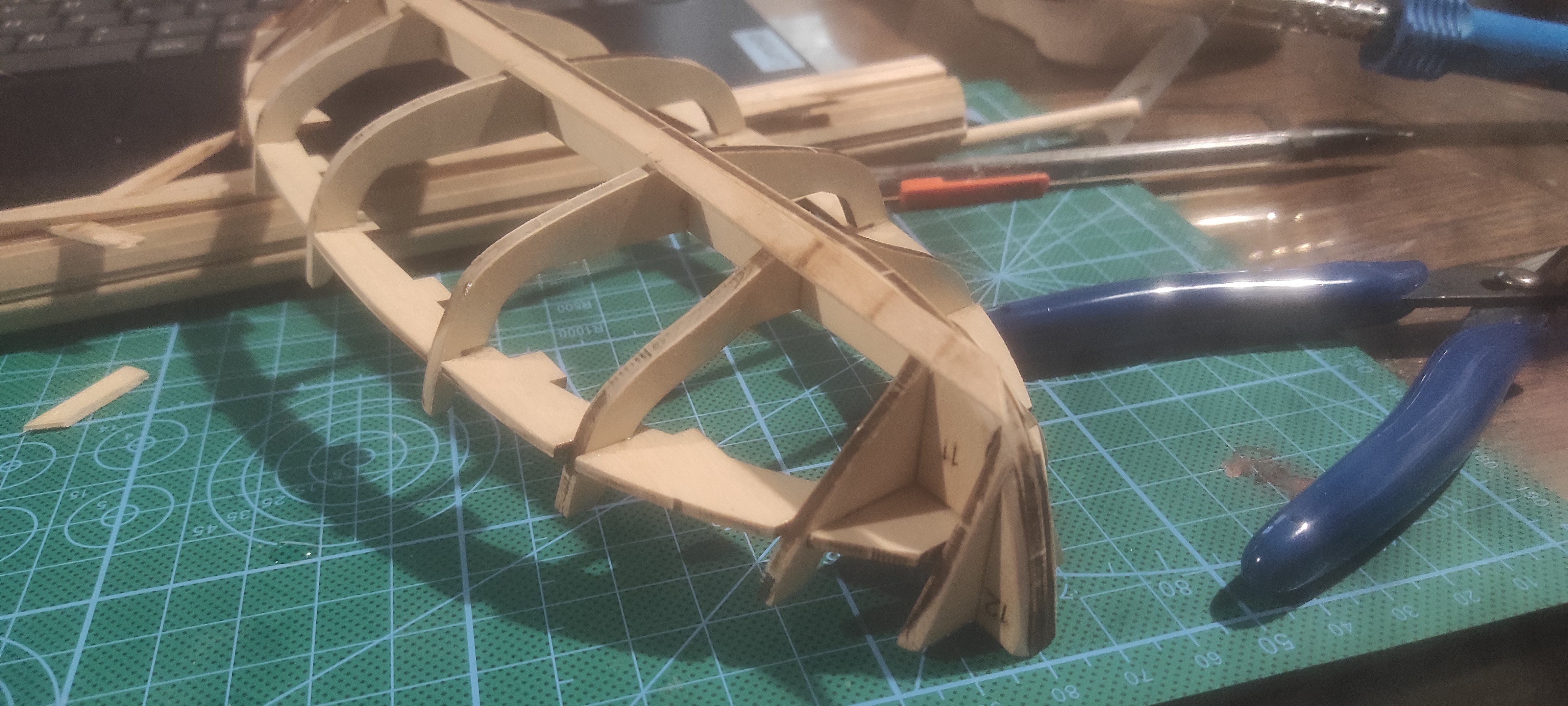

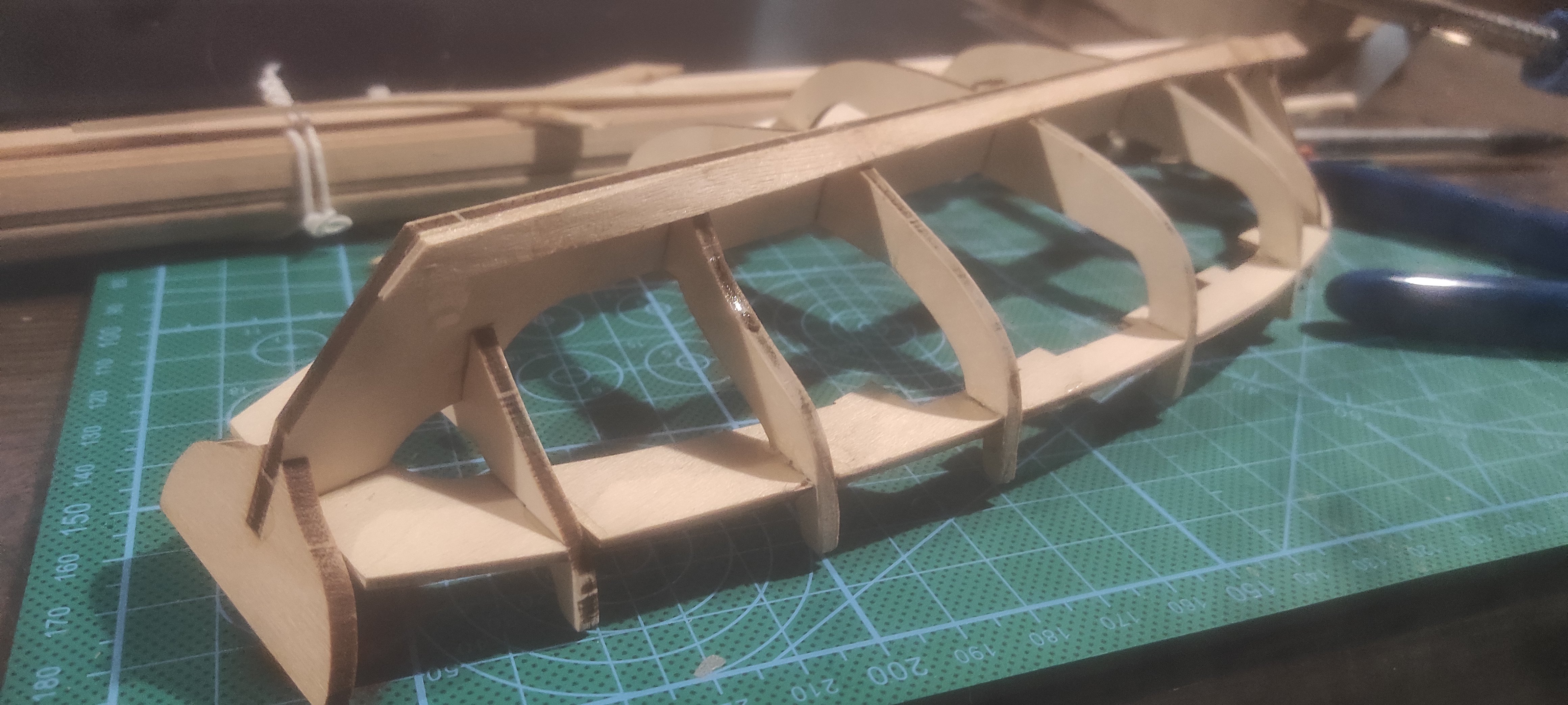

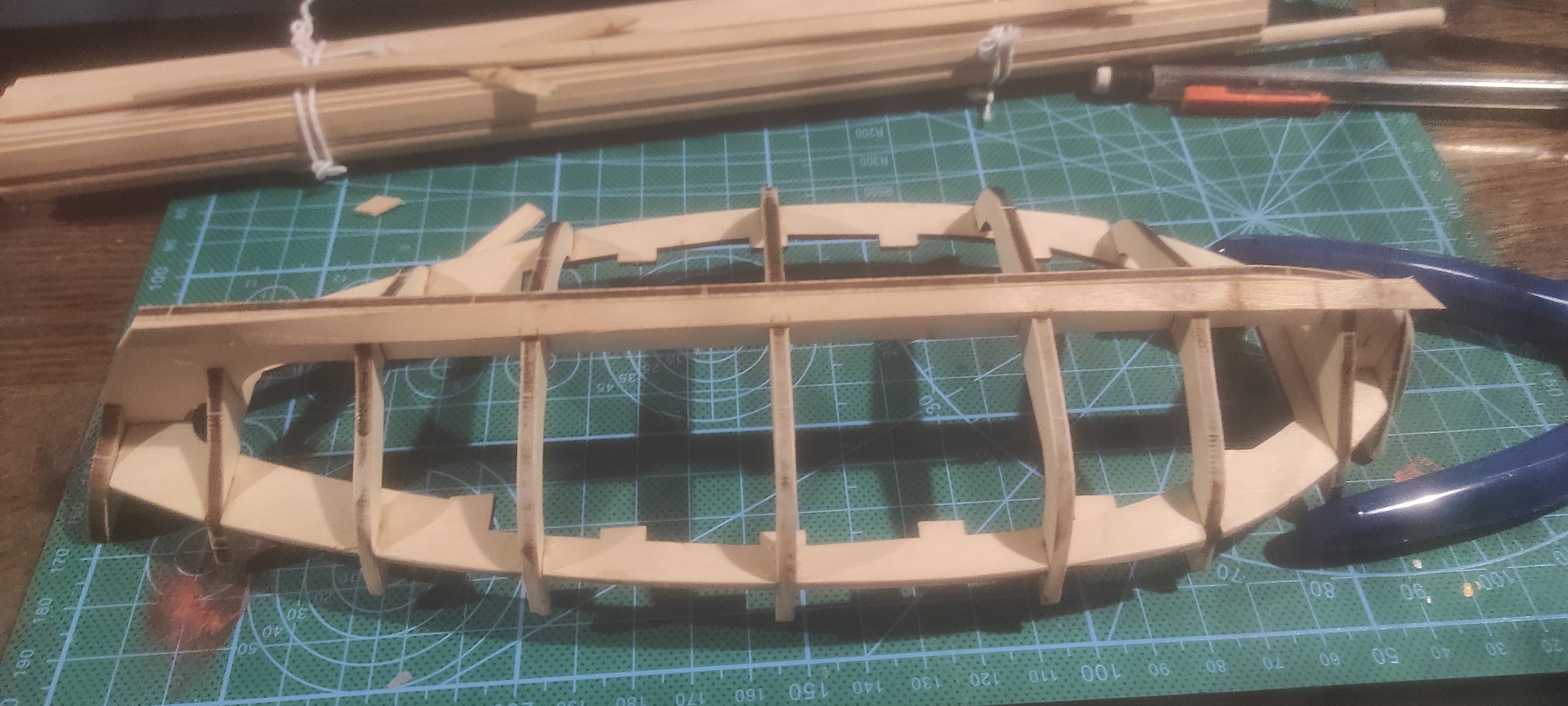

I received for my birthday my first boat model of the HMS Bounty (Jolly Boat) from Artesia Latina because they know I like building things but such a thing is a first for me.
I finished the inner frame (if you can call it like that) and the instructions tell me to attach the plank to the hull (I'm french) and for that I need to bend them.
I tried one a few days ago, i moistened it 5mn before trying to bend it and it didn't gave me the results I expected.
It was hard to even give it a shape and it's a bit black on some part of the plank because it's hot.
How do I use it, is there something I don't know?
