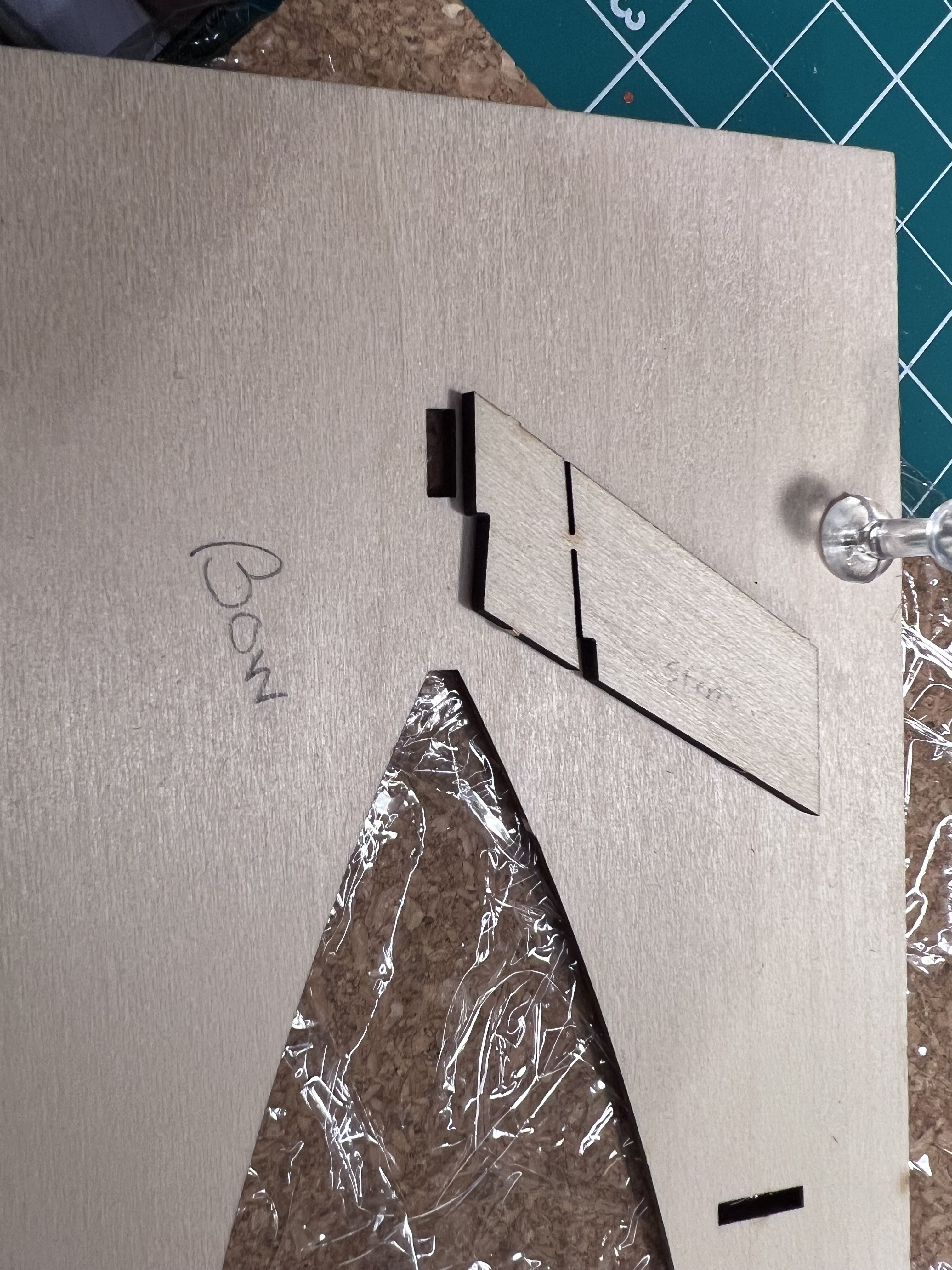

Well, the frustration begins. The stem and sternpost are supposed to slot into the building board but the tabs on the piece are not the same size as the slot they are supposed to fit into.
(Easy enough to just cut the slot out longer, but given that this is a relative beginner model it’s the kind of thing that can stop a beginner in their tracks. A lesson you learn is that you can and you need to improvise and treats these errors in the model as small puzzles you need to solve. I just don’t know why model kit companies don’t see it in their interests to try to minimize these basic errors, especially in starter kits.)

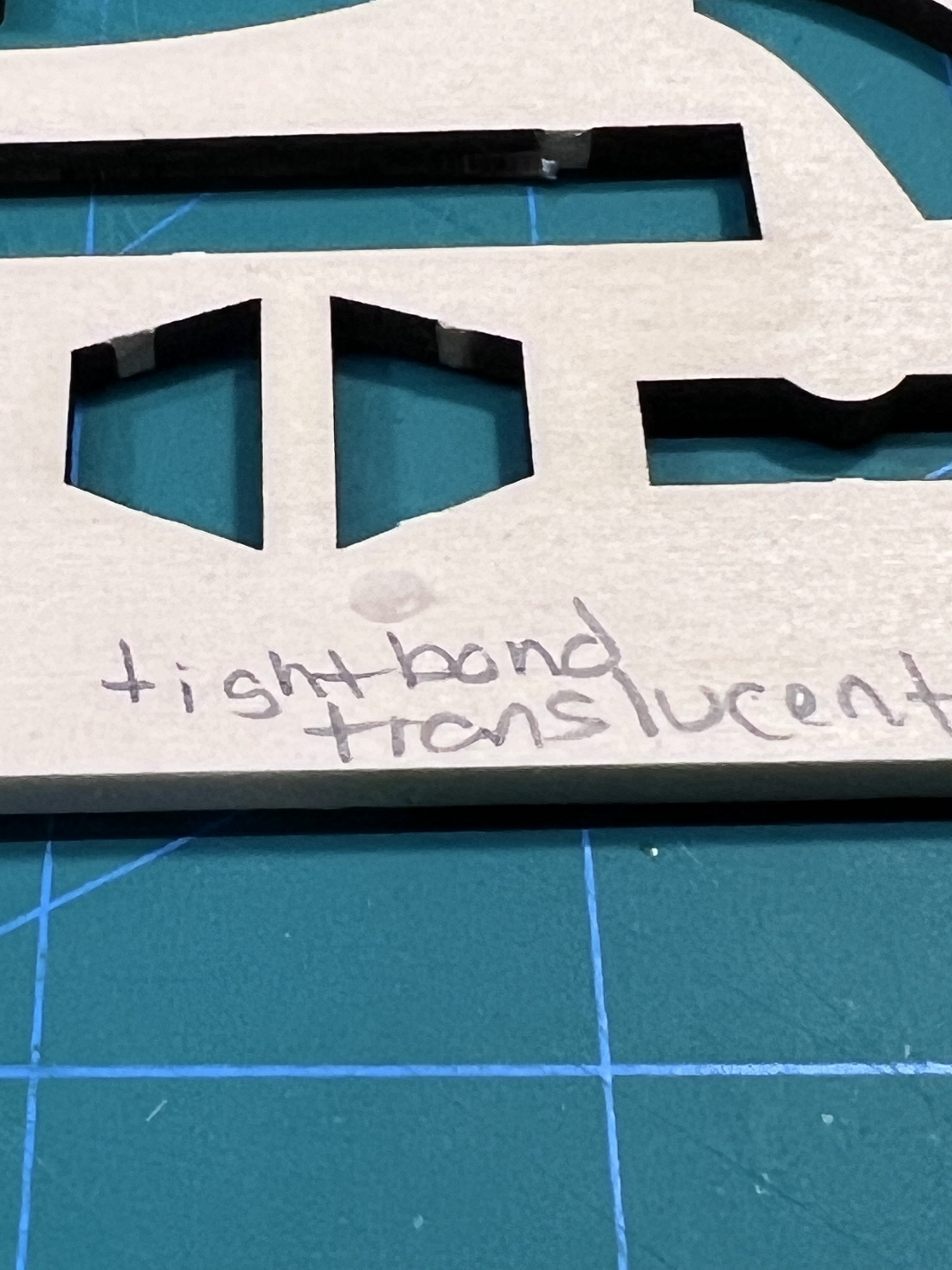

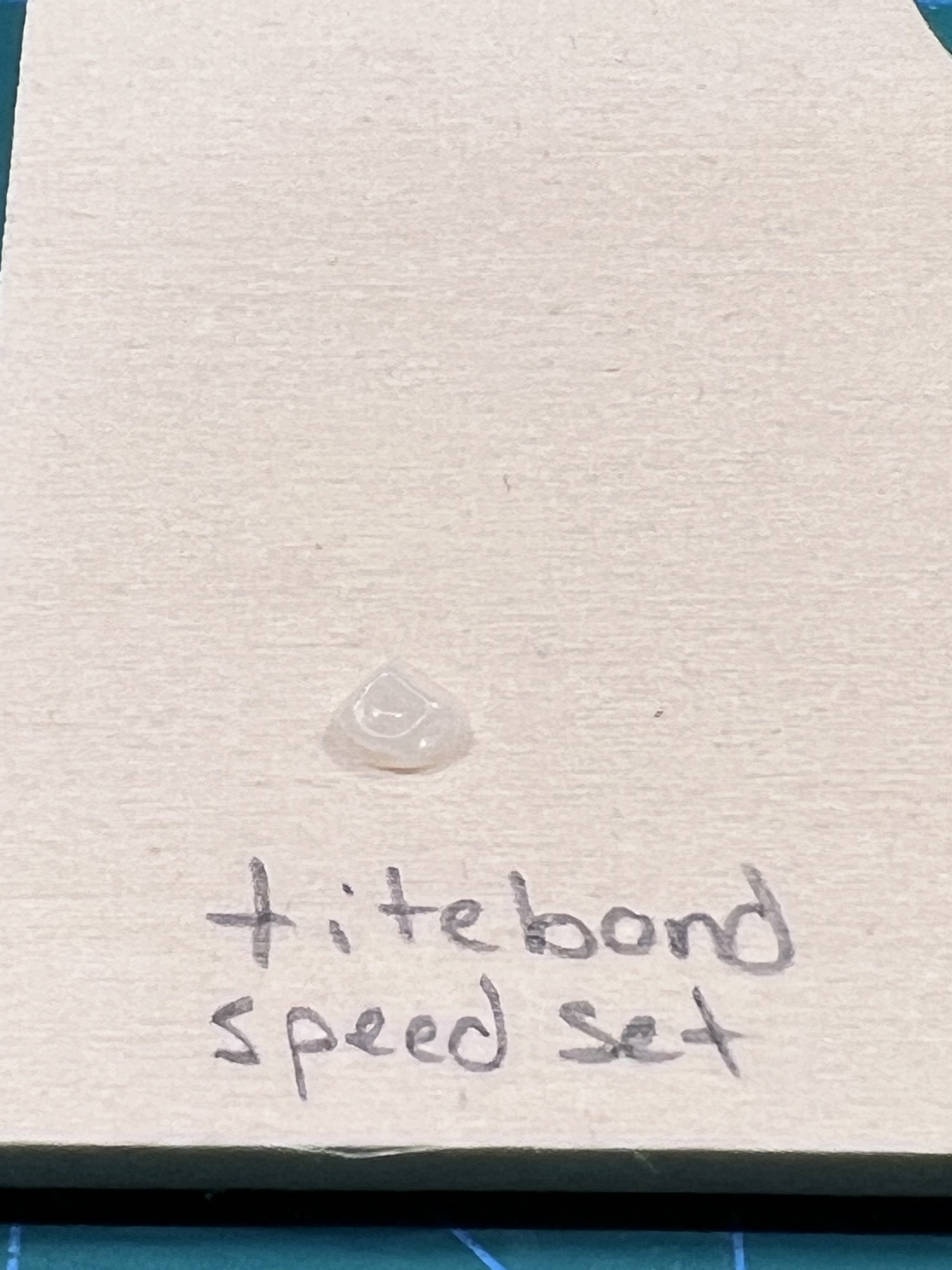

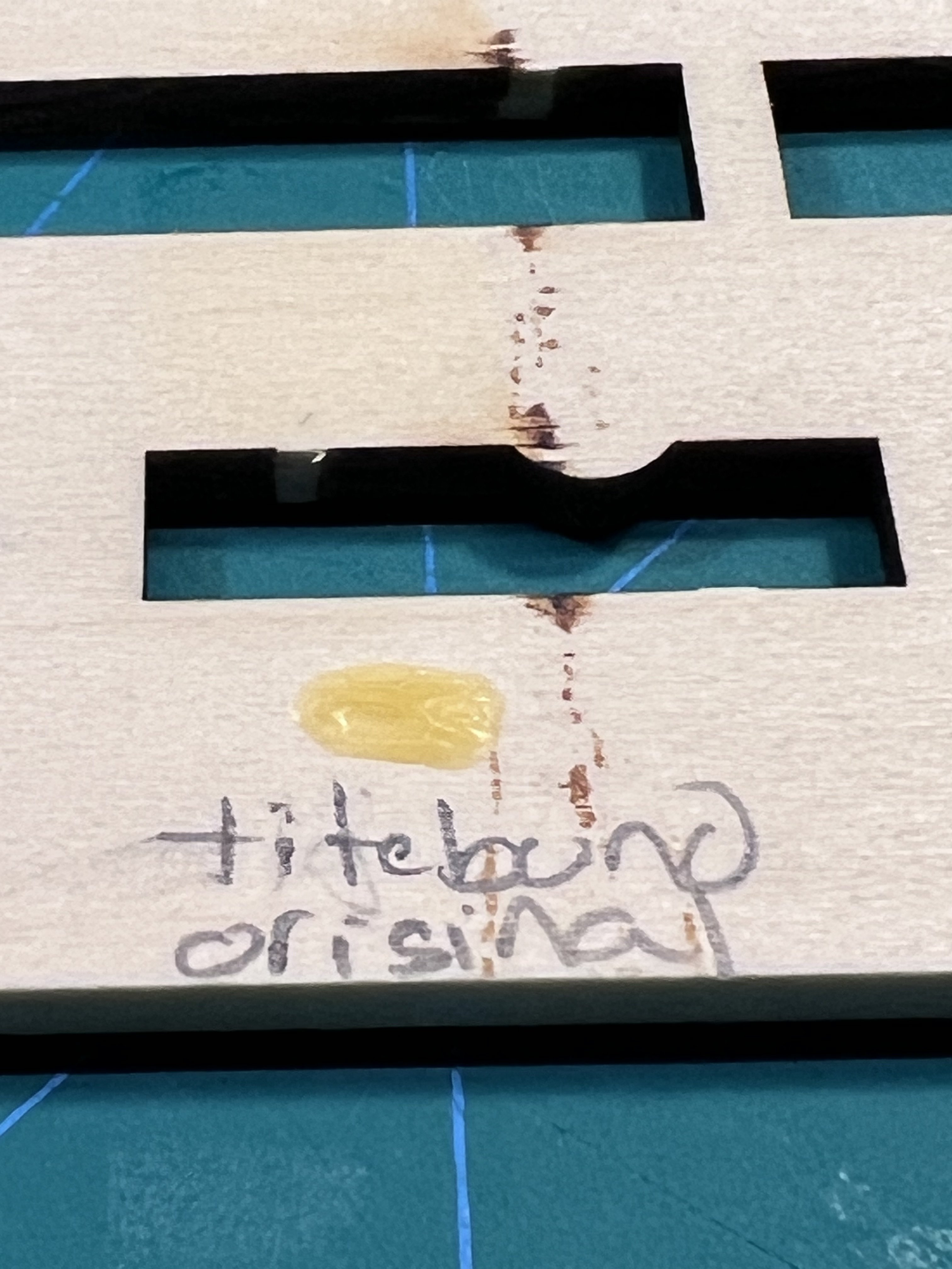

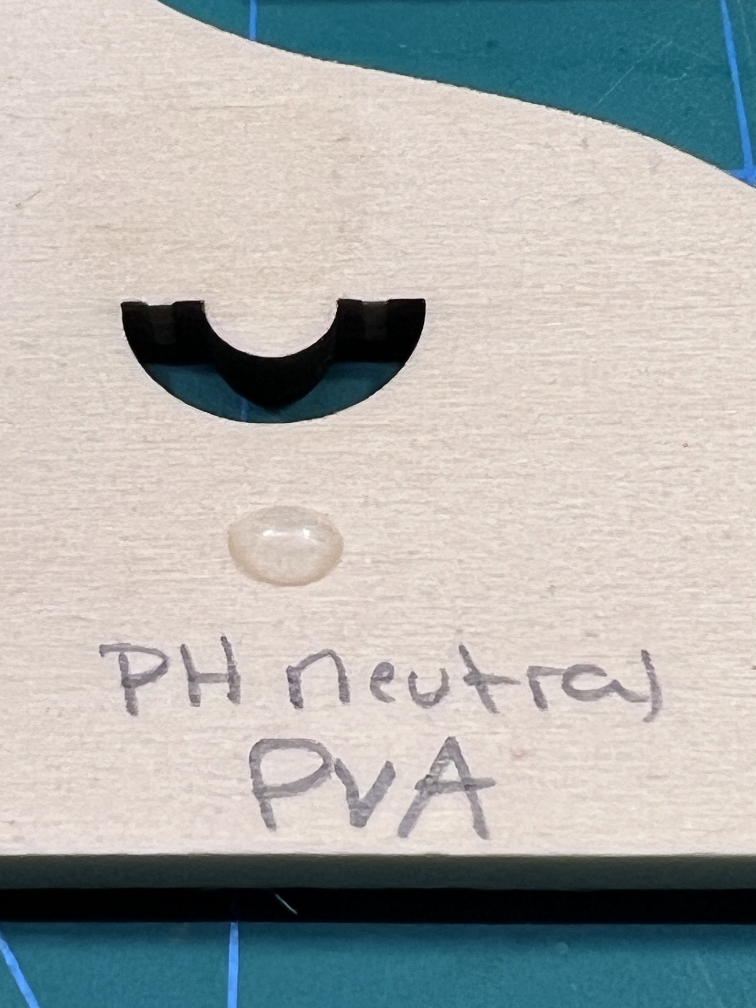

I had accumulated a few different glues. I had never compared them on their translucence - until now.
Titebond original is bright yellow.

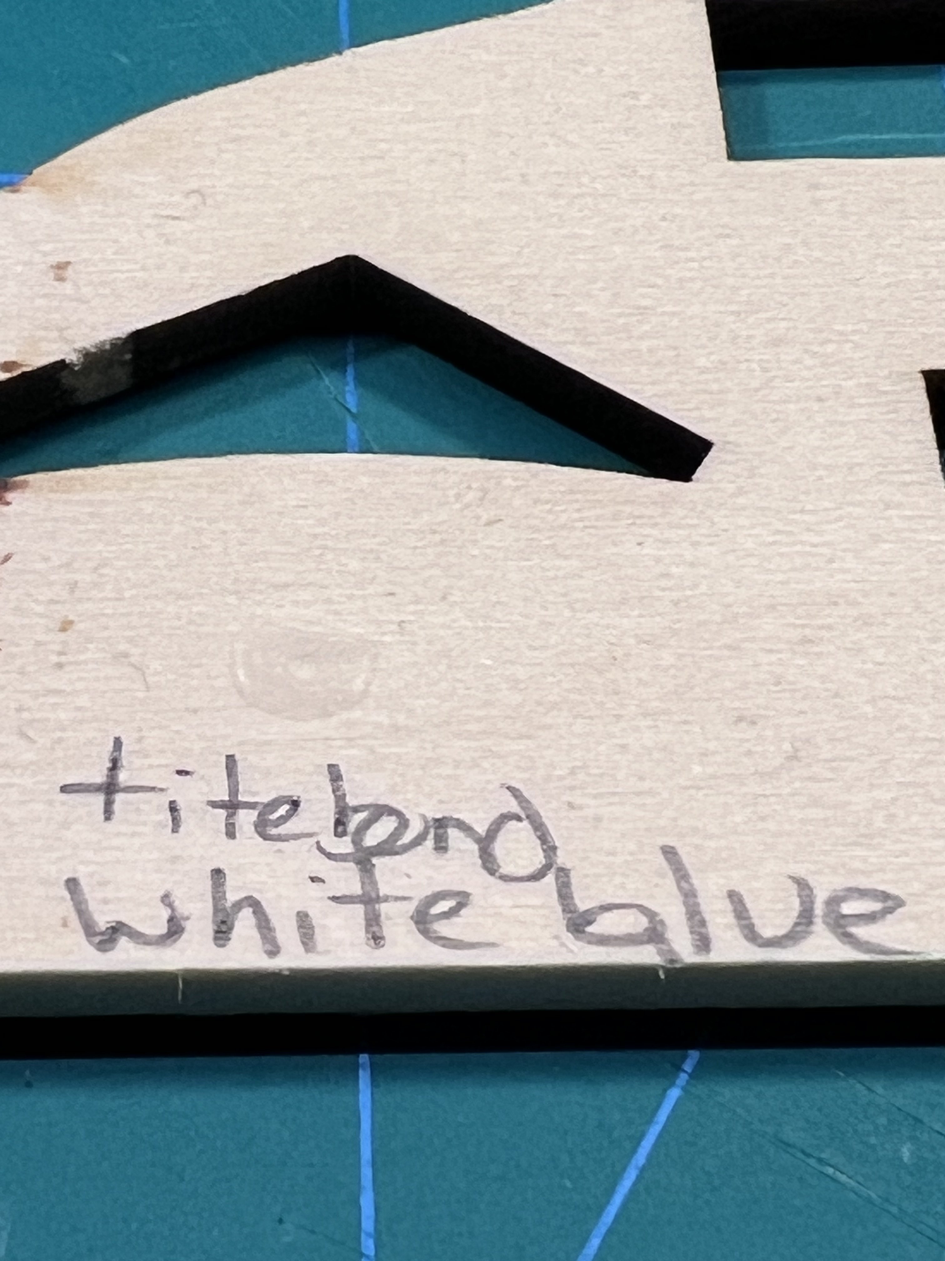

Titebond Speed Set, Titebond White Glue, and Titebond Transluscent are variously white to semi-opaque.
PH Neutral PVA (bookbinders glue) is nearly clear.
I’m going to relegate the original Titebond to the cellar. I’ll use the others when I’m pretty sure I won’t accidentally get some glue on bare wood - and if I do I’ll scrape it off before it dries. I’ll use the PH Neutral bookbinders glue for times when I want a clear glue - like when using a diluted PVA on ratlines.

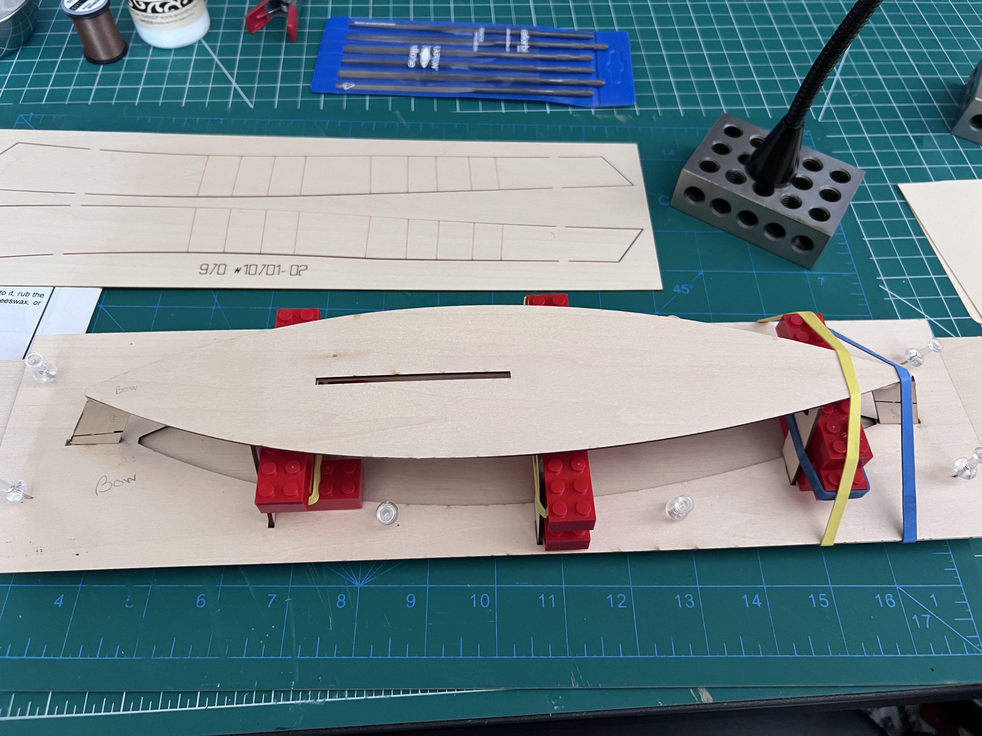

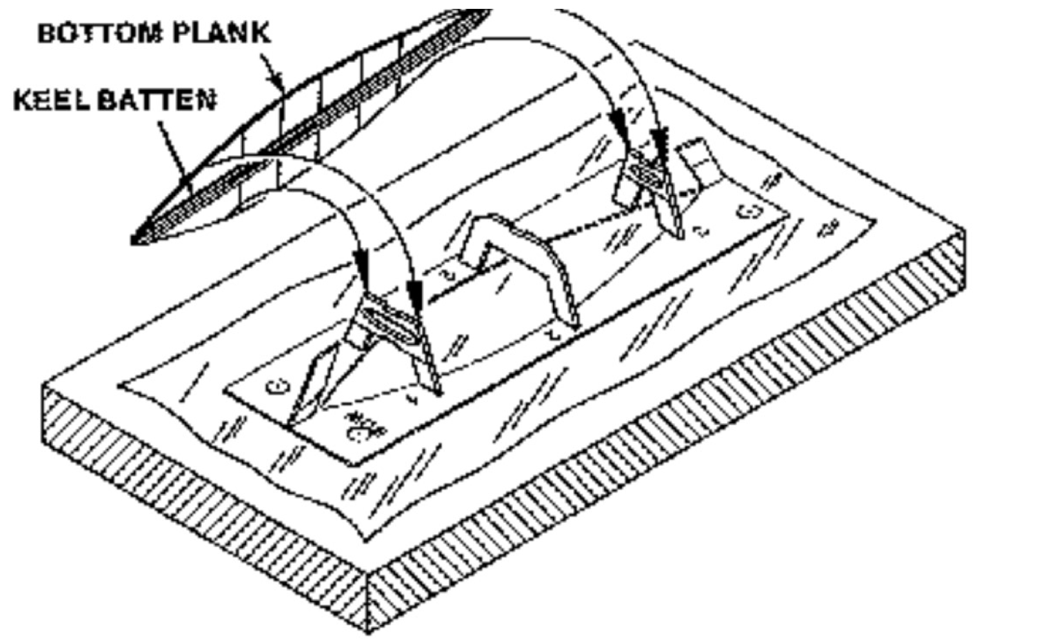

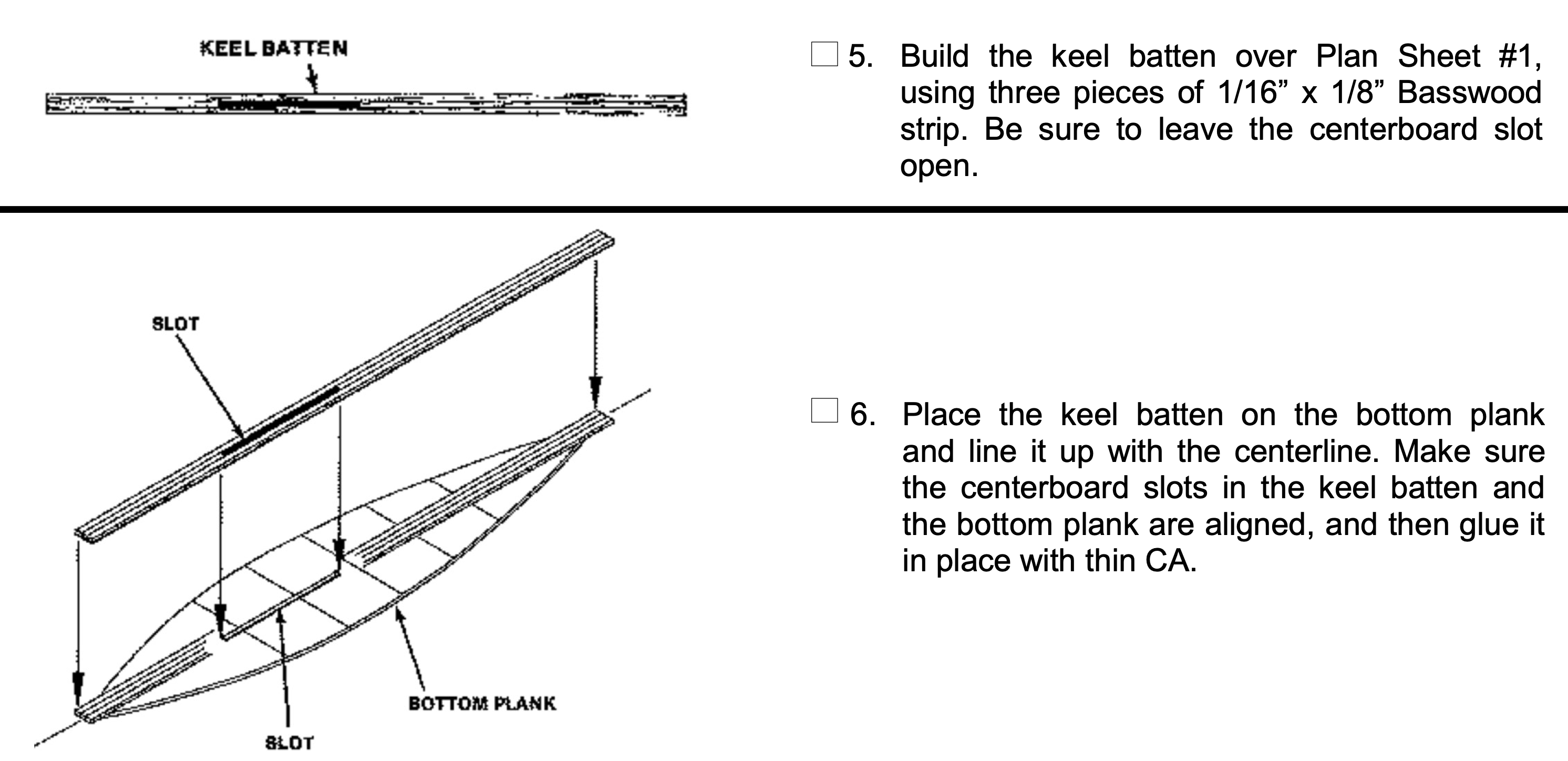

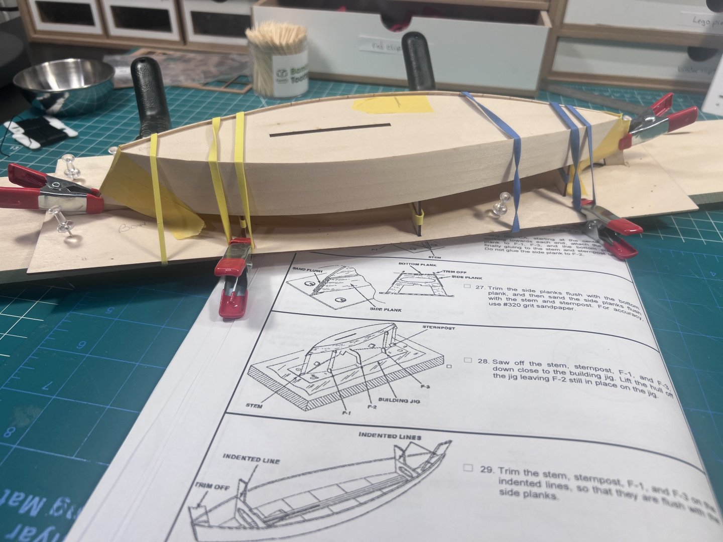

In this case, I needed to make a keel batten out of strips and glue it to the base of the boat. Easy enough. Sorry, I forgot to take photos of it in my build, so I'm including the illustration in the instructions. Then later you need to turn the base over and fit the keel batten into slots in the frame so that the bottom is also then flush with the remained of the frame. Again, forgot to take photos, so I've pasted the illustration. Turns out the keel batten was slightly larger than the slots. You want it tight, but this would just not fit. So I had to take a file and little by little widen each side of the slot until the batten fit snuggly into each of the frame pieces.

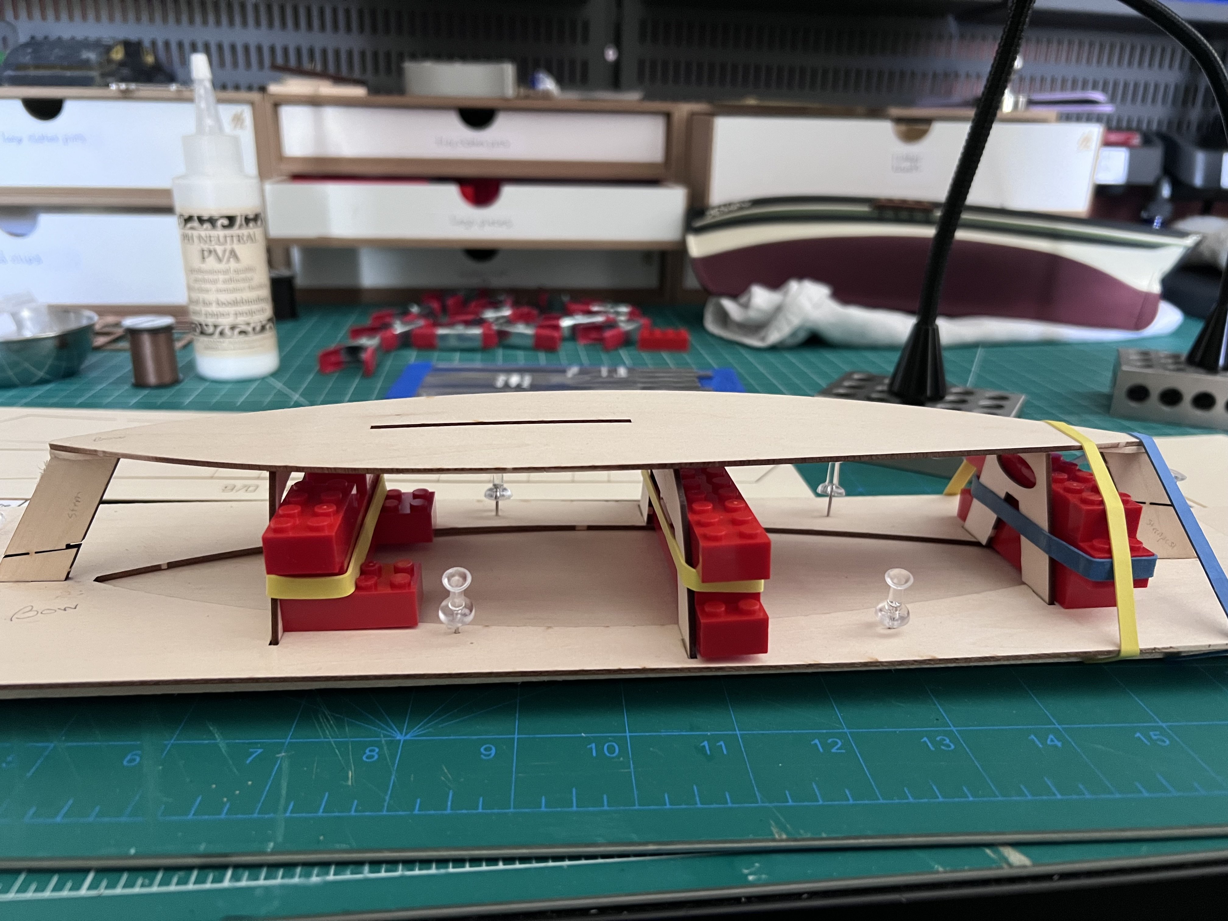

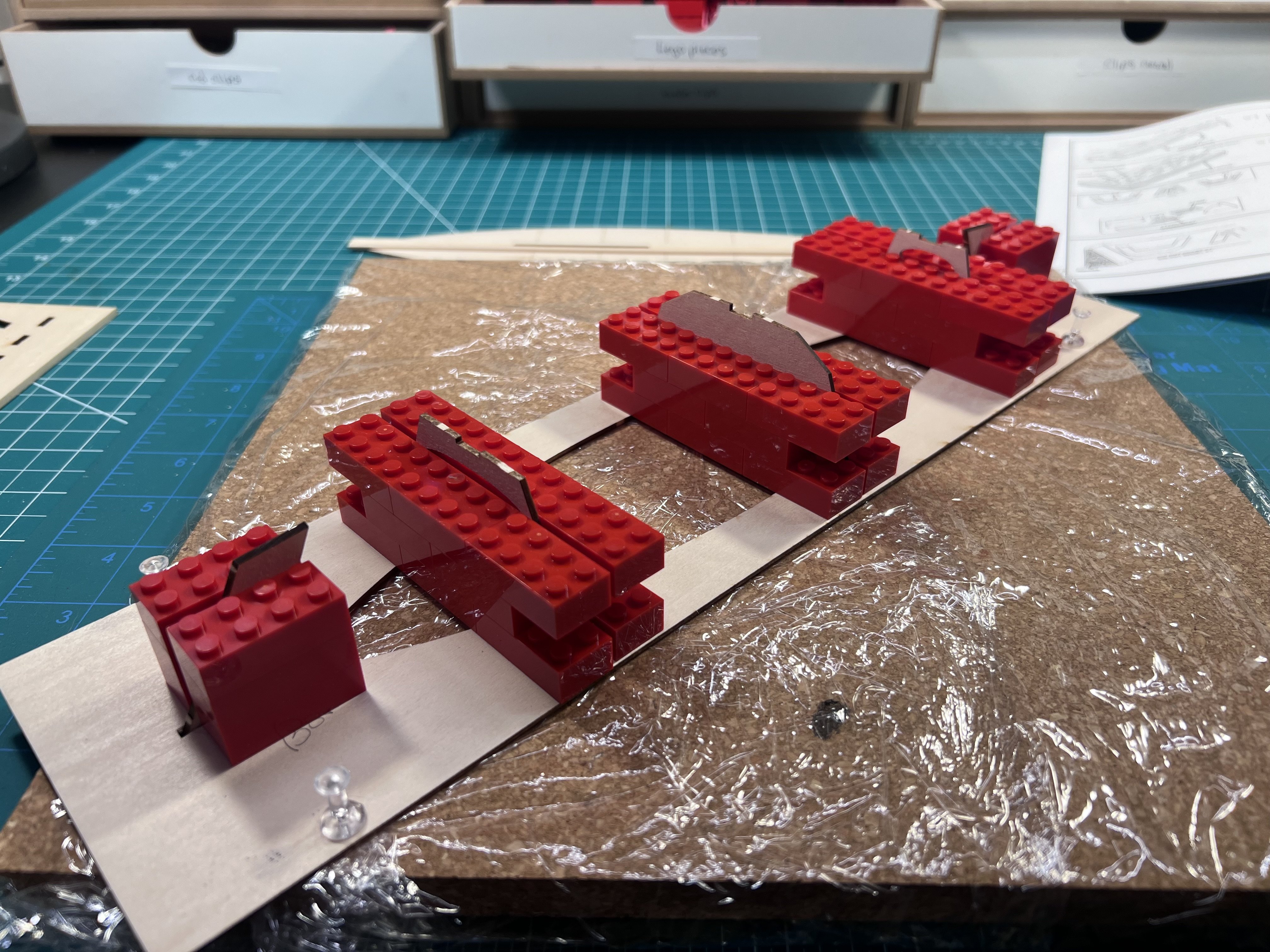

You need a nice solid base to attach the building board to (it's just the scrap thin basswood from where you take out the bottom of the boat, so it's not a board itself). It needs to be solid because you'll need to do a descent amount of bending of the bottom around the frames to get all the pieces glued down (you don't glue the middle frame because that's going to be removed), and you'll want to be able to use something like rubber bands that go around the boat and around the solid board. You wouldn't want to soak a thin sheet of basswood like the bottom is made out of because it would get warped. You need something like rubber bands and weights to keep things in place. And you need to make sure the frames, which were glued in square before, stay at 90 degrees. Everything is thin basswood so it all bends easily. The instructions call for using CA glue, which I think is nuts. You need to really do a lot of repositioning to get all the parts to line up right and then you need to get rubber bands and weights in place and things might get out of position and need to be repositioned again. The Midwest kits (this is my third) all seem to love using CA glue. Use wood glue except when you're adding something like metal parts. CA glue cures too quickly (even medium) when you need to do a bunch of fiddling and repositioning in my experience.

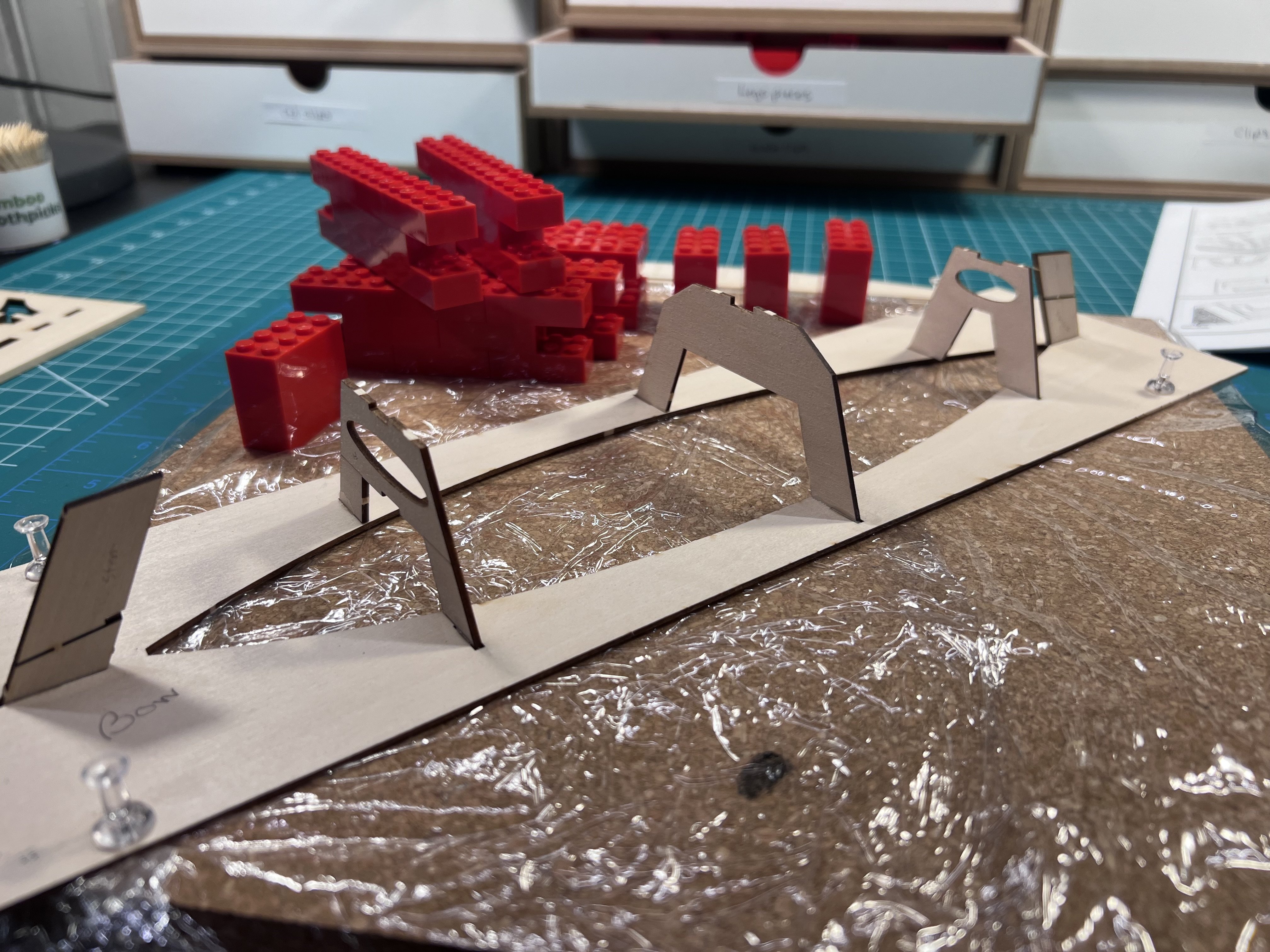

Then there was the challenge that the ends of the base did not meet up to the ends of the stem and sternposts. Maybe that was because the slots to insert those in the building board (see above) did not fit. Not thinking, I made them larger in a direction that made the stem and sternposts farther apart. I probably should have instead gone in the other direction when I widened the slot. So anyone else building this: If you have the same issue with the slots of the stem and sternpost not fitting, check the length of the bottom to guide you in which direction to make the slots larger. You learn something even from a simple model.
Note that the photos are from this morning after I had to reglue one end of the boat and secure it. Last night, there were rubber bands in a few other places and some weights - actually 1-2-3 blocks covered in Saran Wrap - holding everything along the full length of the boat in place.
When the glue is all cured I'll have to do some shaping, filing, sanding around the stem and sternposts. The instructions call for some of that anyway. I'll just need to do more than I might have otherwise.

Ok, so as much as I said it was nuts to use CA, I ended up using medium gel CA to attach the plank (there’s a single plank on each side of this model) just to the middle of the base, then when it was set I used wood glue and clamps and rubber bands to attach the plank to the rest of the base and to the front and rear frames (the middle frame is removed). Need to be careful because basswood is soft and thin so easily deformed and dented.

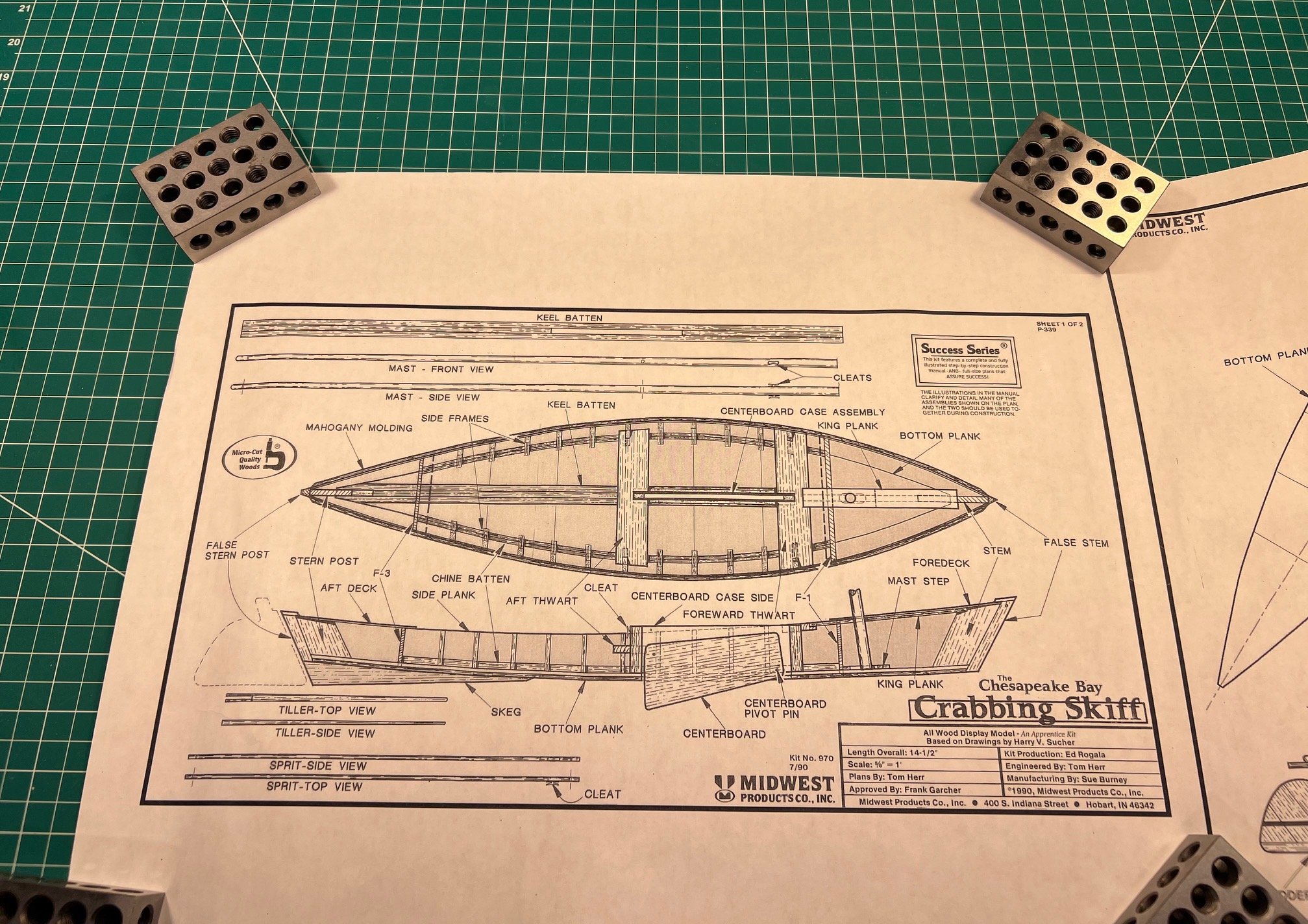

I know this is a reissue of older Midwest Model kits. The parts are not labeled and the piece maps in the instructions do not match the sheets.
There is a piece map in the very front of the instructions. Easy to miss - as I did with a previous Midwest model.

Thoughts? Shouldn’t a boat like this have a thin “deck piece” that goes above the side frames? The model has the thin side planking and the side frames but nothing on top of the side frames. Just a thin planking and the side frames with the only decking at the front and back, not along the sides. I googled around and some versions of skiffs have thin decking around the side. I don’t know if this is modeled after a skiff with no thin side decking or if it was designed that way because this is a relatively beginner model. Thoughts?
Edited by palmerit
The empty thwart notches are definitely a bit odd. You may be able to find more about the possible cap rail or partial decking in Howard Chapelle's American Small Sailing Craft (which can be checked out from the internet archive, last I checked). There's a lot of info on small Chesapeake workboats there.
