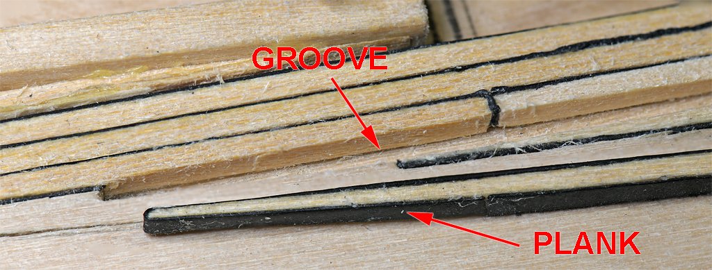

I have been planking the decks on my MSI model and ran into a challenging problem.
The planks are pretty thin (1/16 x 1/16 inch or 1.6 x 1.6 mm) and flexible. They are nibbed into a nibbing strake along the edges of the deck. The deckhouse sides are not parallel, so the planks have to be tapered to fit along the house sides. Planking at the bow and stern is pretty simple, but these deck sections meet along the house sides. Keeping the decking pattern straight and parallel to the centerline was pretty tricky in this area!

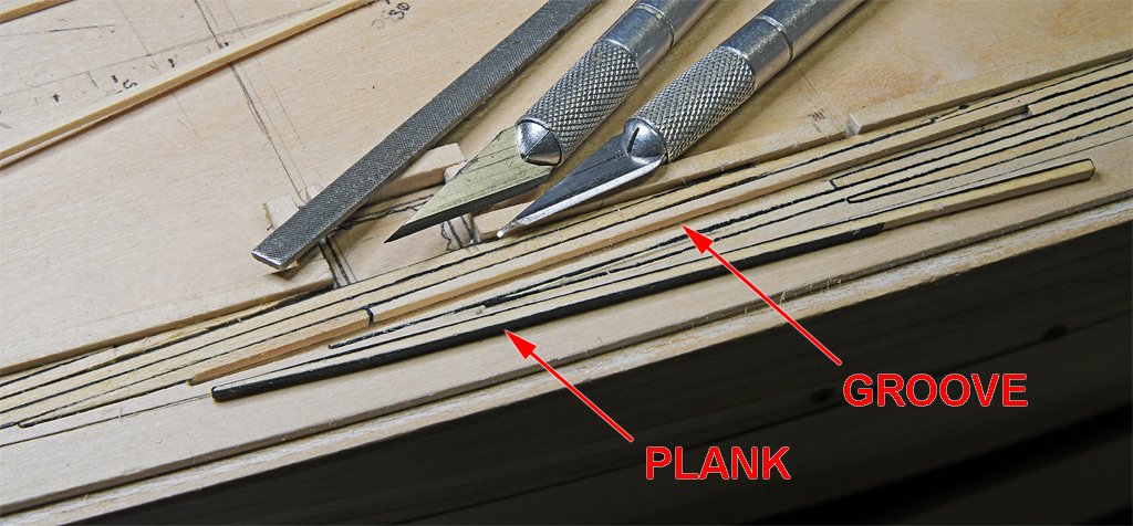

Plankandgroove1.jpg.085a717e9a93014db73dff938b2b8d02.jpgThe planks have 0.005 inch (0.13 mm) black paper "grout" glued along the edges.
The last plank between the forward and aft planking is nibbed into the nibbing strake and sandwiched between two neighboring planks. Because it is the last plank it has paper grout along both edges.
It is a very tight fit into the groove between the neighboring planks. And because the planks actually varied quite a bit in width it was a problem getting the last plank to fit into the groove.

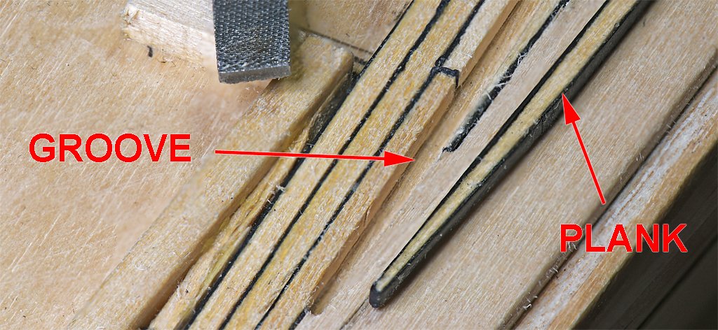

Here are a couple more photos to illustrate the problem.
Plankandgroove3.jpg.14cd2ce5b8df015cae8f50424a7faedc.jpgPlankandgroove2.jpg.78678485b2ef7161ac3d1f37932b2489.jpg
QUESTION: How would you go about widening the groove so the last plank would fit? This is a pretty narrow groove!
The small file shown in the pictures was 0.055 inch (1.4 mm) thick, only slightly thinner than a plank. It didn't remove much material and I had to be careful not to foul the opposing top edge of the neighboring plank. And it tended to remove more material from the bottom of the groove (not good) than along the sides.
What other method would you suggest to remove very small amounts of wood from the sides of the planks along the groove?

If you look at the second photo in my original post you will see two hobby knives with #11 blades. The blade on the right has been ground down to make a narrow chisel about 1/2 plank width.  I used it to make the initial cut in the nibbing strake where the plank end is nibbed into the strake.
I also used the sides of the "chisel" to scrape the edges of the groove to widen it. It did work, but it was slow going. On the other hand, I did want to remove material gradually until the plank just fit into the groove with a slip fit. So slow was good.

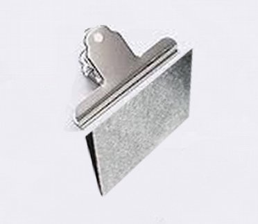

My suggestion with the folded sandpaper is what you see in the (photoshopped) below photo.
You can keep a strip of folded sandpaper between a " Bulldog clip" and use the folded edge in the groove.
Keep the jaws of the clip as close to the folded edge...

Good idea! The metal clip makes a good handle to control the sandpaper. The one problem I see with this is that the grit along the edge of the fold can remove material from the bottom of the groove, making it deeper. With the deck planking application it really won't matter much if the plank is a tight fit into the groove. I put glue on the bottom of the plank (you could put it in the groove) and press the planks into the groove most of the way. Then I use a wooden stick to press the plank down so the top of the plank is level with the tops of the neighboring planks. So the plank won't slide too deep in the groove.
