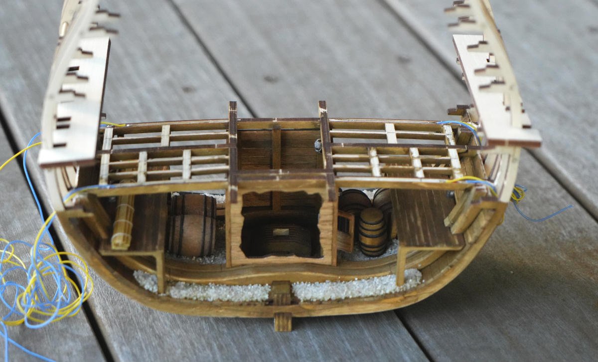

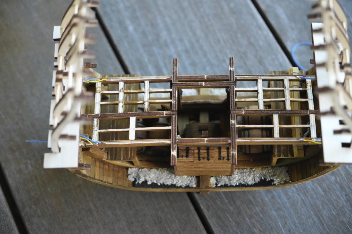

Most of the work I did, was upgrading the ceiling of the hold with additional wood pieces. There are not many pictures of the part of the ship and I used the website of Henk Ship Models, Victory build to locate the individual pieces. I was not able to verify if this is correct.
I also added 4 of my flickering LED lamps.

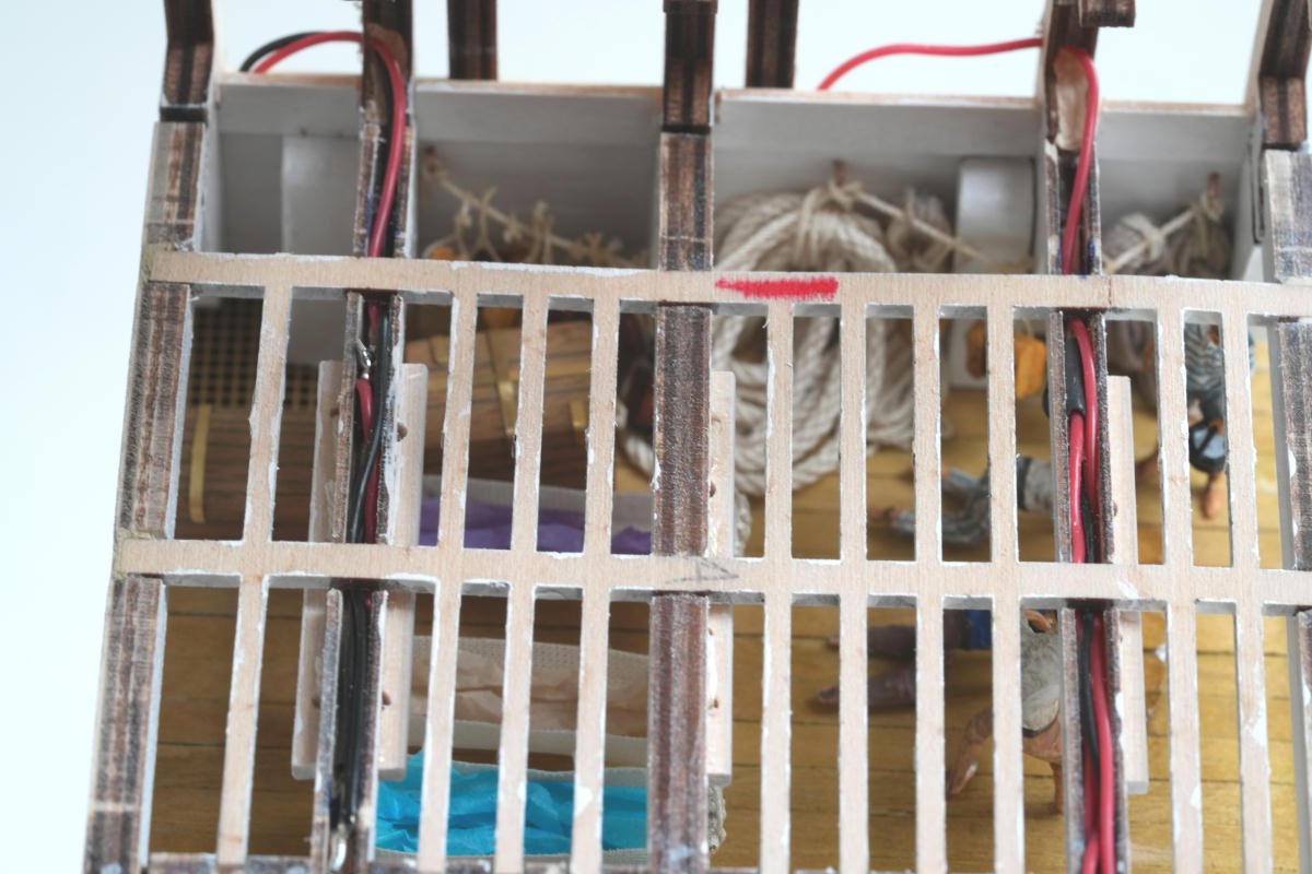

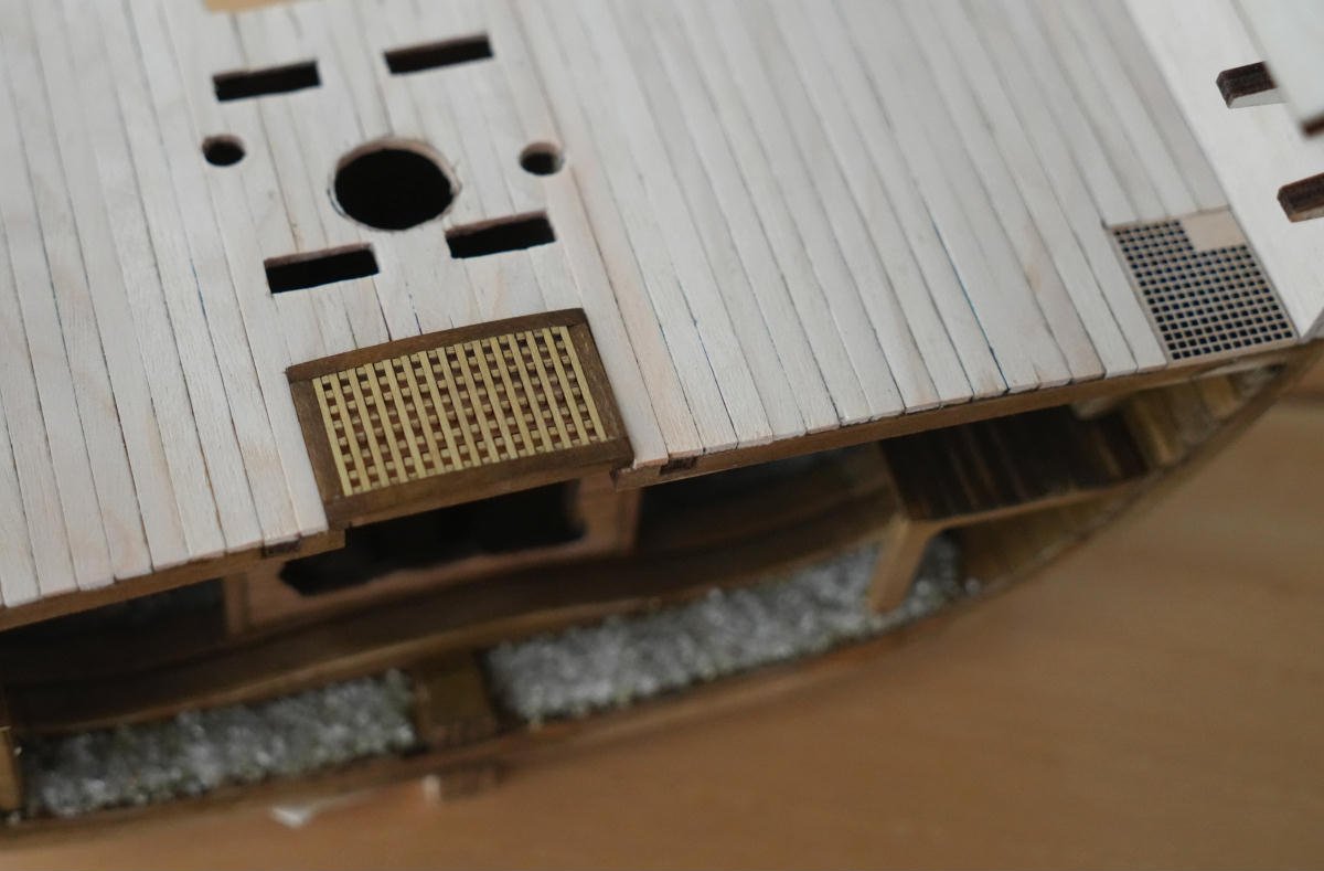

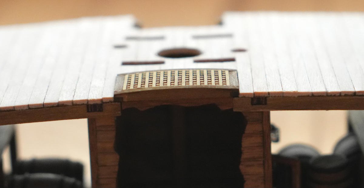

I moved on to the Orlop deck and did not like the provided grates from the kit. The ones by the walls were even brass etched. I lasered a full pieces including the frame. It looks okay but after that I decided to really spent more time on the grates that look more prototypical. I checked out what is available but did not see anything I could not do with my laser myself. It took some time to get the right spacing since I had cut the deck of the orlop already and needed to fit the opening. The higher decks will much easier to make my pieces work.
I still have to adjust the height of the smaller frame pieces, so I can sand it in an arch as well. I am not good in geometry and cutting it out and measure is easier than to calculate.

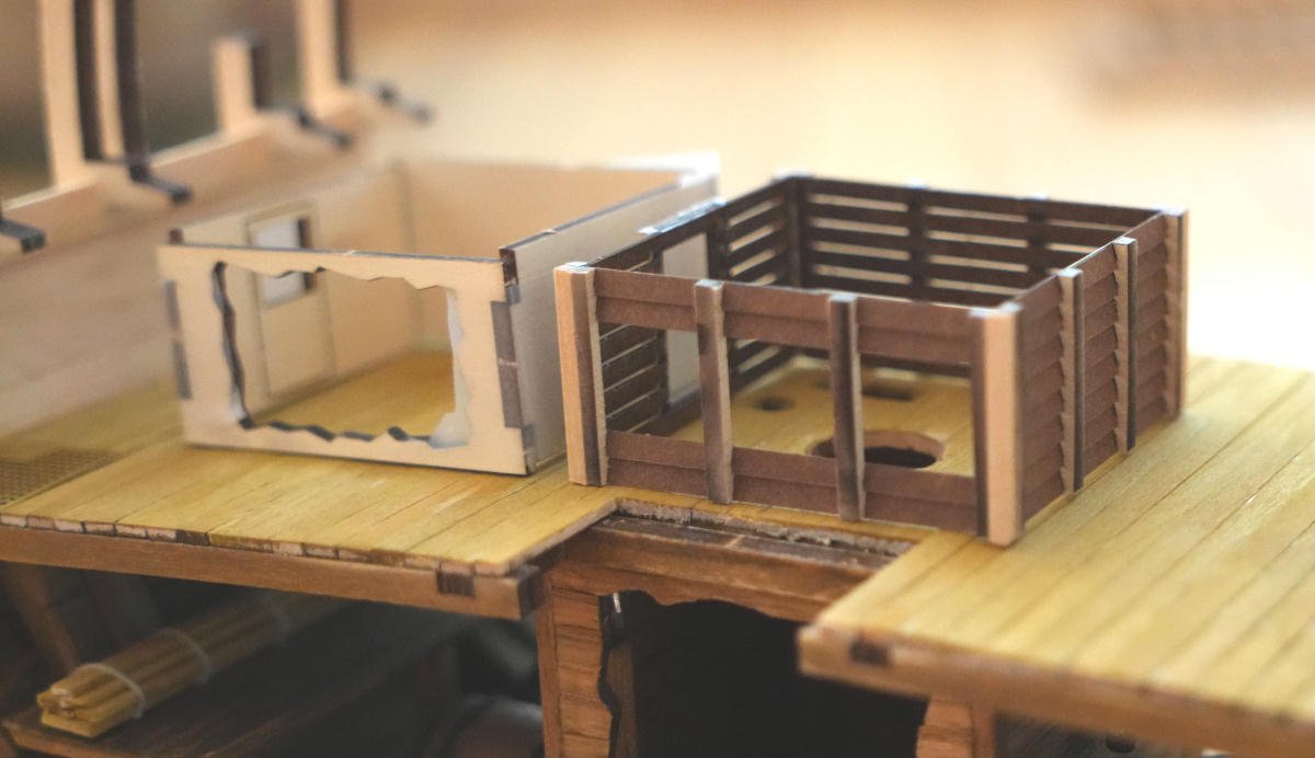

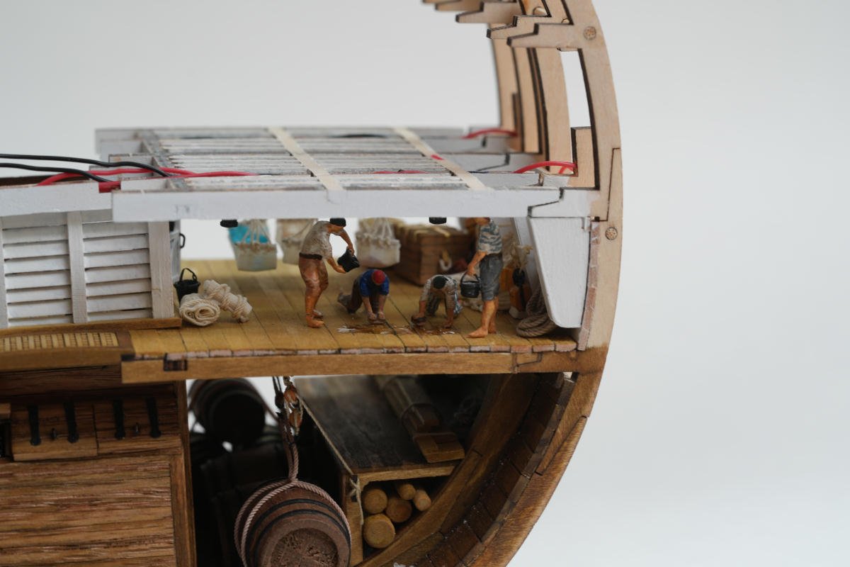

I did not like the kit provided pump house on the orlop deck. I was checking out the Artesania Latina Victory anatomy version and with that kit you get the louvered pump house. Using the build video, I designed the building although I don't know if it is correct. Unfortunately, I could not find any pictures of the real thing and went wit AL version. Still needs some white paint. I am unsure if the white paint is also inside since AL suggest to paint it light oak.
I also need to sand it into shape or add some wood pieces to the outside posts to make up for the curved deck.

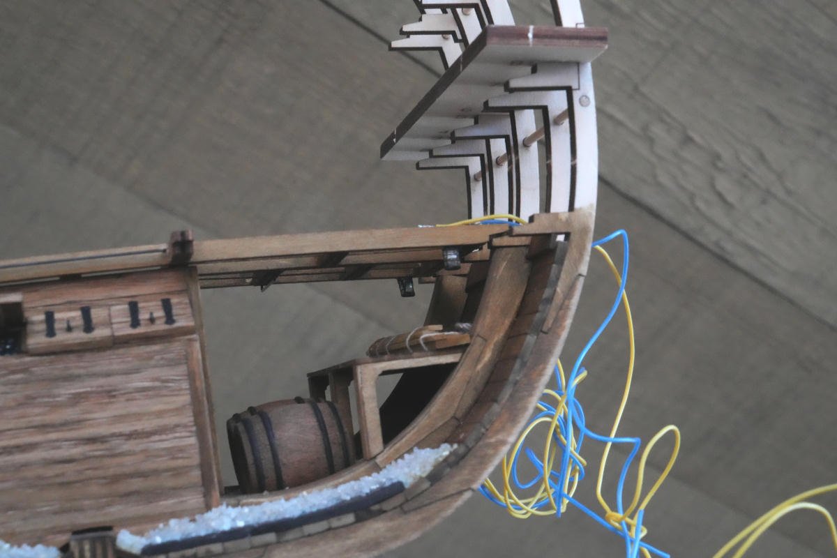

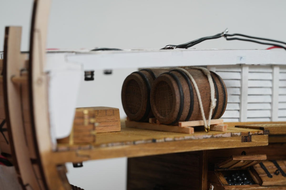

I needed smaller barrels than the kit provided, which I have seen on pictures of the HMS Victory. I bought a collection of cheap hobby wood dowels and gave it a go.
With a $45 mini table saw and a $35 wood lathe, I was able to produce this one. I am still working on the right coloring and the "metal" bands are to wide for this size of barrel but for the first try, it looks promising.
I added more cargo to the hold. I also wanted to show off my first self made ropes (slummed over the barrel and hanging next to it) although the don't look like the ones I bought from Ropes of Scale but I did not expect that anyhow. I hope, the higher I go on the cross section, the better my ropes will get. I might have to add more decks to the Victoria.

I don't know if somebody mention it before, but this is how I paint the iron bands around barrels of kit provided pieces.
I use regular masking tape which I cut thinner than the distance between the bands and apply it in multiple windings.
Instead of paint out of a bottle, I use an artist water-based pen. I have this one for years and it is still not dried out.
You don't have to be very careful with the pen since it will not creep underneath the tape.
There might be some spots that I unintentionally covered up but the pen also has 2 different sizes of tips to fix that.

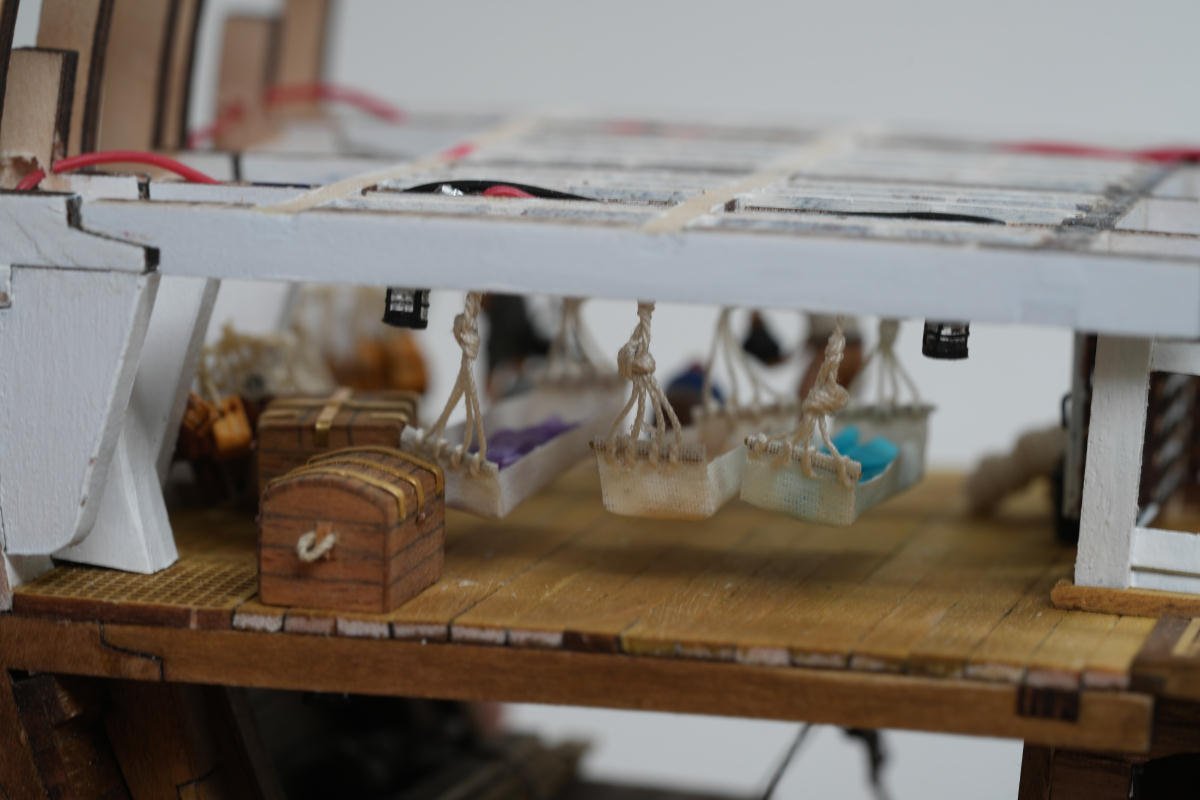

I finished the Orlop Deck. I added as many pieces as I could verify in pictures of the Victory and other ships around this time.
I upgraded the hammocks a little bit but I did not work out the way I imagined. Adding additional lines made them hang crooked.

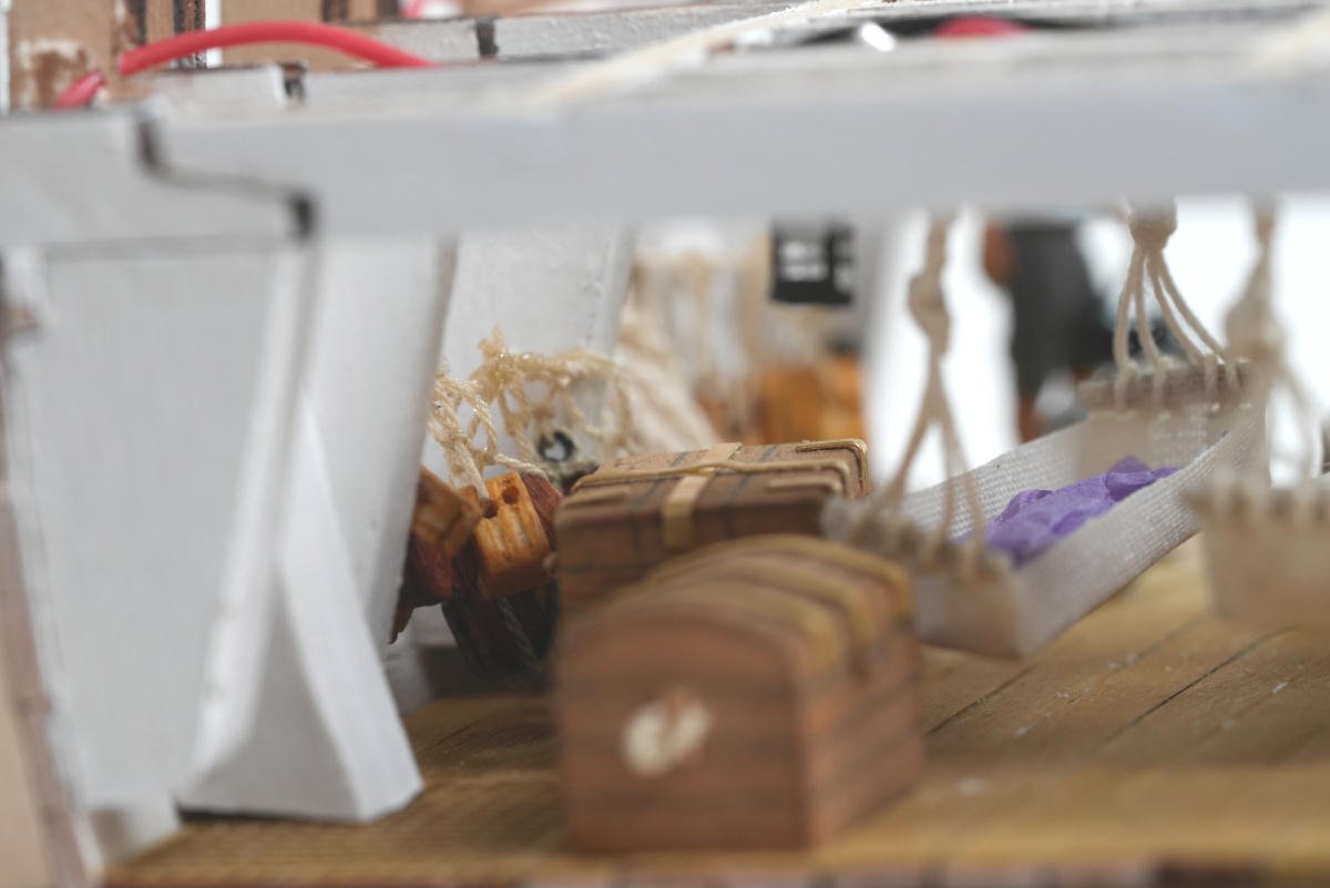

Like I did in the hold ceiling, I added the missing beams. This time I laser cut a basswood sheet instead of adding individual pieces. With a few more adjustments and it will work as planed for the rest of the model. I don't know, why the supplied beams are too short but some wood filler should fix the problem.
The idea of storage of spare blocks and ropes on a line,  came from a photo of the USS Constitution Orlop deck. Since I upgraded to Syren 3D blocks, I wanted to use the kit provided parts somehow.
Although you see that scene a lot in movies on the top deck, I moved it down. I will not have enough room on the busy quarterdeck with all the officers, gun crews and marines. I assume all decks were cleaned on a ship, especially the orlop deck with the surgeon nearby. The figures are from the Victory set offered by Woodys Model Works.
Still showing of my self made ropes when ever I have an opportunity.
