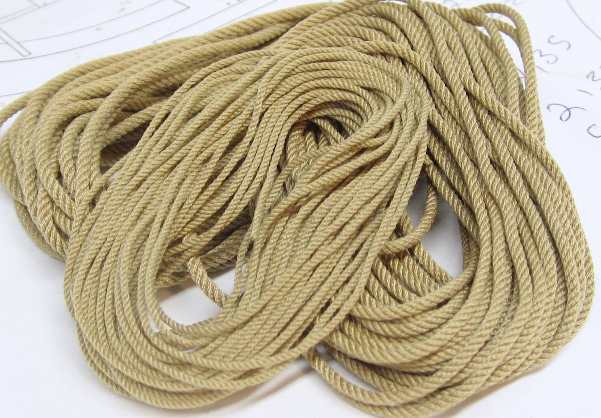

I'm building the Model Shipways Constitution Cross section and am building the lower shrouds using the materials included in the kit.
Do I first; wax the thread, treat the thread with a white glue/water mixture, or leave the thread untreated?
Thank you for any advice you can give me.
Tom
Hello Tom, since you are doing a cross section,  they don't  have a lot of thread, I would buy good rigging thread . It makes the world  of difference . Some very good sponsors for rope right here on MSW. Or you can serve the lines with fuzz free lines.

Wax before using and use white glue to secure knots or stiffen after. Depending on your thread you may or may not need to wax, Cheaper thread tends to be fuzzy in my experience while well-made thread does not.
Rich
  • The title was changed to question about waxing thread
Wax used to be recommended years ago to lay 'fuzz' on rigging line. Unless you are using really cheap and fuzzy stuff, forget about using wax. Also, beeswax is slightly acidic and will rot the line in time. (A lot of old timers' advice was not the best!) If you absolutely have to use wax, use conservator's pH neutral wax instead.
Ideally, use good quality commercial line such as from Ropes of Scale. This has no fuzz and does not require 'treatment'. If you need to use adhesive, pH neutral white glue is best. Avoid CA (superglue) as it will eventually make the line brittle and break.
Alternatively , spin your own rope!
I use Renaissance (conservator's) Wax because a bunch of people recommended it over beeswax. I'm no expert, but the posts say that beeswax is acidic and attracts dust, whereas the conservator's wax dries clear, is neutral pH, and does not attract dust. It's expensive but you use only a tiny bit of it. I have no expertise on this. Just passing along what I've read.
