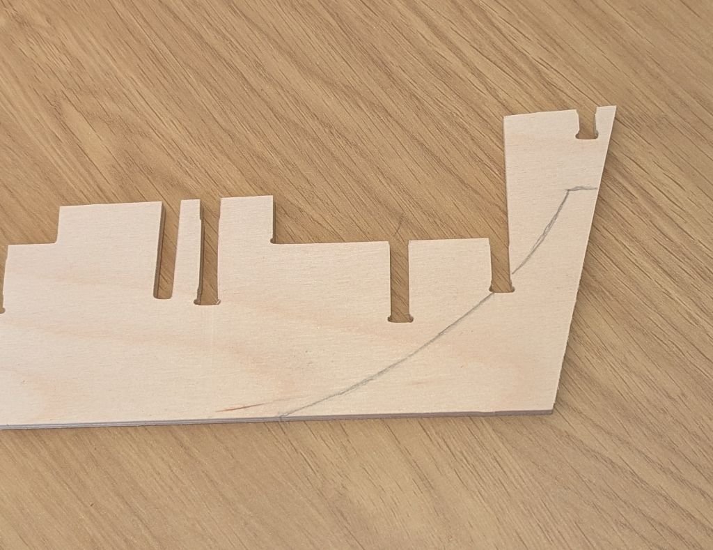

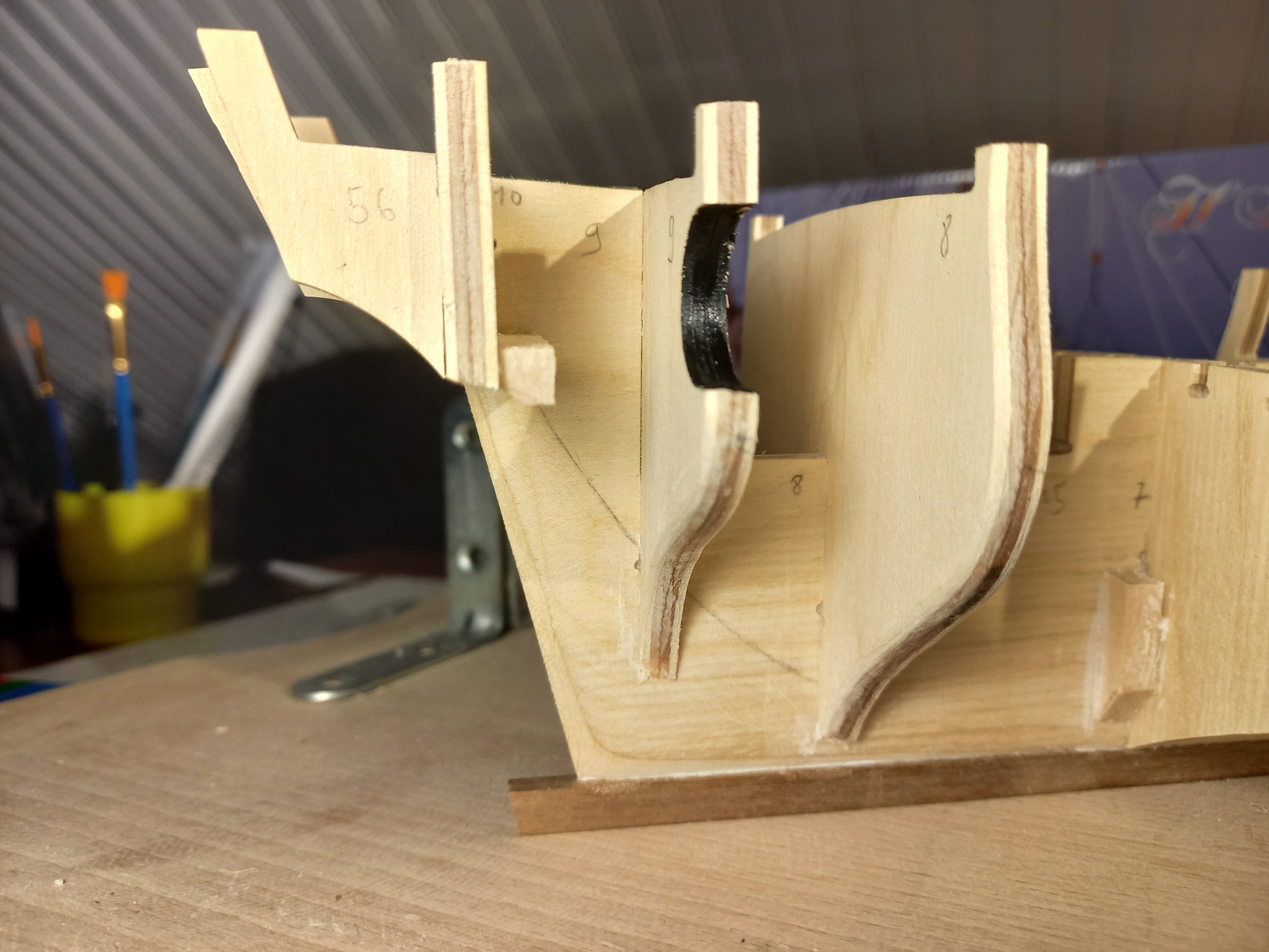

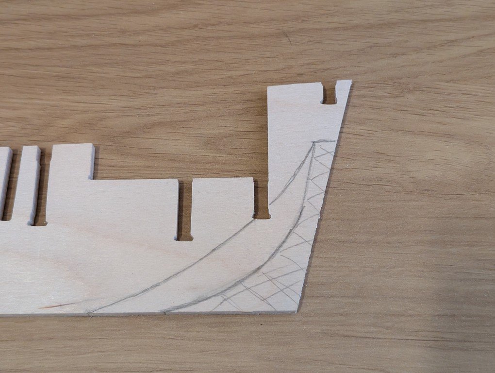

I've cut out the false keel and bulkheads and transferred the bearding line onto the hull as described in the instructions:

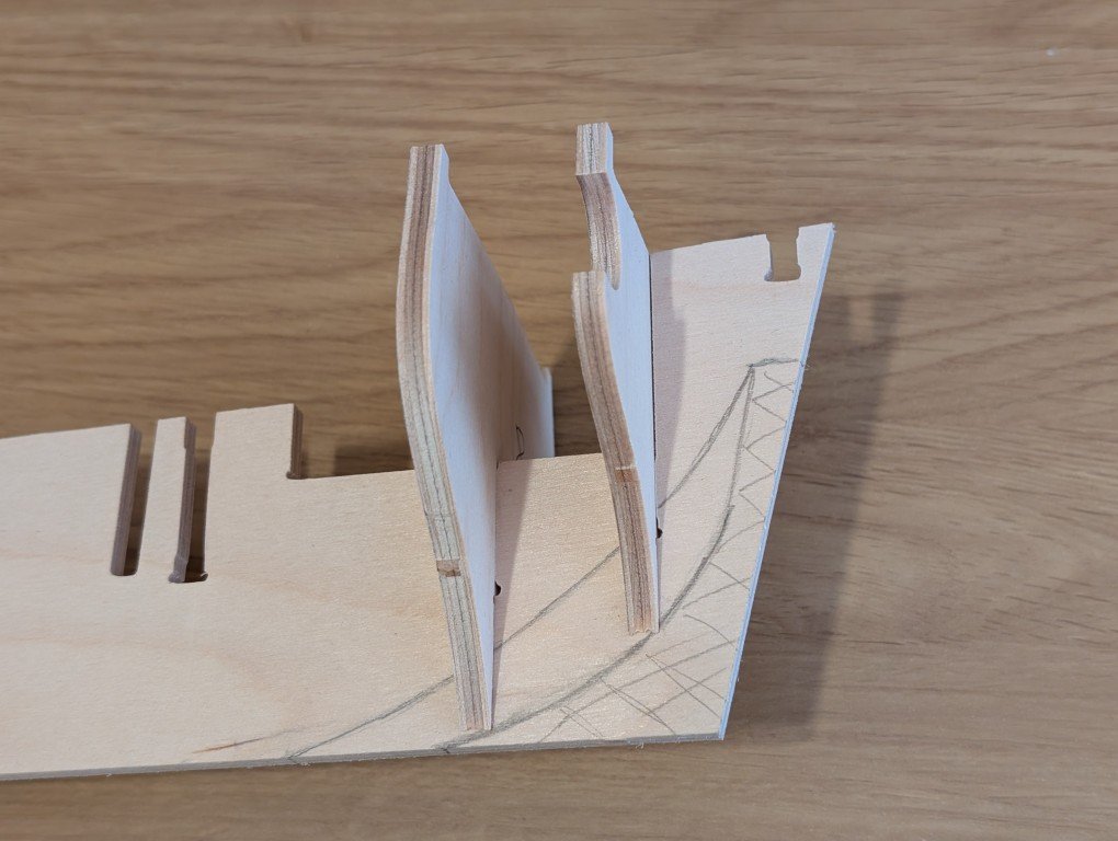

Now before I have even glued my first part, I have in issue which I need to resolve and would welcome some comments.  My issue is that following a dry fit of the bulkheads I see that the bearding line is well above the lowest section of the bulkheads.  I can't see this makes any sense at all, surly this is an error in the instructions.  The bearding line must be below the lowest part of the bulkheads.
Hopefully someone can confirm my thoughts are correct before I make my first mistake.  I suppose if I do wrong I have a spare.

Hi Brian,

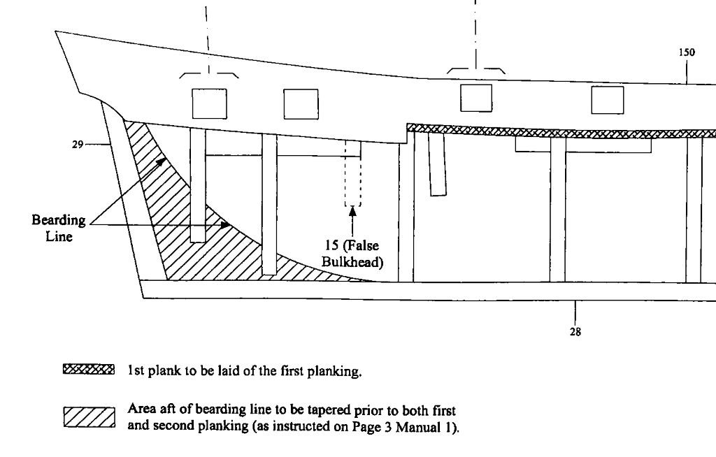

Thanks for your comment.  My understanding is that the bearding line is where tapering of the false keel starts, which allows the planks to land on the false keel and tapers down to the sternpost.  Surly tapering the keel under the bulkheads is pointless or an I missing something?

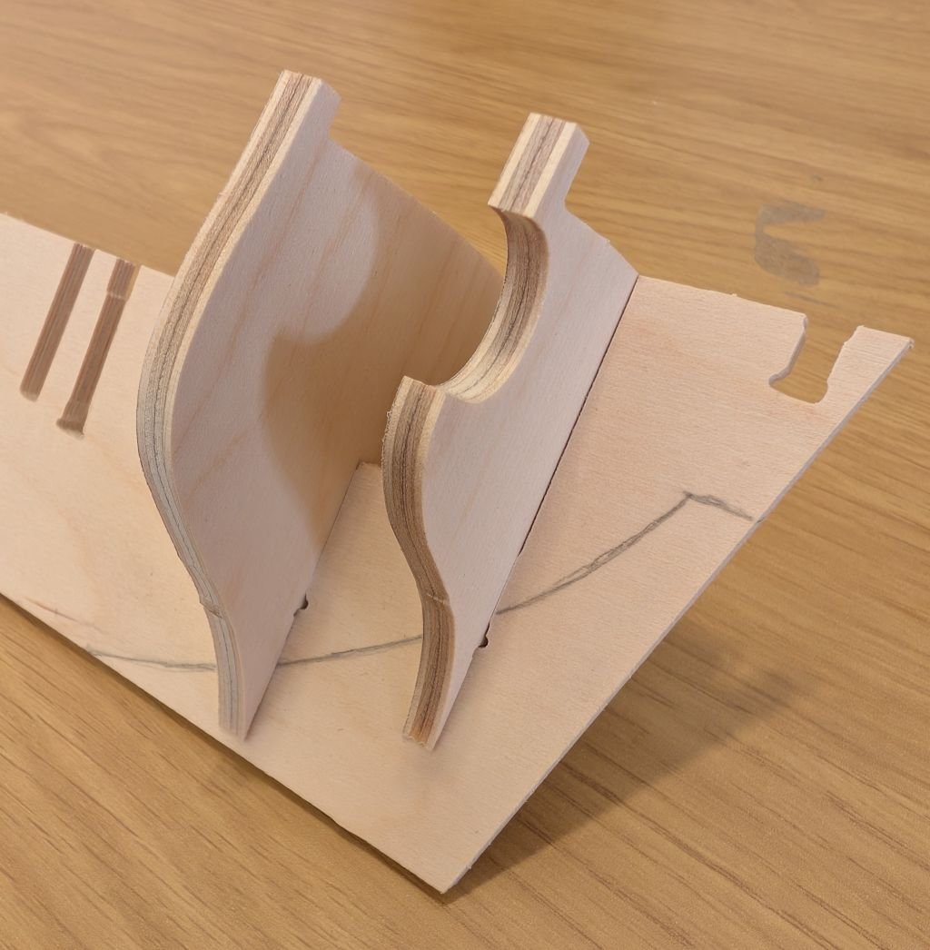

Good news, I will follow your blog with pleasure.
 I did  as you said
