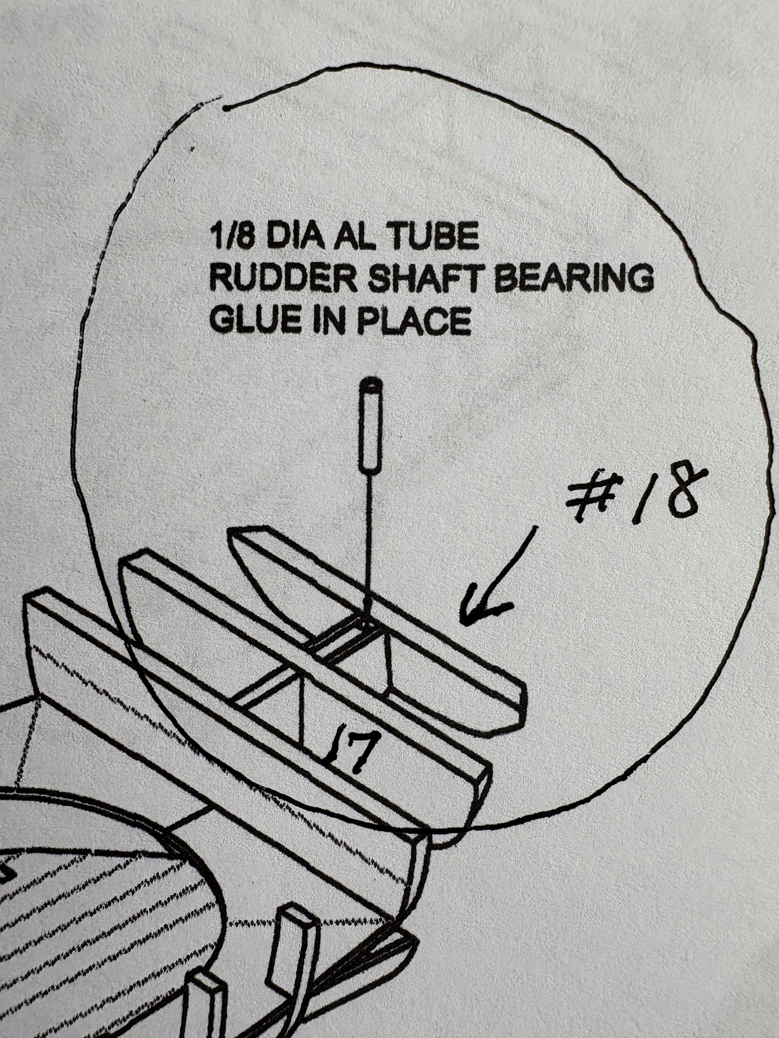

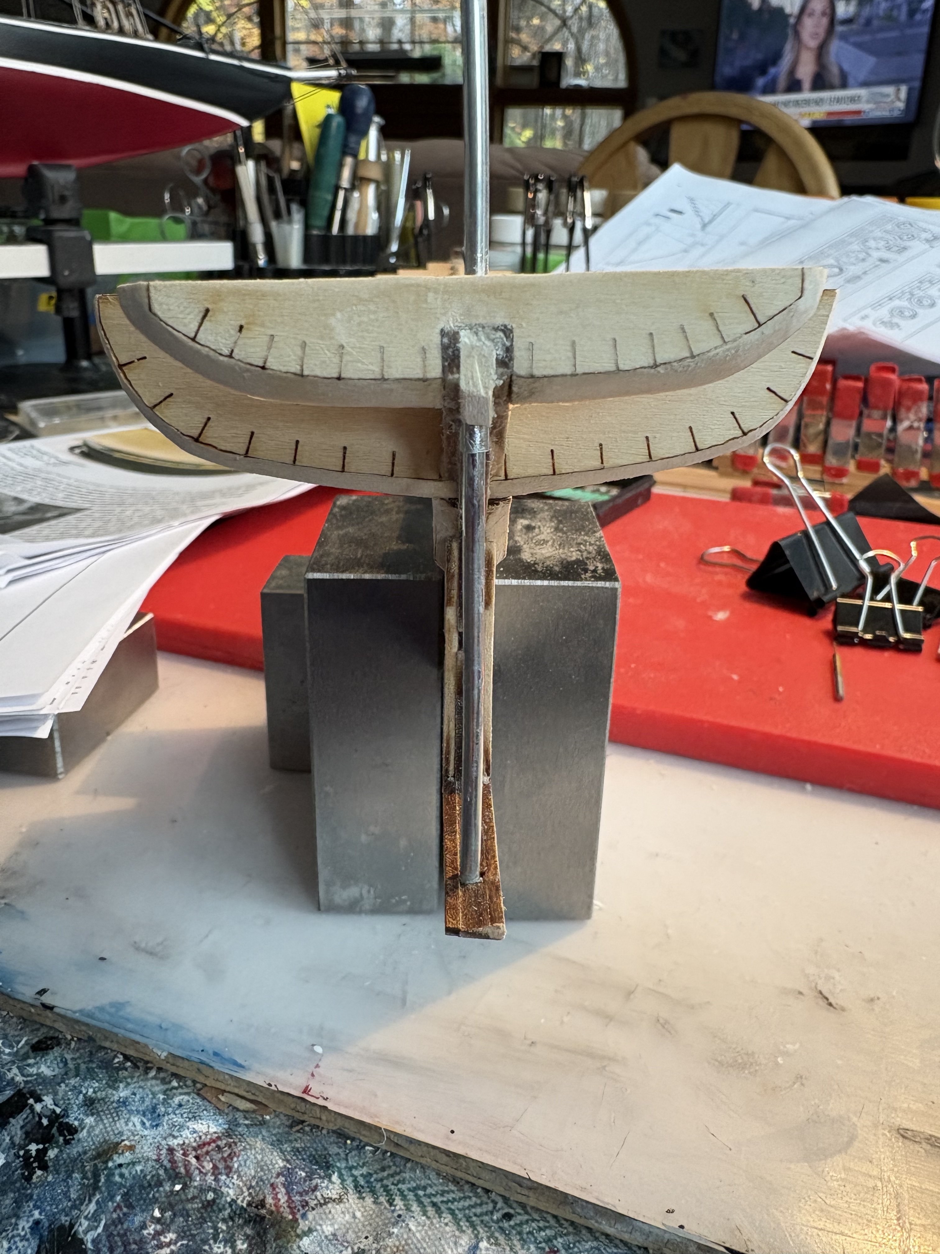

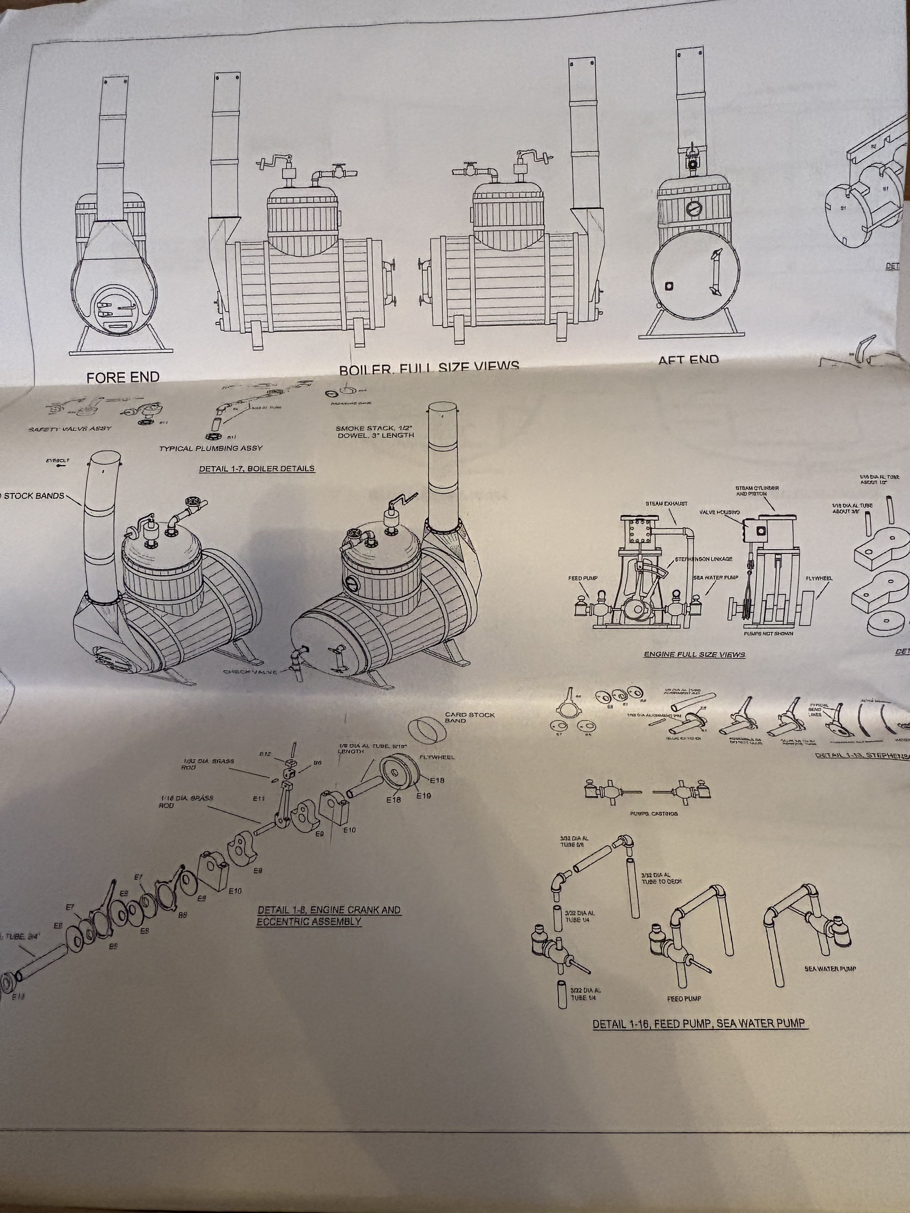

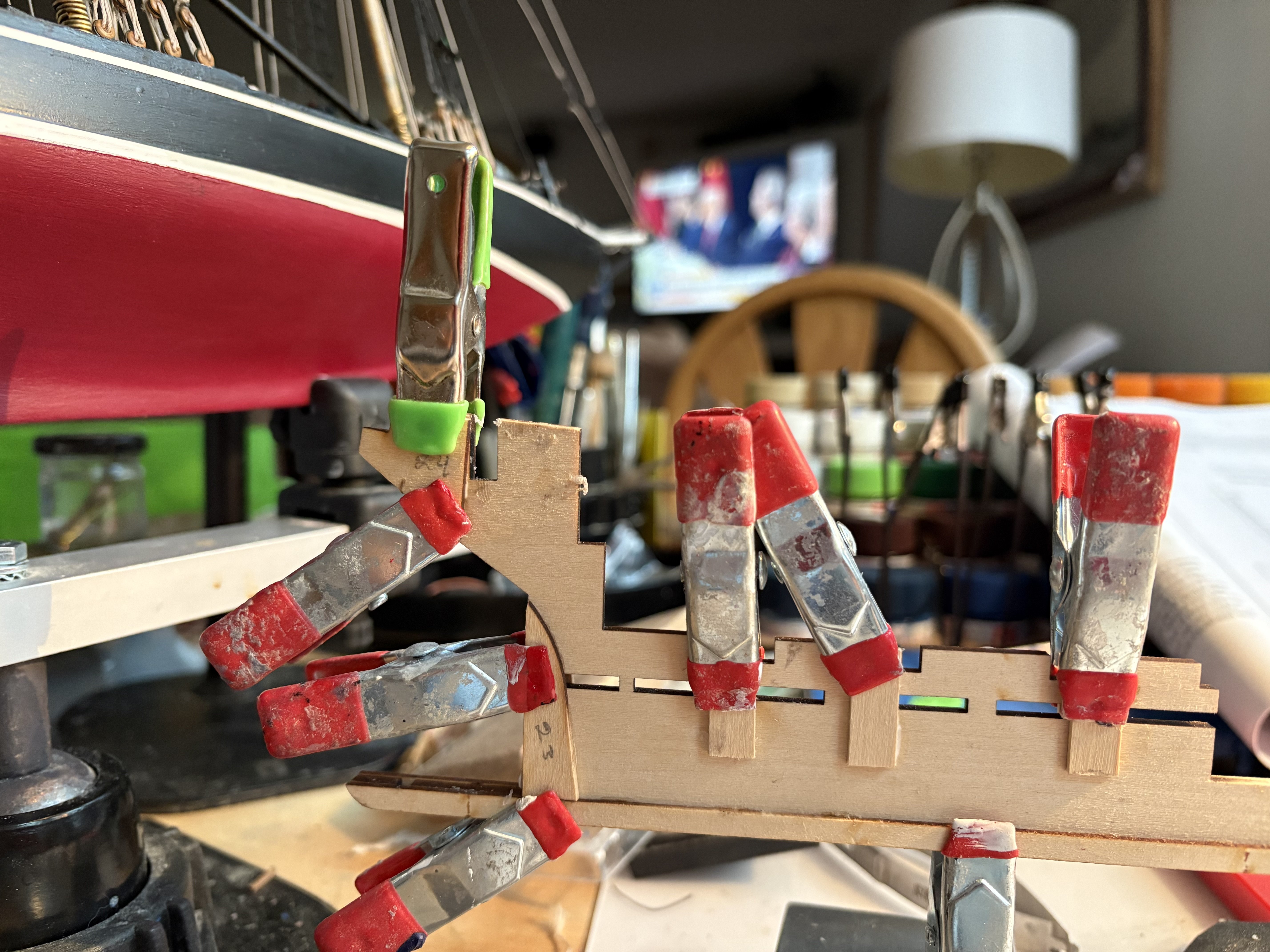

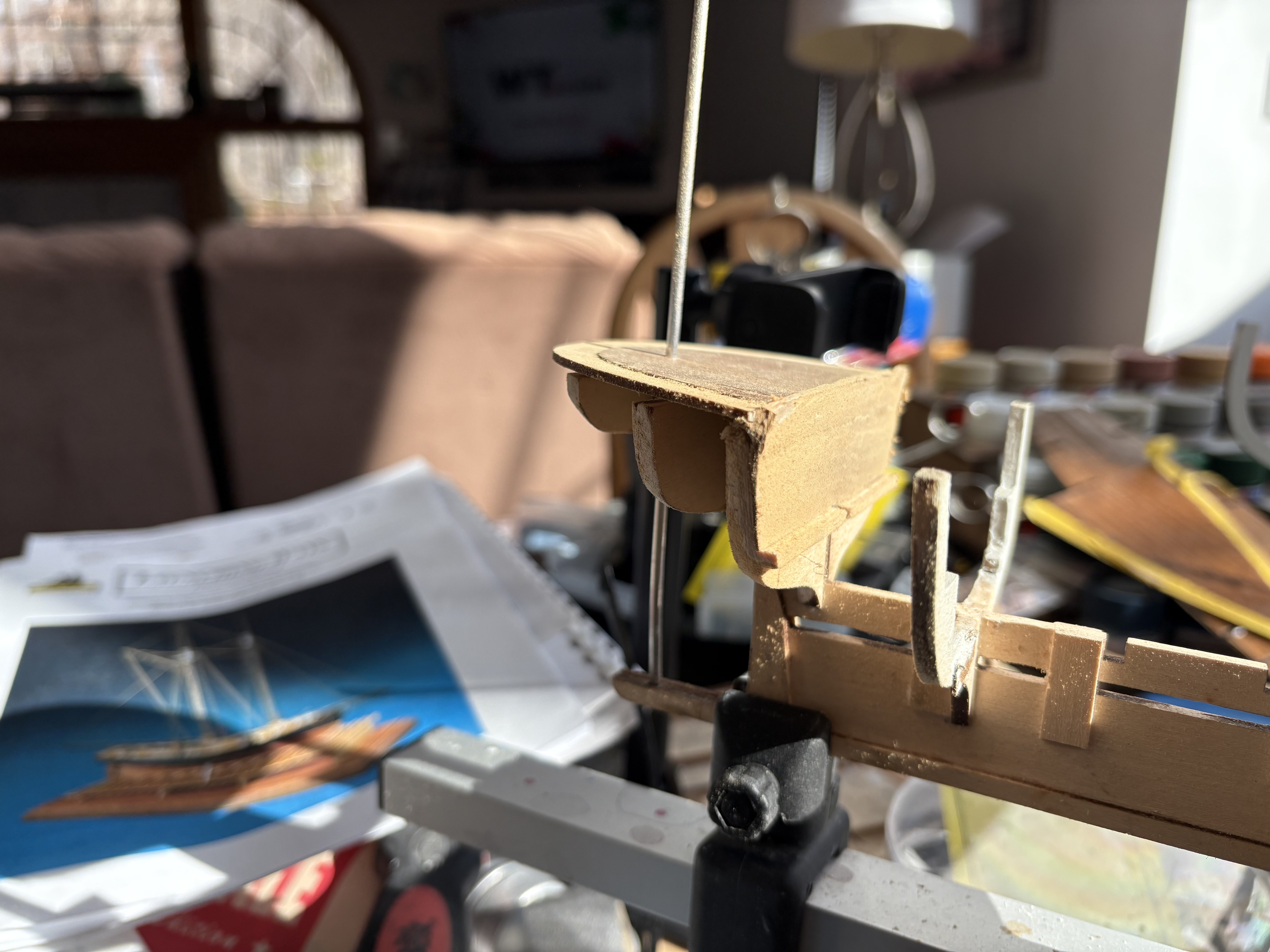

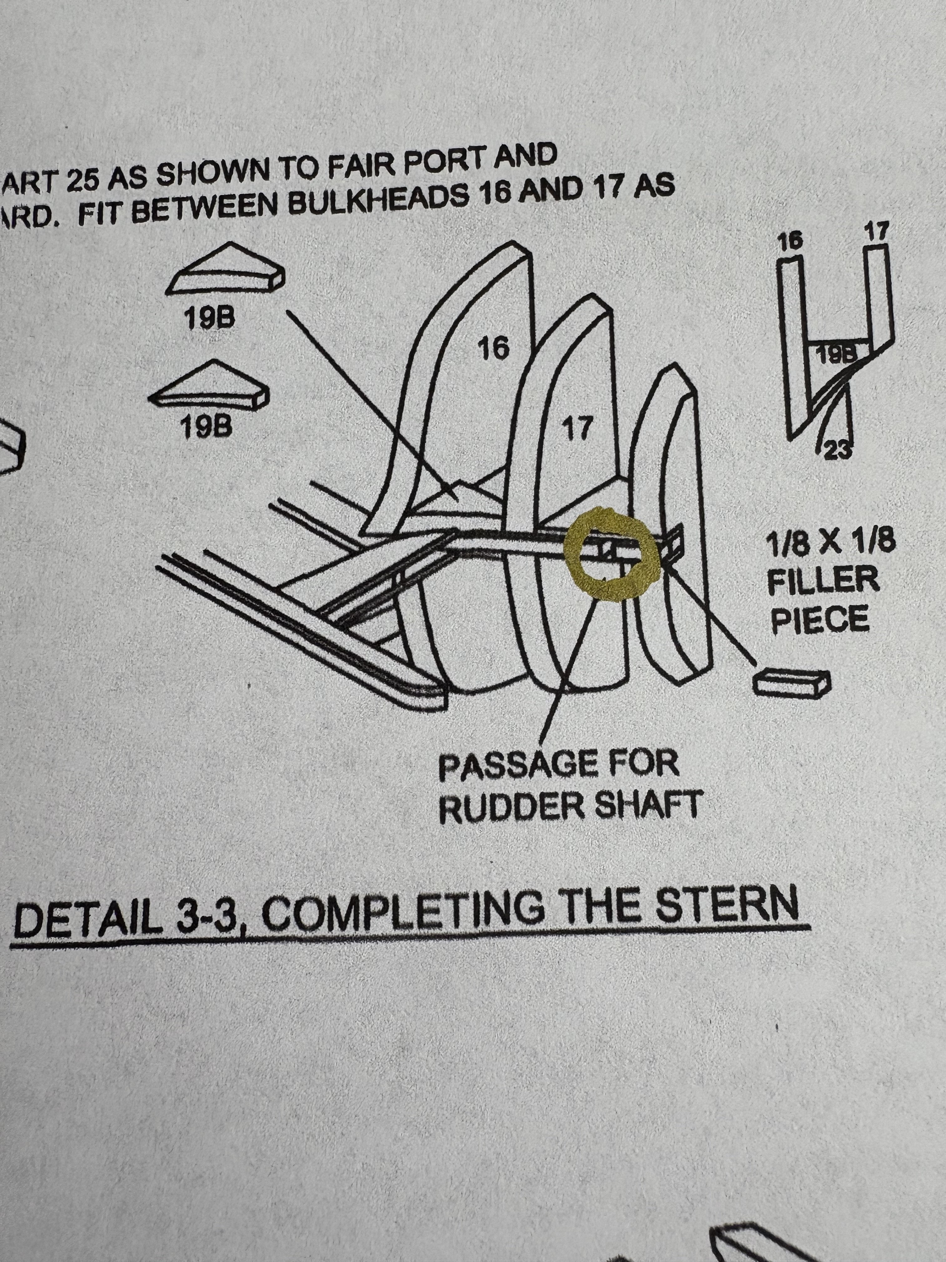

Started the adventure early this morning under a waxing moon and rain. Great conditions to sit with a coffee and assemble the ship. Building the keel was pretty straightforward. The instructions were a little vague depicting the stern assembly vs the bow. It all came together after looking on sheet 3 of the plans and seeing that a space is left between the keel and bulkhead 18 for the rudder shaft (1/8” aluminum tubing). Would have been nice if this was spelled out in the instructions. Time to drop the anchor and retire for the day.

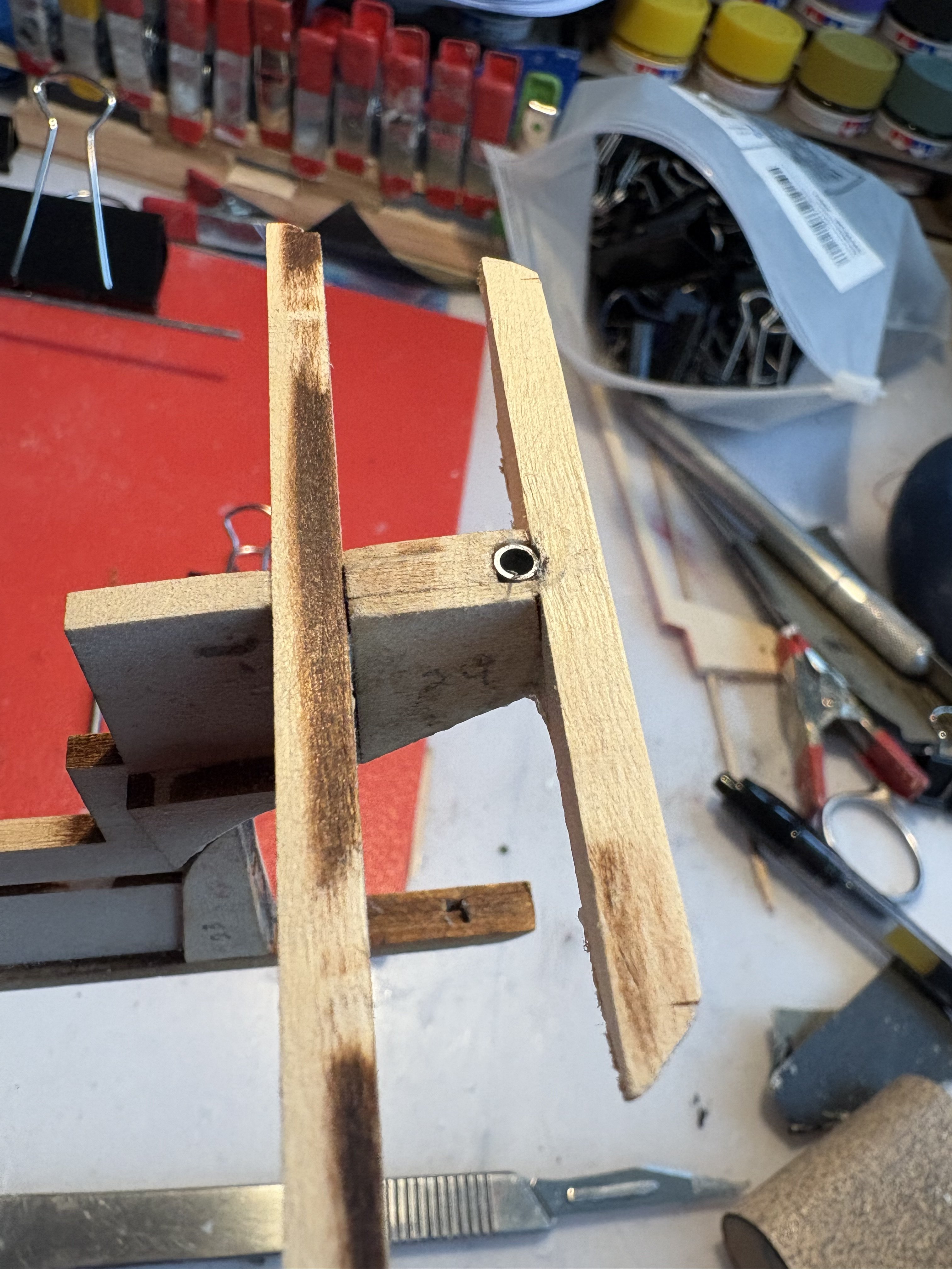

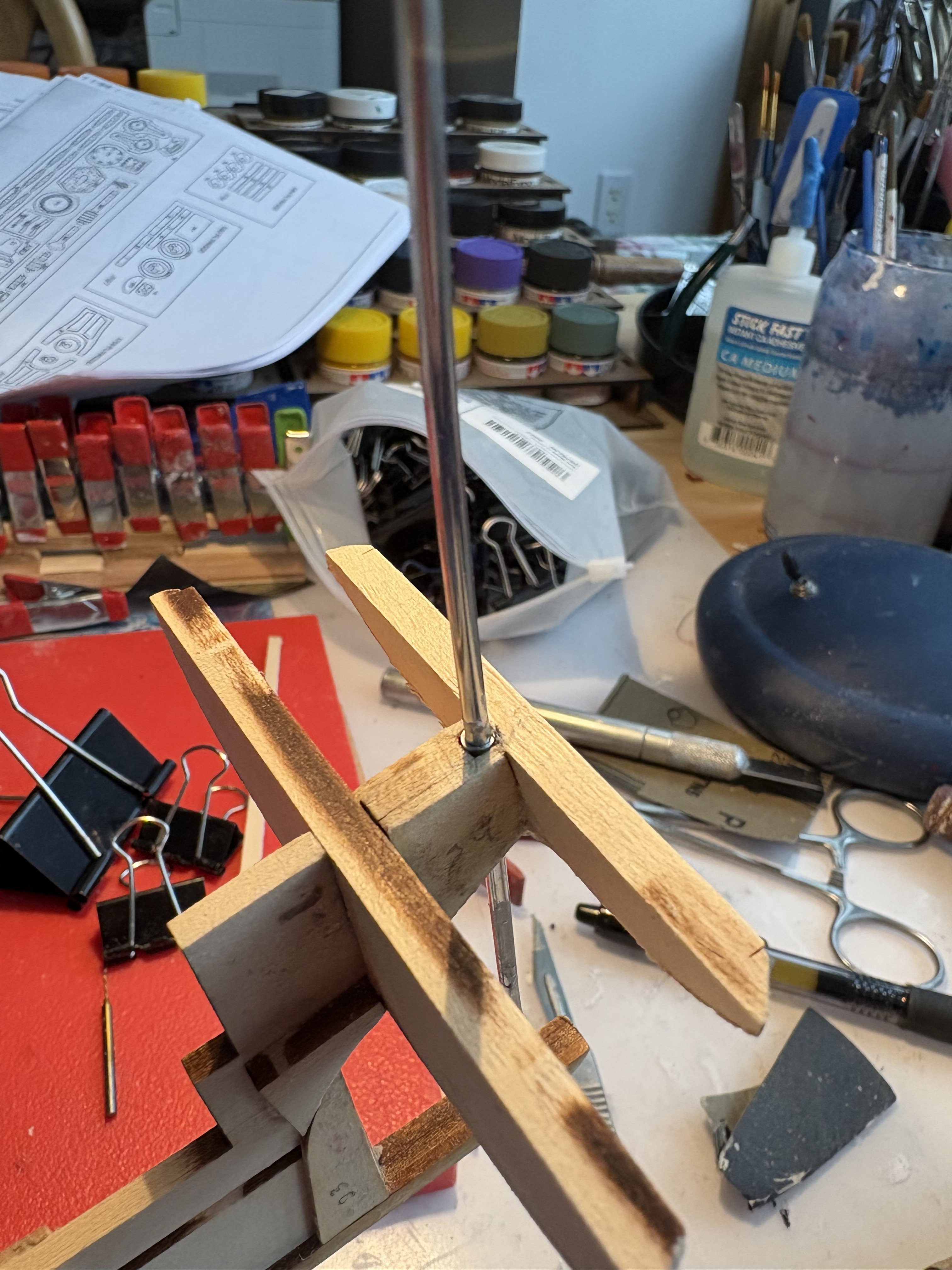

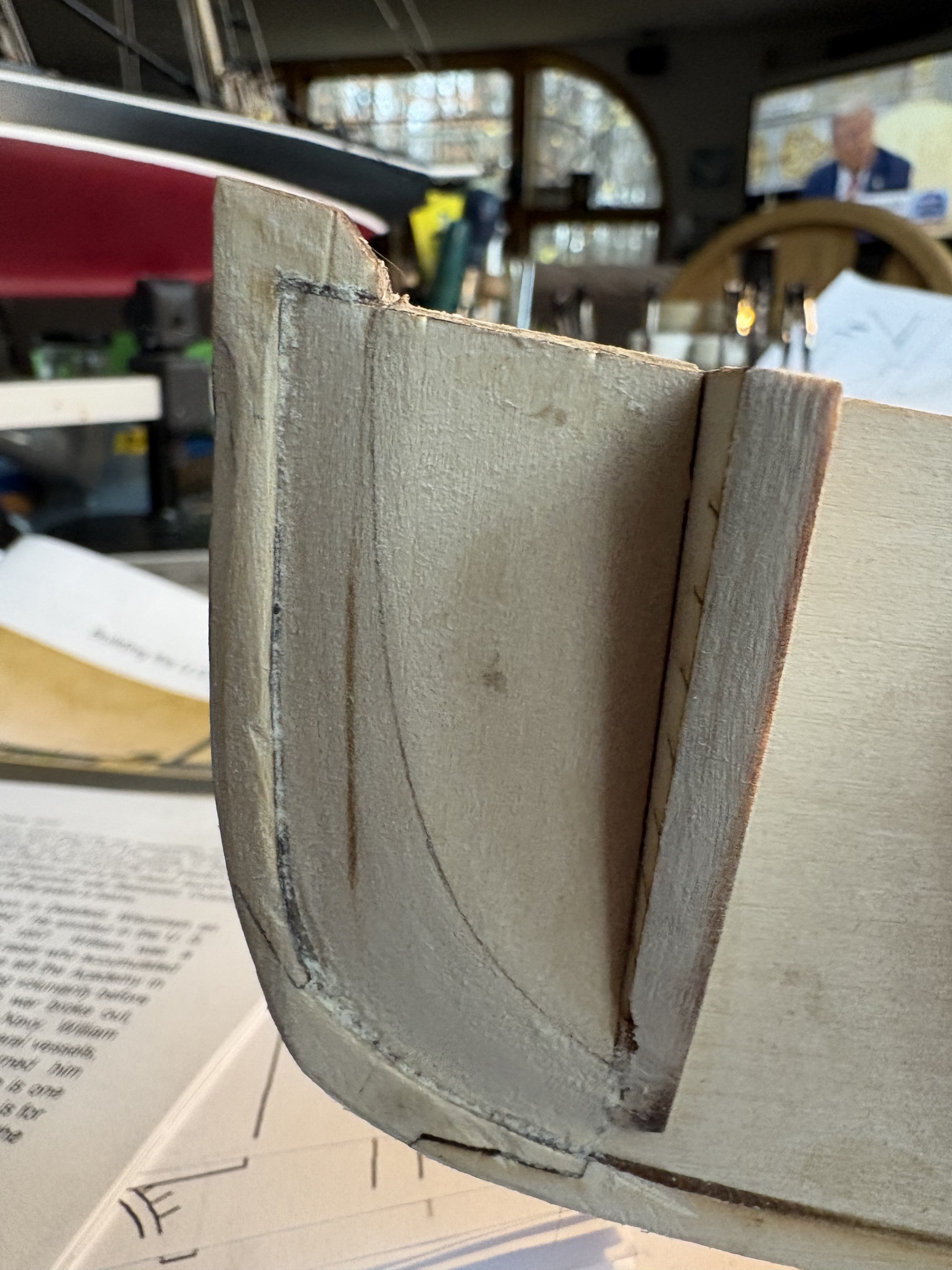

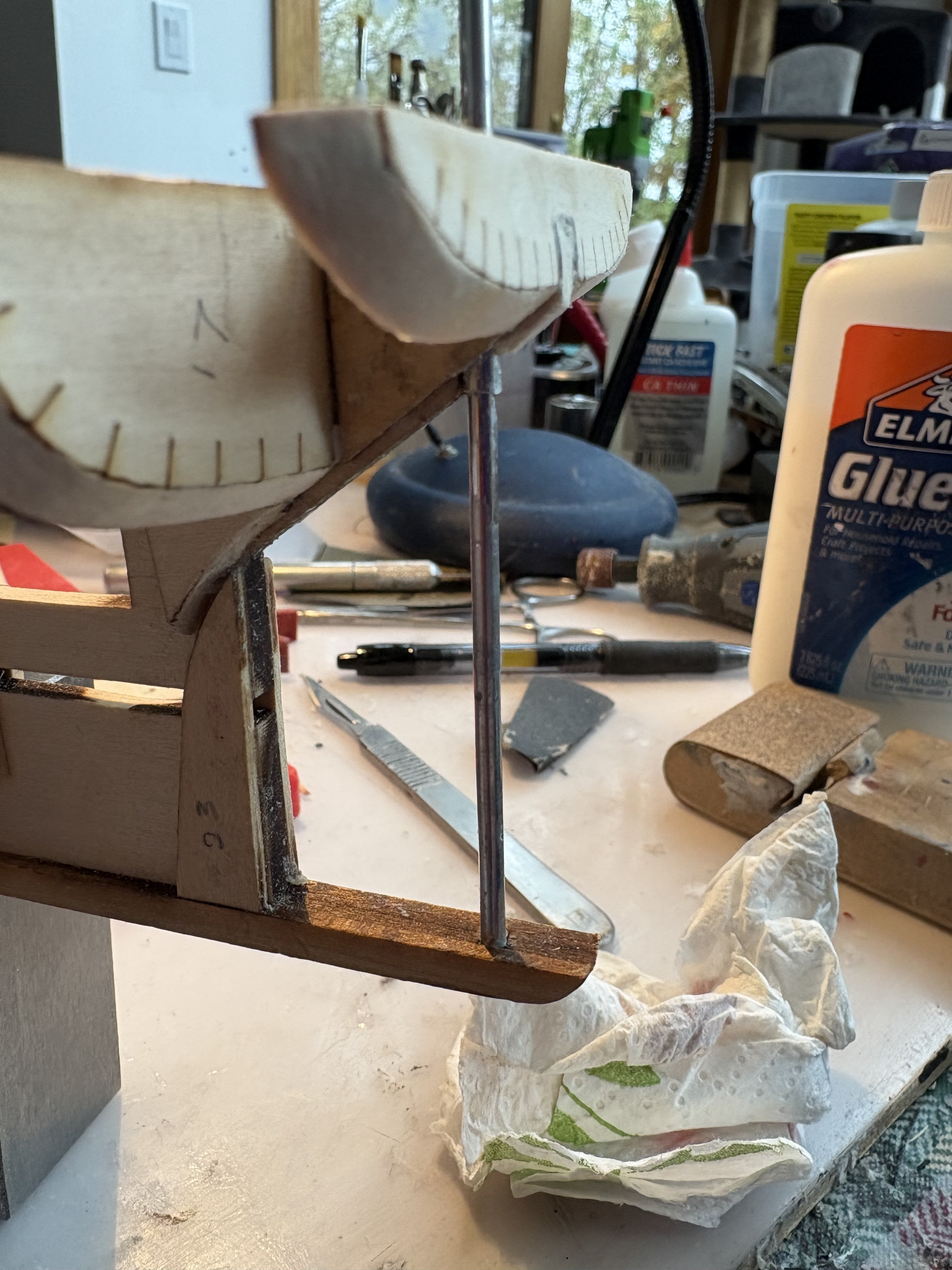

Have raised anchor and set sail again. Installed the carved bow filler pieces port and starboard carved to the rabbit line. Then installed (cemented) the aluminum tube rudder Bearing. The 3/32 rudder shaft was  inserted thru the tube rudder bearing down to the the recess in the keel to assure proper alignment before cementing the bearing.

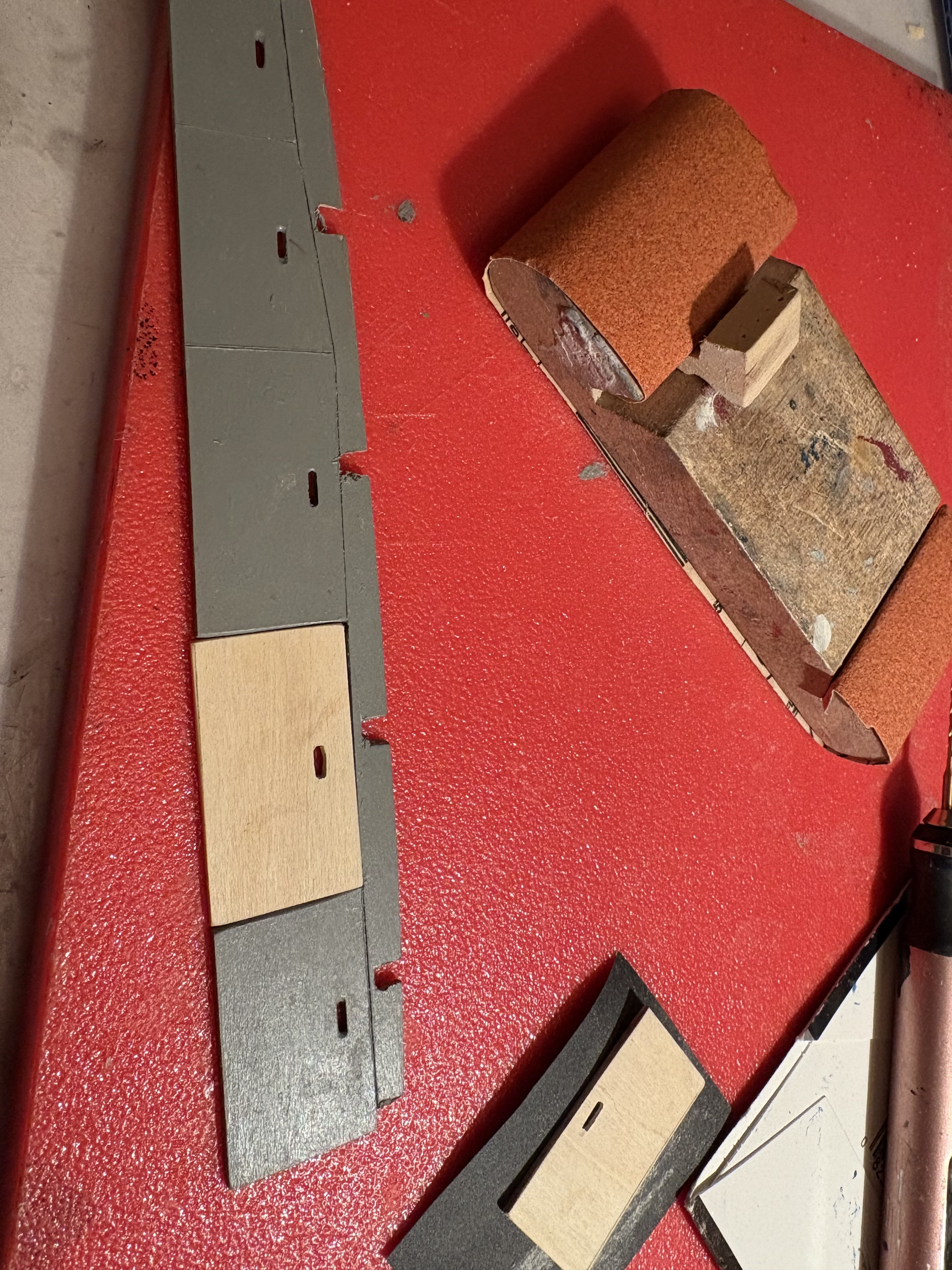

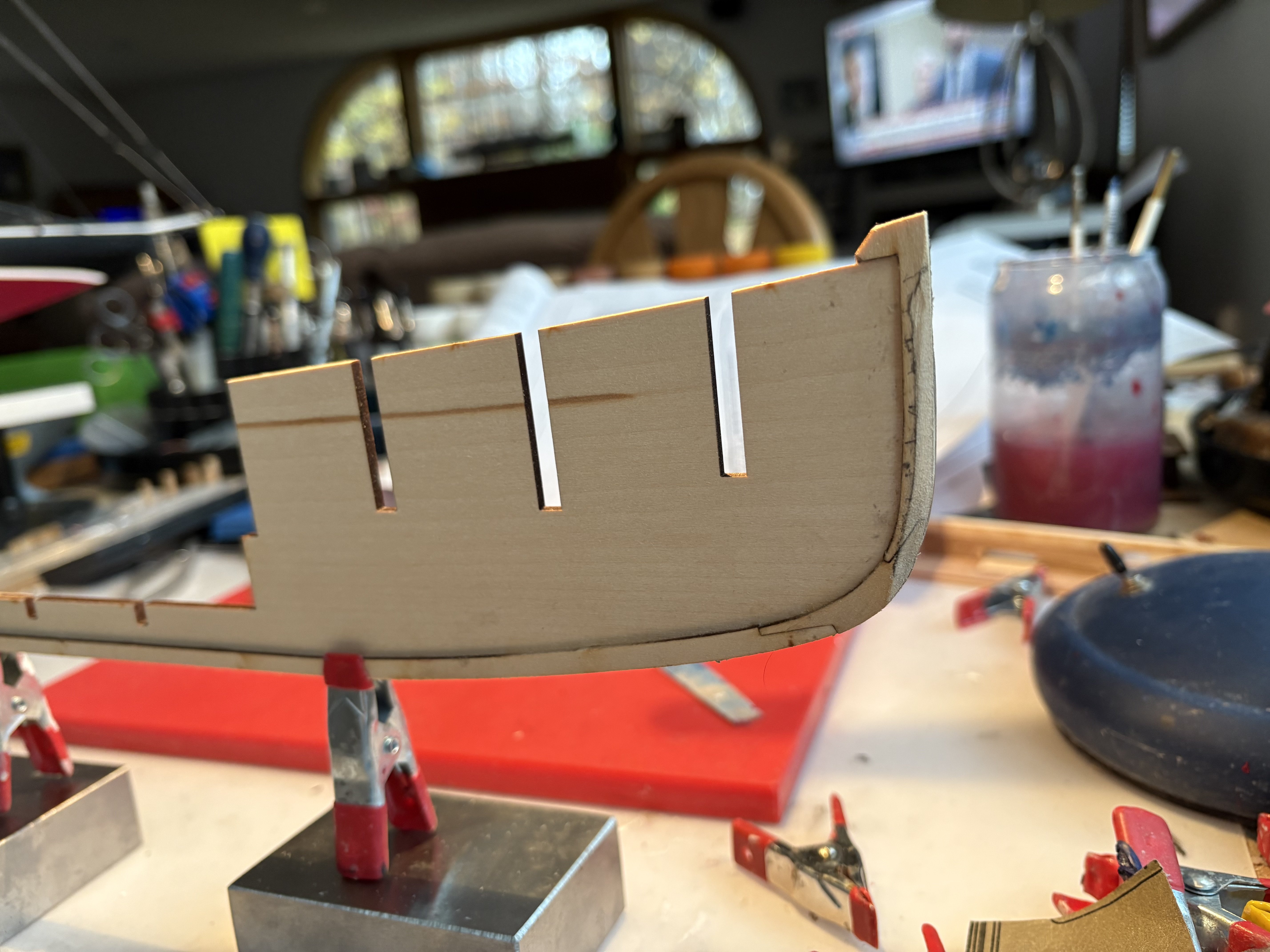

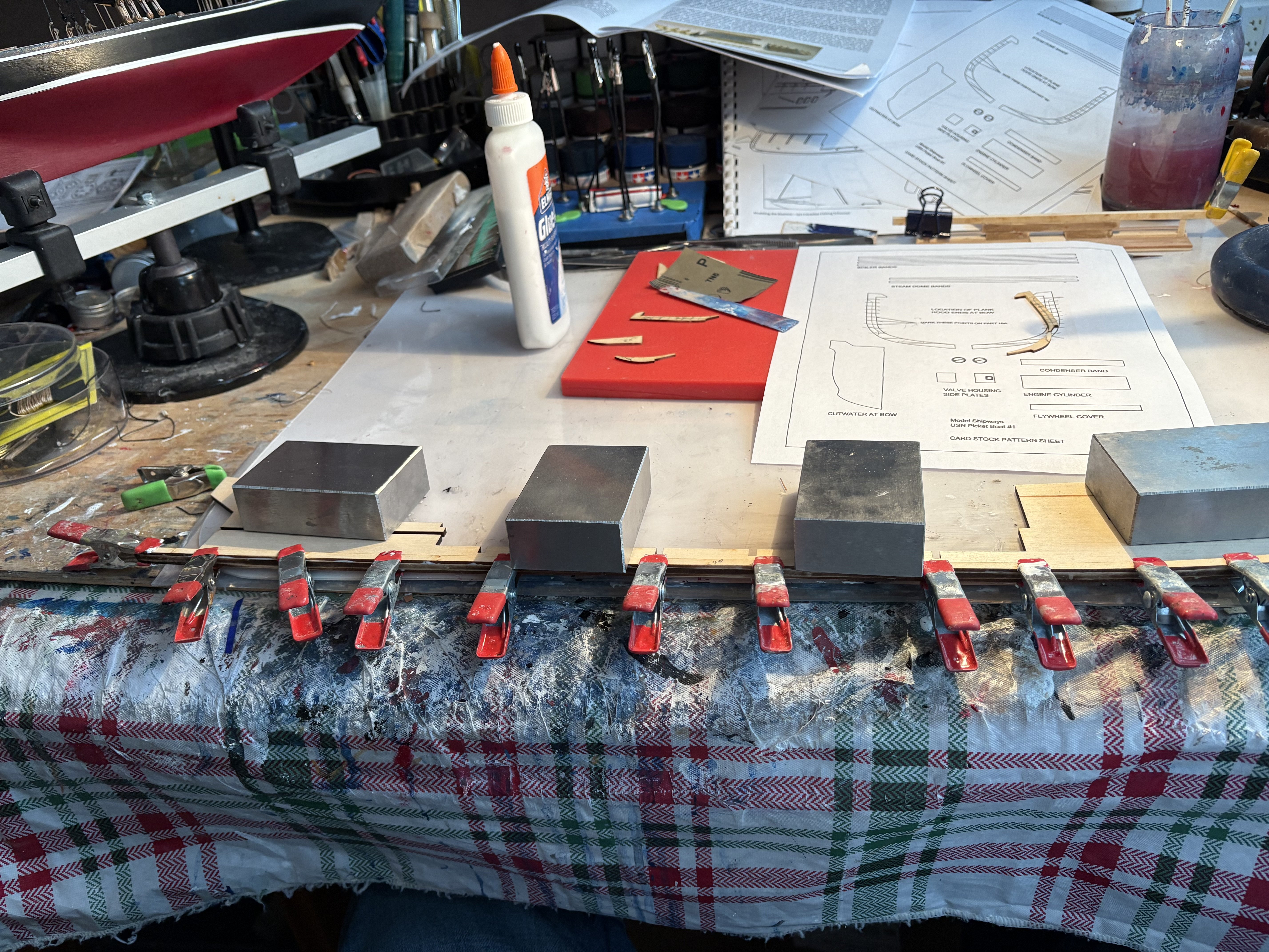

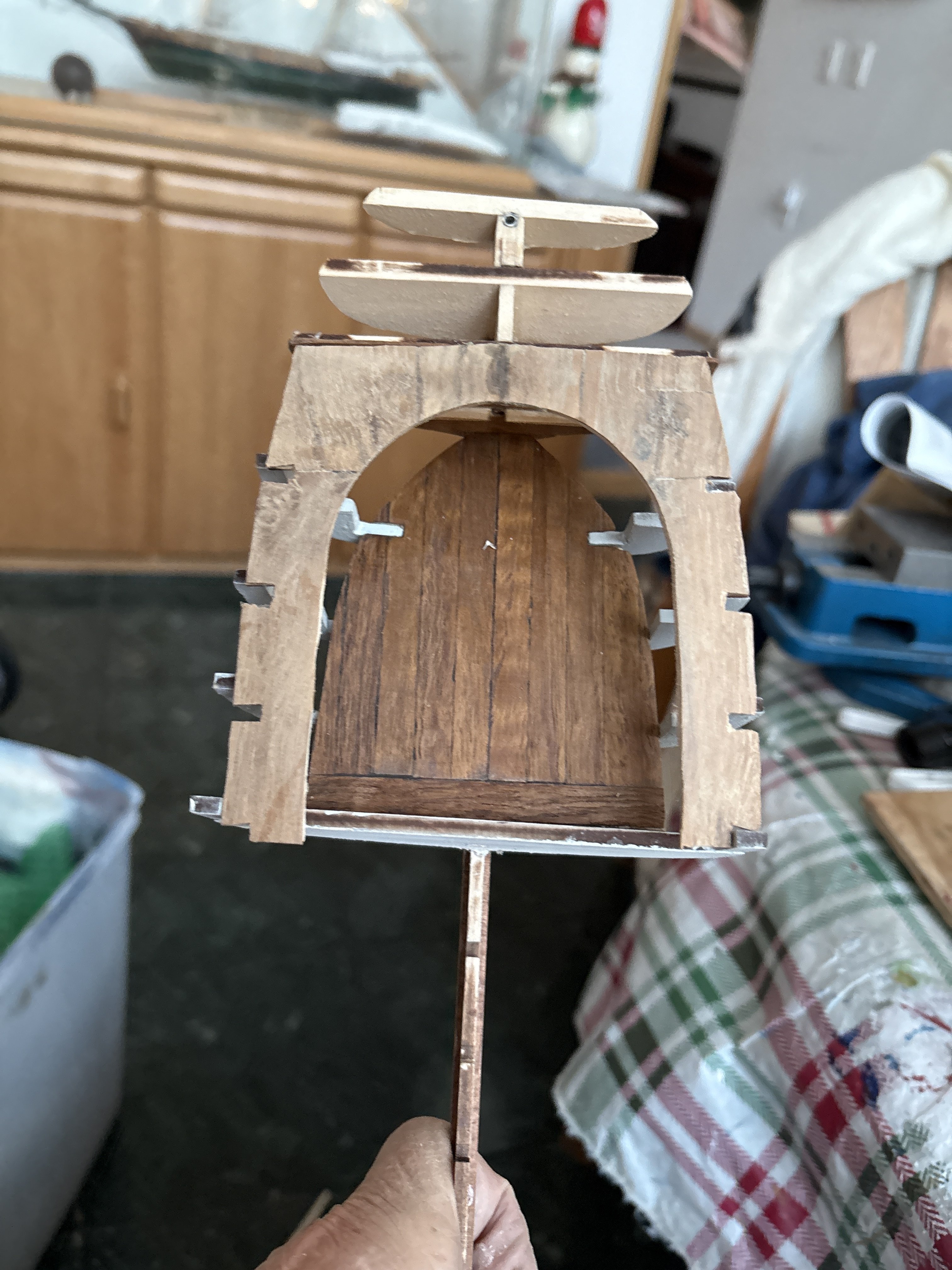

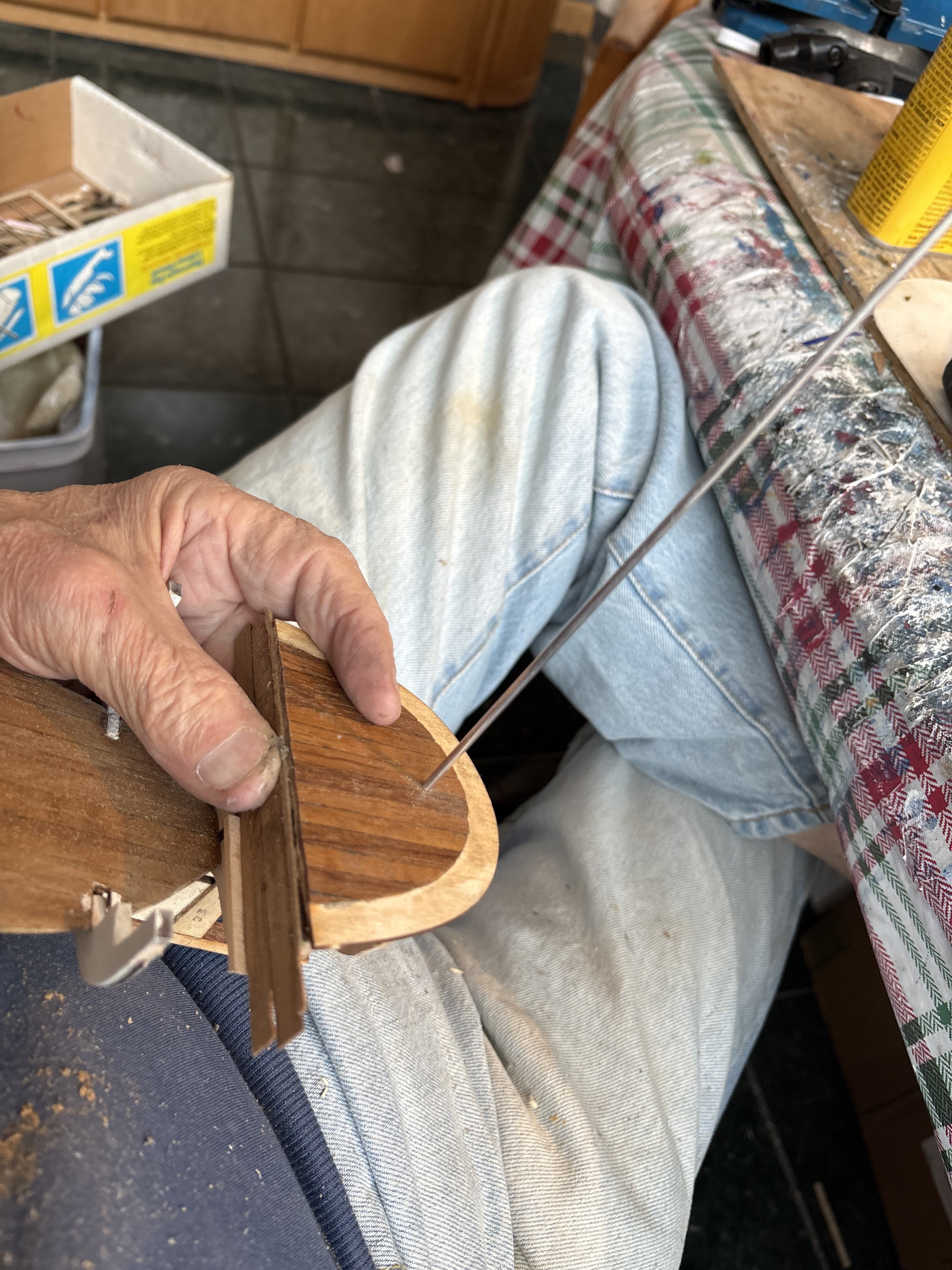

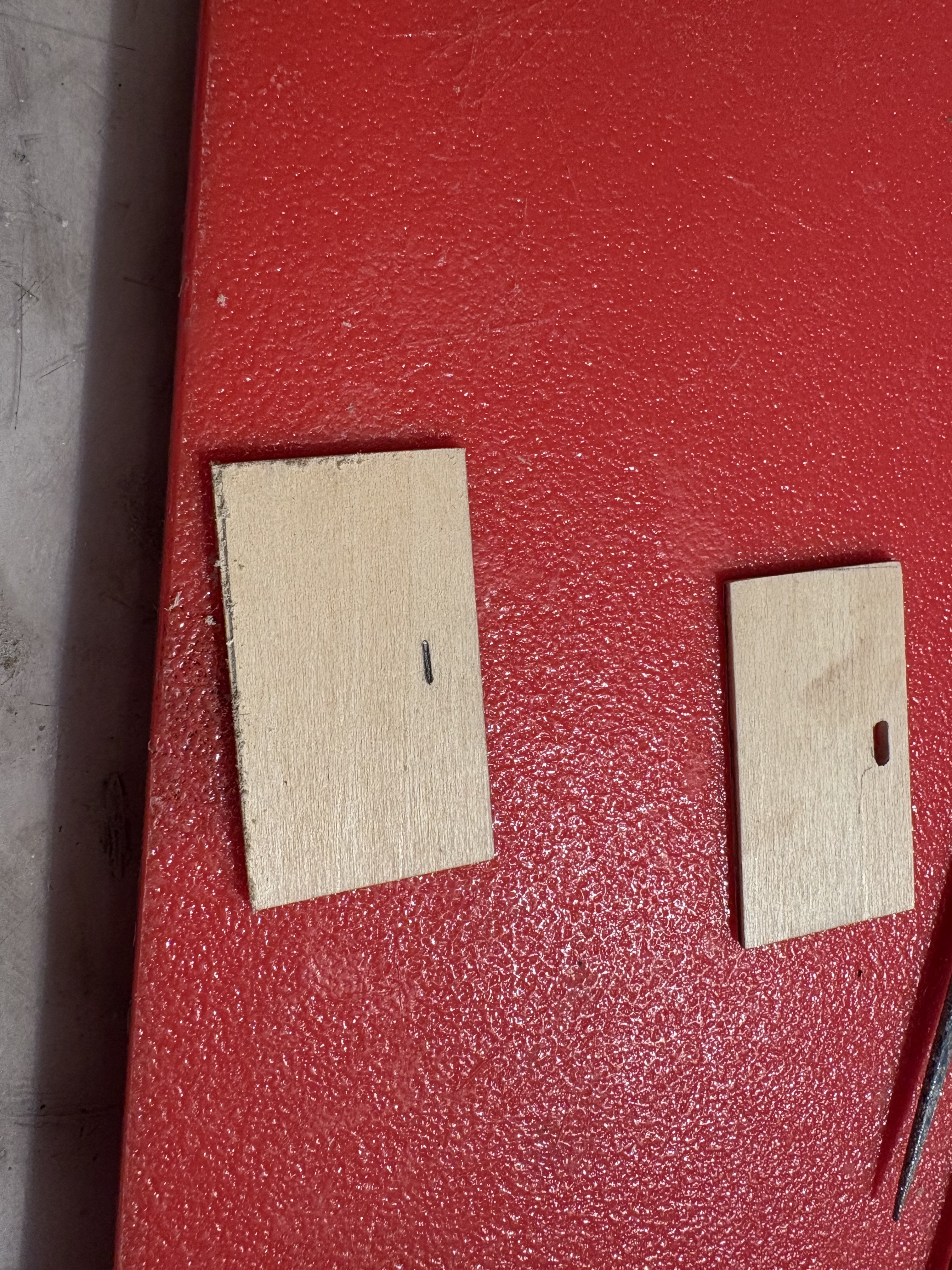

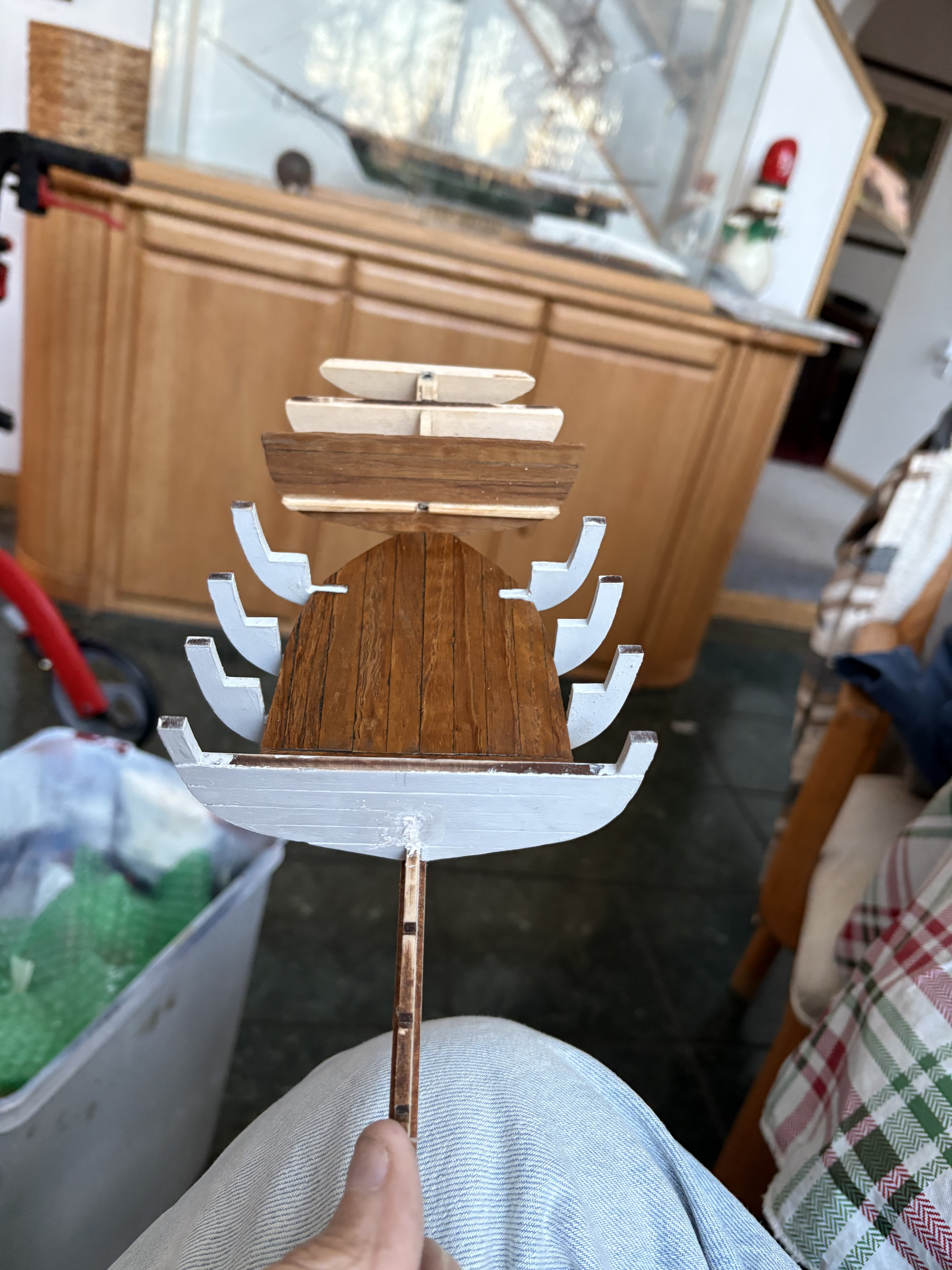

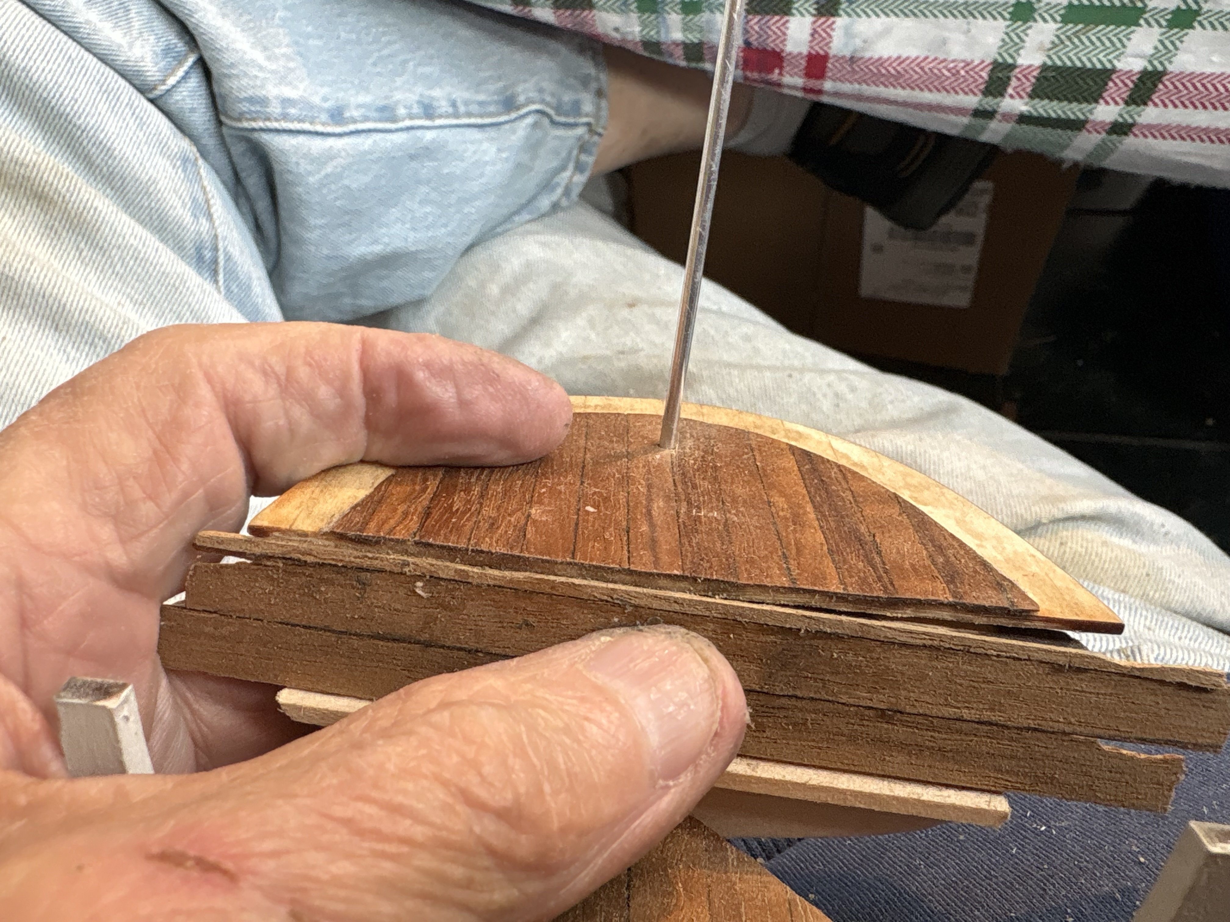

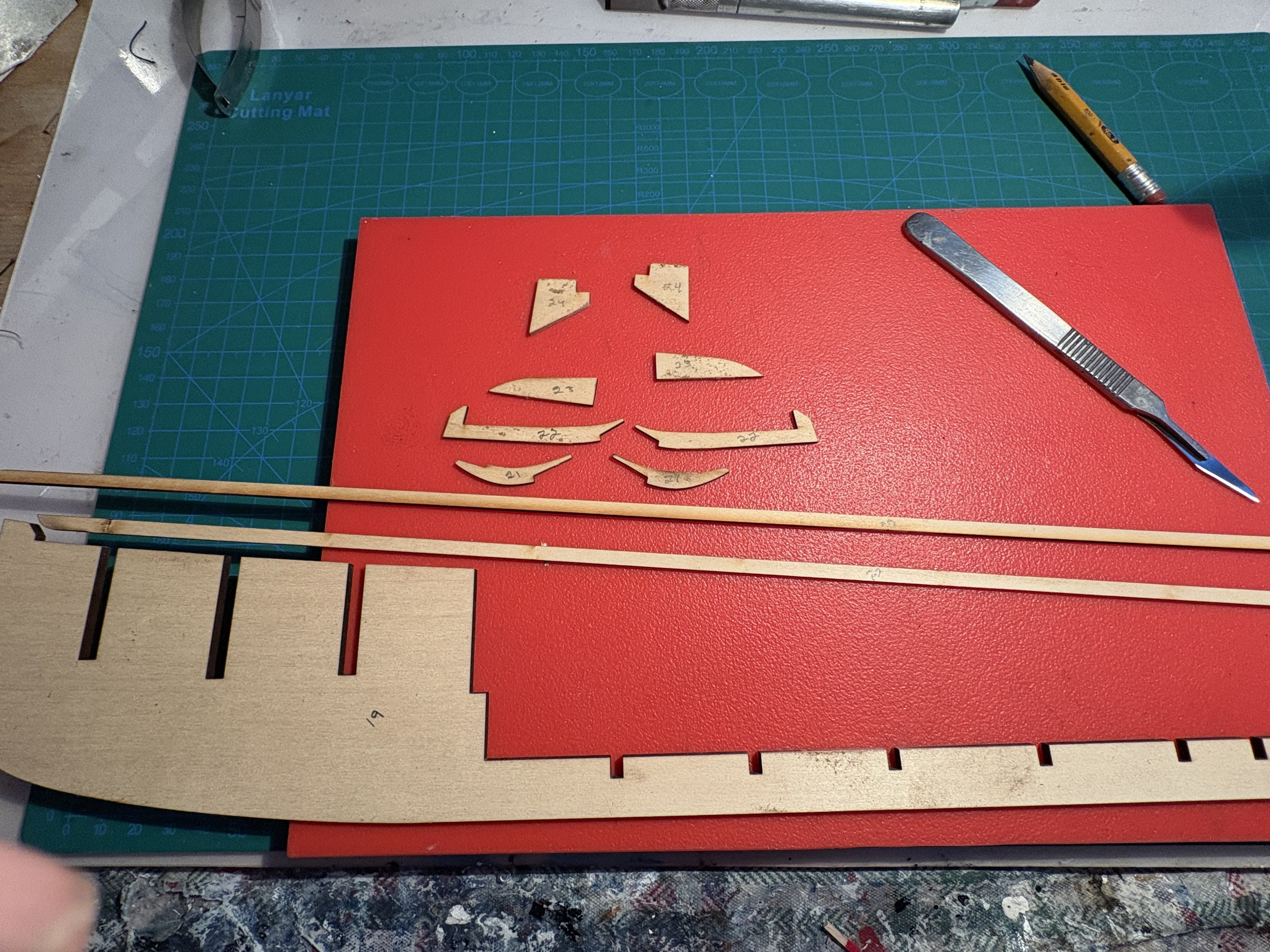

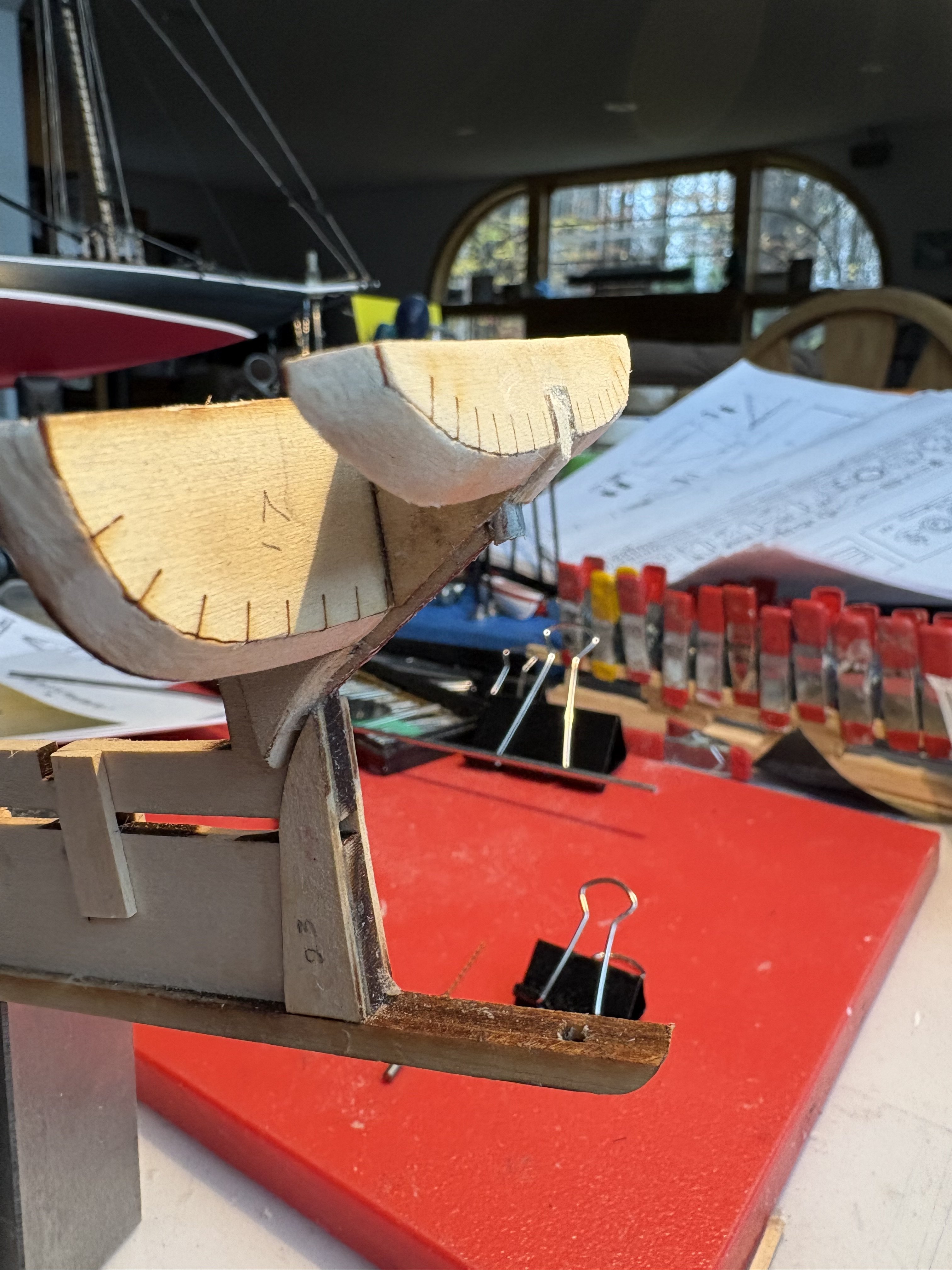

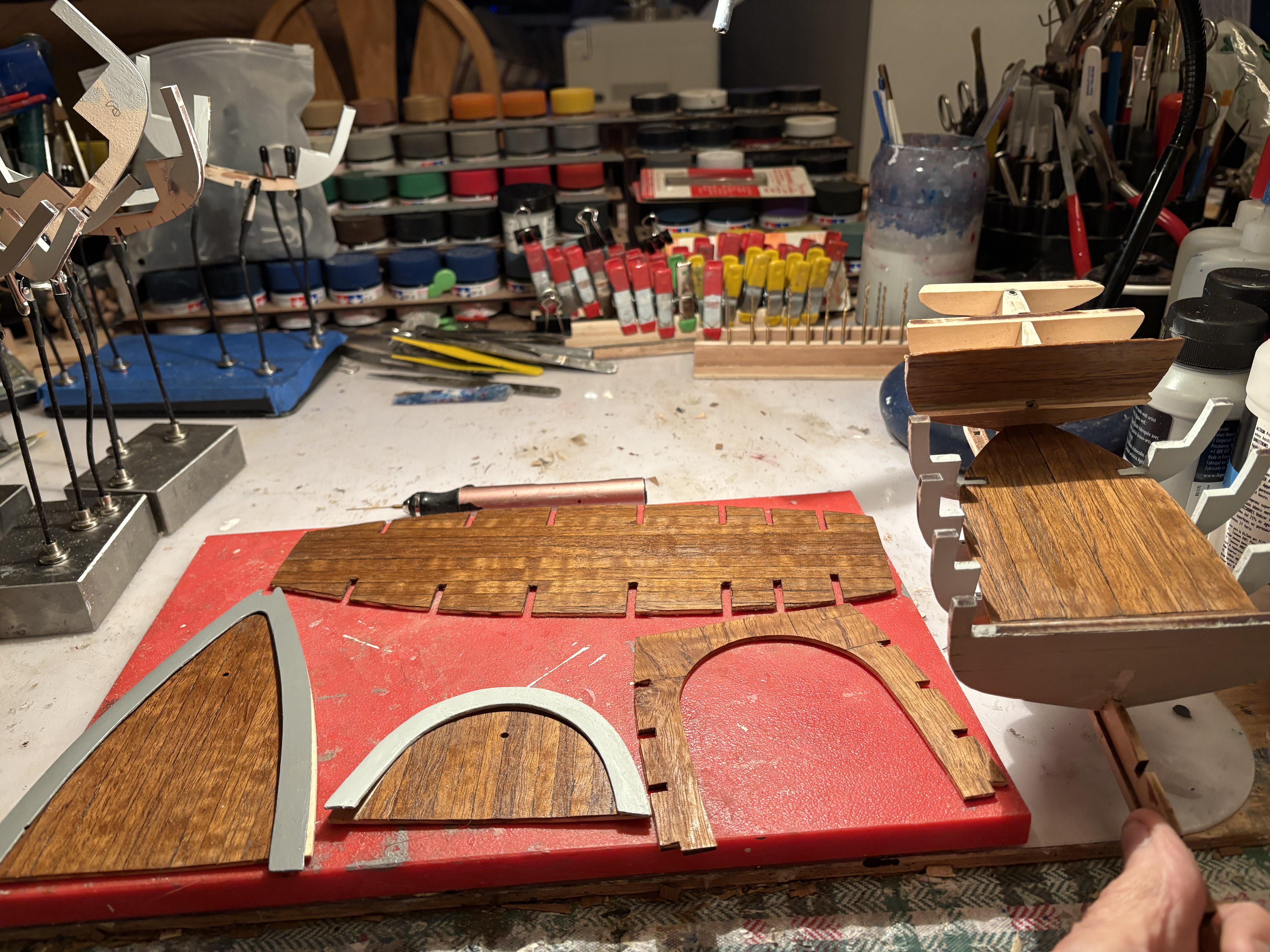

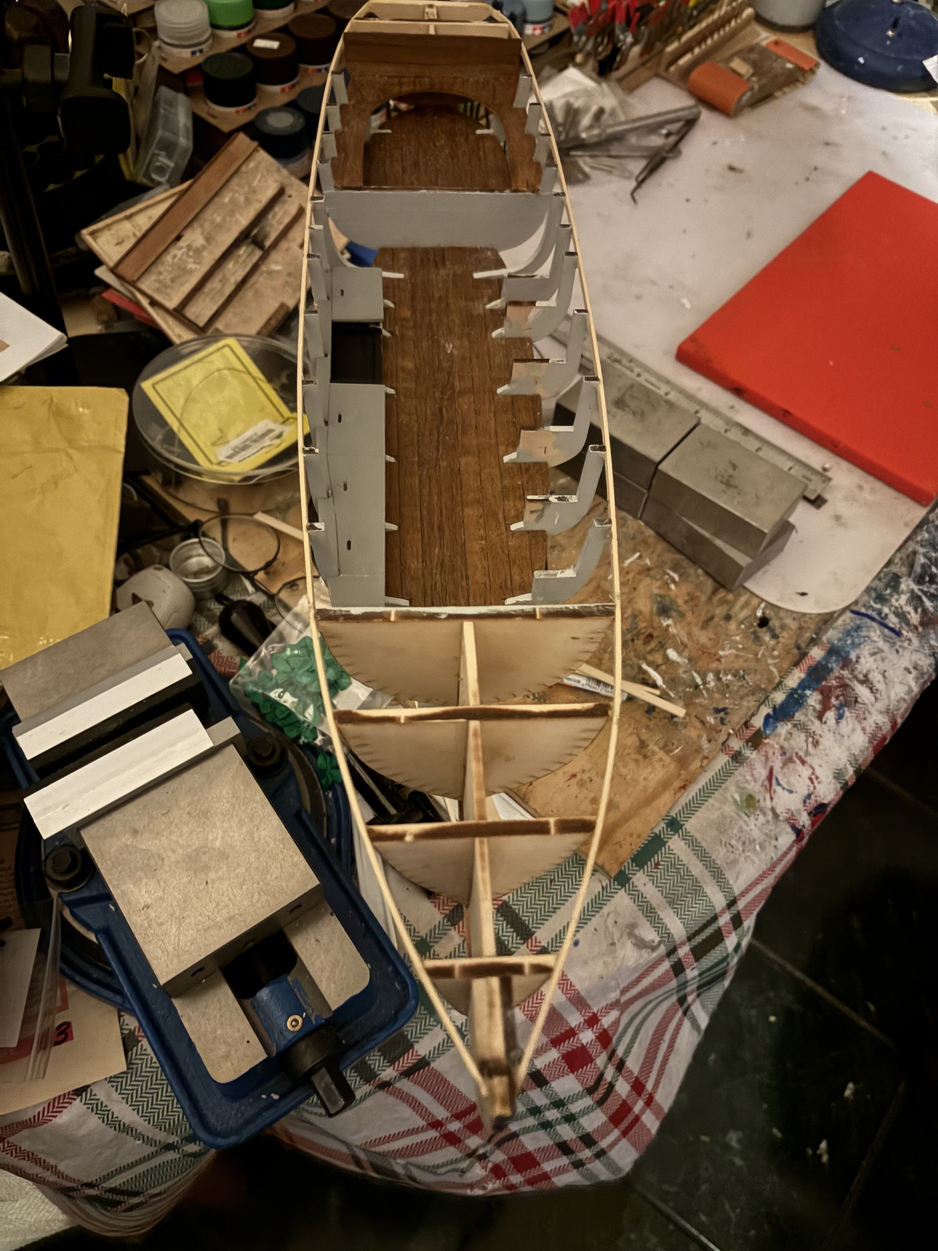

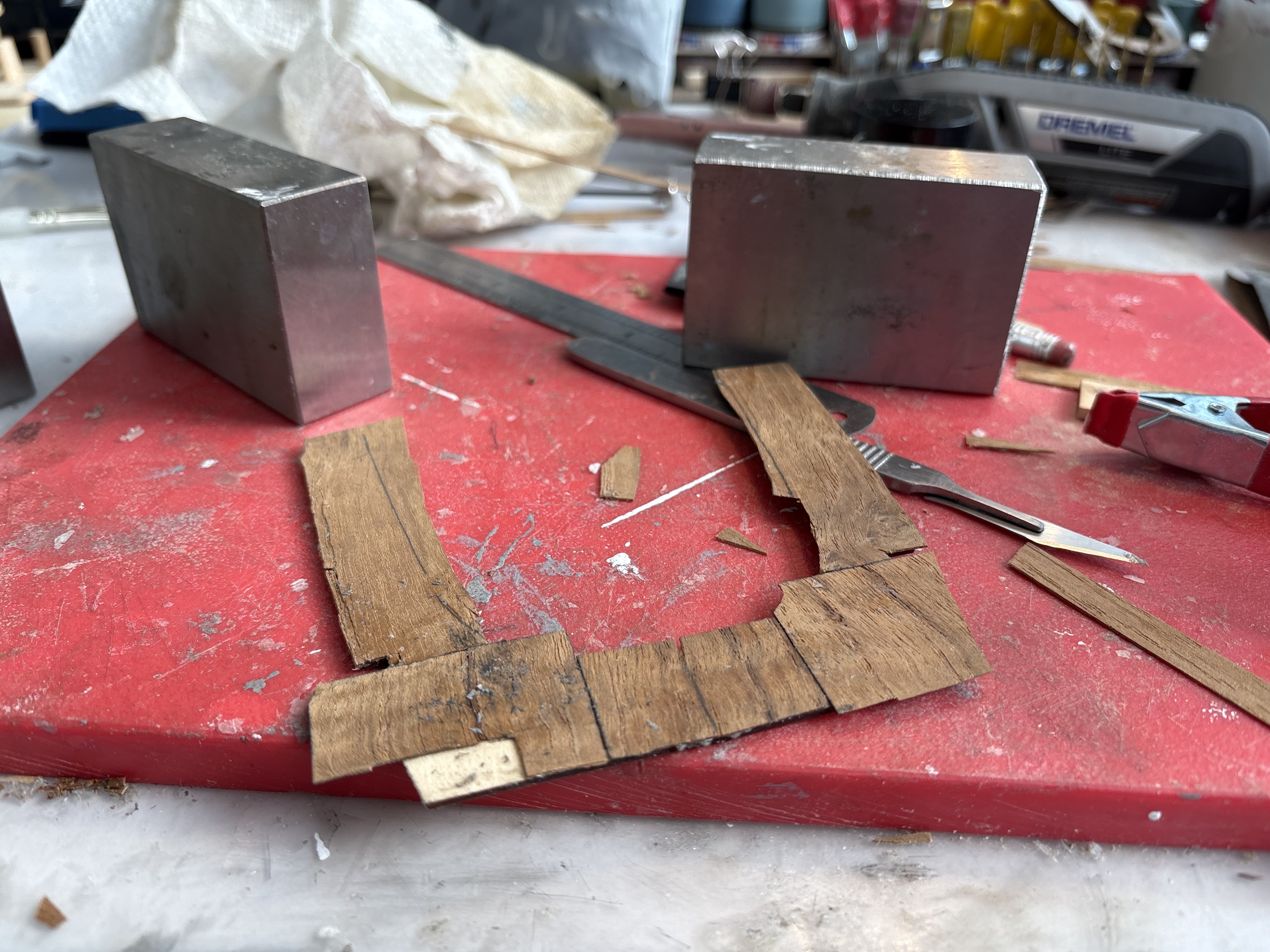

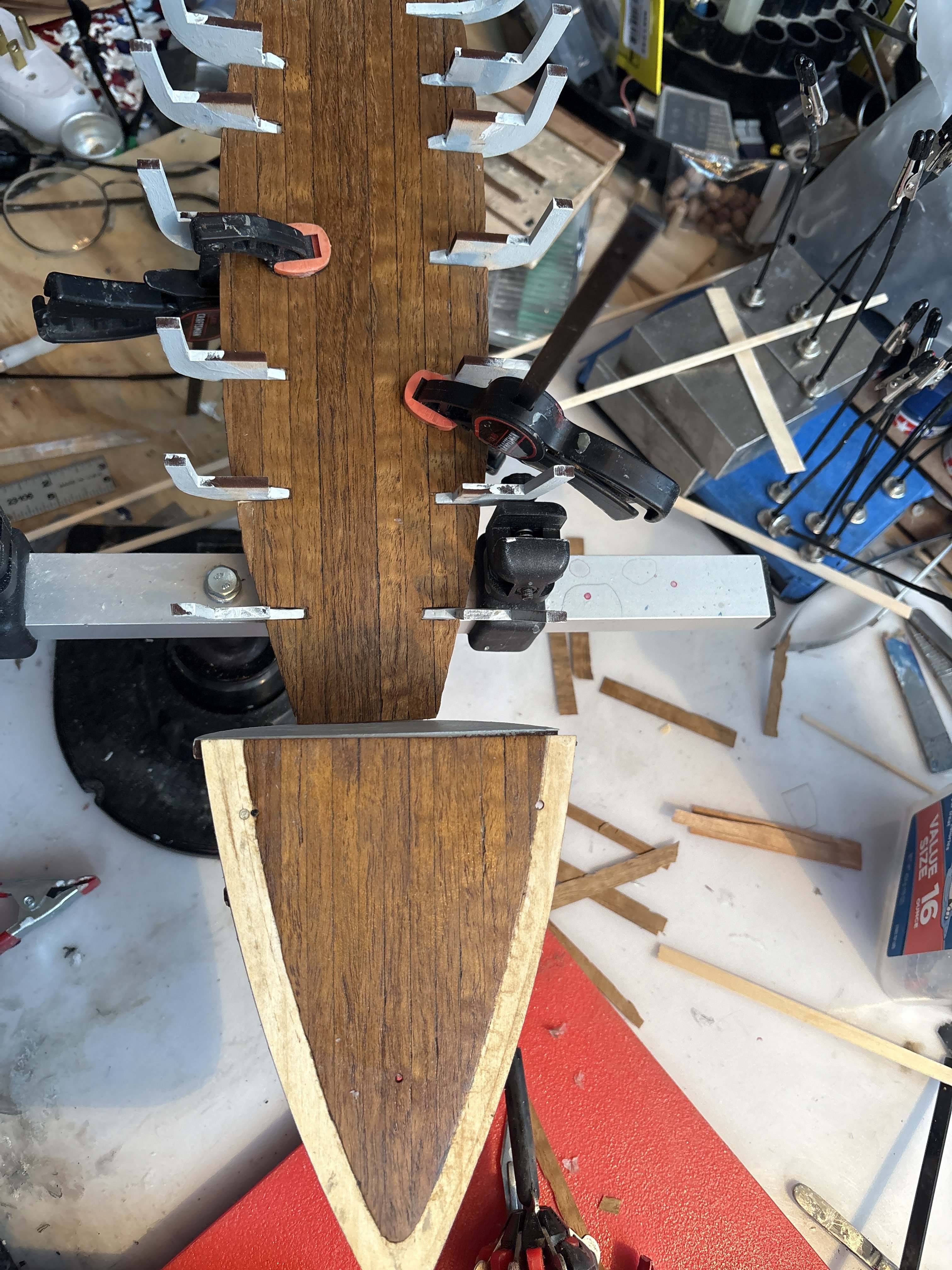

I plan on planking all the decks with 0.5mm teak (the main the bow and the stern). The instructive narrative calls for lead pencil lines to remark the planks and then overlay with varnish. Sounds kind of fluky. Teak decking will look much better. I needed to make 1mm gunnel surrounds for both the bow and stern. I laminated 1mm basswood together with computer paper backing. I also used paper backing to bridge the area of the bulkheads that are prone to breaking to strengthen the area (the paper has a thickness of 0.07mm which is negligible. If the part does break the paper is flexible enough for replying in perfect alignment. ) The basswood sheets were then primed and sanded after drying. Printer copies 100% accurate of the laser marked basswood gunnels were attached and sprayed with a light coat of brown primer. After drying the gunnels were cut out and sanded and are put aside for later installation.

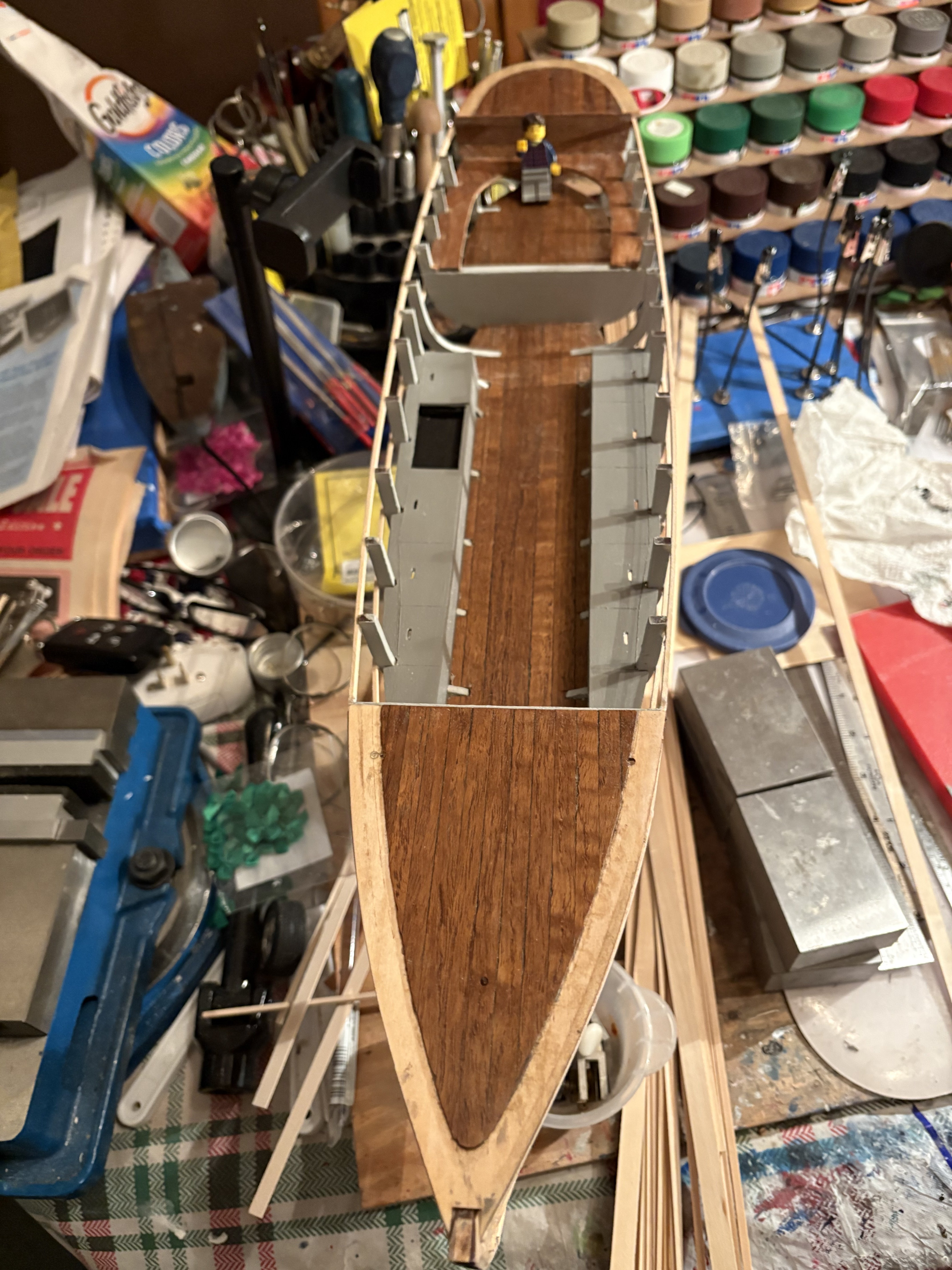

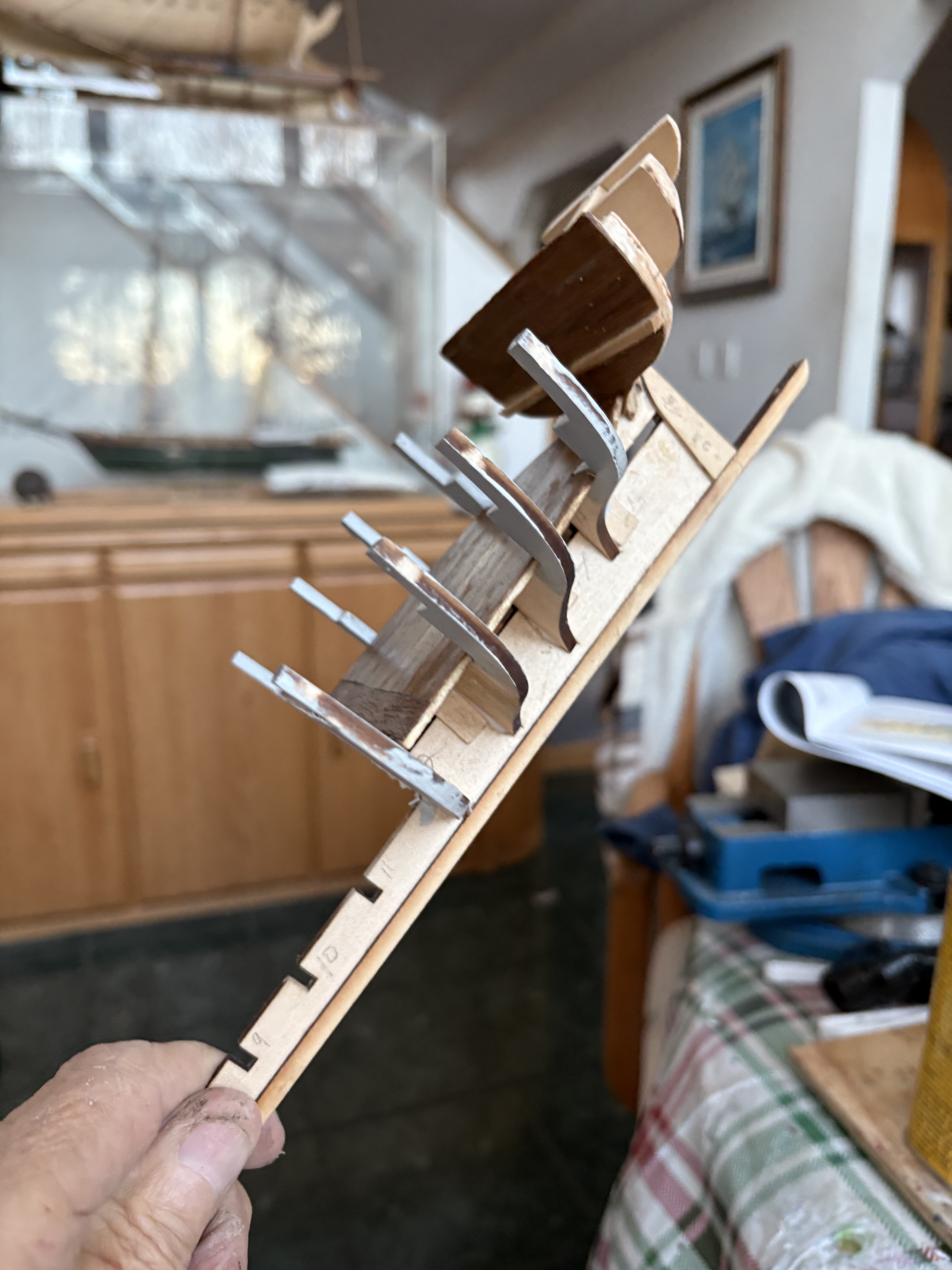

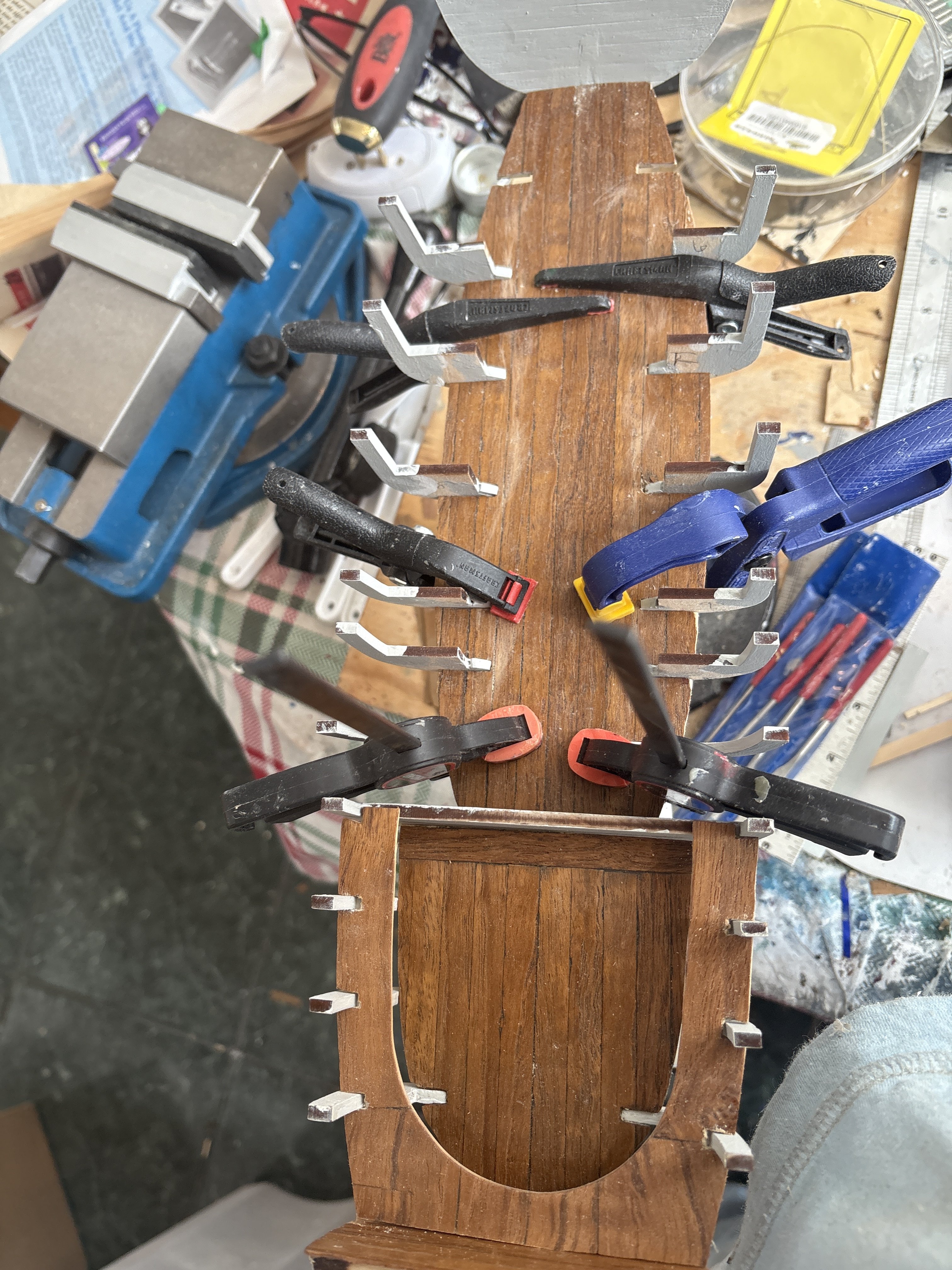

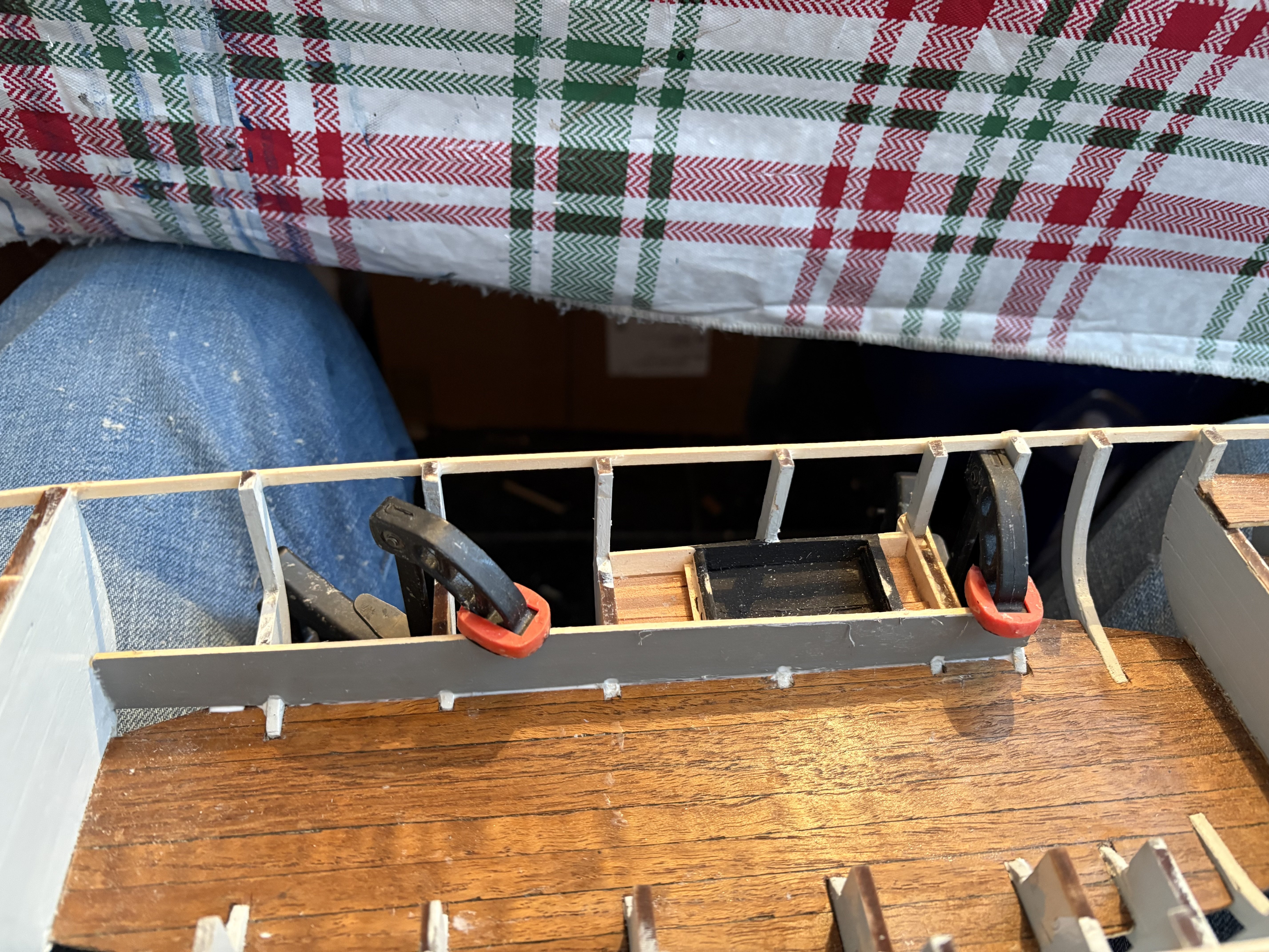

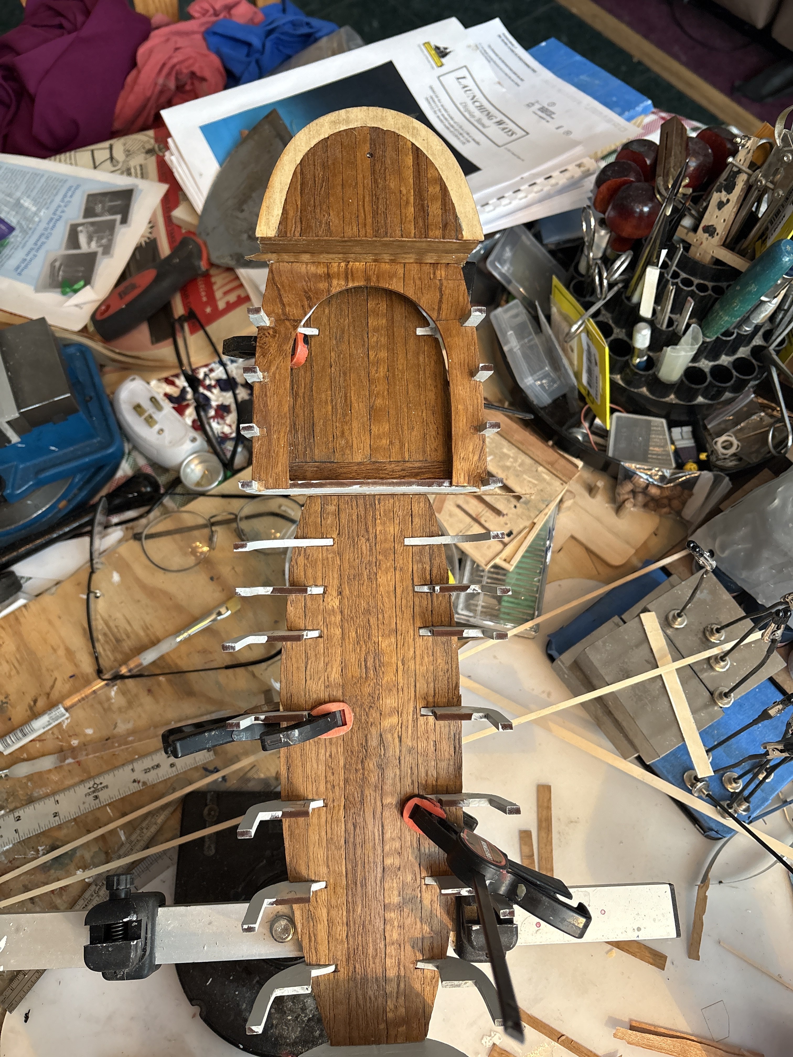

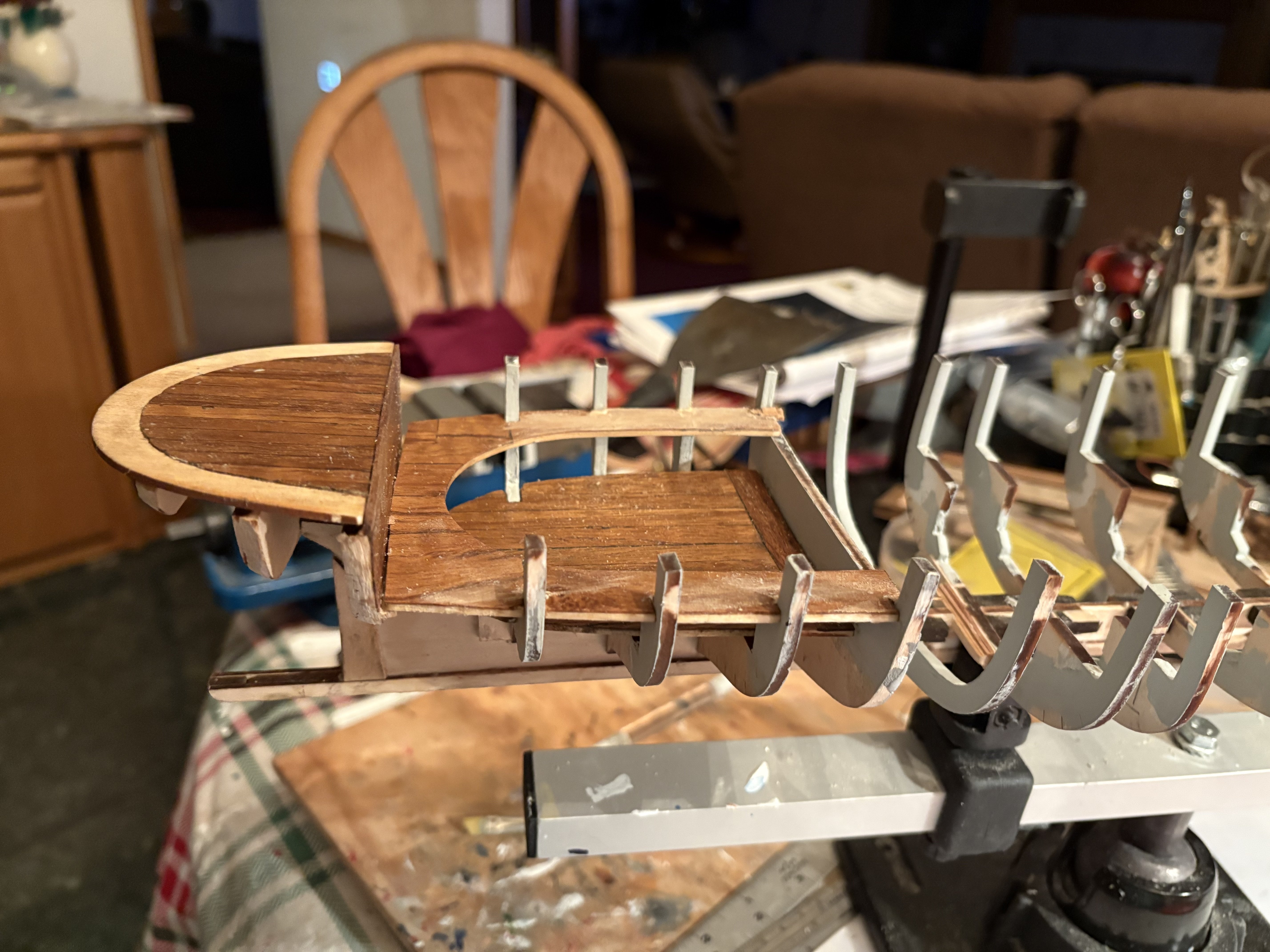

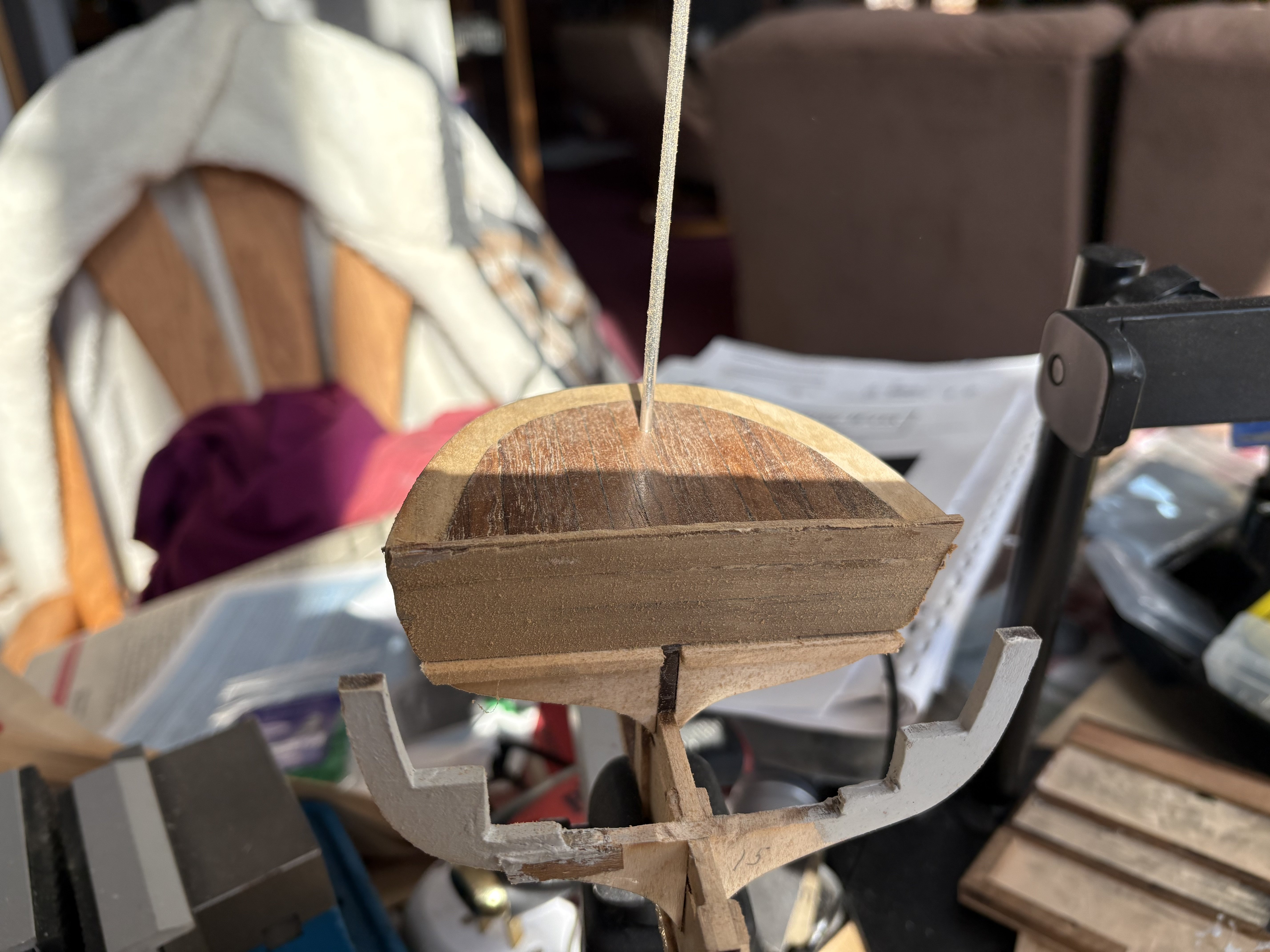

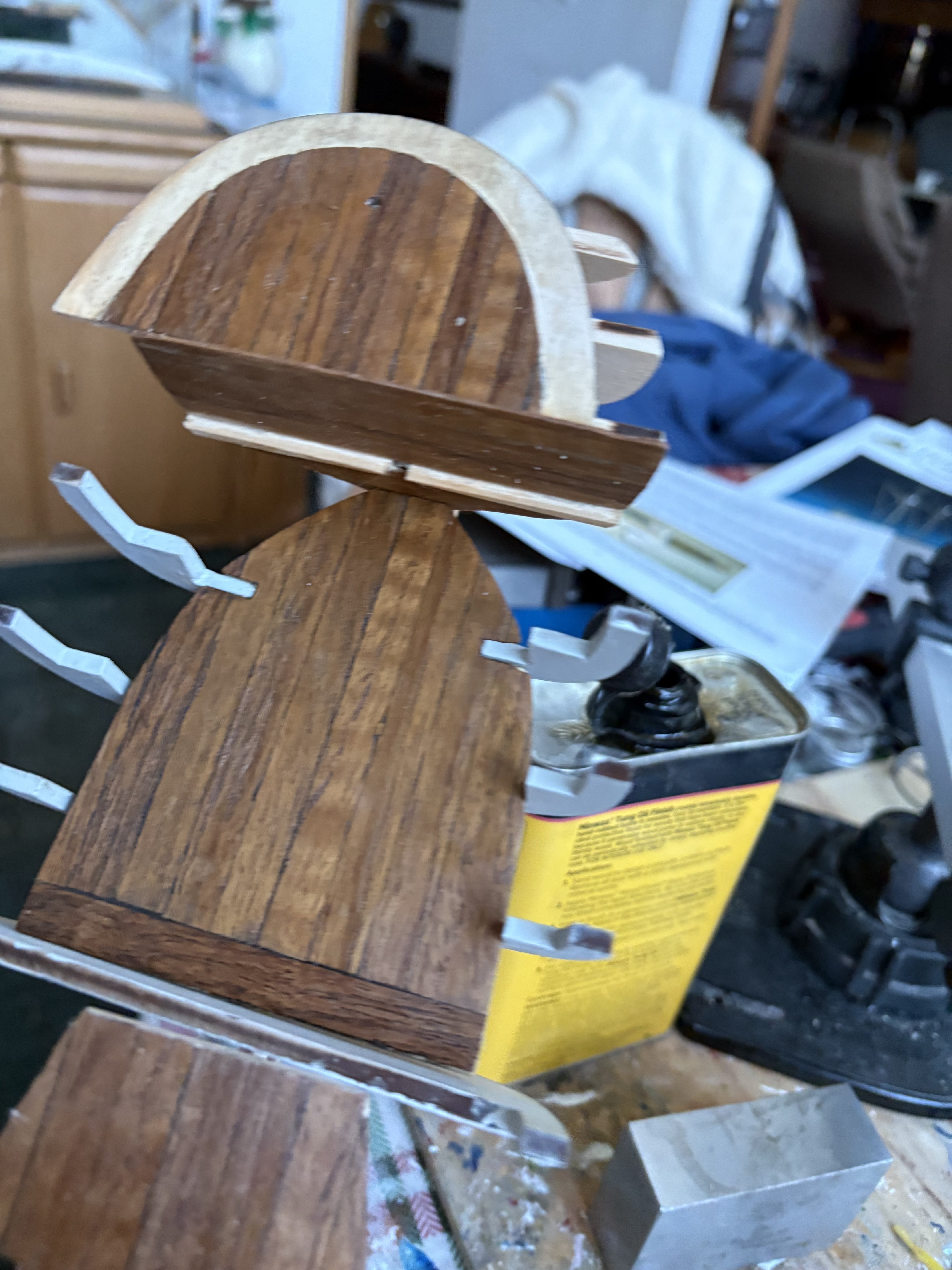

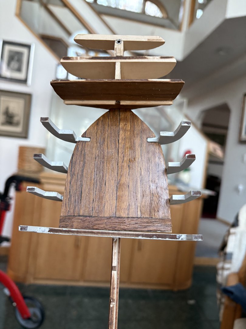

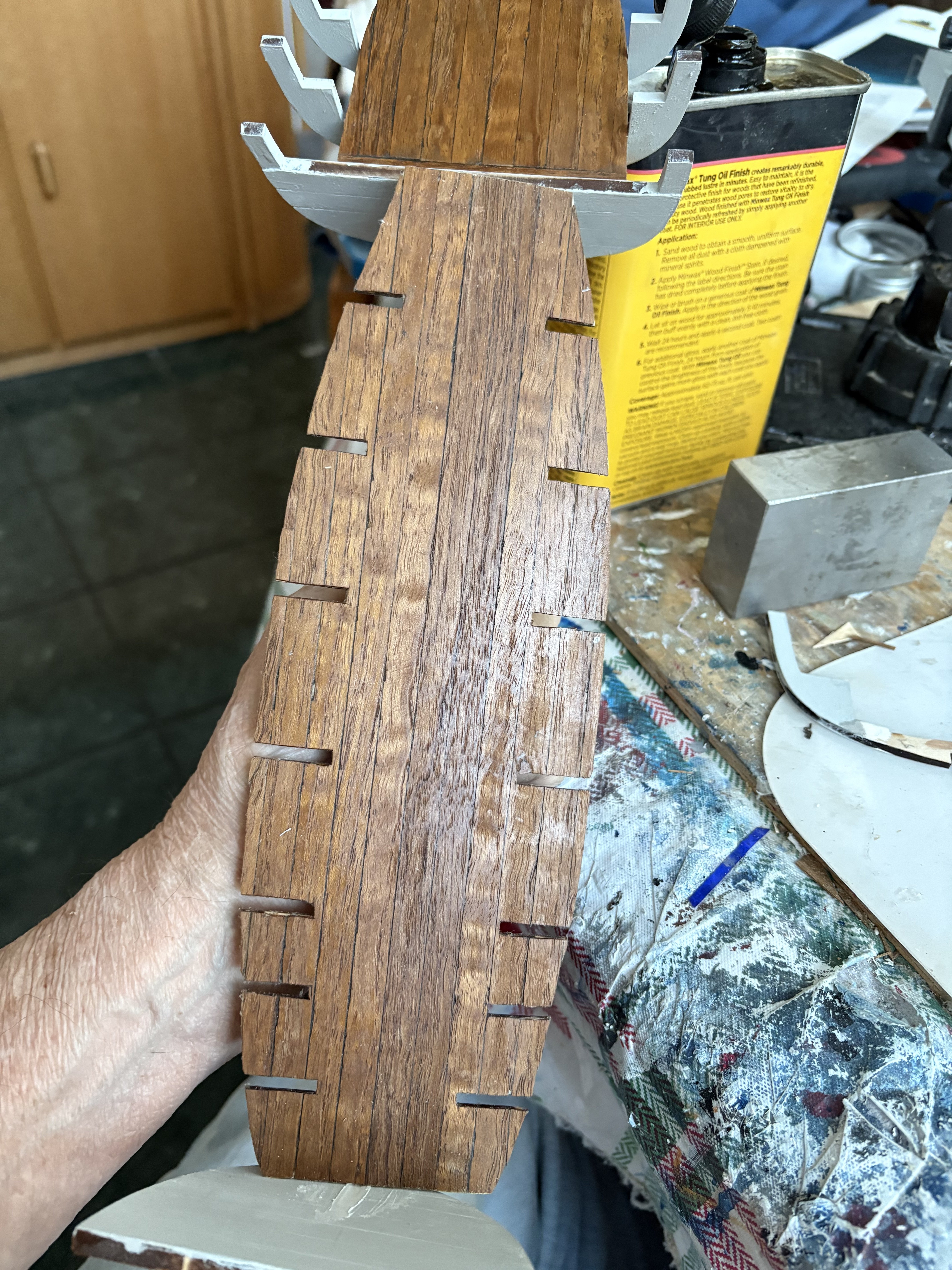

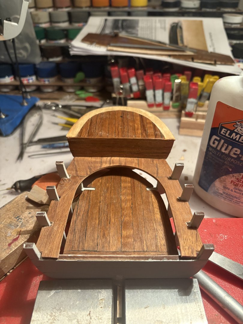

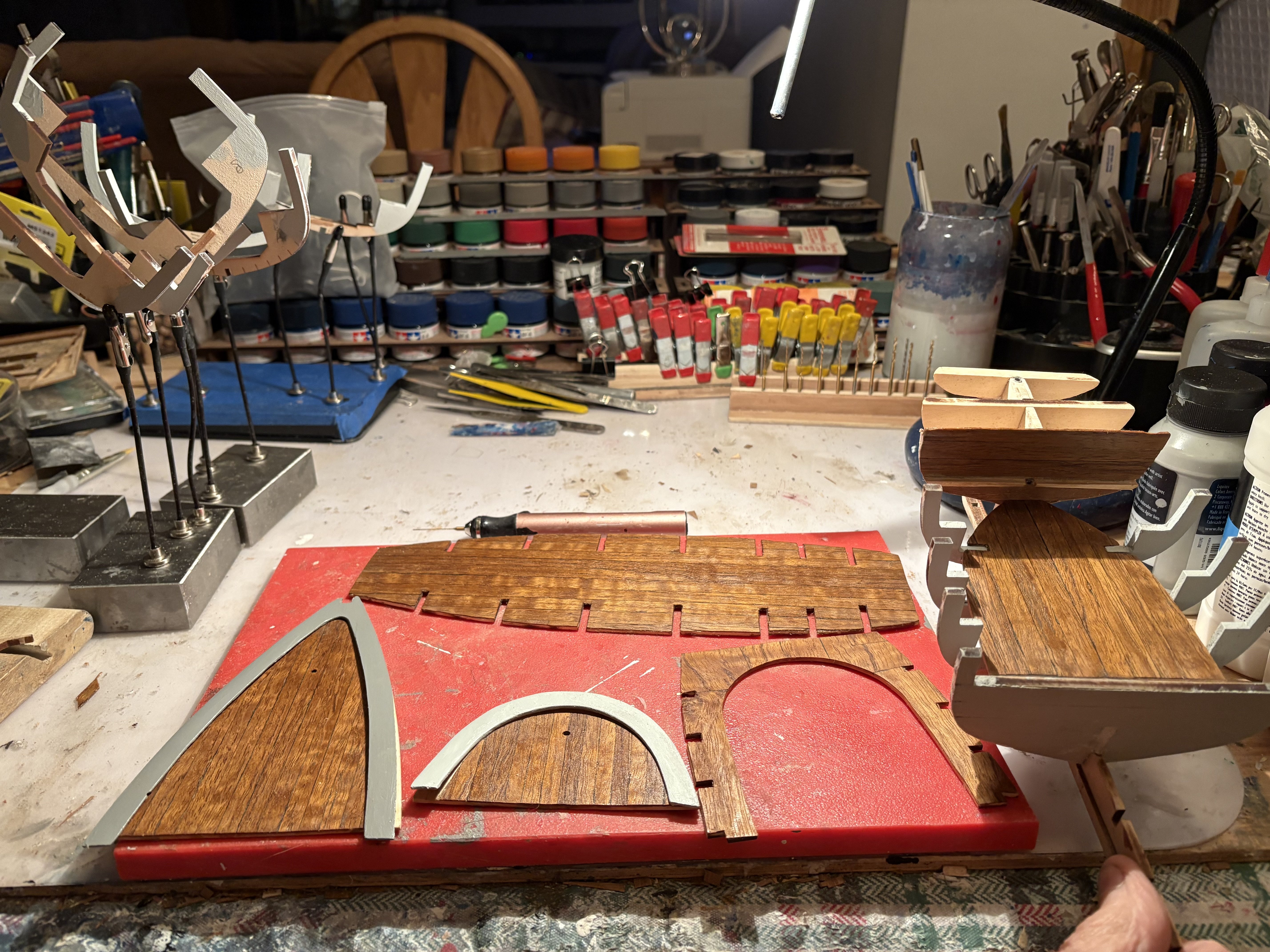

After lifting anchor and miles from shore I decided to work on my cockpit. Veneering the cockpit floor,seat,and seat back with teak and at the same time installing crucial ship structures (bulkheads). The sun is getting low on the horizon time to turn in for today. Enjoying my new adventure immensely.
As always Best Rick

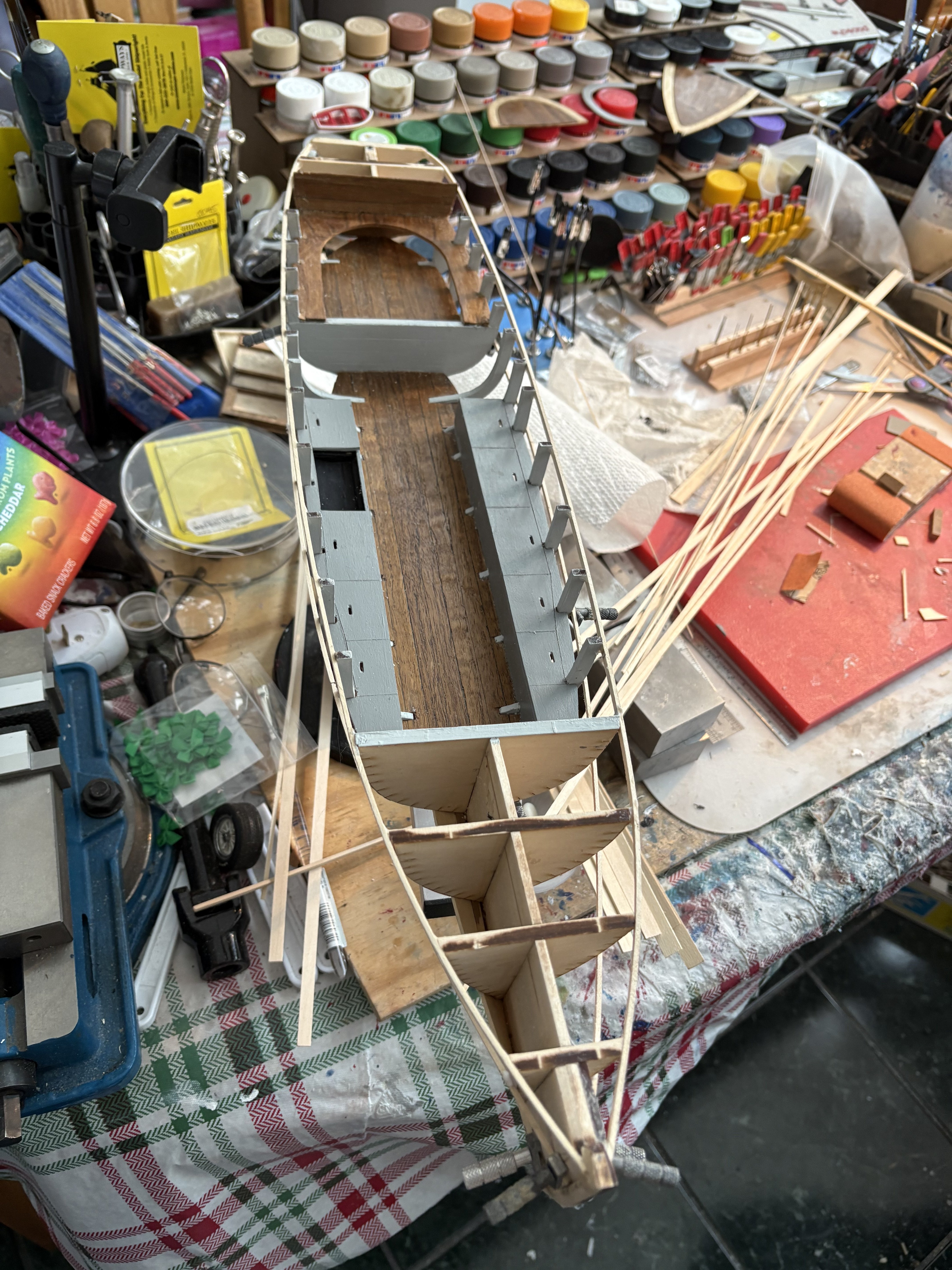

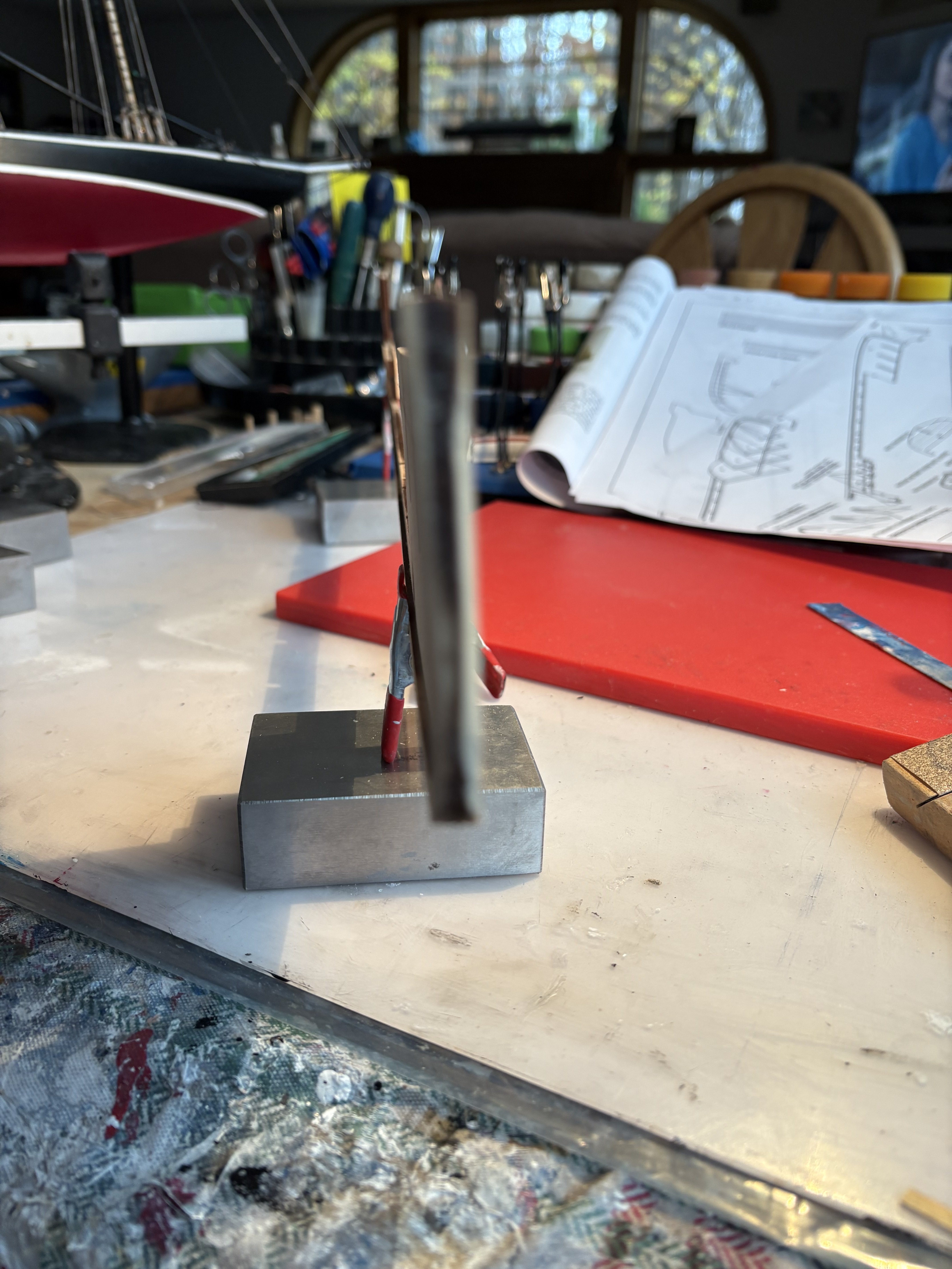

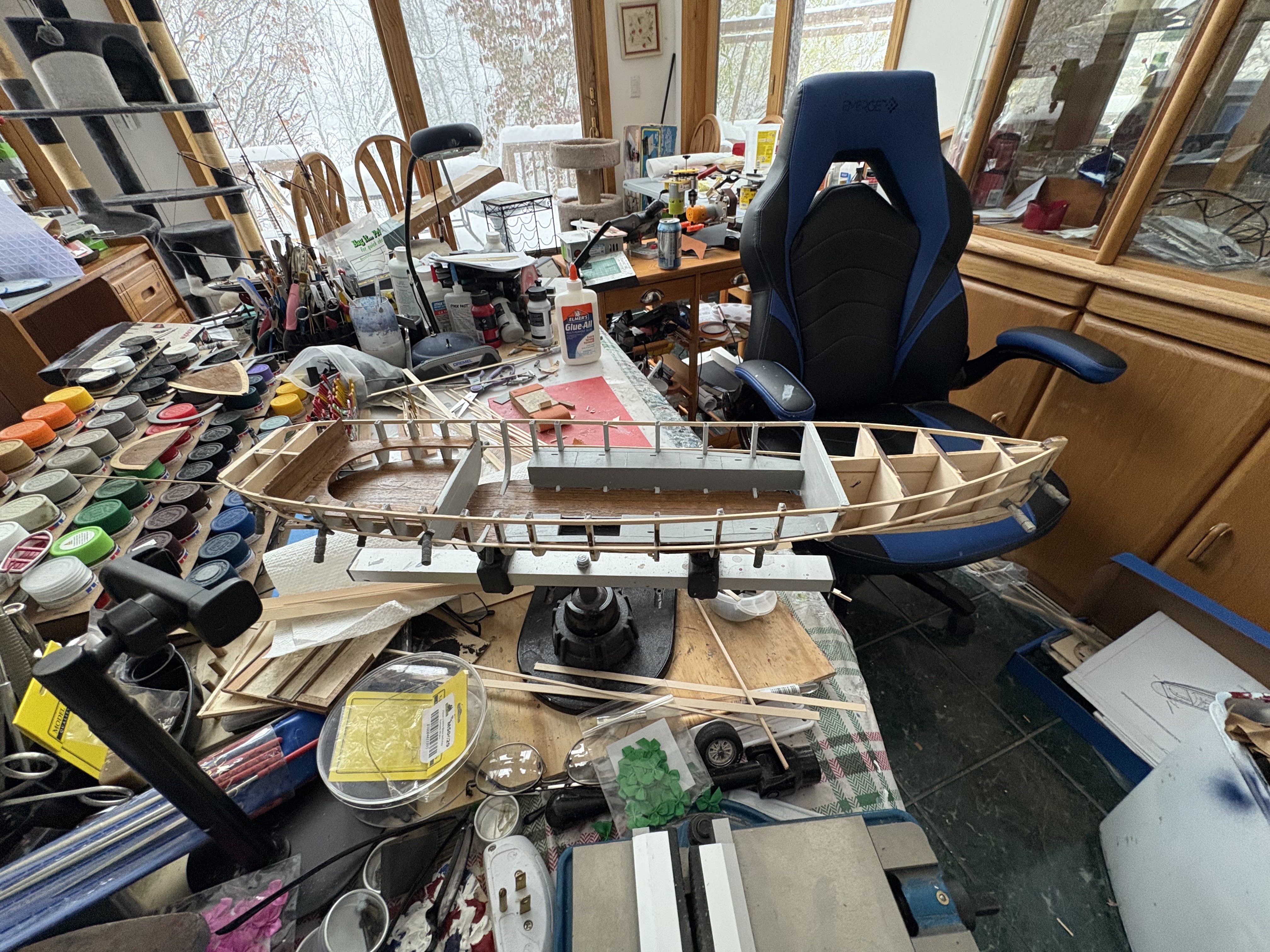

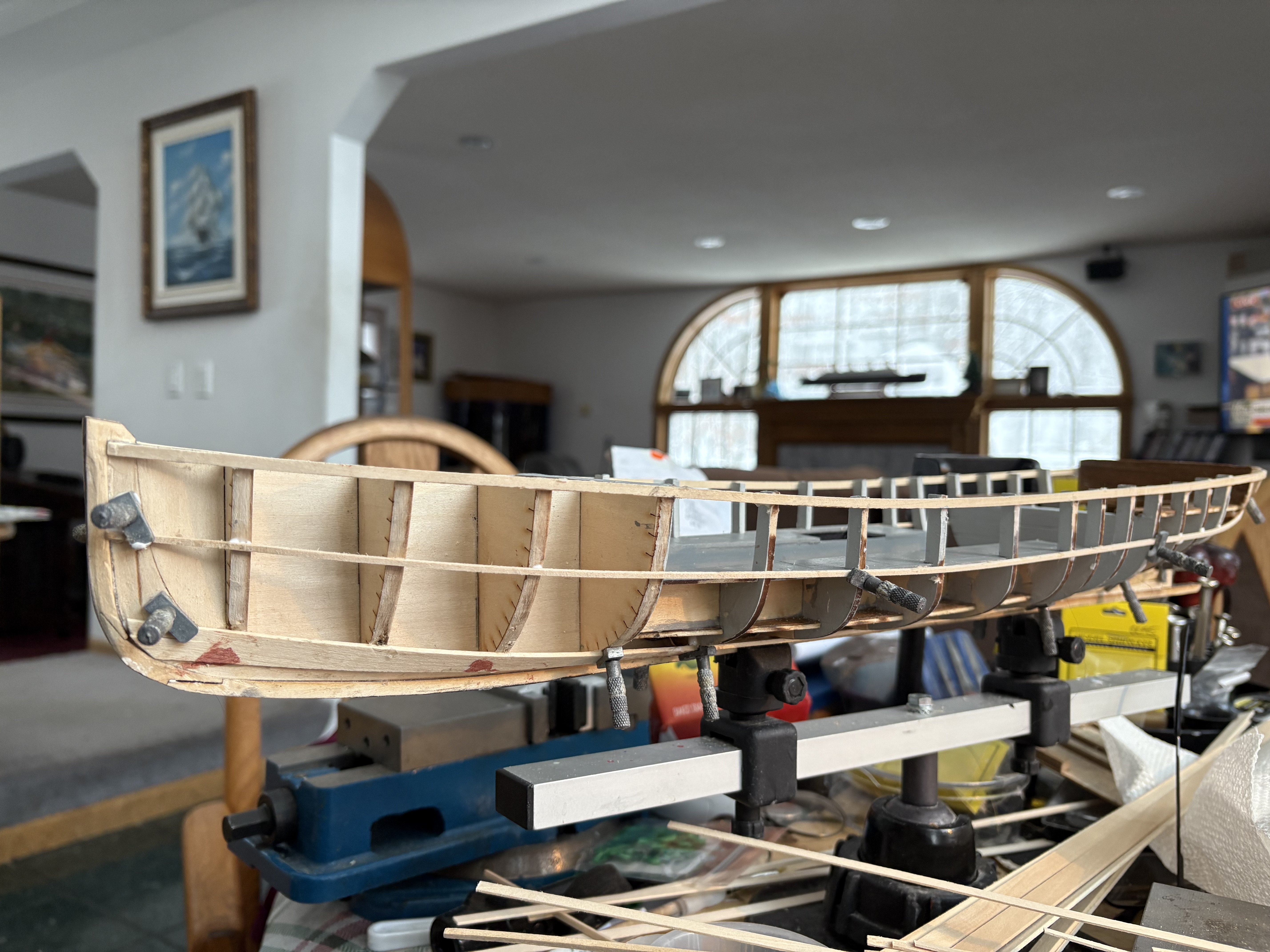

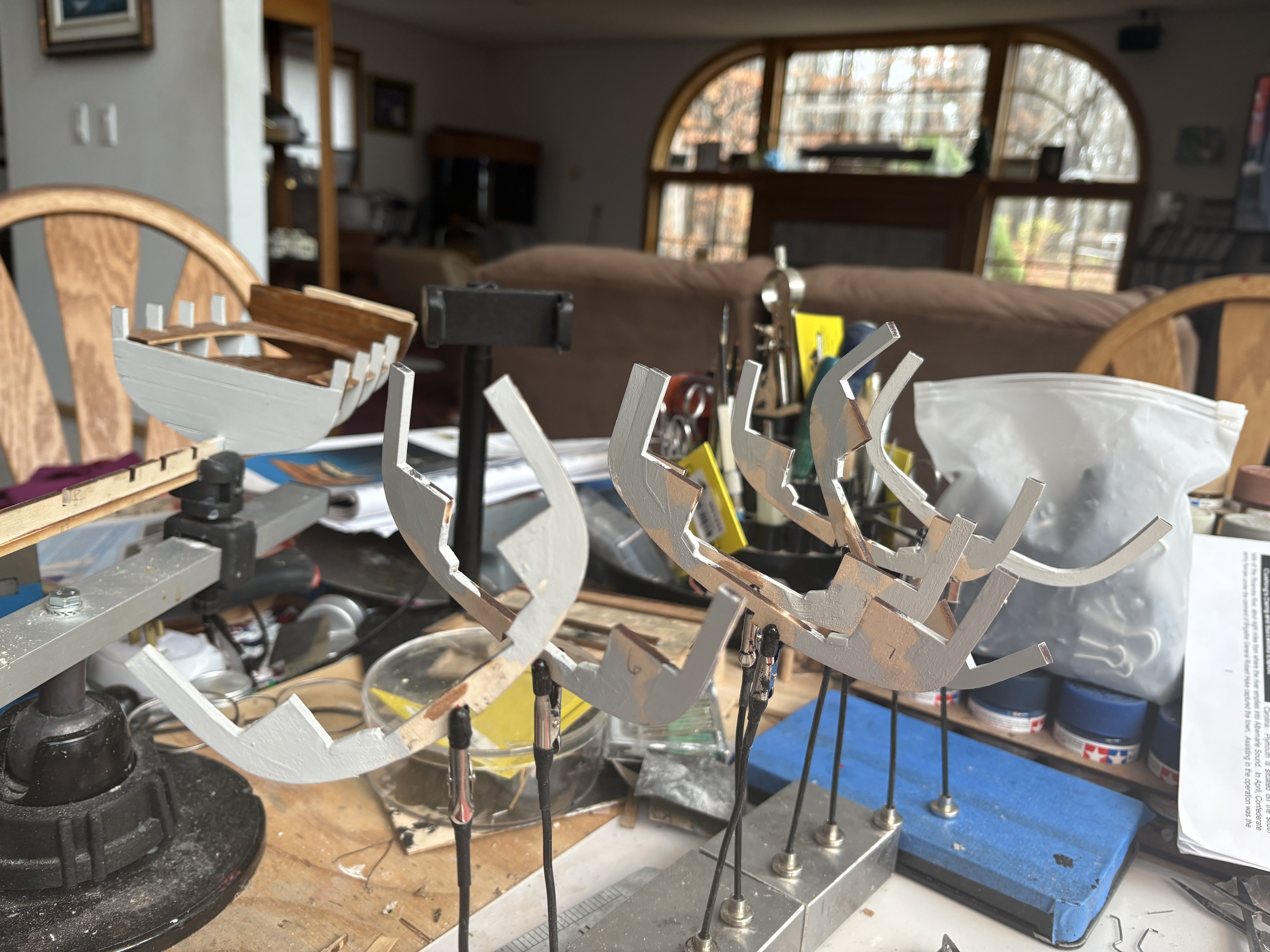

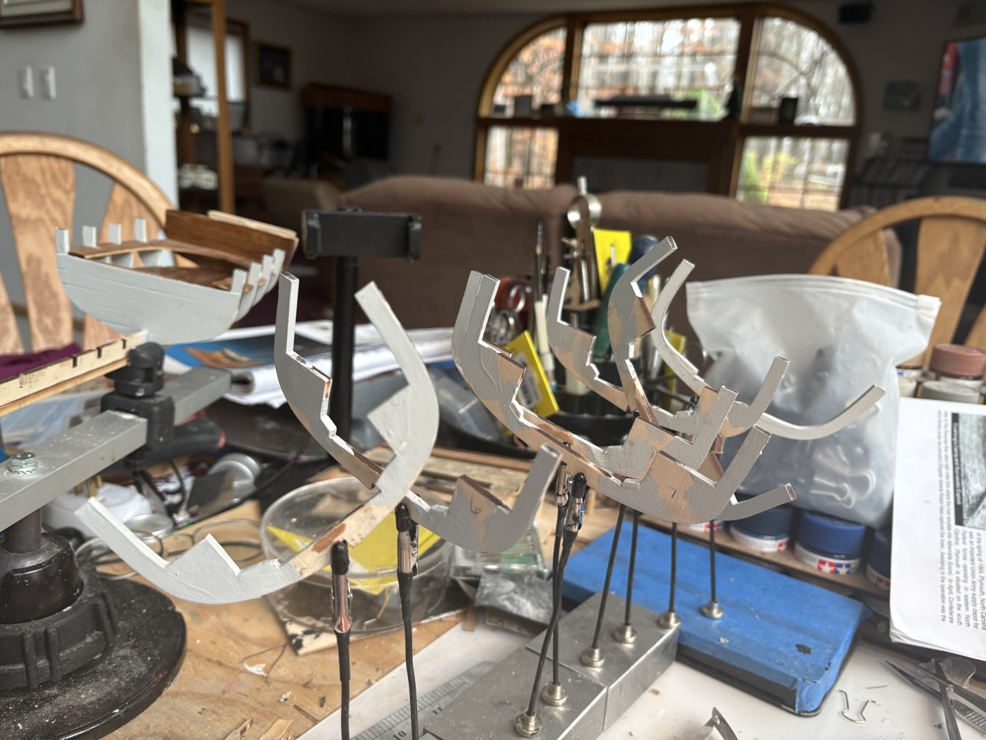

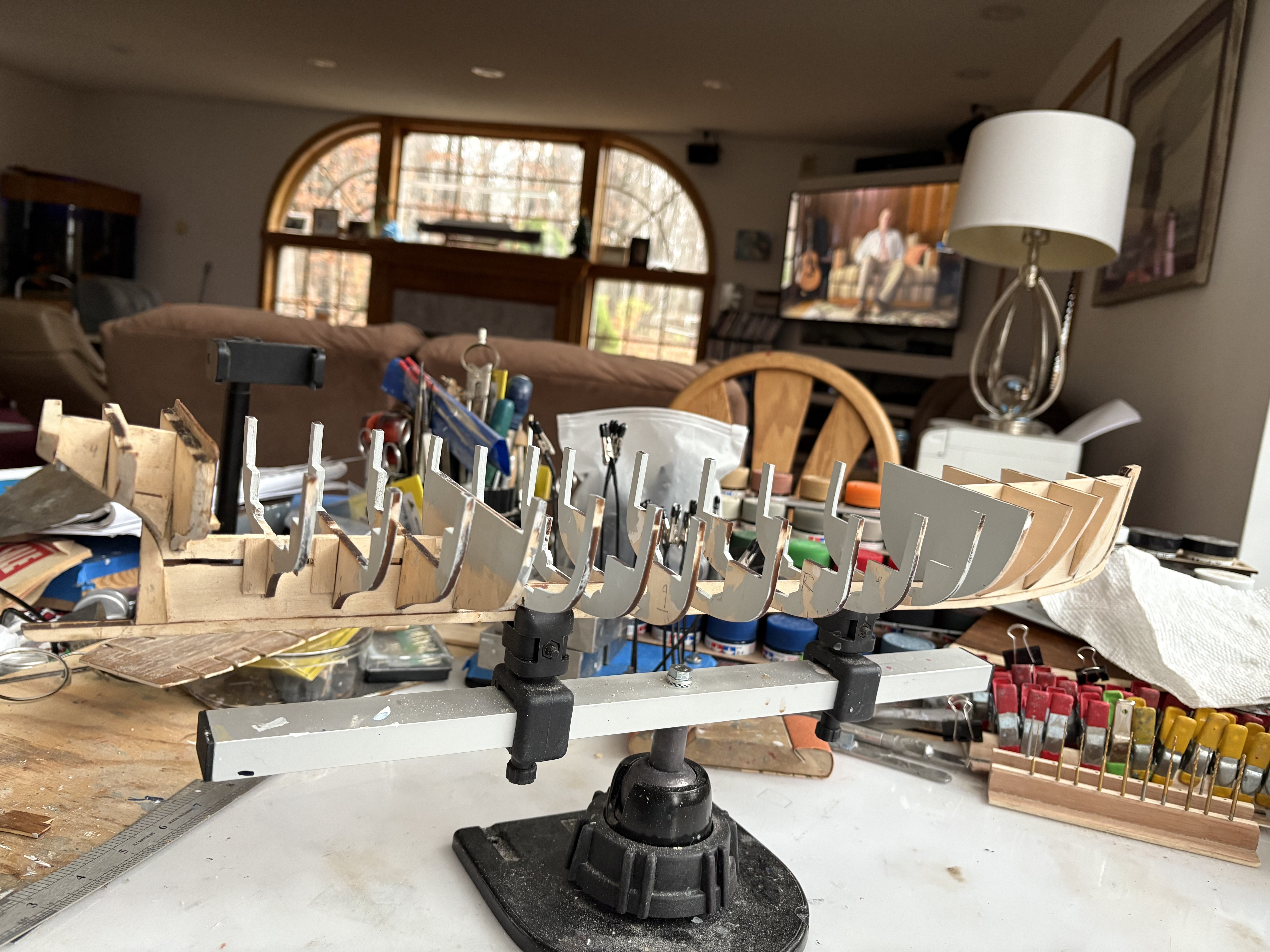

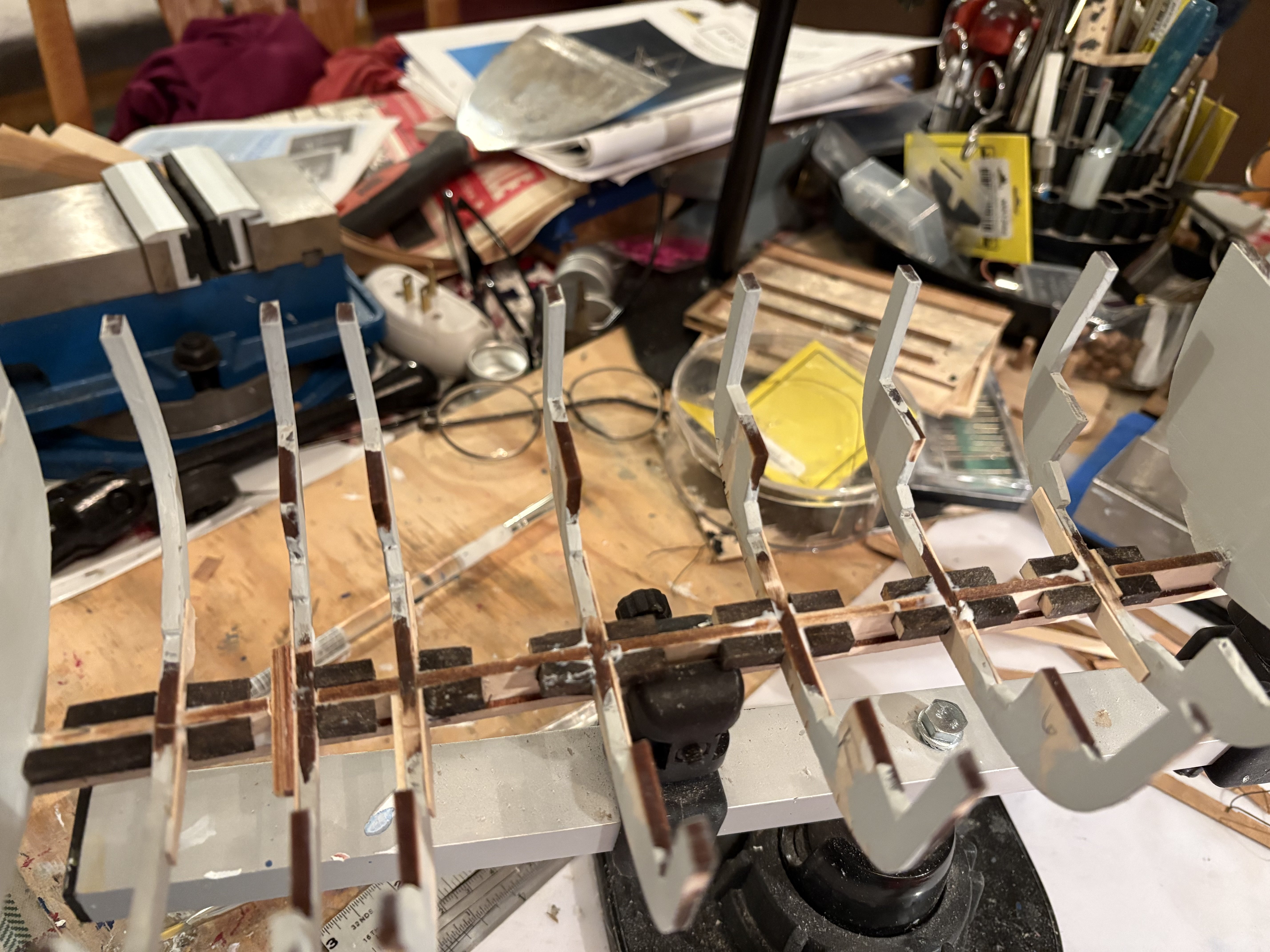

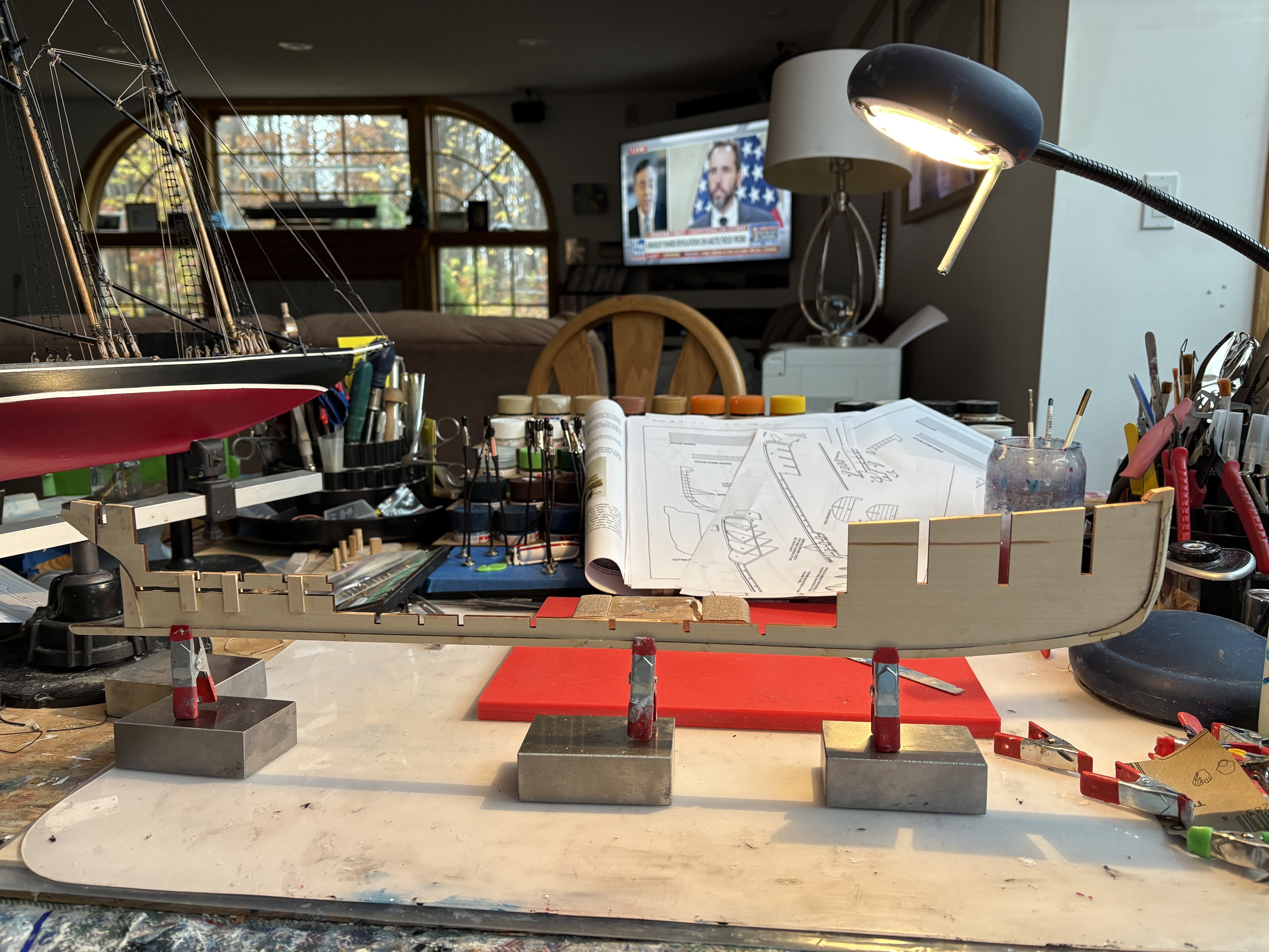

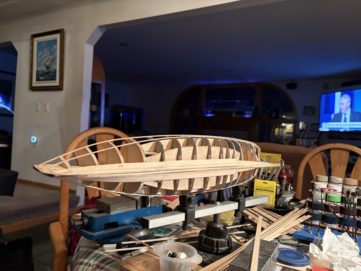

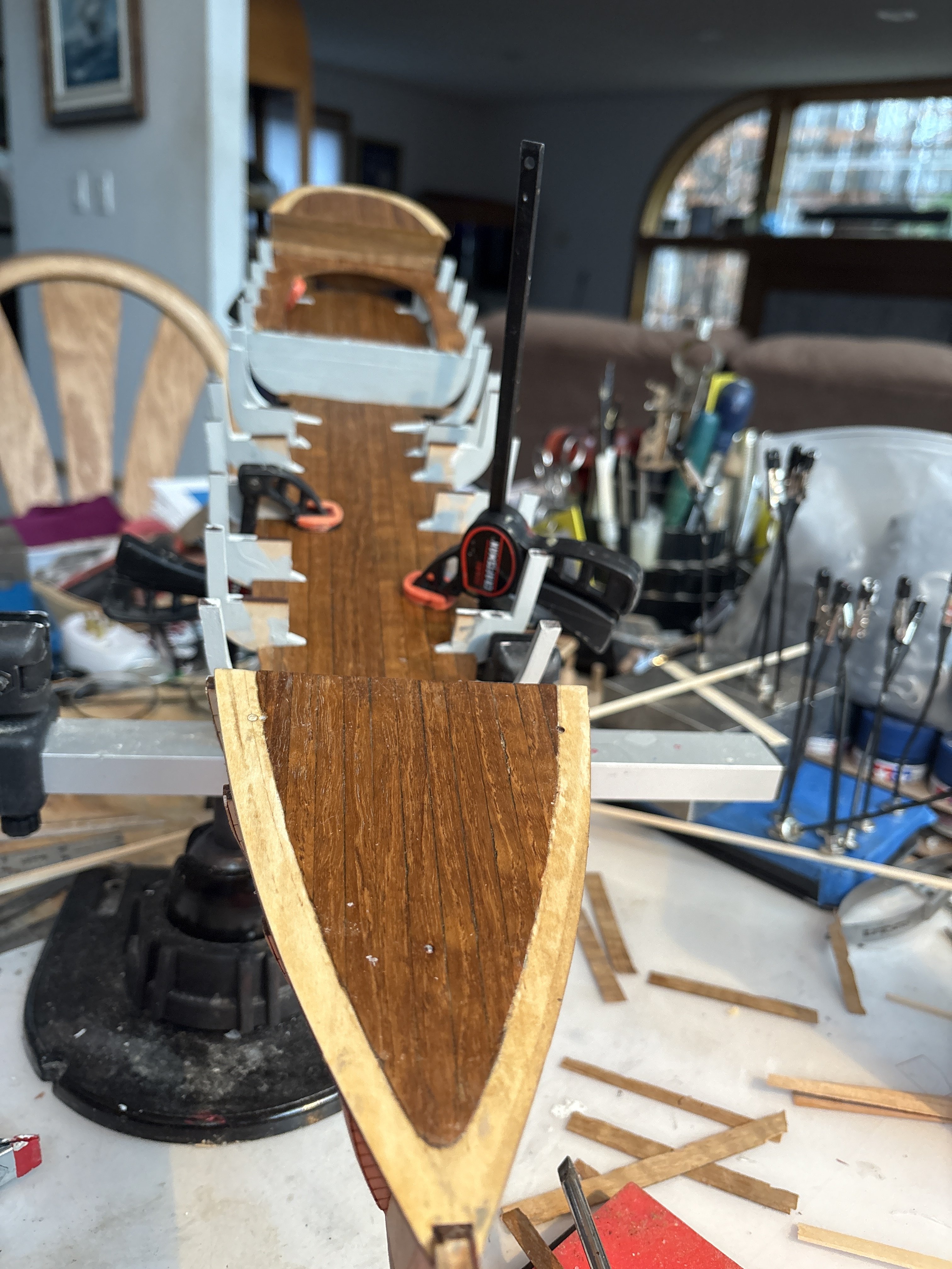

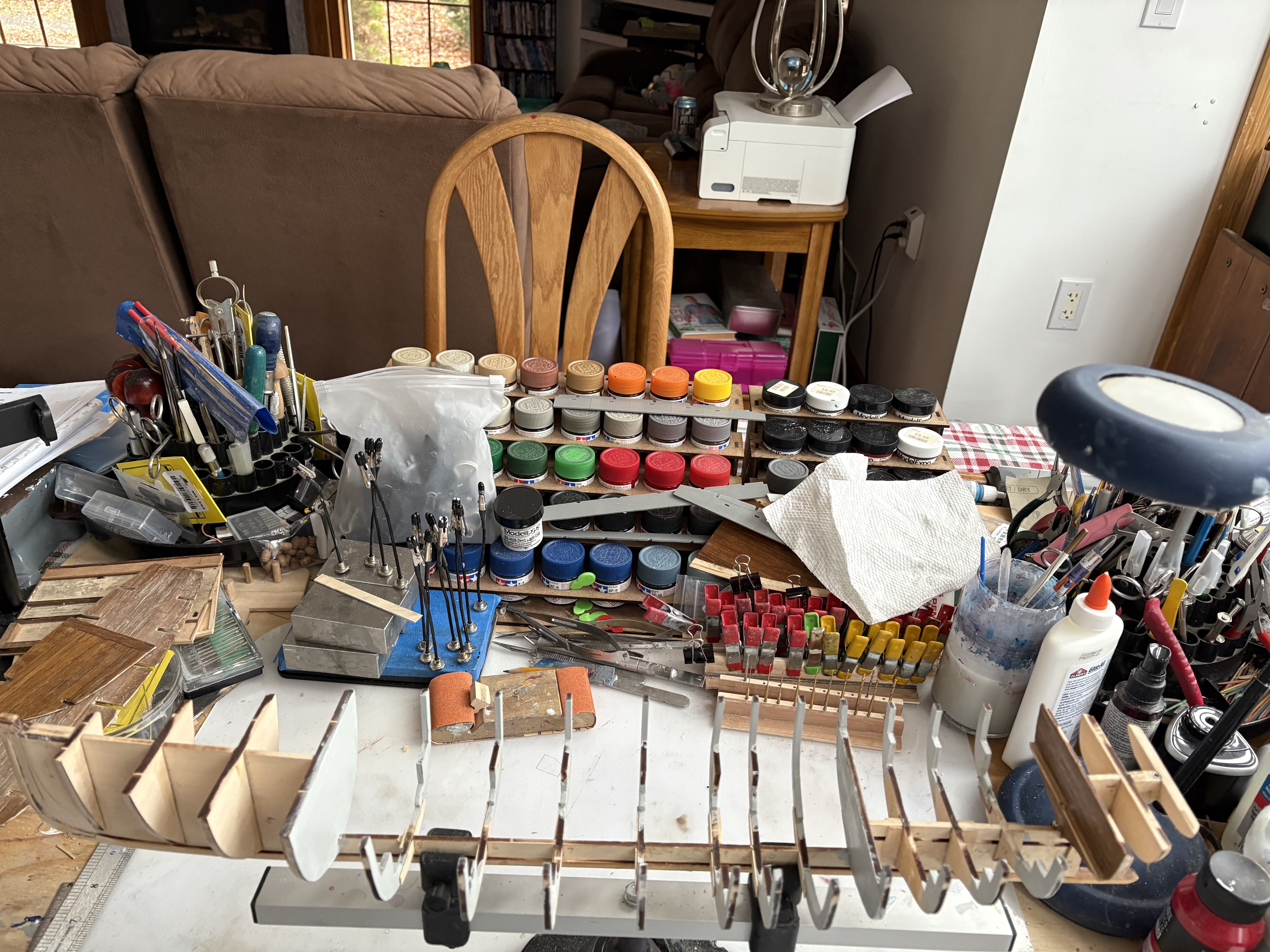

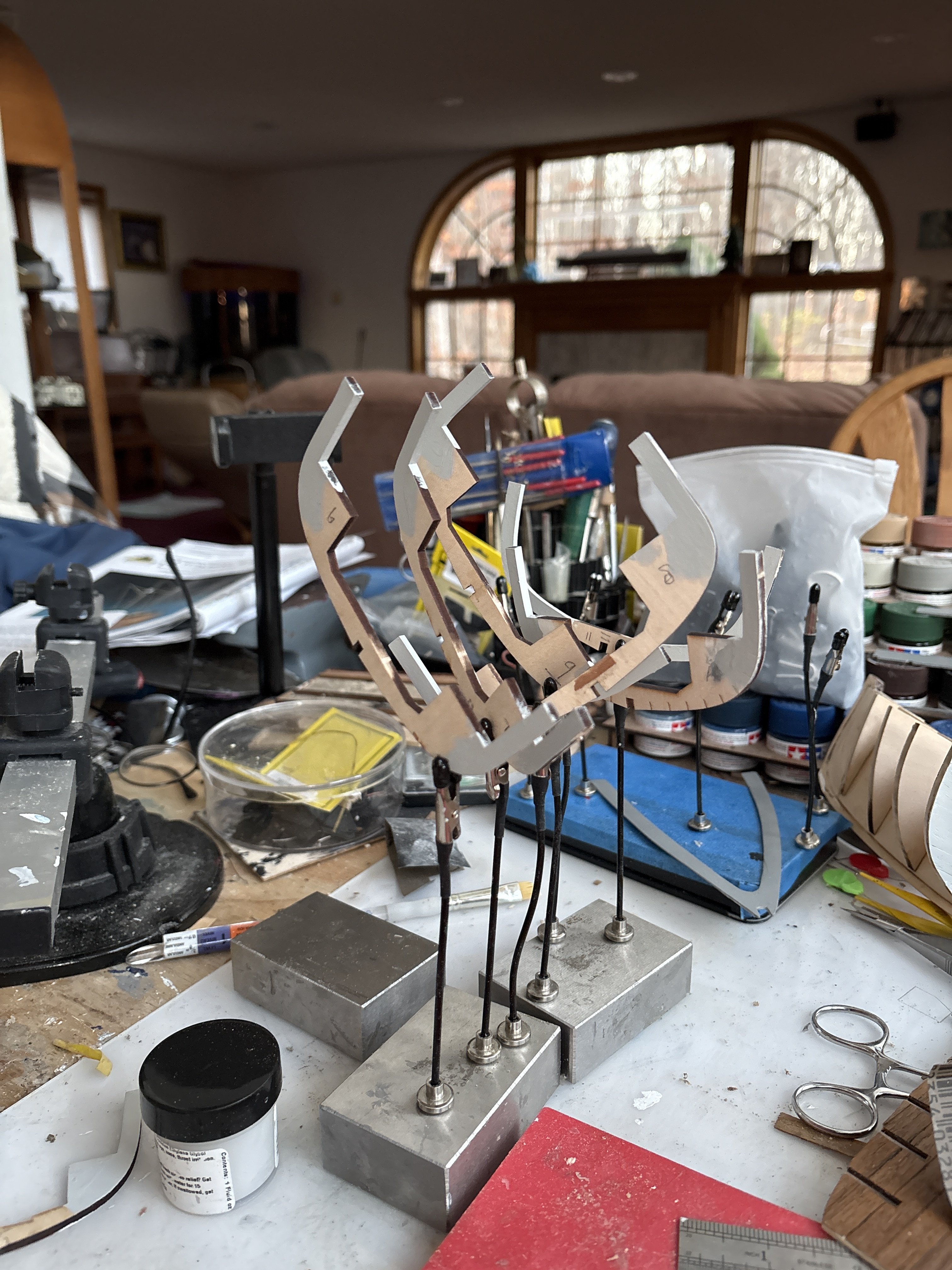

Back at sea again and been working like a beaver-seal painting and test fitting bulkheads. After finishing cockpit test fit and letting the bulkheads dry and lined up in order held by magnetic clips on       1-2-3 blocks they are ready for installation. IMG_3447.thumb.jpeg.367386f6e902e312d7505afee6cfaf82.jpeg

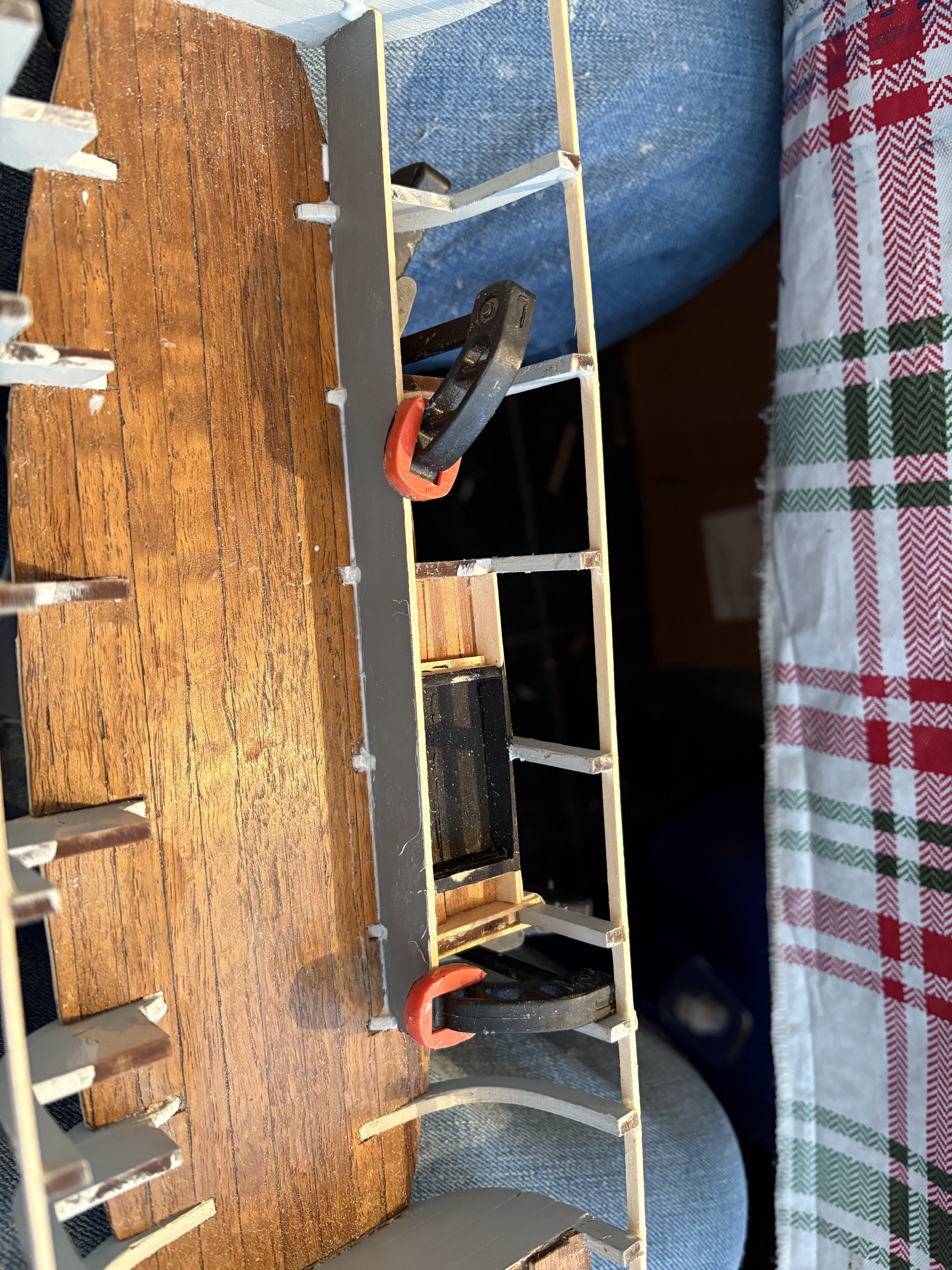

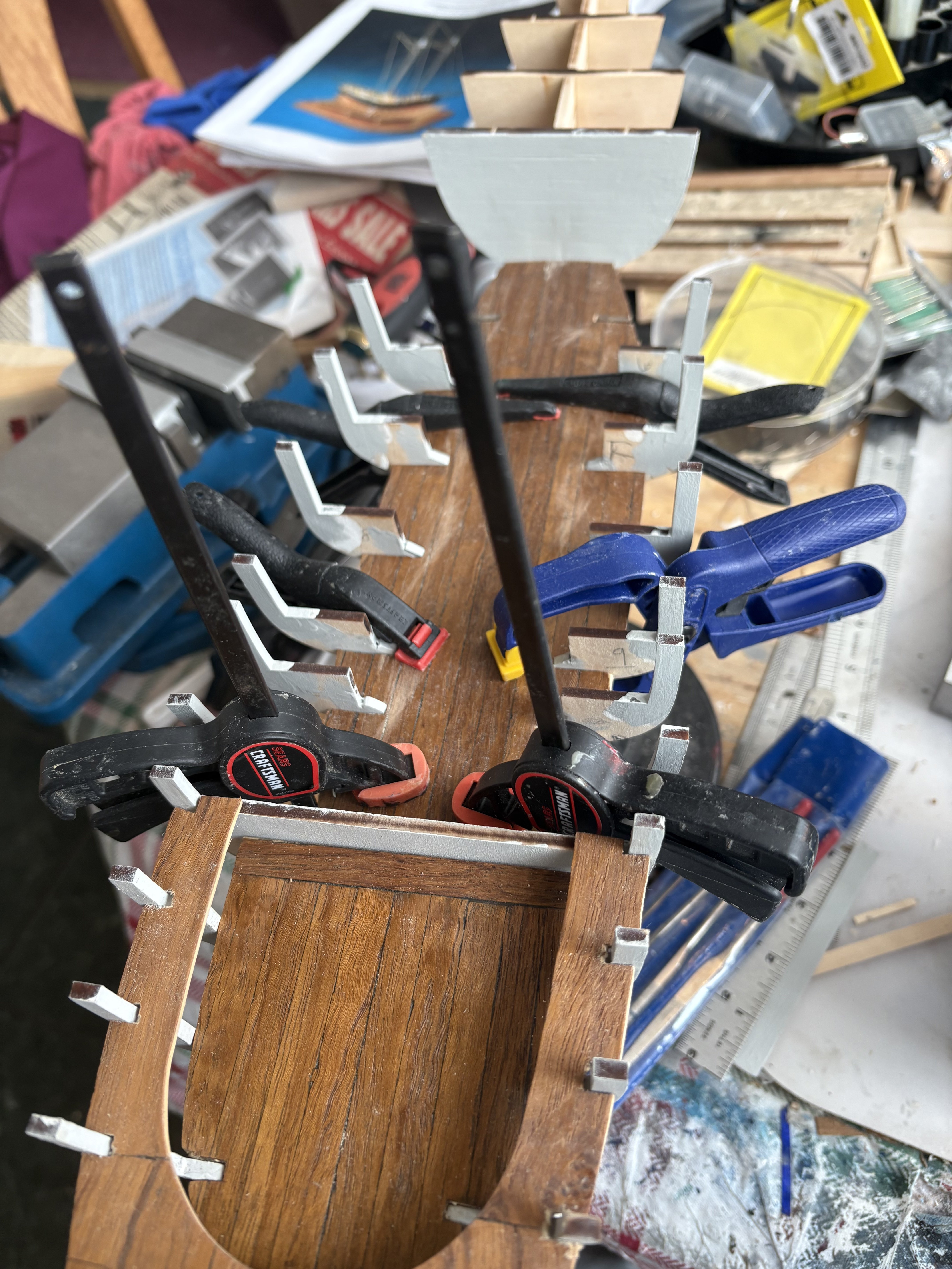

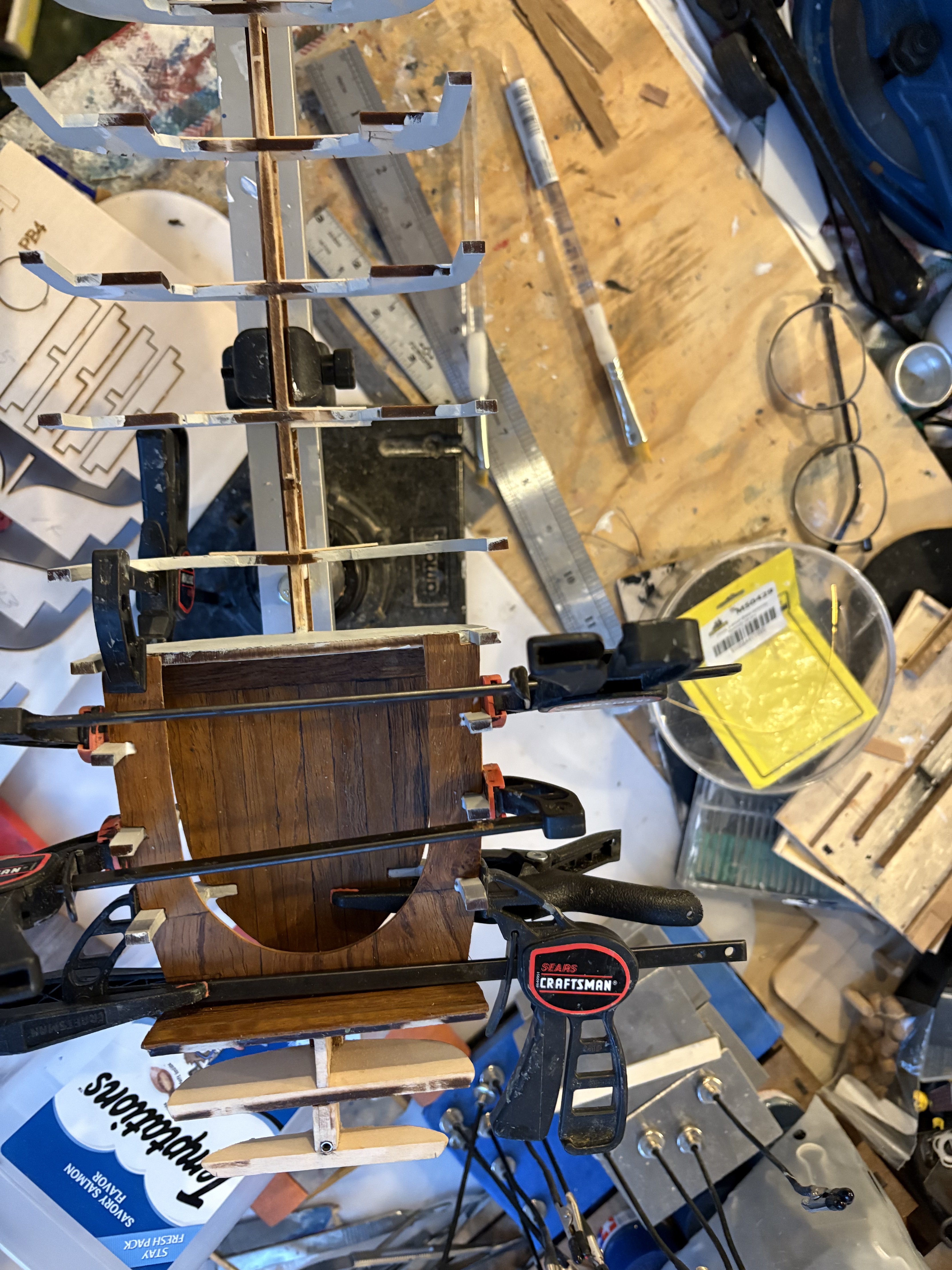

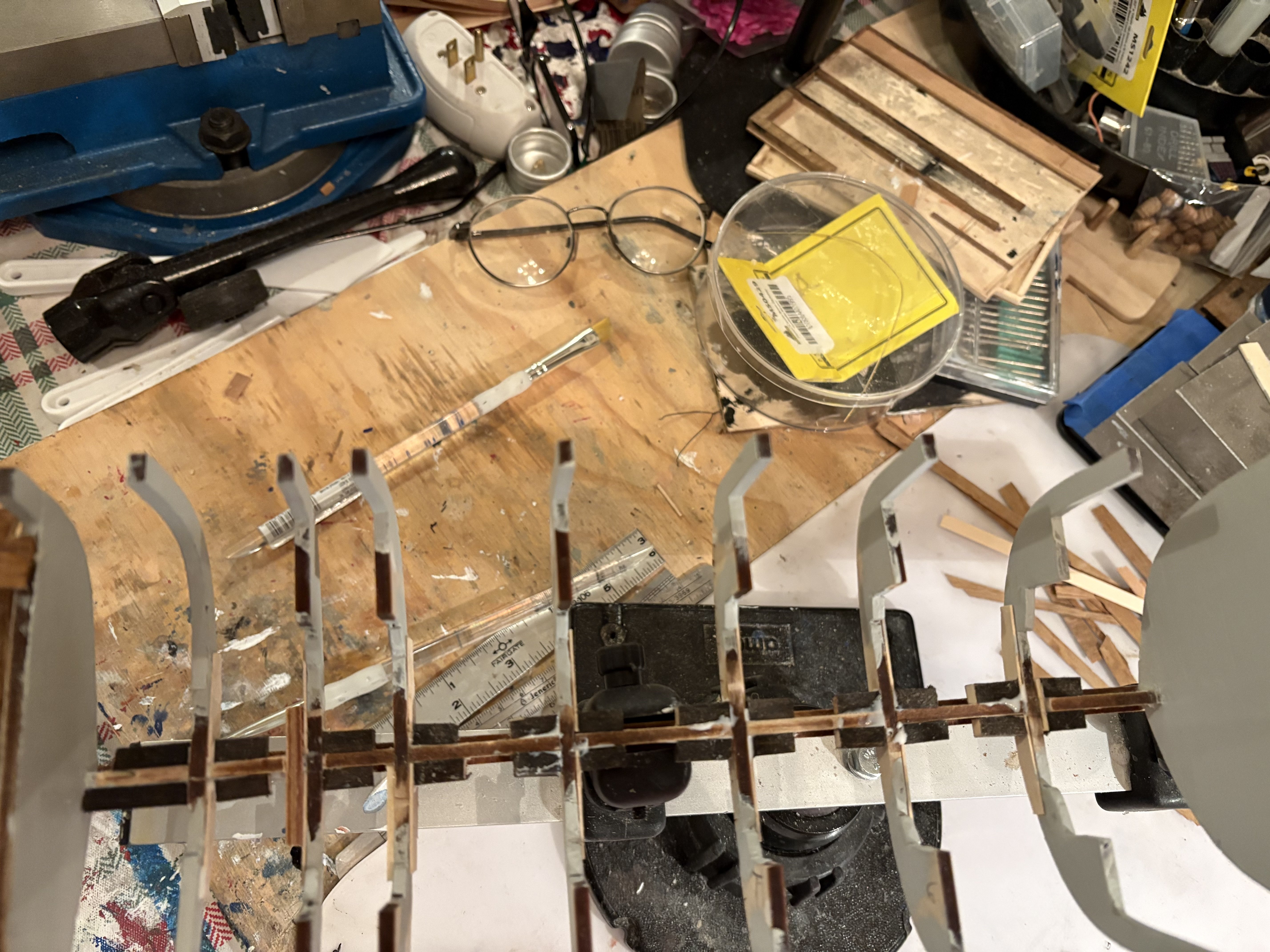

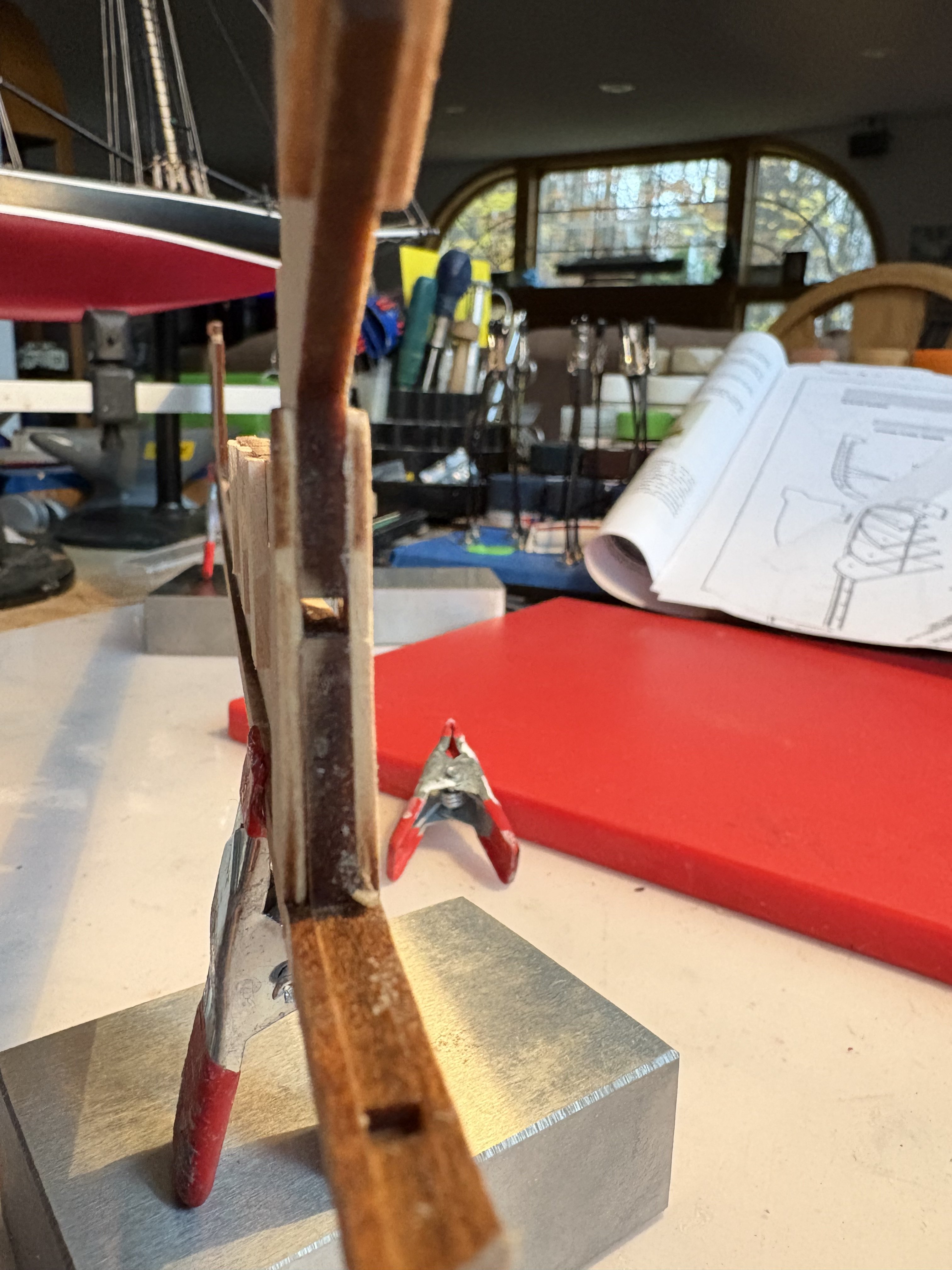

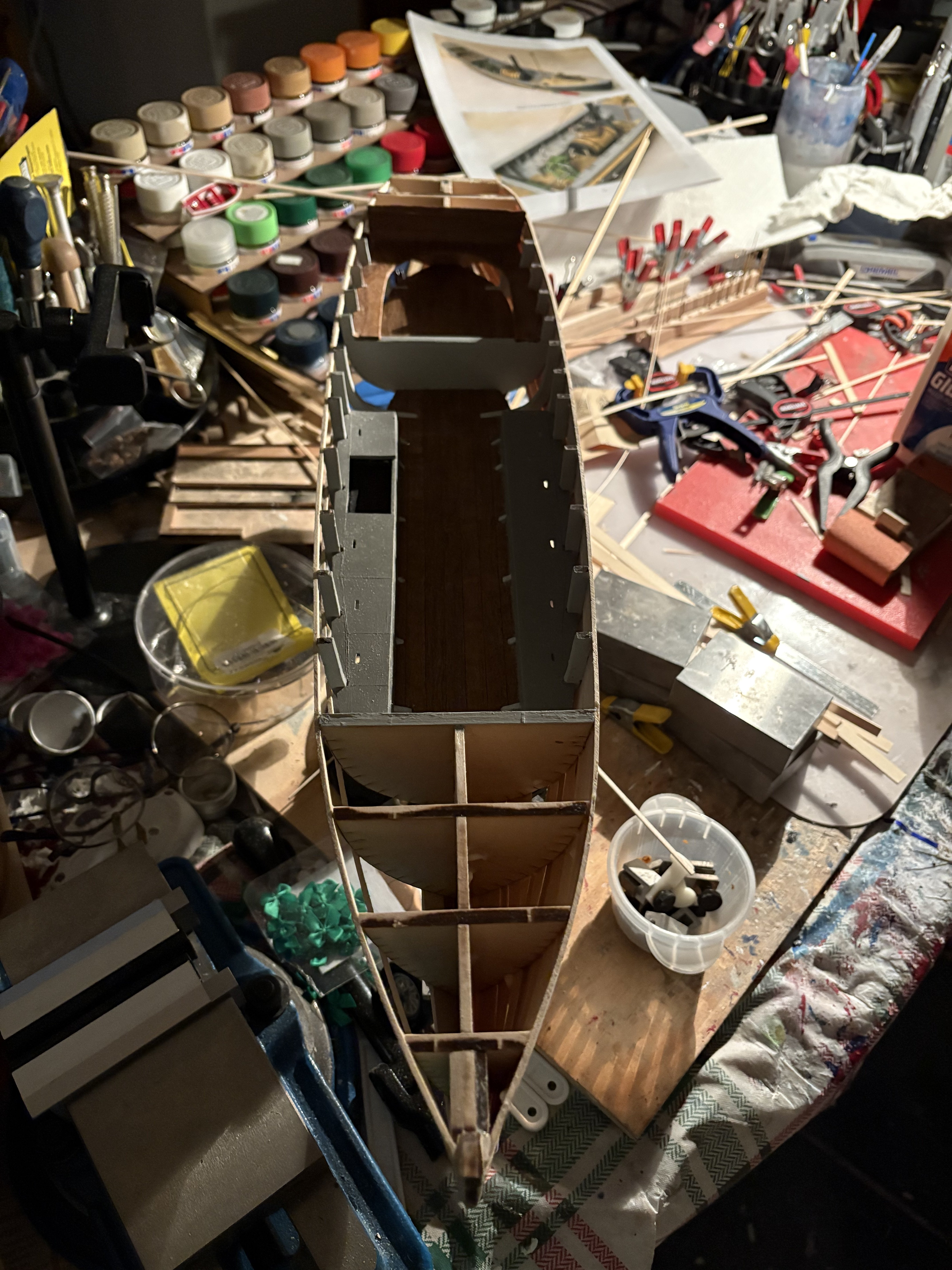

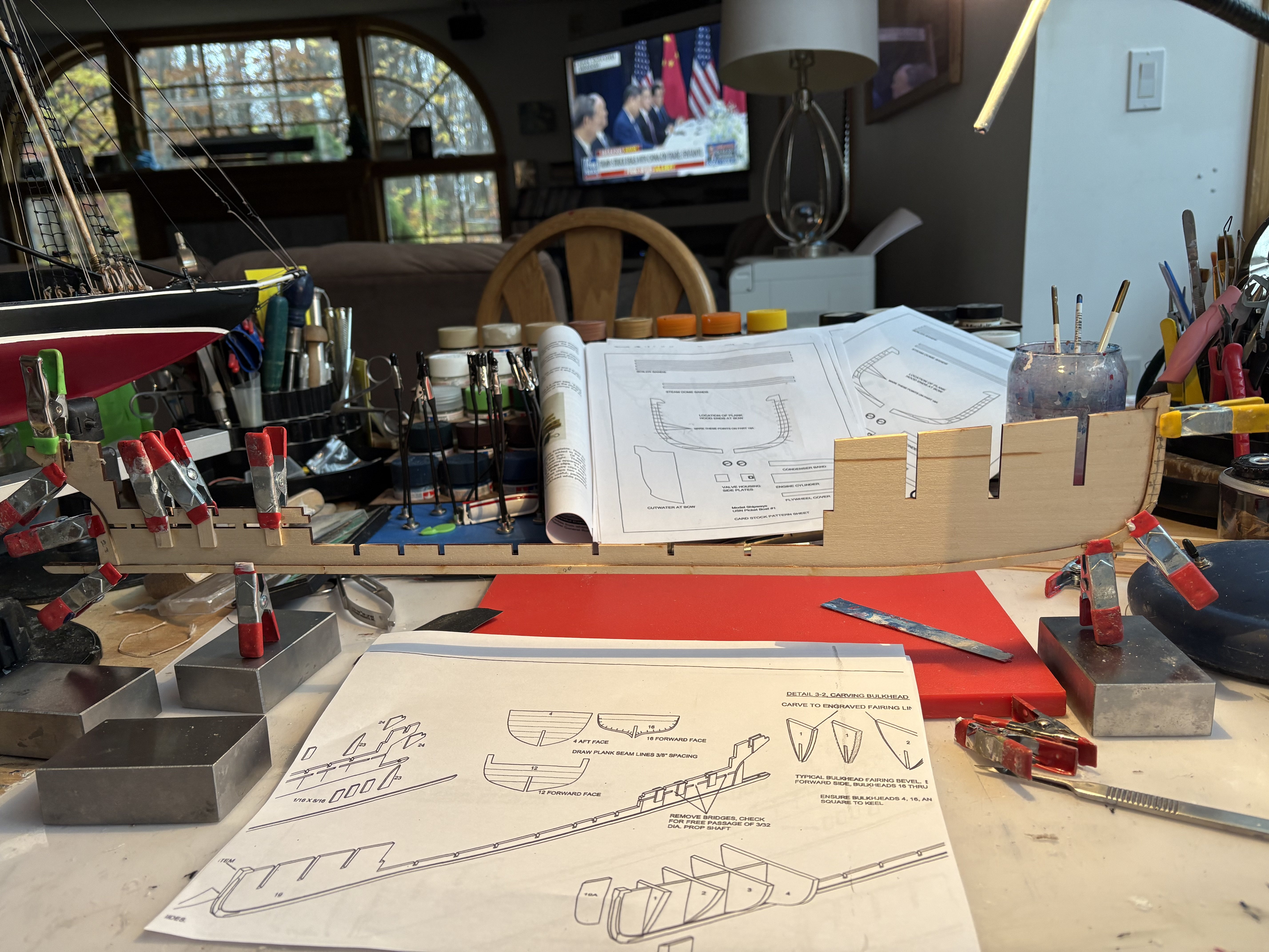

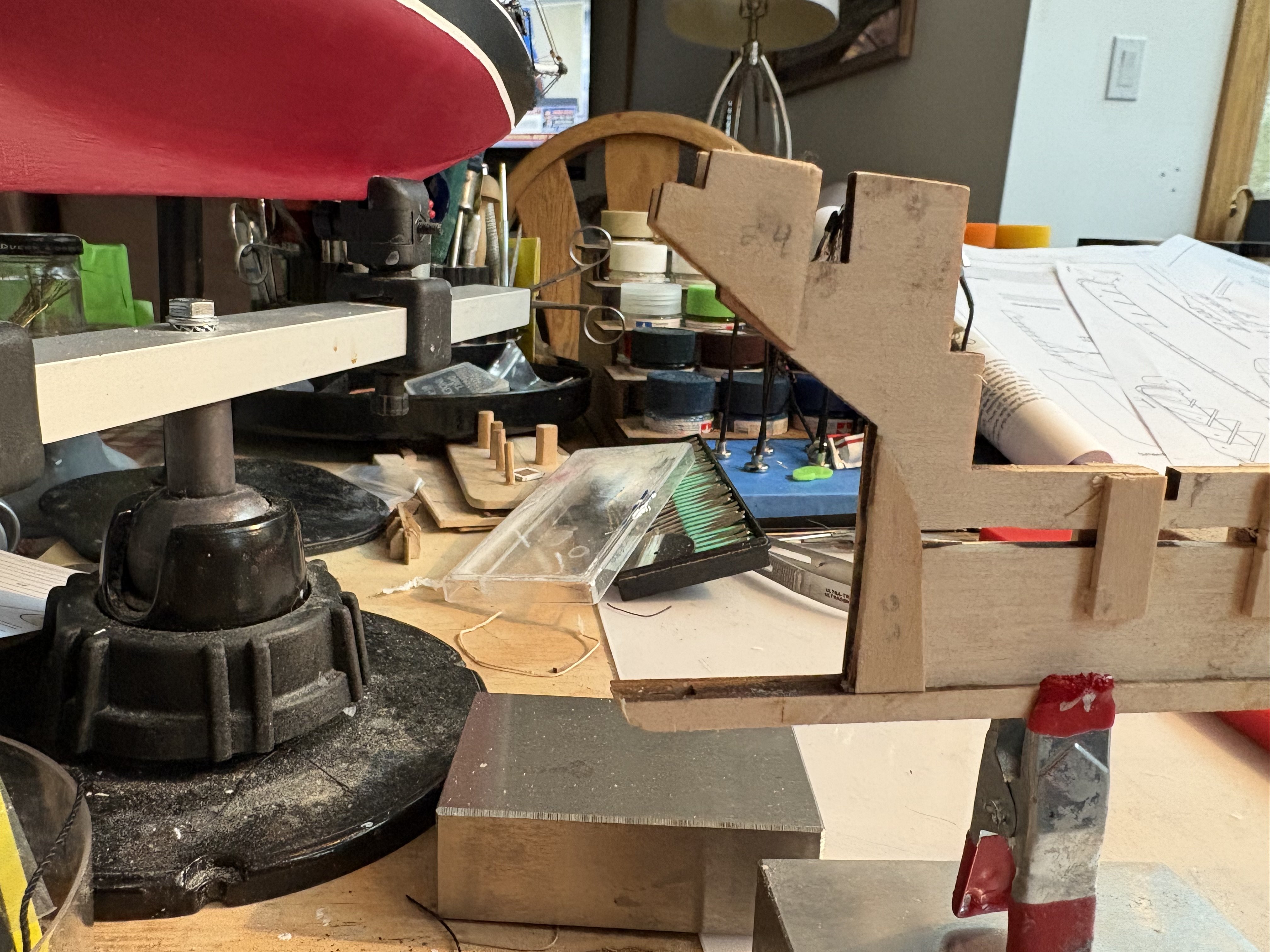

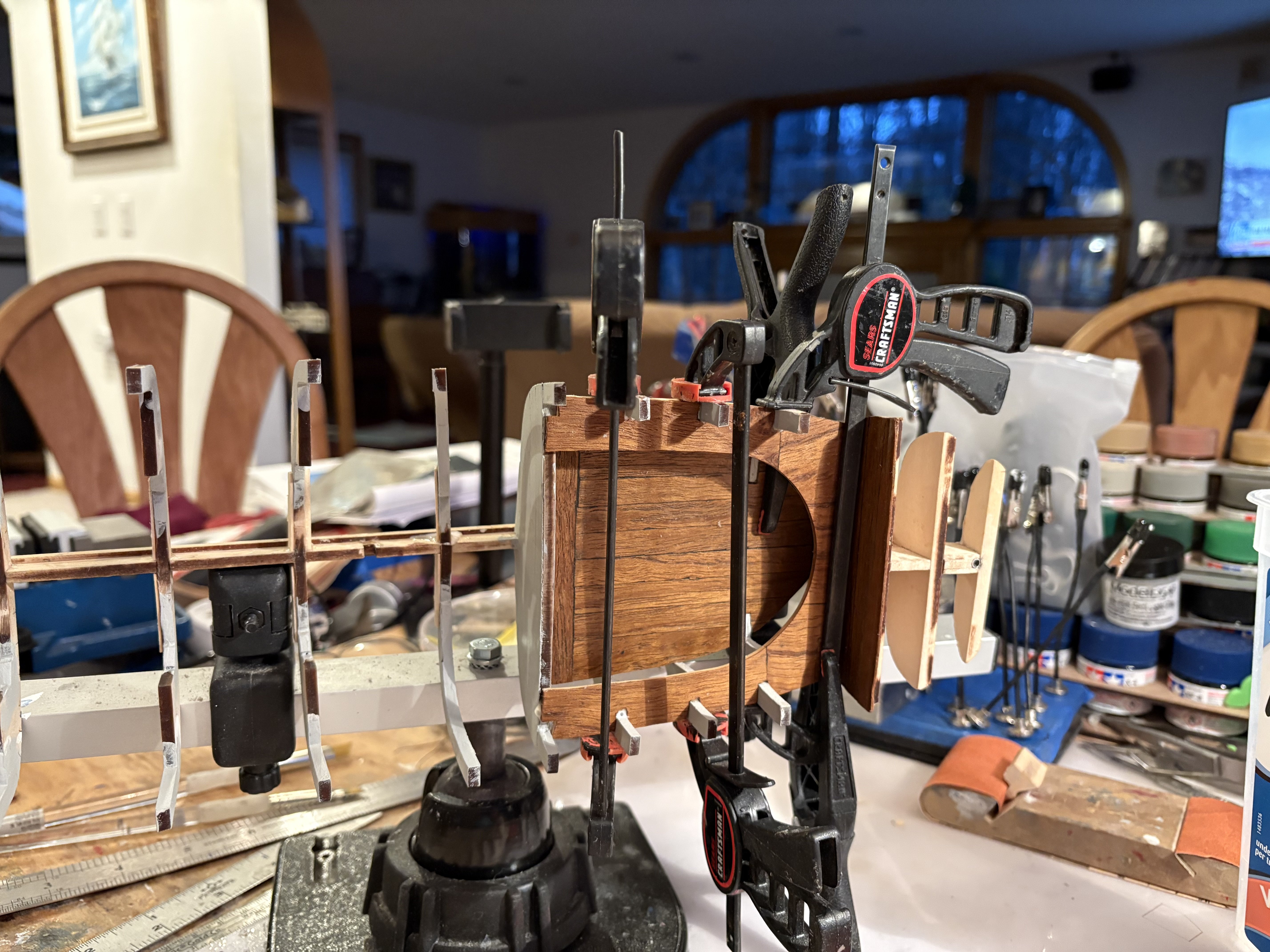

While at sea today sprung a leak in the hole requiring urgent structural repair. After breaking 2 bulkheads on installation (being warned after reading other captain’s nautical loIMG_3458.thumb.jpeg.74b098004be9cd505497734674599a4a.jpeggs they were very fragile) at the point where they met the keel I reinforced them with 3/16 blocks.
All leaking areas secured so will drop anchor and retire for the night.

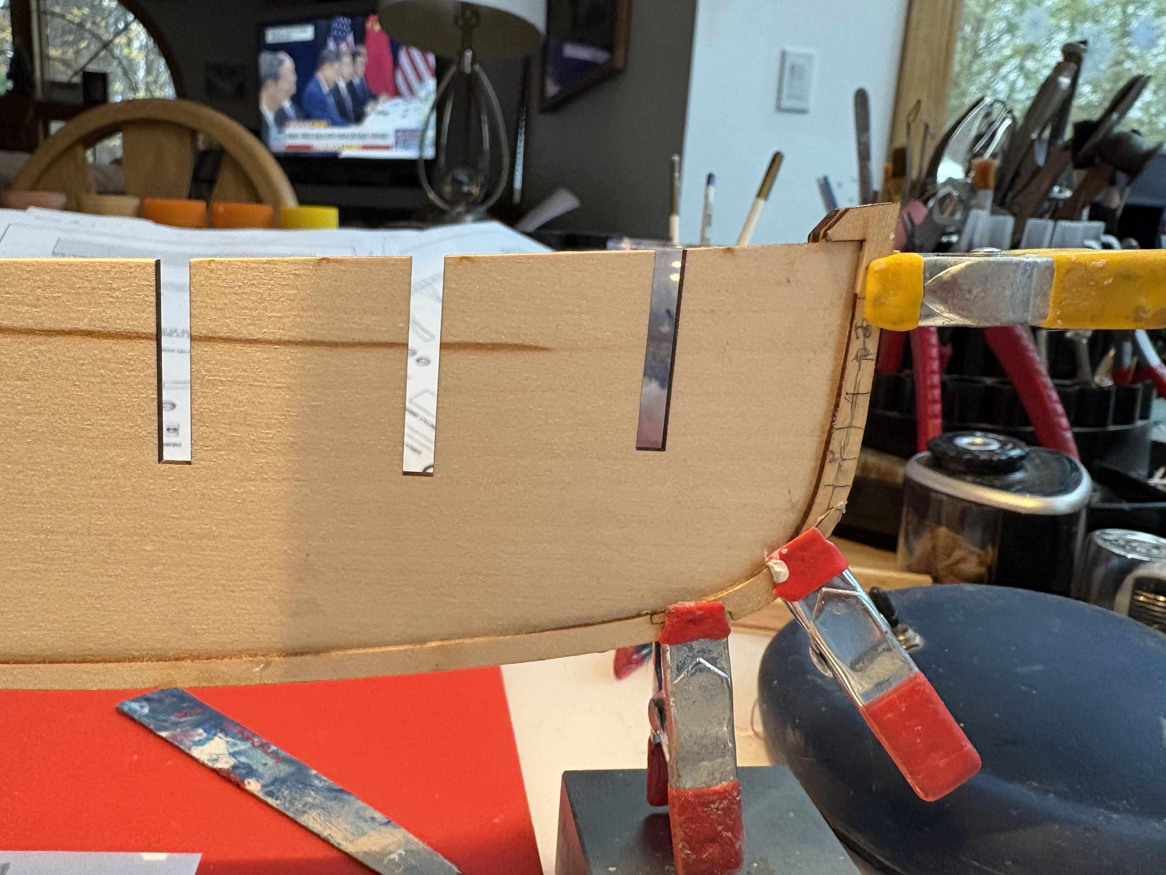

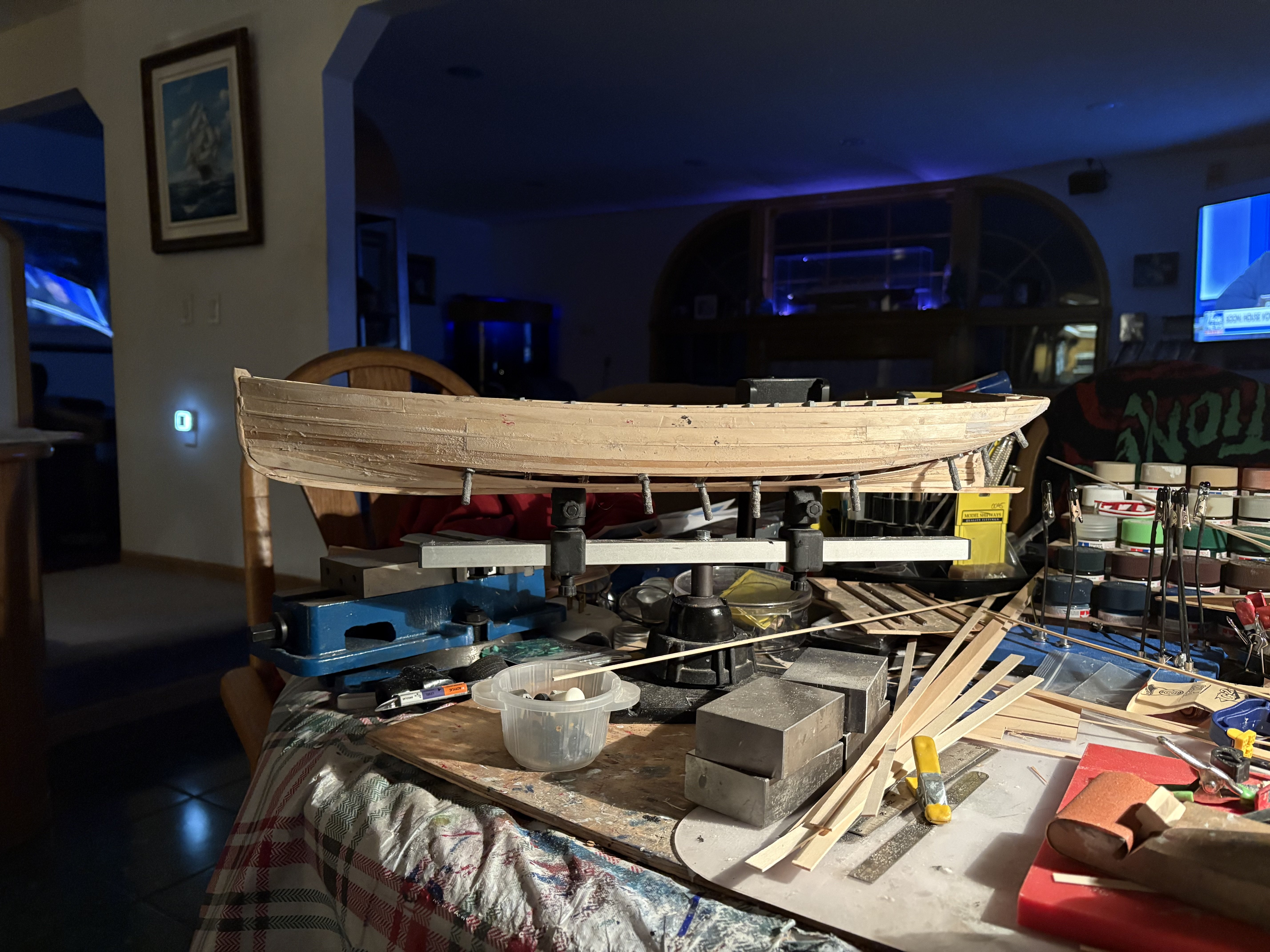

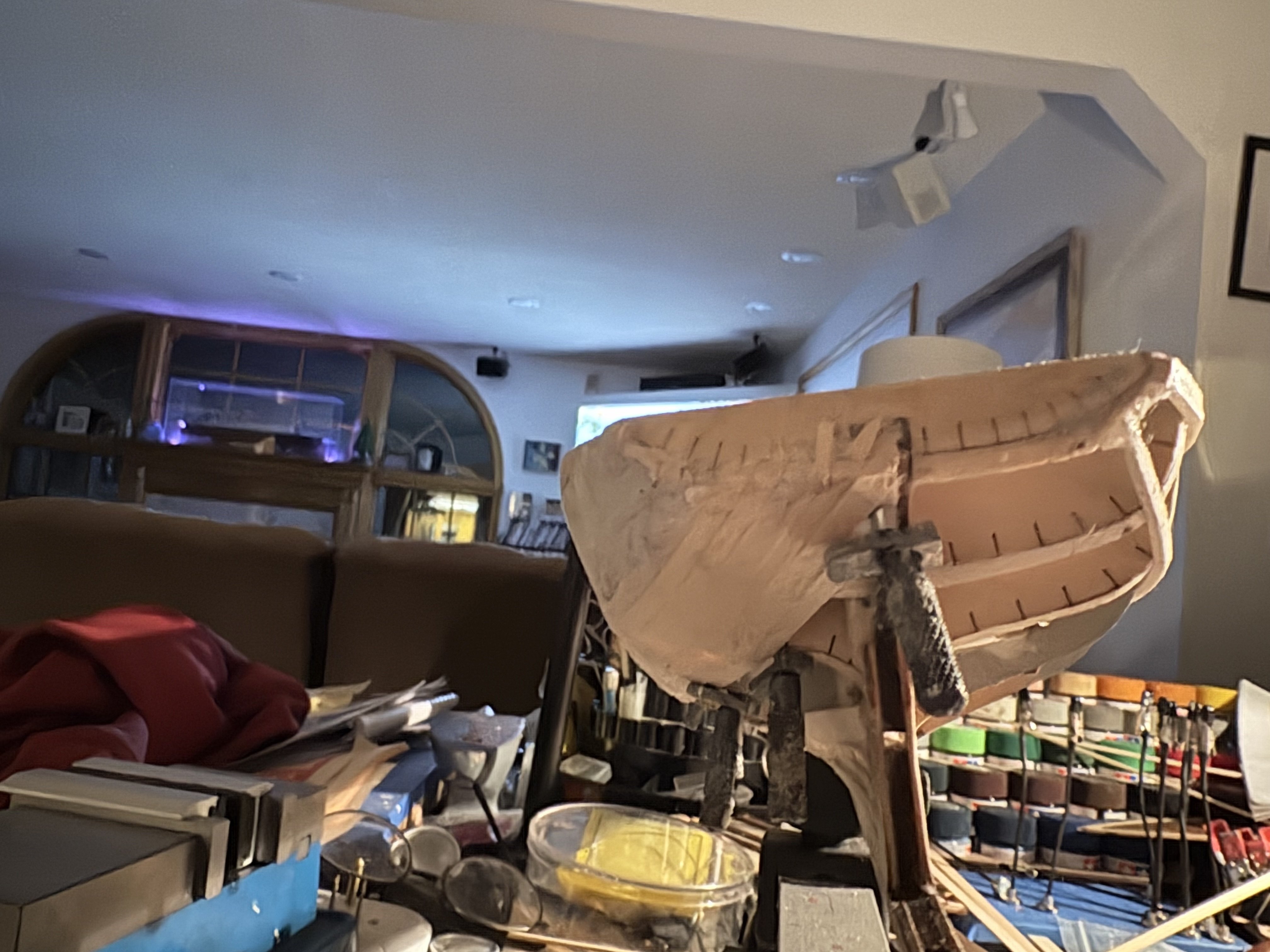

Got up this morning and decided to lay over in port. Next to where I was anchored locals were planking a boat in dry dock and they asked me if I wanted to  pitch in and help. Since I was here for the day I joined in. After a full day of hard work it’s time to turn in for the night and prepare to resume my adventure tomorrow.
