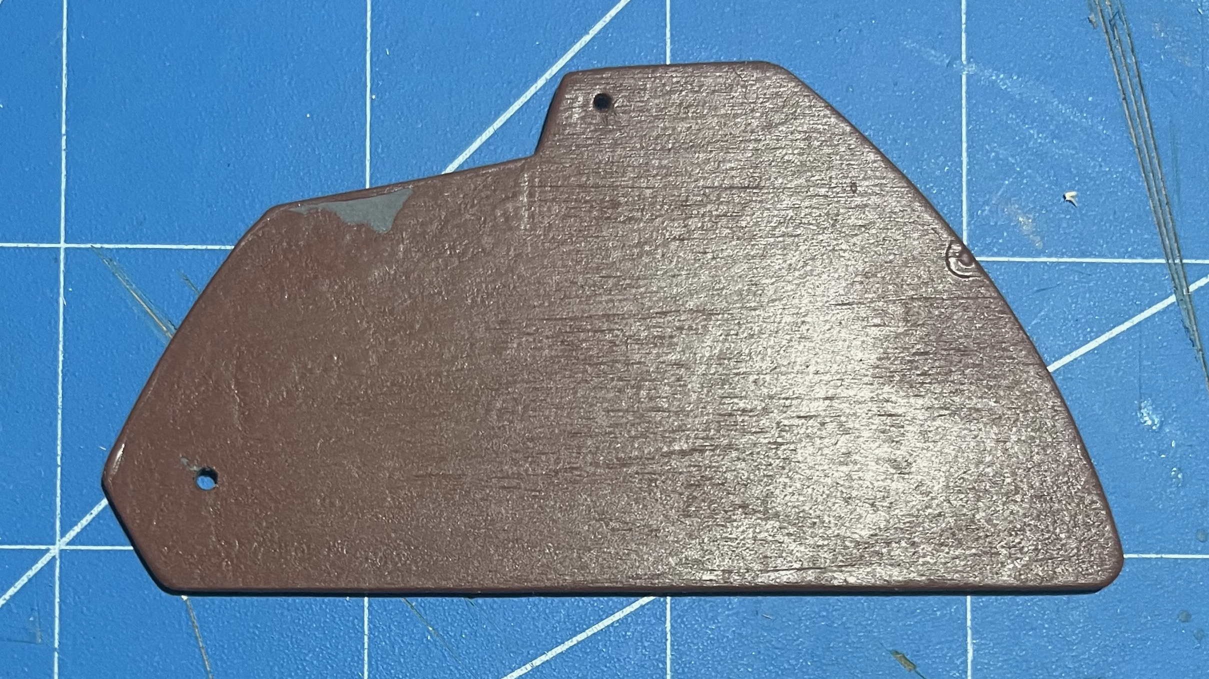

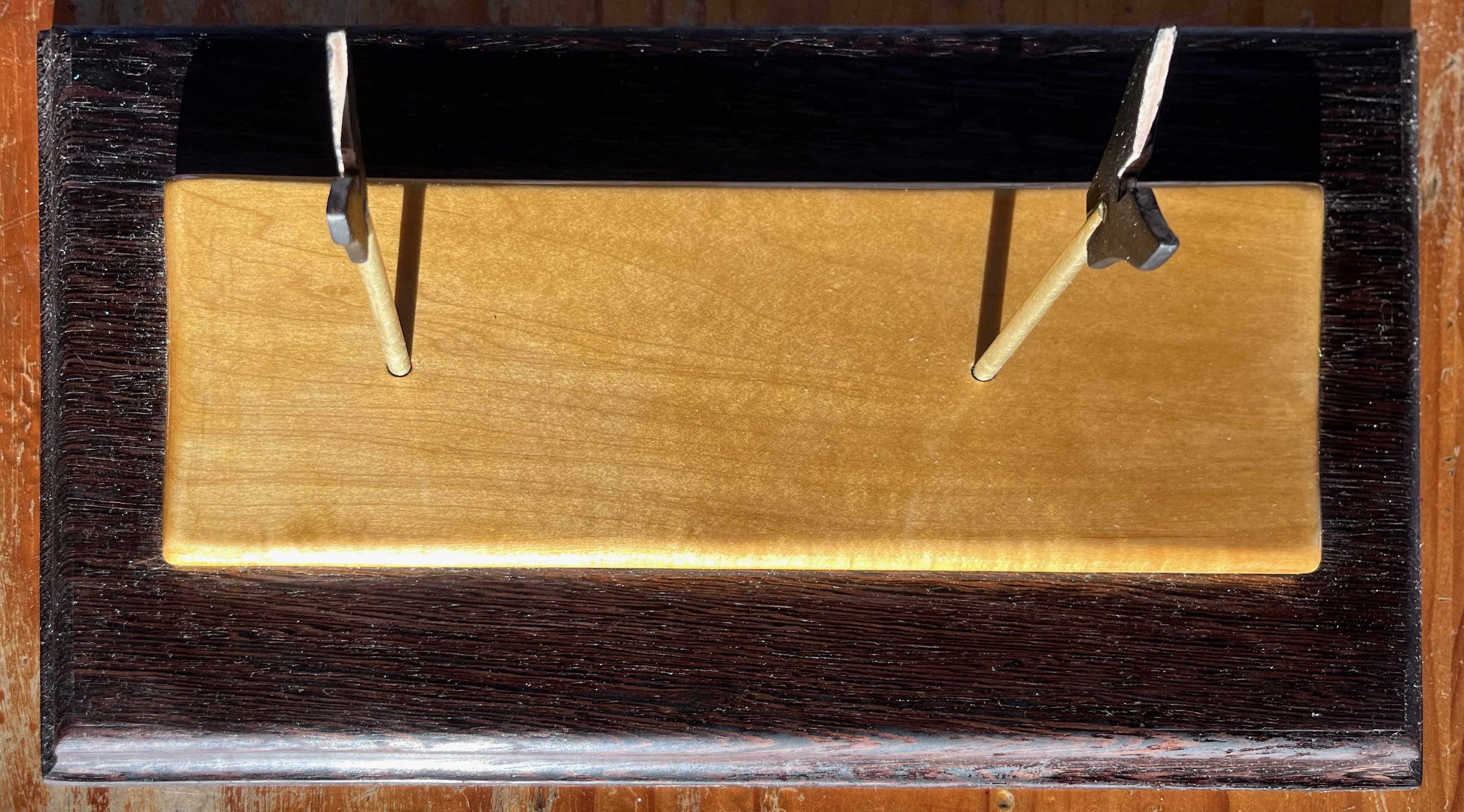

Step 0: Centreboard -- or, to use the authentic terminology of the men who built and used the prototype: "Centerboard".
Yesterday, it was time to escape all the words and start sanding basswood! In truth, the board needed no more than removal of char and gentle rounding off of corners. Then a spray of primer and two coats of paint. I used the kit-suppled ModelExpo "Hull Copper Red". Not the best quality, as others have found before me, and the final colour isn't quite as bright as I would like, though also not as bad as in this image:
I will try for something better when I get to painting the hull but the hard-to-reach parts of the board will be fine without another coat on top.

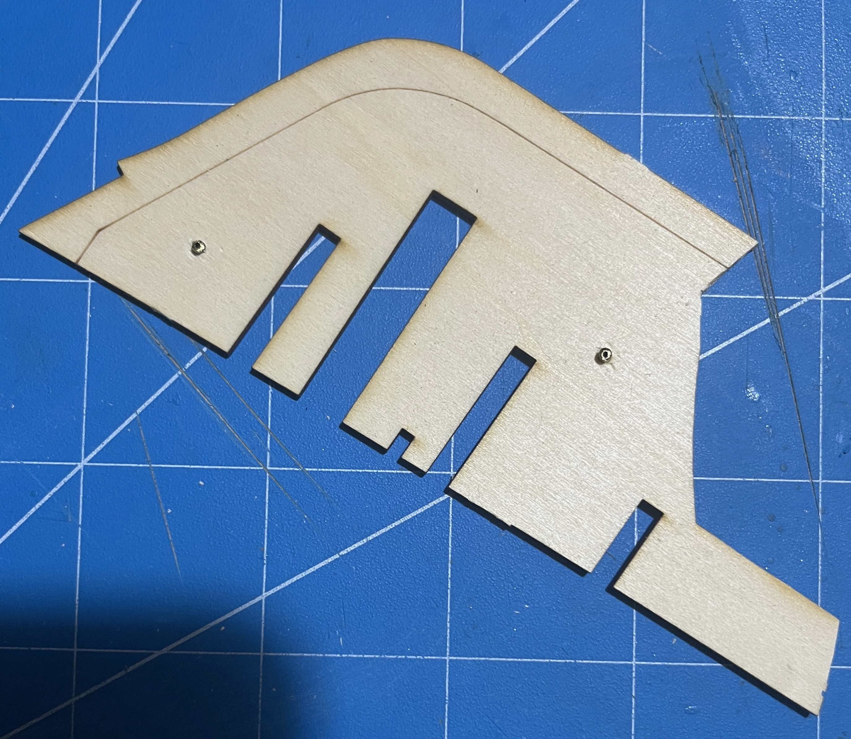

I wasn't expecting to have useful suggestions for this build but, here goes ...
As anyone who has built this kit is very much aware, the hull is built on a "spine" (what other kits too-often bizarrely call a "false keel") and it is a spine built up of three layers, to leave the centreboard trunk open between the outer two. Those outer layers are very thin, with many fragile tabs. Gluing the layers together means a whole lot of white glue but the water in that warps the thin layers, causing trouble from the start of the build. The kit instructions suggest using weight, rather than clamps, to hold the parts while the glue sets. But that brings another problem, at least for me: Before it sets, white glue lubricates. Putting a weight on top makes one layer slide over the other, while the weight hides the error from sight. Bad news when you lift the weight off and find non-aligned parts firmly held together!
The kit does come with spacers to help with alignment but they are thicker than the spine itself and so limit where weight can be placed. And I found that they made it hard to see whether the parts were truly aligned.

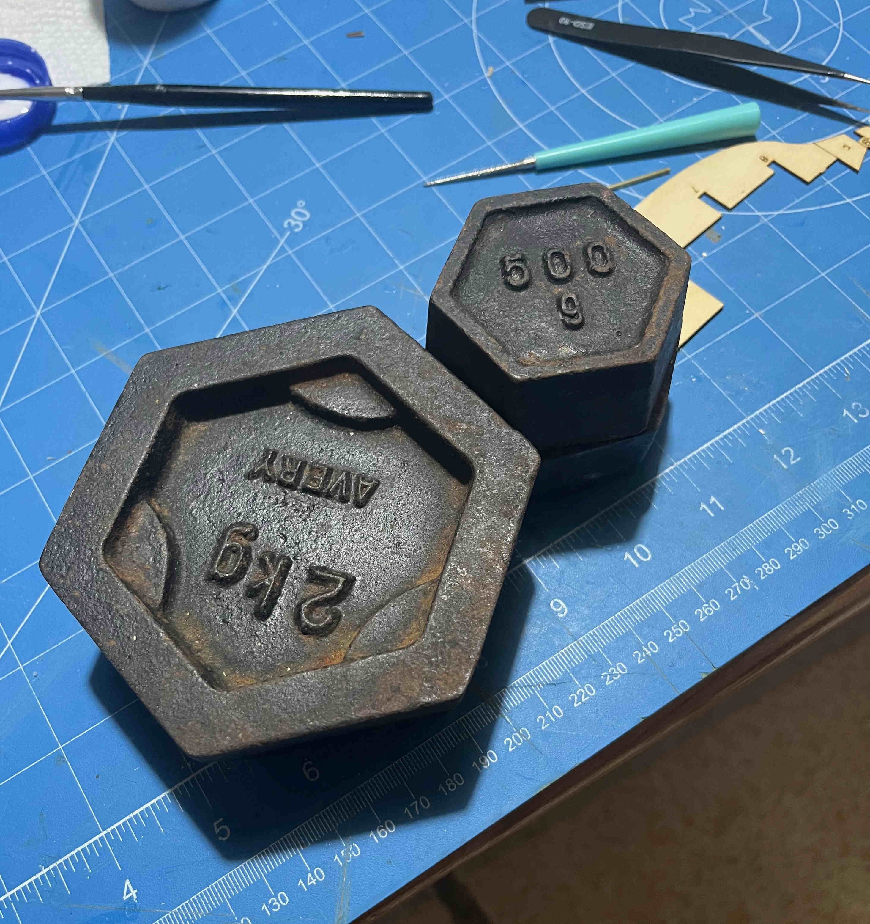

So I drilled two 1/16 holes in out-of-the-way parts of the (rather thicker) central part of the spine, carefully lined up one side piece and drilled that too. Then chopped off short lengths from left-over brass tube from the pram kit and inserted those in the holes of the central part -- though that took a bit of enlarging of the holes:
Add glue, push side piece over brass studs, add weight and:
Came out very closely aligned and very straight, so OK thus far. There's a second central piece of the spine to go abaft the centre plate trunk (and a third, little one abaft the sternpost). Have to see whether those work OK too.
And the fragile tabs? Only broken one so far. (I was focused on the end where I was working and ignored the rest: Bad mistake.) Fortunately, the broken bit will have one side glued to a central piece and the other spanned by a stiffening/reinforcing piece, so repair will be trivially easy.

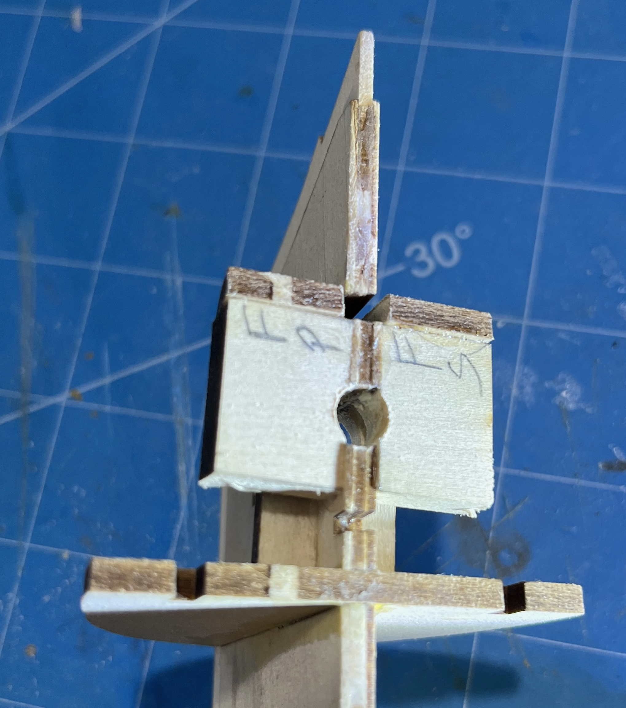

Step 1 continued:
Previous builds of this kit have run into another problem: There is a curved slot in each of the side pieces of the spine, in which the control rod for the centreboard is supposed to move. However, if the spine is assembled from the production-kit's parts but following David Antscherl's instructions, the rod does not line up with its slots. To solve that, past builders have cut away the after edge of the slot, at the cost of making already-fragile parts even weaker.
I dry-assembled the pieces, looked at the geometry and found a different solution: Simply move the centreboard pivot 3mm forwards from the laser-cut hole for its axle. That means drilling new 1/16 holes in each spine side-piece and trimming a bit off the forward central piece of the spine (trimming only from what will become the interior of the centreboard trunk, so exact cuts are not necessary). All that has to be done before assembling the spine but, once done, everything lines up nicely. The next problem, of course, is that a pair of close-set 1/16 holes in very thin basswood will break into one another. One of mine already has. I will fill the gap with epoxy and re-drill, which should fix the problem.
Another alternative that did not occur to me until too late, but someone might try, would be even easier, if the geometry works. (I haven't checked and now cannot.) That is: It might be possible to just drill an alternative hole in the centreboard for the control rod. Worth looking into anyway.

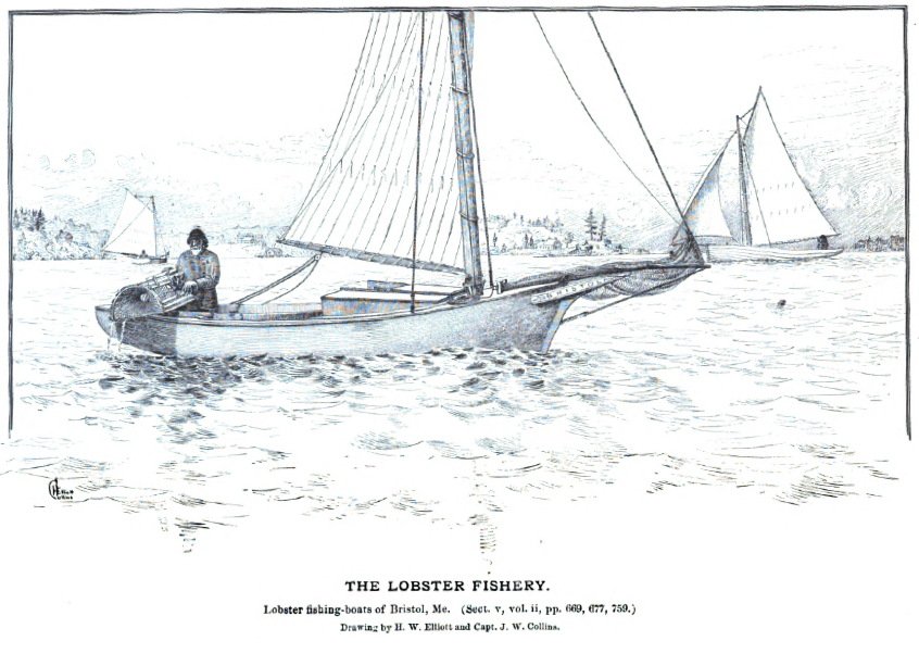

Goode's volumes included an accompanying plate (copyright of the US government, which grants free non-commercial use):
Again, that has much in common with the kit, plus some interesting details. (Note, for one, that the forestay and bobstay are continuous, passing around a sheave (probably a dumb sheave) in the bowsprit end and tensioned at the stem.)

The claim that there were no shrouds was in direct conflict with Goode's plate, though who was right and who wrong may be impossible to determine this long after.

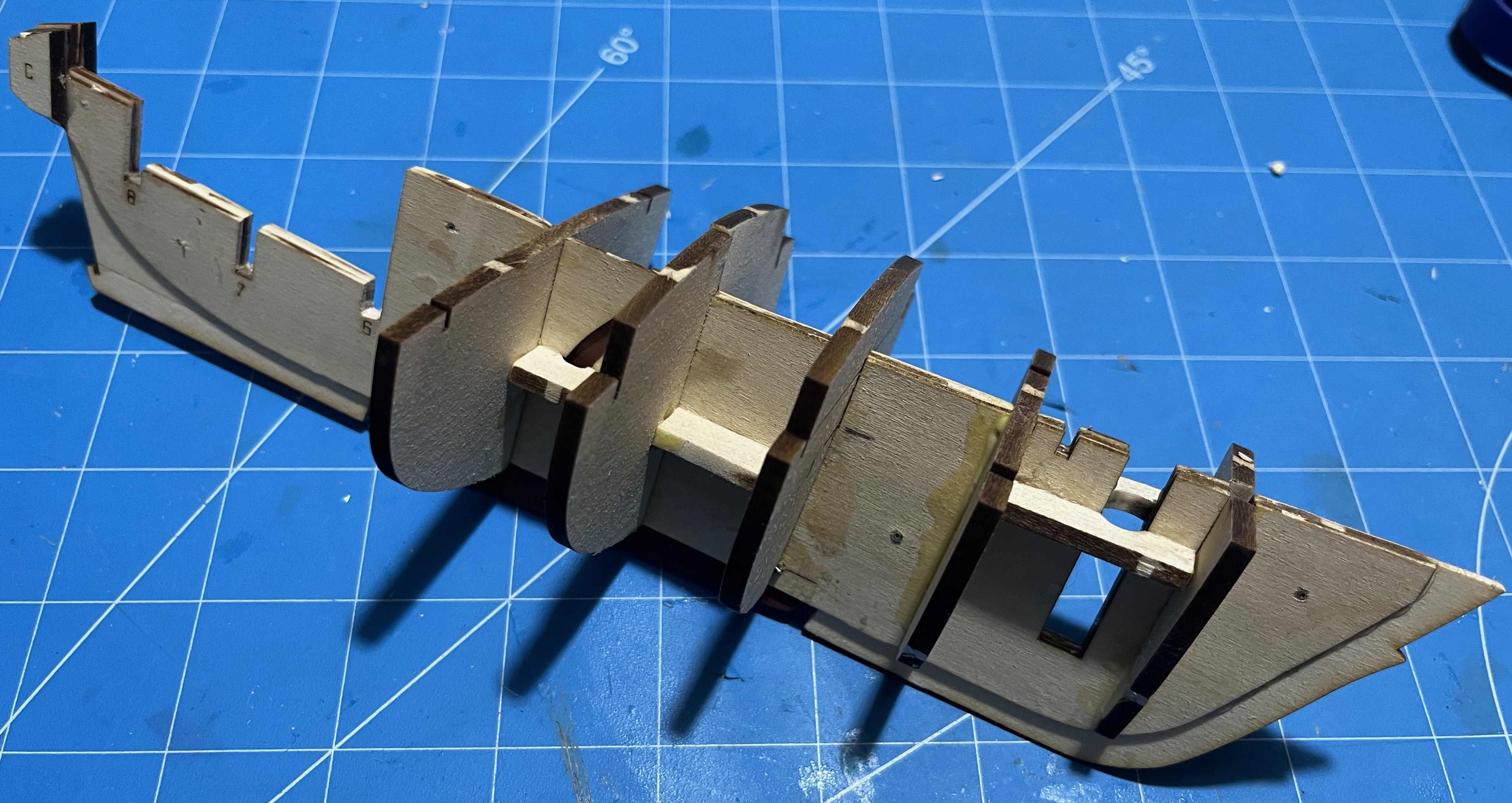

Steps 1 & 3: Construction of spine completed -- sort of
All three layers of the spine glued together (mostly) neatly, despite a total of five breaks. The problem isn't just that the two side pieces are very thin, with multiple narrow tabs. It is also that those tabs are crossed by laser-burnt marker lines and the laser very nearly cut right through. The slightest touch can complete the task and separate the end of a tab.
The reason that I have only "sort of" completed the steps is that two of the breaks were both just abaft the sternpost, where there is a gap between the (thicker) middle parts of the spine -- a gap that will, in time, take the rudder shaft. So my aftermost spine part is entirely separate from the rest. I will wait until the bulkheads are in place on both sections, so that I have something to grab onto, and then make a repair.
I have deviated from the instructions by not yet fastening the centreboard on its pivot. I did use it as a spacer while the glue dried under the weights but I have avoided accidentally gluing the moving part into place, while delaying the metalwork until daylight. Also let me clean up the char along each side of the centreboard slot, without the board in the way. Subsequent attachment of the board and its control rod should be straightforward.
Good news is that the three layers of the spine went together with good alignment (no more than about 0.1 mm out anywhere) and no warping at all.
For anyone wanting similar success when pressing kit parts together ...
Just get a couple of friendly hippos to stand on them 😀

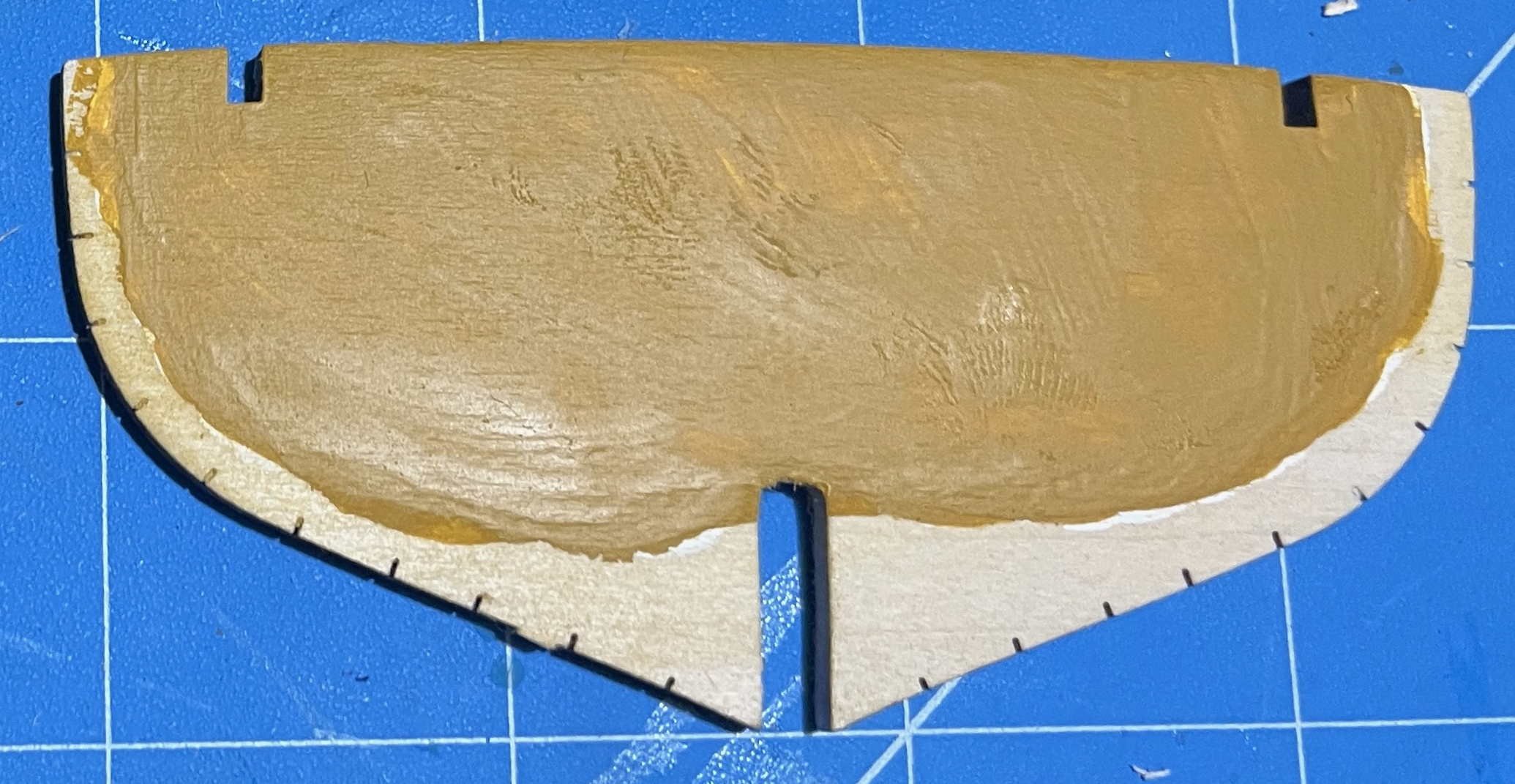

Step 2: Centreboard: Completed

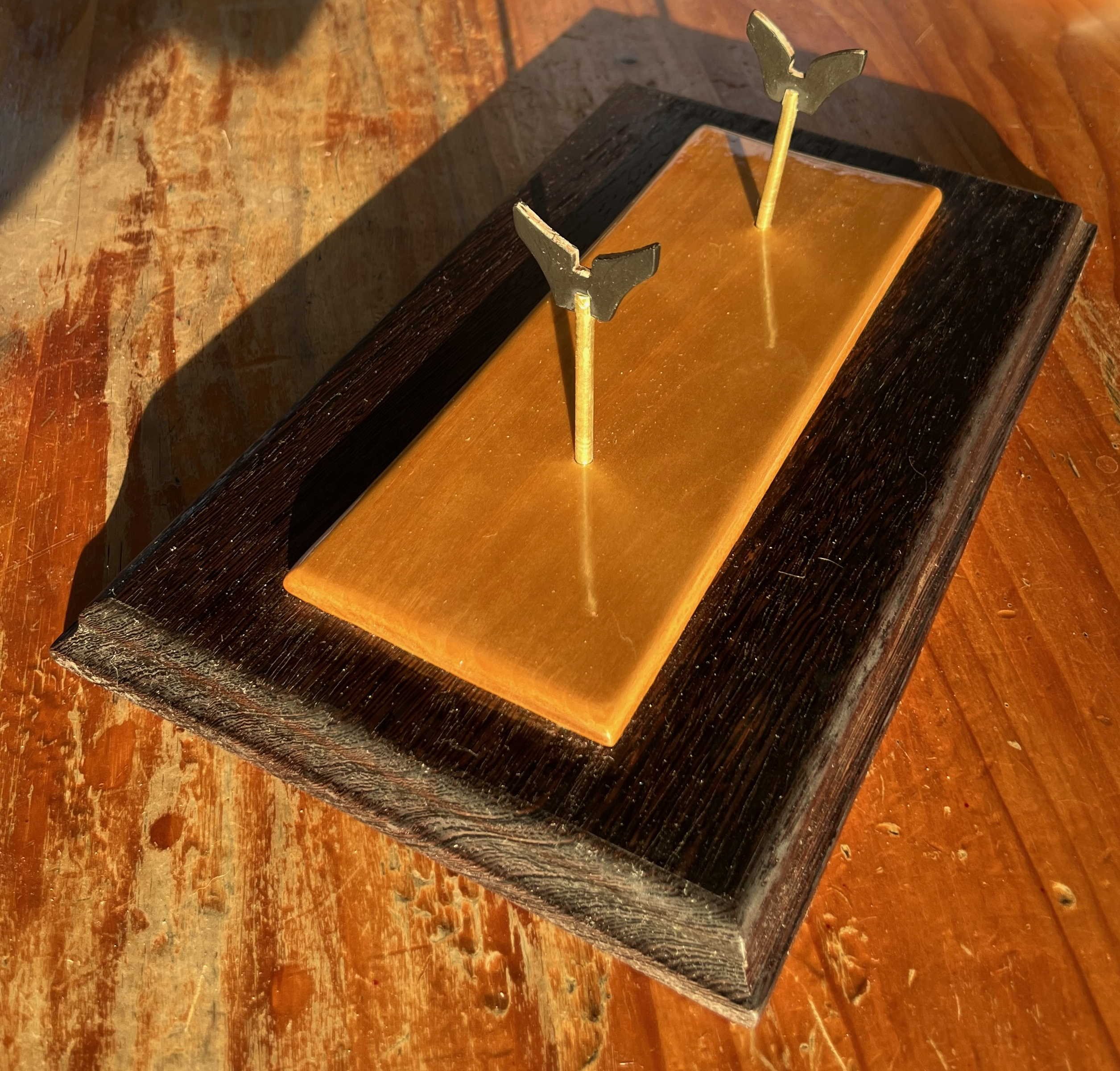

I had a fight to get a tiny piece of 1/16 brass rod into place as the pivot for the board, gooped some epoxy over the ends to hold it in place, laid the spine down and the ***!!!!## piece fell out under gravity alone! So I shoved the whole length of kit-supplied 1/16 through, added epoxy to one end, then clipped off most of the rod with shears. That worked.
Control rod shaped up nicely and easily. I painted as much as might be visible in black, rather than have shiny brass on a fishing boat. Looked nice for a while until the paint started chipping off. I dare say it will be fine after a touch-up. Still have the wooden handle to add but the instructions say "later" -- presumably meaning after the deck is in place.

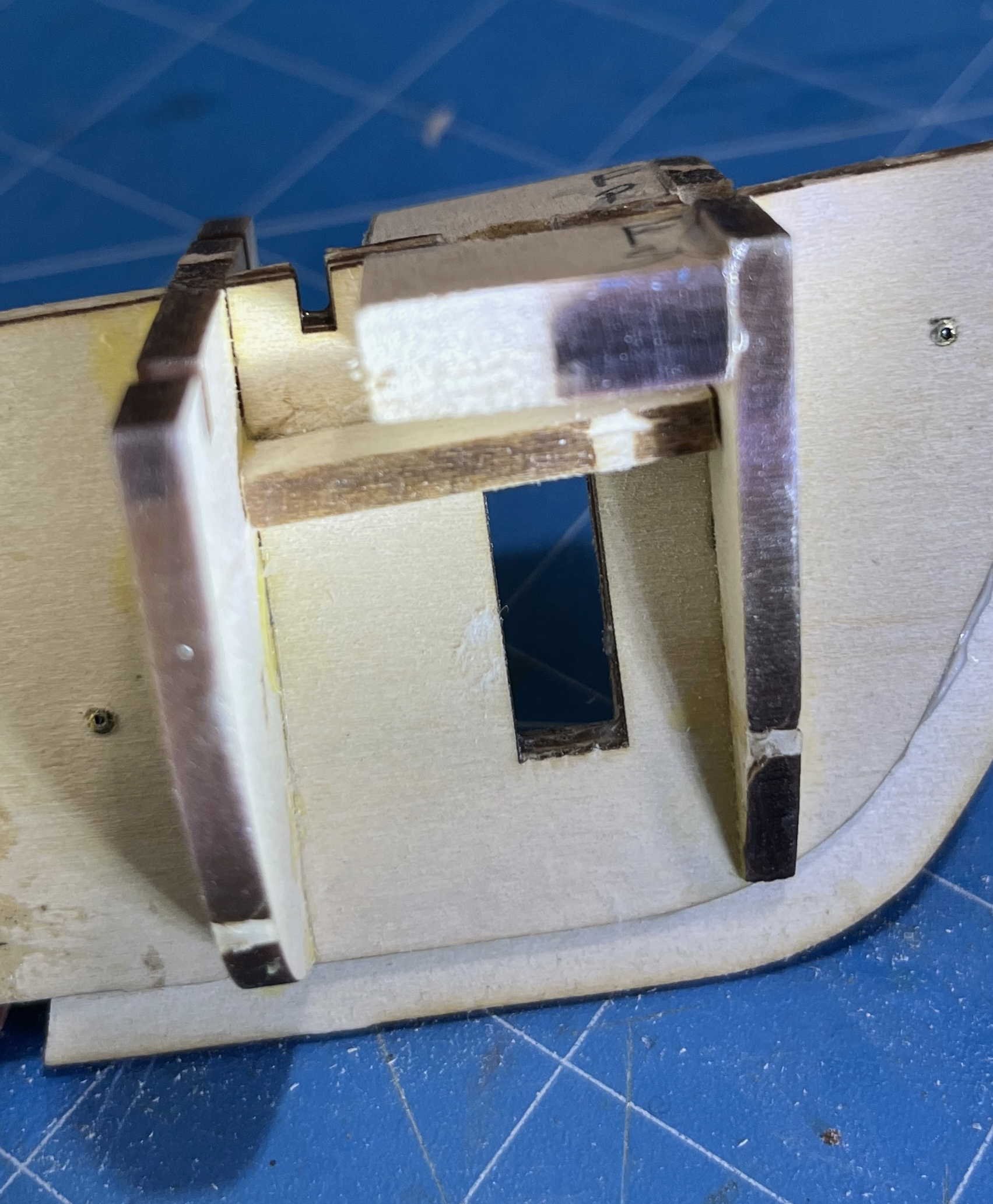

Step 4: Reinforcing pieces: Completed but badly
There's no warning in the instructions that the reinforcing abreast of the centreboard trunk may obstruct the movement of the board's control rod. Mine did and I had to gouge grooves before gluing, then widen the grooves after.
My bigger problem is that I can't see the laster-marked position lines once glue starts oozing out of the joint. For most of these pieces, a little bit of displacement hardly matters but I'm going to have to do some surgery to get Frame 4 to fit. Still, that shouldn't be a problem.
Feels strange to be assembling the various parts without a care in the world, knowing that everything can be sanded or shimmed as necessary, then hidden later. With the dory and the pram, precision in the initial structure was critical and yet every piece is visible in the finished model.

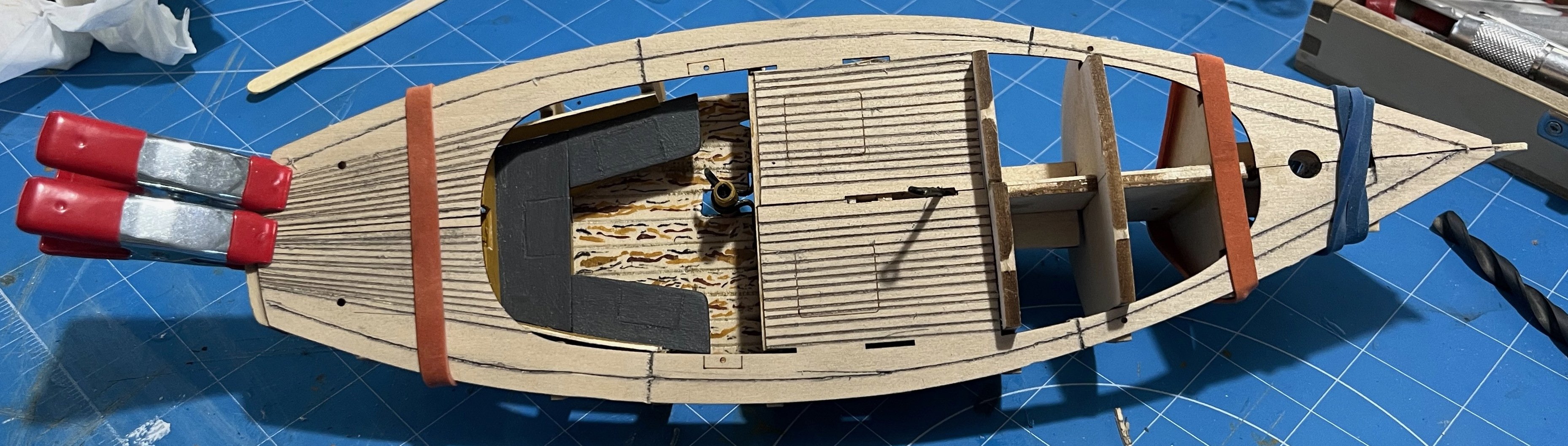

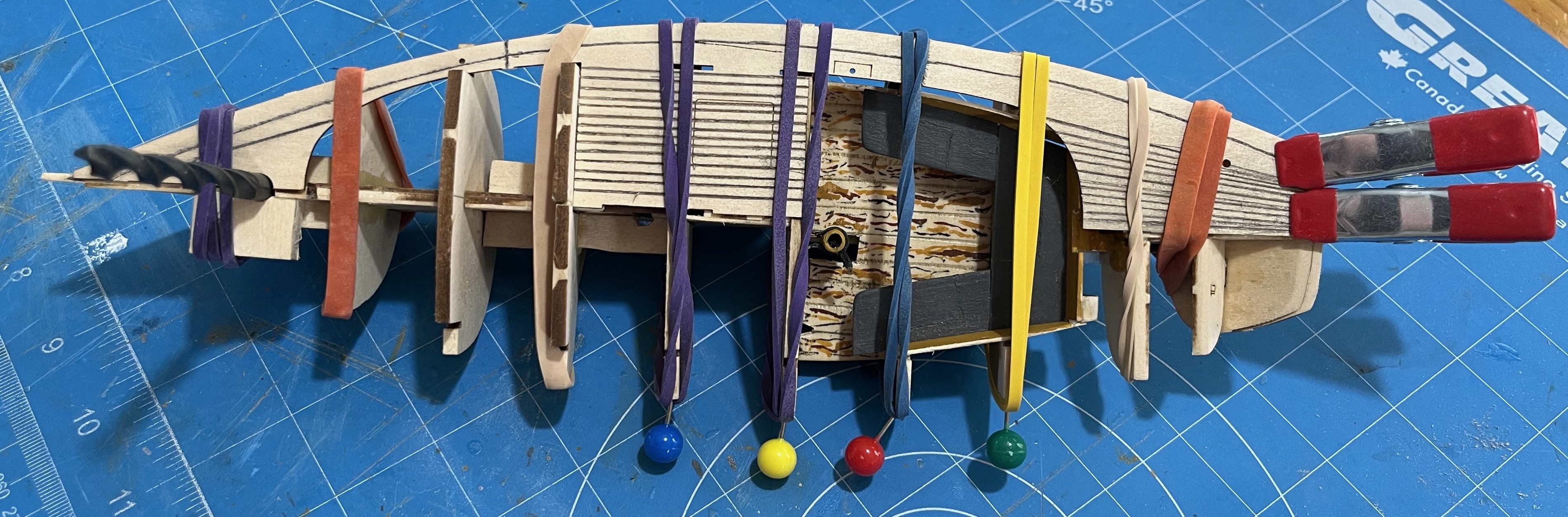

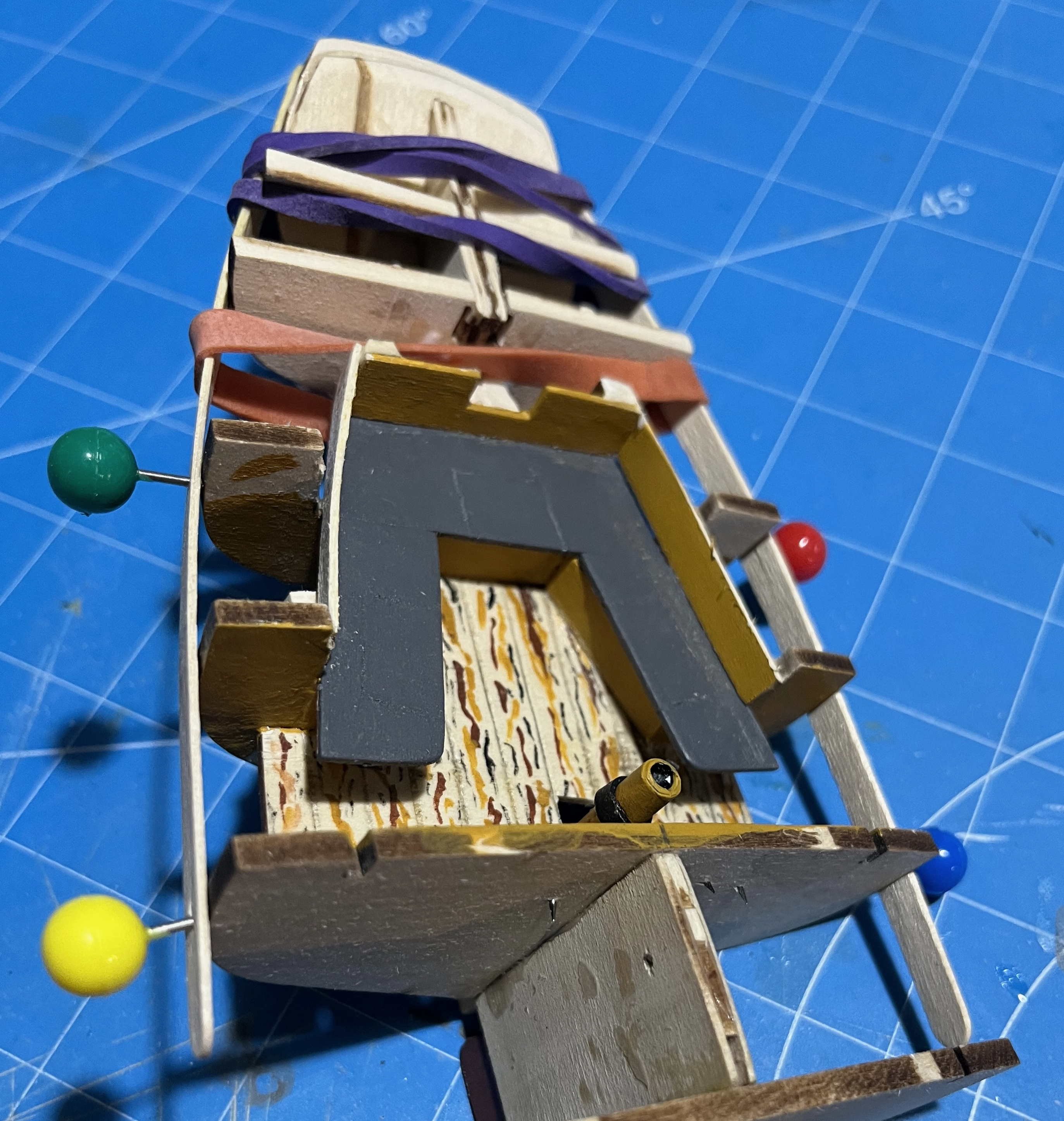

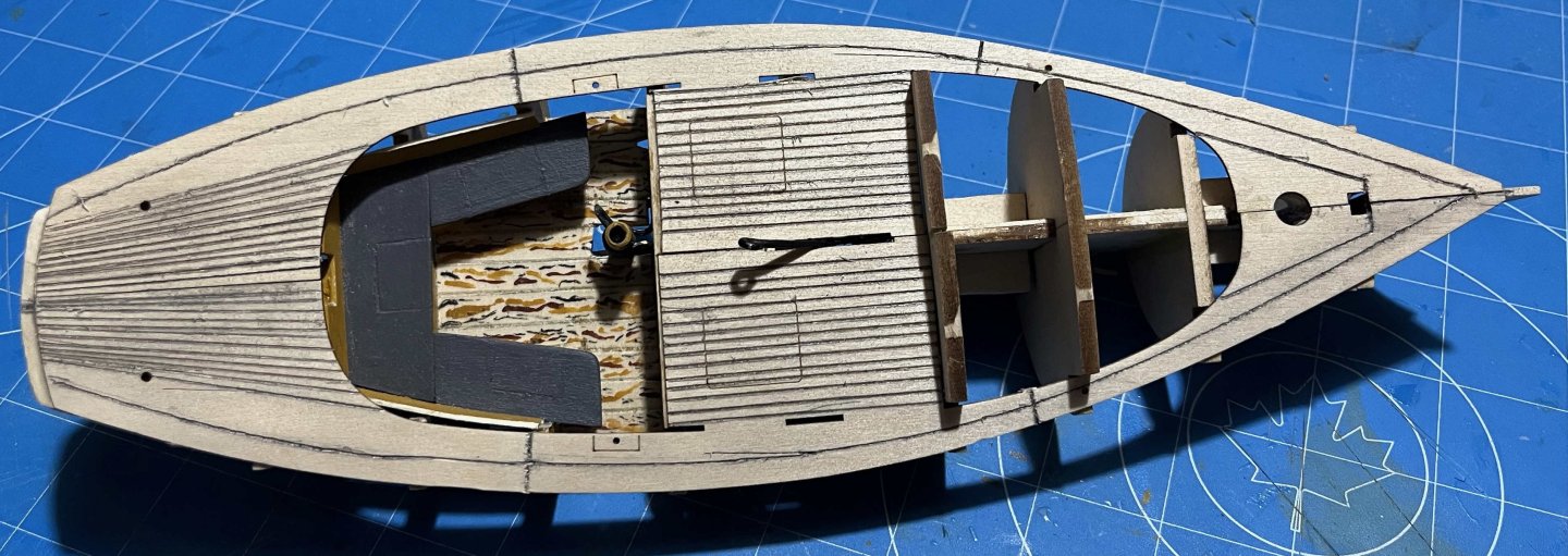

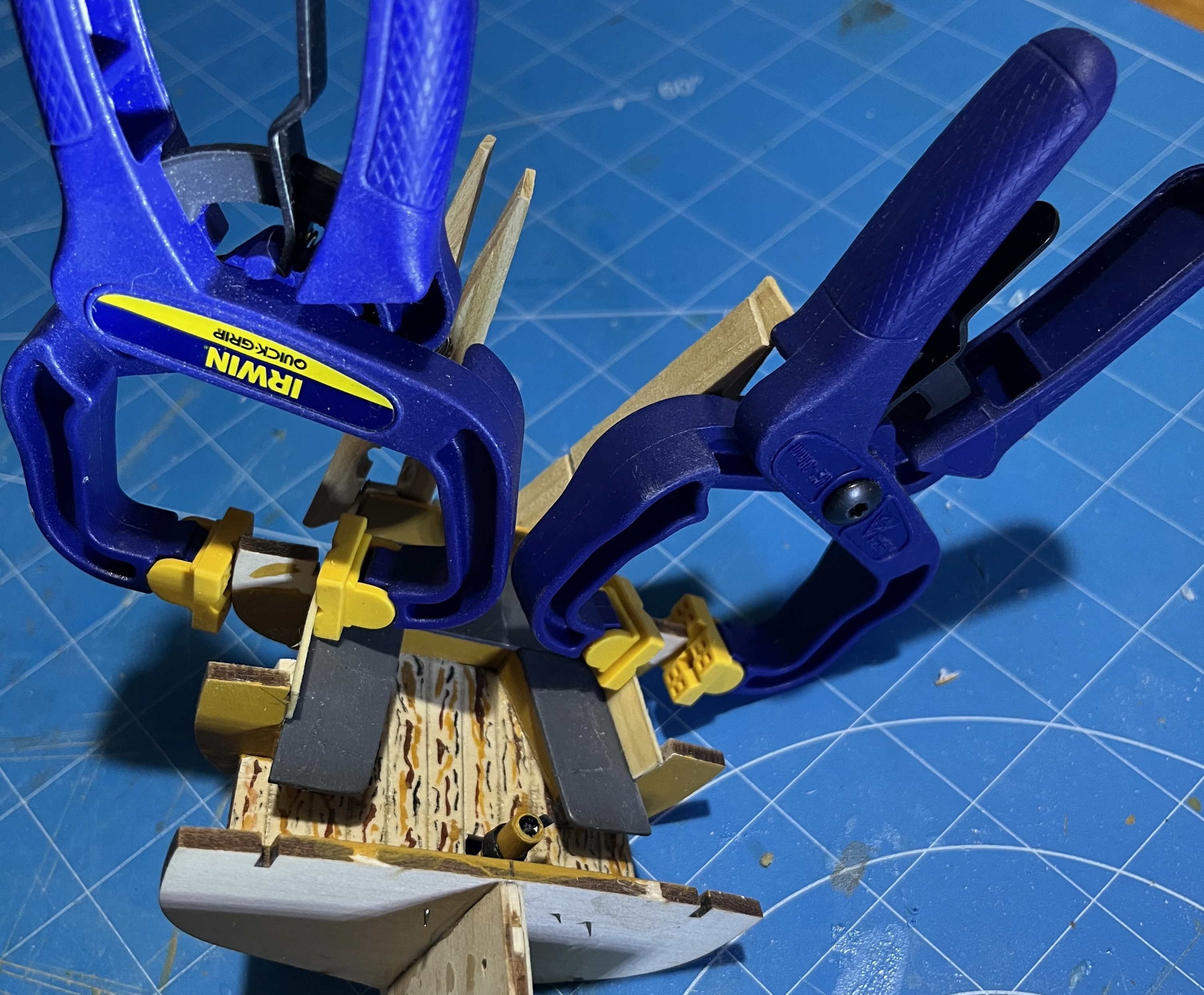

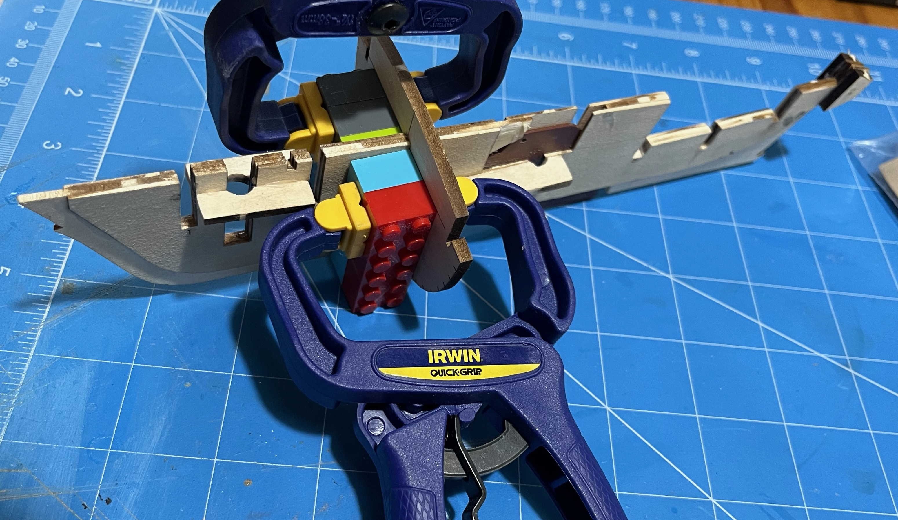

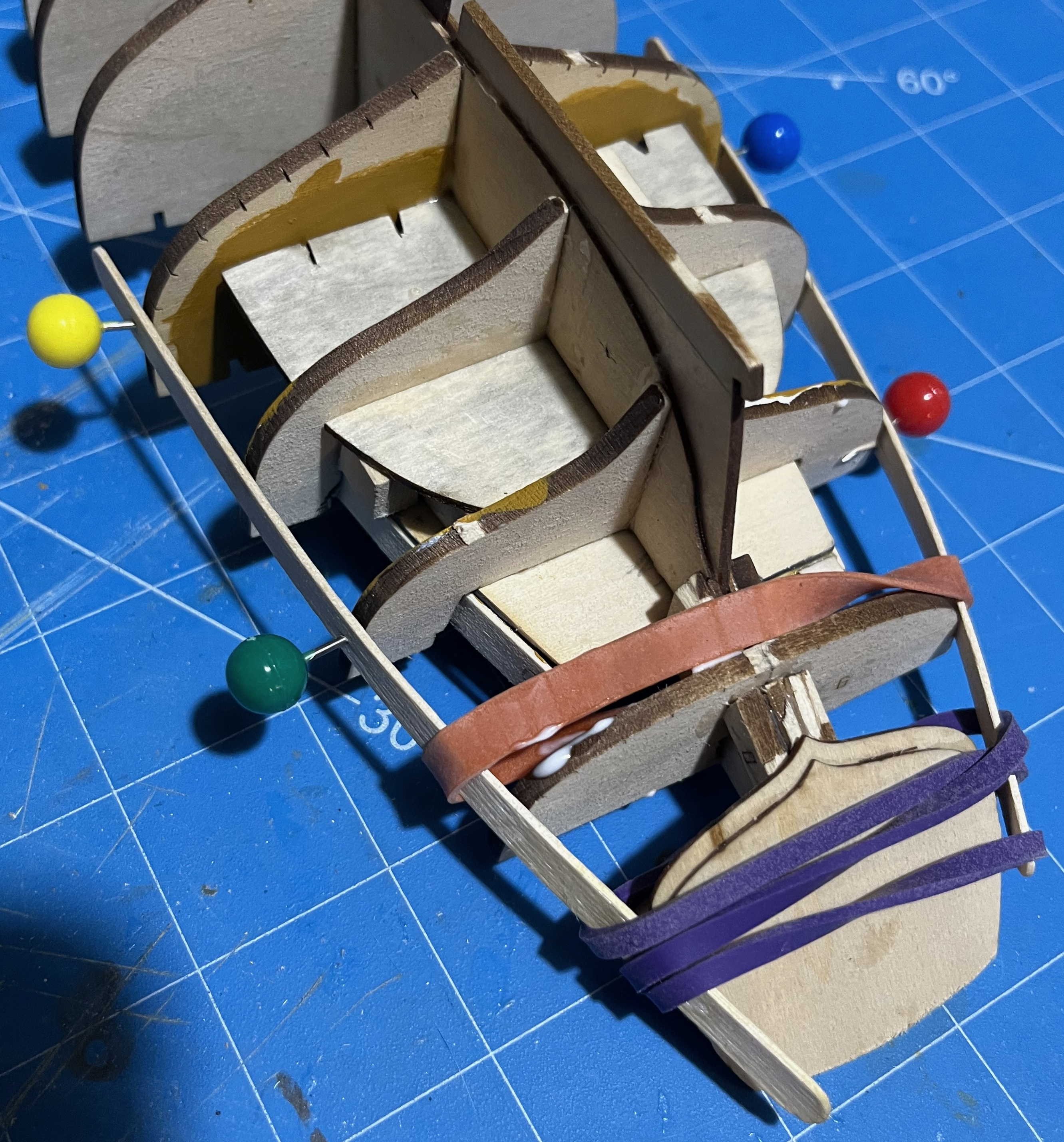

After a week with only stolen moments for model building, I have had most of a rainy Sunday with the sloop-to-be.
The odd moments had been enough to strike centrelines across each bulkhead, free it from its sheet, flip it over and reinsert into the sheet to check symmetry. No problems there at all.
Fitting bulkheads to spine has been more challenging. Before removing charr, they were all much too tight to go into place. Once the charr was off, most were a little too mobile. Meanwhile, the irregularities in my fitting of reinforcing pieces to the spine meant that each bulkhead needed individual fitting. No big problems, though.
The instructions recommend fitting bulkhead 4 first. That, however, is in two halves to make space for the centreboard, so I decided to begin gluing with #3 to get something more solid to establish perpendiculars and have a reference to take check measurements from for the other bulkheads. There are three dimensions, of course. The vertical fit is mostly easy, as all but two bulkheads should be flush with the top of the spine. The exceptions are #3 and #4, which rise up to support the cuddy's coachroof. #4 has steps where the halves close over the spine but #3 needed aligning. I dry-fit #1 and #2, then checked the heights of the outer ends of the three bulkheads, where they will support the deck edge, and adjusted #3 until the alignment was within the range to perfect by sanding.
To get the other two dimensions perpendicular, I marked a horizontal line across the bulkhead and clamped on trusty Lego blocks, aligned so as to keep everything tight and square. Then lifted the combination off, applied glue, replaced it  and it just needed finger pressure until the glue began to bite:
The other bulkheads needed varied fiddling, with the Lego arranged as and when needed -- #1 going into place with fingers only. That's got me to:

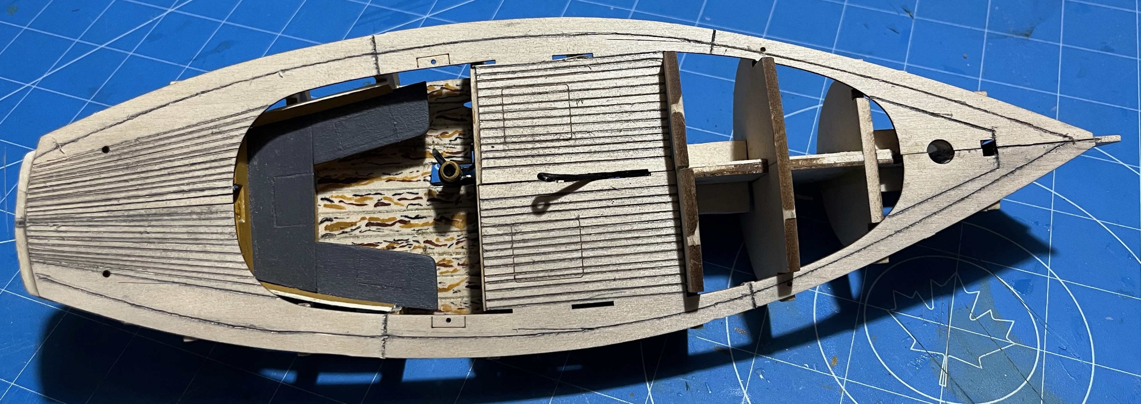

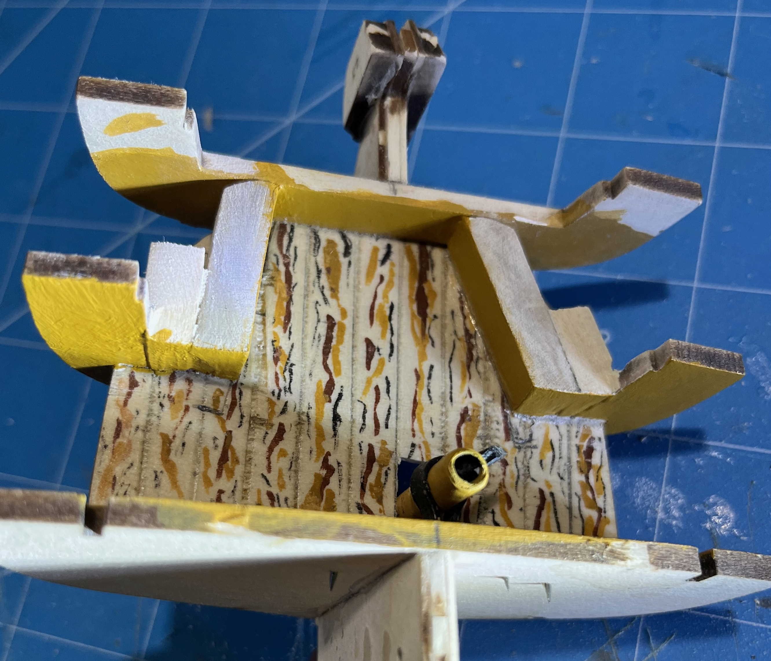

While waiting on glue to harden up, I started preparations for the cockpit and its detailing. Bulkhead 6 forms the forward edge and (unlike anything yet in the model, aside from  the centreboard) it will be visible when all is finished. Hence, I am trying to paint it before attaching to the spine. Chosen colour is yellow ochre, that being an available and affordable option for a lobster fisherman circa 1890. Unfortunately, even when primed, a first coat well sanded and the second with the paint thinned, artist's acrylic still shows the brush strokes:
Further trials needed!

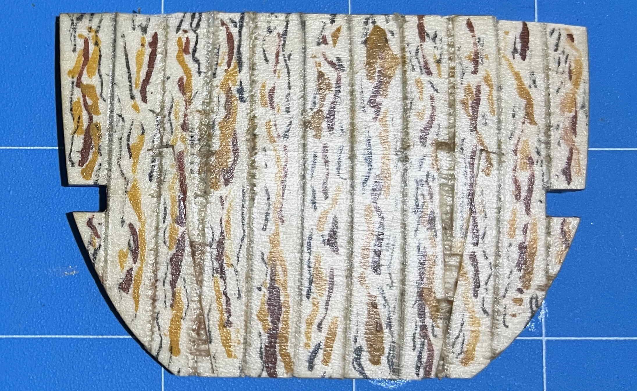

The kit's cockpit "floor" would be OK if painted in an opaque finish, but that would not be realistic. In a clear finish, past build logs show that it looks as though made of marine ply -- again, not realistic. Tracing plank "edges" across the surface doesn't fix the problems as the grain of the underlying basswood runs athwartships. My solution began by scribing "gaps" between "boards" (1/4 inch wide, or 6" full-size: Narrower would have been better but more work.) Ideally, I would have cut right through and set the "boards" apart from one another but I didn't fancy getting caught on the extra complications. To hide the reality that the grain of the wood runs the other way, I doodled in some new "grain", using two colours of acrylic (intended for leather, hence suited to absorbent material) and thin lines of India ink, then topped everything off with two coats of ModelExpo clear finish. The result is ugly to look at and I should have been less enthusiastic with the "grain". However, once the cockpit is finished, this version may pass for bare spruce boards with the resin still oozing out:
At least nobody will mistake it for a sheet of marine ply!

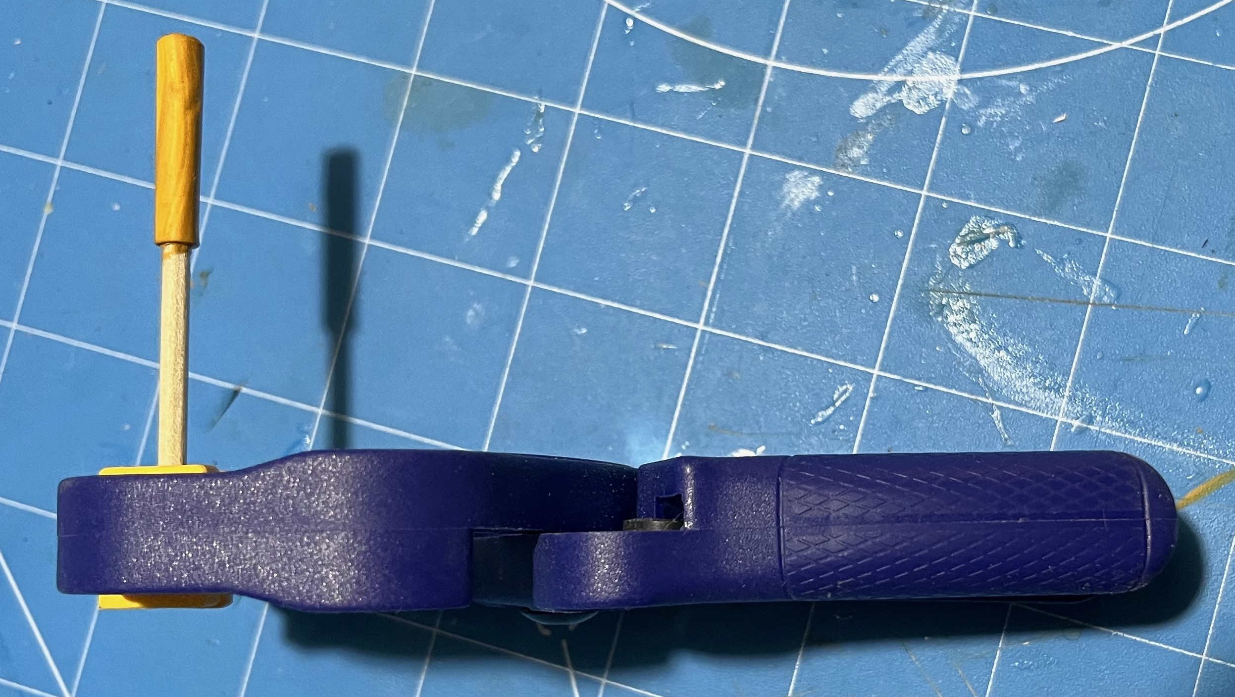

I have also started building an elm-tree pump to go in the cockpit beside the forward bulkhead.  It is a short piece of 1/16 dowel, with heavy printer paper soaked in white glue and wrapped around, then given a coat of yellow ochre to match the rest of the cockpit furniture:
The paper extends beyond the dowel and the hollow interior will become black. It will still need a handle and a spout, while I will need a pail for the water to pour into. (I decided against a much taller pump that would have discharged over the cockpit coaming.)
And that's it for today!

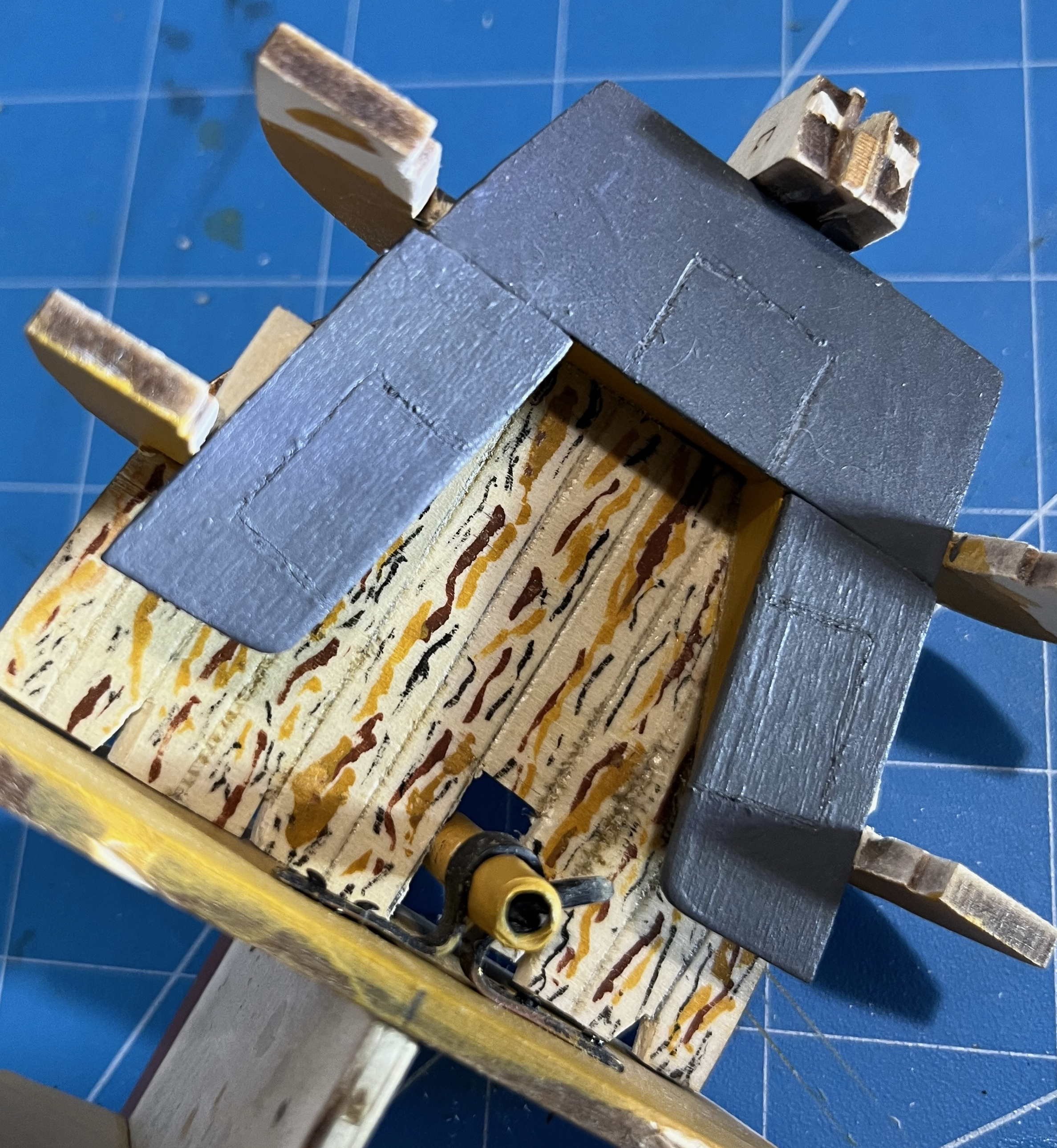

I've been back to just stolen moments for working on the smack, but that delay has given me a chance to figure out how to make artists' acrylic work for me. So I have finally got an acceptable yellow-ochre finish on bulkhead #6 and added that to the developing hull. For good measure, I worked on until I had the bilge pump installed too. So now I have:
Bilgepump1.thumb.jpg.eef2e439ef4e98cea4995f8435f5f2f3.jpgBilgepump2.thumb.jpg.2362bfe06f6e28c21eeb556ba01ec7a5.jpg
Aside from things fully sealed and solid, like paddleboards, and maybe some with a self-draining cockpit (think Laser dinghy), every watercraft needs a way to get water out of the bilges. Doubly so for planked wooden boats and ships (which always leak a bit) and triply if they are open above and so take in rain and spray too. Aboard dory or pram, you could reach to the bottom planks and use a bailer or even a sponge, but the shape of the Muscongus Bay sloop requires some kind of pump. As she is operated single-handed when lobstering, the pump really should be accessible from the cockpit, so that the lone sailor can reach it without leaving the helm for more than a moment. Since she has beach-stone ballast, there must be some kind of pump well, to separate pump from rocks. That much is certain but is out of sight and can be ignored when model building.
The pump has to reach deep into the hull, lest there be a lot of water deeper still that cannot be reached and removed, so the pump needs to be at the forward end of the cockpit, not further aft. It could be set forward of bulkhead 6 but that would mean a more-complex pump well, merged into the deck planking at its top. I've opted for the simplicity of putting the pump in the cockpit itself.
The big question is what sort of pump would be fitted into the well. By 1890, there may have been patent diaphragm pumps suited to a lobster sloop and certainly there were lift pumps with iron workings and pump-brake handles. But the cheapest, simplest, most familiar and perhaps most reliable option was an elm-tree pump, so that is what I have gone for. Such a pump lifts water but does not generate pressure. The discharge can only flow out under gravity. At first, I thought of making the pump tall enough that it could have a dale above the level of the cockpit coaming. That, however, would have to rise very high, so I have opted for a more-modest pump, discharging into a bucket that would then need to be emptied overside. I have assumed a pump well beneath the cockpit floorboards, then provided an "iron" loop bolted to the bulkhead, through which the pump could be lowered into its well -- or lifted out for maintenance, when needed for pumping out the live-wells etc.
In model terms, the loop is annealed and bent brass, painted black. With a household nail as a centre punch and one of the bits supplied with the kit, I drilled for four nails. Those I drove with an Amati nailer -- which proved very easy after the first couple of attempts. I'm happy with it, except that shorter legs on either side would have been better. The pump body is printer paper soaked in white glue and wrapped around a dowel core. The spout is a fragment of a cocktail stick, glued into  drilled hole. I shaped up a chock to hold the lower end in place, out of sight under the floorboards.
When I add the assorted gear in the cockpit, I will complete the pump with its handle. And put a bucket under the spout.

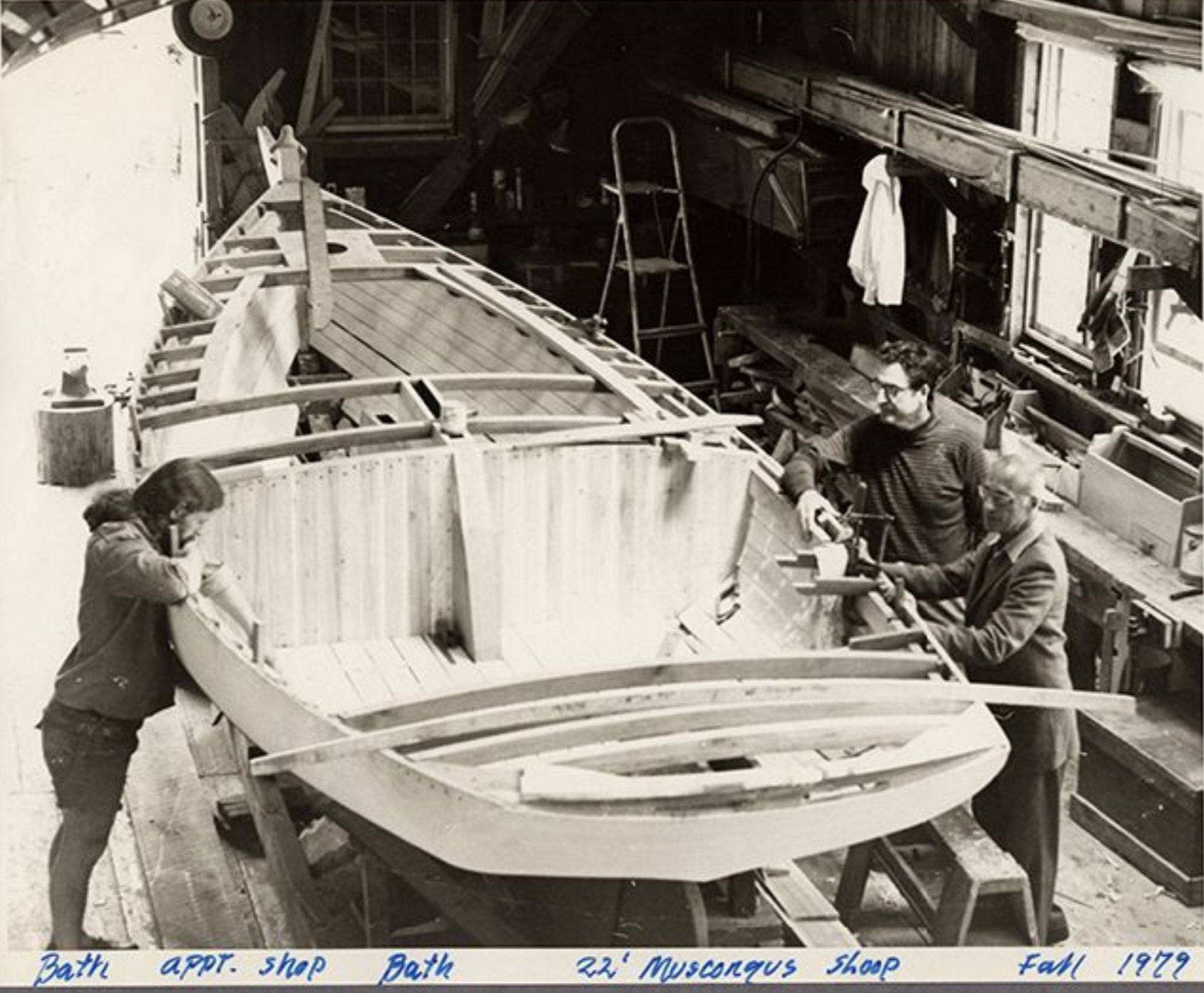

Very nice work, the bilge pump is a great detail to include! (And one that I might steal for my own build, with due credit in the build log of course). I had been wondering about the pump myself but didn't see anything about it in any of my sources, but using the Friendship Sloop plans instead to find it is a great idea.
I notice that the Friendship Sloop seems to have the pump a bit further back in the cockpit. Looking around in photos, though, I noticed a detail I had previously missed. In the photo below of the centerboard sloop Charity, which was built in the 1970s reconstructed from Chapelle's plans, there seems to be something protruding from the floor planking--a hole with something sticking out of it?--just off the bulkhead to the port side of the centerboard case (which, unlike on the model, projects a bit into the cockpit). I would guess that that's the space for the pump, although I don't know if they went for a more modern type in the reconstruction. In any case, it's right where you added your pump.
Source: Penobscot Marine Museum digitized photo collection.
Thank you for that, JC! Nice to see that practical experience supports my deduction. (Though the fate of the 1970s reproductions isn't exactly encouraging.)
I'm not surprised that Chapelle put the pump further aft in his Friendship. With more drag to the keel and lines more suited to sail (and less those of a rowing boat), the Friendship has the deepest point in her bilges nearer to the sternpost than the centreboard boats did. The best place for the pump is not literally the deepest point in the hull but the deepest that gives enough width between keelson and outer planking to fit the bottom end of the pump into. Also, for a simple elm-tree pump, the lower end has to be almost vertically under the upper, while the upper has to be where a man can work it, without it being in the way when doing things other than pumping.

Steps 1 to 6 completed: All bulkheads, transom and cockpit floorboards fastened to central spine
I did take a photo to prove it but my computer won't admit that that image is on my phone and I'm not about to take another.
The bulkheads all went on with little trouble and some with no problems at all, just a lot of careful checking for squareness, along with judicious use of Lego blocks. The only real difficulty was squaring up #9, which goes right by the break in the spine. (And I won't try fixing that break until I have finished the fiddly work in the cockpit.)
The floorboards would have been easy if not for having to make a cut-out to fit around the pump. By sheer luck, that only involved one of the scribed "boards", though I initially cut two and had to make a repair. The one cut had to be much longer than I wanted before I could work the boards in around the bulkheads. Still, I'm sure all will look OK when everything is finished (with a jib sheet loose on the boards in that area and distracting the eye from the hole, quite likely).
Next up is cockpit seats and trim, then attach the part abaft the rudder stock -- and then the great adventure of adding the deck!

Today, I decided to skip forward a bit and prepare the sloop's deck.
Plank decks leak. There's really no way around that. Back when yachts were made of real wood, not popped out of moulds, amateur sailors didn't much like drips of water on their bunks and often covered their decks in canvas. I never got to do that job and I don't recall the details. I think waterproof canvas was stretched over the deck and bedded down into a mastic of some kind. Certainly, the canvas was then painted -- painted in whatever colour the owner wished. Thus, anyone building a Muscongus Bay boat to yacht standards can paint their model's deck any which way they choose.
I will give the cuddy coachroof that treatment but I doubt that a working boat's deck would have been done like that. Maybe I am wrong but I doubt that the painted canvas would stand up to the wear and tear of commercial fishing. And, once water got under it, there would be potential for serious, hidden rot. So I am going for bare wood or, more exactly, the look of scrubbed white pine that clipper captains achieved by having their crews holystone the decks.
The kit's deck, however, is composed of two sheets of basswood (meeting down the centreline) and, if simply given a clear finish, would look like marine ply (though, in contrast to the cockpit floorboards, at least the visible grain would run fore-and-aft). So I'm trying for a "planked" look by scribing the "joints" between planks and blackening them with a soft pencil -- definitely a job to be done while the deck pieces are flat, not after they are on the model. But that choice, naturally, raises the question of how wide the planks should be and how they should lie. I photocopied the sheet of basswood containing the two deck pieces and played around with a pencil for a while.
Howard Chapelle did not record the details of the deck of his centreboard sloop but he did give essential information on later Friendships. Importantly, their decks had narrow planks only two inches wide. I did not welcome the thought of trying to joggle many narrow planks into margin planks that followed the continuous curve of the sloop's rail. So, I have divided the deck into four zones:
From the cockpit to the  cuddy bulkhead, I have scribed simple, straight, 2-inch planks, aside from at the centreline, where I went for 4-inch each side, to accommodate the centreboard control-rod's slot. That's 30 planks in all.
From cockpit to transom, I have imagined 24 tapered planks, 2-inch at the cockpit and 1-inch at the transom.
Outboard of cockpit coaming and cuddy, I went for a single strake of very wide margin plank, made up of three (relatively straight) planks on each side. However, I'm not very happy with that and I think I will scribe an extra seam, making it two strakes per side. (Maybe I will paint the outer one.) But that had better wait until I pop the pieces out of the sheet and have the edge of the cut-out as a guide for the scriber.
Rather than have a few short planks forward of the cuddy, I have gone for one near-triangular piece on each side of the centreline. With an unstayed mast (as Chapelle described the centreboard sloops), beefy mast partners would be needed, so I think I can justify the simplification.
The net result, so far, looks like:
It's not as neat a job as I could wish but, I hope, will give the right general impression. I'll just have wait and see how it looks once all is done, with the surface sanded and finished!

My first problem was with the kit-supplied seat supports. Their after ends have to be bevelled to fay against Bulkhead #8, which is easy enough. But pressing them in tight while the glue grips makes the angled end slide. So it was out with the isopropynol and try again. Second attempt was just good enough, so I accepted that, then sanded the forward ends flush with Bulkhead #7 -- simplifying construction but also hiding a future mess under an overhanging seat end.
I got into trouble trying to lay thin basswood across the forward face of the support and bulkhead. (The material kept breaking along the grain.) So I sawed, sanded and filed the blocks seen in the photo, filling the gap between support and bulkhead. I had painted as much as possible before gluing but, once all was set, there was sanding to get surfaces flush, then careful priming, followed by three coats of yellow ochre on exposed surfaces.
The cockpit seats went on top without trouble.
Grey paint is best for seats on a work boat, as it doesn't show dirt or (more important) scratches and gouges that cut down to bare wood -- wood that swiftly goes grey!
Also: Closed-in lockers require openings in the seats to provide access. I marked those by scribing the surface to indicate lift-out sections. To improve things, I tried painting the grooves black, intending to scrape off the grey when all was done. However, the paint didn't want to come off, so I am left with just the scribing.
The kit provides a piece to fill between the after edge of the seats and the deck. I needed two more pieces to cover the inboard faces of Bulkheads 7 and 8, from the seats up to the bottom edge of the coaming. It turned out that those would need to be twisted if they were to meet the ends of the kit-supplied crosspiece, which itself would need stiffening to support the side pieces. So it was time to soften two tiny pieces in boiling water, then clamp them in place to dry:
That's as far as I have taken the cockpit for today but I did make one more advance: I aim to give the sloop the rig that Chapelle described, with no shrouds, but I don't fancy the consequences of my clumsy hands striking the top of the mast, if that is only supported laterally by the thin basswood of the kit's deck. So I added "mast partners" at the level of the underside of the deck, with a hole between sized for the mast:
MastPartners1.thumb.jpg.33a66d4292c27a2380755c822fc7980a.jpgMastPartners2.thumb.jpg.11a3dd9f3501f441a7a0b41e8d0b7117.jpg
I have been making some progress on a display-stand too but more about that once it is finished.
Next up: Get the cockpit side pieces into place, add the broken-off after framing, then it will be time for the deck!
Trevor
Moving right along ... I painted and fitted the two pieces bent yesterday. They will need a touch of filler and paint once the cockpit coamings are in but OK to proceed now. So I fitted the broken-off after portion of the framing, with a couple of cocktail sticks pinned on a temporary battens to support everything until the deck takes over that role:
Sternrepair1.thumb.jpg.9e5f06688bc6279f319170dd2439a6d2.jpgSternrepair2.thumb.jpg.542a384112cf6fe5a804a58c7ad1d119.jpg
And that means that I finally ready to start making this mess look like a boat!

Today was decking the sloop.
The instructions book for this kit definitely supposes that the apprentice builder has experience with the dory and/or pram. It offers not one word about preparing the model's skeleton to receive its deck, but the usual work is needed. There is char to be sanded off (including in slots in the bulkheads that will later receive cockpit coamings and cuddy sides), slight bevels to be worked in the tops of the bulkheads (to match the sheer), any necessary corrections to bulkheads set too high or too low (none in my case) and any other necessary fixes (for me: sanding Bulkhead 4 to give a smooth surface for the cuddy bulkhead to come, where a offset in the bulkhead halves left a step). I also scribed a seam that divides the waterway in two, preventing it from looking over-wide.
Some build logs suggested sanding away enough of the central spine that the deck sits flush with the stemhead, facilitating later addition of the bowsprit. I preferred to maintain the curve of the sheer and will add a fillet over stemmed and gammon knee later, if necessary.
With that lot done and a 1/4-inch drill bit inserted in the mast hole to help line everything up (as per the instructions), the first side of the deck went on easily. The instructions suggest starting amidships and working towards the ends but I preferred to start at the bow, where there was more critical alignment and work aft. The instructions also suggested wetting the surface of the deck piece to make it more flexible. I didn't need to, perhaps because of all the scoring of "seams". I just applied glue, held under finger pressure for 2 minutes, added rubber bands for reinforcement while the glue set up, then moved aft and repeated. My only problem was that the rubber bands did not want to stay securely over the ends of the bulkheads, so I had to pin them. That gave me:
Once that had had time to set, the other side went on nearly as easily. Pulling the centrelines together aft of the cockpit did lift the side-deck off the bulkheads, so I got the after alignment glued down, then went back along the side. I found that I couldn't use many rubber bands as their pressure on the sides caused the scored piece between cockpit and cuddy to pucker. In the end, I relied on finger pressure and got:
After all was set and the bands taken off, I have:
Starting to look like a boat!
There's a tiny amount of tidying up to doing forward of the cuddy and even smaller amount just forward of the centreboard slot. There's a bigger problem at the forward edge of the cockpit. Like others before me, I found that the planking there was just a bit too short. More exactly, it was too short to starboard, probably because I have the bulkhead very slightly off square. I trimmed the length on the port side before adding that to the model (reducing the risk of splitting something while cutting) and must now trim the starboard side to match. Then I will add a thwartships plank to make a deck-edge.
The bigger problem is apparent right aft. Perhaps because of the repaired break in the centreline structure, the transom seems to be angled too far aft. That will be easily fixed by inserting a curved "plank" across the ends of the regular planking. However, the transom is also displaced to starboard of the centreline. (The deck centreline is exact to my pencilled mark of the skeleton's centreline.) I will have to trim the starboard side of the transom and see whether I can build out the port side a bit.
Then the deck will need some cleaning up and a finish that will keep it clean while the rest of the work proceeds. I'm thinking of Miniwax Wipe-on-Poly (satin finish), which seems to get positive comments on other MSW threads, though I will test some on scrap basswood first. I'm also thinking that the outer half of the waterways should be the same white as the topsides, while all future gluing surfaces must remain bare wood for now, of course.
Any thoughts or comments would be most welcome!

While pondering how best to fix the transom problem, I have pushed ahead with the model's stand. That's way out of sequence but my heavy tools live in my island cottage and, at this time of year (water too cold to paddle over but not yet frozen hard enough to walk on), my access is limited to periods when low tide falls within the short December daylight. Worse, I have to lug dust producing tools out onto the patio, as my only way to disperse dust is natural ventilation by the wind, and that confines me to rare, warm afternoons. I have to take advantage of the limited opportunities as they arise.
My dory build forcibly taught me a lesson that I know many MSW members had learnt before me: While a beautiful stand can never save a disappointing model, an ugly one can ruin the visual impression of a successful build. I wanted to do better with my pram and so combined an idea I picked off another member's build log (transparent acrylic posts, in place of kit-supplied dowel) with my own contribution: A hardwood plinth under the kit's basswood baseboard. I liked the result and aimed for the same concept with this base for the Muscongus Bay boat.
However, my pram is clear-finished, so the basswood base is solid colour (white) and the plinth a rich red of oiled jatoba. My sloop will be painted, so I wanted golden grain showing in the basswood base. I have given that multiple coats of marine varnish, as I would the brightwork on my full-size boat. That seemed to call for a much darker plinth and I picked up an offcut of wenge (from Zaire) at my local supplier. That only needed very slight squaring-up with a plane, then an ogive cut in the sides on the router table, following by a bit of hand sanding.
I got into some trouble gluing the basswood to the wenge. I did not allow for warping of the basswood when wetted with yellow glue, so did not weigh down its corners while the glue set. Also, I should have masked the wenge to protect it from penetration by surplus glue oozing out from under the basswood. Easy enough to sand off that excess but the glue-impacted wenge does not take up tung oil to match the unaffected surface. Another time, I will mask areas that might get a glue coating. Still, the defects won't be noticed in the end.
With a drill press to ensure vertical holes, I extended the laser-cut holes in the basswood down into the wenge, thus providing a better grip for the uprights, while being careful that both holes were equally deep. That disturbance called for a final coat of varnish over the top of the basswood, without touching its sides or the wenge.
Rather than clear acrylic, I thought the sloop would look better with brass supports, so picked up a length of rod from the hardware store. I cut the required flats (to take the kit-supplied basswood cradles) with my bench grinder -hardly needing more than a touch on the wheel– then tidied them up by hand filing. Having the full length of brass rod, I could go for longer supports than the instructions call for (so giving better display of the sloop's underbody), while preserving the 10mm difference in length that sets the correct drag to the sloop's keel and places her load waterline parallel to the base. A good go with Brasso made the posts shine.
If I was as good at this hobby as I should be, I would have fabricated cradles from solid brass stock but I'm not ready for that, so used the kit-supplied ones. I wondered about brass paint but feared that that would look bad against genuine metal, so went for black instead. That should make little visual impression, once the model is perched on top. A dab of CA glue attached each cradle to its post.
Last night, all that came together and gave me:
Stand1.thumb.jpg.3627d9b67b1e2ea0ff1a25b78e390376.jpg Stand2.thumb.jpg.839479592602c99333f27ec9fa98e8b0.jpg
{Please don't notice that the base for a little boat model has a much nicer surface finish than the kitchen table it is resting on! My wife has been after me to re-finish that table for years.}
The posts are only push-fit into the base for now, as the tops of the cradles will need bevelling to match the hull, once that is ready. If they will stay in place, I will keep them removable and so be able to polish the brass from time to time. Either way, I think I have a base that will not disgrace the finished model. Now I need to get on with that, in the hope that it will not disgrace its base 😀

Tidied up the deficiencies in the deck today. The big one was right aft. I whittled a wedge of balsa to take future planking and inserted it where the skeleton of the hull was fell short of the deck:
Sternrepair1.thumb.jpg.c2f7e8d77ef791d072bed1fa9a20ebe8.jpgSternrepair2.thumb.jpg.e36fe5ada31312138db063f77258dfde.jpg
Then I shaped the forward edge of an extra, transverse "plank" for the stern, leaving lots of surplus. Glued in place, that looked a mess:
But once sanded and trimmed, with a vertical edge at the extreme stern (as called for by the instructions), it looked quite nice:
There is more shaping to do, below the deck's sheer line, but that will come with fairing, planking and the likely filling of hollows here and there.
By the time that last image was taken, I had brushed on a first coat of Wipe-on-Poly -- brushed as I wanted to keep it clear of points where glue should go in future, though I didn't succeed as well as I should have. Still, while awaiting a second coat of Poly, I have:
The extra piece added across the ends of the planks, at the forward end of the cockpit, is basswood scrap but dipped in golden-oak stain, mostly just for the effect of the visual contrast but also the suggestion of a hardwood edge protecting the exposed corner and the end grain. I doubt that that was normal on Muscongus Bay centreboarders but they certainly could have been built that way if anyone wanted to.
Aside from a gentle sanding and a second coat of Poly later this evening, that brings the model to completion of Step 8 of the instructions. Next up: Fairing the hull.

First, however, I extended the laser-burnt tick marks for the strakes, on Bulkheads 3, 6 and 9. A fine-point Sharpie made nice marks but I couldn't get those exactly perpendicular to the edge of each bulkhead, so they will be in the wrong places once those edges have been faired away. I think my marks will still be good enough as guides, which is all they can be anyway. But for anyone following this log in the future:
Extend those tick marks before fitting the bulkheads to the spine. That way, you can use a ruler and square to get more accuracy.

The upper tips of the bulkheads were easiest: Just sand each one flush with the deck edge. In the end, I only had to add two shims, one of them where I had to re-shape the stern. The bottom of the bulkheads were a little more tricky, though they only needed to reach a feather edge at the end of the outer layers of the central spine structure. Sanding the bulkheads between those limits lacked such easy guidance but the instructions recommendation of a sanding stick-cum-batten (120-grit paper glued to a length of 1/32 basswood) made the midships portion of the hull easy enough. I just sanded until no bulkhead had more than a fine line of char (if any), while the batten worked comfortably across adjacent bulkheads. I did check for port-starboard symmetry, but no issues amidships.
The greatest challenge towards the bow was in cutting away the edges of the outer layers of the spine, to form a bearding for the planks. The instructions recommend a knife but I have more control when sanding, so just worked gradually to and fro until happy with the result. I did take extra care to get symmetry between the two sides of Bulkhead 1, as asymmetries there will be especially noticeable when the planking is viewed from ahead.
All those issues were more complicated at the stern. One point that the instructions do not mention is that the centreline abaft the sternpost needs to be flat (transversely) and only slightly curved longitudinally, so that it can take a centre plank (in Step 10). That meant a lot of sanding but it is an easy shape to make and then provides a guide to the rest of the fairing in that area. For the hollow sections (mostly Bulkheads 7 & 8), the instructions recommend using sandpaper glued around a dowel. I used an old white-board marker pen (larger diameter) and a pencil (narrow), plus some narrow sanding strips. Getting the basic shape was then no harder than the bow but working for port-starboard symmetry was more demanding. Then came shaping the bearding along the edges of the outer spine pieces, followed by re-shaping everything else.
A re-check of my notes then reminded me that previous builds have run into problems where the hollowed, "wineglass" portion of Bulkhead 8 (low down towards the keel) was too wide, making it hard to draw the lower planks to the sternpost. So I did a bit more sanding there. Another problem seems to be bulges in the planking over Bulkhead 7 (worsened by narrowing #8), so I went to some extra effort to get smoothly flowing curves across bulkheads 6 to 9. And then a repeat effort to ensure symmetry.
Hopefully, all is done but I won't know until I get to planking, by which time it will be too late for changes! For now, it looks like:
