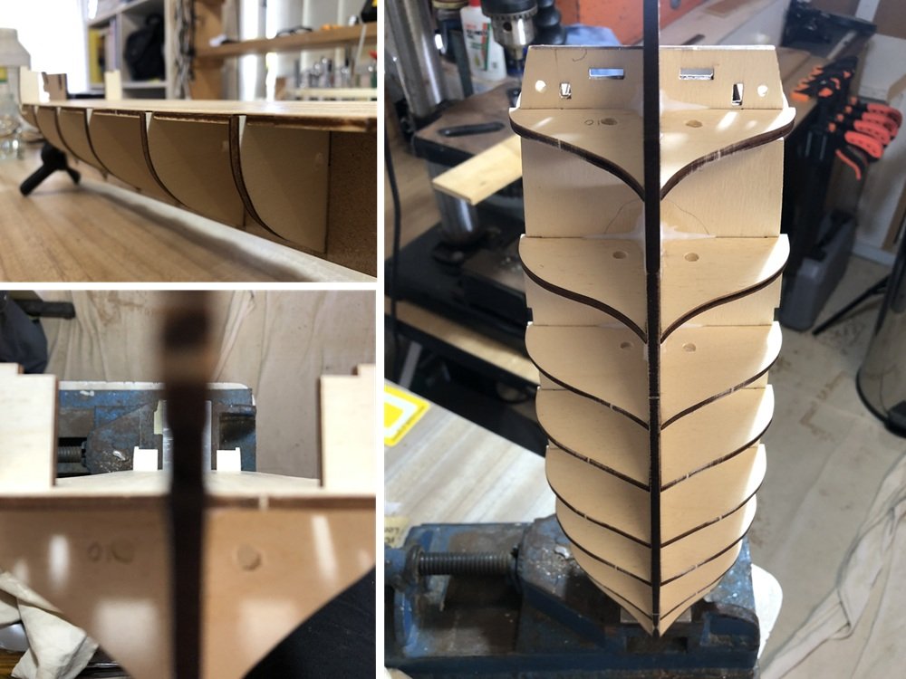

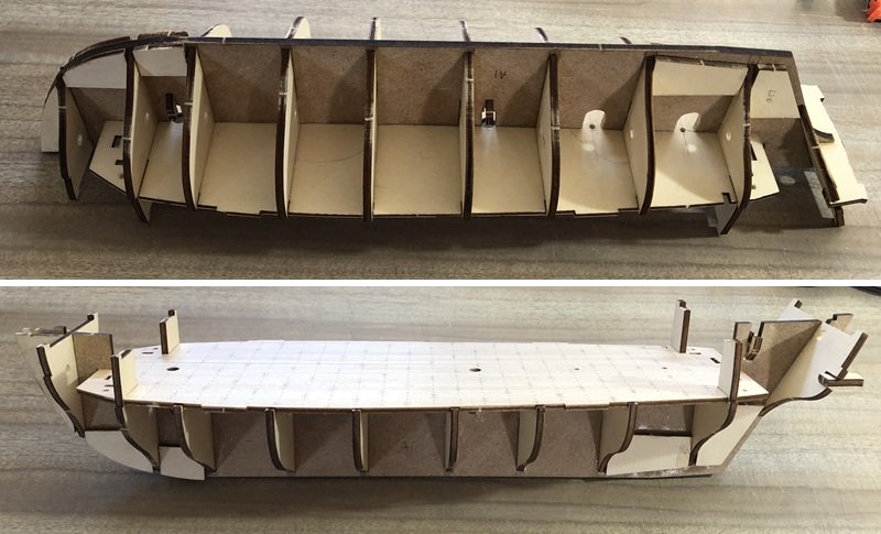

While researching how other builders followed OCCRE's instructions, at times, the deck was not flush with the tops of the bulkheads. I think the problem here is that some of the bulkhead slits are too long and drop into the spine too far.
So I decided not to follow the instructions in this case. Instead, I am going to use the deck as a template jig, and have the bulkheads fit flush to the deck before glueing. But first, I need to draw guidelines on the spine to ensure that the bulkheads will be 90 deg. The following photos show what I mean. I have not yet applied any glue, but when I do, I will use superglue to spot glue the bulkheads all straight and flush. Then, when all looks okay, I will use wood glue as welding-runs.
HMS-BeagleBuild3a.jpg.7161070b09cbbc0d5c4869684a1fbcc6.jpgHMS-BeagleBuild3b.jpg.db6d9177f8a3311c0977ac132d80869b.jpg

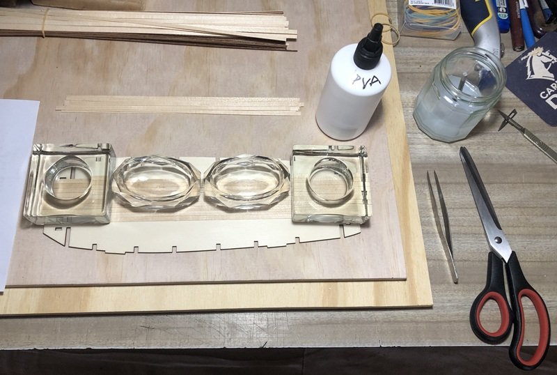

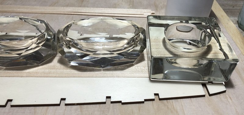

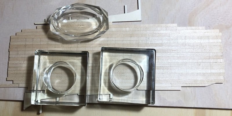

Started planking my first deck. I did not do it as the pros would, but I guess I would have if I were scratch-building.
I am using glass, with flat bottoms, as weights. Got them at a secondhand shop. PVA glue doesn't stick to glass.
Peter.

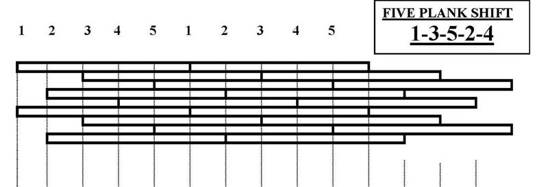

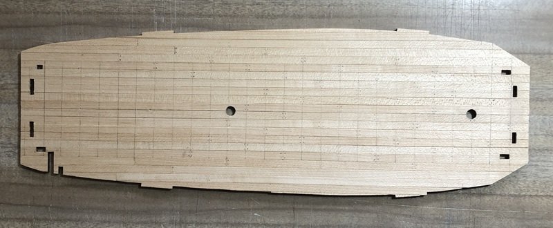

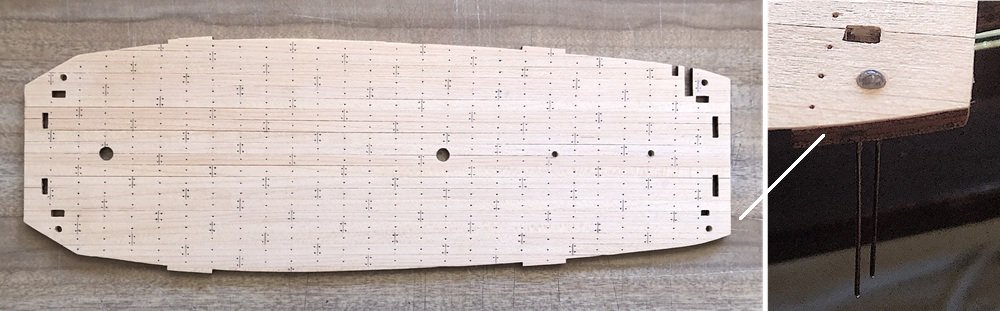

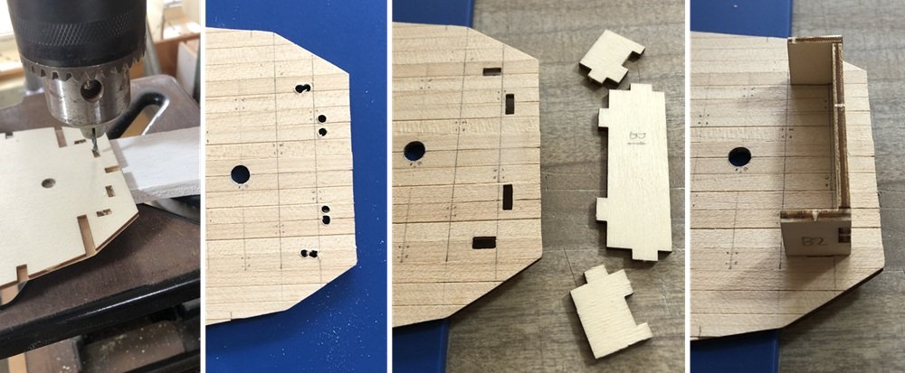

As I was planking the deck, I got to thinking that at this stage I could use the offcuts to fill in the rest of the deck.
To do so, I need to know where the plank needs to end. I found (online) a five-plank shift method of planking.
I temporarily marked the planks as per the plan instructions. I want to slightly sand down the deck before marking out the joints and fasteners (again).
I cut off all the overhang with a scalpel. But I erred to the idea of using the scalpel to cut out the enclosed slots. Instead, I drilled them out and then used needle files.
To gauge how much to file, I used the pieces that were to be placed into those slots to get a neat fit.
I shortened the extended drill bit to stiffen the drill, so it won't wander if I overlap a hole.

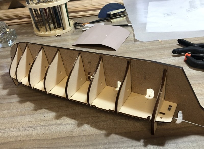

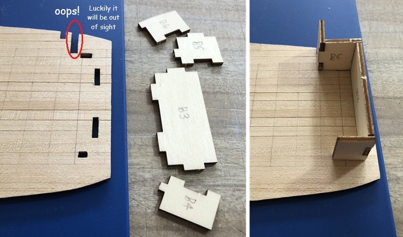

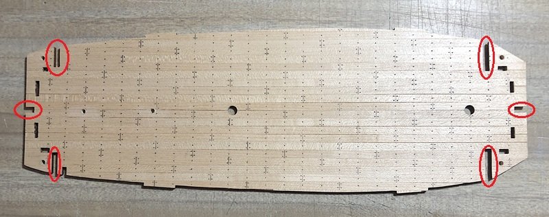

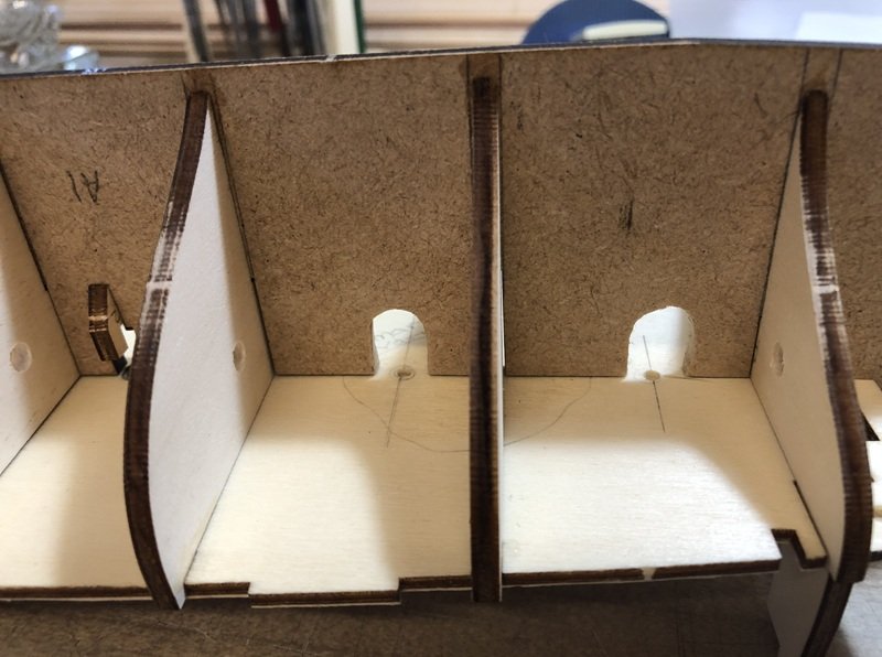

Well, I was surprised to learn that I did not make an "Oops!" in post #20, in fact, I made a bigger oops by not realizing at the time that I needed to cut out another five slots.
Time to assemble bulkheads and deck... But I made another 'Oops!' The LED lights for the two hatches are directly over the spine. I had to cut access slots for when I need to mount them.
After spot gluing everything snuggly together, I am now doing PVA runs, starting from inside corners going out...
Peter.

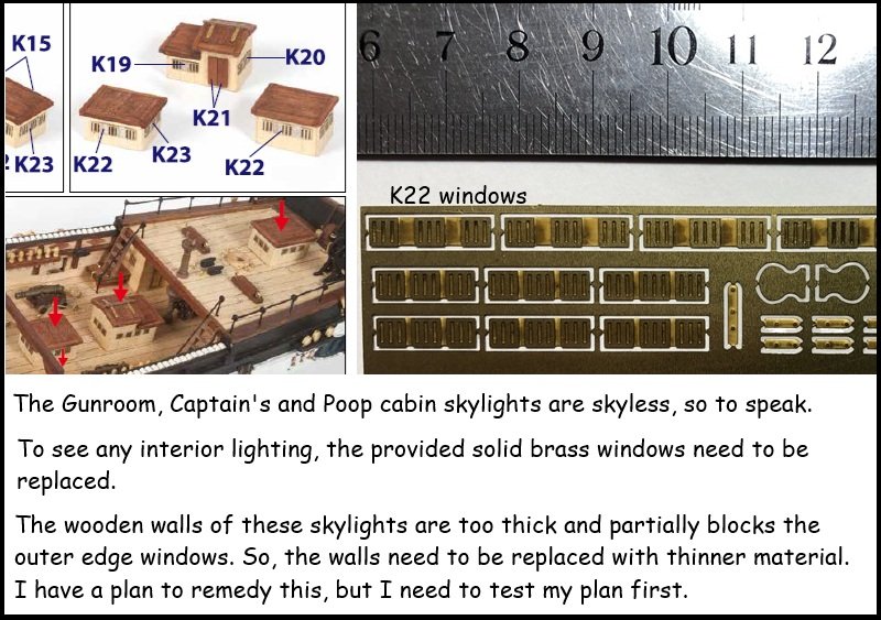

Before I do any planking, I need to work out a few details about the interior wiring for lighting and how to alter or replace some of the kit pieces.
I want to have interior night lighting visible through the skylights, but there is a problem...
Peter.
