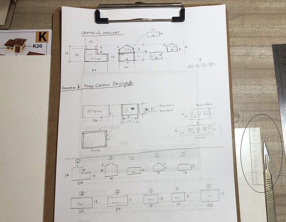

Sorry for the delay in completing the skylights. I have been too tired to do so.
My mates have been getting me back into cycling. The trouble is that I am 20 kgs overweight, and losing it seems to be an impossible task without burning off my fat reserves. The guys I ride with are 70+ y.o., and the better riders average 30 kph. It has taken me a few months of riding to be able to stay with the faster guys. Last week I rode 5 out of seven days, my best performance since returning to the sport. I rode about 270 kms. I am now losing weight, but it will still take a long time to lose the excess.
I am feeling better today and looking forward to completing the skylights.

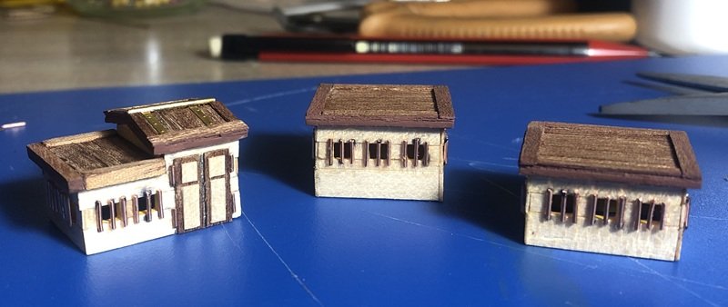

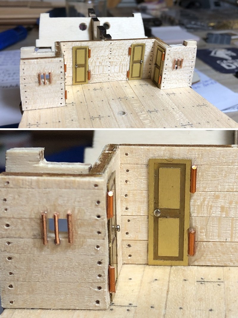

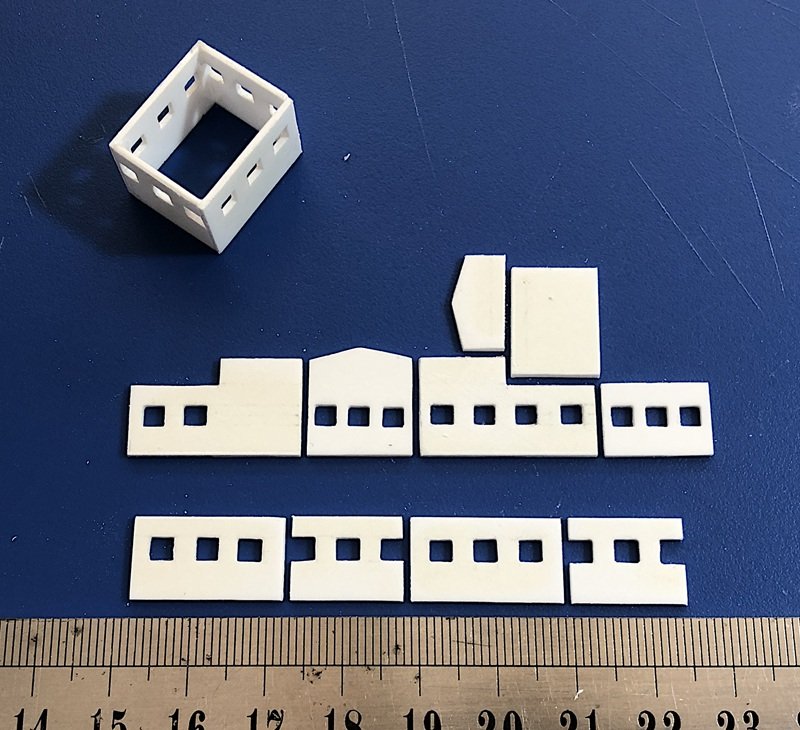

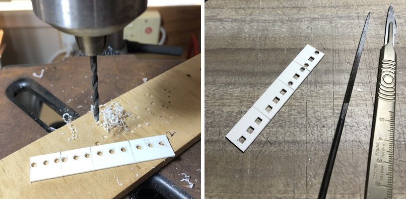

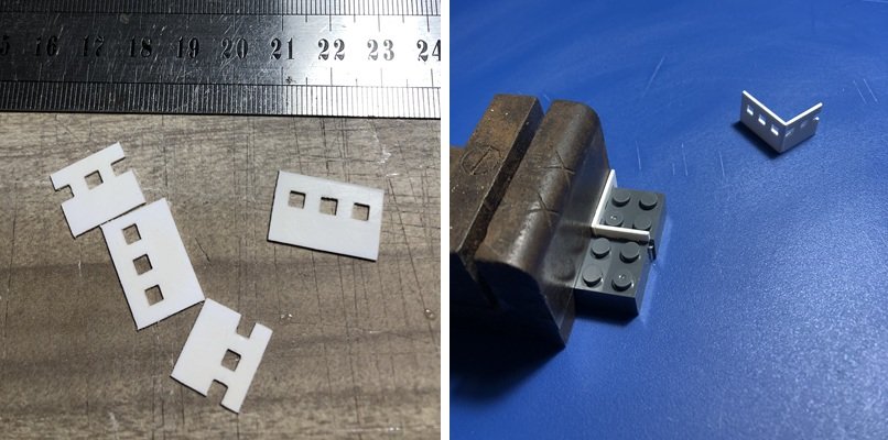

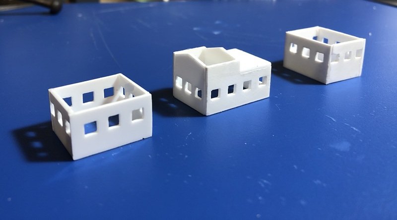

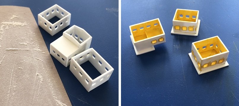

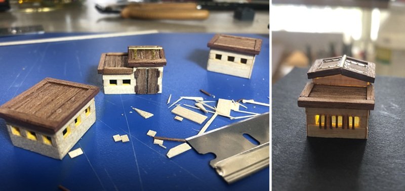

Even though I completed the wooden panelling, it is still not finished. I've run into a few problems (as expected with model building).

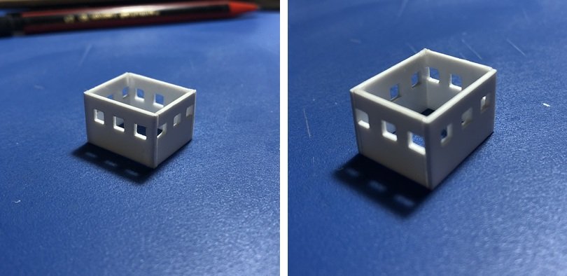

The white 1mm polystyrene sheet is quite light-transparent. I will have to dim the light source even more.
The interior needs to be repainted white to see if that lessens the effect. I am after a warm light effect.
I am not happy with the doors. I might add panels of the lighter timber.

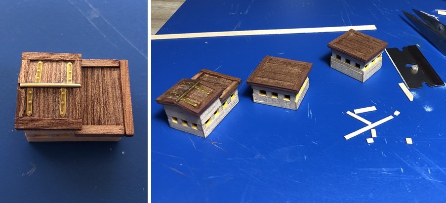

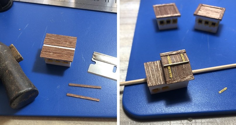

I experimented with a section of the captain's skylight that is not seen when placed on the deck.
I included protective bars across the windows. I will try to do a better job of it with the rest of the windows.
You can see the interior light penetrating the upper panel.

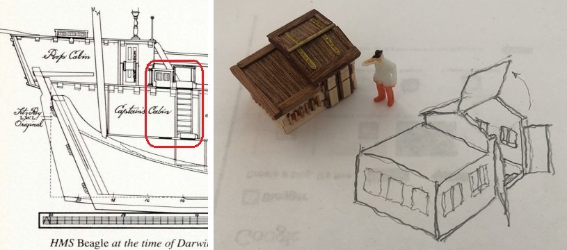

While sleeping last night, I had a dream about those skylight doors. There is still something wrong with them...
First of all, according to the build kit, the doors are too small, resembling cabinet doors.
Besides, what are the slanted hatch lids for?
This morning, I had a closer look at some HMS Beagle plans and discovered that there is a ladder-way from the Captain's cabin to the upper deck.
Aha! So, these doors should be taller. . . I extended the doors and panel to indicate this.

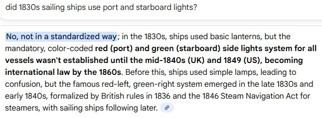

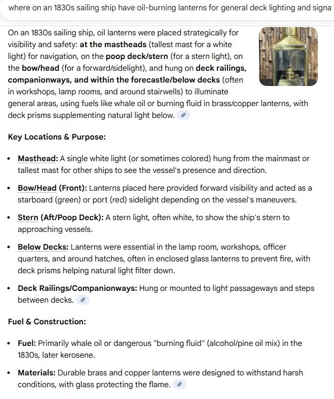

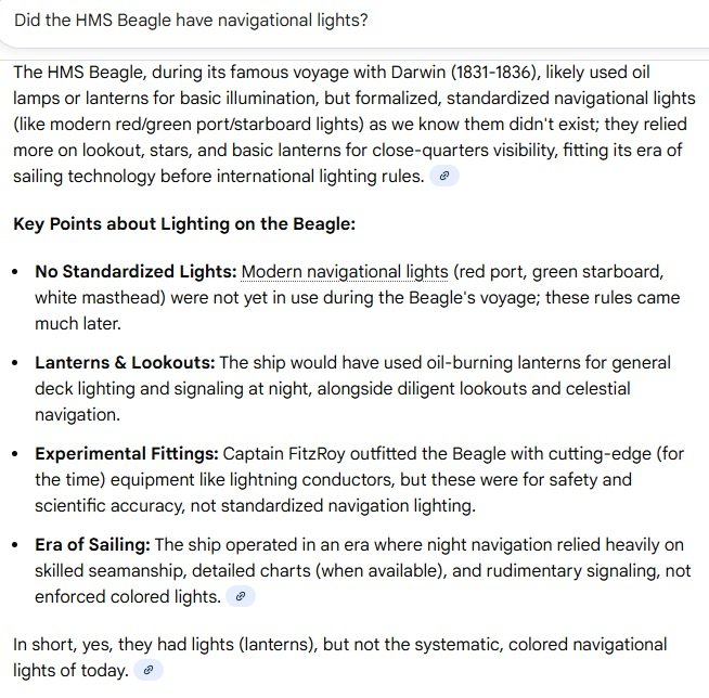

The wiring is for lighting. There are several lights I wish to explore. There are the skylighting areas and the night lights. HMS Beagle did not install any port-starboard (red-green) nav lights. However, it did use lanterns during the night. I will be installing some lanterns in this build. The wiring needs to be fine/thin to conceal it where possible. Yesterday I ordered the wires, and that will take a while to arrive.
I am also still waiting for a book to arrive, HMS Beagle, which has been delayed from the USA. After my recent adventure into constructing the captain's skylight, I realised how little I know about ship design and what to look for. I hope this book will provide me with a better understanding of the construction of the HMS Beagle. I know there is a better book on this subject, but it's too expensive to justify the cost of what I can do with this kit.
About the lighting. AI tells me the following...

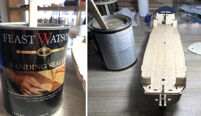

I got a couple of postal deliveries. Two books arrived, and I am happy to have received them.
Yesterday, I bought a tin of satin clear varnish and a tin of sanding sealer (pore filler lacquer) from the local hardware store.
As recommended by the kit instructions, I gave the deck a coat of sealer.

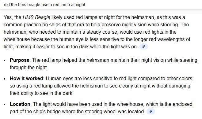

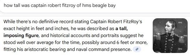

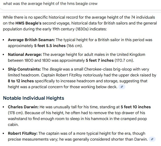

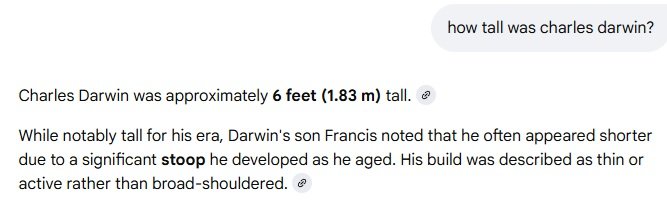

An example of AI contradictions...
After being on the HMS Beagle for nearly five years, it is no wonder Charles Darwin developed a stoop. 😉
Peter.
Current Build: HMS Beagle
  Indeed, A.I. can get it wrong.   I asked what the draft of a C&O canal boat was, and the A.I. 'summary' said 6 feet. I knew this had to be wrong, because I recently visited the Monacay river aqueduct on the C&O and measured the trough depth (from half a foot beneath the top of the capstones) of 5' to the material added to the bottom during the maintenance done in 2005 - which added half a foot to the original base.  Thus the range of water depth in the aqueduct available (though deeper in the earthen sections) when the canal was in use was 5 to 5 1/2 feet.
So I did my own search to find the original specifications in use between 1873 and 1924 (the year of closure) and found that the largest boat was limited in loaded draft to between 4' 3" and 4' 9" - consistent with my measurements of the stone passage.
A.I. was likely stating the distance from keel to gunwale (6'), because the specifications for minimum draft was 6" to 11". The barges were merely wooden boxes with slightly rounded ends, so an empty barge rode high in the water, and was known as a 'lighter'. Due to some low bridges, the overall height also had to be limited.  Still, you can get many good leads from A.I. - but you still have to use human intelligence plus logic to 'filter' out bad info.  It also depends HOW you ask a question in a search, so multiple queries put in different ways can lead to useful results.

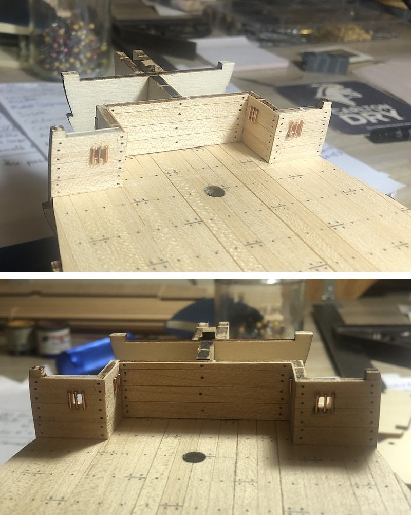

The doors are etched from brass, and they are supplied, in the kit, by OcOrer. So, I did not manage the doors at all, except the door knobs (pin heads).

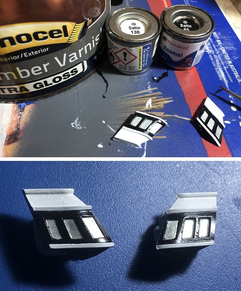

From the beginning of this build, I had a few alternative ideas I wanted to implement. One was to remake the stern quarter galley windows to have windows. But I discovered that in reality, the galley windows were fake, built simply as an ornament. To model them to have windows would have been a bigger fake.
I learnt that quite often, while looking at windows, what one sees is a greyish background. So I decided to apply a few coats of clear ultra-gloss varnish to the windows. This produced a glare effect. The photo below shows the glare as white (it's the best my iPhone can reproduce).

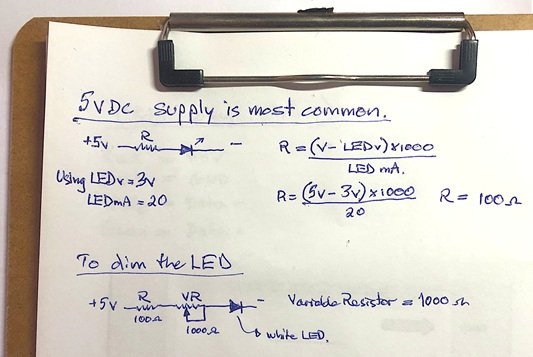

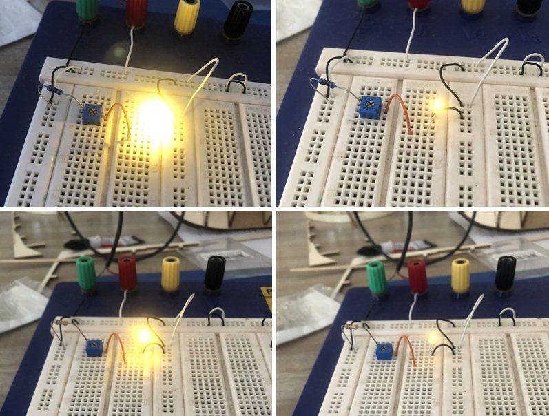

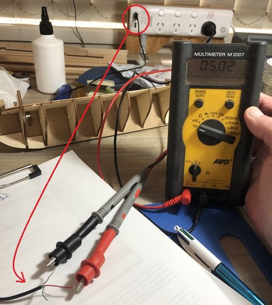

To light my model, I decided to use LEDs and a common DC voltage source (5Volts) from a USB charging socket. I stripped a USB cable to find and check which coloured wire carried the 5V. It's the red wire.
The LEDs I am using have a 3V drop and use 20 milliamps (mA). The following formula calculates the load resistor value to use to drop the 5v to the required 3V at 20mA. It turns out to be 100 ohms. To dim the LED I decided to use a variable resistor up to 10x the load resistor (i.e., 1k ohms), which worked well in my past 'aged' projects.
To my surprise, I discovered that LEDs are much brighter these days! I needed to increase the resistor values by 10 times to get a reasonable dimming effect.
Now the R=1k ohms and VR=10k ohms.

Peter, do you experience any heat buildup due to the increase of resistors?
Respectfully
No, not at all.
The LED only draws 0.02 amperes, at the most, at 3V. When the LED is brightest.
V x I = Watts.    3V x 0.02A = 0.06W     The resistor is rated at 0.5W
Peter.
