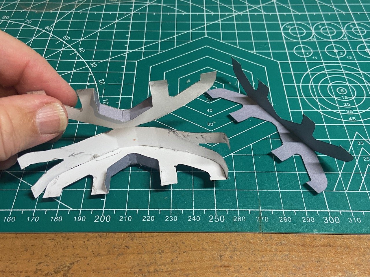

Once the deck was mounted, there was a little overhang that I ended up carefully sanding away, but that seemed to work. It means that the deck is a tad narrower, 1/32" or so. I don't think this will cause any issues. There is only one assembly which spans the full width of the hull, and that's coming up in the next step or so. It's the rear bulkhead section of the forecastle, and I should be able to compensate during construction.

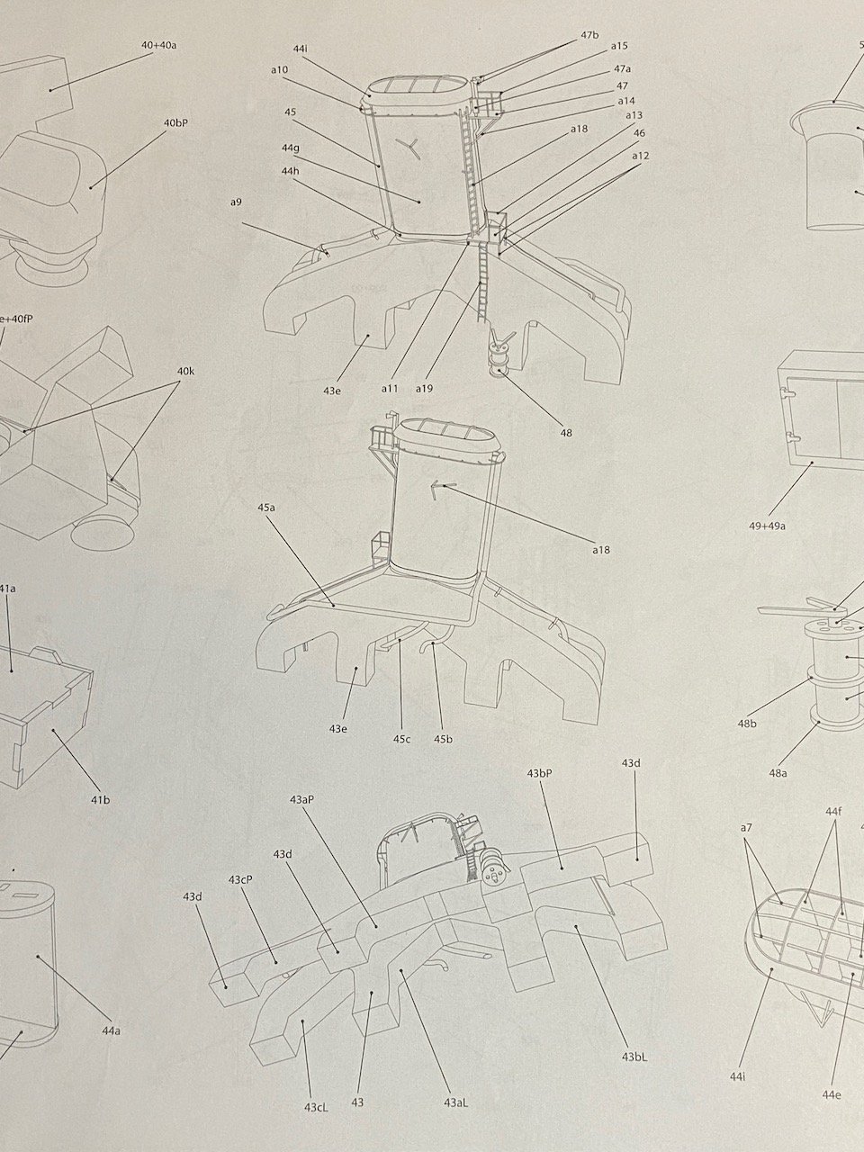

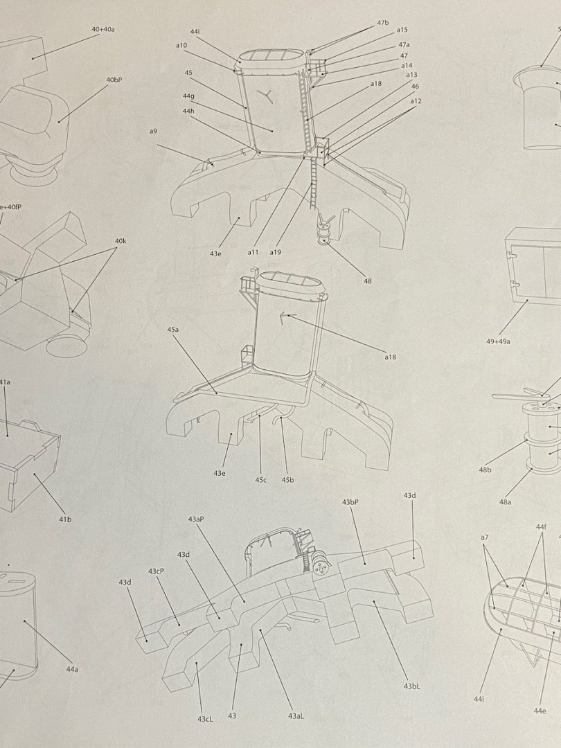

That assembly, by the way, was probably the most confusing part of the instructions. For the longest time, I had no idea what I was looking at or where it was supposed to go.
Now, it looks like I will be an interesting assembly to work on.

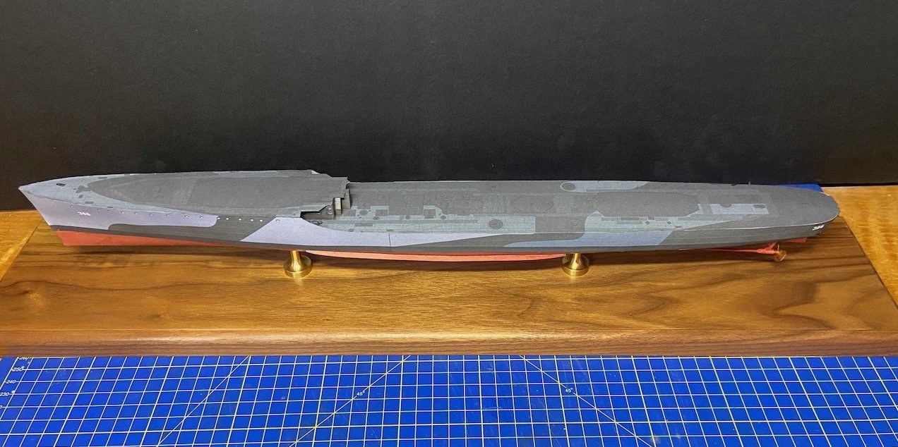

Not much to report today, but I started looking at how I'm going to mount the model, since I'm going to have to drill holes in the bottom before too long. I had some standard brass pedestals for ship models, the kind with the keel slot in them. Since the steel navy ships don't have an external keel, I went ahead and used a chop saw to carefully cut them down and ground and filed them clean, so the tops are flat.
Then, I realized that the bottom of the hull isn't THAT flat, so I went back and ground a very slight "V" into the pedestal tops. The proposed mounting of the model will then look like this:
The base is just one I have laying around. I actually think I prefer cherry wood. Also, I think I may opt for a 24" long base, which only extends about 1-1/4" beyond each end.
Meanwhile, I've gathered the parts for the first assembly, which I need to go on deck, just behind the forecastle. I'll need this in place before I can add the forecastle deck and the remaining hull coverings. But, I might need to deal with the underwater details first, while I can still freely turn the whole thing upside down.

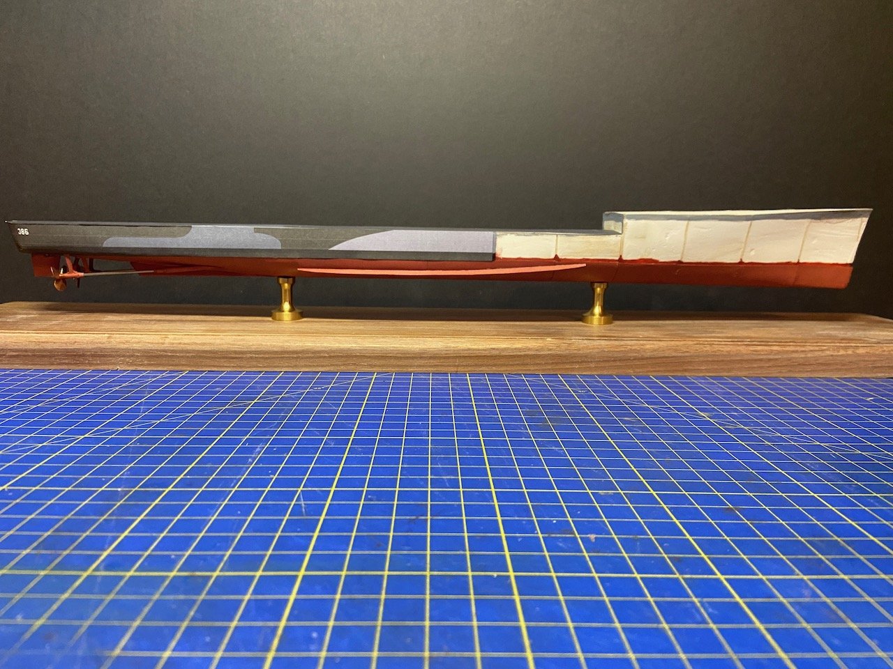

Over the weekend, I realized that first assembly had to wait until I get some of the details added to the underside of the hull. So, I worked on making the skeg and adding the bilge keels.
The skeg is provided as a folded over piece of card stock, with a hollow space inside. Figuring I'd damage that pretty quickly, I measured the hollow, a nice 1/16" wide space, and cut a piece of wood to fit inside. The only issue I ran into was getting the skeg assembly to fit flush against the hull. I had to do a little sanding, but I still had some thin gaps that would let light through if you backlit the model.
I didn't want to mess with the keg much more, so I just made sure to glue it securely in place on the hull. Then, I went back and took a tiny amount of the spackling compound I used to fill the hull, and I spread a tiny amount along the seams. Using a brush to press some of the material into any cracks, I then took a lightly dampened brush and cleaned up the surface.
Once, this had dried, I took a small amount of the acrylic paint I mixed earlier, thinned it well, and applied it along the seam. I then cleaned up any excess paint first by wiping with a piece of paper towel, then took a damp brush and blended any remaining excess, so it's no noticeable.
Note that I think using a damp brush on the hull of a paper model only worked, because the parts were "press" printed (what's the term I'm looking for here?) and not printed on my inkjet printer.
IMG_2708.jpeg.23cdf90f25fa1ad6e4977fbcc5492c04.jpeg\
What I did seemed to work pretty well. Also, the paint mix looks to be a pretty good match. It's actually a little dark, but I serves doubly as shading. I'm thinking that in the future, I may just fill any cracks between the lower hull plates with spackling compound and then just painting all the red areas.
Next came the bilge keels. This wasn't difficult, especially given how well the gluing and painting worked on the skeg. For these, I glued them into place using Aleene's Tacky Glue, just like with most of the other paper parts on this model, but by the time I positioned the keel, it kind of dried out. So, I ended up applying a dilute coat of glue along the connecting seam. The glue dries clear, and you really can't see any residue after wiping the excess.
To be honest, I don't even recall if I applied paint like I did with the skeg. I was kind of flying by the seat of my pants here. Mostly, my attention was on keeping the curvature of the bilge keels nice and smooth, as it was easy to introduce some wobbliness while trying to glue it into place.
It seemed a little odd to me that the keels rise up at the bow end so much, but I followed the fine, printed guide lines exactly. Being primarily a wooden sailing ship modeler, this is the first model I've ever built where I had to add bilge keels, so I'm just trusting Avangard on this.
You'll note in both pics, I've drilled out a couple mounting holes and inserted temporary brass pins. These allow me to set the model on the pedestals and to keep it from falling off them. Again, this is only temporary. I'll either mount the model directly on longer pins and into a display base, or I'll use the brass pedestals and replace these pins with mounting screws. That's not going to happen until the work on the underwater part of the hull is done.
For now, this is how I set the model up...

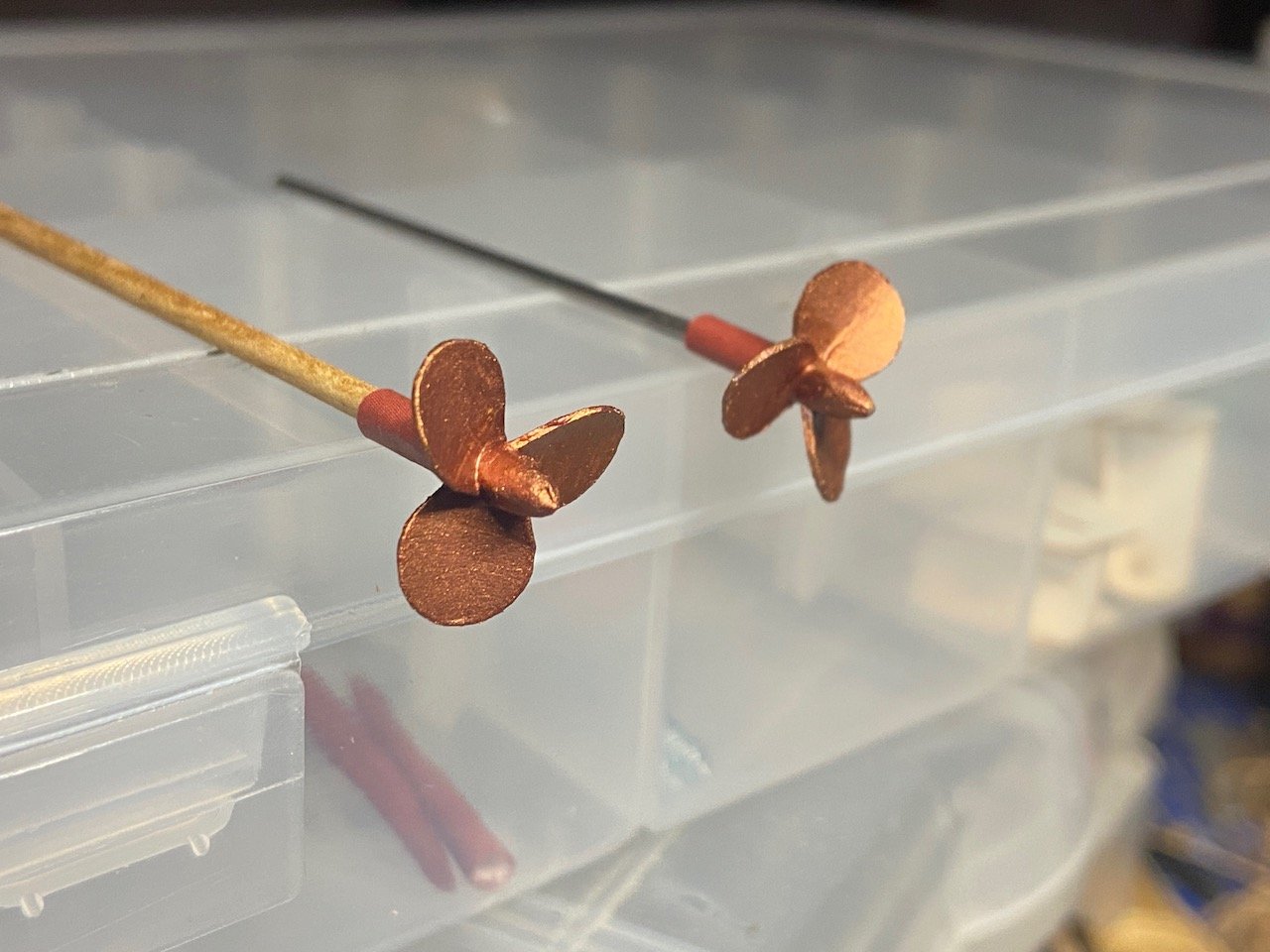

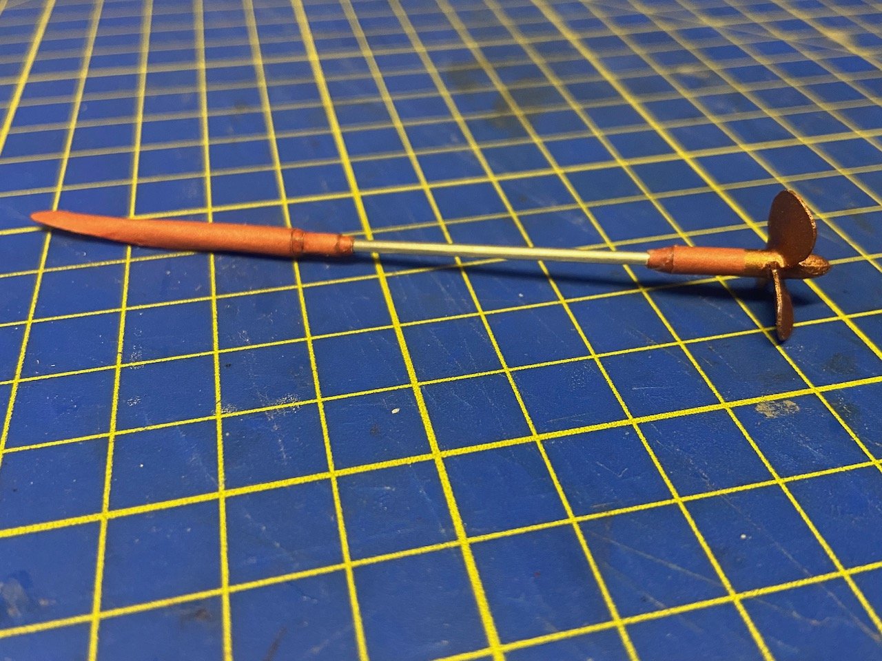

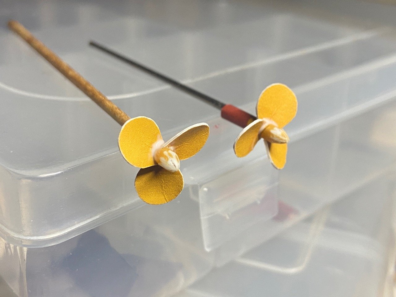

Assembling the screws is one of those things that makes me nervous, so just stare at the parts, and set it aside to do something else. But, it isn't so bad. I used a little CA on the ends of the hubs, so I could sand them smooth, the I added the blades. The paper hub pieces are marked, which makes adding the blades pretty straight forward.
After adding the blades, I also used a little of the sparkling compound to fill gaps and help smooth things out. I rubbed off any excess with my fingers. After that dried, I brushed on a little more thinned Aleene's and let it set.
When that was all dry, I brushed the yellow parts with Revell's Matte Bronze. Not sure where I got the stuff, but I've had it for a while. It comes in a little tin, like the Humbrol paints.IMG_2720.jpeg.07ef3bac18bbd28b7bbbdbdf609f0bba.jpeg
They're not perfect, but I'm pretty happy with them. On one blade, you'll notice a slight creasing of the paper material.
Now, to finish the parts that hold the shafts. The kit includes a paper part for the shafts themselves, but I'm replacing them with stainless steel rod.

10 hours ago, GrandpaPhil said:
They are nerve wracking to make!
Especially out of card!
Hi GrandpaPhil, actually, I found them more intimidating to think about than to actually make. Once I started making them, construction went along pretty quickly and easily. The things that are nerve wracking to me are little conical rings that make up the propeller shaft housings and all. The Bagley has three of these conical rings for each shaft. 😕

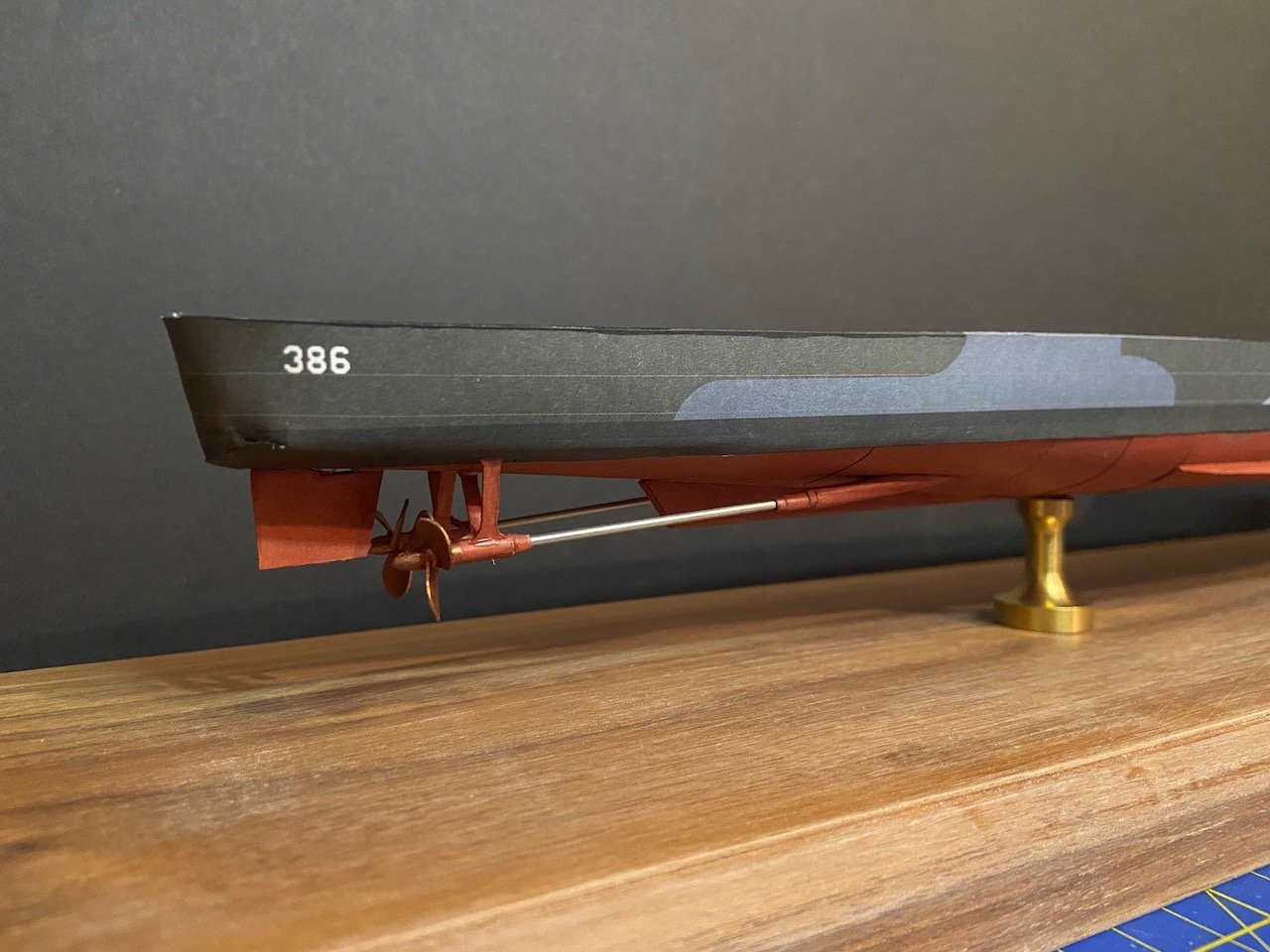

Bagley construction was on a very brief pause. Was all set to finish off the underwater hull details when I realized I was short on the rod. Got this far...
But, then I discovered that the local ACE Hardware had some in stock. Ran over to pick it up and I was able to finish the propeller shafts, rudder, and all.
IMG_2730.jpeg.e725d796d398215452e0265668001478.jpegIMG_2731.jpeg.88c1479a240855e0f14c86cfdfcecff2.jpeg
I'm pretty happy with the way this assembly turned out, and VERY happy to be done with it!

That's not my understanding. When I brought up this question elsewhere, I was told that propeller shafts were bare stainless steel. Anyway, if I do need to paint the shafts, it's easy enough to do.

Propeller shafts of WW2 warships were generally painted to protect against corrosion and marine growth, rather than left as bare metal. The exposed sections of the shaft that were underwater were typically treated with the same anti-fouling paint used on the rest of the lower hull.
ddp, thanks for the comments. I've now painted the shafts. It's not a great paint job since the shafts are steel and I have no way to remove them for painting without damaging the model. But, they should be fine. They will not be handled in any way, so I don't anticipate any rubbing off or flaking off of the paint.

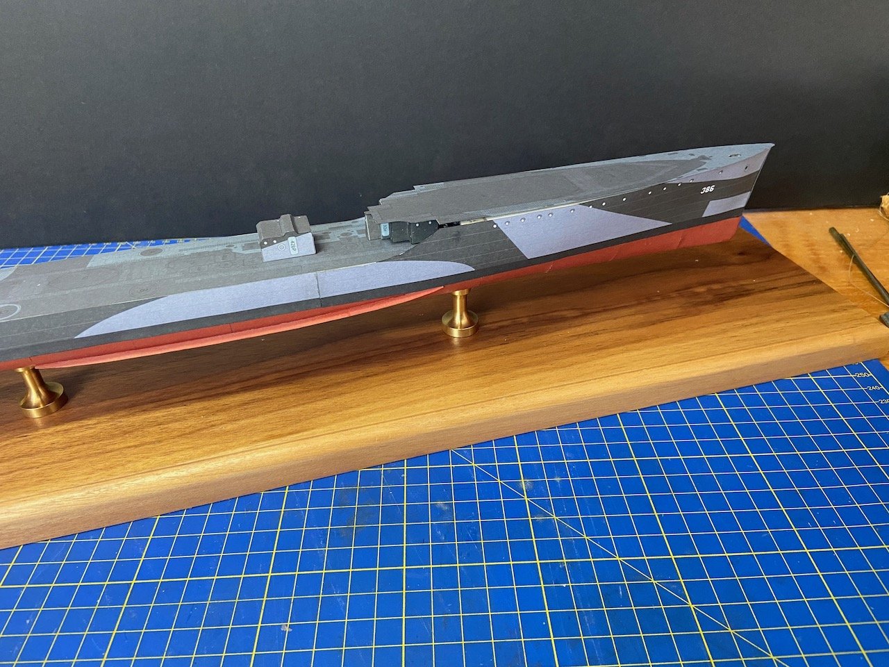

Next, while it seems like a minor update to the model, I added the forward hull plates. This was actually a big step for me. I really wasn't sure how well the whole hull would go together in the end. Now I know! I think it's all come together pretty well, and I'm hopeful that this will turn out to be a nice looking model.
IMG_2745.jpeg.a006e63c02b408a3c4f6473907722e61.jpegIMG_2744.jpeg.bcf142dac1066230b4122642d677b8b0.jpeg
I thought I'd have to mount the forecastle deck first, but I did a lot of test fitting, and I think it will go on okay at a later stage.

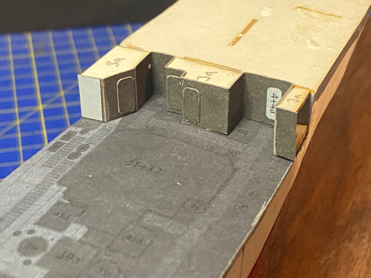

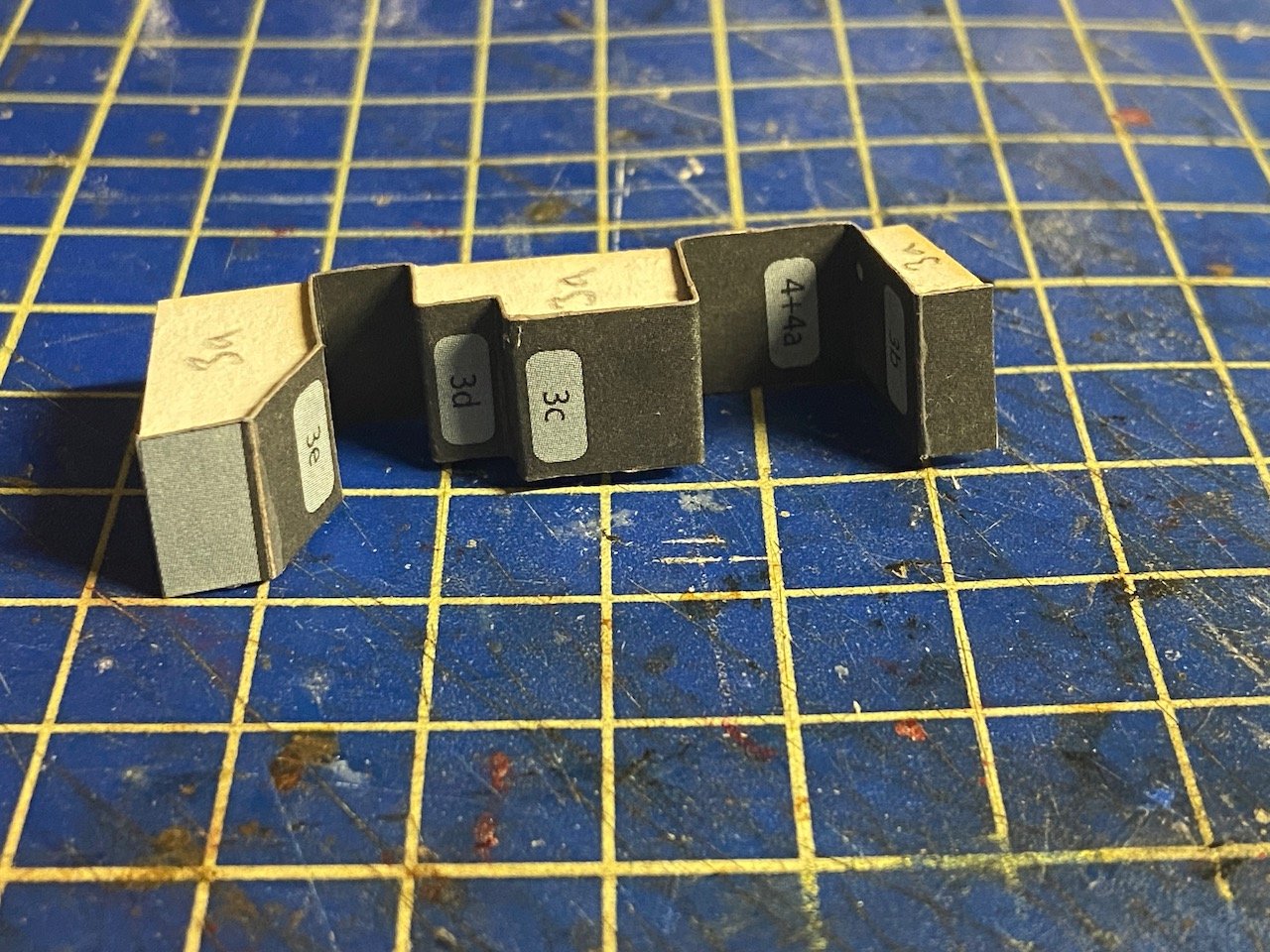

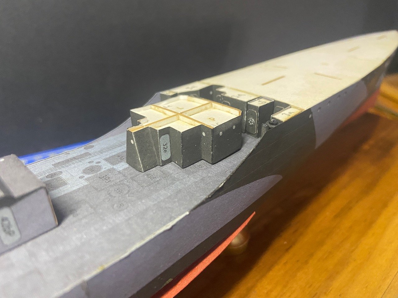

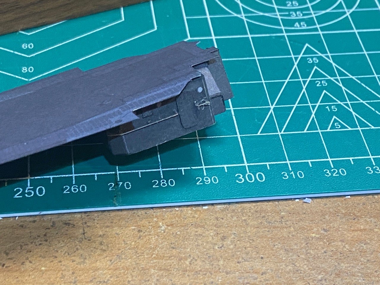

At this stage in the build, the ship doesn't change much, and each step forward represents hours of work to add small details. Mostly at this point, ship construction is a matter of building each of the structures first, then gluing them into place on the deck. The only major step will be getting to the point where I am able to glue the forecastle deck into place.

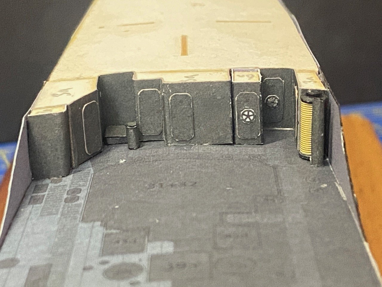

I managed to add all the details for what I'll call the forecastle bulkhead. I'm still learning and working out the best way to deal with certain items, like the spoked wheels on the watertight doors. Those are printed with a white area between the spokes. I tried cutting them out on one of the wheels, and I just managed to tear up the details. Fortunately, it's on one of the doors that will be tucked way under the forecastle deck, so nearly impossible to see at later stages.
The one thing that seemed helpful is that I soaked the wheels with thin CA glue, prior to cutting. The result was that the white areas turned a little darker, so the contrasts are not so pronounced. I also have come to the conclusion that while I've been using paint marker pens for edging the white paper parts, thinned paint applied with a brush, may be give better results. Also, paint markers are very limited in color shades, whereas brush-applied paints are easily mixed to create any desired shades of color, even if it's all just about shades of gray.

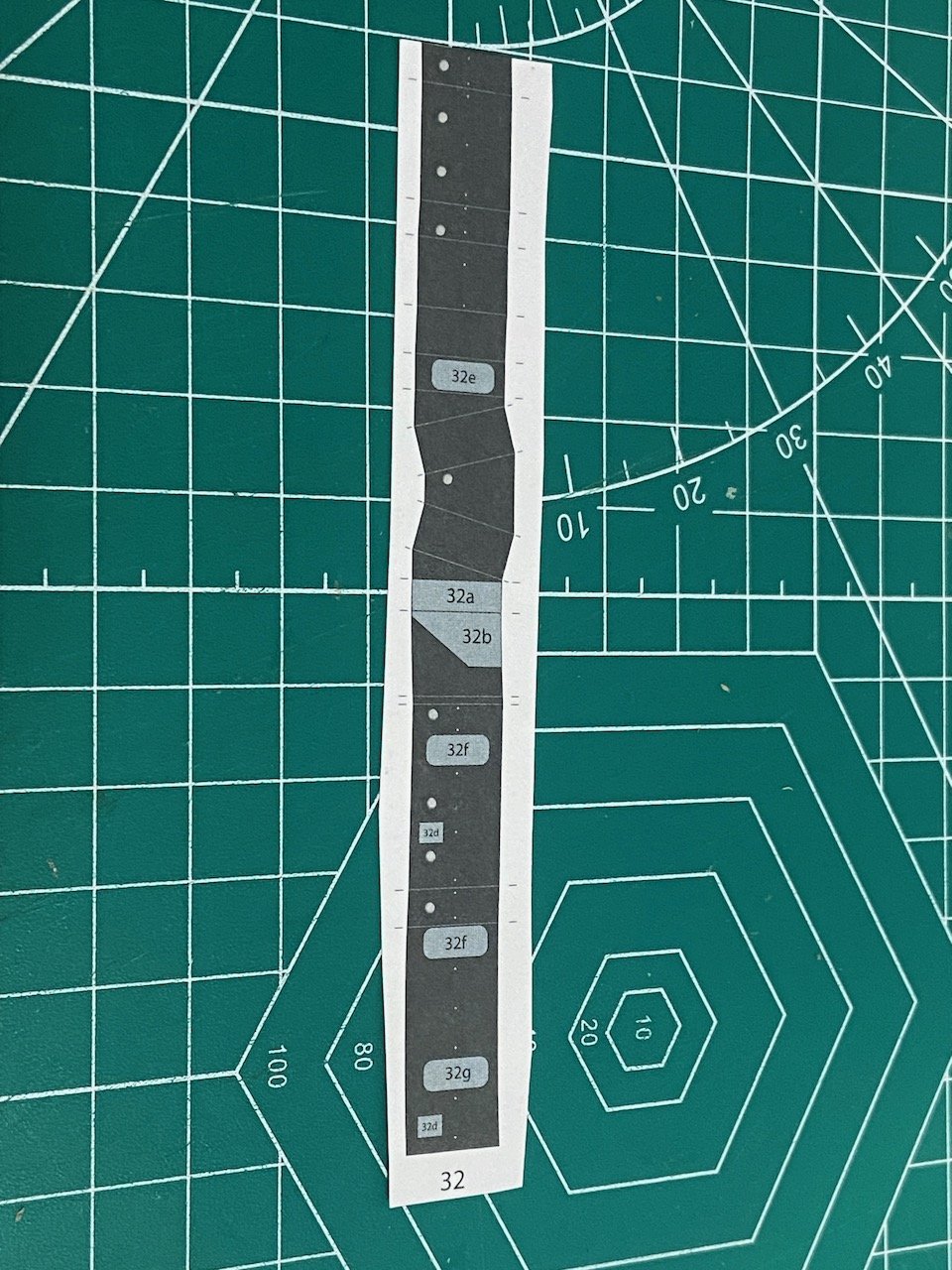

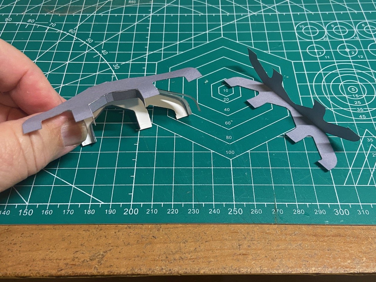

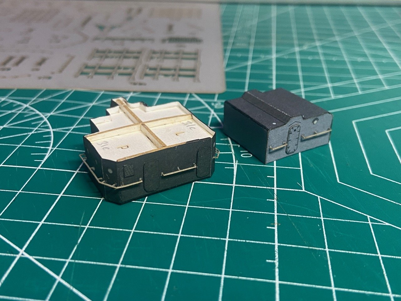

Next up was this complicated piece, requiring 16 folds. Using those little marking just outside the part, I line up a straightedge across them, score along the fold lines with the back side of my scalpel, fold lightly along the scores, just to make sure I scored them sufficiently. The last step was to then cut the paper close to the part.

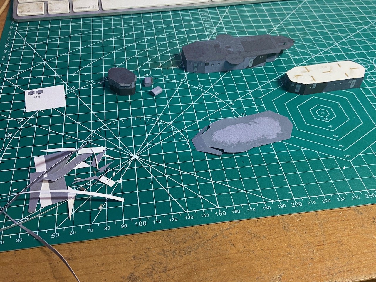

After that comes test fitting, to make sure the part fits the internal structure properly. After that, I can glue it on the structure. However, it occurred to me that this piece fits underneath the forecastle deck. That means that this particular structure has to fit the camber of the main deck below it, as well as of the forecastle deck above it. That's why this particular structure has the vertical parts sticking up above the flat, horizontal parts, as well as down below the lower flat, horizontal pieces. Meanwhile, all the other structures that fit on the deck are flat on top, and the upper structures are flat on both top and bottom.
Below, you can see my test fit of this structure, as well as another at the far left of the picture.
And below is another test fit of the forecastle deck. This test fit was very useful, as the irregular shape at the aft end of that deck has to fit perfectly on the hull as well as this structure underneath it. That lead me to realize that it's more important to alight this structure with the forecastle deck, than it is to align the structure with fuzzy markings on the main deck.
And, finally, I proceeded to add the fine details to these two deck structures. That involved breaking into the laser-cut details set I ordered with this kit. These details are extremely fine parts, mostly railing, cut from thin gray card stock. These were pretty easy to add. I think they were easier than photo-etched brass that I've used on plastic kits.
Not sure if I should paint them to match the camouflage. I actually like the way they look, and I don't think they are significant enough to ruin the effect of the camouflage. Anyway, the structure on the left is ready to mount on the model as soon as I add some details to the main deck around where this piece will fit.
