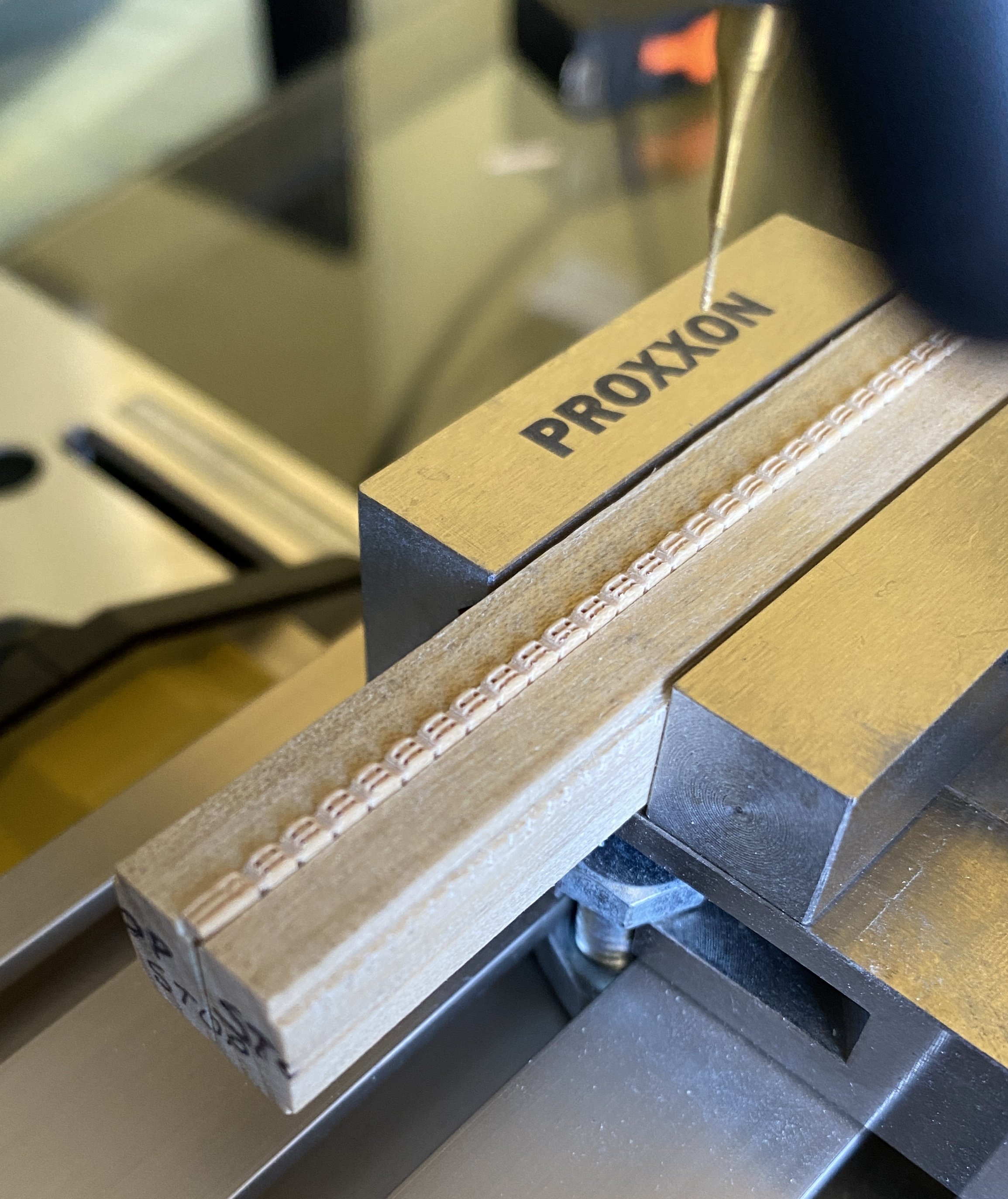

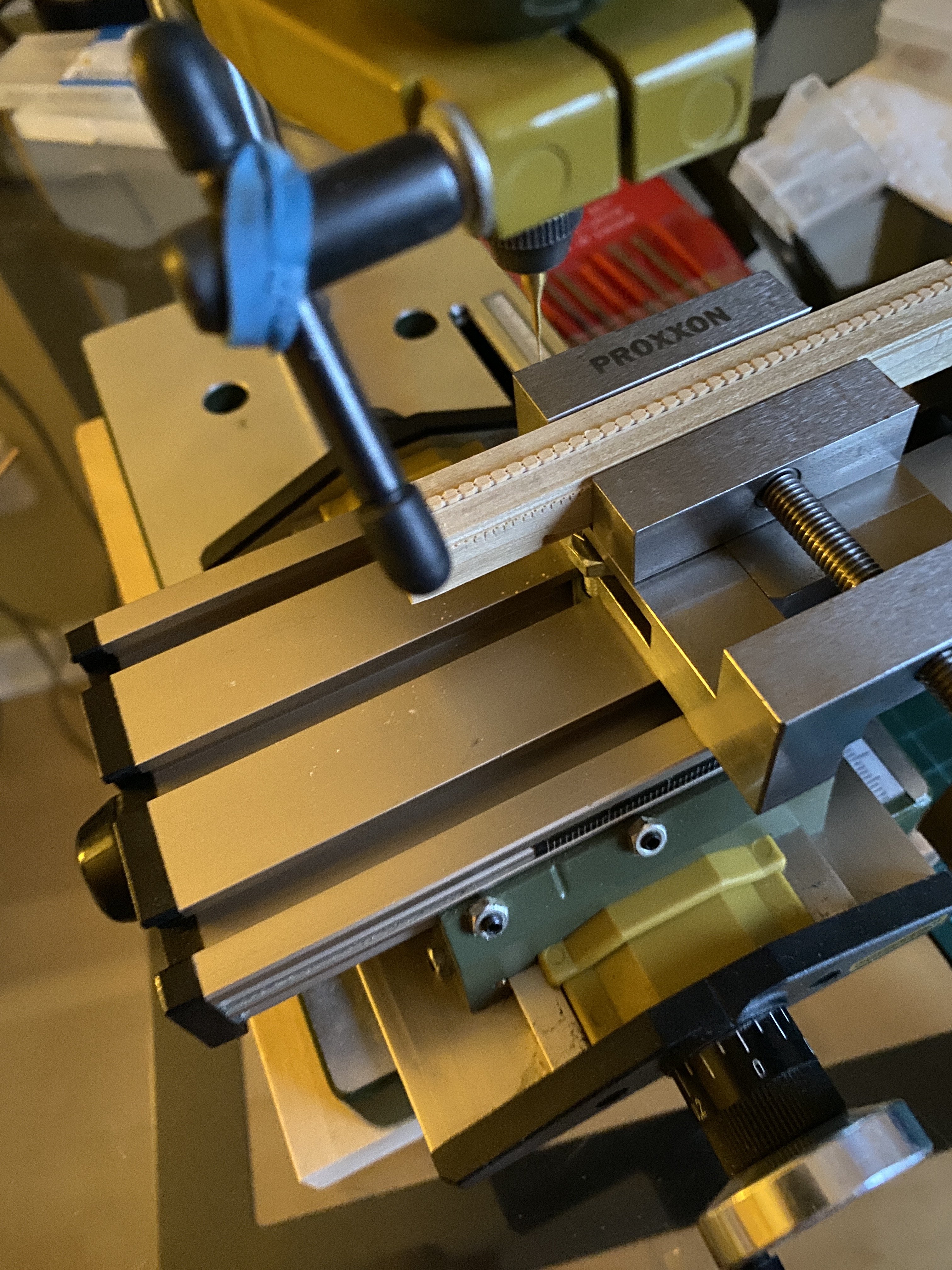

It is held by lowering and holding a drill quill. I find it extremely efficient. I have Sherline mill but would never do blocks on it even with a sensitive drilling attachment I have. It has about 5 thou runout on the 0.4 mm tool. My Proxxon setup is 1.5 thou runout. Sherline is for some more crude and metal work.

It is sturdy and accurate enough to do such work. Better than Sherline with its runout.
