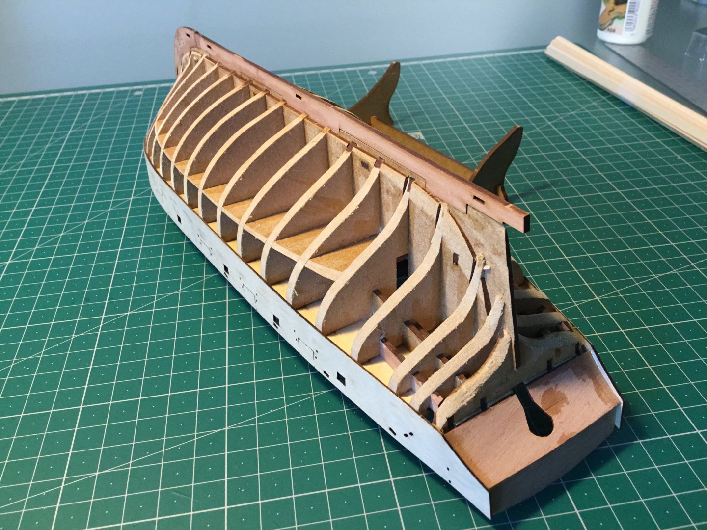

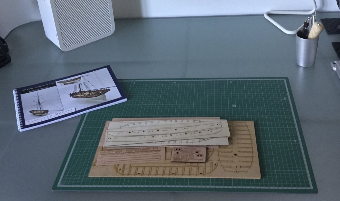

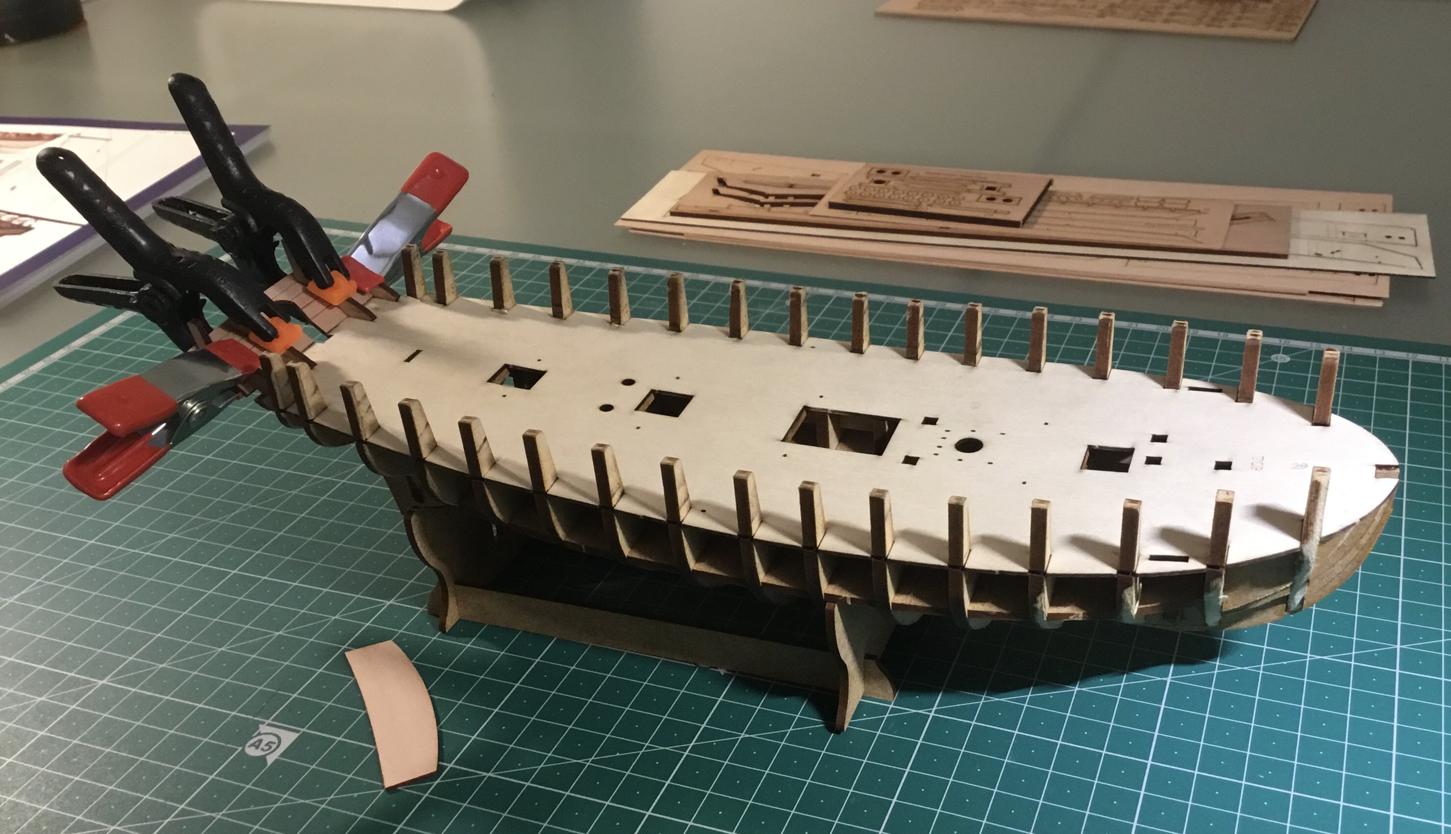

So here we go, first ship, first wooden ship build wish me luck.
Got to say from the get go, what a wonderful kit. The hull fitted together perfectly and the instructions were amazing. I did refer very briefly to the YouTube log quoted on the Vanguard site. Coming from the plastic modelling world, I wish all manufacturers would adopt Vanguards vision.
This is how far I am along, the only slight problem I had was with the keel keys but spares were supplied. May I suggest add a few more on the sheet for prudence. Time to clean down the ship building area and look forward to the next session.
Please if you see anything untoward or problematic issues I’ve built in, please feel free to flag them.

Good luck on your journey,  you can't go wrong with Vanguard Models.  Check the logs for the Sherbourne, they will answer most of your questions,  and Vanguard Models  will answer all your questions .

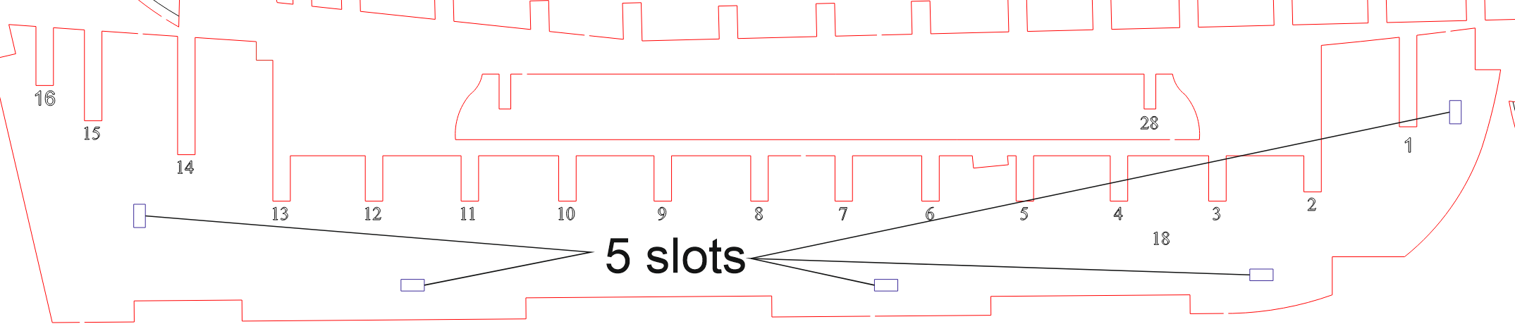

Looking good!

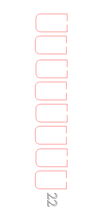

I just checked the amount of 'Keys' on the 2mm MDF sheet, and there are a total of 8, with only 5 required, so you should have 3 extra :)
Thanks Chris, I was a little heavy handed 🫤 with three of the keys so just had enough with the spares. A couple more spare’s maybe help some people.

You will catch up to me in no time, you can learn from my mistakes as well. The instructions are good but here is what I would add on top of instructions that is next few steps:
1. sand the stern frames before you put them on
2. make sure the false deck is glued flat where the companion way gonna sit
3. bevel stern counter and transom
4. really sand down the stern area of false keel as later it will have 2 layers of planks which need to be the same thickness as the fully assembled keel
5. with the keel parts on, dry fit the outer keel patterns as well and mark where they outline as this is where your second layer of planking need to slot into (I am now fixing my Sherbourne so it does fit).

Thanks Danny, I’ll have a gander and good to have a heads on some aspects. Having both shipbuilding and my plastic modelling it’s going to be a spilt between them, it will also allow PVA to set. Also with this bitter weather the garage is too cold to do any bulkhead sanding ready for first planking.
Stunning kit and the instructions are brilliant.
If you ever lose any pegs, just cut them from the sheet yourself? That's what I inevitably do if I lose any while building the prototypes.
That was my first thought when putting the last one in. I’m a real magpie in storing left over plastic and now timber for just an event or a bit of scratch building.

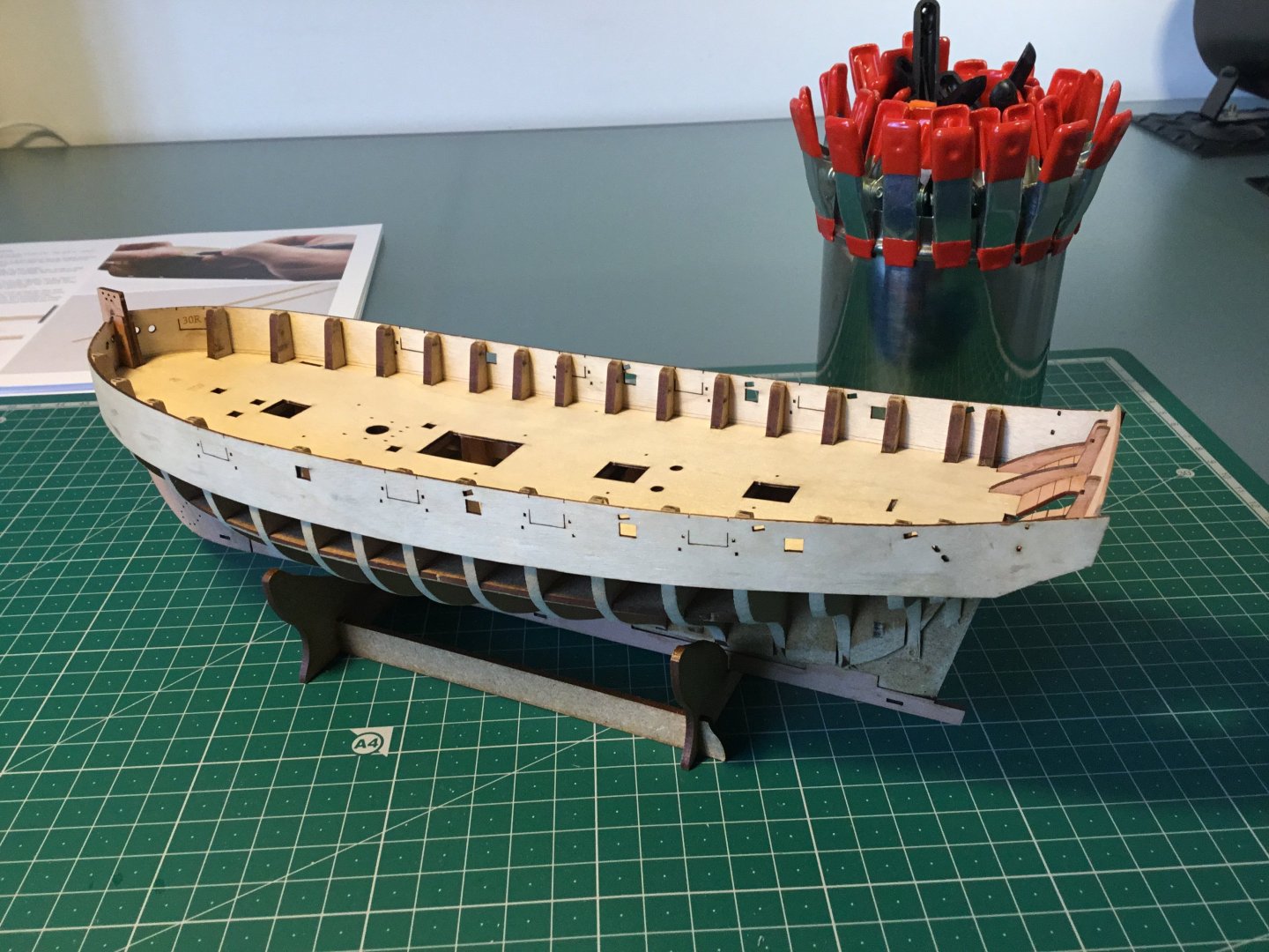

Please could someone have a quiet word with the weather people. I’m ready to sand in preparation for first planking, the only problem it’s below freezing in my garage. 🥶🥶🥶🥶 As soon as fit, onward my friends.

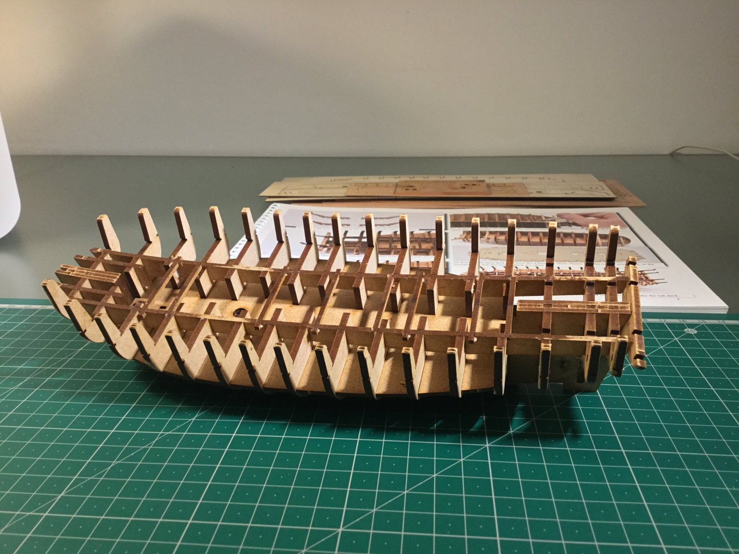

For first planking, dont miss the instruction to edgebend the first plank a little and try to follow the frame.
Maybe you could give us a better picture of the frames.
Maybe you could sand more?
You should always sand the frames after installing, not before!
I’ve checked with a plank and all of the bulkheads sit square.
