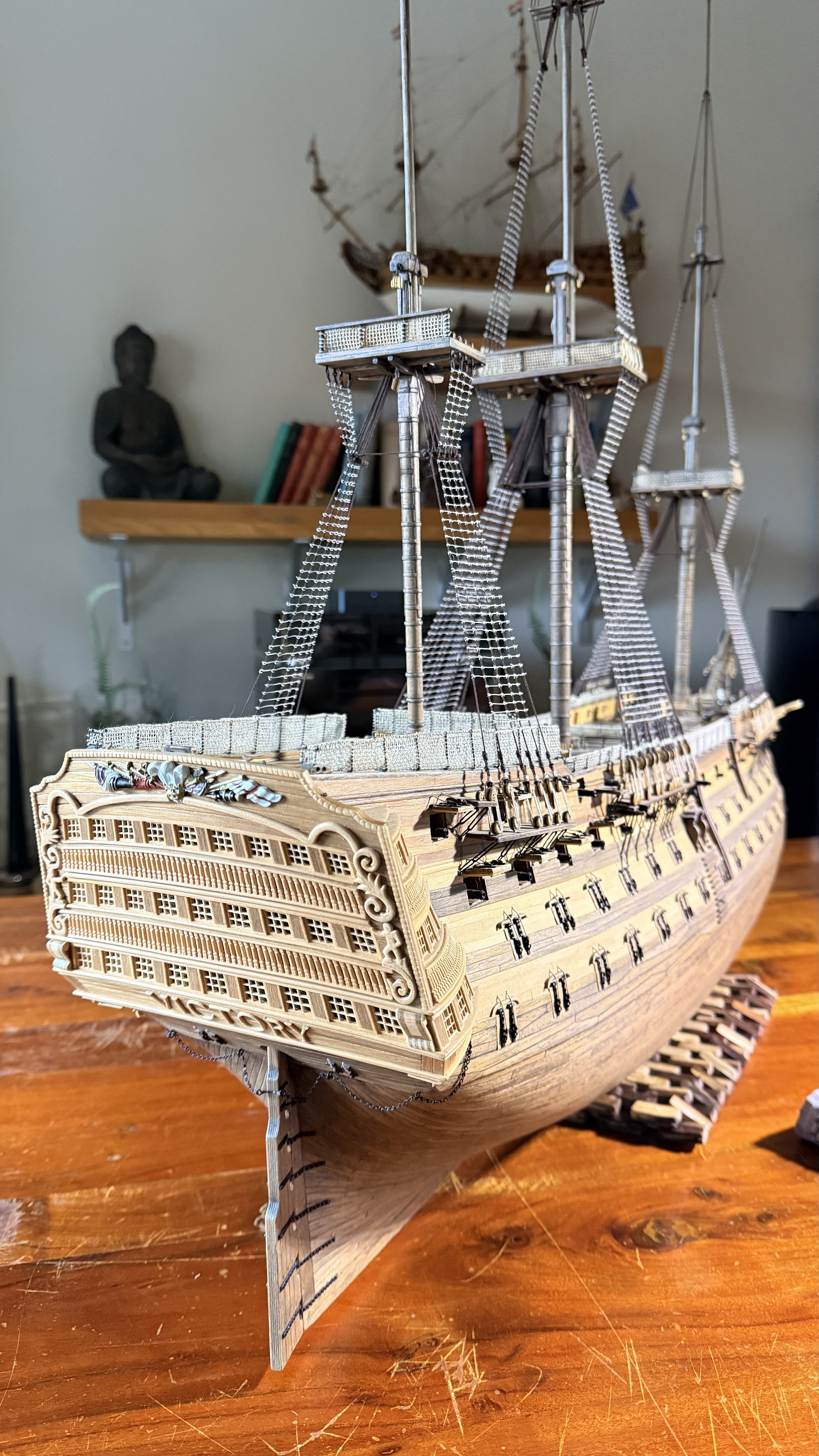

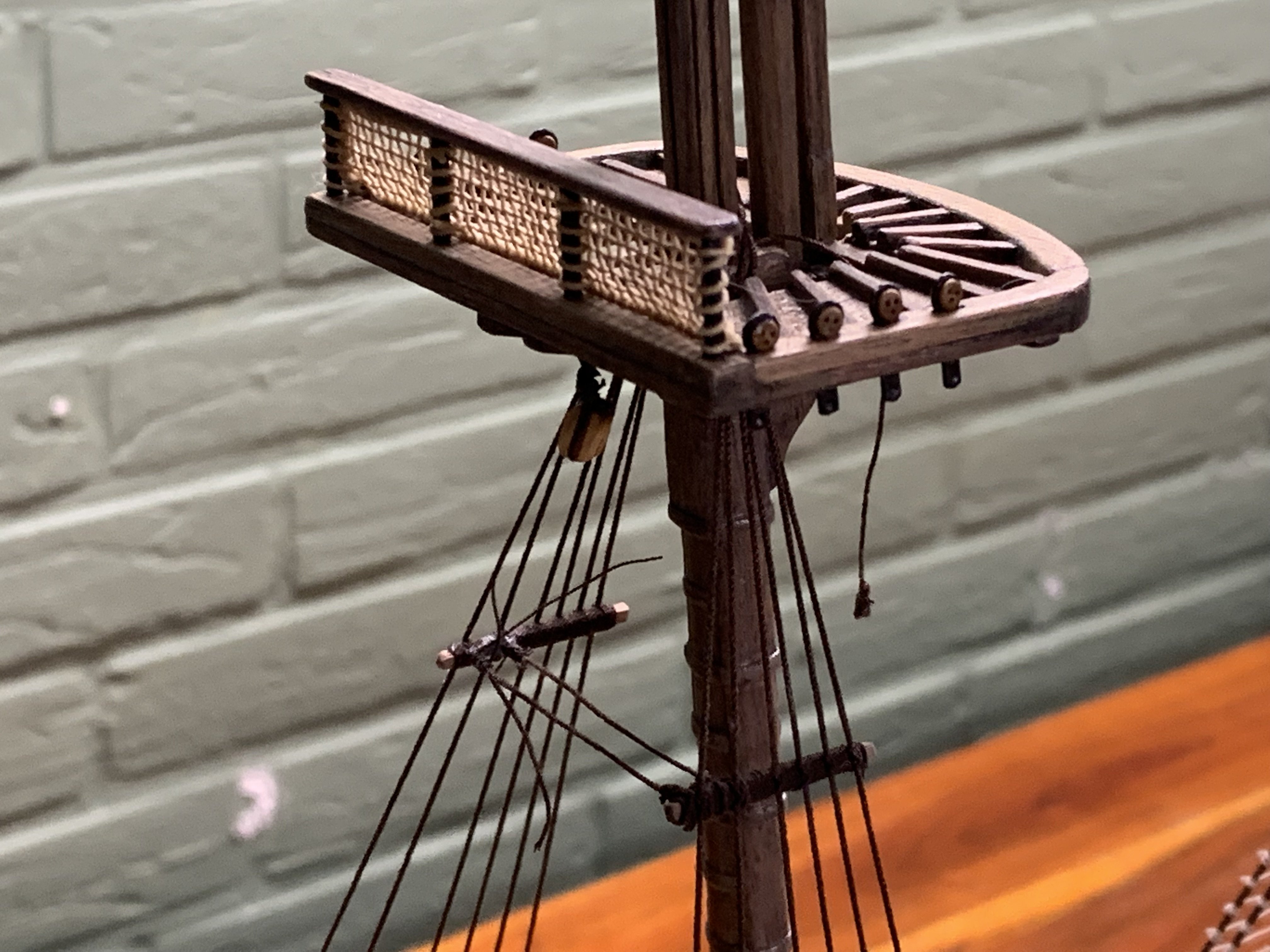

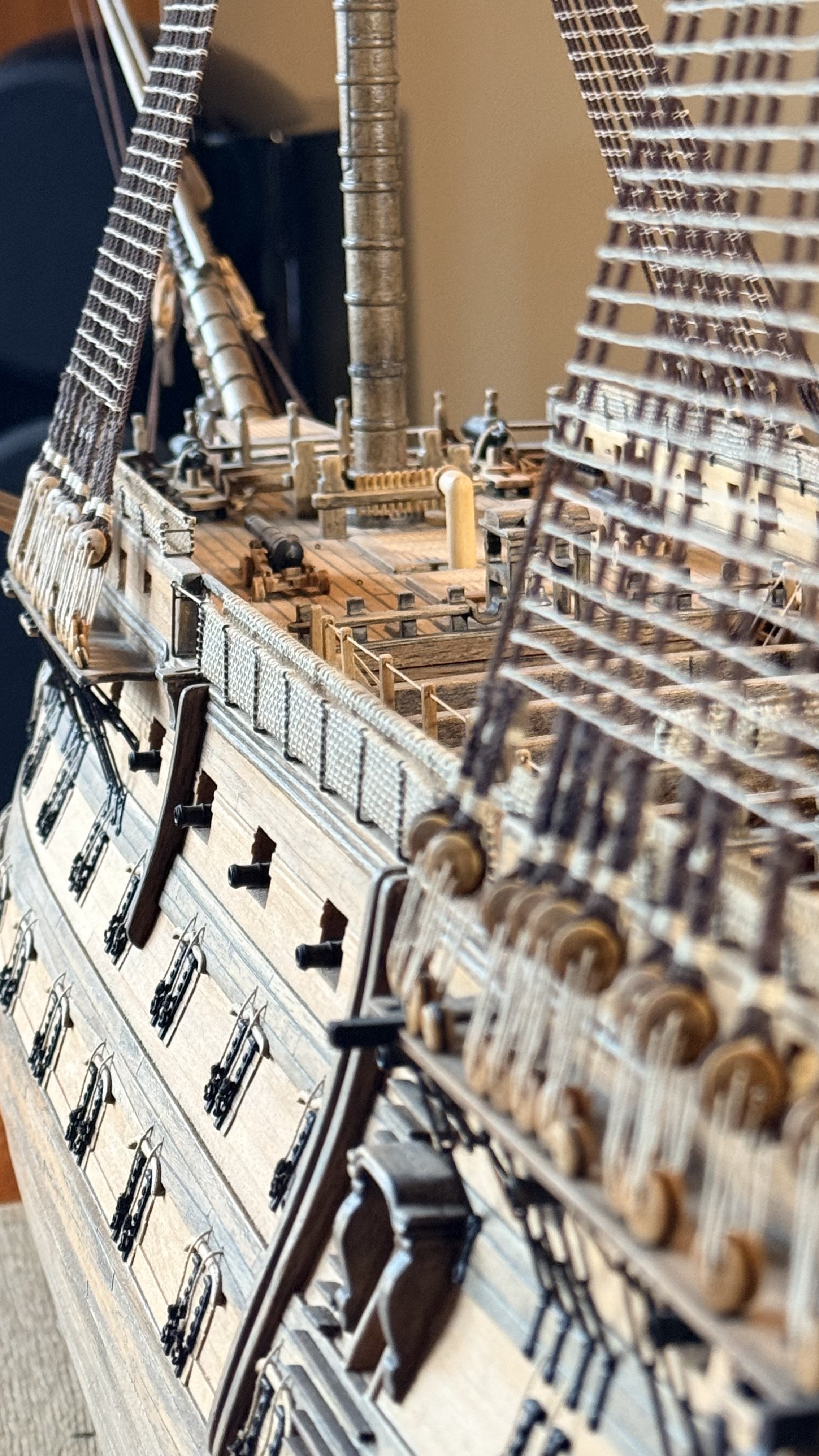

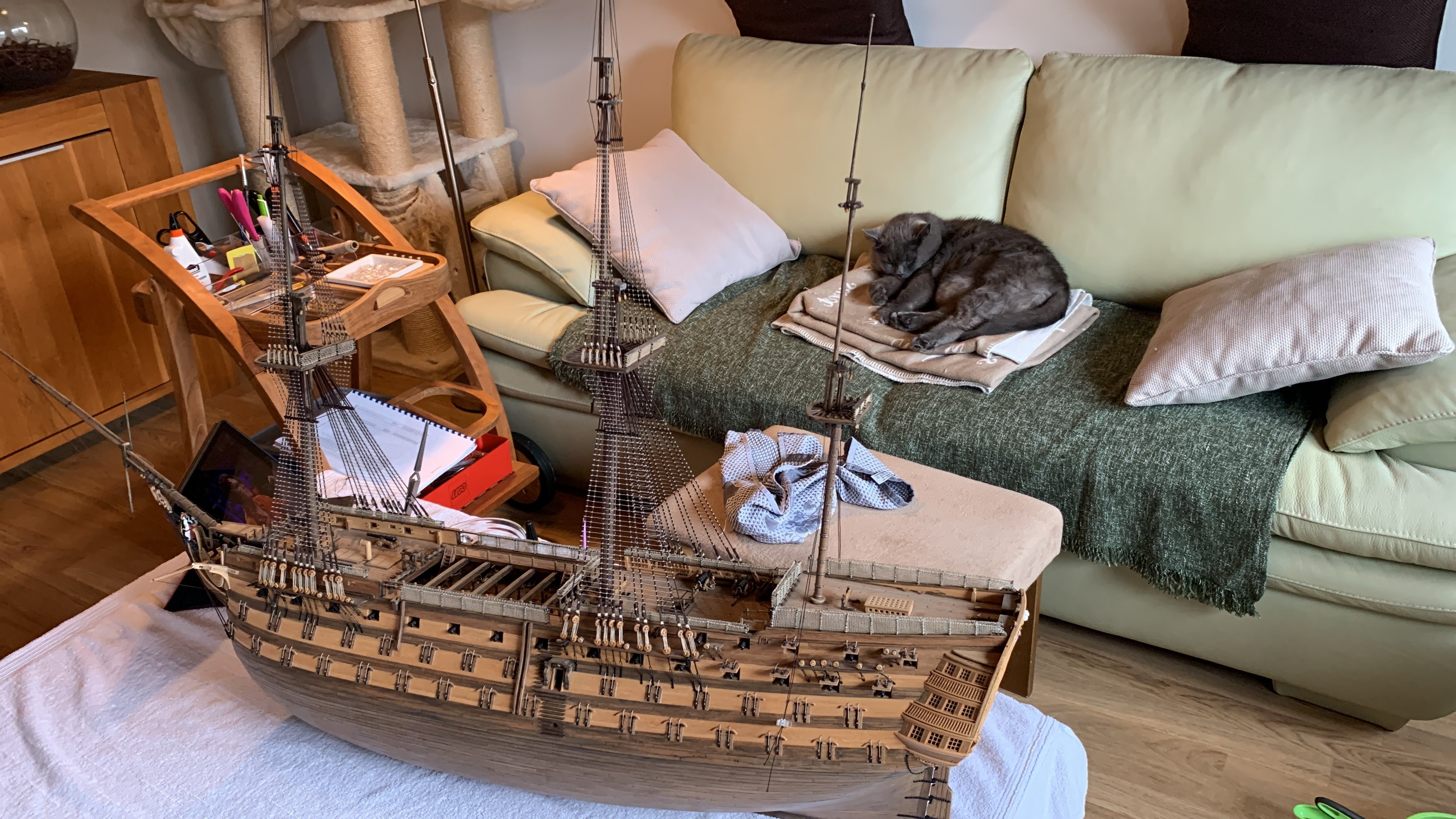

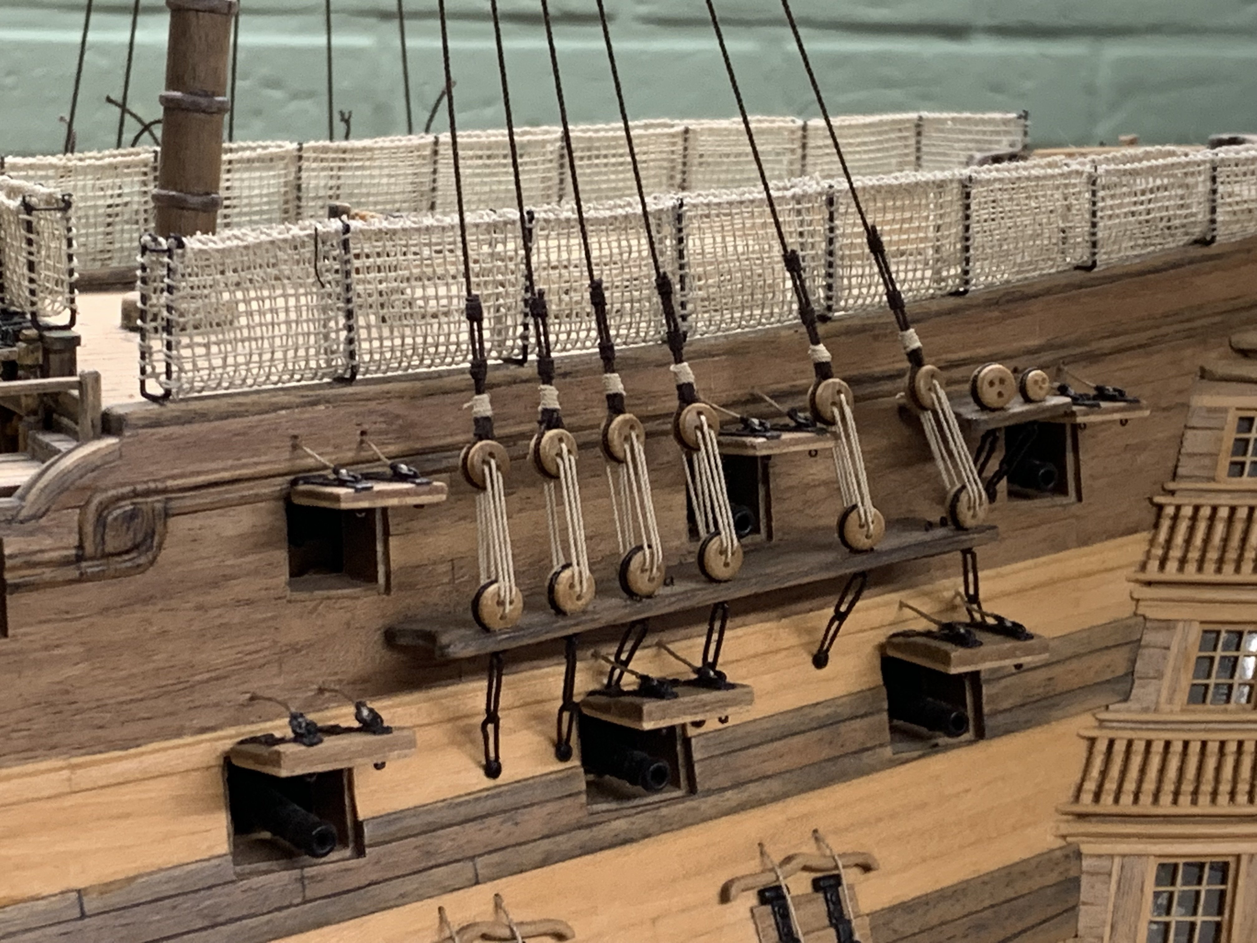

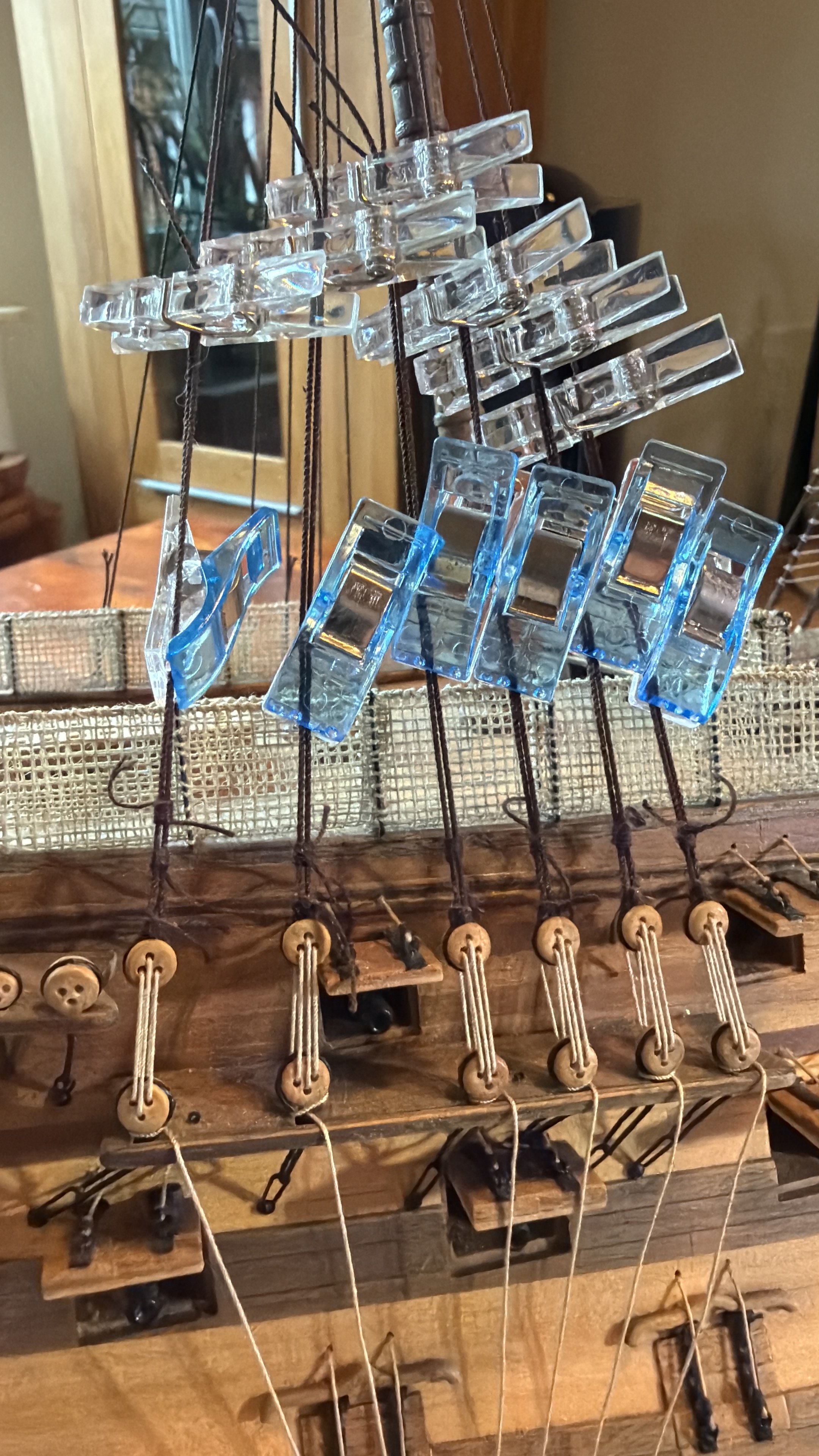

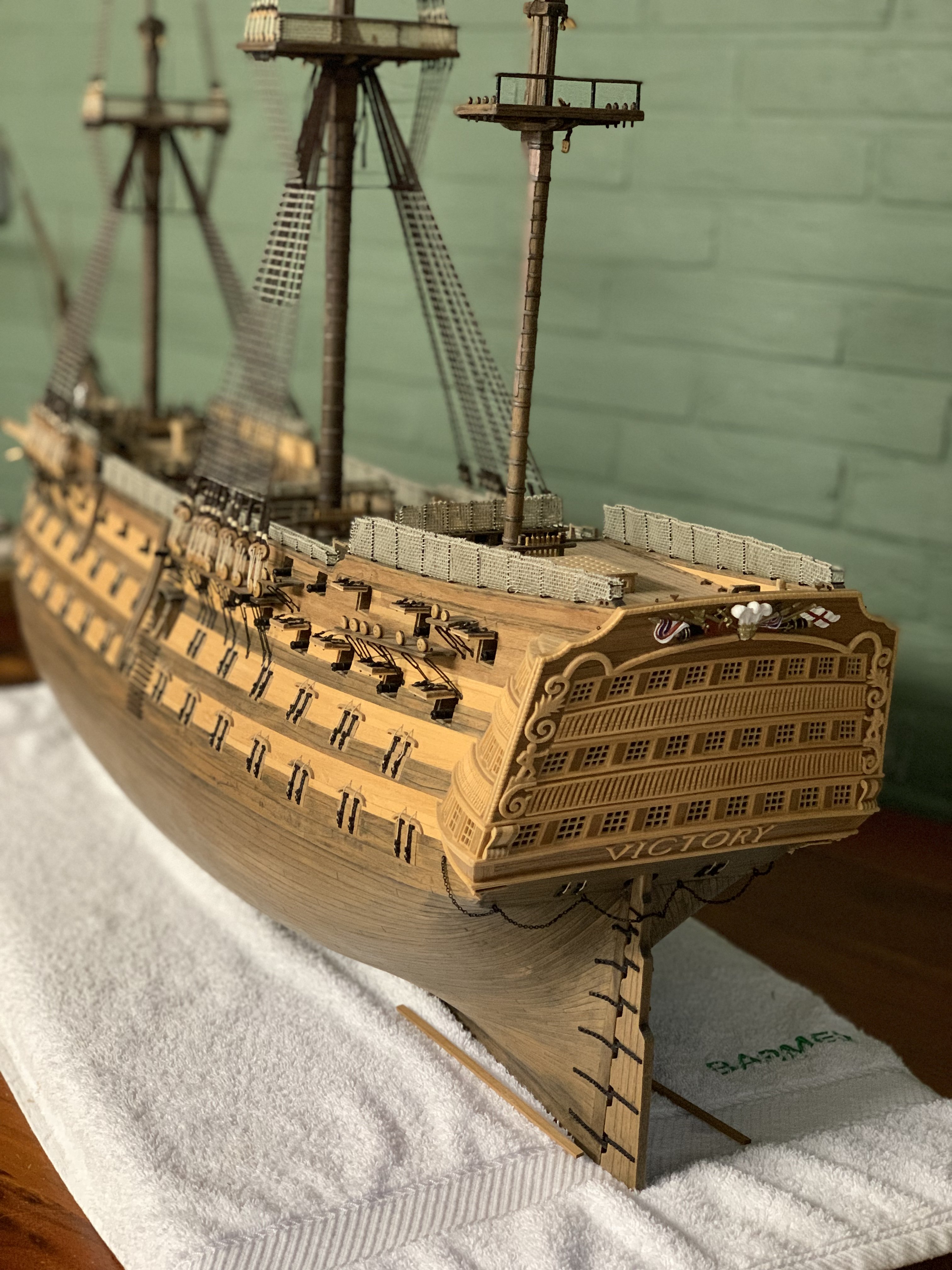

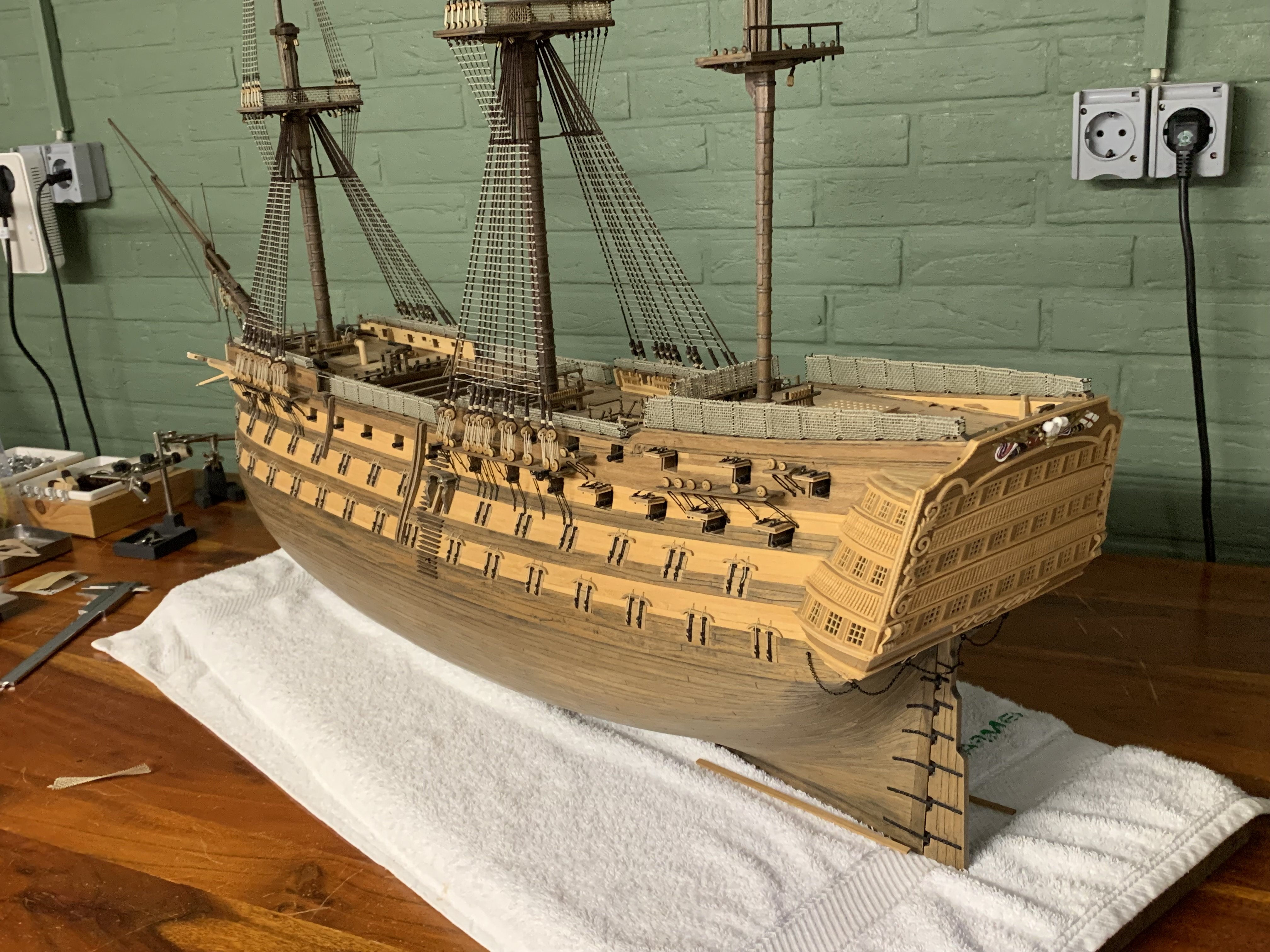

Hello forum!

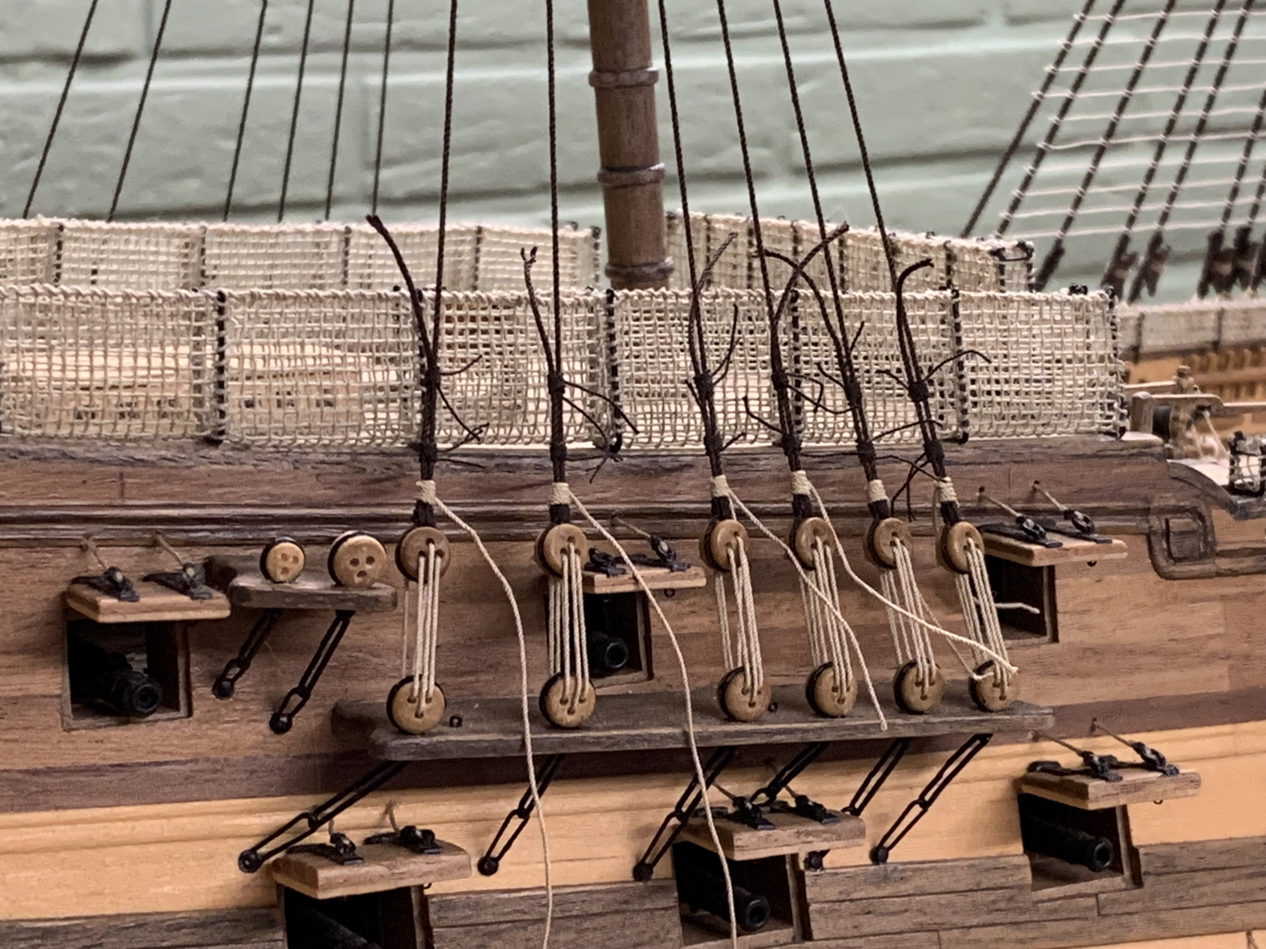

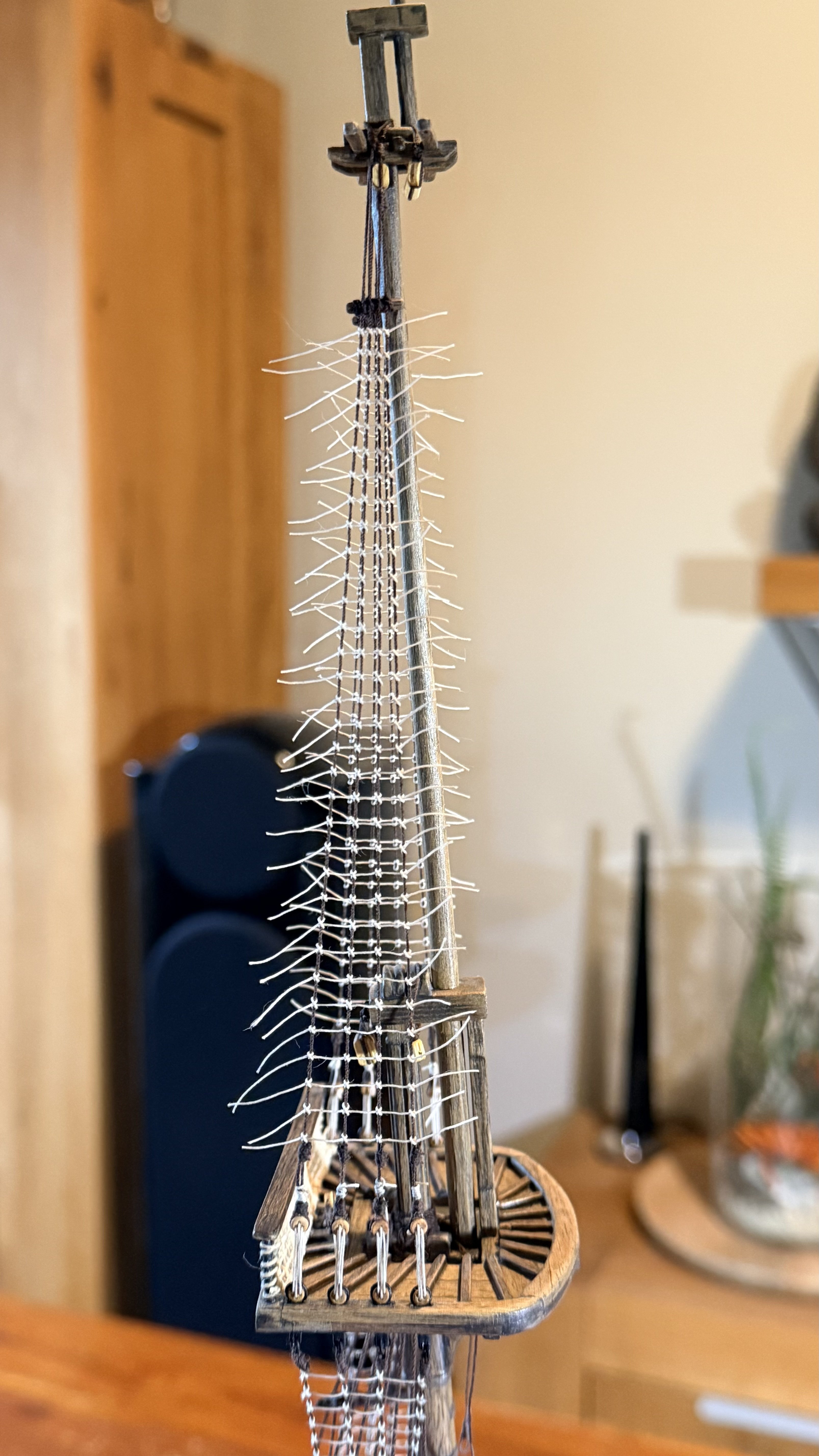

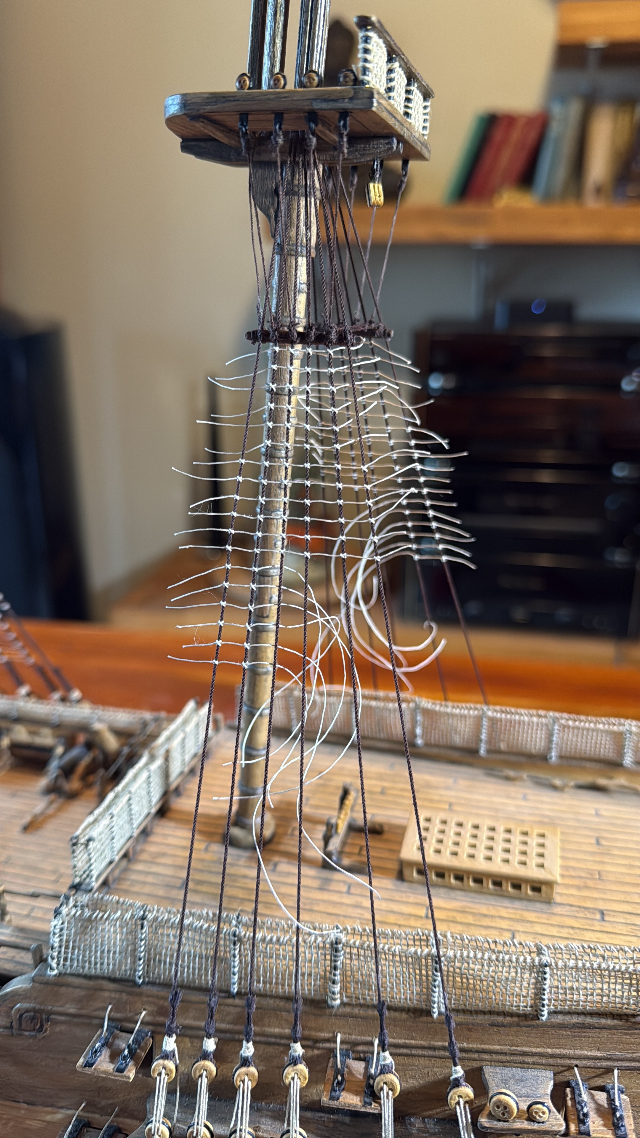

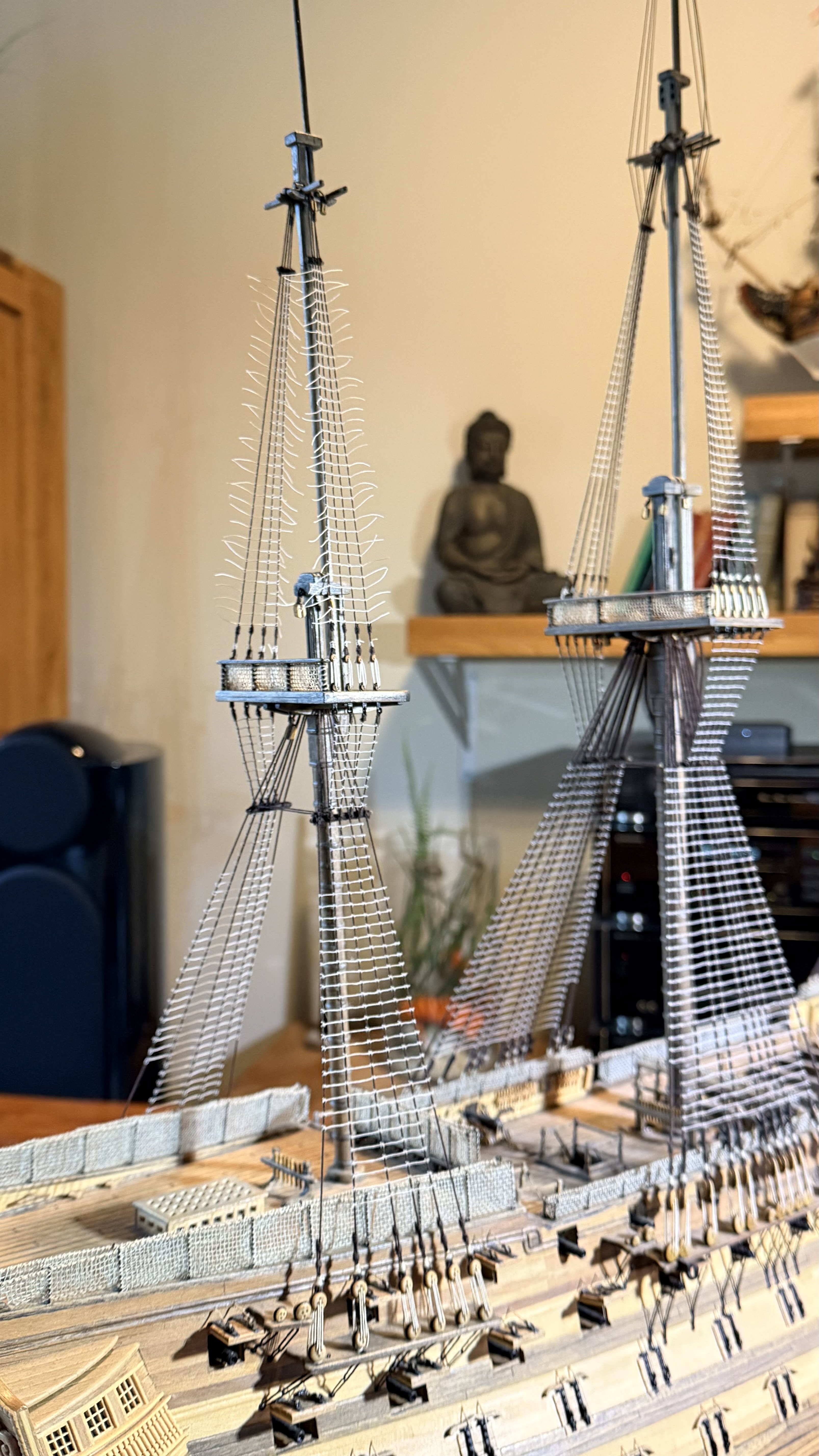

It's been quite a while since I've been active on this forum. And I must admit that I've hardly worked on my Victory during that time. In fact, I was very depressed because I had a lot more problems with the rigging than I had imagined.
I just couldn't get the shrouds tight enough, so they kept warping with the webbing lines. The result was terrible, at least in my eyes. I tried several times but was never satisfied.
After spending some time working on other things, I wanted to give it another try. It's still not perfect, but I'm finally satisfied!
I don't have many new photos to show you, but the latest ones are really up to date.
Greetings and best wishes to all model builders!!!

Definitely worth the wait. The tops, ratlines, shrouds and netting, she’s looking great. Welcome home sailor, welcome home.
 Mort
