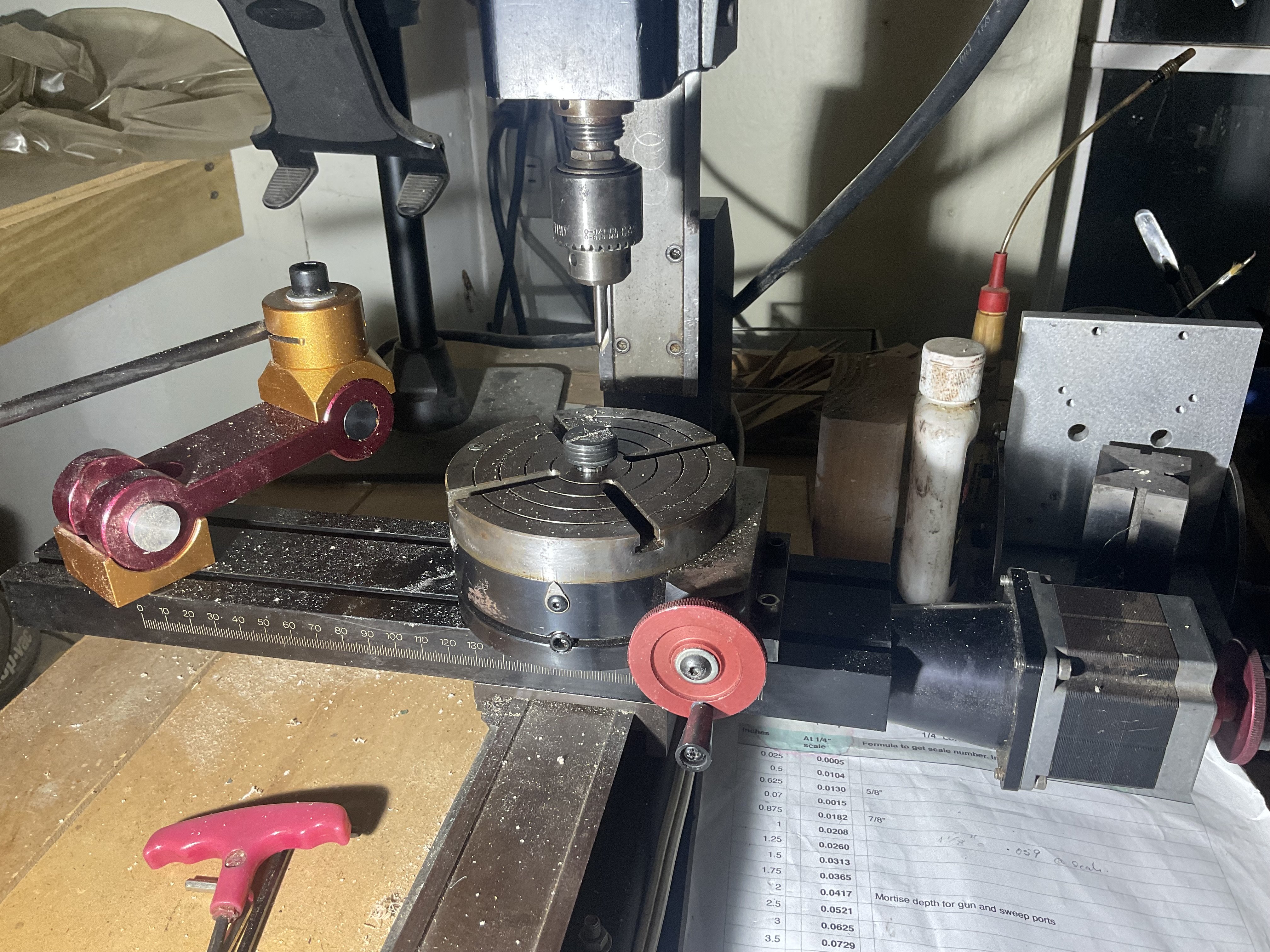

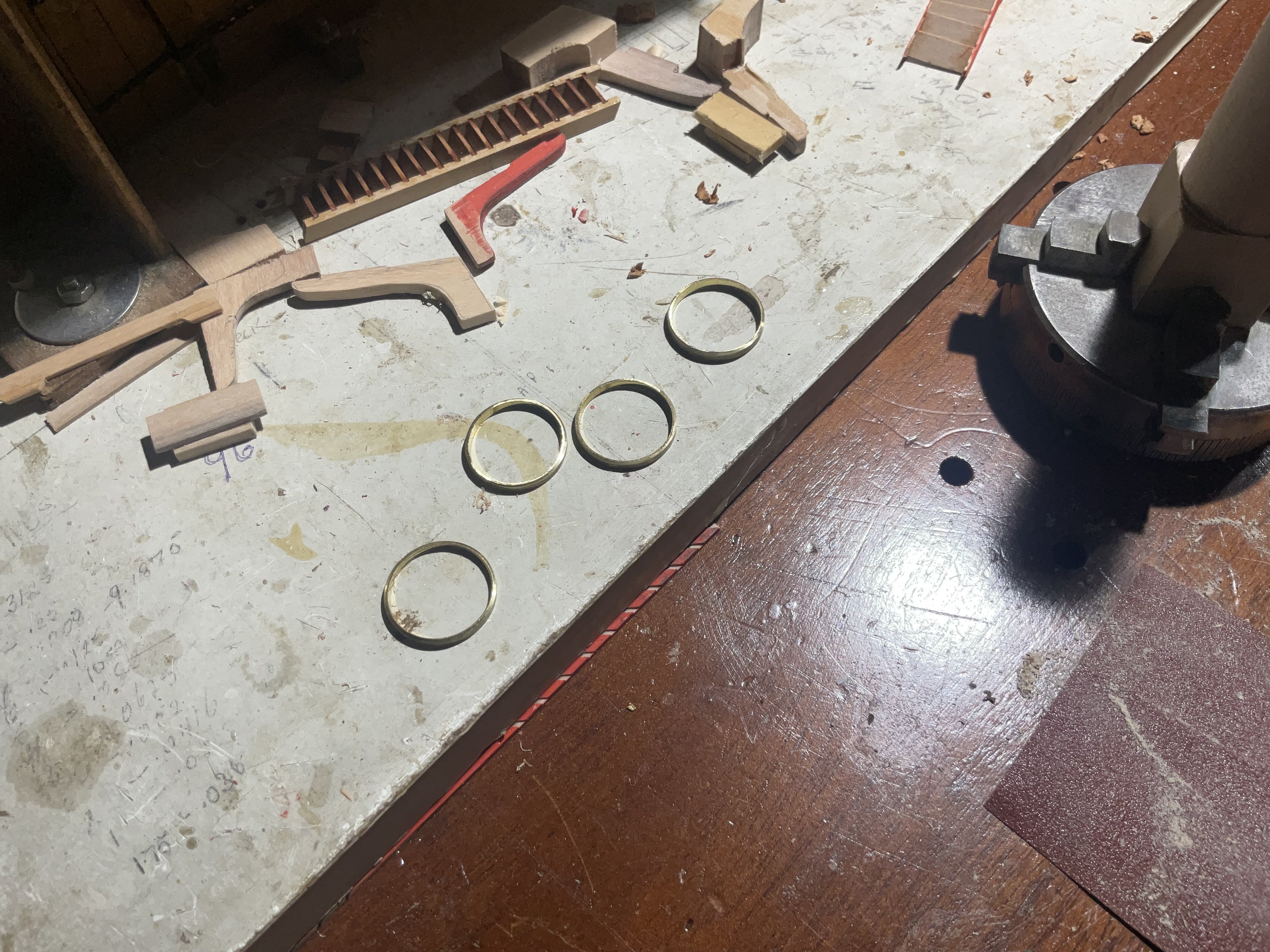

I actually had the correct center drills but when i checked on them i only had one left and it broke as i started using it, i just did not film it. I had lots of other ones but they were all too big. . I will replace them in due course. The dental bitts work great and give me a nice starter hole. They are also very robust. I have since ordered a number of them from the local dentist supplier as they can be purchased locally. Dentist seem to use them a lot. Once i use cutting fluid the drill bit never get hot and last a long time. i did speak to Sherline before Christmas and they were very happy to redo the laser numbering on the rotary table at a cost of $60 per hour plus shipping. I will take it up on the next trip as the freight from here would end up costing more than the tool itself and Mr Trump might want to hit me with another tariff. my next big purchase will be a digital readout for the mill. I have needed to bite this bullet for some time now. It will save so much time with initial setup. I have to say it was quite a challenge to get the rebate for the brass insert to fit perfectly. The readout would have helped greatly with this and make repeatability so easy. And boy that quick change post is just great. Of course i was so excited to fry it i broke one of the cutting tools on the first pass. Good tools are such a pleasure to work with. .

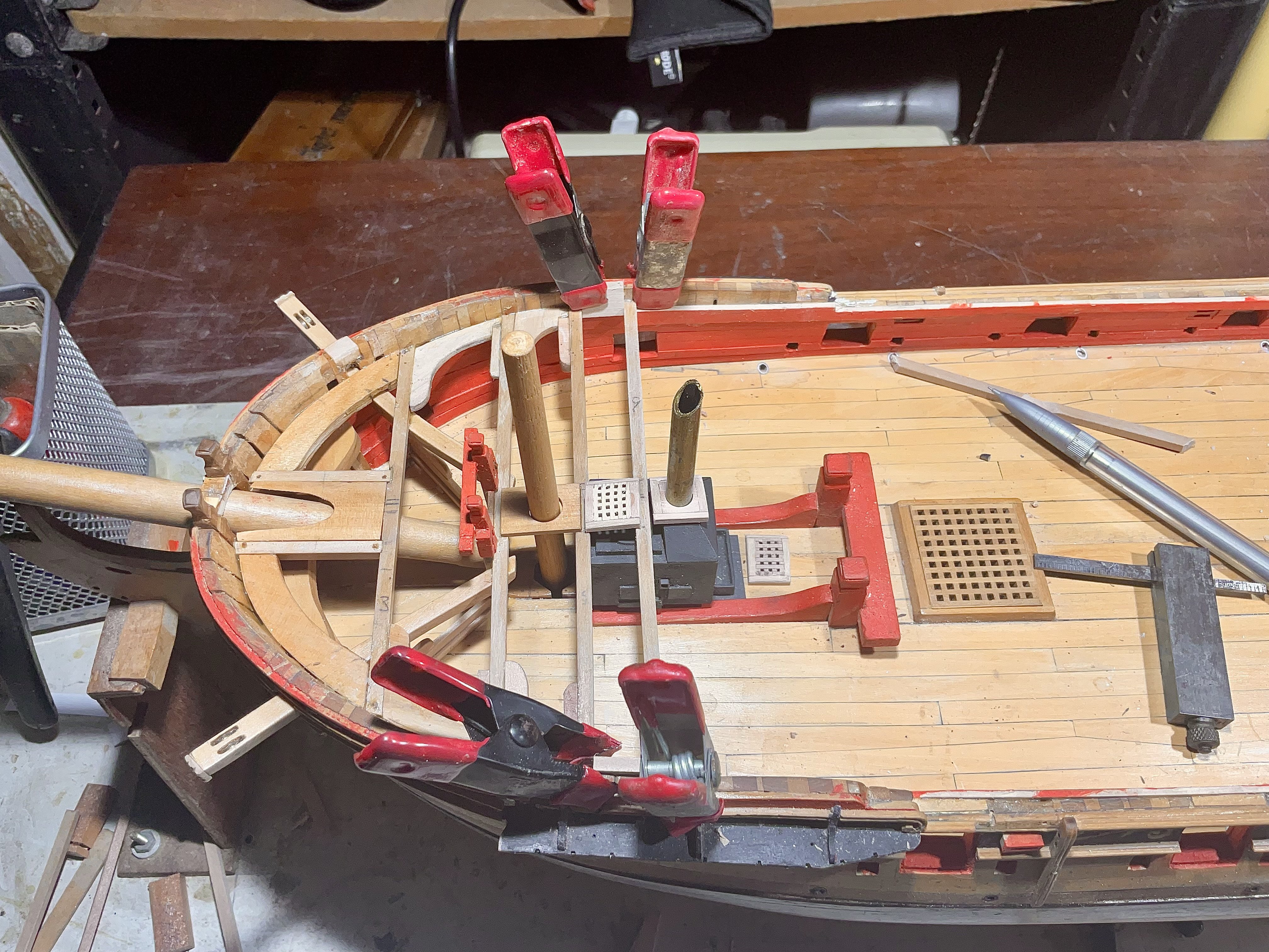

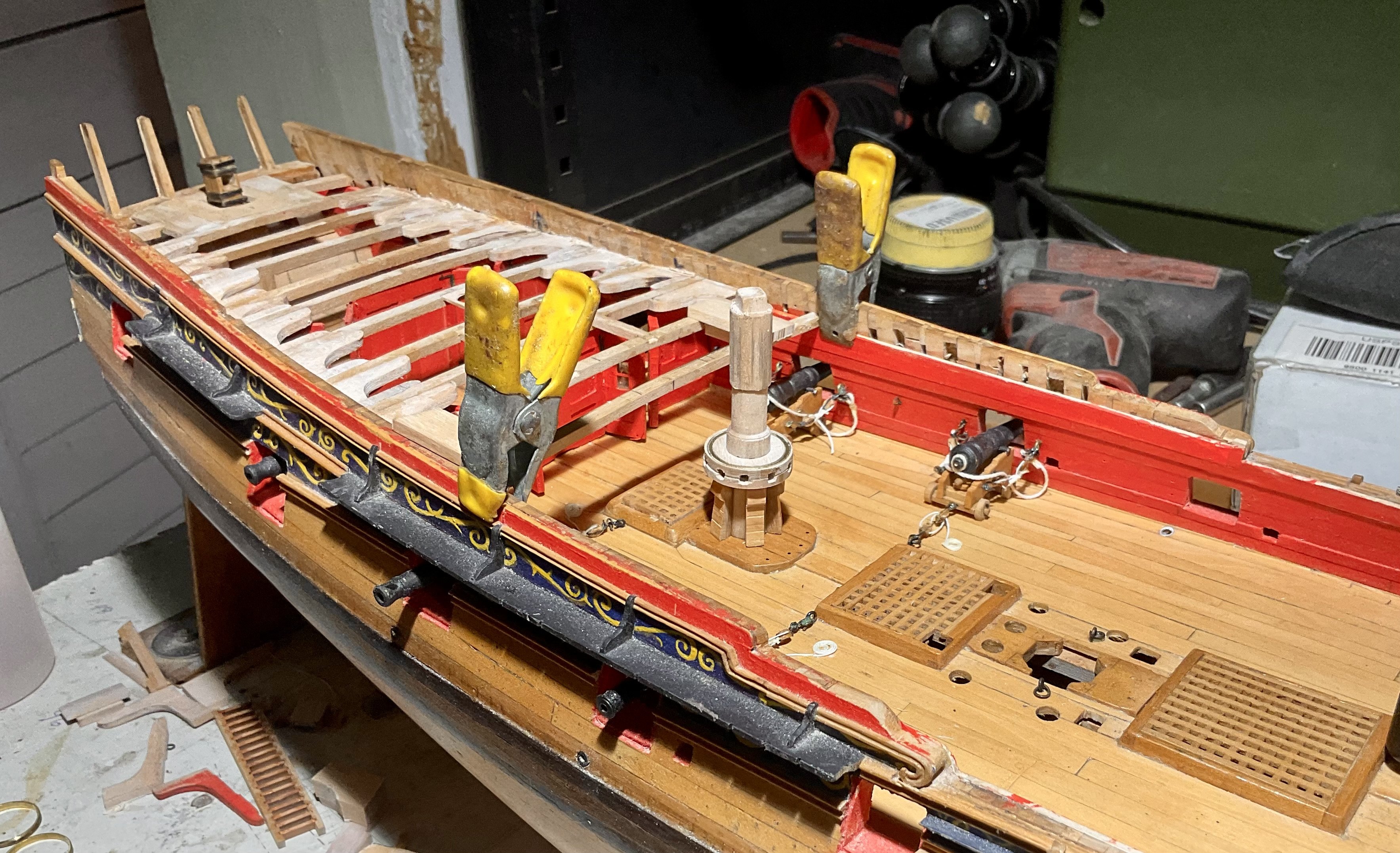

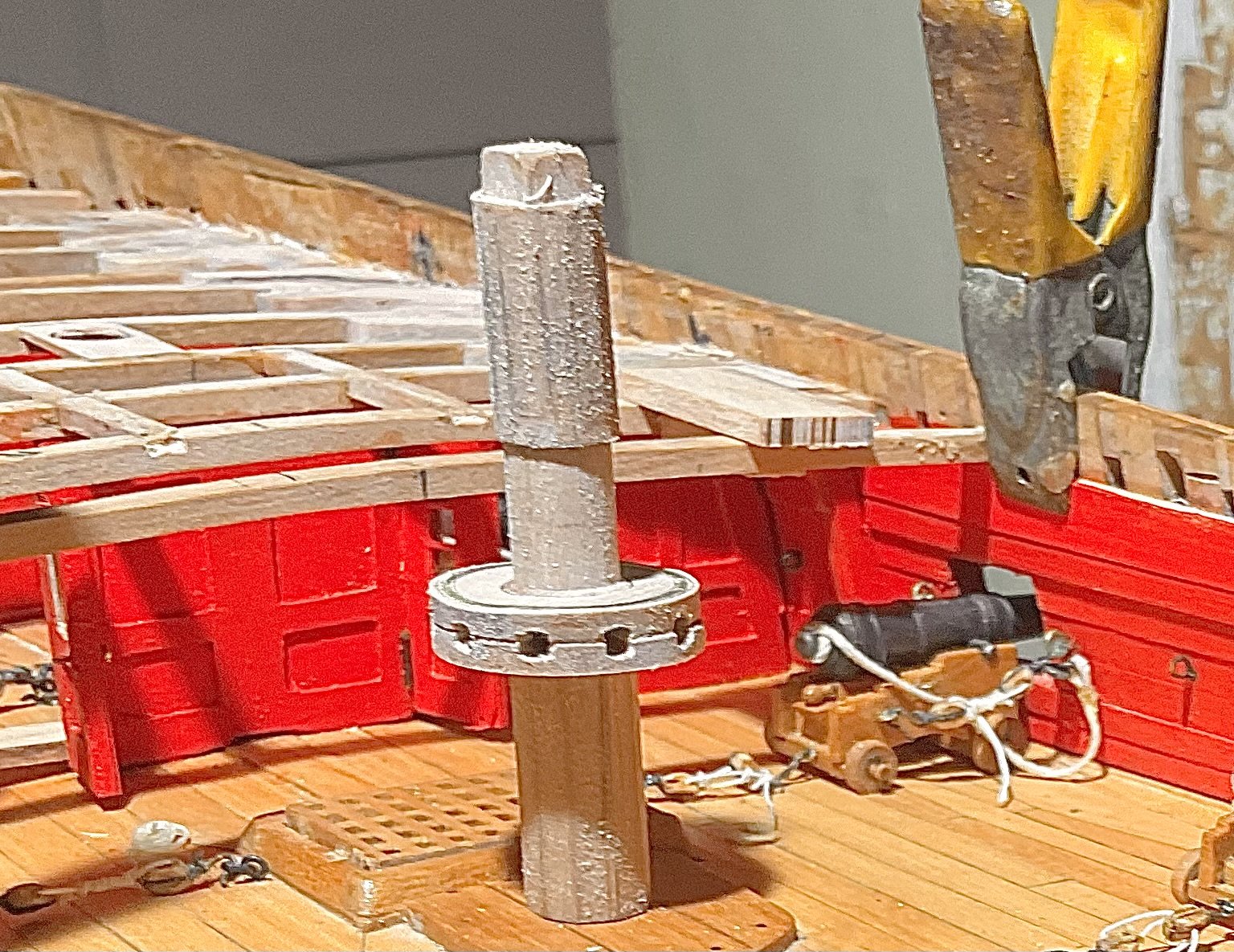

Finial fitting of the lower Capstan. I had to fit the last two beams which are slightly wider than the rest to be able to get the finial height of the barrel. . Then added the partner and adjusted the Barrel so it is just above the level of the partner. That is it for the year as I am off to NY to cut down a christmas tree and role in the snow. Thank goodness for alcohol.

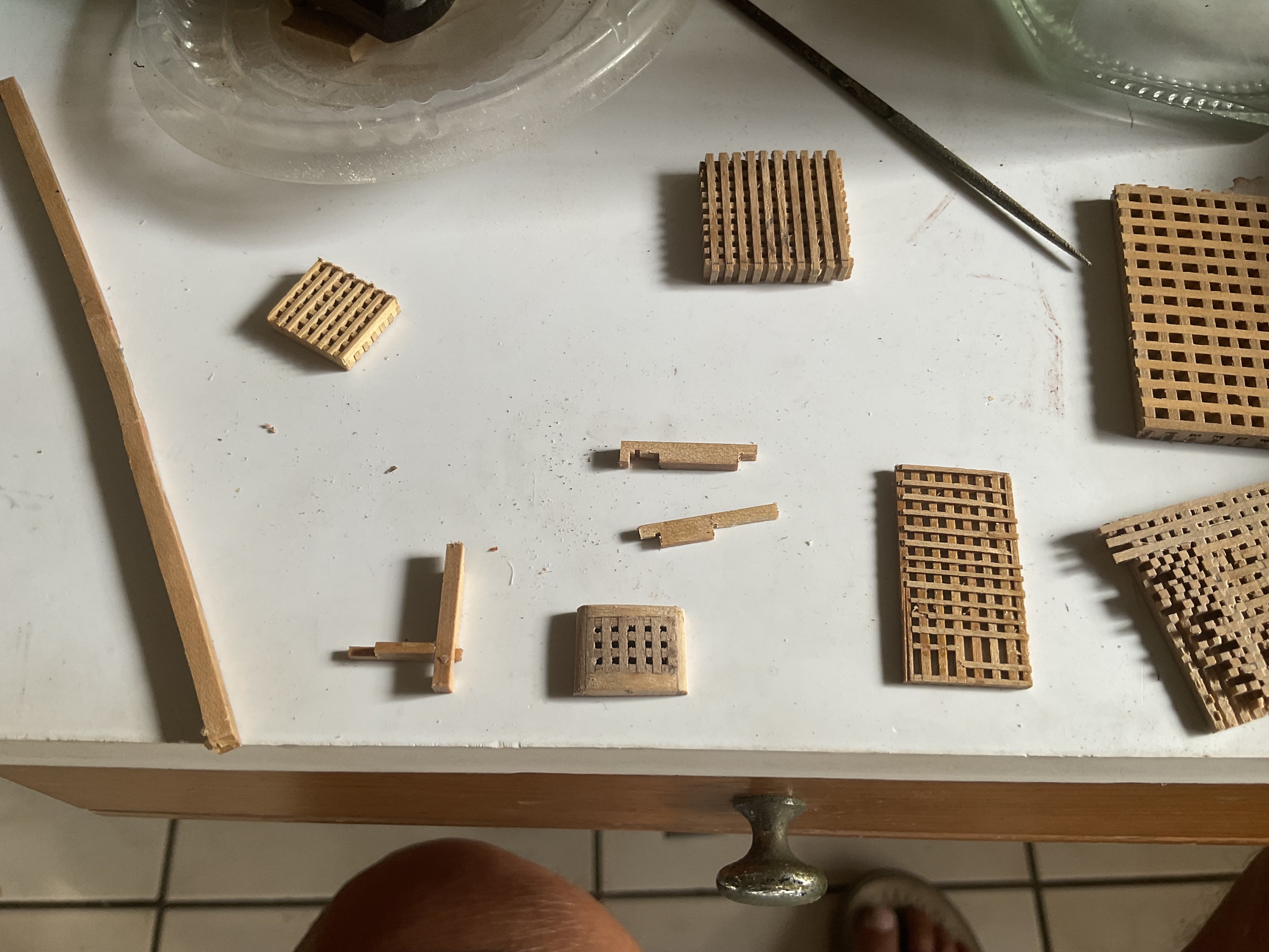

Hi Greg all my new tools are waiting for me in NY, nice new mill ends, the quick change for the lath, new mill ends, Mito_tuyo Caliper, edge finder, parallel for the mill etc . i wrote to sherline and they did say it was laser etched and that i could send it back and they would redo it for me for only $60. Plus freight. When this is all over i will send it up some time next year. I was hoping they had a tape that i could stick on the side, they thought it was a good idea but have not been forthcoming. The square hole were not done that well done because i did not have the correct size mill end and i used a center drill which i knew i would give trouble. When i get back in January i will be redoing everything and filming the process as i will have all the correct tools. i also had some creap with the deck beams so have to cheat a bit, the Capstan center hole lines up perfectly, so at least that good. Its nice to get back on the mill and lath. best regards kevin

Yes Alan i do have very fine chisels. But i want to horn the technique to film it so that i can share what Greg showed in the book. The reason i had trouble cutting the squares is that i did not have a mill end the exact size so used a center end instead. I was more interested in the technique than in the exact finish. I also went about constructing the part different than what Greg showed in the book. Stretching my skill to try figure it out my self. . Next time i will construct it the way he built it and then decide which method is better. I need some new mill ends to do it his way. I only have a few days left before i leave for New York so the next video will be last week of January next year so i have time. Also my rotary table has most of the numbers missing so i have written to Sherline to see how i can have them replaced. perhaps with a sticker. Failing that i will just have to mark the major stop points temporarily. Thats the only way to get them to line up exactly. also Greg used a dark wood insert, Ebony, i used a brass strip which was not the correct width. I may stick with that as it worked well, but might try cutting it out of a brass sheet.

I did not have the correct size mill ends to cut the square holes. This is my first attempt. I will pick up some when i am in New York in 2 weeks time. I am not unhappy with this 1st try and know ill get it better. Some of the markings on my rotary table have worn off so it makes it difficult to cut the holes spot on. Trying to solve that issue.

Greg I did use the dial indicator and it did not need any adjustment. The only issue I had was turning the cutter head in the wrong direction once.
