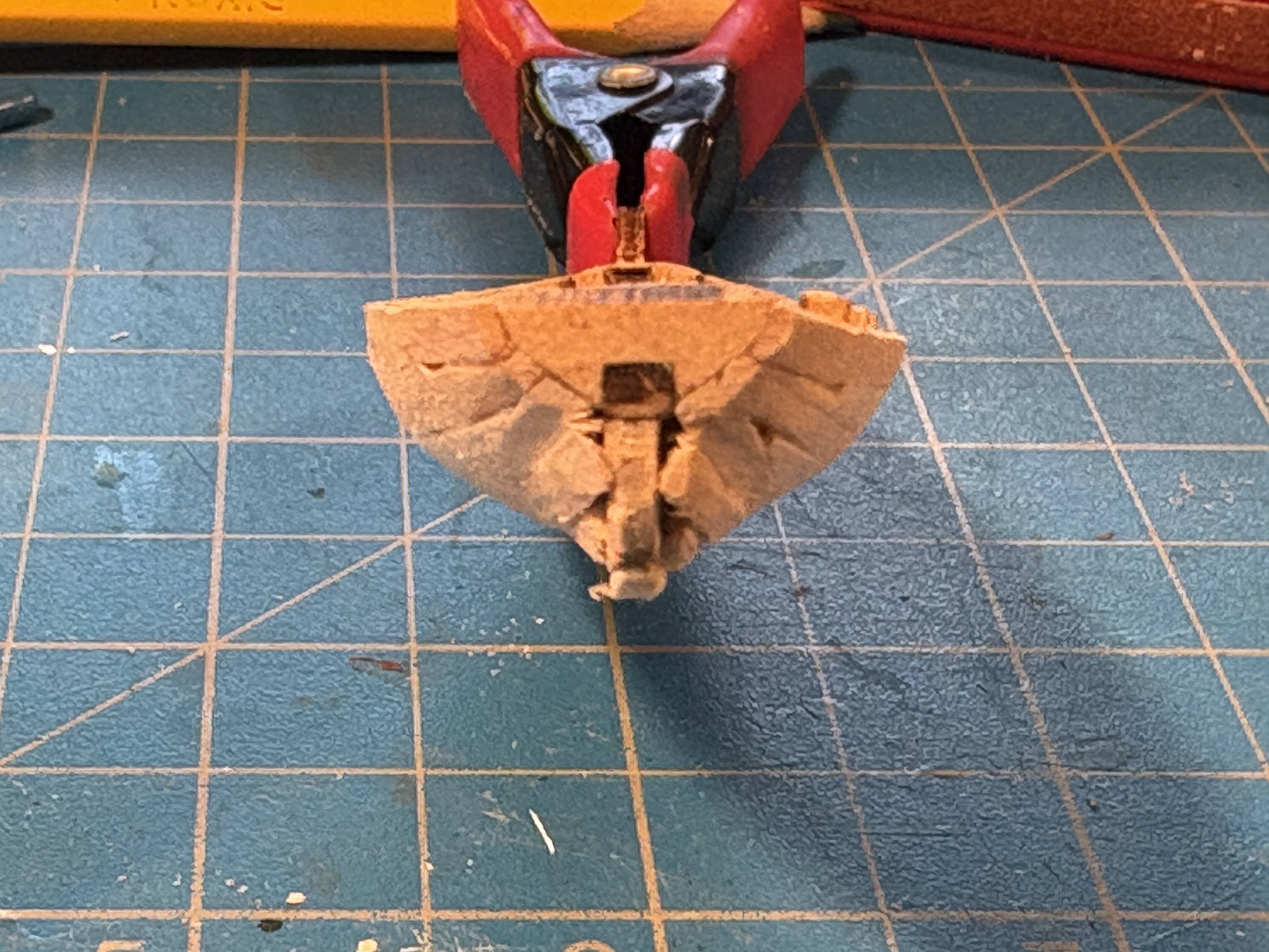

Years ago I used Bondo, but it's fumes are terrible and I don't use it (or recommend it) anymore. I think it was Nic at BlueJacket that suggested spackle, which in my experience is used mostly for small holes and cracks in drywall. It's most commonly found in powder form, which needs to be mixed with water, but I found some spackle paste lying around the house, which is pre-mixed. I usually find myself "digging" a shallow hole in what's in the container and mix in a few drops of water to get the consistency I want. I find it works really well and is very easily sanded. Only drawback is that it's white, so it's only appropriate for wood that's going to be painted.

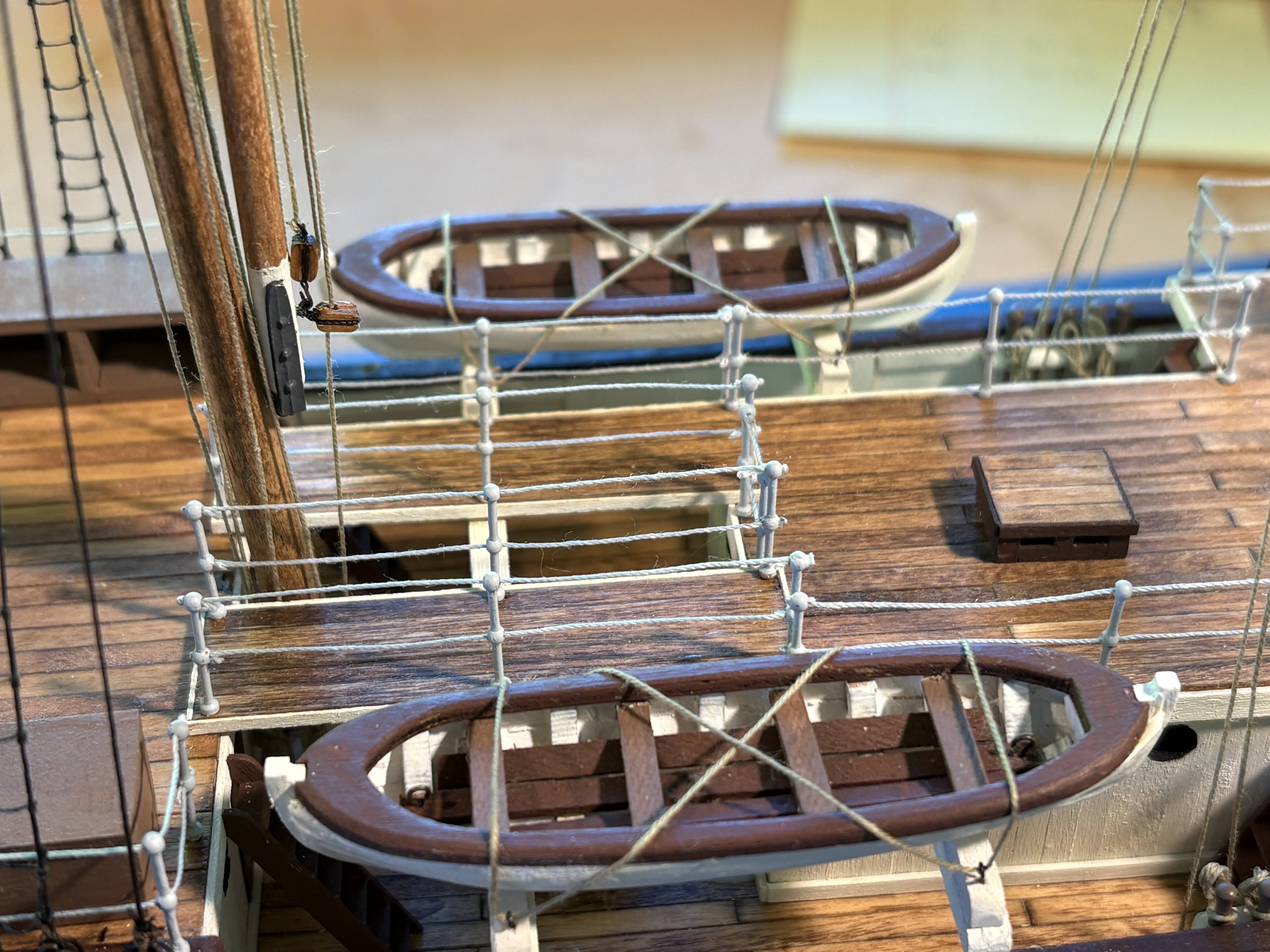

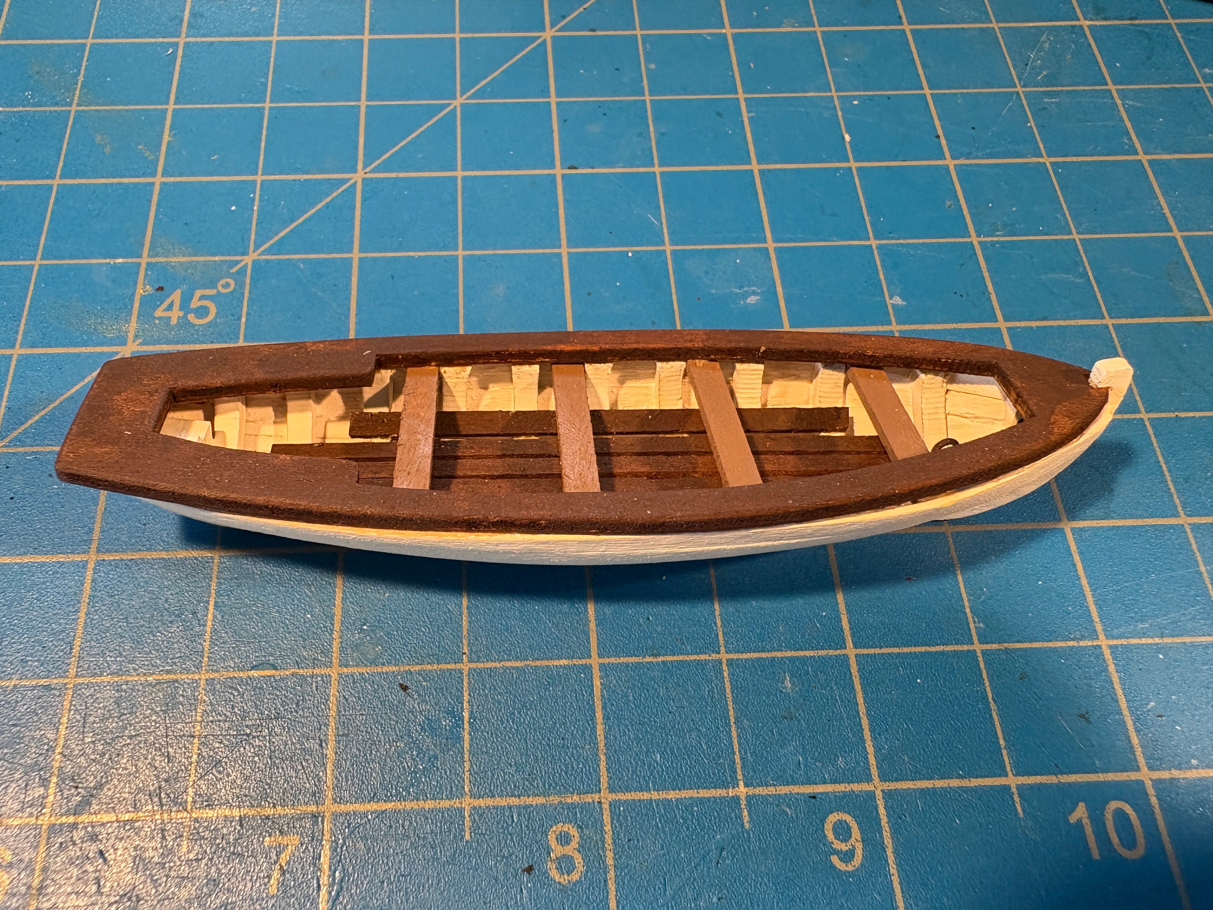

Six or seven weeks have gone by since my last post, and all I have accomplished in the meantime is building the one remaining ship’s boat and building and installing davits for it to hang from. Some great travel and nice autumn weather have kept me outdoors and away from the shipyard. As I did with the forward pair of boats, the lower block of the tackle is attached to the eyebolt in the boat’s hull with a hook; obviously that block would not likely be tied to the eyebolt as OcCre would have you do it. This time I cut the line in that tackle long enough so that I could make a rope coil to hang from the davit. The coils look a lot better than what I did on the opposite side, where I will do a do over. The light at the end of the tunnel is getting brighter, but still a number of things left to do. 🙂

I don’t think I have seen any photos of the aft ship’s boats showing them anything other than hanging out over the water. In the photo below, it appears that the davits are not high enough to lift the boats over the railing and onto the deck. And once the dog kennels were added, there would be no room for the boats on deck. I made the davits the same way I made the forward boat davits, bending 2mm aluminum wire around a marker pen. This time I had to make fittings (or straps?) to wrap around the davits, attaching them to the sides of the hull. For this I used 1mm aluminum wire, the same material I used in making the anchor davits many months ago. After giving it some thought, I made the “legs” of these straps of unequal length, figuring I would insert the longer leg into its hole in the hull, then bend the fitting a minute amount as needed to get the other leg in its hole. Easier than trying to fit two legs into their holes simultaneously. In rigging the two tackles, I cut the thread too short; it would take quite a bit of rope to lower the boat into the water. I had too little thread to make a realistically robust rope coil, and I found it very difficult to coil what thread I had left to work with. In retrospect, I should have made separate rope coils from separate pieces of thread and fashioned something to hang them from, as I did with every other rope coil on the ship. As can be seen in the photo below, I had particular difficulty with the coil on the left. The saving grace is that these meager attempts won’t be all that noticeable in the overall scheme of things. And I’ve been giving some thought to a do-over, but haven’t quite gotten there yet. Now, I need to build the other boat and its davits. And finish the ratlines and some standing rigging on the mizzen mast. Who knows, maybe my next post will have “Finished” appended to the topic title. If so, it will likely be well into the fall before it’s posted.

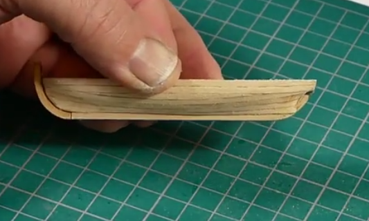

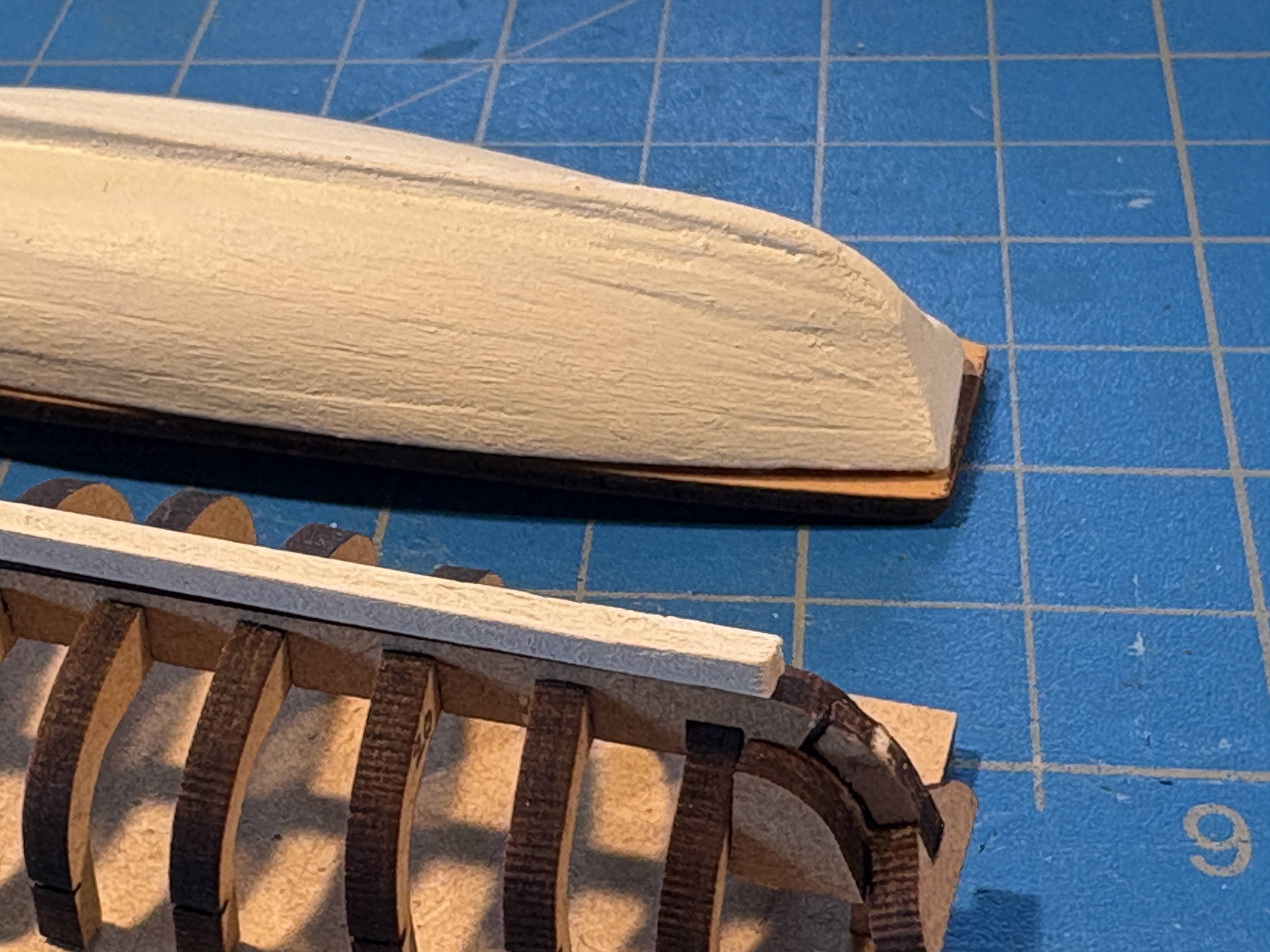

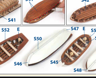

A month since my last post, and the only thing I have accomplished is building one of the two remaining ship’s boats. Ah, the joys of summer. As I mentioned in previous posts, these boats are larger than the ones I have already installed. Additionally they have a transom, while the others are double ended. The plans I have posted previously show none of them to be double ended and all to be about the same size. There is a mistake in OcCre’s instructions. The instructions show a piece (S47) butting up against the end of the keel (S50), while in actuality, that piece butts up against the transom at the upper end and the false keel at the other end. The aft end of the keel needs to be rounded or tapered to flow seamlessly into the false keel and piece S47. For me, the biggest challenge was shaping the sharp angle where the upper part of the hull, along the transom, meets the lower part, along the keel; a challenge mostly due to the small size of the boat. As is usually the case when I’m planking, things looked downright ugly before sanding and filling. 🙂

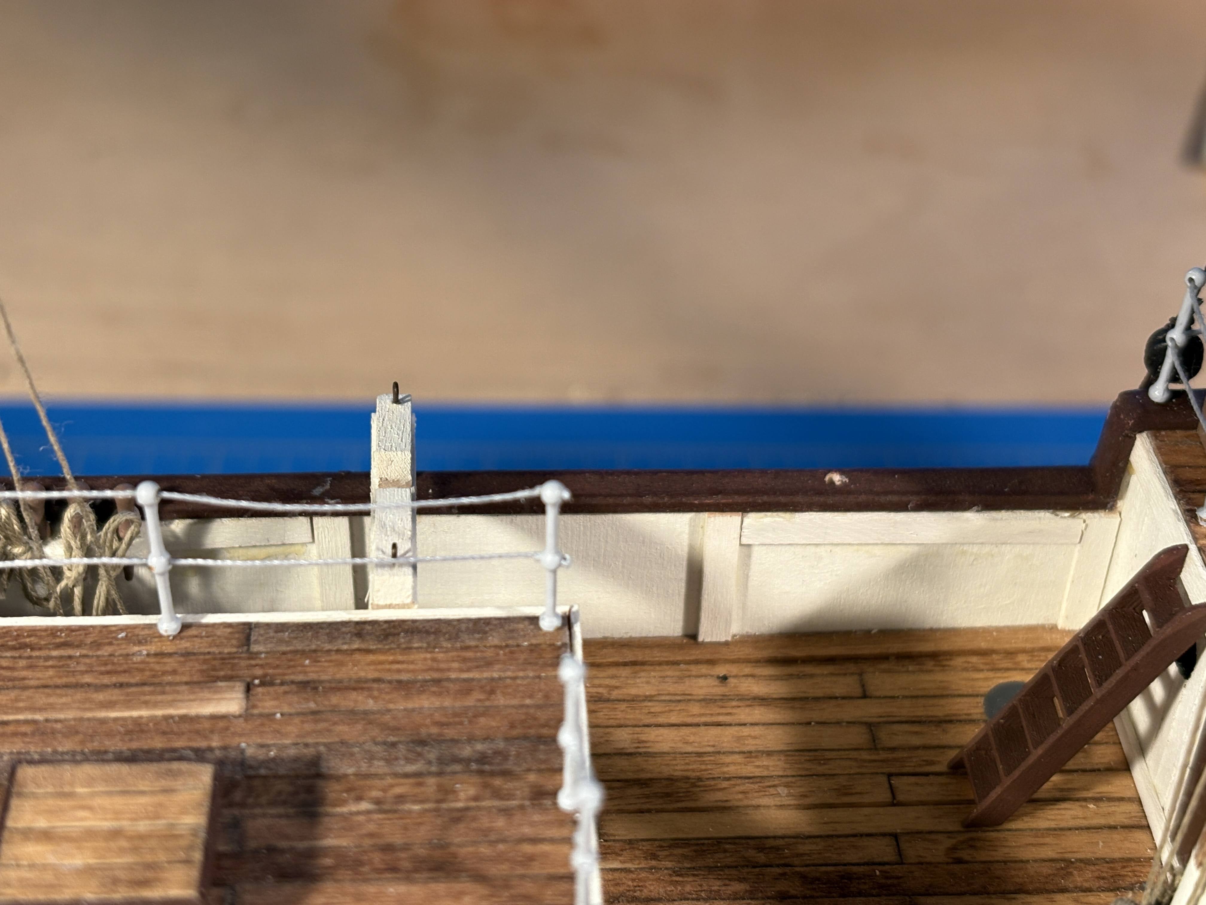

Thanks for the kind remarks Mark. I had some fun putting the boats and davits together. About a year ago, I installed railings on deck, using realistic looking brass stanchions I ordered online from somewhere instead of the flat photo-etched ones supplied by OcCre. I Installed the railing that runs around the stern as instructed by OcCre (the railing topped by a cable), and later remembered a photo of the ship which shows a wooden cap atop the railing. Ever since then I have thought about a do over to make my model better match the real thing, but that thought was always accompanied by another thought . . . I’ll approach the issue another day. Well, another day has arrived. Once I decided that the do over was in fact doable, I photo-copied the aft deck plan included in OcCre’s instructions, then cut out the rail, intending to use that as a template, to make sure the fit was right and for cutting out the rail from a sheet of 3/32” basswood I had. The paper was too flimsy to use for checking the fit, so I used it to cut a template from something thicker (an old file folder). I then cut out the rail using an Xacto knife. The result was a little asymmetrical, but I was hopeful that wouldn’t show. Laying it on top of the stanchions allayed my fears in that regard, but I discovered it was a couple of millimeters too narrow at the open end of the horseshoe. Fortunately it could be pulled to the appropriate width without stressing the wood much at all. The point of no return came when I clipped off the tops of each of the stanchions. That took some courage, but I grit my teeth, held my breath, and did it. To stretch the rail cap to the desired width, I drilled holes in each end and slipped them over the stanchions. Getting holes precisely drilled for all the other stanchions was going to be a challenge, so instead I tried leaving a drop of CA on top of each of the remaining stanchions and simply laid the rail cap on top of the rest of them. That worked better than I expected. I’m sure it’s a little fragile, but that’s true of most of any ship model. Unfortunately the rail cap is a bit too thick (I later found a 1/16” sheet that would have been better), but over all I’m pretty happy with the result. Finally, I have now glued the dog kennels in place.
