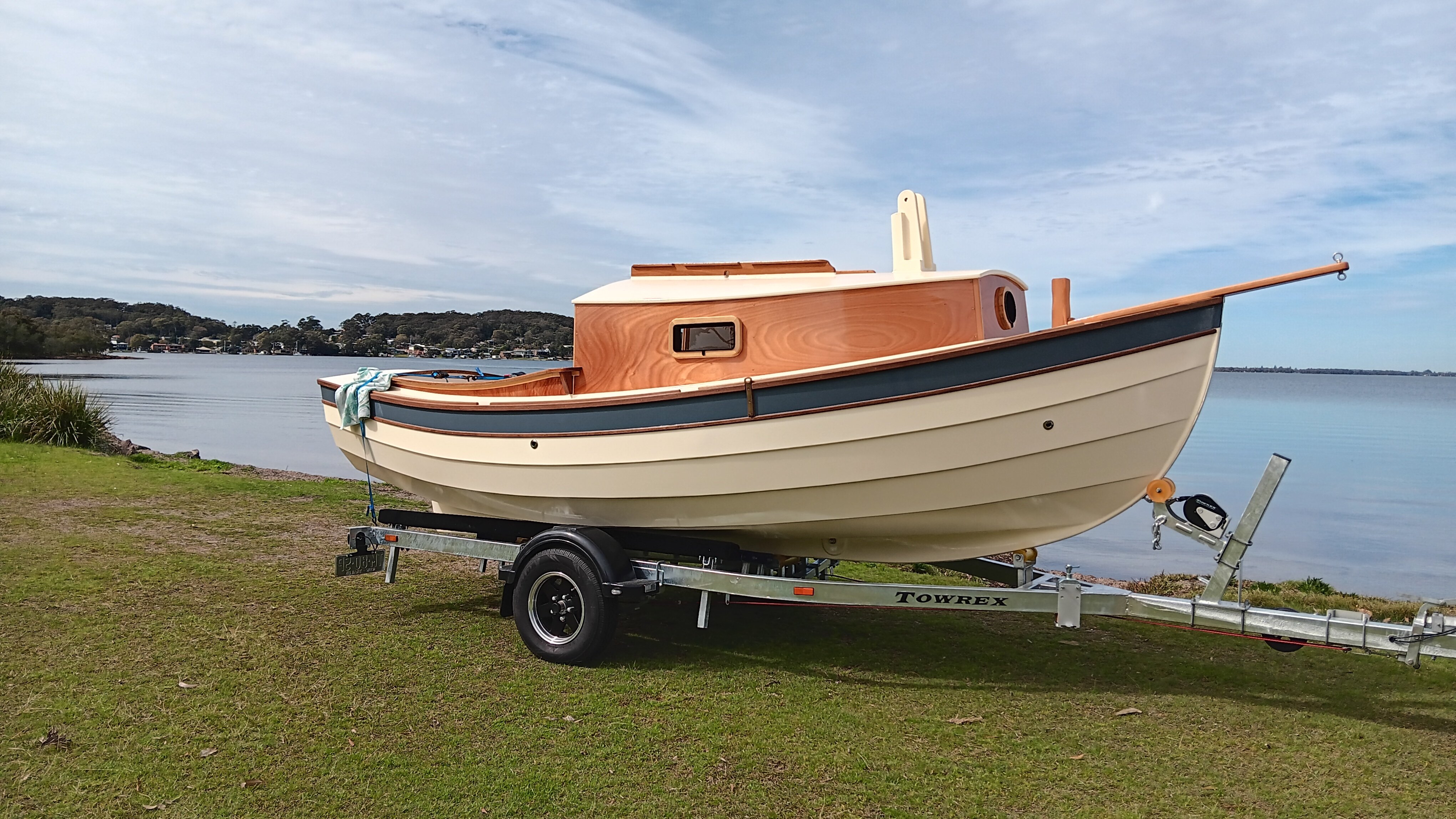

Vaddoc, I get the need for these figures in the design phase and the fact that you're into them and sharing them is what this forum is all about and I know many will really appreciate your efforts. The Ptarmigan I just built (full size 5mtr sail boat) will have no doubt been drafted similarly but the building of it required simple graph plotting for the shape of the frames and correct spacing of the frames. Everything flows from there bearing in mind the golden rule of boat building, a fair line supersedes any given measurement! This might become apparent in the difference you have found in the width of the stem. I include a picture of what I built without knowing such detail, just to show it's a tad better than the boat you demonstrated above
