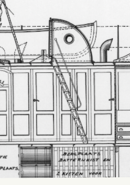

After recently watching the film The Cruel Sea, I came to the conclusion that those were most likely companionways. I was planning to mention that on my next post, but you beat me to it.

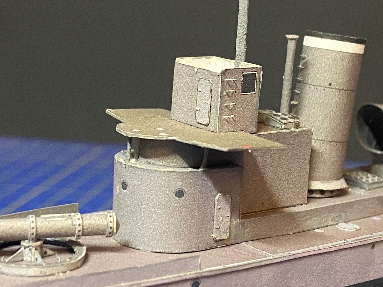

Meanwhile, the V108 build continues. Here's a minor update – Do any paper model updates seem to be anything but minor?
Managed to add the supports posts under the center part of the bridge. Unfortunately, I got things a bit out of order here, and added the bridge deck before I added these supports, which are fine brass rod.
Also, forgot that there are ladder rungs going up the side of the radio shack, so I added those as well. These rungs seem to be the easiest detail for me to add to the model.
I probably should have waited to add the bridge deck after completing the whole assembly, but I got kind of anxious, as I hadn't done much on the model at the time and wanted to get something on it.

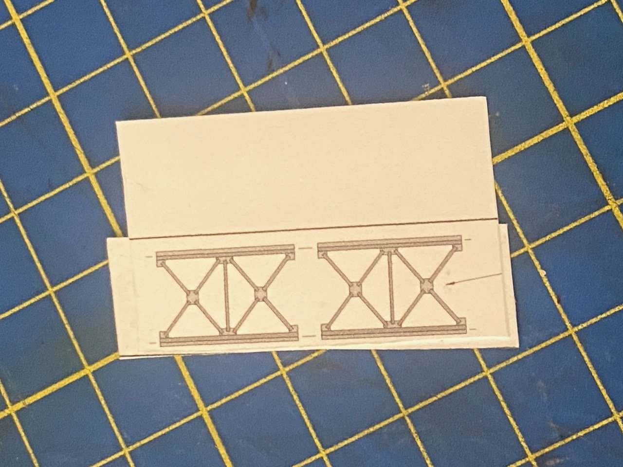

Next thing I want to do is to get those big support girders into place that hold up the wings of the bridge deck. The details on this are so fine, though, that I'm having trouble cutting them out. I'd better go back and look at other builds to see how they managed. I almost had one all cut out. I'd soaked it with thin CA, then cut using a scalpel. But, after about 10 minutes of work, ended up mucking it up, right at the end (! 😫) .
I'm thinking I need to reprint the parts on thicker card stock and just carefully do it again, maybe using a razor blade as instead, since that's thinner and doesn't put so much sideway pressure on the delicate parts when cutting straight into the paper, like chopping. Here's the culprit...
I did start on chocks for the ship's launch, and did a little work on the last of the ventilators. Those should be going on the model shortly.

I appreciate the suggestions. What do you mean by pre-sealing both sides? Sealing with what? I already spray my card stock with matte lacquer to protect the print.
I've tried using CA to stiffen up the parts before doing the cutting. But, I'm wondering if perhaps it's better to wait until after the cutting. I'm just not sure. This is first assembly that is really so delicate that my work falls apart.
I tried laminating the printed card stock onto another piece, but where the girder parts are really thin, the laminated card moves around and starts to come apart.

I use the Folk Art Clear Primer and brush both sides, even after laminating pieces.
It helps prevent (or at least reduce) delamination when cutting small pieces out.
If they still delaminate, I just clue them back together with PVA (Mont Marte to be exact).
I apply the CA after cutting small pieces out to reinforce them.
It essentially plasticizes them.

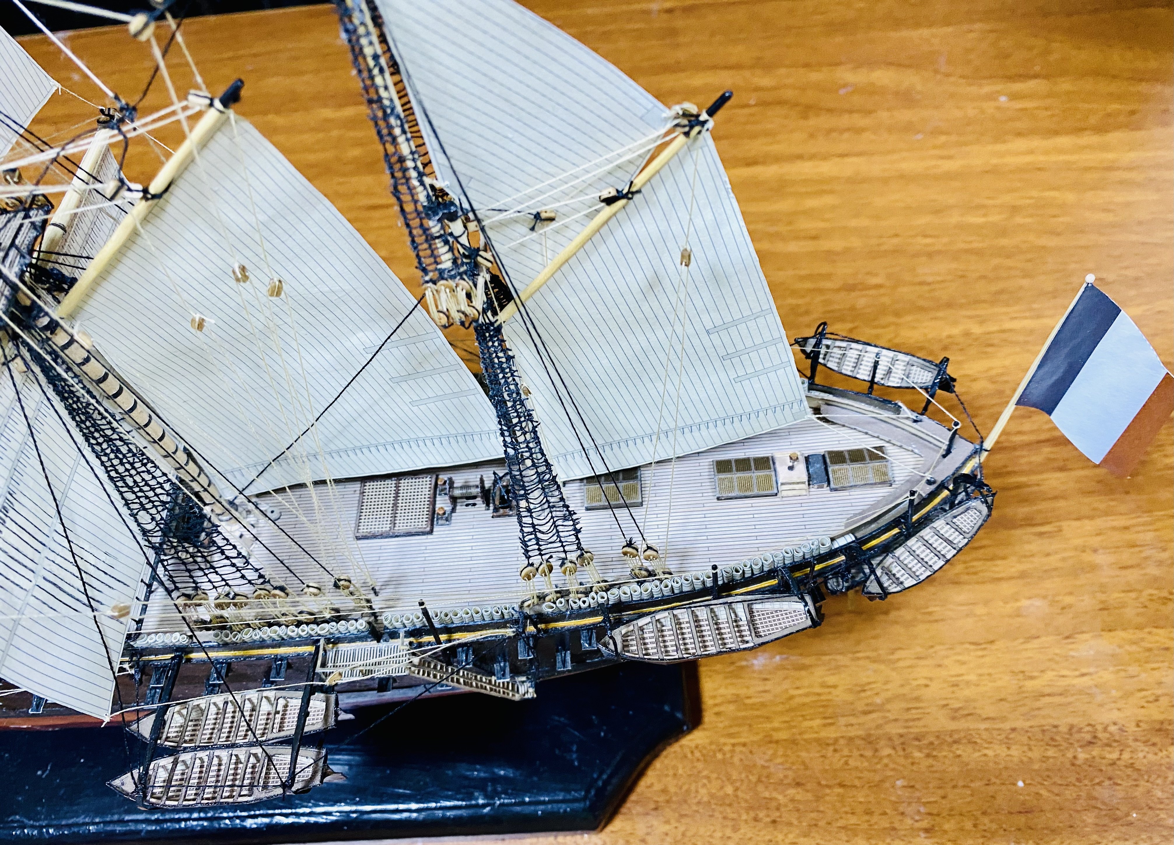

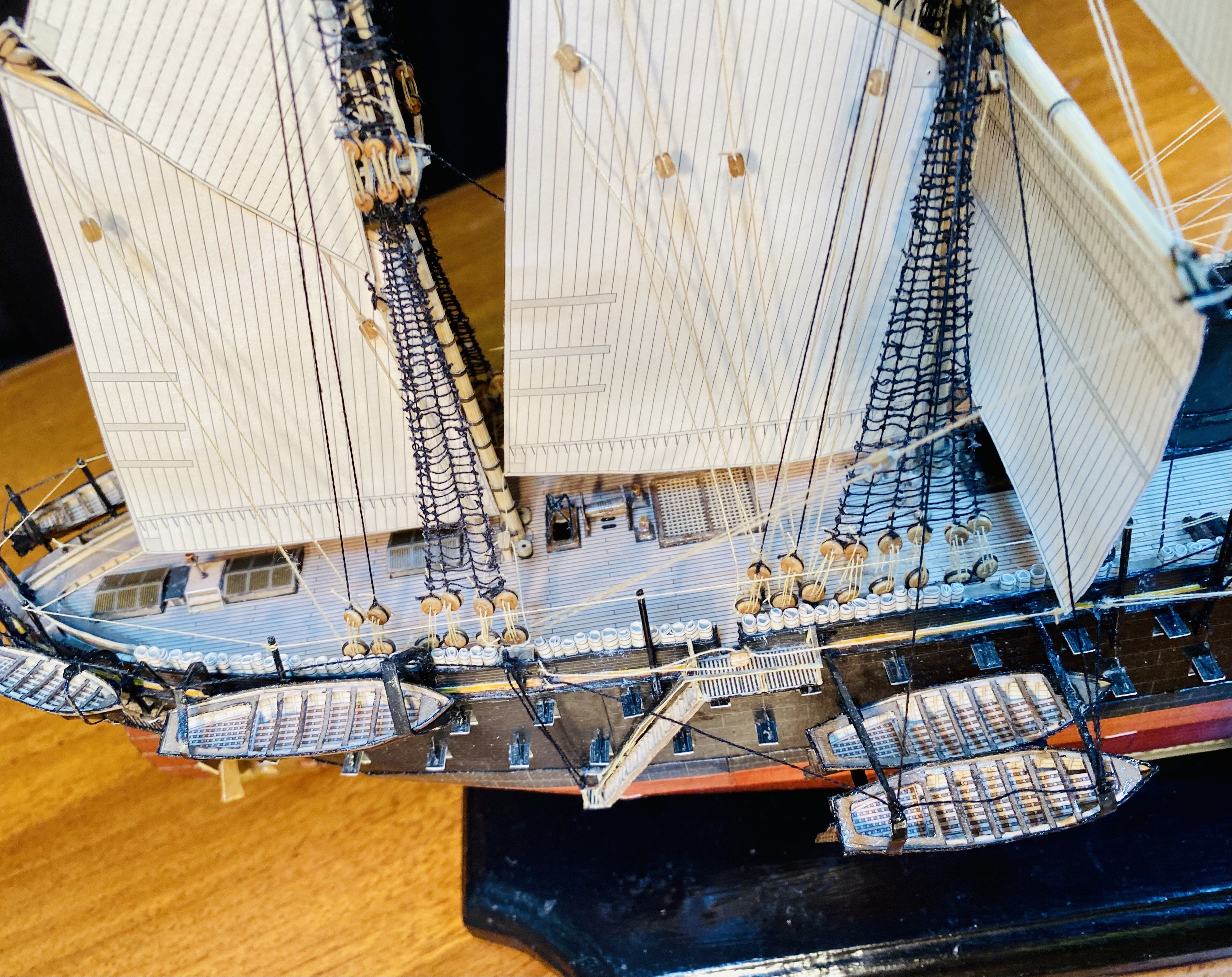

That’s how I got my davits to retain their shape, and be functional, on my model of the Solferino.

Clare, I did mine by cutting out first, then soaking in CA. Are you familiar with what the Poles (I believe) call the 'woodpecker' cutting technique (if I'm remembering the name correctly)? For anyone reading, this consists of cutting by means of a series of up-and-down strokes rather than the usual dragging of the blade across the paper. Each vertical stroke only makes a cut about 0.5 - 1.0 mm long. Normal cutting strokes tug at the paper's fibers, which is not a problem on large parts but can pull very small pieces apart while cutting them. The vertical cutting stroke greatly reduces such tugging-and-tearing.
GradpaPhil, thanks for the explanation on the primer coating. Haven't tried that yet. With CA, I've been using thin CA to plasticize my paper parts since my first paper model 10 years ago. I've just never cut anything this thin before. I tried using the CA before I cut the part, and that seemed to work for a while, until it didn't...
Next, I tried laminating the part, thinking the extra layer would make the part stronger. The problem there is that the parts are so thin, when there is delaminaion, there's some tearing and some slipping of the paper that happens, leaving not much to glue back together. I'm going to try going back to a single layer card stock for this.
Beautiful French sailing warship, by the way!
Hi Chris, I'd never heard the name for the technique, but it makes sense, thanks. That's what I'm basically doing with the chopped single-edge razor blades. Did the same thing really when I was using a scalpel blade, but the thickness of the blade pushes parts sideways as I push the blade down on the part. I'm hoping the razor blades, being so much thinner, will reduce the sideways pressure as I chop into the part.
I gave up on it last night, but printed out yet another parts sheet so I can try again. Maybe a combination of the up and down strokes, using single layer card stock, and luck will lead to success this time?

Have you tried Necroscoping?
A couple of years ago I was designing a Zeppelin model (there's an old build log on the Paper Modelers forum under the user name 'Kugelfang') and I used the technique to laminate some pieces. Basically, I took plastic from a zip lock bag, sandwiched it between the two pieces of card I wanted to laminate, encased the whole thing in a folded piece of 20# paper and ran a medium (or low?) temperature iron over it to melt the plastic and bond the two pieces of card stock together. It also added considerable rigidity to the piece--which is why it might be worth trying.  As a matter of fact, when I get back to my skipjack build I think I'll try this technique for the frame of the winder which will be similar to your support girders.
Just a thought....
Sounds vaguely ominous! 😬
In this instance, I think any kind of doubling technique would adversely impact the scale of the part -- but your description of the process is intriguing! I can easily envision this conversation going down at the Coyle household later:

No admiral here to worry about, but I will probably try one more time, cutting the bridge wing supports, and if that doesn't work, I'll try the grilled ziplock bag sandwich method. But, for now, I decided that I'd deal with the issue of the bridge wing supports by NOT dealing with them for now. Taking a break from it, while I get a few other things done that need to be done anyway.

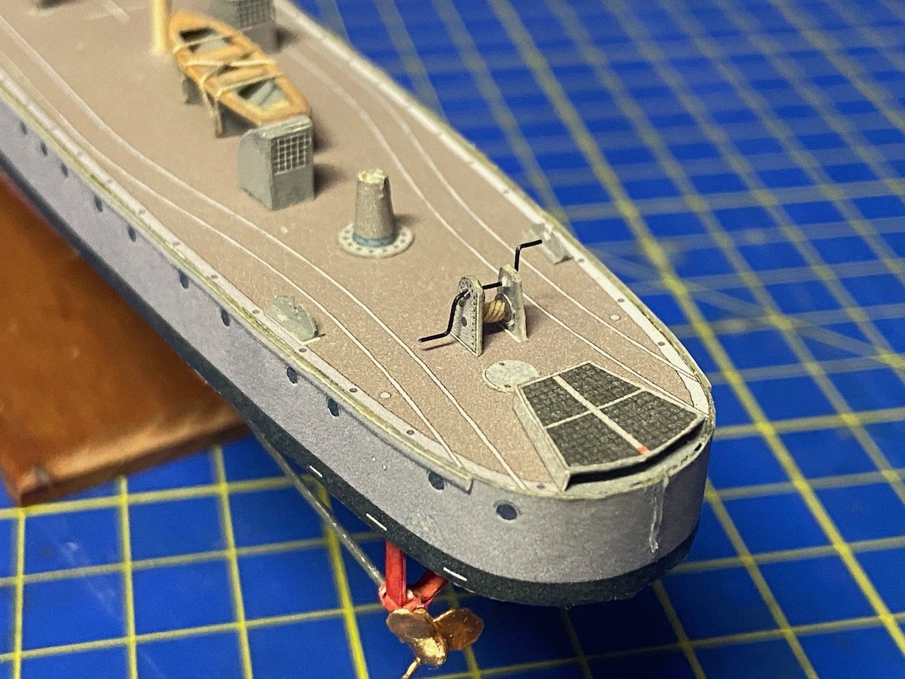

Finished making the remaining ventilators, and adding the launch. Seems odd that the kit didn't include a cradle for the boat. I fashioned something simple out of card scraps. I attached them to the boat and cut small notches in each of their corners. Then, I could use the smallest rigging line I have to tie the boat down.
My only concern with the ropes on the launch is that it's going to look really heavy compared to the rest of the 'rigging' on the model. But, this is the only rope on the ship, the others are going to represent wire guys and radio antenna wires, so maybe the thick rope on the launch is okay.

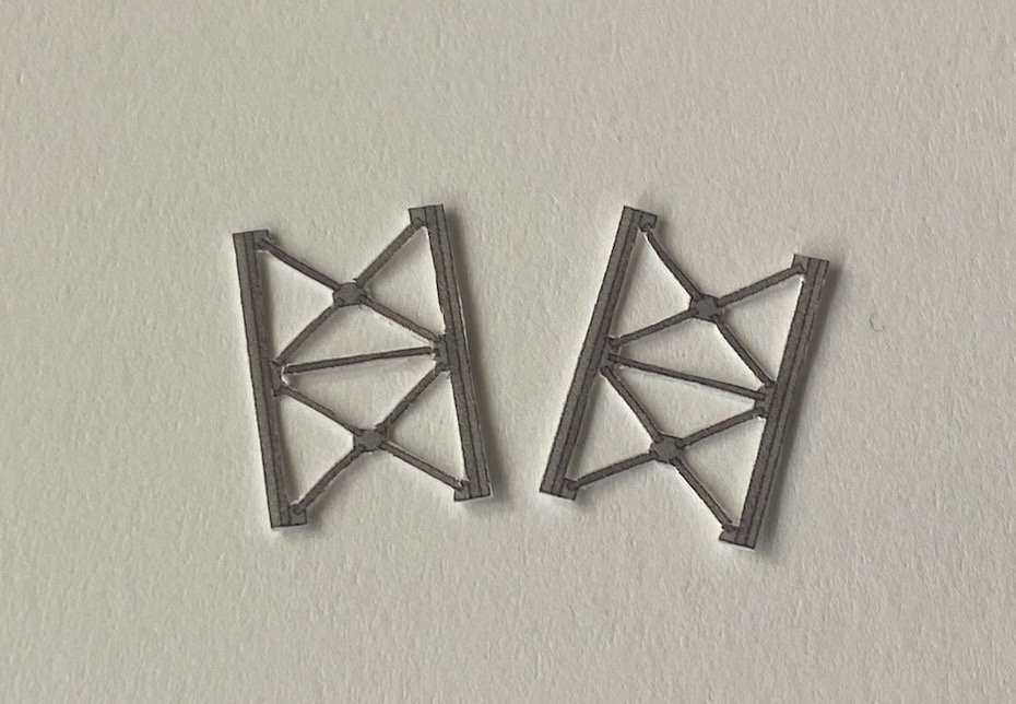

Next, I didn't cut those bridge wing supports, but I did manage to cut these parts that required a lot of careful little tiny chops, like what Chris was describing as the Woodpecker technique. I had to use thin CA on the parts first, though. Also, I didn't laminate any of these parts.
These all went pretty much without a hitch. I was amazed at how well the crane structure turned out.

Progress is very slow this last week. Only small windows of time available.
However, I made use of a window of opportunity last night and overcame what I've found to be the hardest task yet...
Thinking I may just reinforce these with some wire on the back sides, particularly some of those thin trusses. Still have to clean up the white edges.
Chris, what markers did you say you use? I should try them out.
Oh, and one more photo. Decided to finish up that stern reel. The handles are a bit large, but I had a hard time bending them at all without destroying the whole assembly. So, this is how it will be... I think.

Markers work fine, but often just plain watercolour or acrillic paint does the trick.
with respect to the side wings: i should have cut the angled pieces, and glue them, instead of folding backwards: the paper I used was slightly too thick to get a nice even bend.
Jan
Chris, I'm counting on your excellent V108 tutorial to lift me up to the challenge of the USS Bagley kit! 😁
Jan, thanks for pointing that out. As you can see, I haven't even dealt with that girder edge. I will probably do as you suggested and simply cut and glue.
