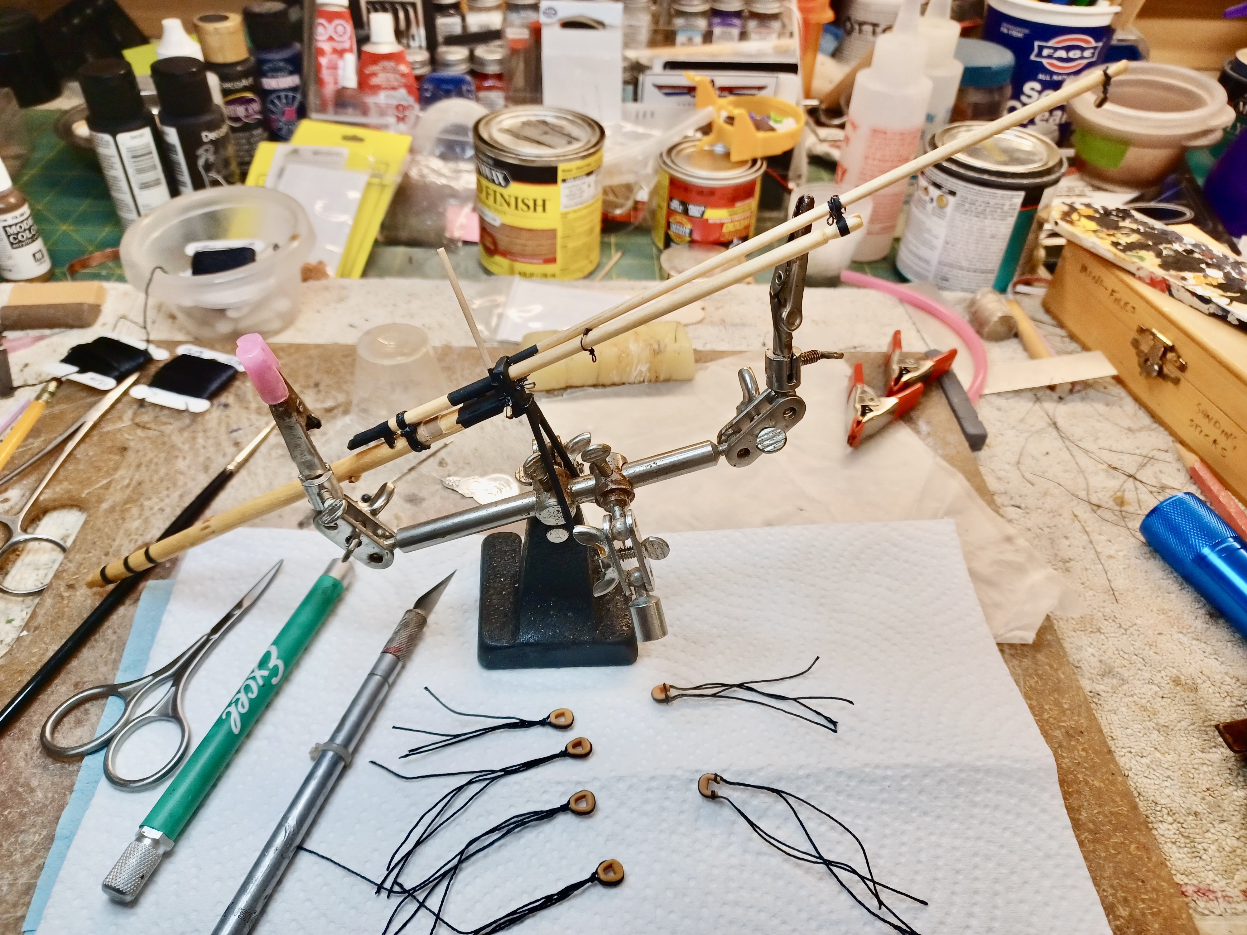

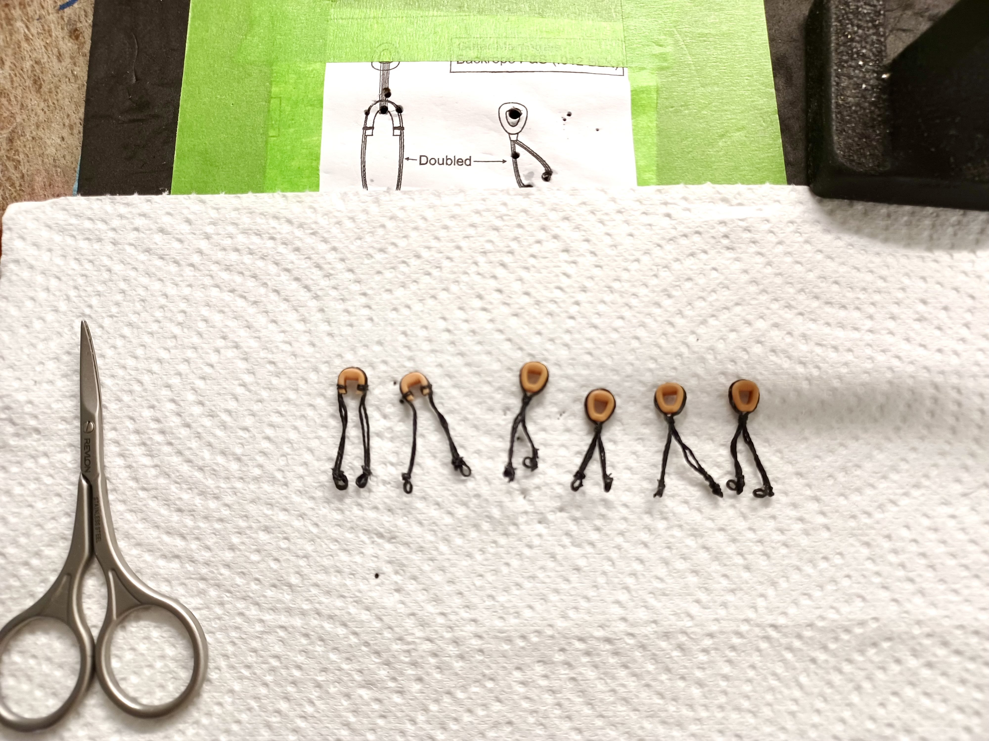

 I have made some progress over the last couple of days.  The single blocks have been installed on the flying jib boom, and the bowsprit cap.  They are a little difficult to see, but came out fine.  The open and closed collars are well along in their completion and will be installed when I get the loops in the lines figured out.  Then it’s a matter of adding them in the proper order.
Newbie notes:  I highly recommend the open and closed hearts that I got from the Syren Ship Model Company.  They are the 7mm size and are quite strong for printed parts.  If you want to work with the wood laser cut ones do not let me stop you.  However, if the wood is weak you can get pretty frustrated.  My opinion only…they should be included in the kit due to their size, but that’s just me.

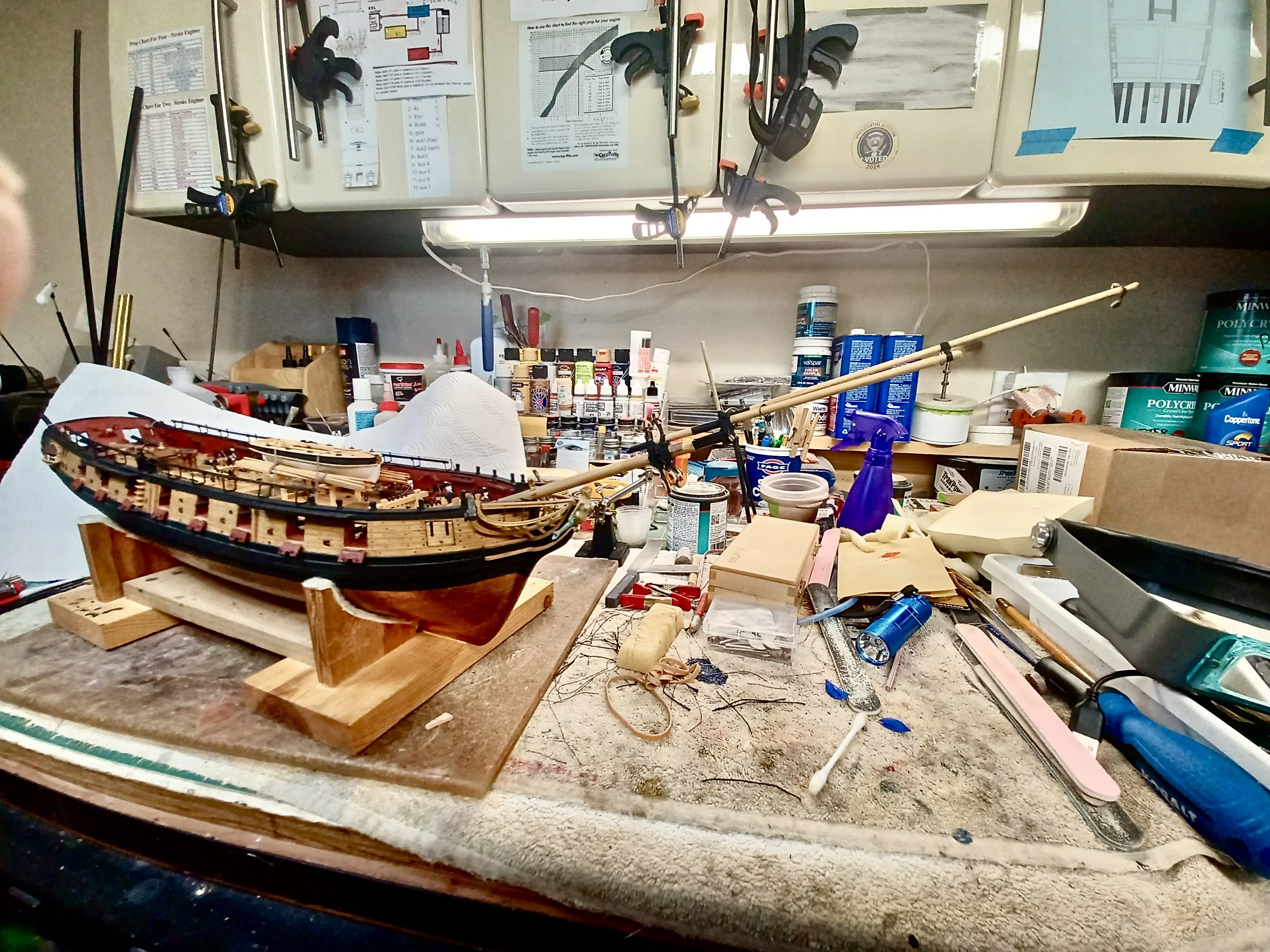

It hasn’t been fun, but with a couple hours a day, I have completed the bob stays and stay collars.  Still have the installs to do, but at least, they are together.  Although, I will admit that looking at the space where they go, and how many there are, it’s going to be very tight fitting them all in.  It’s also flying season, and I have some maintenance to do on a couple of planes, but should get to the Syren this week.

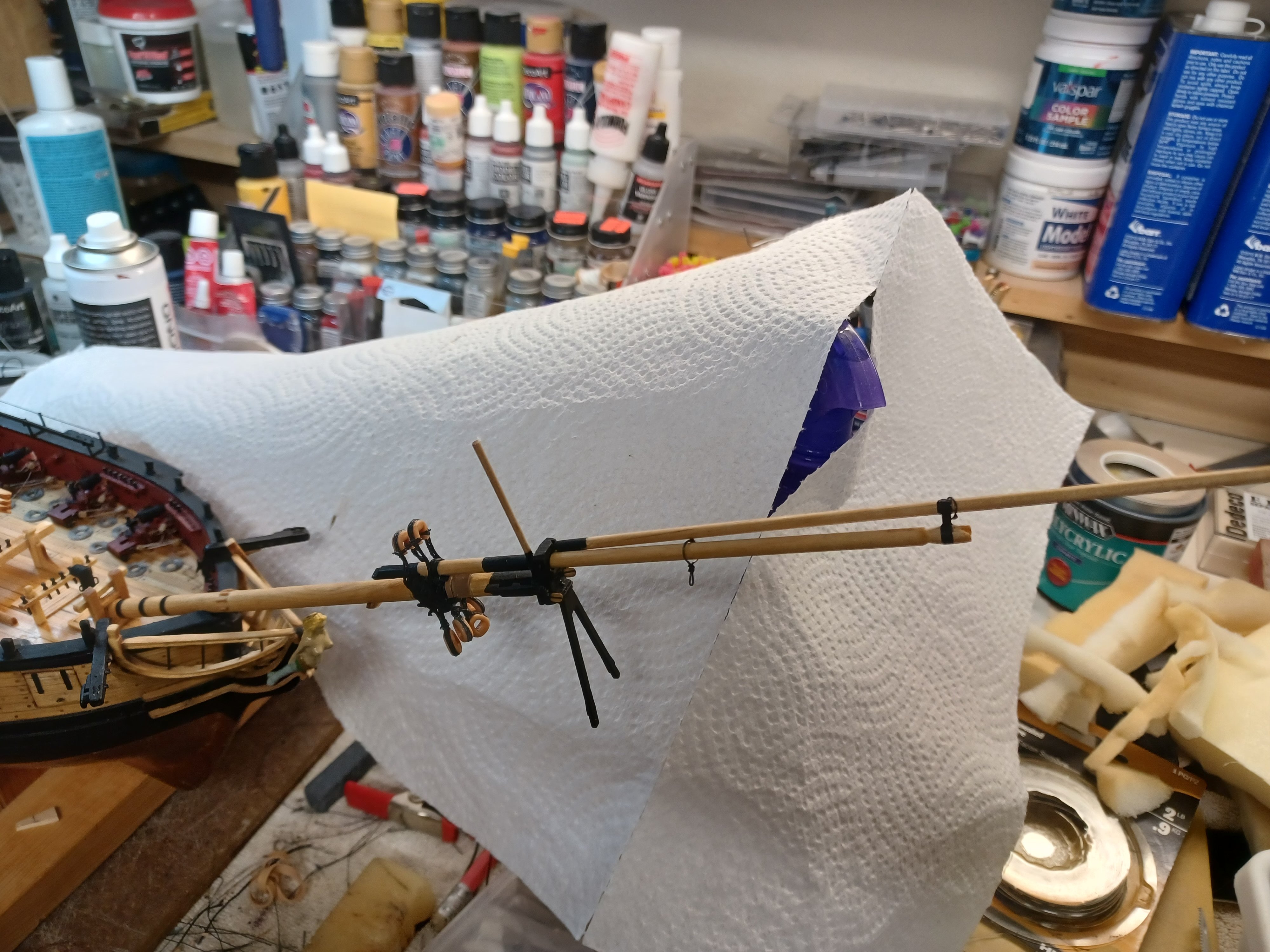

It was like stuffing a size 12 foot into a size 8 shoe, but after some pushing, shoving, and appropriate encouragement I got the bobstays, and open heart rigging onto the bowsprit.  I am glad that it is black which helps to clean them up visually.  We had rain so the temp dropped some, allowing me to make a little progress….. now….a couple of warnings
Newbie Note
1.  Do not, repeat, do not attach the dolphin striker, or Ball Truck before this step.
     I know the instruction booklet has them installed before now, but if you are like me, you will just have to replace them.

On this step I found that rigging the open hearts and bobstays very difficult.  Not because of the actual steps, but the space where the rigging attached under the jib boom.  If I had to do it over, I would put some thought into doing it differently.  I think the pictures showing before installation showed that I didn’t build them too big.  I have measured all placements with dividers so everything is placed correctly.  Unfortunately, this step is not very detailed in the manual or on the plans.  If I was to do it over, I would reduce the line sizes to conserve space.  Or, I would connect starboard and port lines differently.

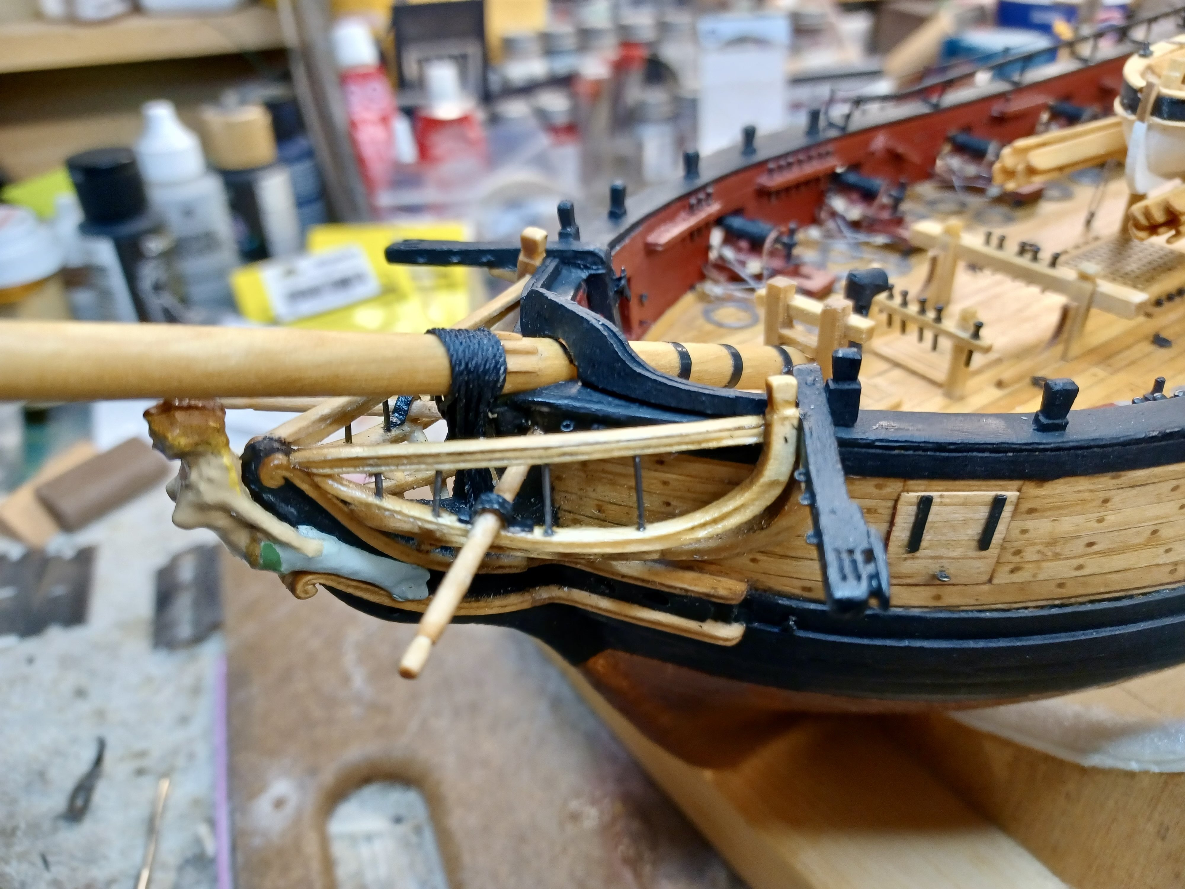

Here is a picture of the bowsprit glued in.

You could have reduced the congestion at the bowsprit cap by combining several of the hearts/deadeyes on a single collar. Lever (page 21) shows two bobstays on a single collar. Marquardt (page 170) shows three on a collar for stays. Petersson (page 84) shows the bobstay and two jibboom guys on a single collar. So this technique was not uncommon.
However, making these collars with multiple attachments can be tricky. Getting the hearts/deadeyes/thimbles positioned around the boom with the correct spacing takes a bit of practice. You can see in this picture of the bottom side of the bowsprit that I really didn't get the collar tight enough around the spar.
The problem is that I tried to make the collar with a single turn of rope spliced together at the center deadeye. I should have created an open collar with eyes spliced in the ends - like you are doing. Then I could have drawn it tight to the boom with lacing. It works anyway but wants to pull over the side thumb cleats (the top one holds it in position). Live and learn!

Thank you, @Dr PR After I completed the installs, I did think about how I could have done it differently.  However, after, doesn’t help much to resolve the issue.  Since the rigging is black, it is difficult to see how crowded it really is.  The only thing I am wondering about is if the closed hearts are in a good position for attaching the follow on rigging.  If not, I can see me redoing the whole section.  That, however, will be a last resort. I can see me doubling up the closed hearts to conserve space.  Thanks again for your comments and pictures.

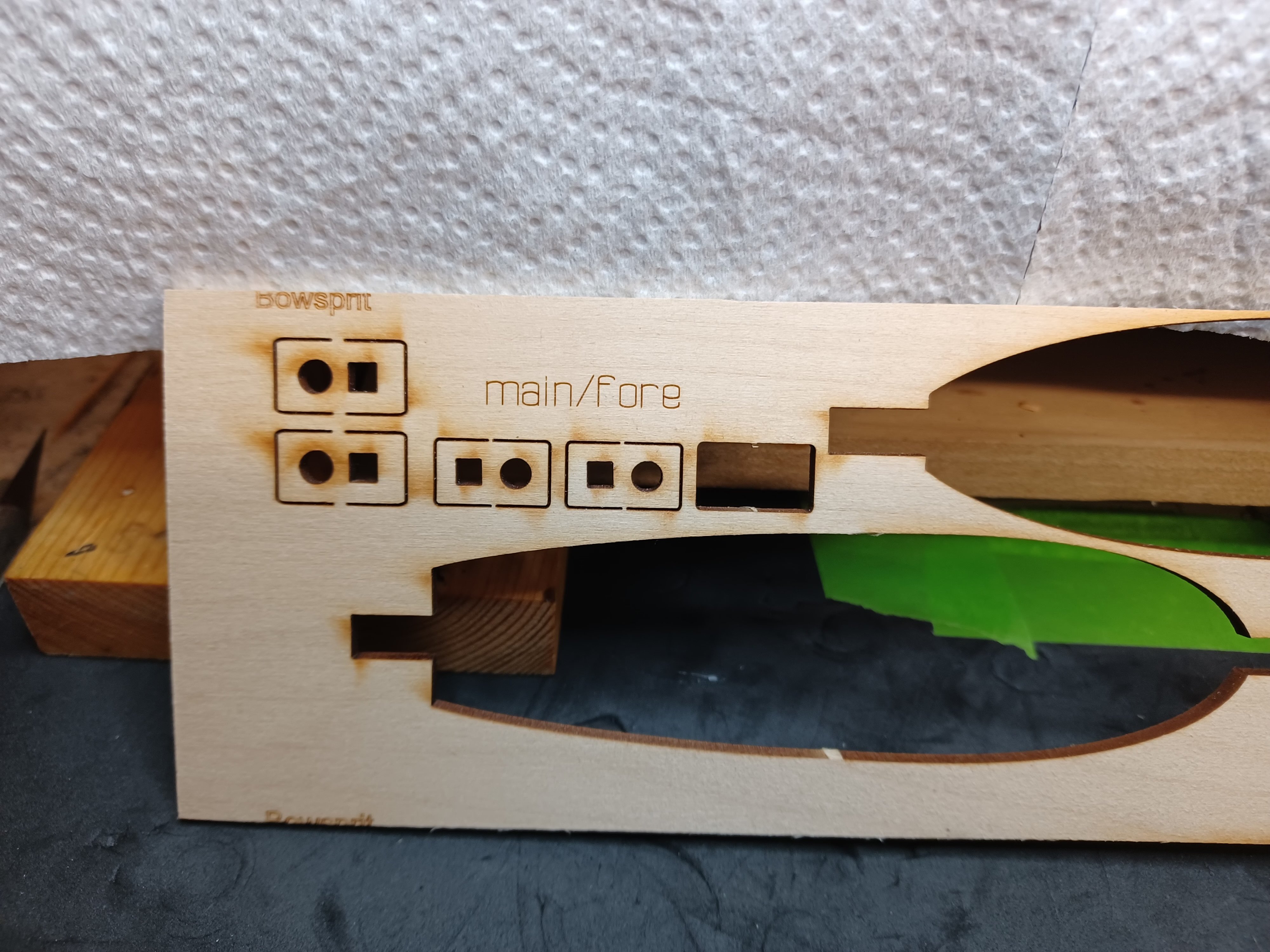

Newbie Note:  What’s wrong with this picture?
Give up?😁
Well, it’s a mistake I found by looking for something else. When I selected the part for the bowsprit cap, I used a part for the mast.  It really didn’t make much difference, except for the room for mounting the jack staff and the wire brackets on the jib boom.  There really isn’t much size difference between the two parts, but the bowsprit cap is just a tiny bit larger.  The square and round holes on both parts are the same size, but the surrounding wood is wider by a hair.  Just a reminder to watch your part selection.

Despite the continuing heat, we had a few days where I could get some work done on the Syren.  I have been able to complete the bumpkins, including the mounting brackets.  I tried the copper strips folded over, but I ended up using some card stock.  The gammoning turned out to be easier than I expected, but ‘easier’ is very relative.  To complete the gammoning I did make a small hook out of a RC control rod so that feeding the line would be easier.
