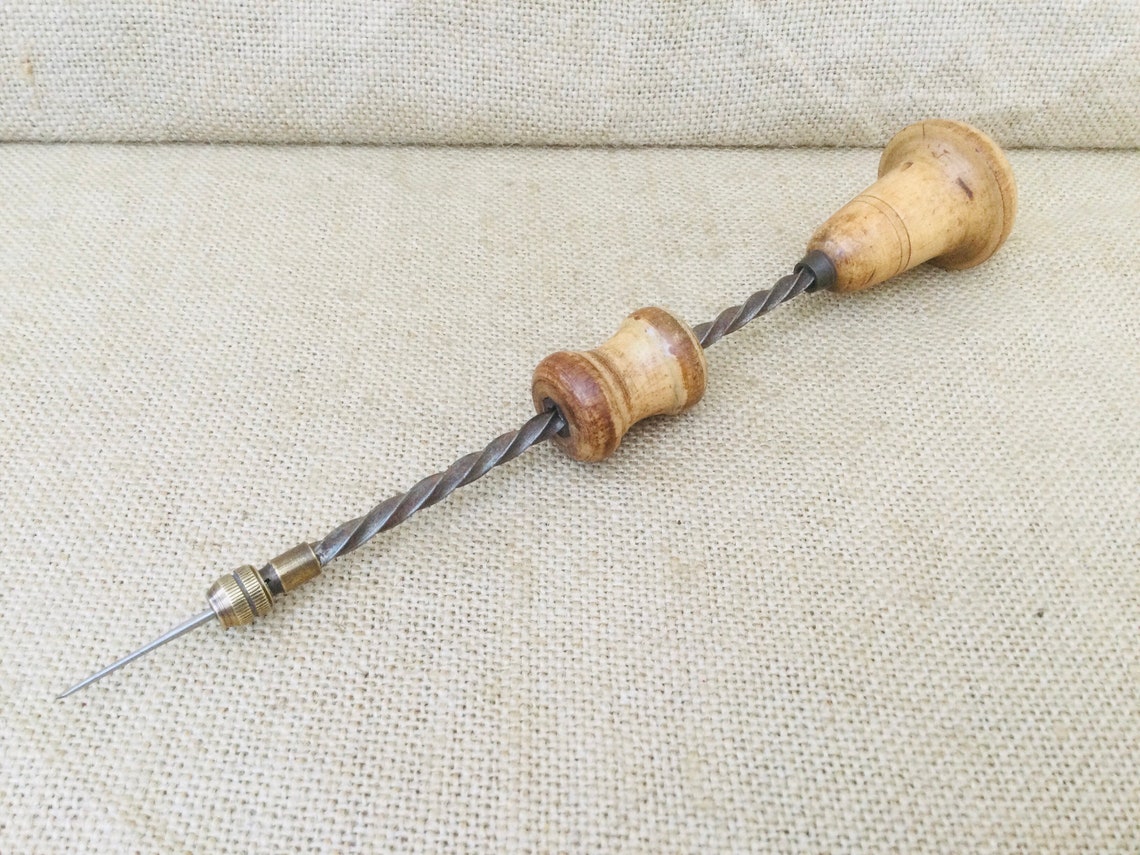

I know this tool as a pump drill, but I don’t know the actual name. I not looking for a similar sized drill with a spring inside but one with the movable ‘bobbin’ in the middle, this size or smaller. I trust some soul on this great site may a have a clue or two to help. Thanks!

It's properly called an Archimedean drill, also known as a fretwork drill, is an old type of drill which works on the Archimedian principle; the drill rotates quickly as the barrel on the stem is worked up and down. This tool provides a quick and easy way to bore holes through fretwood. They are still made and available in various sizes on the new and used specialty tool market, some with springs and others without.

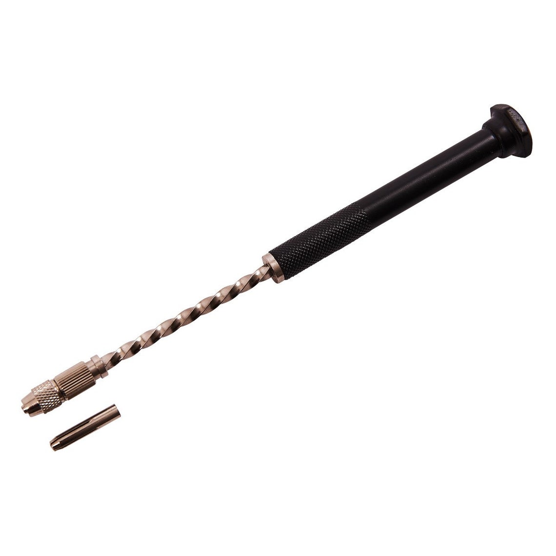

A "modern" version is carried by many jewelry making supply houses:
Spiral Push Drill / Archimedes / Archimedean Push Hand Drill. image 1

I call that an Archimedes screw drill.  I bought mine many years ago (1980’s) from a jewelry tool supplier that came to an NRG Conference.  I suspect that you might find one on EBay under jewelers or watchmakers tools.

Be aware, however, that these Archimedes-drills are actually meant for use with so-called spade-drills. Spade-drills are not fluted, but cut in both directions on account of the reciprocating action. For this reason they are also not very suitable for drilling deep holes. They are still quite popular with watchmakers, as they do not 'catch' in soft brass, unlike standard fluted drills. Watchmakers used the make them themselves, but they are also available (as the drills) from watchmakers supply houses (which is where I got mine some 30+ years ago).
The sprung version pops up everywhere on ebay and I think some modellers supply houses also carry them.
The large wooden version may not be very useful, as their collet is actually machined for bits that are square at the mounting end - at least the one I was given as a kid in my first tool set around 1964 is like set. In fact, I rarely used it and knowing my father's cranked hand- and electric drill considered it already then an antiquity.

While I don’t doubt that the Archimedes drills are not intended for use with standard twist drills for the reasons given by Wefalk, I have not had a problem using small wire sized twist drills in mine to drill hard woods like pear and box.  I have also used it to drill holes in brass.  In all cases, holes drilled have been thin materials where the drill bit does not bind.
