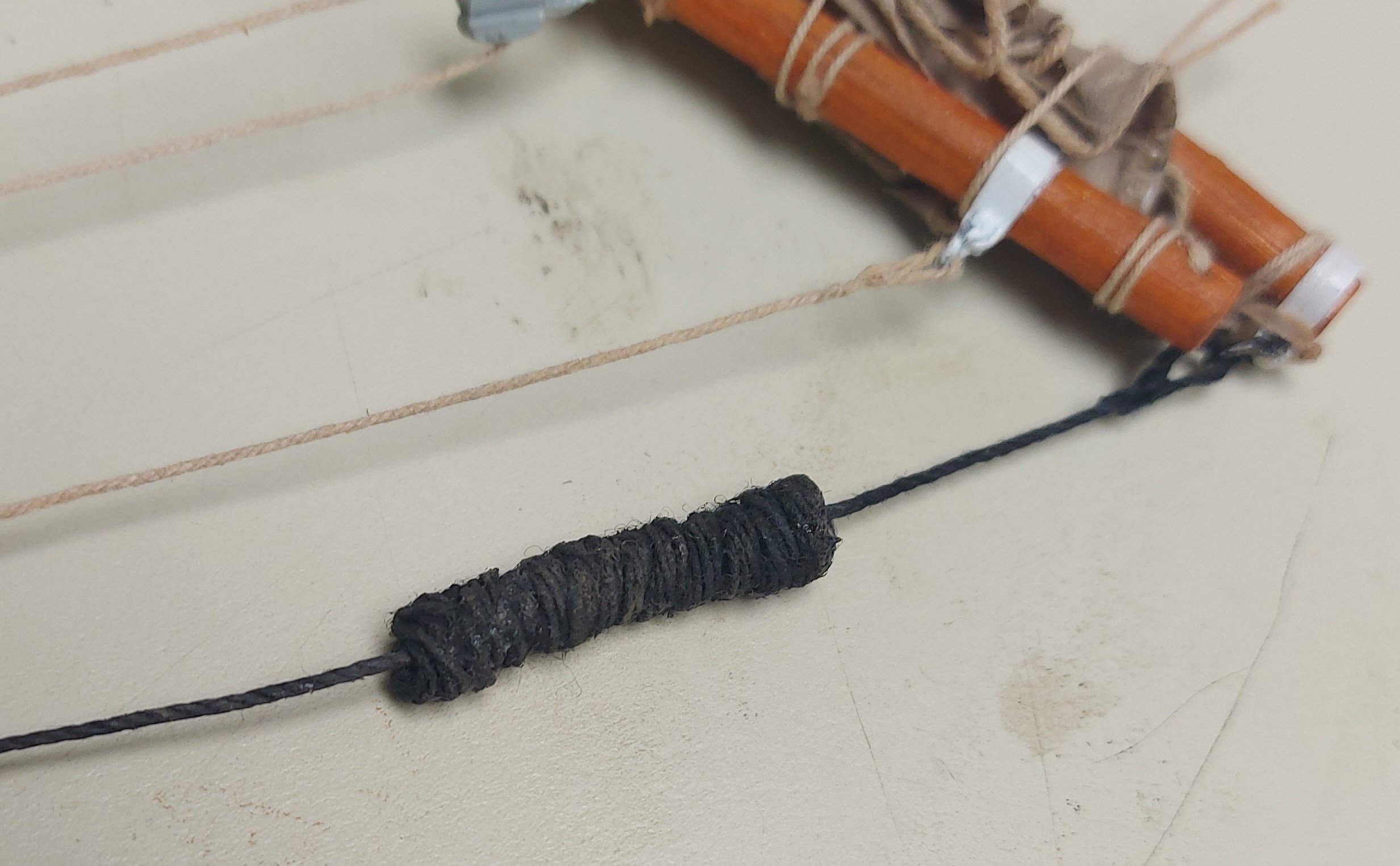

Baggywrinkle round 2... this is wrapped yarn. An improvement over the chenille but still not where I want to go with these. This is now a scale 9" diameter, which looks right, but still looks like the wrapped yarn it is...
I think I will try wrapping the yarn around a mandrel like a drill bit rather than the line, so I have more control over the wrap. It means I have to take the block off the end of the line, but I think that will be worth it. Then I will try and make some fuzz on them...

I think your first attempt was better than the last.
Alan O'Neill
I liked the first better as well.  Looked like what you see on current tall ships at any rate (the first ones).  For what it's worth.

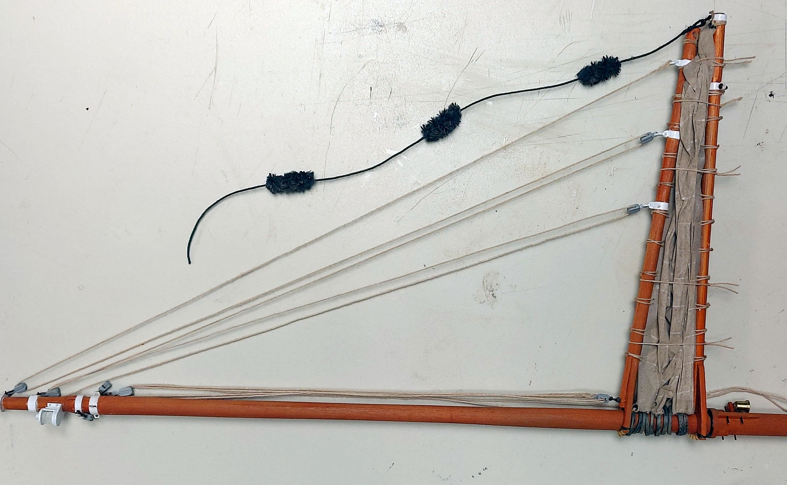

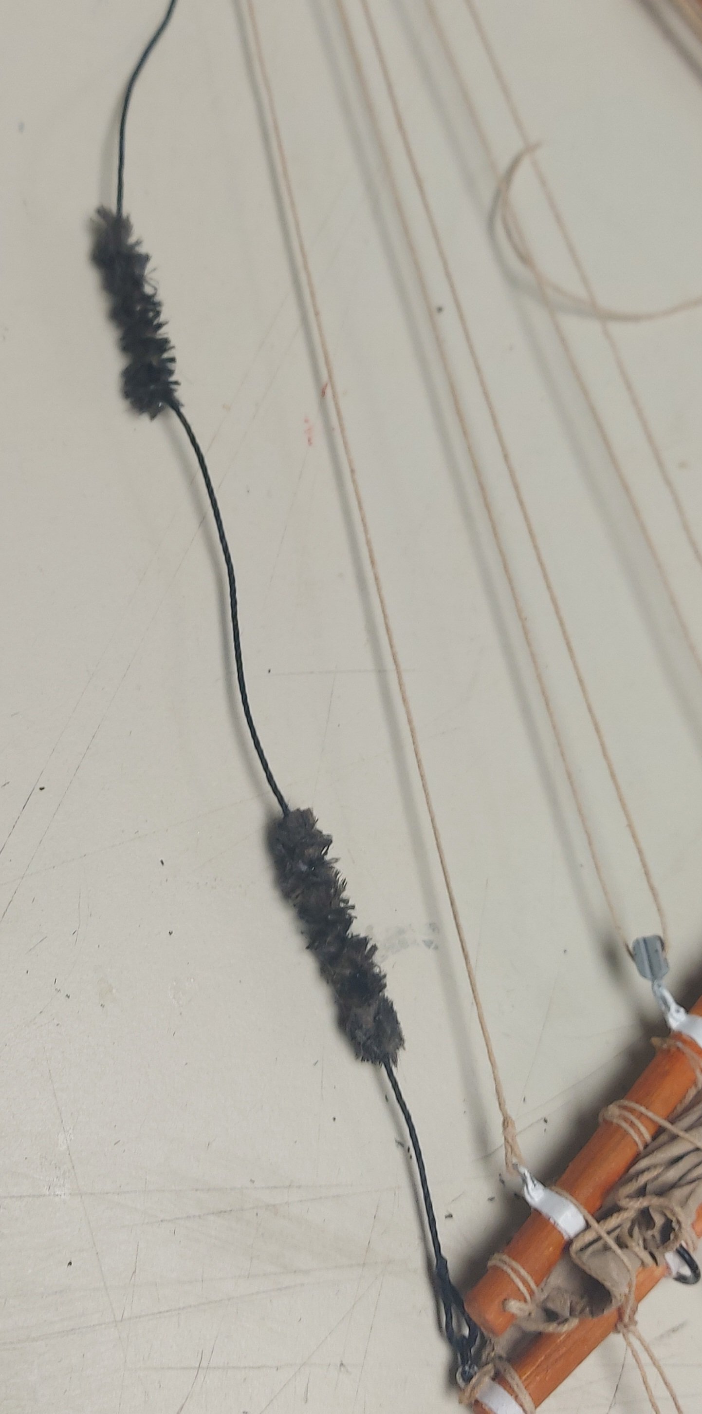

Thanks Alan and Steve. After considering your comments, and more fussing with the yarn, I returned to the chenille, this time wrapping it around a small diameter plastic rod (in case I couldn't get the baggywrinkle off the rod I at least had a hole for the lift)!
Anyway, they did come off so I added dabs of black paint to hide the wires, some dark brown dry brushing since these were made from old hemp, and I trimmed them a bit around the edges.
I slid them onto the lift to see what they look like, scale dimensions are about 36 x 12".
I think some more trimming might be warranted, but I'm wondering what y'all think of them now??

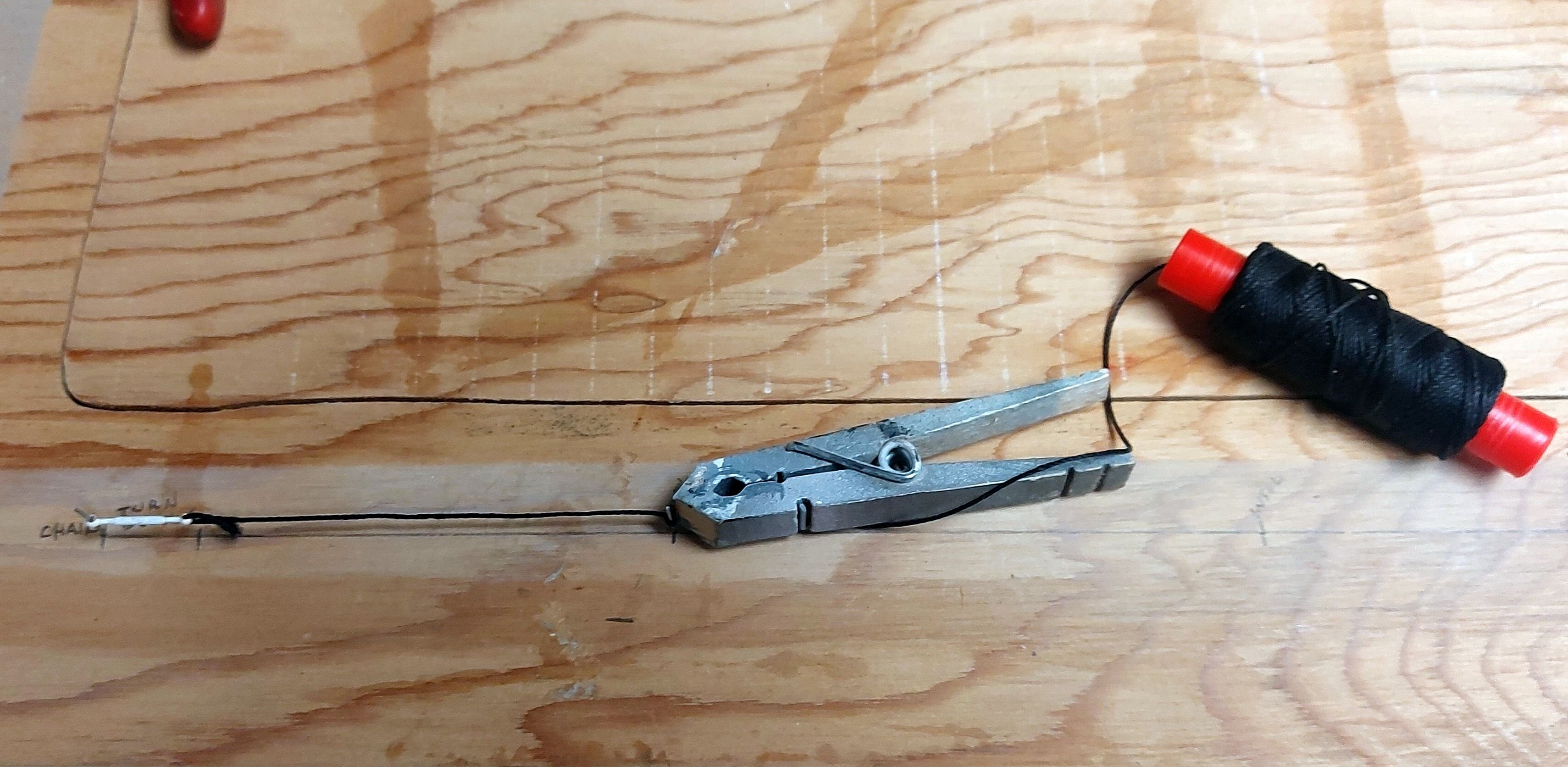

I also started making stays off the ship. These are fswr, simulated with black Amati rigging line of a scale 2" diameter per the plans. I made a template along the bottom of my silkspan frame, scaling dimensions from the rigging plan and indirectly from photos. Pins anchor each of the components so each stay will be identical. Each stay starts with the bottle screw, and runs to the first electrical insulator, this is what I have so far in the picture.
Each item of standing rigging is broken with two insulators, and will be fitted with an eye at the top. The lower eyes are presumable served, but covered with a leather wrap, which I will simulate with more silkspan scraps.
I will make a pair of each item then install them onto the ship...

I think they look quite good.

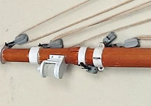

is the turnbuckle what you are calling an insulator?
Alan O'Neill
No, the bottlescrew is what it is. Where the clothespin is, is where the first insulator will be installed...
Very nice and quite convincing!

11 hours ago, Dr PR said:
Bruce,
I like the fuzzy chenille bagywinkles/baggywrinkles better than the tight yarn versions.
The mast is coming along fine.
Thanks Phil... I agree and think the yarn version might be better in smaller scales. Later I'll rig up the lift and think good thoughts about mounting the mast permanently.

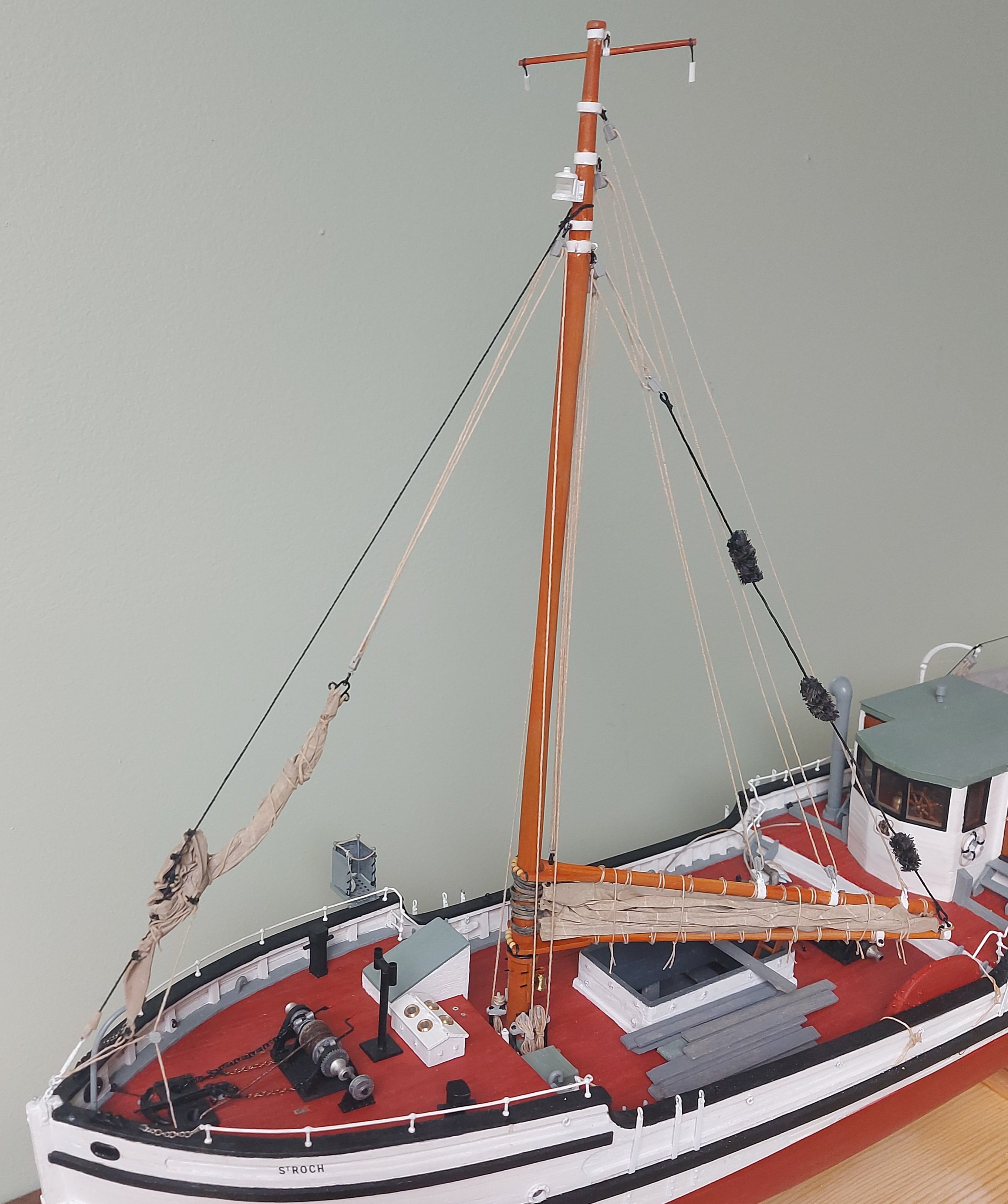

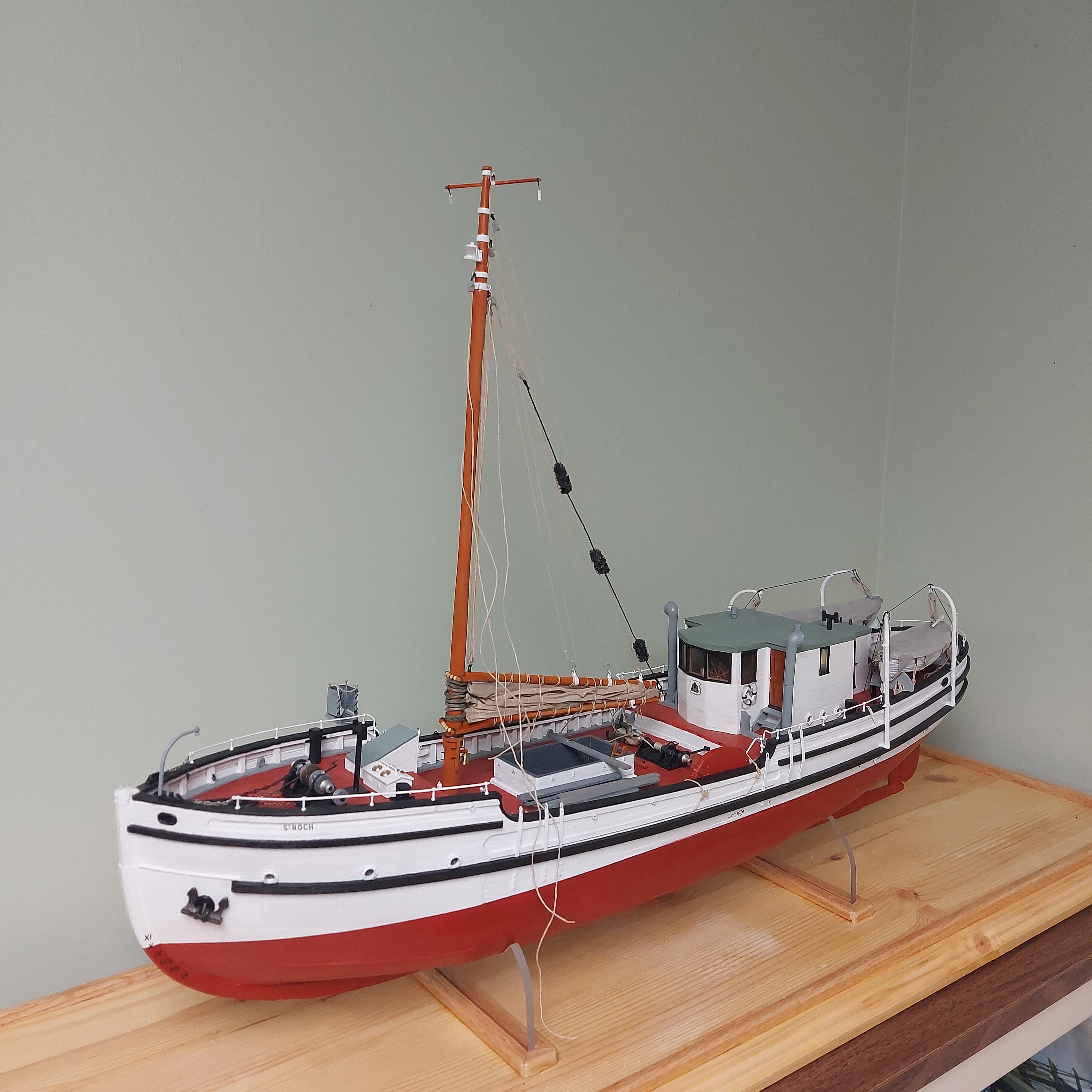

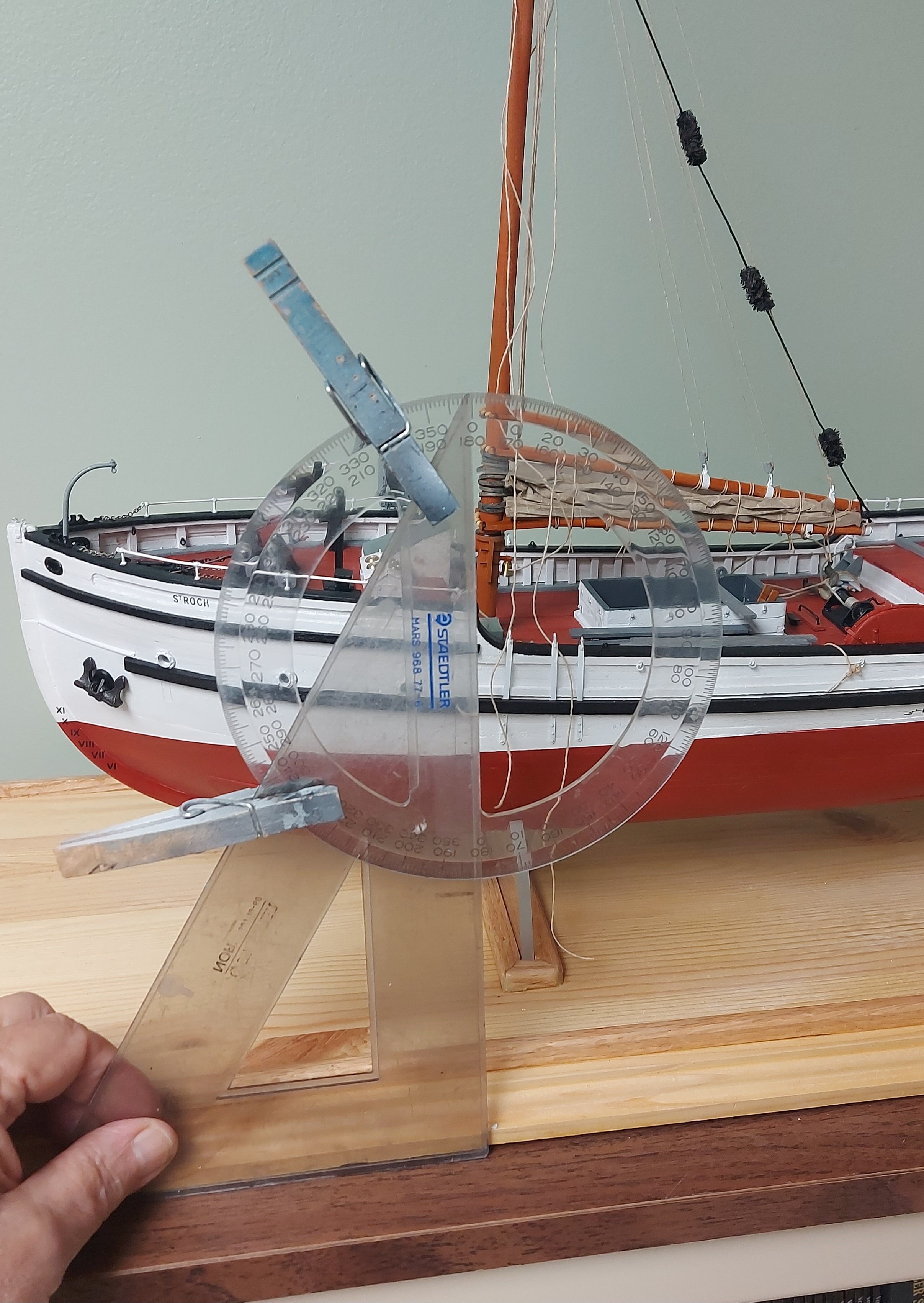

Well, it finally happened... the boom lift got rigged and the mast got set into the hull permanently...
I checked the side to side positioning against the line of the stem and the center of the wheelhouse, and in the next picture I am checking the 3 degree rake angle after confirming the ship is set properly onto her base...
After the glue has cured overnight I will add the pin rails to the bottom of the mast and finish up the running rigging.

Congratulations! Stepping the mast is one of the milestone achievements in model making. It usually means the wood work on the hull is finished and you are about to become all tangled up in rigging and sails.

Thanks Phil! Yes, I am happy to reach this milestone but with St. Roch it means 'rinse and repeat' because I have to repeat everything on the mainmast now!

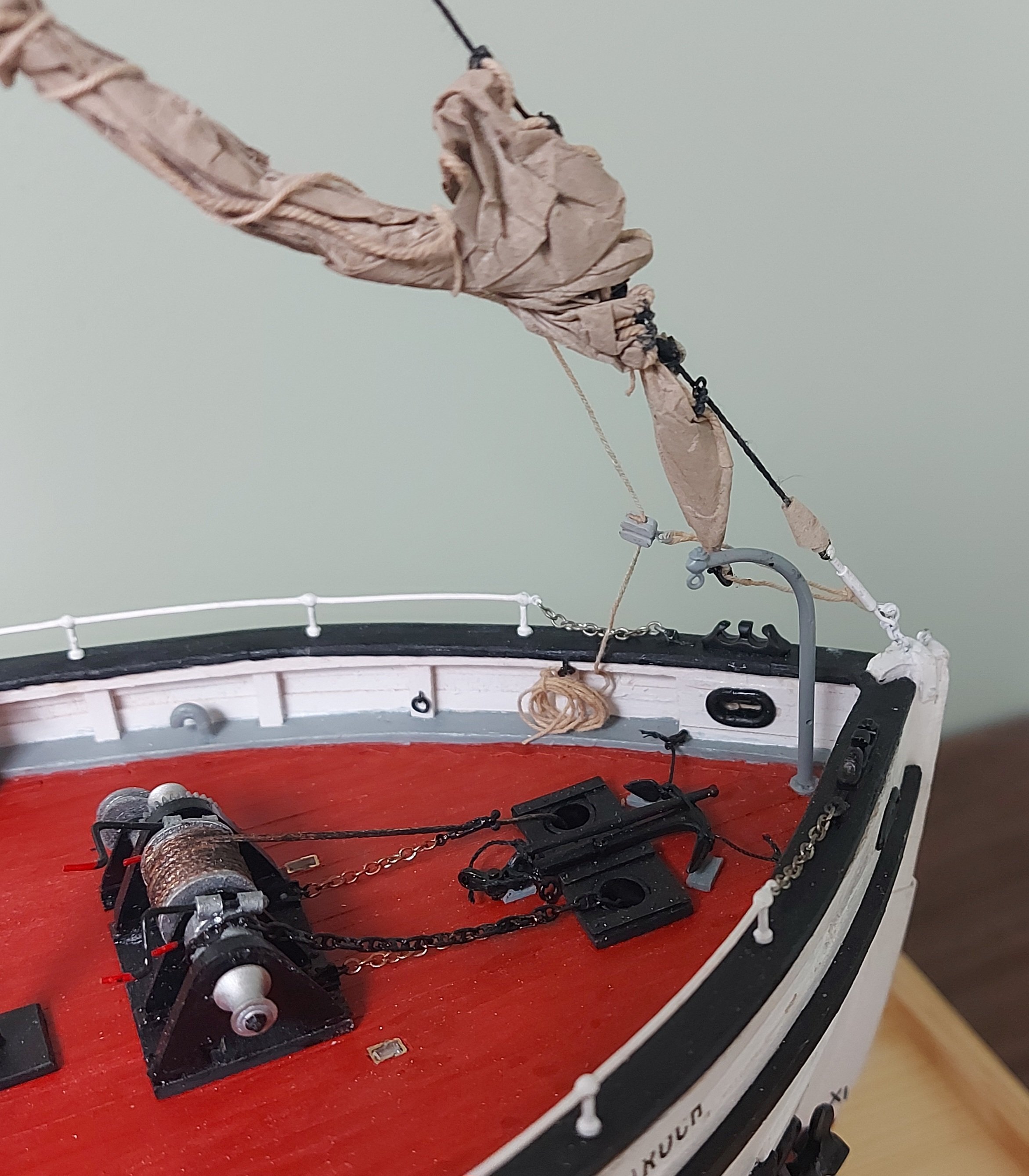

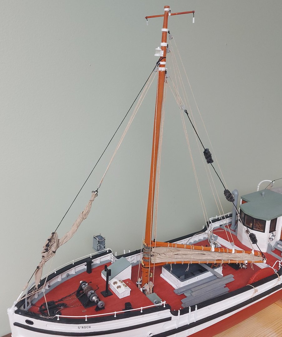

Furling the jib onto the model is now complete!
The jib stay went on without an issue, I passed the cable strands through the jib stay to create the eye at the mast, leaving enough slack line to pull the stay taught.
Of course the jib was already attached to the stay, so once the glue had set up I only needed to belay the halliard and downhaul, shown in the first picture...
Observers who have been following along may very well ask why is the halliard shackled to the clew instead of the head of the jib, and where are the sheets?
One of my contacts on the Board of the Vancouver Maritime Museum is also a sailor who lived on board his ship "North Star of Herschel Island", the last of the fully rigged fur trading sailing ships, and a contemporary of St. Roch. He has been a valuable source of details about period rigging.  St. Roch was a poor sailor and rarely used her sails, especially to move through the channels in the pack ice. Her jib needed to be triced up in order not to lay across the machinery on her fo'c's'le. I do have one picture showing the jib furled with the halliard at the head and the sheets on the clew, but the sheets do get in the way of the fo'c's'le deck access, and all other pictures show the sail furled without the sheets. He and I agreed, based on the photographic evidence, that the halliard was removed from the head of the jib and shackled to the clew in order to furl it out of the way.
This next picture shows St Roch in 1928 with the sail furled in this manner, all other later photos show the jib hauled further up the stay as I have modelled it, but this is the clearest picture of the rig.
This method does allow the sail to be set quickly if needed, and the next picture shows the downhaul, which is shackled to the head of the jib, as I have belayed it to a ring on the bulwark.
The rigging plan shows the downhaul, but not where it belays. If it was taken to the foremast like the rest of the rigging it would foul the windlass and other fixtures on the fo'c's'le. Since the downhaul was rarely used and only under tension when pulling down the jib, my consultant and I agreed that coiling it onto a bulwark ring would be correct, keeping the line handy while out of the way.
So what of the sheets? I showed a previous picture where today they are coiled on top of the companionway roof, but this is obviously incorrect for St. Roch during her working life, and if they were shackled to the jib's furled clew they would be in the way of the fo'c's'le deck...
