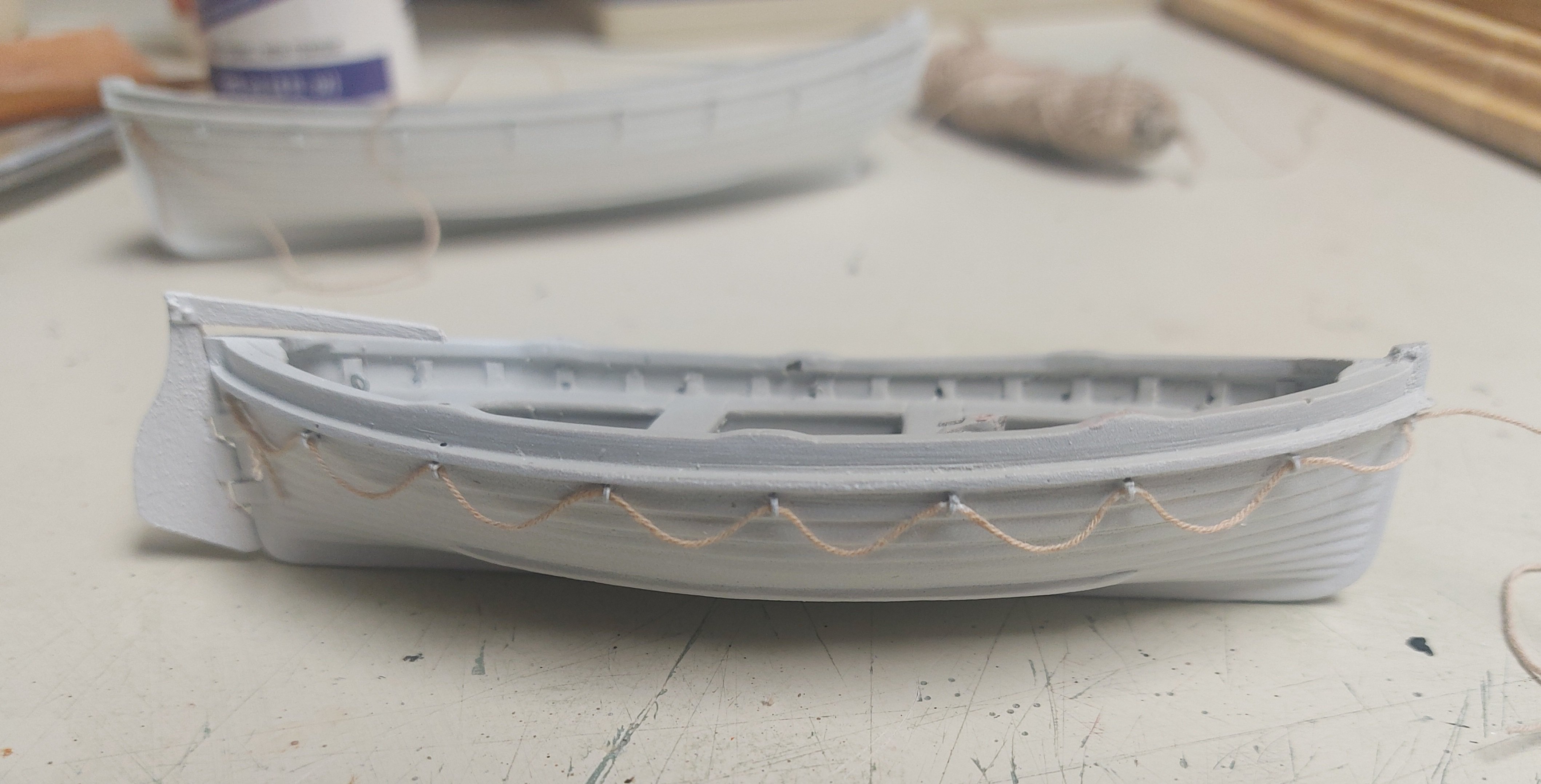

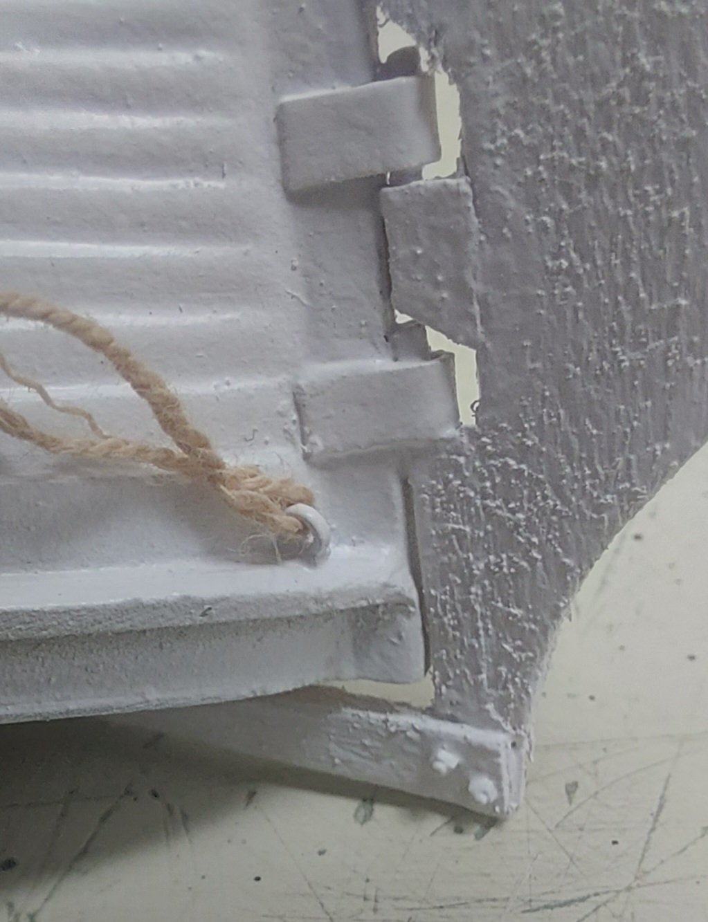

A rainy morning here in Alberta, so a good time to get some work done on St. Roch's boats...

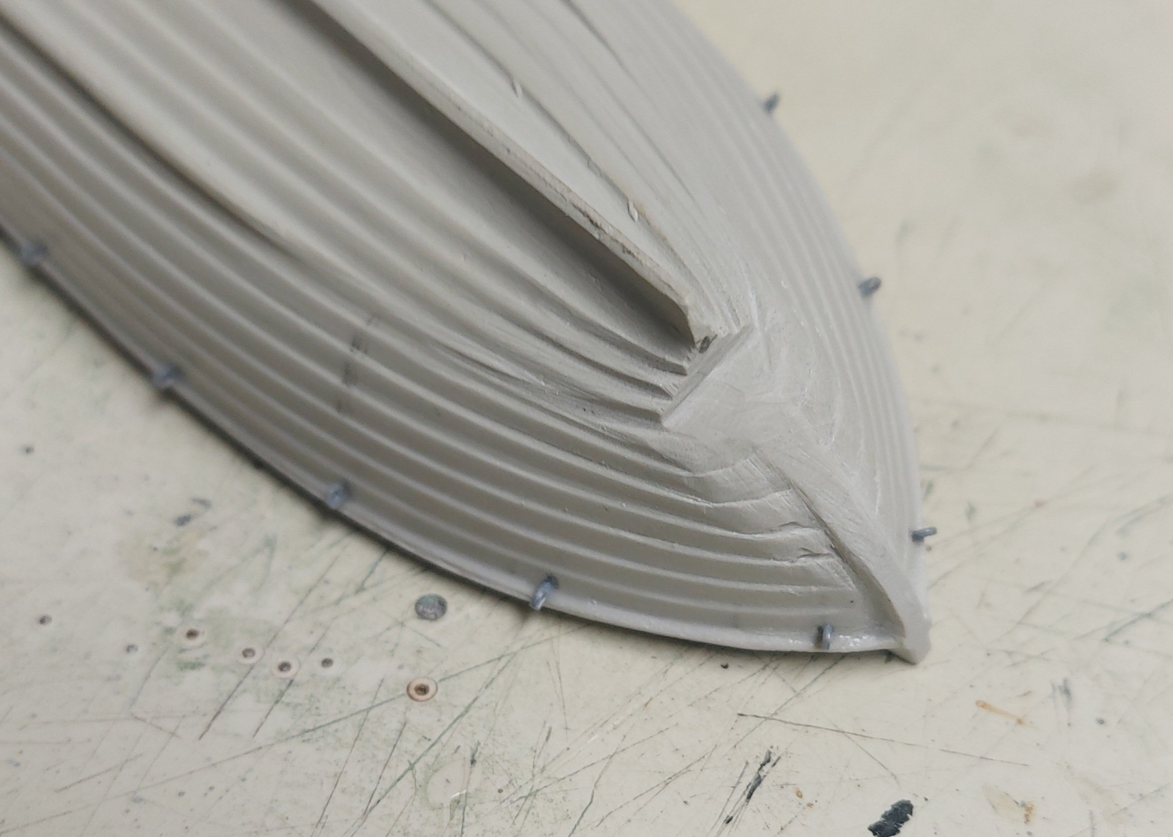

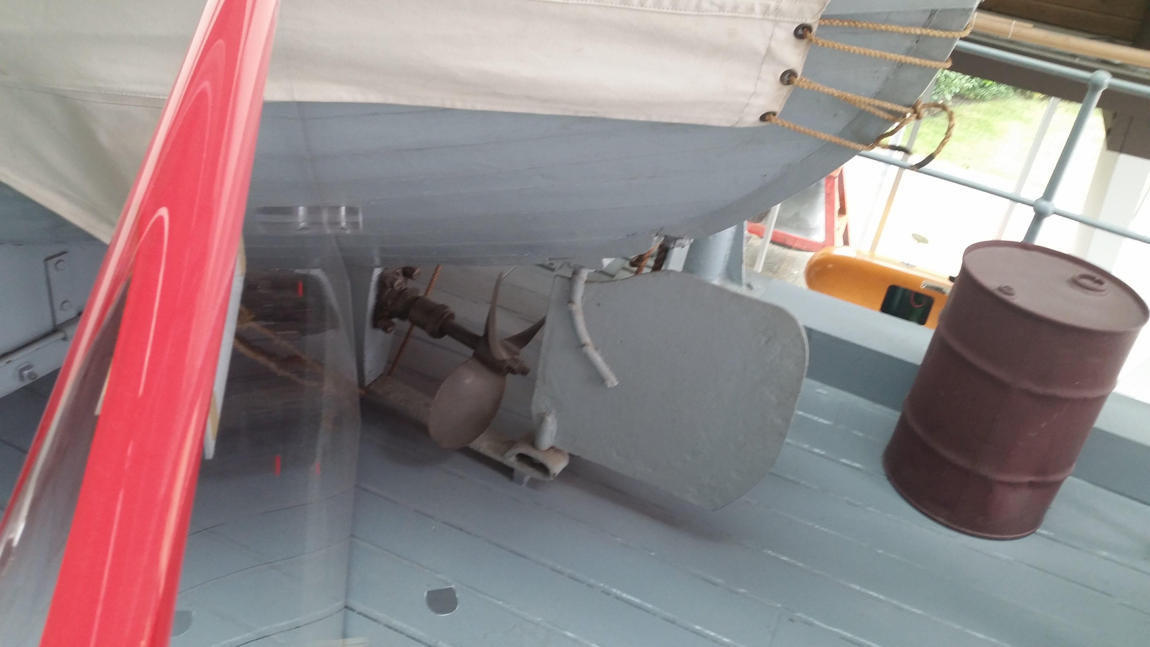

First I needed to carve back the stern of the motorboat. The first picture is St. Roch's motorboat showing the rudder and prop; this is what I am trying to emulate with the second picture...

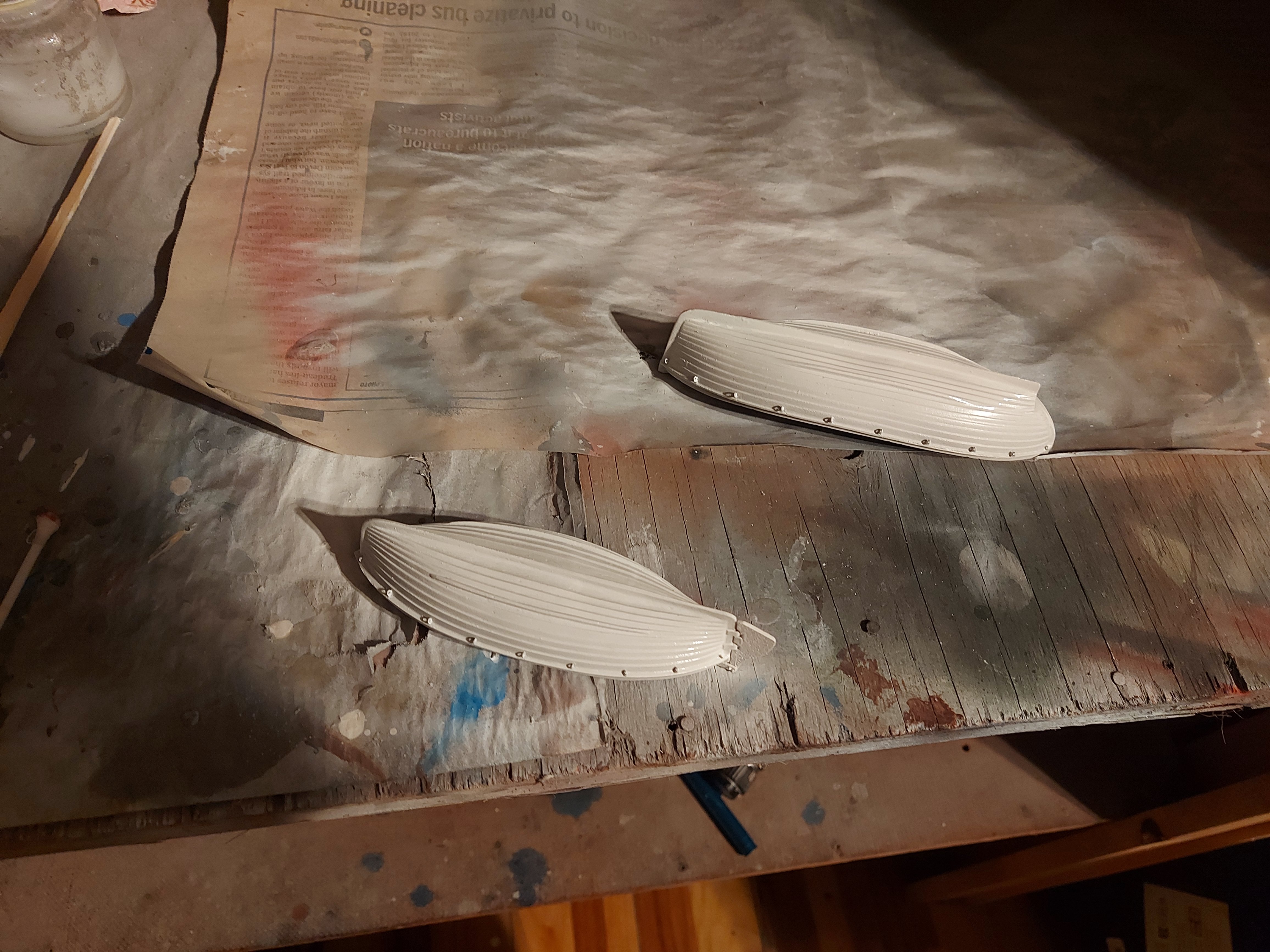

Then it was off to the paint booth...

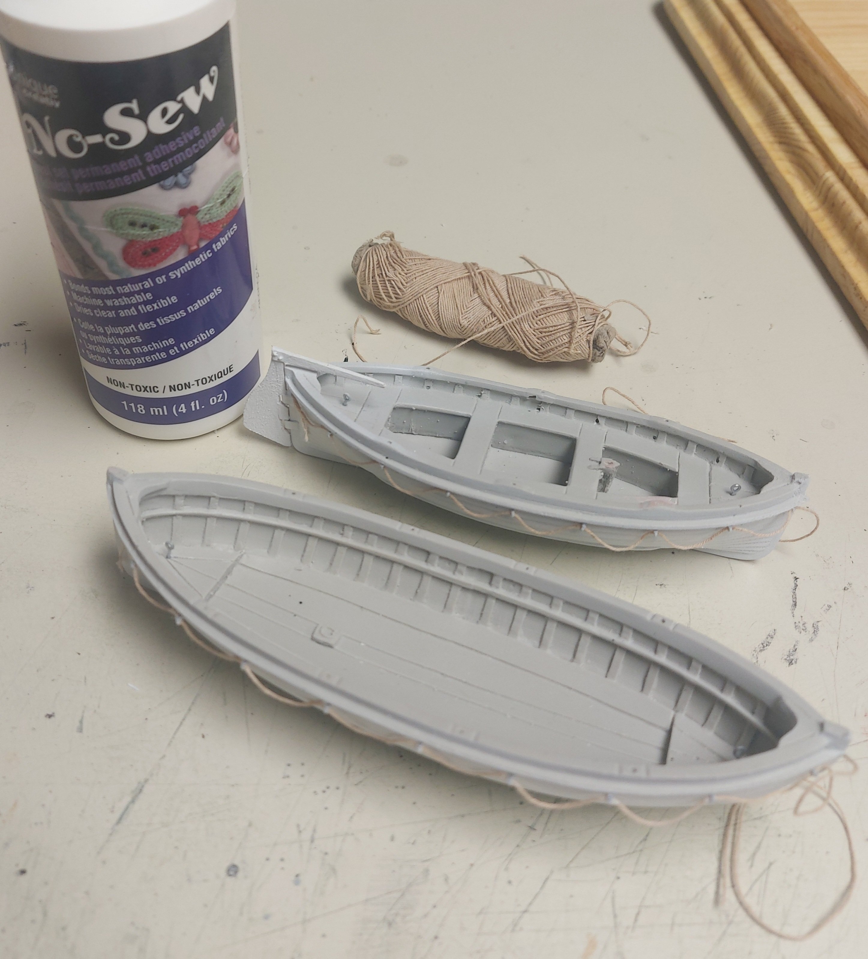

After the paint dried it was time to reeve the lifelines around each boat.
I made eye splices at the end of each line...
Here are the boats with the line and glue I used, ready for the final line splicing once the glue dries. I used 'No Sew' fabric glue to tack the lines into position... this dries clear and flexible, and will hold the lines in the proper shape while I make the final splices.
Next I am going to make a start with the silkspan sails, and make the boat gripes and covers. Then the davits should complete the hull work on the ship except for putting some cargo in the hold.

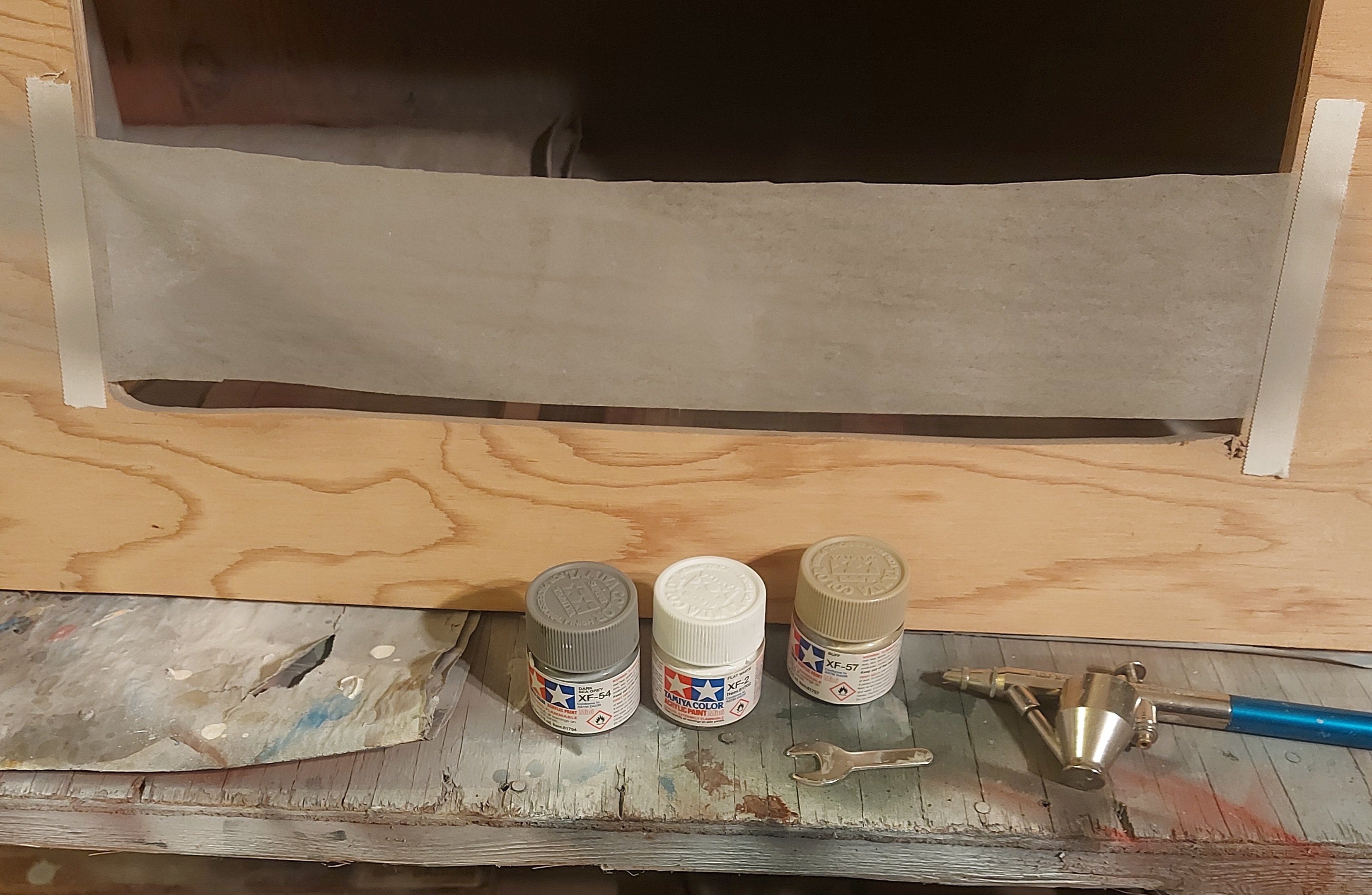

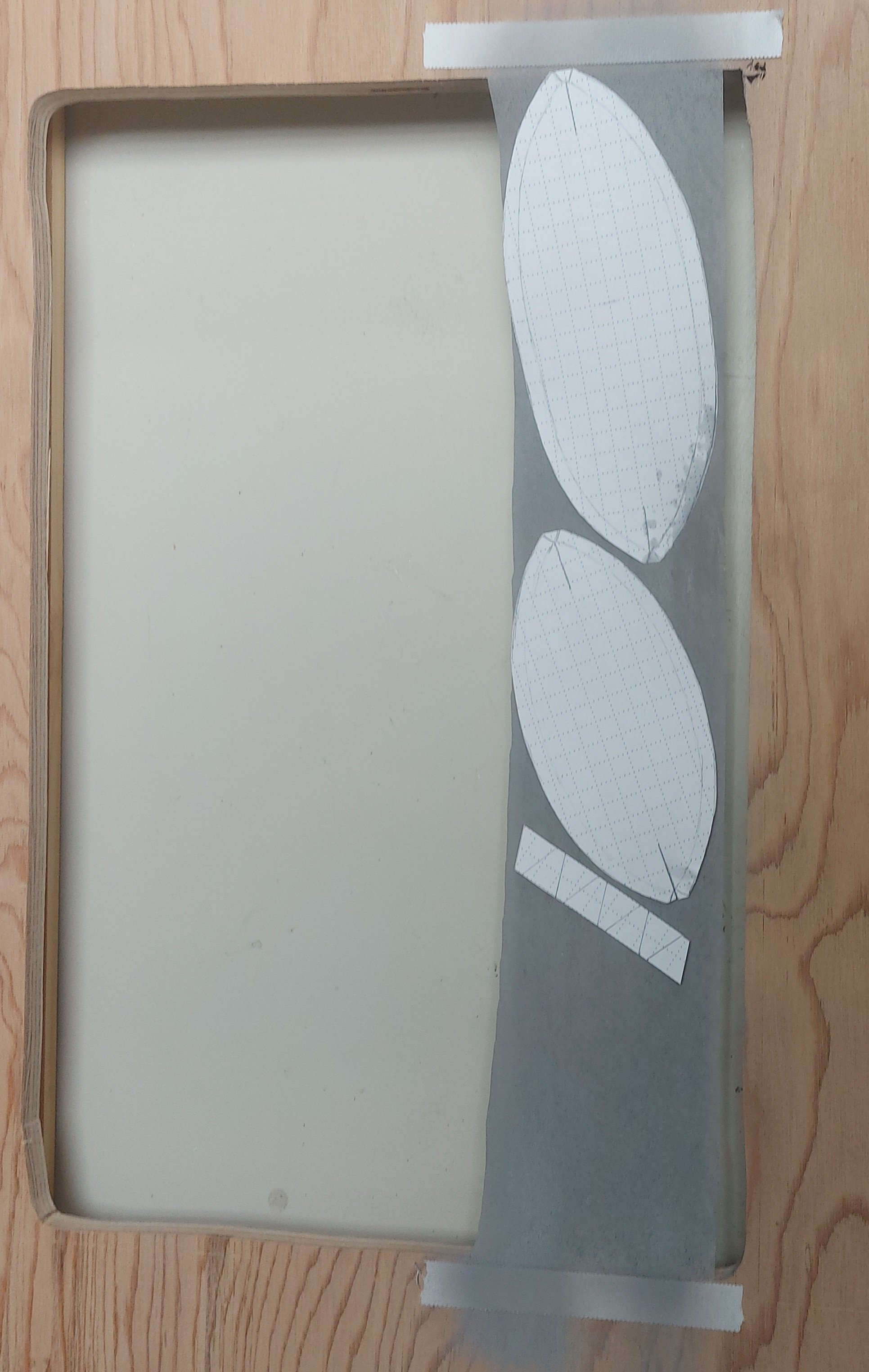

So back to the silkspan... I decided to first work with an offcut to make the boat covers. This leaves the main piece of silkspan for the sails, and if I mess up the offcut I can still make the sails (I hope)!
I had previously (on page 8 of this build log) made the frame to hold the silkspan. Now I wetted the offcut and taped it onto the frame, per David Antscherl's directions. I deviated by using medical adhesive tape since I could not get the paper packing tape in Beaumont. It is waterproof and seems to work very well. Taping two sides vs. all four did not seem to matter on a piece this size. Here is the wet silkspan drying on the frame.
Next I coloured the silkspan to match what I think the boat cover canvas would have looked like. Rather than the artist's tube paints recommended by David I chose to use my Tamiya acrylics. Buying tube paints would leave me enough left over that I could will them to my heirs! The Tamiya paints are water based and give me a broader range of colours, and would go on with my airbrush, which I considered a better technique than brushing.
I used a base of flat white, and added a drop of buff and another of dark sea gray. My airbrush cup was about half full, so I topped it with Tamiya thinner and sprayed it onto the silkspan. Here it is in the spray booth. I laid down two coats, light enough that there were no runs.
When I moved he frame to my bench I saw that the colour was more gray than I would have liked.
Memo to self, better lighting at the paint booth!
Here it is drying on the bench with the boat cover templates laid on top.
After it dries, if I am still not satisfied, I'll shoot another coat of diluted buff to try and get more of a canvas colour... we'll see.
Next will be to cut out and assemble the covers, then try to get them to fold nicely over the boats...
Thanks for looking in, tips and critiques are always welcome!

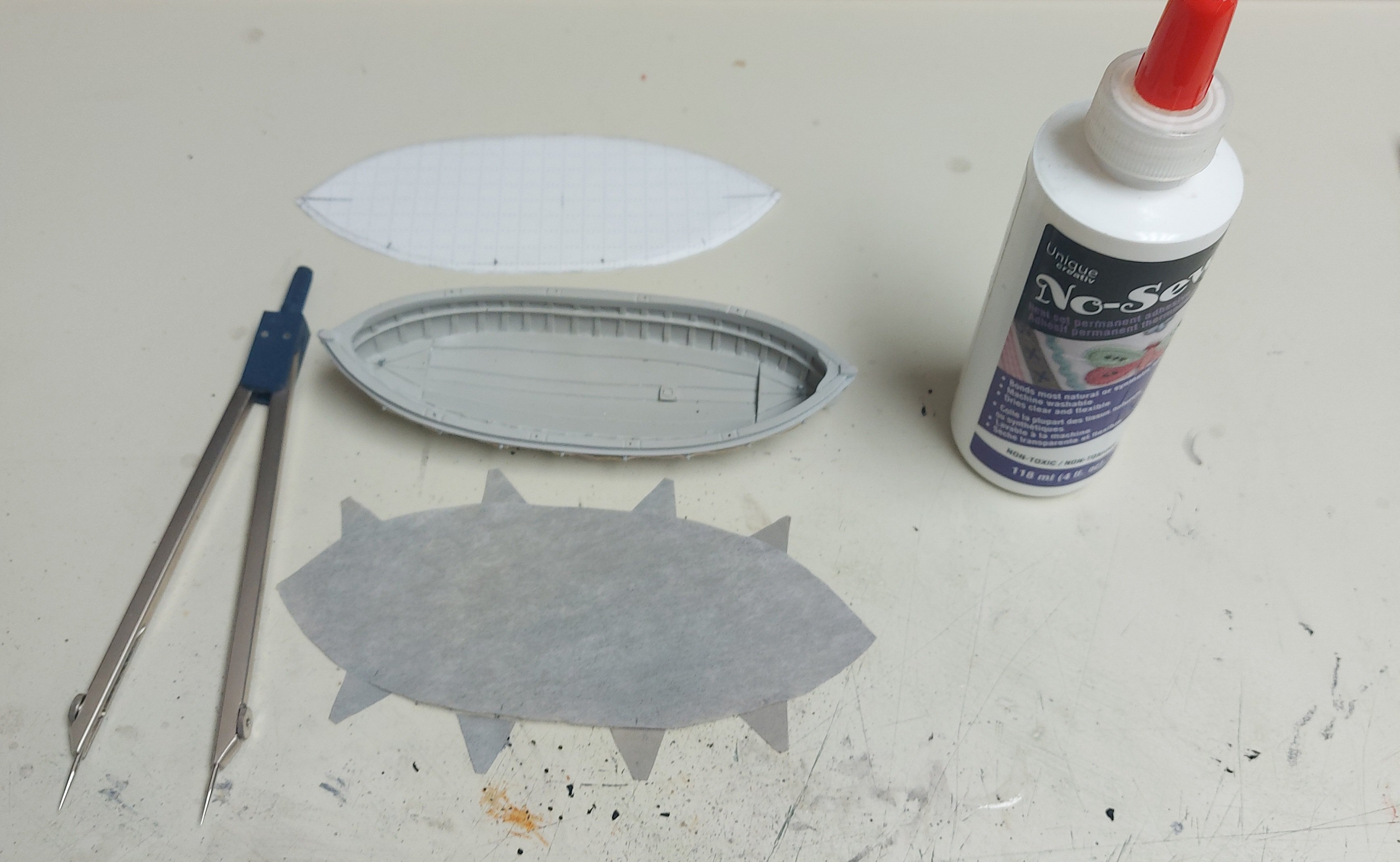

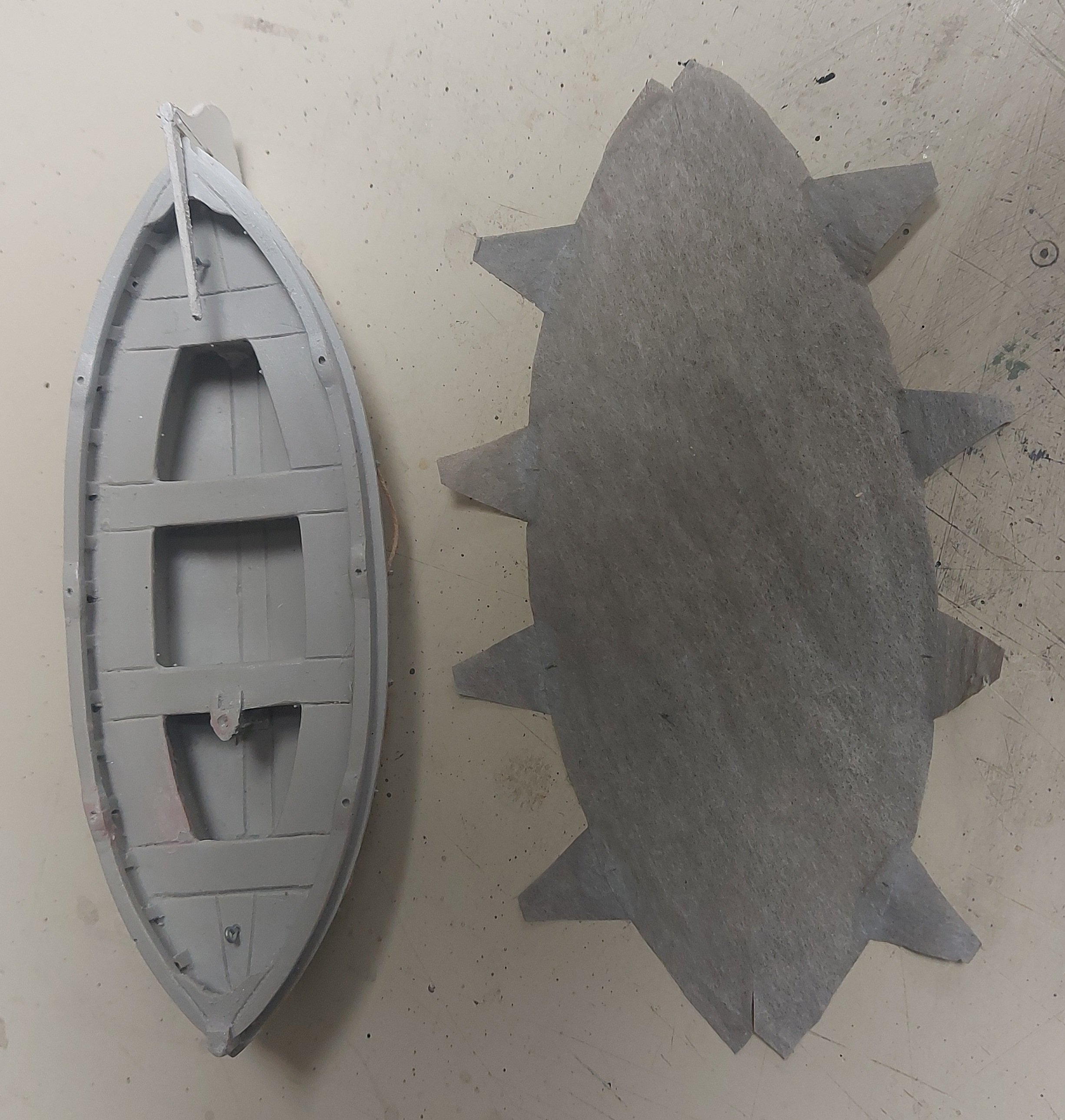

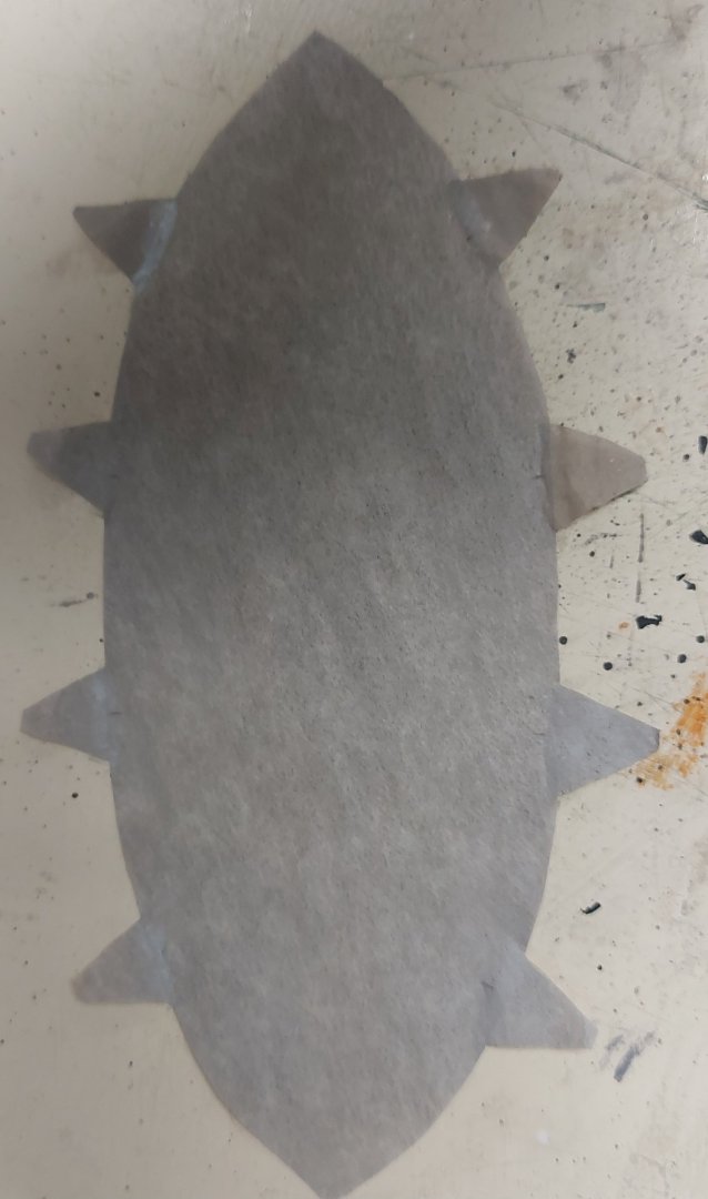

After some back and forth with the airbrush I am happy with this shade for the boat covers... the picture shows the paper template, the cover pieces cut from the silkspan, and the 20' motorboat...
The triangular pieces are the tie downs (not sure if they have a nautical name or not?) They are just set in place to see how things look. David Antscherl recommends Matte Medium for gluing silkspan pieces together. I have lots of 'No Sew' on hand so I'm giving that a try. I have used it before with great success gluing flags to halliards and anything else involving fabrics. It dries clear and flexible, and once set up it can be washed, so it is waterproof.
Here is the motorboat cover assembled, waiting for the No Sew to dry. We'll see how it holds together when I wet the cover to fit the boat, and when I lash it down... I'm going to give it a day and maybe a second application from the back side... delving into uncharted territory here!
The proper name for the small boat cover or canvas tie down rope is  ......... darn it, I forget!

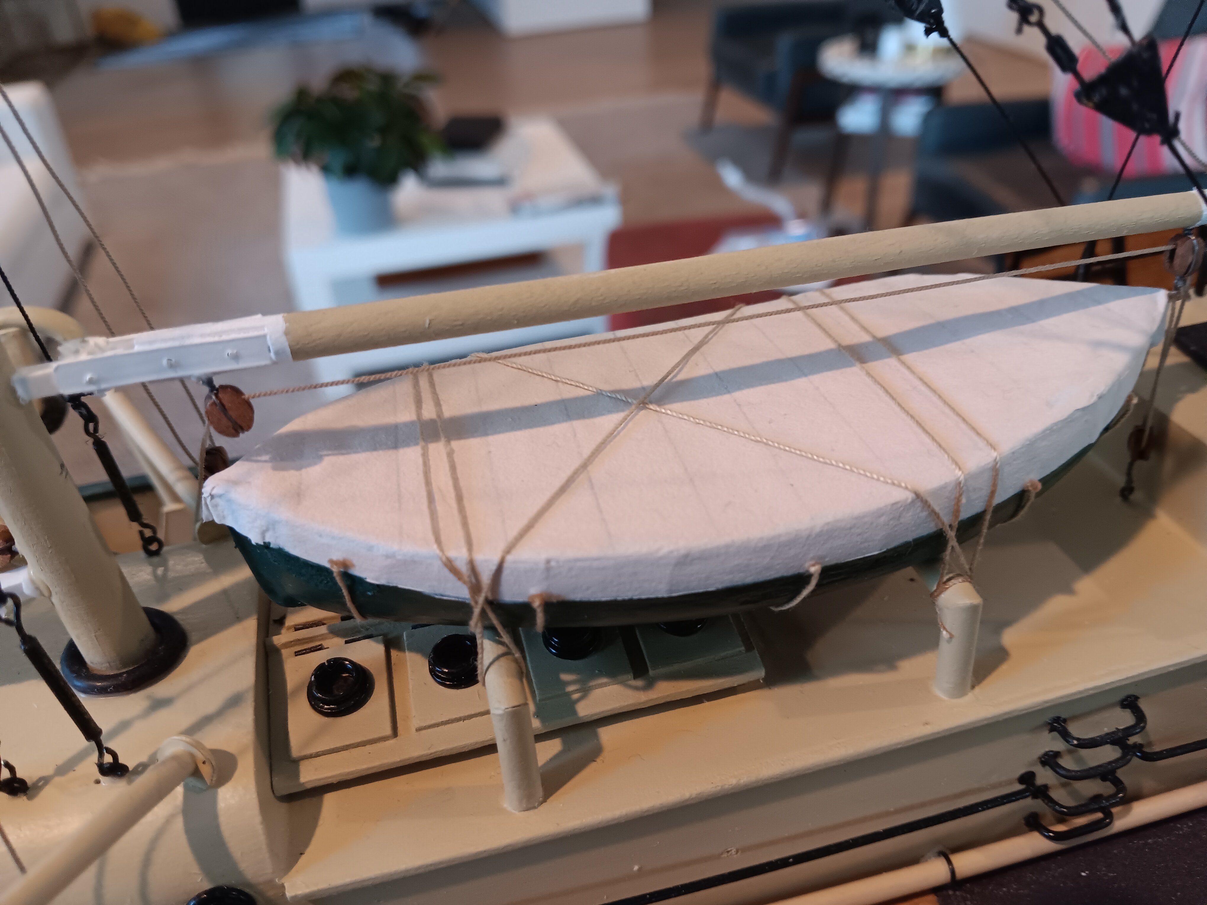

Your build is coming along very well.
Here was my attempt at a cover using silkspan. I cut it oversized so it would hang over the sides a bit. I wet it down to fold and bunch it up. Then I glued a long strip of silk span along the edge around the boat. Trying to look like a sewn piece. Then attached some thread as tie downs. The trick is getting the material that folds over the edge to not bunch up too thick.
I have 4 to do on my current build so I am interested to see how your method with the triangular tabs works out.
Bill
Thanks Bill, your boat cover looks great! nice idea about gluing a strip around the edge, I'm hoping mine fold over when wetted without the triangular pieces falling off!
Regards,
Bruce
 if those triangular pieces don't have a proper nautical term let them be forever known as "cats ears"  :)

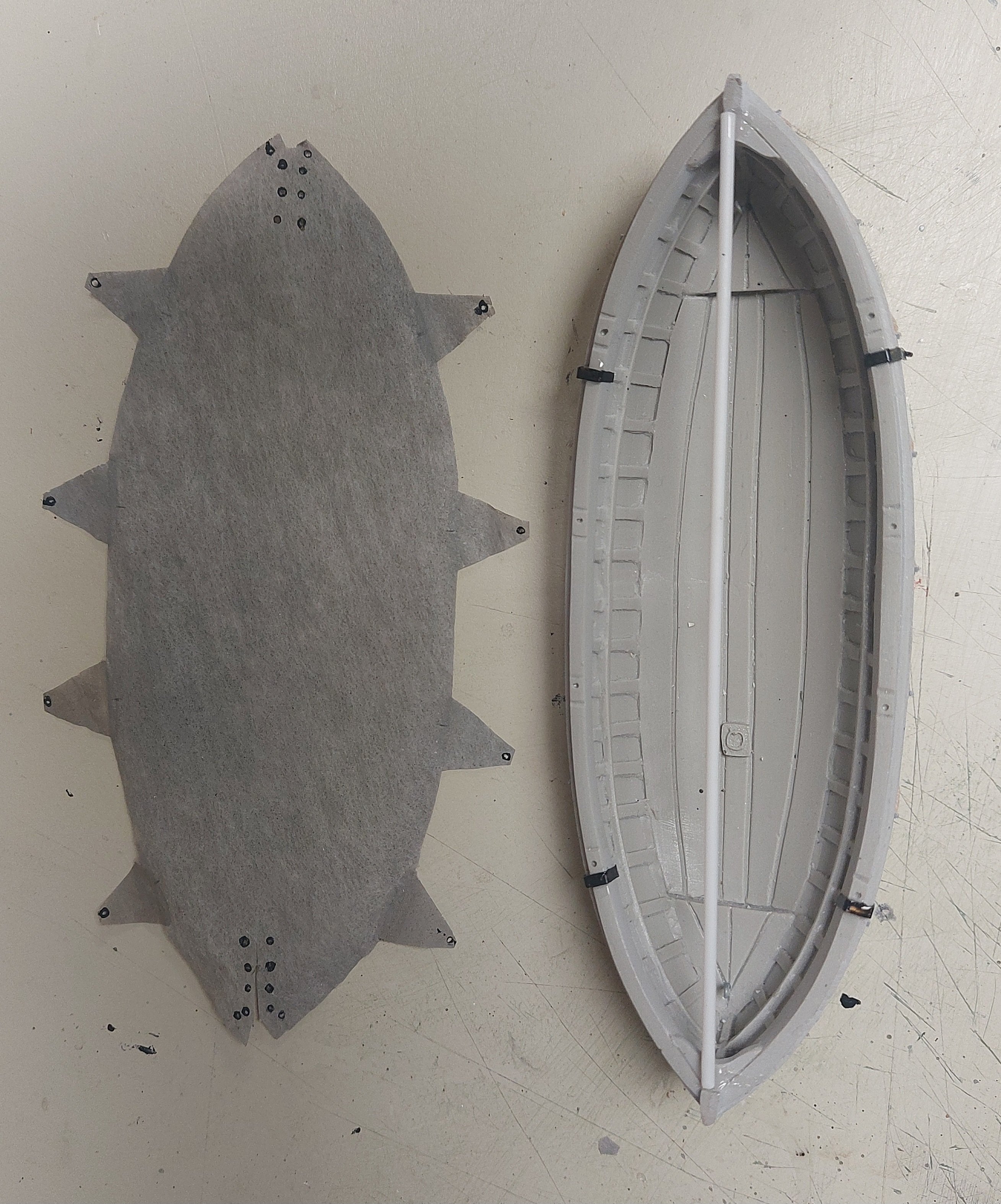

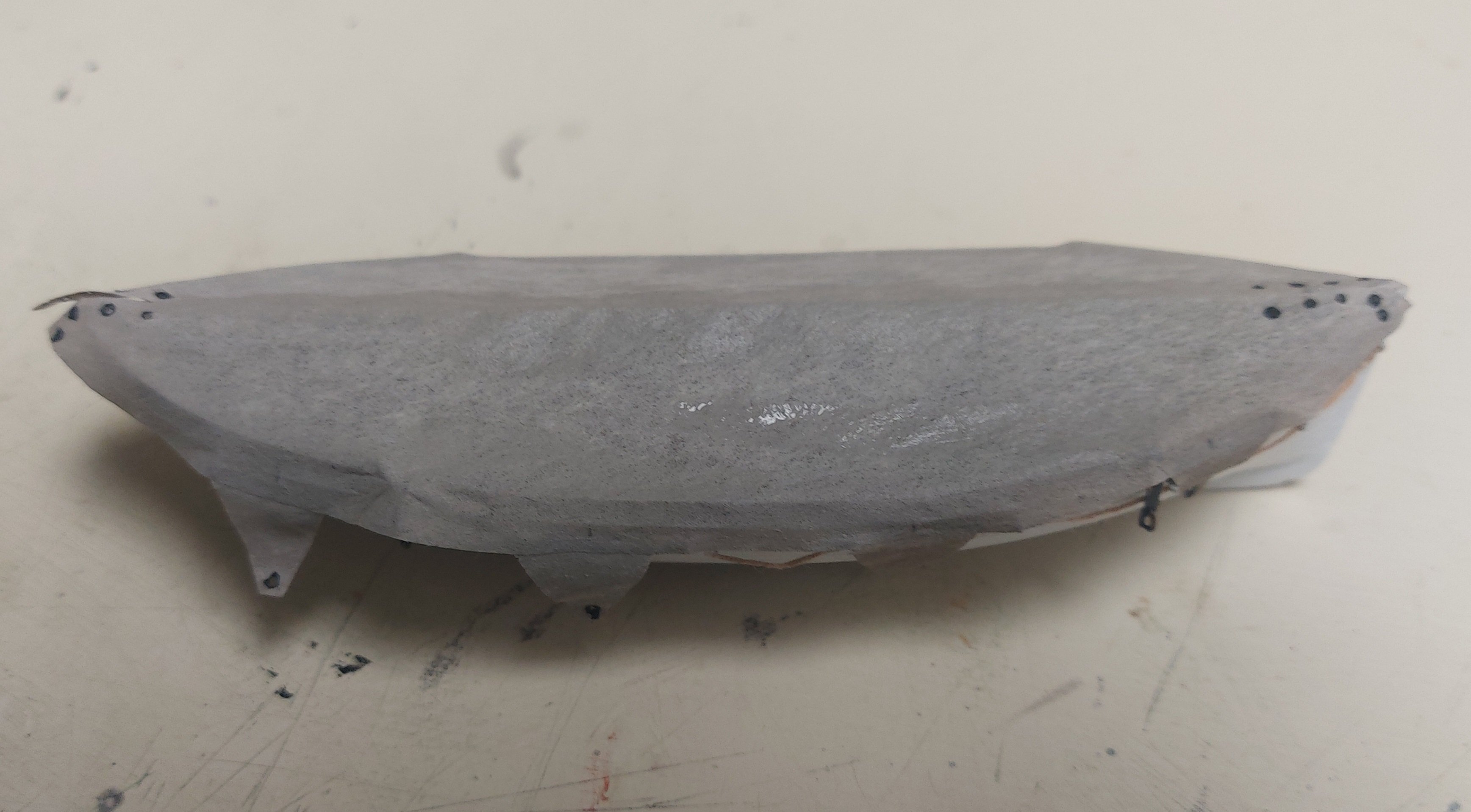

Progress on the boat covers... the No Sew worked a treat, and bonded the 'darn cat ears' very well to the cover...
I moved on to drill the grommet holes, and like David Antscherl said the holes drill cleanly in the painted silkspan. I used a tapered cocktail toothpick dipped in Tamiya XF-18 Semi-gloss Black to paint the grommets. Just dip the pointy end into the paint then into the grommet hole, it leaves a neat painted circle.
After that I prepared the motorboat by gluing a spar bow to stern to 'tent' the cover like the original, and also glued the gripes in place.
The picture shows the boat and cover to this point.
Next I centered the cover over the boat and used a water soaked paint brush to wet it, enough to start getting a tent shape and fold around the edges, and the 'darn cat ears' stayed on, Yay!
I left it at this point to dry, I will give it another wetting before lashing the cover to the boat. First I have to lash the triple blocks to the eyebolts in the boat, these will be the lower part of the falls.
Almost made a mistake when I forgot to make sure the 'darn cat ears' would not interfere with the gripes, but fortunately there were no conflicts!
So far so good, so I made a start on the dinghy. Since it is done the same as the motorboat I won't repeat the details in this log.
Next time you see the boats they should be in their chocks with everything lashed down!

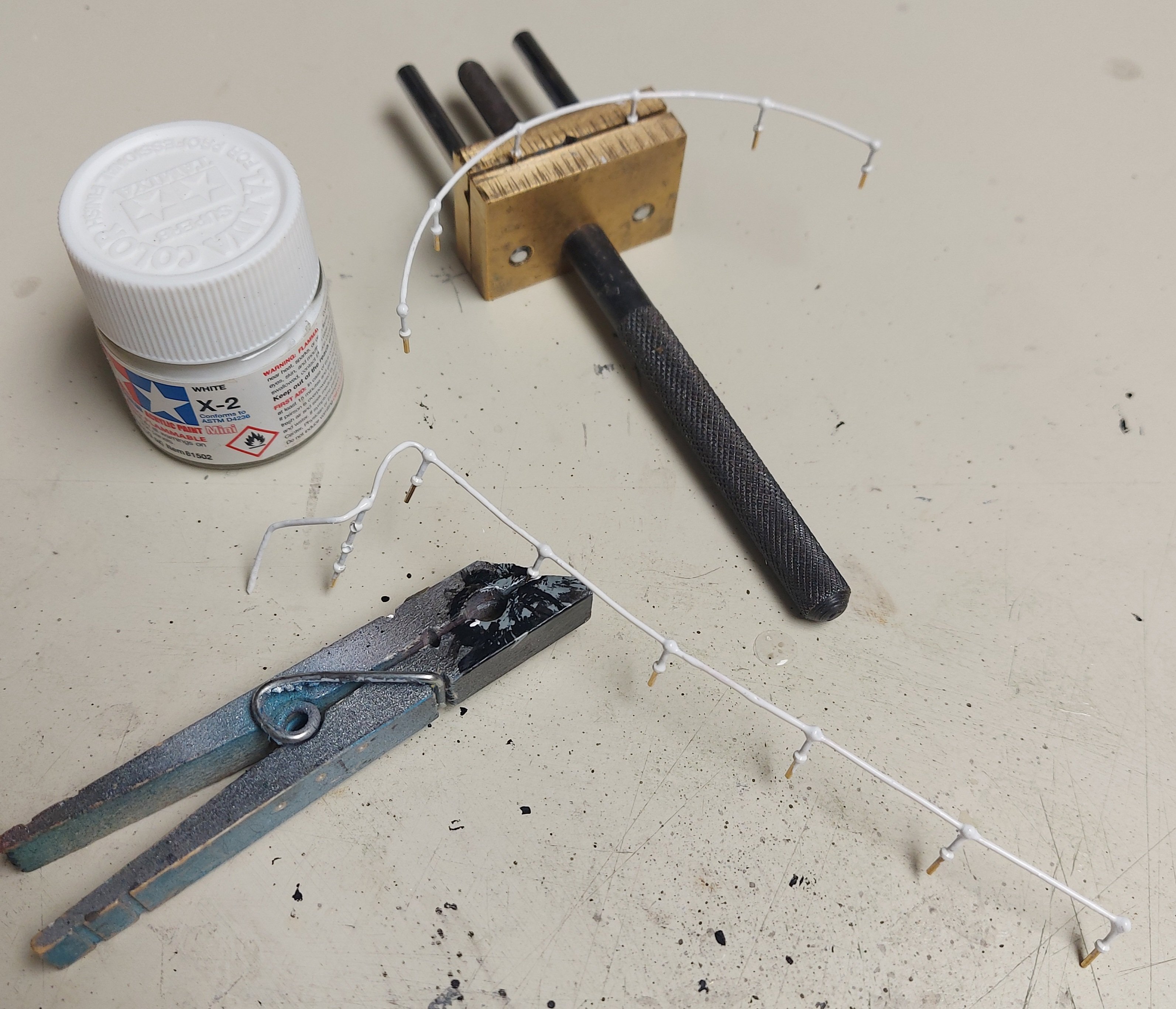

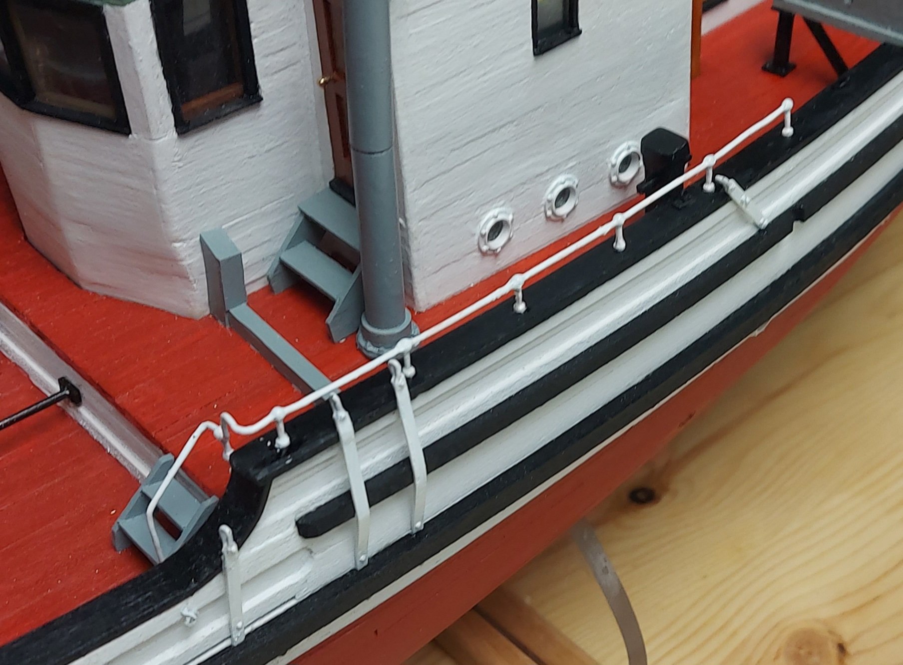

And here they are done, didn't take much time at all.
The first picture shows the shaped rails off the ship for painting. I never try painting anything so fussy on the ship where the paint will get everywhere it shouldn't!
After painting they popped right back into their holes...
Et Voila! Done!
