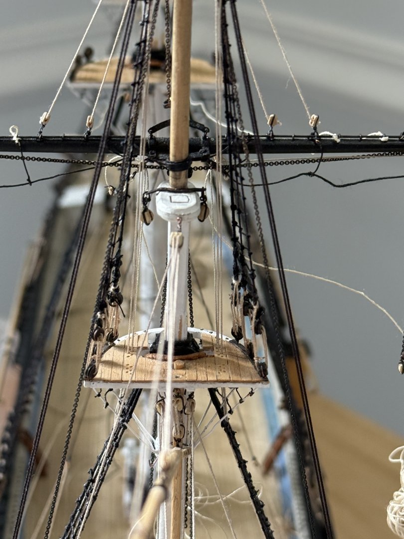

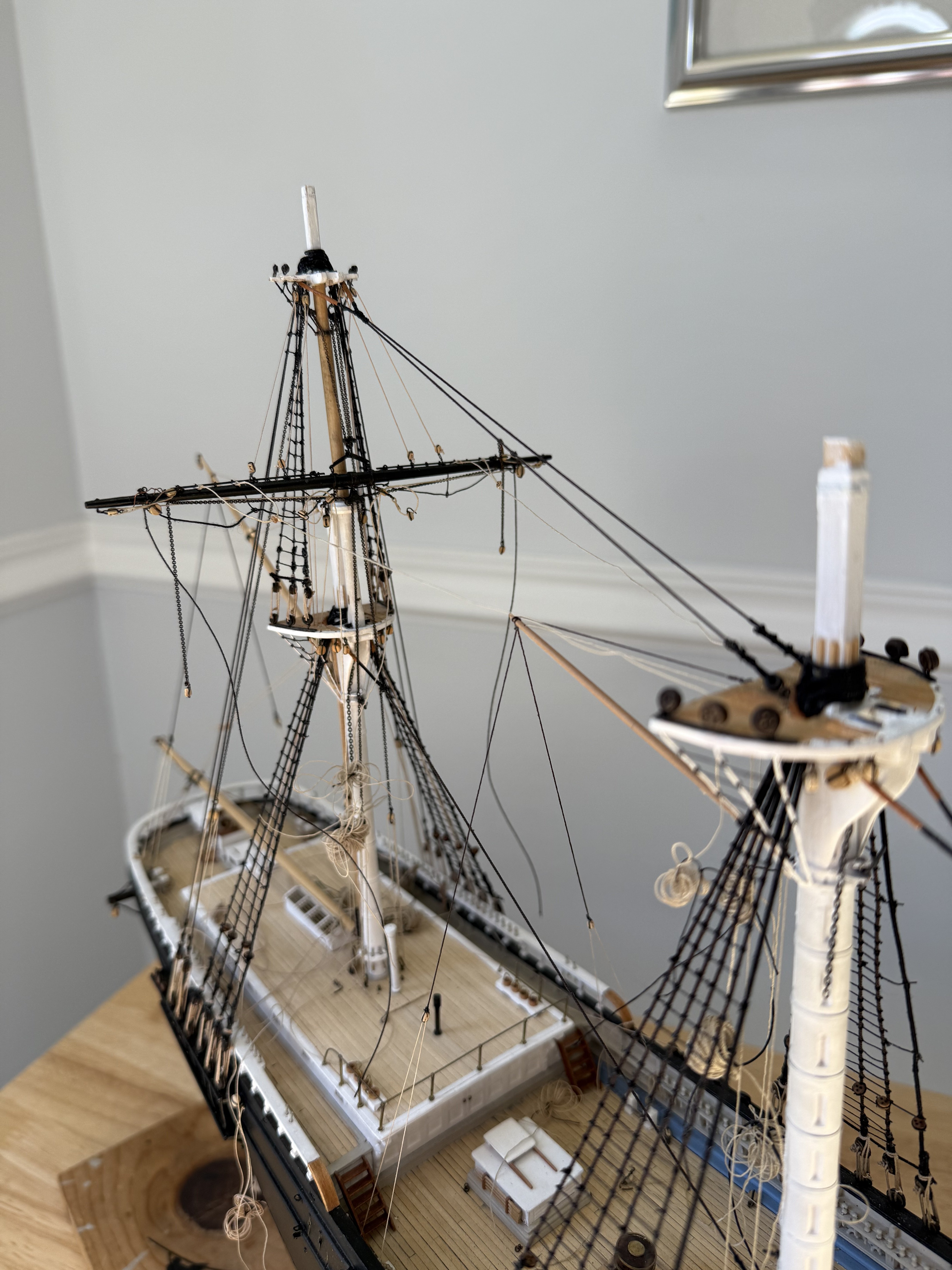

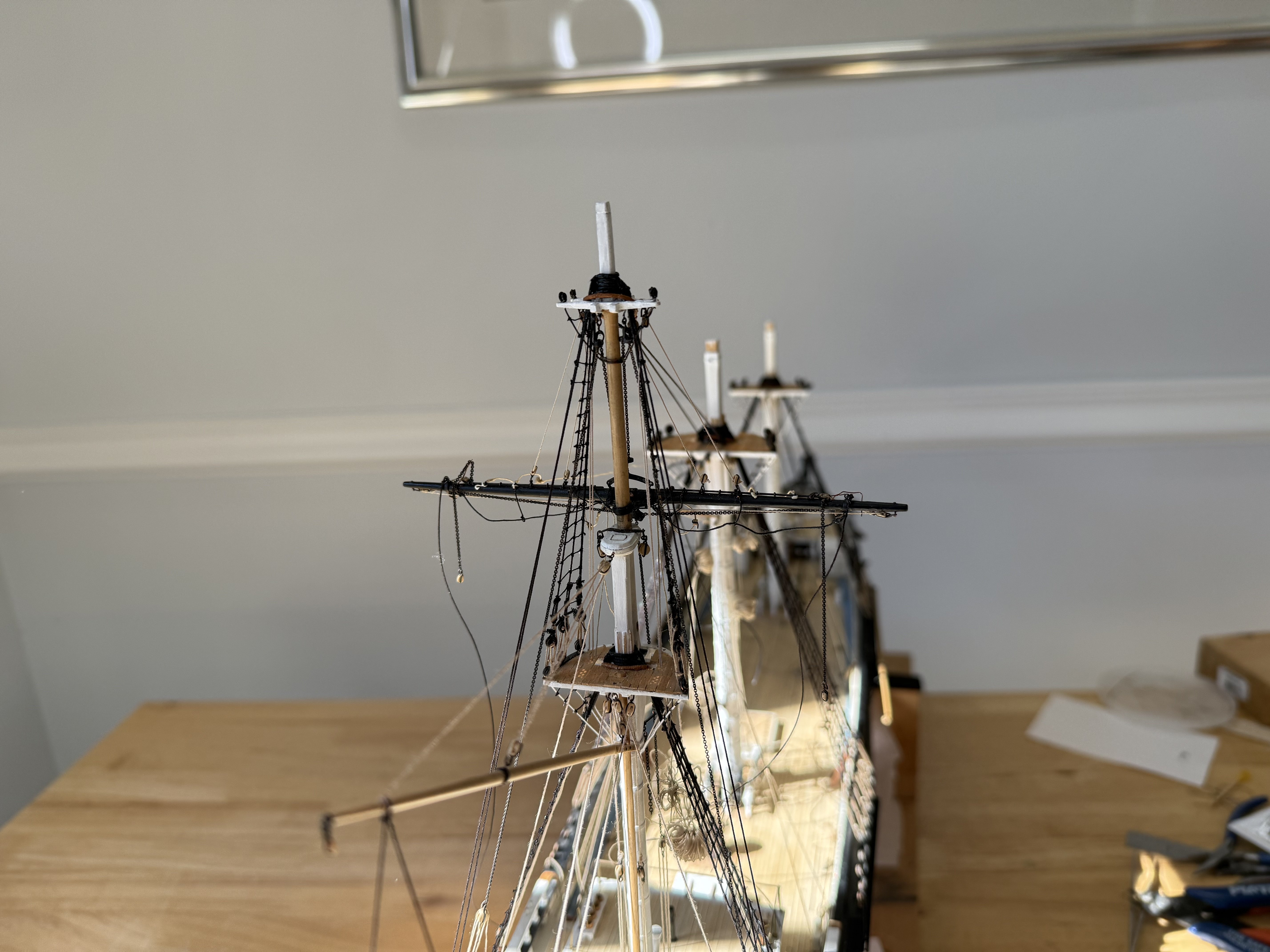

Finally finished rigging the mizzen topmast.  This included the shrouds, lanyards, backstays and the ratlines and the mizzen topmast stay.
I also finished rigging the mizzen topsail reef line, and the bunt and leech lines.  These are not yet permanently secured to their belaying pins.  The topsail bowlines were also temporarily run to their blocks on the aft side of the main top to get them out of the way for the time being.

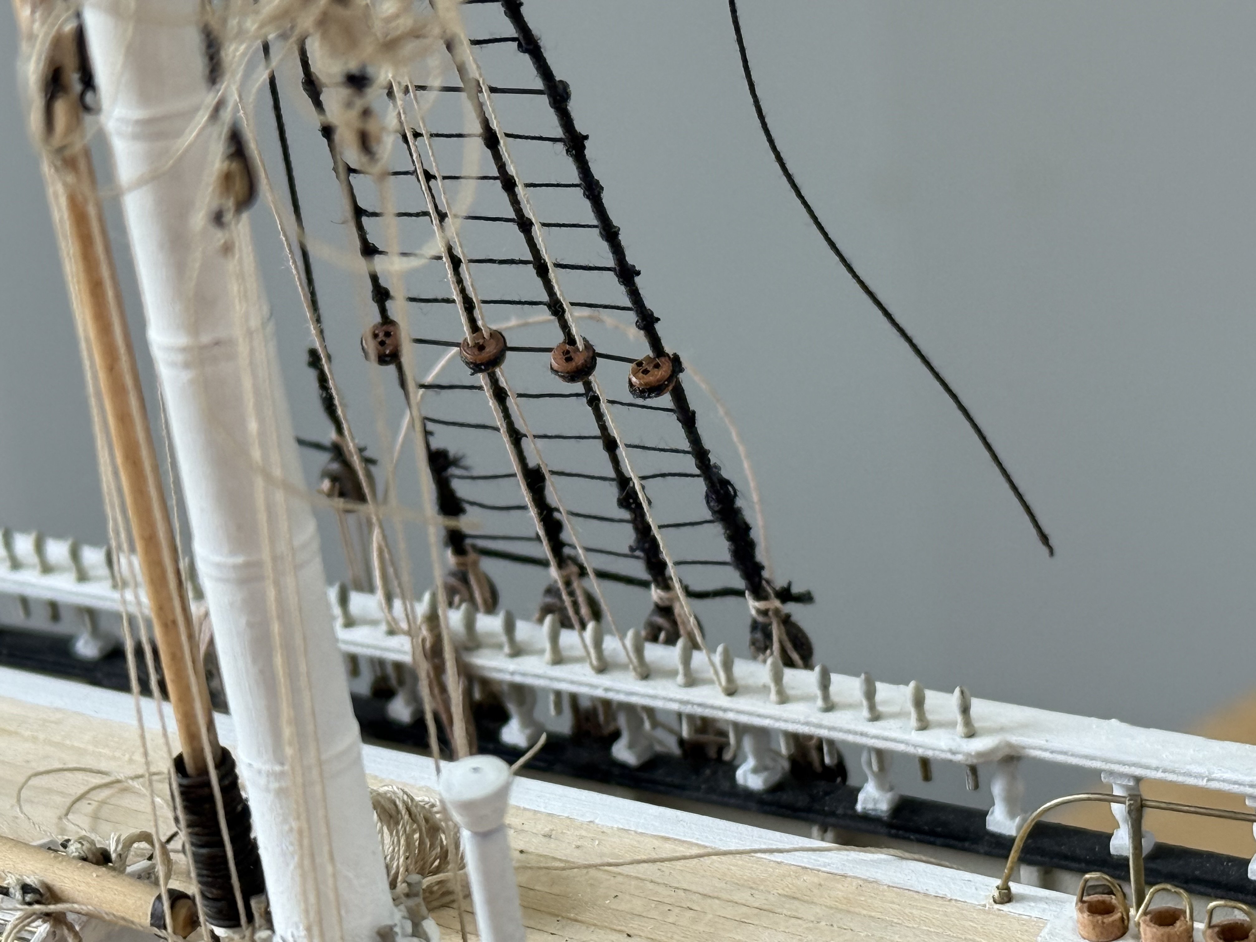

One major flaw with the plans, in my opinion, is the lack of information on which lines run through which holes in the fairleads in the top and on the shrouds.  Also, the plans fail to show accurately the relationship of the pins in the rack rail to the shrouds.  This often results in a specific pin not being as close to the shroud fairlead to insure a straight path.
The result is that I have to modify which lines are belaying to which pins. I am not able to follow the belaying diagram which I’m sure was based on accepted practice. This  probably explains why I had to run the mizzen  peak halyard aft due to interference with the mizzen top.
The run of the bowlines are my interpretation base largely on the Flying cloud model at the Boston Fine Art Museum.  May be wrong but seem logical to me knowing that the run of the bowlines had to be such that they would not interfere when lowering the yard quickly, same as the braces.
If anyone has any thoughts, I would love to hear them!IMG_5726.thumb.jpeg.c7f820c2964d5c2dff7e75aa626b2a0b.jpegIMG_5725.thumb.jpeg.02985940b8d1981032998acc217b3c23.jpegIMG_5724.thumb.jpeg.9bef672c3ef96c1f0fdbc40f7b09cac3.jpegIMG_5723.thumb.jpeg.9f64c2d457ae3090a93412fe95ef90a3.jpegIMG_5722.thumb.jpeg.6e289ccc892ee177e40de0a50710e49c.jpegIMG_5728.thumb.jpeg.639d656f8f0129acc00d5be83aa3d6a1.jpegIMG_5729.thumb.jpeg.c4894a614b708ace2f59260ea4859f20.jpegIMG_5728.thumb.jpeg.639d656f8f0129acc00d5be83aa3d6a1.jpeg

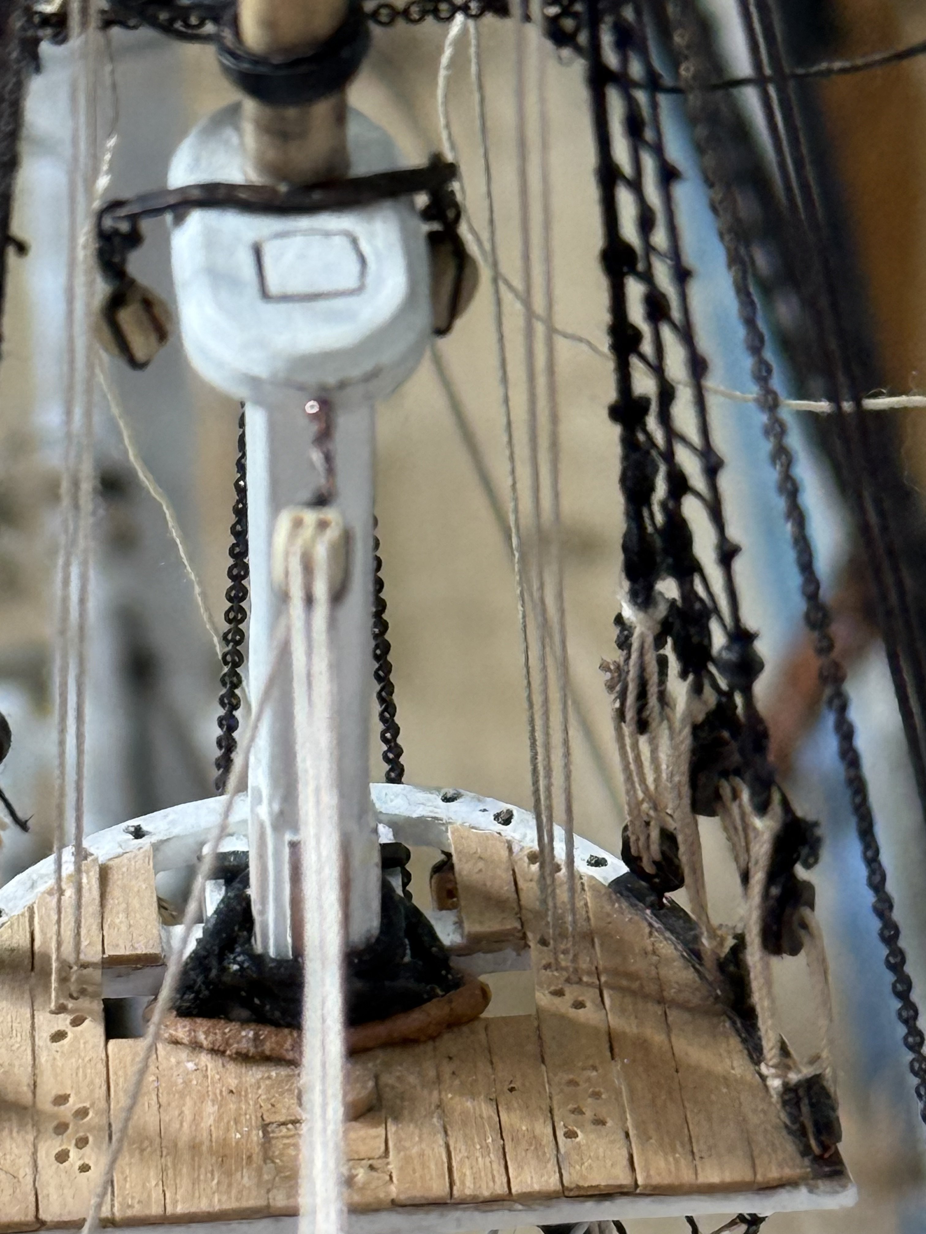

Really nice looking Rick! I know this is a small detail, but how did you get the fairleads on the shrouds so neat? It was a perpetual source of frustration trying to get them to stay in place.
Regards,
Geirge
George, sorry it has taken so long to get back to you!
After filing a groove in the deadeyes/fairlead with a round diamond file, I glued black thread in the groove on the inward side of the fairlead (away from the shroud).  I used titebond wood glue.  When that had set, I wrapped the thread in the groove around the shroud and tied an over hand knot.  Then I wrapped the thread back round the fairlead and tied another over hand knot that was then glued with cyano.
I found the failed would still rotate around the shroud, so to keep them in place, I touched them with a drop of cyano to the shroud.
Sorry for the long explanation!
Rick
