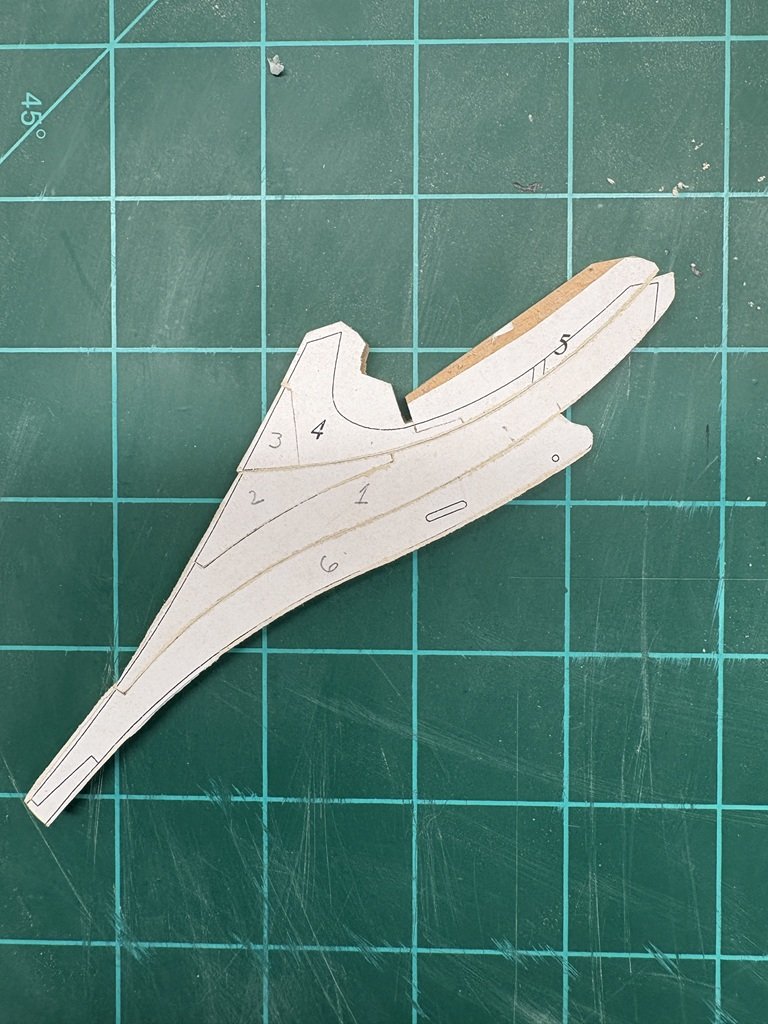

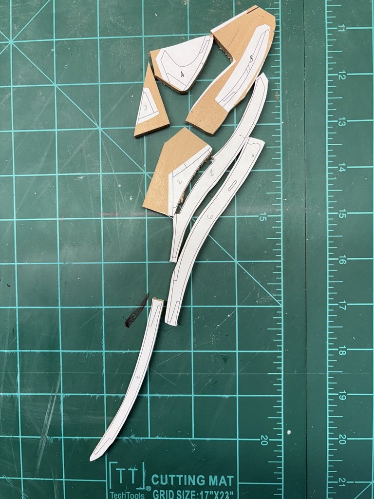

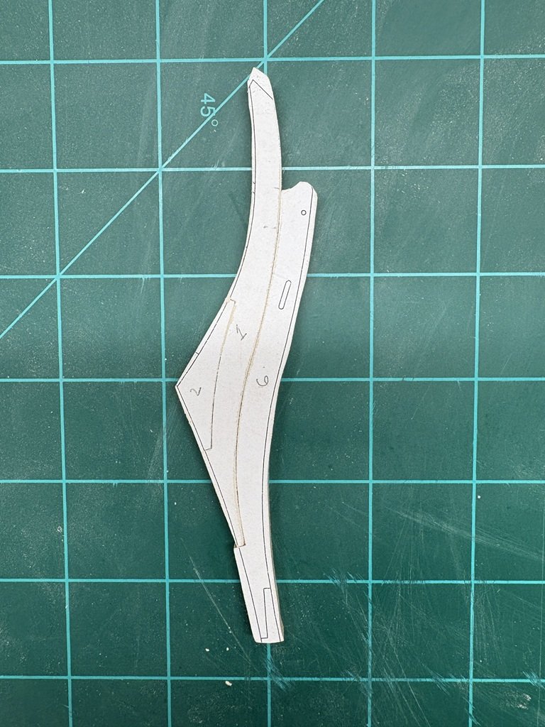

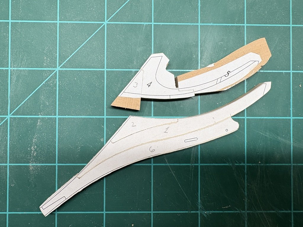

I decided to start work on the cutwater. Templates for all the parts were rubber cemented a sheet of Swiss pear and cut out with the scroll saw - some closer to the lines than others depending on the size / complexity of the parts. This is my first opportunity to fabricate a built-up cutwater and I am looking forward to the experience. Of course the situation leaves me with some questions as how to proceed. Here's the current plan:
I've numbered the parts in a perhaps strange order - parts 4 and 5 are numbered in the plans, but the rest are not, so I chose a numbering system that seemed reasonable but would not mirror the intended order of assembly.
1. Fay parts 1 and 2
2. Smooth top and bottom contours of the assembly
3. Fit and add part 6 (remembering to have shaped the top S-curve of 6 beforehand)
4. Form and add parts 3, 4, and 5.
5. Begin matching this assembly (parts 1-6) to the stem.
6. Match the inner side of 7 to the stem
7. Cut the scarf joints on 6 and 7
8. Connect 7 to the 1-6 assembly.
9. Continue shaping the joint between this unit and the stem
10. Add the forefoot to the stem assembly and insure the cutwater matches well with the stem and the joint between part 7 and the forefoot.
11. Set the cutwater in a safe place and have a nice glass of scotch and/or whiskey!
Tapering of the cutwater, etc. can then be done at a later date.
Please let me know if I am missing something important here.

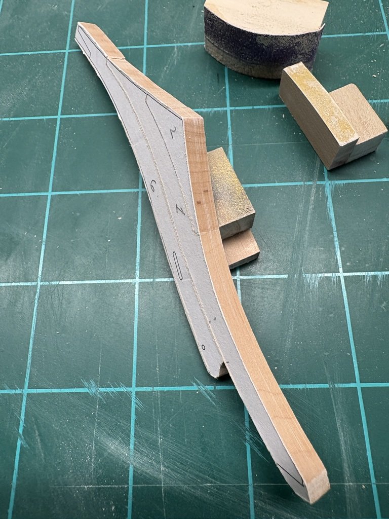

So here are the cutout parts and a start of forming the joint between parts 1 and 2.

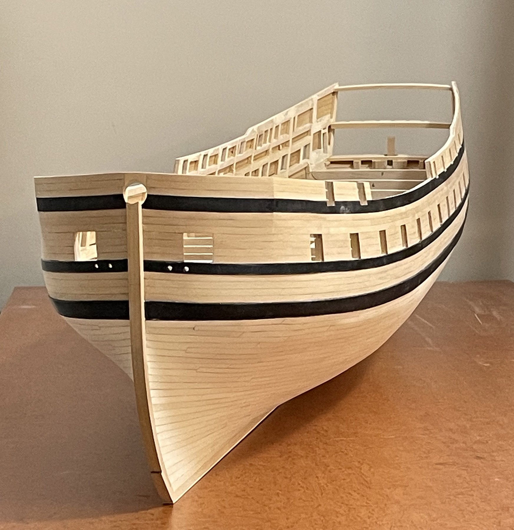

Is this South Carolina?

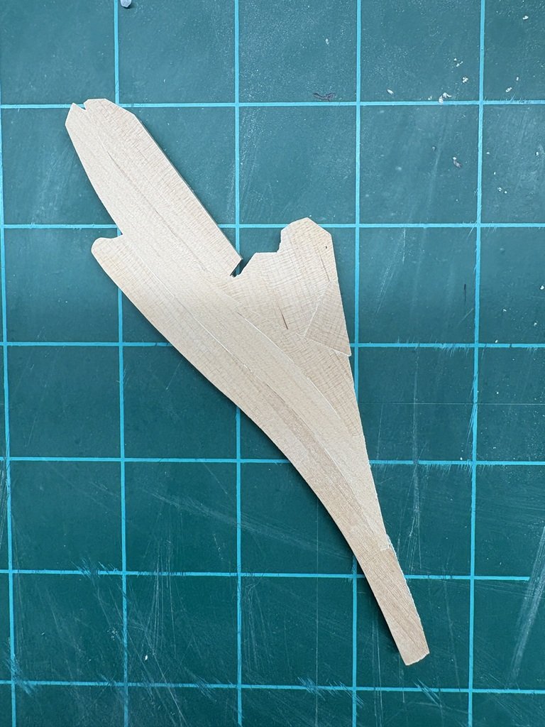

A few more parts connected (3, 4, and 5) together today. 4 and particularly 5 are delicate; this is why I left quite a lot of material on the top for now. Once the bottom is matched to the surface of parts 1 and 2, I will go about removing material / shaping the top contour.
Yes, Greg, you are correct: She is. The model is much more advanced now than in the photo posted. The hull, decks and fittings are almost complete. The headwork will shortly commence. But I don't want to hijack your exemplary build!

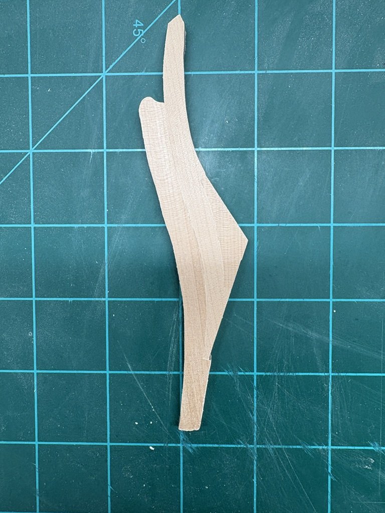

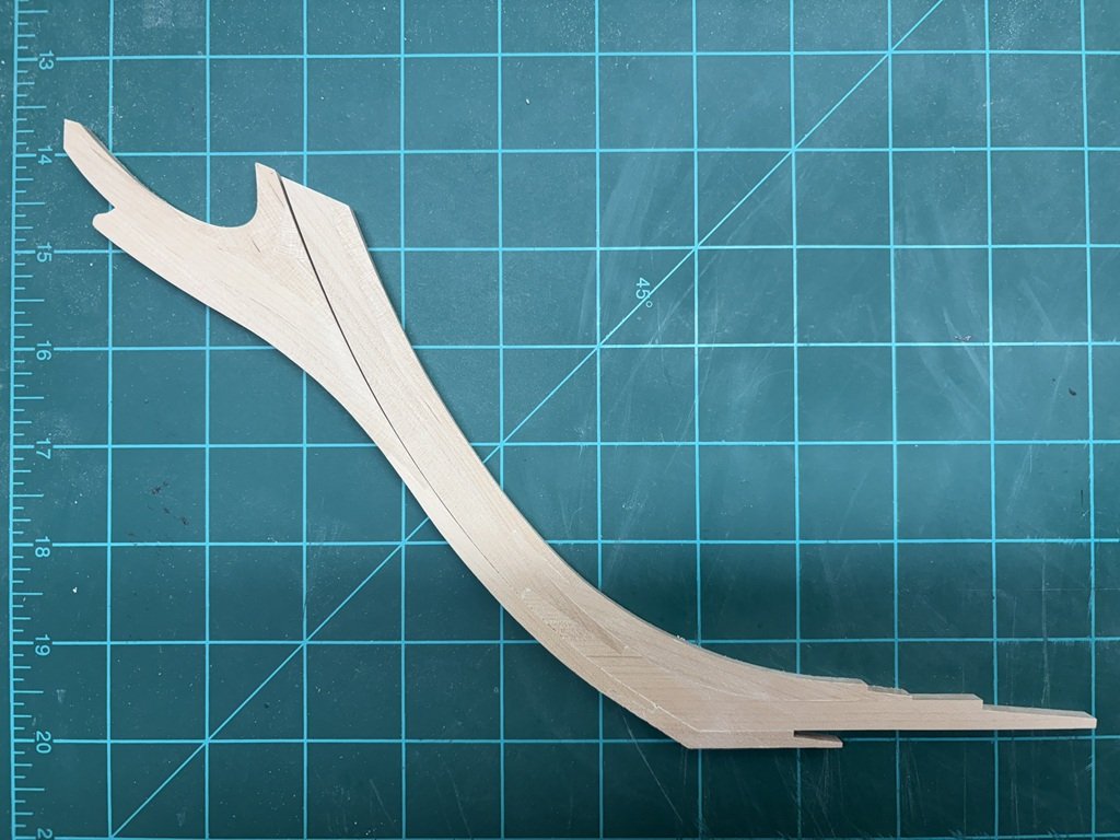

Another day, another joint!
This will sit between glass plates through the night to insure it dries flat. I can then remove some of the excess material along the curved contour of 4 and 5. The flat on the top of 4 will be cut a bit later so that it matches the top of the stem. It also looks like I can start working on the joint between what is done and the stem.
HeadConstruction4a.jpg.6d12625491ae57633a325c8422d7a837.jpgHeadConstruction4.jpg.2b7380f9ffc629a1c269cc6eb7dae378.jpg

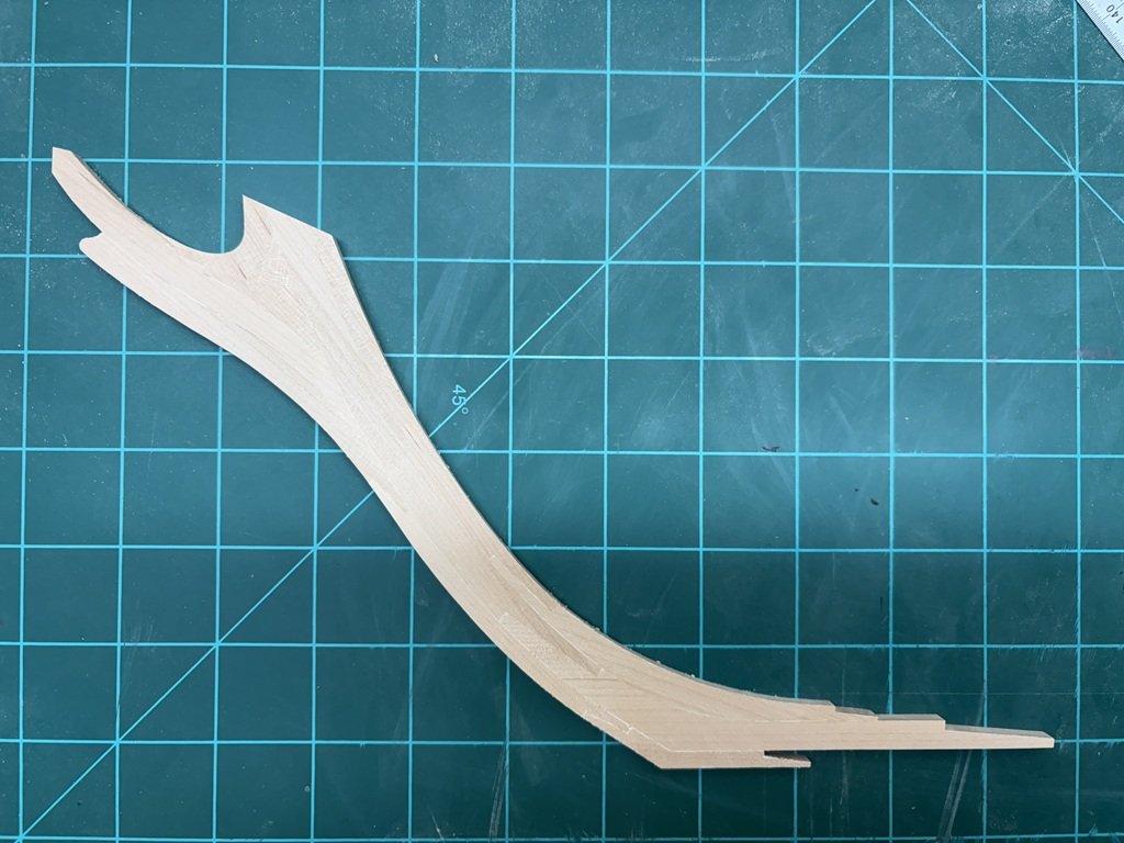

Cleaned up / milled out some wood above gamming knee and lengthening timber (4 & 5). I didn't want to accidently catch something on one of the rough edges and / or slots that were along the top. Once that was done, using a spindle sander, I did a preliminary sanding of the back edge that will match with the stem. This actually resulted in a better than expected start to the final shaping:

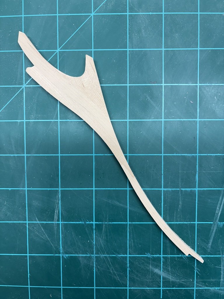

The cutwater / knee of the head assembly is nearly complete. Lots of slow going to get all the graceful curves sanded. I am now making adjustments so that this work fits neatly with the stem / forefoot assembly. I also need to drill / mill a hole and slot for future rigging purposes.

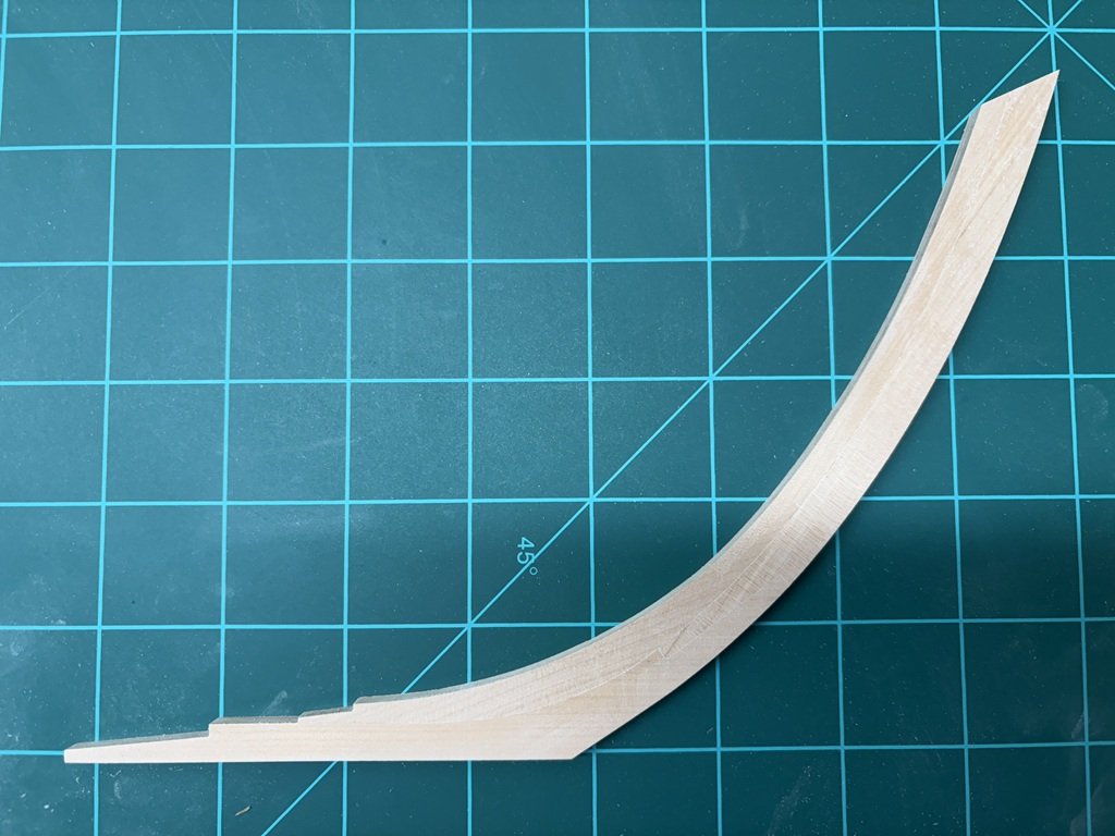

Yesterday I attached the forefoot to the stem structure. Today I spent some time adjusting the cutwater / head assembly to fit nicely to the forefoot / stem structure. I'm finding this to be a challenge; however, it seems like it is getting close. They fit quite well together when a small amount of pressure is used to pull them together. I think I can get a little better fit so there is minimal tension in the joint before setting the setting the head aside for quite a long time. I am glad that I decided to build this assembly now as this fitting process would likely have been even more challenging if I couldn't lay all these parts flat on the bench!
So a little more time on the mating process and then I will start adding in the keel.
