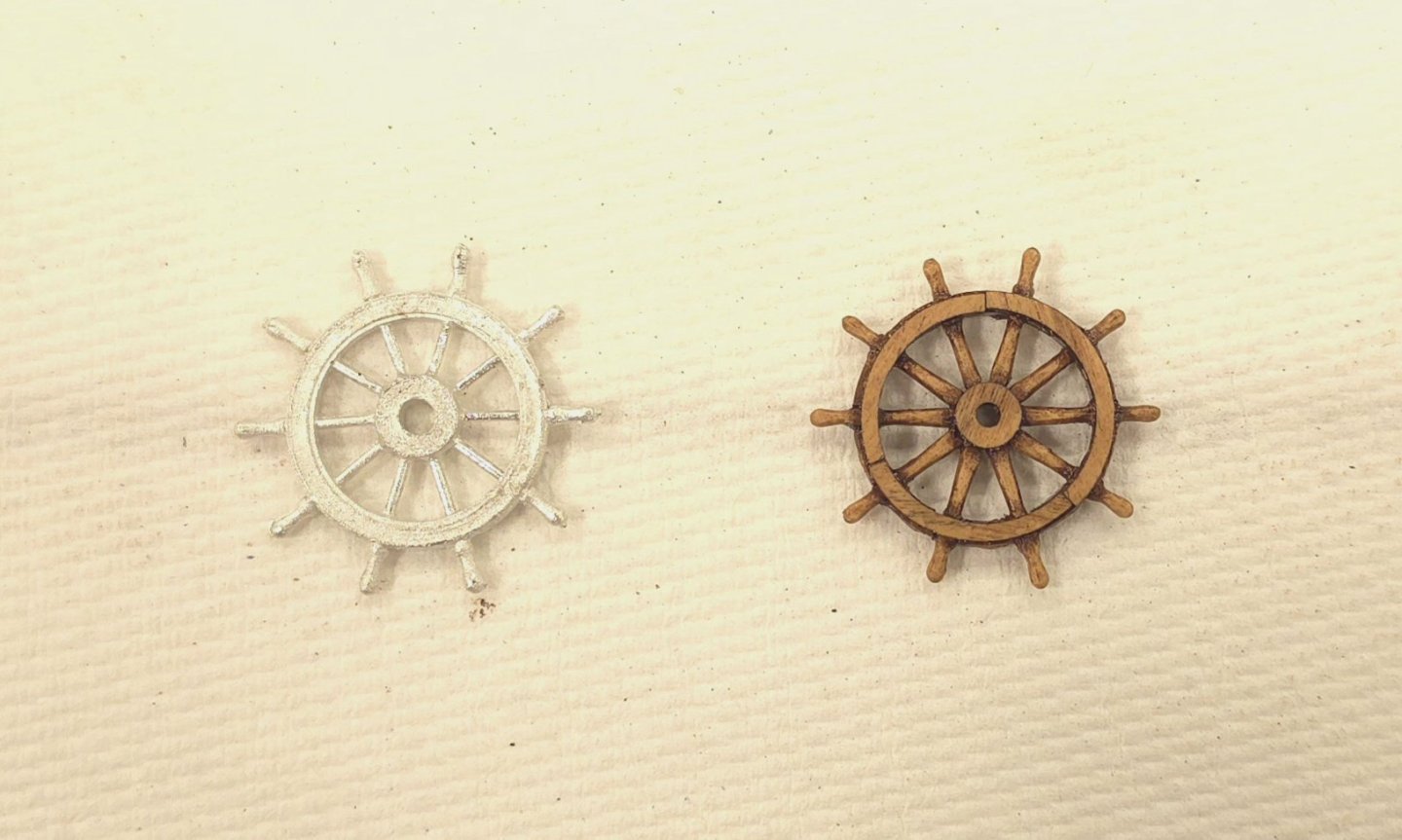

Completed wheel (on right).  Unfinished metal wheel from kit on left for comparison.

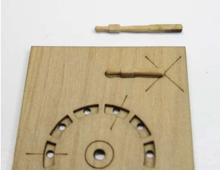

I guess I wasn't clear in the above post (#813).  What is pictured is one metal wheel (left) unpainted from the MS kit and the Syren kit wheel (right) stained after assembly.   BTW, that Syren wheel took roughly 5 hours to assemble, which included time on the lathe to turn the spokes into something more realistic than the blanks that came in the kit. And talk about fiddly work!  The assembly  required the patience of Job.
These photos come from the assembly instructions for the Syren wheel. Note the unmodified blank on the left vs the turned version on the right.  X marks the spot!
image.png.6854d77c4d450d5e64f27723fd05be69.pngimage.png.674bfcd644358b6468517ecd71a5934e.png
Because it'll be a week before I get the second wheel from Syren, I will experiment with painting the metal wheels from the MS kit.  However, I'm fairly certain that once I get a coat of poly on the Syren wheel, I'll simply invest the additional five hours to have the pair.  Maybe I'll get lucky and love the paint job.  We'll see.

51 minutes ago, Der Alte Rentner said:
What is pictured is one metal wheel (left) unpainted from the MS kit and the Syren kit wheel (right) stained after assembly....
The Syren wheel, albeit the assembly looks to be a bit tedious (excellent lathe work, BTW), does look pretty sharp with some stain, Peter!
OK, I am too lazy to pull applicable plans out and do the measurements and conversions, but I am curious (and trying to take meticulous notes).  The Syren wheel looks to be in scale with your kit-provided wheel.  Is that Syren's 24mm or 31.75mm wheel?  Thanks, Peter!  Great work, sir!
It's the 24 mm wheel.  The scale is a smidge off.  According to Syren, "This size is perfect for most 1:64 scale models", whereas the 31.75mm wheel is, "perfect for most 1:48 scale models".  Conny is 1:76, yes?

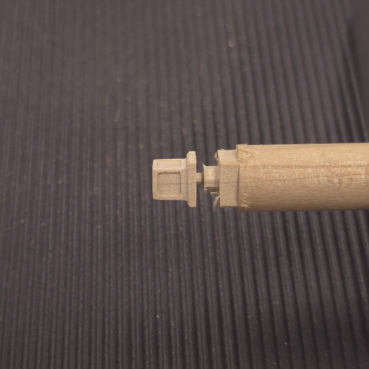

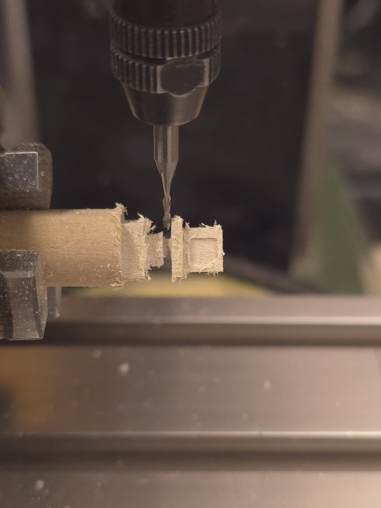

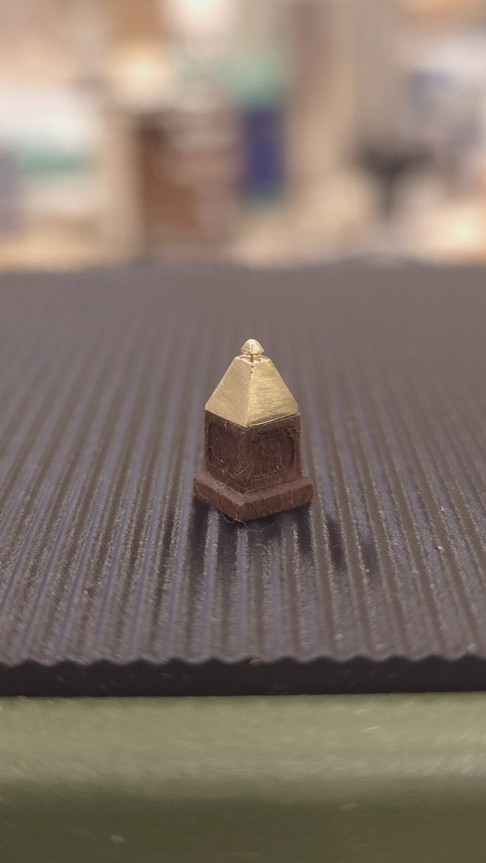

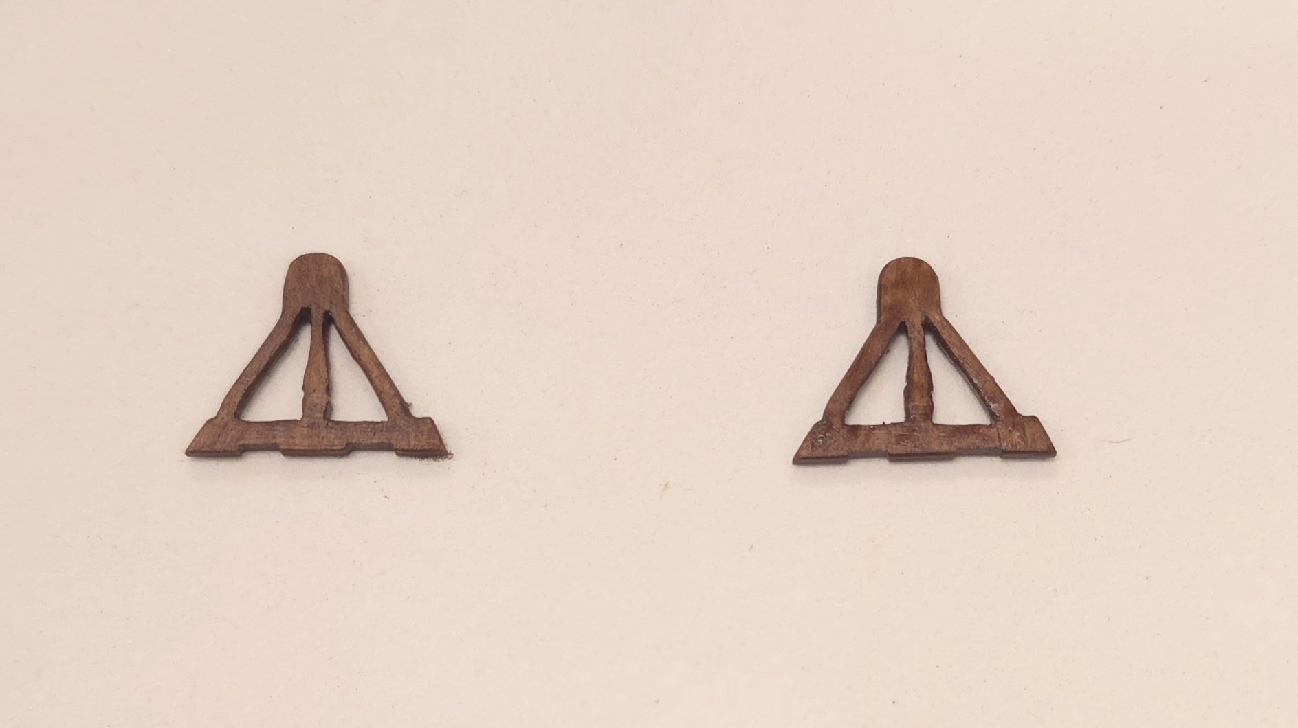

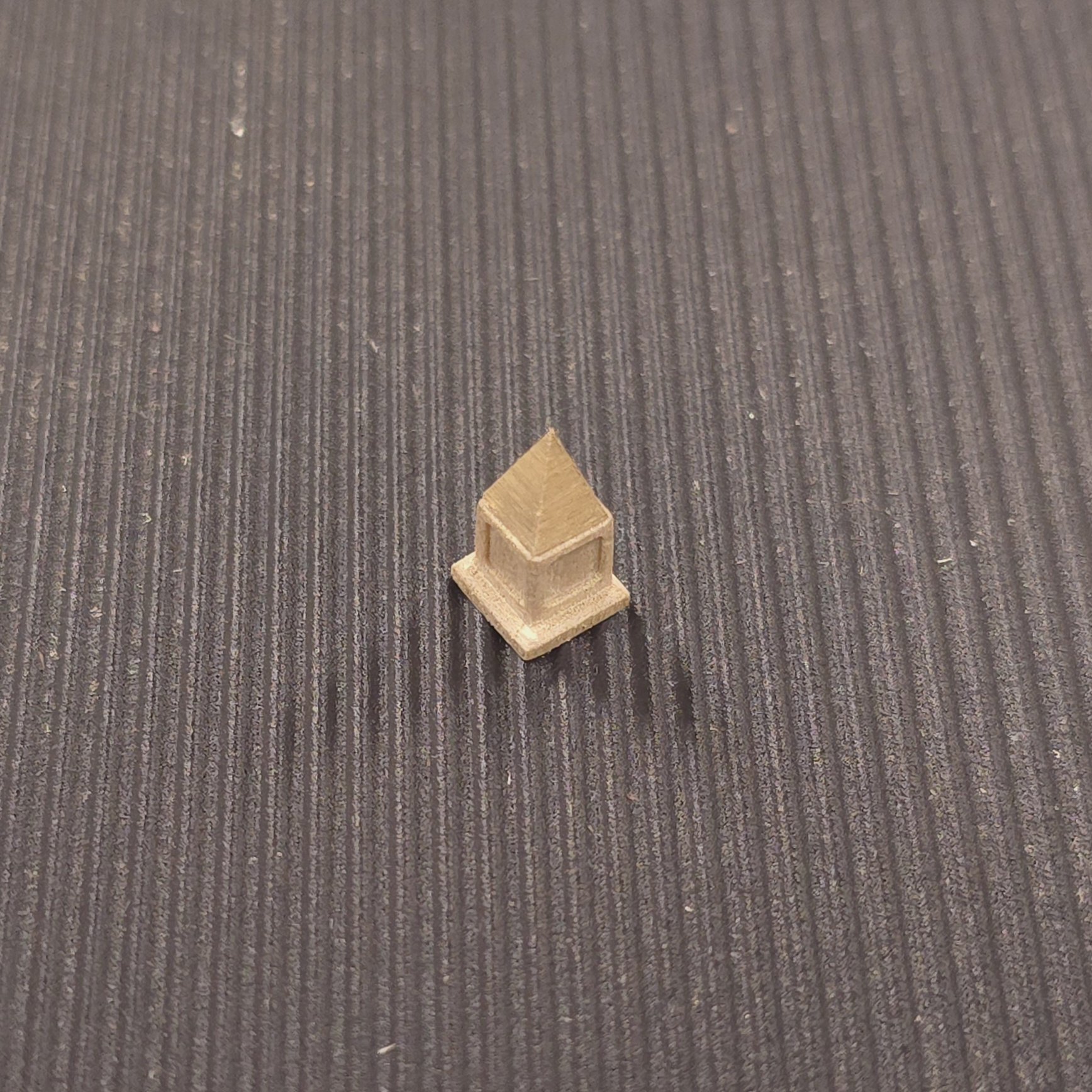

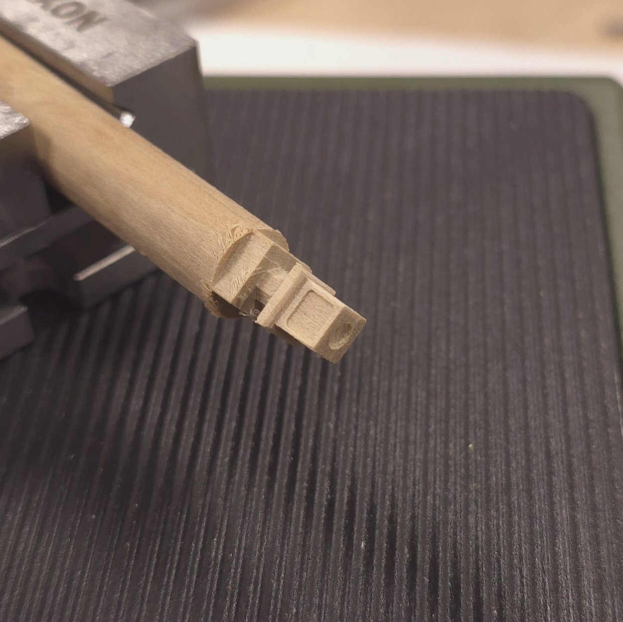

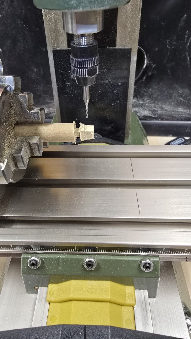

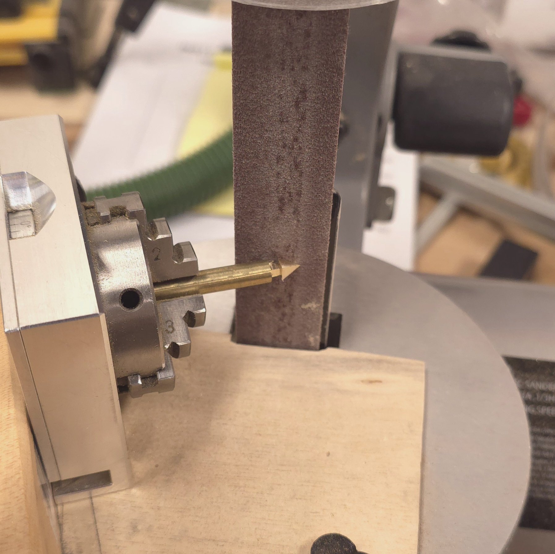

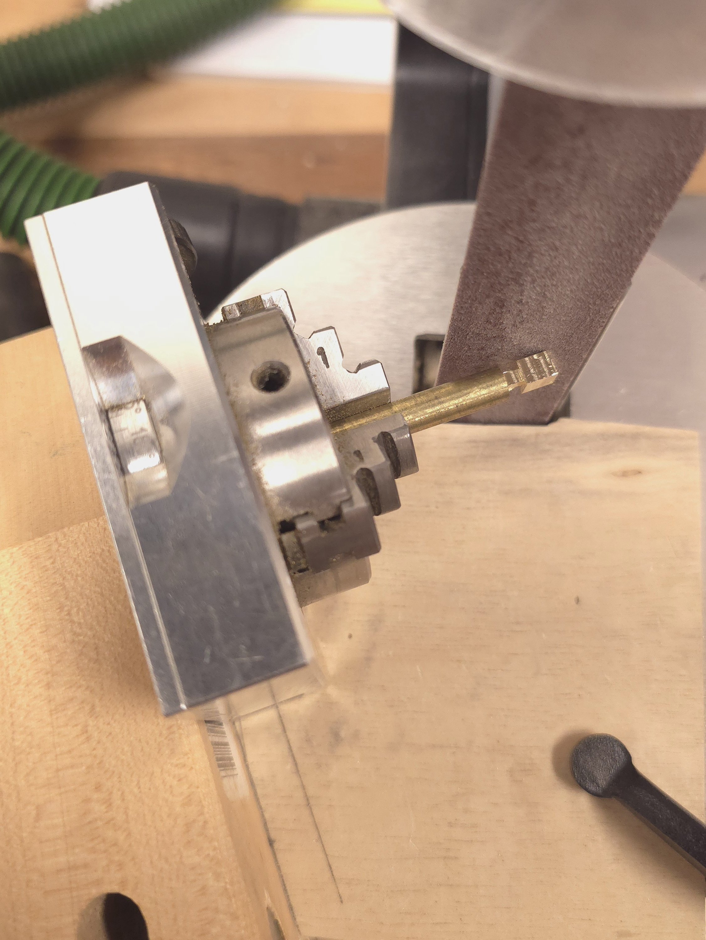

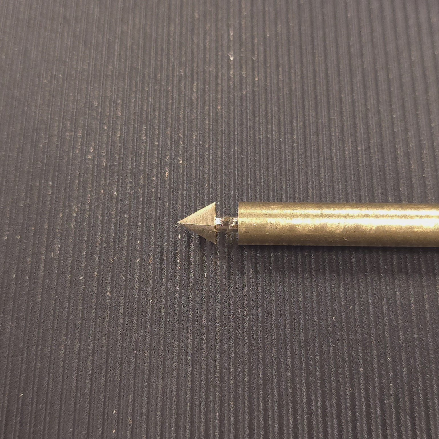

While I await delivery of the 2nd Syren wheel kit, I'm diverting to the construction of the binnacles, giving me ample opportunity to make use of the Proxxon mill.
Since the accessory I'm using to hold the material only has a three jaw Chuck, I'm making square dowel out of round dowel for both the base and the top of the binnacle.
20250808_100627.thumb.jpg.e341d361ded71b2018d5978cd563a252.jpg20250808_102142.thumb.jpg.e511dafdebb39567b78a9d68f19b965c.jpg

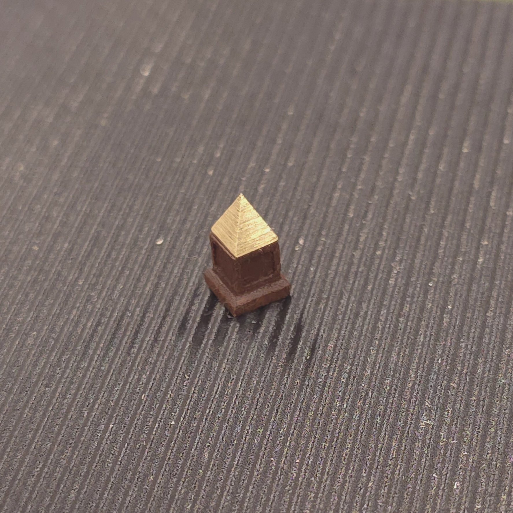

I decided to make another top, this time trying to simulate the lamp on top of the binnacle.  Before I cut the binnacle off of the brass rod, I gouged out a groove and then rounded the top on the lathe.

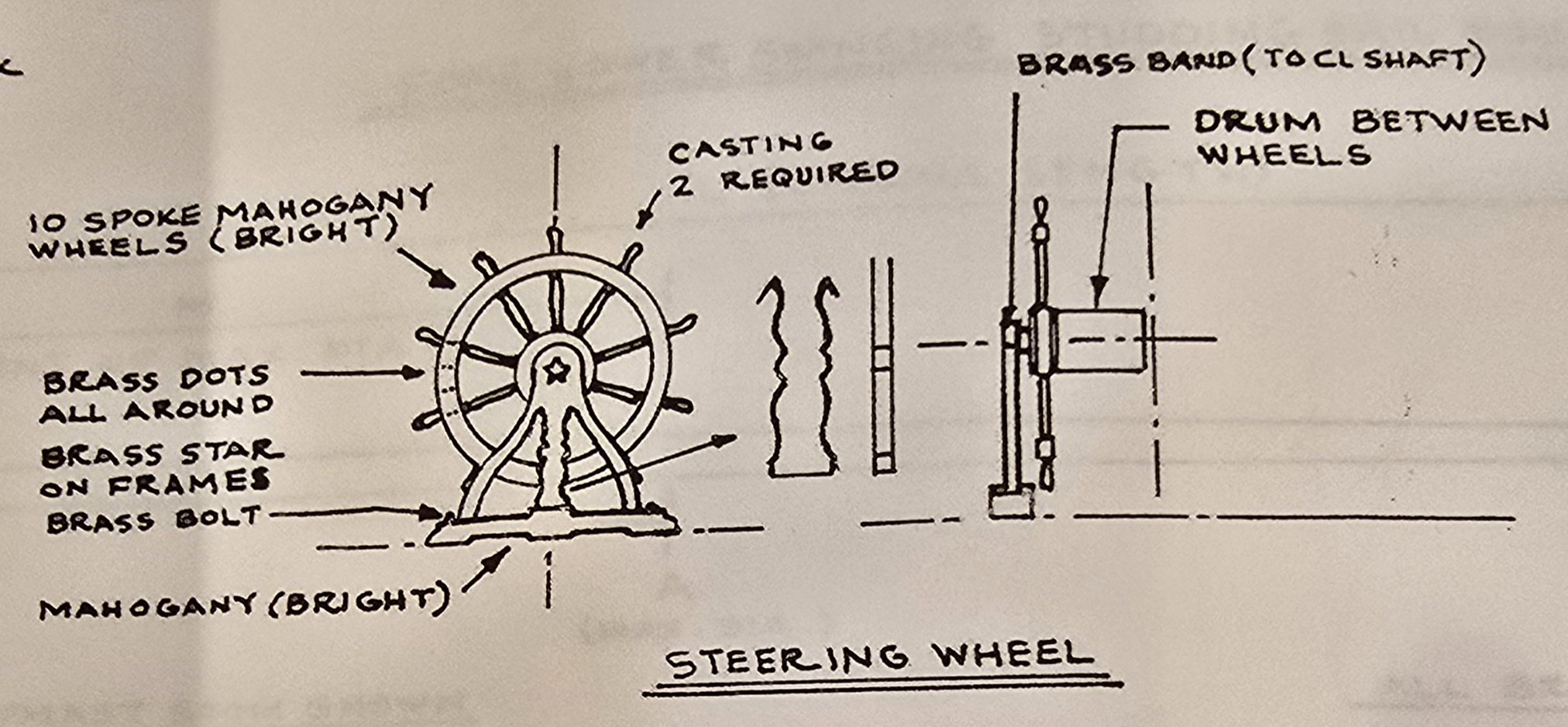

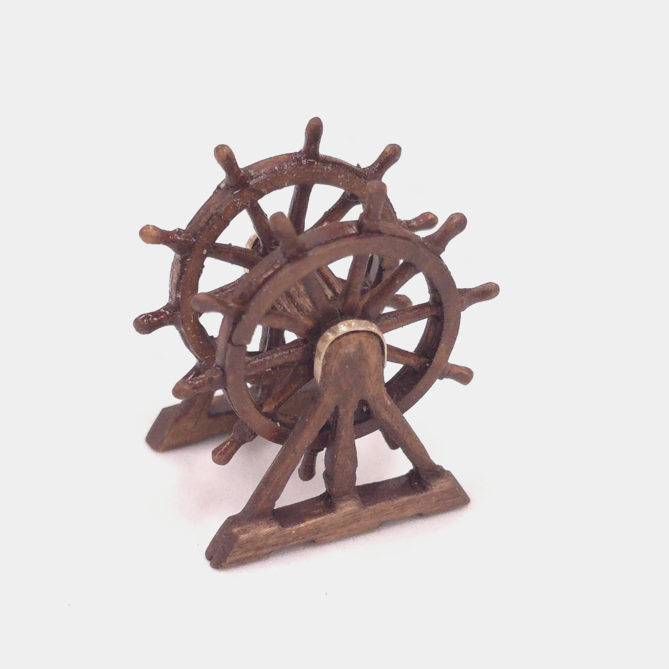

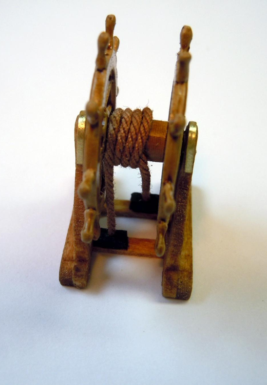

Nice work on the steering wheel base, Peter!  The plans show the base wood to be cherry.  This looks really close.  Is it natural wood, painted or stained?
Gregg
Gregg,

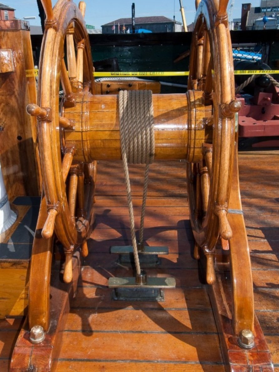

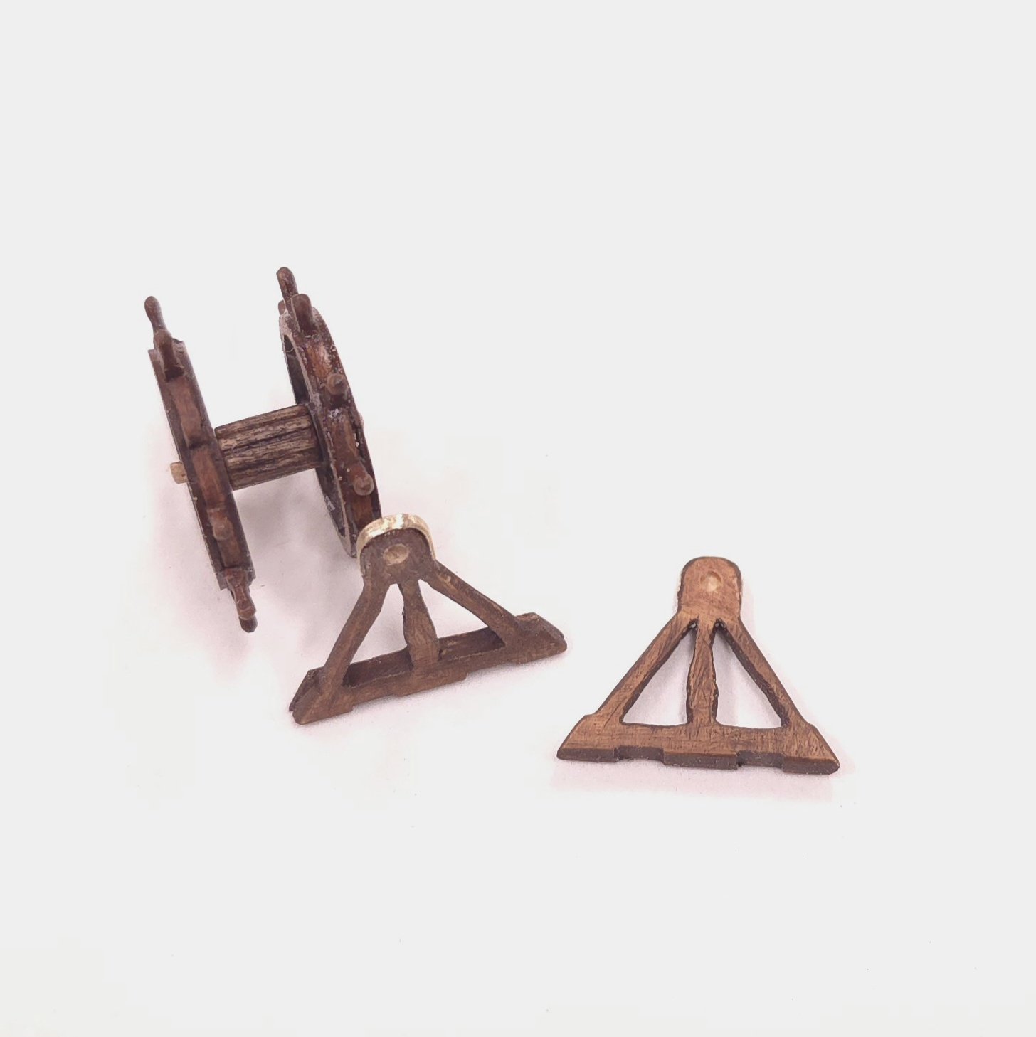

The plans that came with my MS kit call for mahogany, though that probably refers to the finish and not the base wood.  Be that as it may, in keeping with my non-traditional color scheme, I used boxwood to fabricate the base, and American Walnut stain for the finish.
oh snap!  I just realized that I didn't make the bottom part of the base wide enough!  Good thing you asked the question.  Now I can start thinking about how to effect repairs..  So much for making this in one piece. 😒

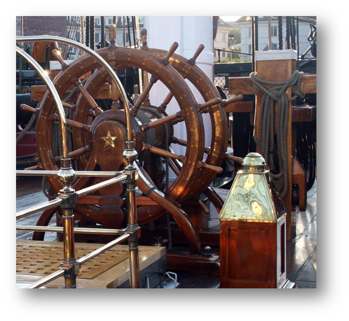

I added a couple of photos.  The one of the wheel and binnacle supports my choices in color and materials, and the one of the wheel from XKen's build shows one possible solution to the base remodeling problem above, which I subsequently employed.

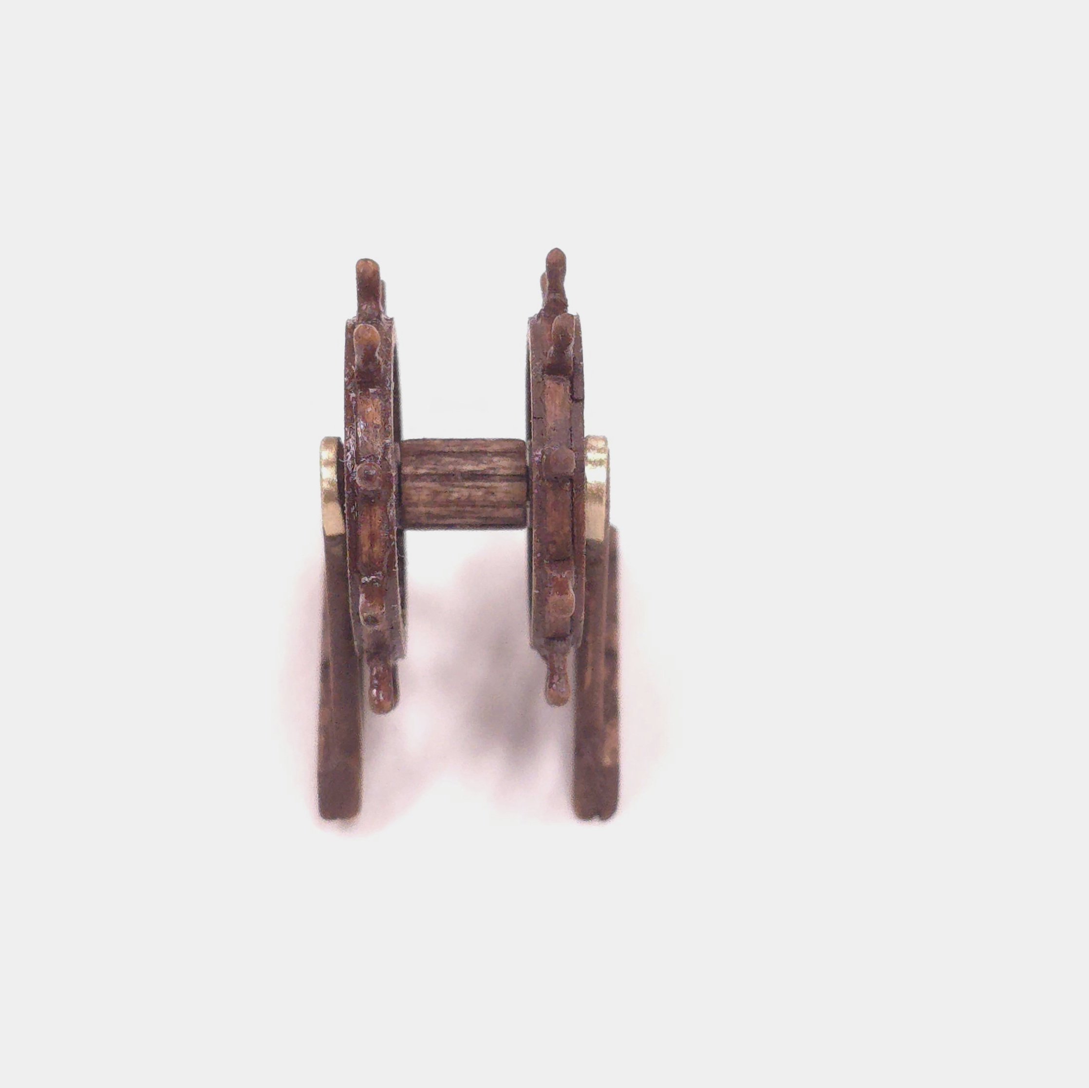

A little clean up and some poly, the wheel will be, for the most part, done. Still to do would be the little brass sleeves where the wheel rope would disappear below deck.

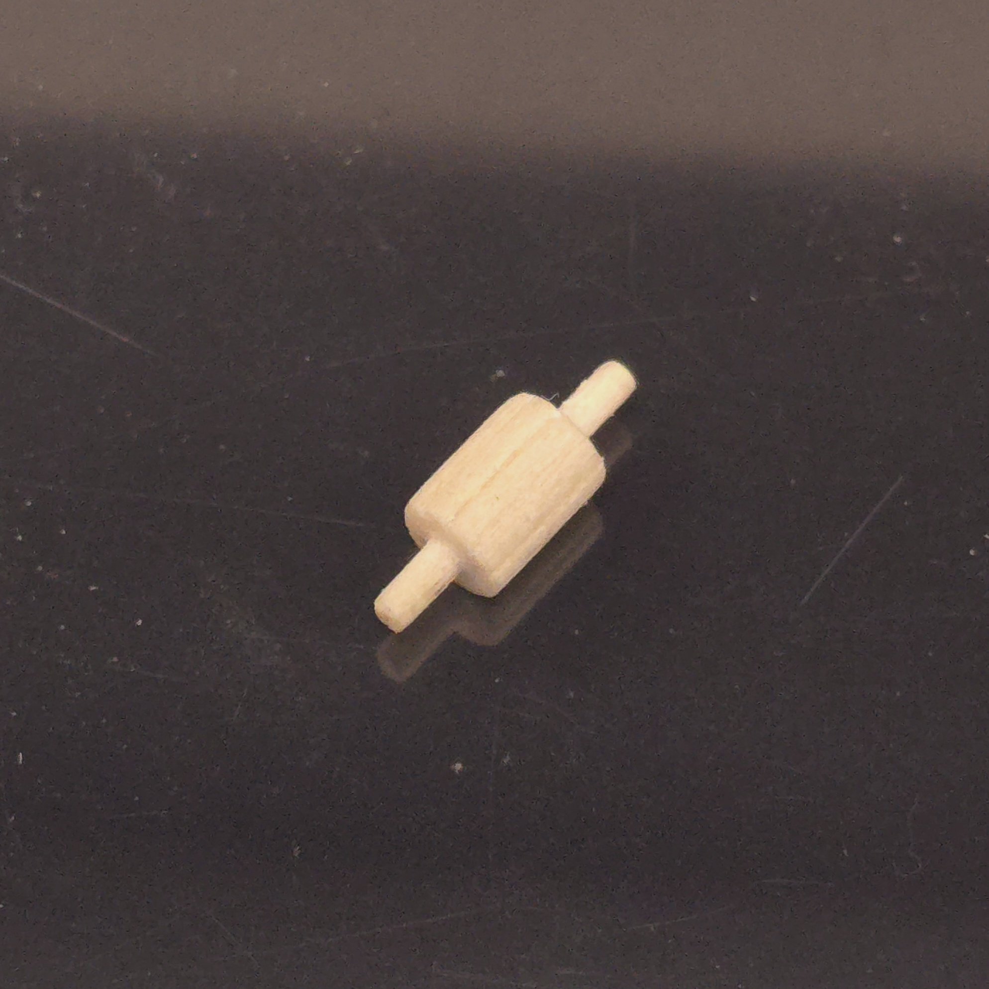

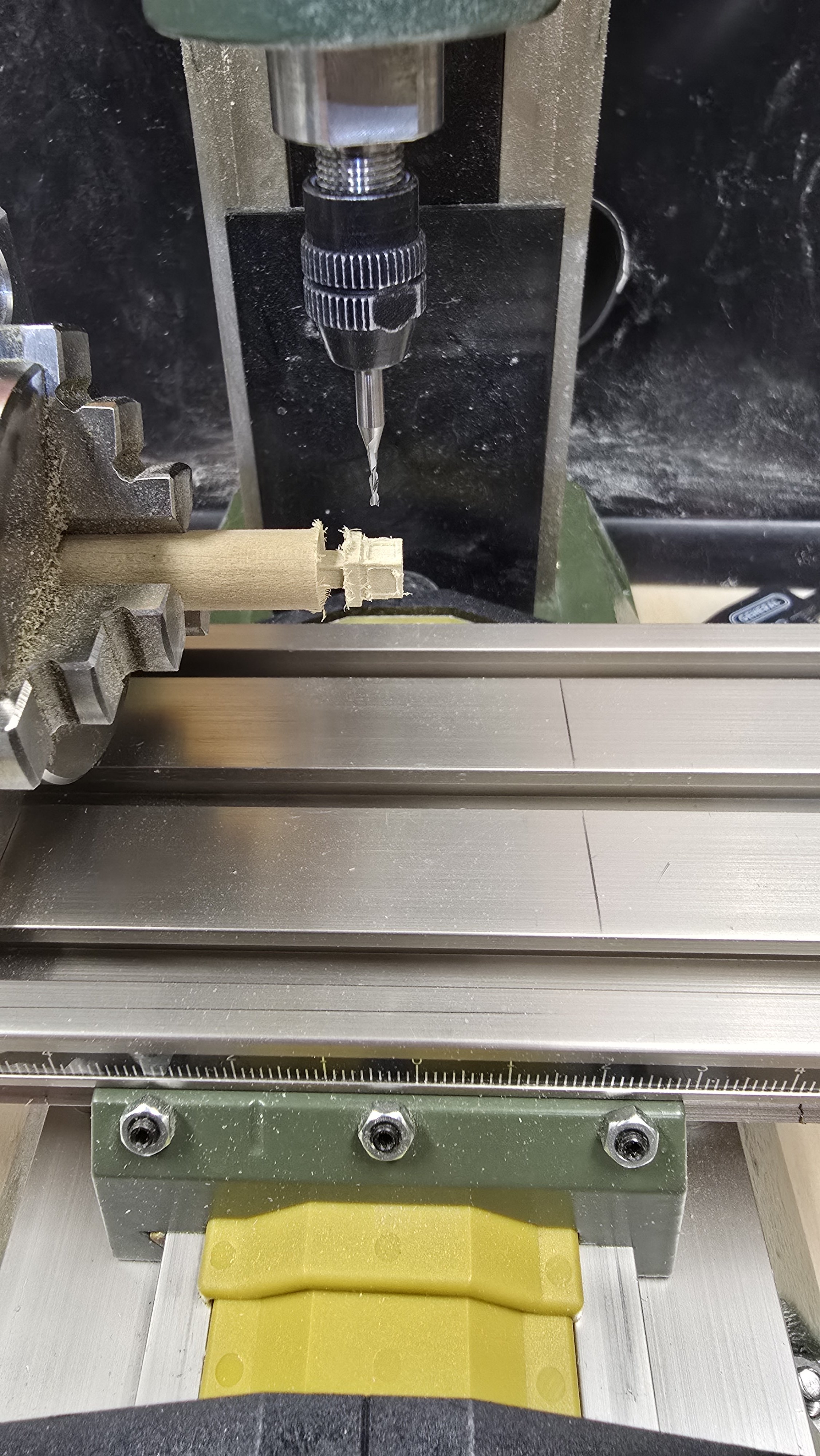

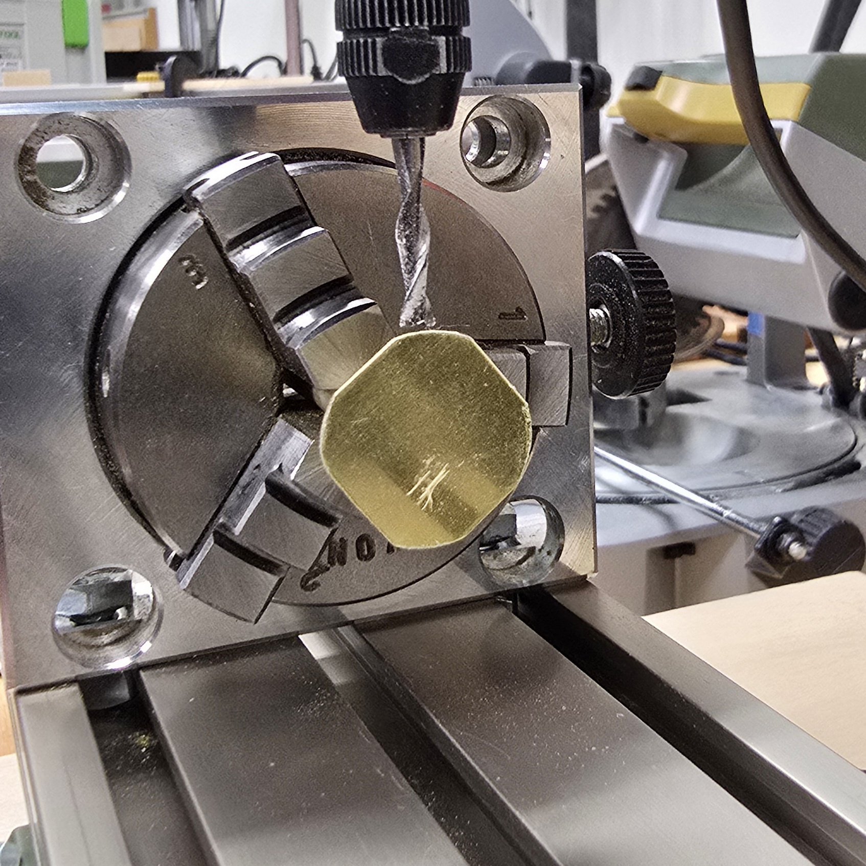

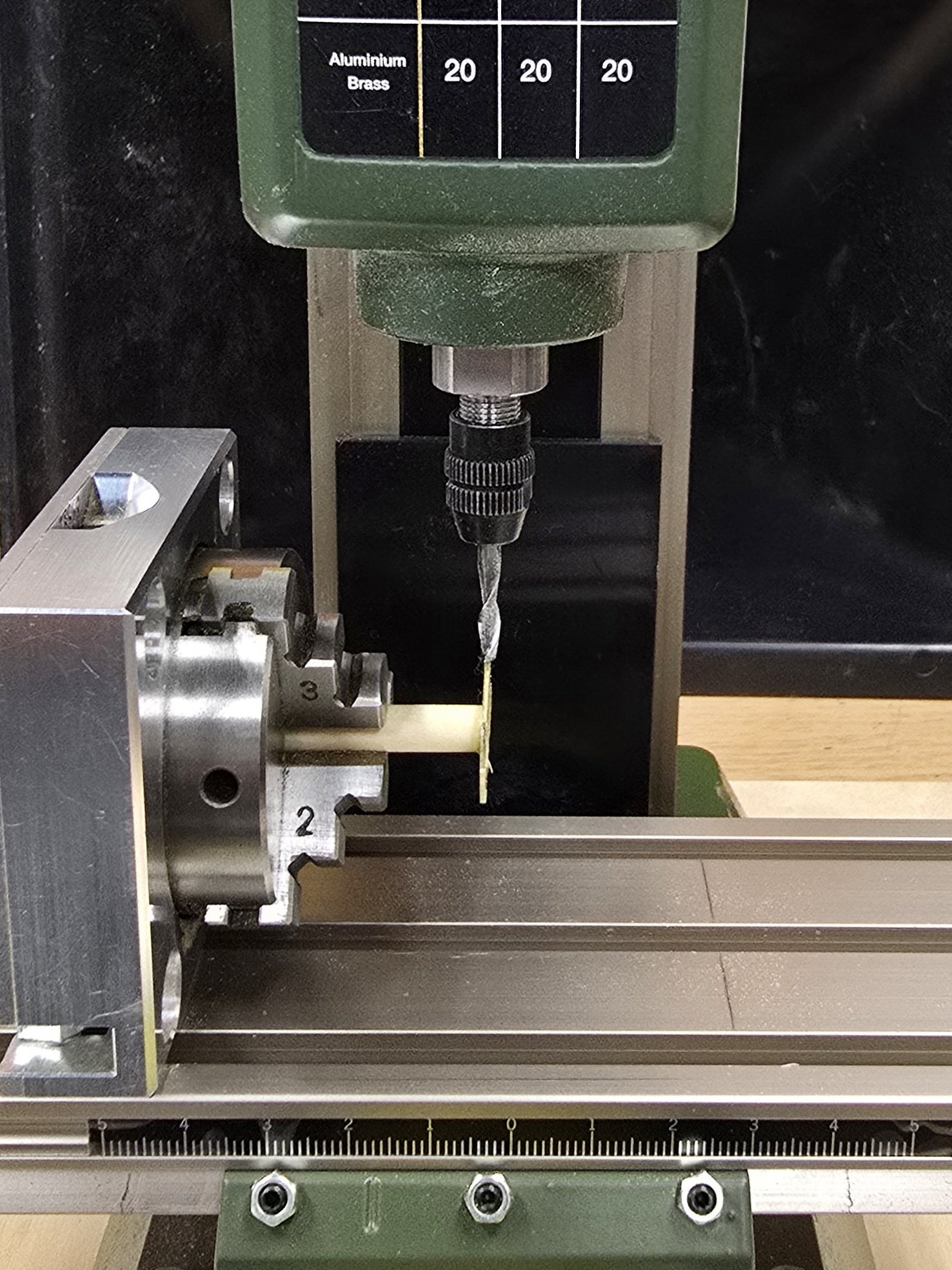

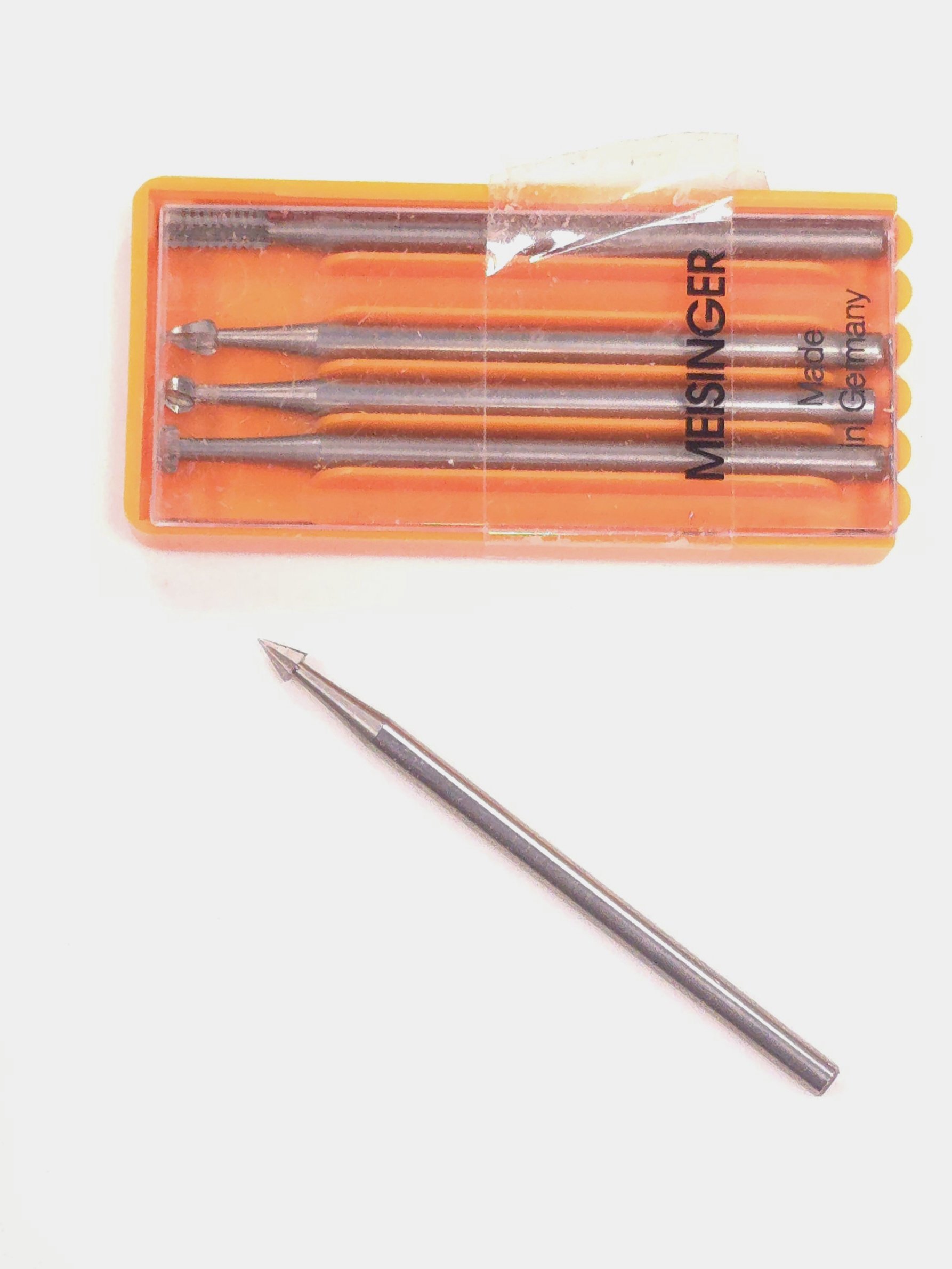

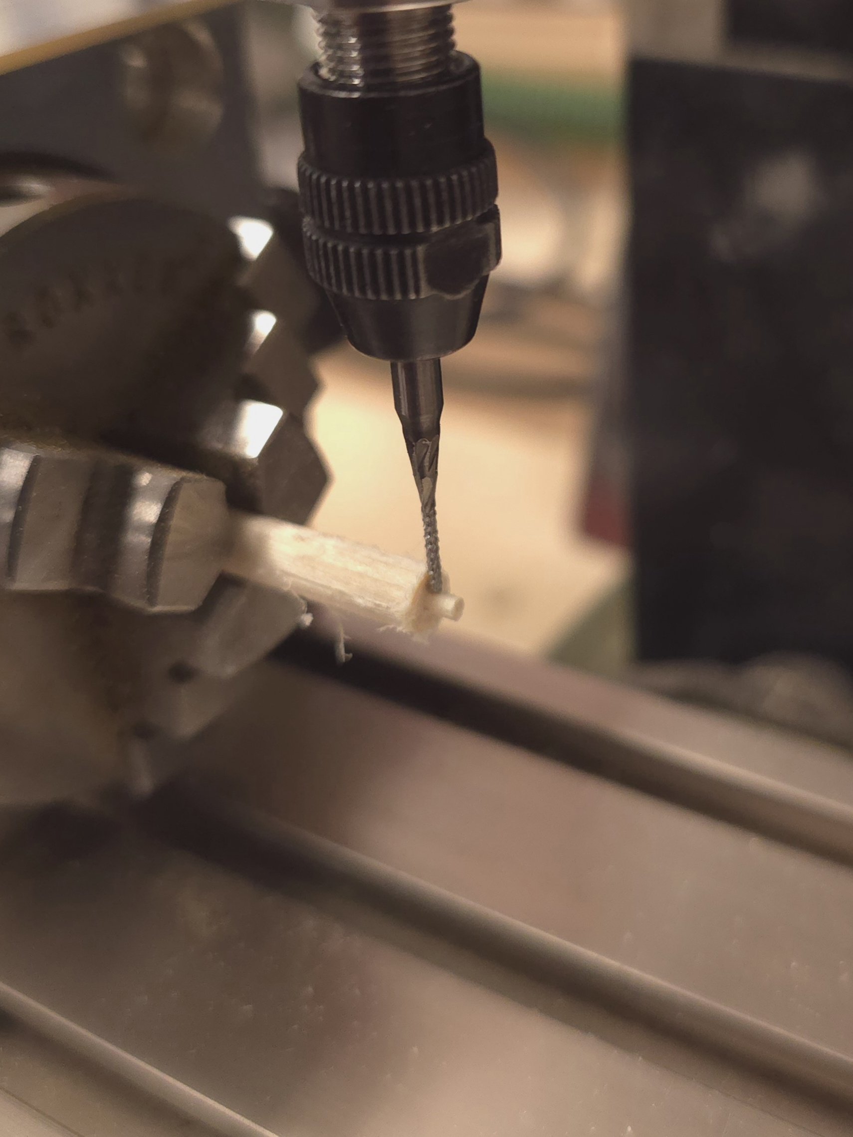

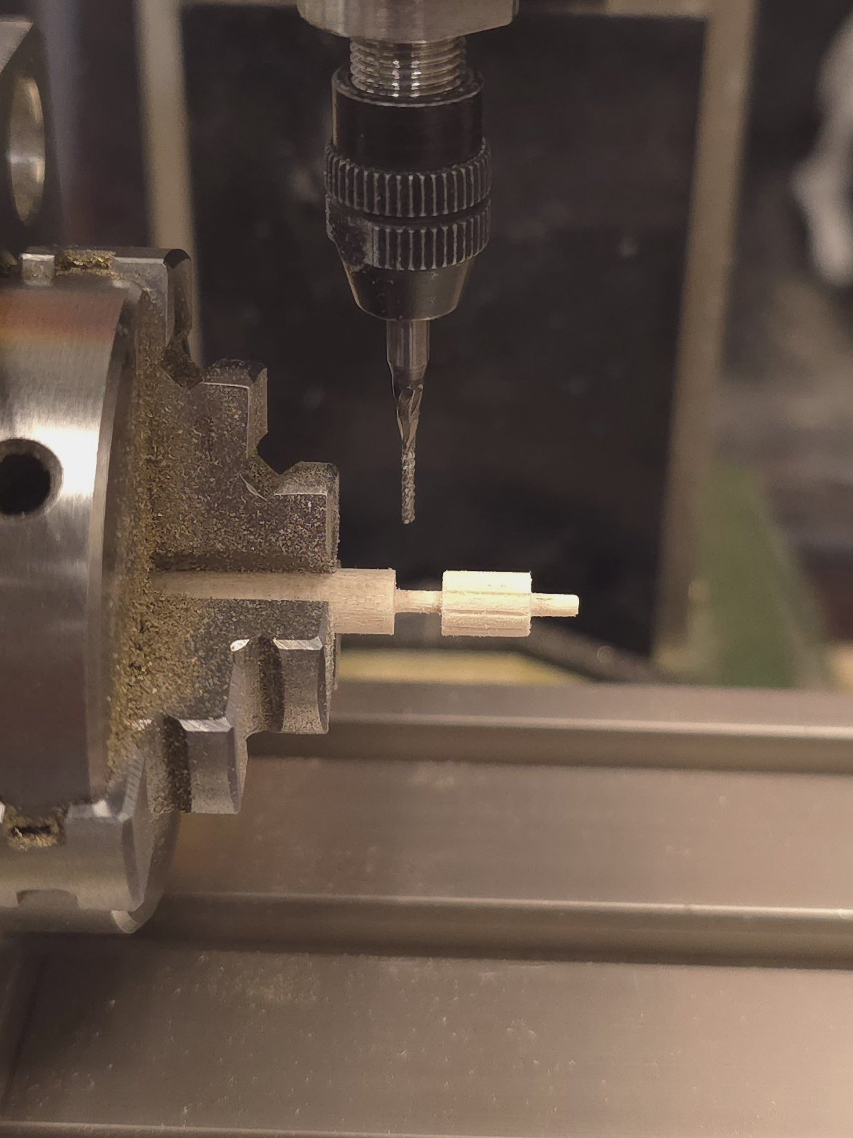

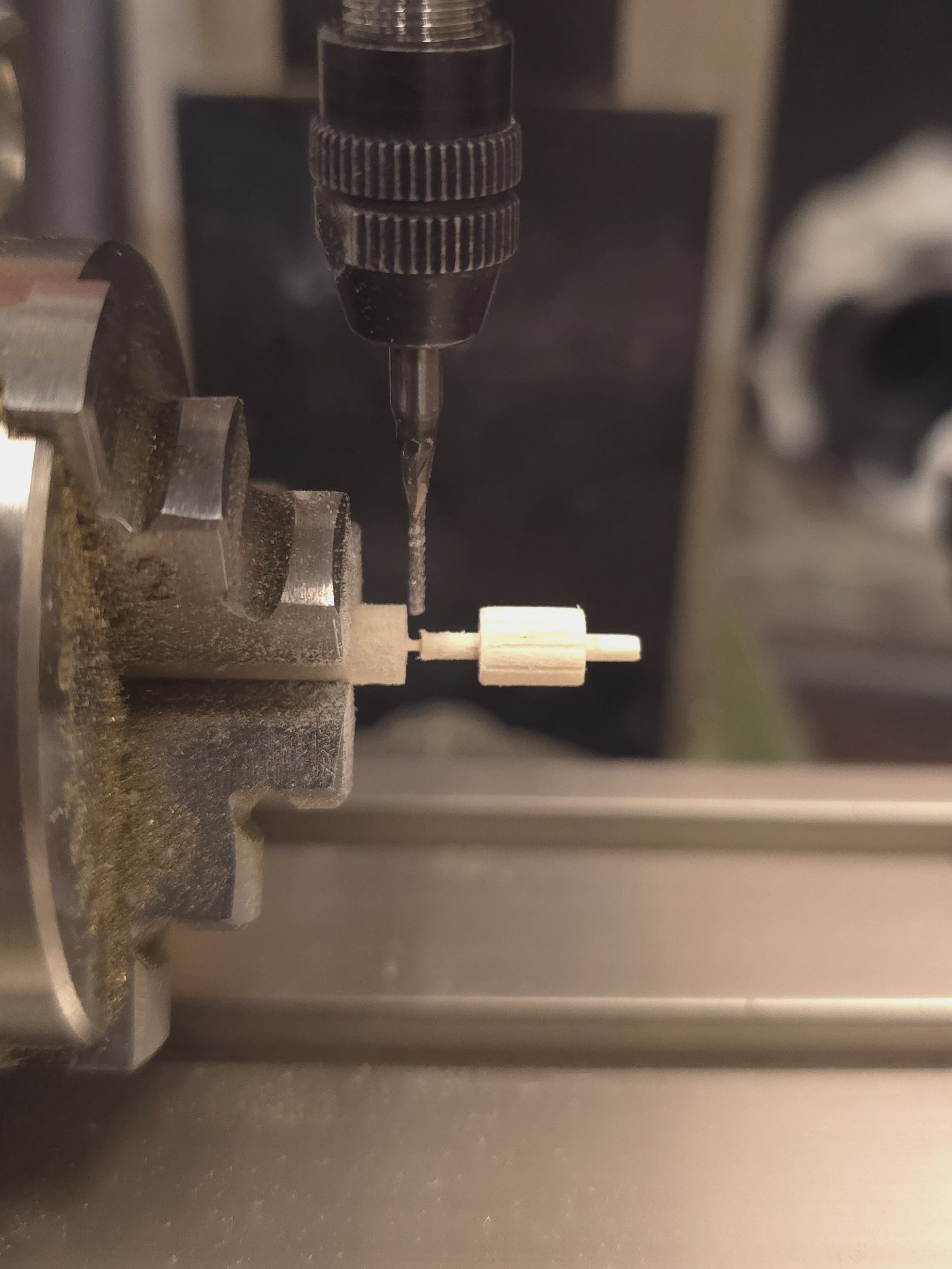

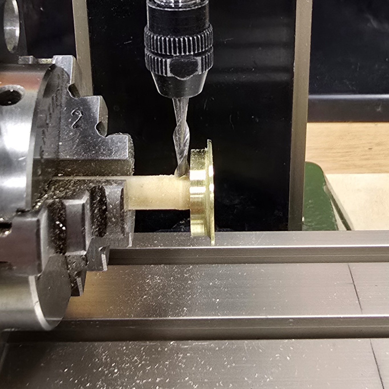

A little tip: you can manually rotate the divider attachment for the Proxxon mill with the cutter spinning in place to effectively turn the divider into an ersatz lathe.
Using this bit, and rotating the Proxxon divider 36-degrees at a time (locking it in at every step), I milled the detail grooves into the wheel hub.
Again, using the dividing attachment like a lathe, I turned the axles on the hub.  (Now, Grok informed me that the hub s/b called the axle.  If so, I turned the axles on the axles..)
20250816_101850.thumb.jpg.47fcb13f481276e80630995cf21c6d48.jpg20250816_102144.thumb.jpg.26710a06c585573719f4e36289a0f778.jpg
Nothing's glued yet, and, as I said, some cleanup needs to be done to tidy the wheel assembly up,

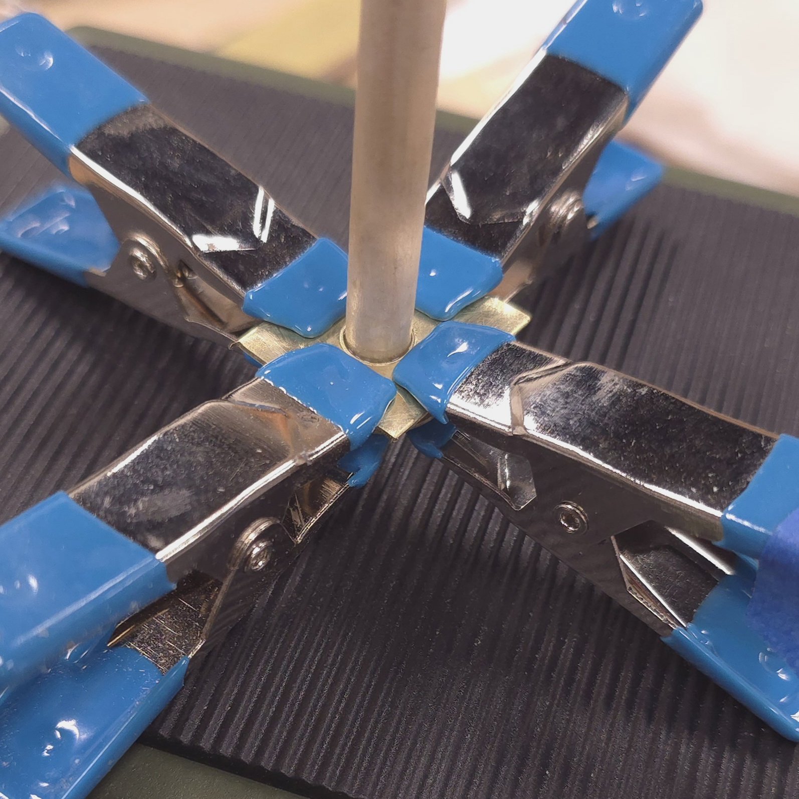

They are quite the adventure..  File this tip away for when you "treat" yourself to that project: When attaching the spokes, use double sided tape to hold the hub center and the rim in place on the jig that comes with the Syren kit.  That's the only way you're going to get the spokes glues in place.  This was not spelled out in the instructions.

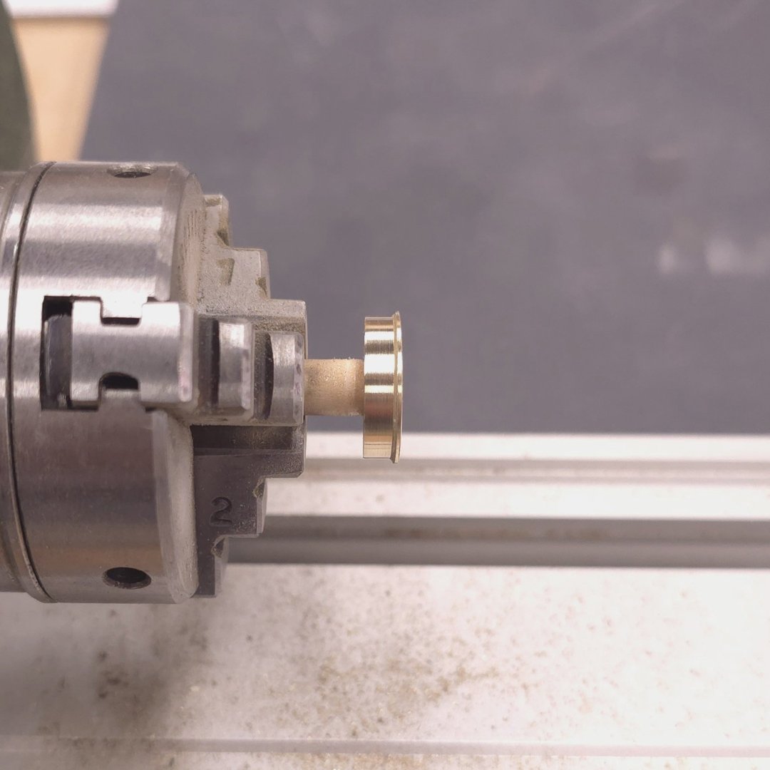

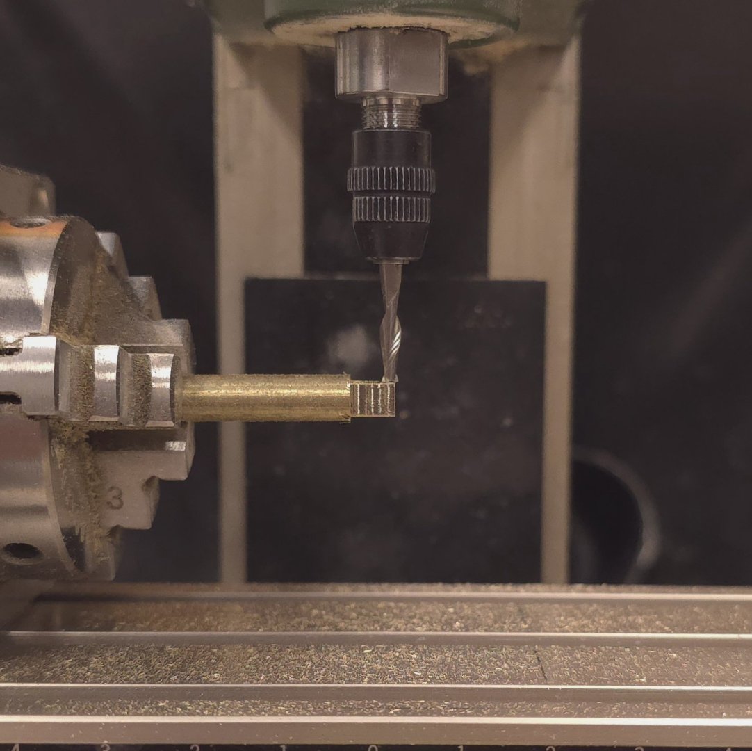

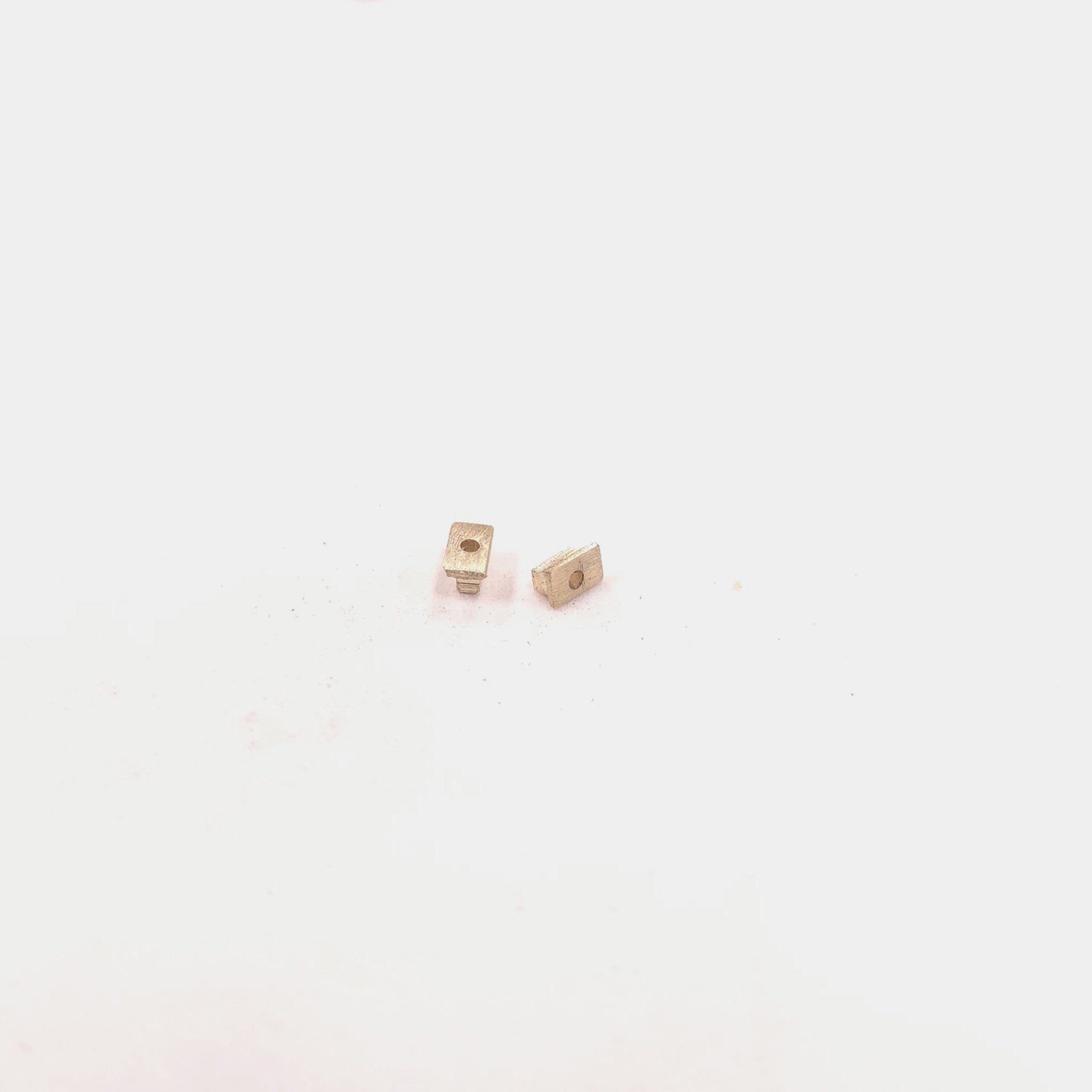

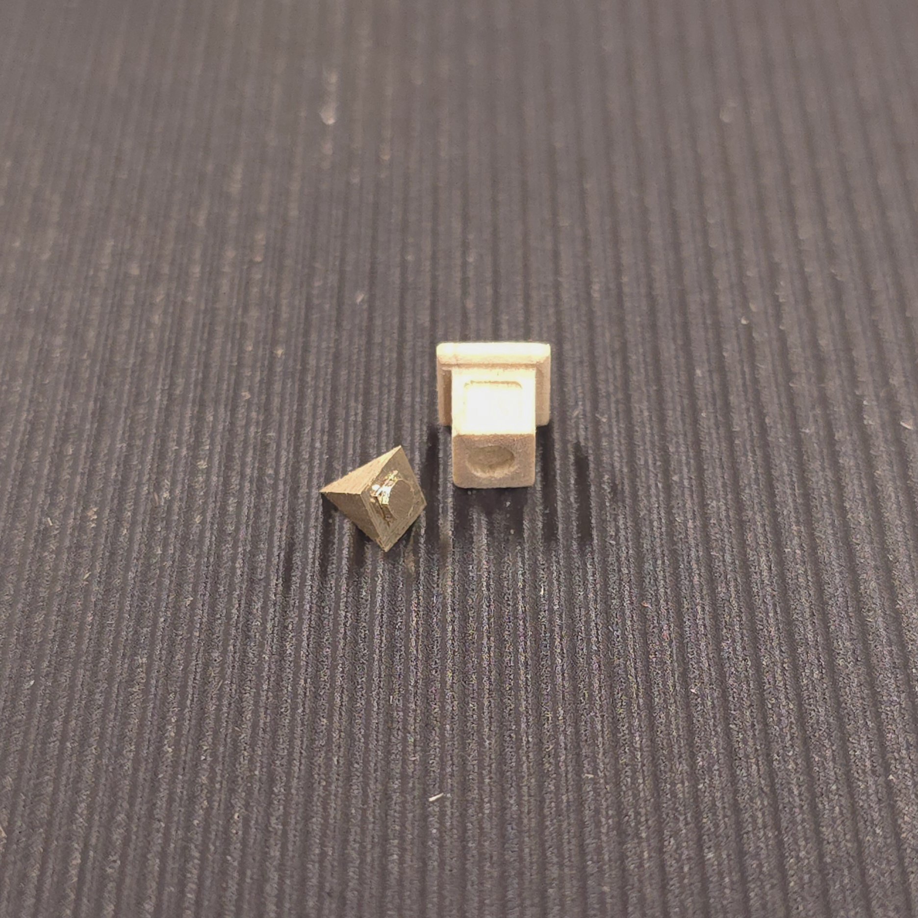

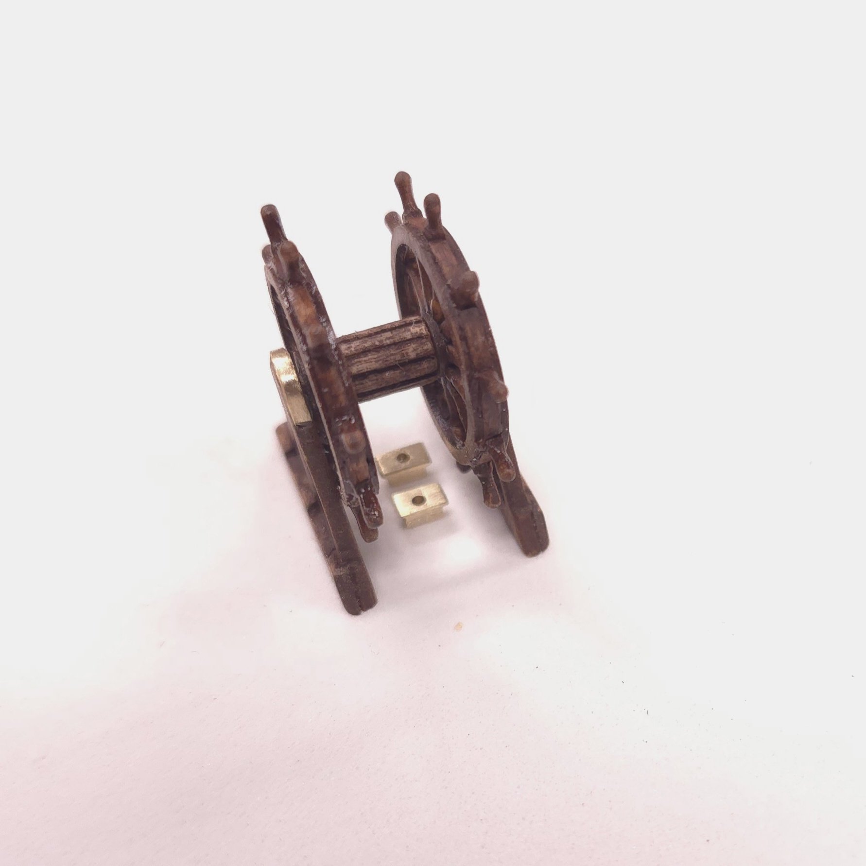

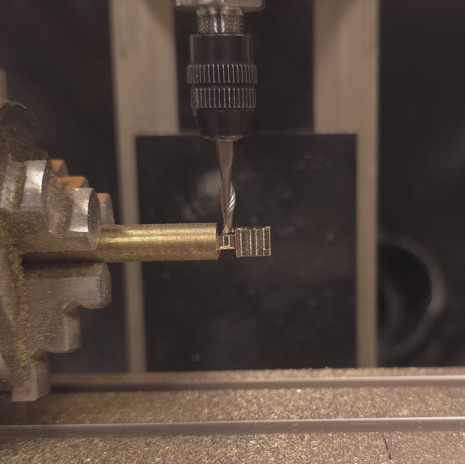

Using similar techniques with the Proxxon mill, I fabricated the brass "fairleads", as identified by X's A/I assistant Grok, for the steering wheel rope.
Close enough to the real thing?    It is for me.Screenshot_20250817_094513_DuckDuckGo.thumb.jpg.6358999f03220235fa8c3573ab175d49.jpg
Edited by Der Alte Rentner
swapped photos and text (fairleads). Pass 2, corrected text placement.
That will work.
Jon
Excellent work, Peter!  I haven't had an opportunity yet to use the Proxxon mill on brass.  So, is the base and the flat part all one piece, or are they two separate pieces soldered?  Details! 😉👍
Gregg
Each one is a solid piece of brass.  It's all just a matter of careful setup on the mill.  That dividing attachment makes for effortless rotation of the brass stock.  The rest is just a matter of milling away the material that isn't part of the fairlead.  Also drilled the hole using the mill.  It's quite easy to figure out the indexing.  Use high speed on the mill, have sharp cutters, and feed the material slowly.  It's almost as painless as working with boxwood.  I began by milling a 3/16" square shape roughly 1/2 inch long at the end of a 1/4" diameter brass rod.  I wish now that I'd taken photographs of the milling process for these.  I thought doing so might be perceived as being repetitive, after all the detail on the binnacles.  Similar effort for both..

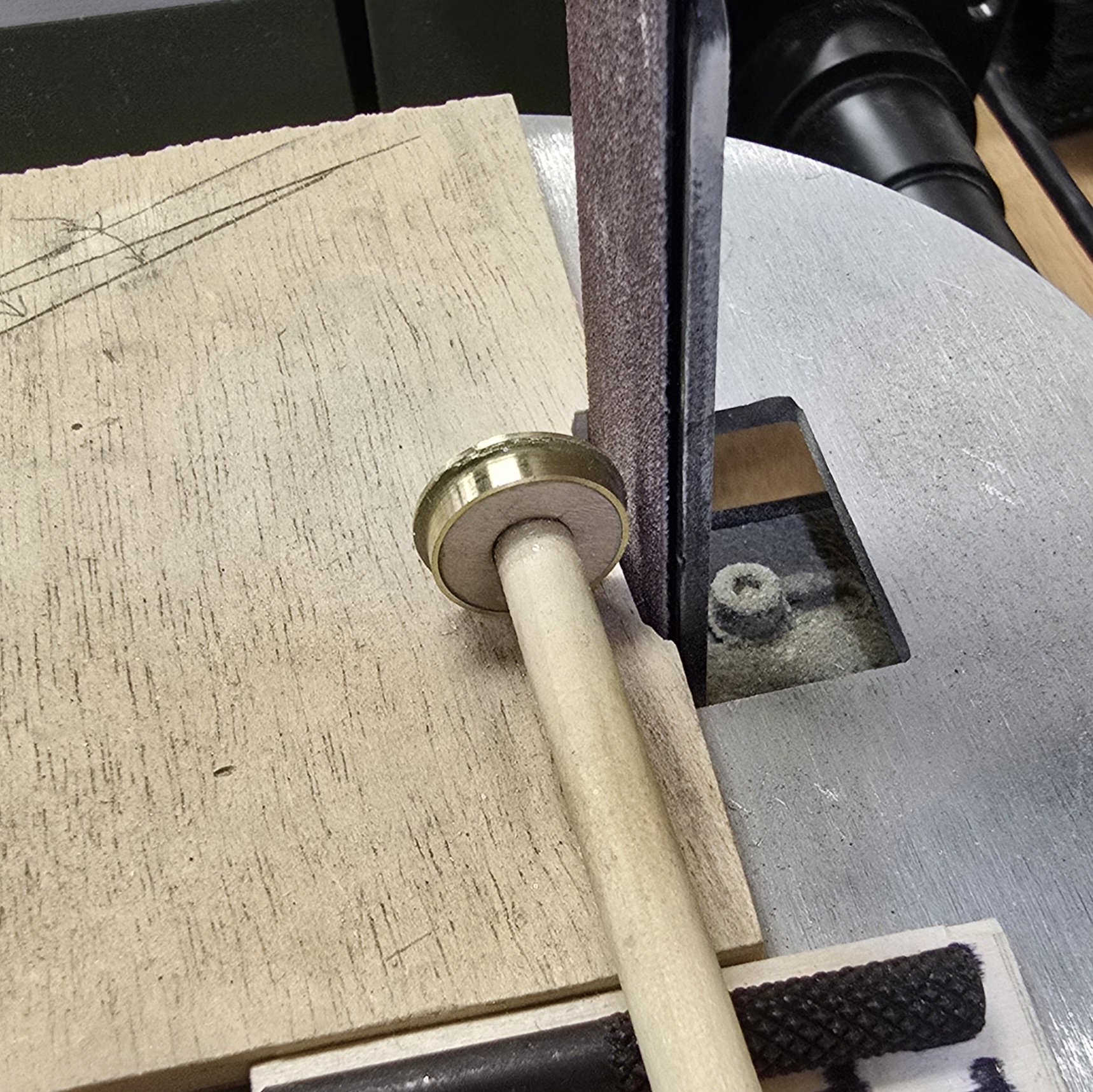

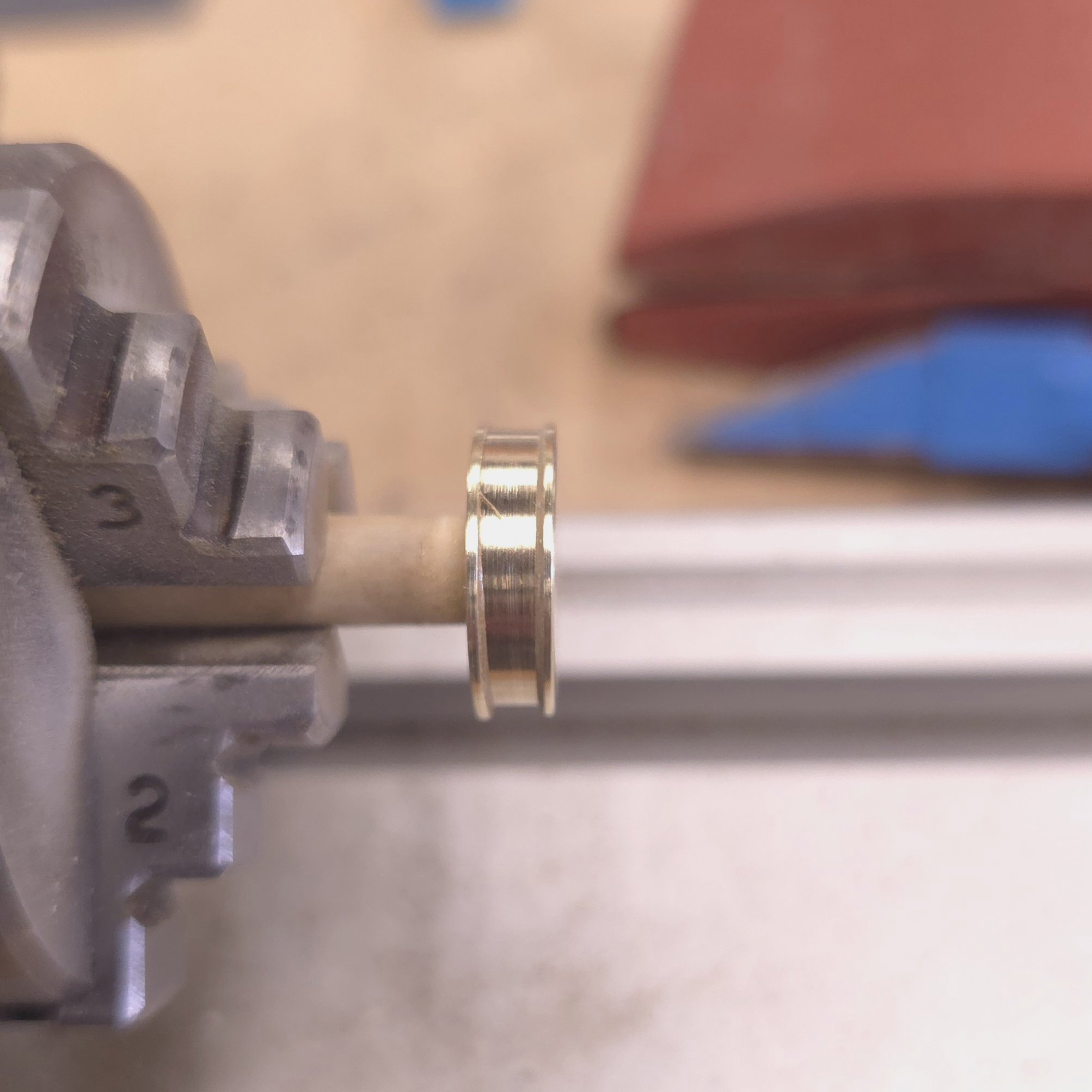

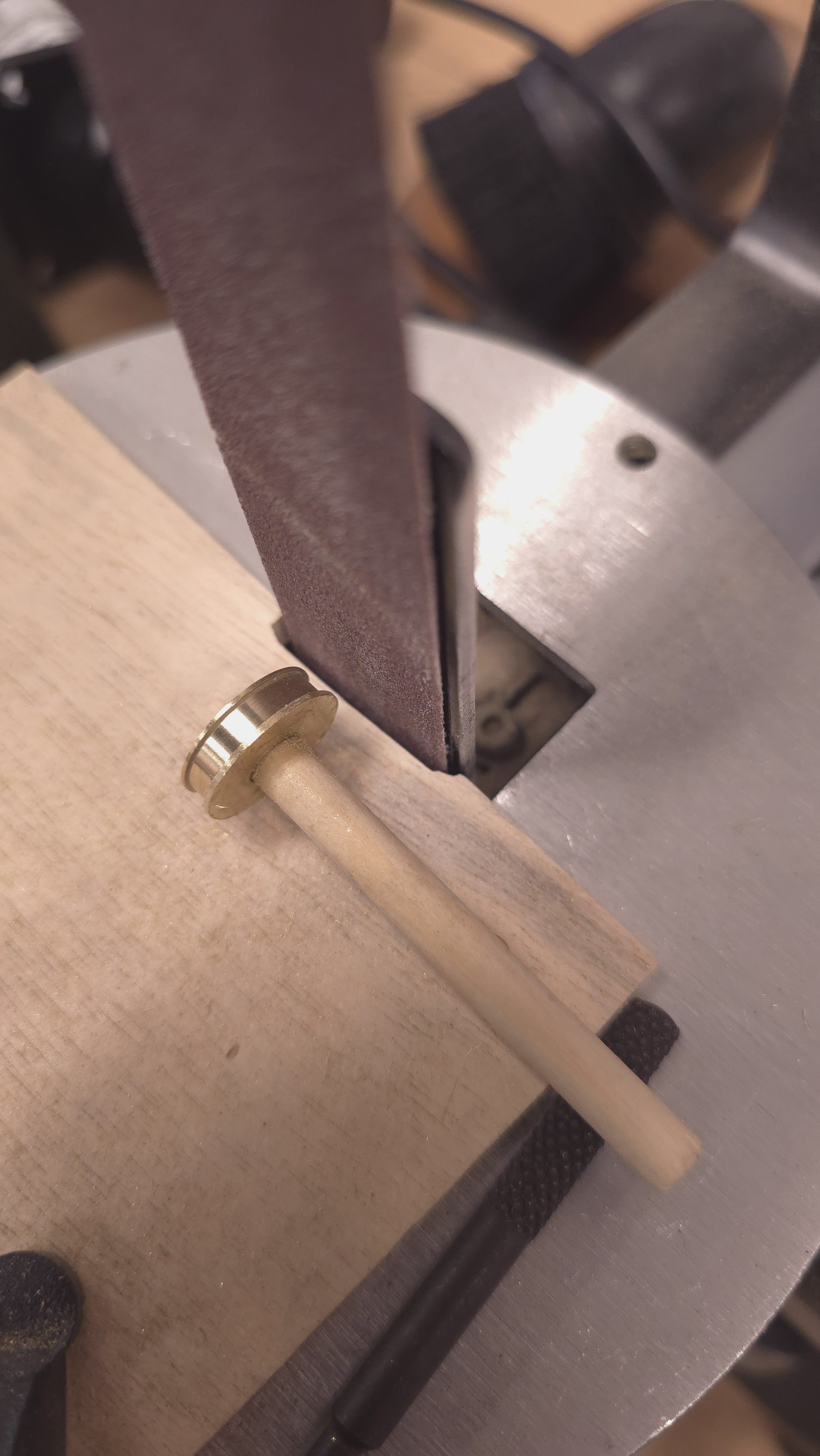

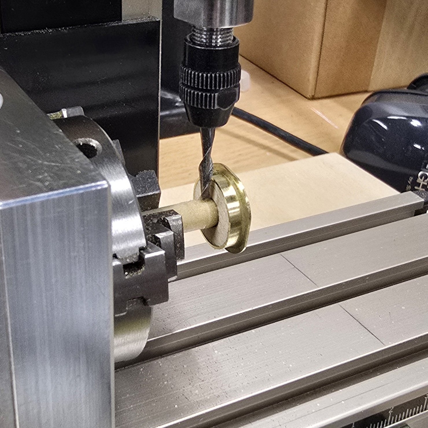

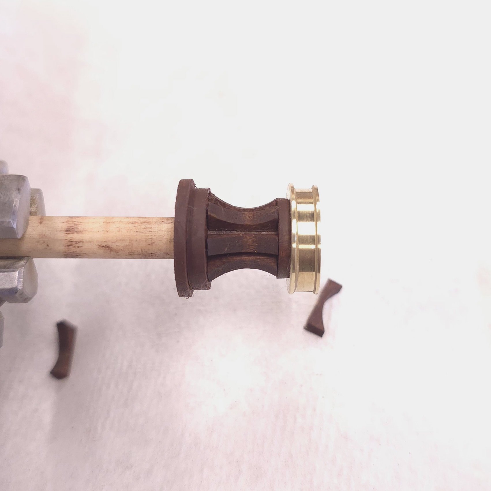

I'm going to try a radical approach in making the capstan. I'm starting from the top and working my way down. I tried adhering the brass blank to the wooden dowel with C/A glue first, but it did hold well under the stresses of milling.  I did get fairly far in the process of rounding the corners, but the brass plate kept separating from the dowel.
Consulting my AI assistant, I was advised to try G Flex epoxy. I didn't have any of that, so am trying the Bob Smith 5 minute epoxy that I have on hand.  I just applied it and I'm going to let a cure overnight.
The results you see were from the experiment with c/a glue.
corrections to the process

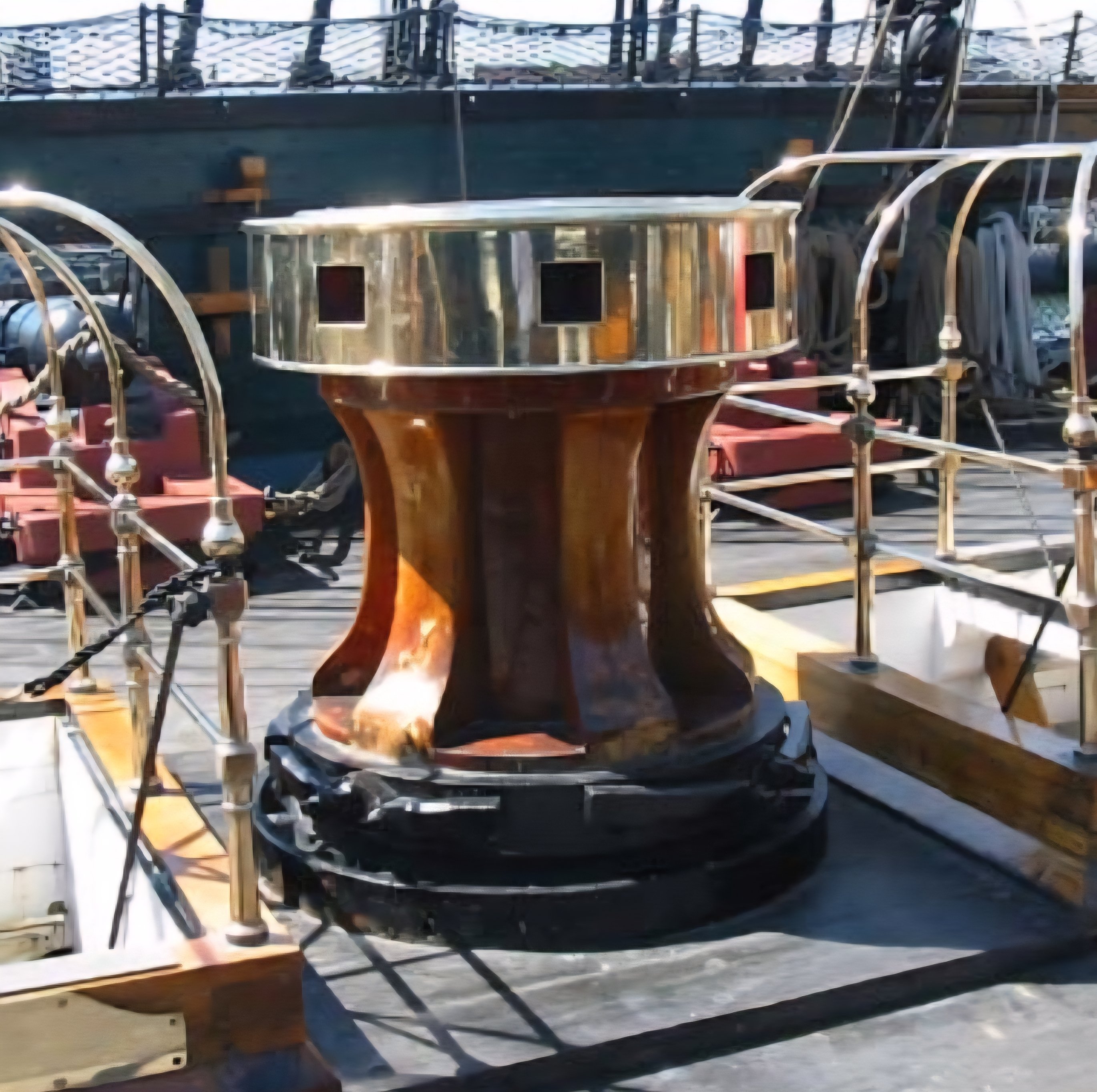

The goal:
The process:
I forgot to mention this when I first posted this, and I failed to take photos of the intervening steps. but:  I fitted a brass ring around a wooden disk, drilled a hole the diameter of the dowel, and epoxied the brass covered ring onto the dowel and against the as yet unrounded brass plate at the end of the dowel.  This substantially increased the strength of the assembly and permitted unfettered milling.
Get close to the final diameter with the disk sander.
Fine tune on the lathe.
Ready the bottom disk.
Rinse, repeat.
Stain, and get ready to assemble.
I've got to wait for the stain to dry before I glue the wooden pieces to the rest of the capstan assembly.  Then I'll mill the holes in the brass ring above the whelps and attend to finishing touches.
