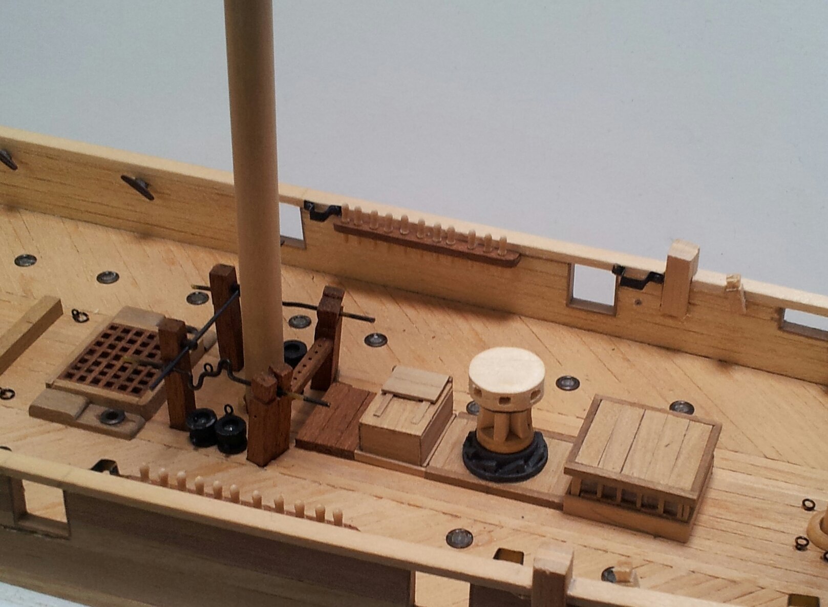

After making some headway on my Pourquois Pas build, put Erebus back on the bench and fitted the eyebolts and rings on the deck and made a start on the mizzen mast along with adding the hatch behind the mainmast fiferail for storing the rudder- one improvement on their Terror kit is the use of laser cut walnut instead of ply for mast caps, keel timbers etc (hoping if i get far enough with the masts it will inspire me to make a start on the chainplates!

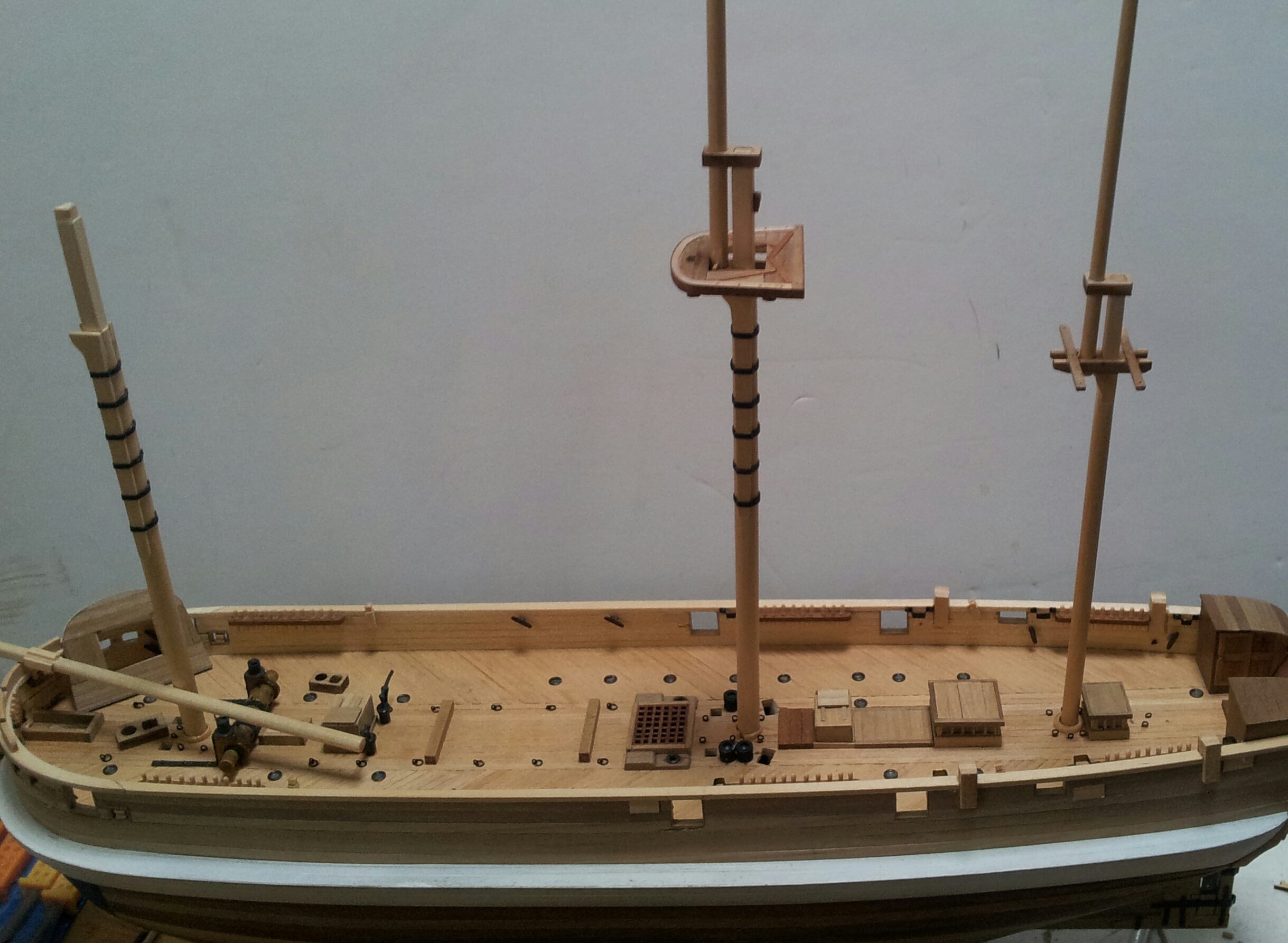

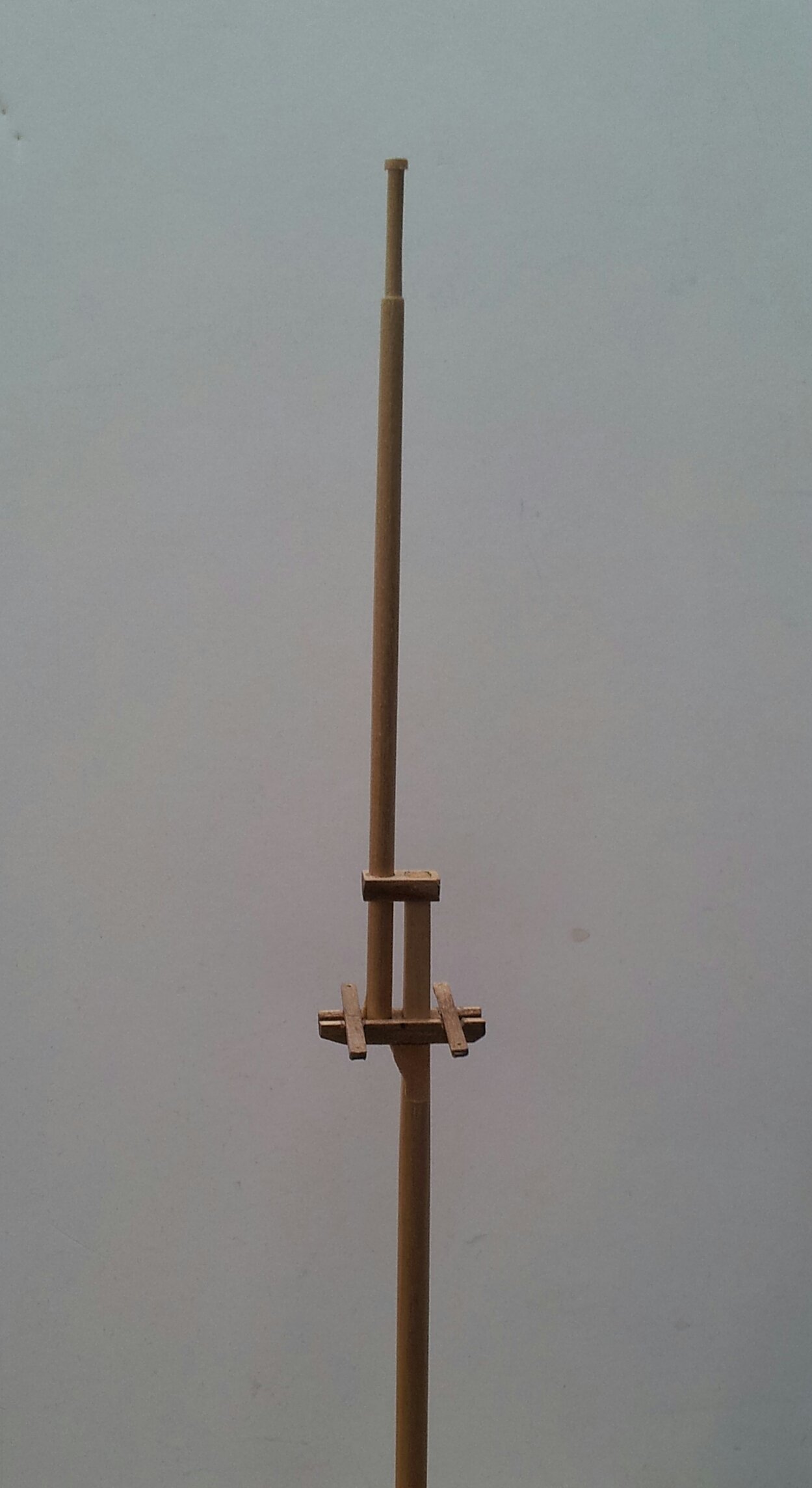

Thanks for looking in - more progress with the mizzen mast - the trestle trees have been added (scratch built with walnut from my spares pile) and the cross trees sized from offcuts from the laser cut walnut for the mast caps etc. The mizzen topmast has been cut to length and tapered- still need the fid hole and the cap/ hounds carved/ sanded at the mast head.
The mainmast has had the masthead squared off, cheeks and bibs added. The mainmast trestle trees and cross trees have been scratched and aren't actually glued yet (just the half lap joints holding them together

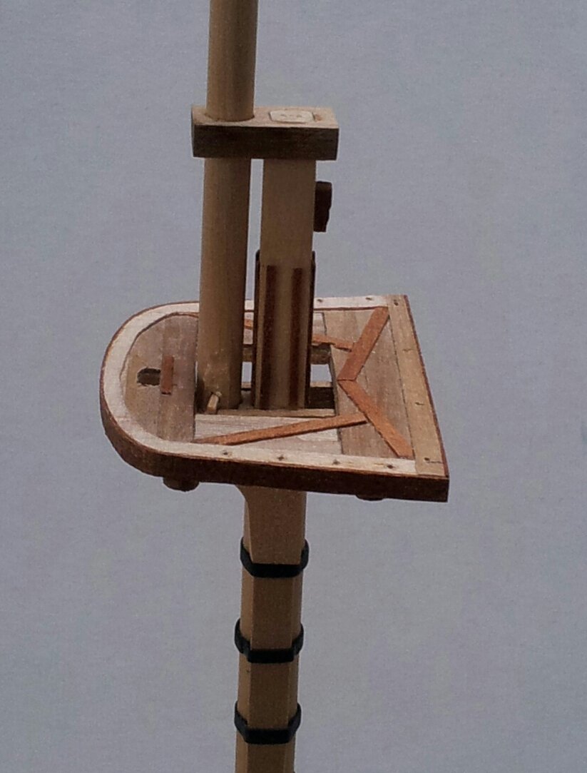

I was in two minds as to the style of the tops i was going to use- on my Terror i went with the style from around 1810, but decided i will opt for the version from the1830s (still in progress build wise) using Lees masting and rigging to get the measurement ratios (Occre's tops are actually about the right size but add a thin strip above the top not the timber added to the edge they specify in the kit)
first pic shows the trestle and cross trees on mizzen and main- the mizzen does not have a top as shown in kit instructions.
2nd pic shows replacement main top
and 3rd shows the kit supplied top

Thanks for the likes everyone and thanks Guy- no theeyebolts are not part of the kit- i made mine from annealed iron craft wire and the rings are  the same wire wound around a suitable diameter rod and snipped off.

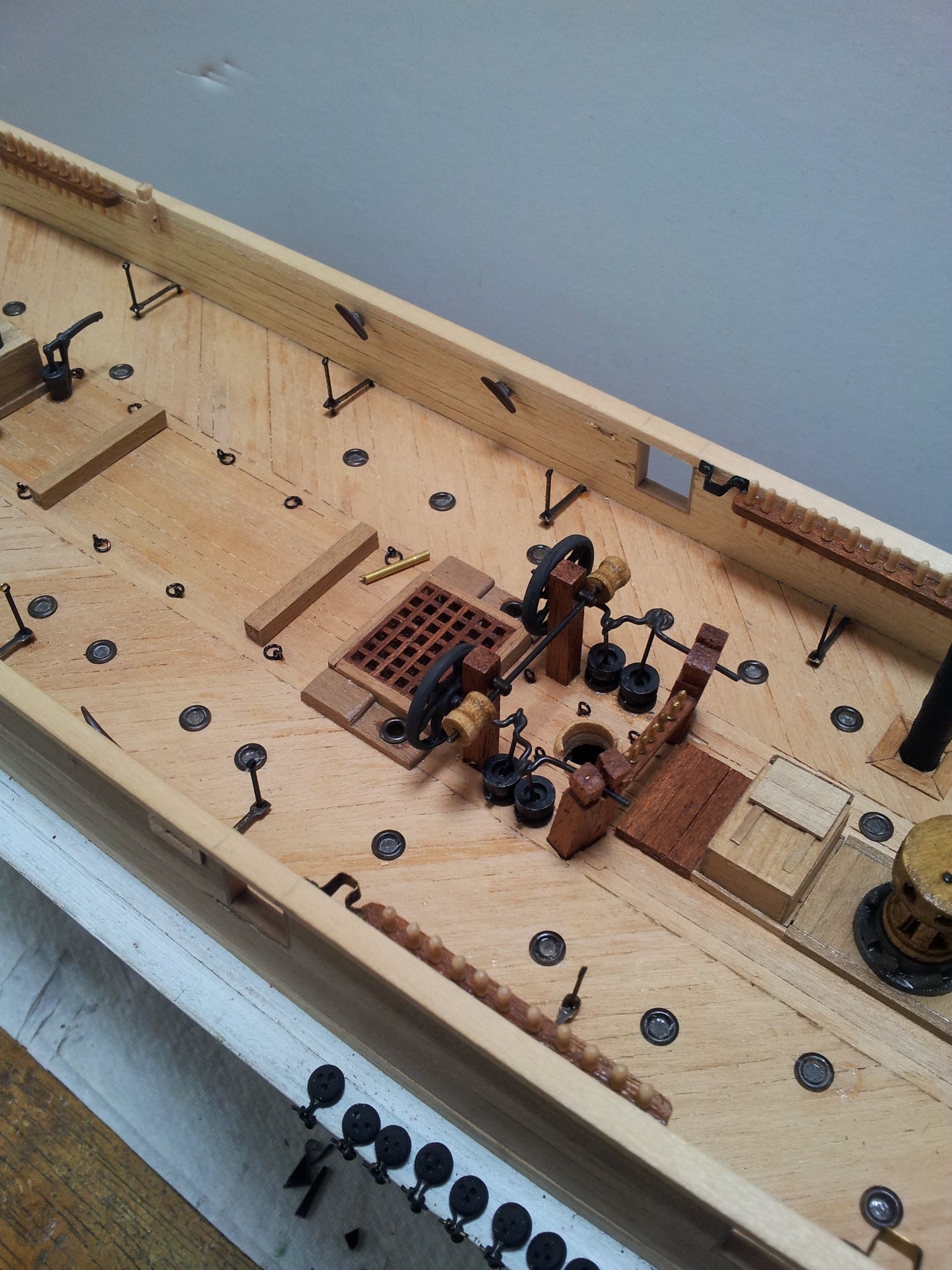

Thanks for the likes and comments- always appreciated, have now moved on to the philip's capstan - used the original base of the occre capstan but cut the head off and added one made from scratch, also added 6 instead of 8 timbers around the barrell as suggested by occre (still more work to do).
Work also on the main mast bitts and fife rail - the fife rail looks like it should be made of wrought iron on the 1836 admiralty plan but stuck with timber.

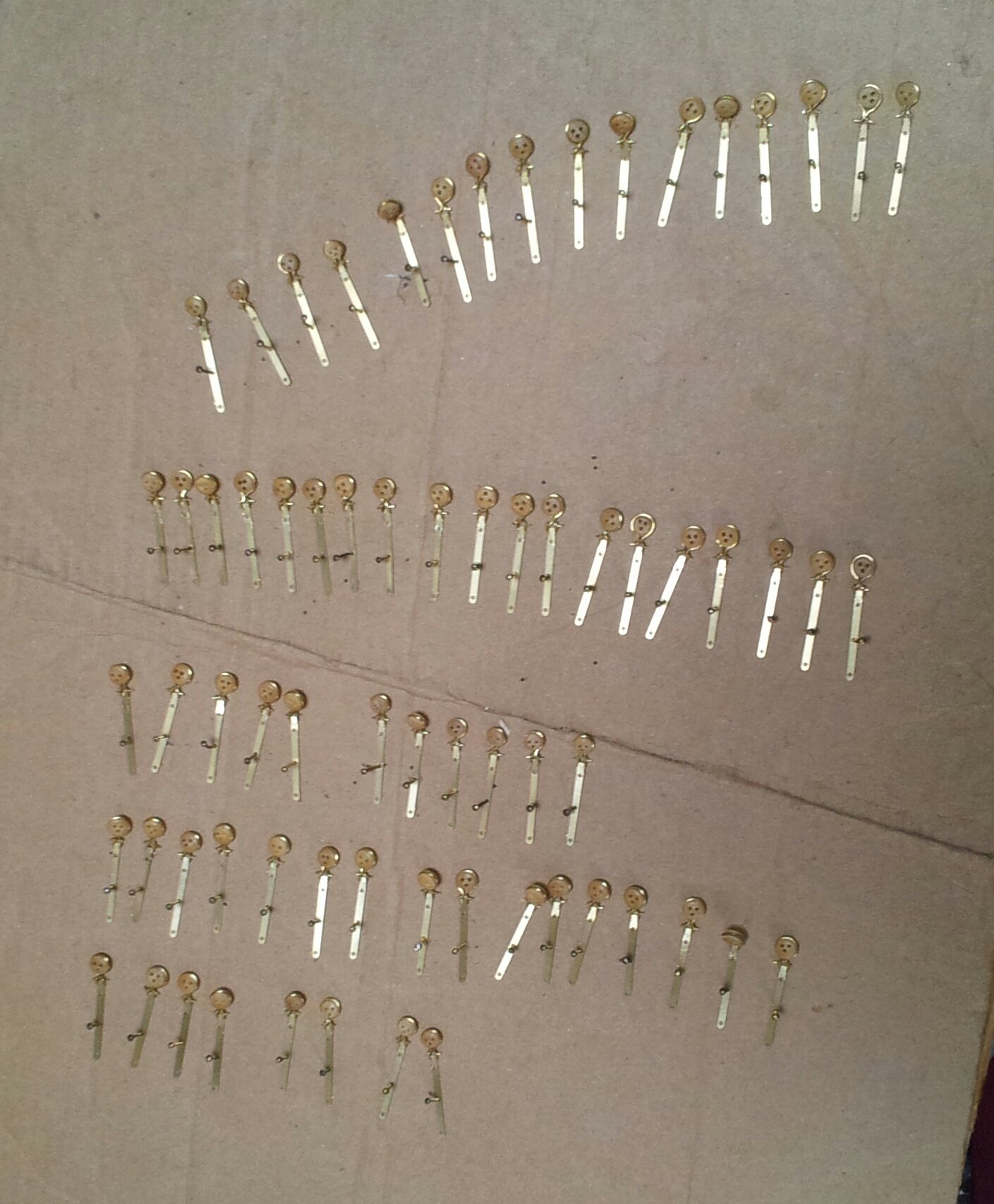

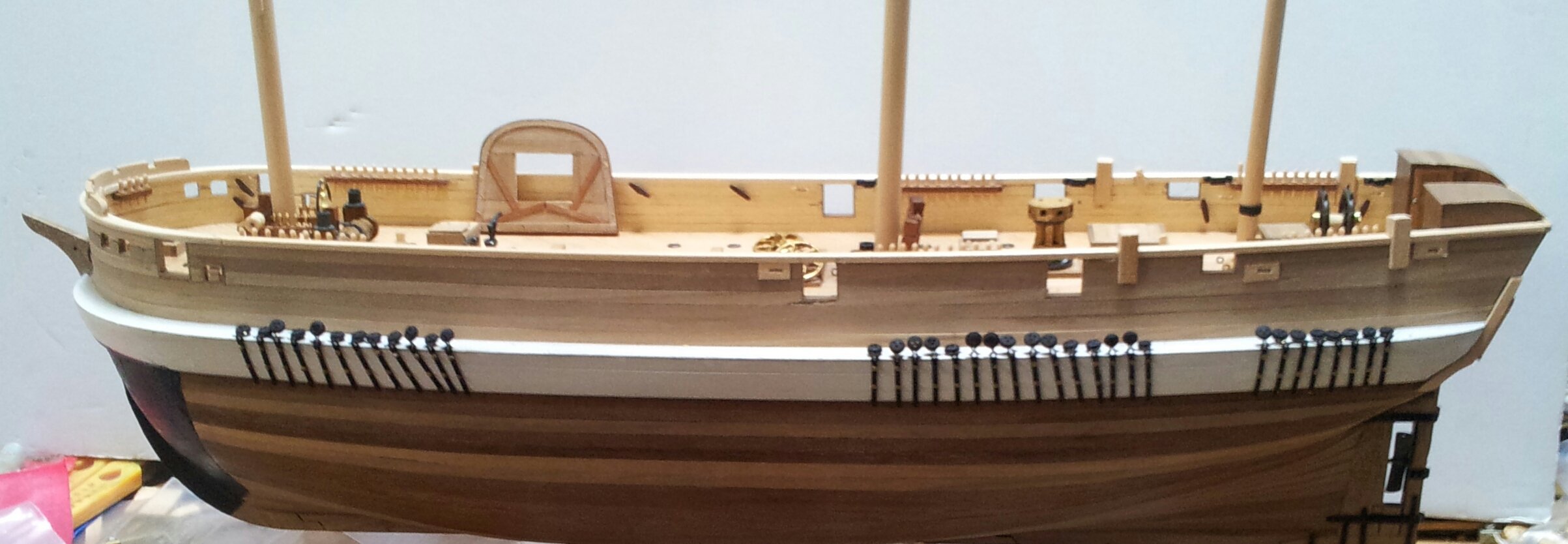

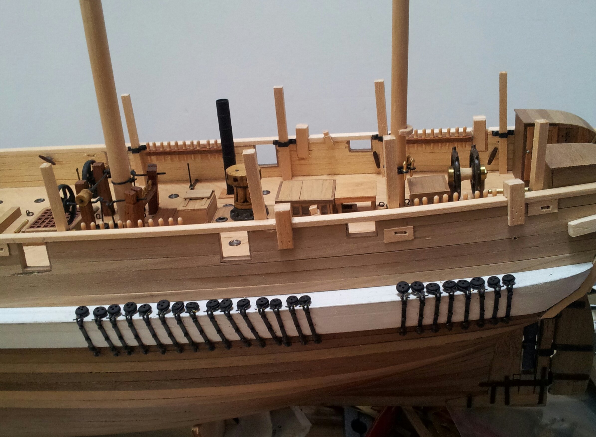

Thanks for looking in and the likes - finished the Philips capstan and added the fife rails around the foremast and added the ships bell and pawls to the windlass - the bell is not the kit supplied one but was ordered from Cornwall Model Boats along with chainplates- on my Terror i scratchbuilt the strops around the dead eyes but chickened out this time and used Amati turnbuckle chainplates along with some 0.5mm diameter soft brass wire omega loops made using a pair of round nosed pliers. The chainplates are shown pinned to some card awaiting spray painting black. also the kit supplied 5mm deadeyes were replaced with more accurate to scale 4mm ones- not much different but makes a world of difference to the spacing along the hull.

Thanks Keith, the chainplate joy continues with them sprayed black and got them mounted - used old brass pins recovered after pulling them from the first hull planking (never throw anything away)!
Also the battens at the mastheads have been added.

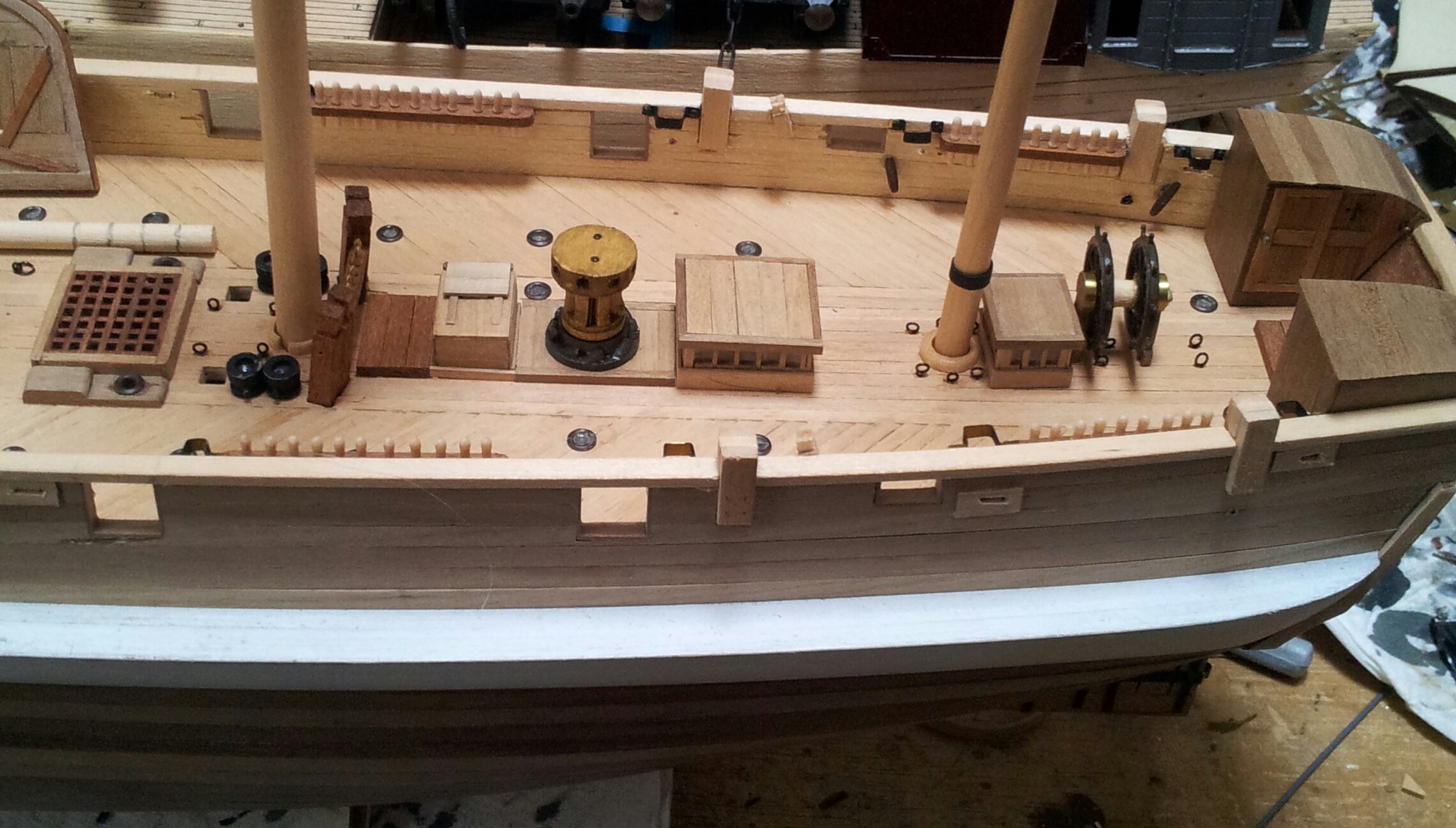

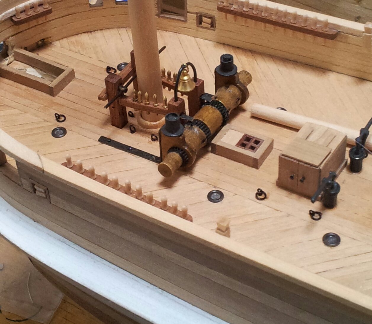

Thanks for looking in- safe to say we have definitely left the occre instructions far far behind! Have done more work on the Massey Pumps - will add handles later as opposed to bending them from the same piece of brass as the cam shaft (shows handles arranged like that on the admiralty plans), also using more thin black card and blackened brass eyes from the occre fittings to make the spider band on the mizzen mast, and added the warping drums to the fore and main jeer winches.

one thing that should be said move often is that your sense of photography makes reading your updates extra valuable.   I really look forward to seeing your work as time goes by. I have learned a lot from it.  Another of your fine lessons is the sense of sequence.  Getting all of ths tie off points in place early makes so much sense.
thank you for sharing so well!
Jon
Thanks Keith and Jon - regard the photos i take them from a distance with my smartphone so they are in focus then crop the image on the detail i want to show. The white backdrop is piece of foamboard.

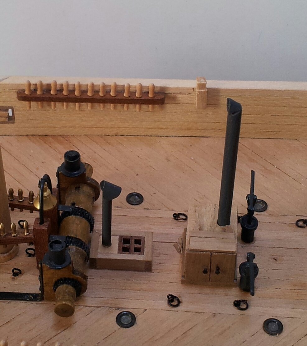

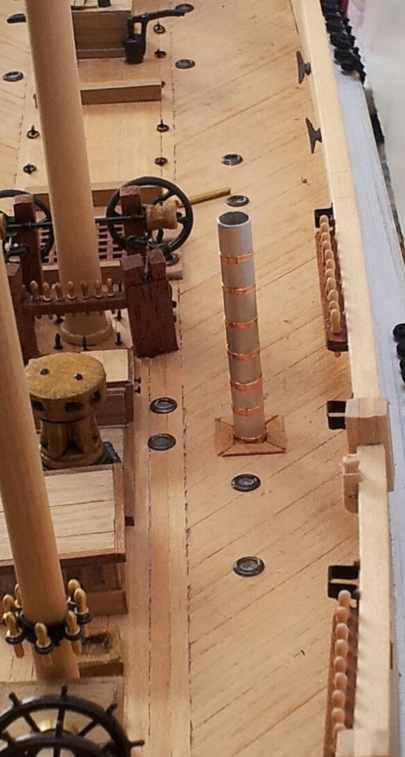

Anyways little more work on Erebus with the flues for the galley stove/ forced air heating furnace. The galley stovepipe has a hinged cowl- not sure if KeithS and myself spent much time regarding the heating system flue and on Terror i actually had it coming up the starboard deck, when after consulting admiralty plans and Matthew Betts Terror book it actually comes out to one side and slightly off centre to starboard on the fore companionway - i reduced the depth of the hatch and reduced the runners to suit.
Also made the funnel for the steam engine using Aluminium tubing and self adhesive copper tape cut into strips as i did with Terror and and added some strip to make a coaming around it- will be painted gun metal same as the flues.

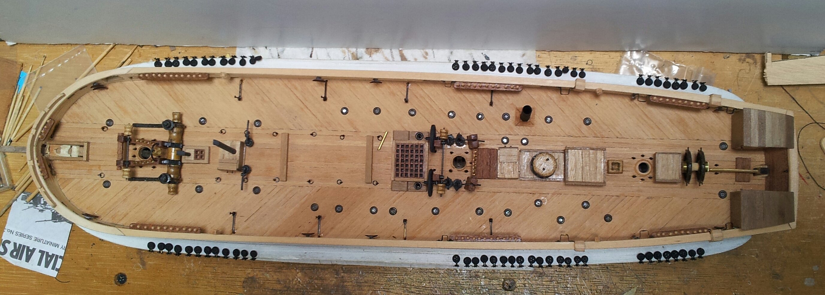

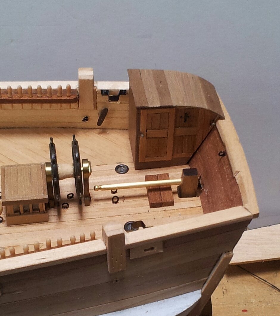

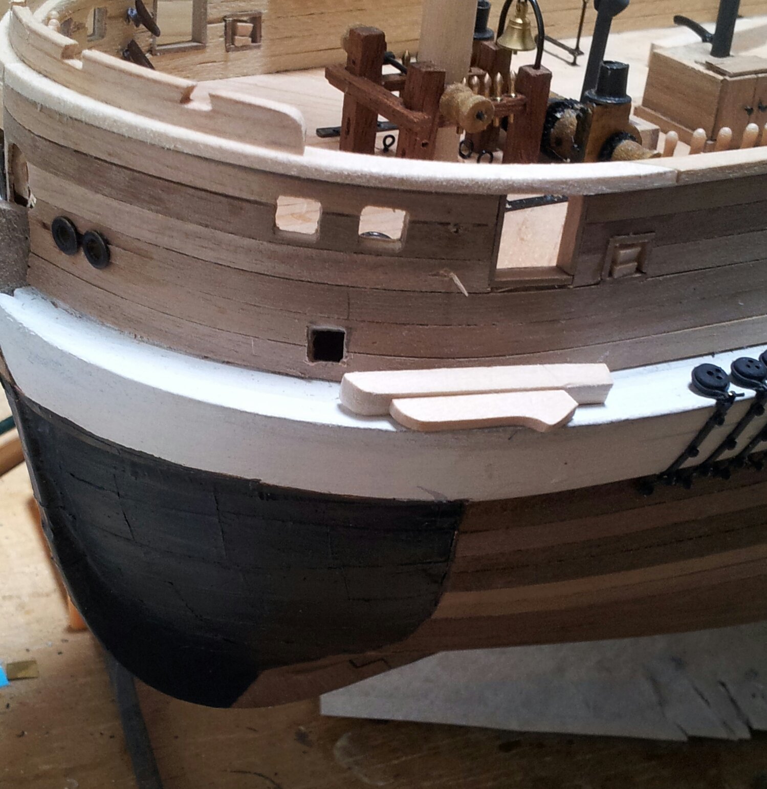

for the likes and looking in everyone- weather back to rain and wind on and off so a bit of ship yard time. The rudder has been added (drilled extra holes in  the pintle straps) - used the Peco blackened trackpins as fasteners and added a sheeve at the top of the rudder in the hole for lifting the rudder out, and made the tiller out of some spare brass rod i had same as on my Terror build.
Also added the brackets for storing the spare spars and other timbers - for making the shelter over the deck? Decided to go with black for the funnel as opposed to gun metal i was going to use.

 Love the overhead snap, Keith. It looks so nice and tidy. 👍

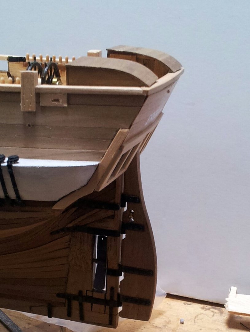

made and added the stern davits the same as on my Terror build. Also added another band to the fore and main masts under the bibs for the yard trusses - not really clear in pics but also fitted an omega shaped loop for the futtock stays from the tops (should actually be a shackle) and fitted a u shaped piece of brass strip with 3 holes drilled for the yard truss - the bracket is fitted to the yard with a planking pin and left free to turn. On my Terror i rigged rope trusses and chain collars then seen the mention of the foreyard still having its heavy iron truss attached on the wreck in Matthew Betts book! The trusses are from Billings with the central mounting hole moved forward and the old one cut off and files to bring them closer to the mast.
Also made the small map/ chart /plotting table -used the kit one cut slightly smaller, cladded with veneer and shaped walnut legs added.

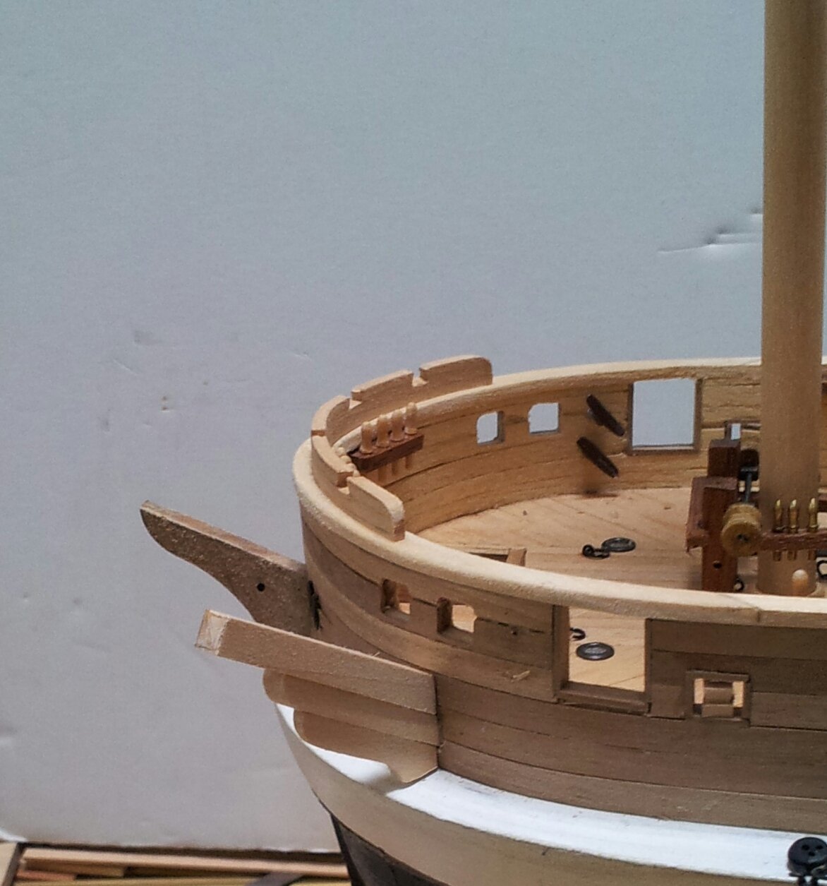

Thanks for the likes and looking in everyone, finally started to construct the catheads and like on my Terror i drilled and filed a square hole to accept the supporting piece below the cathead - also made a new knee from some planking strip to replace the ply one, next job will be drilling holes and cutting grooves to imitate the sheaves.
Also made a start on the posts for the stern davits (the two for the boat skids/ ice bridge are 4mm the others are 3mm).
