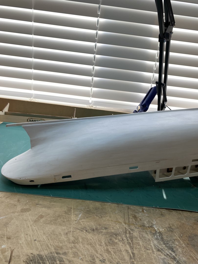

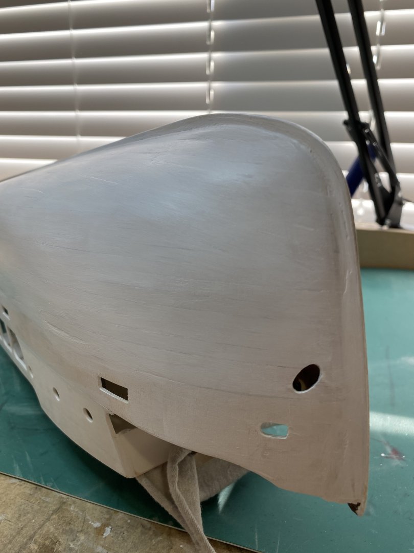

I have done the first heavy sanding with 120 grit, 180 grit and a final with 220 grit.  There are some areas that will need filler and more sanding.  I did manage to snap off a piece of the keel where the rudder post will mount.  Used a piece of scrap from the kit and made a new one.  I have said before and will say again, this kit should have an instruction book and the build sequence should be modified.  I have still not heard back from AL with my concerns about this model

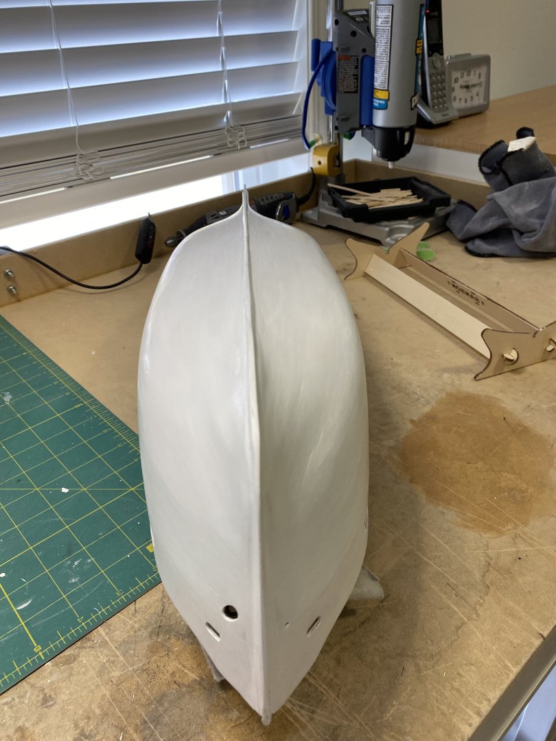

So the ugly duckling got a coat of wood filler and then was sanded with 220 and 400 grit.  One coat of primer/sealer has been brushed on.  There are some areas that need attention, more filler, more sanding and more primer.  The hull has turned out better than expected
I have done another coat of filler and while it drys I started on one of the small boats that come with this kit.  The instructions show this as a Clinker build, but starting at the gunwales and going to the keel would have the overlap in the wrong direction.  I have decided to build it as a Carvel.  Hope this is the right term.  A couple of pics to show my clamping solution for this small build.  The instructions show the small boats covered and lashed to the deck.  I might try and leave the covers off and have them swung out on the Davits ready to be lowered.  Any thoughts on this appreciated
I have done another coat of filler and primer and another sanding session.  There are still a couple of areas that need attention but I have to remind myself that this is a Tug , not a racing yacht.  Still not an excuse to make it as good as possible.  Next step will be adding colour coats.

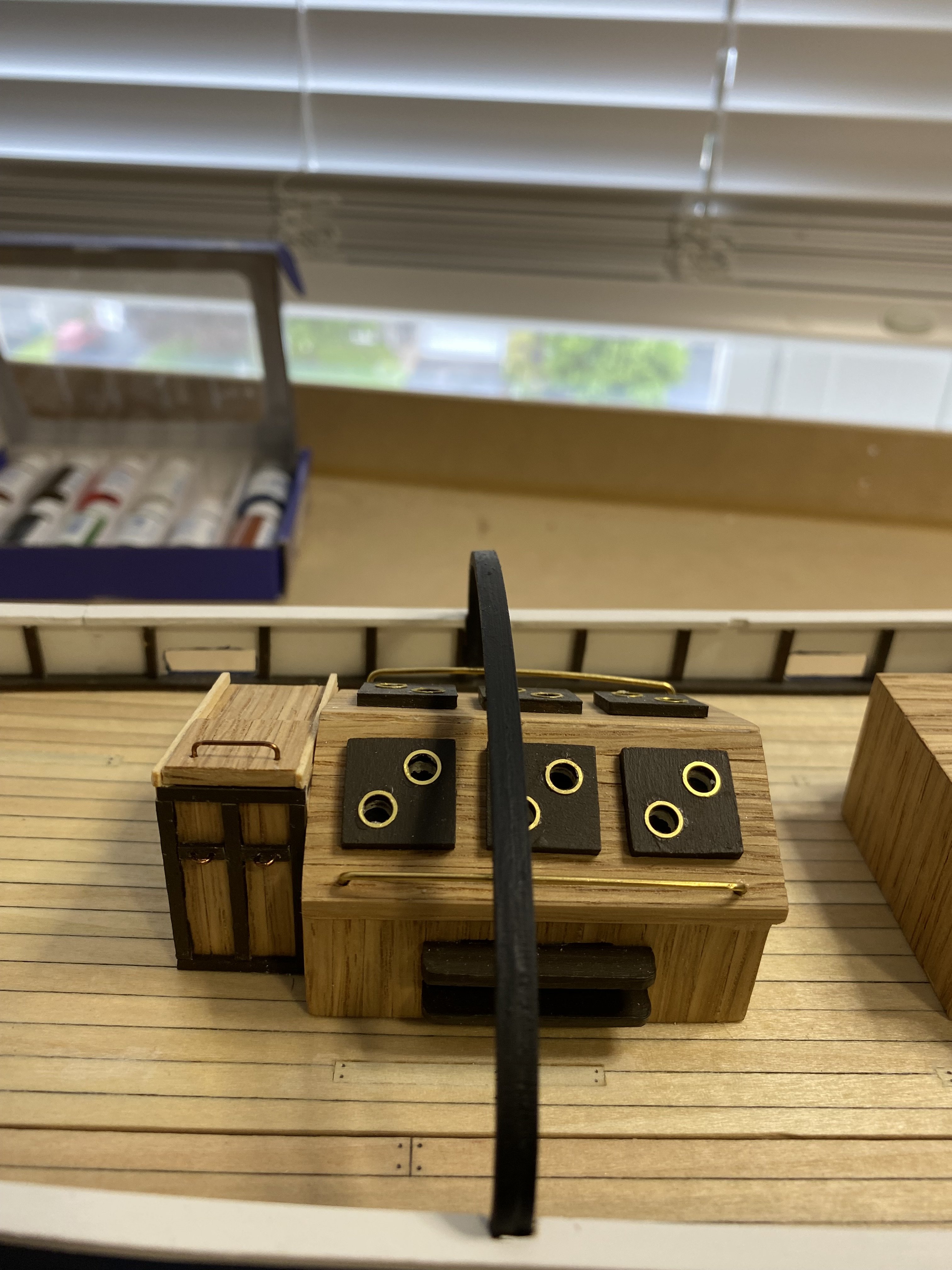

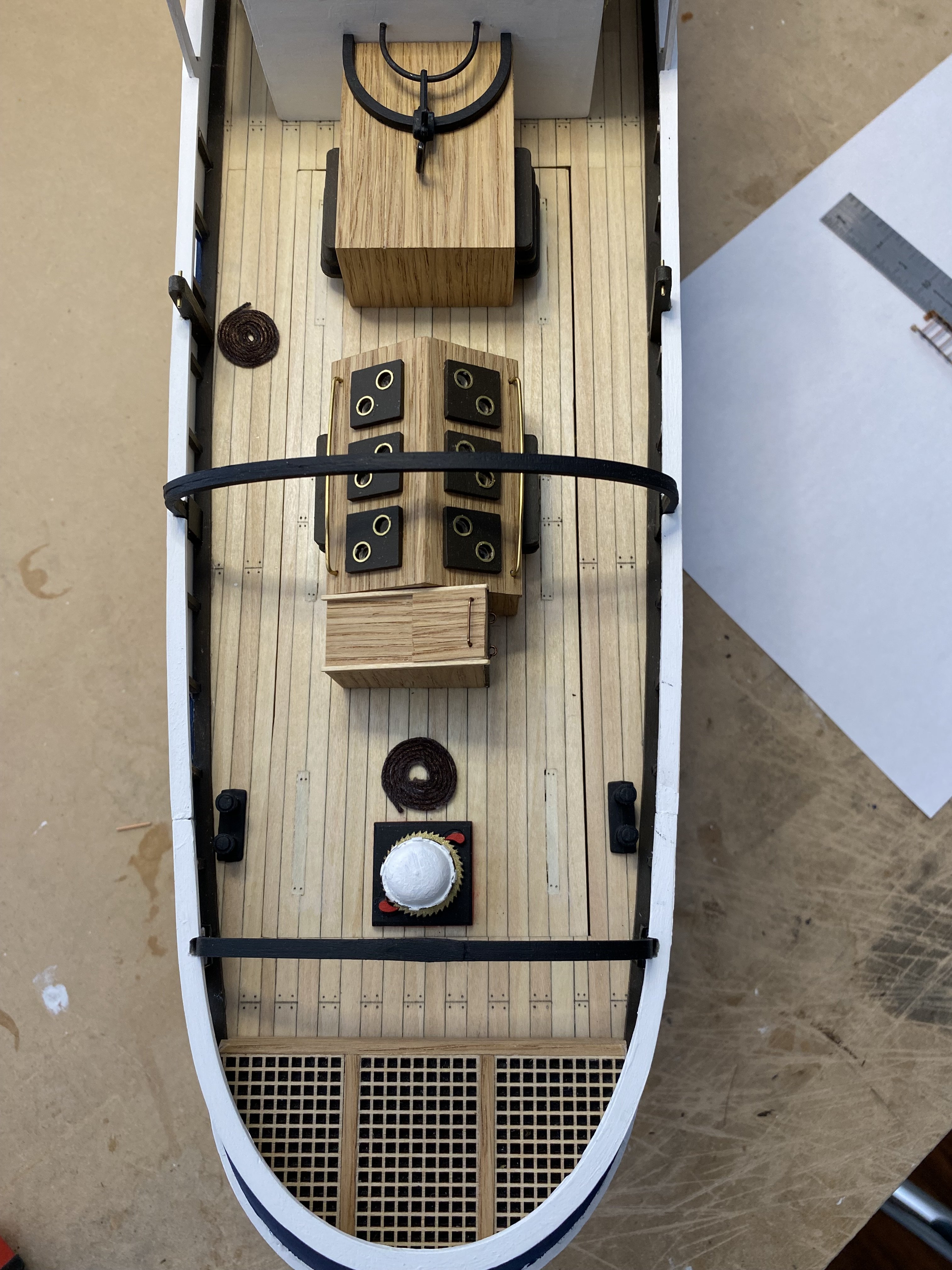

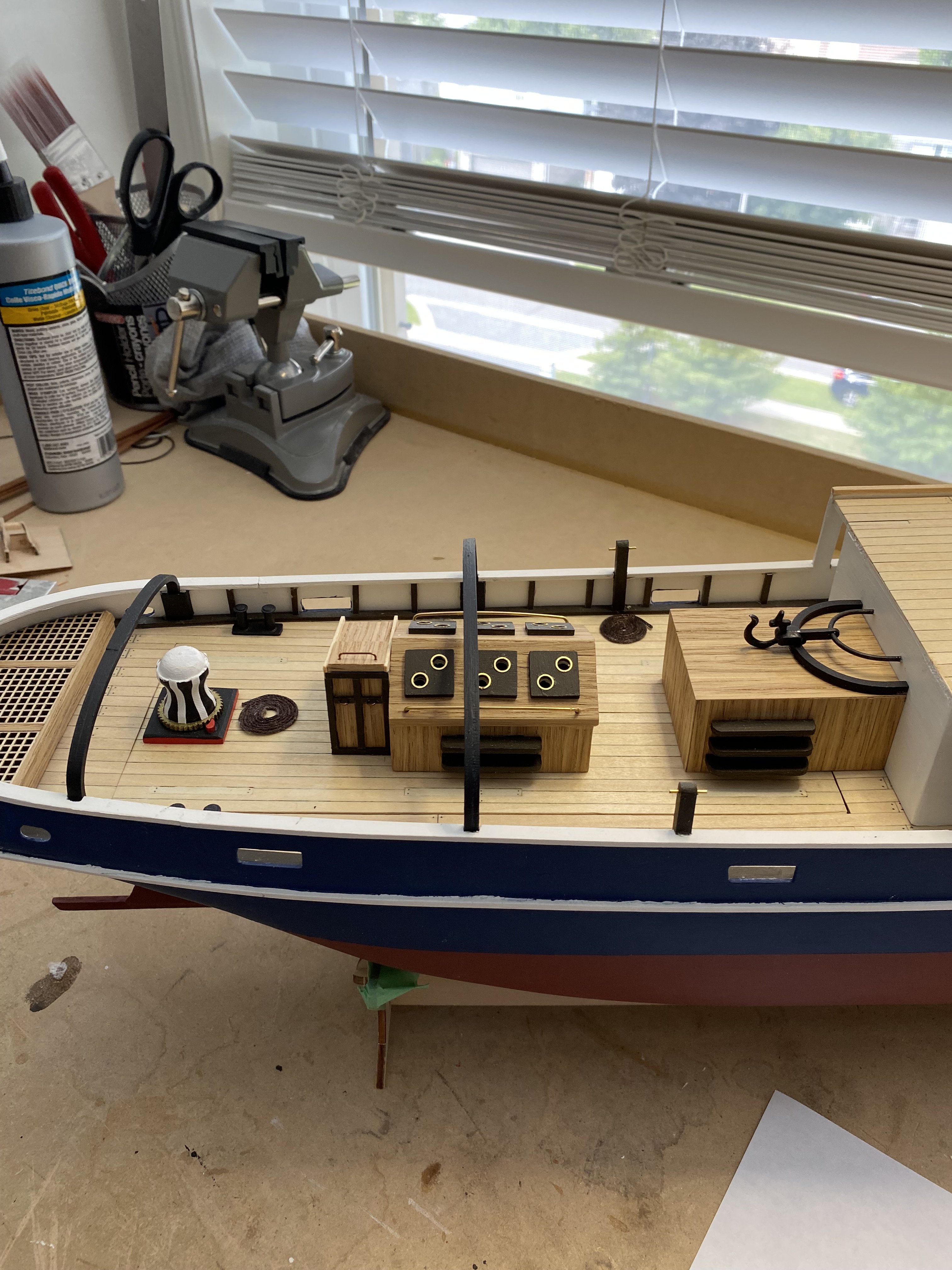

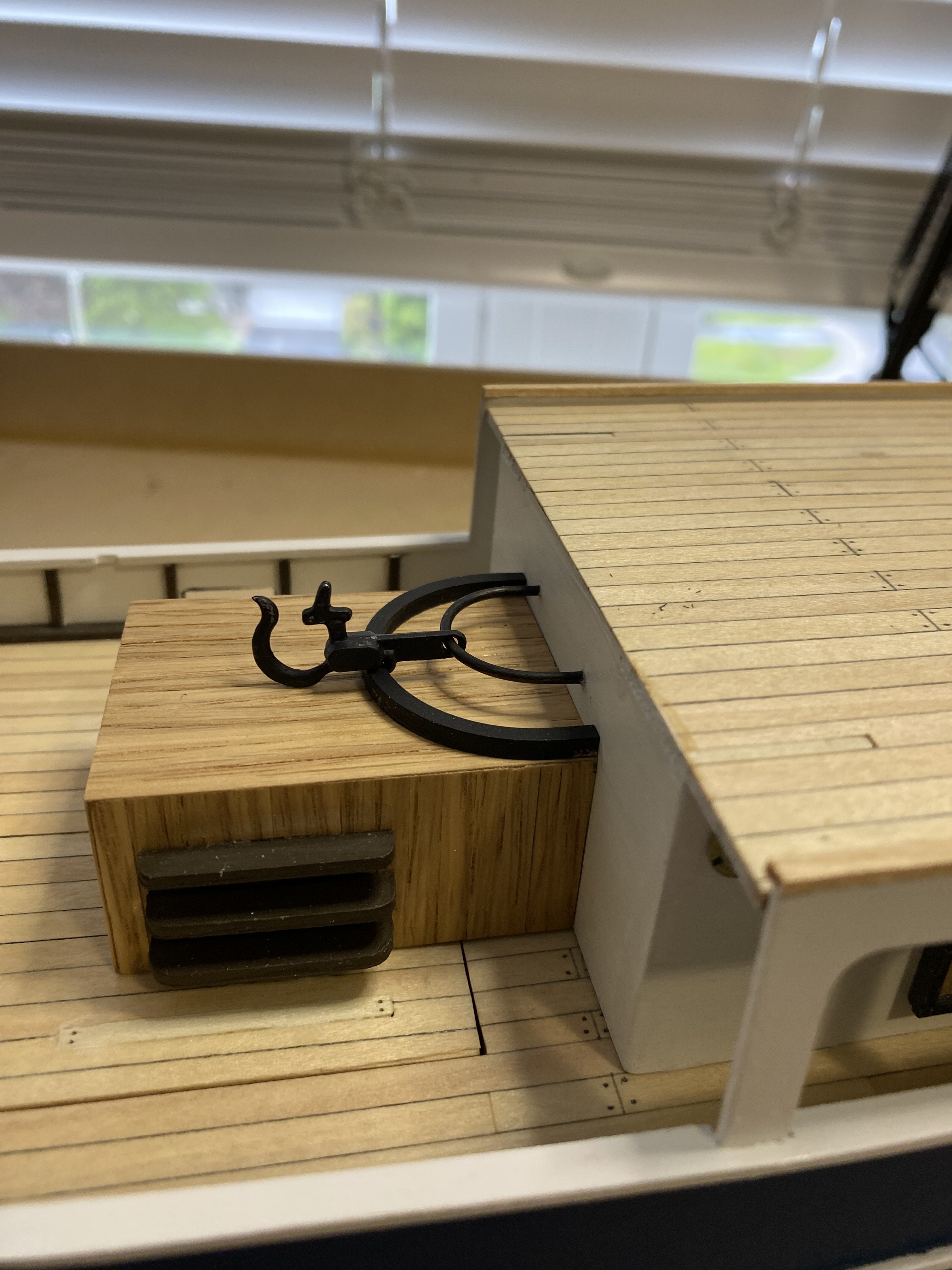

I have started on some of the fun stuff.  The capstain and anchors are secure, the ventilators require a bit more work before they are glued in
Looking at these photos it appears the capstan shifted when I glued it down.  I used CA and Titebond so I don’t think it can be moved

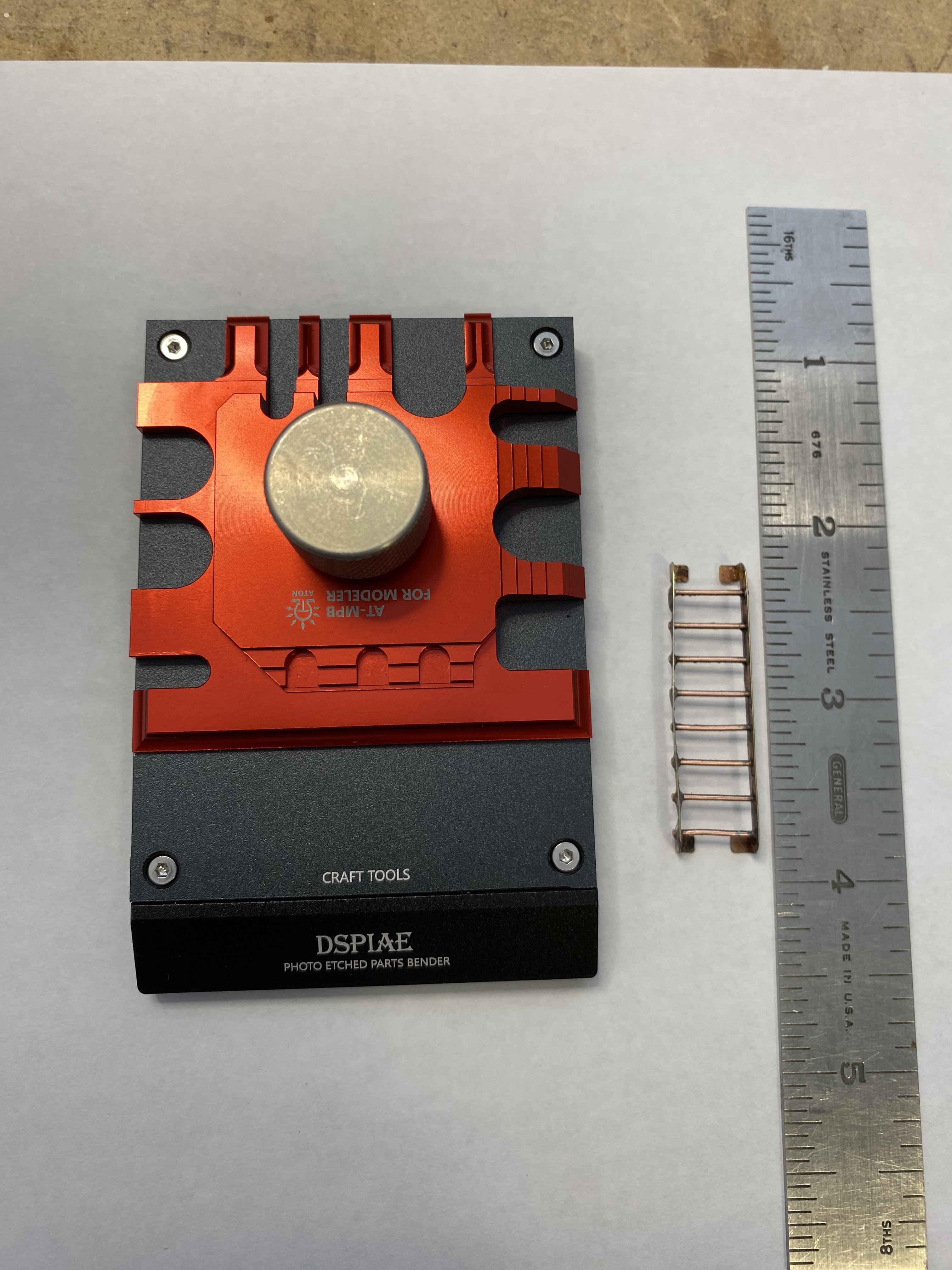

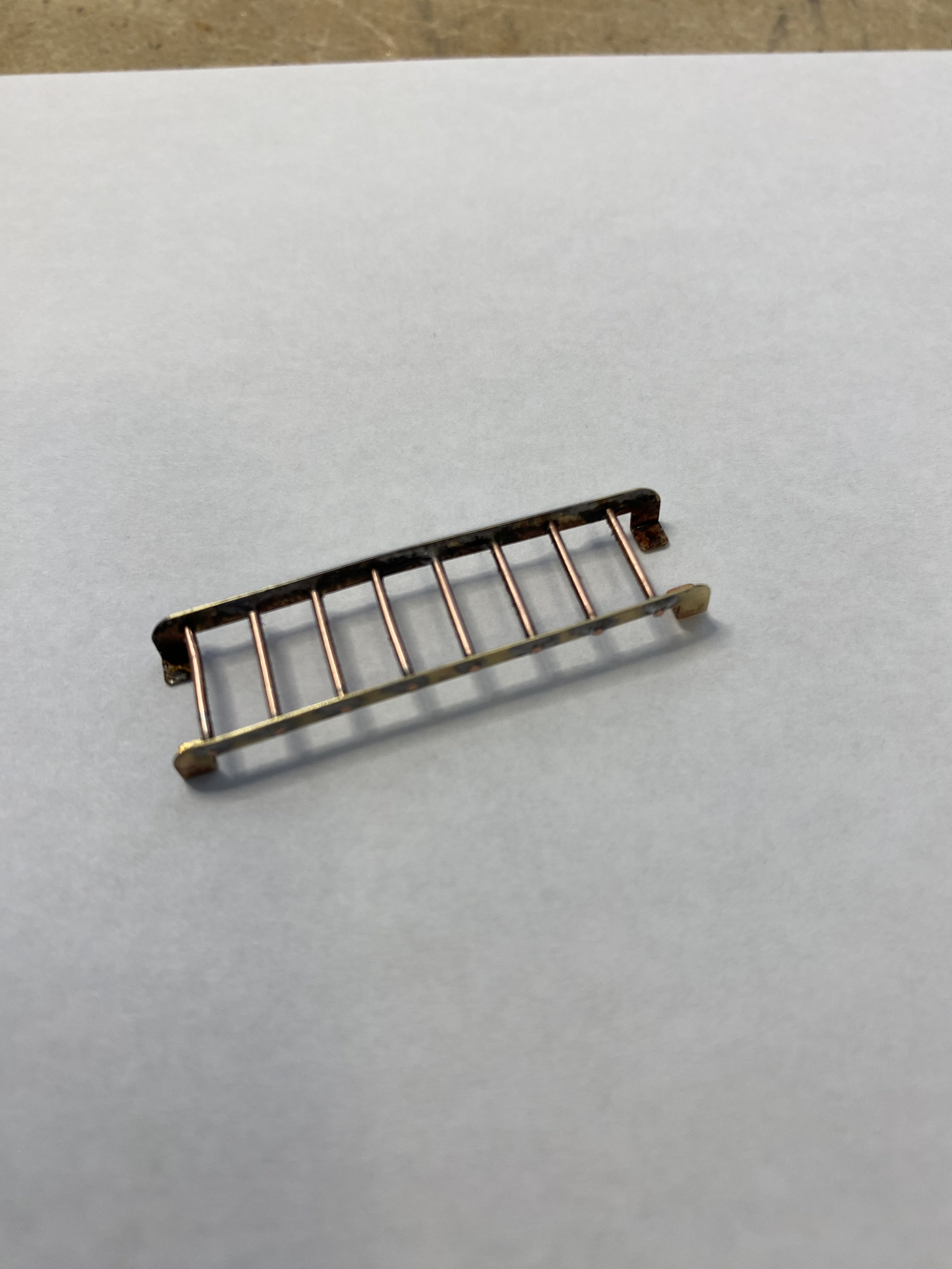

I just purchased the DSPIAE photo etch bending tool so the ladders and other parts could be shaped .  The tool is well made and worked very well.  Unfortunately the operator not so good.  After bending the ends of the ladder I twisted the steps in the wrong direction.  When trying to correct this the steps broke off.  The sides were drilled and some copper wire cut and soldered in.  It’s not perfect but with some paint it will be acceptable.  The towing deck of the tug is pretty much complete, now it’s onto the boat deck.
