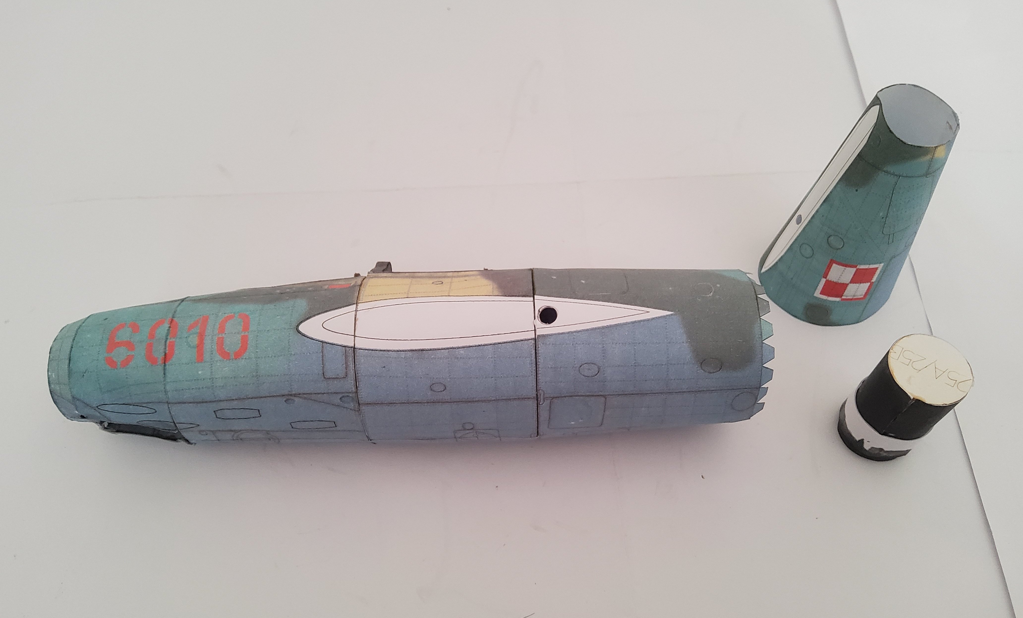

OK, back to the MiG.

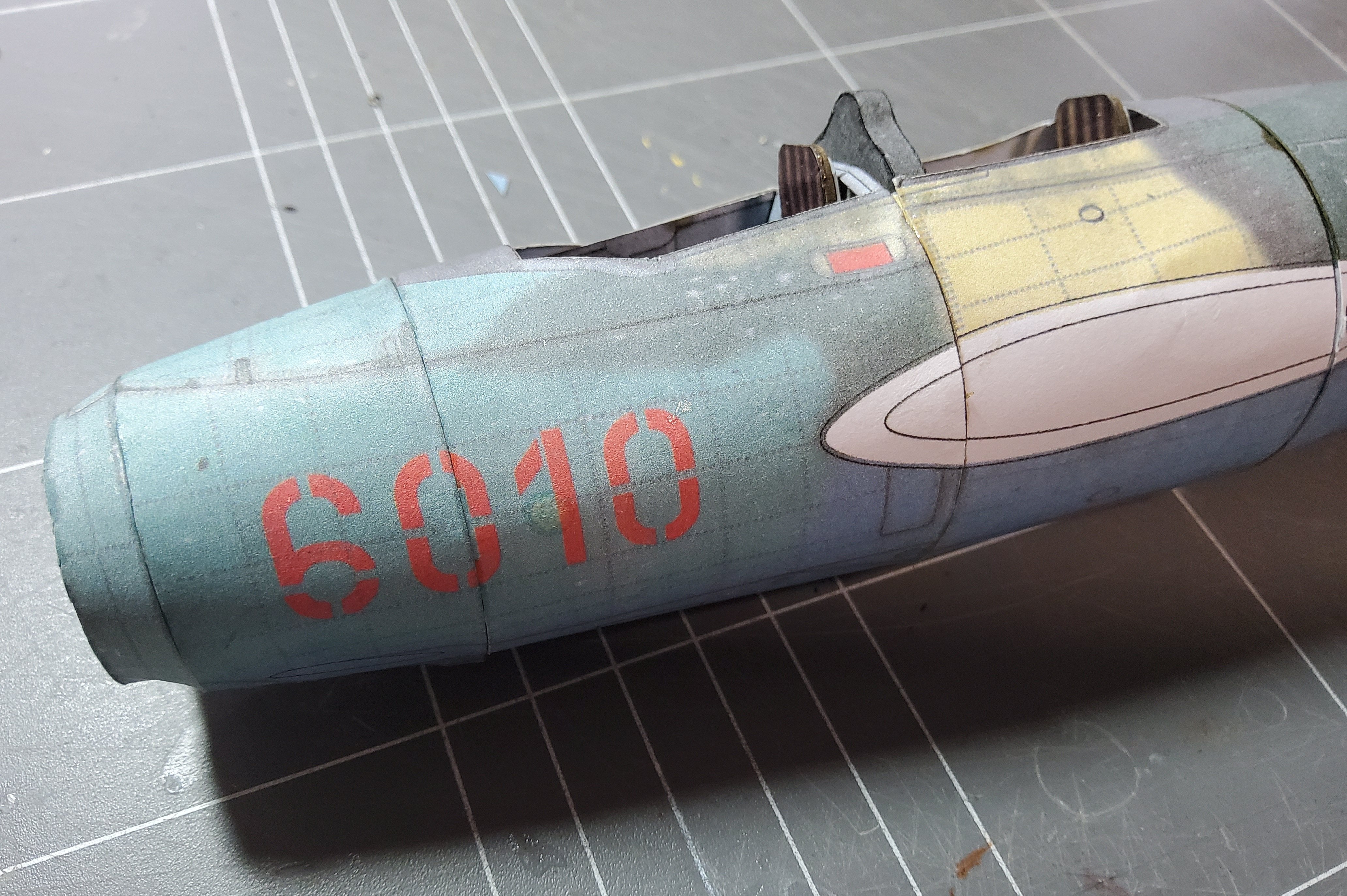

The forward section of the fuselage was built again and the rear-most section and tailpipe added.
Photos are a little lacking I'm afraid.

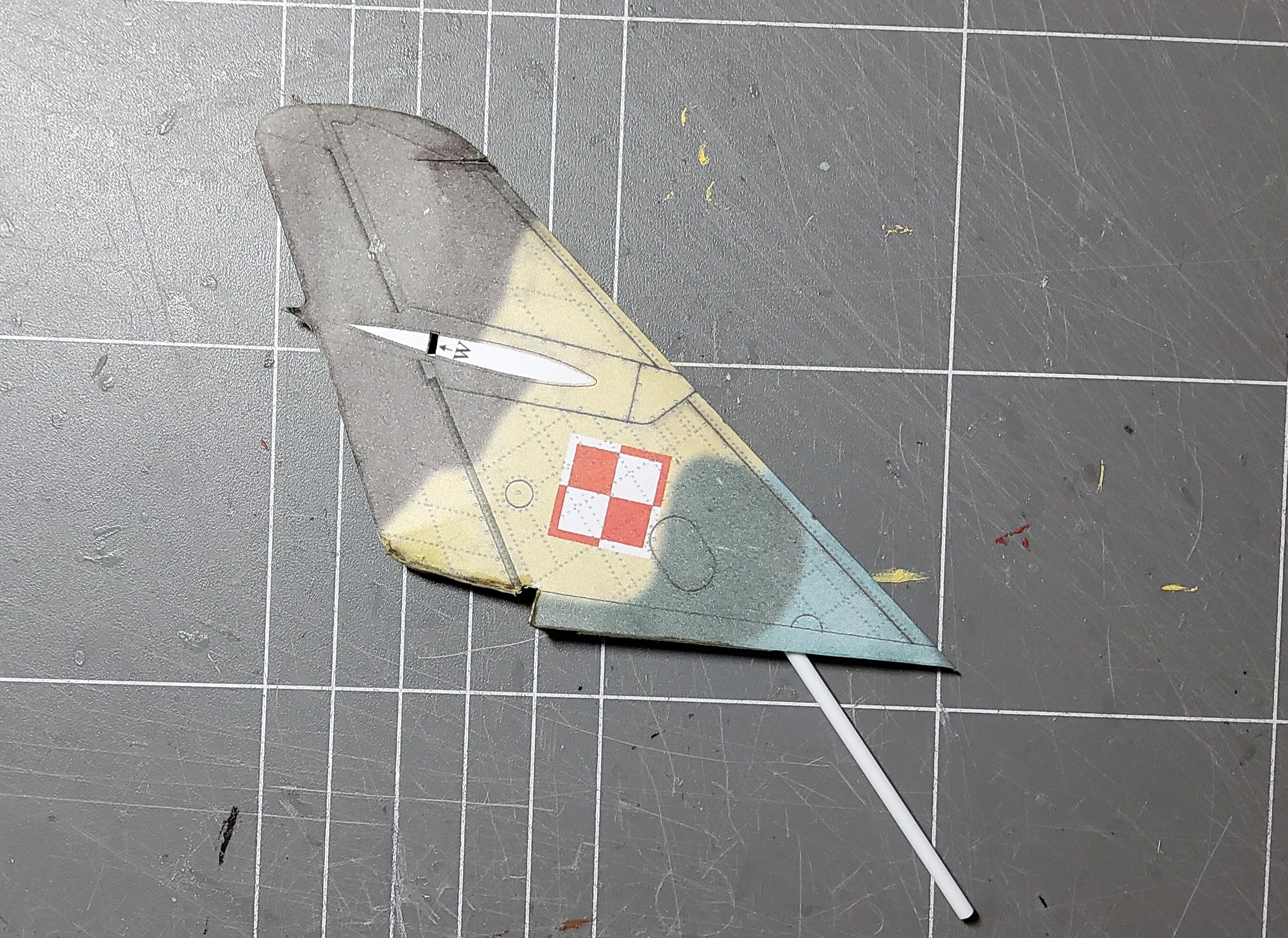

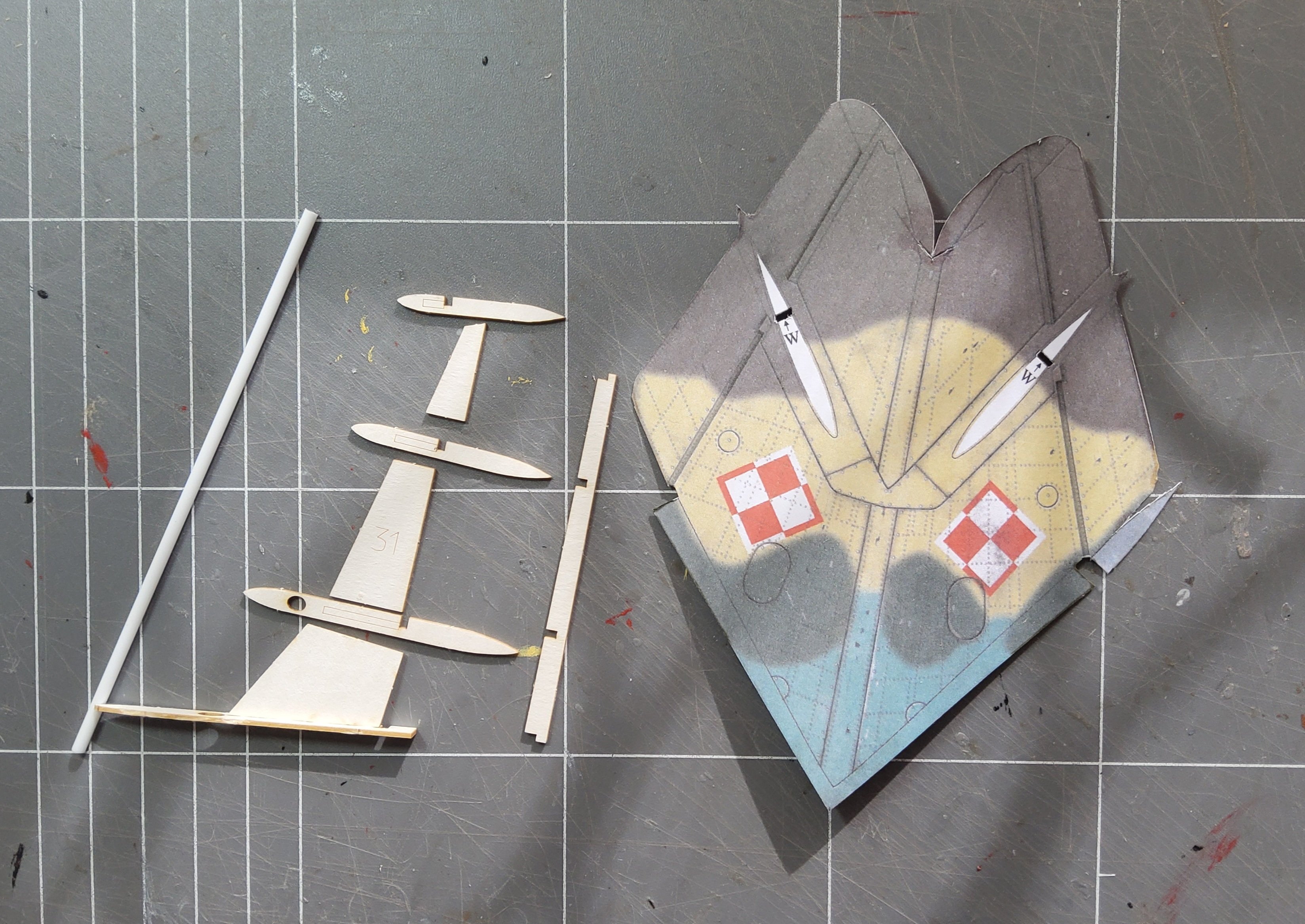

Next was the vertical stabilizer. The photo shows the parts  -  the skin, the laser-cut framing and a length of styrene rod that acts as a support/brace for it. The rod extends down into the fuselage and into one of the bulkheads. 20250630_095557.thumb.jpg.db8f823e9c56364f5653a643984c65c7.jpg
As Chris said in his log,  the dart (to be cut out) at the top of the stabilizer appears to be unnecessary, but I did it anyway. However, a dry fit made me think that the topmost former was also unnecessary as omitting it would make closing the seam at the top easier. So I left it out but tapered the vertical spar slightly.  Even so, the top of the stabilizer is a little messy.20250701_092206.thumb.jpg.599ad9eed460bb6b2d43423d5d23eecc.jpg

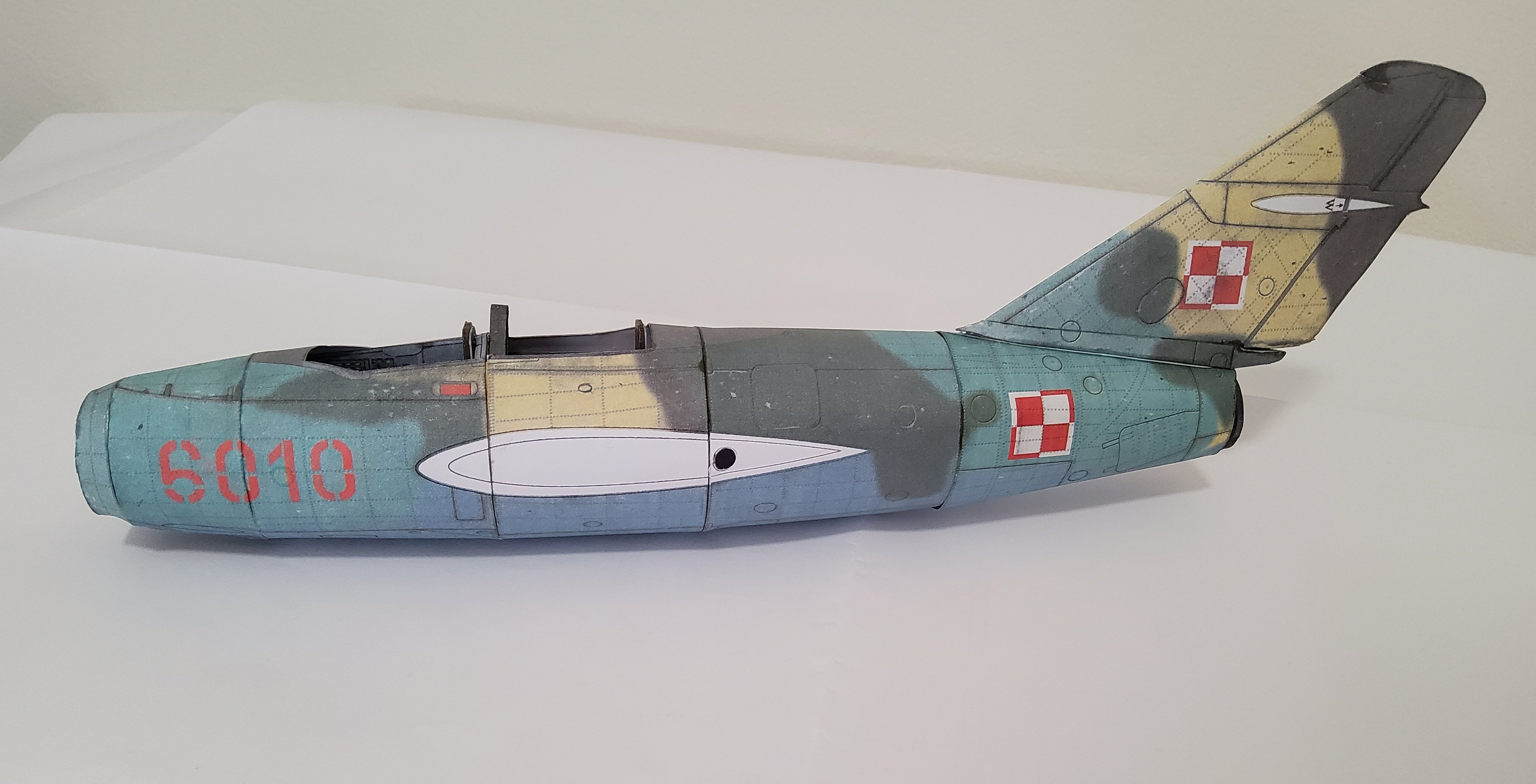

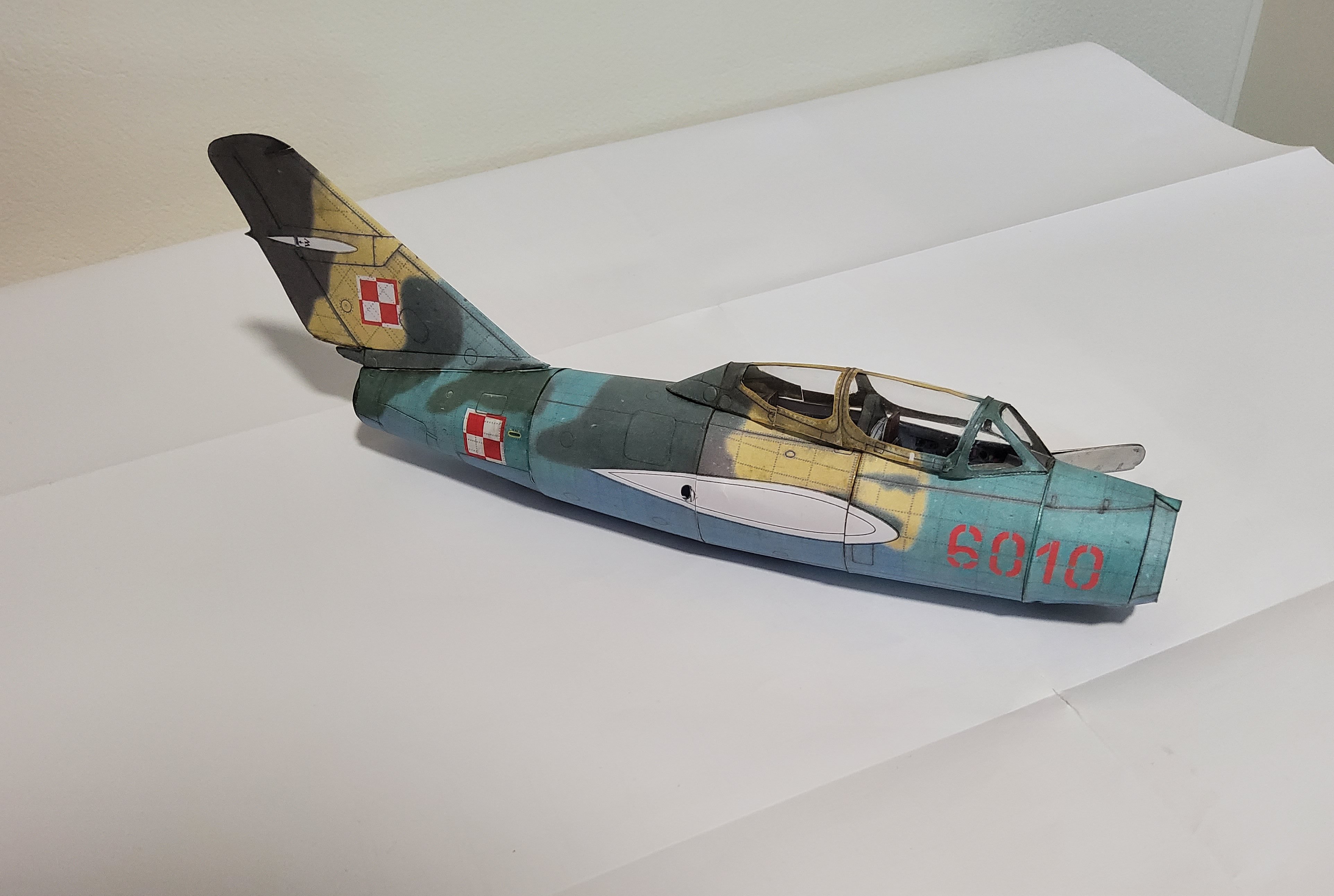

The completed fuselage plus vertical stabilzer.20250702_105201.thumb.jpg.e1f00afdd4daf2f6f82008ae9bbf6083.jpg
I should point out that viewing distance and camera angles are all-important when looking at my model.😁
Cheers

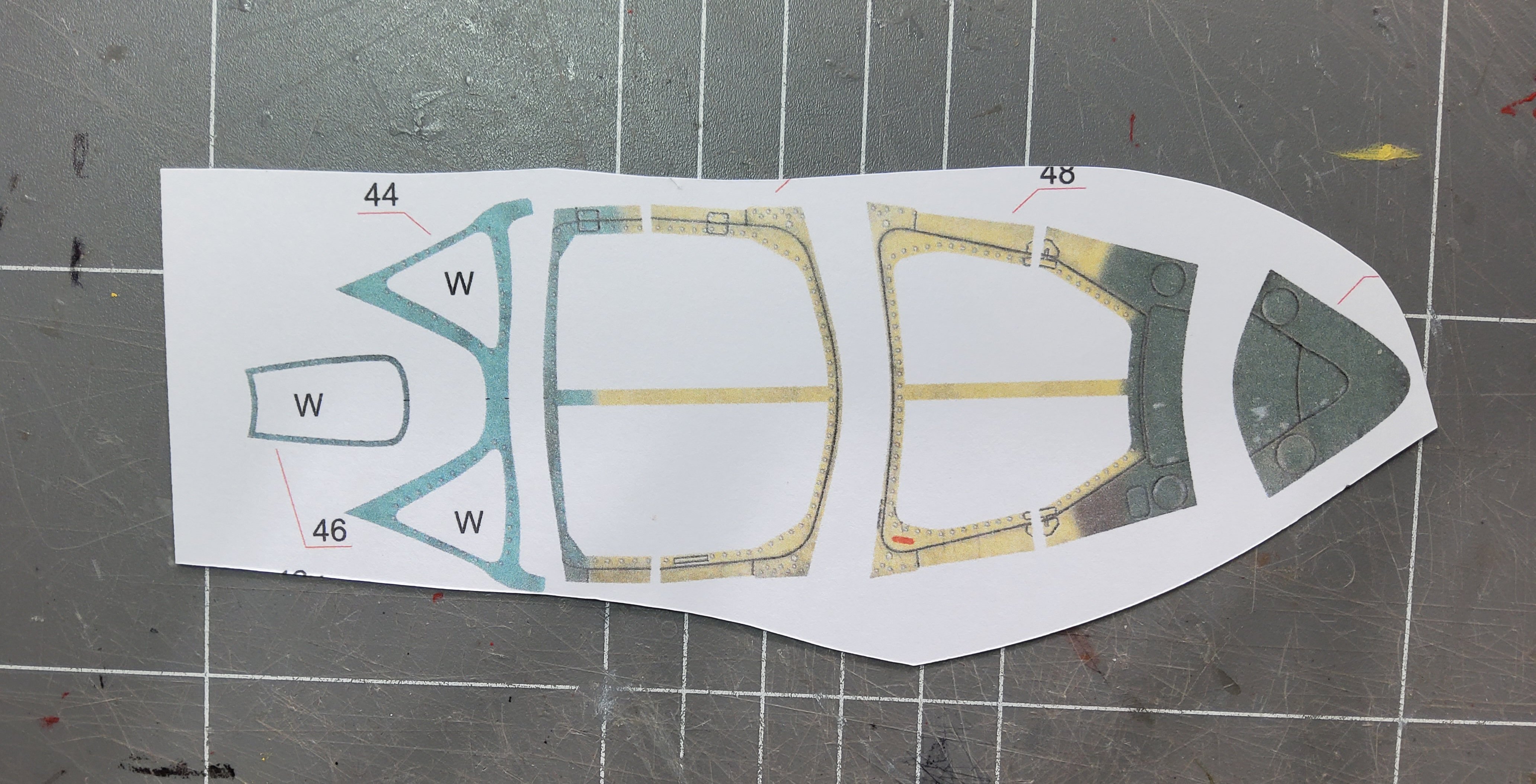

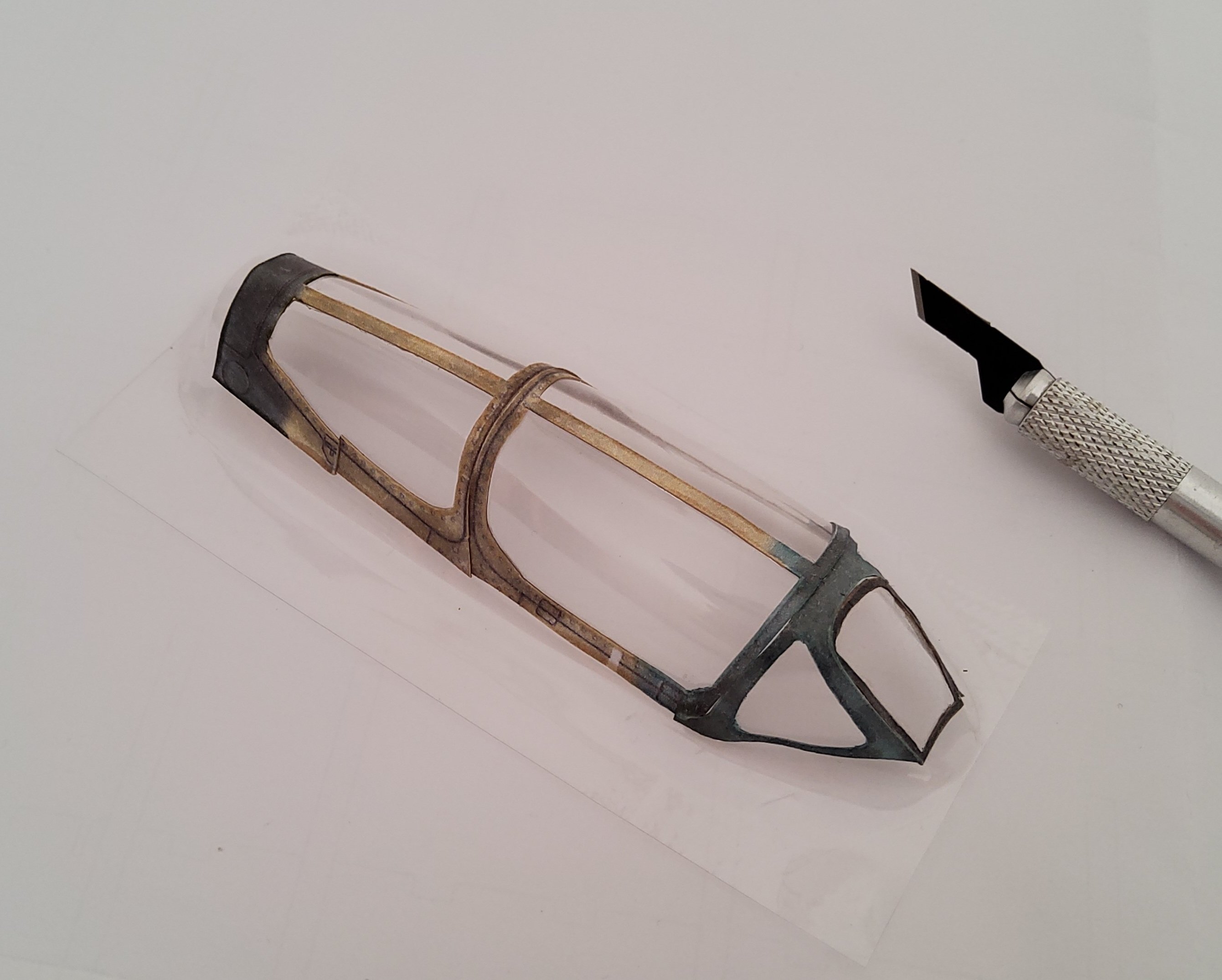

Next up was the canopy. I ordered a clear vac-formed canopy when I bought the kit. I would not have liked to assemble a canopy from printed card.
The first photo shows the parts of the frame, yet to be cutout. In the second, the frame has been glued, piece-by-piece, to the canopy. Fairly successful but not totally so. The third photo shows the fuselage with the canopy in place (and yes Chris, I remembered the gunsight 😁). It is noticeable in the photo, and even more so when looking at the plane in your hand, that the canopy does not sit flush with the fuselage. This is because card models are susceptible to being crushed if gripped too hard - and that is what I did with the MiG. The fuselage is slightly crushed in the cockpit area.20250703_093832.thumb.jpg.363302db6a2440ce61f231163f399420.jpg20250704_100914.thumb.jpg.3a0127c8c59738c2fb8a4ef2a3ebac40.jpg20250707_111920.thumb.jpg.deed5e710ec7425a34a39c3a26283f0e.jpg

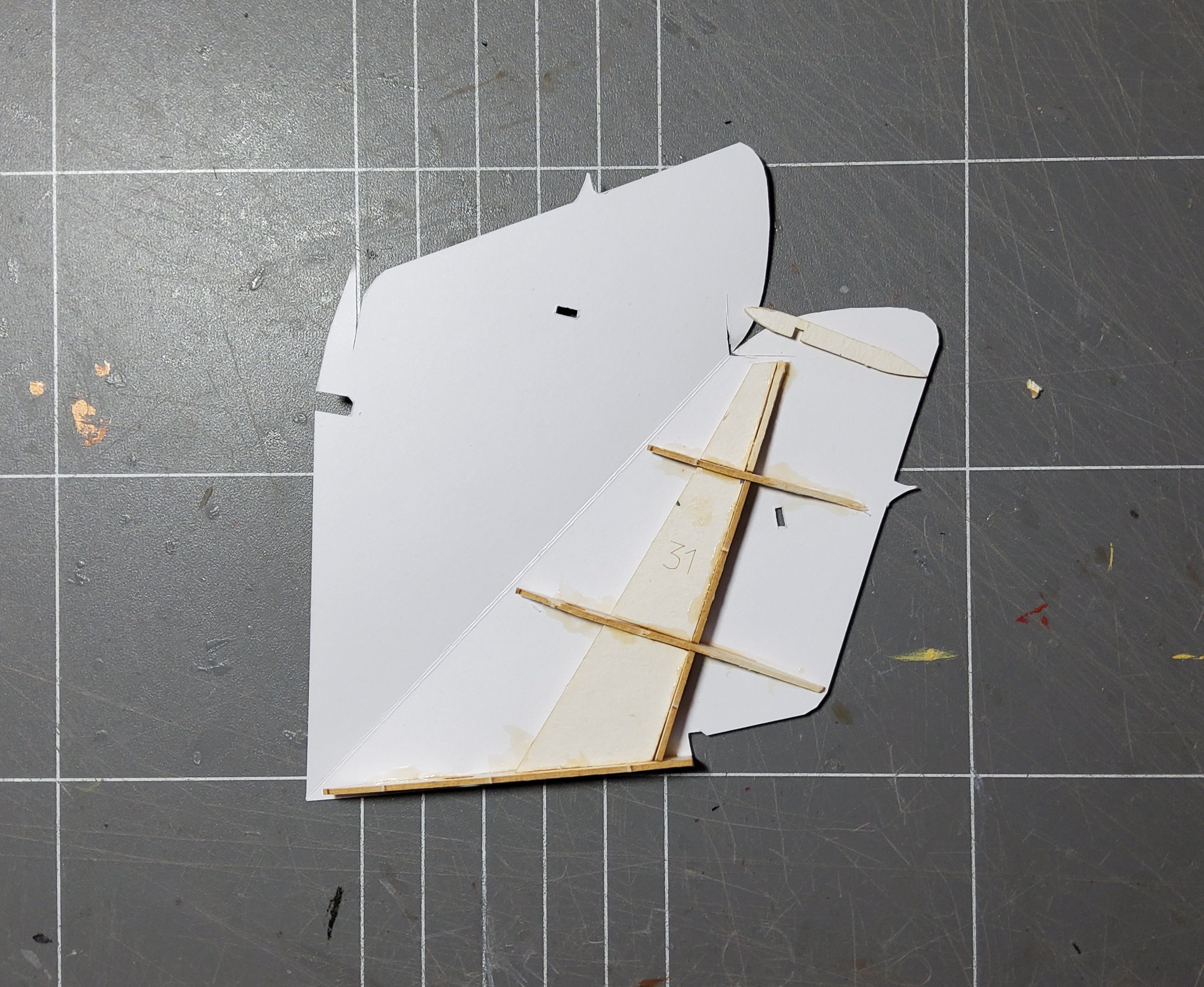

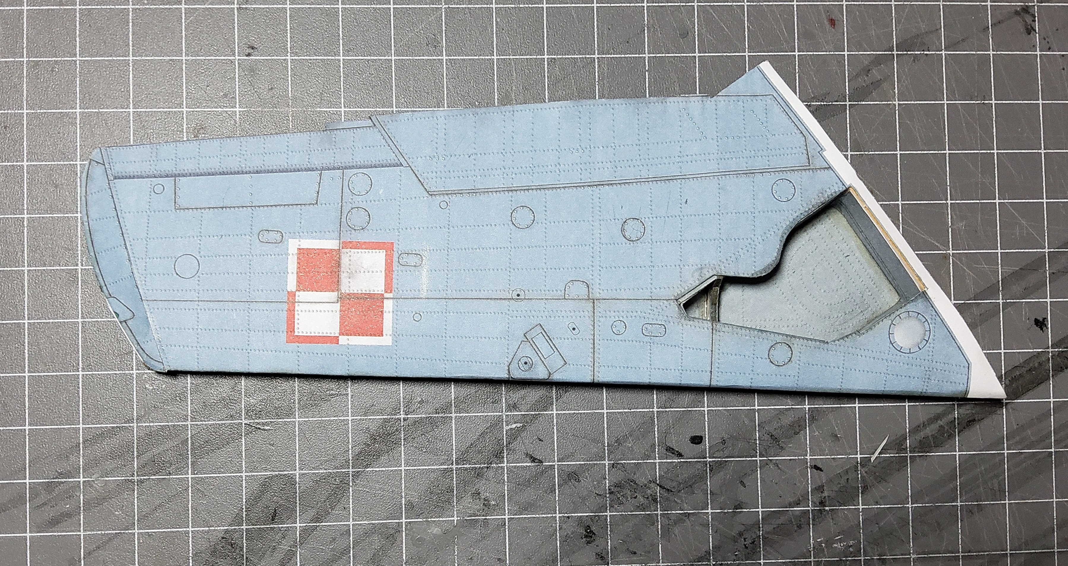

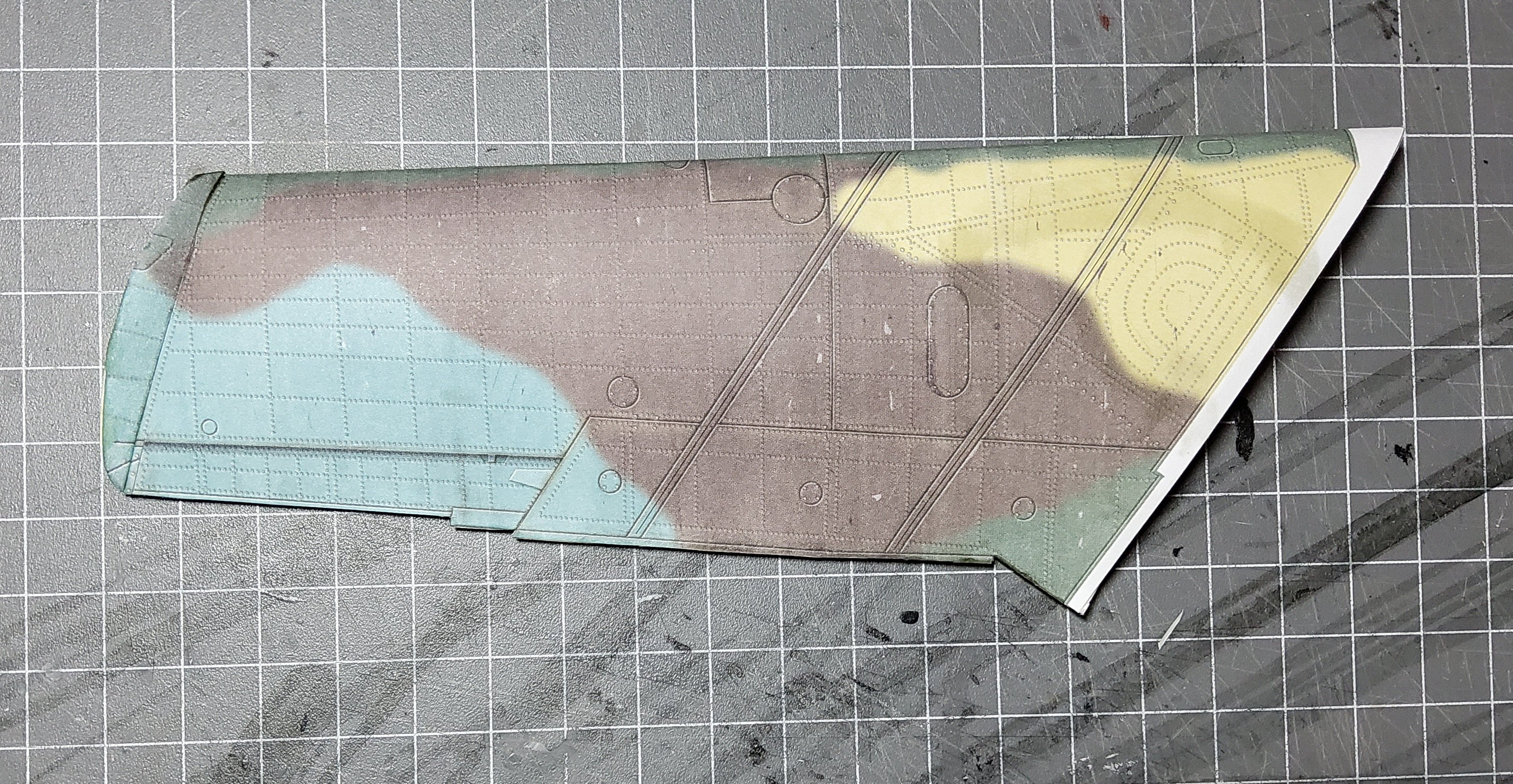

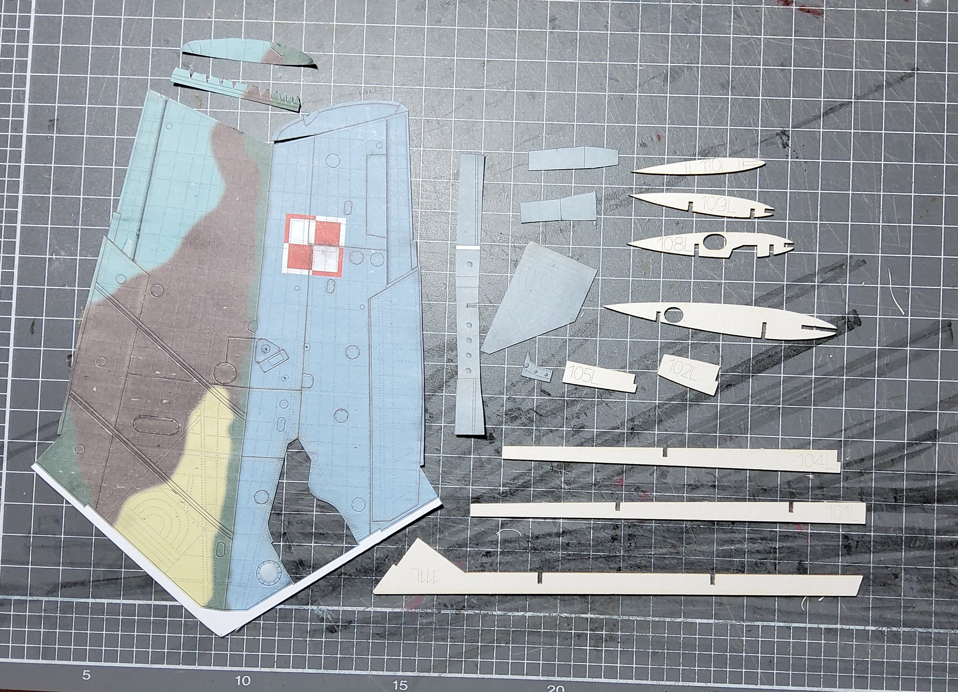

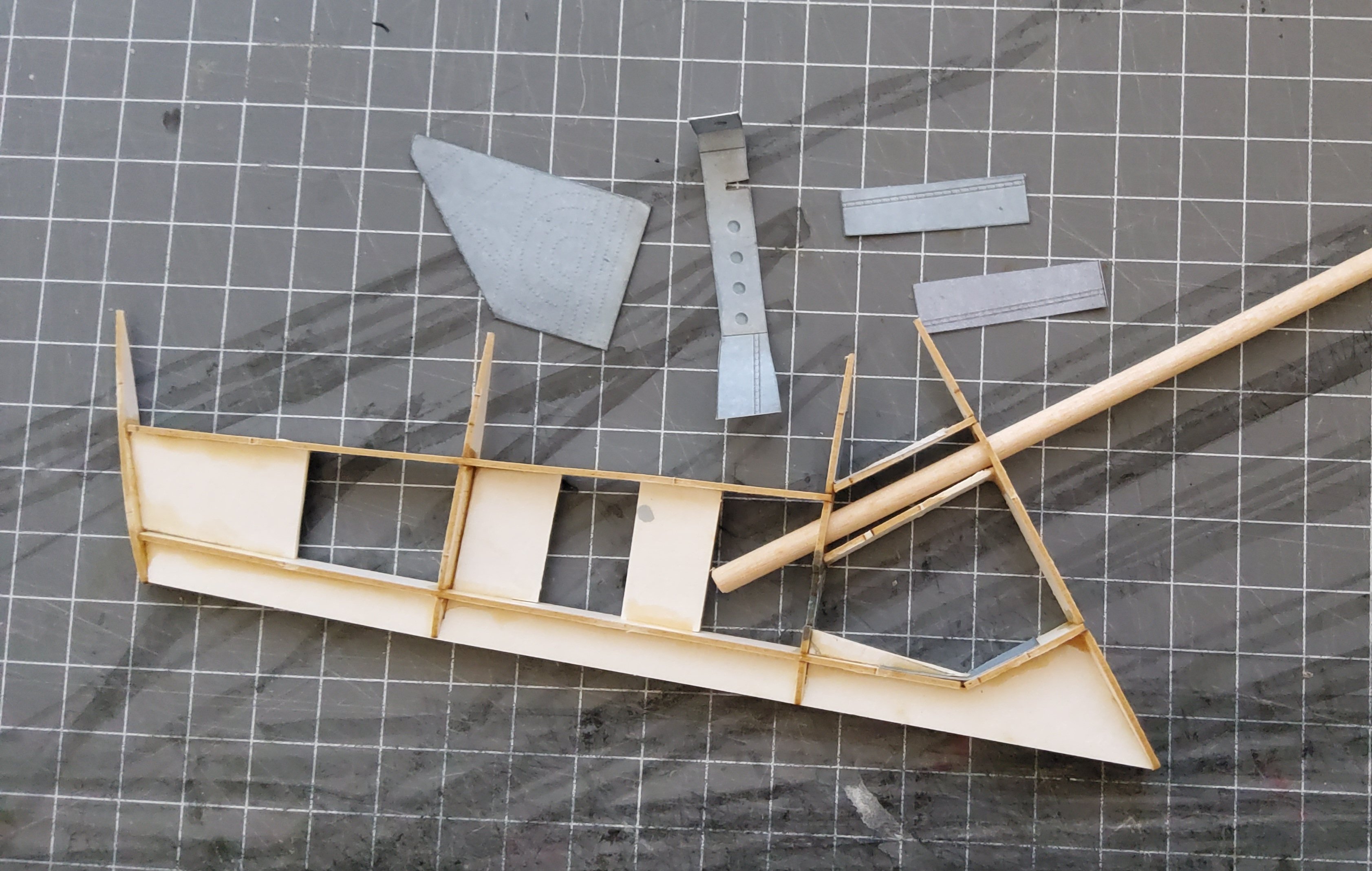

Time to tackle the wings.

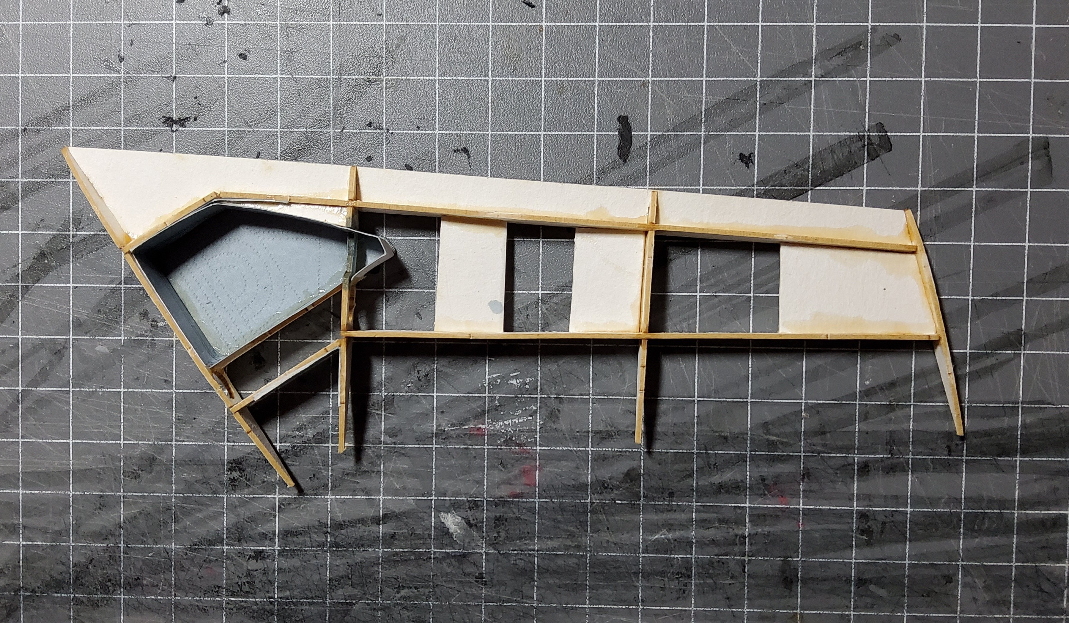

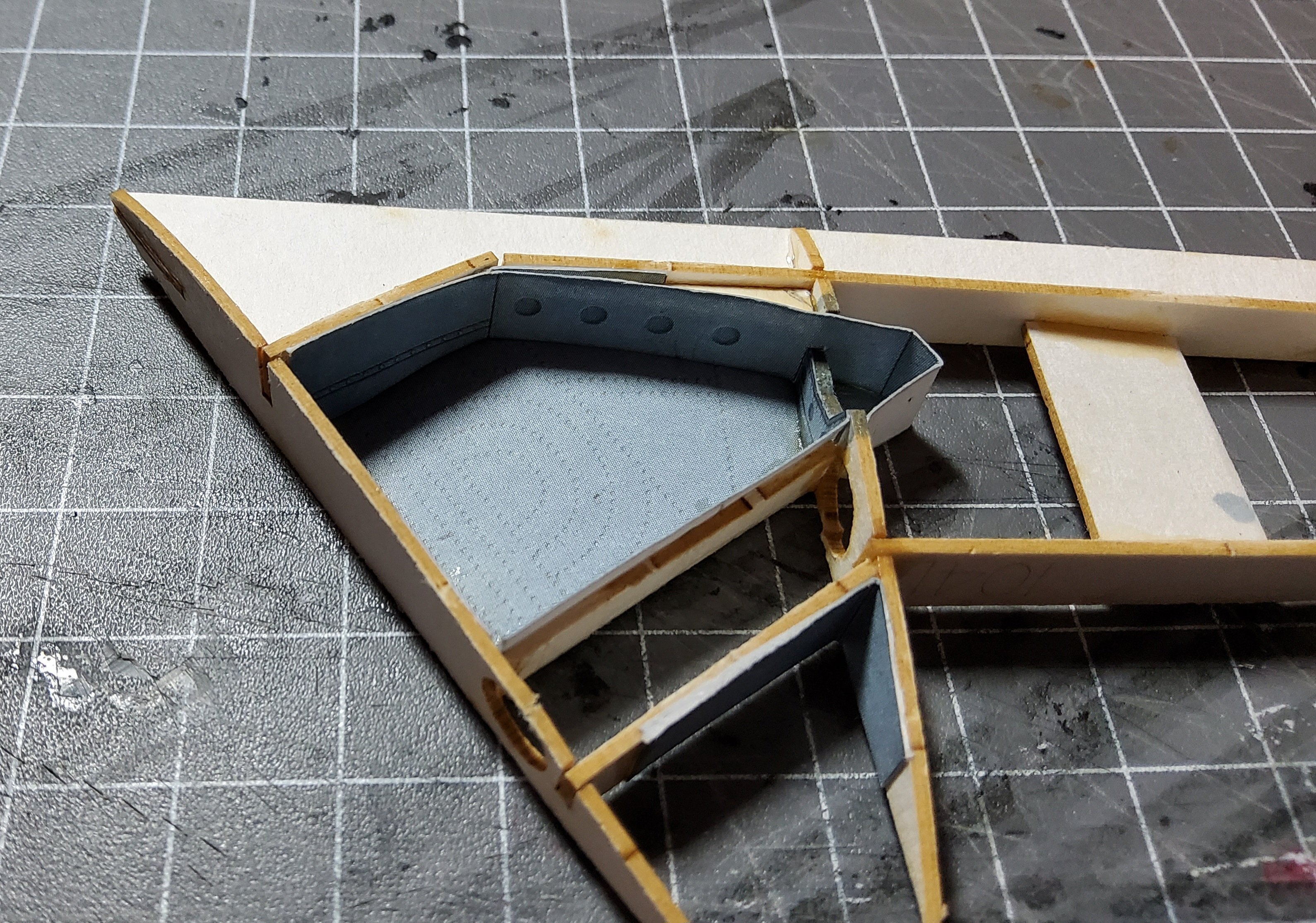

These have an internal structure made from either laser-cut material (which I have) or diy laminated card, and a one-piece skin. There are also two options, full undercarriage with wheel wells or not. I've gone with the full undercarriage. The photo shows the parts, with the cutout for the wheel well visible.
There's no strength in the laser-cut material, and the assembled frame felt weaker than any I've made since my days with sticks-and-tissue planes way back. So I added some bracing. The wing joiner rod is also shown in the next photo, as are several pieces that will line the interior of the wheel well.
The completed wheel well. This was not easy, and the fit was not great. But it was finished.20250716_164145.thumb.jpg.11d6e673d31b5599d74c6c900c87ccdc.jpg

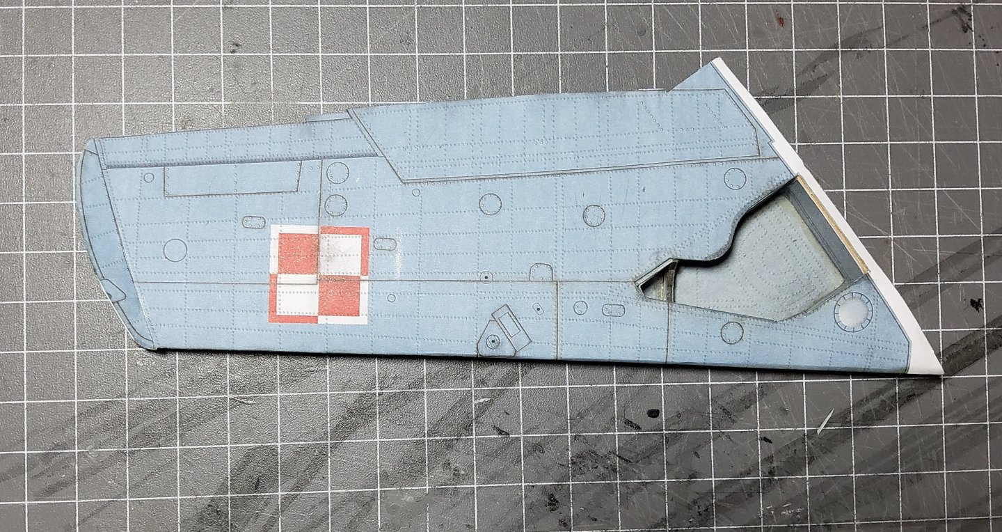

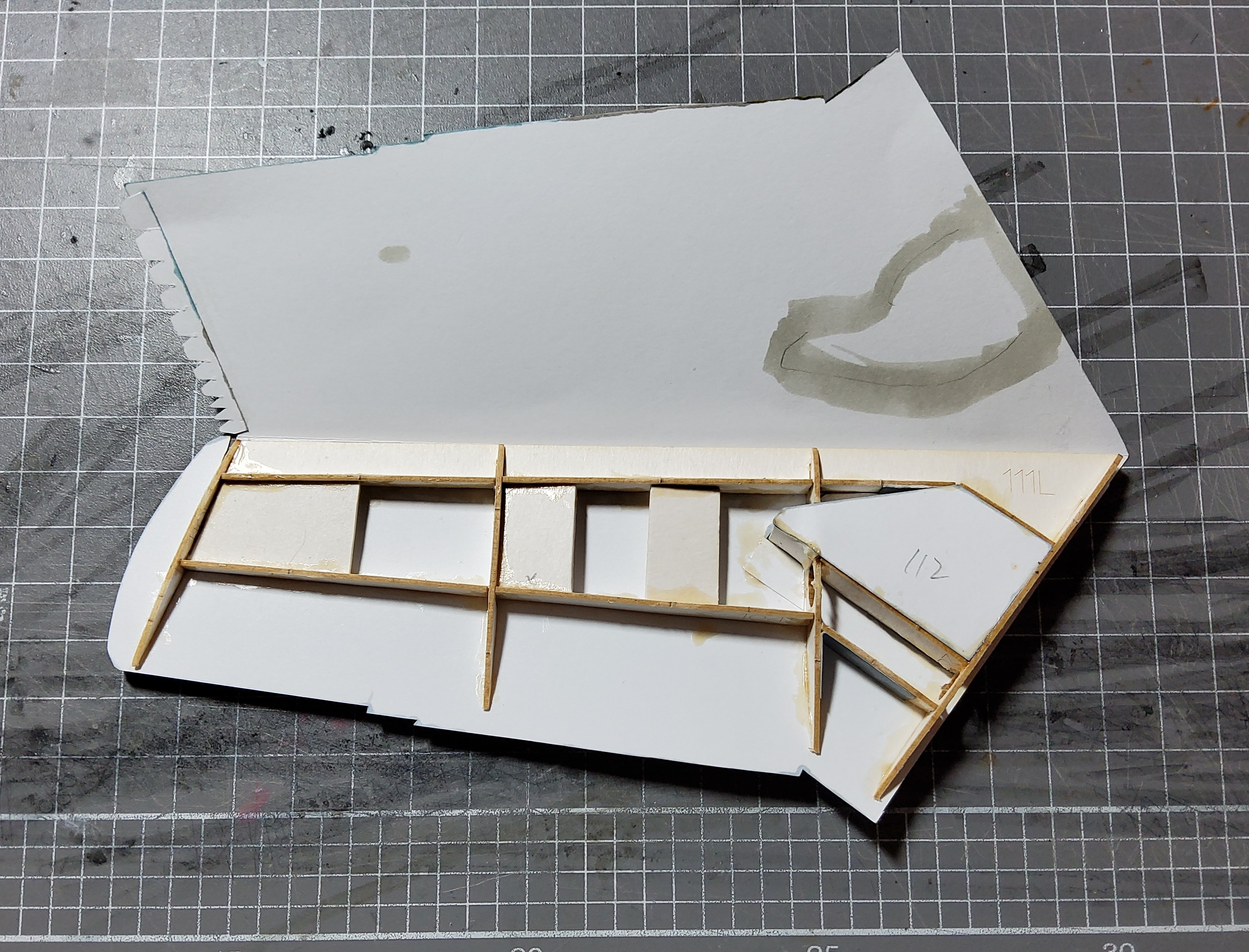

The next photo shows the frame glued to the lower part of the wing skin. Getting this in place accurately was a test of my patience. The power of certain words did help 😁 😁.  The well had to be aligned with the cutout in the skin underside as well as lining up with the trailing and leading edges. Can't use clamps to assist as these just collapse the card.
The completed wing (the other one should be easier, but no guarantee).

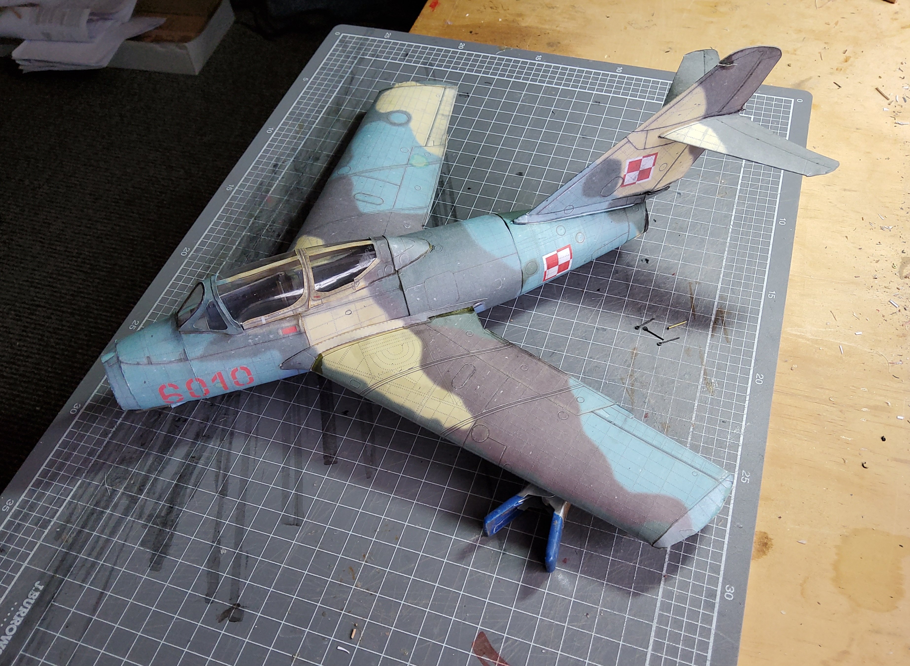

The second wing was completed without much trouble. The two wings were mated to the fuselage, though this was not quite so simple. As I mentioned before, I'd squeezed the fuselage somewhat so the place where the wings had to go was not as even as it should have been. A little surgery at the wing roots proved to be sufficient. The wing fillets then covered the slight gaps that remained. A dowel joiner assisted this.
The tailplane was quite easy and was glued in place without any trouble. The two halves were joined with a laser-cut spar.20250804_103617.thumb.jpg.eb3c2b286e856678365569bb749597dd.jpg
Next, the undercarriage - should be fun 😁.
