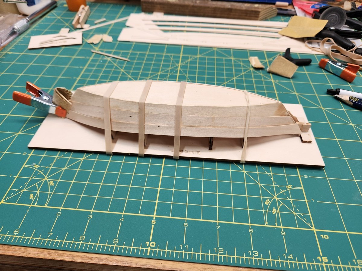

I've got a few issues,...my stern knee and transom have some misalignment. I used wood glue instead of white so I'm going with it. While I was experimenting with weights to put on the bottom of the boat one of my blocks fell over and broke the stem out...glued back and ended up using a hammer for a weight. Frames are in the build board with just a spot of to keep glue on the end to keep them stable. I also started adding the bevel to the garboard plank. I'll wrap my sandpaper around a popsicle stick or file for the final edge.

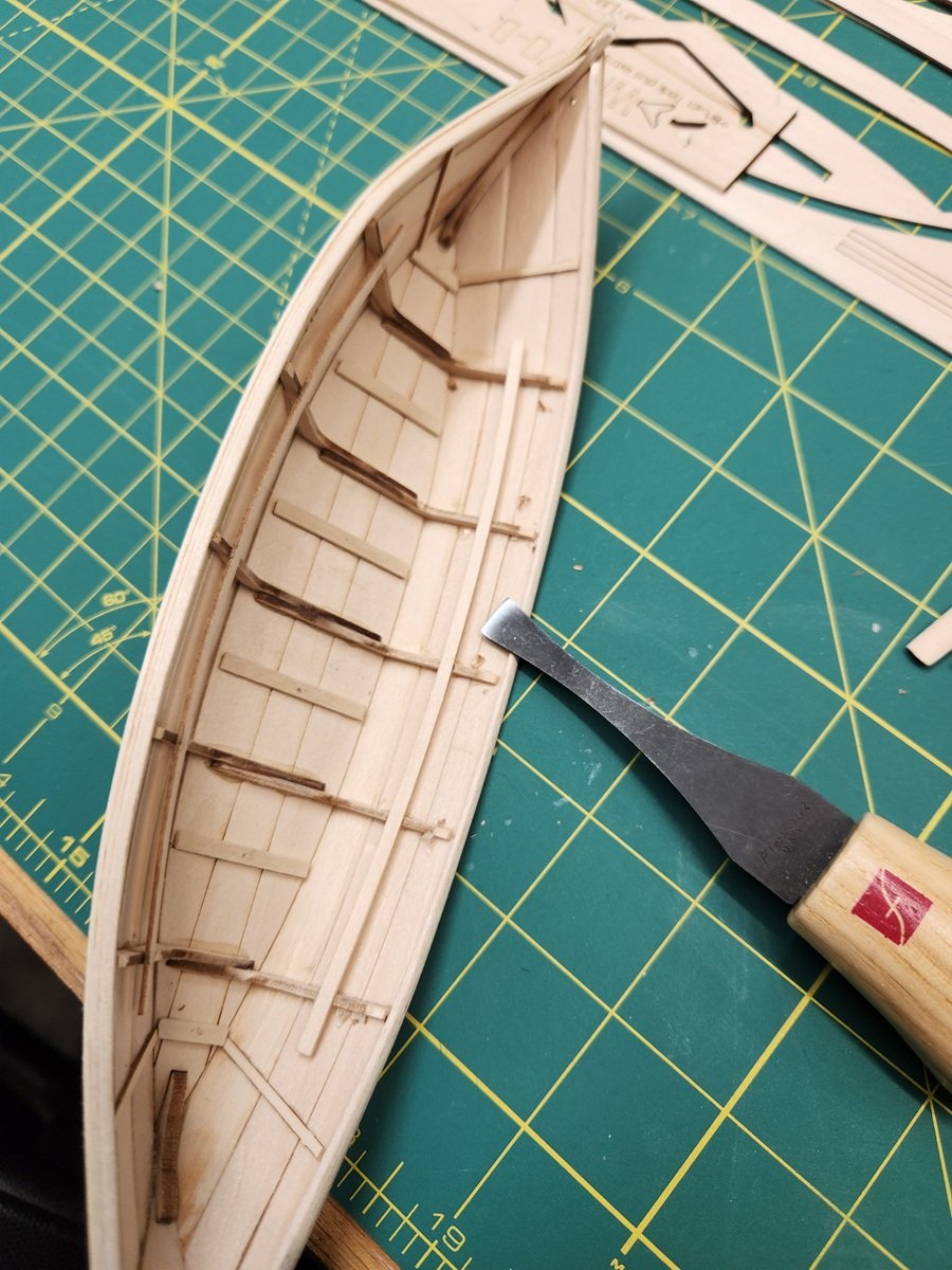

The frames should have riser heights marked on, though the marks too easily get sanded off. If yours are gone: Lay the thwarts in position across the boat, at the height that has those touch the inside of the planks. The risers should support the thwarts at that height.
If your risers end up a little low, you can sand the ends of the thwarts. If the risers are a little too high, very small gaps at the ends of the thwarts are not a problem.

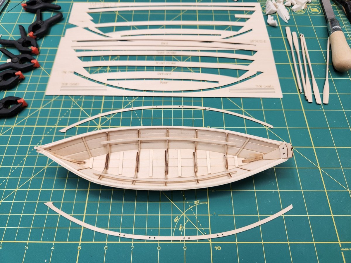

Been moving along here and there since cooler weather has set in and yard work has slowed down. Currently the gunwales are dampened and clamped. I'll do final sizing and glue next week. I've had a couple of misfires on the false stem but hopefully will get it lined out next week as well.

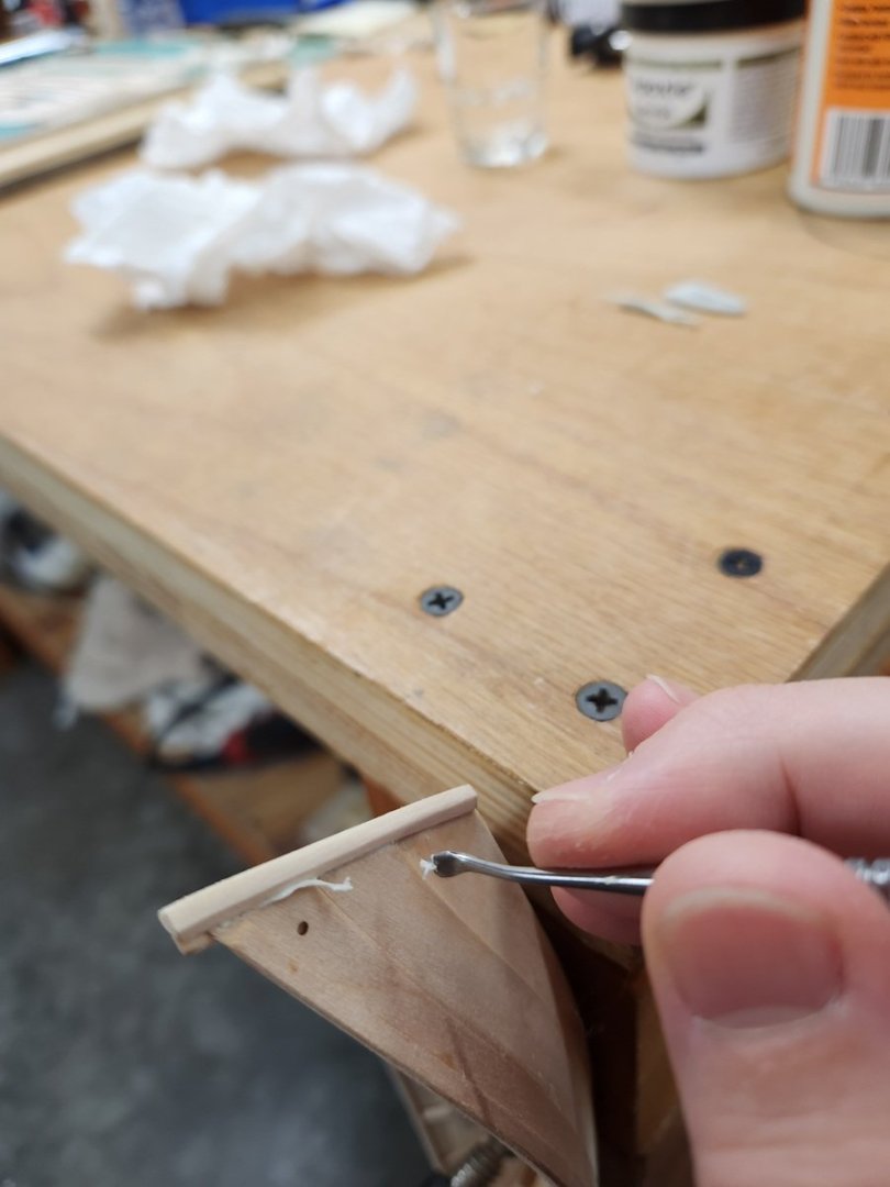

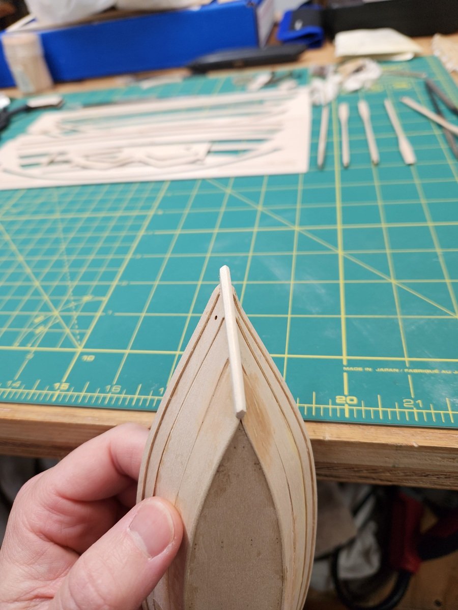

I'll do some final profiling before I call it good but I have me a false stem fashioned and attached. I used some apoxie sculpt to get a nice fit and also wood glue for securement.  I think its a bit bulky but I'll take it, My breast hook wasn't fitting great so I used the original for a pattern and just enlarged the size. I finished shaping it this evening.
Hi, Aaron, I see that you "simulated" the nails that are holding together the bottom, how did you do that? Are those just pencil marks, or something else? I don't think you mentioned it.
I'm preparing to start the dory build soon, and was also thinking about such enhancements.
Those marks were already there, at least on my model. Good luck with your build.

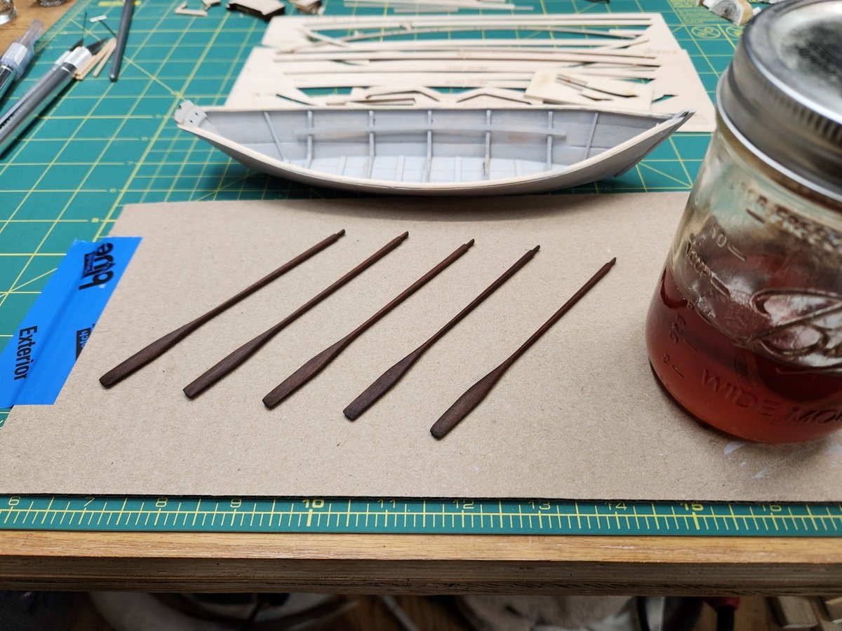

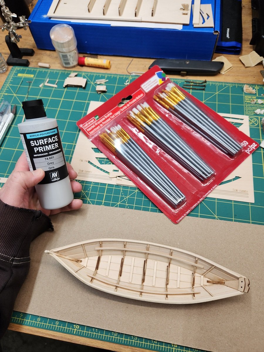

While I had some staining going this evening on other projects I hit my oars for some color. I had rounded out the handle end a little yesterday with a needle file for final shaping. Topped them off with some home brew finish.  Don't have a definite plan yet on color but leaning heavy toward an off white with grey trim for my paint. I'll be using oils.
I received that Peterboro canoe from Santa per my request thats posted in the "what did you receive today" thread. I'm excited about that build but sticking to my plan. Given the mistakes I've made on this build I ordered the 1:12 Dory today. It will be my next ship model and I also plan to work in some different materials on the build. Looking forward to that aspect as well.
