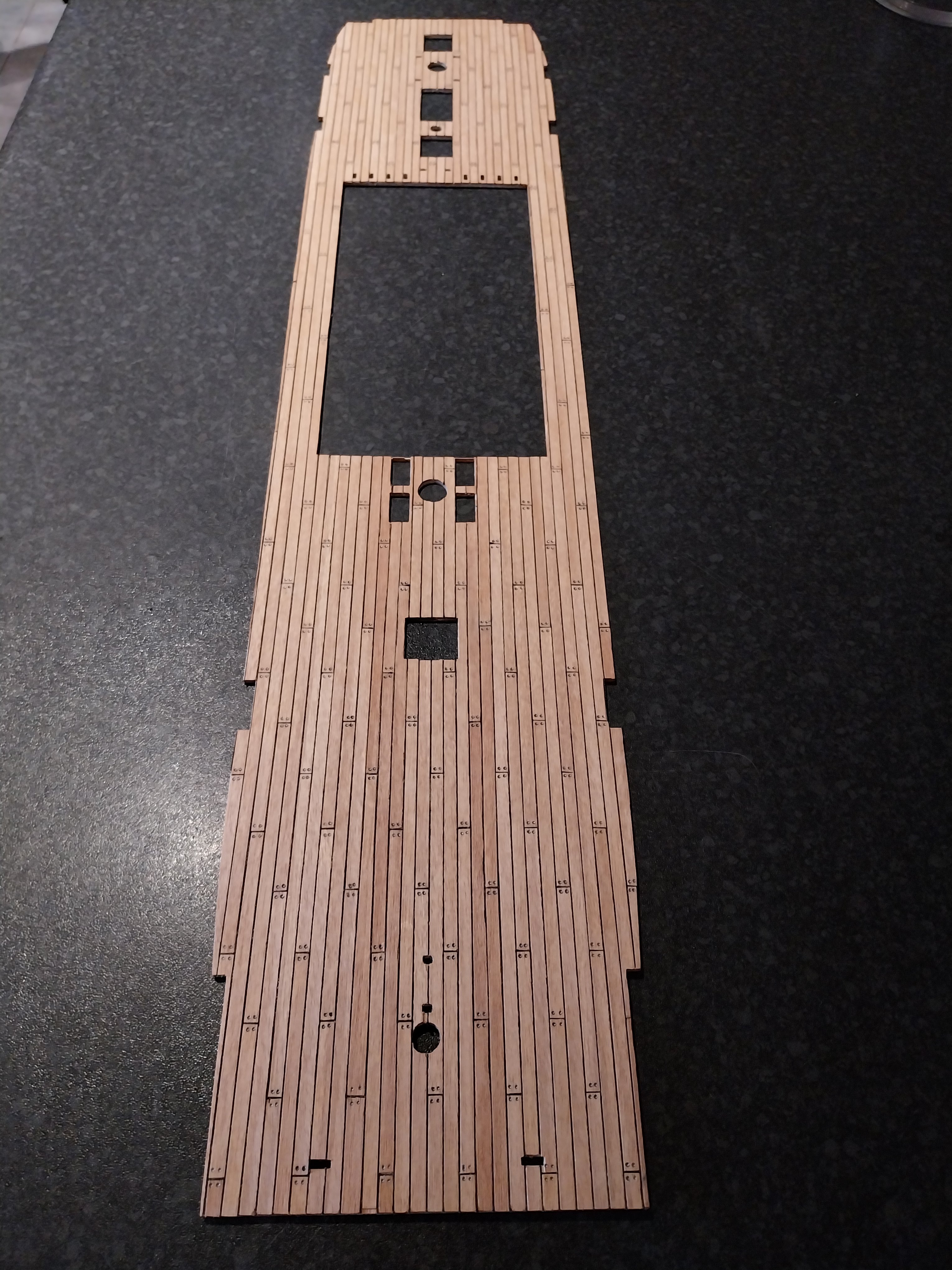

Next I added the Upper Gun Deck and then using the 4 Butt system, began Deck Planking of the Upper Gun Deck, using 10cm length Strips (Approximately 20 ft) where I used black bonded Nylon 40s thread between the planks as caulking

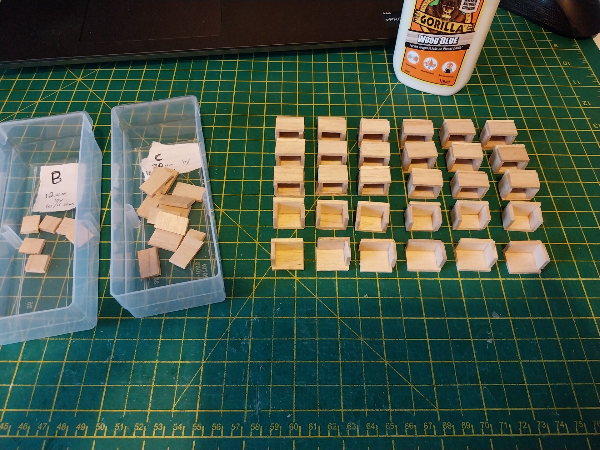

Although I've started to assemble the Gun Carriages, this task is not yet complete, which about brings me up to date of where I currently am with my build.

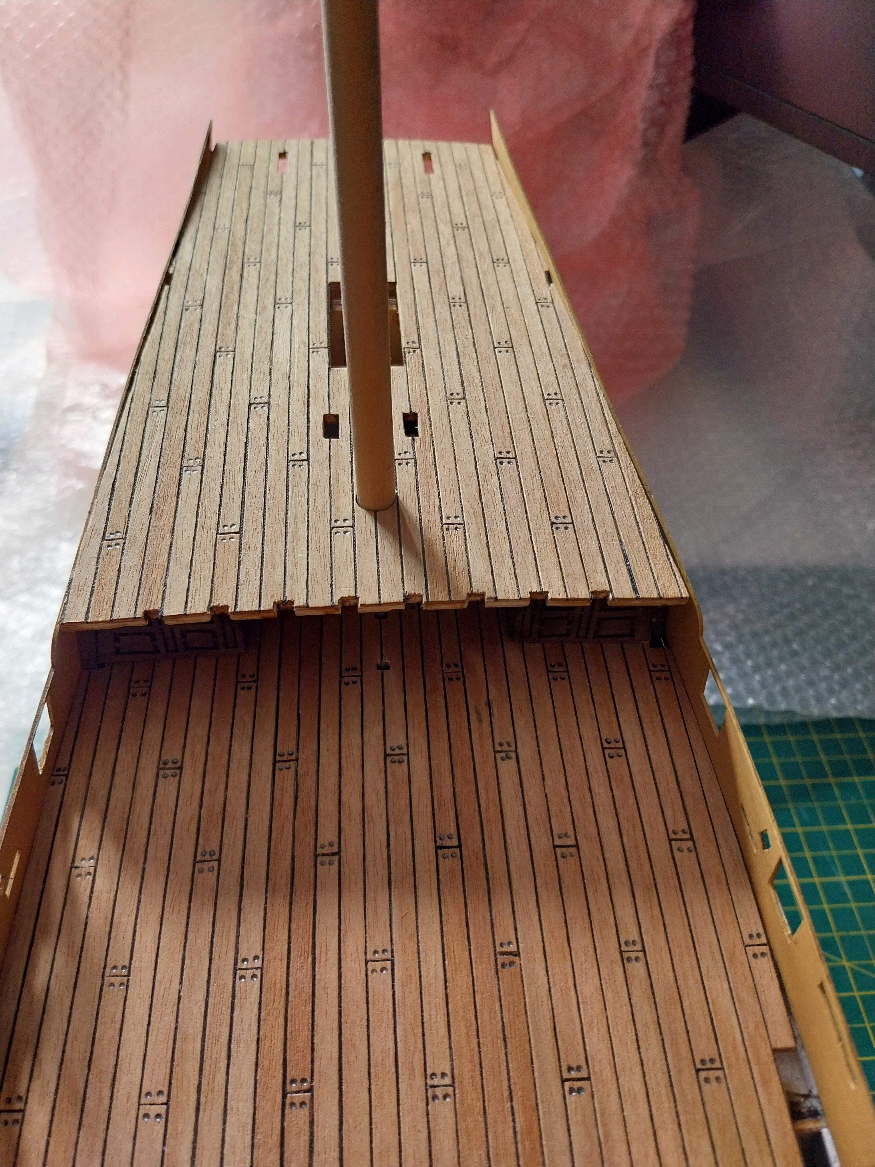

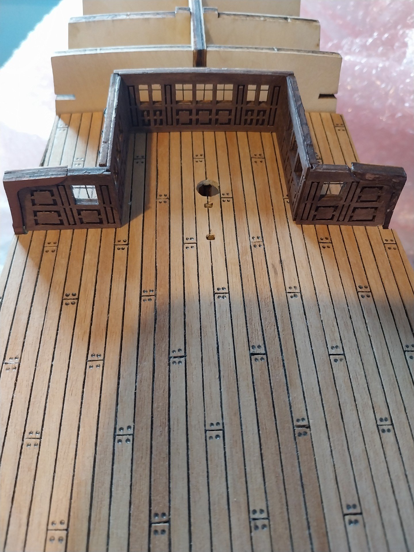

So I've now Planked the poop deck before fitting it, and tried out a new technique, one I am much happier with.   With the Upper Gun Deck I used thread as caulking, and used lengths that crossed over the width of the deck, where in the 4 Butt system I used, for every 5 adjacent planks, x4 went over the thread, this caused a bumpy and frankly not very smart looking deck.  Therefore For the Quarter Deck and Poop Deck which would be much more visible, I will be using thread as caulking lengthways, but I will cut out 4mm lengths and add to each plank end. As you can see by the images, much smarter, and much more pleasing to eye

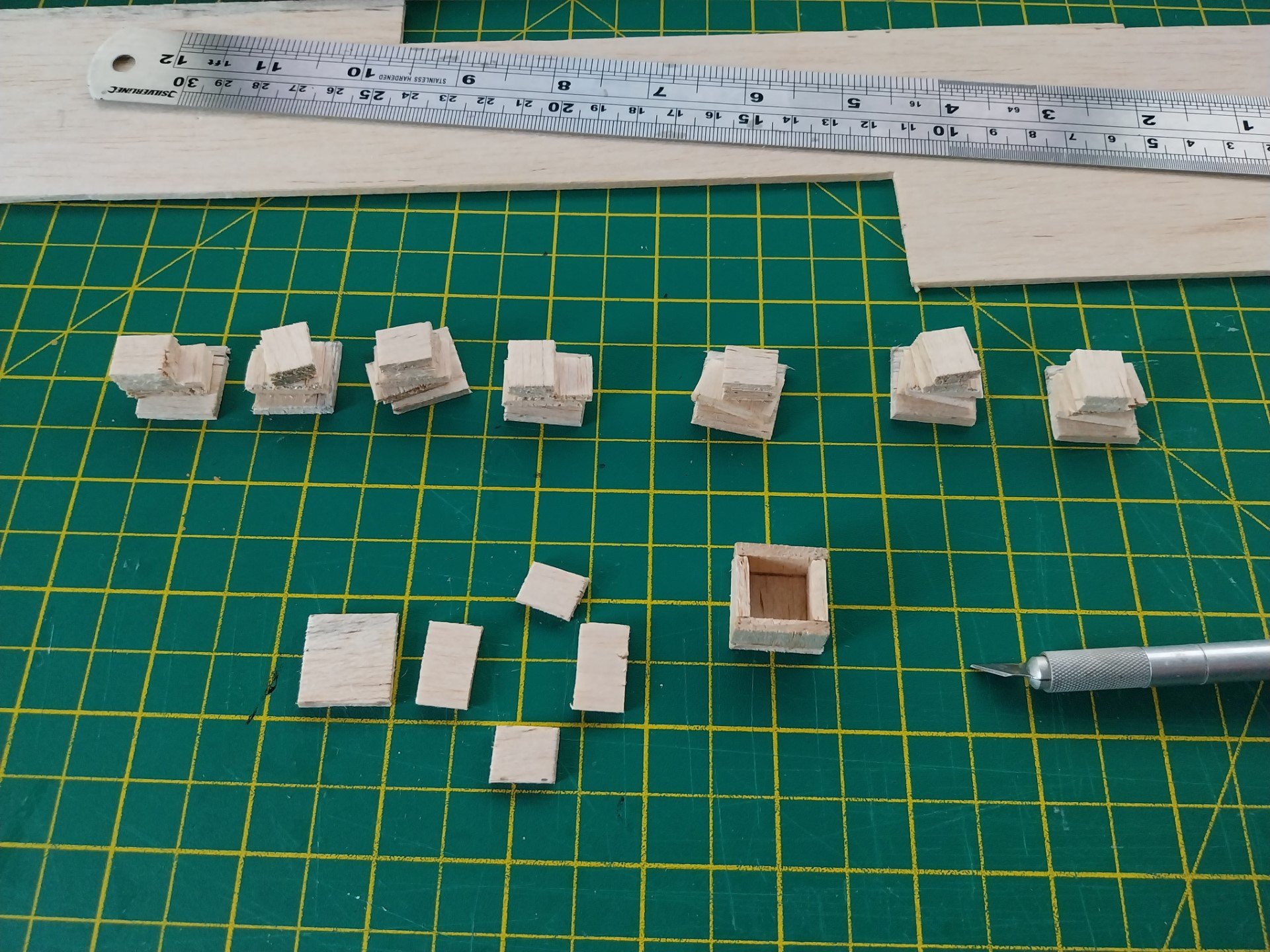

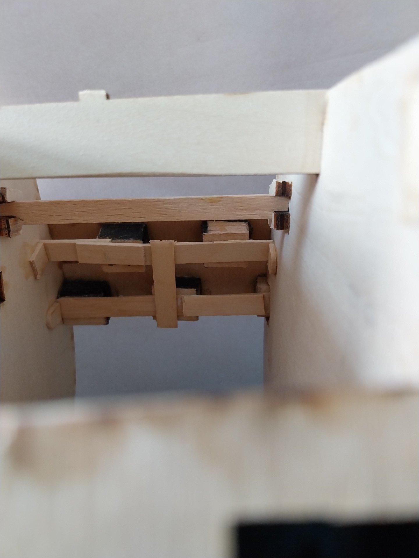

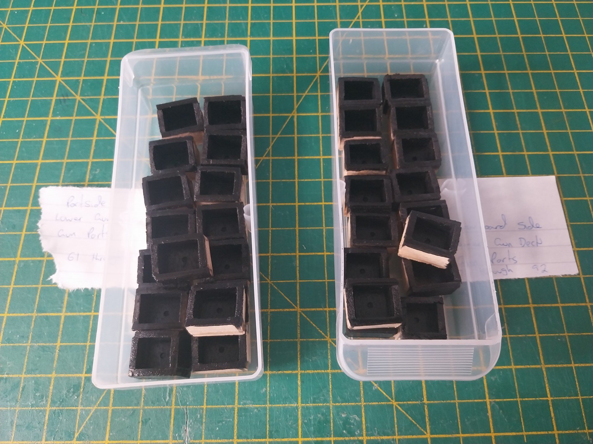

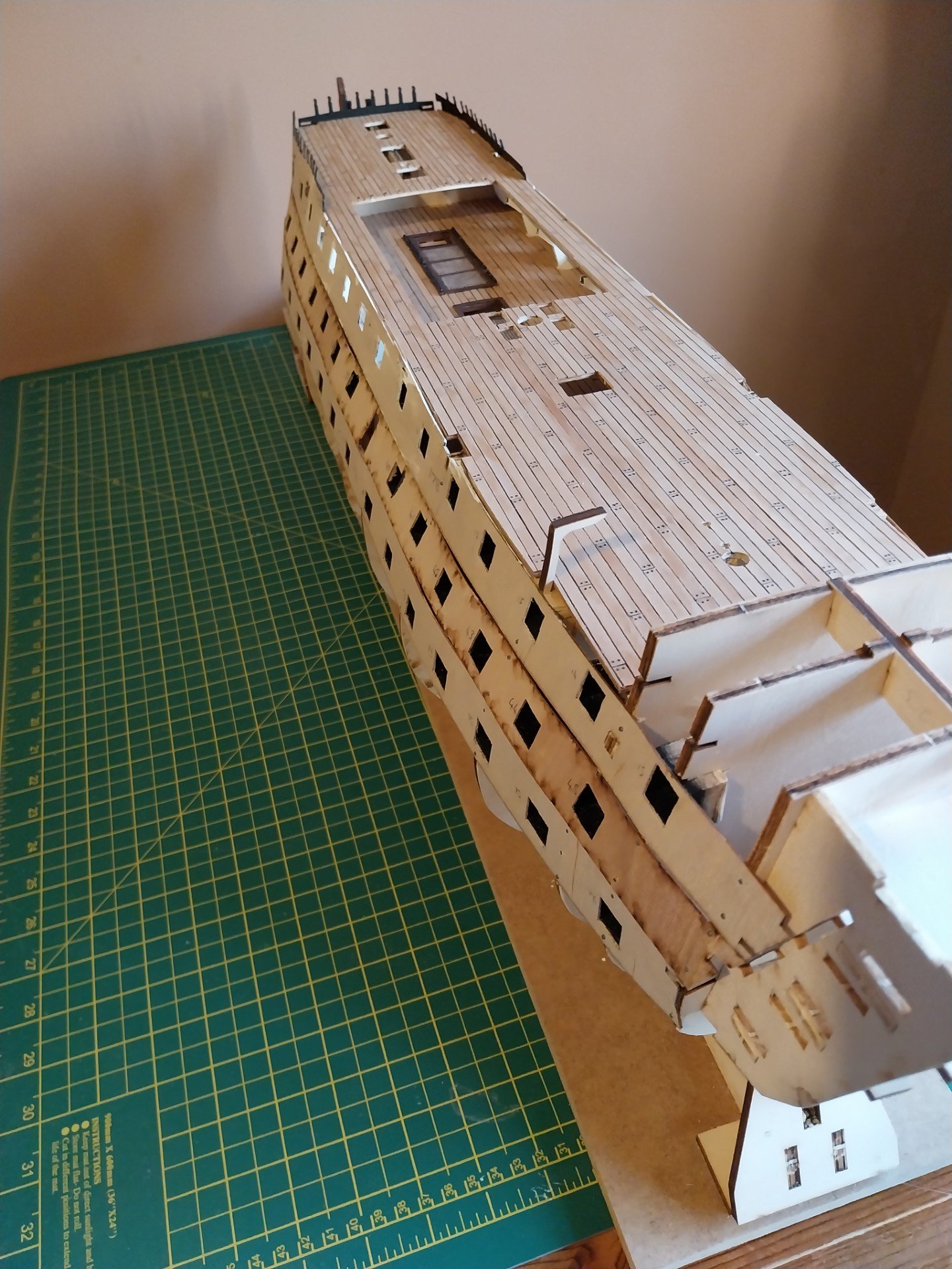

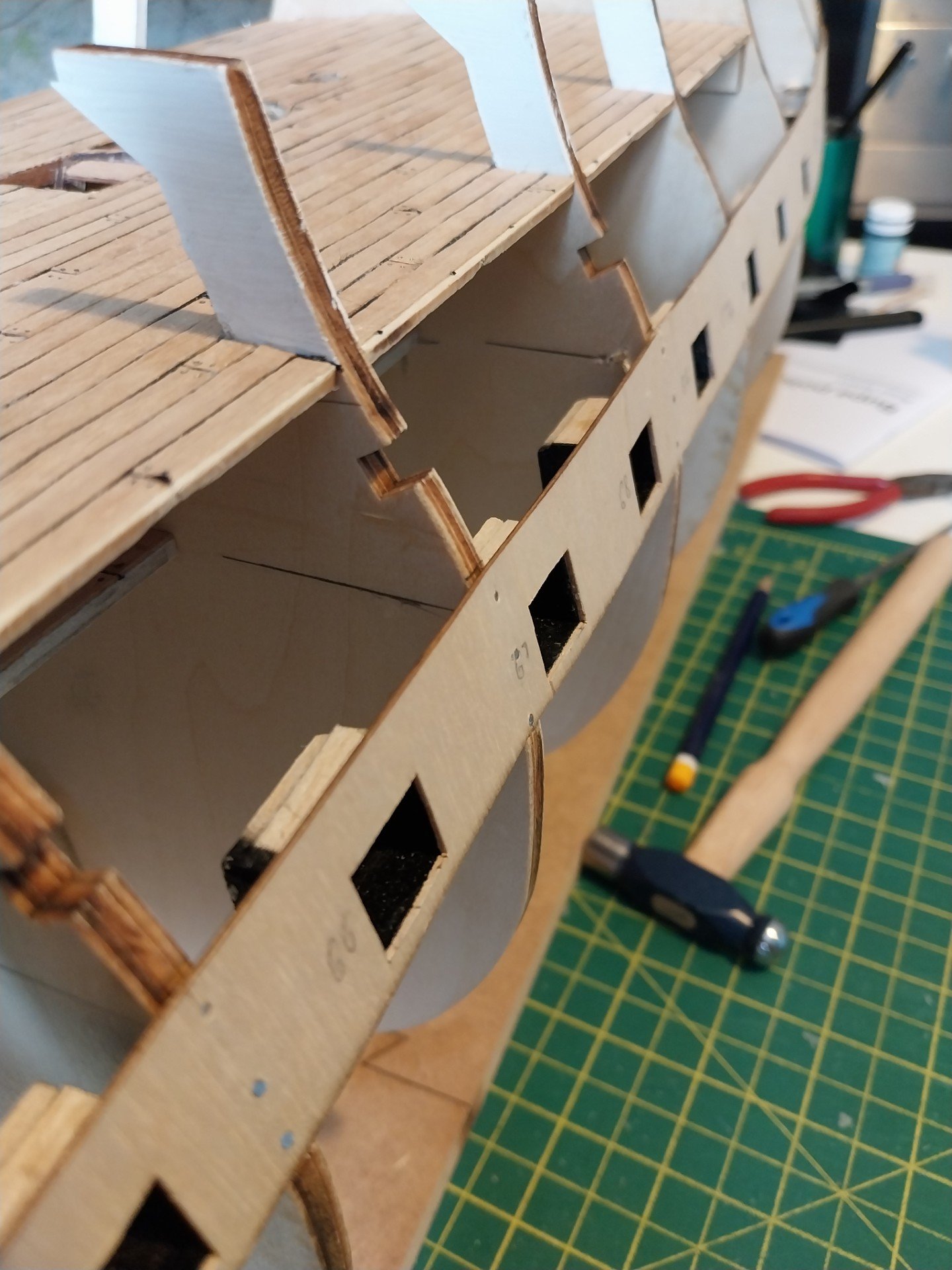

I've planked and fitted the Quarter Deck and then, inspired by Shihawk's build, I too decided to go with sunken gun ports. I was a little nervous about these coming off when applying the cannons, so opted for a lot of additional bracing.  I also attached the Side Planking strips.
50 Attached Quarter Deck, upper Gun Deck side planking strips and Forward Bukhead A.jpg
Edited by Sparkov

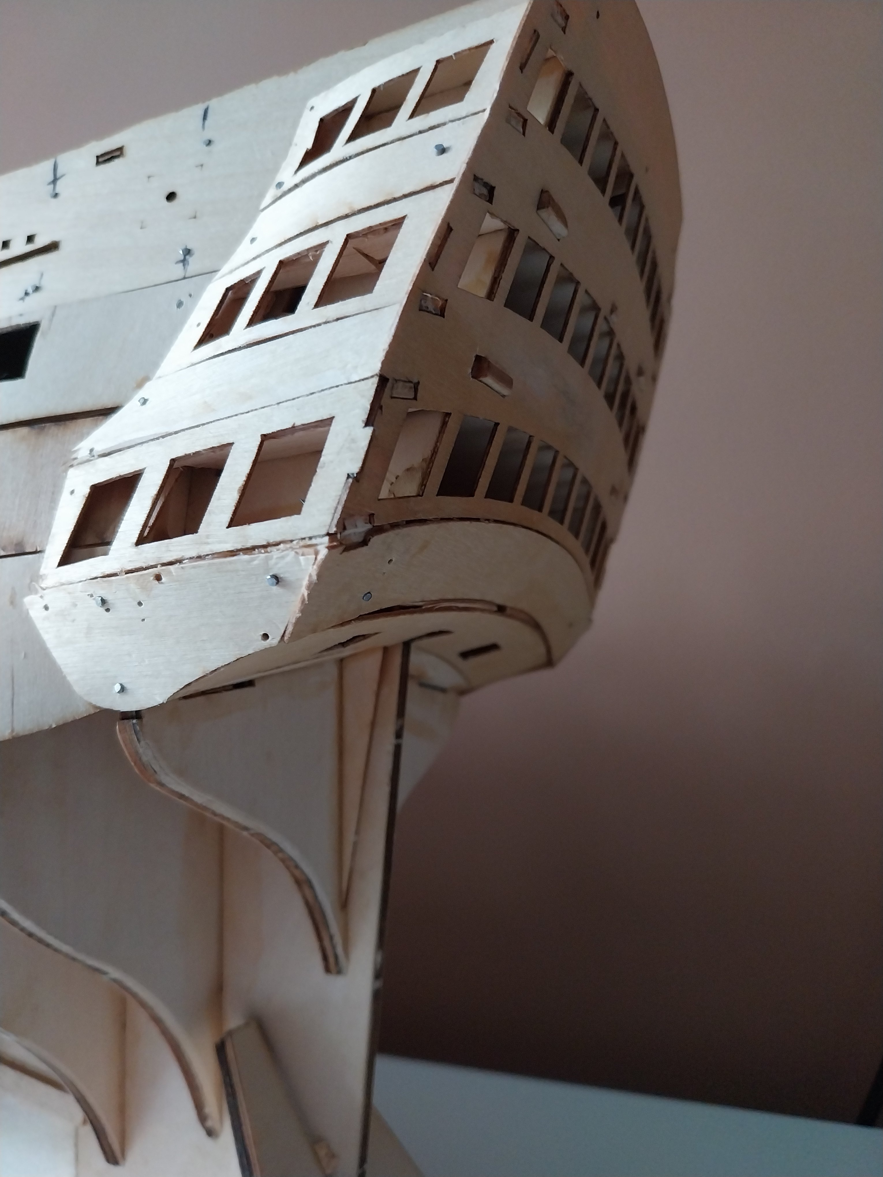

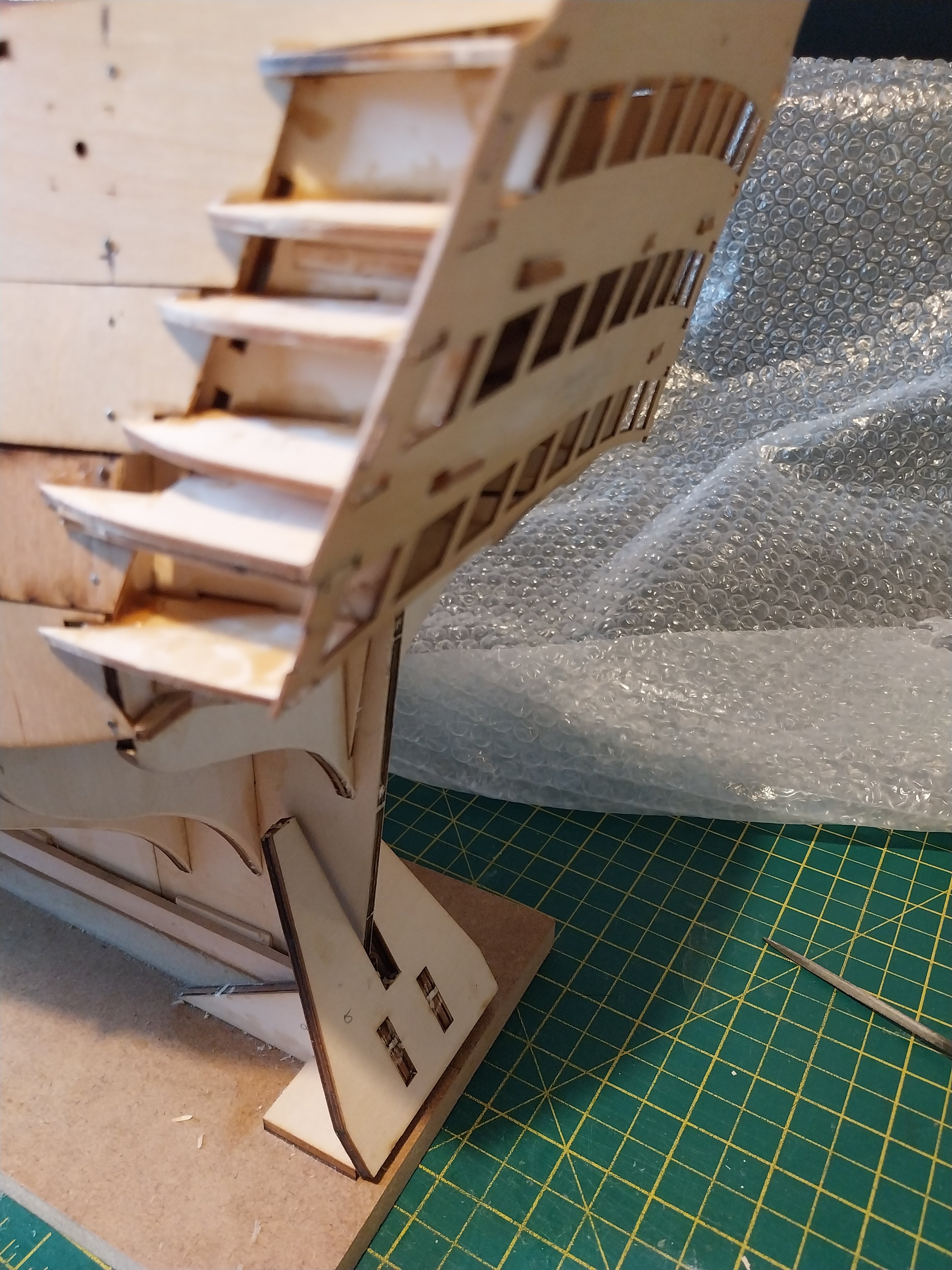

In the last 4 months, I have also attached the Cabin Bulkheads, Poop Deck and the stern Gallery and all manor of small odds and sods jobs while I build myself up to Planking.

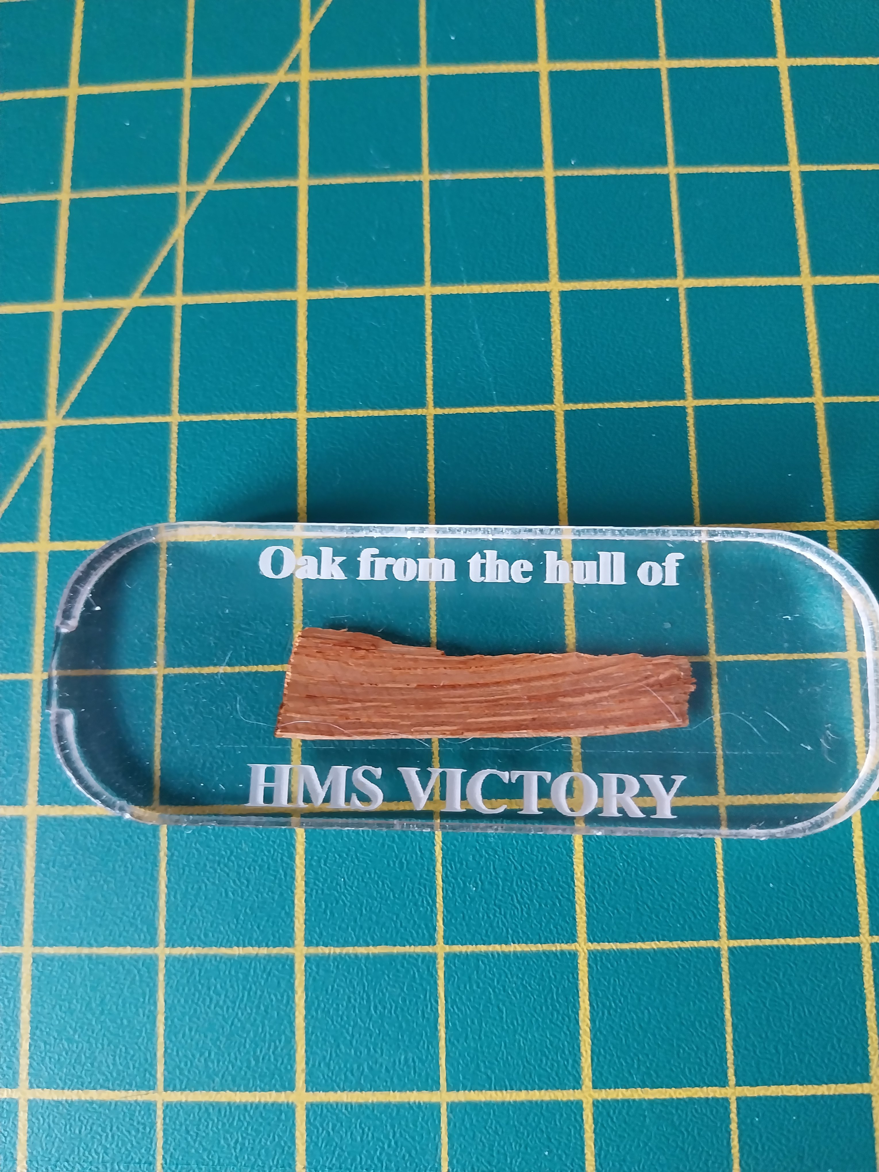

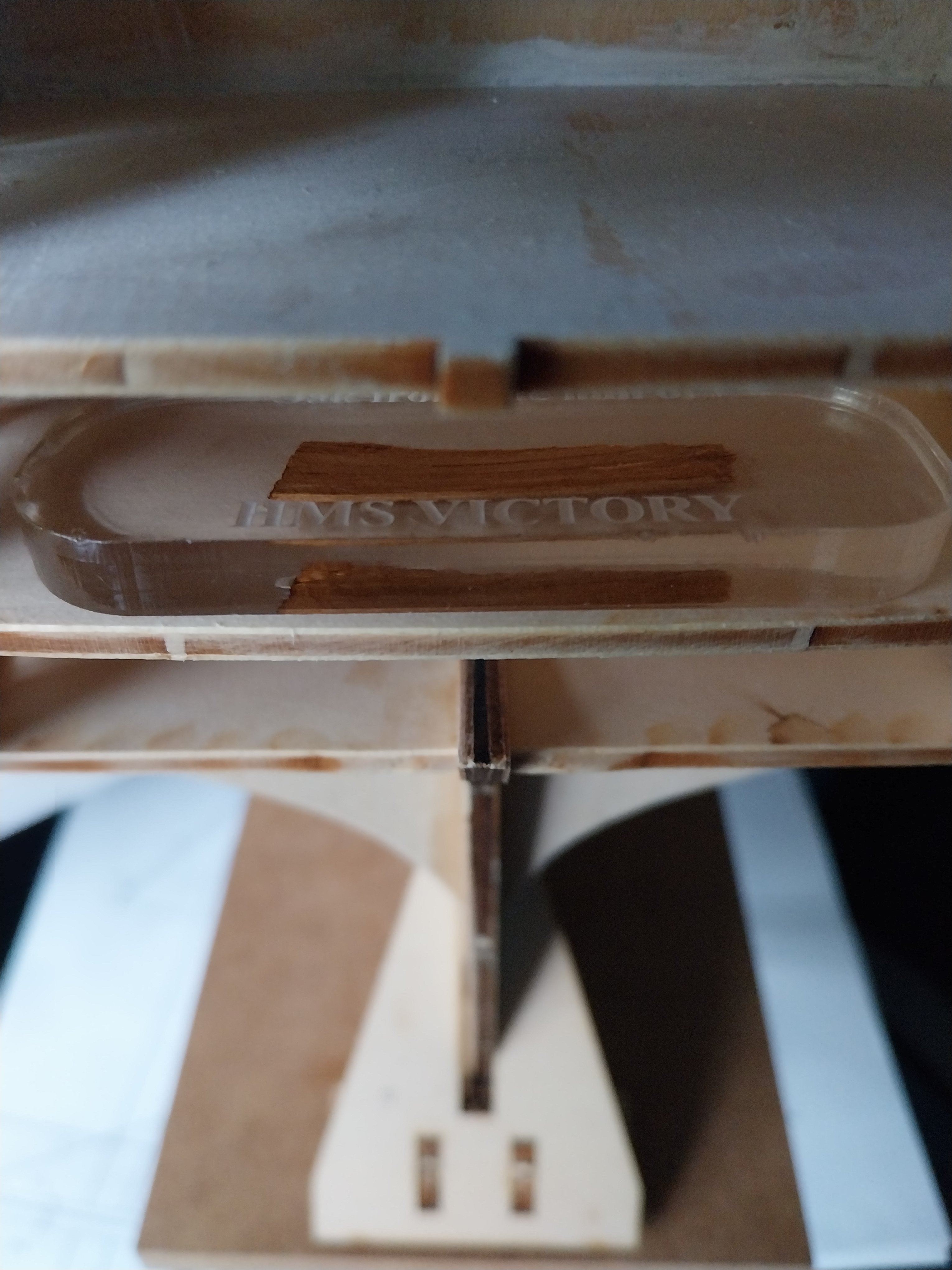

I have some original Oak from the real HMS Victory in the form of a Key ring from the history Portsmouth Dockyard gift ship, which I wanted to include in my model if Victory, as homage. I added this to Great Cabin.
