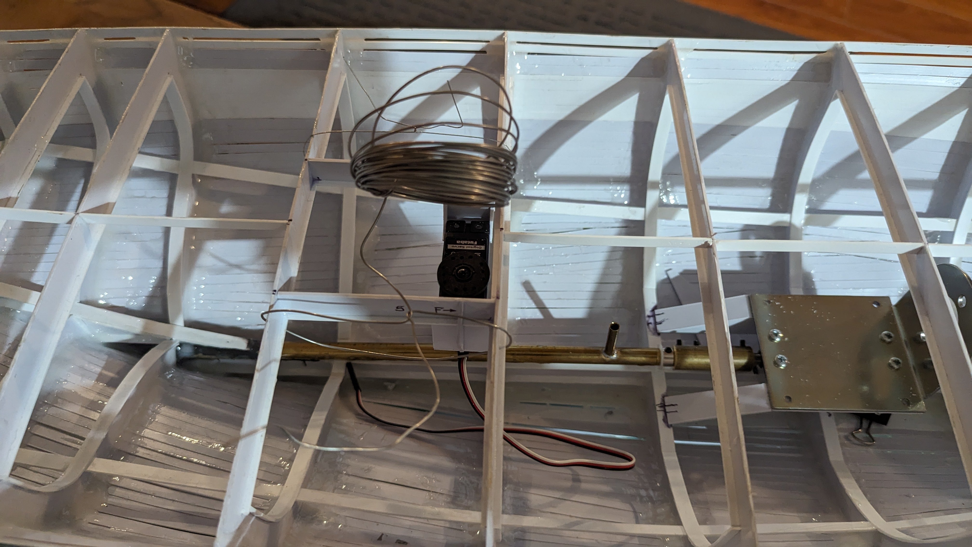

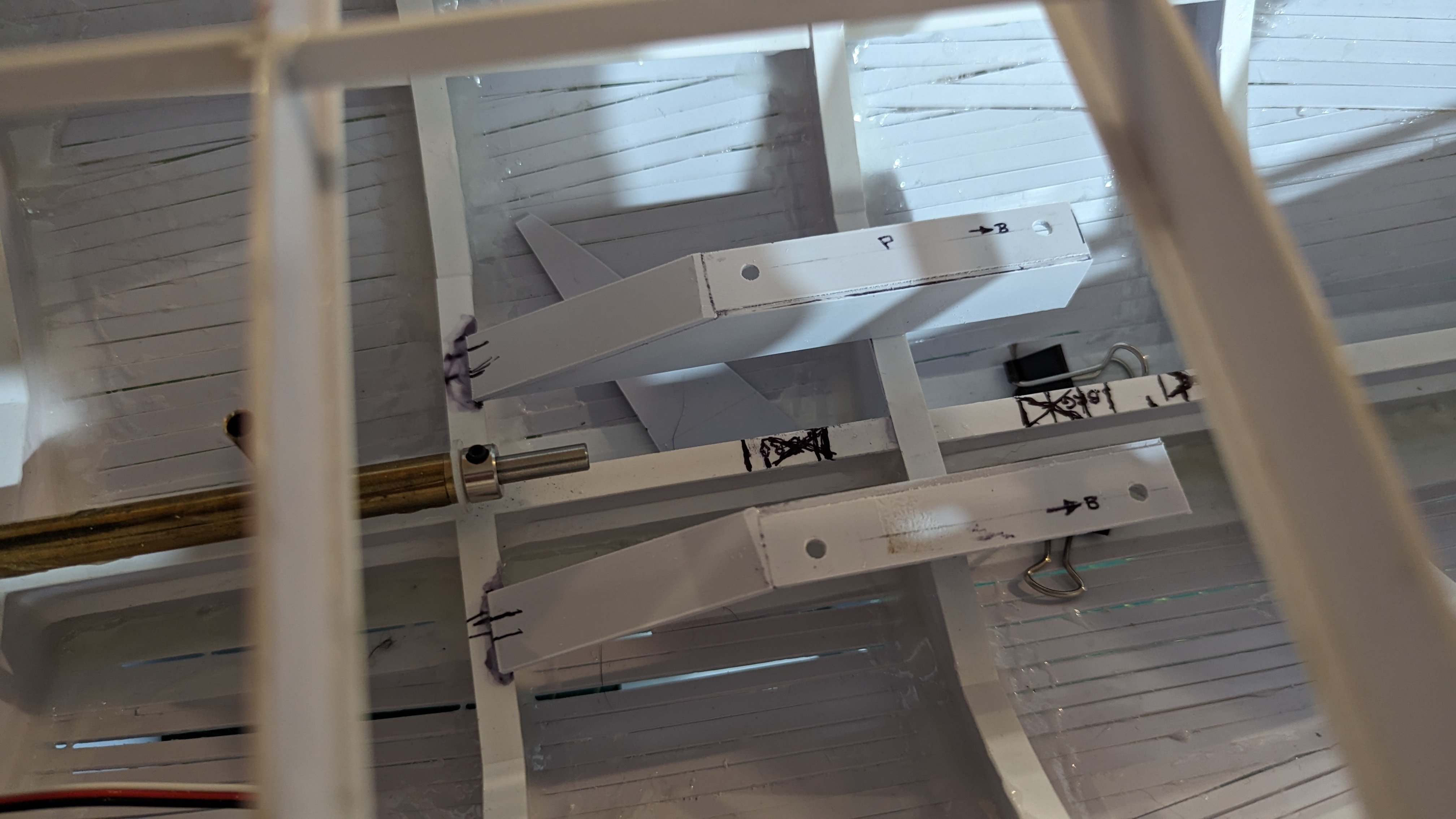

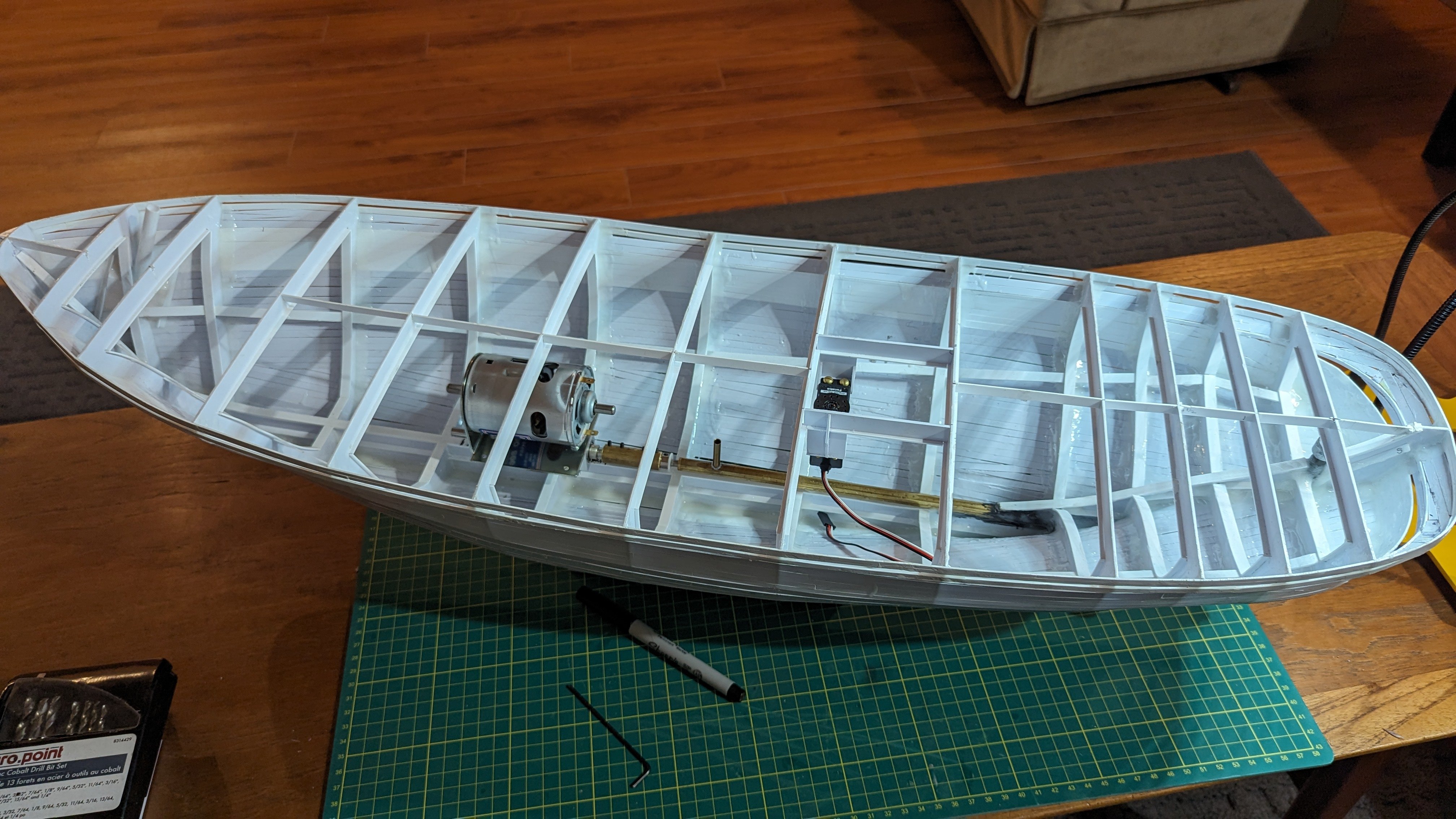

It's time that I update this thread and carry on where I left off some time ago. Currently the project is in a bit of a holding pattern, while still on the books it had to take a back seat to my logging truck rebuild, work and a few other things requiring my time; not a lot has happened in the last 14 months. However prior to this hiatus the project did see its first water test, one which turned out much better than anticipated.

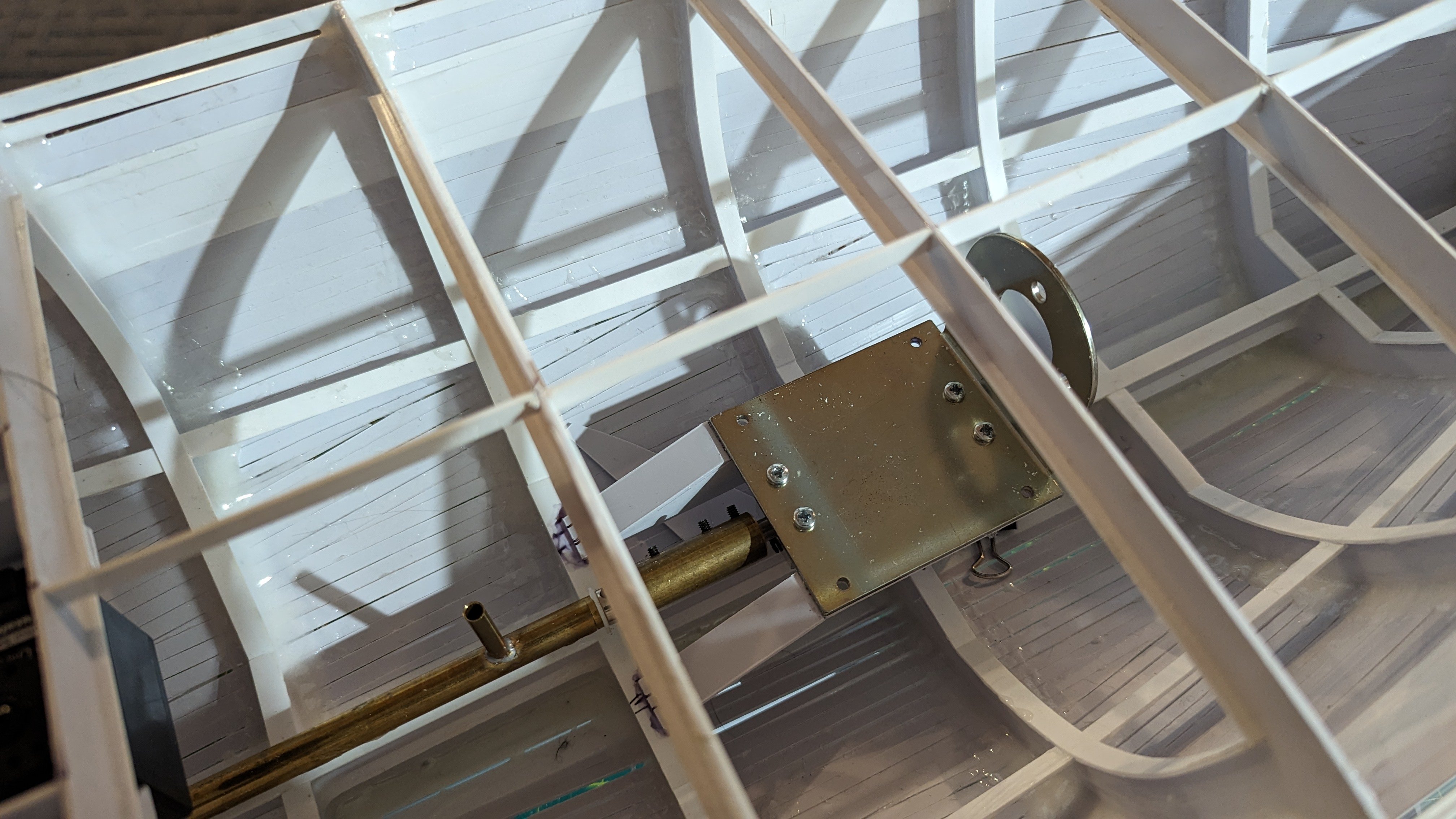

To carry on from my last post work was done to mount the motor and steering gear inside the hull:

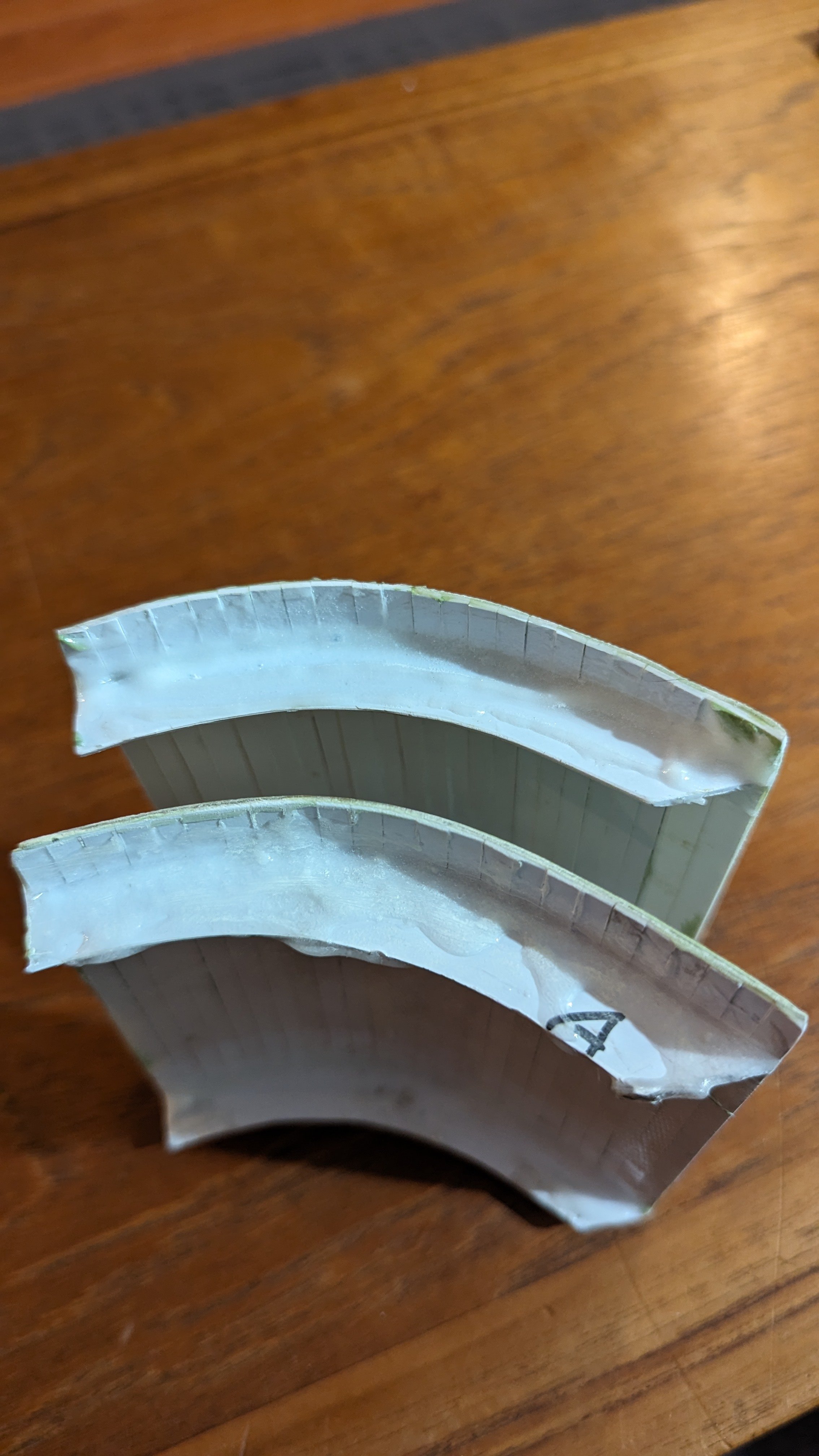

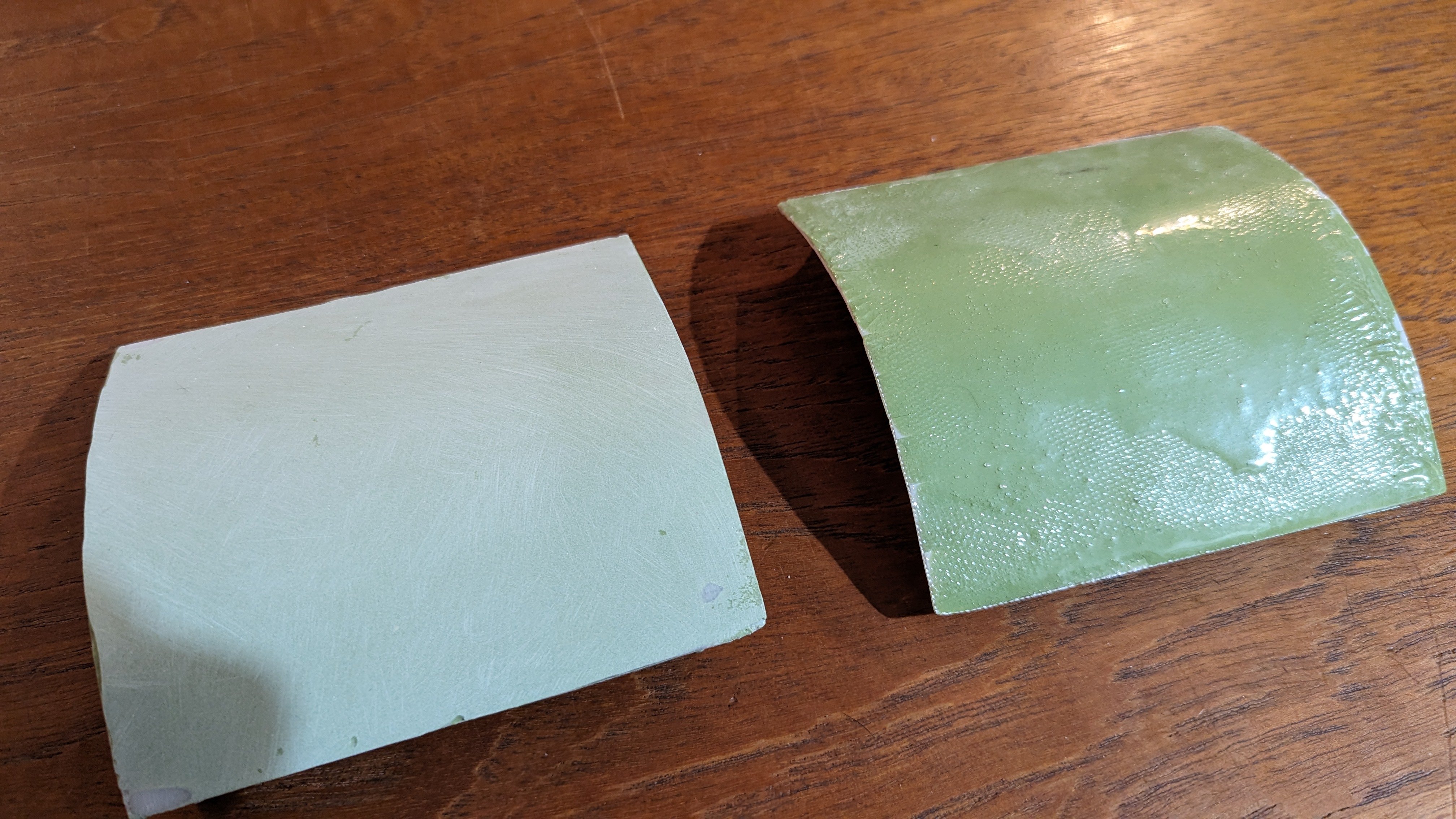

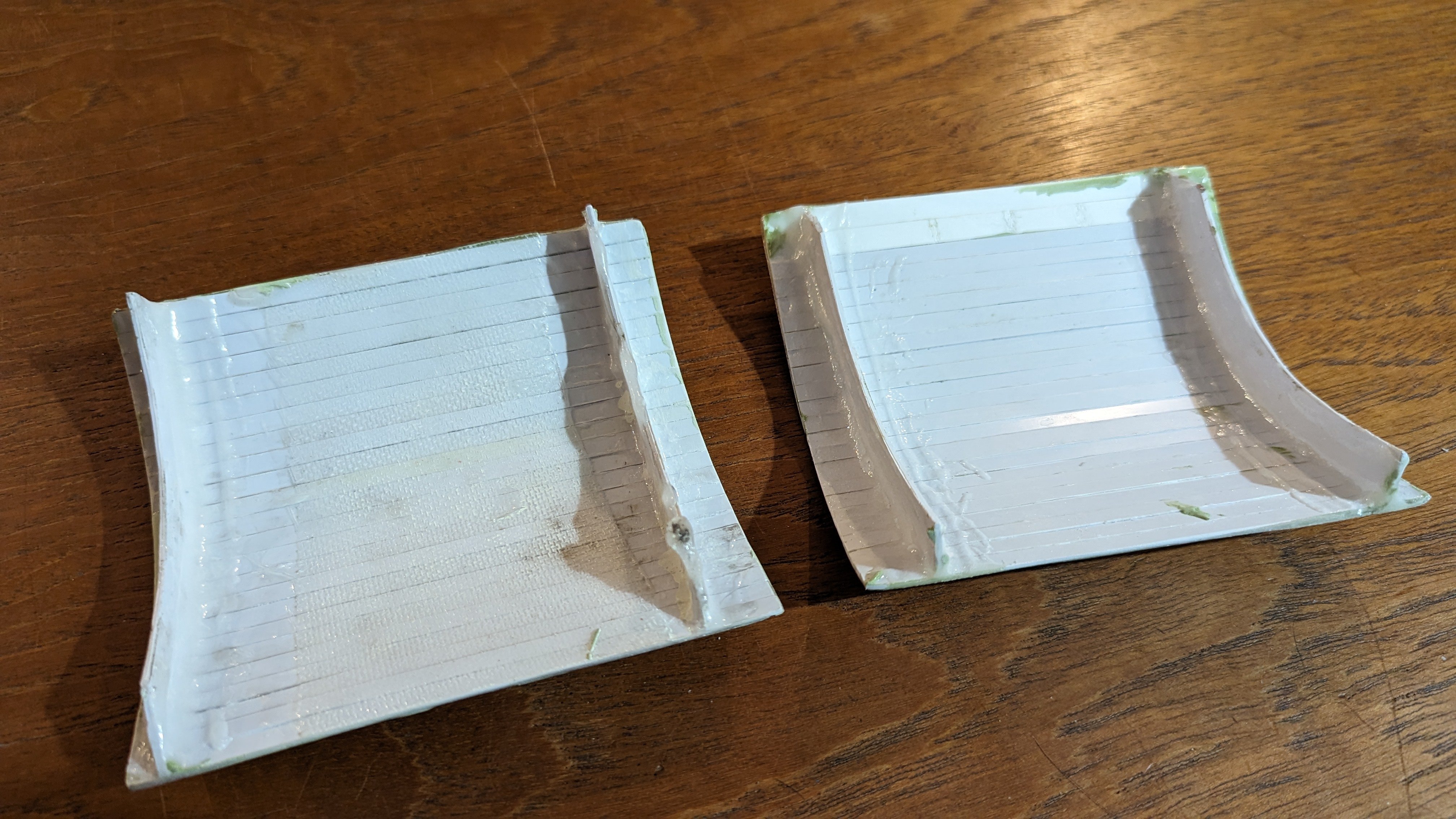

With this done, the next step for was to do a bit of experimenting. A concern was the adhesion of body filler, styrene plastic and fibreglass and it's differing rates of expansion when subjected to extreme temperature swings. As luck would have it, we were expecting to see -45C in the coming weeks so a few test rigs were made. These rigs had a defined profile, one that I could compare to a go / no-go gauge and mimicked my hull construction. One was lined with fibreglass mat and body filler applied over this and the other smoothed with filler and then covered with fibreglass mat. Once the fibreglass and body filler were cured and sanded these two rigs were toss out into a snowbank to freeze. After a week they were brought into the house, twisted, dropped and kicked and then placed near the toasty warm wood stove. With a temperature swings of about 70 degrees no distortion or separation was noted; both good news for my logging truck and the tug.
Here are the rigs after their torture in the cold, they aren't pretty:
I am not too sure which route to go for glassing the hill. With body filler over the glass sanding is a breeze, however body filler will absorb water over time and any scratches in the paint system may allow this to occur. With glass over body filler sanding will be a bit more tedious but the hull less susceptible to damage. In regards to strength, I believe both to be roughly the same strength, what are your thoughts?
