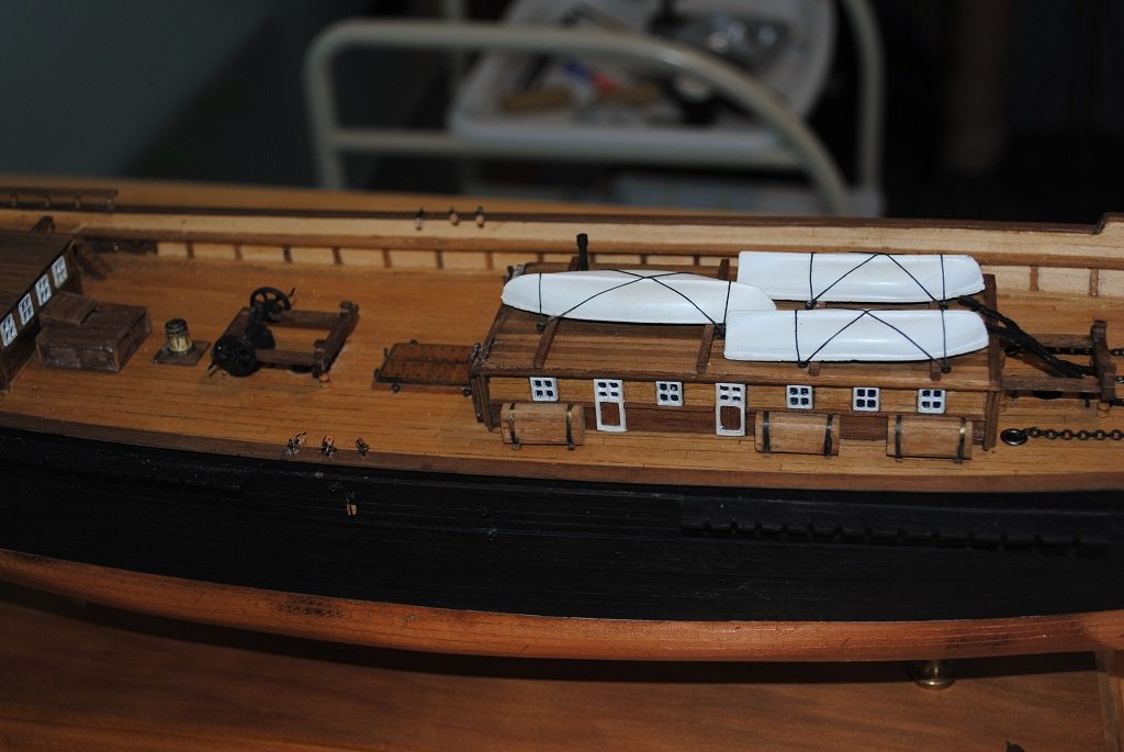

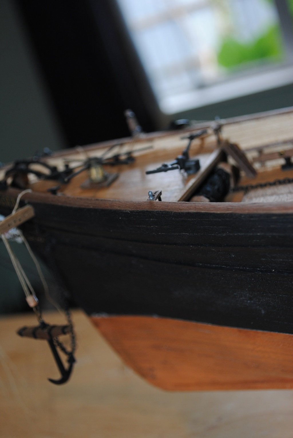

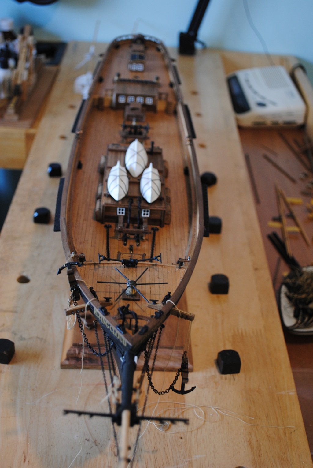

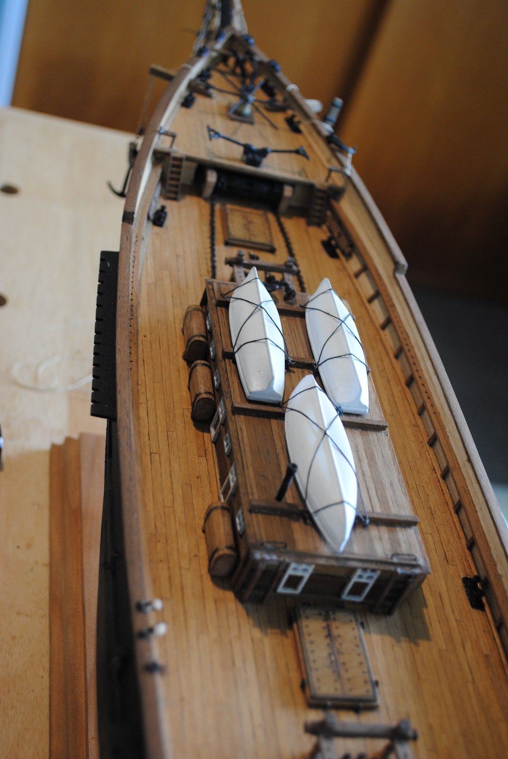

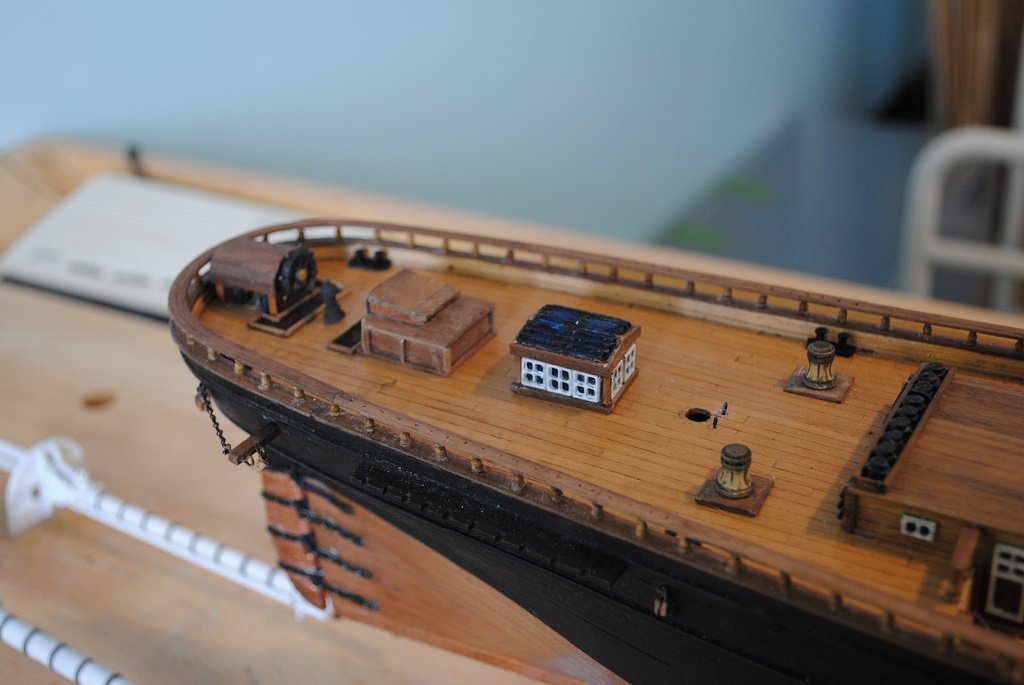

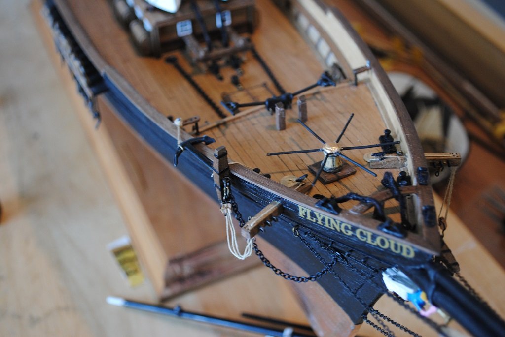

Hi All,
Time for a small update....
  • Fitting of Deck Funiture progresses, only a few Deck Eye Bolts yet to place and a couple of Blocks on the Aft side of the Catheads.
  • Thanks to @petervisser for his suggestion on Anchor Stowage. (I have done one up and one down.)
  • I removed the Focsle Mooring Bitts in order to be a little more accurate with the Capstan placement, I also decided to install Capstan Bars for a little added interest. (Vertical Capstans are A/L as the kit supplied ones were pretty nasty.)
  • I made up a couple of Gratings, one in front of the Ships Wheel and one for the Aft Companionway.
  • The only things left unattached at the mo. are the Vertical Capstans and the Skylight structure/block. The Skylight continues to be a point of indecision for me as I am not happy with the way the Roof Windows look. (Photos show structure with a Brass frame around these and one without for comparison, feel free to comment. I have a couple of ideas yet to represent these Roof Windows a little better perhaps? (I might just be better to leave well alone.... 🙂))
  • Shroud Chainplates and Deadeyes assembled, (No photo sorry), and I'll assemble the Backstay Chainplates soonish. The Chainplate material is a "Soft" white Metal, and I overstressed a couple of these so had to replace with ones made from Brass wire.
I think that's it for the mo. If I remember anything else, I'll update.
Apologies for a couple of "Out of focus" pictures but I think that you'll get the idea. 🙂
Cheers....HOF.

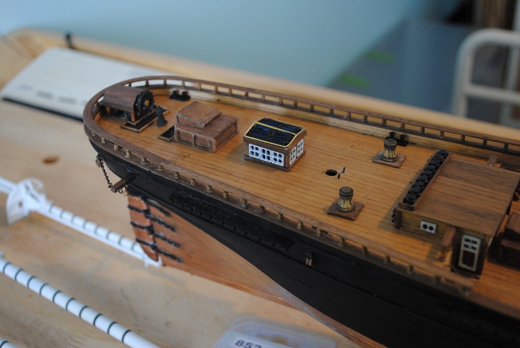

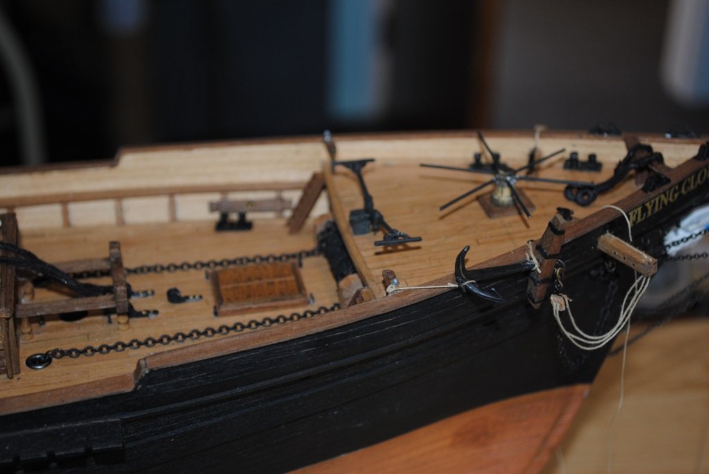

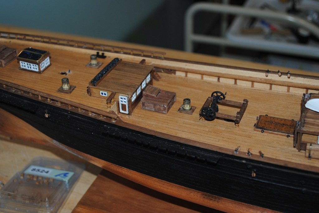

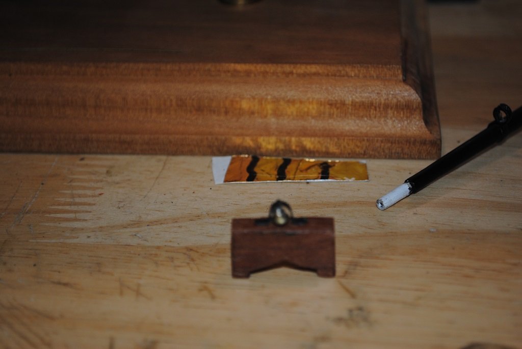

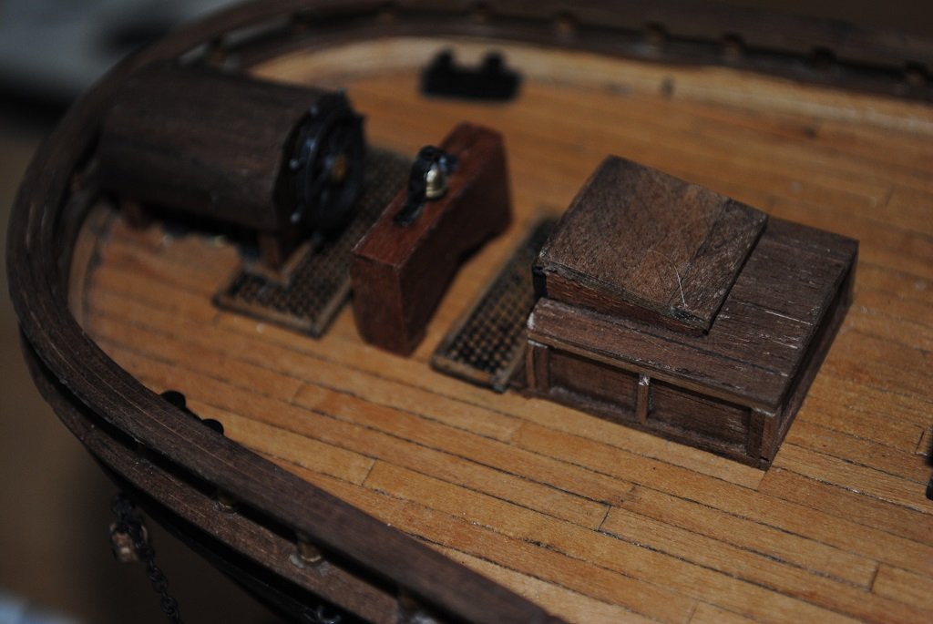

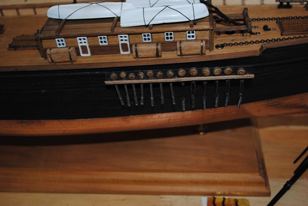

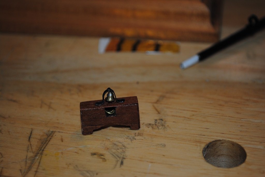

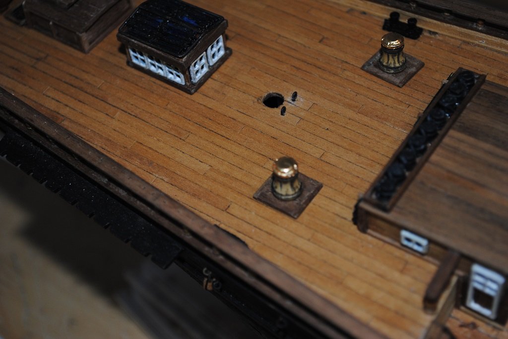

Hi All,
Time for a small update:
For some time, I have been struggling with tying my Stropped Blocks on to my first Yard, Fore Main Course. Several attempts later I think I have the correct "Recipe", one that seems to work for me anyway. I will post my fourth attempt after the Blocks are on.... 🙂
One of my issues was lining up the Blocks along the length of the Yard. I have some 0.5mm Brass Rod on order for the Jackstays, my plan is to utilize these to assist.
Anyway, I digress, I decided to make my own Binnacle, the Kit supplied one was a "Later" 19th Century, Similar to a small pillar. Photos show my second attempt. I turned a Bell, also my second attempt as the first was way too large.
I added "Brass" Caps to the Vertical Capstans. The material is actually Gold Bare Metal Foil but I think it does the job.
This morning, I decided to have a bash at mounting the Chain plates. For the Channel Capping I cut 1.5 X 1.5 strips, pinned middle and both ends.
Photos show unpainted capping strip. This will be painted Black before affixing.
Anyway, that's about it for the day.
Cheers.... HOF.

Fine work....but McKay clippers utilized, double channel chainplates...not single.  Before you get too far.
Rob
Current build:
Finished build:
Current build(On hold):
Nice job on the bell and binnacle, look’s really good!
your Flying Cloud is coming along nicely!!
Check the lengths of your chai plates, in the picture they look a bit long.
Rick
Rob
Hi Rob,
Thanks for the "Heads-Up."
I am aware of the Double Channel set-up used.
The Kit does not supply secondary Channels. The do however instruct the modeler to install a 2.0mm? strip to represent the secondary Channels.
Yup, I have been thinking about these items and am considering "Scratching" something. (It's not too late, the Channel Caps are not fixed yet, just pinned. 🙂)
Cheers and Regards,
Harry.
Rick
Hi Rick,
Thank you for your kind comments, appreciated.
Regarding Chain Plate lengths, I'll definitely have a look-see. I do think that it's a little too late to adjust the lengths.
(They are quite a bit shorter when the bottom Link of the Shroud Chainplate is held on the Wales.)
I will have a wee break from proceedings while I ponder suggestions by yourself and Rob.
(Maybe do some Yard and Mast work? 🙂)
Comments and suggestions very welcome thank you.
Cheers and Regards,
Harry.

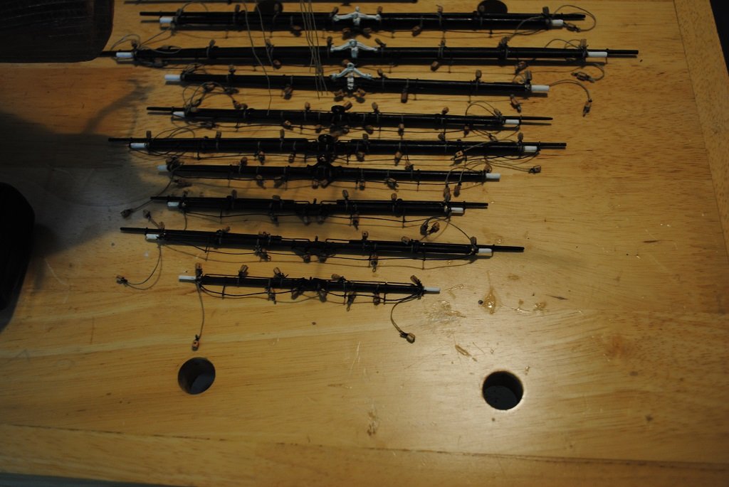

Hi All,
Bit of an update seeing that it's been a few weeks....
Working on Spars, Blocks and Hooks tiring to get my "Recipe" correct for these items. 🙂
I have completed Block installation for the Mainsail yards. For the Blocks that attach directly to the yards I first made up "Pigtails" with the Block siezed to one end using a "Slidey" Siezing secured with a dab of CA.
I then wrapped the "Pigtail" around the Yarad and used the same Siezing to secure the Block and "Pigtail."
After much Gnashing of teeth and brow beating the method works for me, a little more work but the results are more acceptable than other methods attempted. I also utilized the Jack Stay installation to line up Blocks along the center of the Yard. (Blocks for Boom and Gaff a similar approach for Block installation.
The Stunsail Booms are not yet glued in position as I need to develop a method for Footropes and Stirrups. While I experiment, it will be nice to remove any "Clutter." (I have some ideas for Stirrups and Footropes.)
I took some time to have a think about Hooks for Blocks and Rigging and developed a simple Jig to create 5.0mm Hooks. (I need quite a few of these as I am thinking that allot of the Running Rigging will eventually be secured to "Hooked" Blocks with Eyebolts on the Deck.)
Next was to think about attaching the Hooks to the Blocks.... These Blocks require a Becket, no problem to create these but I was disappointed with the result after tying the Siezing on the "Hook" side of the Block. (Even with 0.15mm Rigging Thread, the result was disappointing.)
I decided to resort to 0.4mm Black "Art Wire" More acceptable results and much easier.
Next tasks:
  • Stirrups and Footropes
  • Topsail Yard Furniture
That's me for the mo.
Comments/suggestions always welcome.
Cheers....HOF.

Wonderful job...she is coming along nicely.  The attention to detailing the yards out with *ALL* their blocks, stirrups foot ropes , flemishhorses, and sheet blocks can be daunting.  Not to mention the jackstays.
Many modelers tend to forego many of these and keep the yard furniture to a minimum.  If you plan on adding leach and buntlines...you'll need these blocks as well. Not failing to mention those pesky jewel blocks for the reef tackle.  :default_wallbash: It can get pretty busy for sure.
Good luck.
Will you be adding sails...furled or otherwise?
Rob
Current build:
Finished build:
Good luck.
Rob
Many thanks Rob.
I built the Mantua/Sergal Cutty Sark, (On this site), a few years ago, this now seems much simpler, (The Cutty that is), due to the bigger scale.
1/96 is much more challenging.
Anyway, the answer to you question regarding Sails, no. 🙂
Bare Bones will do nicely.
Incidentally, I have an A/L 1/84 Cutty in the cupboard with sails. After the FC I might be tempted....
Cheers and Regards,
Harry.

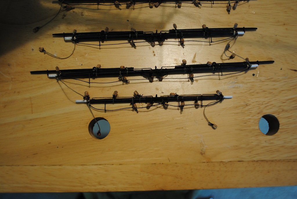

Hi All,
A quick update tonight.
Completed the Fore, Main and Mizzen Yard. (Main Course?)
I am reasonably happy with the result although the process took me a little time to figure out an assembly sequence that seems to work for me anyway. (I guess the next 12 Yards will be practice enough. 🙂)
I decided to blacken, (Paint) the Jackstays as they just didn't look right "Bright." (I have prepped all remaking Jackstays Black.)
Footropes are 5.0mm below the Yard and are 0.15mm A/L "Waxed" Black Thread. (In the photo, the Footropes look a bit "Random," they look much better "Off Camera.")
Stirrups are 4 X strands of Copper wire, (0.1mm?), twisted together with a 0.5mm loop in the end for the Footropes.
Just a couple of touch-ups on these items that I have just seen!! 🙂
Tomorrow, I'll make a start on the Top-Sail Yards. These are, (Painted)), ready for thier "Furniture" which is also prepared.
Thats me for the Mo.
Cheers....HOF.

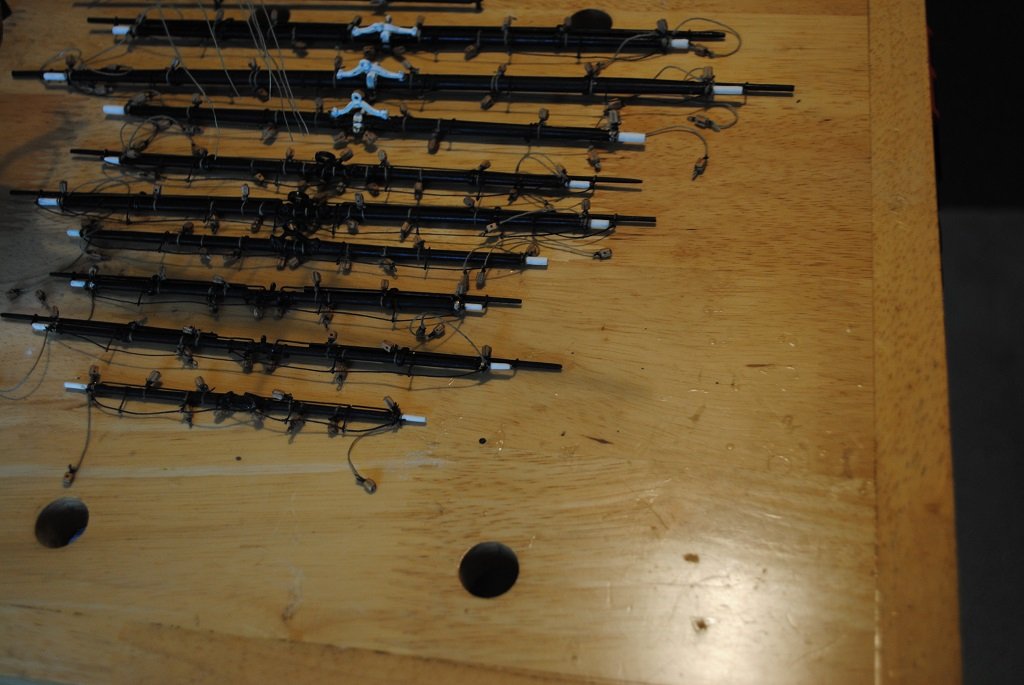

Hi All,
Small update.
A little dull perhaps just some progress on Yards.
Photos are more or less complete Topsail Yards. (These require the addition of Flemish Horses and a bit of paint touch-up here and there.)
I think about one month for these three items. (I am trying not to be too "Precious" with the Yards otherwise I would never get them done!! 🙂)
I am also still trying to decide which Yard were equipped with Flemish Horses. Opinion seems a little divided on the subject. (The advice that I have received is that only Top-Sail Yards were equipped with Flemish Horses. I wonder if this applies to the Mizzen Top-Sail Yard also? If anyone has opinions regarding McCay's Ships, I'd be very keen to hear them.)
I also include a couple of photos of the next three Yards, Topgallant, Fore, Main and Mizzen. (I prepped all Yards some time ago except for Paint and attaching Blocks and other items, prepared also.)
Anyway, that's me for the mo.
Cheers.... HOF.

Flemishhorses, generally were used on yards that supported the stunsail booms.  Crew deeded to get out far to rig and tend to the sail affixed to the boom.
Rob
Current build:
Finished build:
Rob
Thanks Rob.
I'll equip the Mainsail, Top-Sail and Topgallant Fore and Main with "Horses." 🙂
A question for you:
Do you have a diagram/key for Running Rigging Fairleads associated with the Fore, Main and Mizzen Main Tops? (Platforms)
I am trying to figure out if these were used for Sail Handling only or if Sheets, etc. utilized these, or, if they passed through the "Lubbers" hole in the Tops.
Cheers and Regards,
Harry.

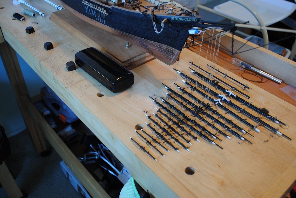

Hi All,
Small update:
More Yard work, this time the Topgallant yards are complete.
Unsure if I am completely happy with my work thus far, (I don't think I'll ever be 100% satisfied though.... 🙂)
If I had it over, I would be fixing the Blocks with annealed Brass wire. (I don't think I will be re-doing this, next time perhaps....)
(I have, however, decided to use annealed Black wire for the Mast Block work So, a bit of a hybrid, Thread for the Yards/Boom/Gaff and wire for everything else.,)
Anyway, next up the Royals followed by the Skysail Yards, six to go.
I am hopeful that these won't take so long, the Block count is ever decreasing the further up the Yard and no Stunsail Booms to worry about, Nice!!🙂
Yards are painted, Jackstays installed on the Royals, no Jackstays on the Skysail Yards.
I ordered a Contour Guage to assist with the Lower Channels, the Hull profile is completely different to the Upper Channels, Once the Channels are made, I will pin them to the Hull, mark and make the necessary slots for the Chainplates.
Thanks to @Rick310 for the Flemish Horse idea. I have installed these on the Main and Mizzen Top-Sail Yards only, less work, less stress.... 🙂
That's me for the mo....
Cheers....HOF.

10 hours ago, Ian_Grant said:
Nice work. Those lower yard trusses are detailed - are they a kit part or did you fabricate them?
Thanks Ian,
The Lower Yard Trusses are kit provided, Main and Top-Sail Yards.
I should have got someone to cast some copies of these in Brass.
The Castings provided are White Metal and very, very fragile until they were located and fixed, that is. (I managed to break a couple of the locating pins.)
I was not happy with the way the plans/instructions fixed the Upper Yards, (Tied on), to the Masts so decided to make Parrel Jaws? to ride on the Masts. (I hope it works out ok.... 🙂)
Cheers and Regards,
Harry.
Cheers and Regards,
Harry.
It's common to buy small beads, maybe 15/0 ?? at your scale, with which to make parrals. It's easy to thread through them but slightly more difficult to make the little ribs between the beads.
Thanks Ian,
I purchased some "Tiny" Black Glass beads, (NZD $3.00 for 100) (1.0mm)), I don't think that I'll be making Ribs for these at this scale. Possible I guess but not for me.... 🙂
Cheers and Regards,
Harry.

Hi All,
Small update:
Today, I finished off the Sky-Sail Yards, (Royals completed last week.), that completes the full "Suite" of Spars inc. Boom and Gaff.
(I hope that my work pays off.... As mentioned in a previous post, I wasn't 100% happy with my work. (At this juncture, "It is what it is." and it's time to move on with the build.    🙂))
I feel it's time to affix the last 3 Capstans and Mooring Bitts.
After this small task, it will be time to work on Lower Channels and set up Shrouds/Chainplates, not something that I am looking forward to.... 🙂
Cheers.... HOF.
Photos:
Edited by hof00

Hi All,
It's been a while since I last posted so here is a little progress.
I am, at present, working on the Lower Channels. I have been thinking about how to approach these for some time.
The solution that I have settled on, (Hope it works.... 🙂)
  • Photocopy Channel parts from plans
  • Paste to 1.50mm Ply
  • Cut out parts, Scroll Saw
  • Drill holes, (Edgewise), through Channel
  • Pin to Hull
  • Mark Chainplate positions
  • Remove Channels from Hull
  • Cut Chainplate locations
  • Install Channels
  • Install Chainplates
  • Install Channel Capping strips
Simple?
If you have a look at #156 in the photos you can see how much the Channel deviates from the photocopy template. this is due to the changing shape of the Hull towards the Bow. (I used a Profile Guage for this. The other Channels, #157/#158 will be sanded to fit closer to the time. I eyeballed the fit of these, the photocopy template is not too bad.
(I have made two of each Channel, in case I need to re-work something.)
To facilitate Edge Drilling these components, I took the plunge and purchased a X Y Table and Clamping Vise. from Ali Express for NZD $142.00. (Inc shipping)
This item is available from many different sites on the internet.
The Table will also be useful for many other tasks, i.e. Main-Top Fairleads, etc., etc.
(I have had a play at edge drilling the Channel material, its quick and easy. 🙂)
Right, so that's where I am at the mo. Much more "Jiggery Pokery" to go
Cheers.... HOF.
