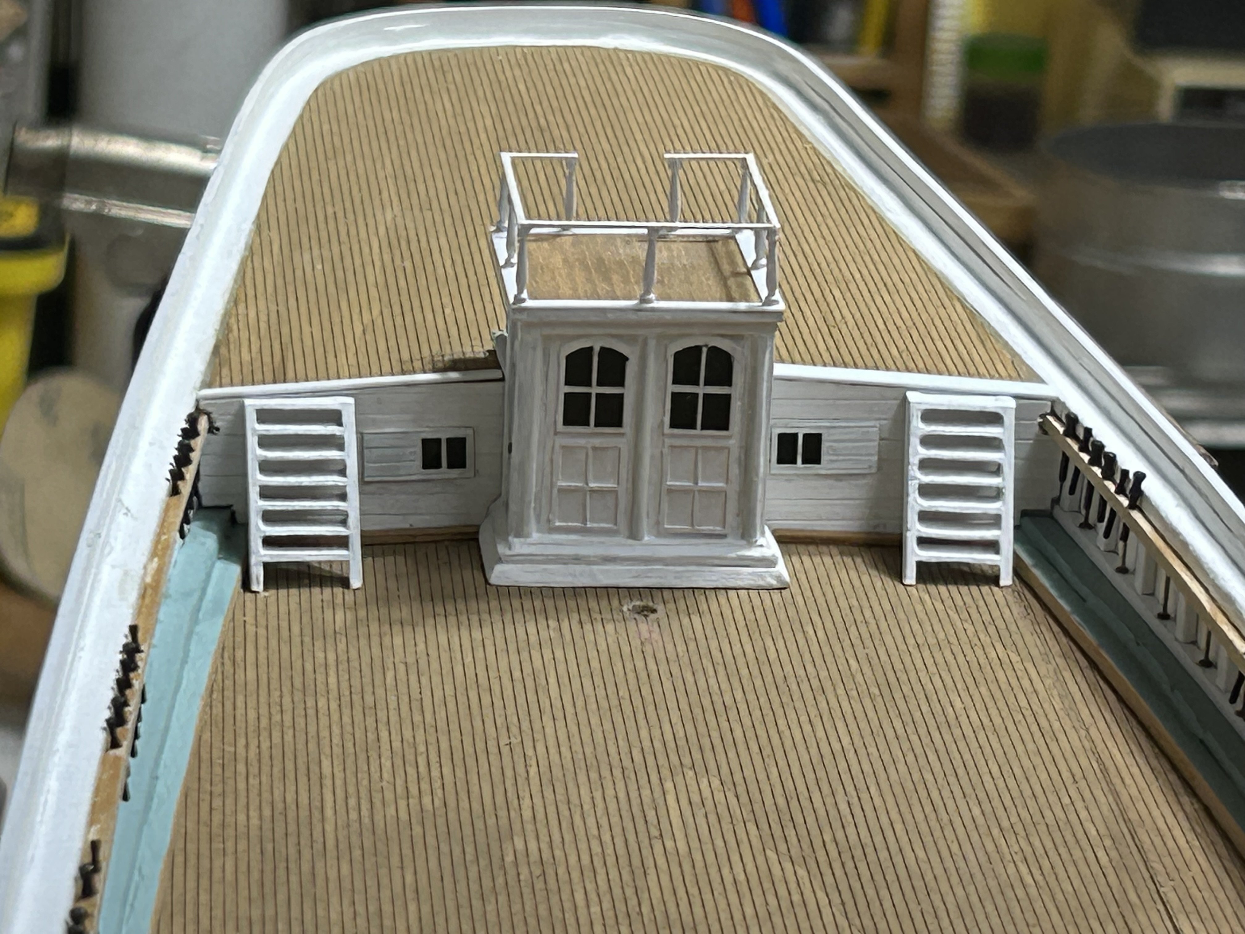

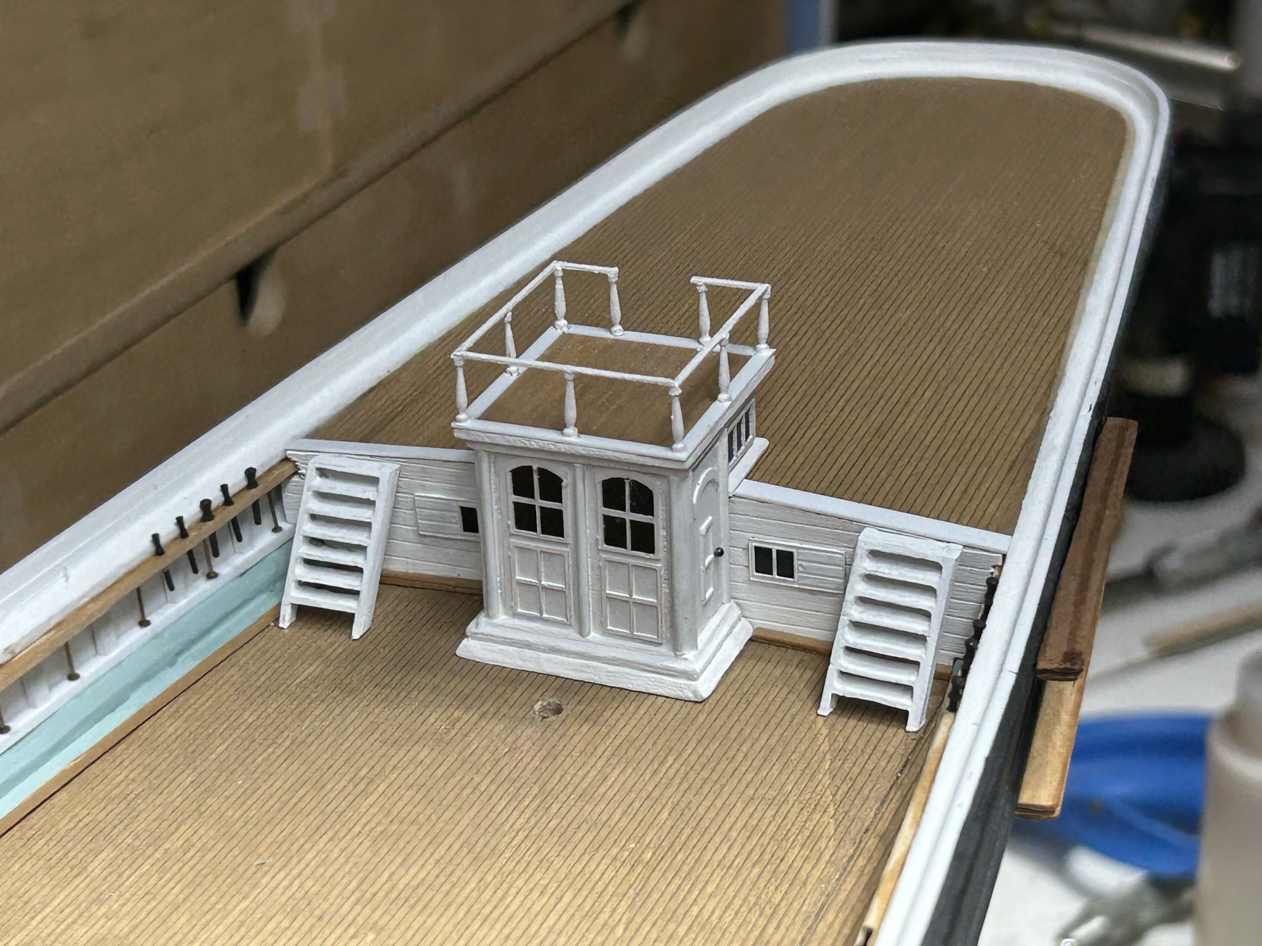

Finished up the poop fore bulkhead.

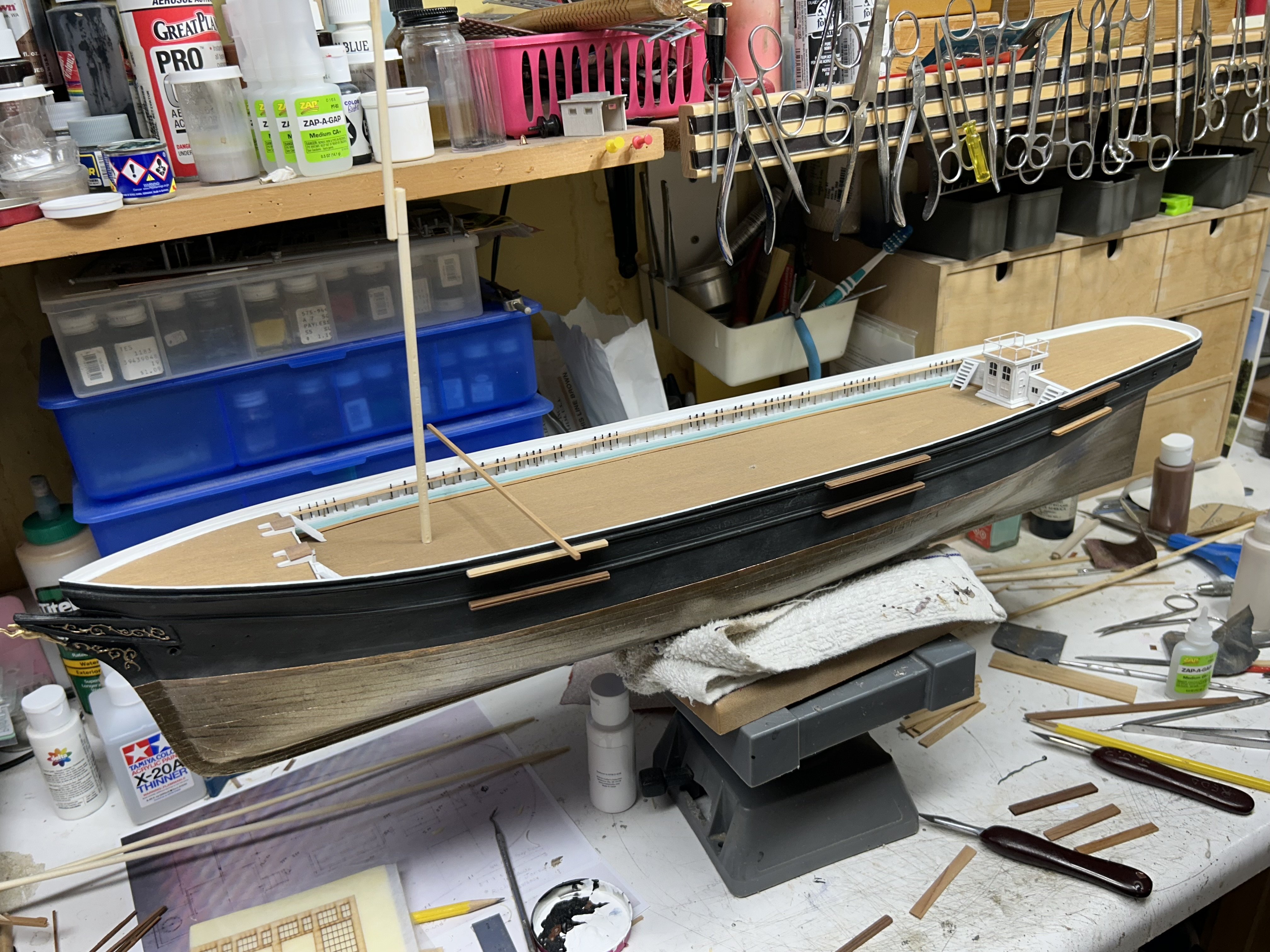

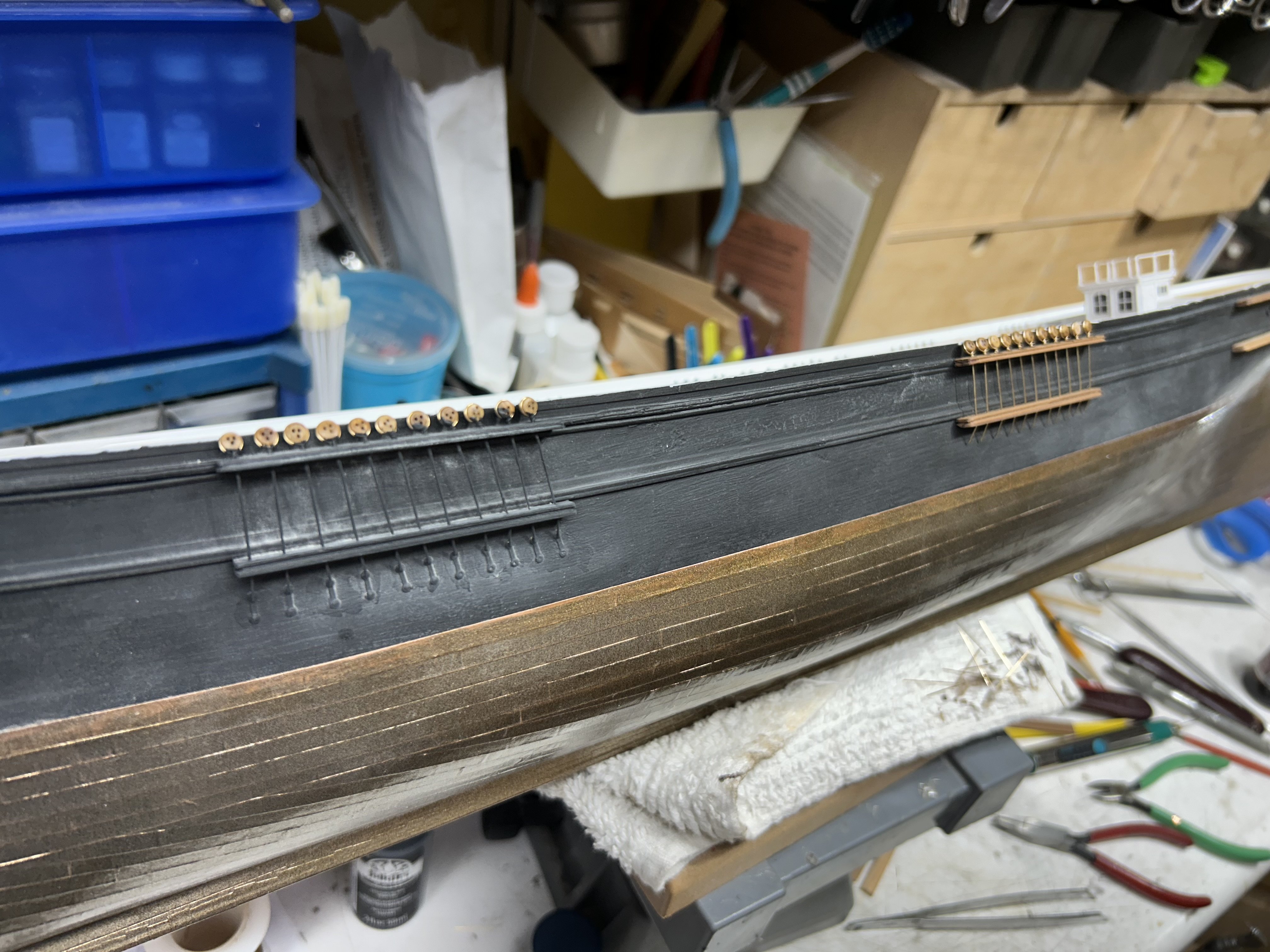

Working on milling the edge moulding on the port channels.
Rob

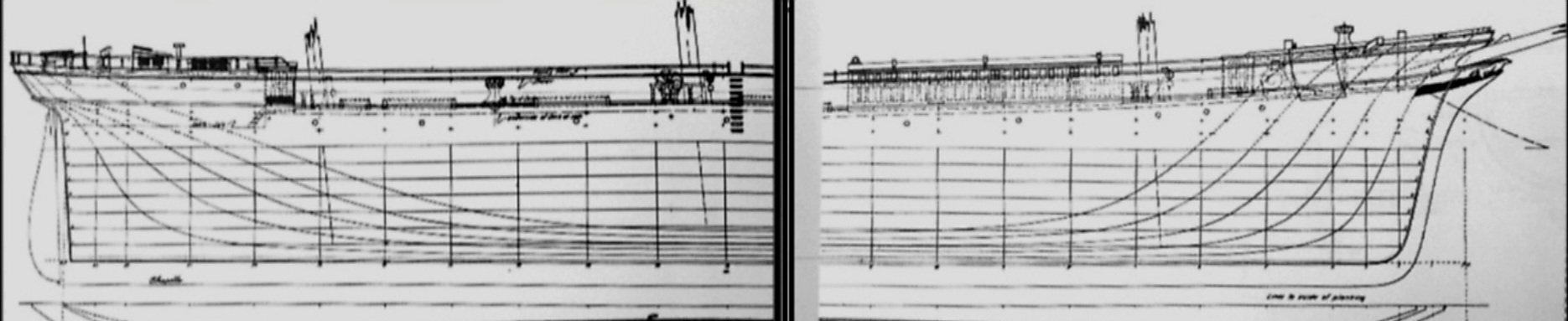

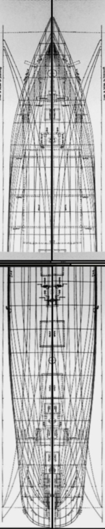

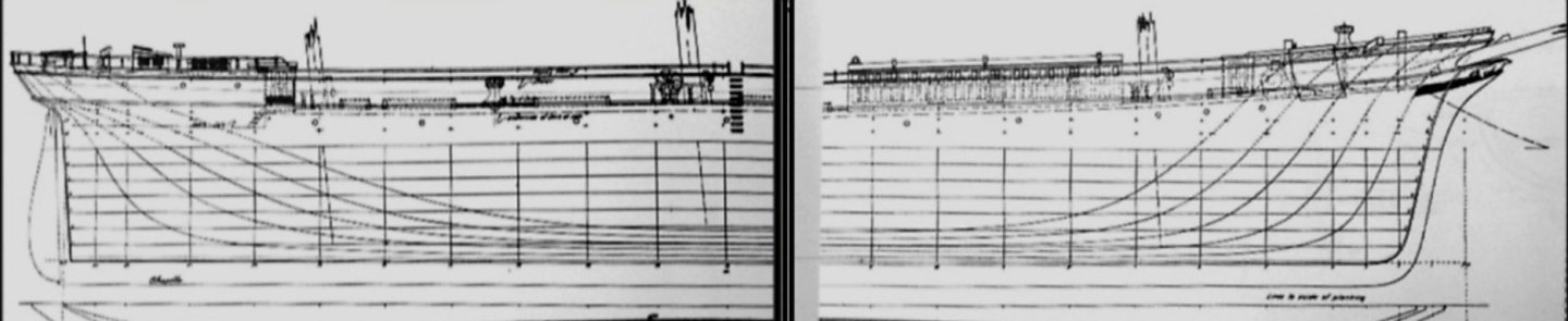

Rob,

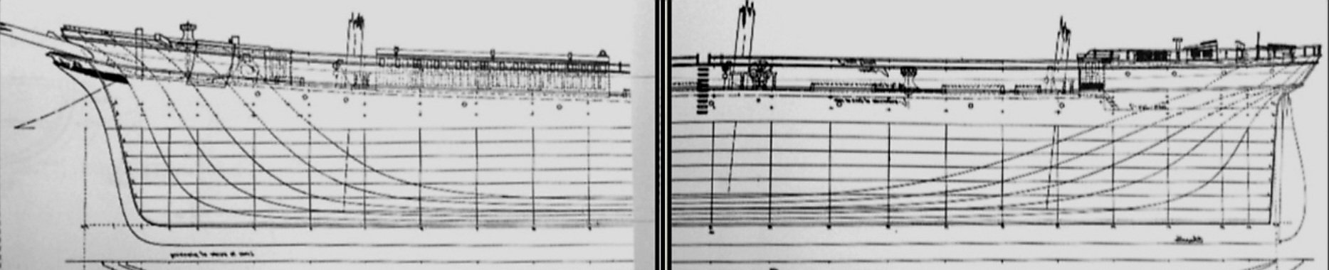

Using genuine old-fashioned paper "cut & paste" I finally combined all 4 Chappelle clipper Stag Hound hull & deck profiles to create one full image. Each section is correct but wrinkles in paper make it appear distorted. The stern still appears to be too small in comparison. I also used the same procedure on the 1881 Hall clipper Flying Cloud which was cleaner as it was just 2 halves. Next step is to trace these prints to generate a more accurate plan.
Edited by ClipperFan
improved images

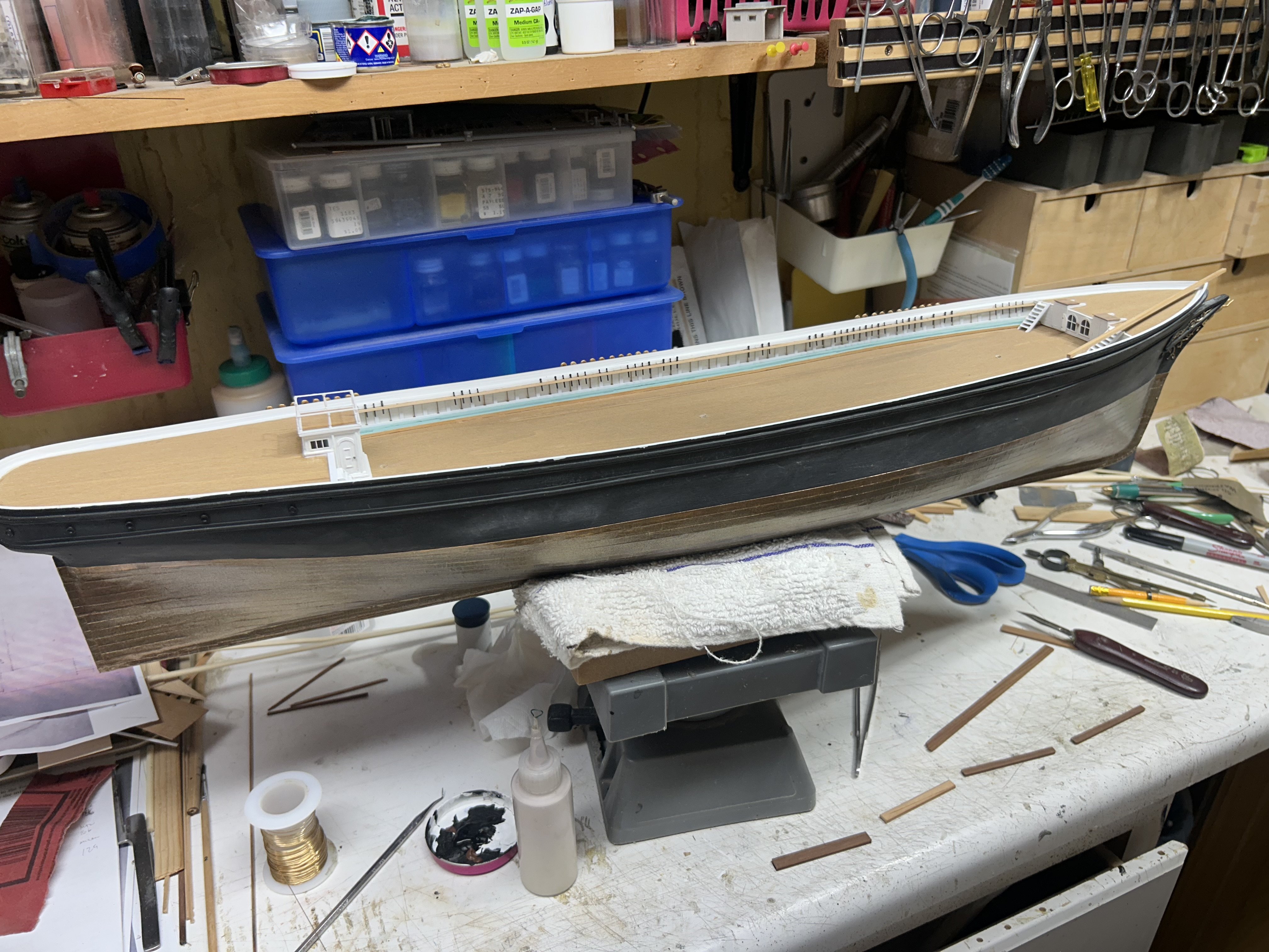

Setting up to drill for the chain plates.
Rob

Had trouble with my browser, had to change it to get this sight to work.
Here are some updates.
Rob

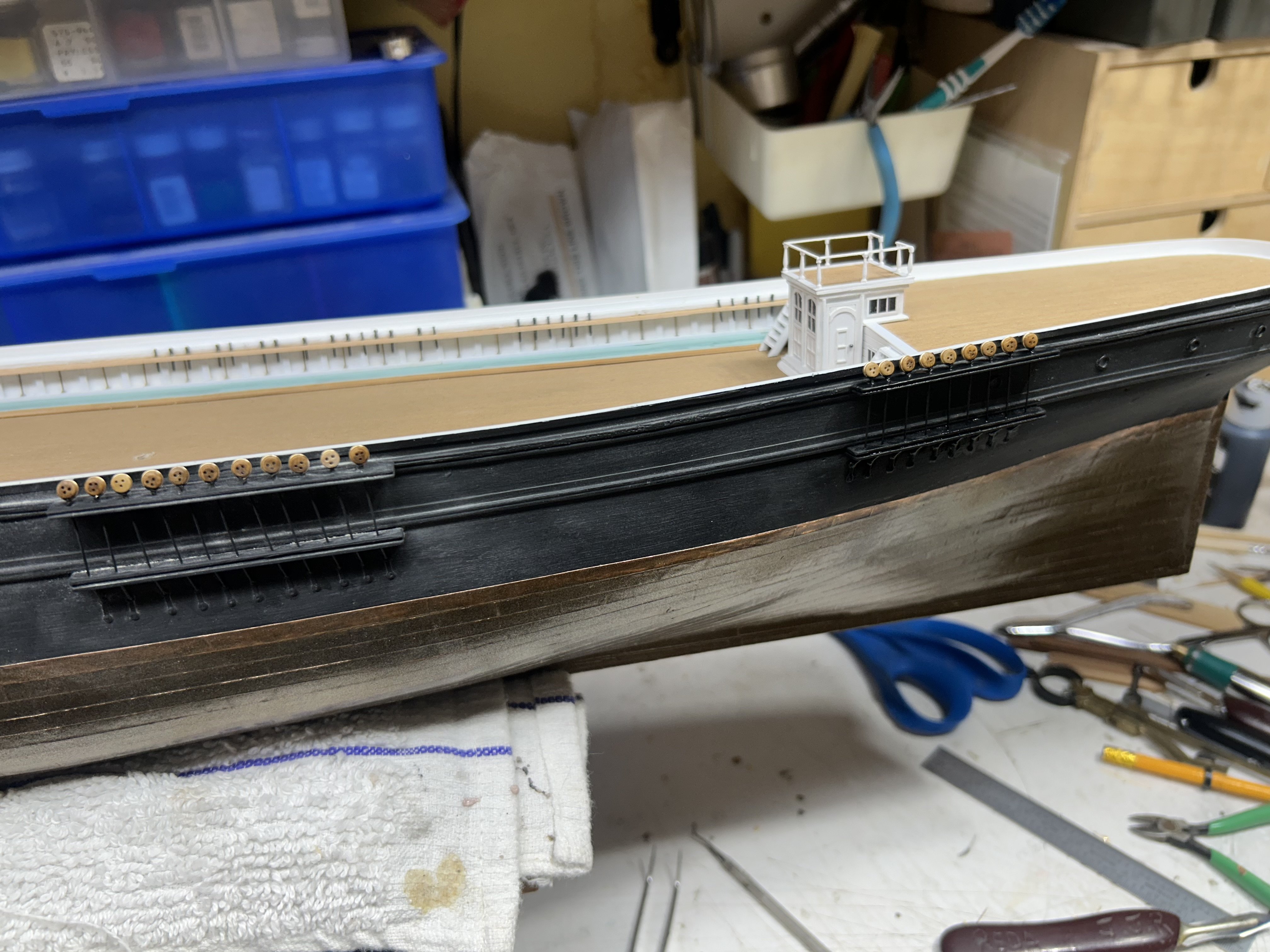

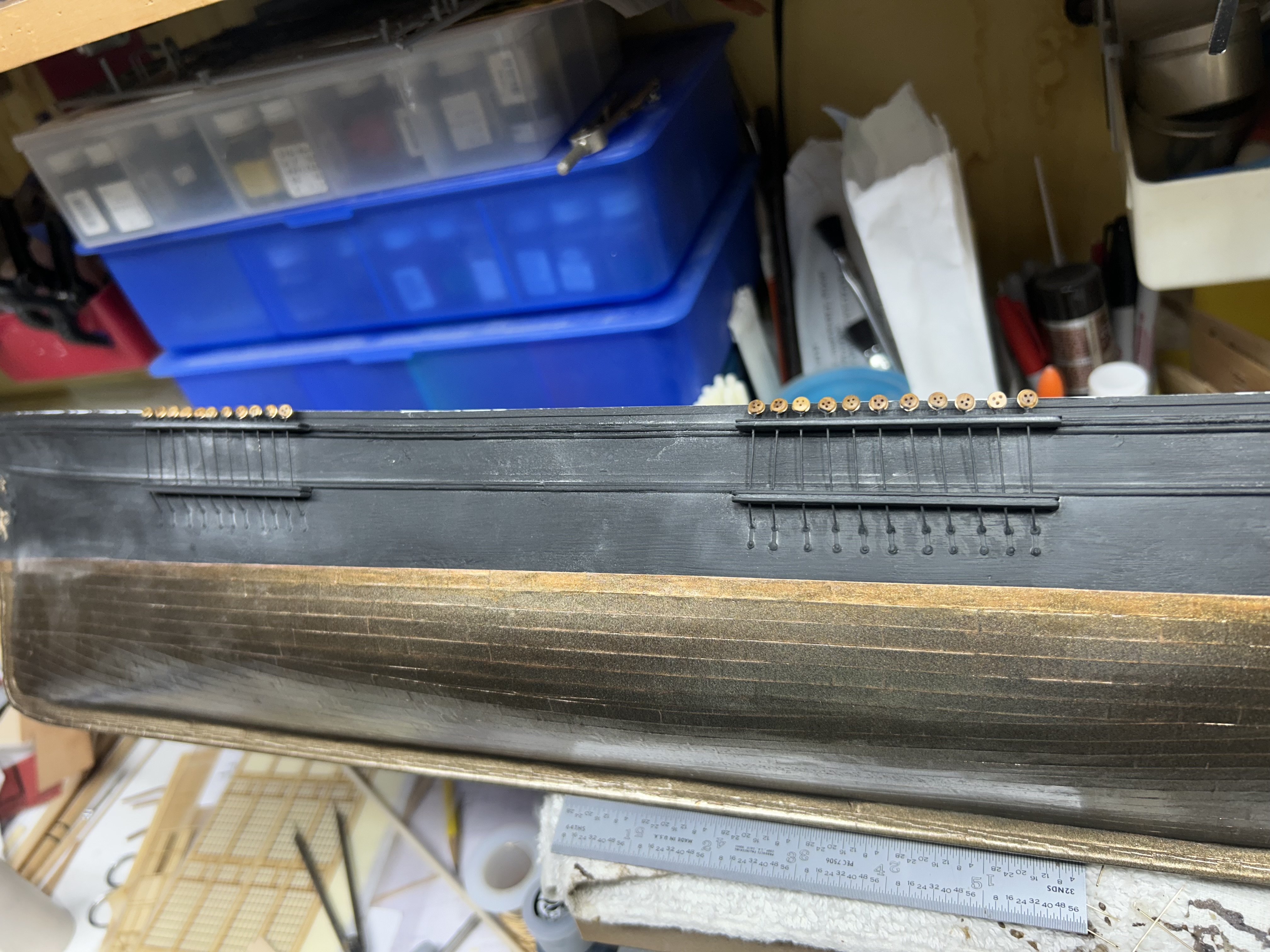

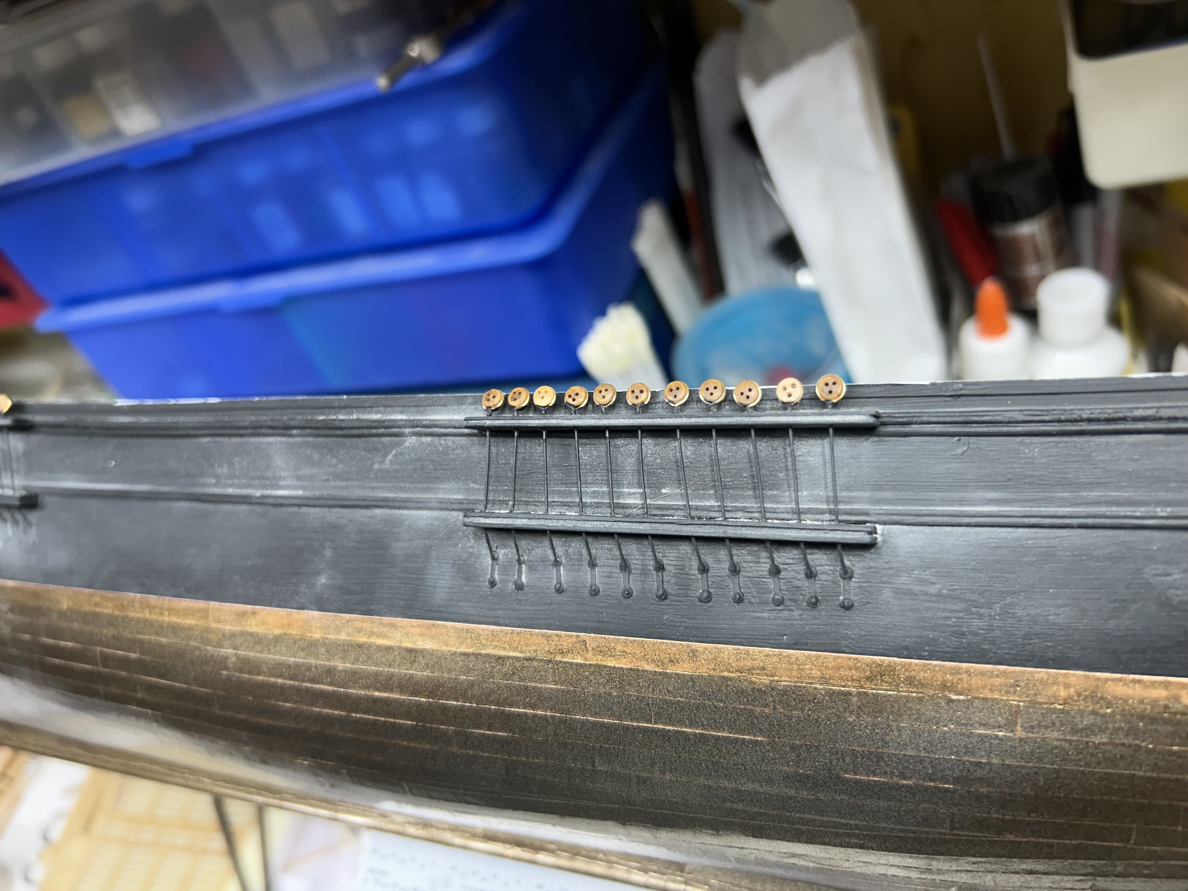

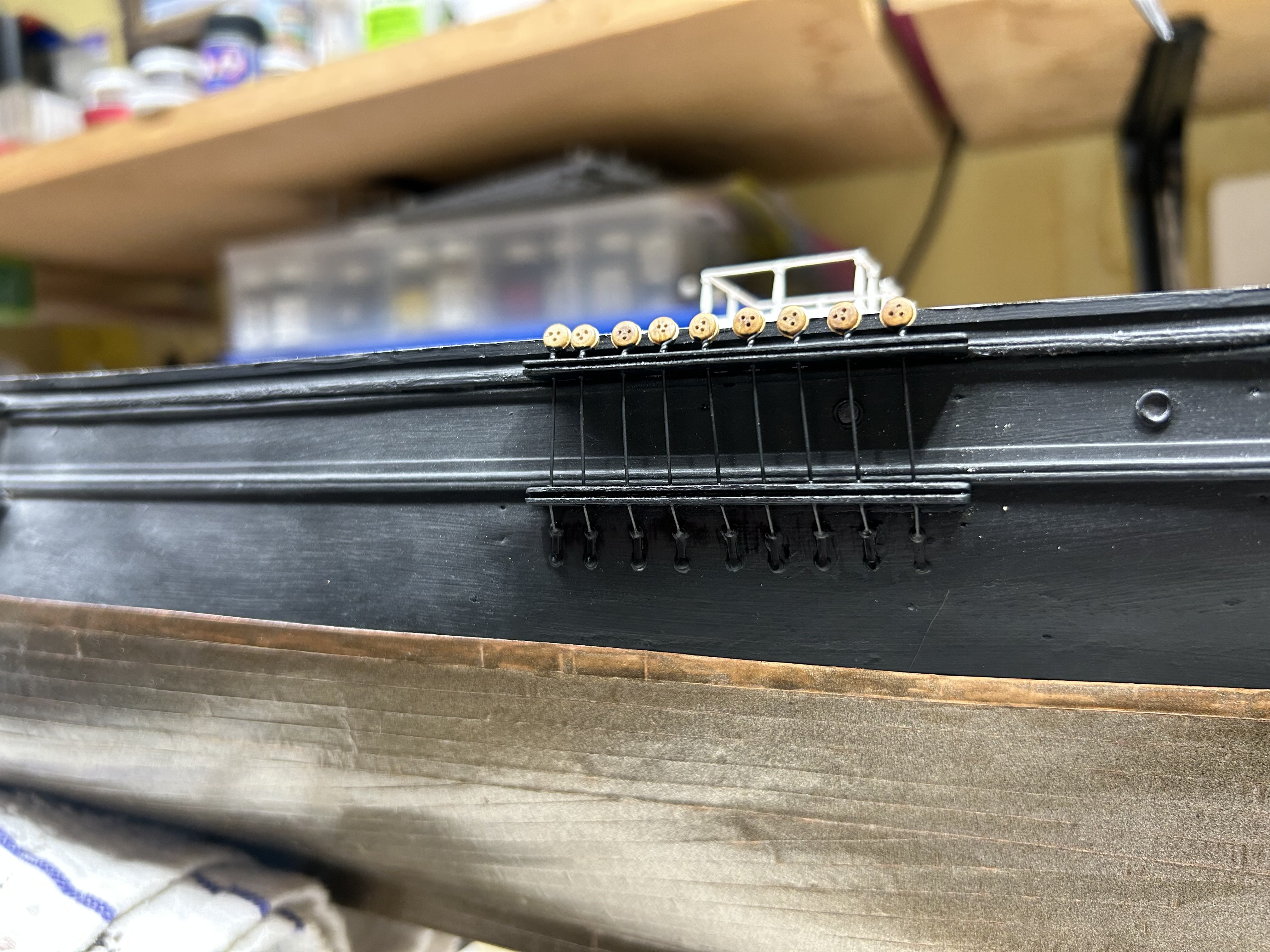

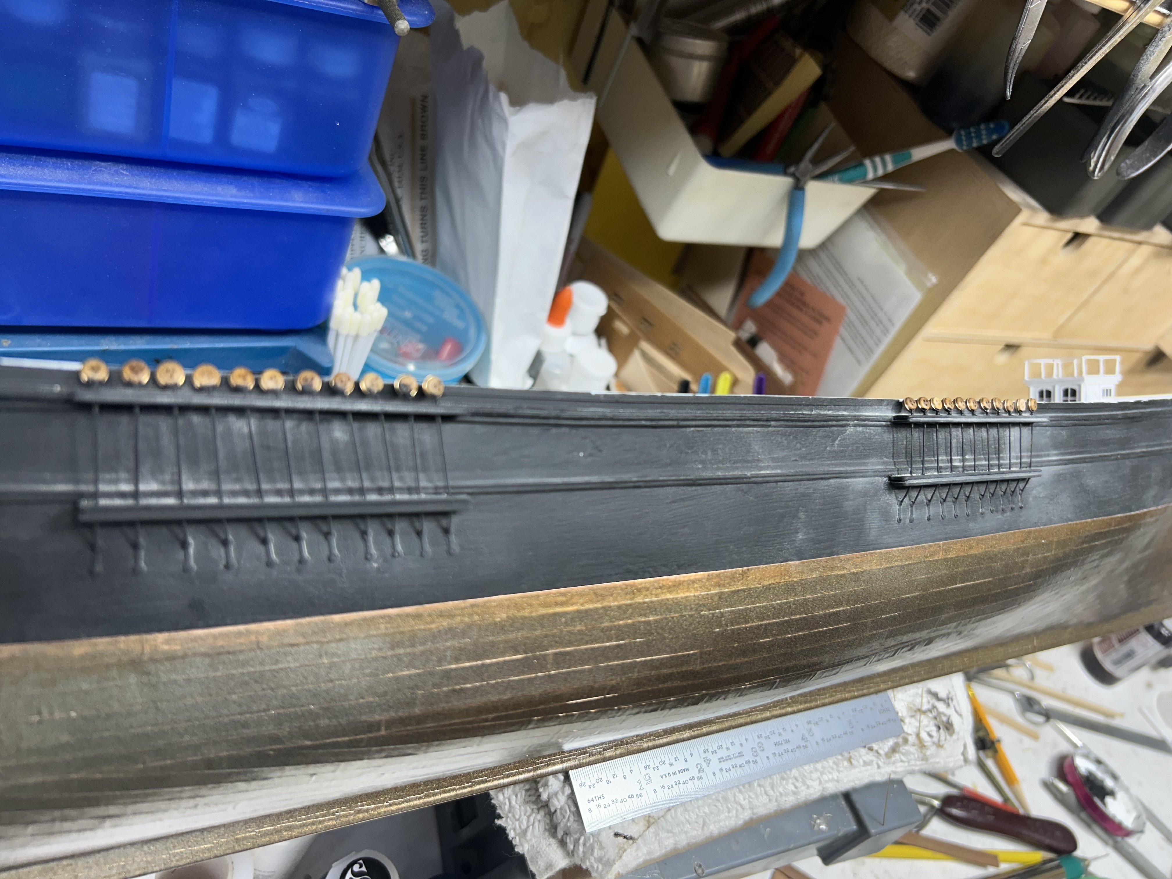

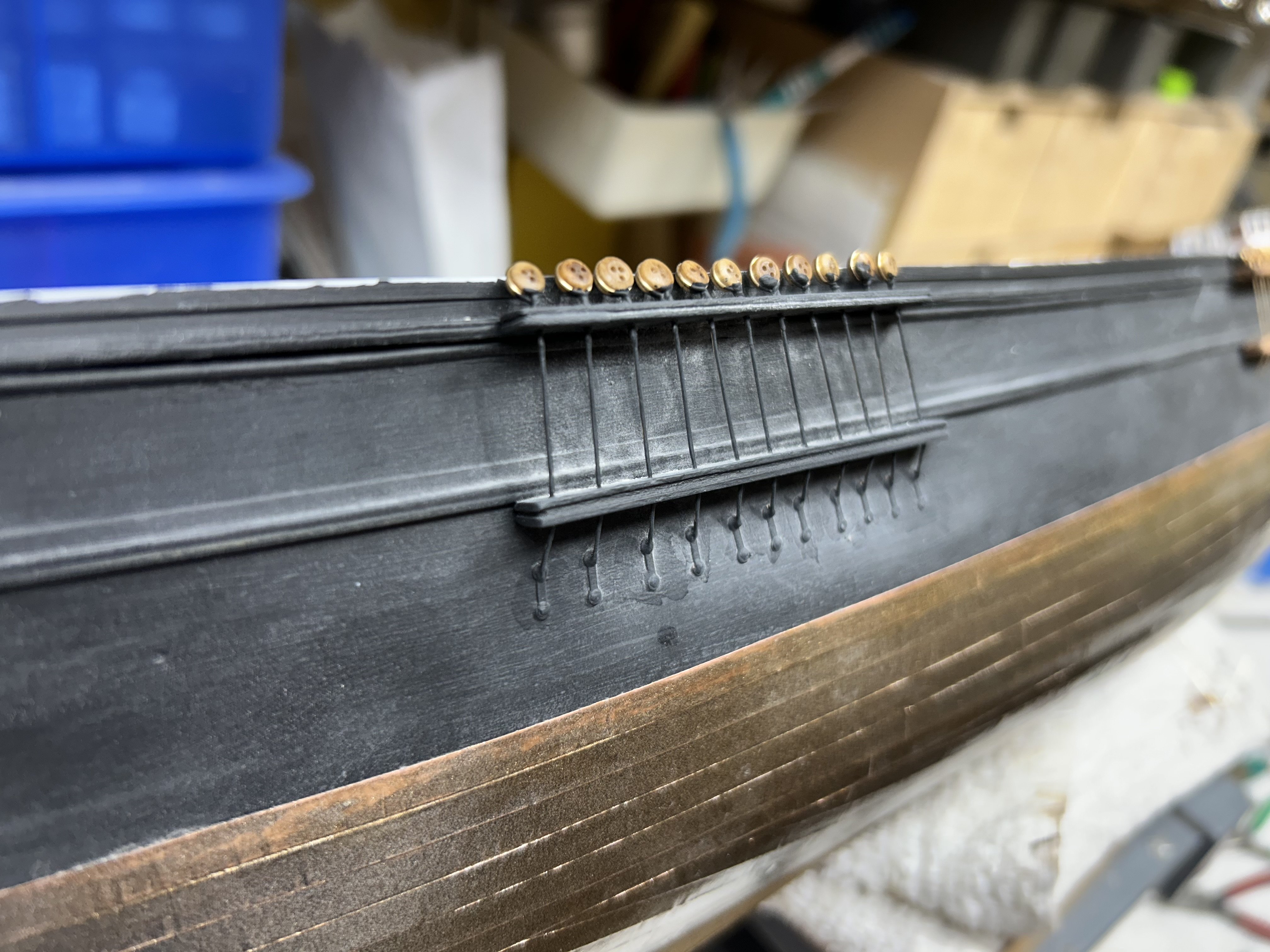

Finished up the main mast port channels.
Rob

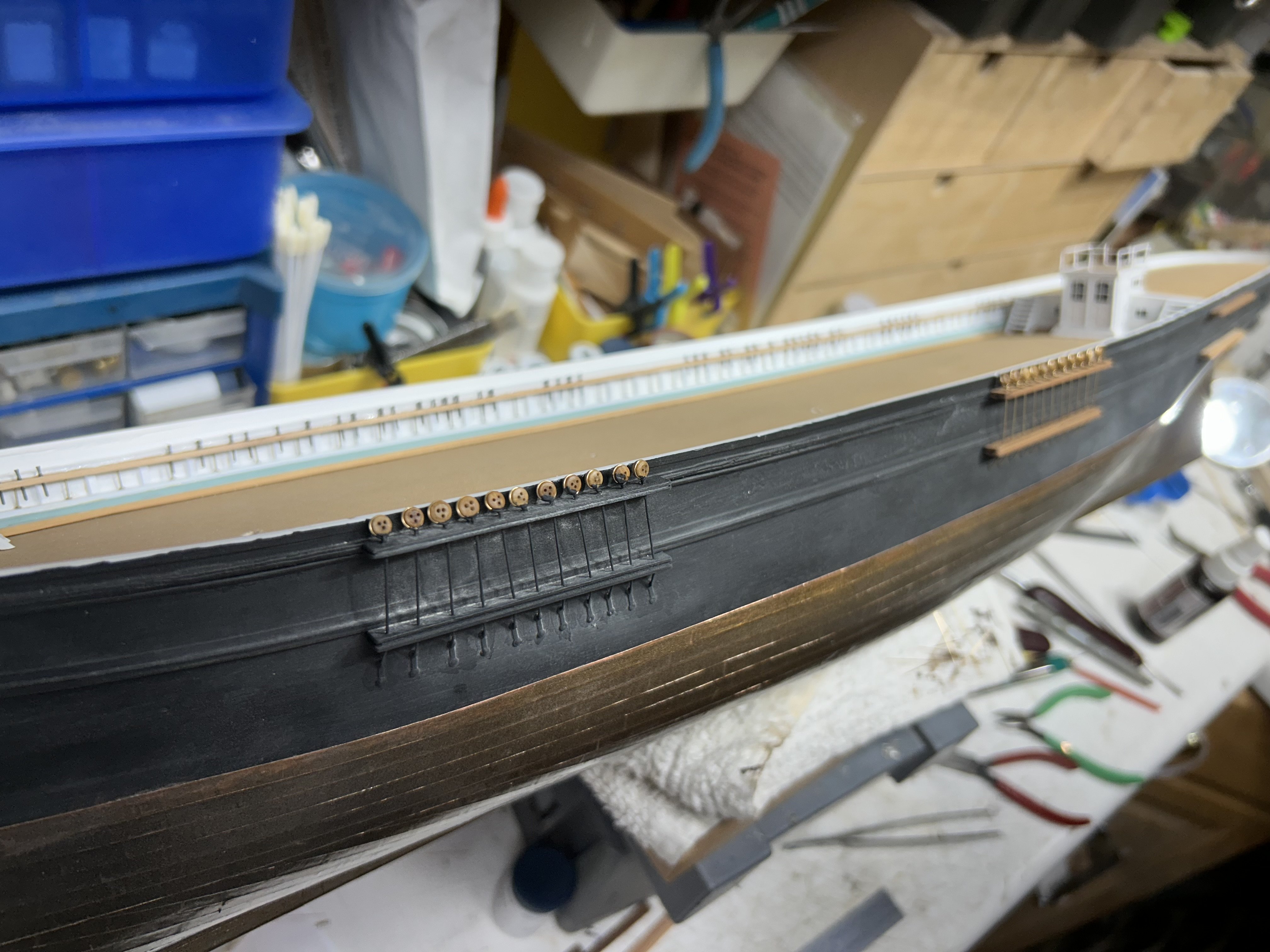

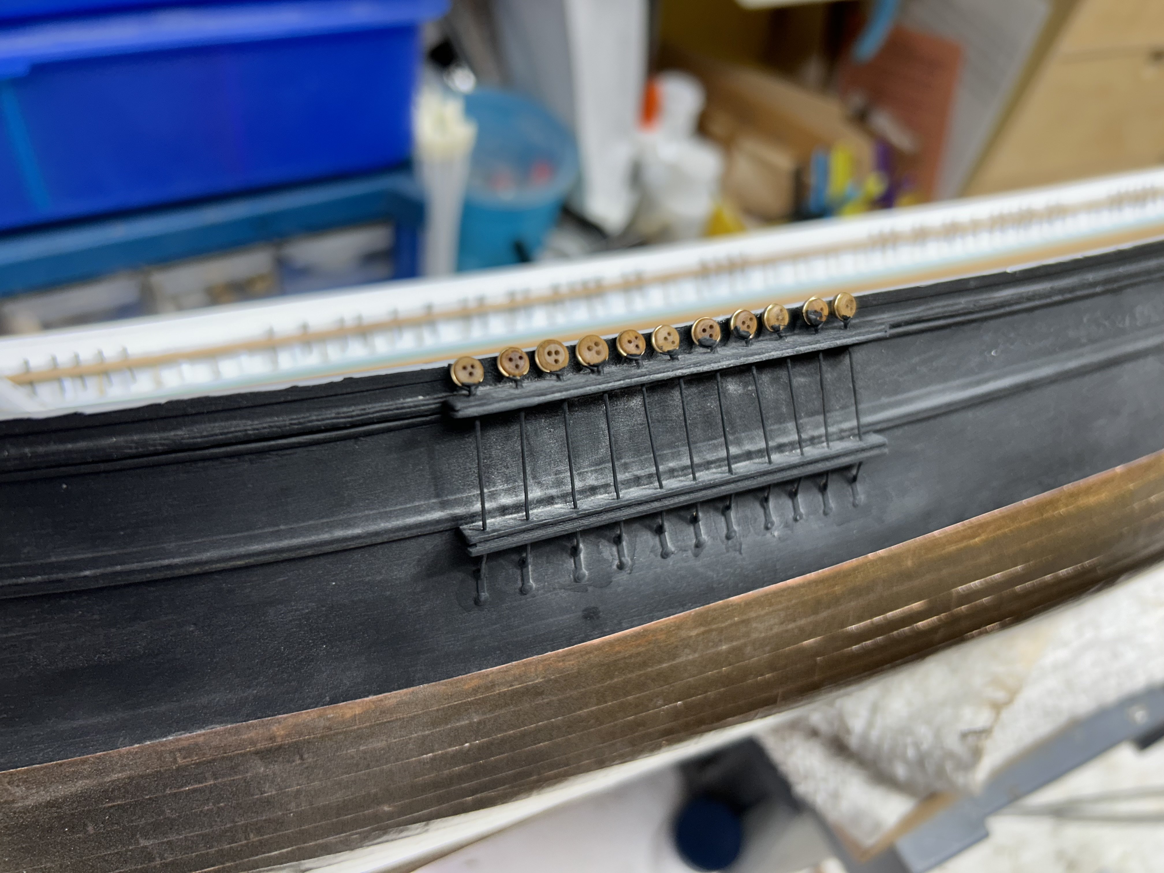

Rob,
Do you know why there are upper and lower channels in the chains? Why not just angle the chainplate back toward the hull from the upper and fasten where the lower end is fastened, bypassing the lower channel? I must be missing something. I don't remember ever seeing that before so it struck me as odd. Or maybe I've seen it and it never stood out before. Seems unusual to  me though. Is it?
Daniel
9 hours ago, Sailor1234567890 said:
Rob,
Daniel
Daniel,
Everything we do is based on following accurate historic images and documentation. Here's two such images confirming that McKay had always installed double channels on his vessels. First is an 1854 daguerrotype of the clipper Champion of the Seas. Second is of the 1869 clipper Glory of the Seas, taken in 1911. Both have double channels installed.
200390735_GloryofTheSeas-02_jpg_1e3ea586a74b8c0a0aa8a4438686e3ec.jpg.f6f2d2d5b7beeb87ff8b85c613a0468b.jpg
Strength has a part to play in this design.  The upper channel is only secured to the rail top and internal stanchions....the lower is secured to the planksheer bottom and massive waterways below that,...and the stanchions/frames.
McLean clearly describes McKay clippers as being most strongly built and secure vessels.....emphasising the strength of their bolting and robust, construction.   Double channels is accurate.
Thanks for being curious enough to question it.
Rob

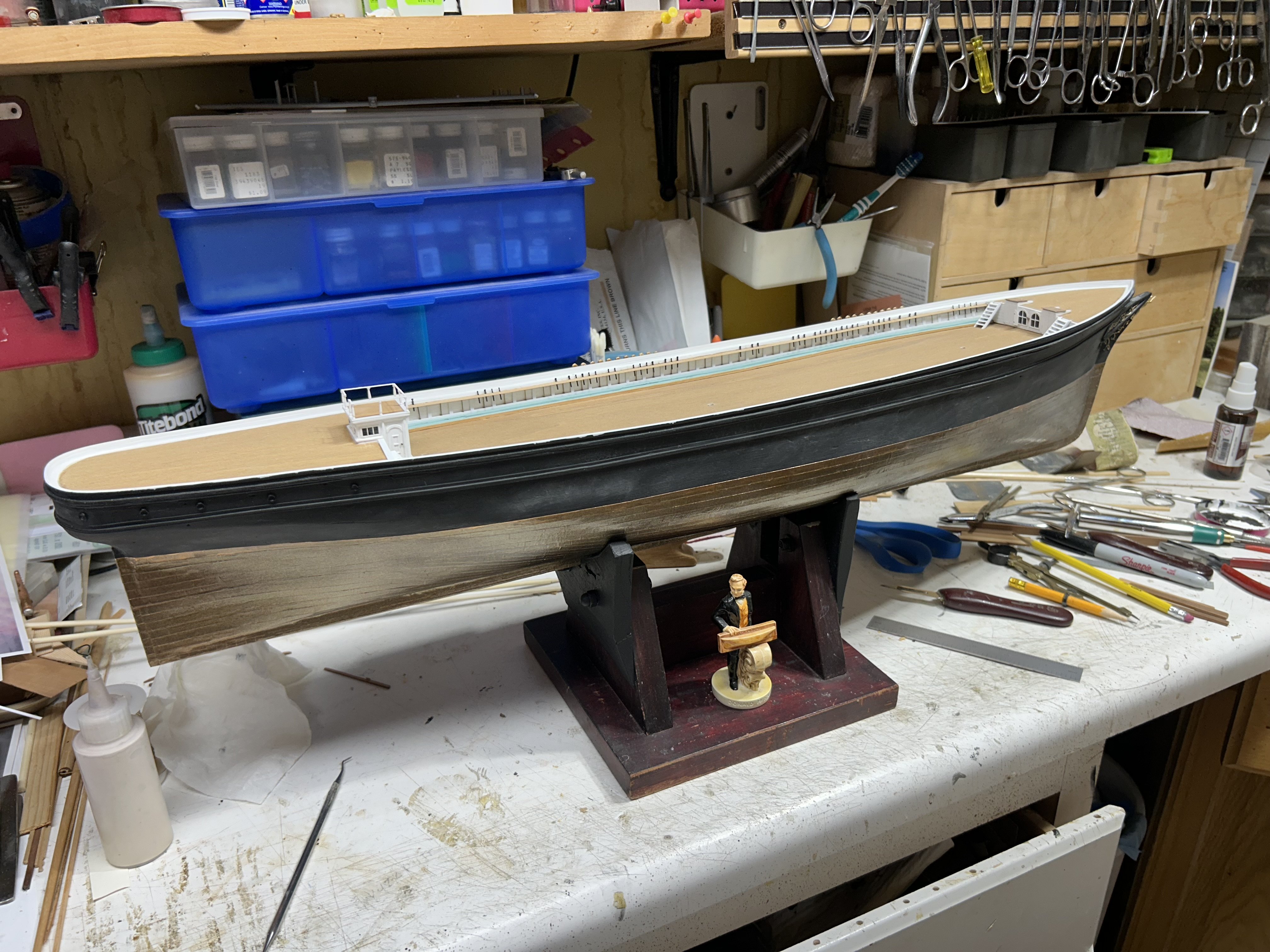

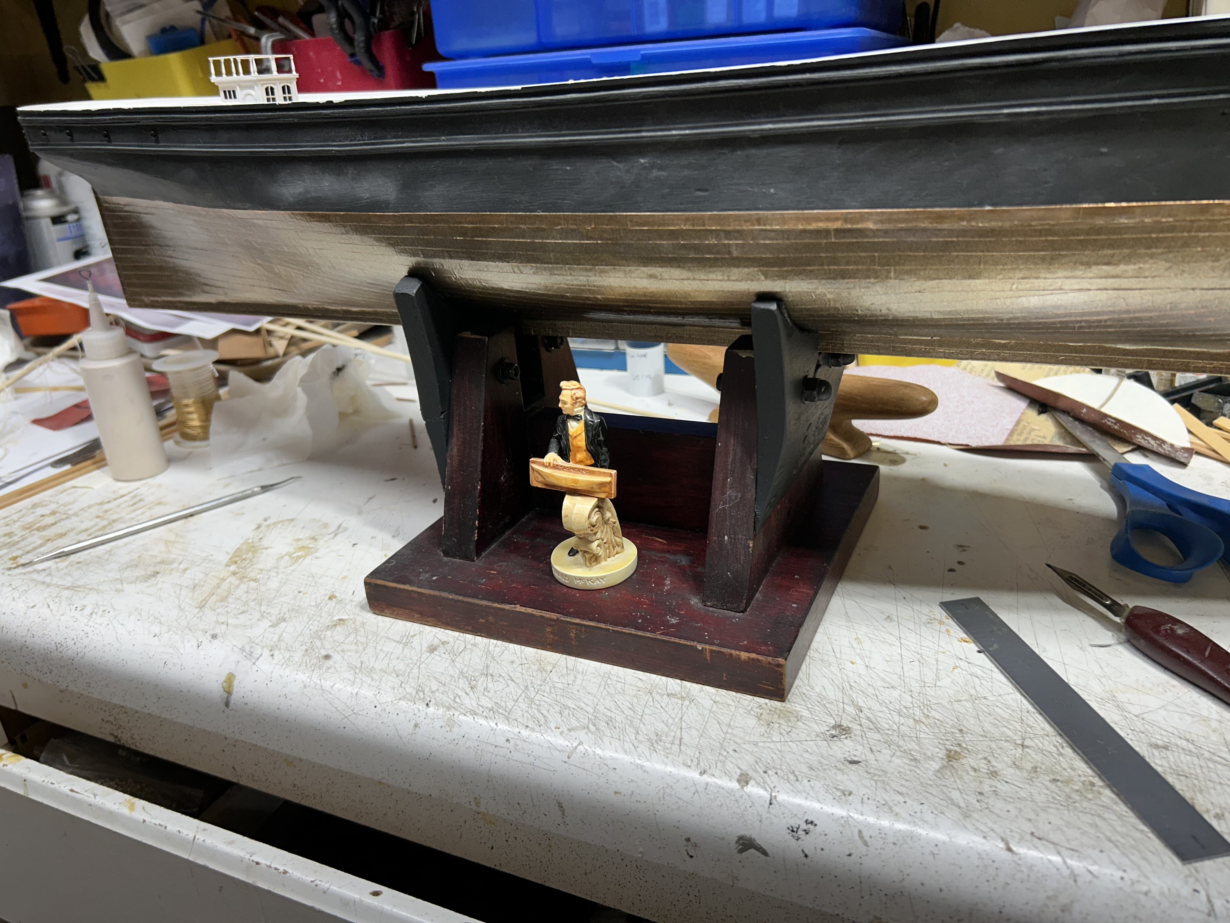

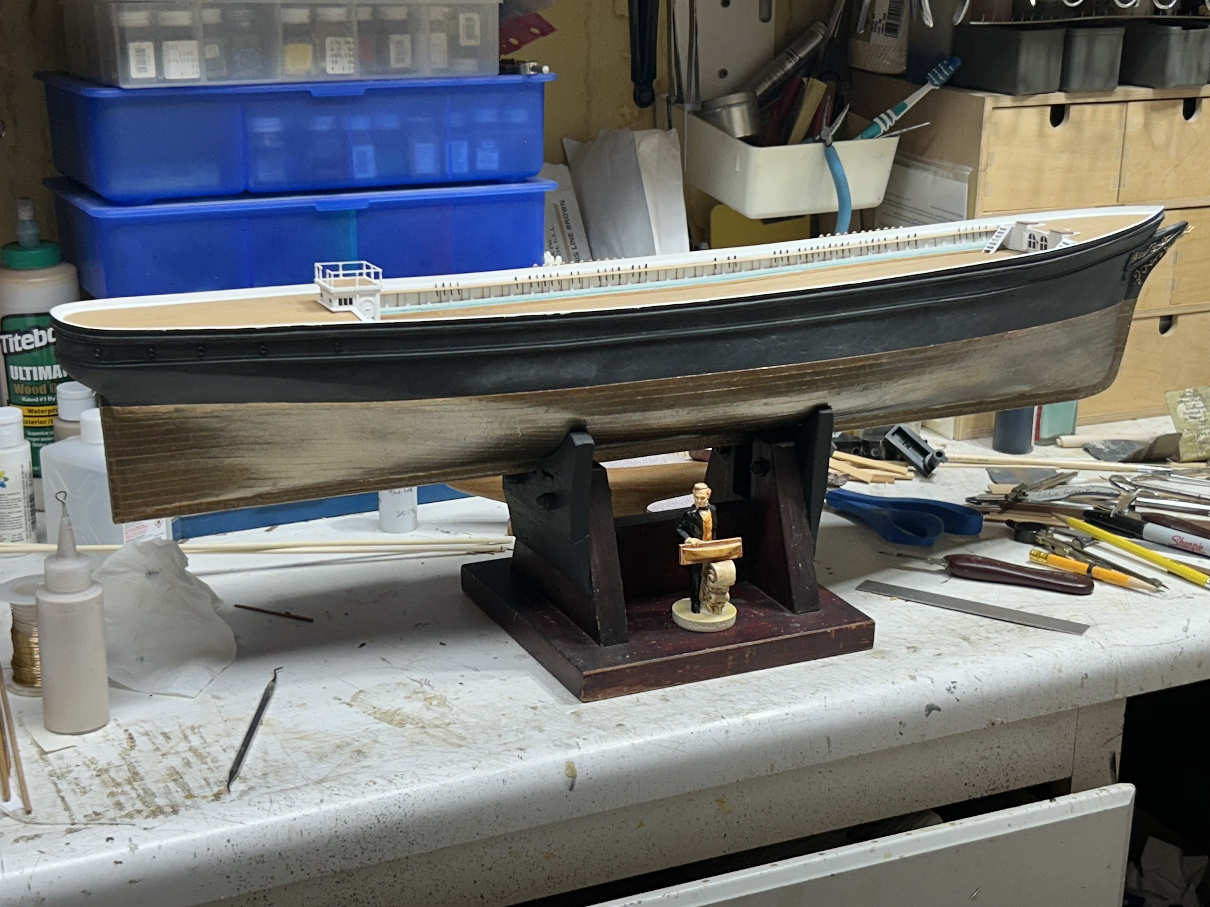

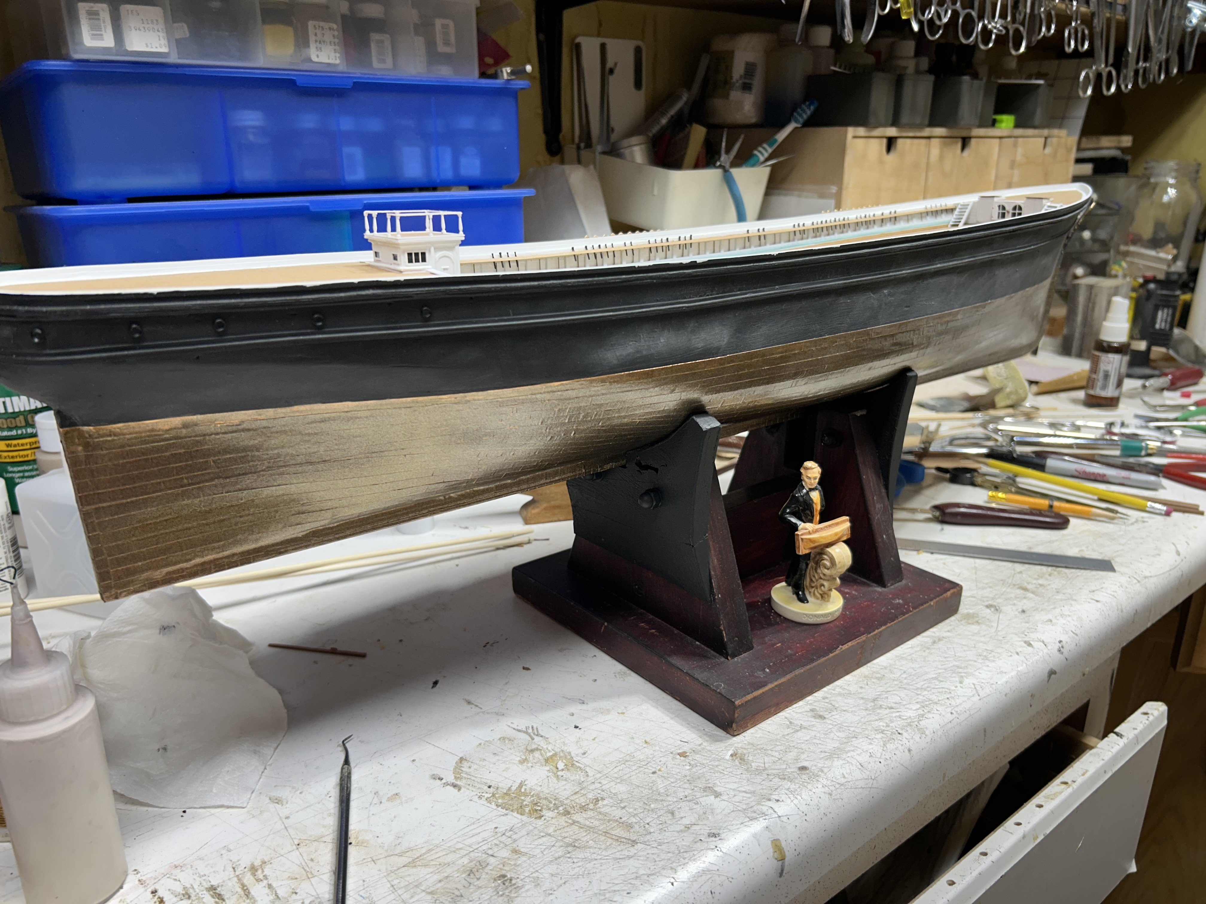

I decided it was time to make the final stand.  I reused an antique optical stand and modified it, by adding the two brackets to hold the model.
I bolted the two brackets to the stand and then added a curio of Donald McKay and a clipper half model (which could be Staghound).
Rob

2 hours ago, BANYAN said:
Wow, love that figurine and the uniqueness of the overall design for your stand Rob.  Looks great!
cheers
Pat
Thanks Pat.  I wanted it to resemble early industrial.   The McKay figurine is frosting on the cake.
Rob

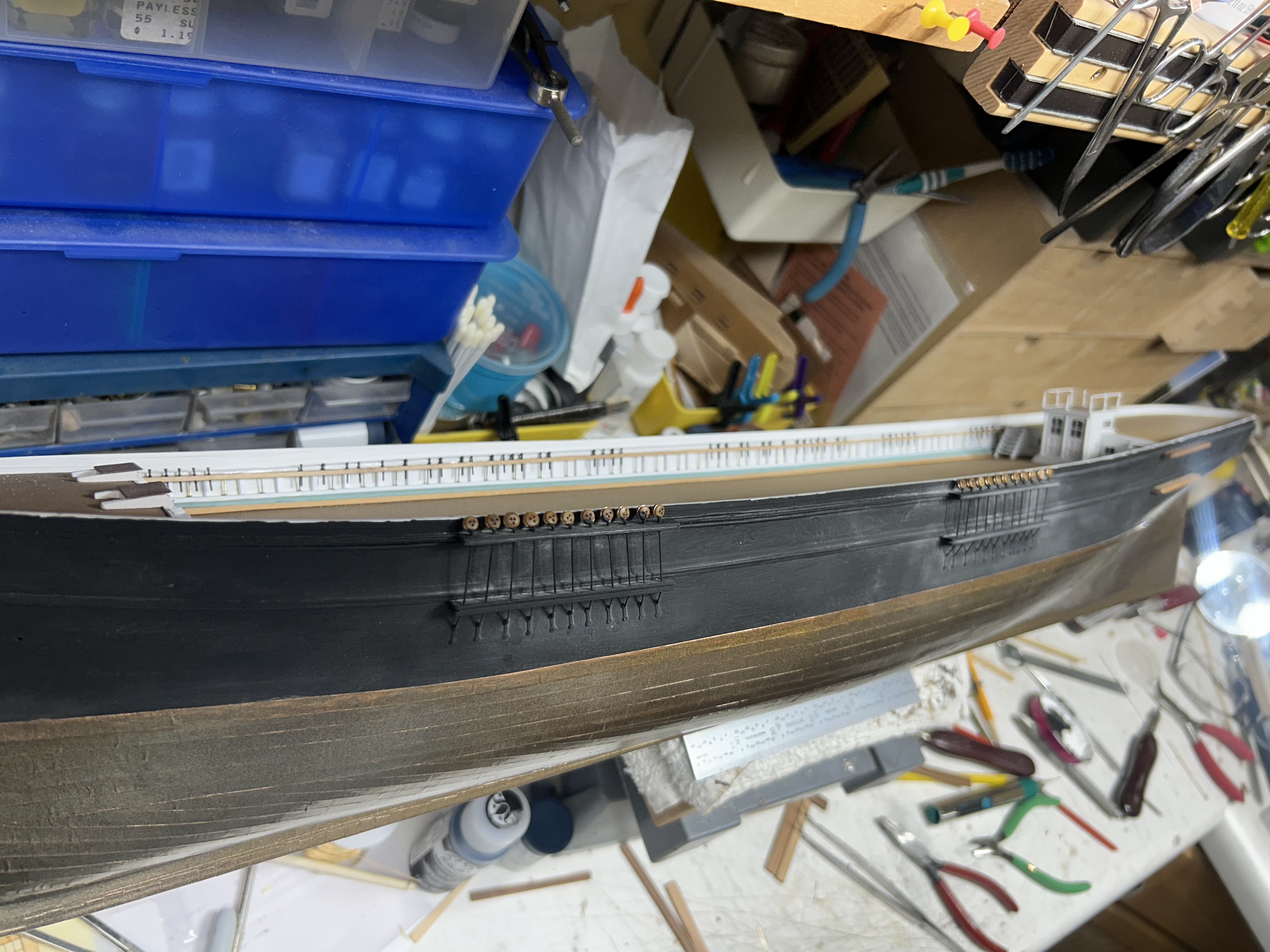

Work has been slow….. I just finished the mizzen port channels.
I won’t be working on Staghound for several weeks from today.  I have a large wedding to do sound for on Saturday and then we leave for a couple weeks on Monday for vacation.
Rob

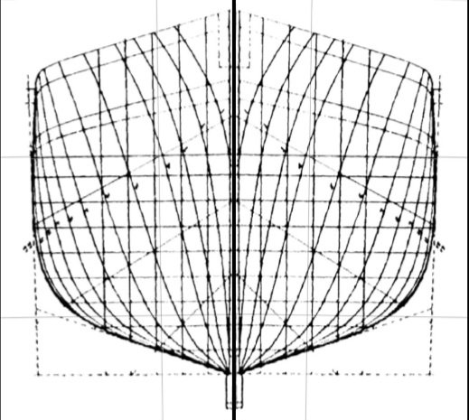

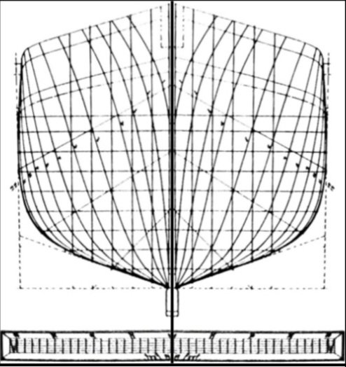

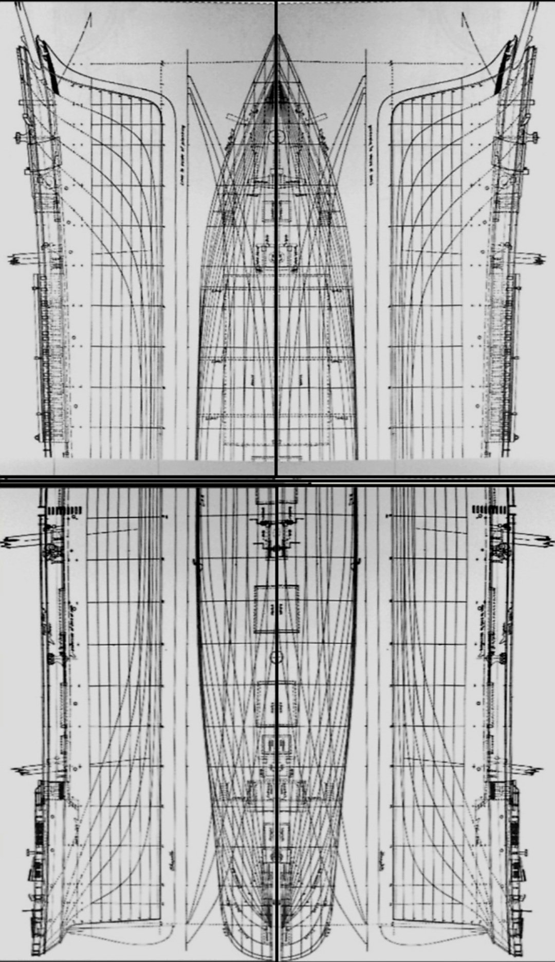

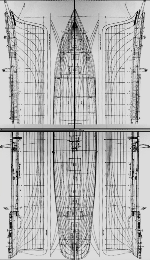

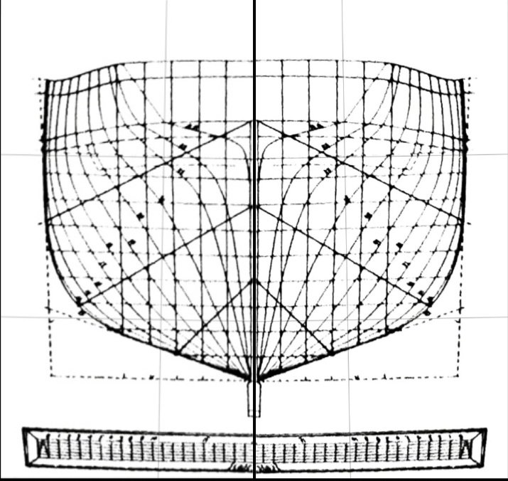

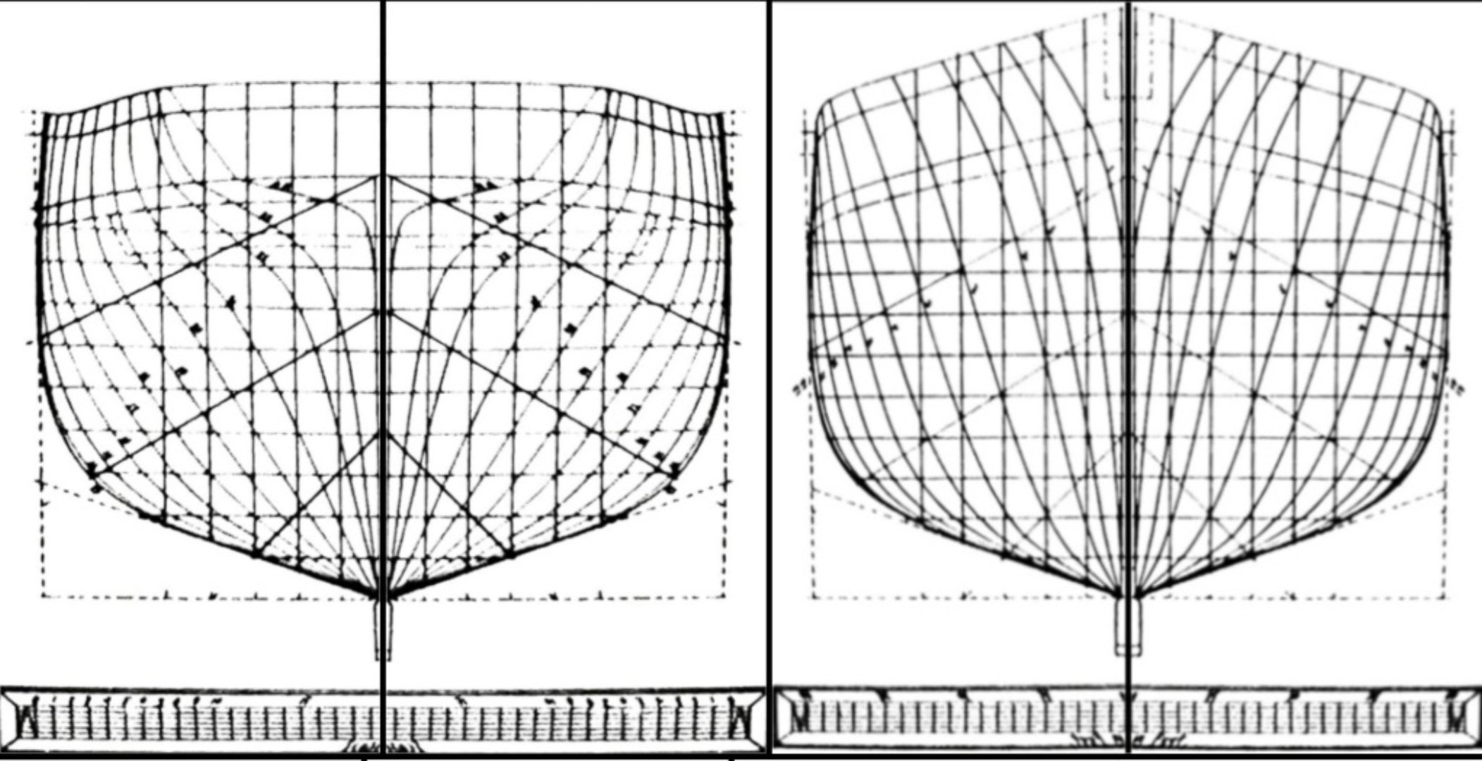

While we're waiting for Rob's return, I figured this would be a good time to update my progress on illustrating Stag Hound plans. Anyone who's been following Rob's build by now knows I'm working on developing the most accurate Stag Hound deck and sheer plans possible. Focusing on Chappelle plans from the 1967 "The Search for Speed Under Sail" I now have five digitally virtually identical sections combined into  coherent units. I will reconcile sheer and body plans with Vladimir's cgi work based on the Cornelius McKay hull model. Next, in this process is to trace these patterns with specific emphasis on maintaining accurate specifications. Then I will recreate all deck furnishings based on the McLean descriptions in the Boston Daily Atlas article.
improved bow image

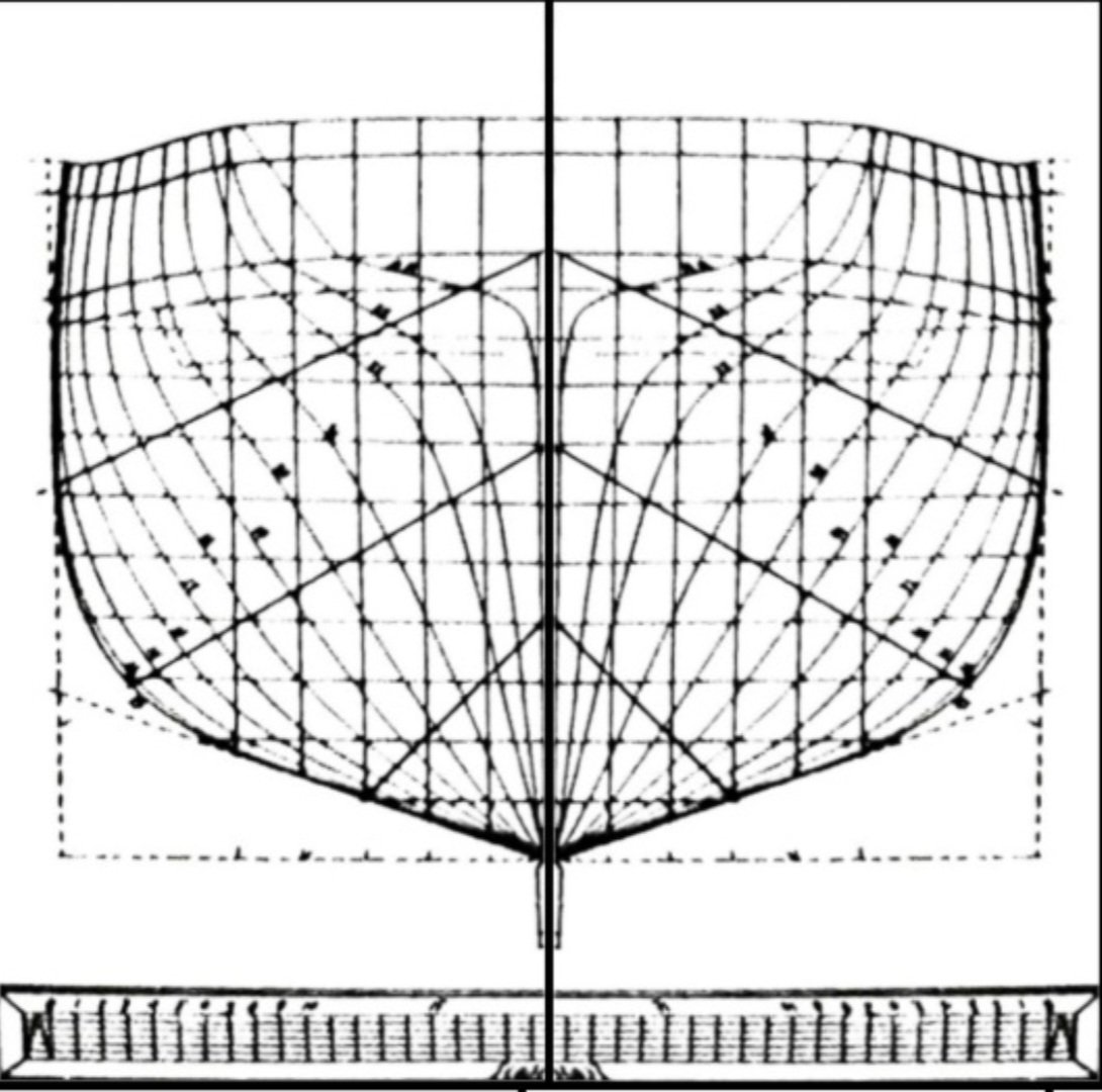

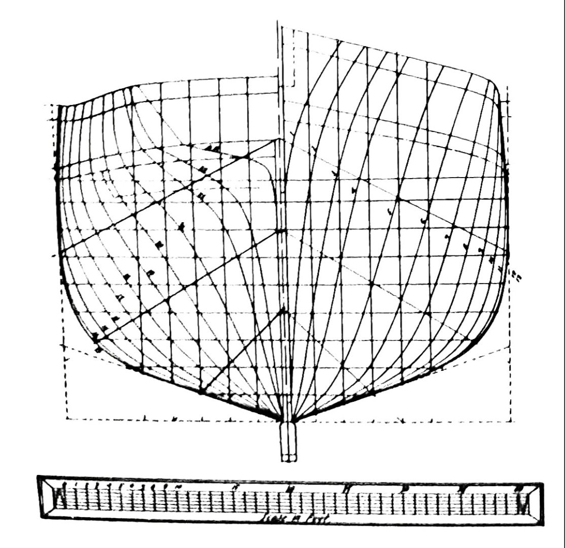

4 hours ago, druxey said:
Looks like serious distortion in the body plan that will need to be addressed.
 @druxey
thanks for challenging me to improve the body plans. I took a closer look at the original source and did the following revisions. Not perfect but I think you'll agree these are improvements. The bow looks damn near perfect, based upon the straight alignment of the lower scale. The stern is very close but still has slight curling at the ends of the scale. However, the pronounced "v" is gone. None of these preliminary plans are to be considered finished products. They're merely guidelines which I intend to use to create more accurate illustrations.
additional information
10 hours ago, druxey said:
Much closer now! Distortion is a pain to eliminate....
@druxey to give you an idea of where this began, here's the original image. It looks like I've taken this as far as possible with a limited cell phone app....
At least you had a good reference with the grid of waterlines and buttock lines, as well as diagonals.
