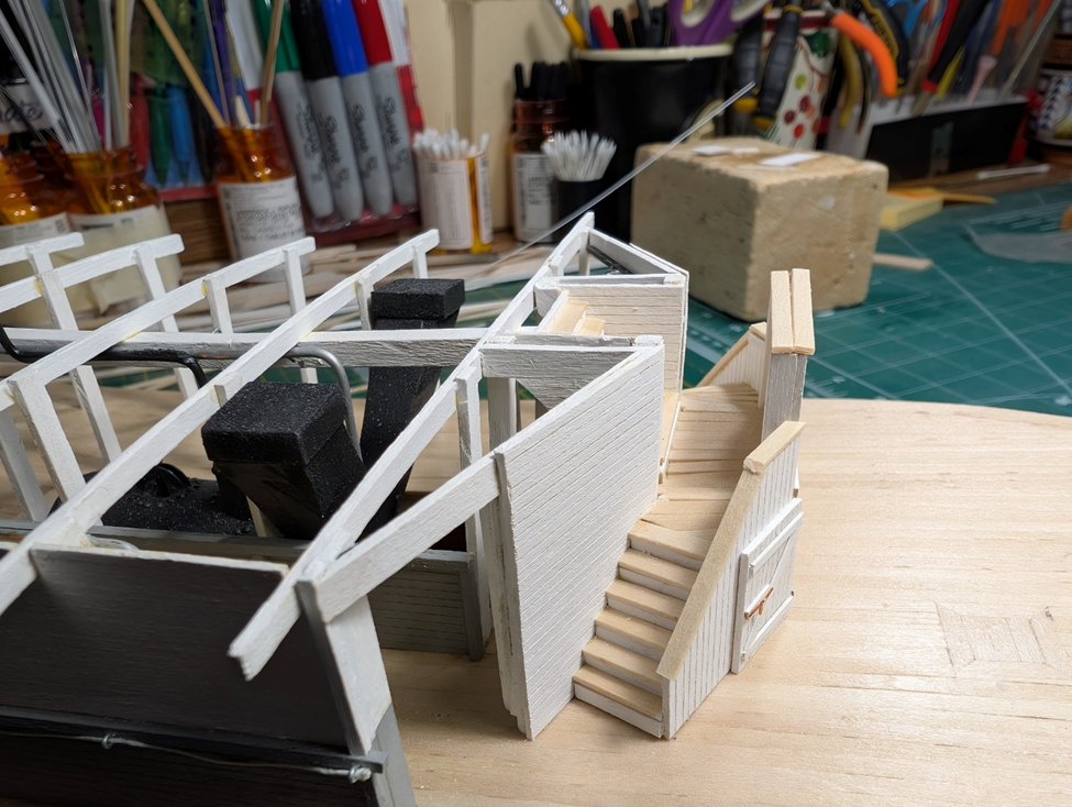

The stairs are now completed. JHC had a very utilitarian set of stairs.  Many of the other early steamboats had a wonderful rounded double stair with an arched entrance underneath.  JHC was simply squared off and angled.

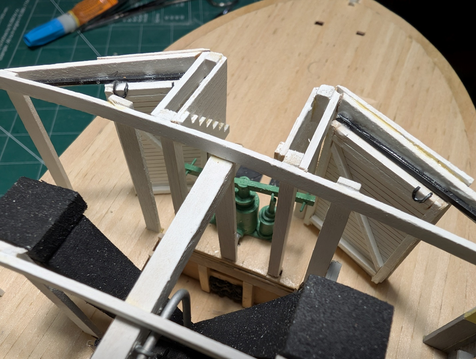

Early construction shows the sliding doors from the inside of the boiler room.  I needed to repair one of the door slides which I had knocked off.  The stairs stringers were cut to an 8-inch rise. A tread was then added along with a riser.
The arrangement for the stairs was a short central stair to a landing and then a short course of stairs to either side.

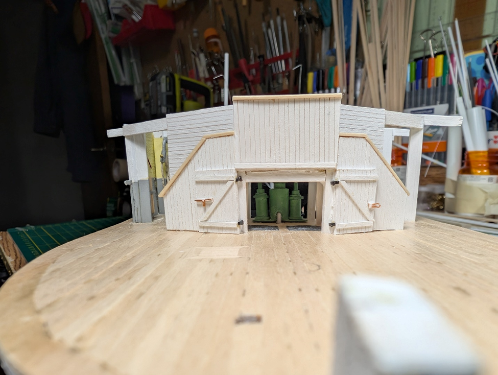

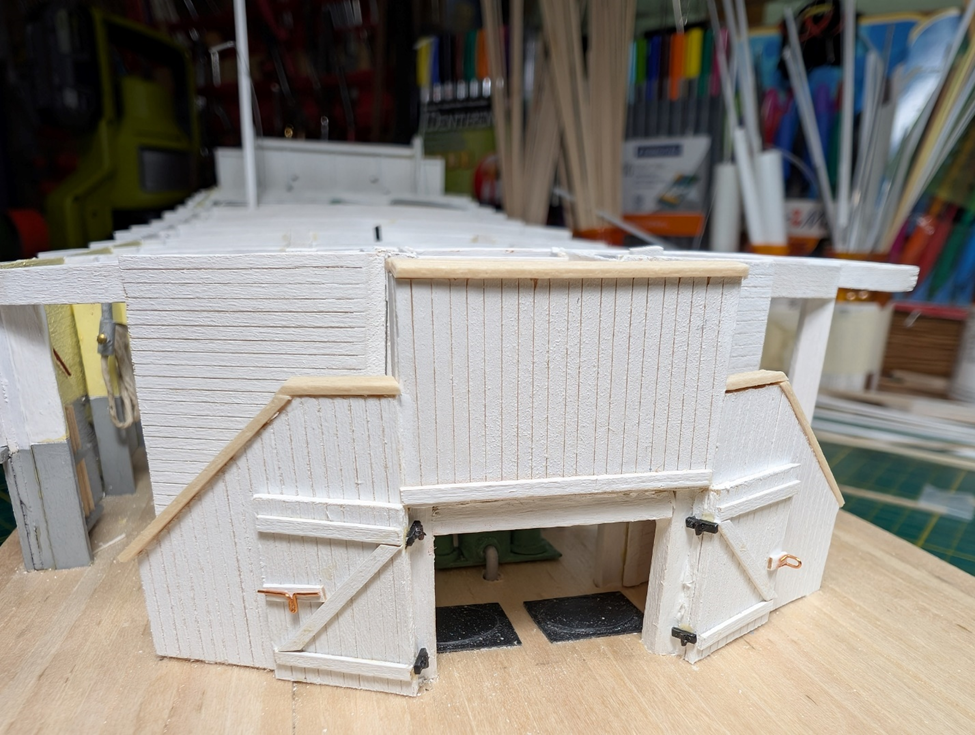

Two frontal views. The first shows an up close with the access doors to the coal chutes.
The second view is a front on with a view through the access doors.  The green hand pump is in the background.

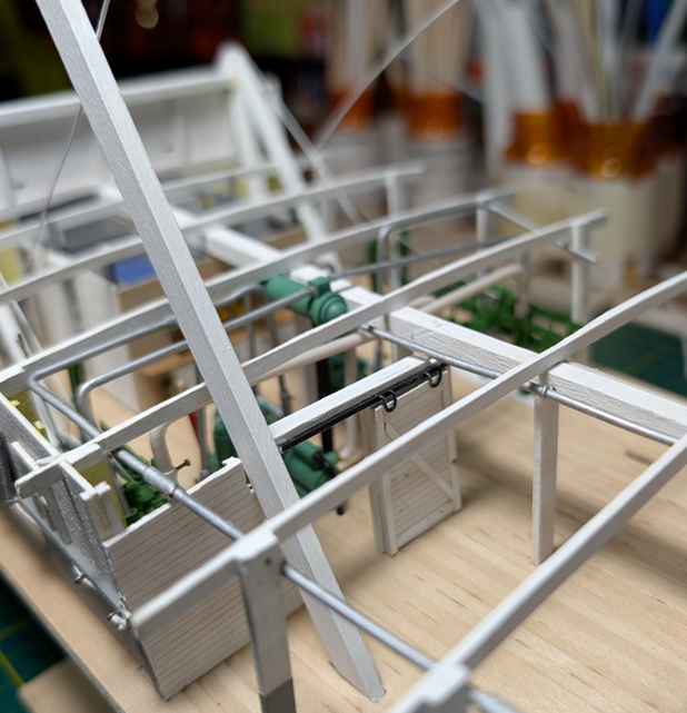

Time now to complete the rest of the underside of the boiler deck.  Before I can add the carlines, I need to add both bells, the speaking tube, steering ropes and a bilge pump.  I also need to complete the various water pipes. Lots of little odds and ends.

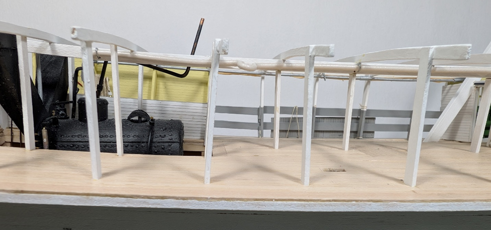

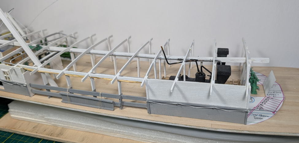

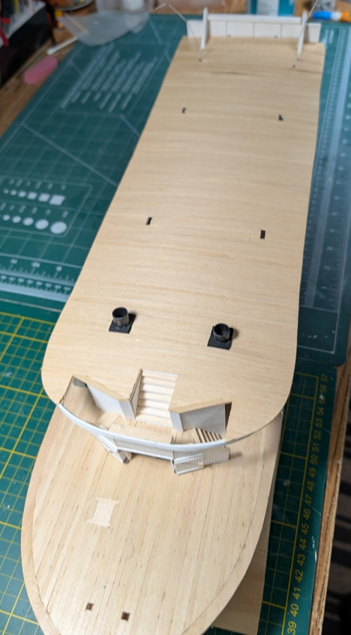

The carlines are done and now it is time to plank the boiler deck.
Surprisingly it was not the carlines which took the time but all of the other little piddly stuff: the two bells, the speaking tube, steering ropes, and a bilge pump.  Several water pipes were also added.  Most of this will never be seen unless it is really looked for.
Still needs a bunch of cleanups before the next step can start.
Note the four little piles of deck boards needed for the next step.

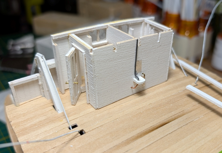

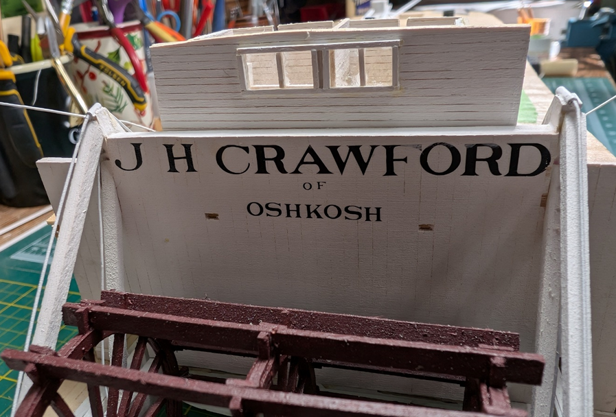

I am probably obsessive compulsive to do this, but I “Outfitted” the men’s and women’s toilets.  This really took a long time to complete (but I was also away for several weeks) and hopefully the rest of the cabins and furnishings will go faster. Please note this is build number two (Pun intended) as the first attempt was not good.
Amazingly, the later Ryan boat the Leander Choate (II) 1908 actually listed the dimensions of the toilets: 6 by 6.  The dimensions of virtually nothing else was ever listed, but for some odd reason, this was. Since both JHC and Choate had the same width (and eventually the same length), I used these dimensions.
The first photos are the interior look that will be partially hidden once assembled.  I have no idea if this was a “two holer” with a urinal trough in the men’s side.  As one who used this type outhouse in northern Wisconsin camps, privacy, and the sensation of smell leave much to be desired.  The false transom has drain holes that actually showed up on some photos.  Again, this is gross but effective as the spray from the paddlewheels would help clean this.
And the completed model.  This is self-standing and will be affixed later.   I would suspect there was a hand wash sink and mirror (and dirty towel to go with it) so I added this beneath the water tank which was located on the hurricane deck.

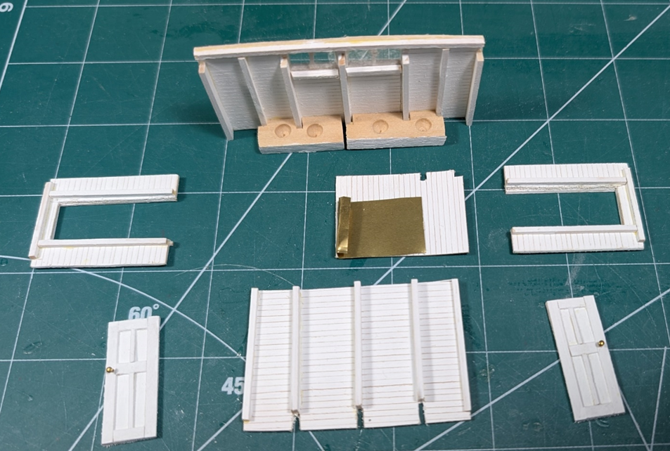

I have been working on the walls for the staterooms, saloons, &c.
This is what the walls look like for the boat interior.
And the reverse side for the exterior.
I continue to use mica to simulate the glass in the windows.  This really works well compared to the clear plastic that I used in Thistle.  Again, thanks for the suggestion.
I need to create the furnishings before I can assemble the superstructure.  I will use a modified description of what was used on the sister boats, Leander Choate (II) and Paul L.  This means a women’s saloon, a men’s smoker (these were both 15 by 15 feet), a galley/kitchen, three staterooms for the Captain, Cook and Engineer, and lastly a multipurpose office used by the purser, captain and small mail and package storage.
