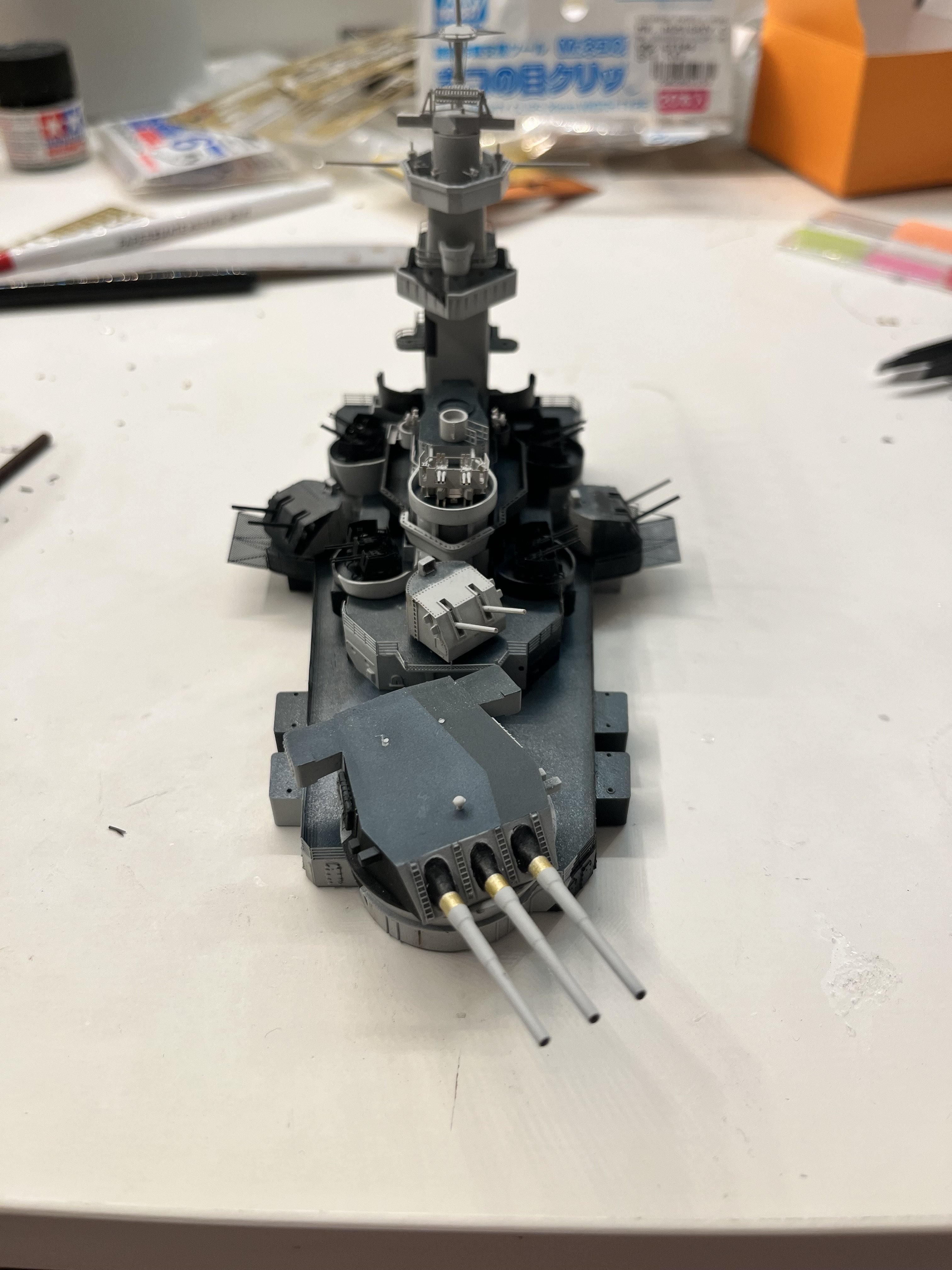

As well as some weathering I did before on the forward superstructure:
IMG_8300.thumb.jpeg.0fe4915c8596766ff964de8046815fad.jpegIMG_8301.thumb.jpeg.39bd54698dae4b52cce88c787286df82.jpegIMG_8302.thumb.jpeg.941e15c3d35d1027f041f597eb675a5f.jpeg
The salt on the black parts of the camo is really annoying, it stands out way too much and is hard to remove even with a proper coat of varnish. Hopefully the panel liner will tone it down. Tomorrow I’ll put on another coat and add some rust streaking and chipping. Also what are some techniques for weathering the underwater hull, it’s looking a little bland and even with chipping it’ll probably look empty.
