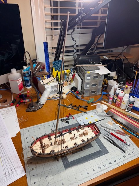

Now I've started on the masts, spars, what-have-you.

Working on the rigging, I've learned something already. After tying a seizing and dabbing on a little dilute white glue, I need to wait until the glue is completely dry before trimming the loose ends. Otherwise the knots come loose and I end up doing it all over.
Luckily, it seems a lot easier to fix mistakes in rigging than planking. At least, so far.

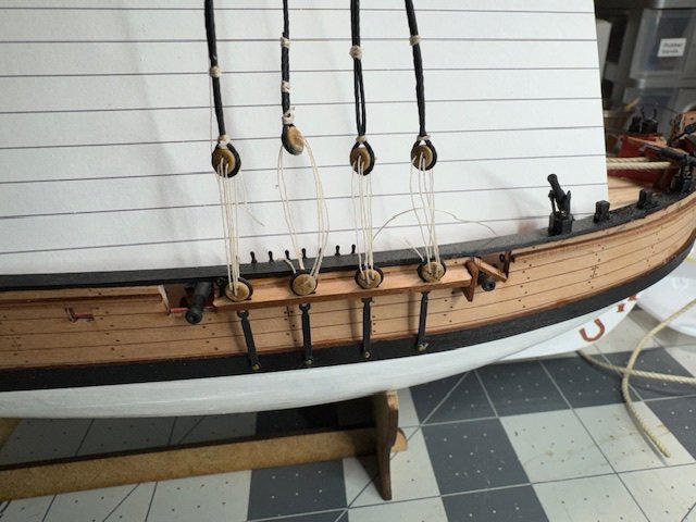

The mast is up, and I'm working on the shrouds. I'm just eyeballing the deadeyes' alignment.
I just put the 3x5 card there so the camera could see the deadeyes, but those lines on the card look like they might be helpful 🙂
Well, I'm getting a wee bit frustrated. My seizings on my shrouds keep coming undone after I trim the loose ends. I'm tying a square knot and soaking it well with dilute white glue, then giving it a day or more to dry, so I'm not sure what I might be doing wrong.
Maybe it's my dilute white glue? I keep reading "dilute white glue" but nobody actually says how dilute it should be - 50-50? 90-10 glue? 90-10 water?
Or maybe something else. It tempts me to reach for the CA glue, but I'm trying to avoid that if I can.
