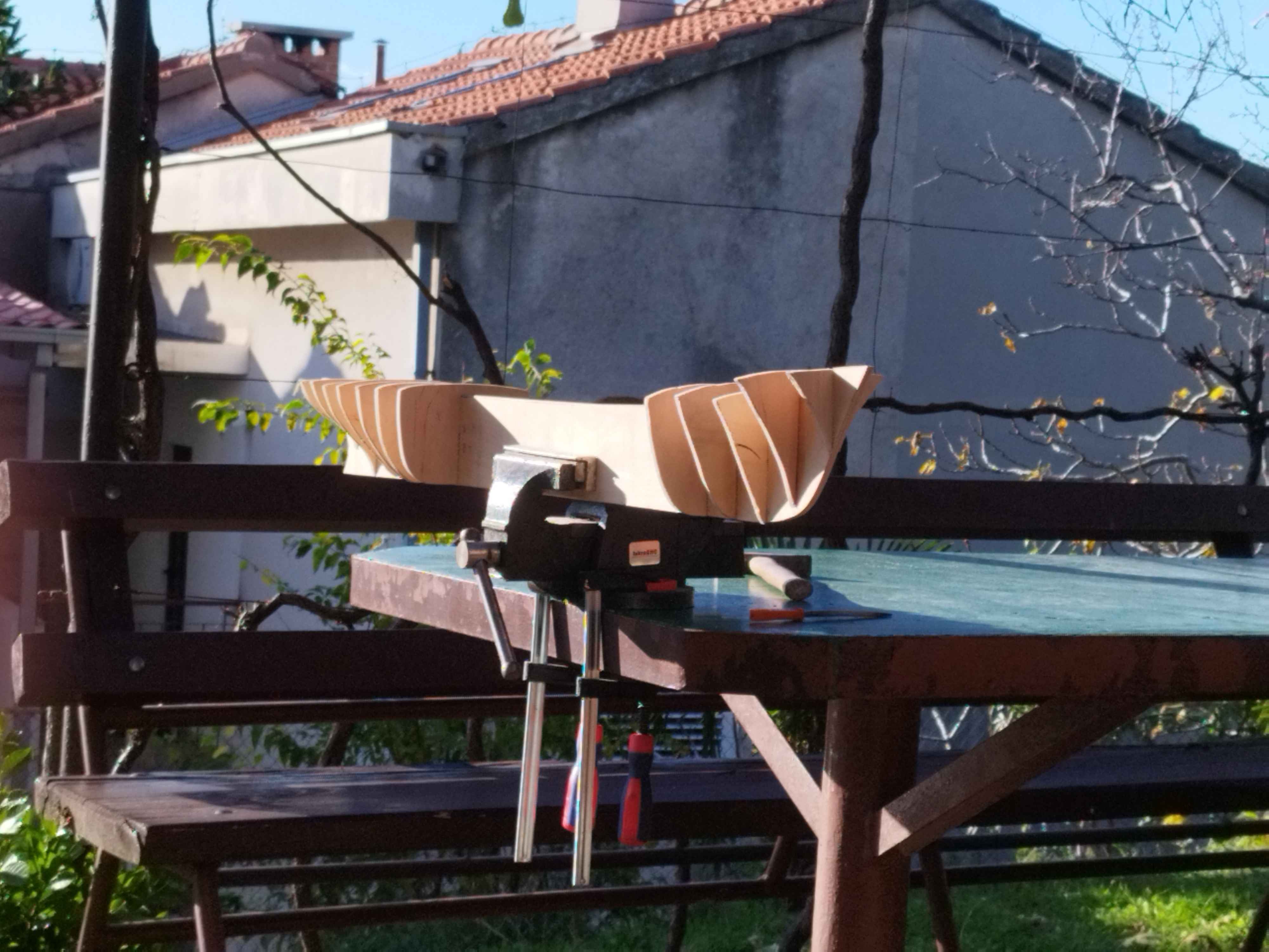

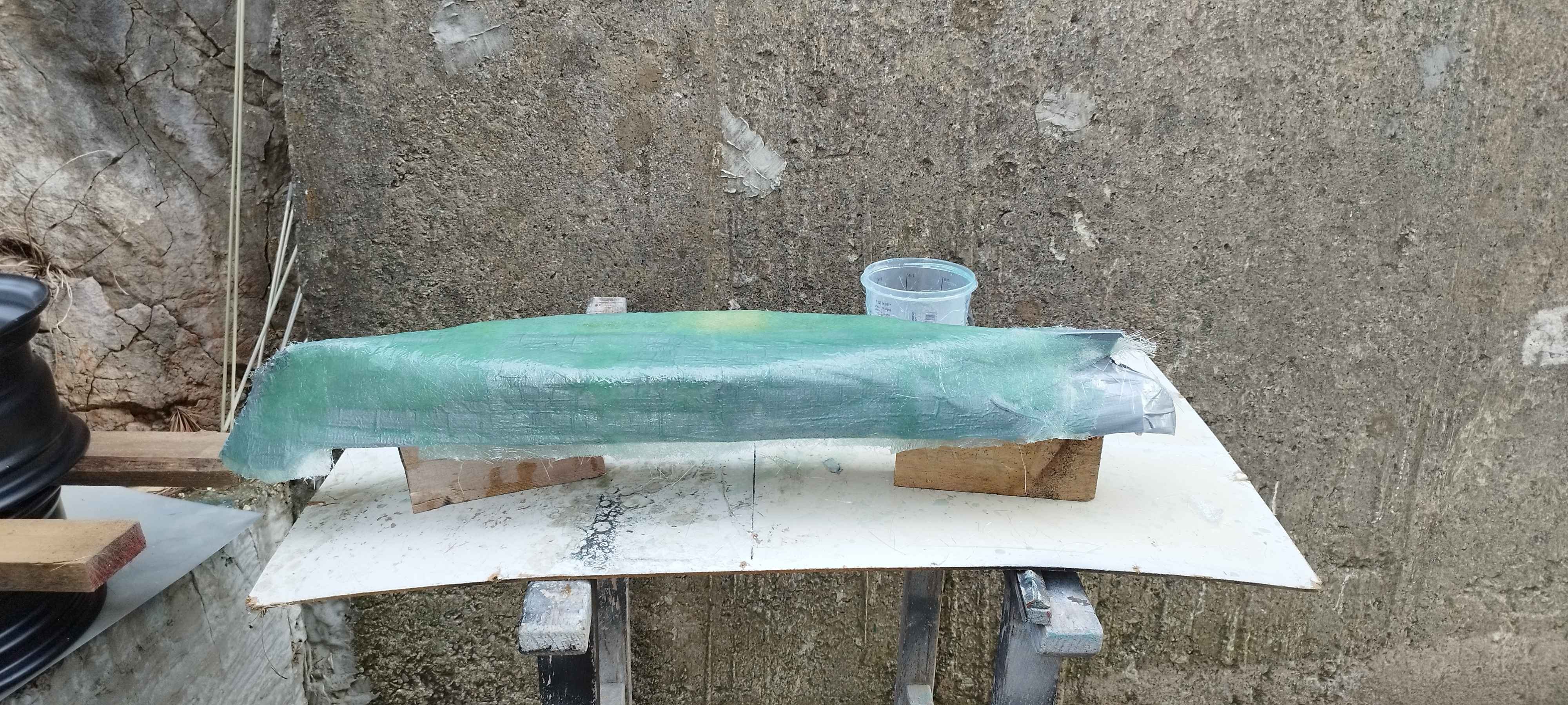

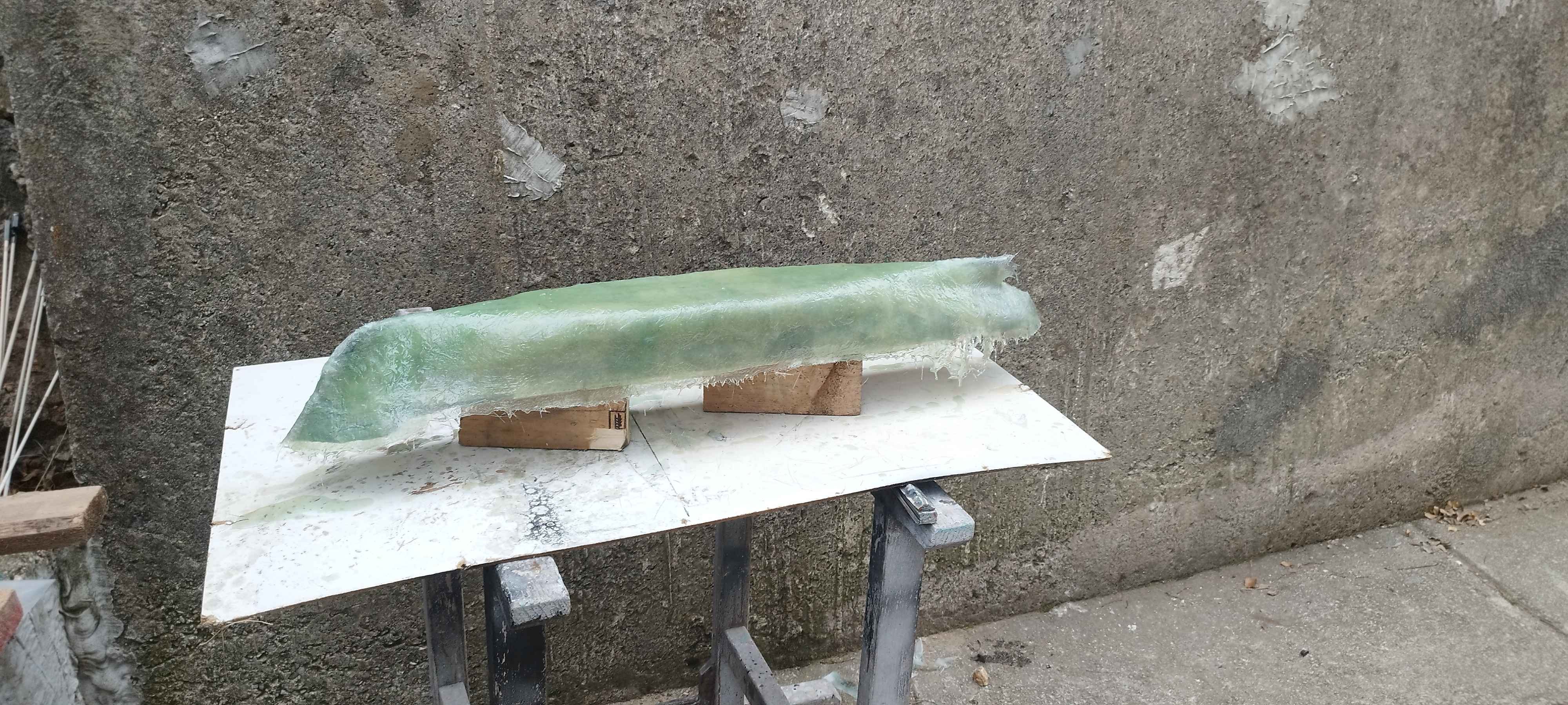

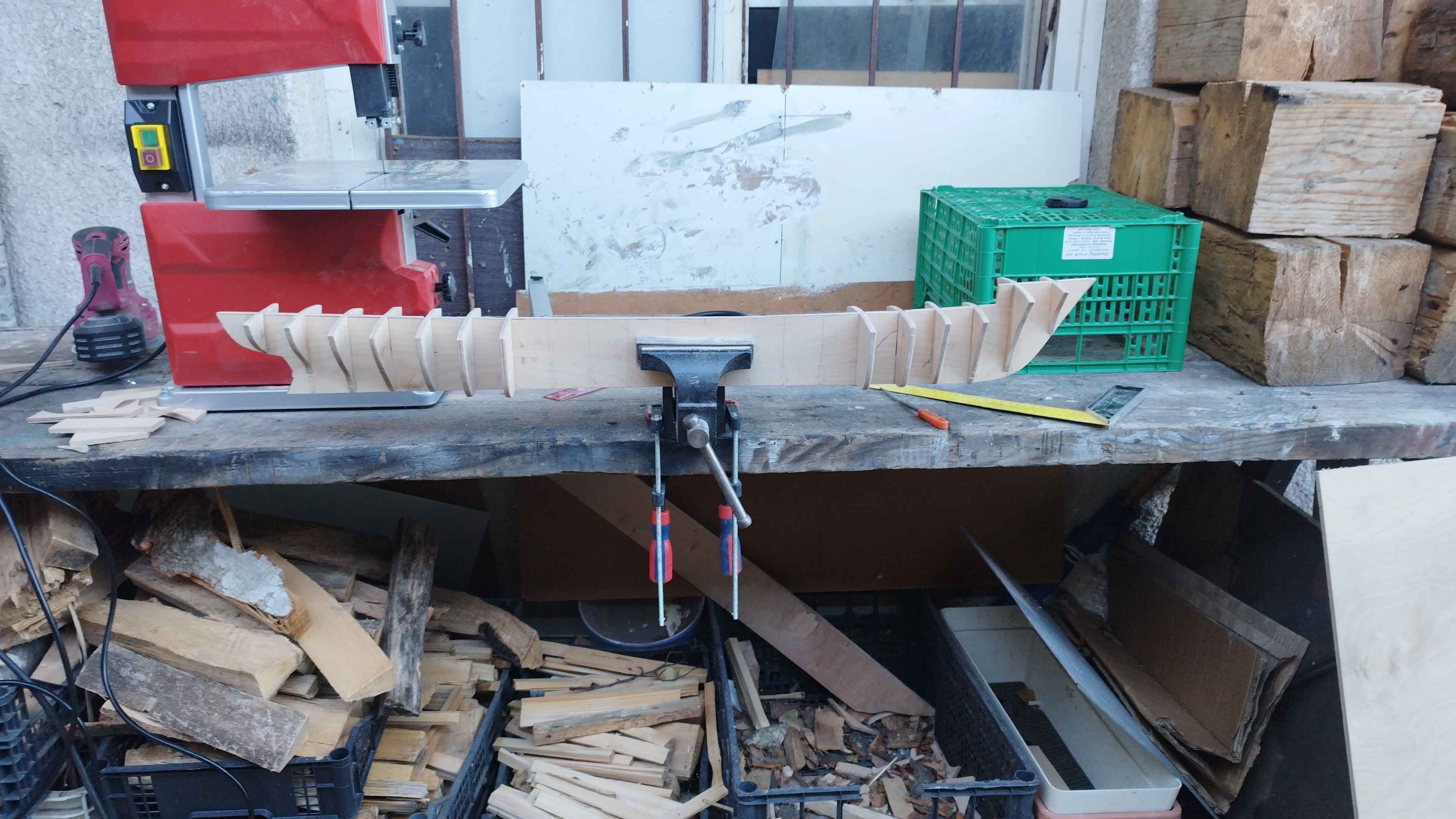

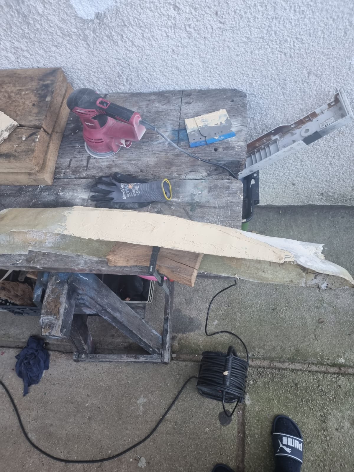

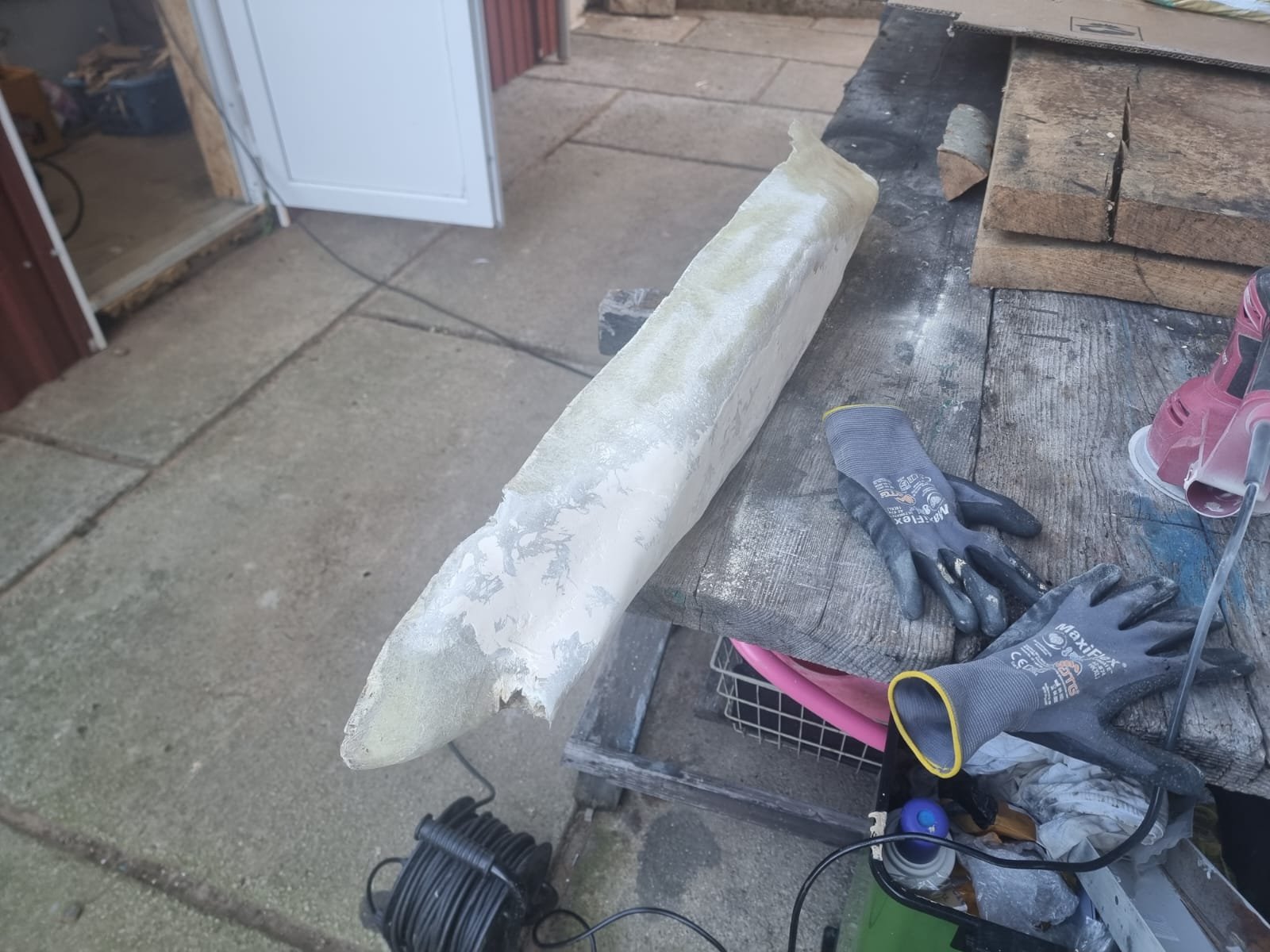

So...life got in way and I didn't do any work on the model. But, I did finish the keel and using duct tape, I got the hull. And that's where it left off.

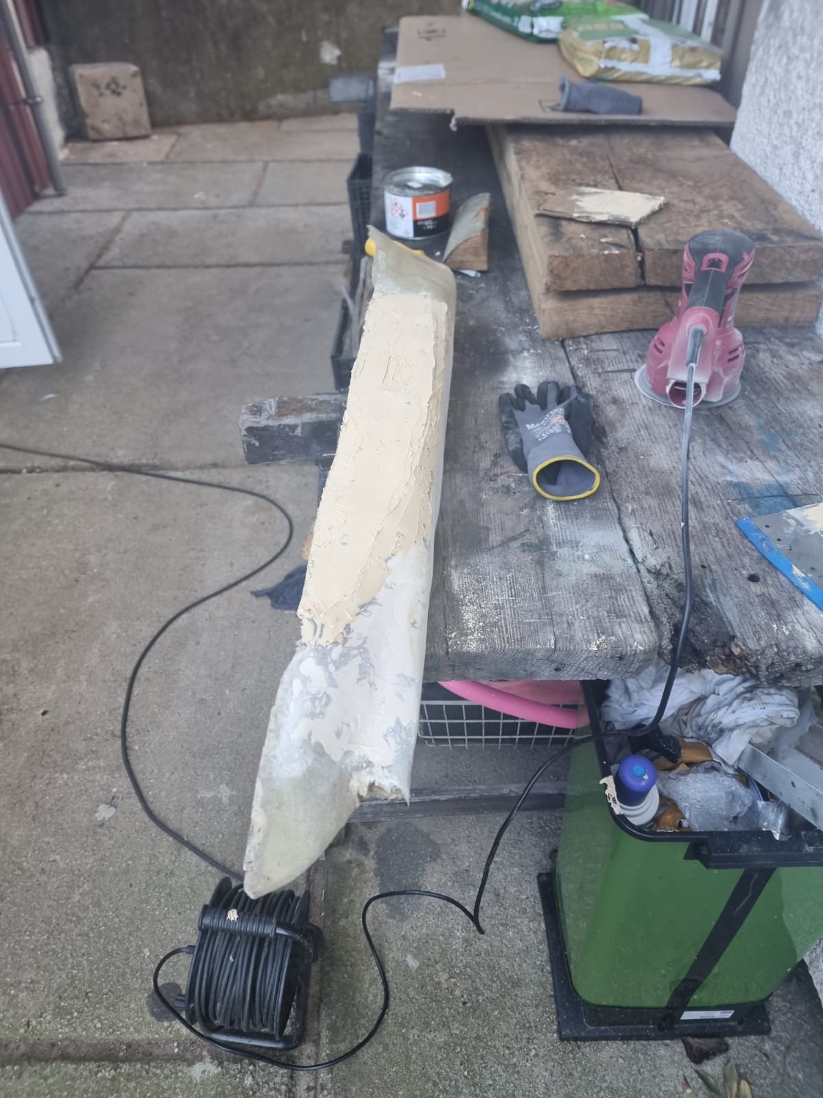

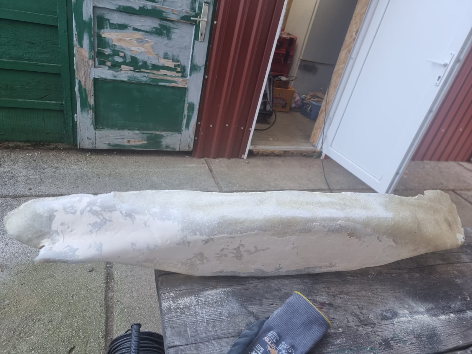

Yesterday, I finally got to applying filler and sanding it. The hull came out badly; when I made the ribs, they were all over the place. It was my first time doing this, and it really showed. But, I pressed on - I have to learn the ropes of this hobby somehow. I should also mention - it was my first time using bondo, so it looked like a disaster. I am a clumsy person, and the hull shows it.
Now, the next step will be the deck and the superstructure; I am going to solve the deck problem with expanding foam - first apply something so that the foam doesn't stick to the hull on the inside, then apply foam, after that when it expands, cut it so it matches the deck, remove it, apply fiberglass, sand it, and then make holes for the RC and other electronics.

From someone who made the same mistakes (see topic on LPG tanker Chaconia), I can give you one advice.
Either start over on that hull starting from the beginning and make those frames again, but perfect this time.
Or, less optimal, carry on, the way you are going now, but continue with filling and sanding untill it truly is perfect. Use primer layers to spot the bumps and dents. I do fear the wobly hull will always show through though. Filler can only do so much.
The reason I'm saying this, is that such ships are a long process and your skills evolve during construction. In the end you're building good details etc, but still on a less-than-perfect hull, and it's going to bother you, believe me 🙄
That said, at least you took on a rare scratchbuild project and got started (that's better than 99.9% of people). If you finish it, people will certainly admire it, unable to understand how you pulled it off.

I would think about redoing the hull if this is to be a R/C model. Any incorrect curves and such will affect the handling, causing it to turn one way or the other. It really should be as symmetrical as possible along the centerline.
Phil
